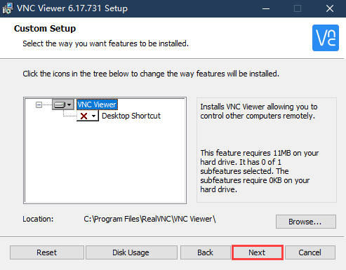

(1) Double-click the installation program VNC-Viewer-6.17.731-Windows in the same directory as this section. Select the installation language as “English” and lick “OK”.
(2) Click “Next” to proceed.

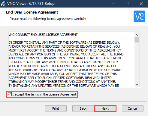

(3) In the License Agreement window, select “I accept the terms in the License Agreement”, then click “Next”.
(4) Keep the default installation location and click “Next”. When you are taken to the next screen, simply click “Install”.
(5) Once the installation is complete, click “Finish”.

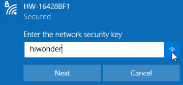

2.1.2 Connect to Robot
(1) After turning on, it is the AP direct connection mode by default, and Raspberry Pi will launch a hotspot starting with “HW”. Please search for and connect to this hotspot on your computer, as shown below:
(2) Input password. The password is “hiwonder”.

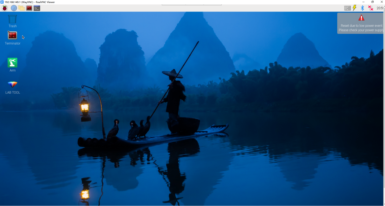

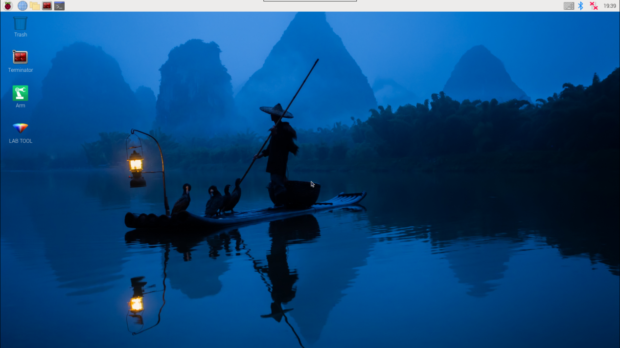

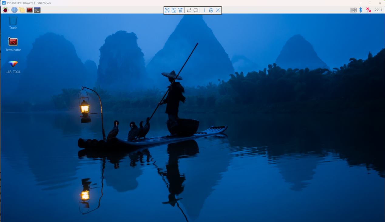

2.1.3 Introduction to Desktop
After successfully connecting to the MentorPi via VNC, the operating interface will appear as shown below:
The following table provides an explanation of commonly used functions:
| Icon | Function |

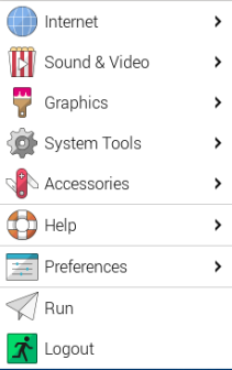

Application menu. Click to select different applications.
Browser comes with the system. |
File manager. |
LX terminal. Click it to open a command line terminal for entering commands. |
Trash can allows you to recover recently deleted files. |
PC software allows you to adjust the the position of the pan-tilt and color threshold. |
Click it to enable or disable full-screen display of the desktop. |
Exit full-screen mode. |
Power. Click it to shut down, restart, or log out of the system.

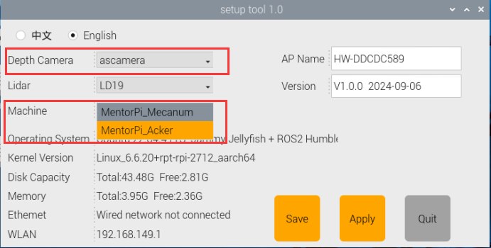

2.2 Robot Version Configuration Instruction
MentorPi offers multiple chassis options (Mecanum wheel or Ackermann steering) and different camera versions. If you need to switch between robot configurations or camera types, please follow the steps below:

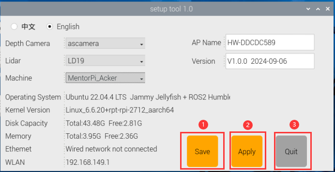

(1) Start the robot and connect it to the VNC. For more details about the connection, please refer to “2.1 VNC Installation and Connection”.
(2) In the remote desktop, double-click the robot system configuration tool
. Then, click the “Execute” to execute it.

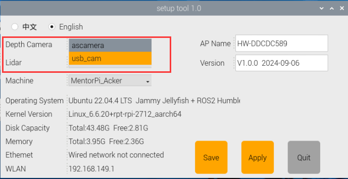

(3) Select the appropriate camera type under the Camera Type dropdown:
① “ascamera” represents the 3D depth camera.
② “usb_cam” represents the 2D monocular camera.
(4) Select the correct chassis type under the Machine Type dropdown:
① “MentorPi_Mecanum” represents the mecanum wheel chassis.
② “MentorPi_Acker” represents the Ackermann chassis.
(5) Click the buttons in the following order: “Save” → “Apply” → “Quit”. This sequence must be followed to successfully apply the new configuration.
(6) Wait for a beep sound from the buzzer, indicating that the chassis type has been successfully updated. Then, open the terminal

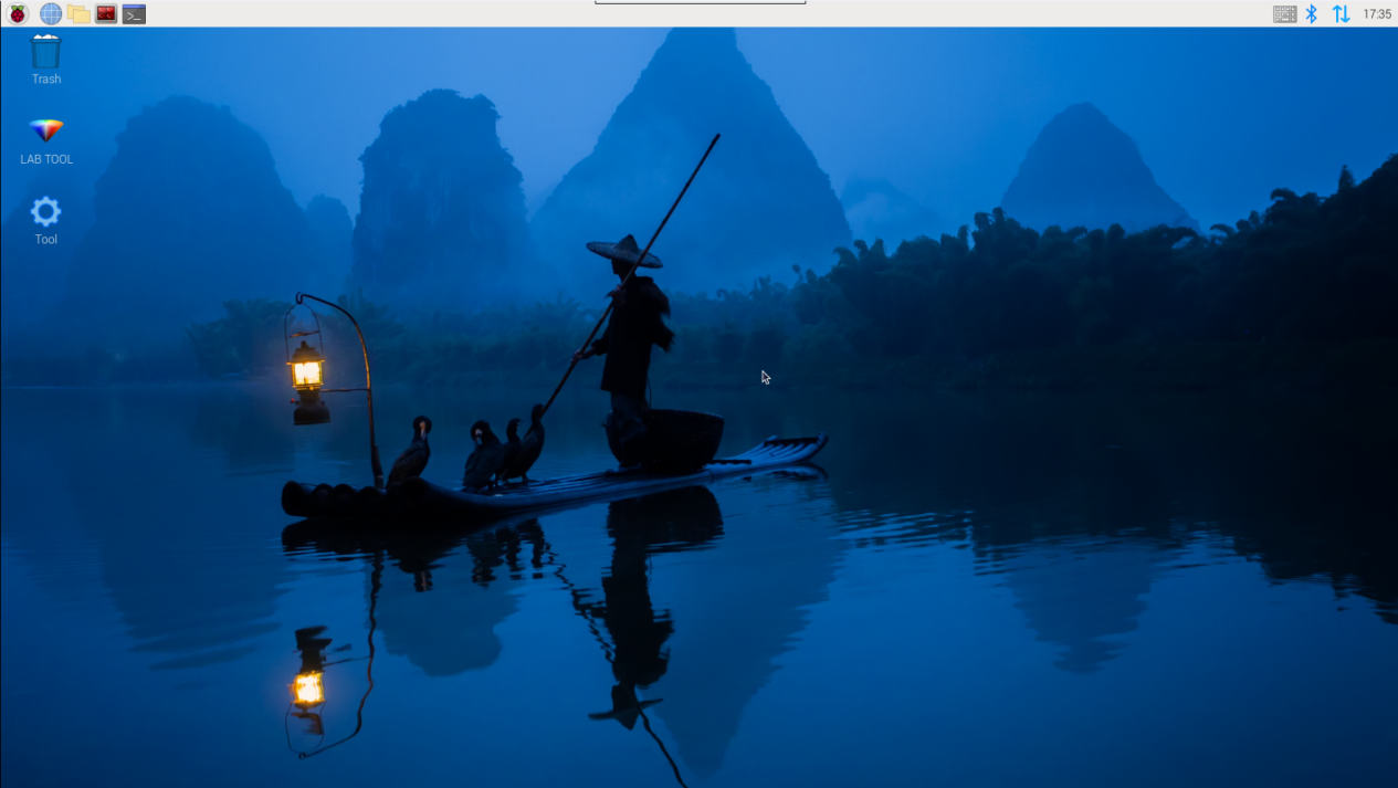

2.3.1 Desktop Overview
After establishing a remote connection via VNC, the Raspberry Pi system desktop will appear as shown in the image below:
| Icon | Function |
Version Switching Tool: switch between different versions and configurations of the robot car. |
Color model parameter adjustment tool. |
Command Line Terminal: input commands for operations. |
Recycle bin. |
Raspberry Pi menu bar. |
System file folder. |

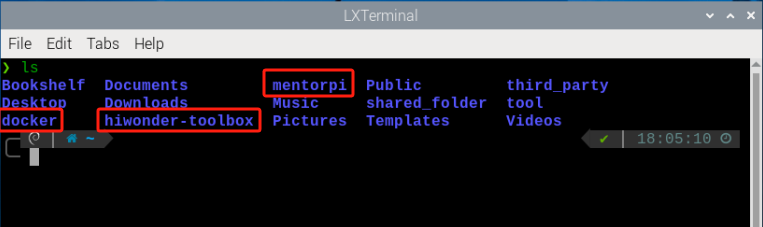

(2) Type the following command and press Enter:
ls
| Directory | Function |
| MentorPi | Contains debugging tools specific to MentorPi |
| hiwonder-toolbox | Wi-Fi management tool. |
| docker | Shared folder between the Raspberry Pi system and the Docker container |

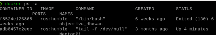

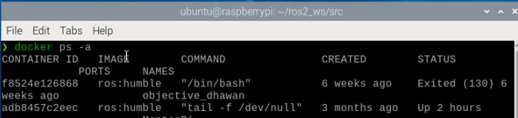

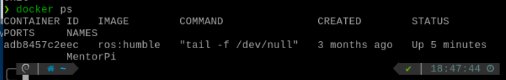

(4) In the terminal, enter the following command to view active and previously run containers:
docker ps -a
(5) Use the following command to access the container:
Replace <container_id> with the actual container ID. It can be abbreviated as long as it remains unique.
docker exec -it -u ubuntu -w /home/ubuntu adb8 /bin/bash(The container'sID can be abbreviated as long as it remains unique.)
The container ID can be abbreviated as long as it is the unique identifier of the container.

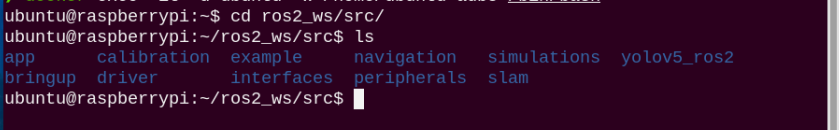

(7) Enter the command “cd ros2_ws/src/” to access the directory of the game and source code. Then, enter the command “ls” to list all folders and files under this directory.
cd ros2_ws/src/
ls
| app | Store app game function package |
| example | Game case |
| bringup | Reference to app function |
| driver | Underlying control |
| interfaces | Program interface |
| peripherals | Hardware driver |
| navigation | Navigation |
| slam | Mapping |
| yolov5_ros2 | yolov5 game |
| simulations | urdf description |

Check Container
Command parameters: docker ps [OPTIONS]
Commonly used parameters:
(1) -a:list all running and previously run containers
(2) -l:display the latest created container
(3) -n=?:display multiple (n) recently created containers
(4) -q:Default mode: only display container IDs

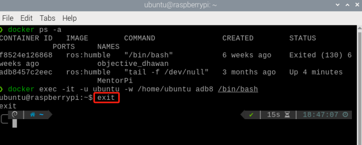

Enter the following command and press “Enter” to display a list of running and previously run containers. The output will show the “container ID,” which is the unique identifier for each container, the “image”, which indicates the name of the image used, the “created” time, which shows when the container was created, and the “status”, which indicates the current state of the container.
docker ps -a
Enter Container
Obtain the unique container ID based on “2.4.2 Docker Command -> Check Container”. Enter the command to access the container that contains the function programs.
docker exec -it -u ubuntu -w /home/ubuntu adb8 /bin/bash (The container ID can be abbreviated as long as it remains unique to the container.)
The container ID can be abbreviated as long as it is the unique identify of the container.
Exit Container
There are two commands for exiting containers:
Method 1: Enter the command below and press “Enter”. This stops the container and exits it.
exit
Method 2: Use “crtl+P+Q”. This detaches from the container without stopping it. Then use docker ps to verify that it is still running:

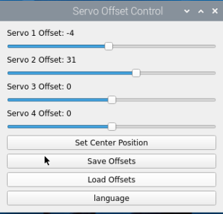

./Servo.sh

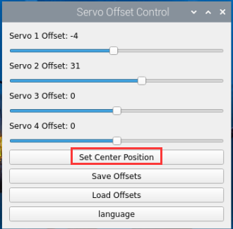

(4) After executing the command, a pop-up window will appear as shown below.
(5) Drag the four sliders shown below to adjust the corresponding servo offsets. The servos will rotate in real time during the adjustment, allowing you to observe their movement and fine-tune the deviation accordingly.
(6) If you’re not satisfied with the adjustment results, click the ‘Set Center Position’ button to reset all servo offsets to their default center positions and readjust as needed.

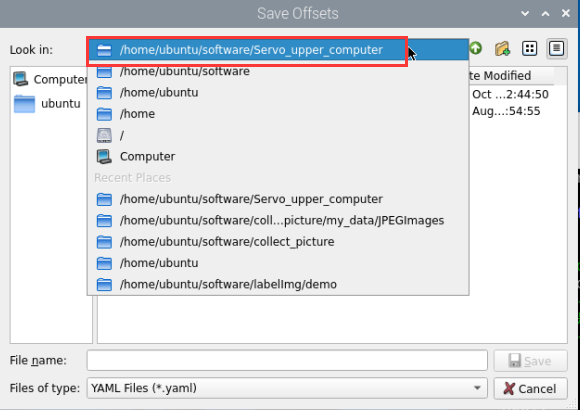

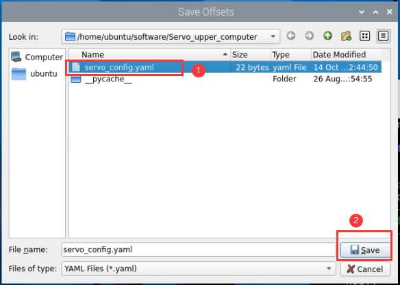

(7) After adjusting the servos to the desired positions, click the ‘Save Offsets’ button to save the calibration settings.
Below is the storage path.
The following file will be saved:
After completing this step, the offset values will be stored. In all future applications involving the servos, this offset file will be automatically loaded to compensate for any servo deviations.

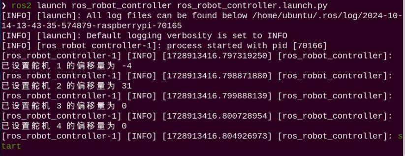

(8) You may also enter the following command and press Enter to launch the chassis control node and verify that the offset values have been applied correctly.
It can be confirmed that the offset values have been successfully saved to the file and can be correctly loaded in other applications.
