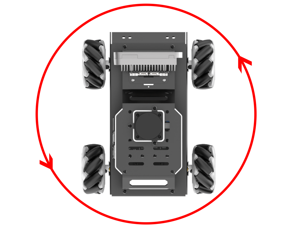

3.1 Mecanum Wheel Chassis Motion Analysis

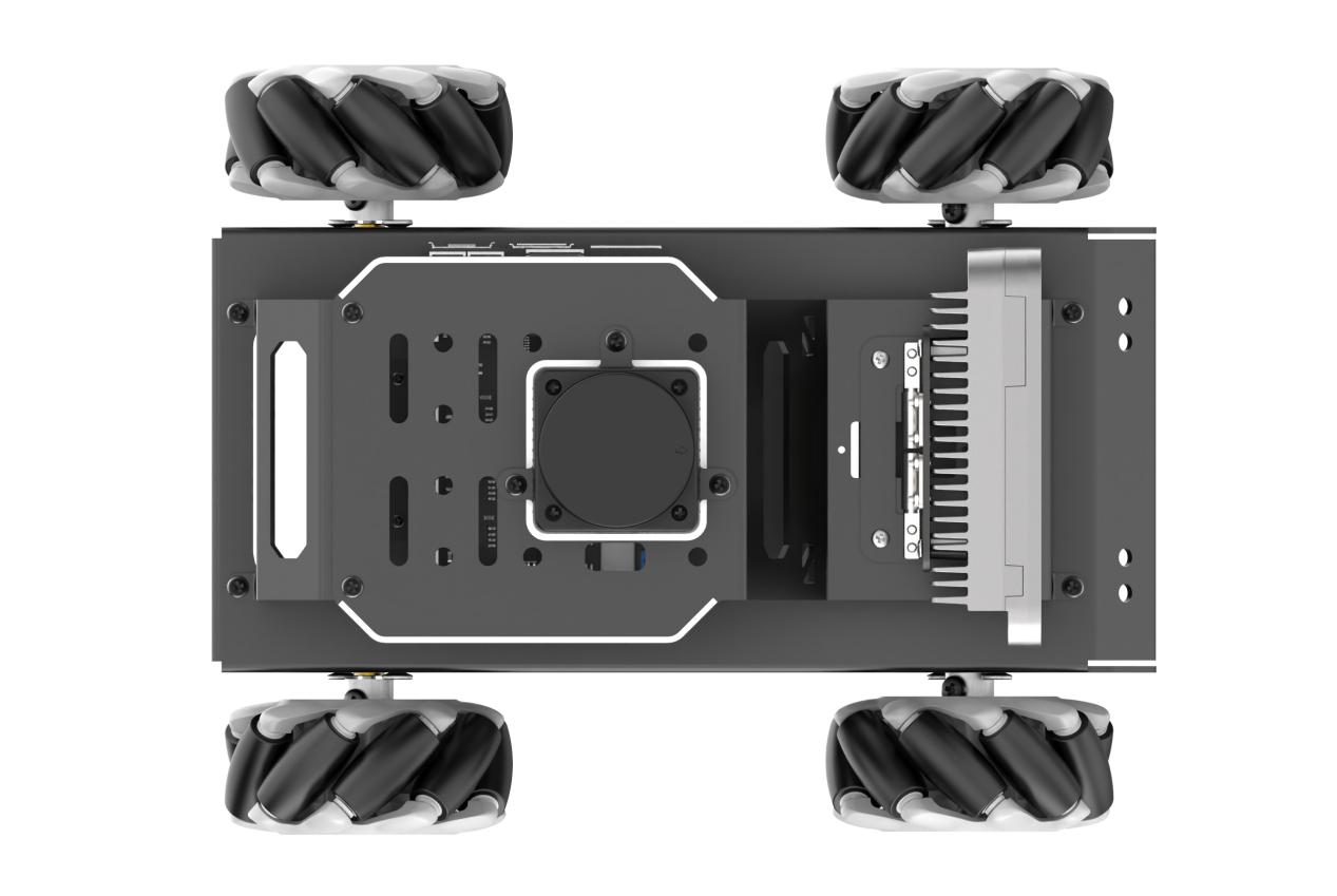

3.1.1 Hardware Structure

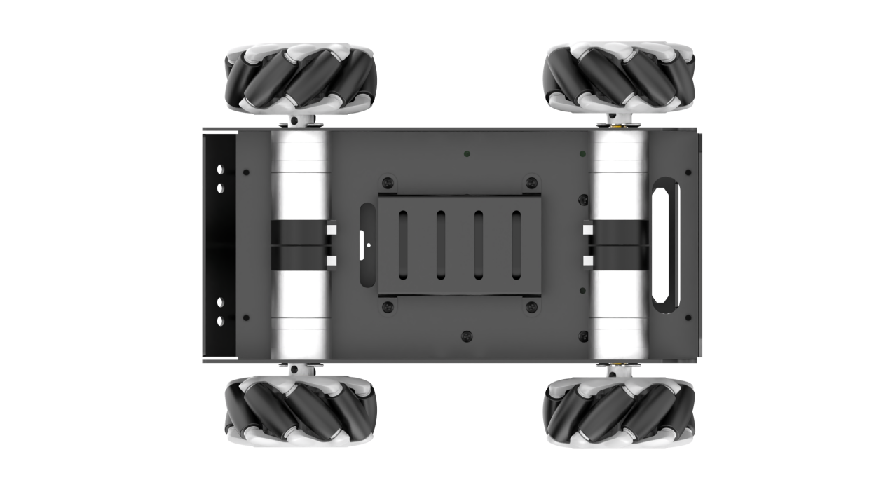

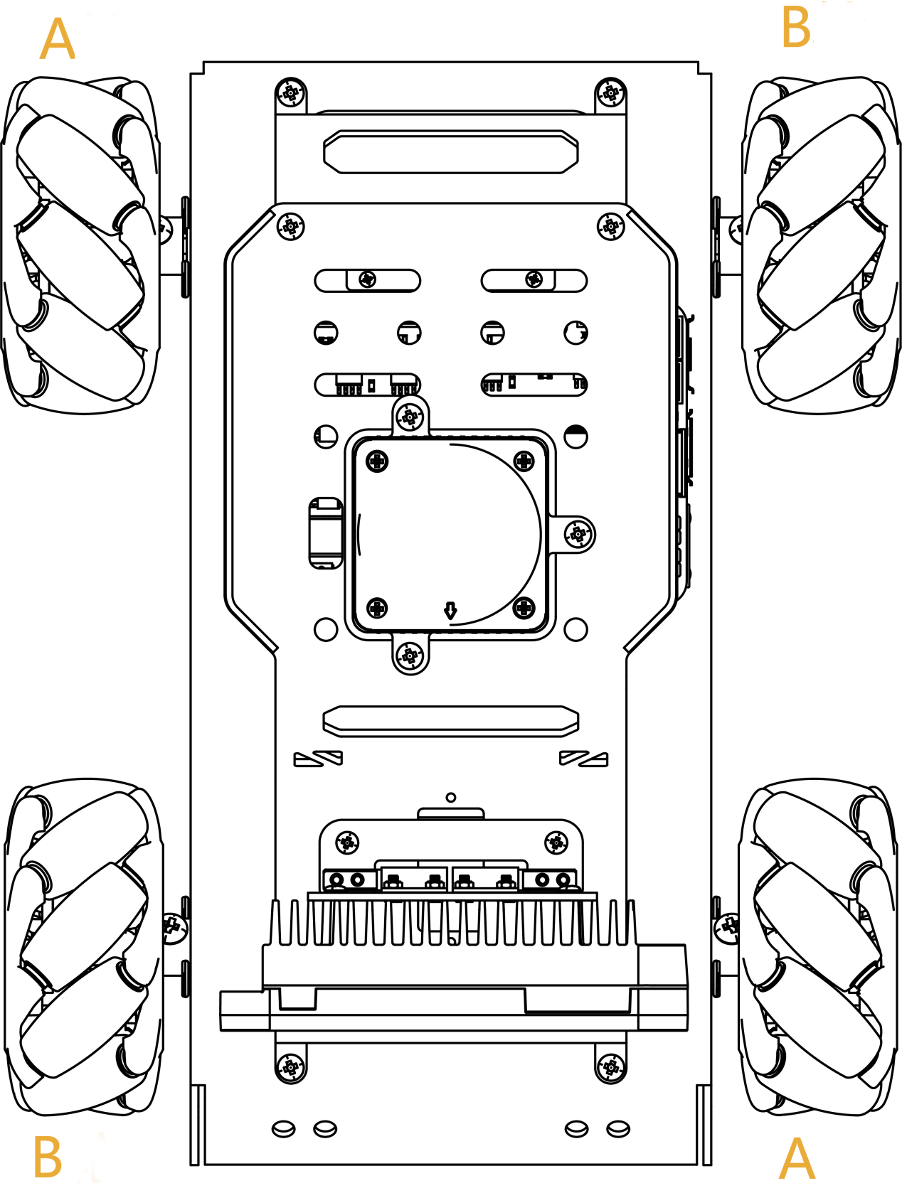

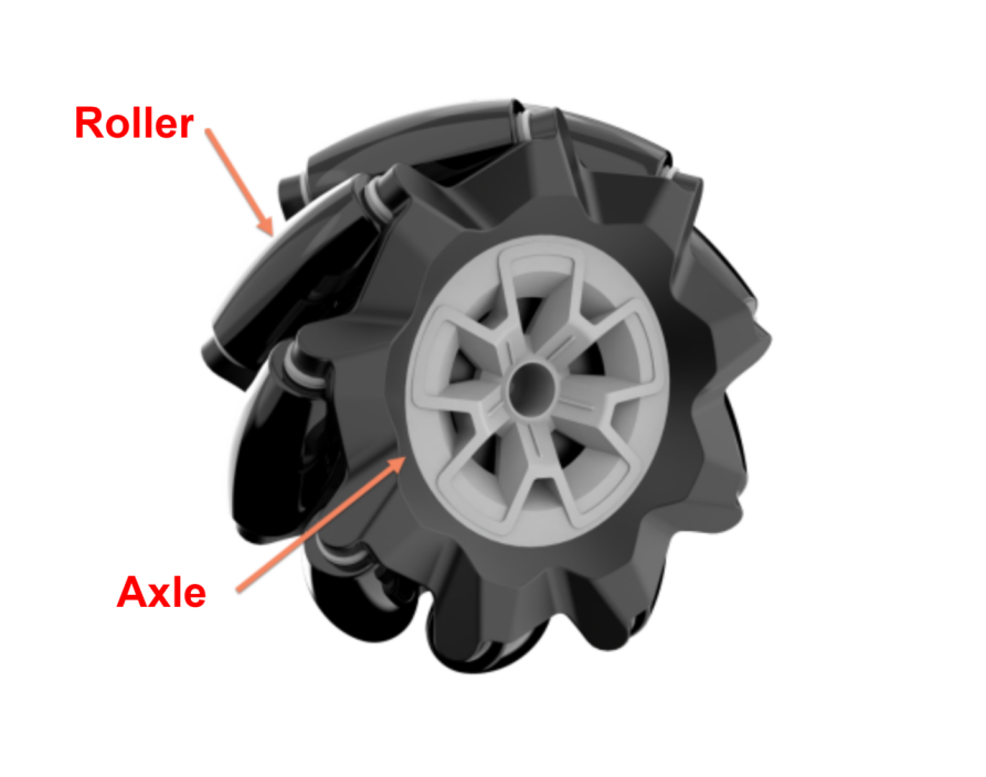

The Mecanum wheel comprises rollers and an axle. The axle functions as the main support structure for the entire wheel, with rollers attached to it. The axle axis is positioned at a 45-degree angle to the roller axis. Typically, Mecanum wheels operate in groups of four, with two left wheels and two right wheels. Wheels A and B are symmetrical.
There are various combinations of four Mecanum wheels, such as AAAA, BBBB, AABB, ABAB, and BABA. However, not all combinations allow the robot car to move in all directions, including forward, backward, and sideways. The Mecanum-wheel chassis combination is ABAB, enabling omnidirectional movement.
3.1.2 Physical Characteristics
The vehicle achieves omnidirectional motion by summing up the propelling forces of the ground-engaging rollers. This summation can occur in any direction through adjustments in wheel rotation direction and torque magnitude for the four wheels.
Because of the rollers’ specific orientation at a certain angle to the wheel circumference, Mecanum wheels have the ability to slip sideways. The generatrix of these small rollers is unique. As the Mecanum wheel rotates around its fixed axle, each small roller’s envelope forms a cylindrical surface, allowing the wheel to continuously roll forward.

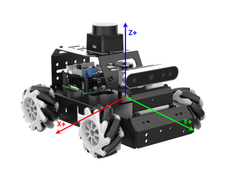

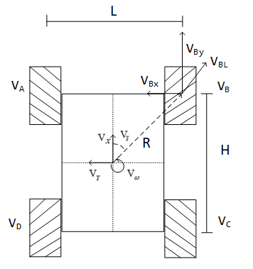

When conducting kinematic analysis, we can consider the kinematic model of Mecanum wheels, which includes the following parameters:
(1) Vx: Velocity of the Mecanum wheel in the X-axis (typically front and rear direction).
(2) Vy: Velocity of the Mecanum wheel in the Y-axis (typically left and right direction).
(3) Vω:Angular velocity of the Mecanum wheel chassis (rotation speed of the chassis around its own center).
(4) Real-time velocities of the four wheels of the Mecanum wheel.
(5) The motion of the right front wheel in the plane can be decomposed into:
(6) VBx: Velocity of the Mecanum wheel in the X-axis (typically front and rear direction).
(7) VBy: Velocity of the Mecanum wheel in the Y-axis (typically left and right direction).
(8) L: Distance between the centers of the left and right wheels.
(9) H: Distance between the centers of the front and rear wheels.
(10) θω: Angle formed by the chassis body center and the center of the right front wheel, typically 45°.
(11) With these parameters, we can perform kinematic analysis of the Mecanum wheel chassis. The following are key mathematical formulas:

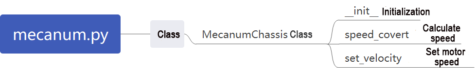

The program file is saved in: ros2_ws/src/driver/controller/controller/mecanum.py
Mecanum wheel kinematics class, used to calculate wheel speeds and implement Mecanum wheel kinematics.

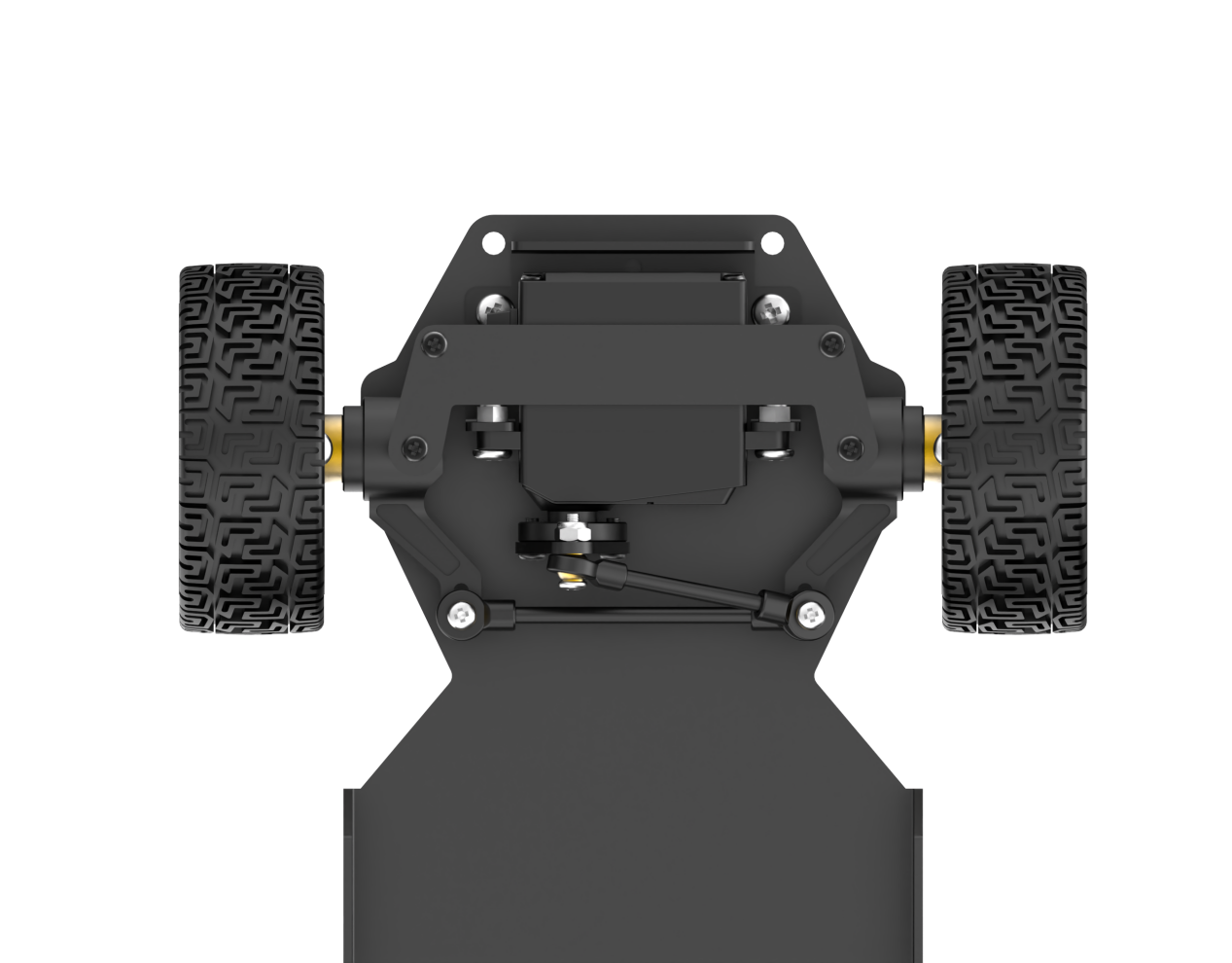

The transmission mechanism of the Ackermann chassis front wheels includes a servo, linkage, and wheels. The servo is linked to the linkage, and the linkage is connected to the wheels. The servo’s rotation governs the extent of the linkage’s rotation, thereby affecting the steering of the front wheels.
During a turn, the front two wheels are in a parallel state, with both wheels having the same angles of rotation. The control of the rear wheels is managed by the motor and wheels, where the motor’s rotation determines the robot’s forward, backward, and speed movements.

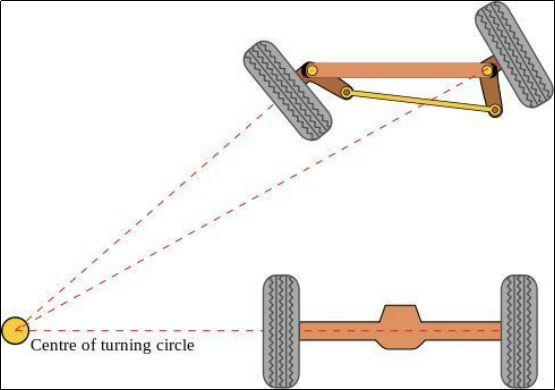

3.2.3 Motion Principle and Formula

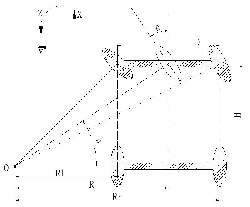

When conducting kinematic analysis of the Ackermann chassis, we can use the following mathematical formulas and parameters to describe its motion characteristics:
To achieve pure rolling motion for the Ackermann car (meaning no side slip during turns), it is necessary to ensure that the normals of the four wheels’ motion directions (lines perpendicular to the direction of tire rolling) intersect at a single point, which is the center of rotation.
To simplify the model, let’s assume that the front wheels have only one wheel (the theoretical concept remains consistent) located in the middle position of the front axle, as depicted by the dashed line in the diagram:
(1) Front Wheel Steering Angle (θ): The rotation angle of the front wheels, indicating the angle by which the front wheels deviate from the vehicle’s forward direction. It is typically measured in radians (rad).
(2) Vehicle Linear Velocity (V): The overall linear speed of the vehicle, representing its translational velocity. It is usually measured in meters per second (m/s). The left rear wheel speed is denoted as (VL), and the right rear wheel speed is denoted as (VR).
(3) Vehicle Track Width (D): The distance between the wheels on the left and right sides of the vehicle, measured in meters (m).
(4) Wheelbase of the Vehicle (H): The distance between the front and rear wheels of the vehicle, measured in meters (m)
(5) Vehicle Turning Radius (R): The radius of the circle described by the vehicle during a turn, measured in meters (m). The turning radius for the left wheel is (RL), and for the right wheel is (RR).
Process for Calculating Robot Speed and Angle:
(6) Consistency of angular velocity:
In this context:
ω represents the angular velocity of the vehicle.
R denotes the turning radius of the vehicle.
V is the linear velocity of the vehicle.
VL is the linear velocity of the left rear wheel.
VR is the linear velocity of the right rear wheel.
RL is the turning radius of the left wheel.
RR is the turning radius of the right wheel.
(7) The relationship between the front wheel steering angle and the turning radius of the vehicle:
H represents the distance between the front and rear wheels of the vehicle.
R signifies the turning radius of the vehicle.
D denotes the distance between the wheels on the left and right sides of the vehicle.
θ indicates the steering angle of the front wheels.
(8) The speeds of the left and right wheels of the robot can be determined as:
(9) The speeds of the left and right wheels of the robot can be determined as:
By knowing the wheelbase, track width, robot speed, and the steering angle of the servo, it is possible to calculate the speeds of the two rear wheels of the robot.

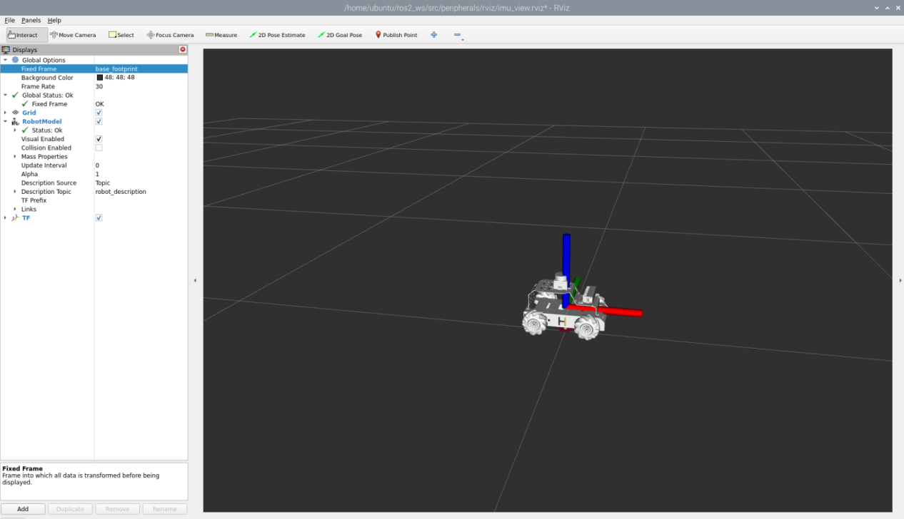

3.3.1 IMU Calibration

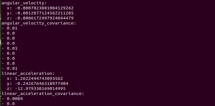

IMU (Inertial Measurement Unit) is a device that measures the three-axis attitude angles (angular velocity) and acceleration of an object. The gyroscope and accelerometer are the main components of the IMU, providing a total of 6 degrees of freedom to measure the angular velocity and acceleration of the object in three-dimensional space.
Upon receiving the first IMU message, the node will prompt you to maintain the IMU in a specific orientation and press Enter to record the measurement values. After completing measurements in all 6 directions, the node will calculate calibration parameters and write them to the specified YAML file. The specific steps are as follows:
The input command is case-sensitive, and keywords can be completed using the Tab key.

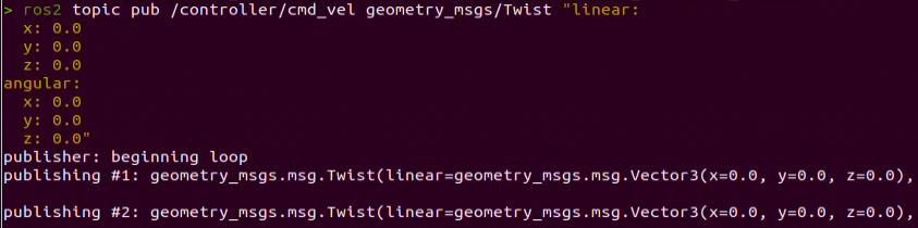

(3) Execute the command to disable the app auto-start service.

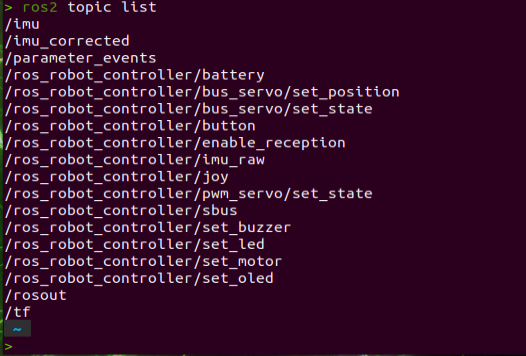

(4) Enter the command and hit Enter key to enable the chassis control node:
(5) Open a new ROS2 command-line terminal, then input the following command, and hit Enter key to initiate IMU calibration:

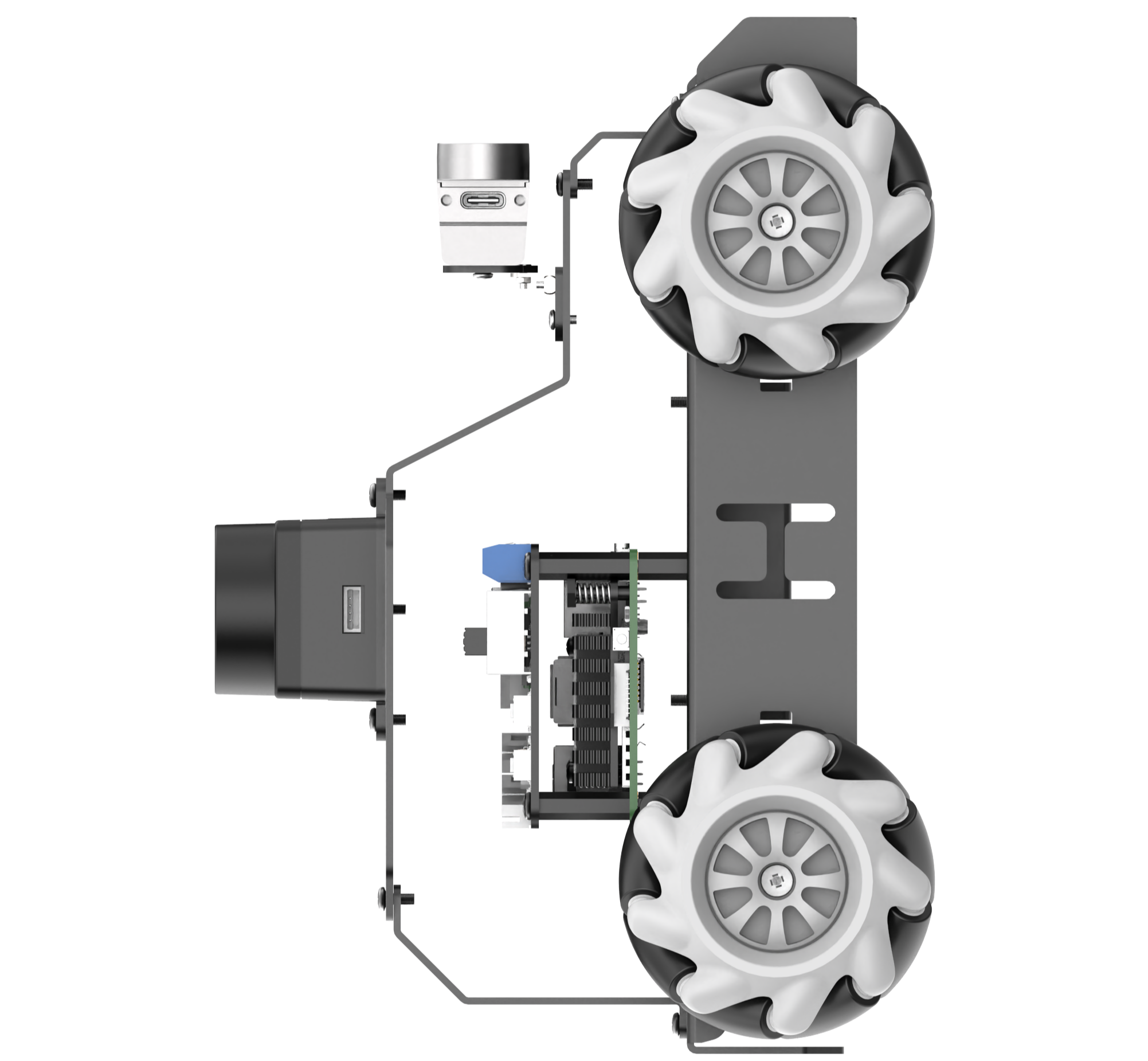

(10) Lift the robot, place it facing upwards, and press Enter. When positioning vertically, be careful to avoid instability or collisions. Use your hand for support to prevent damage to the depth camera or 2D pan-tilt.
(11) Place the robot as pictured, then hit Enter.

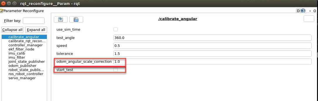

(8) Enter the command and press enter to start the angular velocity calibration.
ros2 launch calibration angular_calib.launch.py

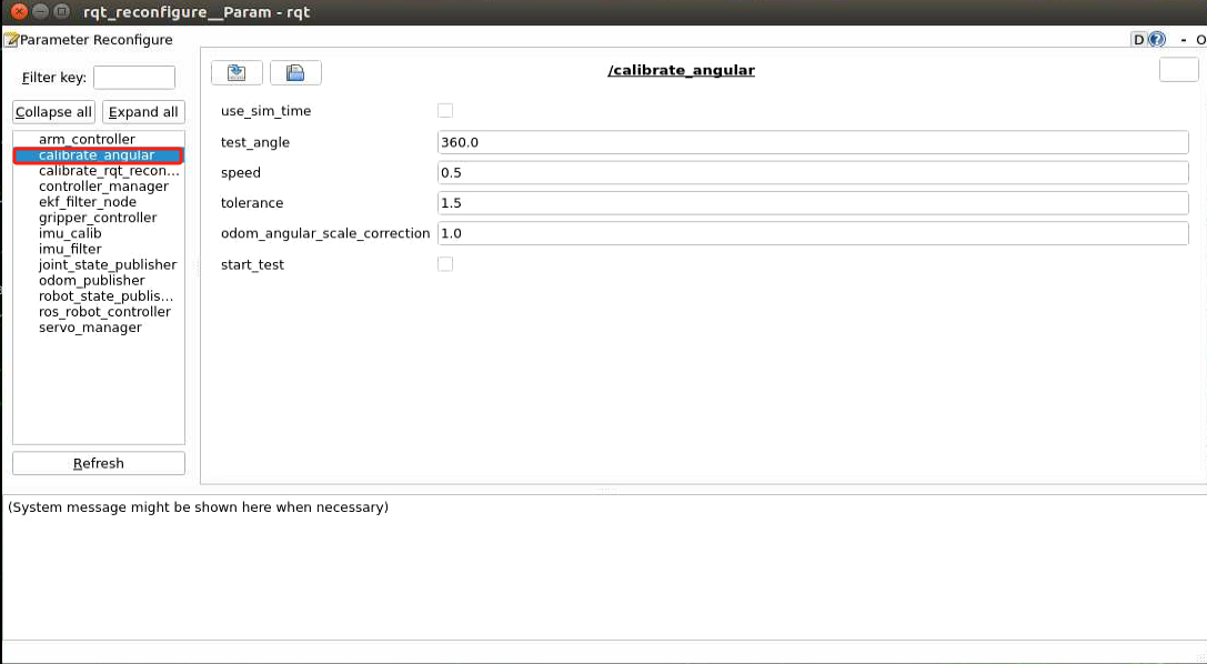

(9) Click “calibrate_angular” on the left side. The calibration interface will appear as shown below.
test_angle: Specifies the test rotation angle, with a default value of 360°.
speed: Indicates the linear velocity, set by default to 0.15 meters per second.
tolerance: Represents the allowable error margin. A smaller value leads to more noticeable oscillation when the robot reaches the target position.
odom_angle_scale_correction: Used to adjust the scale correction for odometry angle measurements.
start_test: A button to initiate the test for odometry angle scale correction.
Ensure the robot is properly aligned, with the marker placed in front of it. Check the start_test option and the robot will rotate in place. If it fails to complete a full rotation, you need to adjust the odom_angule_scale_correction value, which controls the motor’s rotation scale. It is recommended to adjust this value in increments of 0.01.

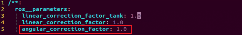

(10) After calibration, enter the command to navigate to the directory containing calibration configuration files. Modify to the calibrated parameter value.
cd ~/ros2_ws/src/driver/controller/config && vim calibrate_params.yaml
(11) Press ‘I’ key to navigate to the editing mode, and modify the value of angular_correctqion_factor to the adjusted value of “odom_angule_scale_correction”.
The aforementioned operations are conducted on the Mecanum-wheel version.
(12) After modification, press the “ESC” key, enter “:wq” to exit and save the changes.
(13) If you want to exit the game, press “Ctrl+C” in the terminal interface.

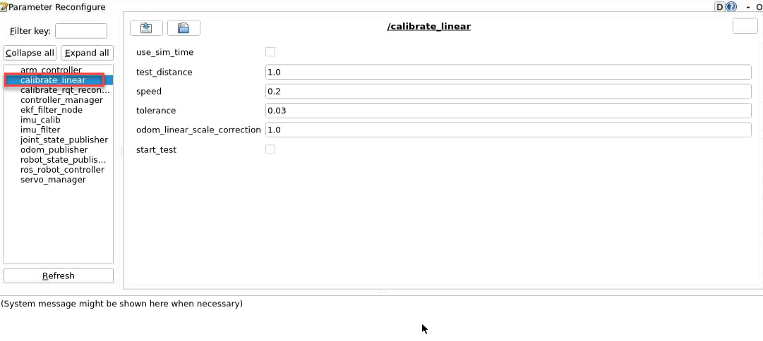

(7) Enter the command and press enter to start the linear velocity calibration.
ros2 launch calibration linear_calib.launch.py

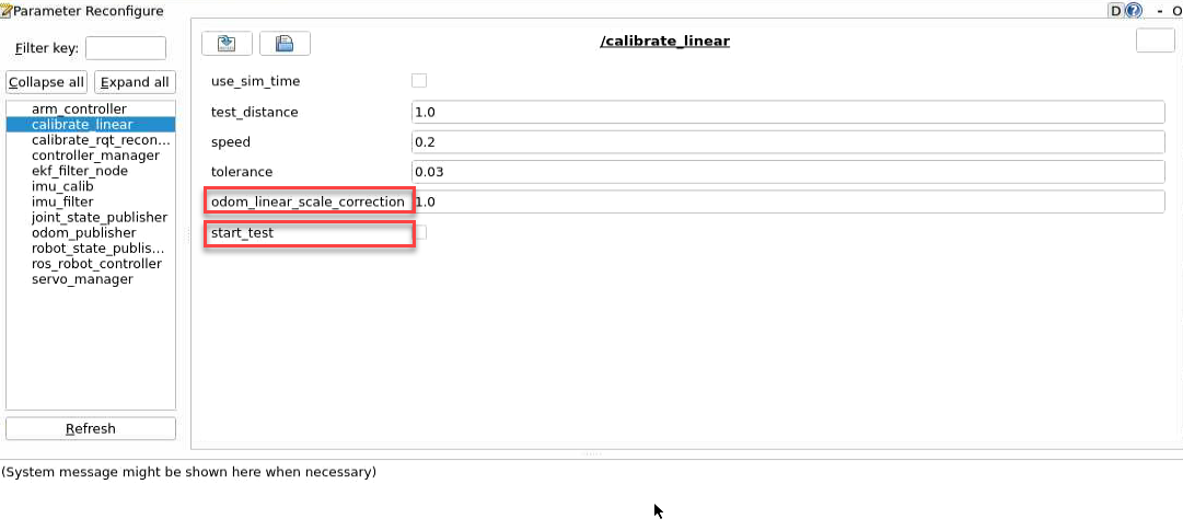

(8) Click calibrate_linear on the left side. The calibration interface will appear as shown below.
The meanings of parameters on the left side of the interface are as follows:
The first parameter test_distance represents the testing distance, with a default value of 1 meter.
The second parameter speed represents the linear velocity, with a default value of 0.2 meters per second.
The third parameter tolerance represents the error value. A smaller error value results in greater robot shaking after reaching the target position.
The fourth parameter odom_linear_scale_correction represents the odometer linear scale correction.
The fifth parameter start_test is the button to start testing the odometer linear scale correction.
(9) Ensure the robot is properly aligned and positioned at the starting point marker. Check the box for start_test and the robot will move forward. Observe if the robot travels in a straight line. If there is deviation, adjust the value of odom_linear_scale_correction. This value adjusts the motor’s scaling factor for forward movement. It is recommended to adjust this value by increments of 0.01 each time.

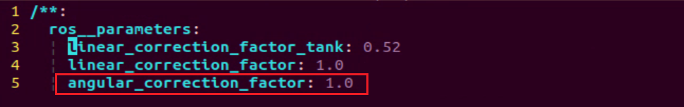

(11) Press ‘I’ key to navigate to the editing mode, and modify the value of “linear_correctqion_factor” to the adjusted value of “odom_linear_scale_correction”.

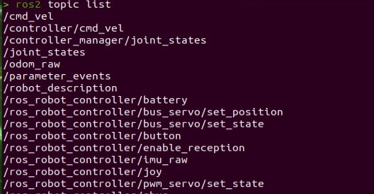

① Open a new command line terminal, and execute the command to check the current topic.
ros2 topic list
② Enter the command to view the type, publisher, and subscribers of the “/imu” topic. You can replace “/imu” with the topic you want to view. The type of this topic is “sensor_msgs/msg/Imu”.
ros2 topic info /imu
③ Use the following command to display the content of the topic message. Feel free to replace ‘imu’ with the name of the topic you wish to view.
ros2 topic echo /imu
The terminal will display the data from the three axes of the IMU.

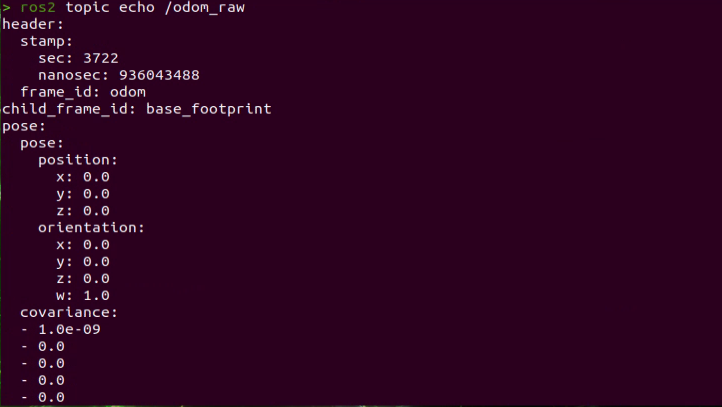

(2) Data Viewing
① Open a new command line terminal, and run the command below to check the current topic.
ros2 topic list
② Enter the command to view the type, publisher, and subscribers of the /odom_raw topic. You can replace /odom_raw with the topic you want to view. The type of this topic is nav_msgs/msg/Odometry.
ros2 topic info /odom_raw
③ Enter the command to print the topic message contents. You can replace the topic you want to view as needed.
ros2 topic echo /odom_raw
The message content includes acquired pose and velocity data.
④ If you want to exit the game, press “Ctrl+C” in the terminal interface.

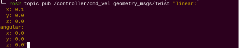

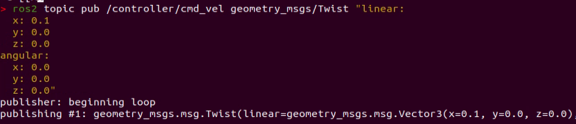

  • Modify Linear Velocity

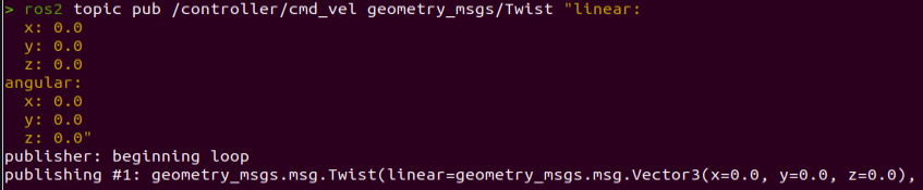

(1) Open a new ROS2 command-line terminal, then enter the following command to enable the linear velocity control.
ros2 topic pub /controller/cmd_vel geometry_msgs/Twist "linear:
x: 0.0
y: 0.0
z: 0.0
angular:
x: 0.0
y: 0.0
z: 0.0"
In this context, linear represents the set linear velocity, considering the robot’s viewpoint where the X-axis points forward without any influence from the Y or Z directions.
On the other hand, angular pertains to the set angular velocity. A positive Z-value induces a left turn in the robot, while a negative Z-value causes the robot to turn right. This configuration has no impact on the X and Y directions.
  • In this scenario, the linear velocity (x) is measured in meters per second, and it is advisable to maintain it within the range of “-0.6 to 0.6”.
  • The angular velocity (z) denotes the turning speed and is determined by the formulas V=ωR (linear velocity equals angular velocity times radius) and tanΦA=D/R (where z=ω, D=0.213, and ΦA represents the turning angle). The angle ΦA should be within the range of 0 to 36 degrees.
angular” sets the angular velocity of the robot. A positive value for “Z” will make the robot turn left, while a negative value for “Z” will make it turn right. There is no motion in the X and Y directions.
(2) Use the arrow keys to navigate and modify the relevant parameters. For example, to make the robot move forward, adjust the linear velocity (X) to 0.1, and then press Enter to execute the action.
(3) To bring the robot car to a stop, open a new terminal and set the linear velocity to ‘0.0’.
(4) If you need to terminate this program, use short-cut ‘Ctrl+C’.
To bring the robot car to a stop, please create a new terminal and adjust the linear velocity. Using the ‘Ctrl+C’ shortcut alone may not effectively halt the robot car.

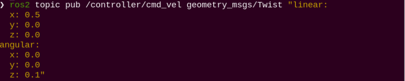

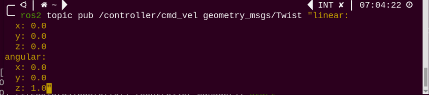

  • Modify Angular Velocity
(1) Open a new ROS2 command-line terminal, then enter the following command to enable the angular velocity control.
x: 0.0
y: 0.0
z: 0.0
angular:
x: 0.0
y: 0.0
z: 0.0"
angular sets the angular velocity of the robot. A positive value for “Z” will make the robot turn left, while a negative value for “Z” will make it turn right. There is no motion in the X and Y directions.
  • Z” represents the angular velocity for turning, which is the yaw angular velocity of the robot. It is recommended to set the value between “-2” and “2”. A value of “0” means there is no angular velocity, a positive value means counterclockwise rotation, and a negative value means clockwise rotation. The absolute value of the angular velocity represents the speed of rotation, with larger values indicating faster rotation.
(2) Use the arrow keys to navigate and modify the relevant parameters. For example, to make the robot turn left, adjust the angular velocity (Z) to 1.0, and then press Enter to execute the action.
(3) To bring the robot car to a stop, open a new terminal and set the angular velocity to ‘0.0’.
(4) If you want to exit the game, press “Ctrl+C” in the terminal interface.

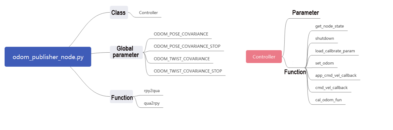

3.5.3 Program Analysis

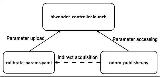

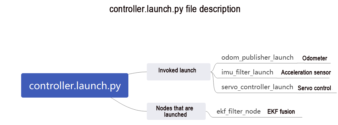

The files include controller.launch.py for launch configuration, calibrate_params.yaml for parameter configuration, and odom_publisher.py for program execution.
During startup, the launch file is executed first. It loads the YAML configuration file and passes the parameters to the ROS nodes. Subsequently, the nodes initialize by reading the configuration parameters from the ROS nodes and communicate with other nodes to collaboratively implement functionalities.
  • Launch File
The launch file is located in: /home/ubuntu/ros2_ws/src/driver/controller/launch/controller.launch.py
(1) Set the storage path
Retrieve the paths for the two packages: peripherals and controller.
    if compiled == 'True':
(2) Initiate other Launch files
    odom_publisher_launch = IncludeLaunchDescription(
        PythonLaunchDescriptionSource([os.path.join(controller_package_path, 'launch/odom_publisher.launch.py')
        launch_arguments={
            'namespace': namespace,
            'imu_frame': imu_frame,
            'frame_prefix': frame_prefix,
            'base_frame': base_frame,
            'odom_frame': odom_frame
        }.items()
    imu_filter_launch = IncludeLaunchDescription(
        PythonLaunchDescriptionSource([os.path.join(peripherals_package_path, 'launch/imu_filter.launch.py')
odom_publisher_launch Odometer launch
imu_filter_launch IMU launch
(3) Initiate Node
Launch the EKF fusion node.
61
70
71
72
73
74
75
76
77
78
    if use_namespace == 'false':
        ekf_param = ReplaceString(source_file=os.path.join(controller_package_path, 'config/ekf.yaml'), replacements={'namespace/': ''})
        ekf_param = ReplaceString(source_file=os.path.join(controller_package_path, 'config/ekf.yaml'), replacements={"namespace/": (namespace, '/')})
    ekf_filter_node = Node(
        package='robot_localization',
        executable='ekf_node',
        name='ekf_filter_node',
        output='screen',
        parameters=[ekf_param, {'use_sim_time': use_sim_time}],
        remappings=[
            ('/tf', 'tf'),
            ('/tf_static', 'tf_static'),
            ('odometry/filtered', 'odom'),
            ('cmd_vel', 'controller/cmd_vel')
        condition=IfCondition(enable_odom),

        self.declare_parameter('linear_correction_factor', 1.00)
        self.declare_parameter('linear_correction_factor_tank', 0.52)
        self.declare_parameter('angular_correction_factor', 1.00)
        self.declare_parameter('machine_type', os.environ['MACHINE_TYPE'])
        self.pub_odom_topic = self.get_parameter('pub_odom_topic').value
        self.base_frame_id = self.get_parameter('base_frame_id').value
        self.odom_frame_id = self.get_parameter('odom_frame_id').value
        #self.machine_type = os.environ.get('MACHINE_TYPE', 'MentorPi_Mecanum')
        self.machine_type = self.get_parameter('machine_type').value
pub_odom_topic: Whether to publish the odometry node
base_frame_id: Robot footprint ID
odom_frame_id: Robot odometry ID
linear_correction_factor: Linear velocity correction factor
angular_correction_factor: Angular velocity correction factor
machine_type: Type of robot

        if self.pub_odom_topic:
            # self.odom_broadcaster = tf2_ros.TransformBroadcaster(self)            # self.odom_trans = TransformStamped()
            # self.odom_trans.header.frame_id = self.odom_frame_id
            # self.odom_trans.child_frame_id = self.base_frame_id
            self.odom = Odometry()
            self.odom.header.frame_id = self.odom_frame_id
            self.odom.child_frame_id = self.base_frame_id
            self.odom.pose.covariance = ODOM_POSE_COVARIANCE
            self.odom.twist.covariance = ODOM_TWIST_COVARIANCE
            self.odom_pub = self.create_publisher(Odometry, 'odom_raw', 1)
            self.dt = 1.0/50.0
            threading.Thread(target=self.cal_odom_fun, daemon=True).start()
Based on the parameter pub_odom_topic, determine whether to publish the odometry node. If publishing is required, initialize the node, fill in the corresponding parameters, and publish the odometry using the self.create_publisher function. Update the odometry data using the self.cal_odom_fun function.

⑤ Explanation of Controller Class Functions:
Function Name Description
get_node_state Used to obtain the current node status, as a callback function
shutdown Used to shut down the ROS node, as a callback function
load_callbrate_param Used to read the current motion parameters as a callback function
set_odom Used to read and set odometry, as a callback function
app_cmd_vel_callback Used to set the app speed, as a callback function
cmd_vel_callback Used to set velocity, as a callback function
cal_odom_fun Used to publish odometry data

ros2 launch controller controller.launch.py
x: 0.0
y: 0.0
z: 0.0
angular:
x: 0.0
y: 0.0
z: 0.0"
  • The angular velocity (z) denotes the turning speed and is determined by the formulas V=ωR (linear velocity equals angular velocity times radius) and tanΦA=D/R (where z=ω, D=0.213, and ΦA represents the turning angle). The angle ΦA should be within the range of 0 to 29 degrees.
Use the arrow keys to navigate and modify the relevant parameters. For example, to make the robot move forward, adjust the linear velocity (X) to 0.1 and the angular velocity to 0.0. Then, press Enter to execute the action.
(2) To bring the robot car to a stop, open a new terminal and set the linear velocity to ‘0.0’.
(3) If you need to terminate this program, use short-cut ‘Ctrl+C’.
x: 0.0
y: 0.0
z: 0.0
angular:
x: 0.0
y: 0.0
z: 0.0"
angular sets the angular velocity of the robot. A positive value for “Z” will make the robot turn left, while a negative value for “Z” will make it turn right. There is no motion in the X and Y directions. Ackerman chassis needs to add linear velocity to turn right.
Use the arrow keys to navigate and modify the relevant parameters. For example, to make the robot turn left, adjust the angular velocity (Z) to 0.1 and the linear velocity (X) to 0.5. Then, press Enter to execute the action.
(2) To bring the robot car to a stop, open a new terminal and set the angular velocity to ‘0.0’.
(3) If you want to exit the game, press “Ctrl+C” in the terminal interface.
Create a new terminal to stop the robot, and then close the node to shut down properly. If you directly press Ctrl+C to close the terminal, the robot may not stop.
  • Launch File
        launch_arguments={
        }.items()
(3) Initiate Node
61
70
71
72
73
74
75
76
77
78
        output='screen',
        remappings=[
            ('/tf', 'tf'),

        # Declare parameters
        self.declare_parameter('pub_odom_topic', True)
        self.declare_parameter('base_frame_id', 'base_footprint')
        self.declare_parameter('odom_frame_id', 'odom')
The function self.declare_parameter is used to define a certain parameter.
The function self.get_parameter is used to obtain a certain parameter.

(9) Explanation of Controller Class Functions:
  • FAQ
Q: The robot continues to move forward even after pressing “Ctrl+C” in the terminal.
A: In such a situation, you need to open a new terminal and enter the command:
rostopic pub /hiwonder_controller/cmd_vel geometry_msgs/Twist “linear:”, then press Tab to autocomplete, set the speed to 0, and press Enter to execute.
