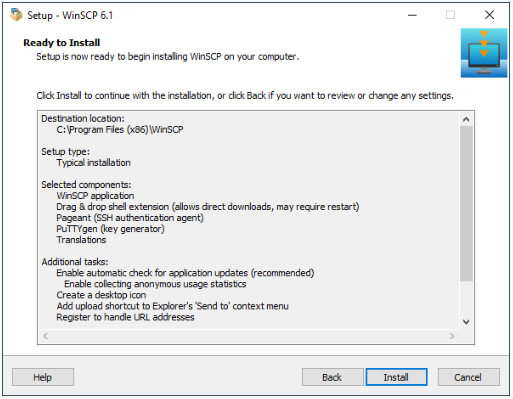

6.1 Install WinSCP
6.1.1 Install WinSCP Tool
WinSCP is an open-source graphical SFTP client for Windows that supports the SSH and SCP protocols. It can securely copy files between local and remote computers. The tool can also directly edit files.

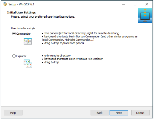

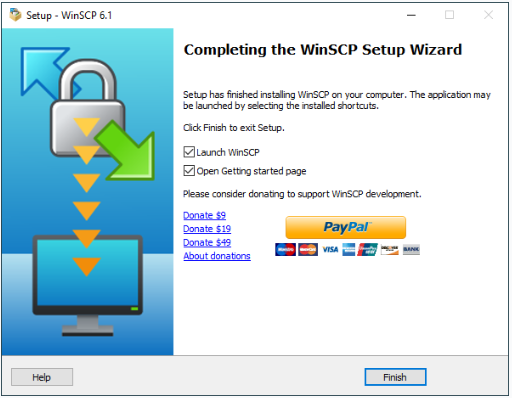

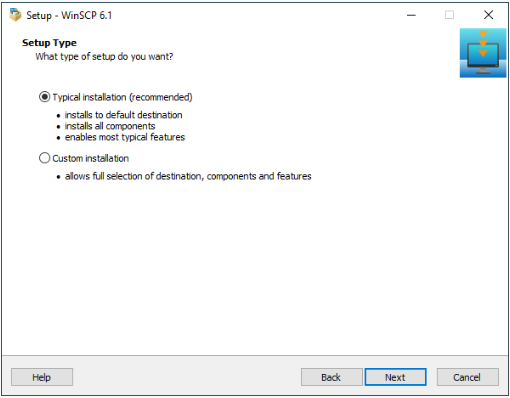

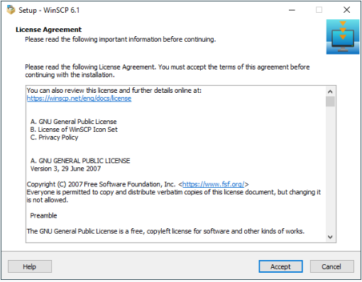

The installation steps for WinSCP are as follows:
(1) Double-click the WinSCP-5.15.3-Setup.exe installation pack in the directory of this section. Click “Accept” to start installing.
(2) Click “Next”.
(3) Click “Next”.
(4) Keep the default installation location and click “Install”.
(5) After waiting for a moment, a prompt window will appear indicating that the installation is complete. Click “Finish”.

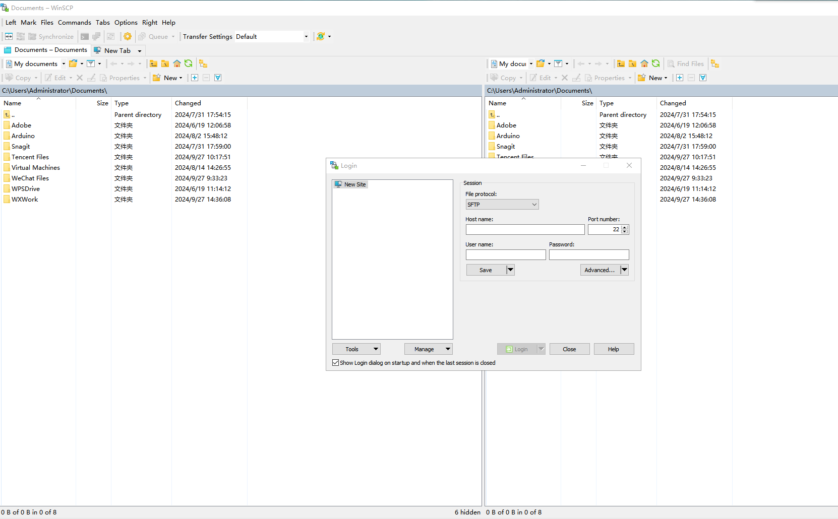

(6) After the installation is completed, click to open it.

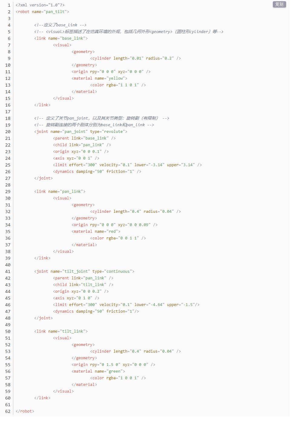

  • Write Simple URDF Model
(1) Name the model of the robot
To start writing the URDF model, we need to set the name of the robot following this format: “<robot name=”robot model name”>”. Lastly, input “</robot>” at the end to represent that the model is written successfully.
(2) Set links
① To write the first link and use indentation to indicate that it is part of the currently set model. Set the name of the link using the following format: <link name=”link name”>. Finally, conclude with “</link>” to indicate the successful completion of the link definition.
② Write the link description and use indentation to indicate that it is part of the currently set link, and conclude with “</visual>”.
③ The “<geometry>” tag is employed to define the shape of a link. Once the description is complete, include “</geometry>”. Within the “<geometry>” tag, indentation is used to specify the detailed description of the link’s shape. The following example demonstrates a link with a cylindrical shape: “<cylinder length=”0.01” radius=”0.2”/>”. In this instance, “length=”0.01”” signifies a length of 0.01 meters for the link, while “radius=”0.2”” denotes a radius of 0.2 meters, resulting in a cylindrical shape.
④ The “<origin>” tag is utilized to specify the position of a link, with indentation used to indicate the detailed description of the link’s position. The following example demonstrates the position of a link: “<origin rpy=”0 0 0” xyz=”0 0 0” />”. In this example, “rpy” represents the roll, pitch, and yaw angles of the link, while “xyz” represents the coordinates of the link’s position. This particular example indicates that the link is positioned at the origin of the coordinate system.
⑤ The “<material>” tag is used to define the visual appearance of a link, with indentation used to specify the detailed description of the link’s color. To start describing the color, include “<material>”, and end with “</material>” when the description is complete. The following example demonstrates setting a link color to yellow: “<color rgba=”1 1 0 1” />”. In this example, “rgba=”1 1 0 1”” represents the color threshold for achieving a yellow color.
(3) Set joint
① To write the first joint, use indentation to indicate that the joint belongs to the current model being set. Then, specify the name and type of the joint as follows: “<joint name=”joint name” type=”joint type”>”. Finally, include “</joint>” to indicate the completion of the joint definition.
To learn about the type of the joint, please refer to “6.2.3 Basic Syntax of URDF Model -> Joint”.
② Write the description section for the connection between the link and the joint. Use indentation to indicate that it is part of the currently defined joint. The parent parameter and child parameter should be set using the following format: “<parent link=”parent link”/>”, and “<child link=”child link” />”. With the parent link serving as the pivot, the joint rotates the child link.
③ “<origin>” describes the position of the joint using indention. This example describes the position of the joint: “<origin xyz=”0 0 0.1” />”. xyz is the coordinate of the joint.
④ “<axis>” describes the position of the joint adopting indention. “<axis xyz=”0 0 1” />” describes one posture of a joint. xyz specifies the pose of the joint.
⑤ “<limit>” imposes restrictions on the joint using indention. The below picture The “<limit>” tag is used to restrict the motion of a joint, with indentation indicating the specific description of the joint angle limitations. The following example describes a joint with a maximum force limit of 300 Newtons, an upper limit of 3.14 radians, and a lower limit of -3.14 radians. The settings are defined as follows: “effort=’joint force (N)’, velocity=’joint motion speed’, lower=’lower limit in radians’, upper=’upper limit in radians’”.
⑥ “<dynamics>” describes the dynamics of the joint using indention. “<dynamics damping=”50” friction=”1” />” describes dynamics parameters of a joint.

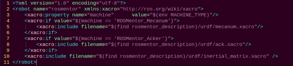

(7) Locate the code below:
Determine the current form of the robot by reading the machine variable to load the corresponding URDF model .
Multiple URDF models are called to compose a complete robot.

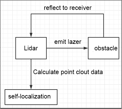

SLAM stands for Simultaneous Localization and Mapping.
Localization involves determining the pose of a robot in a coordinate system. The origin of orientation of the coordinate system can be obtained from the first keyframe, existing global maps, landmarks or GPS data.
Mapping involves creating a map of the surrounding environment perceived by the robot. The basic geometric elements of the map are points. The main purpose of the map is for localization and navigation. Navigation can be divided into guidance and control. Guidance includes global planning and local planning, while control involves controlling the robot’s motion after the planning is done.
6.4.2 SLAM Mapping Principle

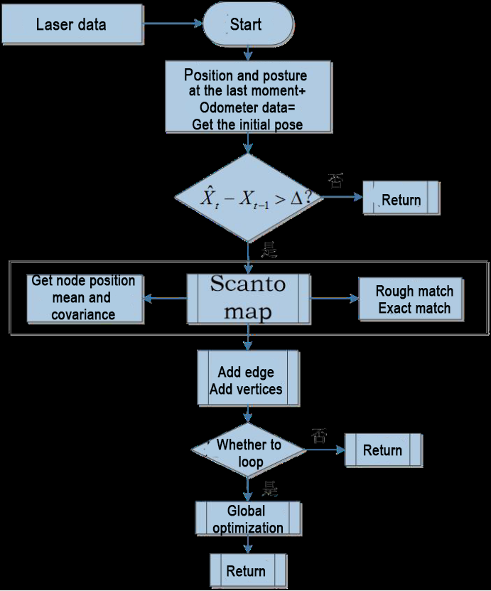

① Preprocessing: Optimizing the raw data from the radar point cloud, filtering out problematic data or performing filtering. Using laser as a signal source, pulses of laser emitted by the laser are directed at surrounding obstacles, causing scattering.
Some of the light waves will reflect back to the receiver of the lidar, and then, according to the principle of laser ranging, the distance from the lidar to the target point can be obtained.
Regarding point clouds: In simple terms, the surrounding environment information obtained by lidar is called a point cloud. It reflects a portion of what the ‘eyes’ of the robot can see in the environment where it is located. The object information collected presents a series of scattered, accurate angle, and distance information.
② Matching: Matching the point cloud data of the current local environment with the established map to find the corresponding position.
③ Map Fusion: Integrating new round data from the lidar into the original map, ultimately completing the map update.

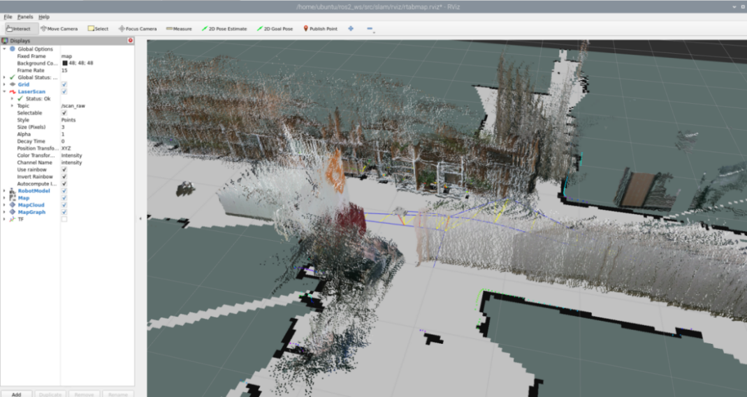

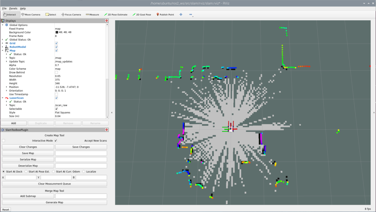

6.4.4 Judge Mapping Result
Finally, assess the robot’s navigation process against the following criteria once the mapping is complete:
(1) Ensure that the edges of obstacles within the map are distinctly defined.
(2) Check for any disparities between the map and the actual environment, such as the presence of closed loops or inconsistencies.
(3) Verify the absence of gray areas within the robot’s motion area, indicating areas that haven’t been adequately scanned.
(4) Confirm that the map doesn’t incorporate obstacles that won’t exist during subsequent localization.
(5) Validate the map’s coverage of the entire extent of the robot’s motion area.

From the above diagram, it can be seen that the process is relatively straightforward. The traditional soft real-time operation mechanism of slam involves processing each frame of data upon entry and then returning.
Relevant source code and WIKI links for KartoSLAM:

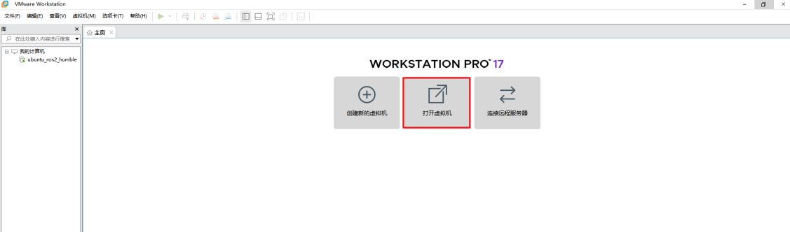

(2) Click on to open the virtual machine.
(3) Enter the virtual machine interface and click on “Open Virtual Machine”.
(4) Select the image file provided in the tutorial and import it. For specific instructions, please refer to the lesson “5. Depth Camera Basic Lesson/Test and Configure ROS2”.

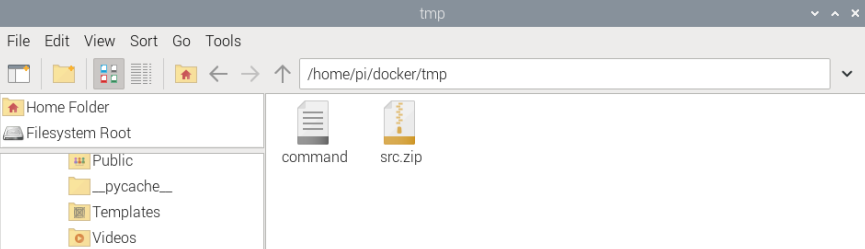

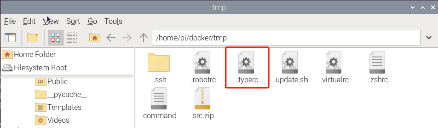

⑩ Click-on to open the file directory, then navigate to the home/docker/tmp directory:
⑪ Use the shortcut ‘Ctrl + H’ to show the hidden .typerc file:

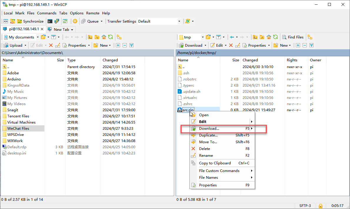

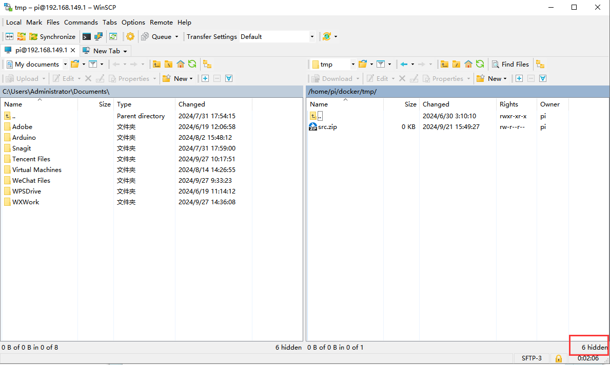

⑫ Refer to the instruction in “Install WinSCP” to install and open the WinSCP tool.

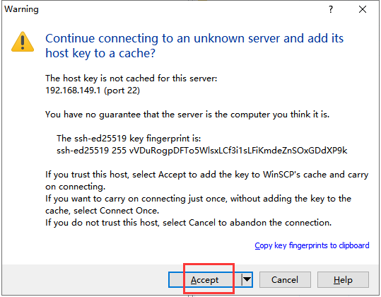

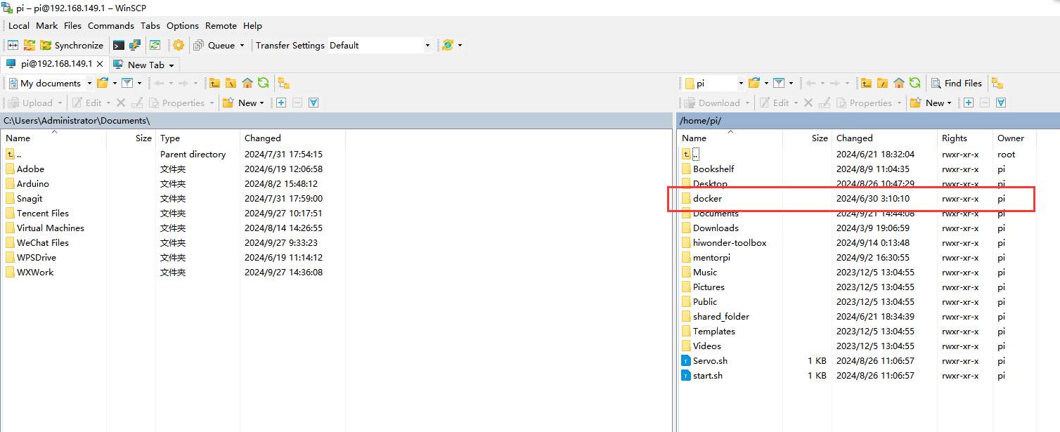

⑬ Enter the IP address of Raspberry Pi “192.168.149.1”, username “pi”, and password “raspberrypi”. Then click “Login”.
⑭ Click “Accept” on the pop-up window that appears.
⑮ The left side shows the directory of your computer, and the right side shows the root directory of Raspberry Pi.
⑯ Select the folder “docker->tmp” and open the shared folder with Docker.

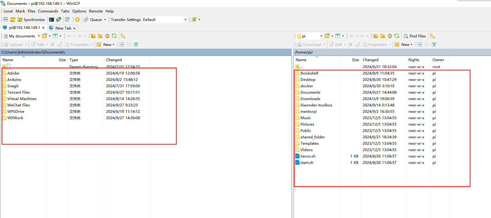

⑰ In the bottom right corner of WinSCP, there is a number indicating the number of hidden files. Double-click on it to display hidden files.
⑱ Select the “src” folder and right-click to choose “Download”.
⑲ Select the path where you want to save the file and click “OK”.
⑳ Follow step ⑱ to save the .typerc file.

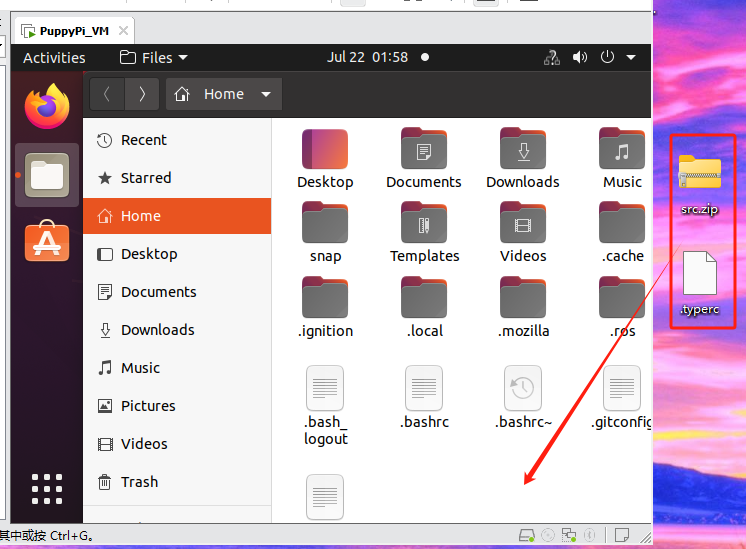

(2) Import files into the virtual machine

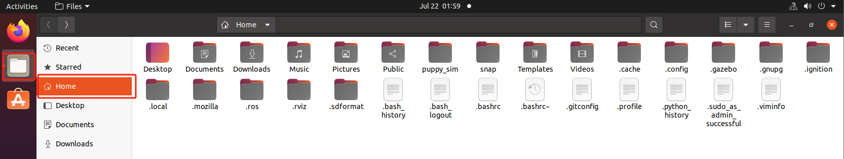

① Click-on to navigate to the home directory.
② Drag and drop the .typerc and src.zip files from the computer desktop into the virtual machine:

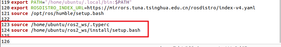

(9) Change the .bashrc file, and input the following command:
gedit ~/.bashrc
Copy the content below to the file .bashrc.
source /home/ubuntu/ros2_ws/.typerc
source /home/ubuntu/ros2_ws/install/setup.bash
(10) After finishing writing, use the shortcut Ctrl + S or click the Save button in the upper right corner to save and exit.
(11) Run the command below to refresh the environment configuration.
source ~/.bashrc

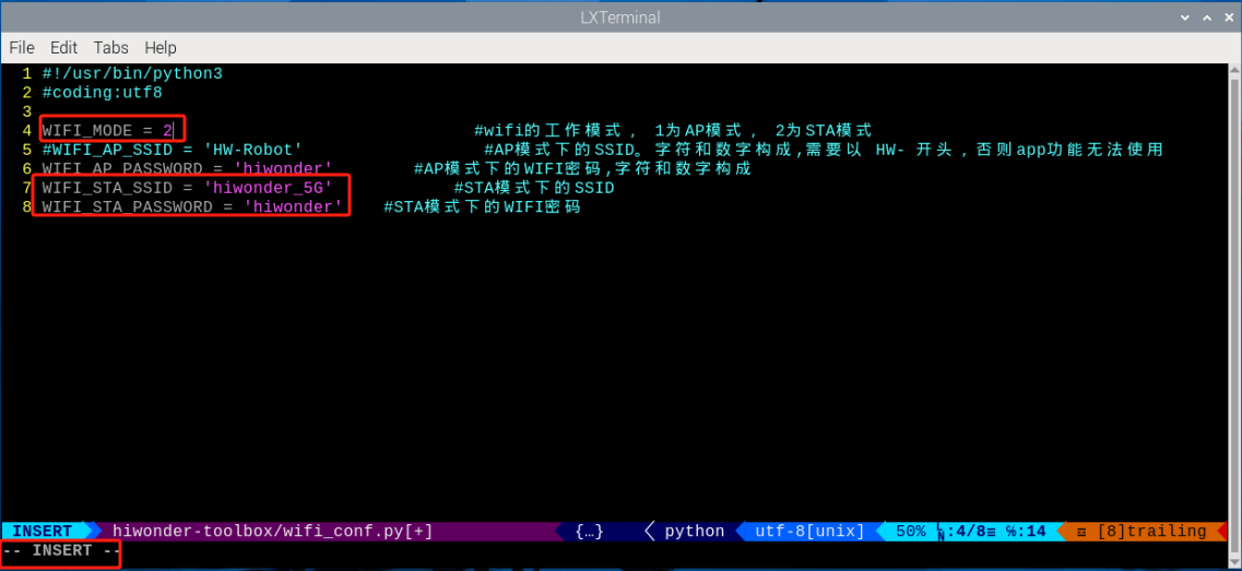

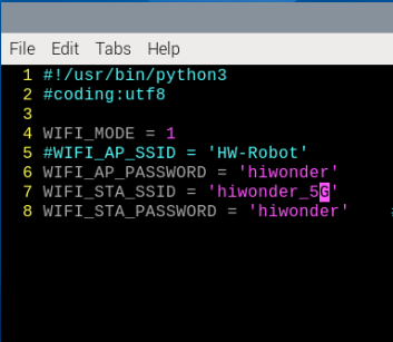

(1) Click-on to open the command line terminal.
(2) Enter the command to open the WiFi configuration file.
vim hiwonder-toolbox/wifi_conf.py
(3) Press “i” key to enter the editing mode. Change the WiFi configuration file to LAN mode, and modify your own WiFi name and password.
When MentorPi fails to find the target network in LAN mode and automatically switches back to Direct Connection mode, the content of wifi_conf.py will not be modified automatically. It will still retain the LAN configuration. If no changes are made, MentorPi will continue to start in LAN mode by default the next time it is powered on.
(4) After finishing writing, press “Esc” and enter the command to save and exit.
:wq
(5) Enter the command to restart the network, or reboot the system. It is recommended to reboot the system.

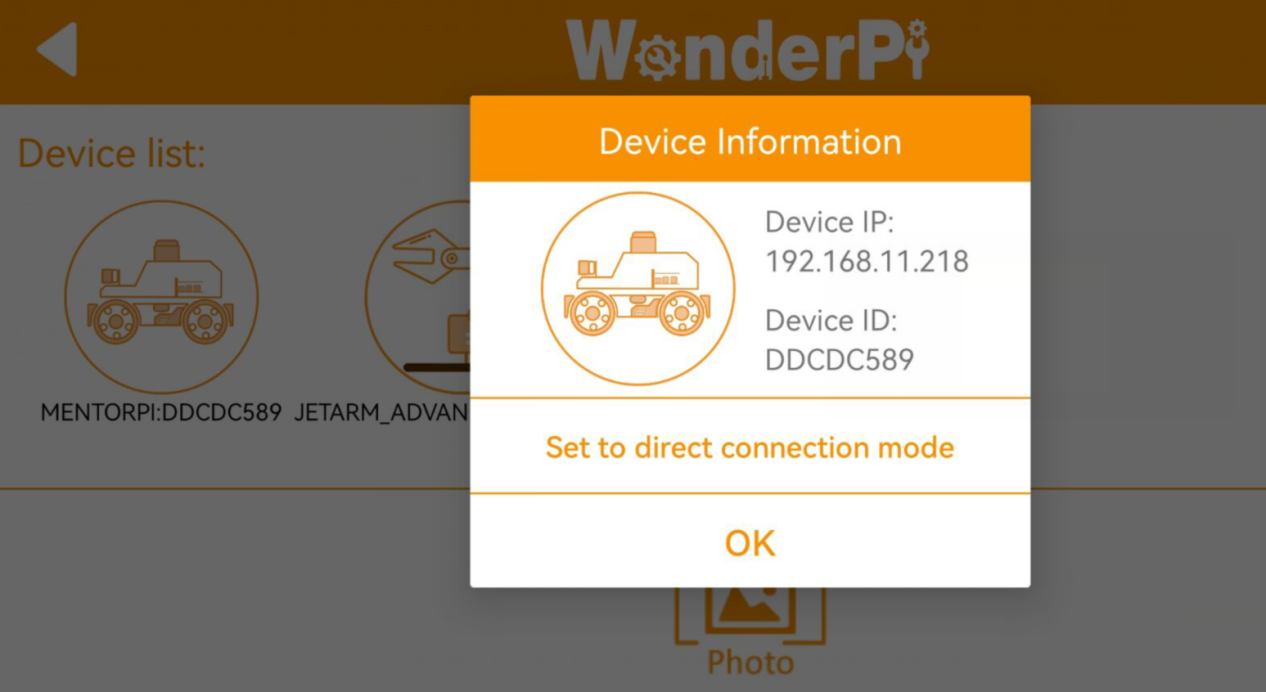

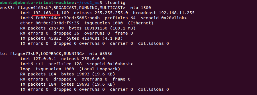

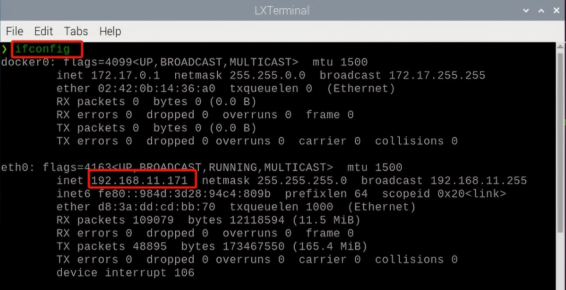

(6) Refer to 1.Getting Ready -> 1.6 APP Control to obtain the robot’s LAN IP address through the app connection.

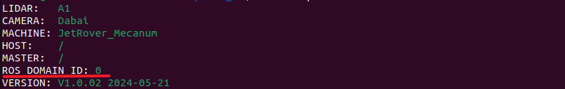

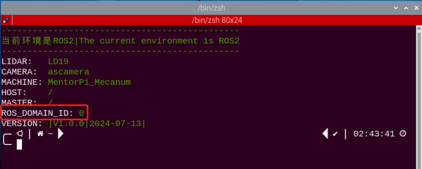

(7) It is important to note that the virtual machine and the robot are connected to the same LAN, and their IP addresses should be within the same subnet:
① Virtual Machine:
② Robot:

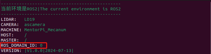

(8) After rebooting, click on to open the robot’s ROS2 command line terminal. You will notice that the ROS_DOMAIN_ID is 0, which is the same as on the virtual machine.
① Robot:
② Virtual Machine:

(1) Click-on to open the command line terminal of the virtual machine system.
(2) Enter the command to open the RViz tool and display the mapping results.

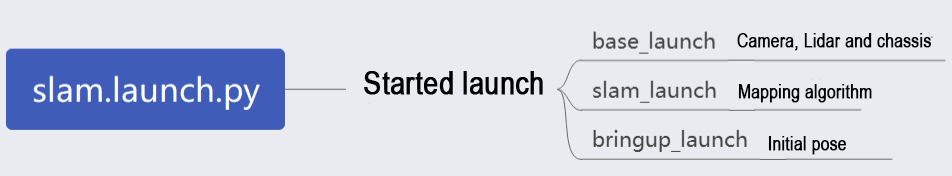

base_launch: Launch for hardware initialization
slam_launch: Launch for basic mapping
bringup_launch: Launch for initial pose setup

(2) Enter the command to open the RViz tool and display the mapping effect:

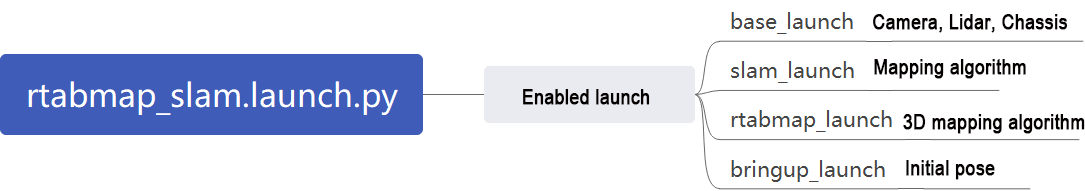

slam_launch: Basic mapping launch
rtabmap_launch: RTAB mapping launch
bringup_launch: Initial pose launch
