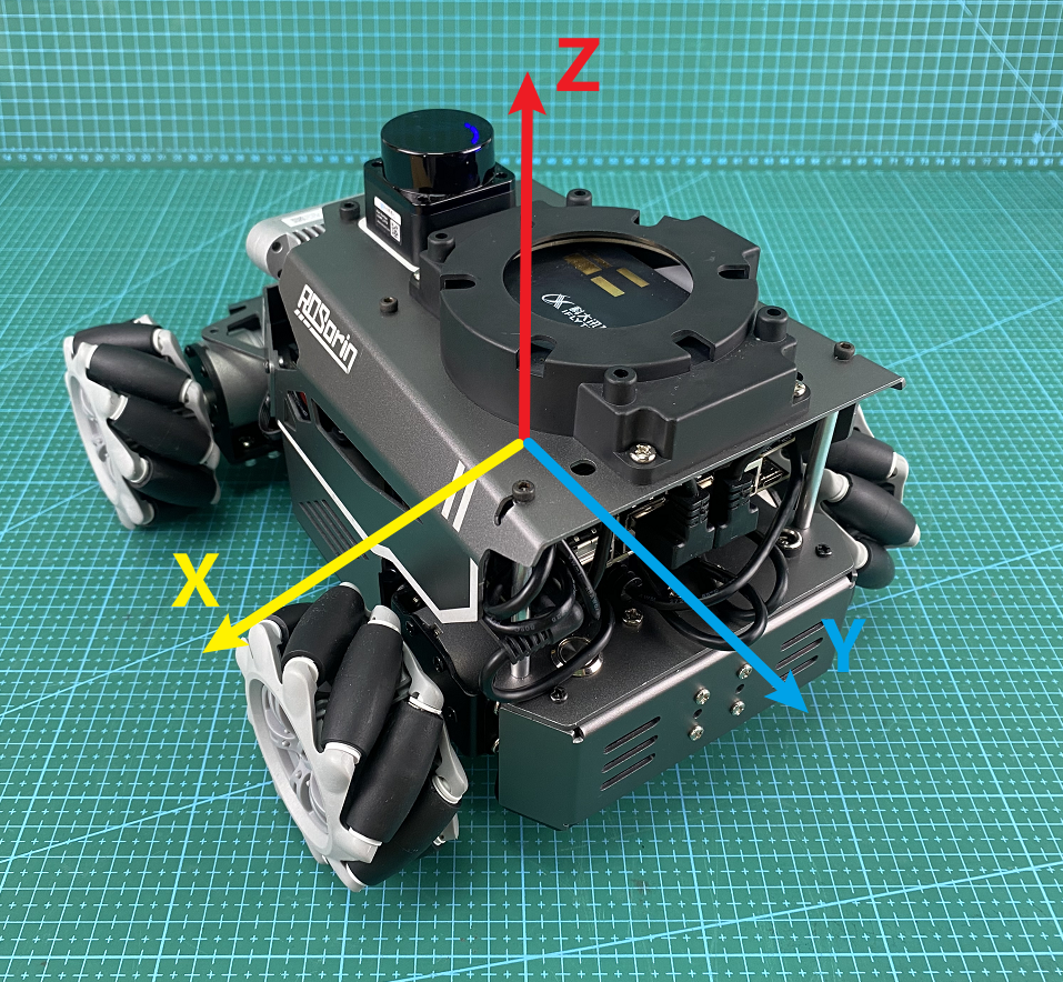

The IMU, Inertial Measurement Unit, is a device that measures an object’s three-axis orientation, angular velocity, and acceleration. The gyroscope and accelerometer are the main components of the IMU, providing a total of six degrees of freedom to measure angular velocity and acceleration in 3D space.
The figure above shows the positive directions of the IMU’s x, y, and z axes. During the calibration process, you can refer to this coordinate system. After the node receives the first IMU message, it will prompt you to hold the IMU in a specific orientation and press Enter to record the measurement. Once all six orientations are completed, the node calculates the calibration parameters and writes them to the specified YAML file. The detailed steps are as follows:

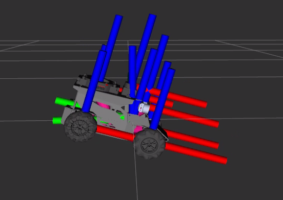

  1. After calibration, you can check the calibrated model by running the command:

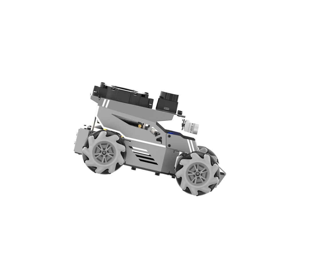

  1. Gently tilt the platform to check whether the model’s tilt direction matches the actual movement. Refer to the example below. If both directions align, the IMU calibration results are considered accurate.

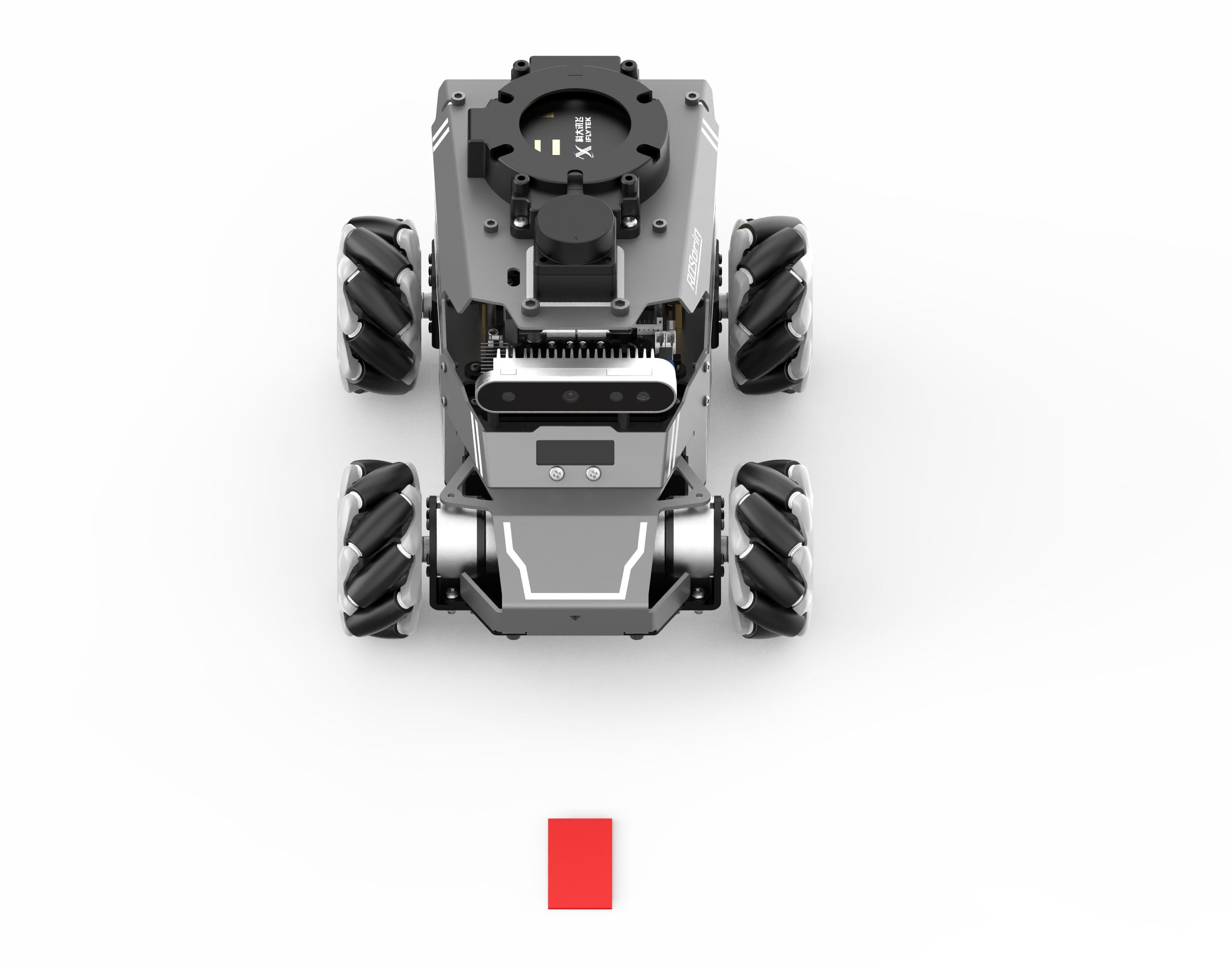

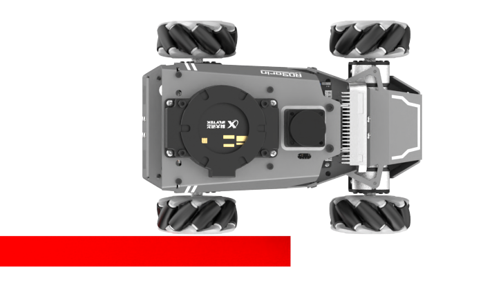

  1. Place the robot on a flat surface and apply a piece of tape—or position another marker—at the center of its front side, as shown below.

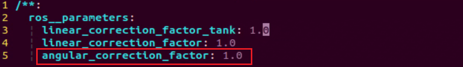

  1. Before starting the calibration, navigate to the calibration configuration file directory and open the configuration file.
cd ~/ros2_ws/src/driver/controller/config && vim calibrate_params.yaml
  1. Set the angular velocity parameter to 1.0 before proceeding with the calibration.
  1. After editing, press ESC, type :wq, and press Enter to save and exit.

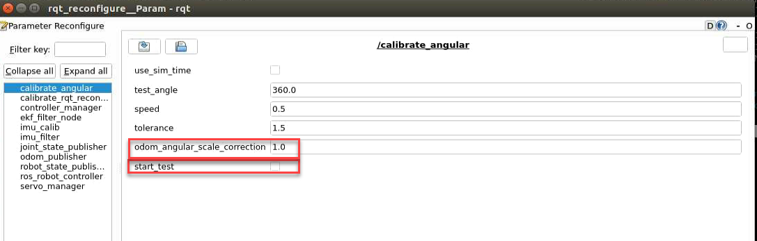

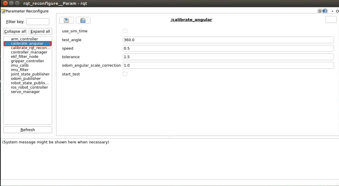

  1. Then, click calibrate_angular on the left to open the calibration interface, as shown below.
The meanings of the parameters on the left side of the interface are as follows:
(1) test_angle – The rotation angle for testing, 360° by default.
(2) speed – The linear speed, default is 0.15 m/s.
(3) tolerance – The allowable error. A smaller error value results in more noticeable oscillation when the robot reaches its target position.
(4) odom_angule_scale_correction – The odometry angle scaling ratio.
(5) start_test – Button to start testing the odometry angle scaling.
Make sure the robot is properly aligned, then check start_test. The robot will rotate in place. If it cannot complete a full rotation or shows deviation, adjust the odom_angle_scale_correction value, which scales the motor rotation during turning. It is recommended to adjust in increments of 0.01 and repeat the test until the robot can rotate exactly one full turn, then record this value.
If the rotation angle exceeds one full turn, it indicates a deviation in the robot’s angular velocity. To correct it, increase the odom_angular_scale_correction parameter in the input field next to the slider, adjusting by 0.01 each time. For example, changing 1.0 to 1.01. Conversely,
If the rotation angle is less than one full turn, decrease the parameter odom_angular_scale_correction.
When the robot completes exactly one full turn, the calibration is correct. Record the current value of odom_angular_scale_correction.

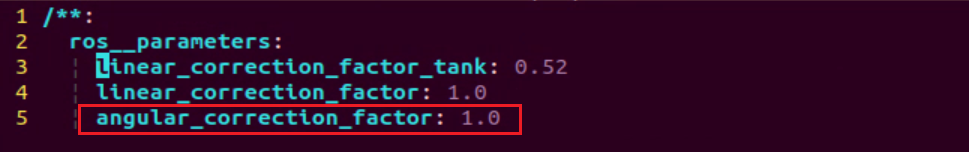

  1. After calibration, open the calibration configuration file to save the corrected parameter:
Press the key i to enter edit mode and modify the value of angular_correctqion_factor to the calibrated value of odom_angule_scale_correction.
This section uses the Mecanum chassis as an example for calibration. The Ackermann chassis does not require angular velocity calibration.
  1. After editing, press ESC, enter the following command, and press Enter to save and exit.

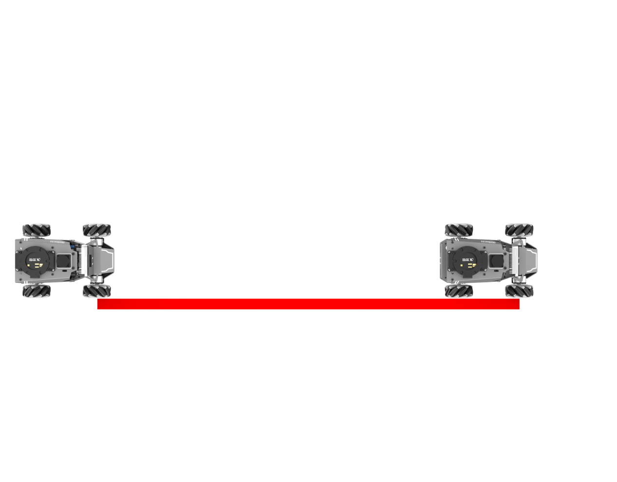

  1. Place the robot on a flat, open surface. Attach a start marker, such as tape, directly in front of the platform, and place an end marker about 1 meter ahead, as shown below.

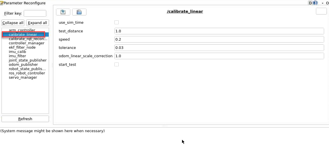

  1. After the calibration program starts, click on calibrate_linear on the left to open the calibration interface, as shown below:
(1) test_distance – The test distance, default is 1 meter.
(2) speed – The linear speed, default is 0.2 m/s.
(3) tolerance – The allowable error. Smaller values reduce the deviation from the target but may cause more shaking after reaching the target.
(4) odom_linear_scale_correction – The odometry linear scale factor.
(5) start_test – The button to start testing the odometry linear scale factor.

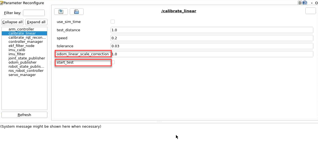

  1. Ensure the robot is properly aligned and positioned at the start marker, then check start_test. The robot will move forward 1 meter in a straight line.
If no adjustment to the interface parameters is needed and the platform moves exactly 1 meter, the current settings are correct, as shown below.
If the robot moves more than 1 meter, the robot’s linear speed is off. Increase the odom_linear_scale_correction parameter by 0.01 at a time until the robot moves exactly 1 meter. Record this critical value, increasing it by 0.01 will cause the robot to travel less than 1 meter. If the robot moves less than 1 meter, decrease the parameter in 0.01 increments.
  1. If there is any deviation, adjust the odom_linear_scale_correction value, which controls the scaling of the motor’s forward movement. It is recommended to change it in increments of 0.01 each time.
  1. After calibration, open the calibration configuration file to save the corrected parameter.
  1. Press the key i to enter edit mode and modify linear_correction_factor to the calibrated value of odom_linear_scale_correction.

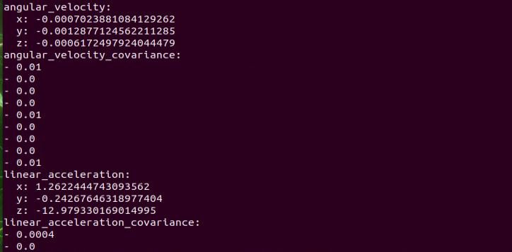

  1. Then, enter the command to print the topic message content, and you can replace it with any topic you want:
ros2 topic echo /imu
The message content shows the data collected from the three axes of the IMU.

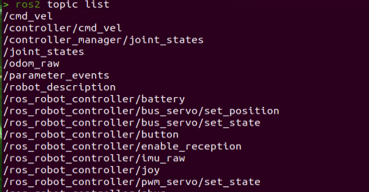

  1. Open a new terminal, enter the command to check the current topics:
ros2 topic list

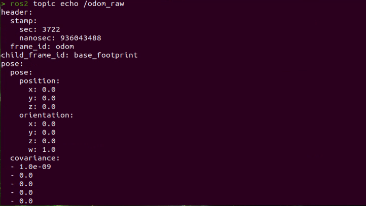

  1. Next, enter the command to check the type, publisher, and subscriber of the /odom_raw topic. You can replace it with any topic you want to check. The type of this topic is nav_msgs/msg/Odometry:
ros2 topic info /odom_raw
  1. Then, enter the command to print the topic message content. You can replace it with any topic you want:
ros2 topic echo /odom_raw
The message contains the robot’s pose and twist data.

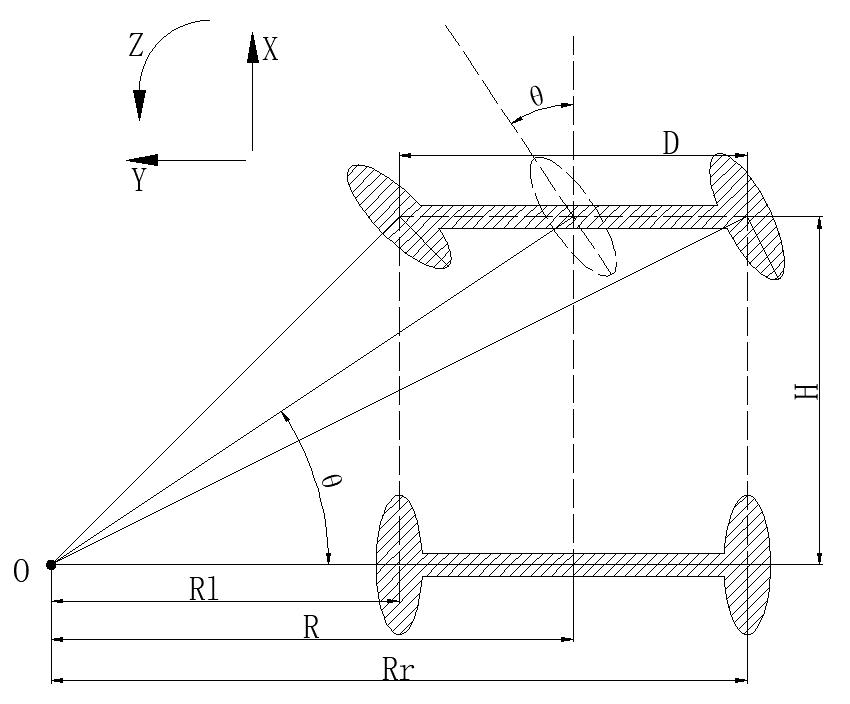

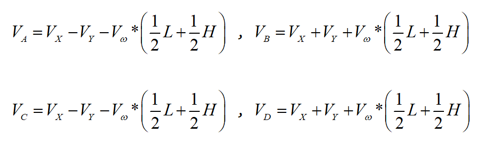

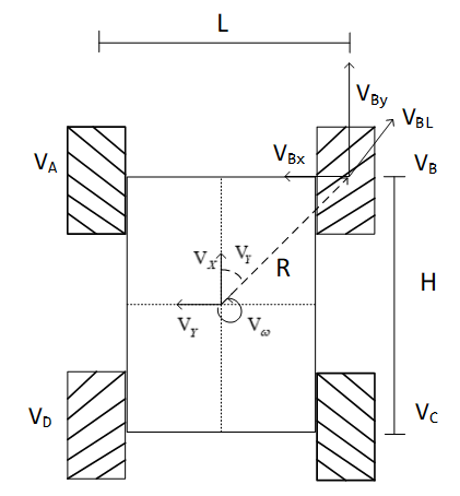

Based on the robot’s motion characteristics, the forward, backward, and turning motions are achieved by controlling the rotation direction of the driving wheels.
The program subscribes to the /controller/cmd_vel topic to get the set linear and angular velocities, which are then used to calculate the robot’s movement speed.

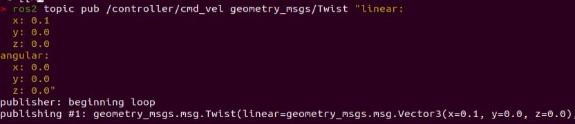

  1. Enter the command to start the motion control service:
ros2 launch controller controller.launch.py

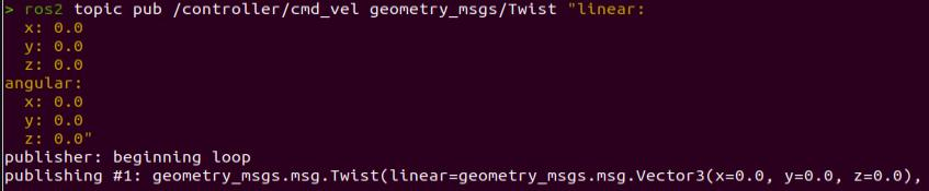

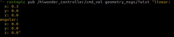

  1. Open a new ROS2 terminal and enter the command to enable speed control:
ros2 topic pub /controller/cmd_vel geometry_msgs/Twist "linear:
x: 0.0
y: 0.0
z: 0.0
angular:
x: 0.0
y: 0.0
z: 0.0"
The linear parameter sets the linear velocity. From the robot’s perspective, the positive X direction points forward, with no motion along the Y or Z axes.
The angular parameter sets the angular velocity. A positive Z value makes the robot turn left, while a negative Z value makes it turn right. There is no rotation along the X or Y axes.
  • The unit of linear velocity X is meters per second (m/s), with a recommended range of -0.6 ~ 0.6.
  • Z represents the angular velocity for turning. It can be calculated using the formulas: V = ωR and tanΦA = D / R, where z = ω, D = 0.213, and ΦA is the turn angle, ranging from 0° to 36°.
Use the keyboard arrow keys to modify the corresponding parameters. For example, to move forward, set linear X to 0.1 and press Enter to execute.
  1. To stop the robot, open a new terminal, set the previously modified linear X back to 0.0, and press Enter.

2.1.5.3 Modifying Forward Speed
By adjusting the linear velocity X value, the robot can move forward at different speeds. For example, to make the robot move straight forward, set X to 0.3 as described in Step 5 of 2.1.5.2 Disable the App Service and Enable Speed Control.
After pressing Enter, the robot will move forward at a speed of 0.3 m/s.
2.1.5.4 Program Outcome
After starting the feature, the robot will move forward at the previously set speed of 0.3 m/s.

(2) Define ROS Parameters:
        self.declare_parameter('pub_odom_topic', True)
        self.declare_parameter('base_frame_id', 'base_footprint')
        self.declare_parameter('odom_frame_id', 'odom')
        self.declare_parameter('linear_correction_factor', 1.00)
        self.declare_parameter('linear_correction_factor_tank', 0.52)
        self.declare_parameter('angular_correction_factor', 1.00)
        self.declare_parameter('machine_type', os.environ['MACHINE_TYPE'])
        self.pub_odom_topic = self.get_parameter('pub_odom_topic').value
        self.base_frame_id = self.get_parameter('base_frame_id').value
        self.odom_frame_id = self.get_parameter('odom_frame_id').value
        #self.machine_type = os.environ.get('MACHINE_TYPE', 'ROSOrin_Mecanum')
        self.machine_type = self.get_parameter('machine_type').value
        self.ackermann = ackermann.AckermannChassis(wheelbase=0.17706, track_width=0.17165, wheel_diameter=0.085)
        self.mecanum = mecanum.MecanumChassis(wheelbase=0.17706, track_width=0.17165, wheel_diameter=0.08)
The function self.declare_parameter is used to define a parameter.
The function self.get_parameter is used to obtain a parameter.
pub_odom_topic determines whether to publish the odometry topic.
base_frame_id specifies the robot’s base frame ID.
odom_frame_id specifies the robot’s odometry frame ID.
linear_correction_factor sets the linear velocity correction factor.
angular_correction_factor sets the angular velocity correction factor.
machine_type specifies the type of robot.

(4) Topic Publishing:
        self.motor_pub = self.create_publisher(MotorsState, 'ros_robot_controller/set_motor', 1)
        self.servo_state_pub = self.create_publisher(SetPWMServoState, 'ros_robot_controller/pwm_servo/set_state', 10)
        self.pose_pub = self.create_publisher(PoseWithCovarianceStamped, 'set_pose', 1)
        self.create_subscription(Pose2D, 'set_odom', self.set_odom, 1)
        self.create_subscription(Twist, 'controller/cmd_vel', self.cmd_vel_callback, 1)
        self.create_subscription(Twist, '/app/cmd_vel', self.acker_cmd_vel_callback, 1)
        self.create_subscription(Twist, 'cmd_vel', self.app_cmd_vel_callback, 1)
        self.create_service(Trigger, 'controller/load_calibrate_param', self.load_calibrate_param)
self.create_subscription is used to subscribe to a topic.
self.create_service is used to create a service.
self.motor_pub publishes motor control messages to ros_robot_controller/set_motor with message type MotorsState.
self.servo_state_pub publishes servo control messages to ros_robot_controller/bus_servo/set_state with message type SetBusServoState.
self.pose_pub publishes servo pose messages to set_pose with message type PoseWithCovarianceStamped.
set_odom topic publishes Pose2D messages, with the callback function self.set_odom.
controller/cmd_vel topic publishes Twist messages, with the callback function self.cmd_vel_callback.
cmd_vel topic publishes Twist messages, with the callback function self.set_app_cmd_vel_callback.
controller/load_calibrate_param service uses the Trigger type, with the callback self.load_calibrate_param.
~/init_finish service uses the Trigger type, with the callback self.get_node_state.

2.2.2.3 Kinematic Principles and Equations
In kinematic analysis, the motion of Mecanum wheels can be described using a kinematic model. This includes several key parameters:
  1. : Linear velocity of the Mecanum chassis along the X-axis, typically the forward/backward direction.
  2. : Linear velocity of the Mecanum chassis along the Y-axis, typically the left/right or lateral direction.
  3. : Angular velocity of the Mecanum chassis, which is the rotation speed around its own center.
  4. : The real-time speeds of the four Mecanum wheels.
  5. For example, the motion of the front-right wheel (Wheel B) on a 2D plane can be decomposed into:
  6. VBx: Linear velocity of the chassis along the X-axis, typically the forward/backward direction.
  7. VBy: Linear velocity of the chassis along the Y-axis, typically the left/right or lateral direction.
  8. L: The distance between the centers of the left and right wheels.
  9. H: The distance between the centers of the front and rear wheels.
  10. : The angle between the robot’s center of chassis and the front-right wheel is 45°.
  11. Based on these parameters, we can perform a kinematic analysis of the Mecanum wheel chassis to determine how wheel speeds contribute to the overall movement of the robot in any direction. Key equations are given below:
Kinematic Analysis and Formula Derivation:
To simplify the kinematic model, we make the following two idealized assumptions:
(1) The Mecanum wheels do not slip on the ground, and the ground provides sufficient friction.

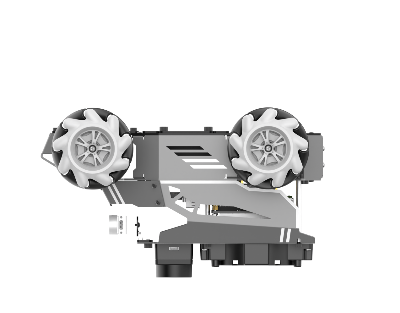

(2) The four wheels are positioned at the corners of a rectangle or square, and all wheels are parallel to their corresponding axes.
In this model, the robot’s rigid body movement is decomposed into three linear components: translation along the X-axis, translation along the Y-axis, and rotation around the Z-axis. By calculating the individual wheel speeds required for these three simple motions, we can combine them to compute the required rotational speed for each wheel during the compound motion of simultaneous translation and rotation.
represent the rotational speeds of wheels A, B, C, and D, respectively, corresponding to the motor speeds. is the translational velocity of the robot along the X-axis, is the translational velocity along the Y-axis, and is the rotational velocity around the Z-axis.
is half the wheel track L, and is half the wheelbase H.
  1. When the robot moves along the X-axis, the speed component of each wheel can be calculated using the following formula:
represent the real-time speeds of the four Mecanum wheels, while represents the wheels’ speed along the X-axis.
  1. When the robot moves along the Y-axis, the speed component of each wheel can be calculated using the following formula:
represents the speed of the Mecanum wheels along the Y-axis.
  1. When the robot rotates around the Z-axis, the speed component of each wheel can be calculated using the following formula:
  1. By combining the velocities along the X, Y, and Z axes, the rotational speed required for each of the four wheels can be derived according to the robot’s overall motion state.

2.2.3.3 Kinematic Principles and Equations
When analyzing the kinematics of an Ackerman chassis, the following mathematical parameters and formulas are used to describe its motion characteristics.
To achieve pure rolling motion, with no lateral slip when the vehicle turns, the normals of all four wheels’ rolling directions, which are the lines perpendicular to the wheel’s rolling direction, must intersect at a single point, known as the instantaneous center of rotation.
For simplicity, the model assumes only a single front wheel located at the midpoint of the front axle, as illustrated by the dashed line in the diagram. The key parameters are:
  1. Front Wheel Steering Angle (θ): The steering angle of the front wheel relative to the vehicle’s forward direction, typically measured in radians (rad).
  2. Vehicle Linear Velocity (V): The translational speed of the vehicle, measured in meters per second (m/s). Left rear wheel speed: VL. Right rear wheel speed: VR.
  3. Wheel Track (D): The distance between the left and right wheels, measured in meters (m).
  4. Wheelbase (H): The distance between the front and rear wheels, measured in meters (m).
  5. Turning Radius (R): The radius of the circular path followed by the vehicle when turning, measured in meters (m).
Left wheel turning radius: RL. Right wheel turning radius: RR.
Computation of robot velocity and wheel speeds:
  1. Angular velocity consistency:
ω is the angular velocity of the robot, R is the turning radius of the robot’s center, V is the linear velocity of the robot, VL and VR are the linear velocities of the left and right rear wheels, and RL and RR are their respective turning radii.
  1. Relationship between the front wheel steering angle and the turning radius:
H is the wheelbase, R is the turning radius of the robot, D is the track width, and θ is the steering angle of the front wheel, where H is the distance between the front and rear axles, and D is the distance between the left and right wheels.
  1. Left rear wheel velocity:
  2. Right rear wheel velocity:
Given the robot’s track width, wheelbase, linear velocity, and steering angle, the velocities of the left and right rear wheels can be determined.
