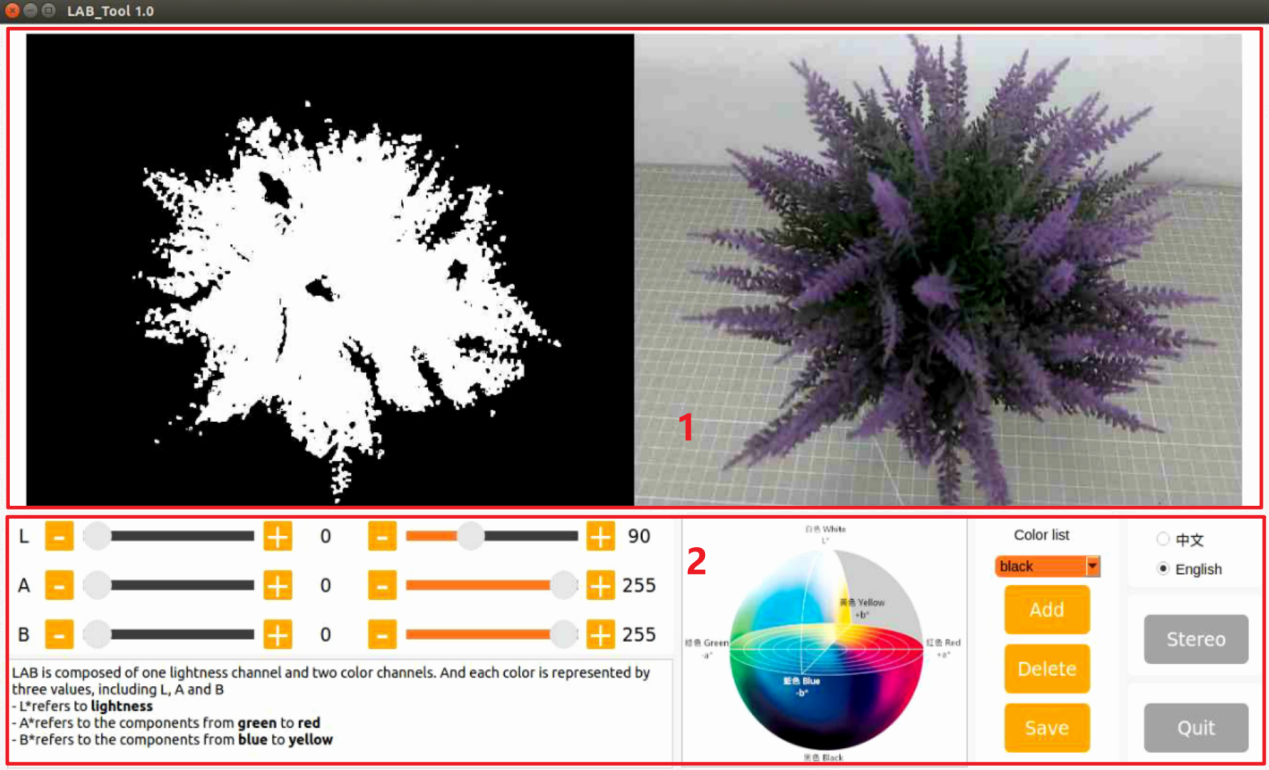

6.1.2 LAB TOOL Interface Introduction

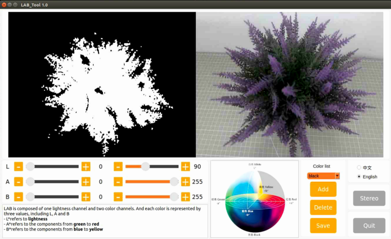

LABTOOL is divided into two parts, including the image display area and the recognition adjustment area.
Image display area: The processed camera feed is shown on the left, and the raw feed is shown on the right.
If the video feed fails to display, indicating a camera connection error, check the camera cable for a secure connection or reconnect it.
Adjustment Panel: Allows color-threshold tuning. The functions of each button are listed below.

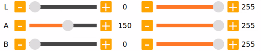

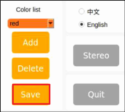

Open LABTOOL, and select the color in the drop-down menu. Take adjusting the red color, for example.

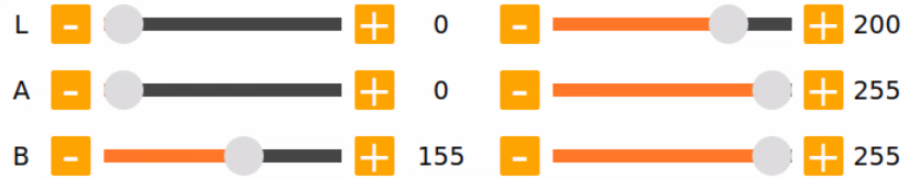

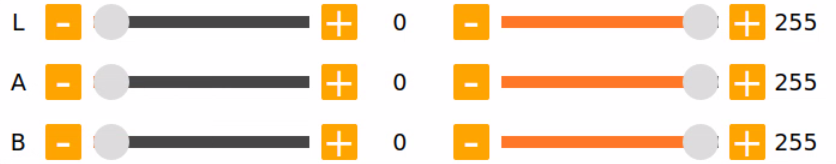

Modify all min values of L, A, and B to 0, and max values to 255.

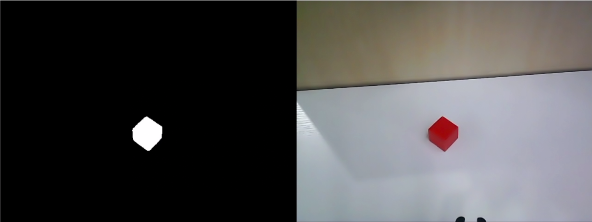

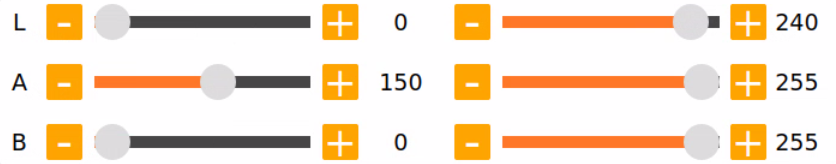

Put the red block within the camera frame. According to the LAB color space, adjust L, A, and B components to approach the zone of the target color.
If the red area appears close to +a, increase the A component. Keep the A component’s max value unchanged and raise its min value until the target object in the left display turns white while all other areas turn black.
Based on the environment, modify the value of L and B. Increase the L component’s min value if the red tone is too light, or reduce its max value if it is too dark. Increase the B component’s min value if the red tone is too warm, or reduce its max value if it is too cool.

Click Save to save the adjusted color threshold parameter.

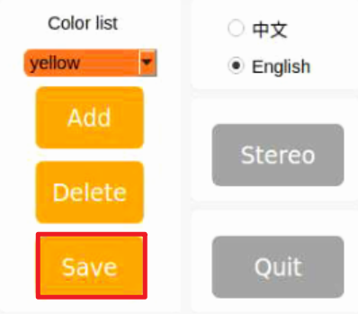

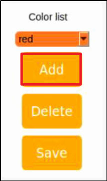

In addition to the built-in detectable colors, additional colors can be added. Yellow is used as an example below. The steps are as follows:

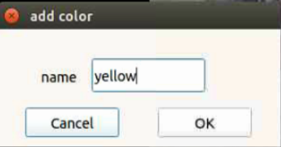

Open the LAB TOOL and click the Add button.
Then fill in yellow, and click OK.

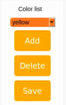

Select the newly added color from the color list.

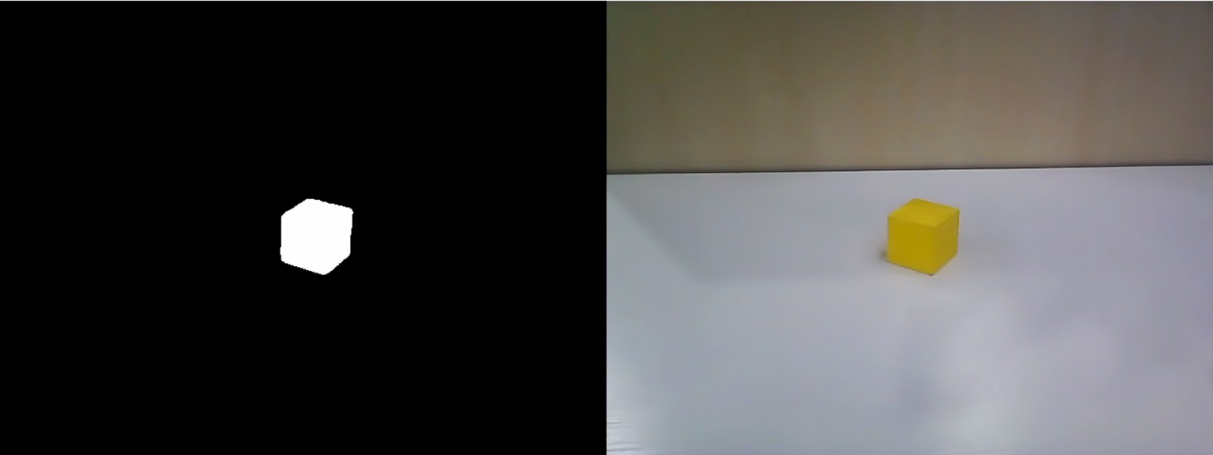

Face the camera at the yellow block. And drag the sliders of L, A, and B to adjust the color threshold till the object on the left turns white and the other area turns black.
For instructions on adjusting color thresholds, refer to section 6.1.3 Adjust Color Threshold.

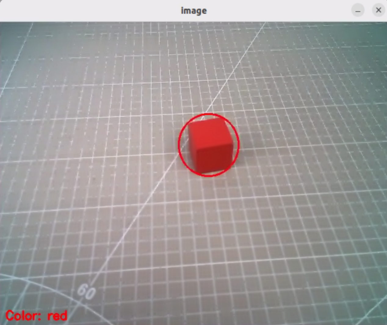

6.2.3 Project Outcome
After the feature starts, please ensure there is no other object containing the recognition color except the target object within the camera view. Otherwise, the recognition result will be affected.
After the feature starts, put the objects within the camera’s view. When the target object is detected, the program will highlight it with a circle of the corresponding color and display the color name in the lower-left corner of the window. The program can detect objects in red, blue, and green.

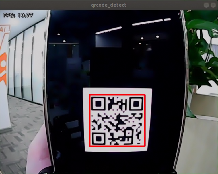

6.3.2 QR Code Recognition
In the previous section, a QR code is created, which will be used to demonstrate recognizing the content of a QR code.
Recognition Process
First, create an instance of the QR code detector and load the required network structure and model weight files for detection.
Next, capture the video stream from the camera and perform detection on each frame.
Finally, when a QR code is detected, it will be highlighted with a bounding box, and the content of the QR code will be printed.
QR Code Recognition Steps

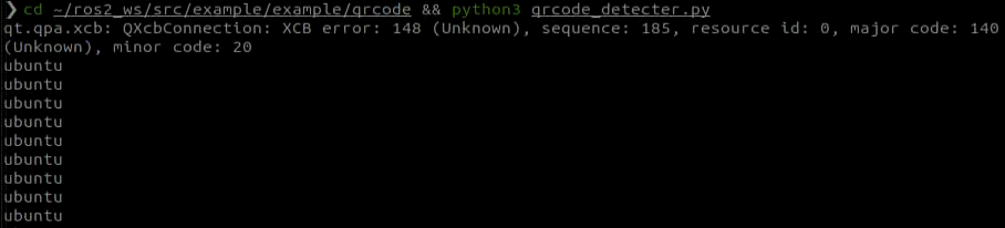

Power on the robot and connect it via the VNC remote control software. For detailed information on connecting to remote desktop, please refer to section 1.7.2 AP Mode Connection Steps in the user manual.
Click the terminal icon
in the system desktop to open a command-line window.Enter the command to disable the app auto-start service.
Enter the command to start the camera node:
Open a new ROS2 terminal, navigate to the program directory, and start the QR code recognition program by entering the following command:
cd ~/ros2_ws/src/example/example/qrcode && python3 qrcode_detecter.py
To exit the feature, press Ctrl+C in the terminal. If the program does not close successfully, try pressing Ctrl+C again.
Project Outcome
After starting the feature, the QR code appearing in the returned video frame is detected, highlighted with a red box, and its content is printed.

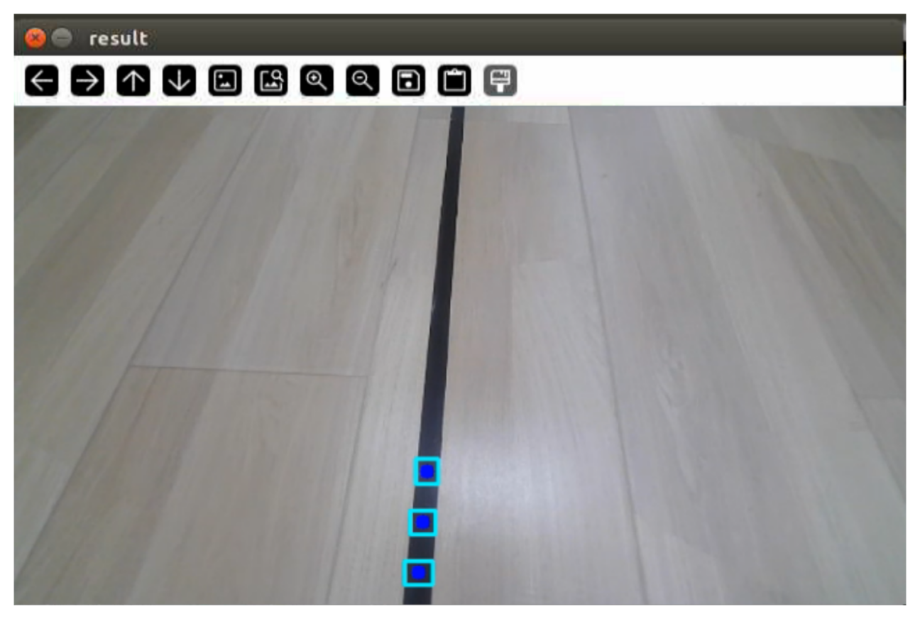

Power on the robot and connect it via the VNC remote control software. For detailed information on connecting to a remote desktop, please refer to section 1.7.2 AP Mode Connection Steps in the user manual.
Enter the command to start the line-following node:
Open a new terminal, navigate to the program directory, and start the autonomous patrolling feature by entering the following command:
Next, in the current terminal, switch to the program directory and start the autonomous patrolling feature by entering the following command:
Click on the line in the interface, select the corresponding color of the track, and the robot will start following the line.
To stop this feature, return to the terminal and enter the following command:
