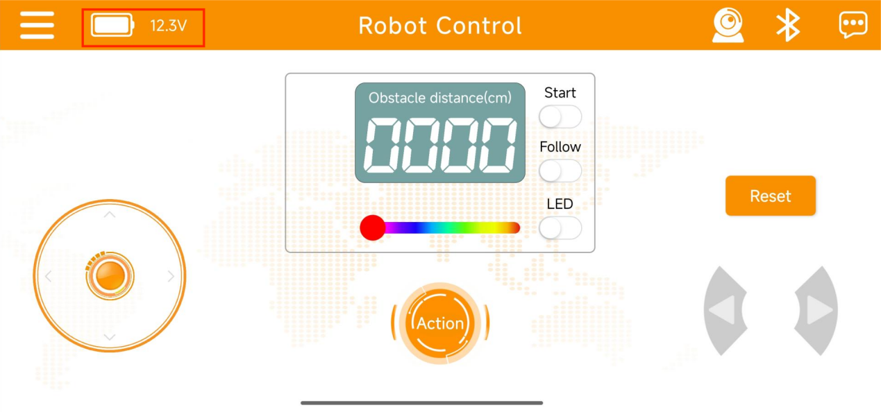

The app enables you to control Tonybot’s movements, ultrasonic obstacle avoidance, ultrasonic following, action groups, and the “Reset” function, all with a simple tap of a button.
The interface is organized into two sections, as illustrated in the image below:
(1) Menu Bar
Icon Description
Return to the main interface to select the robot model
Displays Tonybot's current battery level in real-time
Camera feed: View the live video stream from the ESP32 camera.
Bluetooth connection: The icon flashes when disconnected and stays solid once connected.
More information
(2) Control Zone
Icon Description
Control Tonybot's movement
View ultrasonic distance while in obstacle avoidance mode
Turn the ultrasonic obstacle avoidance feature on or off
Enable or disable the ultrasonic following feature
Switch the ultrasonic RGB lights on or off
Adjust the color of the ultrasonic RGB lights
Tap to trigger an action group on Tonybot.
(This includes both preset and custom action groups.)
Control Tonybot's rotation in place
Reset Tonybot's pose

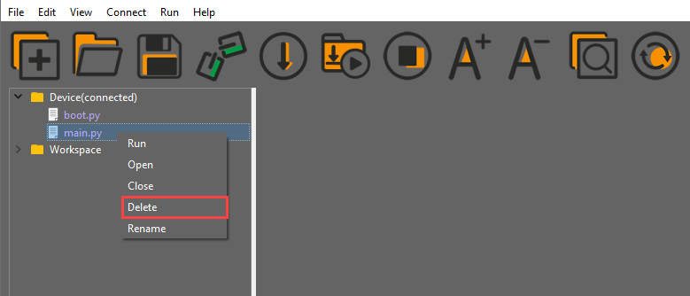

The default factory program includes a self-recovery feature. To restore the app control, simply use the Python editor to connect to the device, delete the “main.py” program, and restart the device. Follow these steps:
(1) Open the Hiwonder Python Editor software.
(2) Click the Connect button in the menu. Once the connection is established, the icon will turn green .
(3) In the “Device (Connected)” section, right-click the “main.py” file and select Delete. Afterward, restart the device to complete the process.
