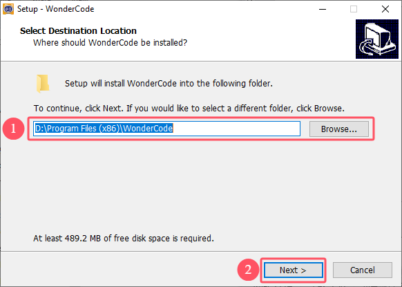

(1) Locate and open the installation file “WonderCode setup.exe” in the same folder as this document, or find it in the “Appendix”.
(2) In the “Select Installation Language” window, choose “English,” then click “OK.”
(3) Select your preferred installation location. You can either use the default folder or choose a custom path. Once done, click “Next.”
(4) The “Additional Tasks” window will appear. The option to “Create Desktop Shortcut” is selected by default. You can leave this as is and click “Next” to continue.
(5) Click the “Install” button to begin the installation process.
(6) The installation will begin, and a progress bar will be displayed to show the status.
(7) Once the installation is finished, click “Finish” to complete the process.

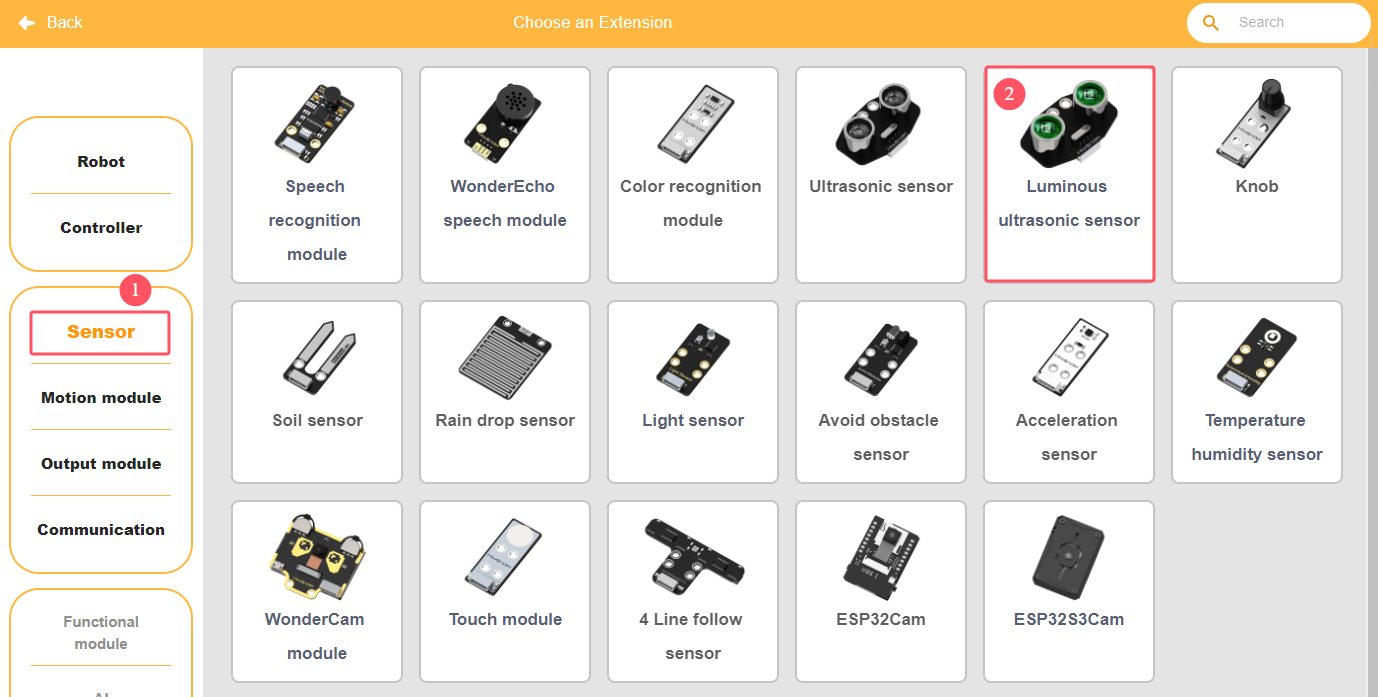

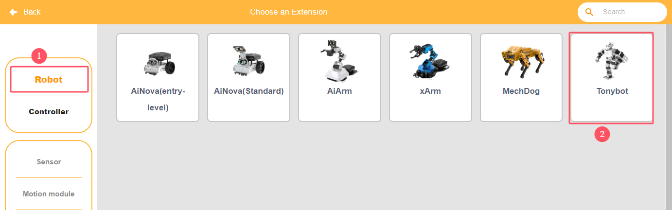

(2) Before you can connect, you’ll need to add the device’s extension package. Without it, the connection won’t work. To add the extension, click the “Add Extension” button located in the bottom-left corner of the main interface. In the pop-up window, select “Robot -> Tonybot” in order.

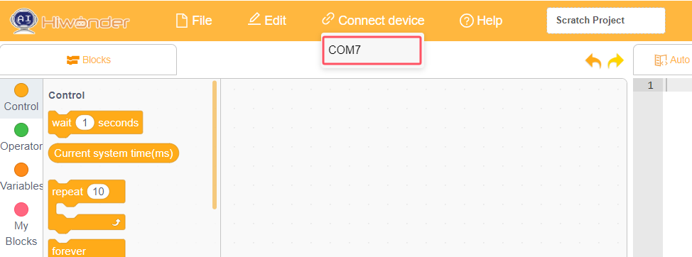

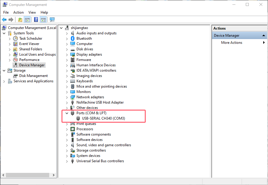

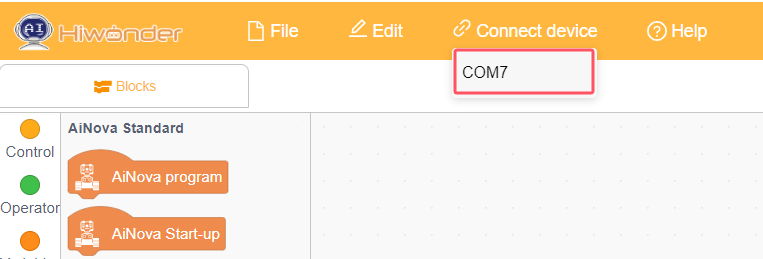

(3) After that, click the “Connect” button and choose the correct port for the connection.
The port number can vary based on your system’s setup. For instance, in this case, the port number used is “COM4”, but avoid using “COM1”, as it’s typically the system’s communication port.
If you’re connecting multiple USB devices and aren’t sure which port to use, you can find it by opening “This PC” on your desktop. Then go to “Properties -> Device Manager,” where you’ll find the port corresponding to the Tonybot controller (it will show as “CH340”).
(4) Once the device and software are successfully paired, you should see a confirmation message indicating the connection was successful.

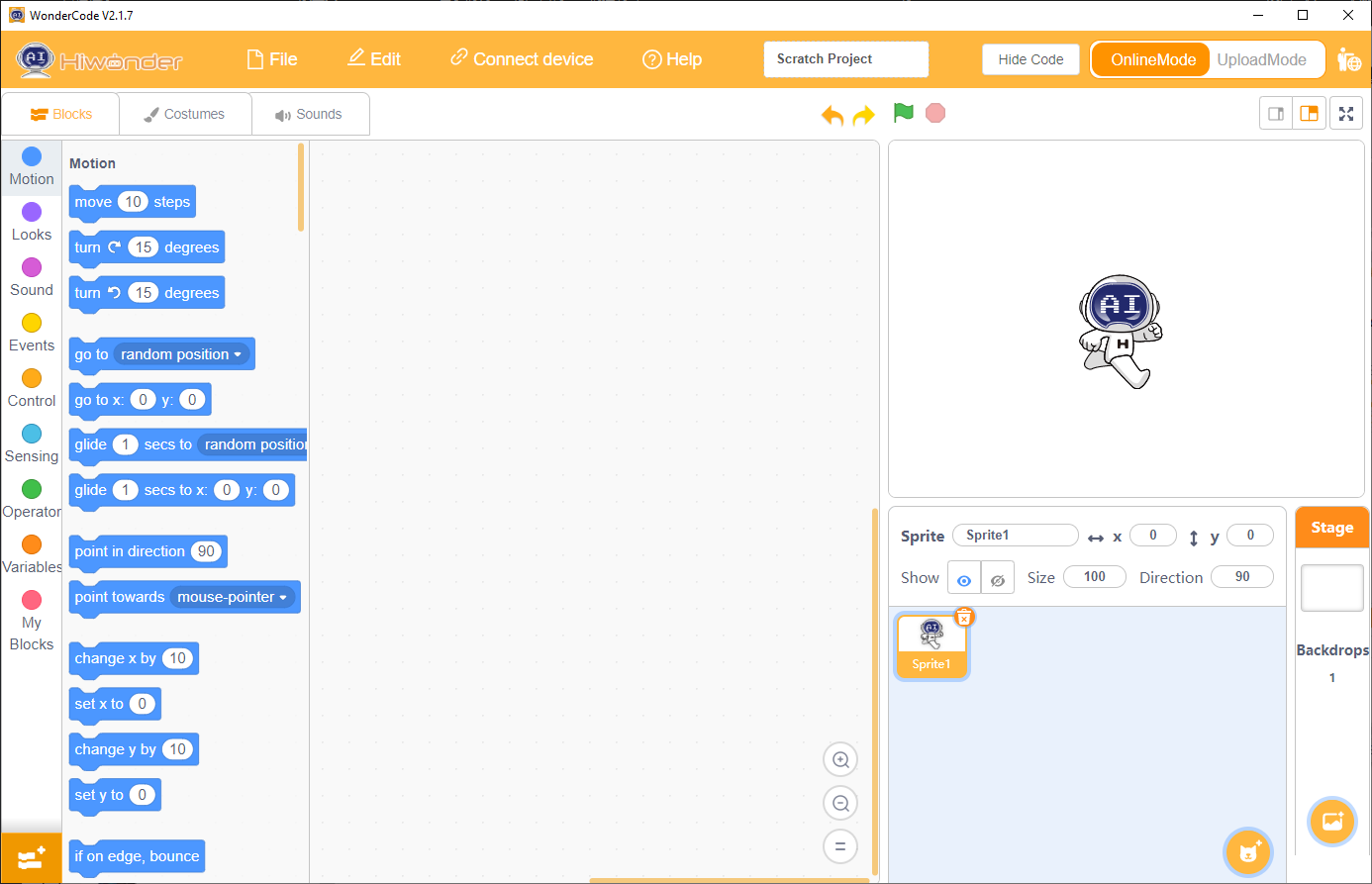

The image below illustrates the functional areas of the “WonderCode” software:
① Menu Bar,
② Command Area,
③ Script Area,
④ Code Display and Upload Area.
The functions corresponding to each area are listed in the table below:
Icon Function
Create, Save, and Open Program Files: This option allows you to create, save, and open program files.
Online Mode (Reference Only): This section is for understanding the online mode. No need to master it for now.
Connect Device and Software: Use this to connect your device to the software and choose the appropriate port.
Help, Updates, and Driver Installation: Access help, check for updates, or install necessary drivers here.
Program File Name Display: Displays the name of the program file. If you haven't started programming or the file isn't saved yet, it will show "Scratch Project".
Switch Between Modes: Use this button to toggle between "Online Mode" and "Upload Mode." Be sure to save your work before switching, as unsaved files will be lost (Note: Online Mode is used for activities like playing animations and making games, while Upload Mode is for interacting with your device and utilizing its features).
Language Options: Choose the language for the interface, with options for English, Simplified Chinese, and Traditional Chinese.
Undo and Redo: Easily undo or redo actions during programming.
Switch Editing Modes: Toggle between "Auto Transcoding", which converts block-based programming into Python, and "Python Programming", where you can directly edit with Python.
Save as Python Code: Save your program in Python code format.
Open Saved Python Files: Open Python files you've previously saved.
Device Interaction: Download your program to the main control board for device interaction.
Add Device Extension Package: Add necessary extensions for your device here.
Zoom Controls: Adjust the zoom for your code editing interface, or reset it to the default size.

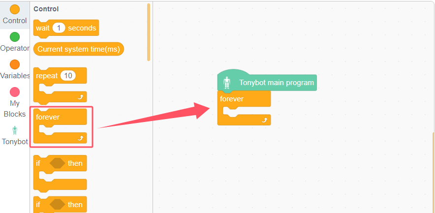

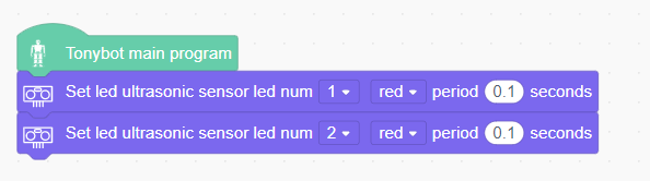

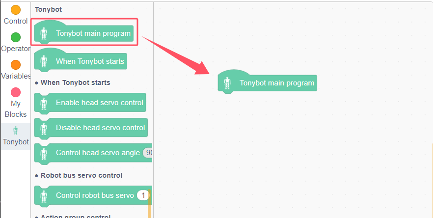

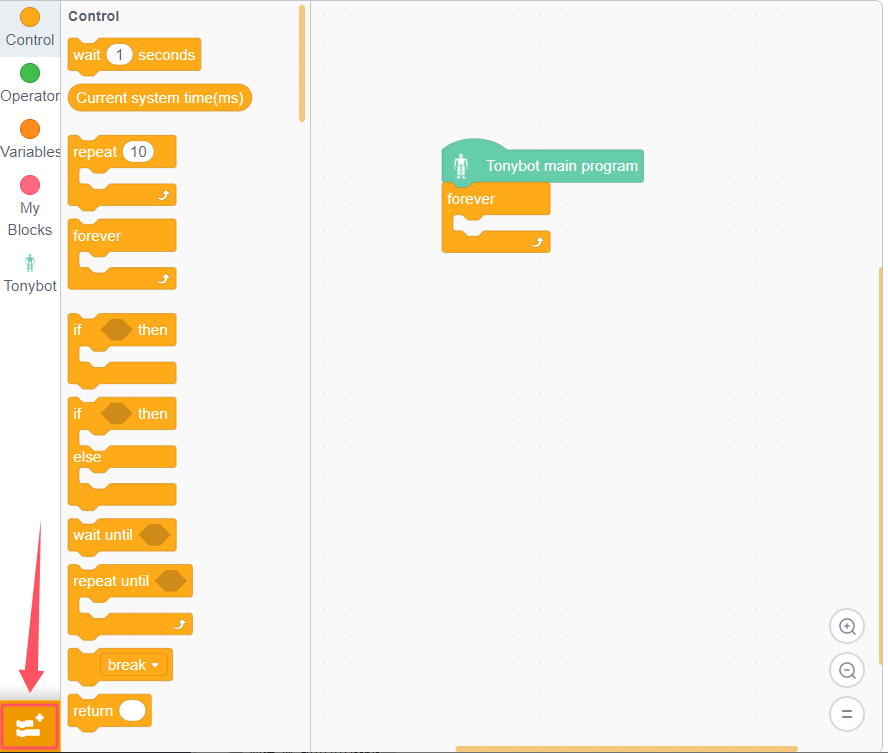

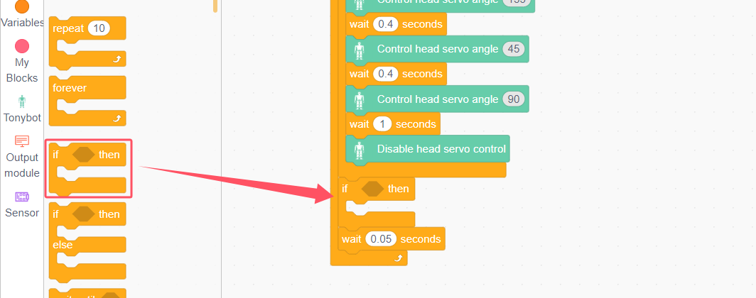

(1) Find the “Tonybot Main Program” block within the Tonybot command set and drag it into the code editing area.
If you want to remove a block, simply drag it back to the command set area from the code editing section.
(2) Next, drag the “Repeat” block from the control command set and place it below the previous block.

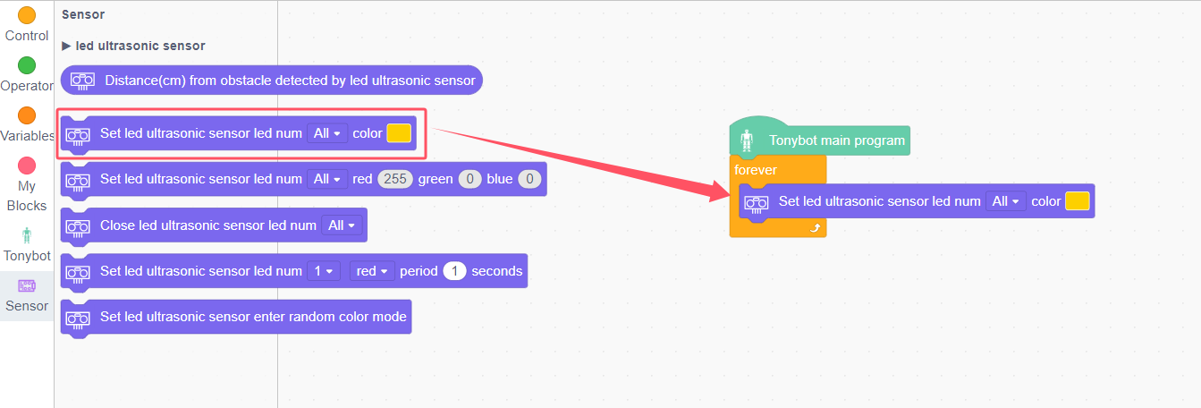

(3) In the lower-left corner, add the “Glowy Ultrasonic Sensor” extension package.
(4) From the sensor command set, drag out the block to set the color of the ultrasonic LED lights. Place it inside the “Repeat” block and configure all LEDs to glow red.
(5) Once you’re done, click “Upload” to transfer the program to the main controller.

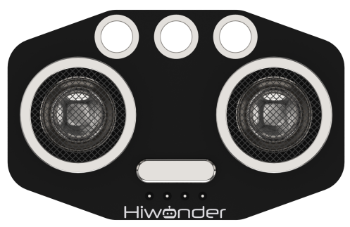

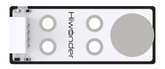

  • Introduction to Glowy Ultrasonic Sensor
This is a glowy ultrasonic distance sensor module that communicates via I2C. It reads the distance measured by the ultrasonic sensor using the I2C protocol.
When measuring distance, the module sends out 8 pulses of 40kHz square waves and checks for any returning signals. If a signal is detected, the module outputs a high-level signal, and the duration of this high signal corresponds to the time taken for the ultrasonic waves to travel to the target and back.
The ultrasonic sensor is pre-installed on the robot when it leaves the factory.

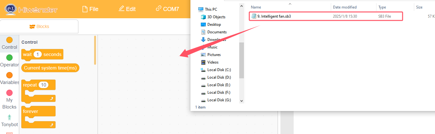

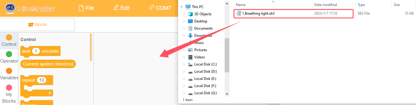

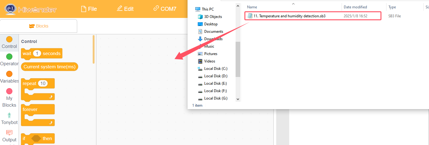

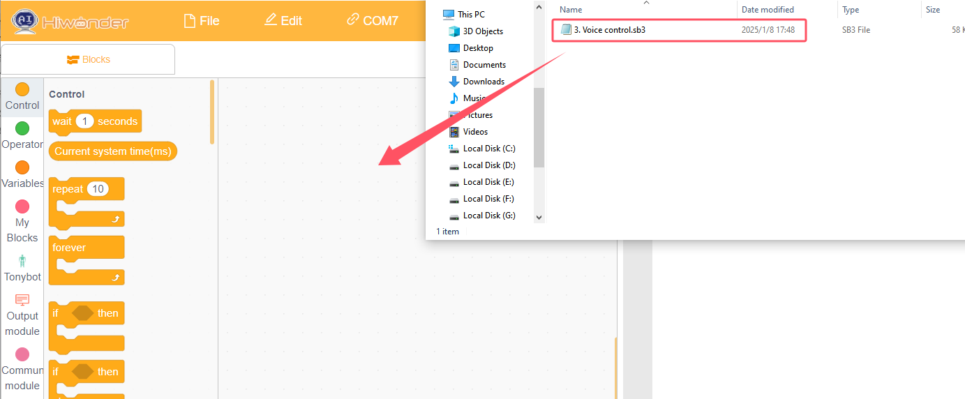

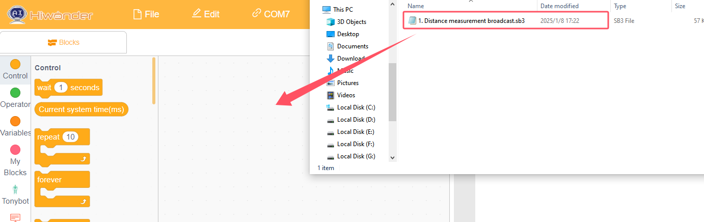

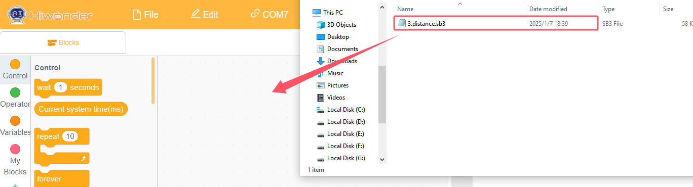

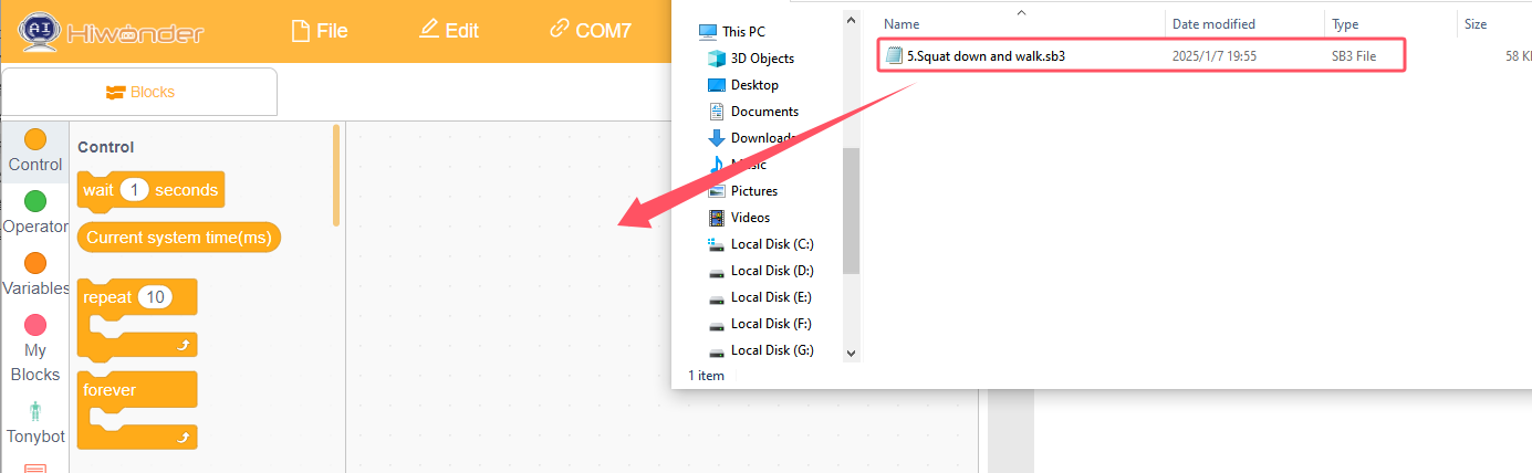

(1) Open the WonderCode software .
(2) Drag the “02 Breathing Light Program.sb3” file from the same folder as this document into WonderCode.
(3) In the menu bar, click on “Connect device” and select the correct COM port (e.g., COM7). Once the connection is successful, you’ll see a “Connect Success” message.
(4) Hit the Upload button on the right to transfer the program to the Tonybot. Wait for the confirmation that the upload is complete.

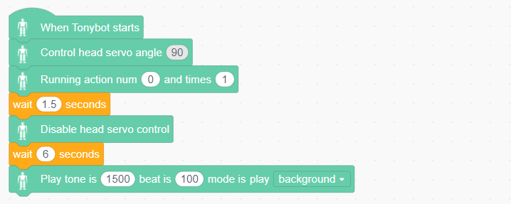

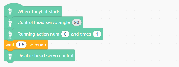

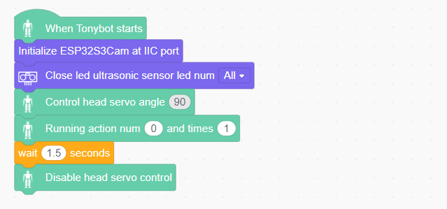

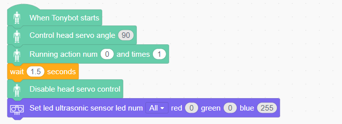

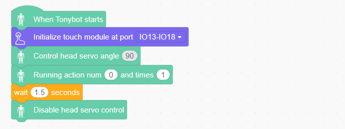

(1) Initialize the posture of Tonybot and configure the flags for the buttons and actions.
(2) In the main program, set the color and cycle period for the ultrasonic RGB lights.

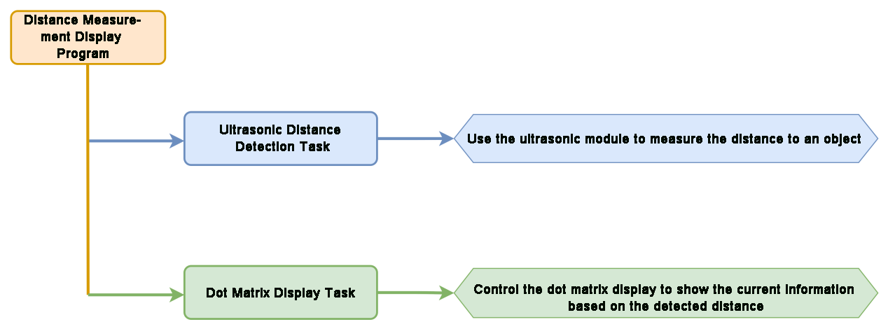

This section utilizes the ultrasonic module to measure the distance to an obstacle. The measured distance is displayed on the LED dot matrix, and the RGB light color of the ultrasonic module is adjusted accordingly.
  • Program Implementation Process
  • Sensor Introduction
(1) Glowy Ultrasonic Sensor
This is a light-emitting ultrasonic distance sensor module that communicates via I2C. It reads the distance measured by the ultrasonic sensor using the I2C protocol.

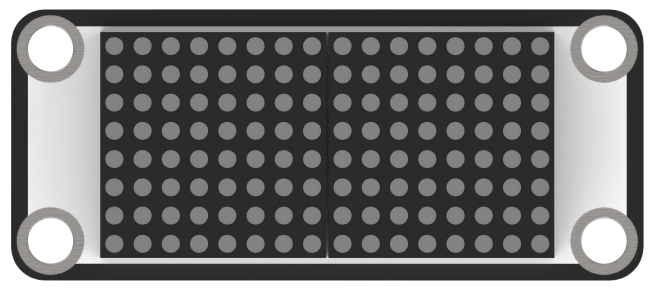

(2) LED Dot Matrix Display
The LED dot matrix module utilizes an LED display screen that offers high brightness, flicker-free performance, and easy wiring. It is capable of displaying numbers, text, patterns, and other content. The module consists of two red 8x8 LED matrices and is controlled by the TM640B driver chip, which enables efficient control of the dot matrix screen.
For a detailed introduction to the installation and assembly process, please refer to the tutorial video.
  • Program Download
Distance Ranging & Display Program

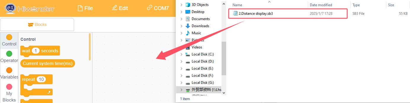

(2) Drag the “03 Distance Ranging & Display.sb3” file from the same folder as this document into WonderCode.
  • Achieved Effect
Slowly bring the object closer to the glowy ultrasonic sensor. As the distance decreases, the ultrasonic light will shift towards red, and as the distance increases, it will become greener. The LED dot matrix display will update in real-time to show the measured distance.
  • Program Analysis

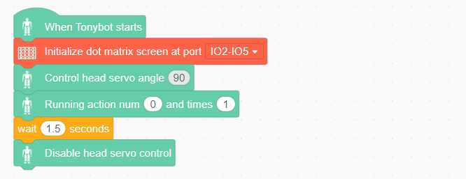

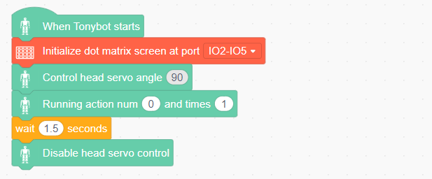

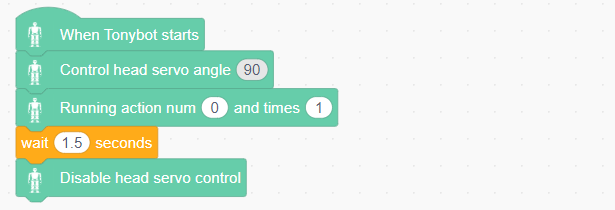

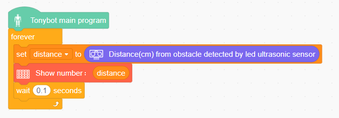

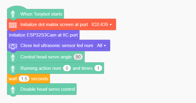

(1) Initialize Tonybot’s posture, set up the dot matrix, and configure the initial action sequence.
(2) In the main program, assign the detected obstacle distance to the variable ‘distance,’ display this distance numerically on the dot matrix screen, and introduce a 0.1-second delay.

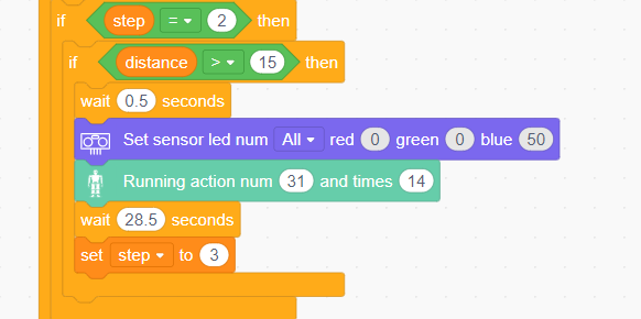

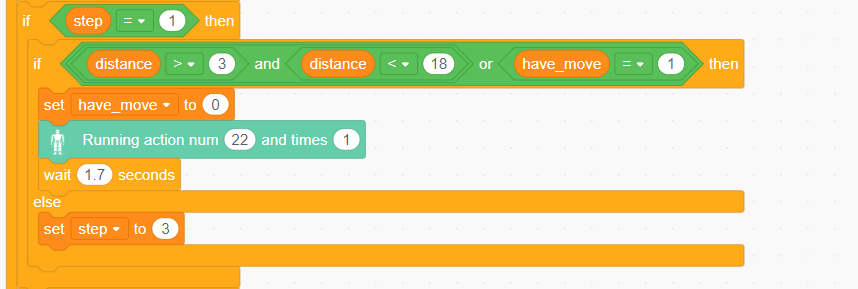

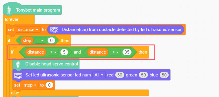

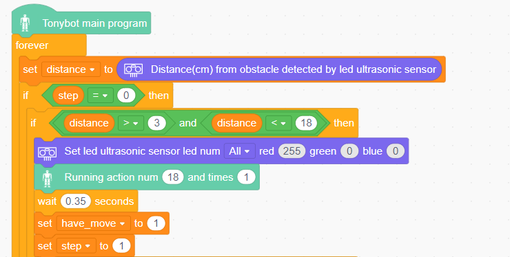

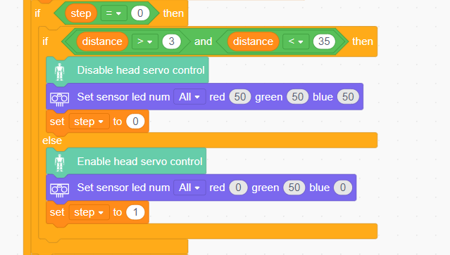

(2) In the main program, initiate an infinite loop. The Distance variable stores the current measurement between the sensor and the obstacle. When the step variable is set to 0, the program will proceed with the subsequent actions. If the measured distance to the obstacle meets the specified condition, the robot will execute either a forward or backward movement.

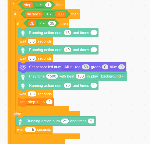

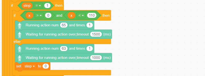

(3) When the step variable is 1, if the detected distance is greater than 3 and less than 18, or if the have_move variable equals 1, then initialize the have_move variable and run action group 22 once. If the conditions are not met, update the step to 3.

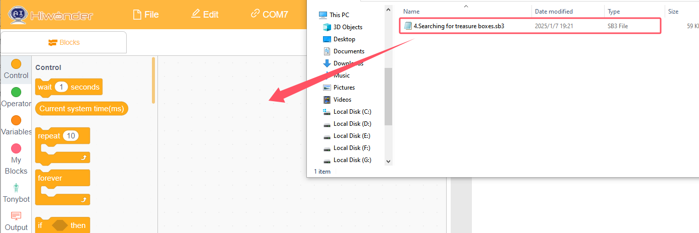

(2) Drag the “02 Treasure Hunt.sb3” file from the same folder as this document into WonderCode.
(3) In the menu bar, click on “Connect” and select the correct COM port (e.g., COM7). Once the connection is successful, you’ll see a “Connection Successful” message.

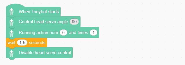

(1) Initialize the posture of Tonybot and set the initial actions.

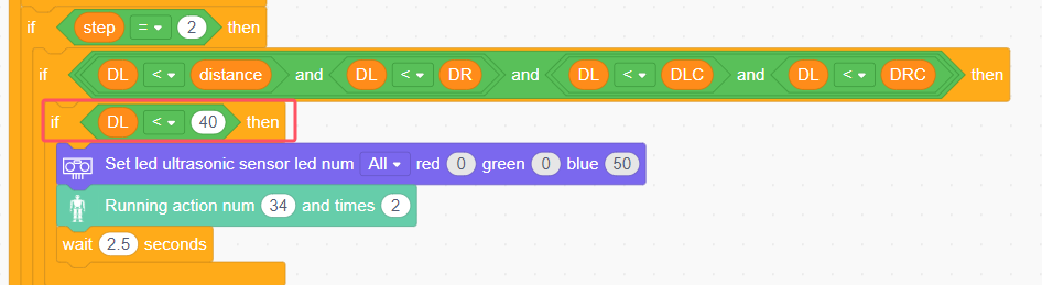

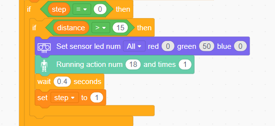

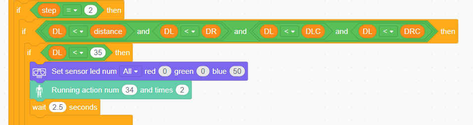

First iteration (step = 0):
① The program executes the logic for step = 0, using the measured distance to control the ultrasonic RGB module, which lights up in different colors depending on the distance.
② If the forward distance to the treasure box falls within a moderate range (30–300), the logic for step = 1 is executed (while step remains 0). If the distance is too large, step is set to 1, prompting the program in the next loop to search for the direction closest to the treasure box.

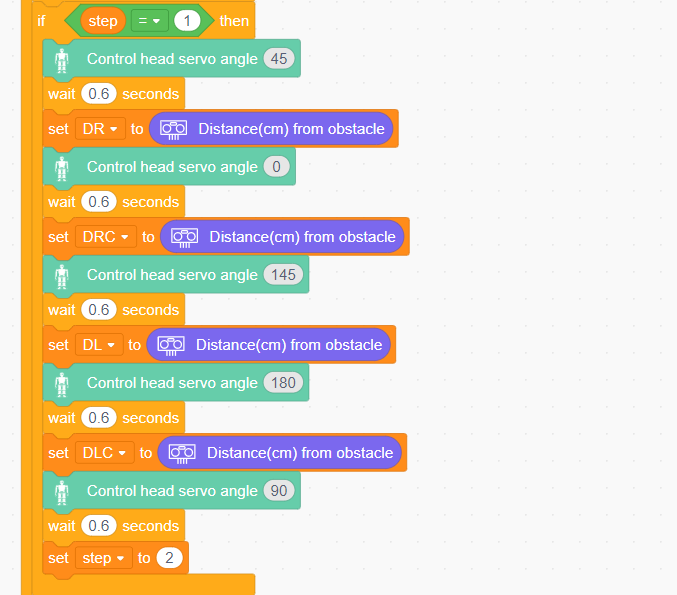

Second iteration (step = 1):
① The program rotates the servo to detect the distance from four directions: 45° (front-left), 0° (left), 145° (front-right), and 180° (right).
② It then updates step to 2, allowing the program to proceed to directional decision-making in the next loop.

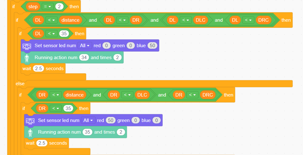

Third iteration (step = 2):
① The program first processes and normalizes the distance values. If the sensor cannot detect the treasure box in a given direction (returns 0), that direction is treated as having an infinite distance, standardized to 9999.
② It then compares the distances from all directions to determine the shortest path to the treasure box. If the closest direction is on the left, the RGB module lights up blue; if on the right, it lights up red. The robot then performs a series of turns to align itself with the selected direction.
If the forward direction still yields the shortest distance despite being large, the robot will not perform any turning motion. In this case, the RGB light will remain green, as set during step = 0.
(3) Through this three-step cycle, the function’s complete detection and decision-making process is executed.
(4) In this code block, once step is updated to 2, the program evaluates the conditions and executes the corresponding actions—such as changing the color of the ultrasonic RGB light and triggering Action Group 34.

(1) Adjusting the Detection Range
① To modify the detection range, simply update the code within the highlighted section, as shown below:
② When the detected distance between an object and the robot is greater than 3 cm but less than 35 cm, the system identifies the presence of a “treasure box” and triggers the treasure-hunting action. You can adjust the detection range by changing the condition in the distance check, as shown below:

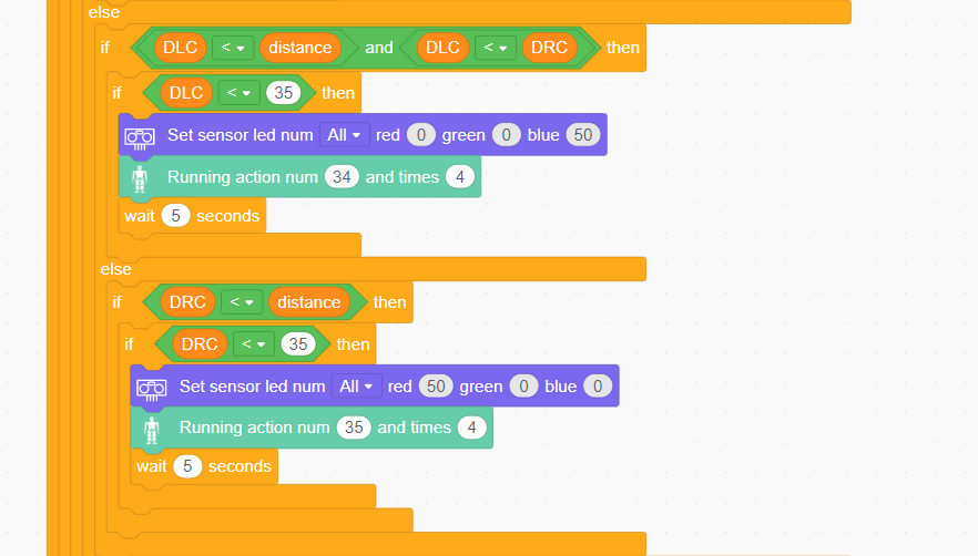

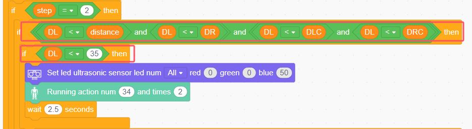

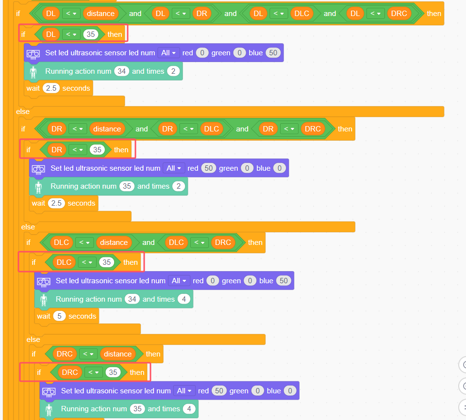

① To adjust the turning conditions, update the code in the specified section of the program, as illustrated below:
② The program first evaluates the 5 measured directions and determines which one has the shortest distance. It then checks if this distance is within the defined detection range. If it is, the robot will perform the corresponding turning action.
③ To modify the detection range, you can adjust the distance values in each directional check. For example, when the left side is the closest and the distance is under 400, the robot will turn left, as shown below:

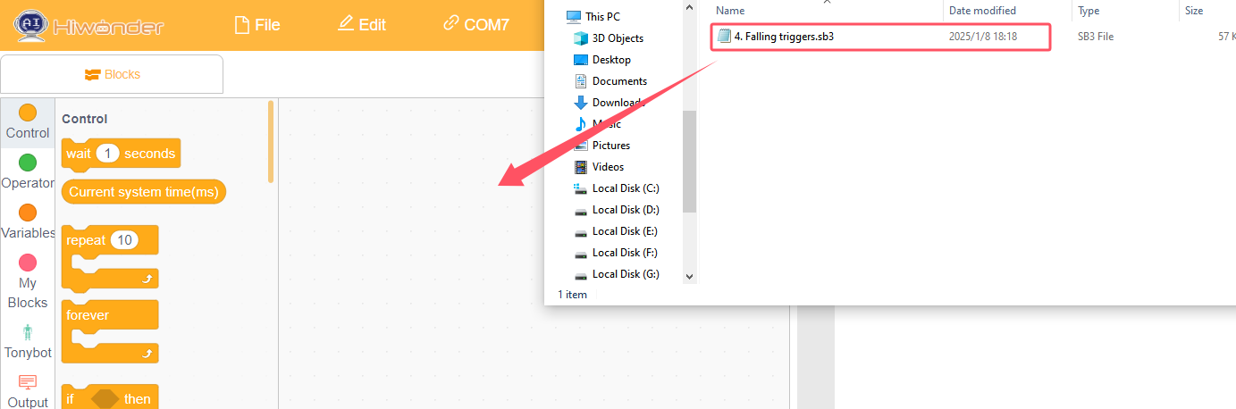

(2) Drag the “02 Low-Altitude Navigation.sb3” file from the same folder as this document into WonderCode.

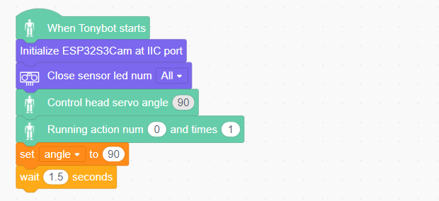

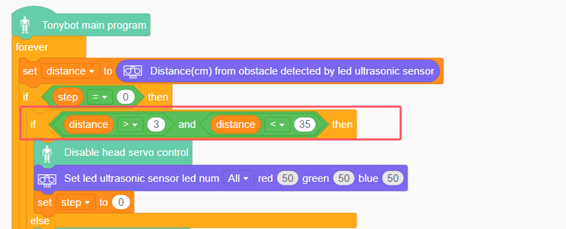

(2) Initialize global variables, such as distance (distance), step (step), DLC (distance threshold), DL (another distance threshold), and others.

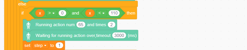

(3) Enter a loop to continuously read the distance values from the ultrasonic sensor. Based on the distance values and the current step (step), execute the corresponding actions and update the step accordingly.
(4) Within the loop, the robot executes different movement behaviors based on the current step value:
First Iteration (step = 0):
① The program runs the logic for step = 0. If the measured distance is greater than the predefined threshold (i.e., no obstacle is detected and the distance value is 0), the robot executes a specific action group, lights up green, and transitions to the logic for the second iteration on the next loop cycle.
② If the measured distance is less than the threshold, the robot remains in the step = 0 logic branch during the next loop cycle.
Second Iteration (step = 1):
① If, during the time between the previous and current iterations, the newly measured distance falls below the threshold, the robot performs two action groups, lights up red, and activates the buzzer as an alert. It then shifts to a low-stance standing position and proceeds to step = 2 in the next cycle.
② If the distance remains above the threshold, the robot performs a high-stance walking action and stays in the step = 1 branch in the following loop.
Third Iteration (step = 2):
① If the newly measured distance is still below the threshold, the robot executes two action groups, lights up blue, and transitions from a stationary low stance to low-stance forward movement.
② If the distance exceeds the threshold, the robot maintains its low-stance standing position and remains in the step = 2 logic on the next cycle.

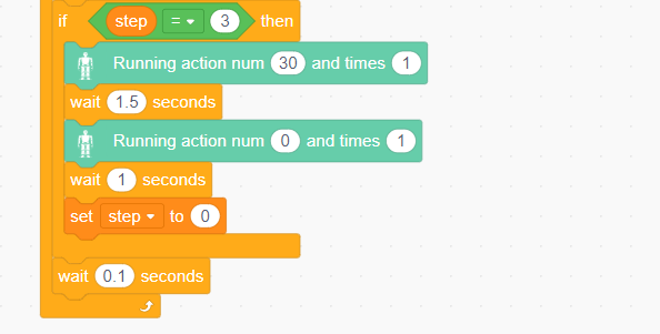

Fourth Iteration (step = 3):
① The robot first performs a low-stance standing action to stop any ongoing low-stance movement, then transitions to a high-stance standing state.
② On the next loop cycle, the program resets and returns to the logic branch for step = 0.

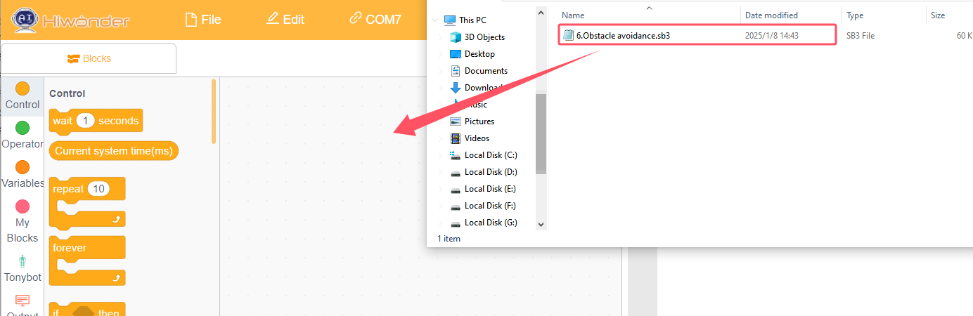

  • Program Download
Head-Shaking Obstacle Avoidance Program
(2) Drag the “Head-Shaking Obstacle Avoidance.sb3” file from the same folder as this document into WonderCode.

(1) Initialize the Tonybot’s posture and set the initial motion.
(2) Execute specific actions to avoid obstacles based on the distance measurements obtained from the ultrasonic sensor.

  • Program Download
Fall and Recover Program

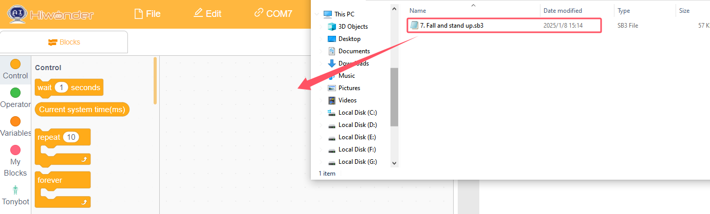

(2) Drag the “Fall and Recover.sb3” file from the same folder as this document into WonderCode.

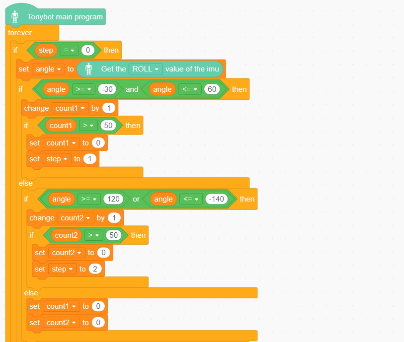

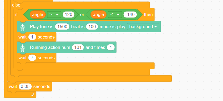

In the fall and recover mode, when the robot is powered on or restarted, the IMU will initialize. Wait for the ‘beep’ sound to confirm that initialization is complete.
After turning on the robot, place it flat either on its front or back. After a brief moment, the robot will automatically perform the standing action. (The standing action differs depending on whether the robot is placed face up or face down.)

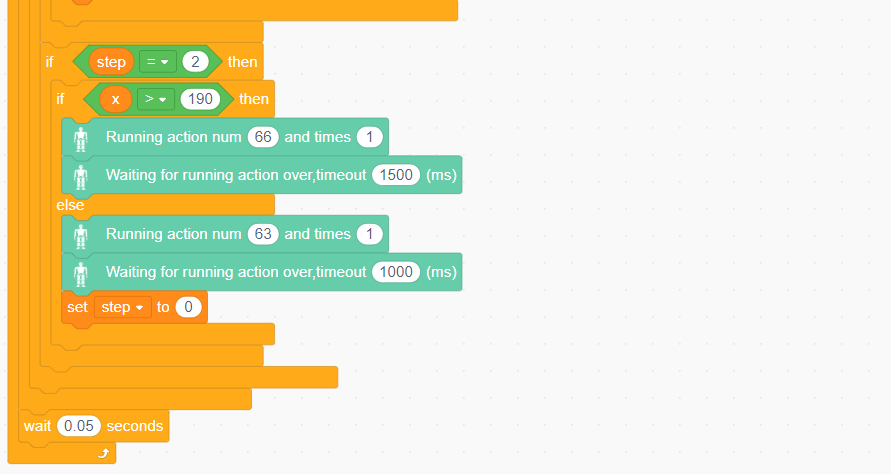

  • Program Analysis
(1) Initialize the Tonybot’s posture and set the initial action.

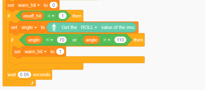

(2) Read the IMU sensor’s angles. By obtaining the roll angle values, detect whether the robot is in a “fallen” state, and execute the standing action group based on this status.

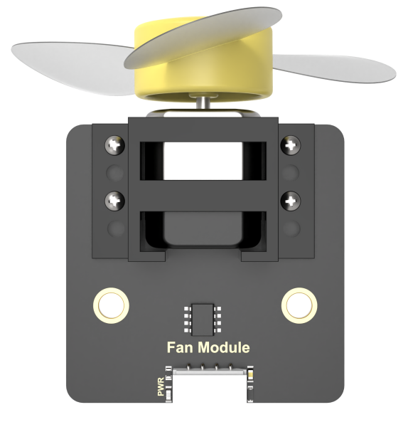

(2) Fan Module
The fan module is a sensor that operates without the need for an external motor driver board, utilizing PWM (pulse-width modulation) to control its movement. The direction of the fan’s rotation is managed by PWM pulse waveforms in both directions, while the fan speed is adjustable by modifying the duty cycle of the PWM signal.
For module installation and wiring, please refer to the section 1 in the same folder.
(2) Drag the “Smart Fan.sb3” file from the same folder as this document into WonderCode.

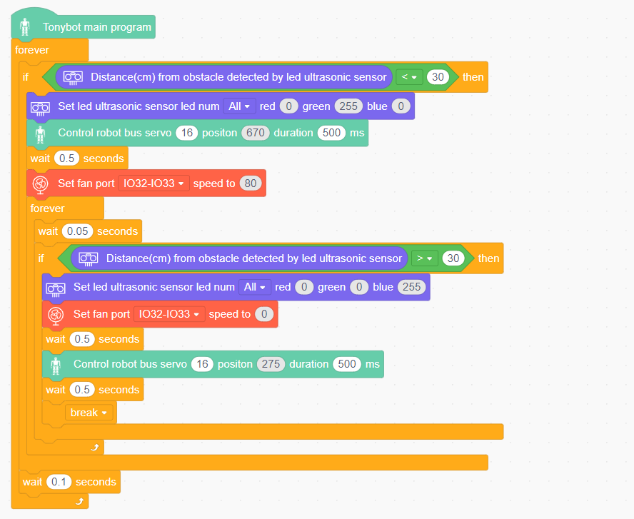

Slowly move the object closer to the glowy ultrasonic sensor. If the distance is less than 300mm, the robot will extend its right hand and activate the fan. If the distance exceeds 300mm, the right hand will lower, and the fan will be deactivated.
  • Program Analysis
Smart Fan Program

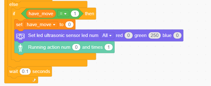

(1) Initialize the Tonybot’s posture, set the initial action, and initialize the ultrasonic RGB lights.
(2) Infinite loop:
Within the loop, different actions are performed based on the distance between the device and obstacles, with movements triggered by the angle. For example, when the distance is less than 30 cm, the ultrasonic RGB lights will turn green. Then, Servo 16 will execute an action lasting 500 ms, followed by a 0.5-second pause before the loop repeats.
4.2.9 Touch Control Project
  • Sensor Installation & Wiring
  • Project Introduction
Touch the capacitive pad on the touch sensor, and Tonybot will perform a bowing motion.
The touch sensor operates based on capacitive sensing technology, detecting the presence of human skin or metal through its gold-plated contact surface.
When no human or metal is in contact with the surface, the signal output is high. Upon contact with a human or metal, the signal output becomes low. Additionally, the sensor can detect contact through materials such as plastic or paper. The sensitivity of detection is influenced by the size of the contact surface and the thickness of the covering material.
For module installation and wiring, please refer to the section 1 in the same directory.

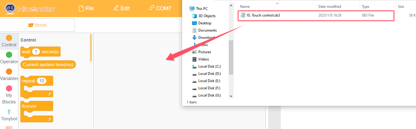

  • Program Download
Touch Control Program
(2) Drag the “Touch Control.sb3” file from the same folder as this document into WonderCode.

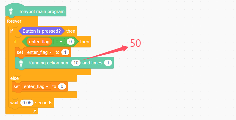

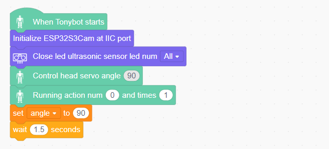

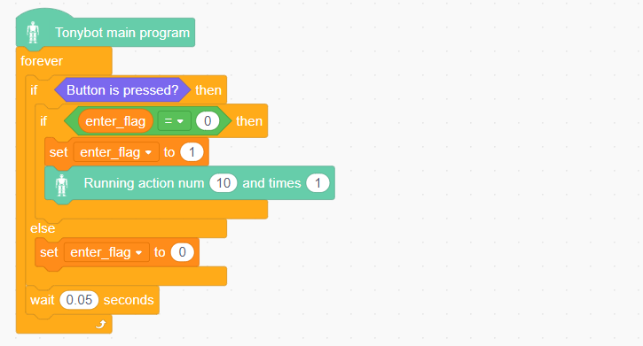

(1) Initialize the touch sensor interface and configure Tonybot’s initial posture.
(2) If the touch sensor is pressed and the enter_flag is 0, set enter_flag to 1 and execute action group 10 once. If the touch sensor is not pressed, set enter_flag to 0, wait for 0.05 seconds, and then continue repeating the process.

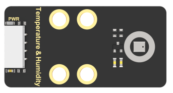

(1) Temperature and Humidity Sensor
This sensor detects the temperature and humidity of the environment and provides accurate readings.
The AHT10 module converts the air’s temperature and humidity into digital signals, which are then sent to the control board via I2C communication.
(2) LED Dot Matrix Module
The LED dot matrix module uses an 8x8 LED display, known for its high brightness, flicker-free display, and easy wiring. It can display numbers, text, patterns, and more. The module consists of two red 8x8 LED arrays and is controlled by the driver chip TM640B, enabling full control of the dot matrix screen.
(2) Locate the “02 temp_humidity_detection.sb3” file in the same directory as this document, then drag and drop it into WonderCode.
(3) In the menu bar, click “Connect”, then select the appropriate COM port (e.g., COM7 in this example). A “Connection Successful” message will appear once the connection is established.
(4) Click on the right to transfer the program to Tonybot. Wait for the confirmation message indicating a successful upload.

Once the temperature and humidity are detected, the dot matrix module will display them individually.

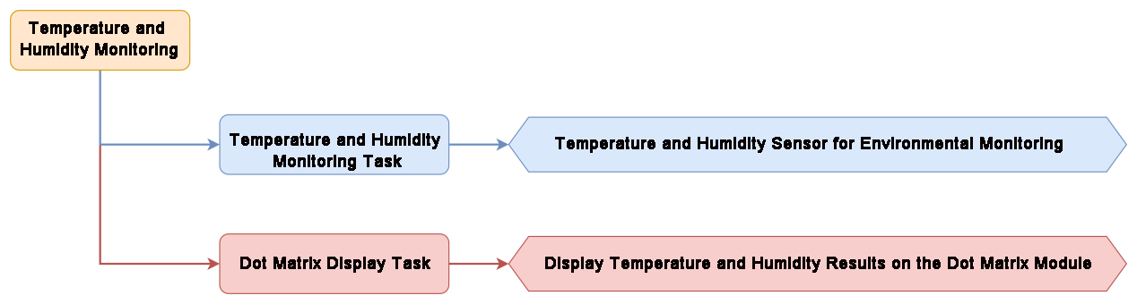

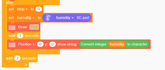

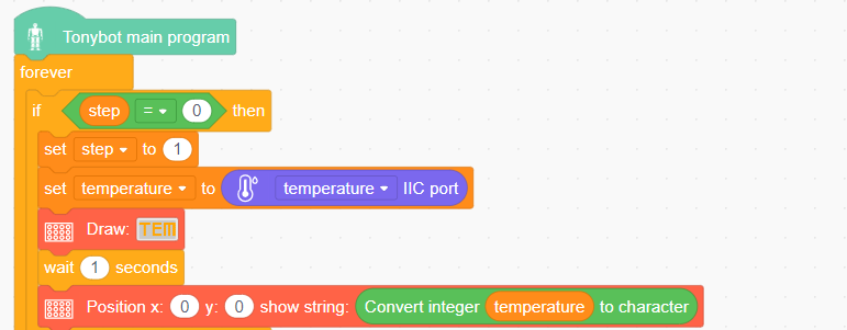

  • Program Analysis
(1) Initialize the dot matrix module interface and set Tonybot to its default posture.
(2) First, obtain the temperature reading from the temperature and humidity sensor and display it on the dot matrix module.
(3) Then, obtain the humidity reading from the sensor and display it on the dot matrix module.

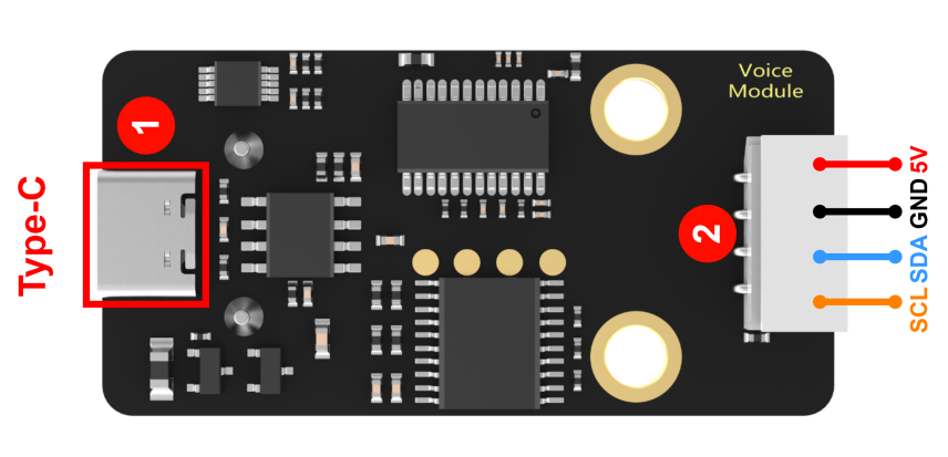

  • Interface Description
Type-C Interface: Used for powering the module and for firmware programming.
I2C Interface: Used for communication with host devices.
PIN Function Description
5V Power input
GND Power ground
SDA I2C data cable
SCL I2C clock cable

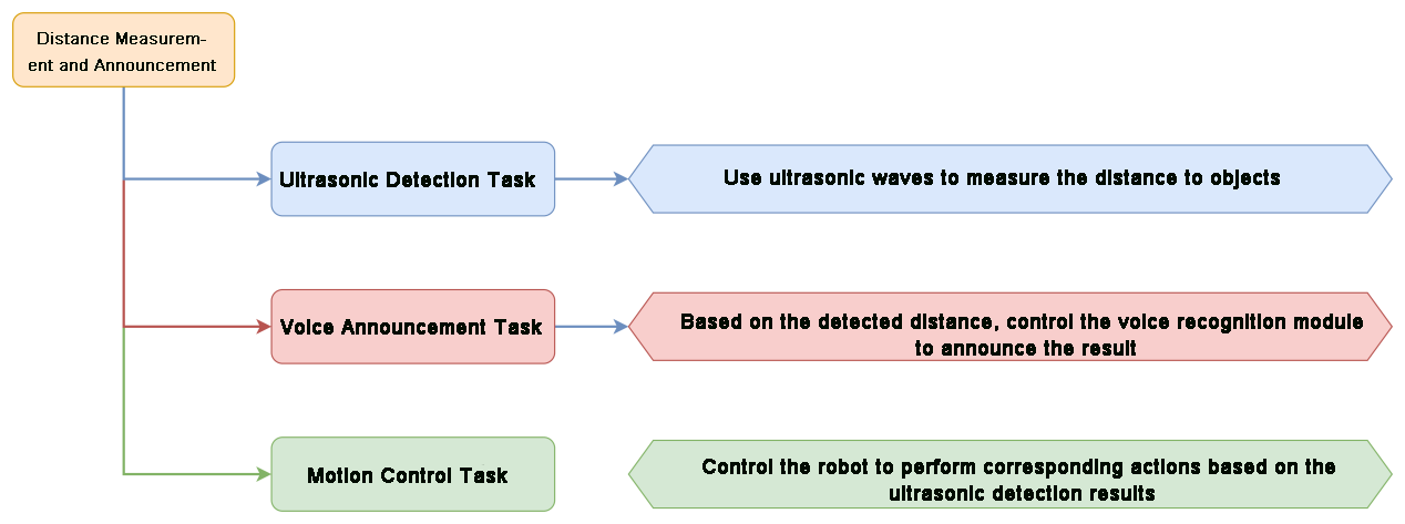

4.3.2 Distance Ranging & Announcement Project
This section utilizes the glowy ultrasonic module to measure the distance to an obstacle. Based on the detected distance, it controls the voice interaction module to announce messages and triggers the robot to perform specific action groups.

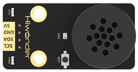

(2) Voice Interaction Module
The voice interaction module is built on embedded voice recognition technology. It consists of a voice recognition chip and supporting circuits, designed for seamless communication with the main control chip. This module enables both voice recognition and voice playback functionalities. Developers can easily integrate it into their products to enable voice interaction capabilities.
For instructions on module installation and wiring, please refer to assembly guide saved in the same directory.

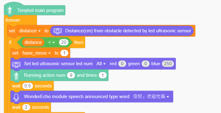

Distance Ranging & Announcement Program

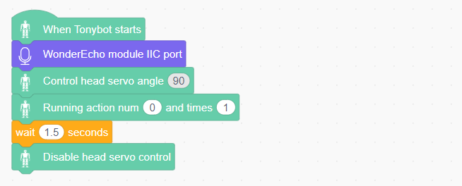

(1) Initialize the posture of the Tonybot and the voice module interface.

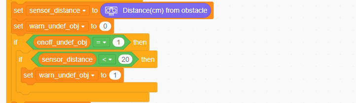

(2) Set the variable distance to the distance between the glowy ultrasonic sensor and the obstacle. If this distance is less than 20, set have_move to 1 and change the color of the two ultrasonic sensor lights to blue. Then, execute action group 9 once, wait 0.5 seconds, broadcast the phrase via the voice module, wait for 2 seconds, and repeat the cycle.
(3) If the distance variable is greater than 20, set have_home to 1, change the color of the ultrasonic sensor lights to green, execute action group 0 once, wait 0.1 seconds, and continue looping through the previous code block.

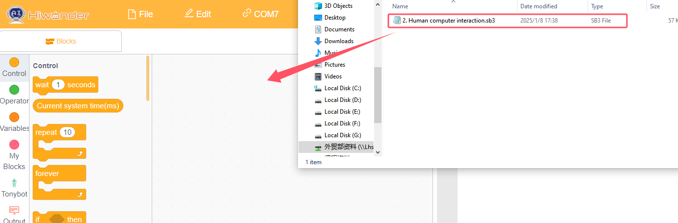

(2) Drag the “Human-Robot Interaction.sb3” file from the same folder as this document into WonderCode.

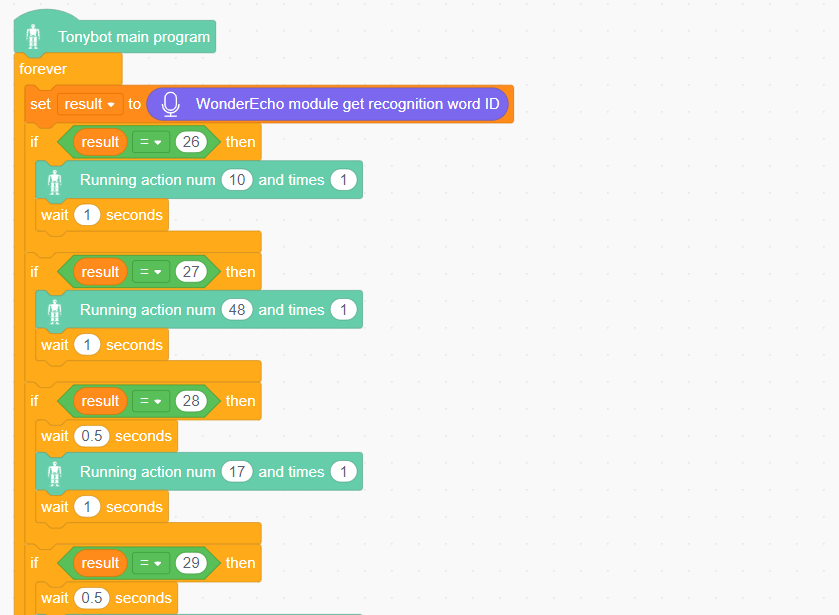

NO. Command Phrase Corresponding Action
36 HELLO Bow
37 INTRODUCE-YOURSELF Say hello
38 SHOW-A-SKIII Spread arms
41 DIVE-FORWARD Go forward
30 SHAKE-IT-OFF Control servo to rotate
  • Program Analysis
Human-Robot Interaction Program

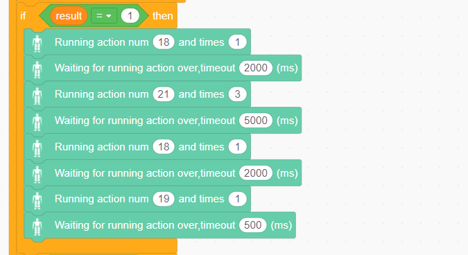

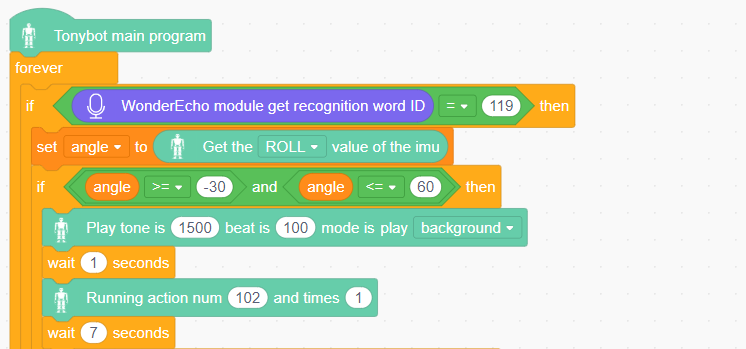

(1) Initialize the posture of the Tonybot, the voice module interface, and configure the flags for the buttons and actions.
(2) Initialize the result variable. When the value received from the voice module is 26 (which corresponds to “Hello”, and so on), execute action group 10 once. If the value is 27, execute action group 48 once. If the value is 28, execute action group 17 once.

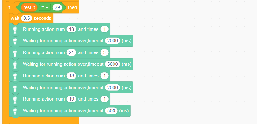

(3) When the value is 29, wait for one second, then execute action group 18 once, followed by action group 21 three times. Afterward, execute action group 18 once more, followed by action group 19 once. The timeout for this sequence is the total duration required for action group 18, which is 2000ms.

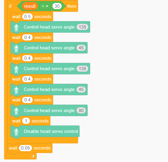

(4) If the value received is 30, Tonybot will trigger the servo motor to perform the corresponding action after a 0.5-second delay. Once the action is completed, the servo will be disabled, and the main program will restart the cycle.

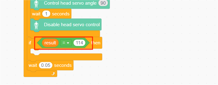

  • Function Extension

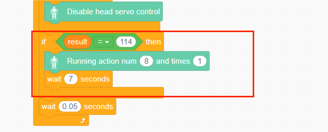

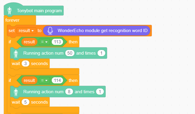

In the program, we can add new entries and perform new actions. For example, to add the “sit-up” action:
(1) Add the “if” statement block at the end of the program.
(2) Set the condition to result = 114.
(3) If the condition is true, execute Action Group 8 once, which corresponds to the “sit-up” action.
(2) Drag the “Voice Control.sb3” file from the same folder as this document into WonderCode.
(4) Hit the “Upload” button on the right to transfer the program to the Tonybot. Wait for the confirmation that the upload is complete.

  • Program Analysis
Voice Control Program

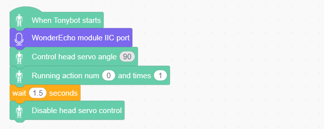

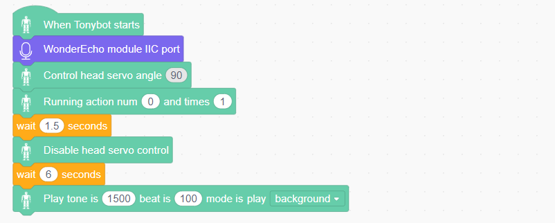

(1) Initialize Tonybot’s posture and voice module, and set the flags for the buttons and actions.
(2) Initialize the variable result. If the value received from the voice module is 113, execute action group 50 once. If the value is 114, execute action group 8 once.
(3) When the value received is 1, execute action group 18 once, followed by action group 21 three times. Then, execute action group 18 again once, and finally, execute action group 19 once. The total timeout duration should be set to 2000ms, which is the runtime of action group 18.

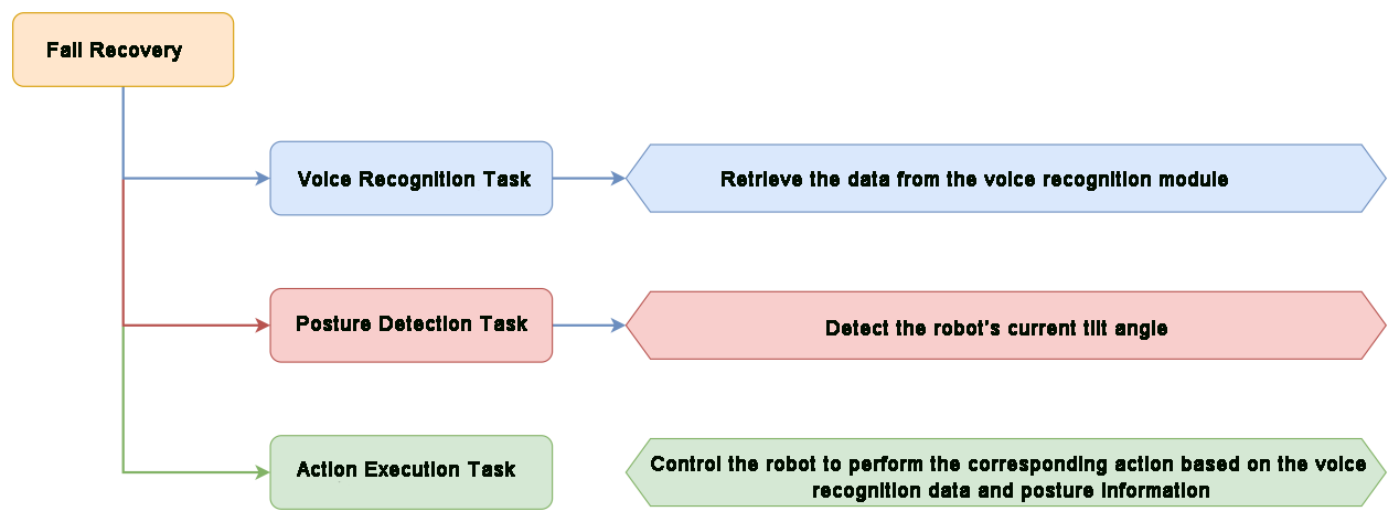

4.3.5 Fall Recovery Project
After the robot falls, say the command ‘fall recovery’ to make the robot stand up.
(2) Drag the “Fall Recovery.sb3” file from the same folder as this document into WonderCode.

  • Program Analysis
Fall Recovery Program
(1) Initialize Tonybot’s posture, voice module interface, and set the flags for buttons and actions. If the head servo fails and remains inactive for 6 seconds, the system will begin playing audio in the background.
(2) Initialize the variable angle with the value obtained from the IMU sensor. If the value is between -30 and 60, the system will play audio in the background. After waiting for one second, action group 102 will be executed once.
(3) If the value is between 120 and 140, the system will play audio in the background. After waiting for one second, action group 101 will be executed once. Finally, the program will wait for 0.05 seconds before looping back to continue the main program.

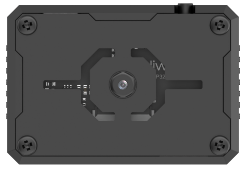

  • Overview of the ESP32-S3
The ESP32-S3 Vision Module is a compact camera module that can function as a standalone system. It captures images with its built-in camera, processes the data using the ESP32 microcontroller, and wirelessly transmits it via Wi-Fi. With support for various communication protocols and low-power features, this module is widely used in a range of IoT applications.
(1) Specification
Parameter Specification
Size 59*43*17.5
Power Supply Range 4.75~5.25V
Operating Temperature Ambient Temperature
Storage Environment Ambient Temperature and Pressure
SPI Flash Supports up to 16MB
RAM 512KB Internal + 16MB External PSRAM
Bluetooth Suppport Bluetooth 5 and Bluetooth Mesh
WiFi 802.11 b/g/n
Supported Interfaces UART、I2C
Serial Baud Rate Default 115200
Image Output Format JPEG (only supported by OV2640), BMP, Grayscale
Frequency Range 2412~2484MHz
Antenna Type Onboard PCB Antenna
Transmit Power
802.11b:20.5 dBm(@11Mbps)
802.11g:18 dBm(@54Mbps)
802.11n:17 dBm(@MCS7)
Receive Sensitivity
802.11b:-88.5 dBm(@11Mbps)
802.11g:-76.2 dBm(@54Mbps)
802.11n:-74.2dBm(@MCS7 HT20)
-71.2dBm(@MCS7 HT40)
Power Consumption (assuming peripherals are on)
Active (RF On): TX: 285-355mA @ 3.3V RX:95-97mA@3.3V
Deep-sleep:8uA@5V
Modem-sleep:47.6-107.6mA@5V 240MHZ
Light-sleep:240uA@5V
Security RSA/AES/SHA/HMAC/XTS-AES
Kind Reminder: The product specifications are theoretical values and are for reference only. Please rely on actual performance for precise details.

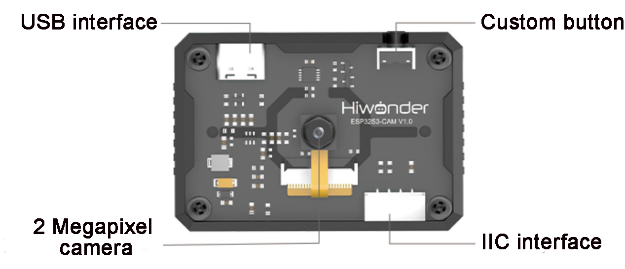

(2) Interface Description
Interface Name Interface Description
USB Serial Port Serial communication, firmware programming
Custom Button Allows customization of the button event in code
IIC Interface Secondary development interface, connects with the main controller

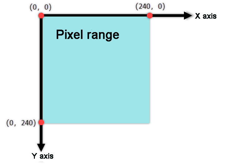

  • ESP32-S3 Image Coordinate Framework
Here are a few important points to note about the module’s image coordinate system:
(1) The origin is positioned at the center of the screen, not at the top-left corner.
(2) The Y-axis direction is opposite to that of a typical Cartesian coordinate system.

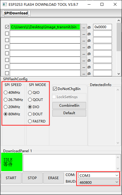

① Connect the ESP32-S3 vision module to your computer using a Type-C data cable.
② Extract the ZIP file “Image Transmission Firmware & Flash Tool/flash_download_tool_3.9.7”, then double-click “flash_download_tool_3.9.7.exe” to open the program.
③ In the opened window, configure it as shown below.
④ In the flashing interface, click to select the firmware file (”Image Transmission Firmware & Flash Tool/image_transmit.bin”), then configure the settings according to the image below.
⑤ Choose the correct port number (do not select COM1, as this will cause the flashing to fail).
⑥ Click “ERASE” to erase the existing firmware (this step is essential), then click “START” to begin the flashing process.
⑦ Wait for a completion message to appear.
⑧ Once flashing is complete, disconnect the Type-C data cable and restart the device.

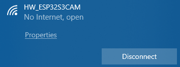

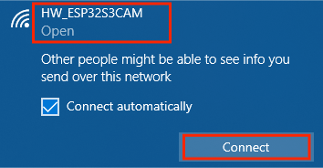

  • Device Connection

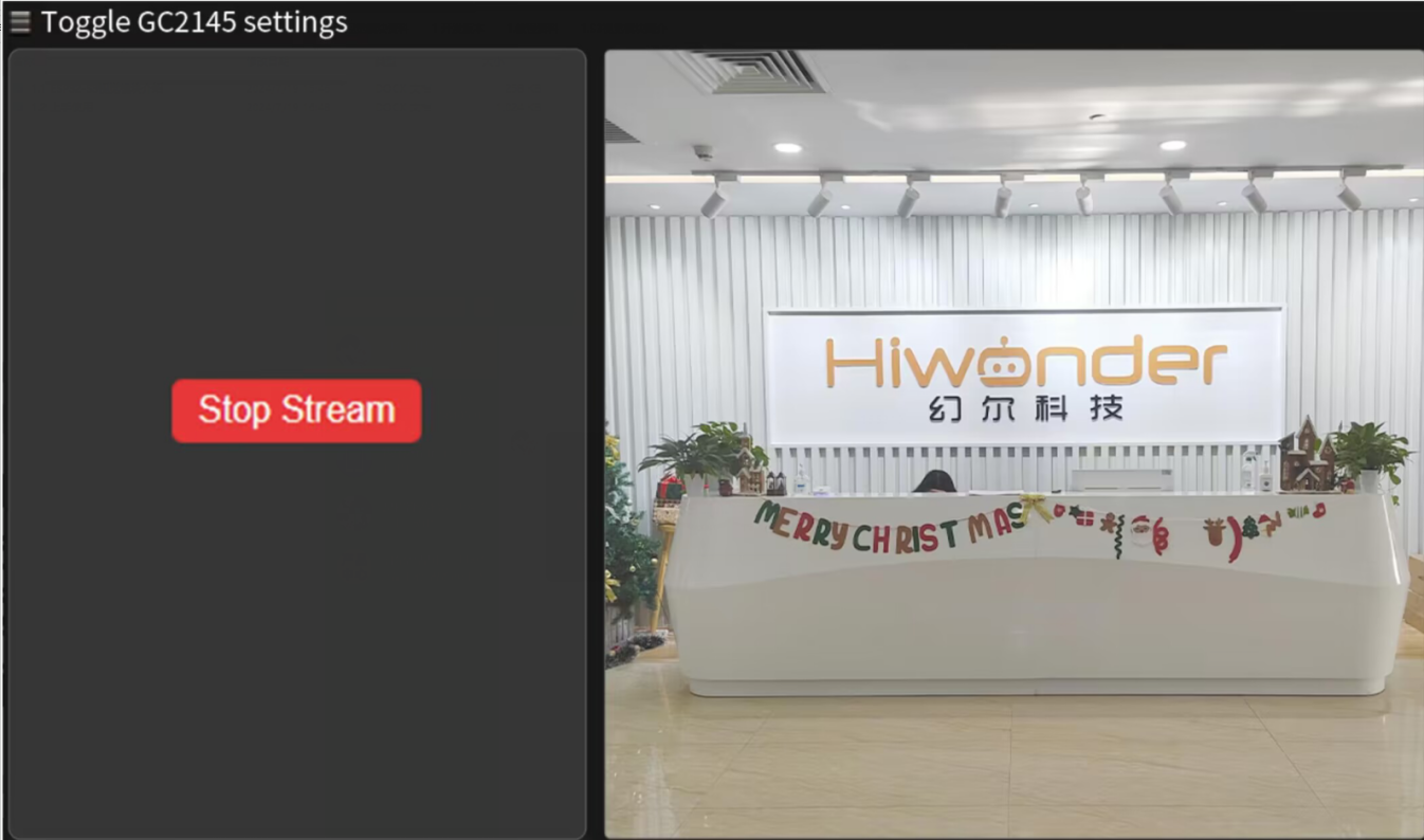

(1) Power on the device (ensure the vision module has been installed on the robot according to the instructions in “6.4.1 Overview and Installation of ESP32S3 Vision Module” before powering it on).

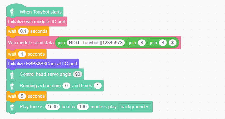

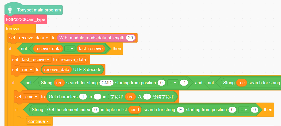

(2) Locate and connect to the hotspot generated by the module: HW_ESP32S3CAM.
(3) Image Transmission Implementation
Open a browser (this works on both mobile and PC browsers; we’ll use a PC as an example) and enter “192.168.5.1” in the address bar, then press Enter. On the resulting page, click to access the camera’s live transmission interface.

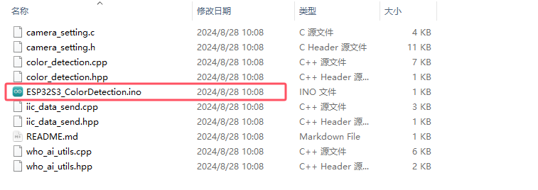

(1) ESP32-S3 Vision Module Program Download
① Connect the ESP32-S3 to your computer using a Type-C data cable.

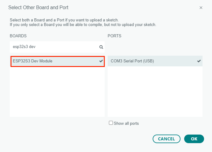

② Open the program file “ESP32S3 Color Recognition Example/ ESP32S3_ColorDetection/ ESP32S3_ColorDetection.ino” located in the same directory as this document.
③ Select the “ESP32S3 Dev Module” as the target board.

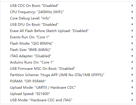

④ In the “Tools” menu, configure the ESP32-S3 development board settings as shown in the image below. (This configuration is only required for the first use. It does not need to be repeated for subsequent uses.)
⑤ Click to transfer the code to the ESP32-S3 and wait for the flashing process to complete.

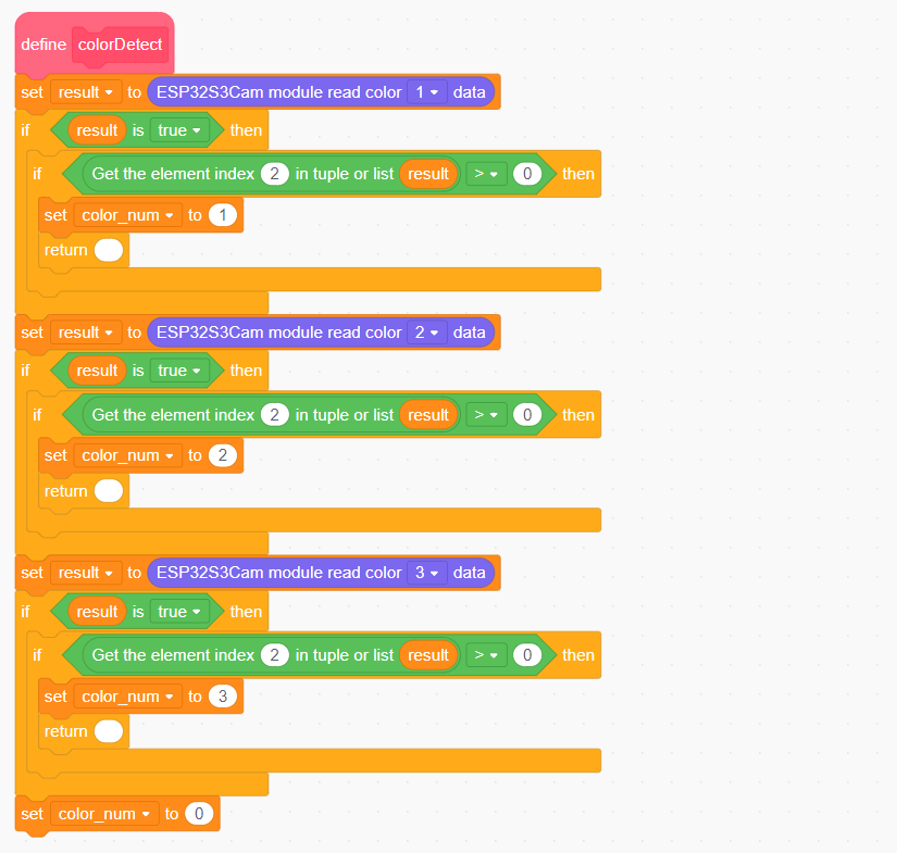

  • Program Analysis

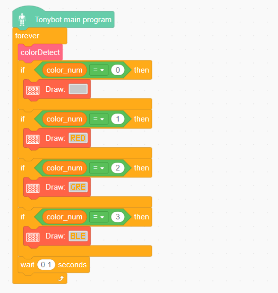

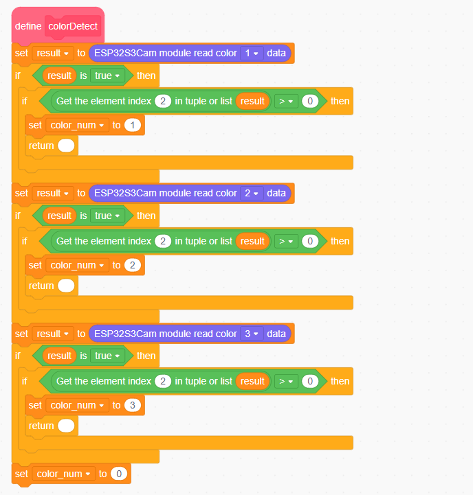

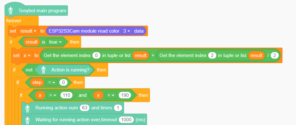

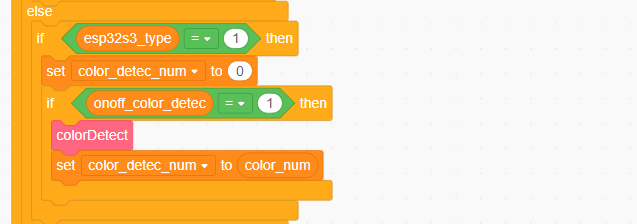

(1) Initialize the dot matrix interface, ESP32-S3 vision module, ultrasonic module, and servos.
(2) In the main program, repeatedly call the custom colorDetect function to obtain color recognition results. Use the color_num variable to identify the recognized color ID and display the corresponding color name in English on the dot matrix screen.
(3) Within the colorDetect function, retrieve data for color IDs 1 through 3. When the vision module returns data for a color, check if the second element (representing the width of the detected color) is greater than 0. If so, the color is considered detected, and the color_num variable is updated with the corresponding color ID.

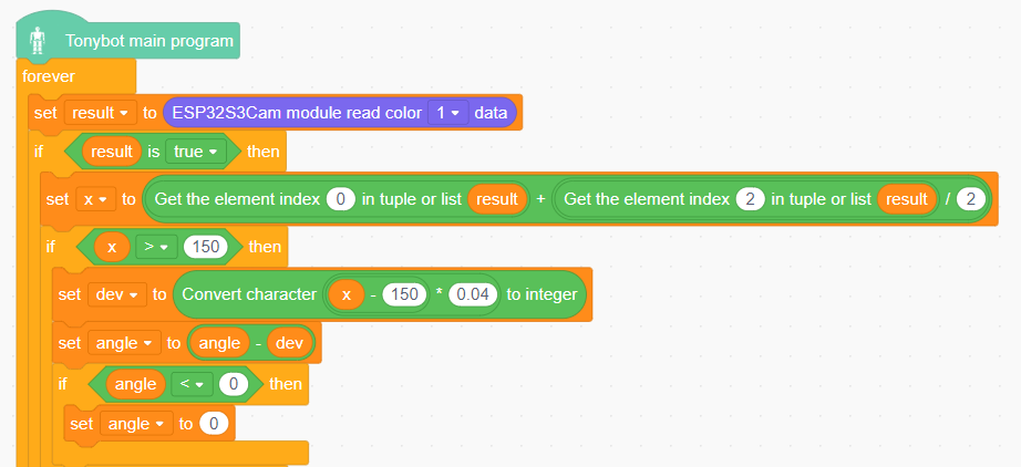

4.4.4 Color Tracking Project
Tonybot, equipped with the ESP32-S3 vision module, tracks a red ball while the robot’s head follows the ball’s movement direction.
  • Module Introduction
To get the detailed installation guide, please refer to ‘4.4.1 Introduction to ESP32S3 Vision Module’.
  • Program Download
② Open the program file “03 ESP32S3 Color Recognition Example/ ESP32S3_ColorDetection/ ESP32S3_ColorDetection.ino” located in the same directory as this document.
⑥ After the flashing is complete, disconnect the Type-C data cable.
(2) Program Download
Color Tracking Scratch Example.sb3
① Locate and open the program file “03 Color Tracking Scratch Program.sb3” from the same directory as this document.
② Power on the device and connect it to your computer using a Type-C data cable.
③ Click the “Connect” button and select the appropriate port.
The port number may vary depending on your computer’s configuration. For example, in this section, the port used is “COM4”. However, avoid selecting “COM1”, as it is typically reserved for system communication.
④ Once the device successfully pairs with the software, a confirmation message will appear, indicating that the connection was successful.
  • Achieved Effect
When we move the red ball in front of the ESP32-S3 vision module camera, the robot’s head will follow the ball’s movement.
  • Program Analysis

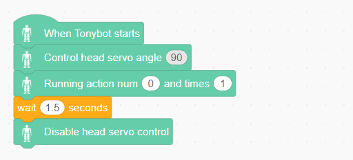

(1) Initialize the ESP32-S3 vision module, disable the RGB lights on the ultrasonic module (to avoid misdetection), and set the head servo to 90° (facing forward). Then, execute the standing motion sequence to make the robot stand.

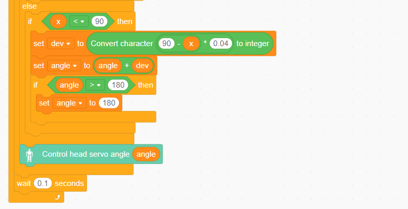

(2) In the main program, retrieve the data for color ID 1 and set x as the x-coordinate of the color region’s center. If x > 150, this indicates that the color block is positioned toward the right of the vision module’s field of view. In this case, adjust the servo to rotate right, ensuring the color block remains centered in the camera’s view.
(3) If x < 90, this means the color block is positioned toward the left. Adjust the servo to rotate left, again ensuring the block stays centered. Finally, if the angle exceeds 180, set it to 180 to prevent the servo from rotating beyond its limit.

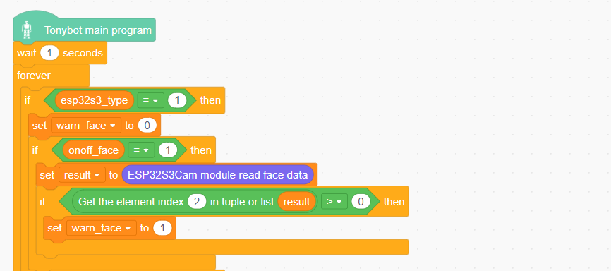

4.4.5 Face Detection Project
This section demonstrates how the ESP32-S3 vision module detects faces. When a face is recognized, the robot performs a waving gesture to greet the person.
To get the detailed installation guide, please refer to ‘4.4.1 Overview and Installation of ESP32S3 Vision Module’.
  • Program Download
ESP32S3 Face Detection Example

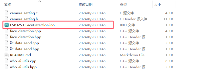

② Open the program file “ESP32S3 Face Detection Example/ ESP32S3_FaceDetection/ ESP32S3_FaceDetection.ino” located in the same directory as this document.
Face Detection Scratch Example.sb3
① Locate and open the program file “03 Face Detection Scratch Program.sb3” from the same directory as this document.
The port number may vary depending on your computer’s configuration. For example, in this section, the port used is “COM4”. However, avoid selecting “COM1”. as it is typically reserved for system communication.
  • Achieved Effect
When a face is detected, the robot will greet the person by performing a waving gesture.
  • Program Analysis
(1) Initialize the ESP32-S3 vision module, turn off the ultrasonic RGB lights (to prevent false detections), and set the robot to a standing position.
(2) In the main program, retrieve the face detection data from the vision module. When a face is detected, execute action group 9 (the waving gesture).

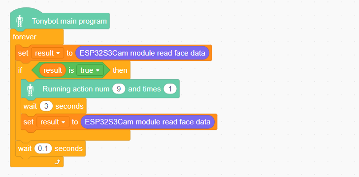

  • Program Analysis
(1) Initialize the ESP32-S3 vision module, disable the ultrasonic RGB lights (to prevent false detection), and execute the standing action to make the robot upright.
(2) First, retrieve the data for color ID 1, and set the variable “x” to the x-coordinate of the detected color’s center. If no action group is currently running, and if the x-coordinate is between 110 and 190, it indicates that the robot is on the line. In this case, execute action group 63 to make the robot move forward.
(3) If the x-coordinate is between 0 and 110, it means the line is to the robot’s left. In this case, run action group 65 twice to make the robot turn left, and set the variable “step” to 1. The “step” variable controls the robot’s movements: when set to 0, the robot moves forward; when set to 1, it turns left; when set to 2, it turns right.
(4) If the line is detected to be on the robot’s right (x > 190), execute action group 66 twice to make the robot turn right, and set “step” to 2.
(5) When step = 1, if the line is still on the left, continue running action group 65 once to make the robot turn left. If the line is no longer on the left, execute action group 63 once to move the robot forward.
(6) When step = 2, if the line is still on the right, continue running action group 66 once to make the robot turn right. If the line is no longer on the right, execute action group 63 once to move the robot forward.

This section provides a step-by-step guide for downloading the ESP32-S3 vision module program, using the face detection program as an example. The process for downloading the color recognition program is identical to that of the face detection program.
(1) Program Download
② Open the program file “02 Face Detection Porgram/FaceDetection/FaceDetection.ino” located in the same directory as this document.
Tonybot IOT Example.sb3
① Connect the ESP32-S3 to the computer using a Type-C data cable.
② Open the “02 Tonybot IOT Example.sb3” program file, which is located in the same directory as this document.
③ Power on the device and connect it to the computer via the Type-C data cable.
④ Click the “Connect” button and select the correct port.
The port number may vary depending on the computer. For example, the port number in this section is “COM4”. Avoid using “COM1”, as it is typically reserved for system communication.
⑤ Once the device is successfully paired with the software, a connection success message will appear.

Before using the app, make sure that Wi-Fi and location services are enabled in your phone’s settings. This section demonstrates using the Android version of the app, but the steps are the same for the iOS version.
(1) Power on the Tonybot, then open the “IoT Control” app on your phone.
(2) Tap in the top-right corner, select “IOT_Tonybot” from the Wi-Fi list, and enter the password “12345678” to connect.
(3) Once connected, the Wi-Fi icon in the top-right corner will become solid.
To get the detailed installation guide, please refer to 4.5.1 WiFi Module Installation & Wiring.

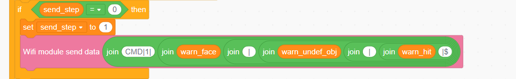

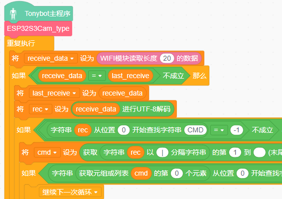

(1) Initialize the Wi-Fi module interface and set the Wi-Fi module’s name. Then, initialize the ESP32-S3 vision module, set the head servo angle to 90°, and execute the standing action sequence. Once initialization is complete, the buzzer will emit a sound as a reminder.
(2) Retrieve the functionality of the ESP32-S3 vision module. First, read the color recognition results. If the x-coordinate of the detected color region is not 0 and the x-coordinate is equal to its width, set esp32s3_type to 1 for face detection mode. If these conditions are not met, set esp32s3_type to 2 for color recognition mode.
(3) In the main program, if the vision module is set to face detection mode, check the onoff_face flag to determine if the face detection alert function is enabled. If enabled, obtain the face detection data from the vision module. When a face is detected, set warn_face to 1.
(4) In another section of the main program, send the face detection alert, unknown object collision warning, and unknown object detection alert to the mobile app.

  • Program Analysis
(1) Initialize the Wi-Fi module interface and configure the Wi-Fi module’s name. Then, initialize the ESP32-S3 vision module, set the head servo angle to 90°, and execute the standing action group. After the initialization is complete, the buzzer will sound to signal the completion.
(2) Retrieve the ESP32-S3 vision module’s functionality. First, read the color recognition result. If the x-coordinate of the detected color region is not 0 and the x-coordinate matches the width of the detected color region, set esp32s3_type to 1 (face recognition mode). If not, set esp32s3_type to 2 (color recognition mode).
(3) When the unknown object collision detection feature is enabled (onoff_hit = 1), retrieve the IMU’s roll angle data. If the roll angle is less than 70° or greater than 110°, set the warn_hit flag to 1.
(4) In another main program, send the face detection warning, unknown object collision warning, and unknown object detection warning to the mobile app.

(1) Initialize the Wi-Fi module interface and configure the Wi-Fi module name. Next, initialize the ESP32-S3 vision module, set the head servo angle to 90°, and execute the standing motion sequence. Once initialization is complete, the buzzer will sound as an indicator.
(2) Retrieve the functionality of the ESP32-S3 vision module. Start by reading the results of color recognition. If the x-coordinate of the detected color area is not 0 and the x-coordinate equals the width of the detected area, set esp32s3_type to 1 for face recognition mode. Otherwise, set esp32s3_type to 2 for color recognition mode.
(3) Measure the obstacle distance using the ultrasonic sensor. When the undefined object warning is enabled (onoff_undef_obj = 1), evaluate the obstacle distance. If it is less than 20 cm, set the warn_undef_obj flag to 1.
(4) In a separate main program, send the face detection alert, undefined object collision warning, and undefined object alert to the mobile app.
4.5.7 Color Detection Project
This section allows Tonybot, equipped with the ESP32-S3 vision module, to detect red, green, and blue colors and display the corresponding colors on the mobile phone.
To get the detailed installation guide, please refer to 4.5.1 Module Installation & Wiring
  • S3 Vision Module Program Download
For details on downloading the vision module and Tonybot program, please refer to 4.5.2 Program Download.
  • Achieved Effect
When Tonybot detects red, green, or blue, it sends the data to the app, which then displays the recognized color.
  • Program Analysis
(1) Initialize the Wi-Fi module interface and configure the Wi-Fi module name. Then, initialize the ESP32-S3 vision module, set the head servo angle to 90°, and execute the standing motion sequence. Once initialization is complete, the buzzer will sound to indicate the process is finished.
(2) Retrieve the functionality of the ESP32-S3 vision module and read the color recognition results. If the x-coordinate of the detected color area is non-zero and the x-coordinate equals the width of the area, set esp32s3_type to 1 to enter face recognition mode. Otherwise, set esp32s3_type to 2 to enter color recognition mode.
(3) Check if the vision module is set to color recognition mode. When the onoff_color_detec flag is 1, remote color detection is enabled. Then, call the colorDetect function to retrieve the recognition result, which will be stored in the color_detec_num variable.
(4) In the color recognition function, retrieve the vision module’s recognition result. If the second element of the color data is greater than 0, it indicates the detected color area has a width greater than 0, meaning a color has been recognized. Set the color_num variable to the recognized color ID.
(5) Finally, send the recognized color ID to the app.

4.5.9 RGB Light Control
This section allows you to control the RGB light color of Tonybot’s ultrasonic sensor through the app.
For details on downloading the vision module and Tonybot program, please refer to Section 4.5.2 Program Download.
  • Achieved Effect
Tonybot will adjust the RGB light color of the ultrasonic sensor according to the commands sent from the app.
  • Program Analysis
(1) Initialize the Wi-Fi module interface and configure the Wi-Fi module name. Then, initialize the ESP32-S3 vision module, set the head servo angle to 90°, and execute the standing motion. Once initialization is complete, the buzzer will sound to indicate the process has finished.
(2) Retrieve the functionality of the ESP32-S3 vision module and read the color recognition results. If the x-coordinate of the detected color area is non-zero and equals the width of the area, set esp32s3_type to 1 for face recognition mode. Otherwise, set esp32s3_type to 2 for color recognition mode.
(3) Use the Wi-Fi module to retrieve the data sent from the mobile app and store the parsed data in the cmd string.
(4) Using the first element of cmd, identify the command sent from the mobile app. When the command number is 4, it indicates a remote control command for the RGB light. We will then use the parsed data to control the ultrasonic RGB light and display the corresponding color.

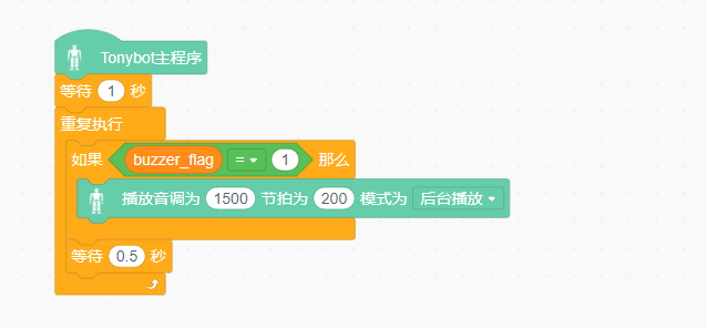

4.5.10 Remote Warning
In this section, you will learn how to use the app to control Tonybot’s buzzer and trigger sound.
Tonybot is equipped with a 5V buzzer. By adjusting the frequency of the PWM signal output, the buzzer can produce sounds of different pitches.
  • Achieved Effect
After enabling the remote warning feature, Tonybot’s buzzer will sound.
  • Program Analysis
(1) Initialize the Wi-Fi module interface and set the name for the Wi-Fi module. Then, initialize the ESP32S3 vision module, set the head servo angle to 90°, and run the standing motion group. After the initialization, the buzzer will sound to provide a notification.
(2) Retrieve the functions of the ESP32S3 vision module. First, read the results of color recognition. When the x-coordinate of the detected color region is not 0 and the x-coordinate of the detected color region equals its width, set the esp32s3_type to 1, indicating facial recognition mode. Otherwise, set esp32s3_type to 2, indicating color recognition mode.
(3) First, obtain the obstacle distance from the ultrasonic sensor and store it in the sensor_distance variable.
(4) Then, retrieve the data sent from the mobile app via the Wi-Fi module, and store the parsed data in the cmd string.

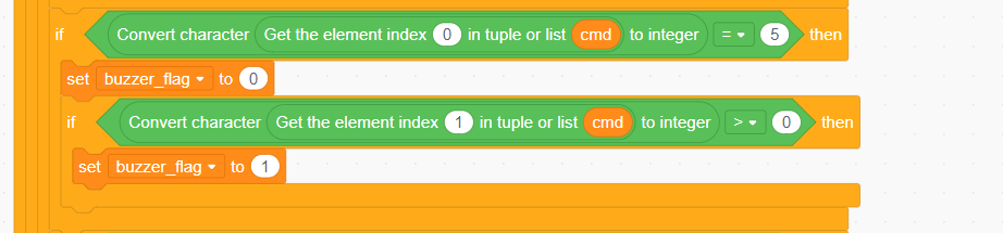

(5) When the first element of the parsed data is 5, set buzzer_flag to 0 to turn off the buzzer alarm. When the second element of the parsed data is greater than 0, indicating that the remote alert feature is enabled, set the buzzer_flag variable to 1.
(6) Finally, in another main program, run the buzzer alarm function. When the buzzer_flag variable is set to 1, control the buzzer to sound the alarm.

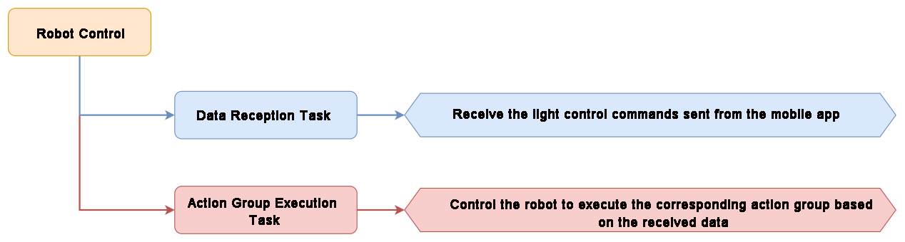

4.5.11 Robot Control
In this section, you’ll use the mobile app to control Tonybot and make it perform a series of actions.

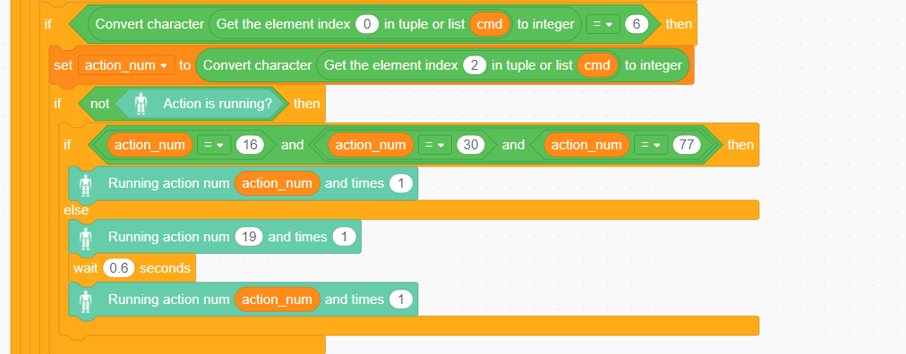

  • Program Analysis
(1) First, initialize the Wi-Fi module interface and set its name. Then, initialize the ESP32S3 vision module, adjust the head servo angle to 90°, and run the standing action group. Once the initialization is complete, the buzzer will sound as a reminder.
(2) Access the functions of the ESP32S3 vision module and read the color recognition results. When the x-coordinate of the color region is not 0 and equals the width of the color region, set esp32s3_type to 1, indicating facial recognition mode. Otherwise, set esp32s3_type to 2, indicating color recognition mode.
(3) Retrieve data from the mobile app via the Wi-Fi module and store the parsed data in the cmd string.
(4) When the first element of the parsed data is 6, it indicates a remote control command. At this point, check if the robot is currently running an action group. If not, execute the designated action group. Then, determine if the action group requires a squat position. If it does, execute it directly. If not, first run action group 19 (Quick Attention), and then execute the target action group.
