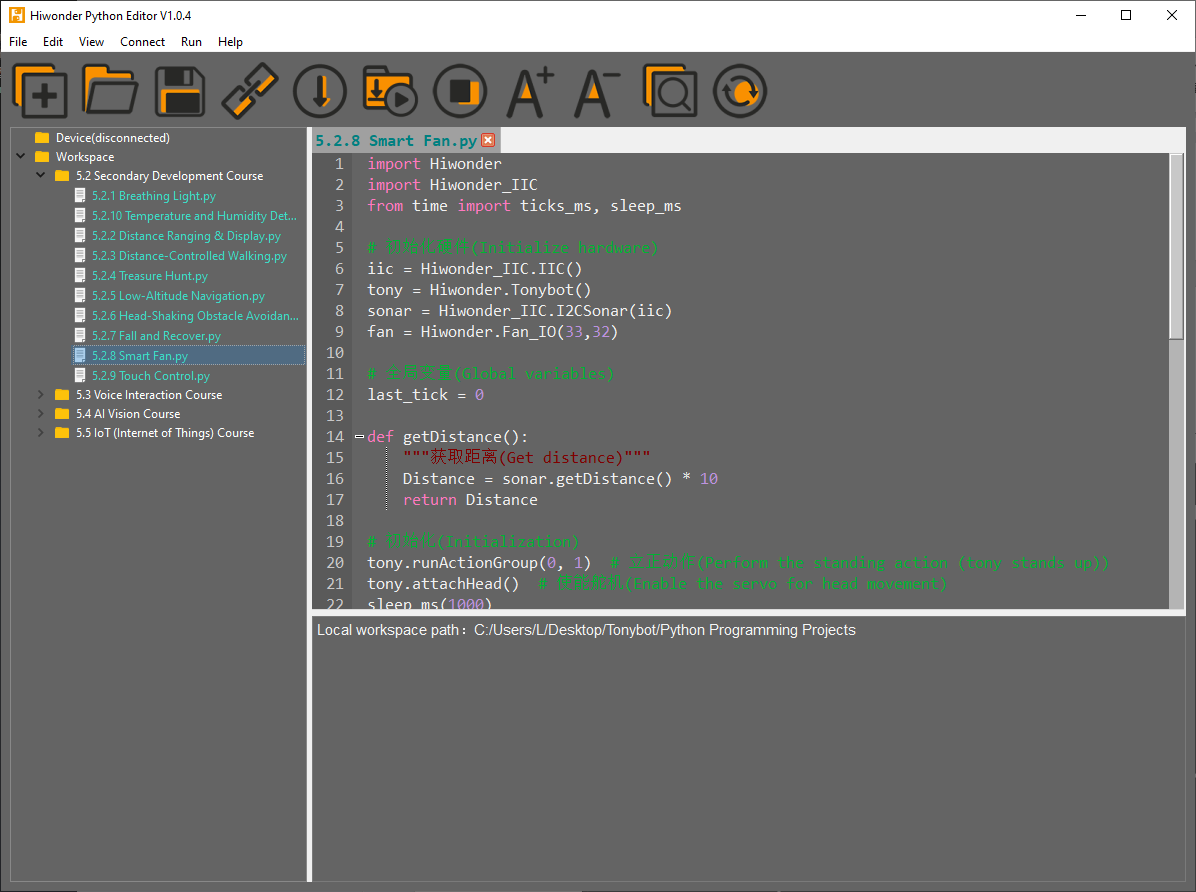

5.1 Introduction to Hiwonder Python Editor
In this section, we will learn about the connection methods and specific functions of the Hiwonder Python Editor.
If the editor fails to open, please change the editor’s name to English only, such as ‘Hiwonder’.
5.1.1 Function Introduction

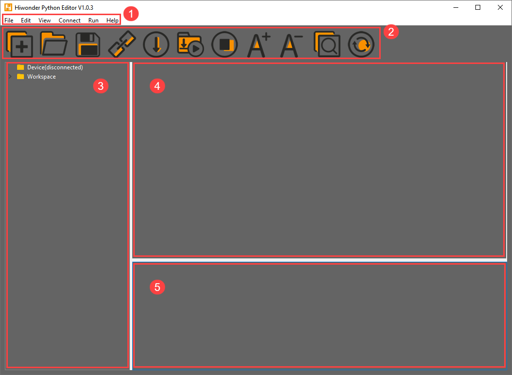

The editor interface is divided into 5 sections as below:
Each area has its corresponding functions, as shown in the table below:
| No. | Area Name | Function Description |
| 1 | Menu Bar | Contains File, Edit, View, Connect, Run, and Help |
| 2 | Toolbar | Includes some commonly used shortcut keys that have the same effect as certain keys in the menu bar |
| 3 | File List | Divided into multiple project files in the device and locally, allowing you to view the contents of project files (folders, source code, etc.) |
| 4 | Code Editing Area | Allows you to view and write code |
| 5 | Terminal | Displays message logs and debugging information. When no device is connected, only the message logs can be viewed |

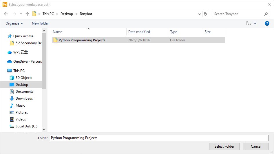

(1) When importing a local project for the first time, left-click on ‘Local Projects’ to open the file selection list. (For subsequent imports, right-click on ‘Local Projects’ and select ‘Switch Project Path’).
(2) Select Appendix/Program Collection/Python Project Programs and click the ‘Select Folder’ button.
(3) The files in the folder will be automatically added to the local projects, and you will be able to see them under ‘Local Projects’.

Here, we can double-click on the program file in the file list to view the detailed code. For example, let’s take Smart_fan.py:
Similarly, after downloading the program file to the ESP32 core board, you can double-click it under the ‘Devices’ list to view the program file.

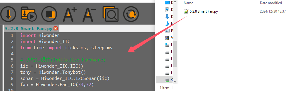

Downloading a program is an interactive action between the editor and the device. Using ‘smart_fan.py’ as an example:
(1) After selecting the ‘smart_fan.py’ file in the ‘Local Projects’ tab, click
in the toolbar or right-click the file and choose ‘Download and Run’
(2) You can view the download progress and completion status in the terminal interface. Since ‘Download and Run’ was selected in the previous step, you can also observe the program’s running effect.

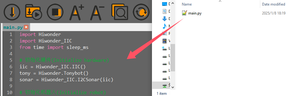

(3) Once the download is complete, the program will appear in the file list under the ‘Devices’ tab.
(4) Finally, delete the original ‘main.py’ file of Tonybot and rename the downloaded ‘smart_fan.py’ to ‘main.py.’

① Besides this download method, you can also rename the file you want to download to ‘main.py’ before proceeding with the download.
② The ‘Download and Run’ function first resets the device (restarts) and then downloads and runs the program, which helps enhance the stability of the program execution.

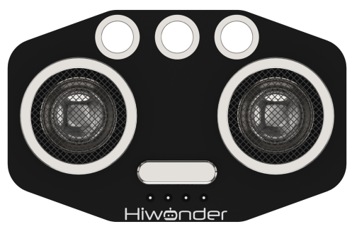

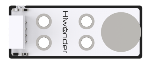

Introduction to Glowy Ultrasonic Sensor
This is a glowy ultrasonic distance sensor module that communicates via I2C. It reads the distance measured by the ultrasonic sensor using the I2C protocol.
When measuring distance, the module sends out 8 pulses of 40kHz square waves and checks for any returning signals. If a signal is detected, the module outputs a high-level signal, and the duration of this high signal corresponds to the time taken for the ultrasonic waves to travel to the target and back.
The ultrasonic sensor is pre-installed on the robot when it leaves the factory.

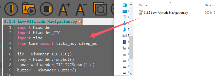

Program Download

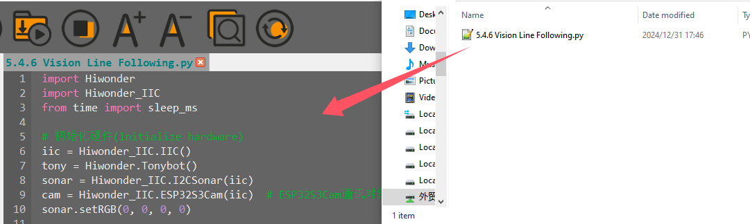

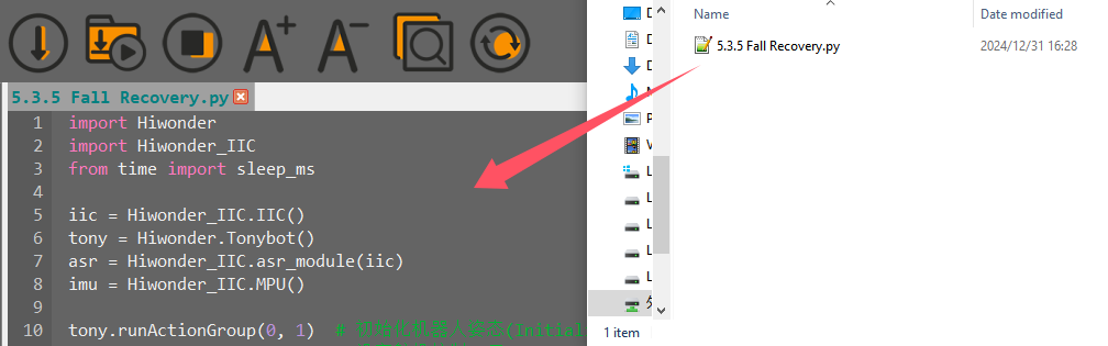

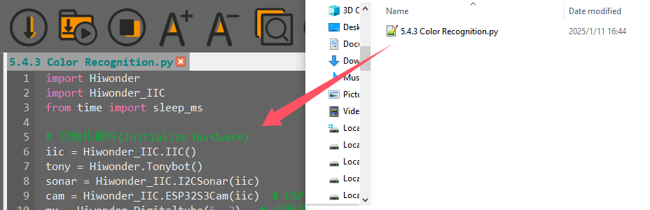

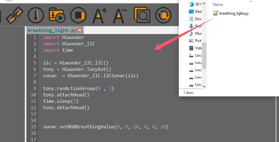

(1) Launch the “Hiwonder Python Editor” software
(2) Drag the “breathing_light.py” file (located in the same folder as this document) into the editor window.
(3) Click the connection button
in the menu bar. Once connected, the icon
will turn green, indicating a successful connection.

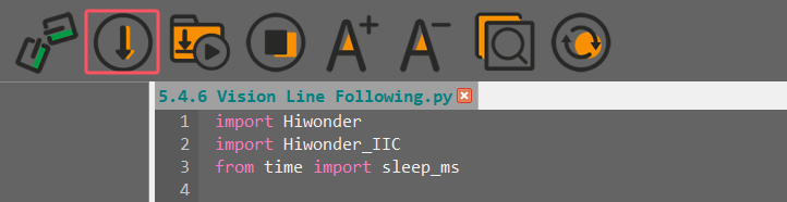

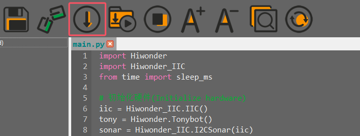

(4) After the connection is established, click the download button
in the menu bar to upload the program to Tonybot. Wait for the completion message to appear in the info box below.

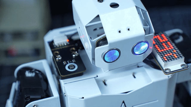

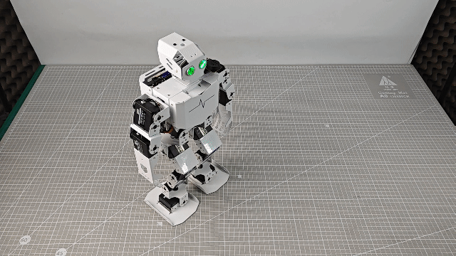

You’ll see the RGB light on the ultrasonic module glowing blue, with a blink every 2 seconds.

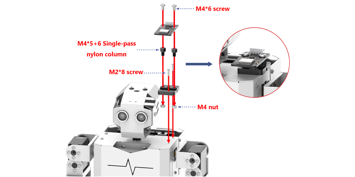

Assembly

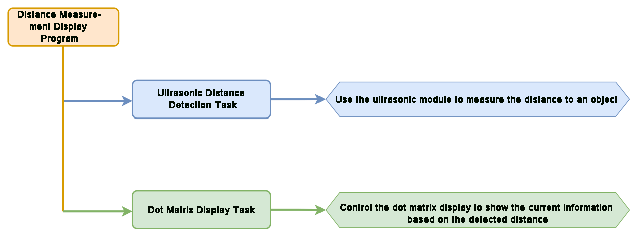

This section utilizes the ultrasonic module to measure the distance to an obstacle. The measured distance is displayed on the LED dot matrix, and the RGB light color of the ultrasonic module is adjusted accordingly.
Program Implementation Process

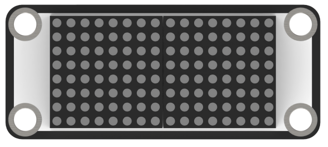

(2) LED Dot Matrix Display
The LED dot matrix module utilizes an LED display screen that offers high brightness, flicker-free performance, and easy wiring. It is capable of displaying numbers, text, patterns, and other content. The module consists of two red 8x8 LED matrices and is controlled by the TM640B driver chip, which enables efficient control of the dot matrix screen.
For a detailed introduction to the installation and assembly process, please refer to the tutorial video.

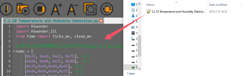

(2) Drag the “distance_display.py” file (located in the same folder as this document) into the editor window.

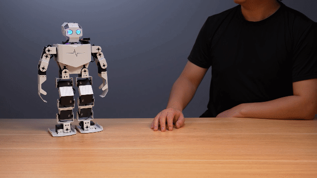

Slowly bring the object closer to the glowy ultrasonic sensor. As the distance decreases, the ultrasonic light will shift towards red, and as the distance increases, it will become greener. The LED dot matrix display will update in real-time to show the measured distance.

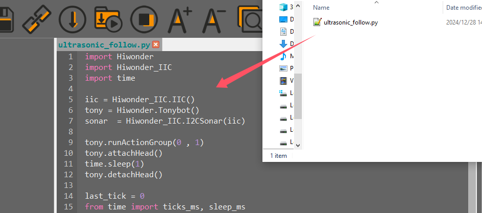

(2) Drag the “ultrasonic_follow.py” file (located in the same folder as this document) into the editor window.

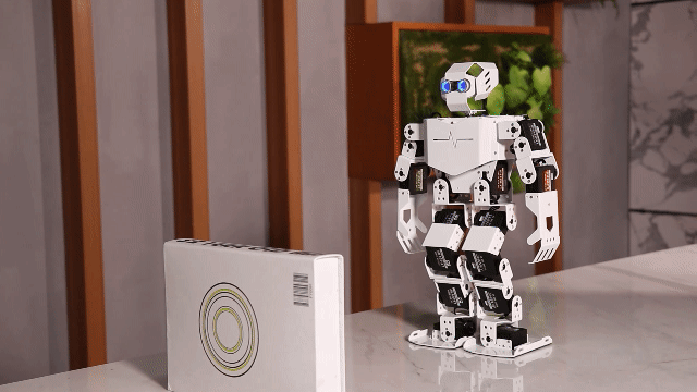

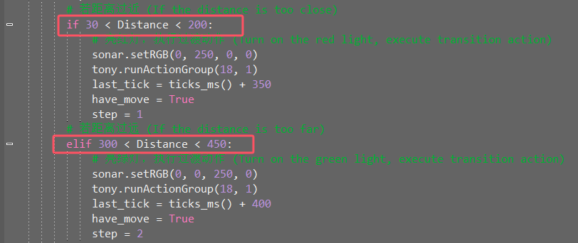

Please avoid using the ultrasonic sensor to continuously detect objects that are too close.
Place a cardboard box in front of the sensor. If the distance is between 28-40 cm, the robot will move forward. If the distance is between 3-18 cm, the robot will move backward.

(1) You can modify the ultrasonic distance range in the program by editing the code in the designated section, as shown in the image below.
(2) The program checks if the distance is between 30 mm and 180 mm, in which case the robot will move backward. If the distance is between 300 mm and 400 mm, the robot will move forward. To adjust the ultrasonic distance range, simply update the comparison values in the code, for example:
(3) After making the modifications, refer to section “Program Download” to run the updated program.

(1) Ultrasonic Sensor
This is a light-emitting ultrasonic distance sensor module that communicates via I2C. It reads the distance measured by the ultrasonic sensor using the I2C protocol.
The LED dot matrix display is a high-brightness display unit that offers flicker-free visuals and easy wiring. It is capable of displaying numbers, text, images, and more. The module is made up of two 8x8 red LED panels and is controlled by the TM640B driver chip, which manages the dot matrix screen’s operation.
For installation and wiring details, please refer to the section 1.
Program Download

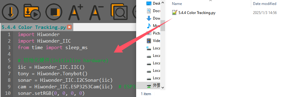

(2) Drag the “find_target.py” file (located in the same folder as this document) into the editor window.

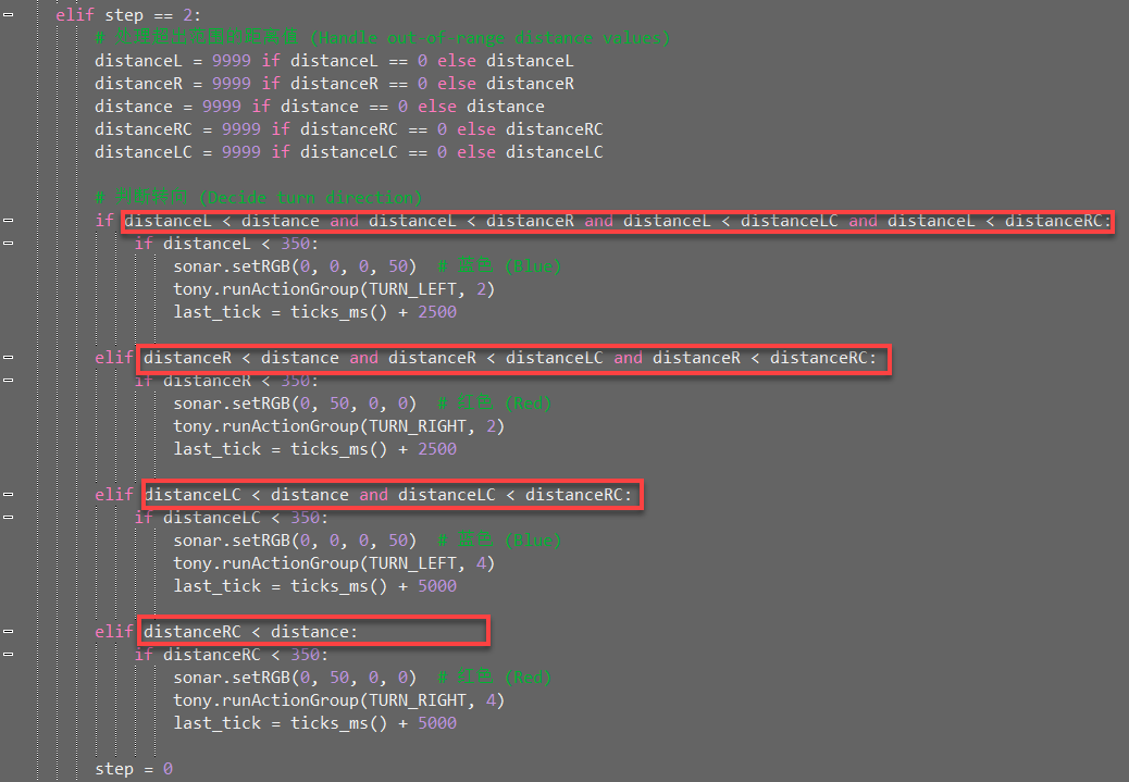

Third execution (case 2):
The program first standardizes the distance values. If the box is not detected within the valid range (sensor returns 0), the corresponding direction is treated as out of range, and the distance is set to a default high value of 9999.
It then performs logic evaluation across all directions to identify the one with the shortest valid distance. If the closest direction is on the left, the ultrasonic RGB module lights up blue; if on the right, it lights up red. The robot then turns left or right accordingly to align with the selected direction.
If the front-facing distance is still shorter than other directions, even if it exceeds the “moderate” range, the robot will not perform a turn. In this case, the ultrasonic RGB module remains green as in case 0.
② After three cycles of executing the find_ function, the robot completes a full decision-making process for optimal navigation.

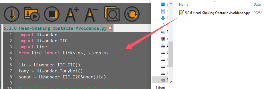

Head-Shaking Obstacle Avoidance Program
(2) Drag the “ultrasonic_obstacle_avoidance.py” file (located in the same folder as this document) into the editor window.
Achieved Effect
Avoid using the ultrasonic sensor to continuously detect objects that are very close.
When an obstacle is detected in front of the robot, it will stop and perform a head-shaking motion to check for obstacles on the left and right sides. Based on the results of this check, the robot will turn towards the direction with no obstacles and continue moving forward.

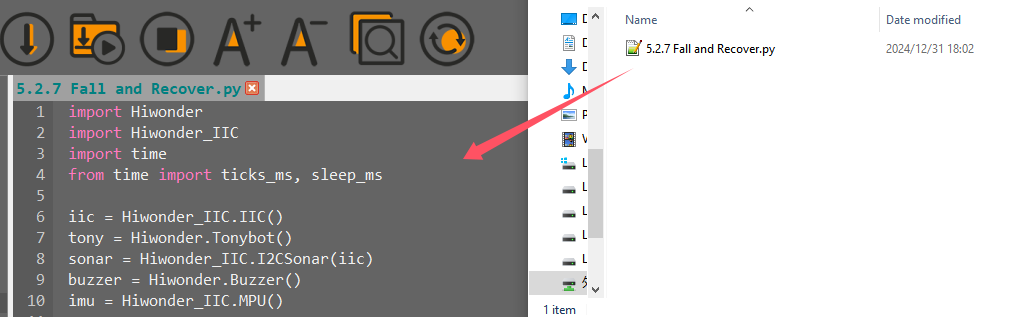

Program Download
(2) Drag the “rise_after_fall.py” file (located in the same folder as this document) into the editor window.
Achieved Effect
In the “Fall and Stand Up” mode, when the robot is powered on or restarted, the IMU will initialize. Wait for a “beep” sound, which indicates that the initialization is complete.
After turning on the robot, place it flat on either its front or back. After a brief moment, the robot will automatically perform the standing-up action. (Please note that the standing-up action differs depending on whether the robot is placed face-up or face-down.)

Program Download
(2) Drag the “smart_fan.py” file (located in the same folder as this document) into the editor window.

(11) The getDistance function is called to measure the distance. If the distance is less than 300mm, the RGB light is set to green using sonar.setRGB(0, 0, 250, 0).
(12) If the distance exceeds 300mm, the RGB light is set to blue using sonar.setRGB(0, 0, 0, 250), indicating a change in state.

Project Introduction
Touch the capacitive pad on the touch sensor, and Tonybot will perform a bowing motion.

Sensor Introduction
The touch sensor operates based on capacitive sensing technology, detecting the presence of human skin or metal through its gold-plated contact surface.
When no human or metal is in contact with the surface, the signal output is high. Upon contact with a human or metal, the signal output becomes low. Additionally, the sensor can detect contact through materials such as plastic or paper. The sensitivity of detection is influenced by the size of the contact surface and the thickness of the covering material.

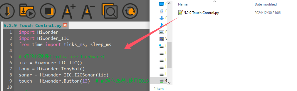

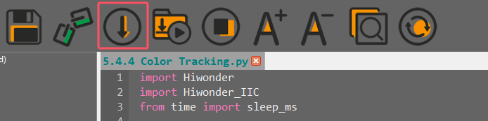

(2) Drag the “touch_control.py” file (located in the same folder as this document) into the editor window.

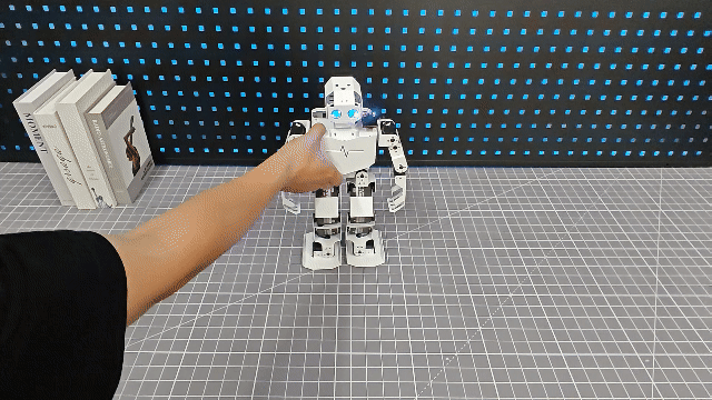

Upon powering on Tonybot, touching the capacitive plate on the touch sensor will trigger the robot to perform a bowing motion.

Once the mode is activated, Tonybot will monitor the temperature and humidity, and display the data on the matrix module.

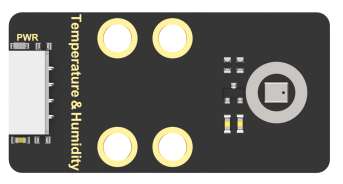

(1) Temperature and Humidity Sensor
This sensor detects the temperature and humidity of the environment and provides accurate readings.
The AHT10 module converts the air’s temperature and humidity into digital signals, which are then sent to the control board via I2C communication.
(2) LED Dot Matrix Module
The LED dot matrix module uses an 8x8 LED display, known for its high brightness, flicker-free display, and easy wiring. It can display numbers, text, patterns, and more. The module consists of two red 8x8 LED arrays and is controlled by the driver chip TM640B, enabling full control of the dot matrix screen.
For installation and wiring details, refer to the section “01 Sensor Assembly and Wiring” in this directory.

Temperature and Humidity Detection Program
(2) Drag the “main.py” file (located in the same folder as this document) into the editor window.

Once the temperature and humidity are detected, the dot matrix module will display the numerical values.

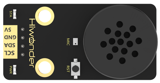

5.3.1 WonderEcho Introduction & Assembly
Assembly
Introduction and Working Principle
(1) Introduction
The voice interaction module is built on embedded voice recognition technology. It consists of a voice recognition chip and supporting circuits, designed for seamless communication with the main control chip. This module enables both voice recognition and voice playback functionalities. Developers can easily integrate it into their products to enable voice interaction capabilities.
(2) Working Principle
The module communicates via I2C and functions as a slave device, allowing communication with a master device. When the microphone on the module detects sound, it processes the audio and sends the result back to the master device.
The module operates in a keyword wake-up mode, requiring a specific trigger word to initiate recognition. By default, the wake-up keyword is “Hello Hiwonder.” Once recognition is complete, if further recognition is required, the module must be re-activated by the wake-up keyword after a 15-second delay.

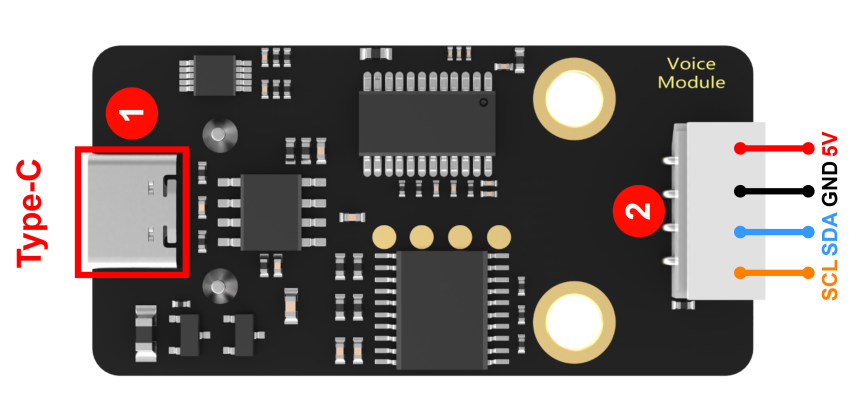

Interface Description
For detailed specifications and chip diagrams, please refer to the “3. Chip Manual.”
Type-C Interface: Used for powering the module and for firmware programming.
I2C Interface: Used for communication with host devices.
| PIN | Function Description |
| 5V | Power input |
| GND | Power ground |
| SDA | I2C data cable |
| SCL | I2C clock cable |

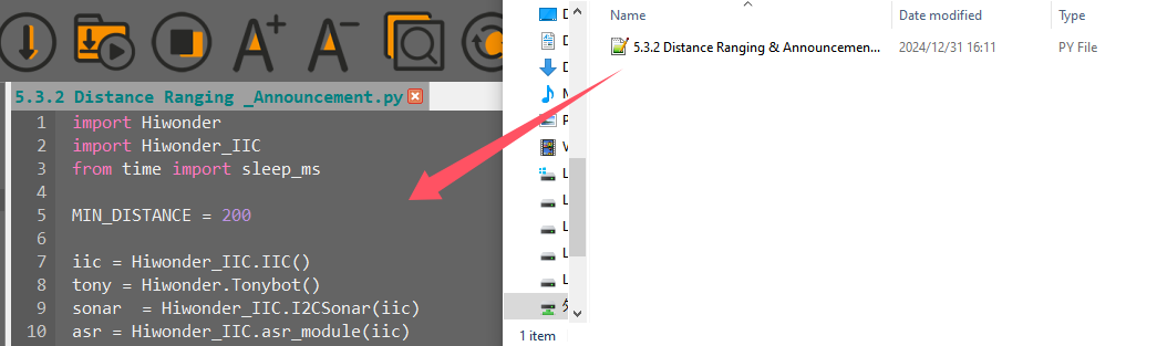

Distance Ranging & Announcement Program
(2) Drag the “Range_broadcasting.py” file (located in the same folder as this document) into the editor window.

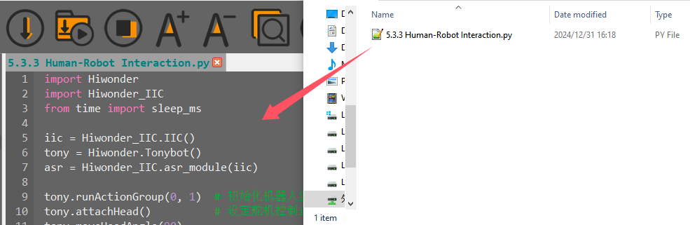

(2) Drag the “Communicate.py” file (located in the same folder as this document) into the editor window.

Sensor Introduction
For instructions on module installation and wiring, please refer to assembly guide saved in the same directory.

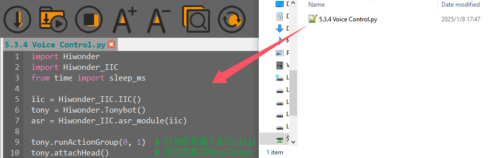

(2) Drag the “wake_up.py” file into the editor window.

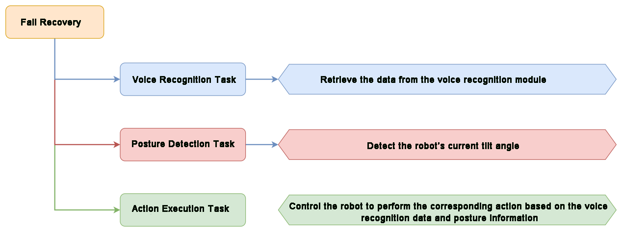

(3) State Management and Recovery Logic
① Global Variable step: A global variable step is used to track the robot’s recovery stages when it falls.
② tumble() Function: The tumble() function is the core of the program, responsible for detecting if the robot has fallen and performing recovery actions based on the current state.
③ global step: This ensures that step can be modified within the function to reflect the robot’s state changes.
④ result = asr.getResult(): Retrieves the current result from the voice recognition module.
⑤ if not tony.isRunning(): This check ensures that the fall detection logic is only executed when the robot is not engaged in other actions, avoiding interference with ongoing movements.
19 20 21 22 23 24 25 26 27 28 29 30 31 32 33 34 35 36 37 38 39 40 41 42 43 44 | def tumble(): """跌倒检测函数(Fall detection function)""" global step result = asr.getResult() # 获取语音识别模块数据(Get speech recognition module data) if not tony.isRunning(): # 若无动作进行(If no action is running) if step == 0: if result == 0x77: # "跌倒起立(Fall and stand up)" angle = imu.read_angle() radianX = angle[0] # X轴角度(X-axis angle) # 判断是倒正面还是背面(Determine whether it is face down or back down) if radianX < 60 and radianX > -30: step = 1 elif radianX > 120 or radianX < -140: step = 2 elif step == 1: tony.runActionGroup(102, 1) # 恢复立正状态(Recover to standing posture) step = 0 elif step == 2: tony.runActionGroup(101, 1) # 恢复立正状态(Recover to standing posture) step = 0 else: step = 0 |

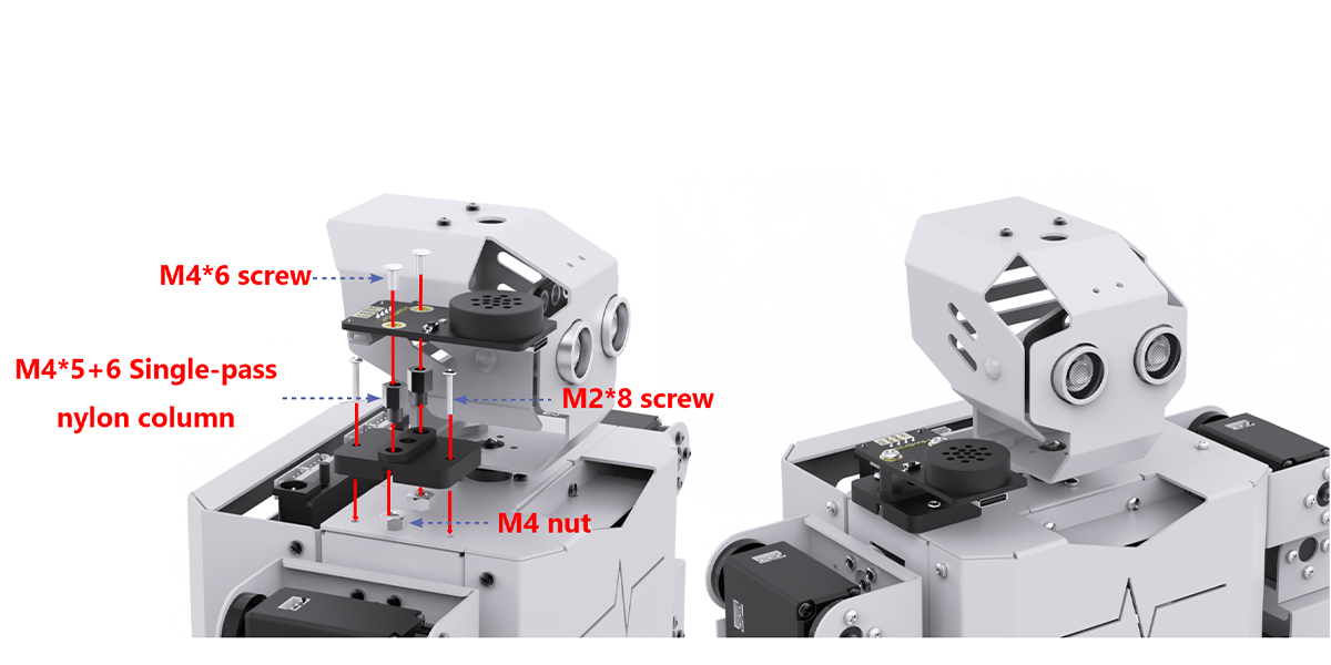

Assembly

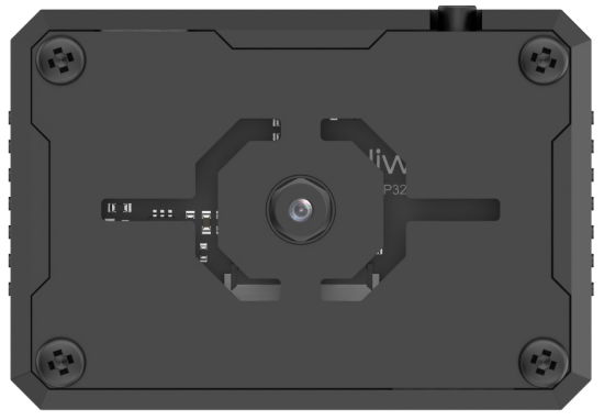

Overview of the ESP32-S3
The ESP32-S3 Vision Module is a compact camera module that can function as a standalone system. It captures images with its built-in camera, processes the data using the ESP32 microcontroller, and wirelessly transmits it via Wi-Fi. With support for various communication protocols and low-power features, this module is widely used in a range of IoT applications.

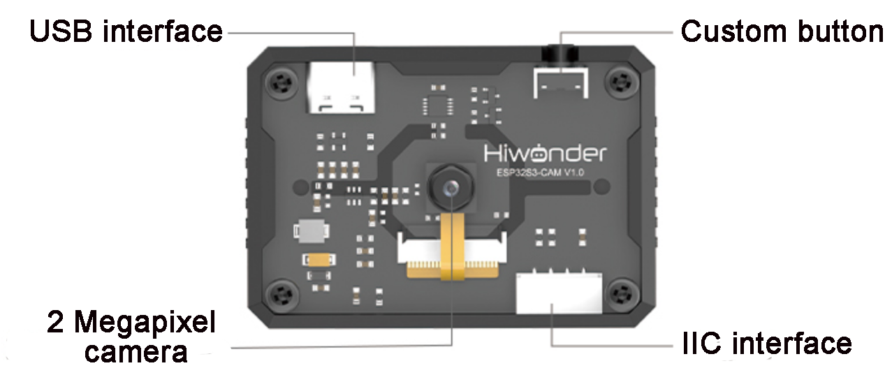

(2) Interface Description
| Interface Name | Interface Description |
| USB Serial Port | Serial communication, firmware programming |
| Custom Button | Allows customization of the button event in code |
| IIC Interface | Secondary development interface, connects with the main controller |

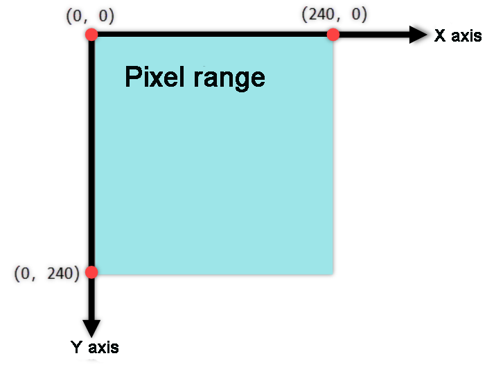

ESP32-S3 Image Coordinate Framework
Here are a few important points to note about the module’s image coordinate system:
(1) The origin is positioned at the center of the screen, not at the top-left corner.
(2) The Y-axis direction is opposite to that of a typical Cartesian coordinate system.

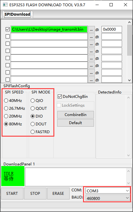

(1) ESP32-S3 Vision Module Firmware Download
① Connect the ESP32-S3 vision module to your computer using a Type-C data cable.
② Extract the ZIP file “flash_download_tool_3.9.7” located in the same folder, then double-click “flash_download_tool_3.9.7.exe” to open the program.
③ In the opened window, configure it as shown below.
④ In the flashing interface, click
to select the firmware file (”02 Image Transmission Firmware & Flash Tool\image_transmit.bin”), then configure the settings according to the image below.
⑤ Choose the correct port number (do not select COM1, as this will cause the flashing to fail).
⑥ Click “ERASE” to erase the existing firmware (this step is essential), then click “START” to begin the flashing process.
⑦ Wait for a completion message to appear.
⑧ Once flashing is complete, disconnect the Type-C data cable and restart the device.

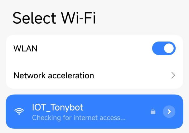

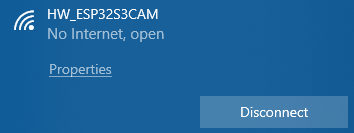

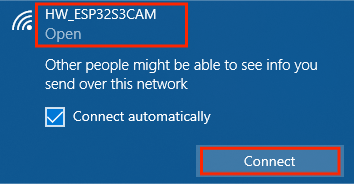

(1) Power on the device (before powering on, ensure that the vision module has been installed on the robot, as described in section 5.4.1 Overview and Installation of ESP32S3 Vision Module.
(2) Locate the hotspot generated by the module: HW_ESP32S3CAM and connect to it.

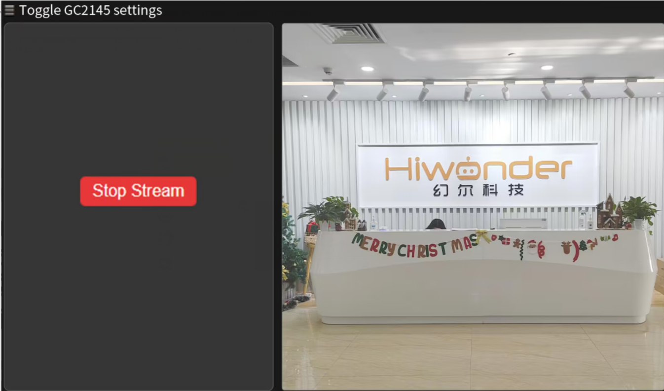

Image Transmission Implementation
Open a browser (this works on both mobile and PC browsers; we’ll use a PC as an example) and enter “192.168.5.1” in the address bar, then press Enter. On the resulting page, click
to access the camera’s live transmission interface.

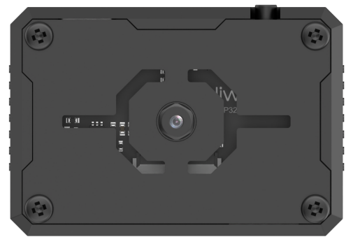

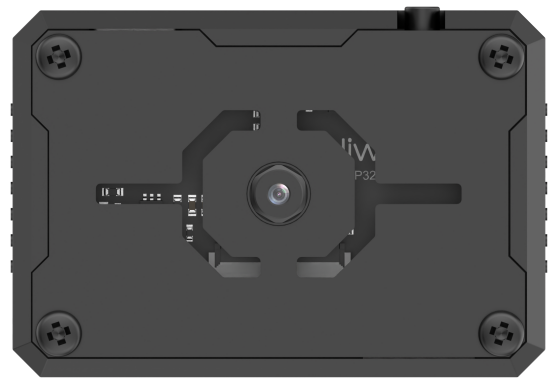

To get the detailed installation guide, please refer to ‘5.4.1 Overview and Installation of ESP32S3 Vision Module’.
The LED dot matrix module features a high-brightness display, flicker-free operation, and easy wiring. It is capable of displaying numbers, text, graphics, and other content. The module consists of two 8x8 red LED matrices, controlled by the TM640B driver chip, enabling full control of the display.
For installation and wiring details, please refer to “01 Dot Matrix Display Installation” in this directory.

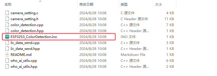

① Connect the ESP32-S3 to your computer using a Type-C data cable.

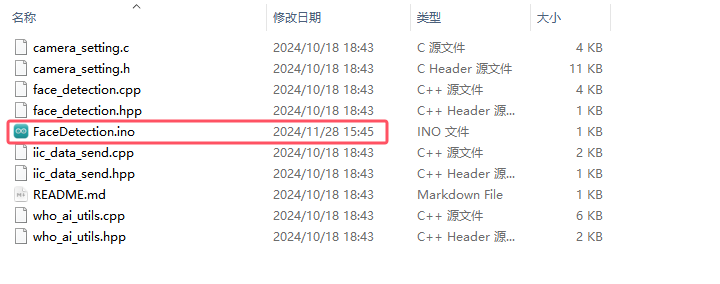

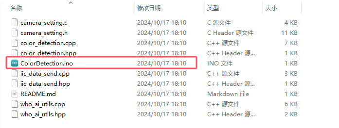

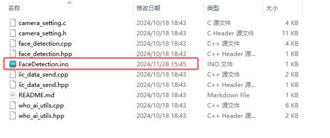

② Open the program file “ESP32S3 Color Recognition Example/ ESP32S3_ColorDetection/ ESP32S3_ColorDetection.ino” located in the same directory as this document.
③ Select the “ESP32S3 Dev Module” as the target board.

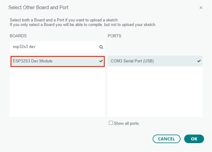

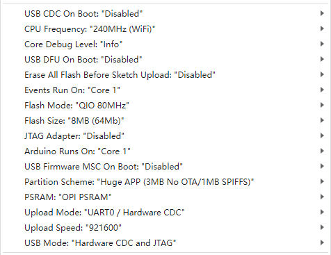

④ In the “Tools” menu, configure the ESP32-S3 development board settings as shown in the image below. (This configuration is only required for the first use. It does not need to be repeated for subsequent uses.)
⑤ Click
to transfer the code to the ESP32-S3 and wait for the flashing process to complete.

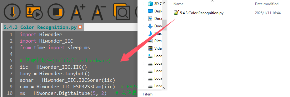

① Open the “04 Color Recognition Python Program\main.py” file from the same directory in your Python editor.
② Power on the device and connect it to your computer using a Type-C data cable.
③ Click
in the Python editor to establish the connection. Once the connection is successful, a confirmation prompt will appear.
④ Click
to upload the program to the Tonybot robot.
⑤ After the upload is complete, a success prompt will be displayed.
⑥ In the “Devices” list, rename the file “color_recognition.py” to “main.py”. Then, restart the device to execute the program.

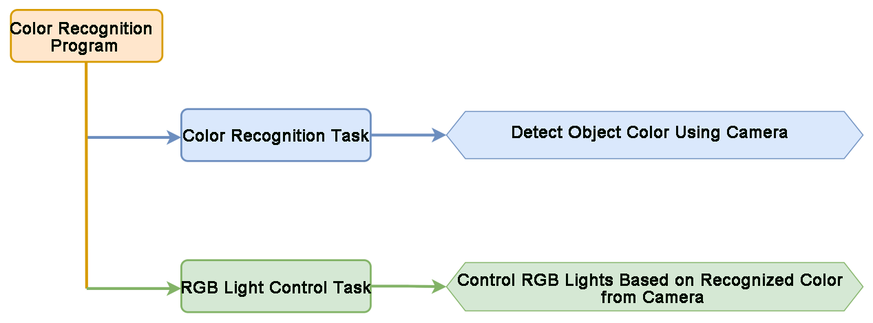

(2) Main Program
① In the main loop, retrieve the color detection data and determine the recognized color based on the results. If no color is detected, clear the display on the dot matrix module. When red, green, or blue is detected, display the corresponding color name in English on the dot matrix module.
48 49 50 51 52 53 54 55 56 57 58 59 60 61 62 63 64 65 | # 主循环(Main loop) while True: # 获取颜色检测数据(Get color detection data) res = colorDetect() if res == 0: # 无检测到(No color detected) mx.clear() elif res == 1: # 检测到红色(Red detected) display_color("Red") elif res == 2: # 检测到绿色(Green detected) display_color("Green") elif res == 3: # 检测到蓝色(Blue detected) display_color("Blue") sleep_ms(100) # 注意需要给相应的延时(Note: Proper delay is required) |
② The display_color() function updates the content on the dot matrix module. It uses the drawStr() function to display the passed text on the module.
24 25 26 27 28 29 30 | def display_color(text): """显示颜色文字(Display color text)""" str_len = len(text) for i in range(16, -str_len*6, -1): # 滚动显示(Scrolling display) mx.drawStr(0 , i, text) sleep_ms(40) # 滚动速度(Scrolling speed) sleep_ms(200) |
③ The colorDetect() function handles color detection. It retrieves the detection results for red, green, and blue. The value in res[2] indicates the width of the detected color. If the width is greater than 0, the color is considered detected, and the corresponding color ID is returned.

(1) ESP32-S3 Vision Module Program Download
② Open the program file “03 ESP32S3 Color Recognition Example/ ESP32S3_ColorDetection/ ESP32S3_ColorDetection.ino” located in the same directory as this document.
⑤ Click
(2) Python Program Download
① Open the “03 Color Tracking Python Example/main.py” file from the same directory in your Python editor.
③ Click
④ Click
⑥ In the “Devices” list, rename the file “color_follow.py” to “main.py”. Then, restart the device to execute the program.

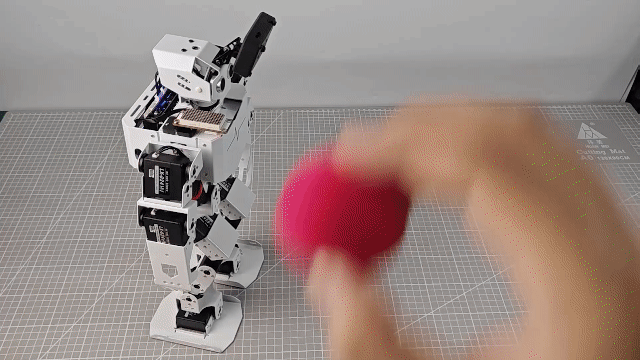

Achieved Effect
When a red ball is moved in front of the ESP32-S3 vision module camera, the robot’s head will move in response to the ball’s movement.

① First, define global variables to set the left and right boundaries for detection and the servo’s rotation step size.
22 23 24 25 26 | # 全局变量(Global variables) left = 90 # 左边界阈值(Left boundary threshold) right = 150 # 右边界阈值(Right boundary threshold) dev = 4 # 转动角度步长(Rotation angle step) angle = 90 # 舵机角度(Servo angle) |
② In the main program, retrieve the recognition results from the vision module. Use the x-axis coordinate of the top-left corner of the detected face (result[0]) and the width of the face area (result[2]) to calculate the x-coordinate of the face’s center. Based on the center point’s x-coordinate, adjust the servo’s rotation angle. If the center point’s x-coordinate is greater than the “right” boundary, the face is shifted to the right, and the servo should rotate right. If the center point’s x-coordinate is less than the “left” boundary, the face is shifted to the left, and the servo should rotate left.
28 29 30 31 32 33 34 35 36 37 38 39 40 41 42 43 44 45 46 47 48 49 50 | # 主循环(Main loop) while True: # 获取识别结果(Get recognition result) result = cam.read_color(1) if result: # 计算x中心(Calculate x-center) x = result[0] + result[2]//2 print(x) # 若偏右(If biased to the right) if x > right: dev = int((x - right)*0.04) angle = max(0, angle - dev) # 若偏左(If biased to the left) elif x < left: dev = int((left - x)*0.04) angle = min(180, angle + dev) # 设置舵机角度(Set servo angle) tony.moveHeadAngle(angle) sleep_ms(100) # 注意需要给相应的延时(Note: Proper delay is required) |
⑤ Click

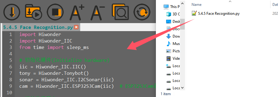

Face Recognition Python Example

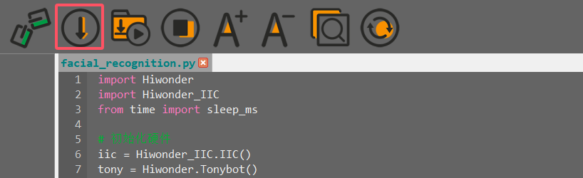

① Open the “03 Face Recognition Python Example/facial_recognition.py” file from the same directory in your Python editor.
③ Click
④ Click
⑥ In the “Devices” list, rename the file “facial_recognition.py” to “main.py”. Then, restart the device to execute the program.
Vision Line Following Python Example
① Open the “Vision Line Following Python Example/facial_recognition.py” file from the same directory in your Python editor.
③ Click
④ Click
⑥ In the “Devices” list, rename the file “visual_patrol.py” to “main.py”. Then, restart the device to execute the program.
Achieved Effect
The robot’s vision module will conduct line-following movements along red lines.

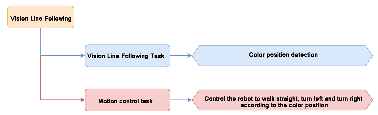

② In the main loop, obtain the recognition result of color ID1. If the result is not empty, calculate the x-coordinate of the center point and pass it to the body_follow function for further processing.
75 76 77 78 79 80 81 82 83 | # 主循环 (Main loop) while True: # 获取线条位置 (Get line position) result = cam.read_color(3) if result is not None: # 计算x中心 (Calculate the x center) x = result[0] + result[2]/2 body_follow(x) sleep_ms(50) # 注意需要给相应的延时 (Note: Proper delay is required) |
③ In the movement function, first check if there is any ongoing action. If no action is being executed, determine the position of the line based on the x-coordinate. If the x-coordinate is within the left and right boundary thresholds, execute the straight movement action group.
35 36 37 38 39 40 41 42 43 44 45 | def body_follow(x): """机体运动函数(Body movement function)""" global step print(x) # if not tony.isRunning(): # 若无动作进行(If no action is running) if step == 0: # 在中间,直走(In the middle, go straight) if LEFT_MIN < x < RIGHT_MAX: tony.runActionGroup(GO_STRAIGHT, 1) sleep_ms(850) |
④ If the x-coordinate of the center point is smaller than the left boundary (or greater than the right boundary), execute the left turn (or right turn) action group. At the same time, set the step variable to 1 (or 2). The step variable will be used for subsequent position checking after the robot completes the turn.
46 47 48 49 50 51 52 53 54 55 | # 左偏,左转 (Deviating to the left, Turn left) elif 0 < x < LEFT_MIN: tony.runActionGroup(TURN_LEFT, 2) sleep_ms(2700) step = 1 # 右偏(Deviating to the right) else: tony.runActionGroup(TURN_RIGHT, 2) sleep_ms(2850) step = 2 |
⑤ When step=1, recheck the robot’s position. If the line is still to the left, continue executing the left turn action group. Otherwise, execute the straight movement action group to make the robot move forward. The same process applies when step=2.
51 52 53 54 55 56 57 58 59 60 61 62 63 64 65 66 67 68 69 70 71 72 73 | # 右偏(Deviating to the right) else: tony.runActionGroup(TURN_RIGHT, 2) sleep_ms(2850) step = 2 elif step == 1: # 左偏 (Deviating to the left) if 0 < x < LEFT_MIN: # 未调整(Not adjusted) tony.runActionGroup(TURN_LEFT, 1) sleep_ms(1350) else: tony.runActionGroup(GO_STRAIGHT, 1) sleep_ms(900) step = 0 elif step == 2: # 右偏 (Deviating to the right) if x > RIGHT_MAX: # 未调整 (Not adjusted) tony.runActionGroup(TURN_RIGHT, 1) sleep_ms(1450) else: tony.runActionGroup(GO_STRAIGHT, 1) sleep_ms(900) step = 0 else: step = 0 |

② Open the program file “02 Face Detection Porgram/FaceDetection/FaceDetection.ino” located in the same directory as this document.
⑤ Click

(2) Program Download

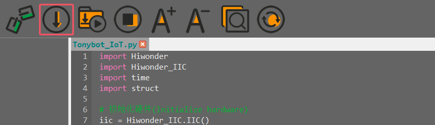

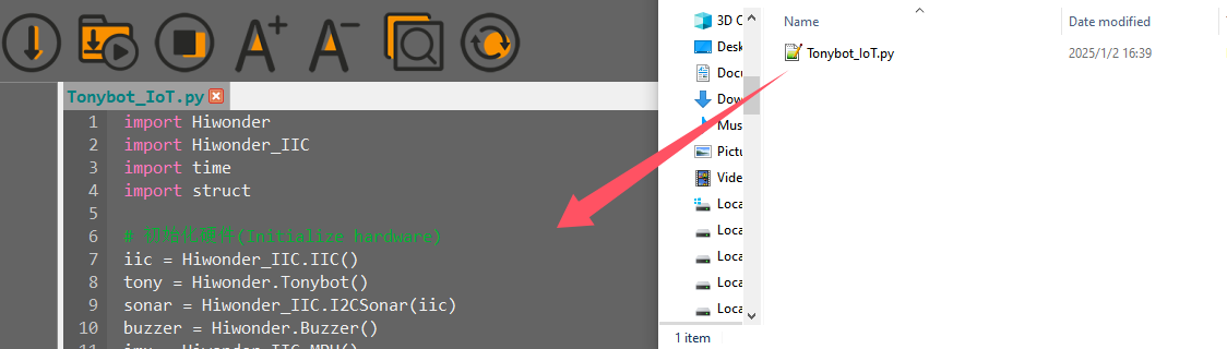

① Open the “03 Tonybot IOT Example/Tonybot_IoT.py” file from the same directory in your Python editor.
③ Click
④ Click
⑥ In the “Devices” list, rename the file “Tonybot_IoT.py” to “main.py”. Then, restart the device to execute the program.

(2) Tap
in the top-right corner, select “IOT_Tonybot” from the Wi-Fi list, and enter the password “12345678” to connect.
(3) Once connected, the Wi-Fi icon in the top-right corner will become solid.

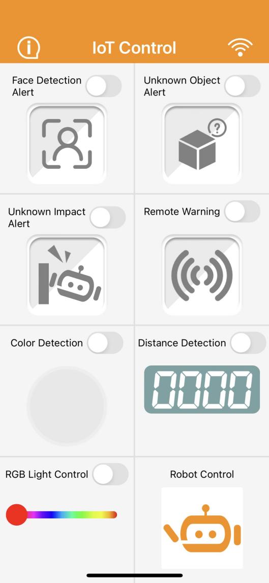

The app provides 8 different modes: Face Detection Alert, Unknown Object Alert, Unknown Impact Alert, Remote Warning, Color Detection, Distance Detection, RGB Light Control, and Robot Control.
A detailed description of each function is provided in the table below:
| Icon | Function |
When the Tonybot vision module detects a face, the phone will vibrate. (Note: This feature requires the face detection program to be pre-installed on the vision module.) |
When the Tonybot ultrasonic module detects an object, the buzzer will sound. |
When an unknown object causes Tonybot to fall, the buzzer will sound. |
Once activated, the buzzer will continue to sound until Tonybot is upright again. |
When the Tonybot vision module detects a specific color, the corresponding color will be displayed in the circle below. (Note: This feature requires the color detection program to be pre-installed on the vision module.) |
With the Remote Distance Measurement feature enabled, the detected distance will be shown below. |
Controls the color of the RGB light on the Tonybot ultrasonic module. |
Controls Tonybot to execute various action groups. |

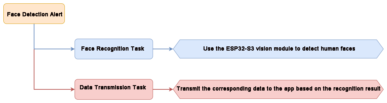

In this section, Tonybot utilizes the ESP32-S3 vision module to detect faces and triggers a vibration alert on the phone upon face detection.

(1) Connect the ESP32-S3 to your computer using a Type-C data cable.
(2) Open the program file “03 ESP32S3 Face Detection Example/FaceDetection/FaceDetection.ino” located in the same directory as this document.

Program Download
For instructions on downloading the vision module and Tonybot program, please refer to the “5.5.2 Program Download” section.
To get the detailed installation guide, please refer to ‘5.5 IoT (Internet of Things) Course/ 5.5.1 WiFi Module Installation & Wiring’
(2) Open the program file “02 ESP32S3 Color Recognition Example/ColorDetection/ColorDetection.ino” located in the same directory as this document.
(3) Select the “ESP32S3 Dev Module” as the target board.
(4) In the “Tools” menu, configure the ESP32-S3 development board settings as shown in the image below.
(5) Click

5.5.8 Distance Detection
This section enables Tonybot to measure the obstacle distance using an ultrasonic sensor and display the distance on the app.
Module Introduction
Program Download
Achieved Effect
Tonybot will continuously monitor the distance to objects and display the measurement on the app.
Program Analysis
(1) Import Library Files
Import the required libraries: The Hiwonder library includes sensor functions, low voltage alarm, and more. The time library is used for time-related operations, and the Hiwonder_IIC library facilitates I2C communication with modules.
1 2 3 4 | import Hiwonder import Hiwonder_IIC import time import struct |
(2) Hardware Initialization
① Instantiate the hardware components, including enabling I2C communication, creating the Tonybot object, and activating the buzzer.
6 7 8 9 10 11 12 | # 初始化硬件 iic = Hiwonder_IIC.IIC() tony = Hiwonder.Tonybot() sonar = Hiwonder_IIC.I2CSonar(iic) buzzer = Hiwonder.Buzzer() imu = Hiwonder_IIC.MPU() cam = Hiwonder_IIC.ESP32S3Cam(iic) |
② Set up the Wi-Fi network with the name “IOT_Tonybot” and the password “12345678”.
14 15 16 17 | time.sleep_ms(100) iic.writeto(0x69 , "NIOT_Tonybot|||12345678$$$") time.sleep_ms(1000) |
③ Initialize the robot’s posture, enable the head servo to rotate to 90°, then disable the servo. Finally, initialize the IMU module.
19 20 21 22 23 24 25 26 | tony.runActionGroup(0, 1) tony.attachHead() tony.moveHeadAngle(90) time.sleep_ms(200) tony.detachHead() time.sleep_ms(1000) buzzer.playTone(1500, 100, False) |
④ Define functions for reading and writing data between the ESP32 and the vision module.
28 29 30 31 32 | def wifi_send(buf): iic.writeto(0x69 , buf) def wifi_read(): return iic.readfrom(0x69 , 20) |
⑤ Create flags and data structures to control function switches and trigger specific actions.
37 38 39 40 41 42 43 44 45 46 47 48 49 | onoff_face = False onoff_undef_obj = False onoff_hit = False onoff_color_detec = False onoff_distance = False warn_face = False warn_undef_obj = False warn_hit = False color_detec_num = 0 sensor_distance = 0 |
Distance Detection Function Analysis
(1) First, define and call the function to determine the current mode of the vision module, whether it is in color recognition or face recognition mode.
51 52 53 54 55 56 57 58 59 60 61 62 63 64 65 | def ESP32S3Cam_type(): result = cam.read_color(3) time.sleep_ms(100) result = cam.read_color(3) print(result) if result is not None: if result[0] != 0x00 and result[0] == result[2]: print("type:face") cam.read_face() return 1 print("type:color") return 2 esp32s3_type = ESP32S3Cam_type() |
(2) First, define and call the function to determine the current mode of the vision module, whether it is in color recognition or face recognition mode.
107 108 |
sensor_distance = sonar.getDistance() * 10
(3) When the remote distance switch is enabled, transmit the obstacle distance data to the mobile app.
132 133 134 135 136 137 138 | elif send_step == 1: send_step = 2 if onoff_distance: wifi_send("CMD|3|{}|$".format(int(sensor_distance//10))) elif send_step == 2: send_step = 0 |

Remote Warning Function Analysis
(1) In the Wi-Fi reception task, receive the data sent from the mobile app and parse the command and data.
147 148 149 150 151 152 153 154 155 156 157 158 | def wifi_receive_Task(): global onoff_face, onoff_undef_obj, onoff_hit, onoff_color_detec, onoff_distance,last_receive,receive_data,buzzer_flag receive_data = wifi_read() if last_receive != receive_data: last_receive = receive_data rec = receive_data.decode('utf-8') print(rec) if rec.find("CMD") != -1 and rec.find("$"): cmd = rec.split('|')[1:] print(cmd) |
(2) When the command value is 5, activate the buzzer to emit an alert.
177 178 179 180 181 182 183 184 | elif int(cmd[0]) == 5: print("55") if int(cmd[1]): print("55-1") buzzer_flag = True else: print("55-2") buzzer_flag = False |

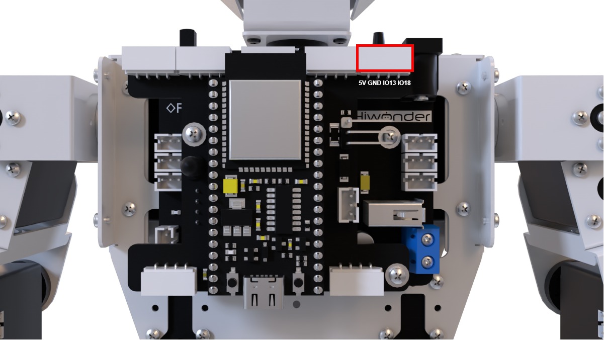

Connect the TXD, RXD, and GND pins of the USB-to-serial adapter to the D6, D7, and GND pins on Tonybot using DuPont wires, and then connect the USB adapter to the computer. (Note: The 5V connection is optional, but the GND connection is required.)
The power supplies for the master device and Tonybot can be different, but they must share a common ground to ensure stable communication levels.
When wiring, ensure that the TX and RX pins of the UART serial port are crossed (TX to RX, RX to TX); otherwise, communication will not be possible.
