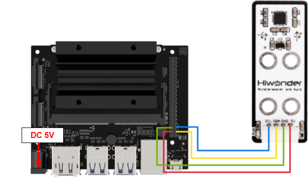

4.1.1 Wiring Instruction
This section uses DuPont wires to connect acceleration modules. For wiring instructions, refer to the figure below:

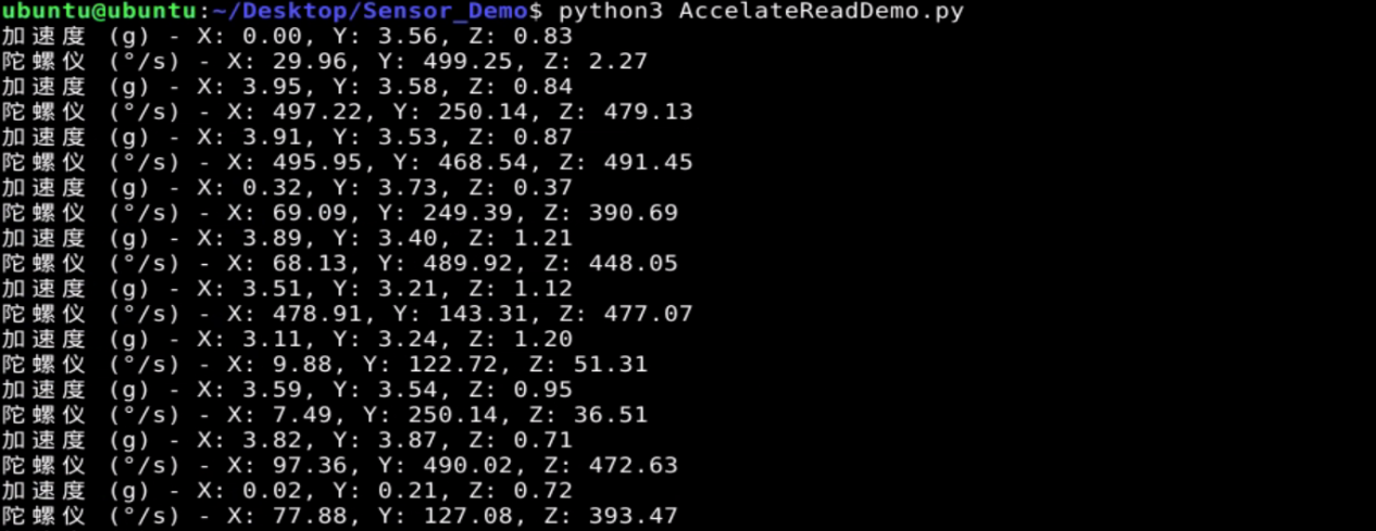

In this case, display the status detected by the acceleration sensor in the terminal window of the Jetson system.
4.2.1 Program Execution
  1. Open the terminal and enter the following command to navigate to the program directory:
cd Desktop/
python3 AccelateReadDemo.py
4.2.2 Project Outcome
You can adjust its orientation to test the three-axis angular velocity and acceleration, which can be viewed in the terminal.
