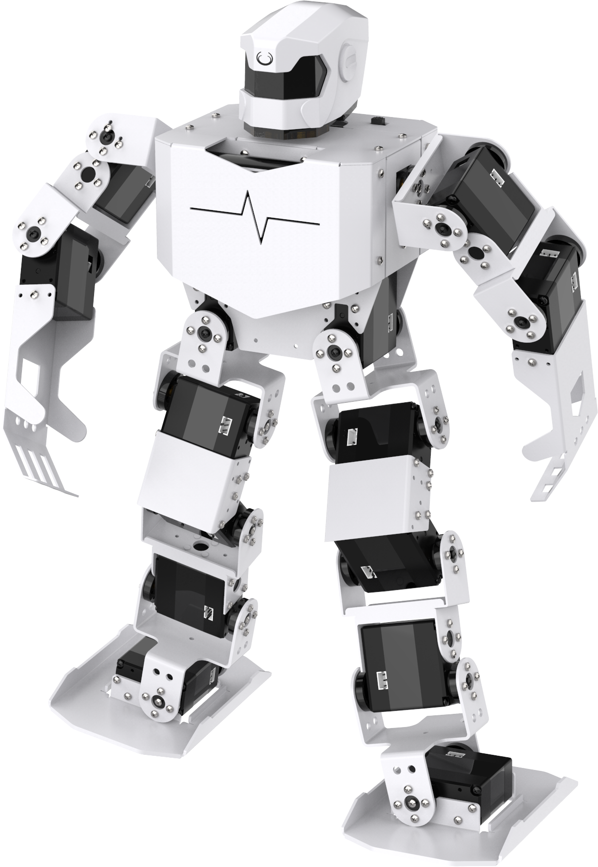

1.1 Introduction to RoboSoul H5S
1.1.1 Introduction
The RoboSoul H5S is an intelligent humanoid robot capable of singing and dancing. The robot is equipped with 16 high-voltage intelligent bus servos, enabling agile and precise bionic movements such as walking, dancing, kicking, and punching. The robot comes with a built-in Bluetooth module, MP3 module, and wireless communication module, supporting group control so that multiple robots can sing and dance in perfect synchronization. With the integrated accelerometer, the RoboSoul H5S can detect the direction of a fall and perform creative functions such as getting up after falling.
Official tools include a mobile app and graphical PC control software, allowing users to freely program the robot’s movements. It also supports manual pose adjustment, enabling even complete beginners to easily create their own customized humanoid robot.

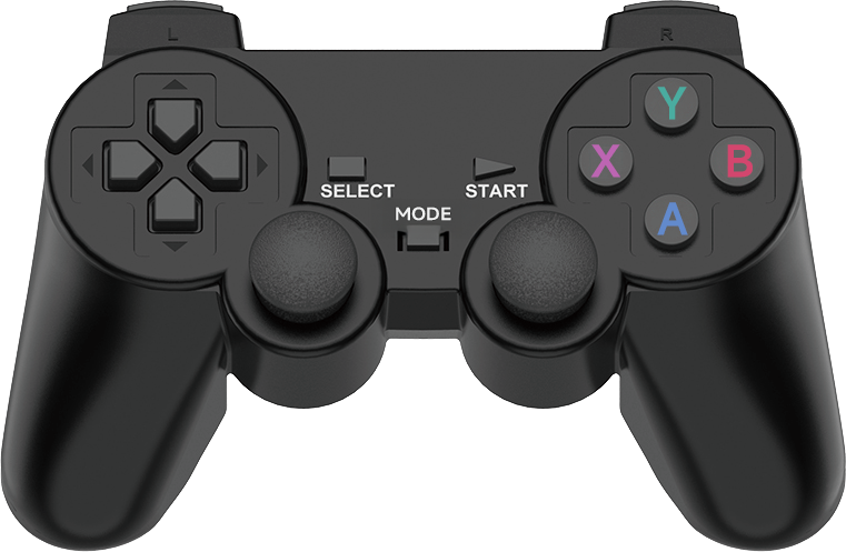

| 4 | Wireless controller | 1 | ![]() |

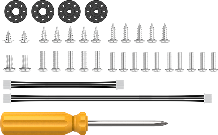

| 5 | Accessory bag | 1 | ![]() |

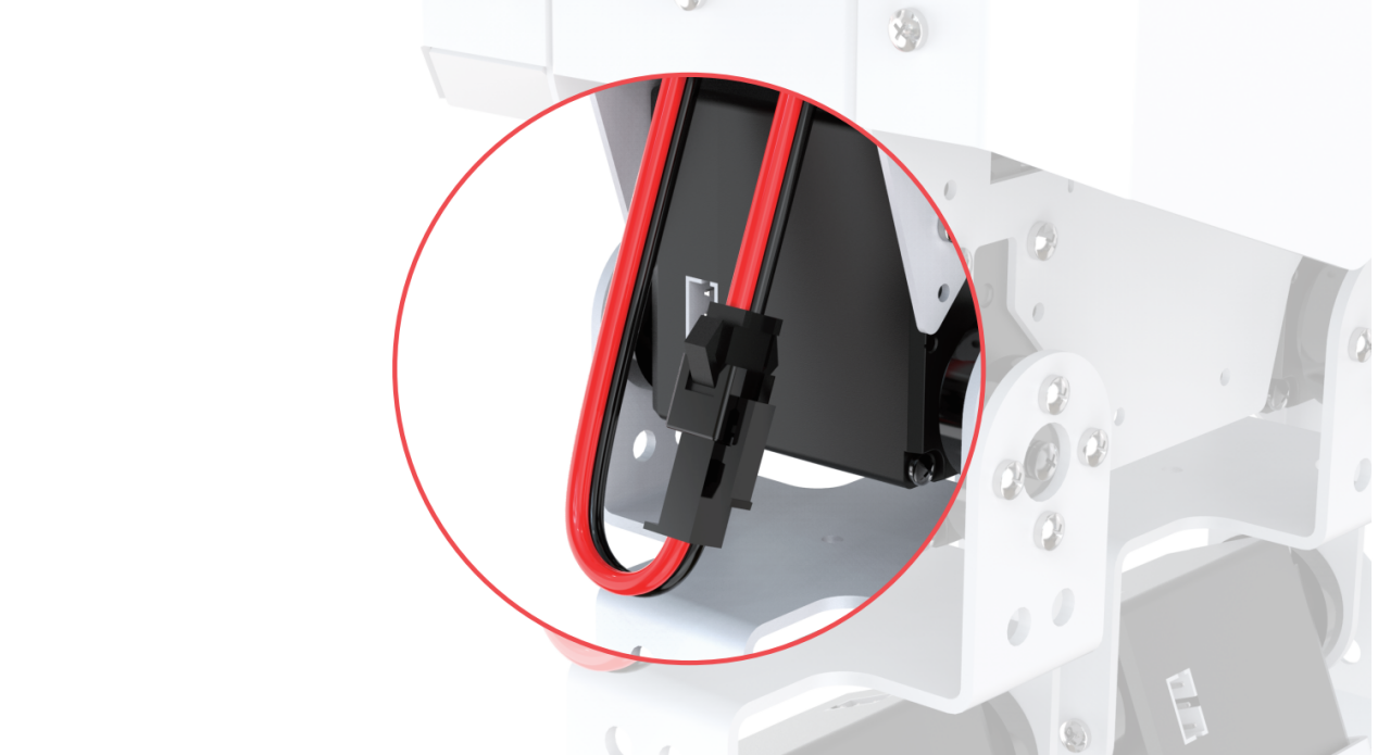

(1) Connect the battery to the matching cable — red to red, black to black.
The connector is designed to prevent reverse insertion. If it does not fit, do not force it.

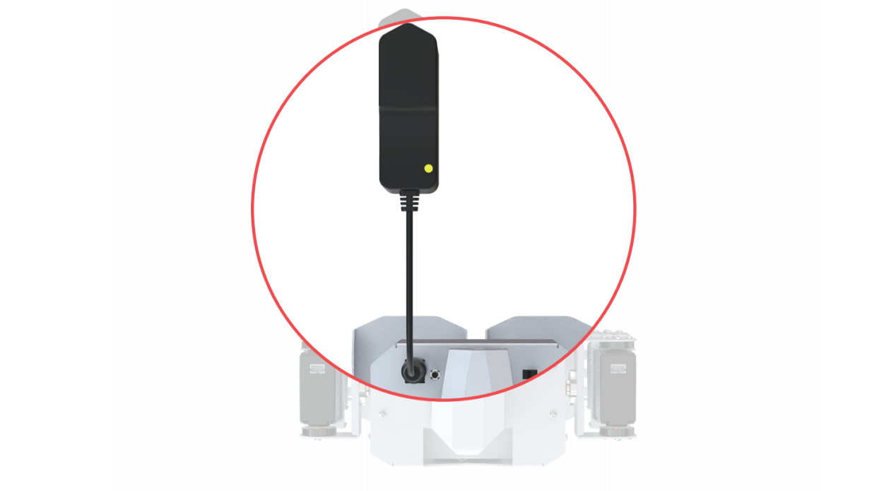

(2) Insert the charger into the charging port on the side of the robot. Charging time is approximately 3 hours. A red indicator light means charging is in progress, and a green light means charging is complete.

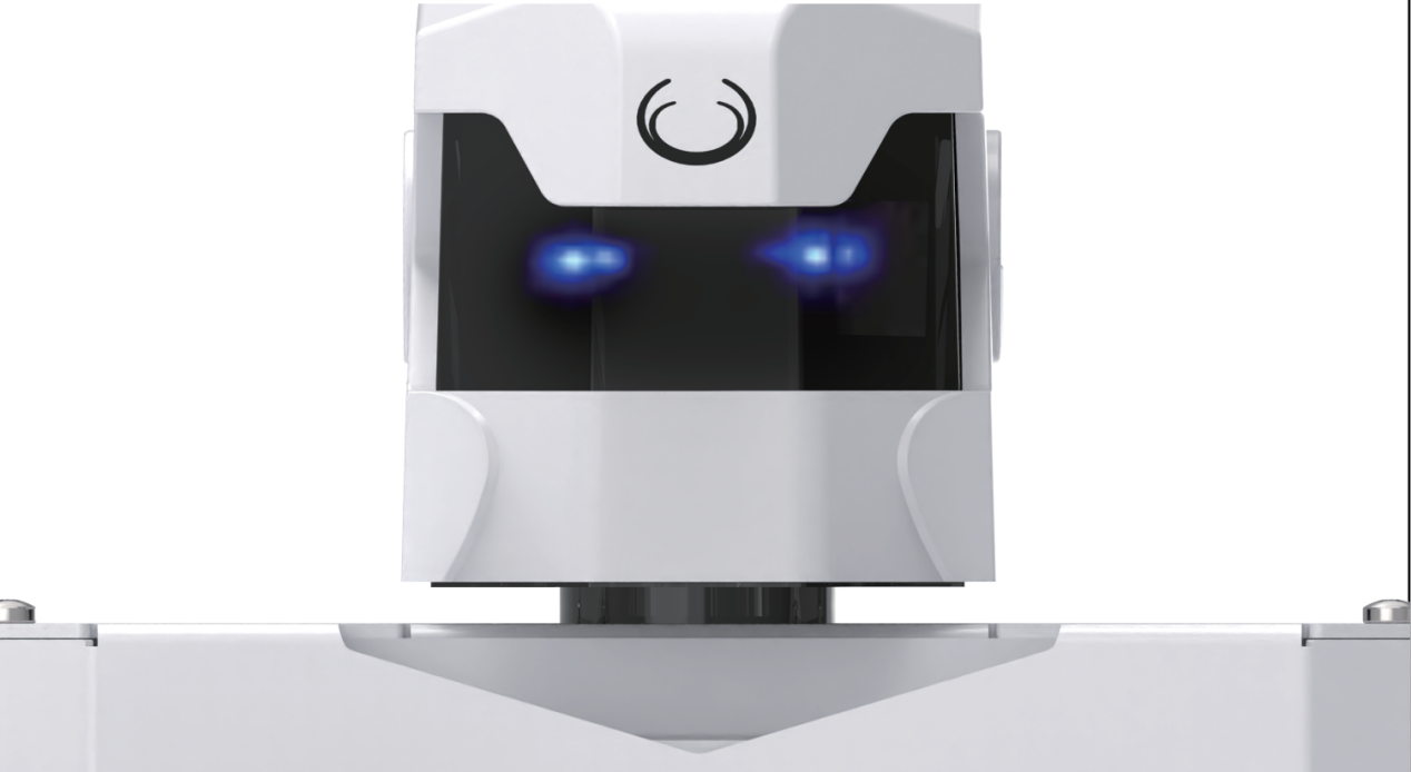

1.3.2 Powering On and Off
The power switch is located on the back of the robot. When turned on, the robot’s eyes will light up, indicating a successful startup. When turned off, the eyes will turn off.

(1) Use only the charger included with the kit to charge the battery.
(2) If the battery voltage is too low, the robot’s performance may be affected. Try to keep the battery voltage above 10V for optimal operation.
(3) While charging, the indicator light will be red, and it will turn green when fully charged. Please unplug the charger promptly after the battery is fully charged to avoid overcharging.
