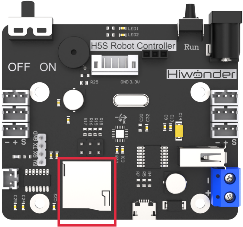

(2) Locate and remove the TF card from the controller, please refer to the diagram below for position.

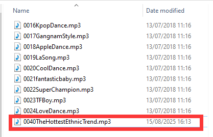

(3) To transfer the audio file, first insert the TF card into a card reader, then copy the renamed audio file into the “MP3” folder on the TF card. After importing, the TF card should contain files exactly as shown in the example below.
Files placed in other folders or in subfolders within the “MP3” folder cannot be read correctly.
