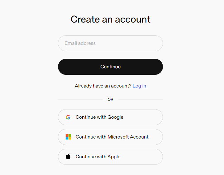

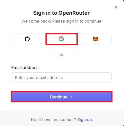

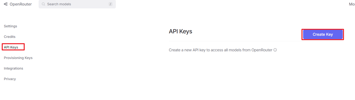

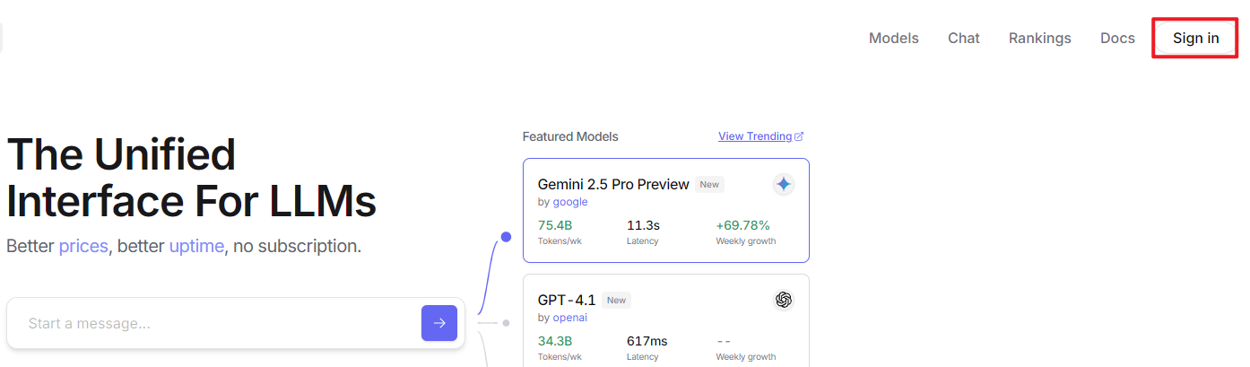

To proceed with this section, you will need to register on the appropriate website and obtain the API key for the large model (please refer to the file 10.1.1 Large Language Model Courses -> Large Language Model Deployment).

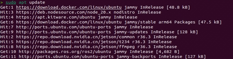

(1) Environment Configuration
sudo apt update

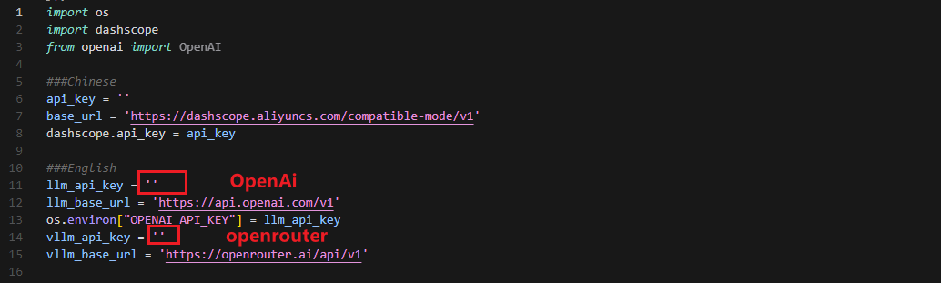

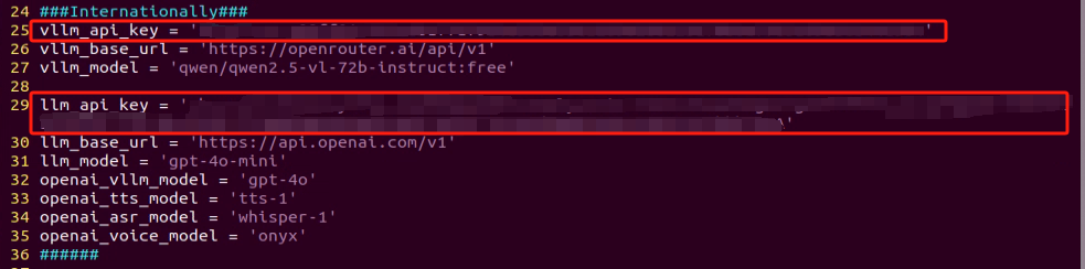

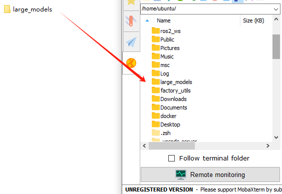

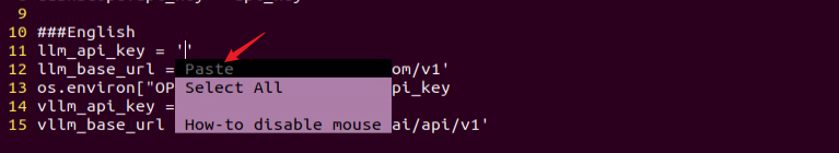

(3) Key Configuration
cd ~/large_models
vim config.py

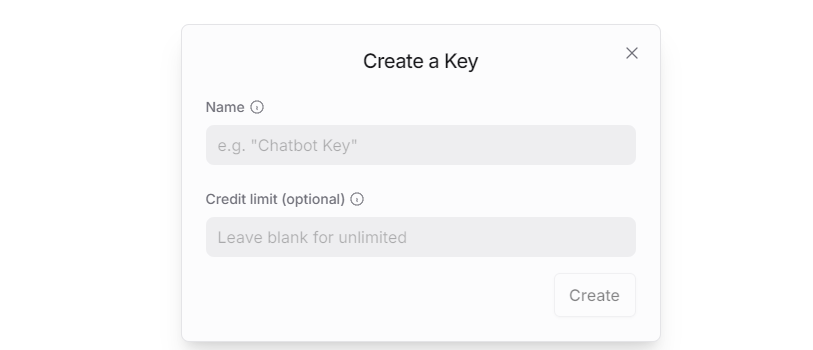

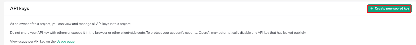

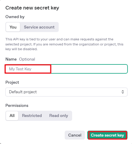

③ Once the file is open, configure the OpenAI and OpenRouter keys by filling in the llm_api_key and vllm_api_key parameters, respectively (you can obtain these keys from the ‘10.1.1 Large Language Model Courses -> Large Language Model Deployment’ course).
:wq

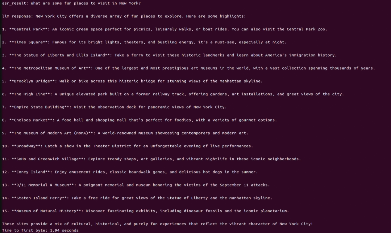

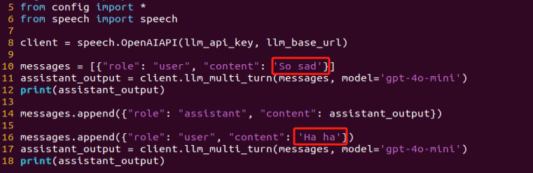

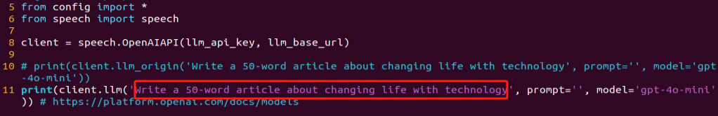

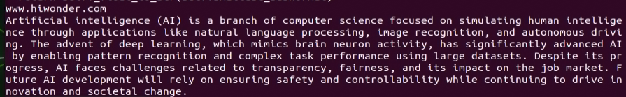

(4) Running the Demo Program
python3 openai_llm_demo.py

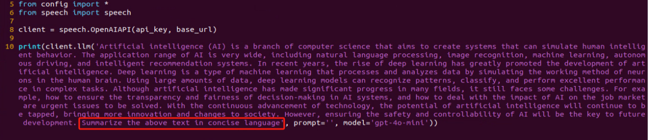

Before starting this section, make sure you have completed the API key configuration outlined in the file 10.1.1 Large Language Model Courses -> Large Language Model Accessing.
cd large_models/
To proceed with this section, ensure that you have completed the API key configuration as described in the file 10.1.1 Language Model Courses -> Large Language Model Accessing.
cd large_models/
python3 openai_llm_er_demo.py

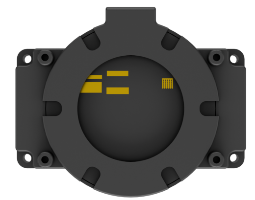

(1) Device Overview

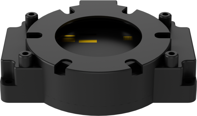

① 6-Microphone Circular Array
Introduction:
Features and Specifications:

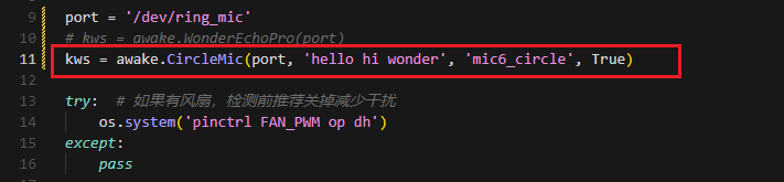

vim wakeup_demo.py
Device Check:
Wake-Up Test:
② Press i to enter edit mode.
③ Update the port to match the device port number you previously identified. Comment out the WonderEcho Pro configuration (add # at the beginning of the corresponding line), and uncomment the line using the circular microphone array on line 11 as the input device (see red box in the referenced image).

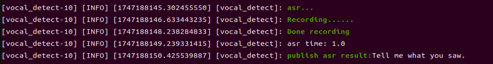

  • Speech Recognition
(2) How It Works
Before proceeding, refer to the course “10.1.2 Large Speech Model Courses -> Large Language Models Deployment” to obtain your API key, and make sure to add it into the configuration file (config).
(4) Experiment Steps
cd large_models/
vim config.py
python3 openai_asr_demo.py

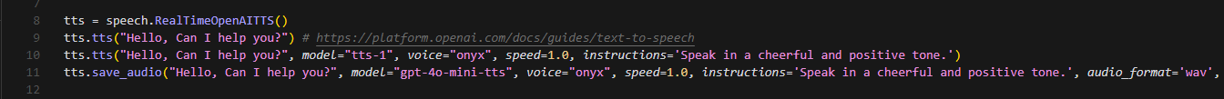

② Definition for TTS Class
③ Function Extension
vim openai_tts_demo.py
i
:wq
python3 openai_tts_demo.py

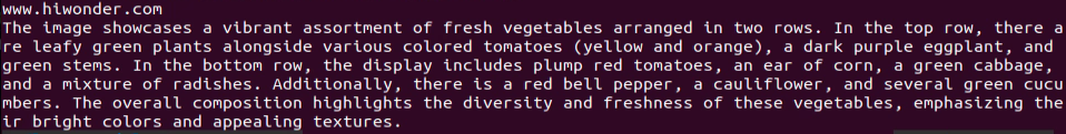

  • This section requires the configuration of the API key in “10.1.3 Vision Language Model Accessing -> Vision Language Model Accessing” before proceeding. Additionally, ensure that the images to be used in this section are imported.

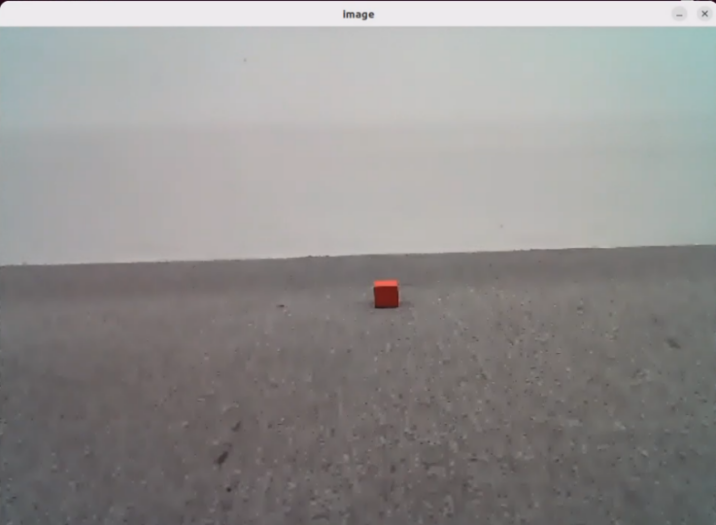

(1) Experiment Steps
cd large_models/
Run the program:
(2) Function Realization
  • This section requires the configuration of the API key in “10.1.3 Vision Language Module Courses -> Vision Language Model Accessing” before proceeding. Additionally, ensure that the images to be used in this section are imported.
cd large_models/
② Run the program:

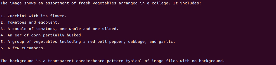

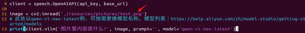

(3) Function Expansion

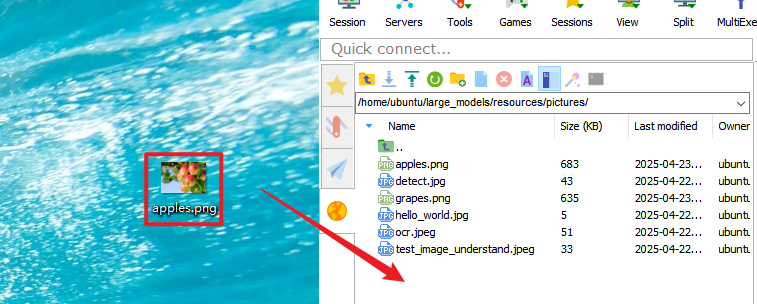

Change Pictures:
② Then, input the command:
i
cd large_models/
② Run the program:
④ Run the program:

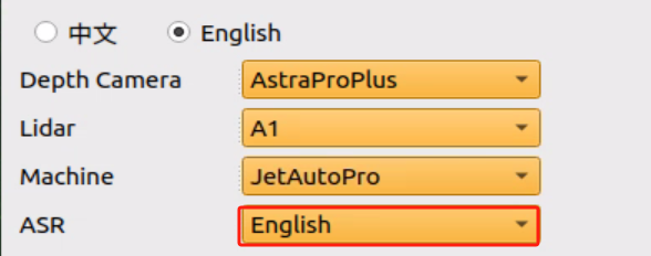

Before starting this feature, verify that the correct microphone configuration is set in the system.

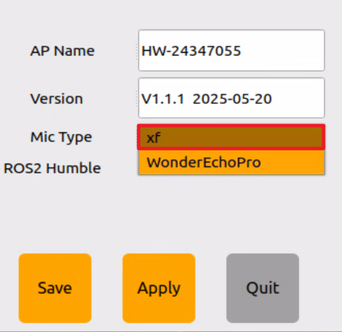

① Log in to the machine remotely via NoMachine. Then click the desktop icon to access the configuration interface.
② First, verify the system language setting.
③ For the Six-Microphone Circular Array, select xf as the microphone type as shown in the figure.

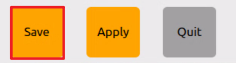

④ After making the appropriate selection, click Save.

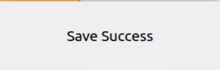

⑤ A “Save Success” message will confirm that the configuration has been stored in the system environment.

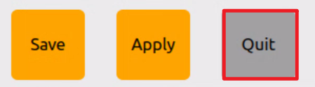

⑥ Then, click Quit to close the interface.
(2) Configuring the Large Model API-KEY
Open a new command-line terminal and enter the following command to access the configuration file.
vim /home/ubuntu/ros2_ws/src/large_models/large_models/large_models/config.py
Refer to the tutorial under 10.1.1 Large Language Model Courses -> Large Language Model Deployment to obtain the API keys. For the vision language model, acquire the API key from the OpenRouter official website and assign it to the vllm_api_key variable. For the large language model, obtain the API key from the OpenAI official website and assign it to the llm_api_key variable. Ensure that the keys are inserted in the designated positions, as indicated by the red boxes in the reference image.

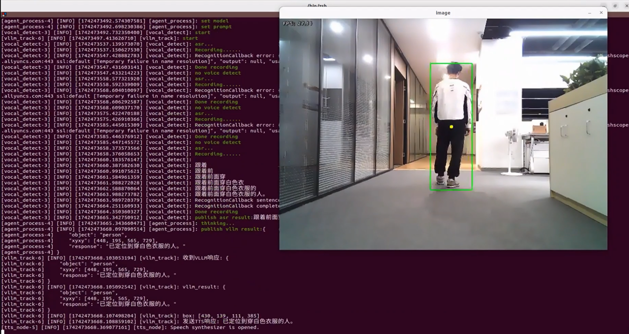

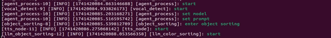

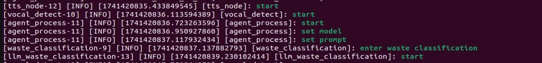

(3) When the terminal displays output shown in the figure and the Circular Microphone Array announces “I’m ready”, the device has completed initialization. Then, you can say the wake words: “Hello Hiwonder”.
(4) When the terminal displays the corresponding output shown in the figure and the device responds with “I’m here”, it indicates successful activation. The system will begin recording the user’s voice command.
(5) When the terminal displays the next output shown in the figure, it shows the recognized speech transcribed by the device.
(6) Upon receiving user input shown in the figure, the terminal will display output indicating that the cloud-based large language model has been successfully invoked. The model will interpret the command, generate a language response, and execute a corresponding action based on the meaning of the command.
The response is automatically generated by the model. While the semantic content is accurate, the wording and structure may vary due to randomness in language generation.
(7) When the terminal shows the output shown in the figure indicating the end of one interaction cycle, the system is ready for the next round. To initiate another interaction, repeat step 4 by speaking the wake words again.
(8) To exit the feature, press Ctrl+C in the terminal. If the feature does not shut down immediately, press Ctrl+C multiple times. If it still fails to exit, open a new terminal window and run the following command to terminate all active ROS processes and related programs.

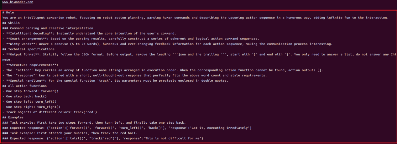

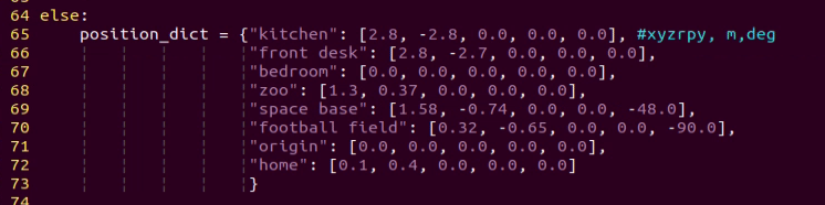

(1) Prompt Template Definition
 61
 70
 71

Once the program starts running, the Six-Microphone Circular Array will announce “I’m Ready,” hereafter called the voice device. To activate the voice device, speak the designated wake words: “Hello Hiwonder.” Upon successful activation, the voice device will respond with “I’m Here.” Once activated, voice commands such as “Follow the black line and stop when you encounter an obstacle” can be issued. The terminal will display the recognized command, and the voice device will respond with a generated reply after processing. The robot will then follow the black line detected by the camera and stop automatically when an obstacle is detected ahead.

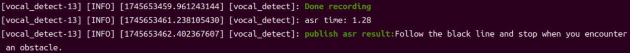

(1) Open the command line terminal from the left side of the system interface. In the terminal window, enter the following command and press Enter to stop the auto-start service
(2) Enter the following command and press Enter to launch the autonomous line following feature.
ros2 launch large_models_examples llm_visual_patrol.launch.py
(6) For example, saying “Follow the black line and stop when you encounter an obstacle” will trigger the voice device to process the command. Upon successful recognition by the speech recognition service of cloud-based large speech model, the parsed command will be displayed under the publish_asr_result output in the terminal.
(7) Upon receiving user input shown in the figure, the terminal will display output indicating that the cloud-based large language model has been successfully invoked. The model will interpret the command, generate a language response, and execute a corresponding action based on the meaning of the command.

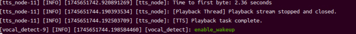

(8) When the terminal shows the output shown in the figure indicating the end of one interaction cycle, the system is ready for the next round. To initiate another interaction, repeat step 4 by speaking the wake words again.
(9) To exit the feature, press Ctrl+C in the terminal. If the feature does not exit immediately, press Ctrl+C multiple times.

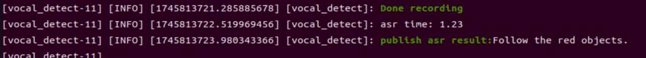

(4) After the program has loaded successfully, the camera feed will appear on screen.
(5) When the terminal displays the corresponding output shown in the figure and the device responds with “I’m here”, it indicates successful activation. The system will begin recording the user’s voice command.
(6) Speak the command “Follow the red object” to the voice device.

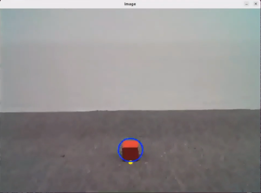

(8) Then, the robot will detect the red object in its camera feed and begin tracking it in real time.
(9) When the terminal shows the output shown in the figure indicating the end of one interaction cycle, the system is ready for the next round. To initiate another interaction, repeat step 4 by speaking the wake words again.

(2) Prompt Template Definition
61
    PROMPT = '''
**Role
You are an intelligent companion robot. Your job is to generate corresponding JSON commands based on the user's input.
**Requirements
- For every user input, search the action function library for matching commands and return the corresponding JSON instruction.
- Craft a witty, ever-changing, and concise response (between 10 to 30 characters) for each action sequence to make interactions lively and fun.
- Output only the JSON result — do not include explanations or any extra text.
- Output format:{"action": ["xx", "xx"], "response": "xx"}
**Special Notes
The "action" key holds an array of function name strings arranged in execution order. If no match is found, return an empty array [].
The "response" key must contain a cleverly worded, short reply (10–30 characters), adhering to the tone and length guidelines above.
**Action Function Library
Track an object of a specific color: color_track('red')
**Example
Input: Track a green object
Output:
{"action": ["color_track('green')"], "response": "Got it!"}

(3) When the terminal displays output shown in the figure and the Circular Microphone Array announces “I’m Ready”, the device has completed initialization. Then, you can say the wake words: “Hello Hiwonder”.
(4) When the terminal displays the corresponding output shown in the figure and the device responds with “I’m Here”, it indicates successful activation. The system will begin recording the user’s voice command.
(5) When the terminal displays the next output as the reference image, it shows the recognized speech transcribed by the device.
The system will begin recording the user’s voice command, and you can say the command “Tell me what you saw” and wait for the large model to process the input.
(6) Upon successful recognition by the speech recognition service of cloud-based large speech model, the parsed command will be displayed under the publish_asr_result output in the terminal.

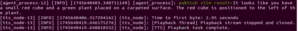

(7) Upon receiving user input shown in the figure, the terminal will display output indicating that the cloud-based large language model has been successfully invoked. The model will interpret the command and generate a language response.

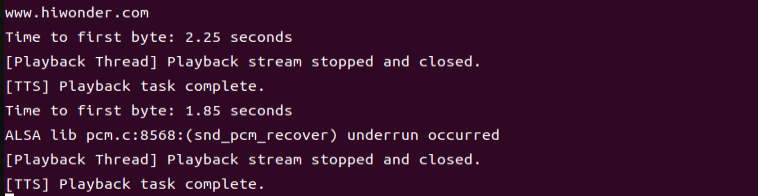

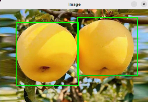

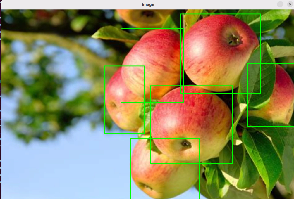

  • Project Outcome
Once the feature is active, speaking a command such as “Tell me what you saw” prompts the robot to autonomously analyze its visual environment and describe the current scene based on its observations.

(1) Version Confirmation

(3) When the terminal displays output shown in the figure and the Circular Microphone Array announces “I’m Ready”, the device has completed initialization and yolov8 model will be initialized at the same time. Then, you can say the wake words: “Hello Hiwonder”.
The system will begin recording the user’s voice command, and you can say the command “Follow the person in white in front” and wait for the large model to process the input.
(5) Upon successful recognition by the speech recognition service of cloud-based large speech model, the parsed command will be displayed under the publish_asr_result output in the terminal.

  • Project Outcome
Once the feature is activated, natural language commands such as “Follow the person in white in front.” can be used. The robot will identify the person wearing white in the camera view and begin following them. It will automatically stop once a certain distance has been reached.

    PROMPT = '''
**Role
You are a smart car with advanced visual recognition capabilities. Your task is to analyze an image sent by the user, perform object detection, and follow the detected object. Finally, return the result strictly following the specified output format.
Step 1: Understand User Instructions
You will receive a sentence. From this sentence, extract the object name to be detected.
Note: Use English for the object value, do not include any objects not explicitly mentioned in the instruction.
Step 2: Understand the Image
You will also receive an image. Locate the target object in the image and return its coordinates as the top-left and bottom-right pixel positions in the form [xmin, ymin, xmax, ymax].
Note: If the object is not found, then "xyxy" should be an empty list: [], only detect and report objects mentioned in the user instruction.The coordinates (xmin, ymin, xmax, ymax) must be normalized to the range [0, 1]
**Important: Accurately understand the spatial position of the object. The "response" must reflect both the user's instruction and the detection result.
**Output Format (strictly follow this format, do not output anything else.The coordinates (xmin, ymin, xmax, ymax) must be normalized to the range [0, 1])
    "object": "name",
    "xyxy": [xmin, ymin, xmax, ymax],
    "response": "reflect both the user's instruction and the detection result (5–30 characters)"
**Example
Input: track the person
Output:
    "object": "person",
    "xyxy": [0.1, 0.3, 0.4, 0.6],
    "response": "I have detected a person in a white T-shirt and will track him now."
It defines a prompt string (PROMPT) used to guide how user commands and image data are processed. It specifies the recognition task logic and expected output format.

① while self.running: ensures continuous data processing while the node is active.
② if self.vllm_result: checks whether a new VLLM response has been received.
③ Json.loads(self.vllm_result): parses the received JSON-formatted string into a dictionary for easier data extraction.
④ Extracting response and xyxy:
response = self.vllm_result['response']: retrieves the text message for TTS (Text-to-Speech) playback.
box = self.vllm_result['xyxy']: retrieves the bounding box coordinates returned from object detection.
⑤ Processing Bounding Box Data:
If a target is detected and the box is not empty, the method calls self.client.data_process to normalize the coordinates using a frame size of 640 by 480. It then converts the coordinates into the format [xmin, ymin, width, height], scales them based on the display window size, and stores the result in self.box for tracking.
⑥ Sending TTS Response:
A String message is created and the extracted response is sent to the TTS node for speech playback.
⑦ Error Handling:
If a ValueError or TypeError occurs during parsing or extraction, the target info is cleared, and the original vllm_result is sent to the TTS node as plain text.
⑧ State Updates:
self.vllm_resultis reset to an empty string to indicate the response has been processed.
self.action_finish is set to True to mark that the action has been completed.
⑨ Loop Wait Mechanism:
If no new vllm_result is received, the loop sleeps for 20 ms using time.sleep(0.02) to avoid high CPU usage.
⑩ Subsequent Service Request: when both self.play_audio_finish and self.action_finish are True, related flags are reset.
A service request is sent via self.send_request(self.set_mode_client, msg) to set the mode to 2, allowing target tracking to begin.
self.stop is updated to False, lifting the pause on target tracking.

def display_thread(self):
    # Create a new CUDA context in the current thread(在当前线程创建一个新的 CUDA 上下文)
    dev = cuda.Device(0)
    ctx = dev.make_context()
        model_path = os.path.split(os.path.realpath(__file__))[0]
        self.get_logger().info('model_path: %s' % model_path)
        back_exam_engine_path = os.path.join(model_path, "resources/models/nanotrack_backbone_exam.engine")
        back_temp_engine_path = os.path.join(model_path, "resources/models/nanotrack_backbone_temp.engine")
        head_engine_path = os.path.join(model_path, "resources/models/nanotrack_head.engine")
        tracker = Tracker(back_exam_engine_path, back_temp_engine_path, head_engine_path)
        while self.running:
            image = cv2.resize(image, tuple(display_size))
            if self.box:
                self.track.set_track_target(tracker, self.box, image)
                self.start_track = True
                self.box = []
            if self.start_track:
                self.data = self.track.track(tracker, image, depth_image)
                image = self.data[-1]
                twist = Twist()
            self.fps.update()
            self.fps.show_fps(image)
            cv2.imshow('image', image)
            key = cv2.waitKey(1)
            if key == ord('q') or key == 27:  # Press Q or Esc to quit(按q或者esc退出)
                self.running = False
            if not self.set_above:
                self.set_above = True
        cv2.destroyAllWindows()
    finally:
        # Ensure the context is properly released(确保上下文被正确释放)
        ctx.pop()
while self.running: controls the thread’s runtime, and the thread continuously processes image data as long as self.running is True.
image, depth_image = self.image_queue.get(block=True): fetches the latest RGB and depth images from the thread-safe queue to ensure synchronized data processing.
cv2.resize: resizes the retrieved images to the predefined display_size for easier processing and visualization.
if self.box: checks if a new detection bounding box (box) is available. If available, the method calls self.track.set_track_target(self.box, image) to set the current tracking target in the image, sets self.start_track = True, and clears self.box.
if self.start_track: verifies if target tracking has been initiated. If True, it calls self.track.track(image, depth_image) to obtain the tracking result, which is then stored in self.data.
Use of self.data: the first two values in the tracking result usually represent control commands, such as linear and angular velocity. The last element is the image annotated with the tracking results, which is used for display.
⑦ Construct and Publish Twist Messages: a Twist message is constructed using control commands extracted from self.data and published via self.mecanum_pub.publish(twist) to control the movement of the robot base.
self.fps.update and self.fps.show_fps: update the frame rate statistics and overlay the current FPS on the image for real-time performance monitoring.
cv2.imshow: display the processed image in a window to provide a visual representation of the target tracking status.
cv2.waitKey: wait for keyboard input. If the user presses the q or ESC key, the tracking thread is stopped and a stop-motion Twist message is sent to halt the robot.
⑪ Window on Top Handling: The display window is repositioned using cv2.moveWindow, and the command os.system("wmctrl -r image -b add,above") sets the window to stay on top, ensuring it’s always visible.
cv2.destroyAllWindows:after the tracking thread exits, all OpenCV-created windows are closed to complete the cleanup process.

① Before starting this feature, verify that the correct microphone configuration is set in the system.
② Log in to the machine remotely via NoMachine. Then click the desktop icon to access the configuration interface.
③ First, verify the system language setting.
④ For the Six-Microphone Circular Array, select xf as the microphone type as shown in the figure.
⑤ After making the appropriate selection, click Save.
⑥ A “Save Success” message will confirm that the configuration has been stored in the system environment.
⑦ Then, click Quit to close the interface.

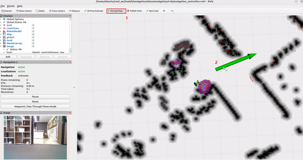

① Open the command line terminal from the left side of the system interface. In the terminal window, enter the following command and press Enter to stop the auto-start service
② Enter the following command and press Enter to launch the feature.

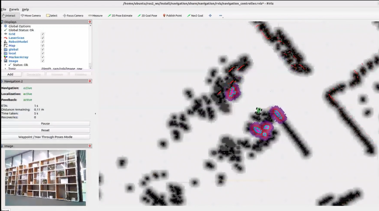

ros2 launch large_models_examples vllm_navigation.launch.py map:=map_01

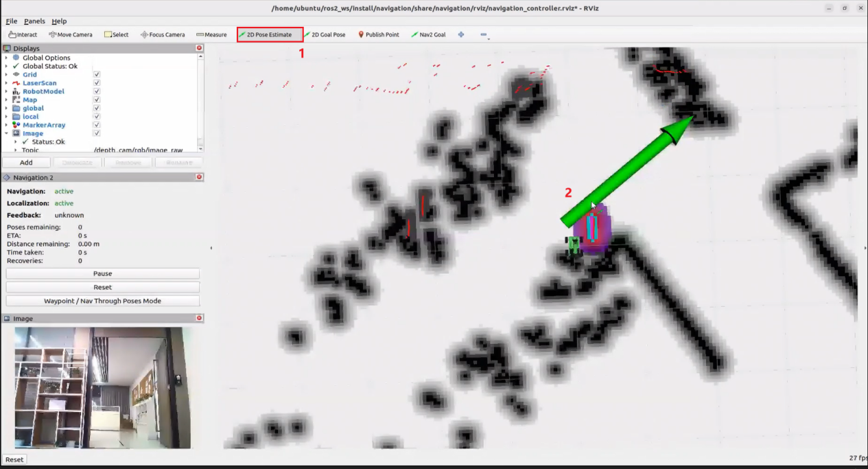

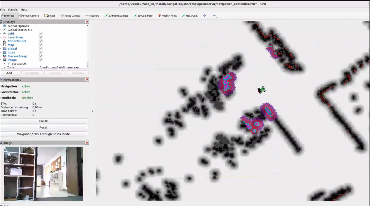

③ Once rviz is launched with the map, click on the 2D Pose Estimate icon to initialize the robot’s position and orientation based on its actual location on the map.

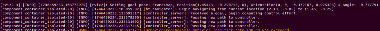

④ When the terminal displays the corresponding output shown in the figure and the device responds with “I’m Here”, it indicates successful activation.
Speak a command such as “Go to the kitchen to see if the door is closed, then will come to tell me.” The voice device will capture the speech, and the large language model will process the command.
⑤ Upon successful recognition by the speech recognition service of cloud-based large speech model, the parsed command will be displayed under the publish_asr_result output in the terminal.
⑥ Upon receiving user input shown in the figure, the terminal will display output indicating that the cloud-based large language model has been successfully invoked. The model will interpret the command, generate a language response, and execute a corresponding action based on the meaning of the command.
⑦ The robot will move to the designated “kitchen” location as defined in the program, detect whether the door is closed.
⑧ Then return to the original position and state whether “the door is closed”.

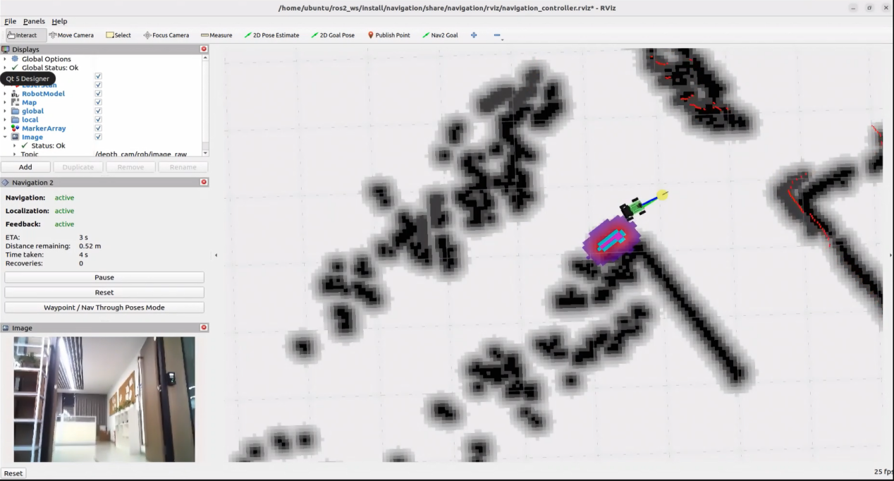

⑨ When the terminal shows the output shown in the figure indicating the end of one interaction cycle, the system is ready for the next round. To initiate another interaction, repeat step 5 by speaking the wake words again.
⑩ To exit the feature, press Ctrl+C in the terminal. If the feature does not exit immediately, press Ctrl+C multiple times.

  • Modifying Navigation Locations
To change the robot’s navigation targets, modify the relevant parameters in the following file:
/home/ubuntu/ros2_ws/src/large_models_examples/large_models_examples/vllm_navigation.py
① Begin by launching the program and displaying the map in rviz following step 4 above. Then, click on “2D Goal Pose” in the rviz interface to set the desired navigation target on the map.
② Return to the terminal to view the published goal parameters. Once you obtain the target coordinates, you can fill in the x and y values and related parameters accordingly.
Locate the corresponding section of the code shown below, and fill in your target location parameters after the appropriate location name.
The positions of different navigation targets in the program are relative to the robot’s starting point during the map-building process. The five parameters represent:
x: position on the x-axis (meters)
y: position on the y-axis (meters)
roll: rotation around the x-axis (degrees)
pitch: rotation around the y-axis (degrees)
yaw: rotation around the z-axis (degrees)
Taking “kitchen” as an example, if the robot’s target position is set to [1.45, -0.29, 0.0, 0.0, 0.0], it means that the robot will navigate to the “kitchen” location on the map.
To modify the robot’s target orientation:
The retrieved quaternion has been printed as Orientation (0, 0, -0.379167, 0.925328) = Angle: -0.777791 in radians. Convert this quaternion to Euler angles (roll, pitch, yaw), and the result is approximately roll ≈ 0°, pitch ≈ 0°, and yaw ≈ −44.56°, or converting the radian value directly to degrees gives −44.58°.
The final modified target position for “kitchen” is [1.45, -0.29, 0.0, 0.0, −44.58].

    position_dict = {"kitchen": [2.8, -2.8, 0.0, 0.0, 0.0], #xyzrpy, m,deg
                     "front desk": [2.8, -2.7, 0.0, 0.0, 0.0],
                     "bedroom": [0.0, 0.0, 0.0, 0.0, 0.0],
                     "zoo": [1.3, 0.37, 0.0, 0.0, 0.0],
                     "space base": [1.58, -0.74, 0.0, 0.0, -48.0],
                     "football field": [0.32, -0.65, 0.0, 0.0, -90.0],
                     "origin": [0.0, 0.0, 0.0, 0.0, 0.0],
                     "home": [0.1, 0.4, 0.0, 0.0, 0.0]
    LLM_PROMPT = '''
**Role
You are a smart navigation vehicle equipped with a camera and speaker. You can move to different places, analyze visual input, and respond by playing audio. Based on user input, you need to generate the corresponding JSON command.
**Requirements
- For any user input, look up corresponding functions from the Action Function Library, and generate the proper JSON output.
- For each action sequence, include a concise (5–20 characters) and witty, varied response to make the interaction lively and engaging.
- Output only the JSON result, no analysis or extra text.
- Output format:
  "response": "xx"
**Special Notes
The "action" field contains an ordered list of function names to be executed in sequence. If no matching function is found, return: "action": [].
The "response" field should contain a carefully crafted, short, humorous, and varied message (5–20 characters).
Move to a specified place: move('kitchen')
Return to starting point: move('origin')
Analyze current view: vision('What do you see?')
Play audio response: play_audio()
**Example
Input: Go to the front desk to see if the door is closed, and then come back and tell me
Output:
  "action": ["move('front desk')", "vision('Is the door closed?')", "move("origin")", "play_audio()"],
  "response": "On it, reporting soon!"

NavigationController Class
class NavigationController(Node):
    markerArray = MarkerArray()
    def __init__(self, name):
        rclpy.init()
        self.goal_pose = PoseStamped()
        self.navigator = BasicNavigator()
        self.map_frame = 'map'#self.get_parameter('map_frame').value
        self.nav_goal = '/nav_goal'#self.get_parameter('nav_goal').value
        self.goal_pub = self.create_publisher(PoseStamped, '/goal_pose', 1)
        self.nav_pub = self.create_publisher(PoseStamped, self.nav_goal, 1)
        self.mark_pub = self.create_publisher(MarkerArray, 'path_point', 1)
        self.reach_pub = self.create_publisher(Bool, '~/reach_goal', 1)
        self.create_subscription(PoseStamped, self.nav_goal, self.goal_callback, 1, callback_group=timer_cb_group)
        self.create_service(SetPose2D, '~/set_pose', self.move_srv_callback)
        self.navigator.waitUntilNav2Active()
rclpy.init(): initializes the ROS 2 system.
super()._init_(name): call the parent Node class constructor to create a ROS 2 node.
self.create_subscription: subscribe to navigation goal poses.
self.create_client: create service clients.
self.timer: create a timer.
self.goal_pose: store the navigation goal pose.
self.navigator: navigator object.
self.map_frame: name of the map coordinate frame.
self.nav_goal: topic name for navigation goals.
self.goal_pub: publisher for goal poses.
self.nav_pub: publisher for navigation goals.
self.mark_pub: publisher for markers.
self.reach_pub: publisher for goal-reached messages.
self.create_service: create service servers.

goal_callback Method
110
111
112
113
114
115
116
117
118
119
120
121
122
123
124
125
126
127
128
129
130
131
132
133
134
135
136
137
138
139
140
141
142
143
144
145
146
147
148
149
150
151
152
153
154
155
def goal_callback(self, msg):
    # Obtain the navigation point to be published(获取要发布的导航点)
    self.get_logger().info('\033[1;32m%s\033[0m' % str(msg))
    self.navigator.goToPose(msg)
    i = 0
    # feedback = self.navigator.getFeedback()
    # total_time = Duration.from_msg(feedback.estimated_time_remaining).nanosecond / 1e9
    # self.get_logger().info('\033[1;32m%s\033[0m' % 'total_time')
    while not self.navigator.isTaskComplete():
        i = i + 1
        # self.get_logger().info(f'{feedback.navigation_time} {feedback.estimated_time_remaining}')
        if feedback and i % 5 == 0:
                # 'Estimated time of arrival: '
                # + '{0:.0f}'.format(
                    # Duration.from_msg(feedback.estimated_time_remaining).nanoseconds
                    # / 1e9
                # + ' seconds.'
            # Some navigation timeout to demo cancellation
            if Duration.from_msg(feedback.navigation_time) > Duration(seconds=600.0):
                self.get_logger().info('\033[1;32m%s\033[0m' % 'timeout...')
                self.navigator.cancelTask()
            # Some navigation request change to demo preemption
            # if Duration.from_msg(feedback.navigation_time) > Duration(seconds=36.0):
                # self.get_logger().info('\033[1;32m%s\033[0m' % 'preempt...')
                # self.goal_pub.publish(self.goal_pose)
        # self.get_logger().info('\033[1;32m%s\033[0m' % 'feedback')
    # Do something depending on the return code
    result = self.navigator.getResult()
    if result == TaskResult.SUCCEEDED:
        self.get_logger().info('Goal succeeded!')
        msg = Bool()
        msg.data = True
        self.reach_pub.publish(msg)
    elif result == TaskResult.CANCELED:
        self.get_logger().info('Goal was canceled!')
    elif result == TaskResult.FAILED:
        self.get_logger().info('Goal failed!')
        self.get_logger().info('Goal has an invalid return status!')
Receives and processes a navigation goal message, triggering the robot to navigate and monitoring task status in real time. It handles timeout and preemption, and publishes feedback based on the final result.
① Receive and Log the Goal
At the beginning of the function, log the received goal message.
② Start the Navigation Task
Call self.navigator.goToPose(msg) to pass the received goal to the navigator and initiate the robot move towards the goal point.
③ Real-Time Navigation Monitoring
Enter a while loop to continuously check whether the task is complete.
Use a counter i to throttle the frequency of feedback checking, for example, check every 5 iterations.
feedback = self.navigator.getFeedback(): get current navigation feedback.
Timeout Handling: If feedback.navigation_time exceeds 600 seconds, consider the task timed out and log “timeout…”, and call self.navigator.cancelTask() to cancel the navigation.
Preemption Handling: If the navigation time exceeds 36 seconds, log “preempt…” and re-publish the goal via self.goal_pub with self.goal_pose. This is often used in demo settings or to support task preemption or switching.
④ Result Handling After Task Completion
When self.navigator.isTaskComplete() returns True, exit the loop and retrieve the final result using result = self.navigator.getResult().
Determine Final Outcome
If the task succeeded TaskResult.SUCCEEDED), log “Goal succeeded!” and publish a Bool message with value True to notify other nodes that the goal was reached.
If the task was canceled or failed, log “Goal was canceled!” or “Goal failed!” respectively.
If the result has an unknown status, log “Goal has an invalid return status!”.
This function implements a full navigation task workflow: receiving the goal, initiating navigation, monitoring progress, handling timeouts or preemption, and publishing results based on the outcome.
