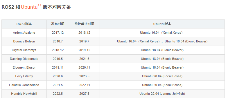

4.1.2 Version Options
Different versions of ROS2 are installed on different versions of Ubuntu. In this section, we will use the virtual machine with Ubuntu 20.04, which corresponds to ROS2 Foxy.

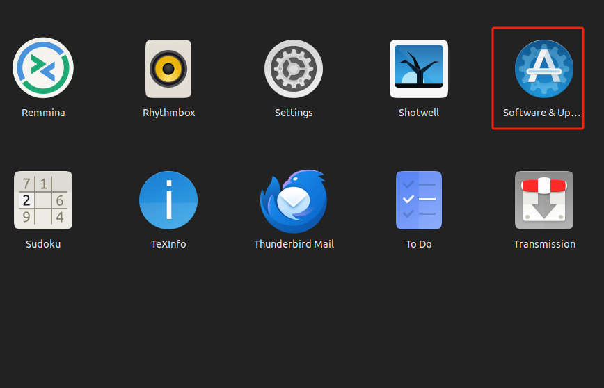

4.1.3 Check Ubuntu’s Software and Update Sources
(1) Locate ‘System&Update’.

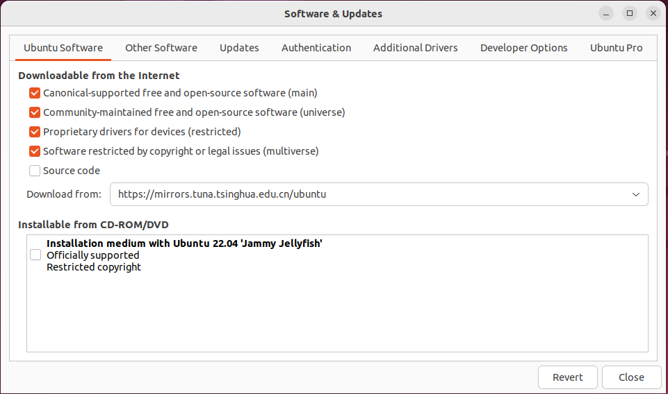

(2) Make sure to check the option for internet downloads and change the download source to the local region’s source.

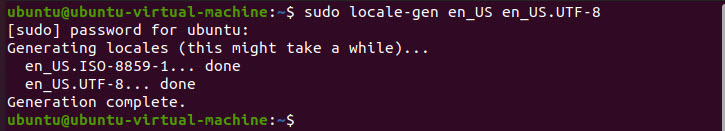

(2) Input
sudo locale-gen en_US en_US.UTF-8
Set the Ubuntu locale to en_US.UTF-8. After entering the command, press Enter, then enter the virtual machine’s password, “hiwonder” (users should enter the password they have set for their own virtual machine; in our case, the password is “hiwonder”).

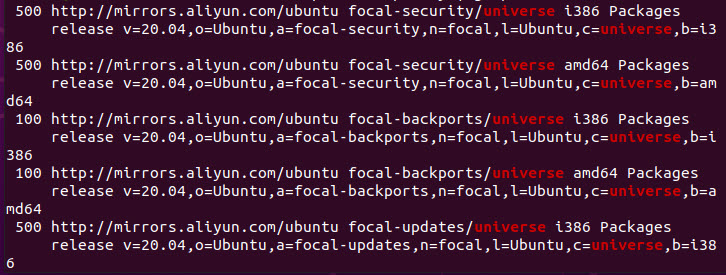

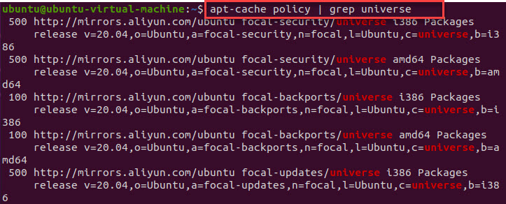

  • Enable the Ubuntu Universe Repository
(1) Enter the command to check if the Universe repository is enabled:
apt-cache policy | grep universe
(2) If the output is as follows, it indicates that it has been enabled, and you can proceed to configure it further in 4.1.4 Set Encoding Format.
(3) If you see the following prompt, it means it has not been enabled.

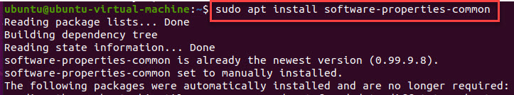

(4) Enter the command to install the software package “software-properties-common”:
sudo apt install software-properties-common
(5) Enter the command to add the PPA to the Universe repository and automatically import the public key:
sudo add-apt-repository universe
(6) You can enter the command again to check if it has been enabled:

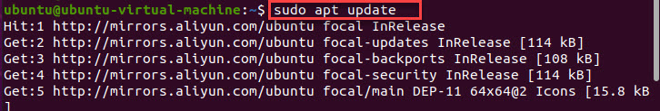

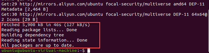

(1) Enter the command to update the software installation packages:
sudo apt update
(2) After the update is complete, it will appear as shown in the following image.

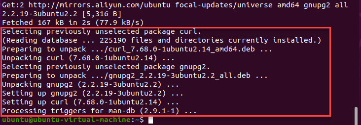

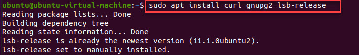

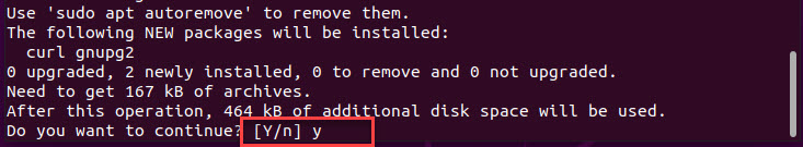

(3) Enter the command to install the curl and gnupg tools:
sudo apt install curl gnupg2 lsb-release
(4) During the installation process, if you see the prompt as shown in the following image, simply enter “y” and press Enter.
(5) After the installation is complete, it will appear as shown in the following image:

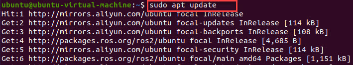

(1) Enter the below command to update the software feature pack.
sudo apt update
(2) After the update is complete, it will appear as shown below.

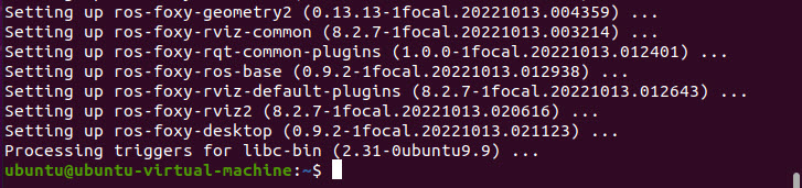

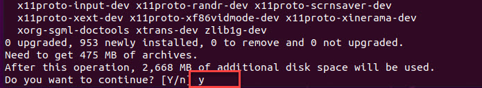

(3) Run the below command:
sudo apt install ros-foxy-desktop
Press Enter. When prompted whether to install, type “y” and press Enter again. Wait for the download and installation to complete. Depending on your network conditions, this process may take about 10 minutes, so please be patient.
(4) After the installation is complete, it will appear as shown below.

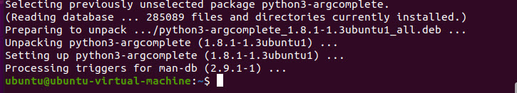

4.1.7 Install Additional Dependency

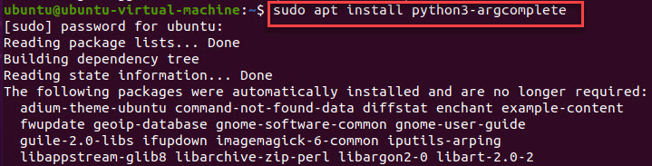

(1) Enter the command, press Enter, and input the virtual machine password “hiwonder” to install the autocomplete tool:
sudo apt install python3-argcomplete

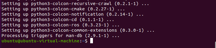

(2) After the installation is complete, it will appear as shown below.
(3) Input the following command and hit Enter key to install the compilation tool. Then enter ‘y’ to confirm the installation.
sudo apt install python3-colcon-common-extensions

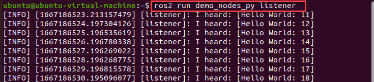

4.1.9 Test ROS2 System

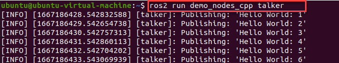

(1) Enter the command to run a talker.
ros2 run demo_nodes_cpp talker
(2) Press “Ctrl+Alt+T” to open a new terminal, then enter the command to run a listener.
ros2 run demo_nodes_py listener
(3) Press “Ctrl+C” to stop the execution. If stopping fails, you can repeat pressing “Ctrl+C” multiple times until it stops.

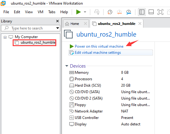

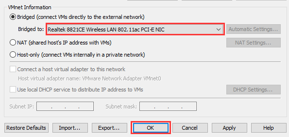

(1) Open virtual machine .
(2) Click-on Edit and choose Virtual Network Editor.
(3) Tick ‘Bridged’, and choose the corresponding wireless network card.
(4) Select the imported virtual machine, then click on ‘Power on this virtual machine’.

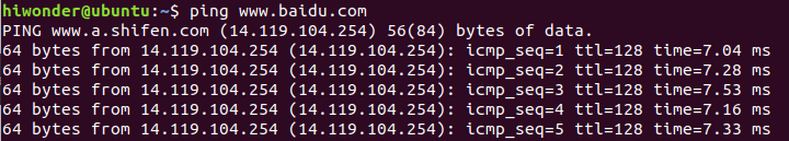

(6) Enter command to check whether the network connection is successful.
ping www.baidu.com
If the terminal prints following content, that means network connection is successful.
If it shows that “Name or service not known”, that means virtual machine fails to connect to the network.

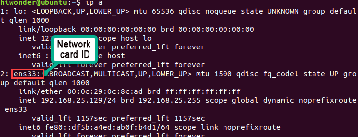

Execute this step only when network connection is failed. Enter command “ip a” to check the ID of network card.
(1) Execute this step only when network connection is failed. Enter command and press Enter. “ens33” is the ID of network card. You need to modify the entered command based to suit the specific case at hand.
sudo dhclient ens33
Repeat step (6). If the terminal prints following content, that means network connection is successful.

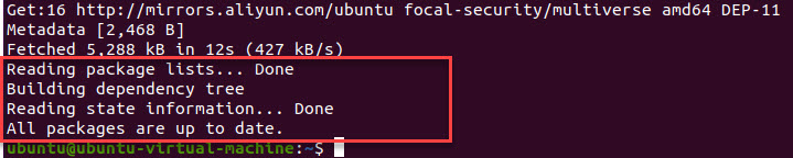

(1) Run the command below to update apt library.
sudo apt update
After update, the following messages will occur.

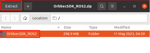

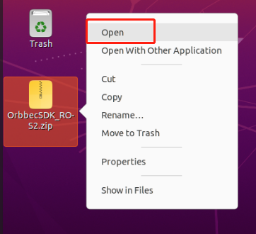

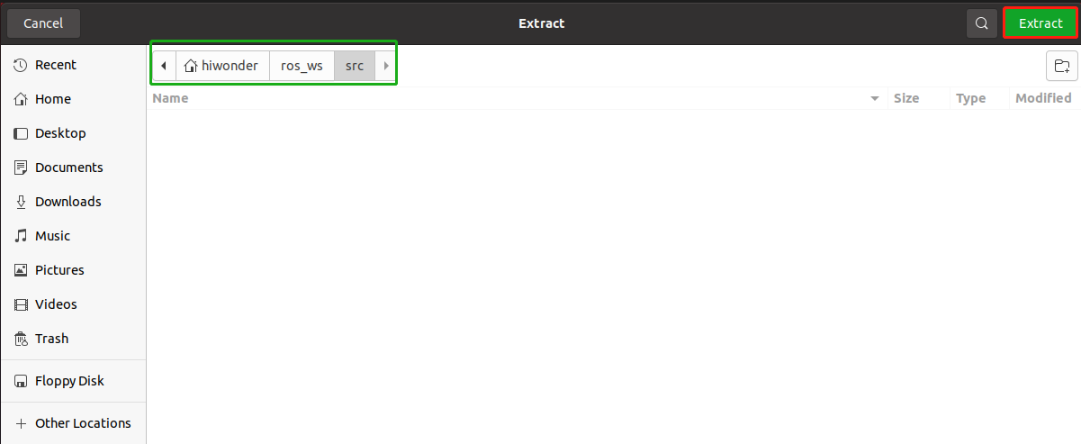

(1) Copy the file OrbbecSDK_ROS2.zip to the virtual machine.
(2) Right-click the package and select ‘Open’.
(3) Click on the folder and then click “Extract” to extract the folder into the workspace.
The green box represents the workspace path. Click “Extract” to extract.

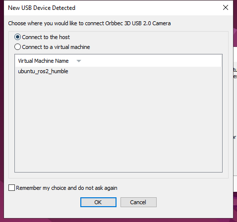

(1) Attach the depth camera to the computer and establish its connection with the virtual machine.

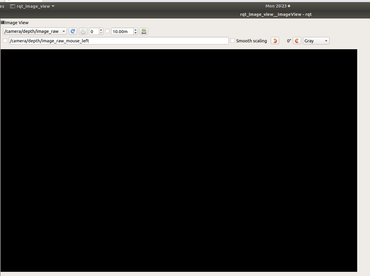

We offer two approaches for image visualization. One option involves utilizing rqt_image_view to observe 2D images, while the alternative is to employ rviz for visualizing 3D images. Users are free to select the method that aligns with their particular needs. It is crucial to emphasize that during image viewing, the camera service should remain active and not be closed.

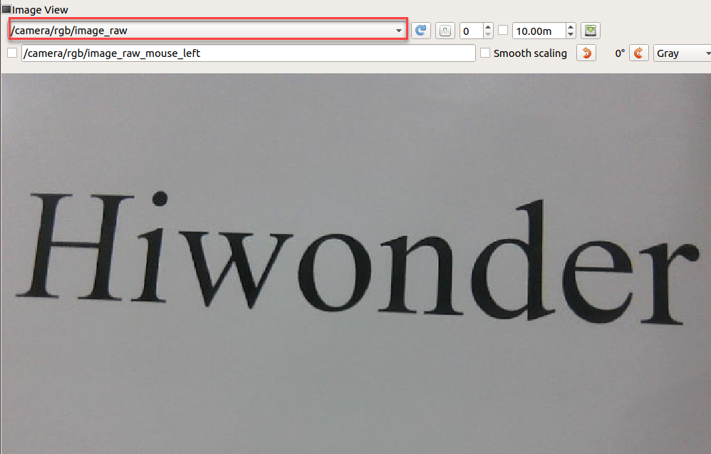

4.4.2 View Image Using rqt_image_view Tool

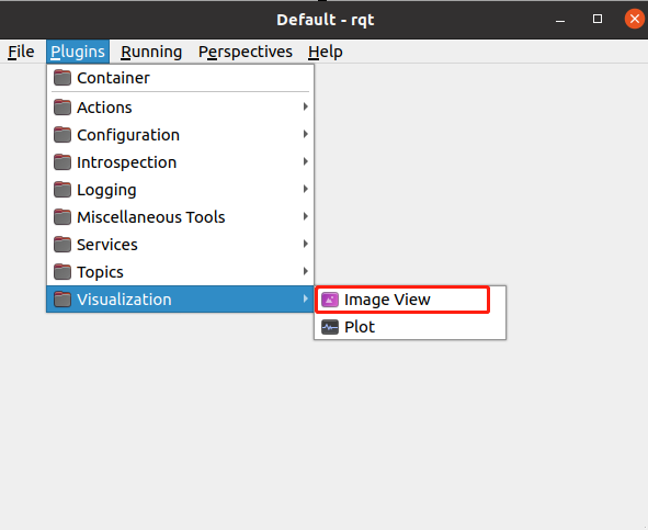

(1) Open a new terminal, and execute the command below to start the image viewing tool.
rqt
When the below interface appears, it means that the tool is started successfully.
Select “Plugins -> Visualization -> Image View”.

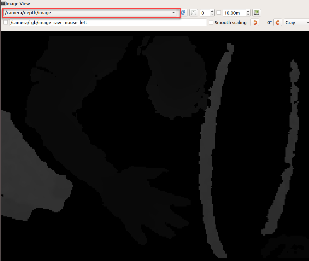

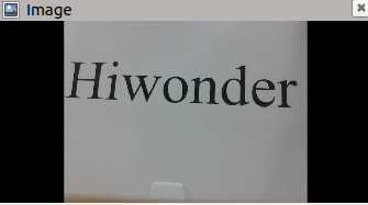

(2) To view the infrared image, please select the corresponding topic.
(3) When viewing the depth map, the red box position needs to be set as shown in the following figure:

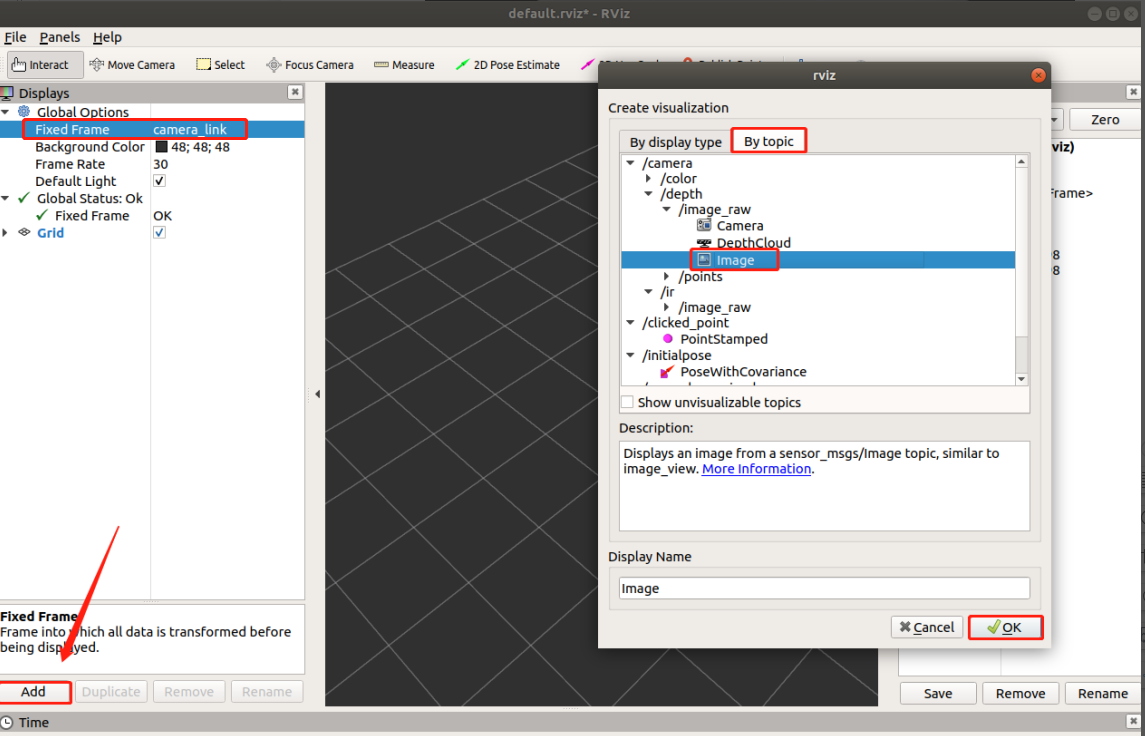

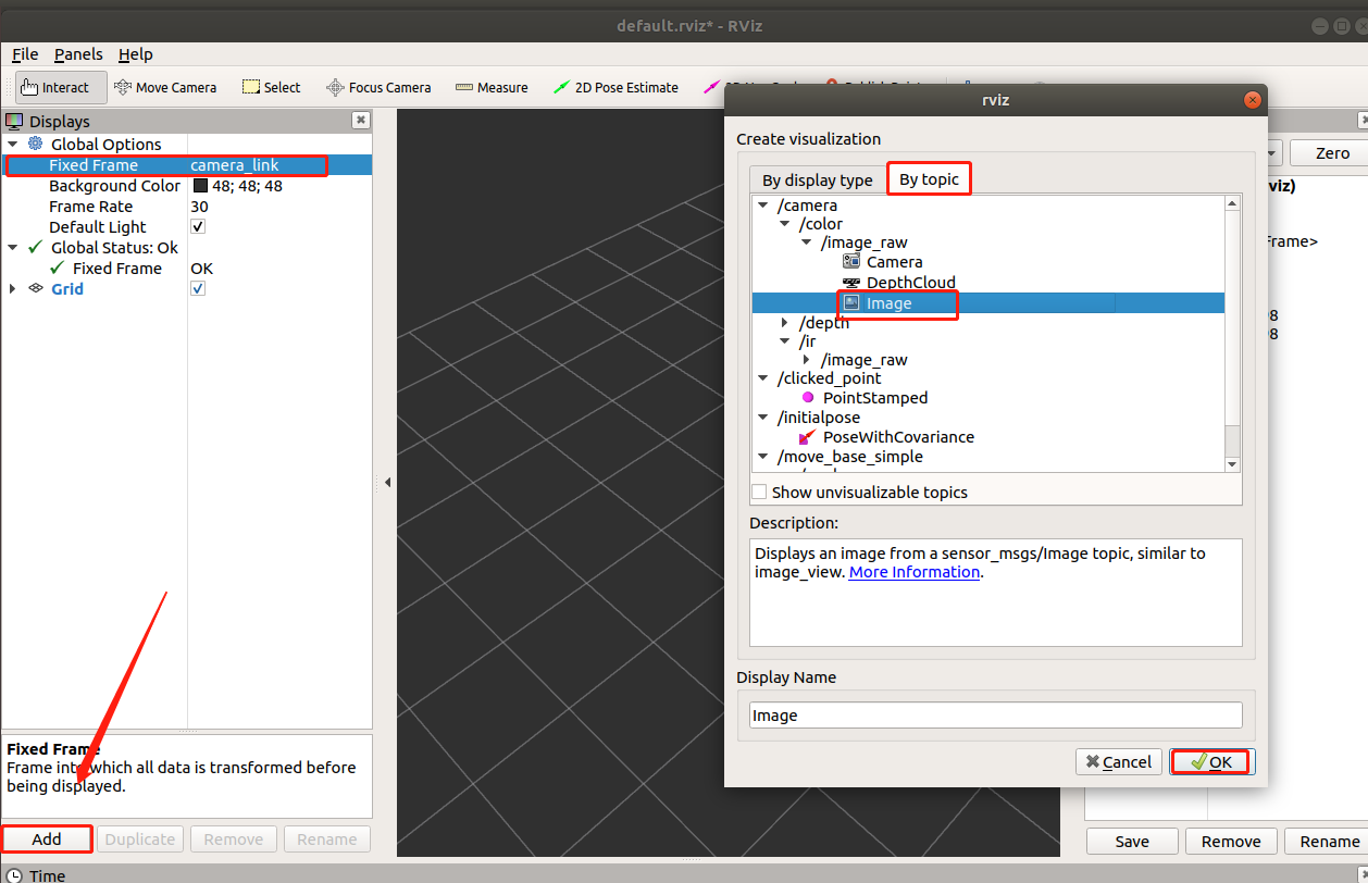

4.4.3 View Image Using rviz

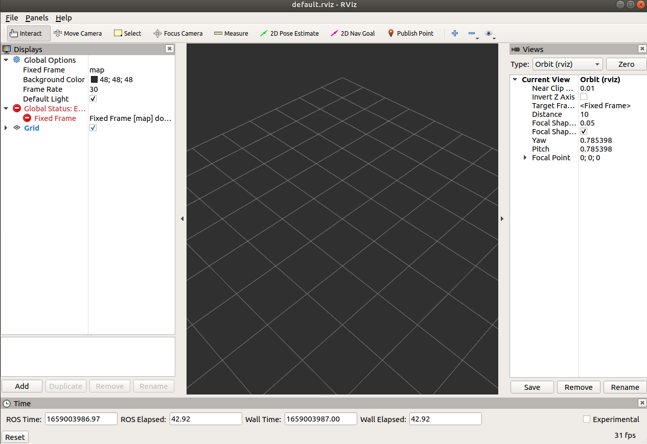

(1) Execute the command to initiate the tool.
ros2 run rviz2 rviz2
(2) To access the camera feed, start by configuring the “Fixed Frame” to “camera_link.” Then, click on “Add,” select “By topic -> camera -> color -> Image_raw -> Image,” and finally, click “OK.”
When the interface below appears, it indicates that the tool has been successfully launched.
(3) To view the depth map, set ‘Fixed Frame’ as ‘camera_link’, then click-on ‘Add’ to select ‘By topic ->camera->depth->Image_raw->Image’, and click-on ‘OK’.

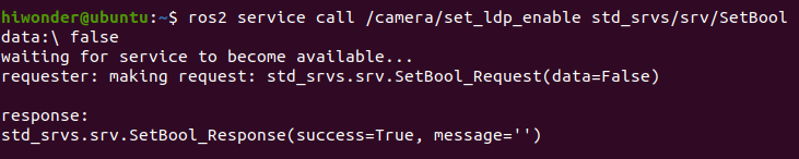

(3) Open a new command-line terminal, and execute the command to close LDP protection.
ros2 service call /camera/set_ldp_enable std_srvs/srv/SetBool data:\ false
At this stage, the image remains visible even as an object approaches the camera.

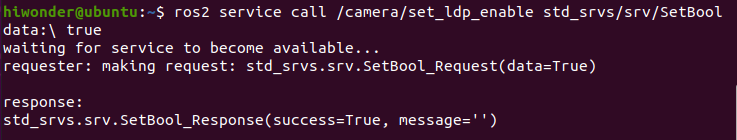

(4) Execute the command to initiate LDP protection.
ros2 service call /camera/set_ldp_enable std_srvs/srv/SetBool data:\ true

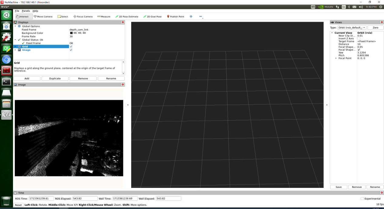

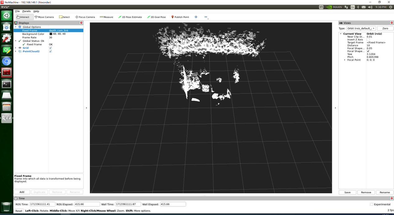

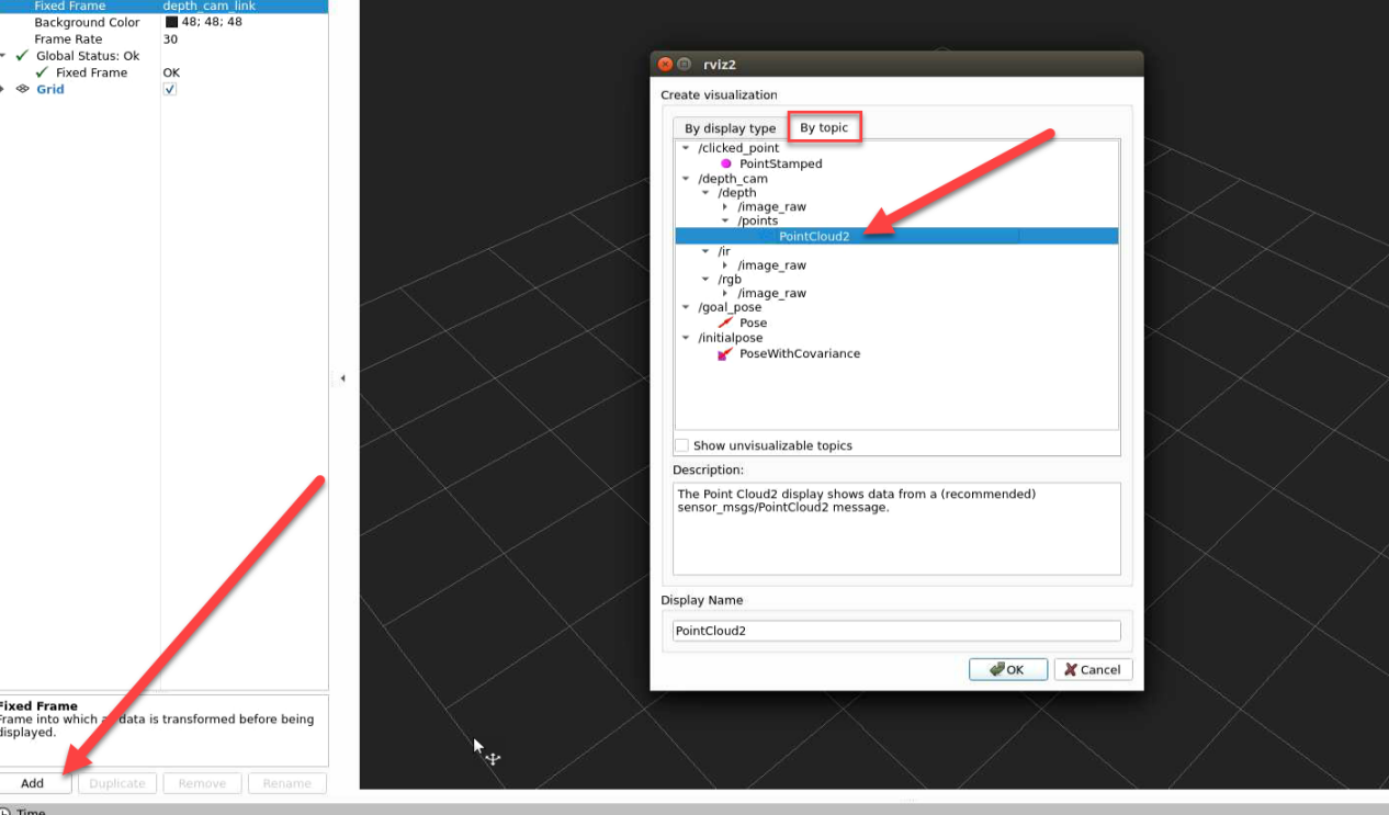

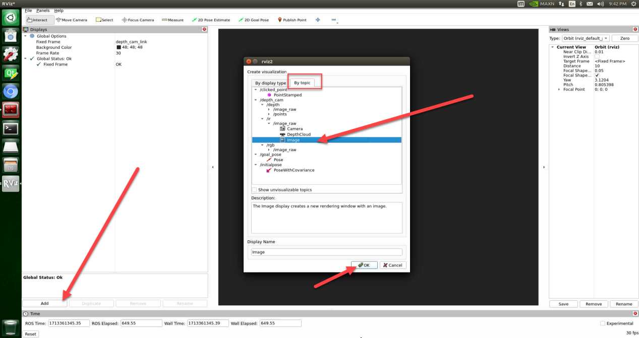

(4) Open a new command-line terminal, and run the following command to open the point cloud view of the depth camera.
(5) Open a new command-line terminal and execute the below command to initiate rviz.
rviz2

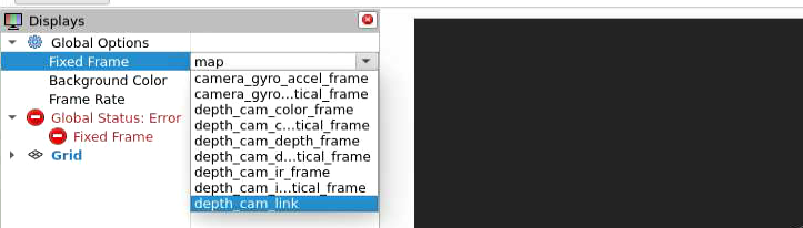

(6) Choose ‘depth_cam_link’.
(7) As shown in the image, click Add -> By topic -> depth_cam -> depth -> points -> PointCloud2, and then click OK.
Once you’ve completed the previous settings, the point cloud will become visible.
  • Depth Camera Infrared Image
When entering commands, it’s important to strictly observe capitalization, and you can use the “Tab” key to autocomplete keywords.
(1) Start the robot, and access the ubuntu desktop using the software NoMachi.
(3) Enter the command below and hit Enter key to disable the app auto-start service.
(4) Open a new command prompt, enter the command to open the depth camera point cloud view:
(5) Open a new command-line terminal, then enter the command ‘rviz2’ to activate the tool rviz.
(6) Choose “depth_cam_link”.
(7) Click on “Add->By topic->depth_cam->ir->image_raw->image”. Finally, click-on ‘OK’ button.
The picture below will appear.
