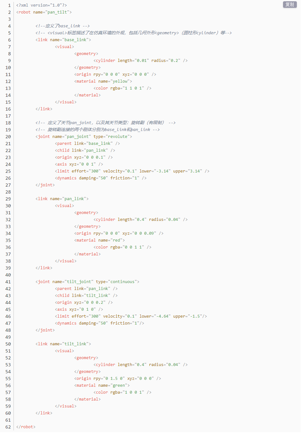

(6) Write Simple URDF Model
Name the model of the robot
To start writing the URDF model, we need to set the name of the robot following this format: “<robot name="robot model name">”. Lastly, input “</robot>” at the end to represent that the model is written successfully.
Set links
To write the first link and use indentation to indicate that it is part of the currently set model. Set the name of the link using the following format: “<link name="link name">”. Finally, conclude with “</link>” to indicate the successful completion of the link definition.
Write the link description and use indentation to indicate that it is part of the currently set link, and conclude with </visual>.
The “<geometry>” tag is employed to define the shape of a link. Once the description is complete, include “</geometry>”. Within the “<geometry>” tag, indentation is used to specify the detailed description of the link’s shape. The following example demonstrates a link with a cylindrical shape: “<cylinder length="0.01" radius="0.2"/>”. In this instance, “length="0.01"” signifies a length of 0.01 meters for the link, while “radius="0.2"” denotes a radius of 0.2 meters, resulting in a cylindrical shape.
The “<origin>” tag is utilized to specify the position of a link, with indentation used to indicate the detailed description of the link’s position. The following example demonstrates the position of a link: “<origin rpy="0 0 0" xyz="0 0 0" />”. In this example, “rpy” represents the roll, pitch, and yaw angles of the link, while “xyz” represents the coordinates of the link’s position. This particular example indicates that the link is positioned at the origin of the coordinate system.
The “<material>” tag is used to define the visual appearance of a link, with indentation used to specify the detailed description of the link’s color. To start describing the color, include “<material>”, and end with “</material>” when the description is complete. The following example demonstrates setting a link color to yellow: “<color rgba="1 1 0 1" />”. In this example, “rgba="1 1 0 1"” represents the color threshold for achieving a yellow color.

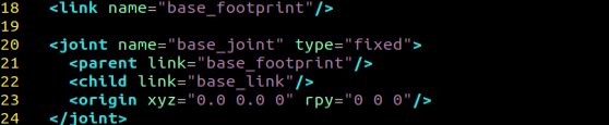

Set joint
To write the first joint, use indentation to indicate that the joint belongs to the current model being set. Then, specify the name and type of the joint as follows: “<joint name="joint name" type="joint type">”. Finally, include “</joint>” to indicate the completion of the joint definition.
to learn about the type of the joint, please refer to “4.2 joint”.
Write the description section for the connection between the link and the joint. Use indentation to indicate that it is part of the currently defined joint. The parent parameter and child parameter should be set using the following format: “<parent link="parent link"/>”, and “<child link="child link" />”. With the parent link serving as the pivot, the joint rotates the child link.
“<origin>” describes the position of the joint using indention. This example describes the position of the joint: “<origin xyz="0 0 0.1" />”. xyz is the coordinate of the joint.
“<axis>” describes the position of the joint adopting indention. “<axis xyz="0 0 1" />” describes one posture of a joint. xyz specifies the pose of the joint.
“<limit>” imposes restrictions on the joint using indention. The below picture The “<limit>” tag is used to restrict the motion of a joint, with indentation indicating the specific description of the joint angle limitations. The following example describes a joint with a maximum force limit of 300 Newtons, an upper limit of 3.14 radians, and a lower limit of -3.14 radians. The settings are defined as follows: “effort="joint force (N)", velocity="joint motion speed", lower="lower limit in radians", upper="upper limit in radians”.
“<dynamics>” describes the dynamics of the joint using indention. “<dynamics damping="50" friction="1" />” describes dynamics parameters of a joint.

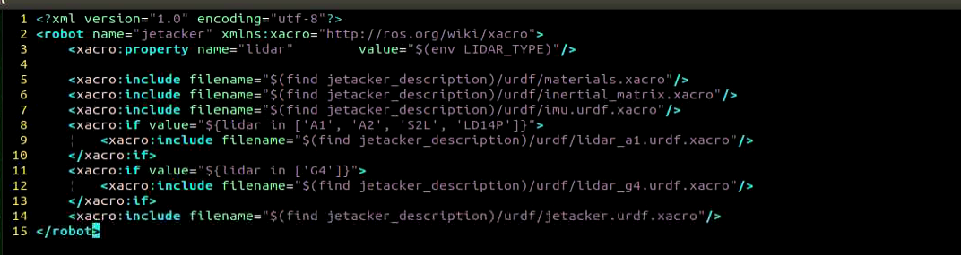

(5) Locate the code below:
Several URDF models are combined to create a full robot:
| File Name | Device |
| materials | Color |
| inertial_matrix | Inertia matrix |
| lidar_a1 | A1 Lidar |
| lidar_g4 | G4 Lidar |
| Imu | Inertial measurement unit |
| jetacker | Robot module |

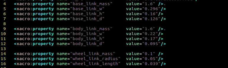

(1) Main Robot Body Model Basic Parameter
This section defines some basic parameters of the robot model:
The first parameter, base_link_mass, defines the weight of the robot’s main body model, in kilograms.
The second parameter, base_link_w, defines the width of the robot’s main body model, in meters.
The third parameter, base_link_h, defines the height of the robot’s main body model, in meters.
The fourth parameter, base_link_d, defines the length of the robot’s main body model, in meters.
The fifth parameter, wheel_link_mass, defines the weight of the robot’s wheels, in kilograms.
The sixth parameter, wheel_link_radius, defines the radius of the robot’s wheels, in meters.

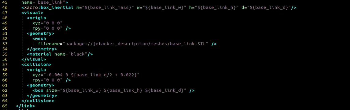

(3) Robot Main Body Model (base_link)
The link base_link is defined and then specified as a rectangle with previously defined parameters.
The description of the link base_link (keyword visual) is defined internally with the following specifications: position at the origin (keyword origin), inclusion of the relevant dynamics configuration file (keyword geometry), and the color defined as green (keyword material).
Collision (keyword collision) is defined, along with the collision position (keyword origin) and the collision area (keyword geometry).

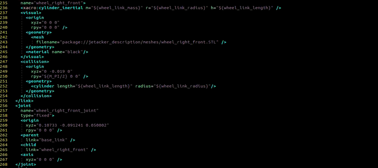

(4) Ackermann Wheel Simulation (taking the right front wheel as an example)
Define the link wheel_front_right_link. This link is defined as a cylinder and populated with the parameters defined earlier.
Define the visual description of the link wheel_front_right_link (keyword visual) and within the visual description define: the position as the origin (keyword origin), the introduction of the relevant dynamics configuration file (keyword geometry), and the color as black (keyword material).
Define the collision (keyword collision), collision position (keyword origin), and collision area (keyword geometry).

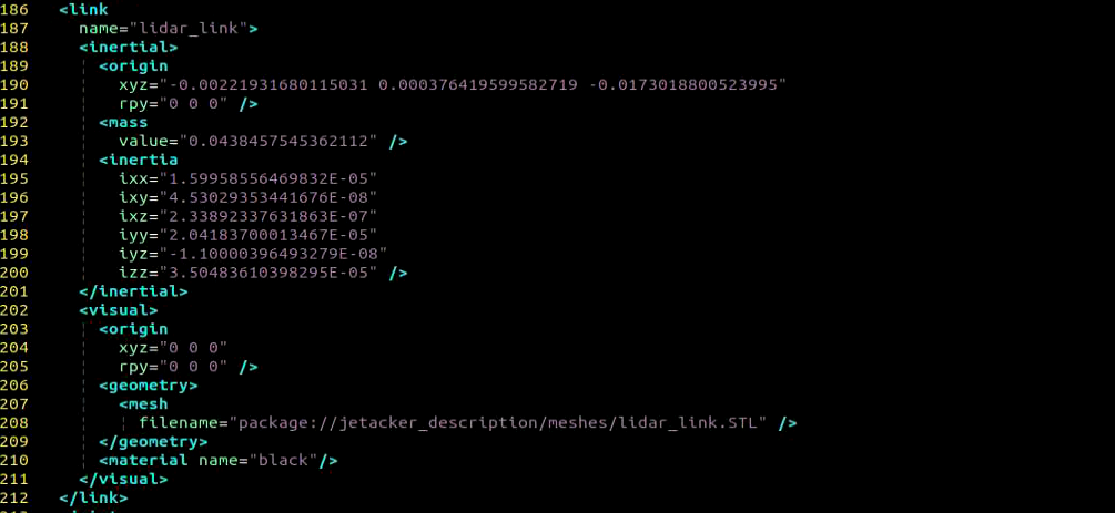

(5) Robot Lidar Simulation Model
Define the link lidar_link. Define the inertial properties (keyword inertial) and within this definition, specify: the inertial origin (keyword origin), the mass (keyword mass), and the inertial properties between the links (keyword inertia).
Define the visual description (keyword visual) and within this definition specify: the position as the origin (keyword origin), the relevant dynamics configuration file (keyword geometry), and the color as black (keyword material).
Define the collision properties (keyword collision), the collision position (keyword origin), and the collision geometry (keyword geometry).

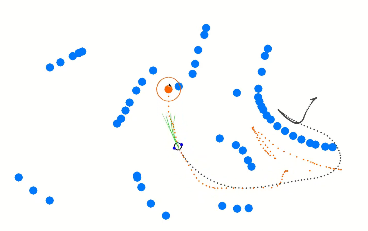

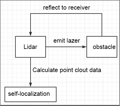

(1) Preprocessing: Optimizing the raw data from the radar point cloud, filtering out problematic data or performing filtering. Using laser as a signal source, pulses of laser emitted by the laser are directed at surrounding obstacles, causing scattering.
Some of the light waves will reflect back to the receiver of the lidar, and then, according to the principle of laser ranging, the distance from the lidar to the target point can be obtained.
Regarding point clouds: In simple terms, the surrounding environment information obtained by lidar is called a point cloud. It reflects a portion of what the ‘eyes’ of the robot can see in the environment where it is located. The object information collected presents a series of scattered, accurate angle, and distance information.
(2) Matching: Matching the point cloud data of the current local environment with the established map to find the corresponding position.
(3) Map Fusion: Integrating new round data from the lidar into the original map, ultimately completing the map update.

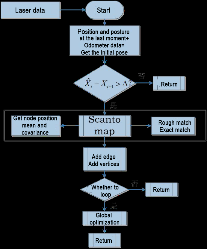

From the above diagram, it can be seen that the process is relatively straightforward. The traditional soft real-time operation mechanism of slam involves processing each frame of data upon entry and then returning.
Relevant source code and WIKI links for KartoSLAM:
KartoSLAM ROS Wiki: http://wiki.ros.org/slam_karto
slam_karto software package: https://github.com/ros-perception/slam_karto
open_karto open-source algorithm: https://github.com/ros-perception/open_karto

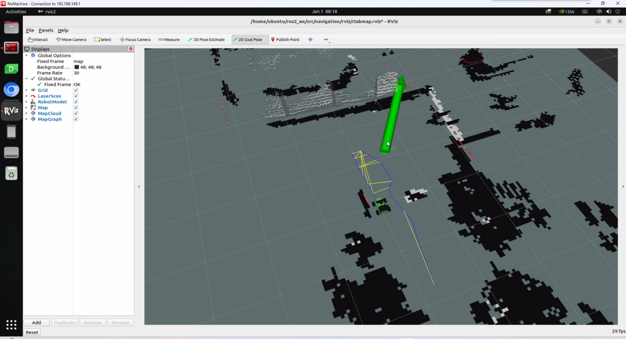

(4) Open a new command-line terminal, and run the command to display the map result through Rviz.

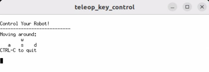

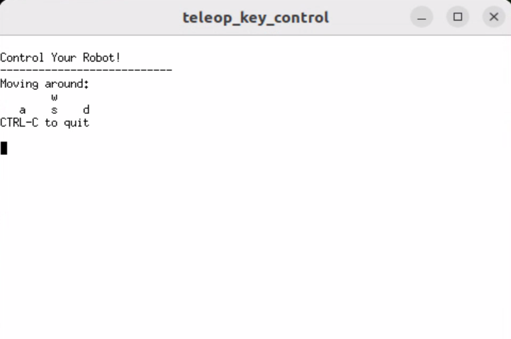

(5) Enter the command to start the keyboard control node, and press Enter key:
If you see the prompt as shown in the following image, it means the keyboard control service has been successfully started.
(6) Control the robot to move in the current space to build a more complete map. The table below lists the keyboard keys available for controlling robot movement and their corresponding functions:

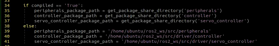

Launch File Analysis
The launch file is located at:

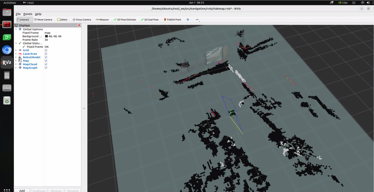

(1) Click on
on the system desktop to open the command-line terminal. Run the command to disable the app auto-start service:
(2) Execute the command to start mapping:
(3) Open a new terminal window. Enter the command to open the RViz tool and display the mapping effect:
(4) Enter the command to start the keyboard control node, and press Enter.
If you encounter the prompt as shown in the figure below, it means that the keyboard control service has been successfully activated.
(5) Control the robot to move in the current space to build a more complete map. The table below shows the keyboard keys available for controlling robot movement and their corresponding functions:
| Key | Robot Action |
| W | Short press to switch to the forward state and continuously move forward |
| S | Short press to switch to the backward state and continuously move backward |
| A | Long press to interrupt the forward or backward state and turn left |
| D | Long press to interrupt the forward or backward state and turn right |
When controlling the robot’s movement for mapping using the keyboard, it’s advisable to appropriately reduce the robot’s movement speed. The smaller the robot’s running speed, the smaller the relative error of the odometry, resulting in a better mapping effect. As the robot moves, the map displayed in RVIZ will continuously expand until the entire environmental scene’s map construction is completed.
Map Saving
After mapping is completed, you can use the shortcut “Ctrl+C” in each command-line terminal window to close the currently running program.
For 3D mapping, there’s no need to manually save the map. When you use “Ctrl+C” to close the mapping command, the map will be automatically saved.

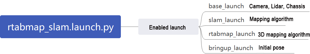

/home/ubuntu/ros2_ws/src/slam/launch/rtabmap_slam.launch.py
(1) Import Library:
You can refer to the ROS official documentation for detailed analysis of the launch library:
1 2 3 4 5 6 7 8 | import os from ament_index_python.packages import get_package_share_directory from launch_ros.actions import PushRosNamespace from launch import LaunchDescription, LaunchService from launch.substitutions import LaunchConfiguration from launch.launch_description_sources import PythonLaunchDescriptionSource from launch.actions import DeclareLaunchArgument, IncludeLaunchDescription, GroupAction, OpaqueFunction, TimerAction |
(2) Set the Storage Path
32 33 34 35 | if compiled == 'True': slam_package_path = get_package_share_directory('slam') else: slam_package_path = '/home/ubuntu/ros2_ws/src/slam' |
(3) Initiate Other Launch File
37 38 39 40 41 42 43 44 45 46 47 48 49 50 51 52 53 54 55 56 57 58 59 60 61 62 63 64 | base_launch = IncludeLaunchDescription( PythonLaunchDescriptionSource( os.path.join(slam_package_path, 'launch/include/robot.launch.py')), launch_arguments={ 'sim': sim, 'master_name': master_name, 'robot_name': robot_name, }.items(), ) rtabmap_launch = IncludeLaunchDescription( PythonLaunchDescriptionSource( os.path.join(slam_package_path, 'launch/include/rtabmap.launch.py')), launch_arguments={ 'use_sim_time': use_sim_time, }.items(), ) bringup_launch = GroupAction( actions=[ PushRosNamespace(robot_name), base_launch, TimerAction( period=10.0, # 延时等待其它节点启动好(delay to wait for other nodes to start up properly) actions=[rtabmap_launch], ), ] ) |
base_launch: Launch for hardware initialization
slam_launch: Basic mapping launch
rtabmap_launch: RTAB mapping launch
bringup_launch: Initial pose launch

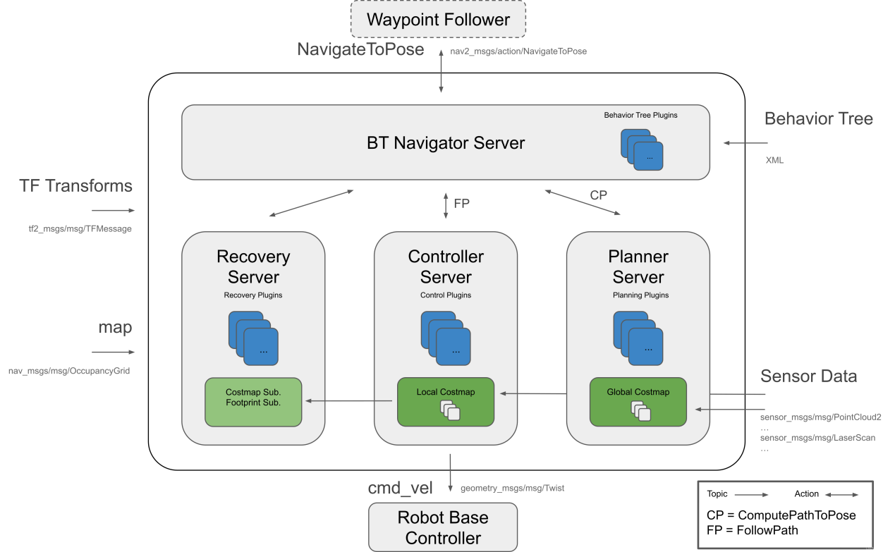

(1) Principle Structure Framework Explanation
The Nav2 project inherits and promotes the spirit of the ROS Navigation Stack. The project strives to safely navigate mobile robots from point A to point B. Nav2 can also be applied to other applications, including robot navigation tasks such as dynamic point tracking, which involves dynamic path planning, velocity calculation, obstacle avoidance, and recovery behaviors.
Nav2 utilizes behavior trees to invoke modular servers to accomplish an action. These actions can involve path computation, control forces, recovery, or any other navigation-related operation. These are achieved through independent nodes communicating with ROS Action servers and the behavior tree (BT). You can refer to the diagram below for a preliminary understanding of Nav2’s architecture:
The architecture diagram above can be further explained as one major component and three minor components, totaling four services.
Major:
BT Navigator Server: This service organizes and invokes the following three minor services.
Minor:
① Planner Server: Responsible for path planning, the planner server computes paths based on selected naming conventions and algorithms. These paths are essentially routes calculated on the map.
② Controller Server: Also known as the local planner in ROS 1, this server provides the method for the robot to follow the globally computed path or complete local tasks. In simple terms, it controls the robot’s movement based on the planned route.
③ Recovery Server: The backbone of the fault-tolerant system, the recovery server handles unknown or faulty conditions autonomously. Its goal is to manage unexpected situations the robot may encounter and recover autonomously. For example, if the robot falls into a hole while moving, the recovery server finds a way to get it out.
By continuously switching between planning paths, controlling the robot along the path, and autonomously recovering from issues, the robot achieves autonomous navigation.

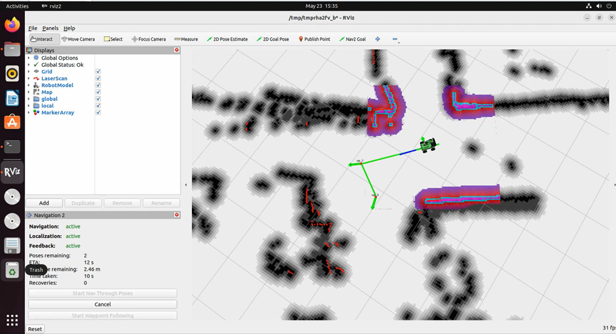

During robot navigation, relying solely on the original map generated by SLAM is insufficient. The robot may encounter new obstacles during movement, or it may find that obstacles in certain areas of the original map have disappeared. Therefore, the maintained map during robot navigation is dynamic. Depending on the update frequency and purpose, it can be categorized into the following two types:

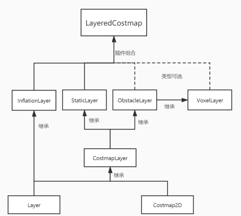

Global Costmap:
The global costmap is mainly used for global path planners. As seen in the structure diagram above, it is located within the Planner Server. It typically includes the following layers:
Static Map Layer: This layer consists of the static map usually created by SLAM.
Obstacle Map Layer: This layer is used to dynamically record obstacle information perceived by sensors.
Inflation Layer: This layer inflates (expands outward) the maps from the previous two layers to prevent the robot’s shell from colliding with obstacles.
Local Costmap:
The local costmap is primarily used for the local path planner, as seen in the Controller Server in the architecture diagram above. It typically consists of the following layers:
Obstacle Map Layer: This layer records dynamically sensed obstacle information from sensors.
Inflation Layer: This layer inflates (expands outward) on top of the obstacle map layer to prevent the robot’s shell from colliding with obstacles.

Positioning involves determining the robot’s position in the global map. While SLAM also includes positioning algorithm implementation, SLAM’s positioning is utilized for building the global map and occurs before navigation begins. Current positioning, on the other hand, is employed during navigation, where the robot needs to move according to the designated route. Through positioning, it can be assessed whether the robot’s actual trajectory aligns with expectations.
The AMCL (Adaptive Monte Carlo Localization) system, provided in the ROS navigation function package ros-navigation, facilitates robot positioning during navigation. AMCL utilizes the adaptive Monte Carlo positioning method and employs particle filters to compute the robot’s position based on existing maps.
Positioning addresses the association between the robot and obstacles, as path planning fundamentally involves decision-making based on surrounding obstacles. While theoretically, completing the navigation task only requires knowledge of the robot’s global positioning and real-time obstacle avoidance using laser radar and other sensors, the real-time performance and accuracy of global positioning are typically limited. Local positioning from odometry, IMUs, etc., ensures the real-time performance and accuracy of the robot’s motion trajectory. The amcl node in the navigation function package provides global positioning by publishing map_odom. However, users can substitute amcl global positioning with other methods that provide map_odom, such as SLAM, UWB, QR code positioning, etc.
Global positioning and local positioning establish a dynamic set of tf coordinates map_odom base_footprint, with static tf coordinates between various sensors in the robot provided through the robot URDF type. This TF relationship resolves the association problem between the robot and obstacles. For instance, if the lidar detects an obstacle 3m ahead, the tf coordinates between the lidar and the robot chassis, base_link to laser_link, are utilized. Through standard transformation, the relationship between the obstacle and the robot chassis can be determined.

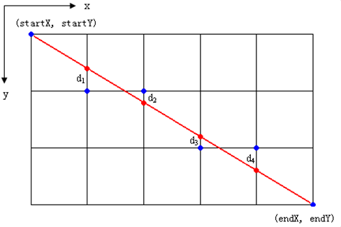

Before delving into costmap_2d, it’s important to introduce the Bresenham algorithm. This algorithm is utilized to draw a straight line between two points by calculating the closest point of a line segment on an n-dimensional raster. It relies solely on relatively fast integer operations such as addition, subtraction, and bit shifting, making it a fundamental algorithm in computer graphics.
To construct a set of virtual grid lines, we begin by passing them through the pixel centers of each row and column. The intersection points of these straight lines with each vertical grid line are calculated sequentially, starting from the line’s origin and moving towards its endpoint. Subsequently, the pixel closest to each intersection point within the pixel column is determined based on the sign of the error term.
The core concept of the algorithm relies on the assumption that k=dy/dx, where k represents the slope. Since the straight line originates from the center of a pixel, the initial error term d is set to d0=0. With each increment in the subscript X, d increases by the slope value k, i.e., d=d+k. When d≥1, 1 is subtracted from it to ensure that d remains between 0 and 1. If d≥0.5, the pixel closest to the upper-right of the current pixel is considered (i.e., (x+1,y+1)); otherwise, it’s closer to the pixel on the right (i.e.,(x+1,y)). For ease of calculation, let e=d−0.5; initially, e is set to -0.5, and it increments by k. When e≥0, the upper-right pixel of the current pixel (xi, yi) is selected, and when e<0, the pixel closer to the right (x+1,y) is chosen instead. Integers are preferred to avoid division. Since the algorithm only uses the sign of the error term, it can be replaced as follows: e1 = 2edx.
The Costmap2D class is responsible for managing the cost value of each raster. Meanwhile, the Layer class serves as a virtual base class, standardizing the interfaces of costmap layers for each plugin. Key interface functions include:
The initialize function, which invokes the onInitialize function to initialize each costmap layer individually.
The matchSize function, found in the StaticLayer and ObstacleLayer classes, ensures consistency across costmap layers by calling the matchSize function of the CostmapLayer class. This initialization process sets the size, resolution, origin, and default cost value of each layer. In the inflationLayer class, a cost table is computed based on the expansion radius, enabling subsequent cost value queries based on distance. Additionally, the seen_ array is defined to mark traversed rasters. For the VoxelLayer class, initialization involves setting the size of the voxel grid.
The updateBounds function adjusts the size range of the current costmap layer requiring updates. For the StaticLayer class, the update range is determined by the size of the static map (typically used in global costmaps). Conversely, the ObstacleLayer class determines obstacle boundaries by traversing sensor data in clearing_observations.
The initialize and matchSize functions are executed only once each, while updateBounds and updateCosts are performed periodically, their frequency determined by map_update_frequency.
The CostmapLayer class inherits from both the Layer class and the Costmap2D class, providing various methods for updating cost values. The StaticLayer and ObstacleLayer classes, needing to retain cost values of instantiated layers, also inherit from CostmapLayer. The StaticLayer updates its costmap using static raster map data, whereas the ObstacleLayer employs sensor data for updates. In contrast, the VoxelLayer class considers z-axis data more extensively, particularly in obstacle clearance. This distinction primarily affects obstacle removal, with two-dimensional clearance in one case and three-dimensional clearance in the other.
Costmap measurement barriers offer remarkable flexibility. You can tailor a specific layer to your requirements, thereby managing pertinent barrier information effectively. For instance, if your robot is equipped solely with LiDAR, you’ll need to establish an Obstacles layer to handle obstacle data scanned by the LiDAR. In case ultrasonic sensors are integrated into the robot, creating a new Sonar layer becomes necessary to manage obstacle information from the sonic sensor. Each layer can define its own rules for obstacle updates, encompassing tasks such as obstacle addition, deletion, and confidence level updates. This approach significantly enhances the scalability of the navigation system.

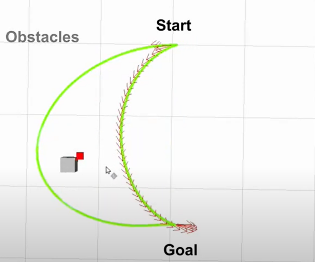

TEB Algorithm
(1) Description

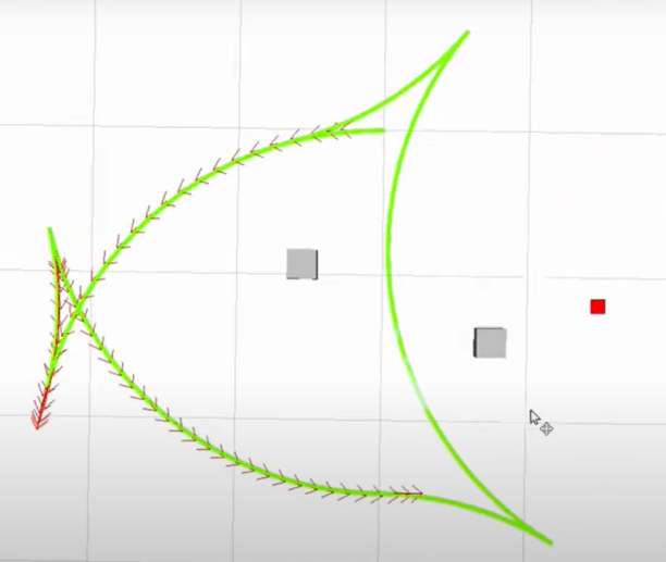

The TEB (Timed Elastic Band) algorithm is utilized for both path planning and motion planning, particularly in domains like robotics and autonomous vehicles. At its core, the TEB algorithm treats path planning as an optimization challenge, aiming to generate the best trajectory within a specified timeframe while accommodating dynamic constraints and obstacle avoidance needs for the robot or vehicle. Key characteristics of the TEB algorithm encompass:
Time Layered Representation: The TEB algorithm employs time layering, dividing the trajectory into discrete time steps, each corresponding to a position of the robot or vehicle. This aids in setting timing constraints and preventing collisions.
Trajectory Parameterization: TEB parameterizes the trajectory into displacements and velocities, facilitating optimization. Each time step is associated with displacement and velocity parameters.
Constrained Optimization: TEB considers dynamic constraints, obstacle avoidance, and trajectory smoothness, integrating them into the objective function of the optimization problem.
Optimization Solution: TEB utilizes techniques like linear quadratic programming (QP) or nonlinear programming (NLP) to determine optimal trajectory parameters that fulfill the constraints.
(2) Formula
The figure below illustrates the optimization objective function in the TEB algorithm:
In the following expression:
J(x) denotes the objective function, where x represents the trajectory parameter.
wsmooth and wobstacle represent weights assigned to smoothness and obstacle avoidance, respectively.
H signifies the smoothness penalty matrix.
f(xi, oj) represents the obstacle cost function between trajectory point xi and obstacle oj.
Status Definition: Firstly, we define the state of the robot (or vehicle) in the path planning problem as follows: Position: P = [X, Y], indicating the coordinates of the robot on the two-dimensional plane. Velocity: V = [Vx, Vy], representing the robot’s velocity along the X and Y axes. Time: t, denoting the current time. Control Input: u = [ux, uy], representing the control input of the robot, which can be speed or acceleration. Robot Trajectory: x(t) = [p(t), v(t)], indicating the state of the robot at time t.
Target Function: The essence of the TEB algorithm lies in solving an optimization problem. The objective is to minimize a composite function comprising various components:
Jsmooth(x): Smoothness objective function, ensuring trajectory smoothness.
Jobstacle(x): Obstacle avoidance objective function, preventing collisions with obstacles.
Jdynamic(x): Dynamic objective function, ensuring compliance with the robot’s dynamic constraints.
Smoothness objective function Jsmooth(x): Smoothness objective functions typically involve the curvature of trajectories to ensure the generated trajectories are smooth. It can be represented as:
Where k(t) is the curvature.
Obstacle avoidance objective function Jobstacle(x): The obstacle avoidance objective function calculates the distance between trajectory points and obstacles. It penalizes trajectory points that are in close proximity to obstacles. The specific obstacle cost function, denoted as f(x,o), can be adjusted according to specific requirements or needs.
Dynamic objective function Jdynamic(x): The dynamics objective function ensures that the generated trajectory adheres to the robot’s dynamic constraints, which are determined by its kinematics and dynamics model. This typically includes limitations on velocity and acceleration.
Optimization: In the end, the Trajectory Optimization with Ellipsoidal Bounds (TEB) algorithm addresses the stated objective function by framing it as a constrained optimization problem. This problem incorporates optimization variables for trajectory parameters, time allocation, and control inputs. Typically, this optimization problem falls under the category of nonlinear programming (NLP) problems.

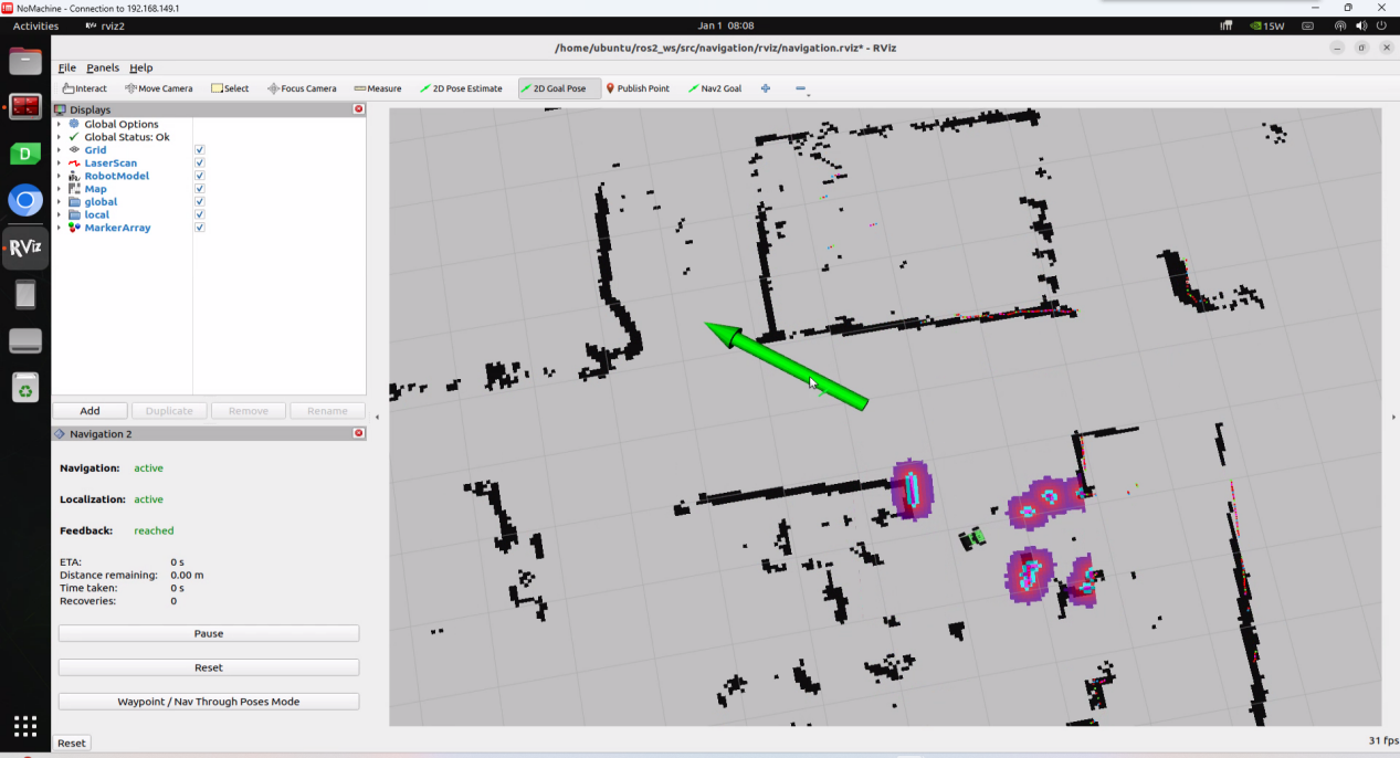

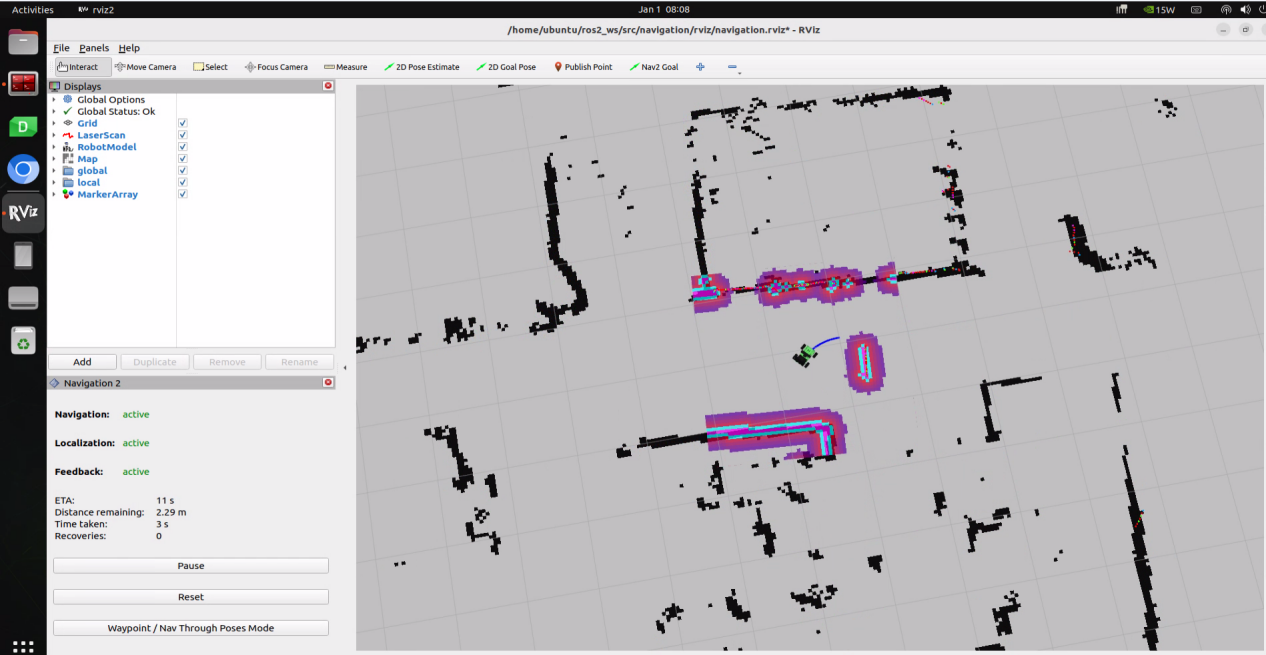

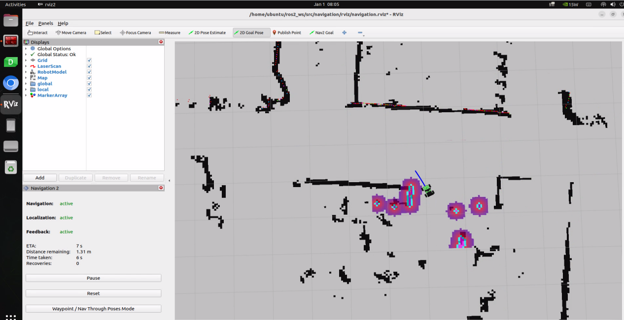

Point-to-Point Navigation
In the software menu bar, “2D Pose Estimate” is used to set the initial position of the JetRover robot; “2D Nav Goal” is used to set a single target point for the robot; “Publish Point” is used to set multiple target points for the robot.
(1) Click
to set the initial position of the robot. On the map interface, choose a position, click, and drag the mouse to select the robot’s pose.
(2) After setting the initial position of the robot, the effect is as shown in the figure below:
(3) Click
and select a location on the map interface as the target point. Click the mouse once at that point. After selection, the robot will automatically generate a route and move to the target point.
(4) After confirming the target point, the map will display two paths: the green line represents the direct path between the robot and the target point, and the dark blue line represents the planned path of the robot.
(5) When encountering obstacles, the robot will bypass them and continuously adjust its posture and travel route.

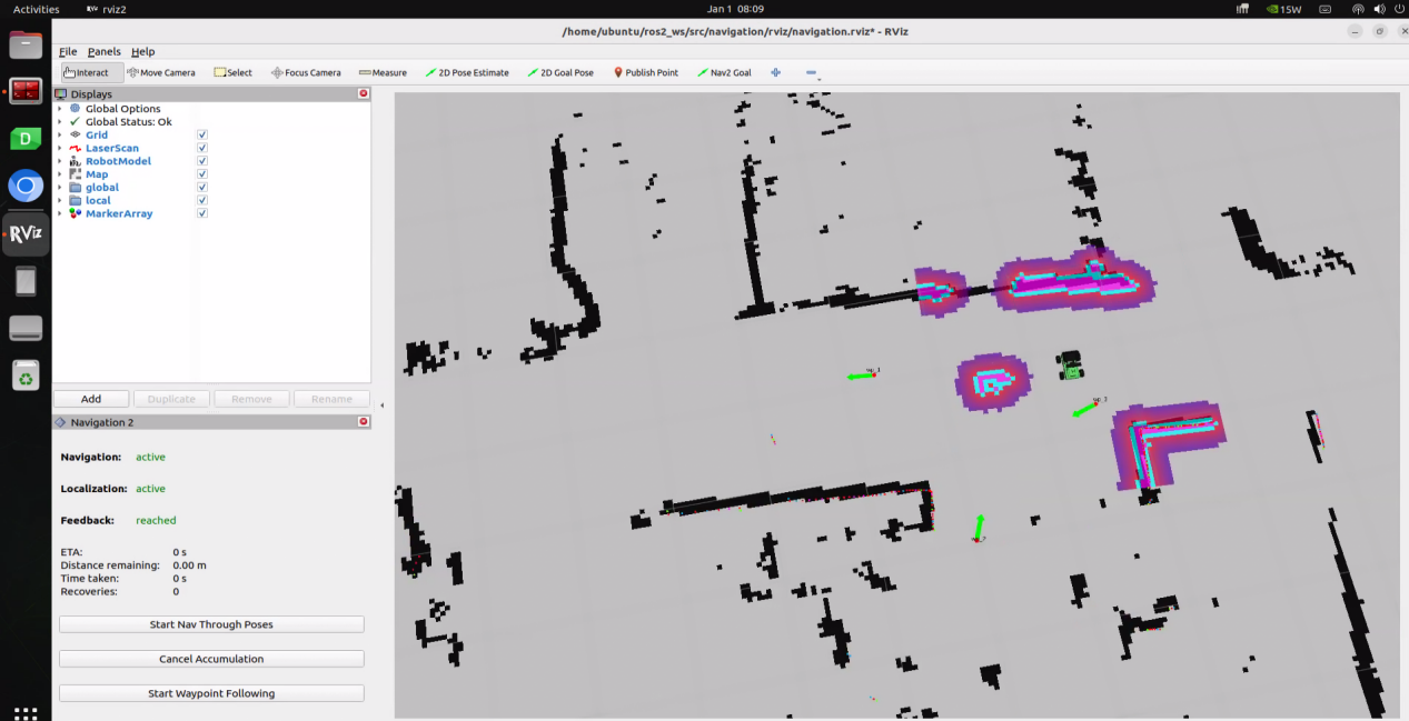

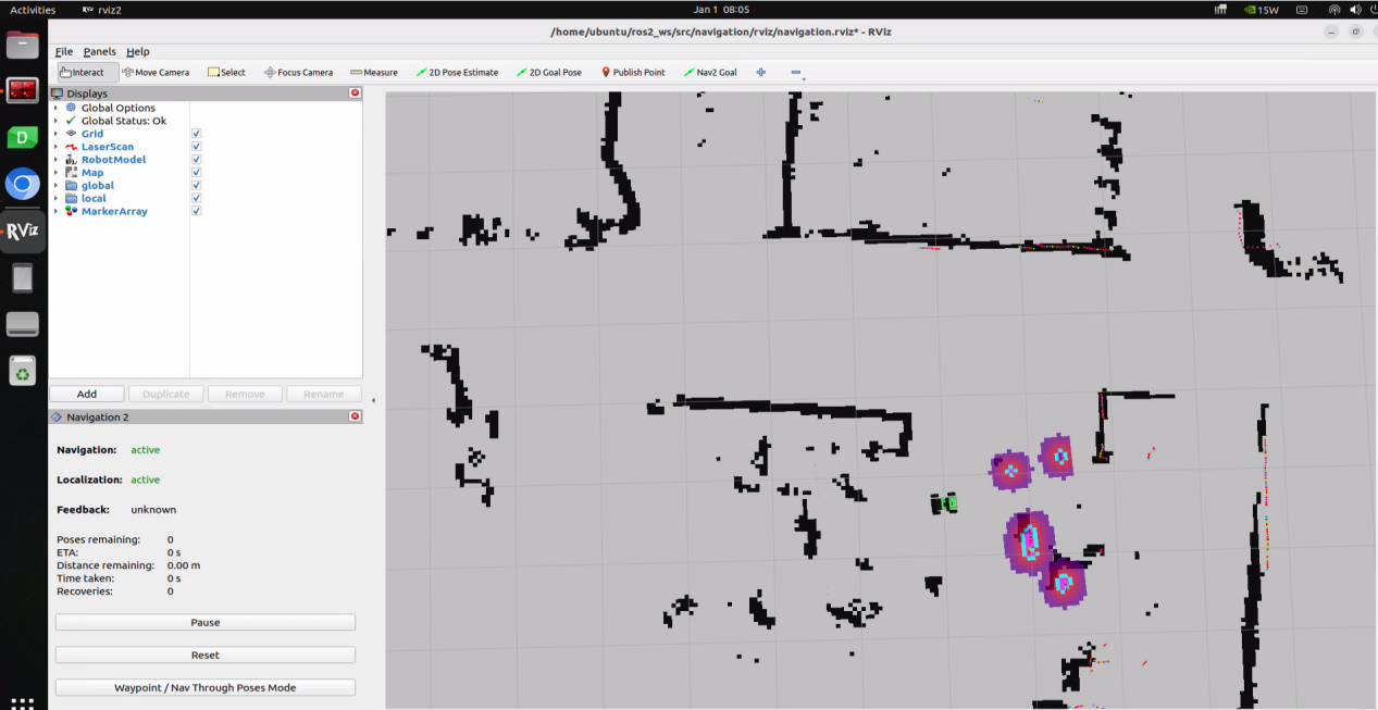

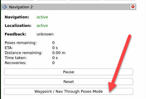

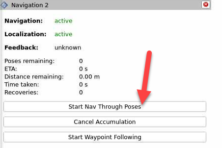

Multi-Point Navigation
(1) Click the “waypoint” button to start multi-point navigation:
(2) Set each navigation point using
(3) Finally, click “Start Nav Through Poses” or “Start Waypoint Following” to start navigation. “Start Nav Through Poses” will control the robot’s pose at each navigation point; “Start Waypoint Following” will not focus on the robot’s pose at each navigation point.

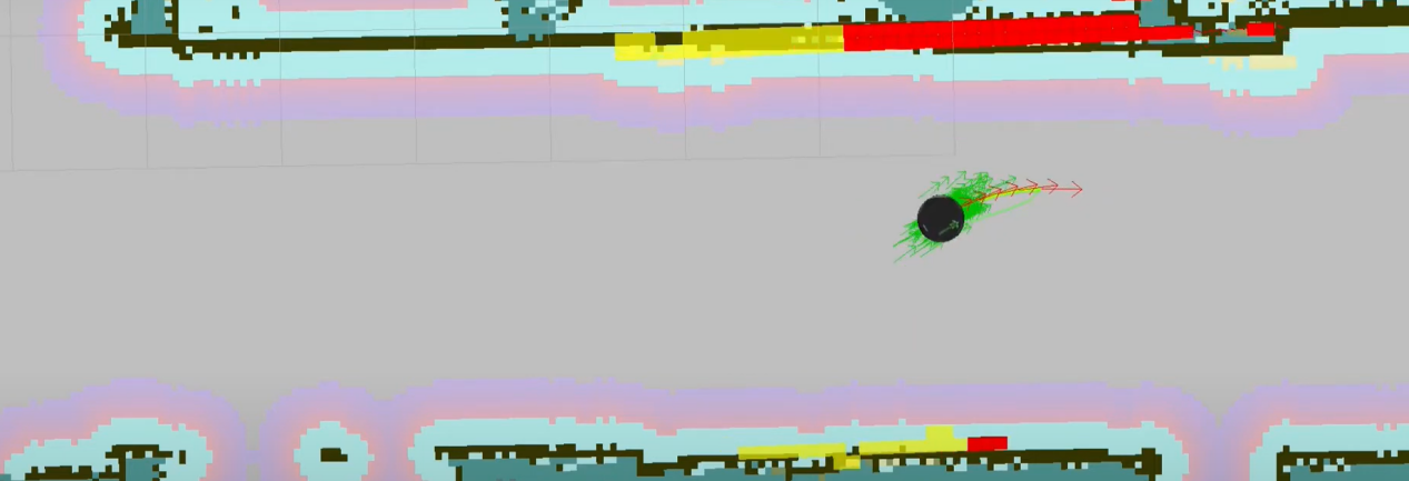

(4) The effect during multi-point navigation is shown in the figure below, with the robot reaching the target points in sequence:
(5) The effect after completing multi-point navigation is shown in the figure below:

(1) Set Paths
Locate the paths for the peripherals, controller, and servo_controller packages.
12 13 14 15 16 17 | if compiled == 'True': slam_package_path = get_package_share_directory('slam') navigation_package_path = get_package_share_directory('navigation') else: slam_package_path = '/home/ubuntu/ros2_ws/src/slam' navigation_package_path = '/home/ubuntu/ros2_ws/src/navigation' |
(2) Launch Other Files
base_launch for various hardware
navigation_launch to start the navigation algorithm
bringup_launch to initialize actions
34 35 36 37 38 39 40 41 42 43 44 45 46 47 48 49 50 51 52 53 54 55 56 57 58 59 60 61 62 63 64 65 | base_launch = IncludeLaunchDescription( PythonLaunchDescriptionSource(os.path.join(slam_package_path, 'launch/include/robot.launch.py')), launch_arguments={ 'sim': sim, 'master_name': master_name, 'robot_name': robot_name }.items(), ) navigation_launch = IncludeLaunchDescription( PythonLaunchDescriptionSource(os.path.join(navigation_package_path, 'launch/include/bringup.launch.py')), launch_arguments={ 'use_sim_time': use_sim_time, 'map': os.path.join(slam_package_path, 'maps', map_name + '.yaml'), 'params_file': os.path.join(navigation_package_path, 'config', 'nav2_params.yaml'), 'namespace': robot_name, 'use_namespace': use_namespace, 'autostart': 'true', 'use_teb': use_teb, }.items(), ) bringup_launch = GroupAction( actions=[ PushRosNamespace(robot_name), base_launch, TimerAction( period=10.0, # 延时等待其它节点启动好(delay and wait for other nodes to start up properly) actions=[navigation_launch], ), ] ) |

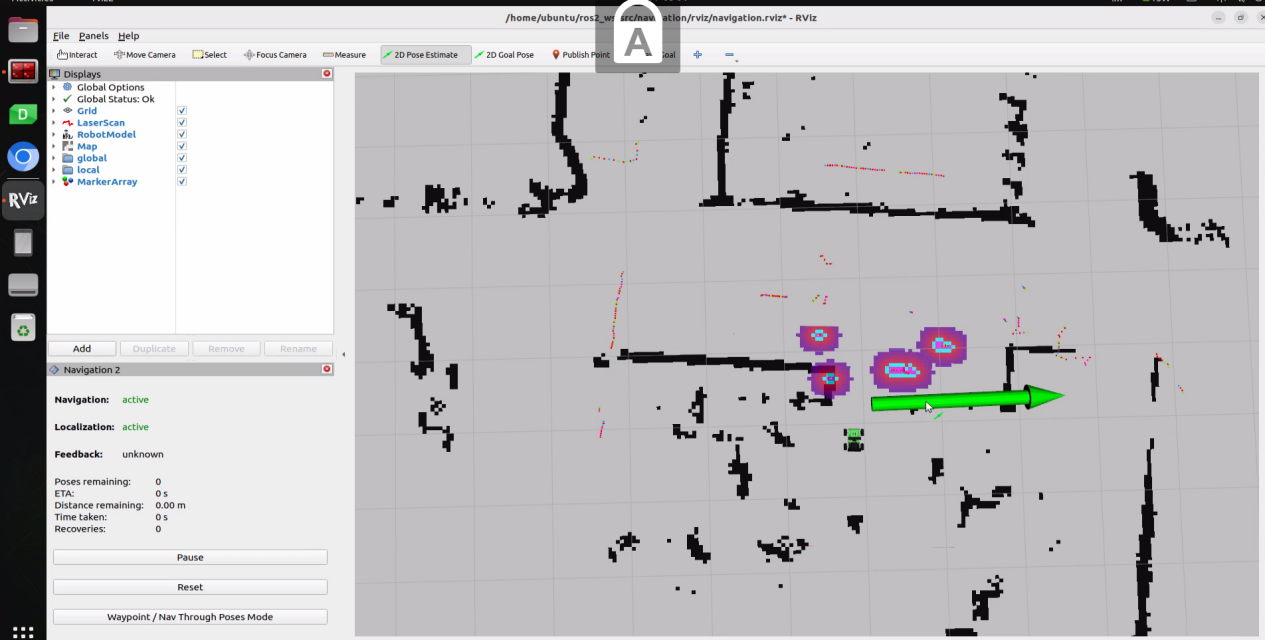

In the software menu bar, “2D Nav Goal” is used to set a single target point for the robot, and “Publish Point” is used to set multiple target points for the robot.
(5) Click
, and on the map interface, select a location as the target point by clicking the mouse once at that point. After the selection is made, the robot will automatically generate a route and move to the target point.
(6) After confirming the target point, the map will display two paths: a line composed of blue squares representing the straight-line path between the robot and the target point, while the dark blue line represents the planned path of the robot.
(7) After encountering obstacles, the car will navigate around them and continuously adjust its posture and trajectory.
