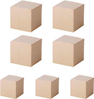

8 Wooden blocks
(40mm wooden blocks * 4
30mm wooden blocks * 3)

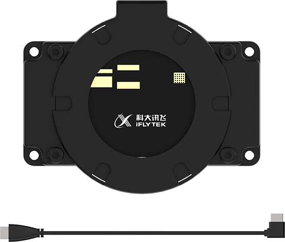

20 Circular 6-Microphone Array 1

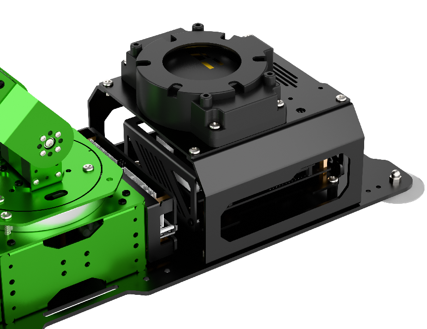

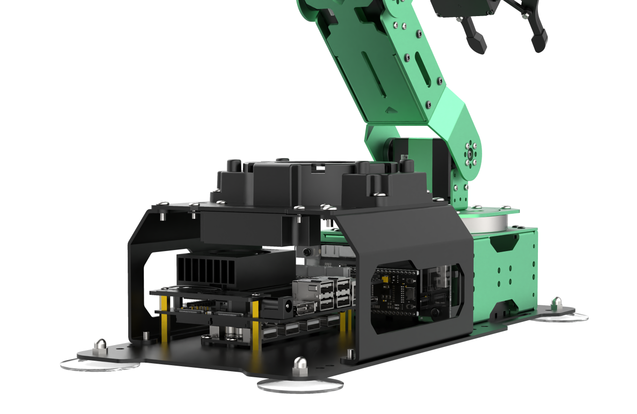

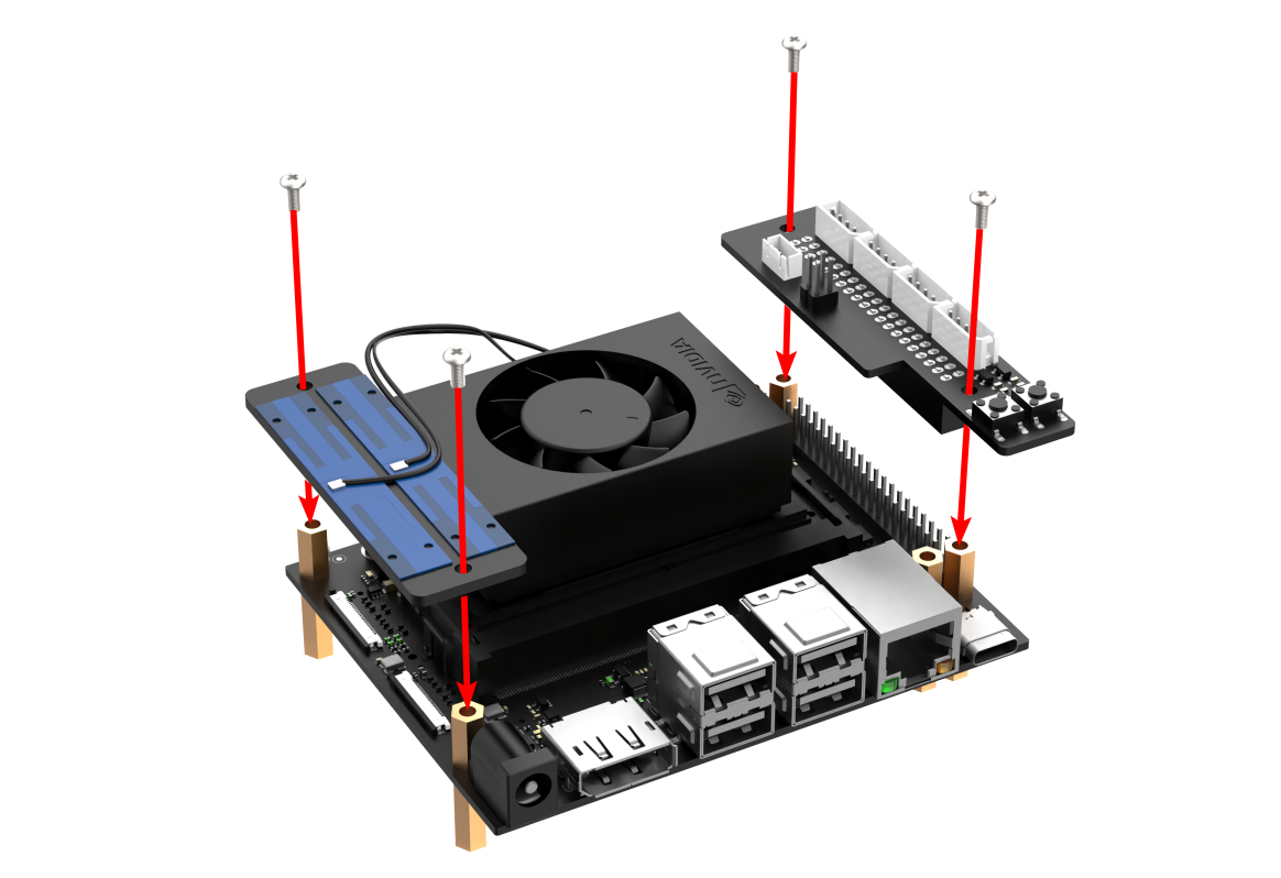

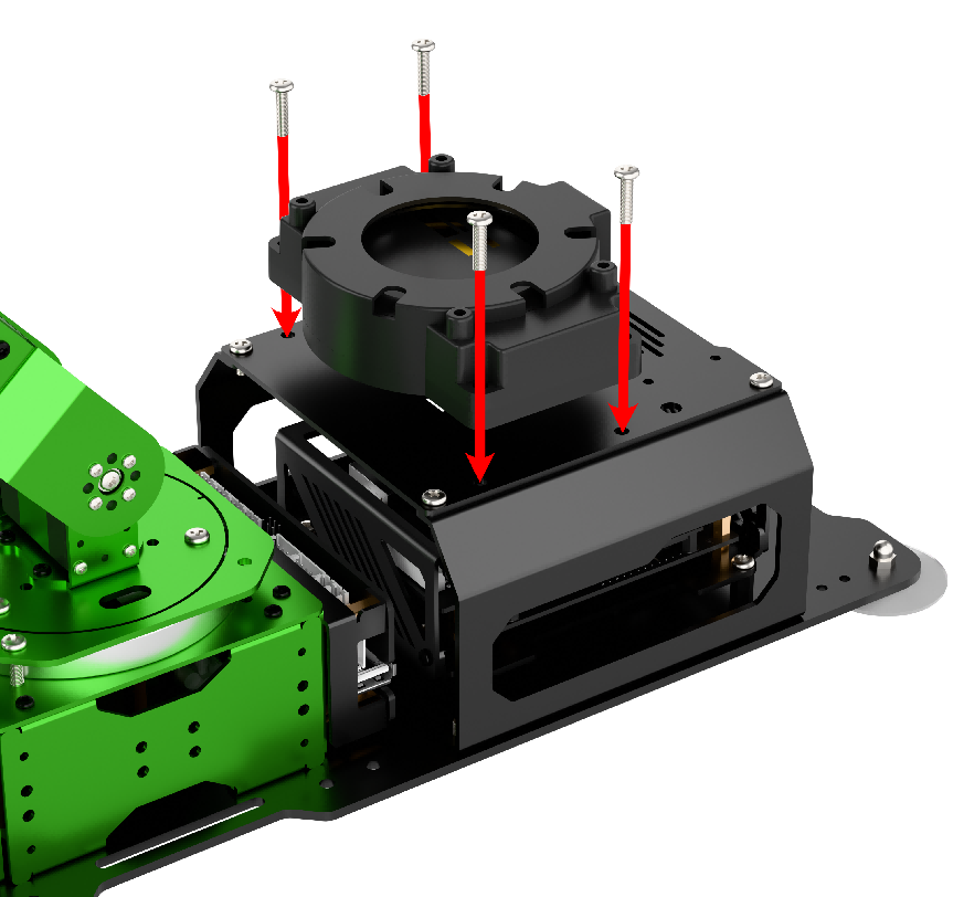

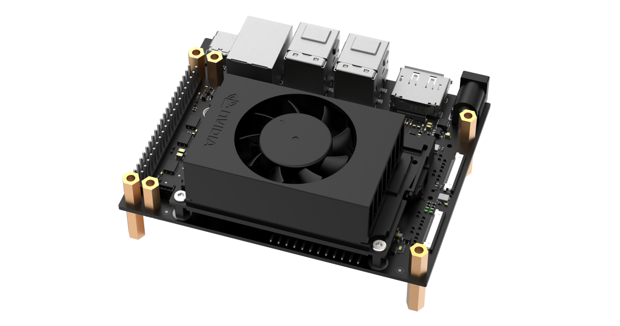

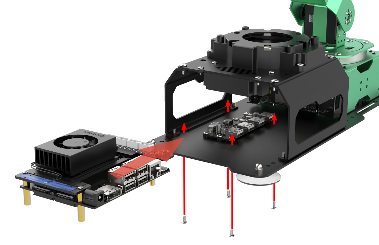

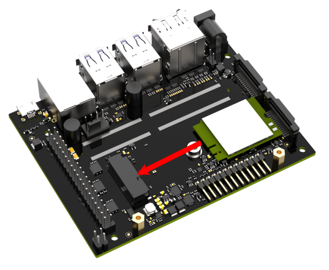

1.2.1 Controller Installation (Applicable Only to Kits Without Jetson Controller)

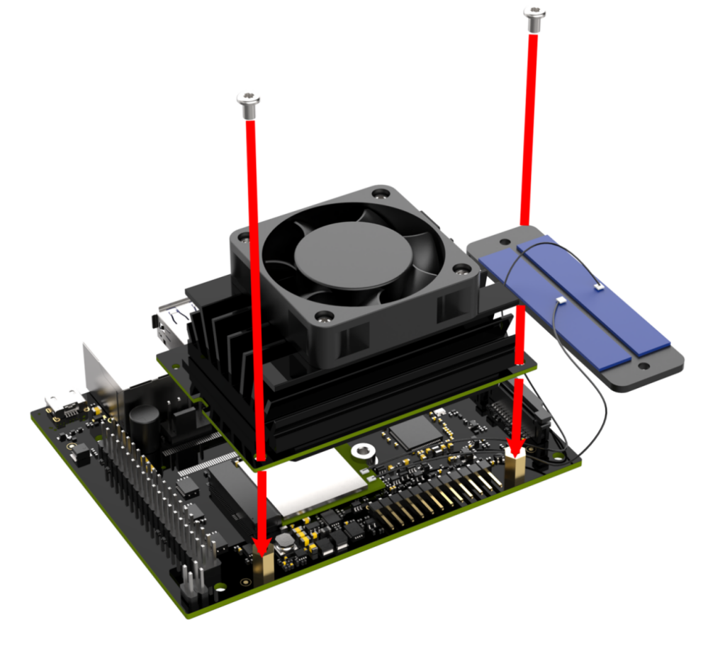

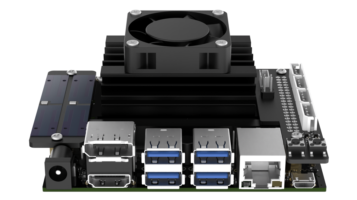

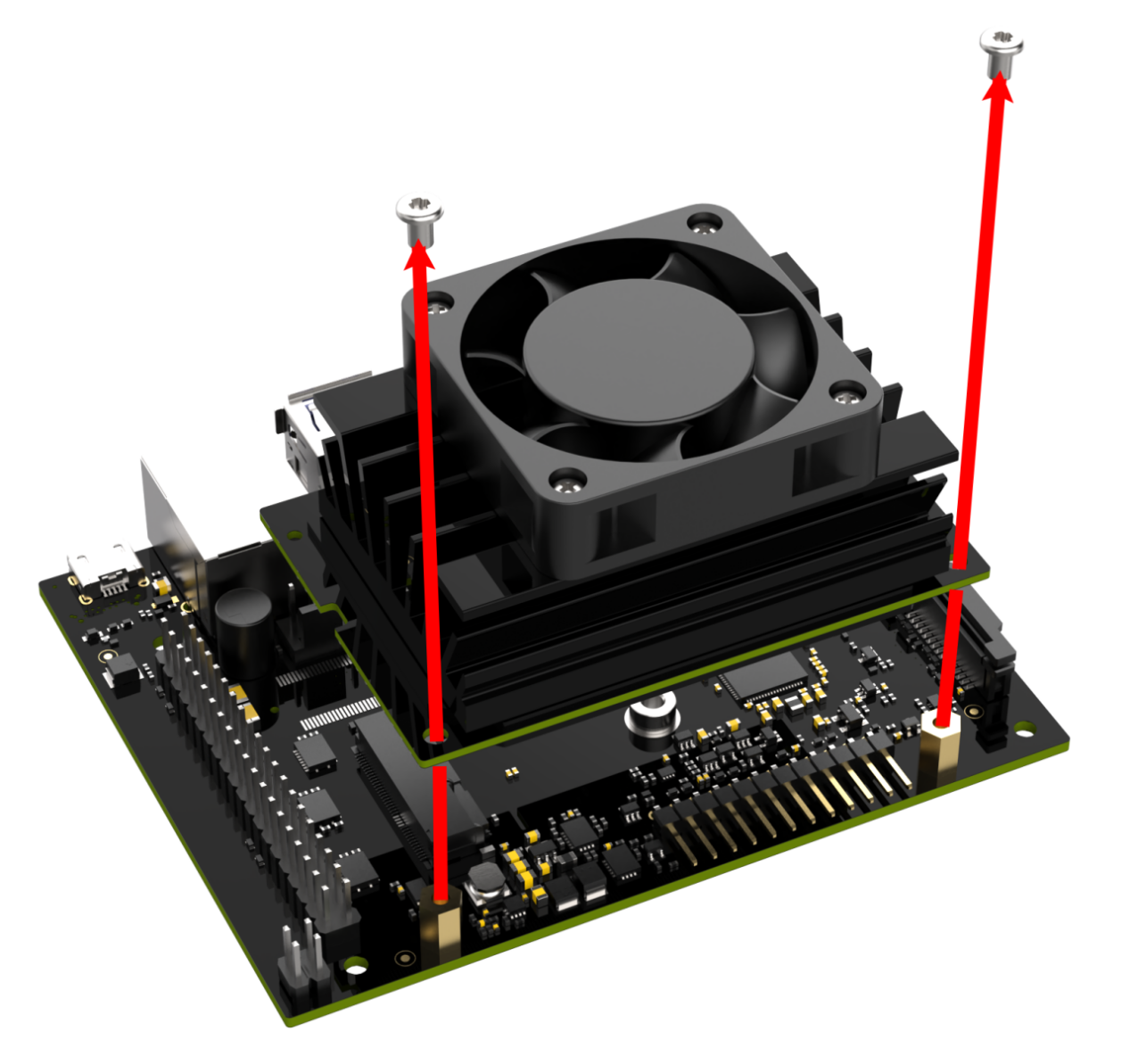

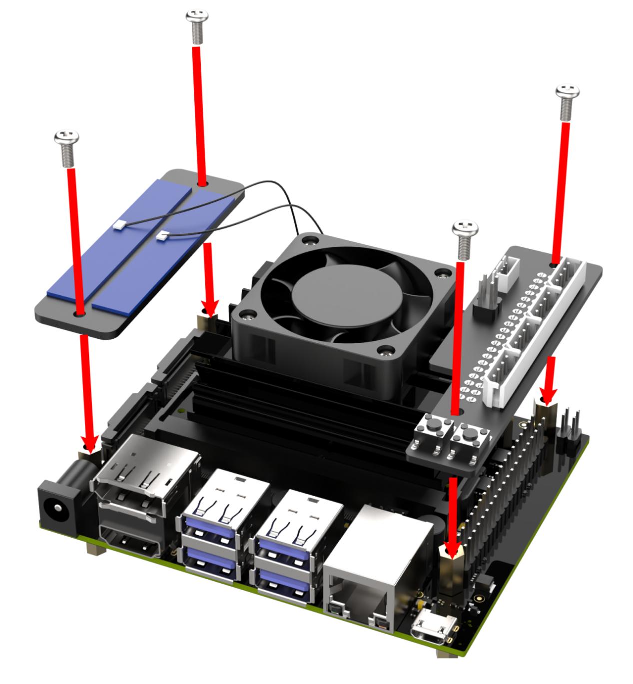

  • Jetson Nano Controller
(1) Remove the two M2.5×4 screws and detach the controller.
(2) Assemble the network card and the external antenna.
(3) Secure the controller using two flat-head M2.5×4 screws.
(4) Fix four M2.5×18+6 single-pass standoffs and four M2.5×12 double-pass standoffs.
(5) Use four M2.5×6 screws to secure the antenna and the expansion board.
(6) Install the assembled controller kit onto the corresponding four M2.5 screw holes on the robot arm baseplate using four M2.5×6 round-head screws.

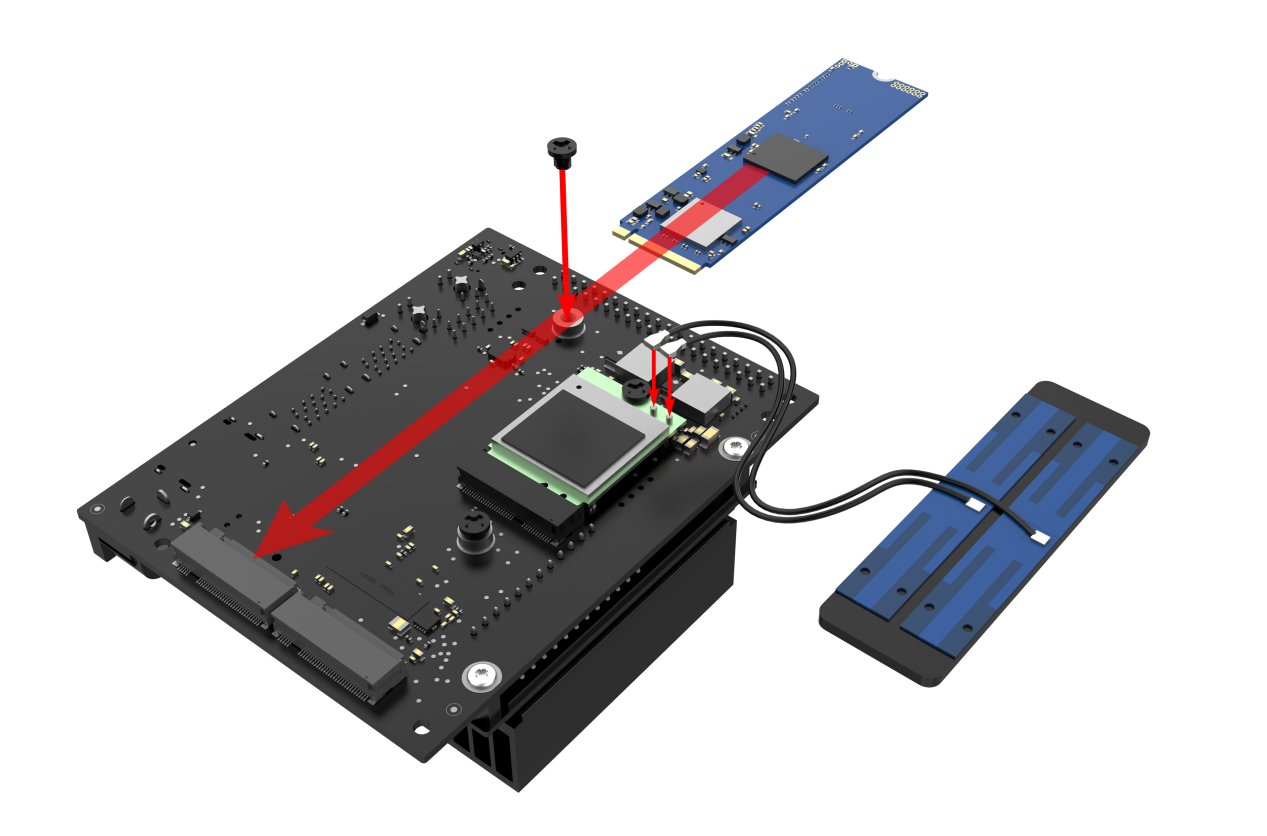

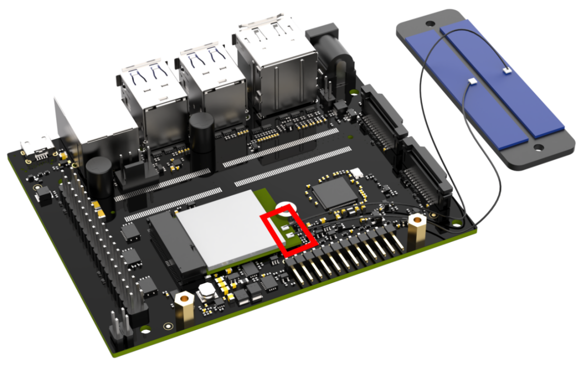

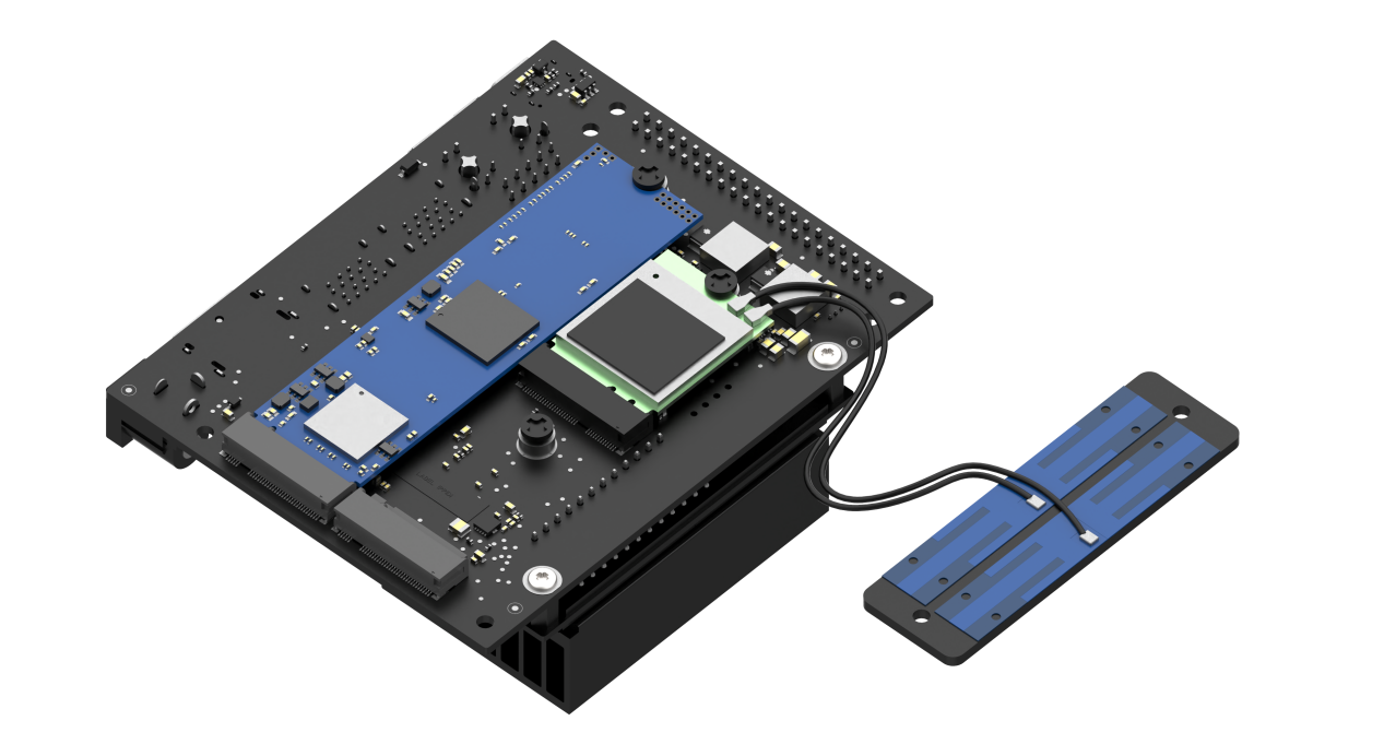

  • Jetson Orin Nano/Jetson Orin NX Controller
(1) Install the provided blue antenna in the original antenna slot, insert the SSD into the card slot, and secure it with the black M3×3 screw.
(2) Fix four M2.5×18+6 single-pass standoffs and four M2.5×12 double-pass standoffs. Use four M2.5×6 round-head screws to secure the other two M2.5×12 double-pass standoffs.
(3) Use four M2.5×6 round-head screws to secure the antenna and expansion board.
(4) Install the assembled controller kit onto the corresponding four M2.5 screw holes on the mechanical arm baseplate using four M2.5×6 round-head screws.

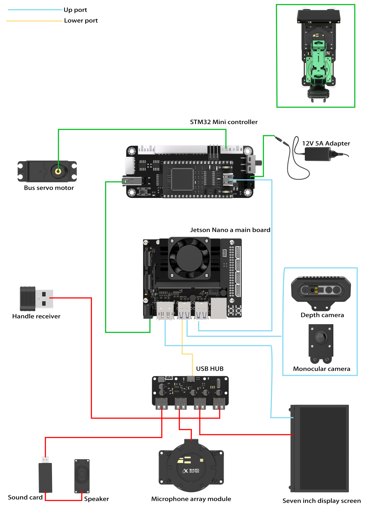

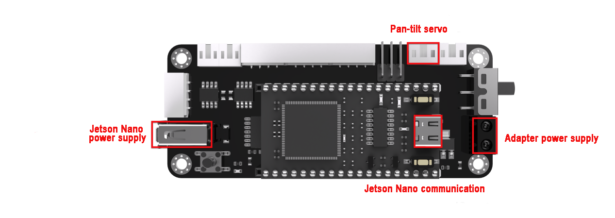

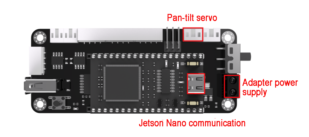

1.2.2 Wiring Instructions

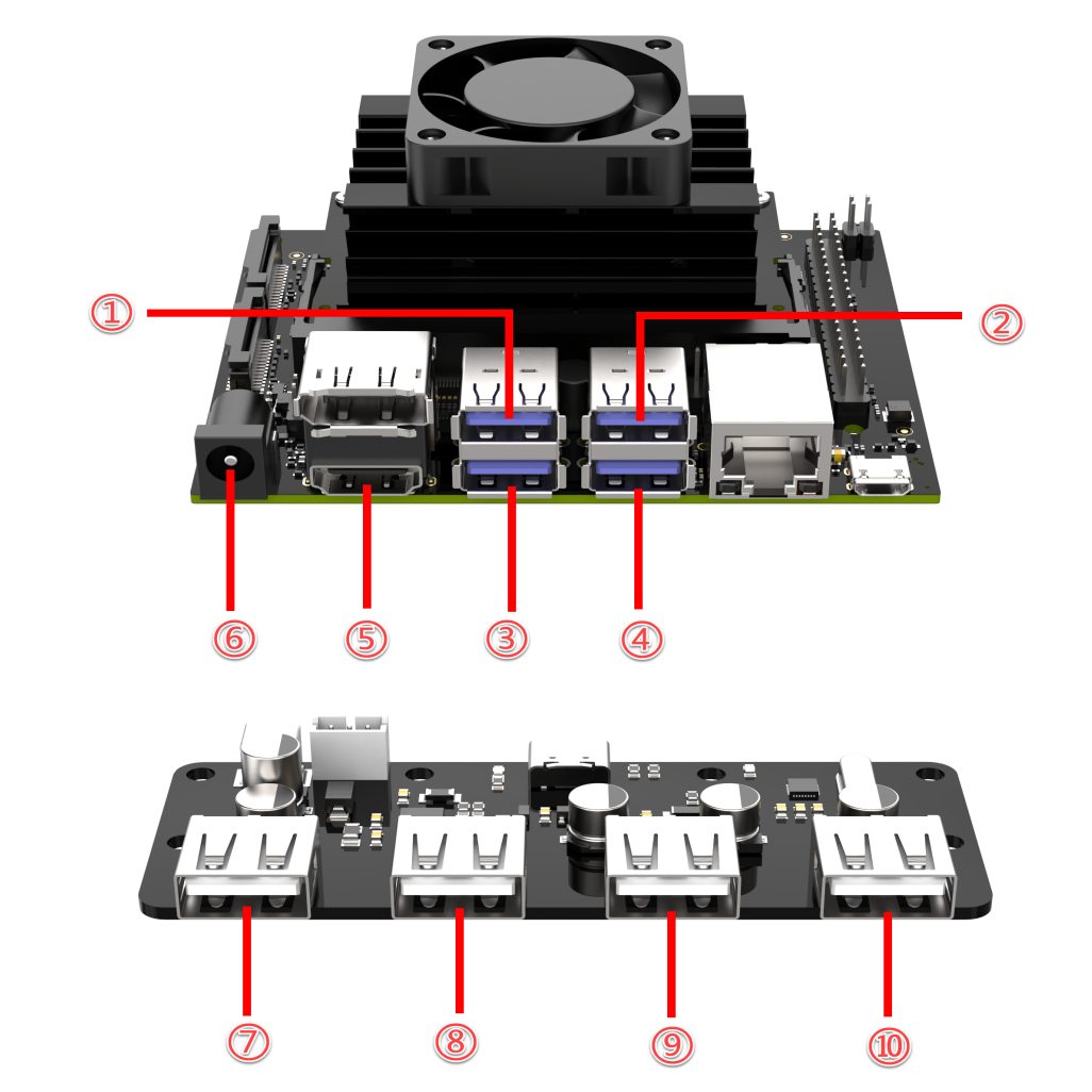

  • Jetson Nano Controller Wiring Instructions
The image below shows the interface numbers for each module connected to the Jetson Nano controller for the ultimate version. Please refer to the table below for standard wiring instructions. (If the purchased package does not include the relevant modules, you may skip this interface.)
Jetson nano & USB HUB
ID Device/Function ID Device/Function
1 Depth/ Monocular Camera 6 Jetson Nano power supply
2 Microphone 7 Custom Expansion Interface
3 USB HUB Communication 8 STM32 Communication
4 Custom Expansion Interface 9 Screen Power Supply
5 Screen HDMI 10 PS2 Wireless Controller Receiver

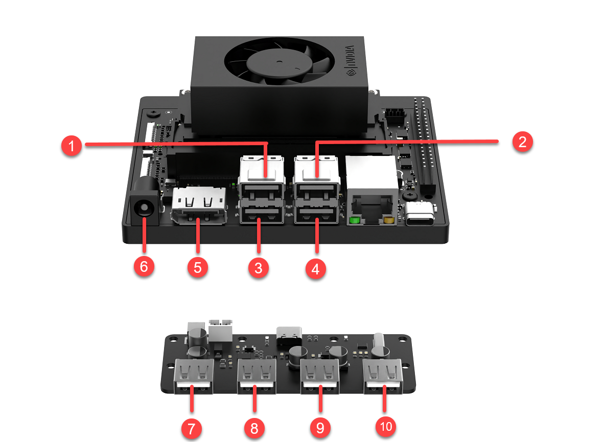

  • Jetson Orin Nano/Jetson Orin NX Controller Wiring Instructions
The image below shows the interfaces for each module connected to the Jetson Orin Nano/Jetson Orin NX controller, as well as the USB hub interface. Please refer to the table below for standard wiring instructions. (If the purchased package does not include the relevant modules, you may skip this interface.)
Orin Nano/Orin NX & USB HUB
1 Depth/ Monocular Camera 6 Orin Nano/Orin NX Adapter Power Supply

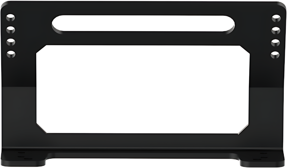

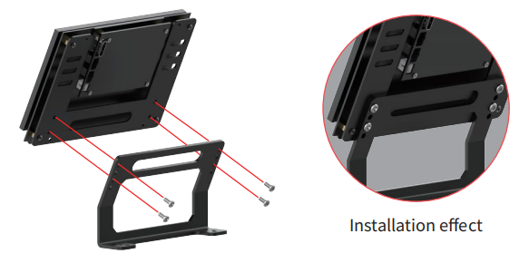

  • LCD Screen Installation Steps
(1) Attach the 7-inch LCD screen to the screen bracket with M4×6 machine screws.
(2) Fix the screen bracket on the bottom with M4×6 screws.
(3) Connect HDMI cable to HDMI interface on the 7-inch screen, and connect USB cable to CTOUCH port.
7-inch LCD screen does not support touch function if the cable is not connected to CTOUCH port.

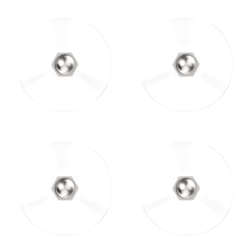

(4) Install the suction cups from the back of the bottom plate, and then secure them with the nuts.

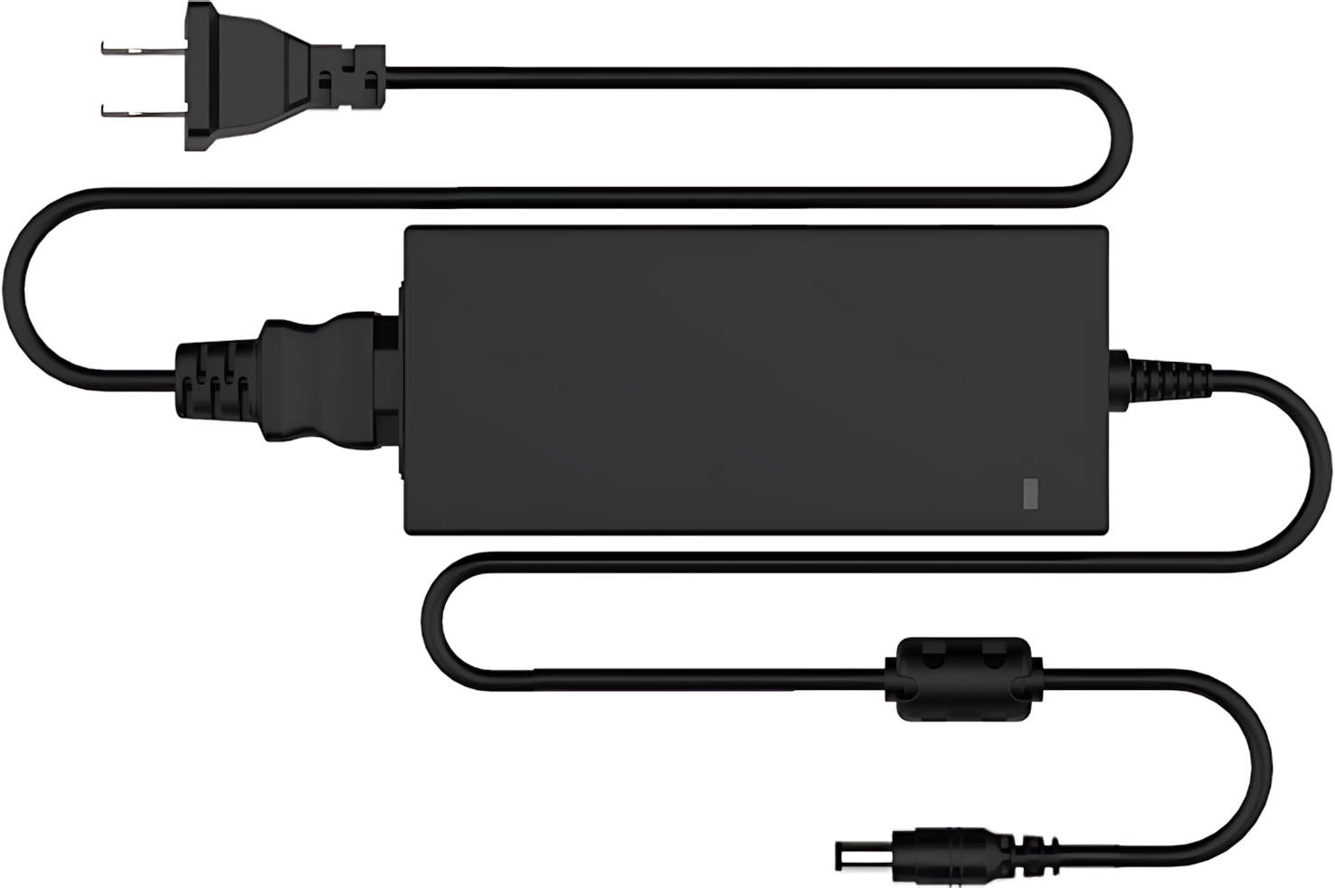

1.2.5 Adapter Connection

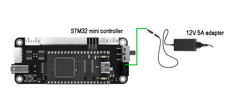

Connect 12V 5A adapter to the power interface on the driver, as shown in the image below:

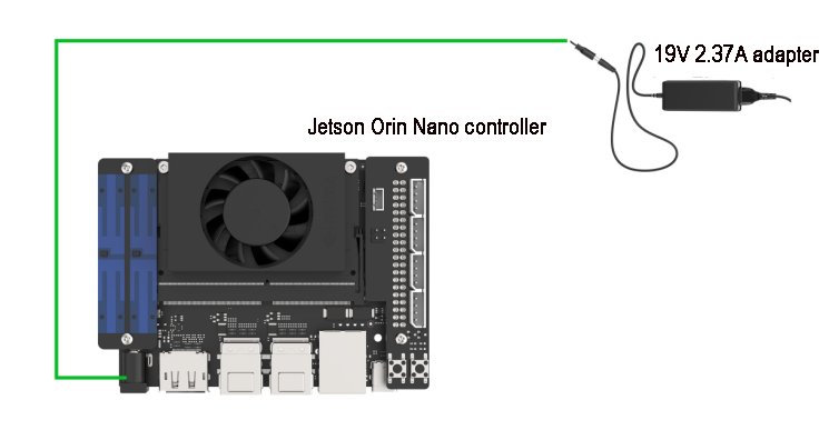

  • Jetson Orin Nano & Jetson Orin NX Controller
The Jetson Orin Nano and Jetson Orin NX controller versions require two adapters to be connected!
(1) Connect 19V 2.37A adapter to the power interface on the driver, as shown in the image below:
(2) Connect the 12V 5A power adapter to the power interface of the controller as pictured.
If a 12.6V battery is used for power supply, the connection can also be made as shown in the figure below.

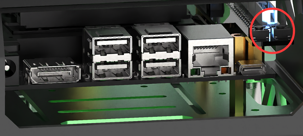

  • If LED1 does not blink after long pressing key1, it may indicate that the SD card or SSD is not detected. Please try reinserting the SD card or SSD.
  • If the LED remains steady after reinserting, there may be an issue with the SD card or SSD, or users who purchased a package without a controller may not have burned the image. It is recommended to replace the SD card or SSD or re-burn the image.
  • If you still cannot power on after replacing the SD card or SSD and re-burning the image, there may be an issue with the Jetson mainboard. Please contact customer service for further assistance.

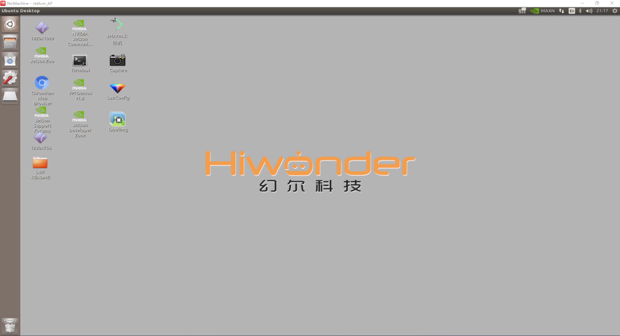

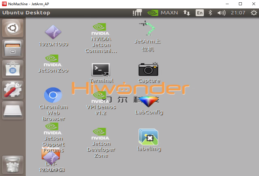

(4) Users who purchased the advanced or ultimate version will see the system startup desktop displayed on the 7-inch LCD screen after installation. Ultimate version users will also hear the notification Ready (as illustrated in the image below, using the Jetson Nano controller as an example).

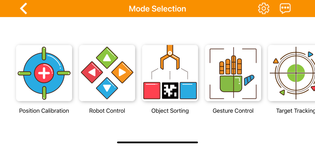

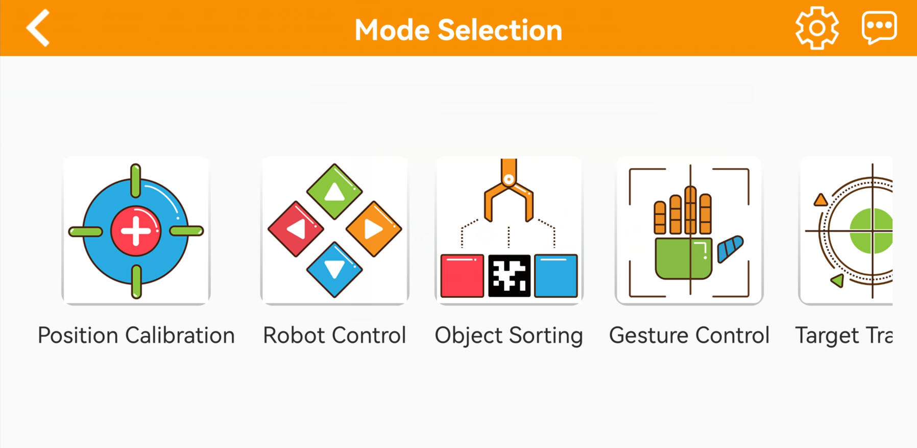

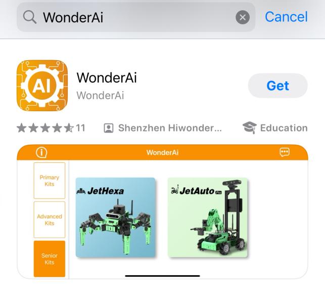

1.4 App Control
Users can control the robot and explore AI vision features using the mobile app WonderAi. This section will detail the operation methods for each function within the app. Please note that the demonstration will use the iOS system as an example, but the methods are also applicable to the Android system.
If you purchased a package without a controller, please refer to the course 1.6 Development Environment Setup and Configuration and complete the 1.6.7 Robot Version Configuration Tool Guide lesson before proceeding.
1.4.1 App Installation
  • Please ensure all app permissions are enables, otherwise app functions will be limited.
  • Before opening app, it is necessary to enable GPS and WIFI functionalities on phone settings.
  • Installation Steps
(1) Android system: the app installation package is located in App Installation Package.
(2) iOS system: search and install WonderAi in App Store.

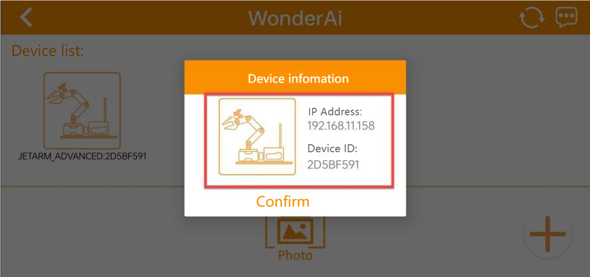

1.4.2 Connection Mode Introduction
There are two network modes, including AP direct connection mode and STA LAN mode.
  • AP direct connection mode: The controller generates a WiFi which can be connected by phones. This WiFi has no internet access.
  • STA LAN mode: The controller actively connects to specific WiFi. You can access Internet in this mode.
  • The robot powers on in AP connection mode by default. Regardless of whether users choose AP mode or STA local network mode, the robot’s functionalities remain the same.
  • We recommend that users first learn the configuration method for the direct connection mode to experience its features. The local network mode can be selected based on individual needs.
  • Direct Connection (Must Read)
The version of the iOS system should be iOS 11.0 or higher, while Android devices require version 5.0 or higher.
For Android users, please ensure that app permissions are granted; otherwise, the app’s functions will be limited!

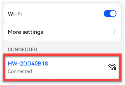

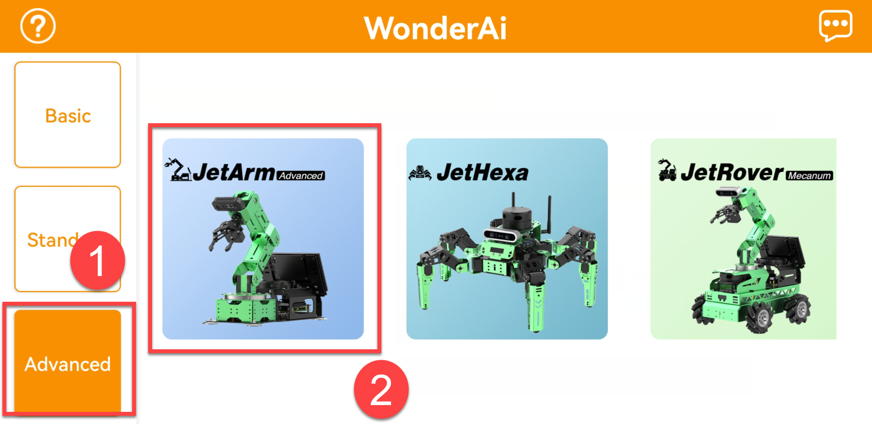

Take JetArm advanced kit as example using Android system for demonstration. The operations are applicable to the iOS system and other robot kits.

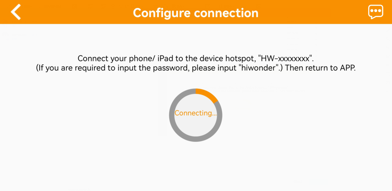

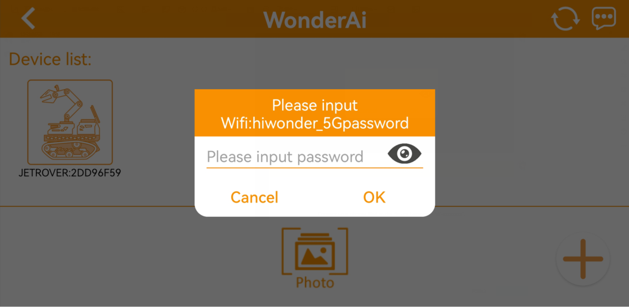

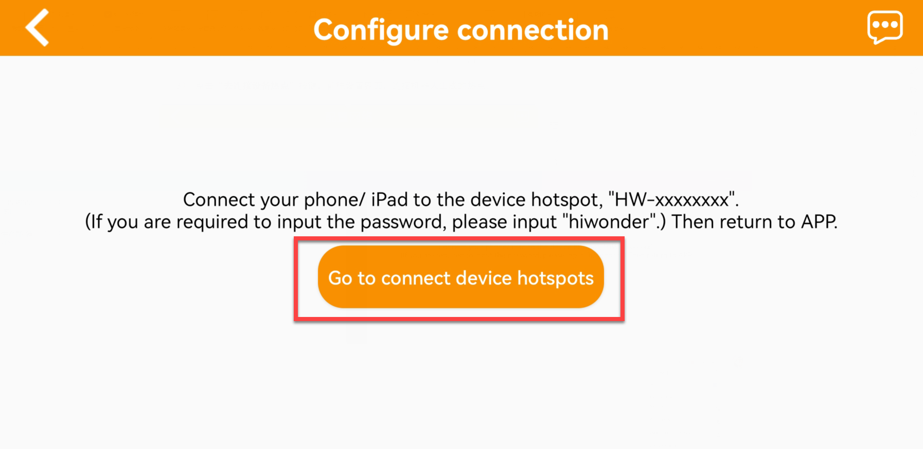

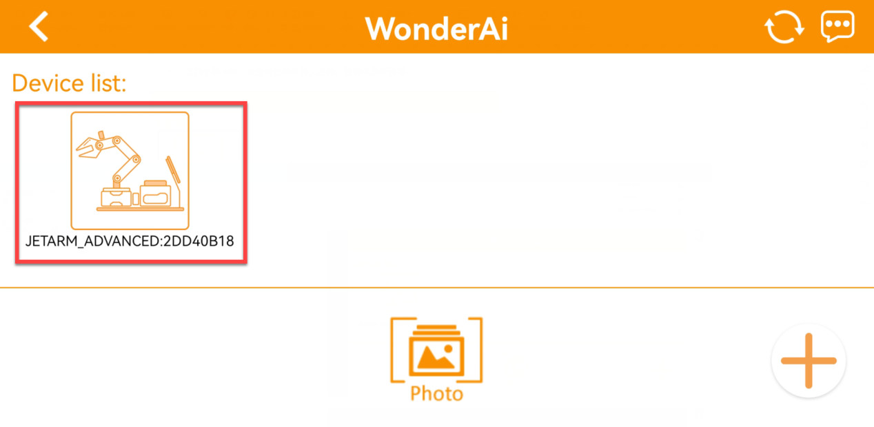

(1) Open WonderAi APP, then tap Advanced->JetArm in sequence.
(2) Click + button, and select Direct Connection Mode.
(3) Next, click Go to connect device hotspots to join the WiFi generated by JetArm.
(4) The device WiFi starts with HW and the password is hiwonder.

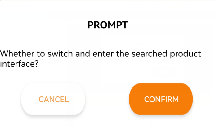

(6) When the following window pops up, it means that you have selected the wrong version. Click Confirm, then the app will automatically switch to the home interface of the right version.

  • LAN Mode Connection(Optional)
(1) Firstly, join 5G network, for example Hiwonder_5G. (The router supporting dual-frequency will distinguish the Wi-Fi name by default under the situation that 2.4 G and 5G are separated. For example, Wi-Fi Hiwonder is 2.4 frequency band while Hiwonder_5G is 5G frequency band)
(2) After connection, open WonderAi. Then click Advanced->JetArm in sequence. (Take JetArm advanced kit for example)
(3) Click + button at the lower right corner, then select LAN Mode.
(4) Continue, enter the Wi-Fi password. Having entered the password, click OK. Please ensure the password you enter is correct.
(5) Click Go to connect device hotspots.
(6) Join the WiFi starting with HW, and input the password hiwonder. After connection, return back to the app interface.
(7) Then, WonderAi app is connecting to the robot.
(8) After a while, the robotic icon will show up. And at the same time, LED1 on the Jetson Nano mini expansion board will light up.
(9) By long pressing the robotic icon, you can check the IP address and ID.

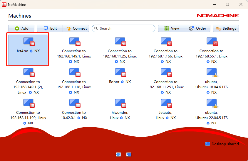

(10) Input this IP address in the search bar on remote desktop software. Then you can enter the robot system desktop. For the operation method, please refer to the following content 1.6 Development Environment Setup and Configuration.
(11) If you want to switch back to Direct Connect Mode, press KEY1 button on the expansion board until blue LED flashes, which means the current mode is Direct Connect Mode.
1.4.3 App Description

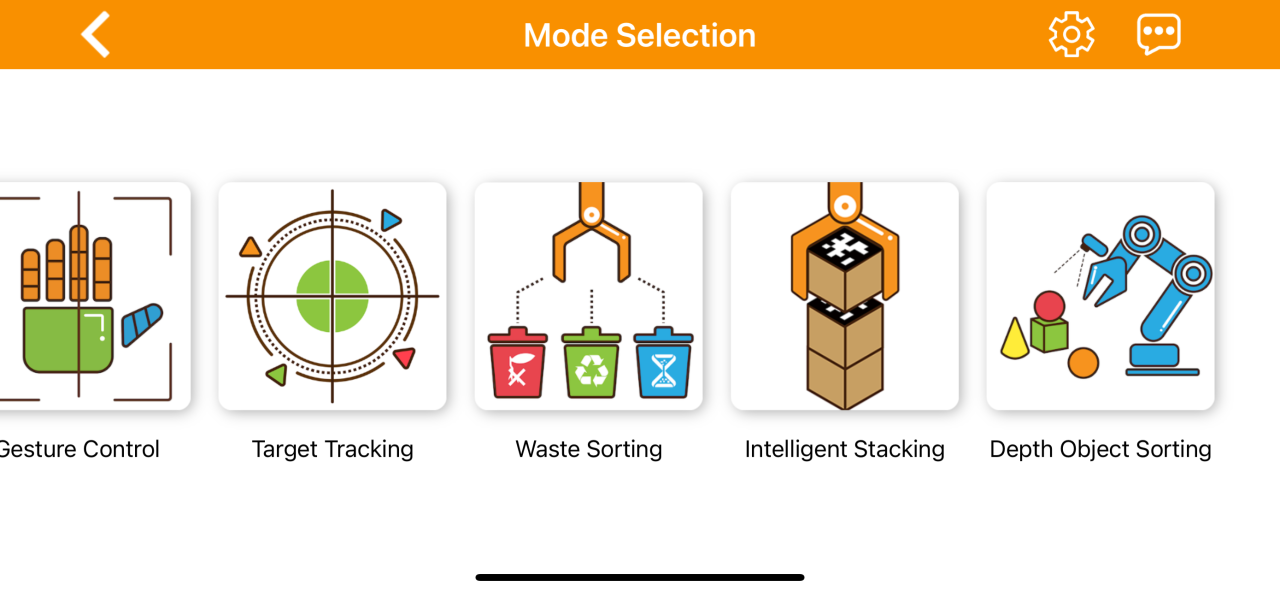

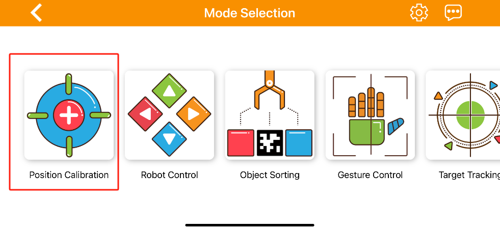

There are 8 robot games available on the app, including position calibration, robot control, object sorting, gesture control, target tracking, line following and AR.
The table below offers a detailed overview of each game.
Icon Name Feature
Position Calibration Acquire the distance between the block and the end effector of the robot arm.
Robot Control Control the robot movement in real time
Object sorting Select the color ID and tag ID in the app. The robot arm will pick up the block with the specified color and tag ID and place it in the corresponding sorting area.
Gesture control Once the feature is activated, the camera will tilt upward and execute the corresponding action when a gesture is detected (specific feedback can be viewed by clicking Operation Instructions on the control area).
Target Tracking Select the color or face to track, and the robotic arm will move accordingly to follow the target
Waste Sorting Garbage blocks within the detection area will be picked up and placed into the corresponding waste category
Intelligent Stacking Labeled wooden blocks in the detection area will be stacked in the designated position
Depth Object Sorting Small balls, rectangular blocks, and cylinders in the detection area will be placed in their corresponding locations

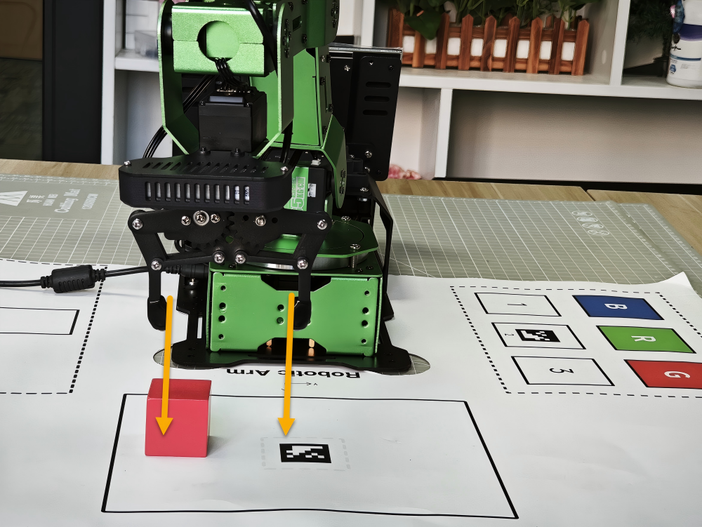

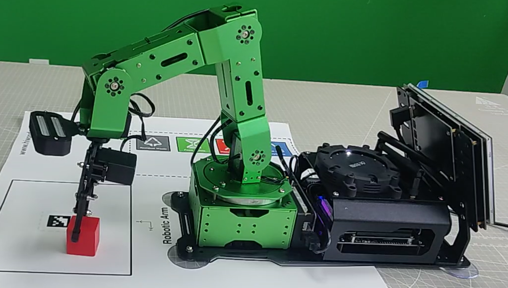

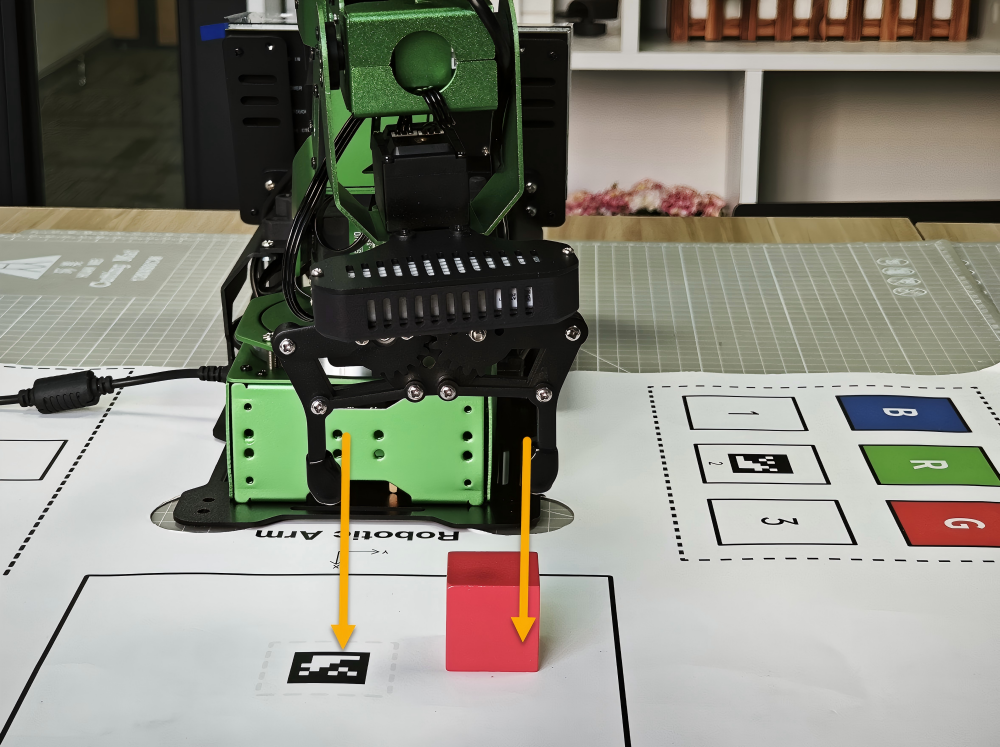

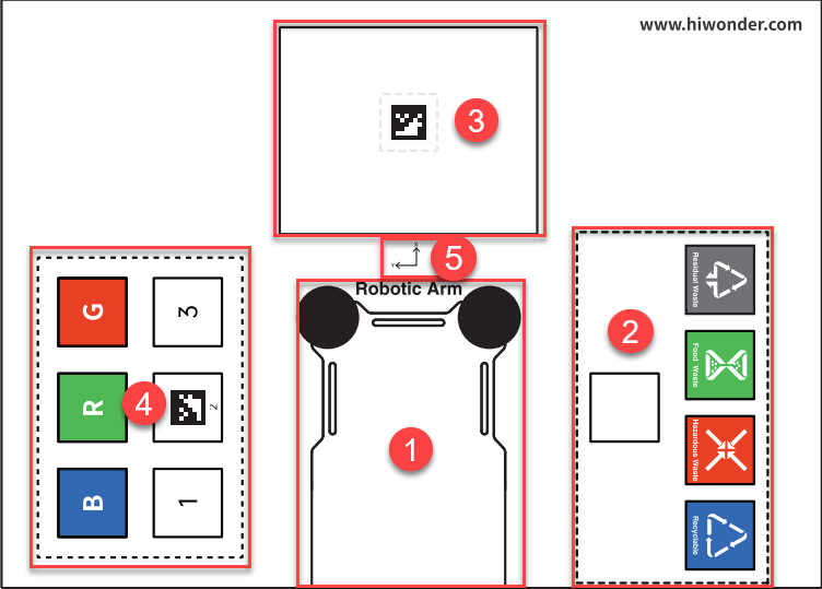

1.4.4 Map Introduction and Device Placement
For a better experience, we need to have a basic understanding of the map. This section will introduce the placement of device and the distribution of map.

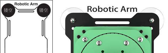

Firstly, lay the map flat on the table, and then position the robotic arm within the area as shown in the left illustration below. The front end of the base should align with the front boundary of the robotic arm placement area, and the suction cups should be firmly against the table, as depicted in the illustration on the right below.
The map is composed of four sections: ① Robotic arm placement area ② Waste sorting area ③ Vision recognition area ④ Color and tag sorting area ⑤ X-axis and Y-axis coordinates of the robotic arm
  • Robotic Arm Placement Area
When placing the robotic arm, the front end of its base should align with the front boundary of the robotic arm placement area, and the suction cups should be firmly against the table, as depicted in the picture below.

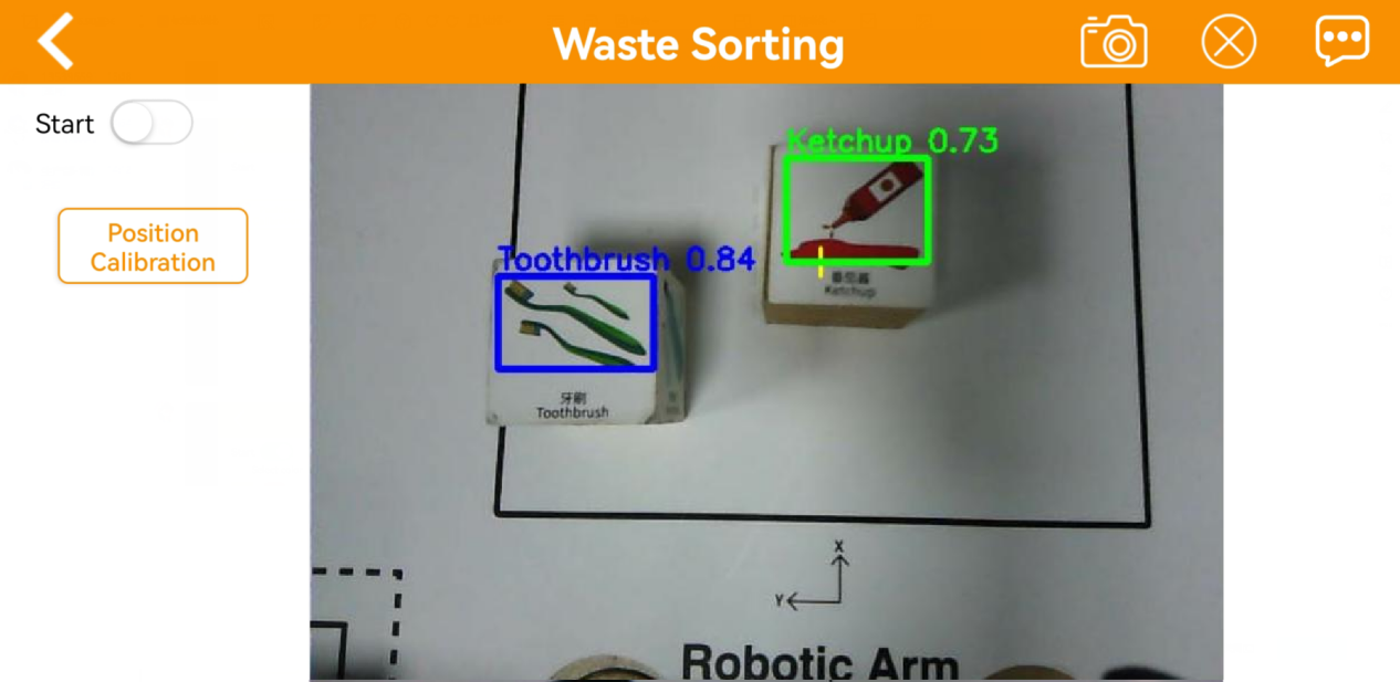

  • Waste Sorting Area
The robotic arm will transport the blocks or cards from the recognition area to their respective placement area.
The functions of above areas are as follow.
Icon Function
Stacking area
Residual waste cards placing area
Food waste cards placing area
Hazardous waste cards placing area
Recyclable waste cards placing area
  • Vision Recognition Area
In robotic arm vision recognition area, the central label servers as a reference point during the position calibration of robot arm (for details on position calibration, please refer to 1.4.5 Position Calibration). Place the blocks with garbage card or color blocks to be recognized within this area.
when placing the blocks, do not locate them at the edges of the vision recognition area to prevent recognition failure.
  • Color and Tag Sorting Area
The robotic arm will transport the blocks from the recognition area to their respective placement area.
Icon Function
Red block placing area
Green block placing area
Blue block placing area
Tag ID3 block placing area
Stacking and tag ID2 block placing area
Tag ID1 block placing area

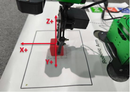

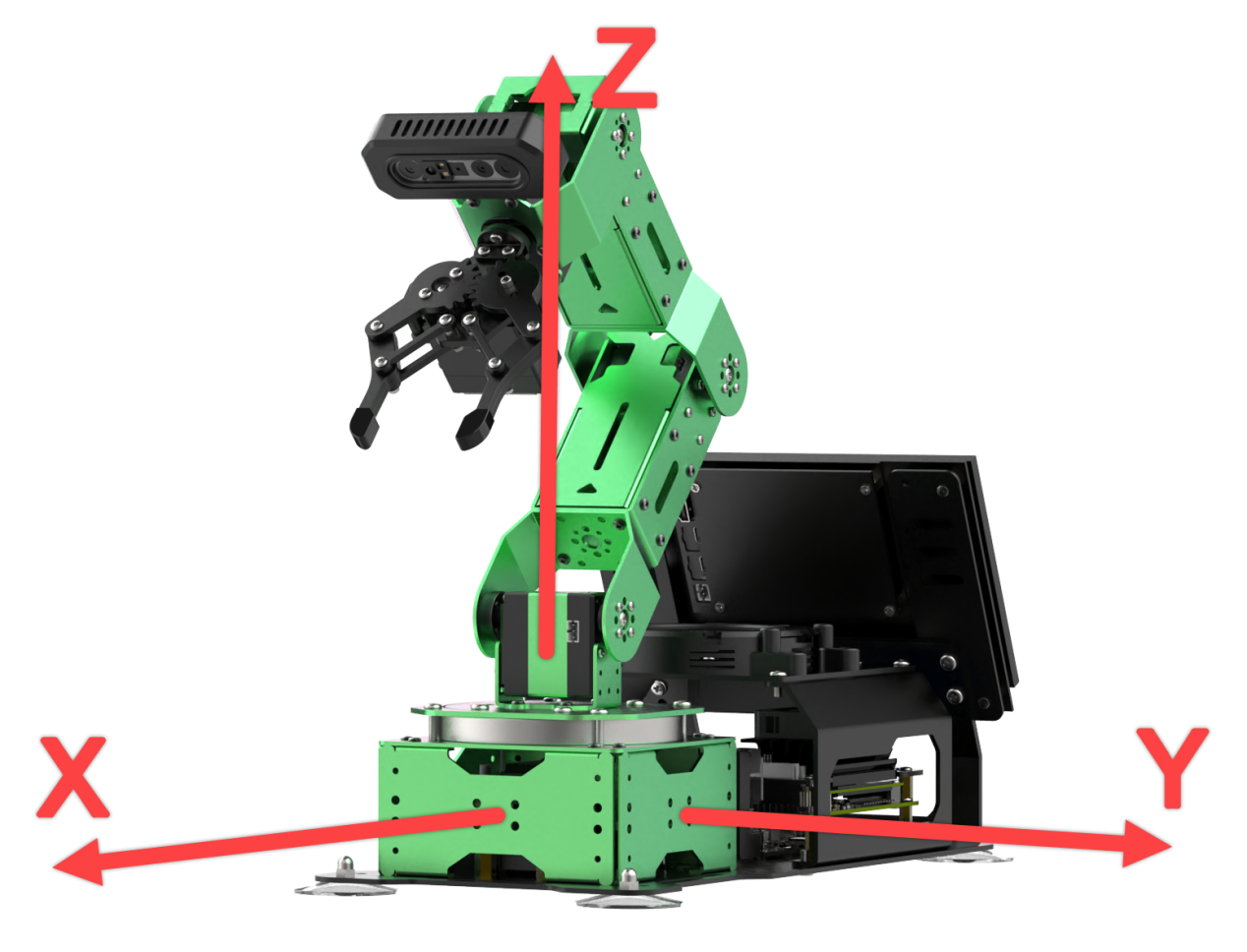

  • X-axis and Y-axis Coordinates of Robotic Arm
After the robotic arm is placed on the map, you can refer to this coordinate axis to confirm the positive directions of X-axis and Y-axis of the robotic arm.

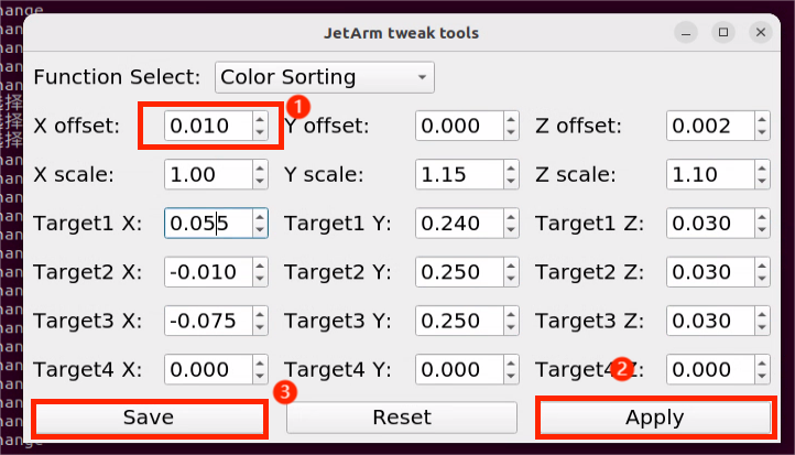

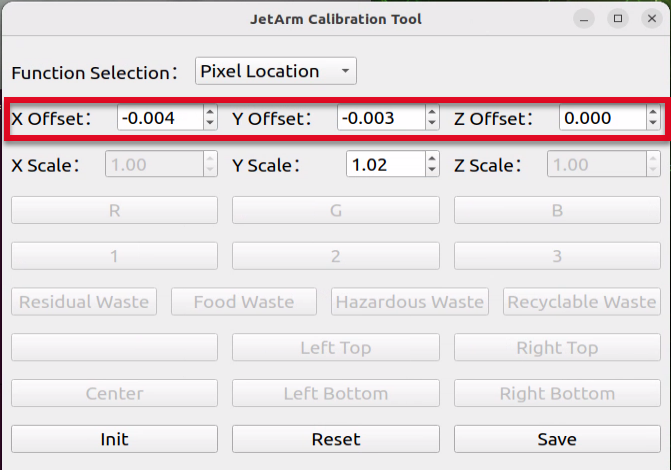

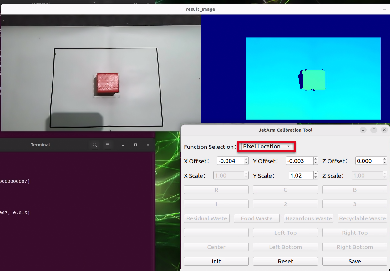

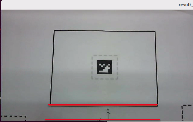

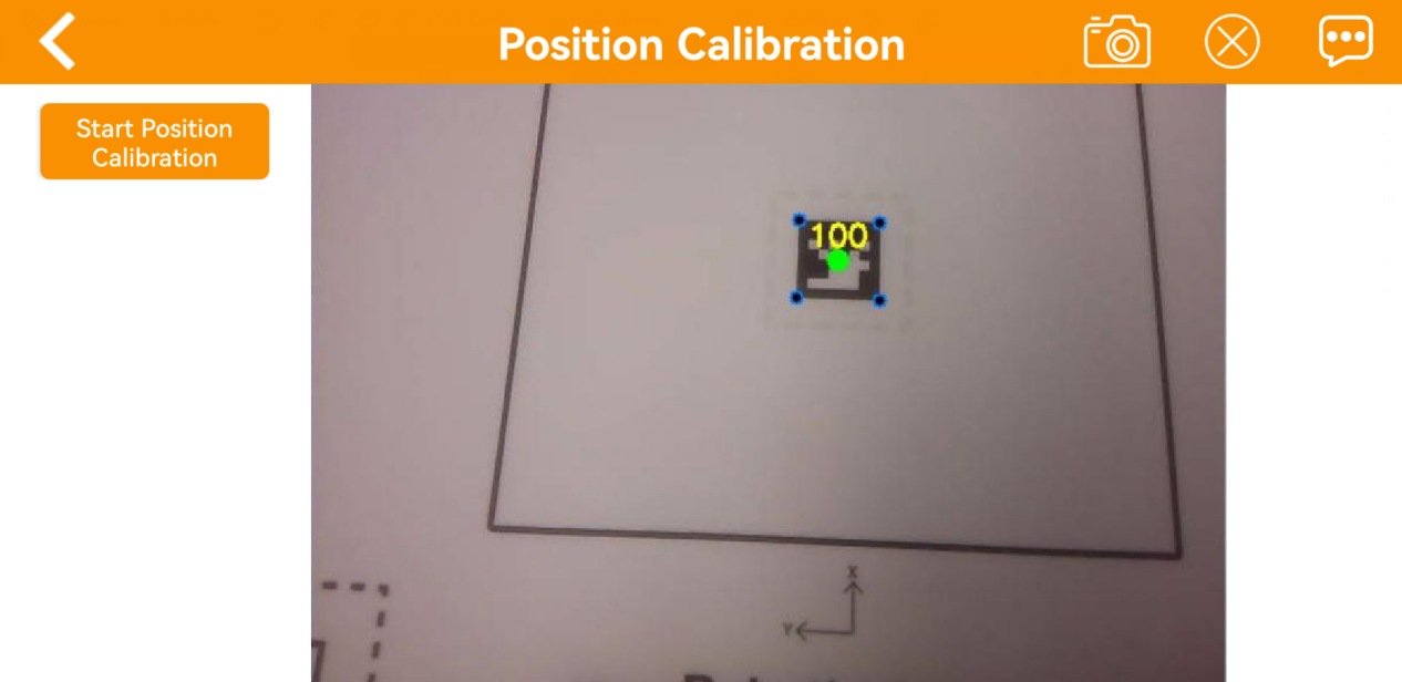

  • Calibration Process

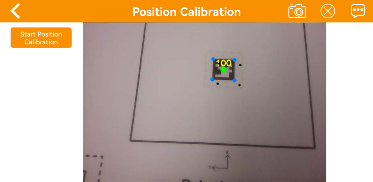

(1) When using the app for the first time, the live camera feed may take a few seconds to appear. If there is no live camera feed for a long time, return to the mode selection page and re-enter. Once the live camera appears, tap position calibration.
(2) Please be patient. Calibration needs to take a while to complete. Upon observing the alignment of 5 block dots overlap with the 5 colored dots on AprilTag, the calibration is finished.

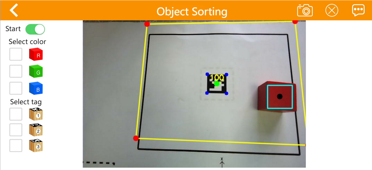

1.4.7 Object Sorting
  • Please start this game in a well-lit environment.
  • Keep a certain distance between the blocks. Do not make them too close to each other.
  • Maintain the integrity of the tag as the missing corners or stains may effect the recognition result.

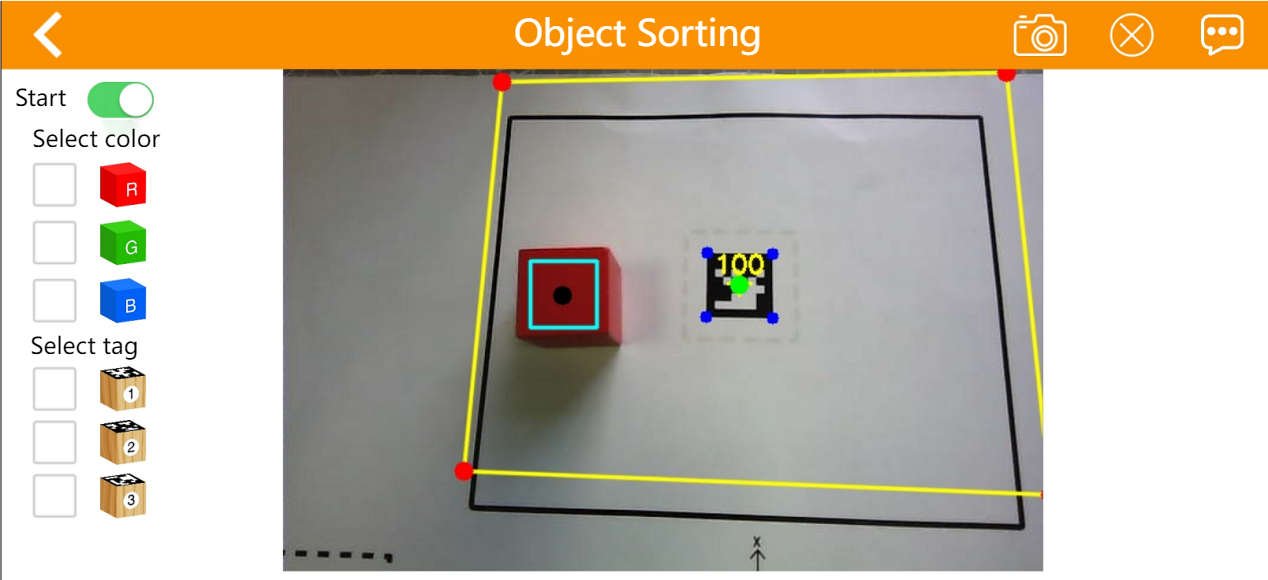

  • Interface Layout
(1) Click to enter the game interface. The interface consists of two parts.
① On the left side, you can start the game and select the target color and tag.
② The right side is the live camera feed.
Icon Instruction
Activate/Deactivate game
Select the color and tag for sorting

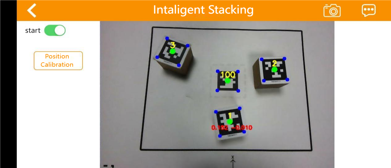

1.4.10 Intelligent Stacking
  1. Please perform this operation in a well-lit indoor environment.
  2. Maintain a proper distance between the blocks; do not place them too close together.
  3. If the gripping is not accurate, click the position calibration button to adjust.
  • Interface Layout
Click to enter the game interface. The interface is divided into two parts:
(1) Left side: game control switch
(2) Right side: live camera feed

1.4.12 Waste Sorting
  • For accurate gripping, keeping the block with waste card parallel to the lines of the gripping area.
  • If the gripping is inaccurate, you can tap the position calibration button to perform calibration.
  • Interface Layout
Click to enter the game interface. The interface is consists of two parts.
(1) On the left side, you can start the game.
(2) The right side is the live camera feed.

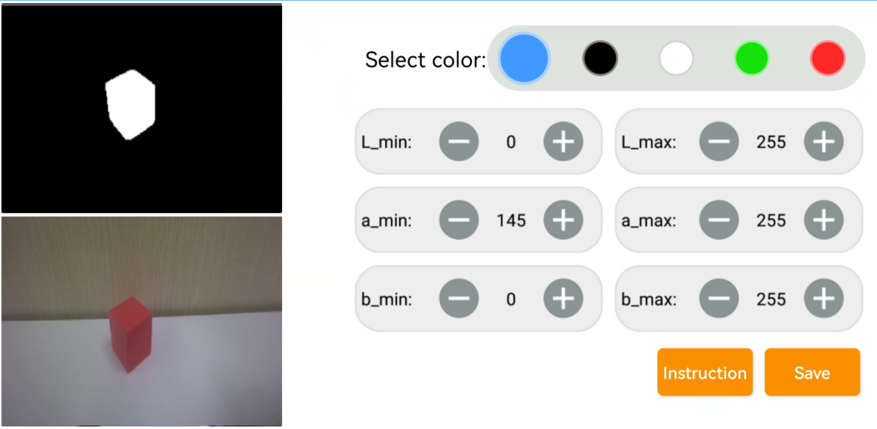

(1) Start JetArm and connect it to WonderAi. (For the operation instruction, please refer to 1.3 Initial Startup Instructions and 1.4 App Control.)
(2) Enter the main interface, then click at the upper right corner to enter the interface of color threshold setting.

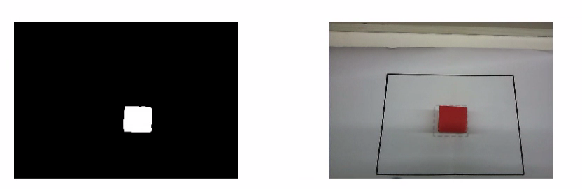

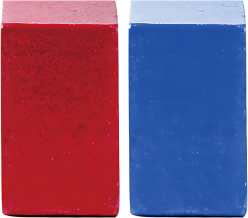

(3) Take adjusting red color for example. Place the red block within the recognition area on the map, then select the red icon.
(4) Click Instruction button to check the color adjustment instruction.

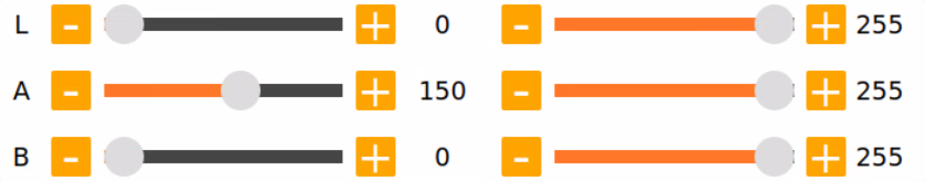

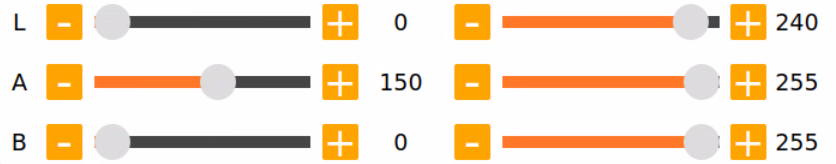

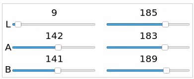

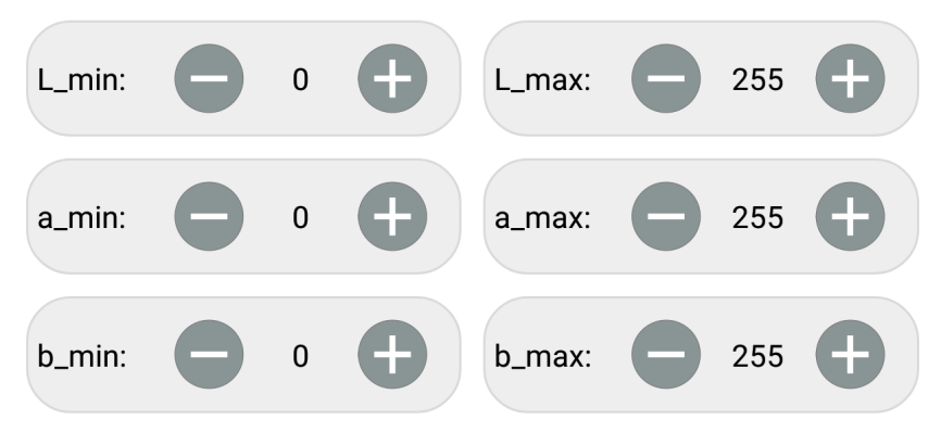

(5) Set the parameters of L_min, a_min and b_min as 0, and the parameters of L_max, a_max and b_max as 255.
(6) Refer to LAB color space distribution to adjust the L, A and B components.
(7) According to the Lab color model diagram, red color is around +a zone, so we need to adjust the color threshold to +a zone. Keep the values of L_max unchanged, while increase the values of L_min until the block image in the screen turns white and other area turns black.
(8) Then based on the environment, adjust the value of L_min, L_max, b_min and b_max. If the color belongs to light red, you need to increase the value of L_min. If it belongs to dark red, decrease the value of L_max. If it belongs to dark red, decrease the value of L_max. If it belongs to warm tone, increase the value of b_min. If it belongs to cool tone, decrease the value of b_max
(9) After the adjustment is completed, tap the Save button to save the color threshold.

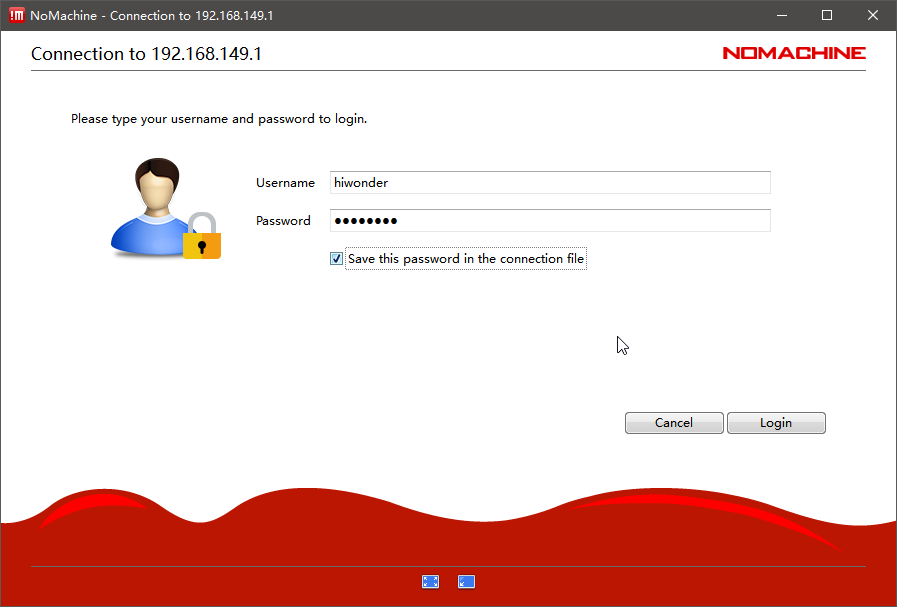

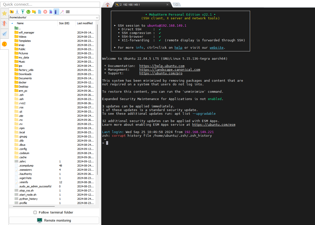

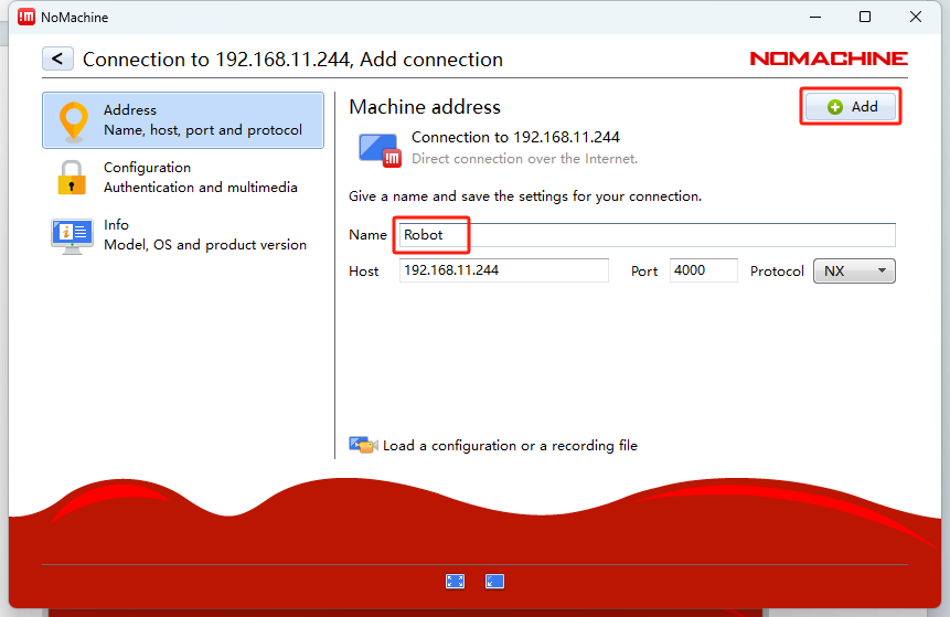

(1) Remotely connect to JetArm via Nomachine. For a specific instruction, please refer to 1.6 Development Environment Setup and Configuration.

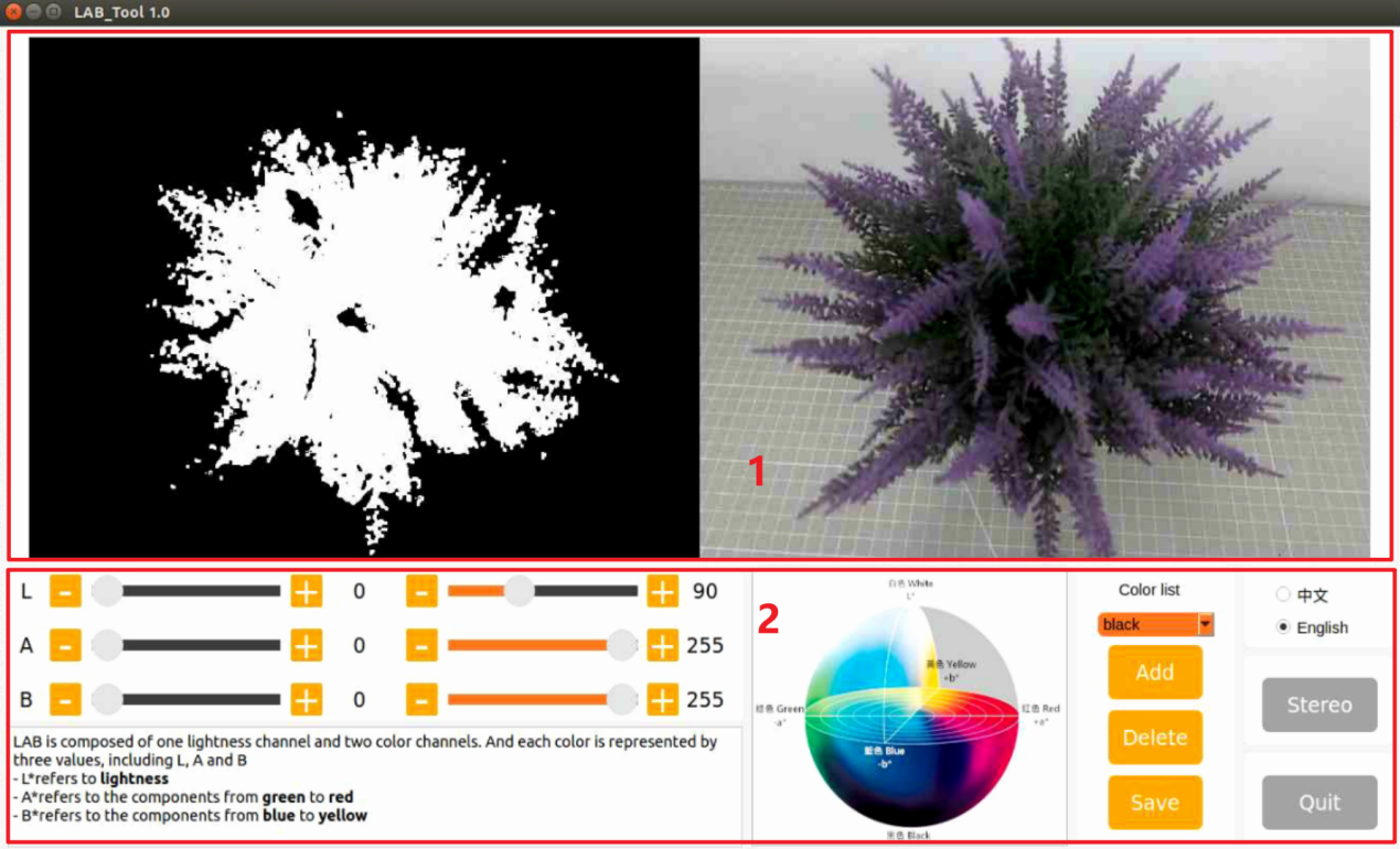

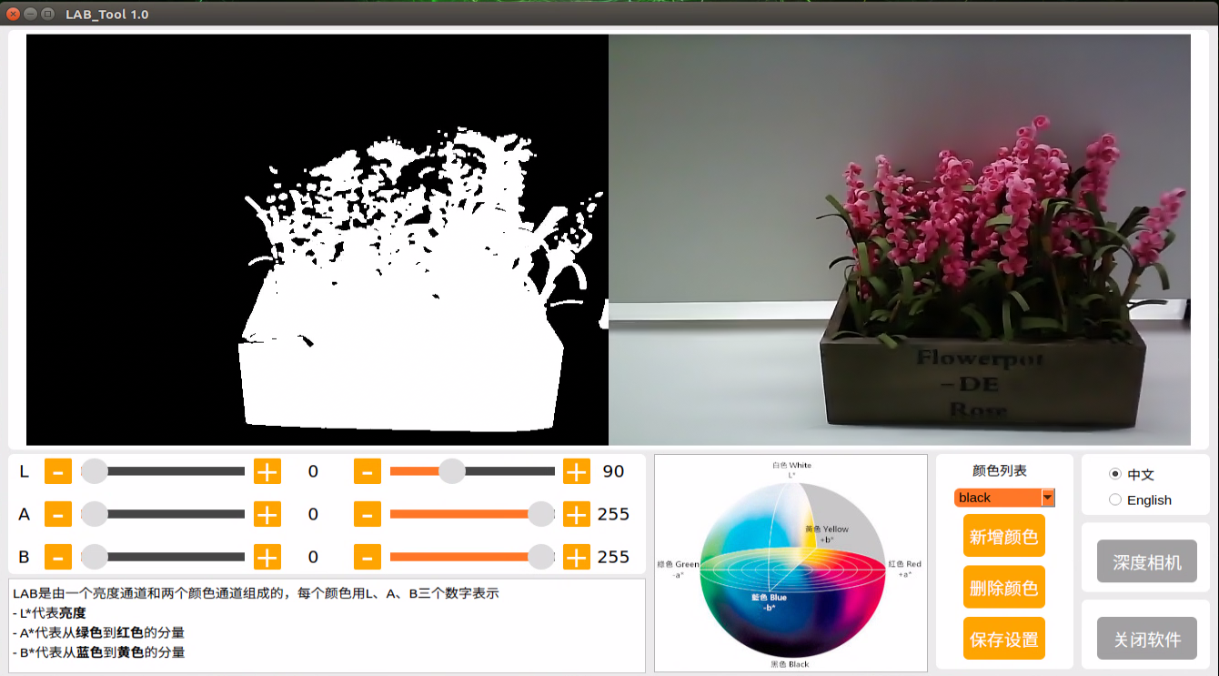

  • LAB TOOL Interface Layout Instructions
The interface of LAB tool software consists of two parts: the display area and the recognition adjustment area.
  • Display Area Functions
(1) Display Area: The left display frame shows the camera-processed image, and the right display frame shows the raw image.
The abnormal image display indicates a camera connection failure. In this case, it is required to verify if the camera connection cable is properly connected , or try unplugging and reconnecting it.
(2) Recognition Adjustment Area: It can be applied to adjust the color threshold. Refer to the following table outlining the features for each buttons:

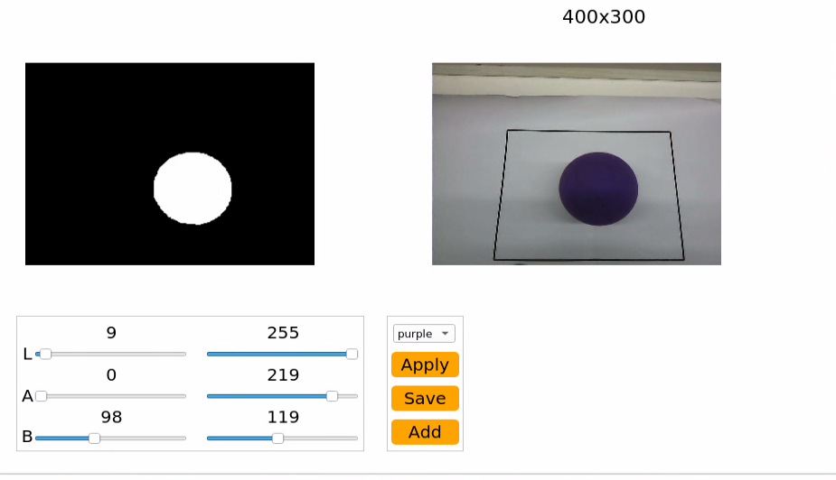

  • Color Threshold Adjustment
(1) Open the Lab_Tool software. Select the color for threshold adjustment from the color list in adjustment area. The red color will be used an example for demonstration.

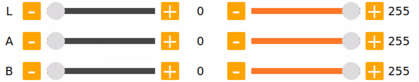

(2) Set the min values of L, A and B components to 0 and the max values to 255.

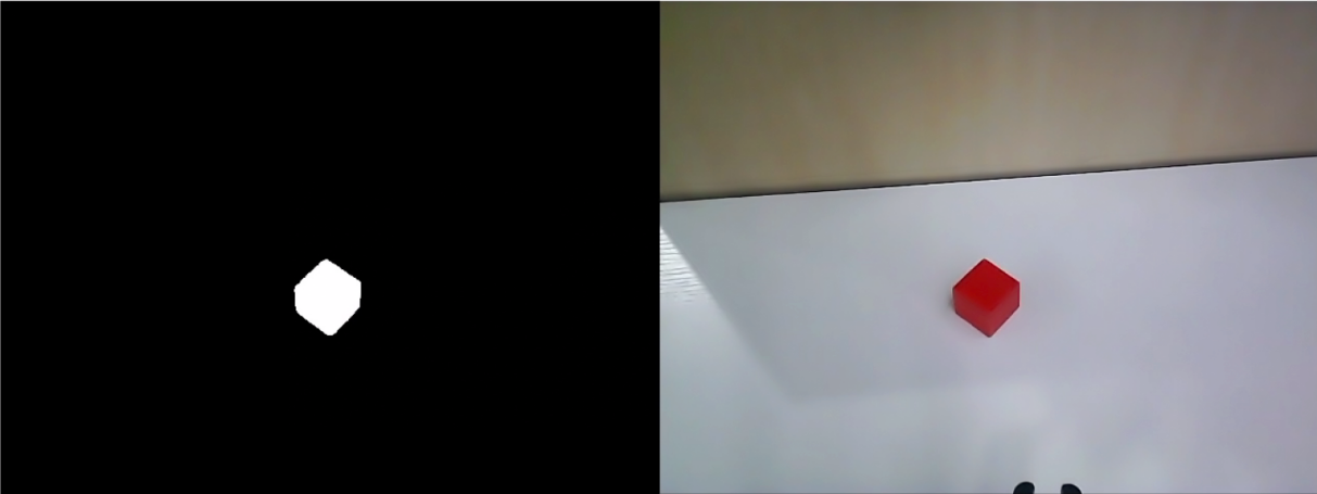

(3) Place the colored object within the camera’s field of view, and refer to the LAB color space distribution chart to adjust the L, A, and B component values toward the target color range.
(4) According to the Lab color model diagram, red color is close to +a zone, so the max value of the A component unchanged and gradually increase its min value until the red object area in the left display frame turns white, and the rest of the image turns black.
(5) Adjust the remaining L and B components according to the surrounding environment. If the red color appears too light, increase the min value of the L component; if it appears too dark, decrease the max value of the L component. If the red color looks too warm, increase the min value of the B component; if it looks too cool, decrease the max value of the B component.
The table below shows the parameter information for LAB threshold adjustment:
Color Component Value Range Corresponding Color Range
L 0~255 Black to White (−L ~ +L)
A 0~255 Green to Red (−a ~ +a)
B 0~255 Blue to Yellow (−b ~ +b)
(6) Click the Save button in the recognition adjustment area to save the color threshold parameters.

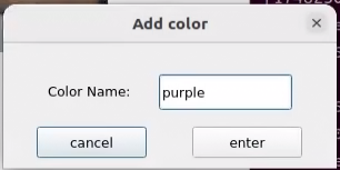

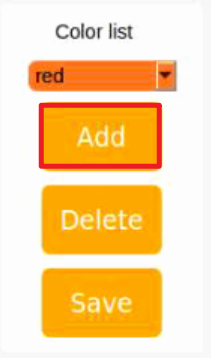

  • Add a New Recognition Color
In addition to the default recognition colors, users are allowed to add other identifiable colors. Taking purple as an example, the specific steps are as follows:
(1) Open the Lab_Tool software, and click Add.
(2) Enter the color name in the Color name field and click the OK button.
(3) Choose the newly added color from the color list.
(4) Place the colored object within the camera’s field of view, then adjust the L, A, and B component sliders to set the thresholds until the colored object area in the left display frame turns white and the rest of the image turns black.
For specific instructions, please refer to the content below 1.5.5 Color Threshold Adjustment.
(5) Click Save button in the recognition adjustment to save the color threshold parameters.

(1) Remotely connect to JetArm via Nomachine. For a specific instruction, please refer to 1.6.2 AP Direct Connection Mode.

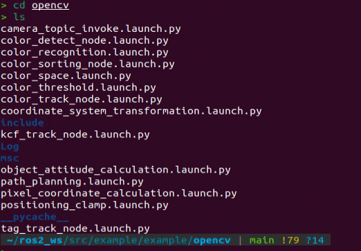

(3) Waiting for a Beep sound from the buzzer, then enter the following command to open the Lab Tool software:
python3 ~/factory_utils/lab_tool/main.py
Regarding the interface layout instructions, please refer to the following sections of this document.

1.5.4 LAB TOOL Interface Layout Instructions
  • Interface Components
  • Adjustment Steps

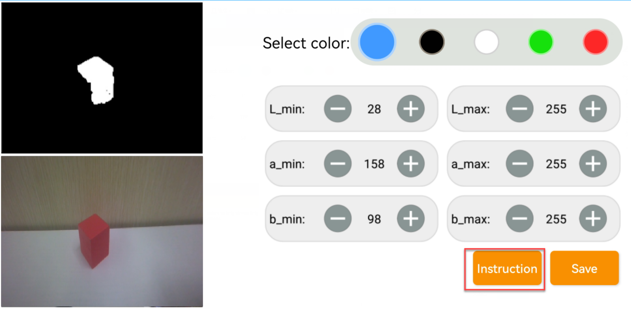

1.5.6 Add a New Recognition Color
In addition to the default recognition colors, users are allowed to add other identifiable colors. Taking yellow as an example, the specific steps are as follows:
  • Adding Yellow Color Process
(2) Enter the color name in the name field and click the OK button.
Once the adjustment is completed, press Ctrl+C to disable the camera service, then click Close to exit the interface.

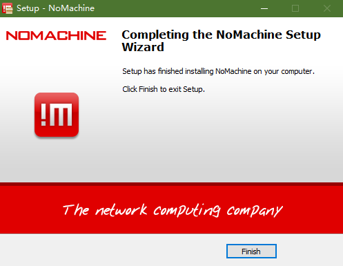

(1) Open the software pack nomachine_8.4.2_10_x64.exe.
(2) Click Next button.
(3) Set the language as English and tick I accept the agreement. Then move to Next step.
(4) Remain the default storage path for NoMachine, then click Next.
(5) Please wait until the installation completes. Click Finish button.
(6) Click Yes to restart the computer. Please don’t skip this step!

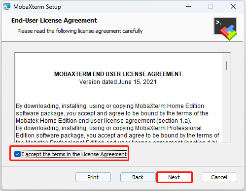

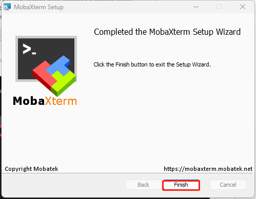

  • MobaXterm Installation
(1) Locate the MobaXterm_Installer_v22.1 , and double-click the file MobaXterm_installer_22.1.msi to install it.
(2) Follow the below pictures to finish the installation.

Connection Through NoMachine
  • NoMachine Connection Steps
(1) Connect your computer to the WiFi starting with HW.
(2) Open NoMachine. Input 192.168.149.1 in the search bar, then click-on Configure connection to new host 192.168.149.1.
(3) Change the name to JetArm, then click-on Add button.
(4) Double-click JetArm.
(5) The Username and Password fields need to be filled in according to the main controller version:
For the Jetson Nano main controller, the initial configuration username is: hiwonder, and the password is: hiwonder.
For the Jetson Orin Nano main controller, the initial configuration username is: ubuntu, and the password is: ubuntu.
For the Jetson Orin NX main controller, the initial configuration username is: ubuntu, and the password is: ubuntu.
After filling in the fields, check the Save this password box and click the Login button. The following image illustrates the Jetson Nano version as an example:

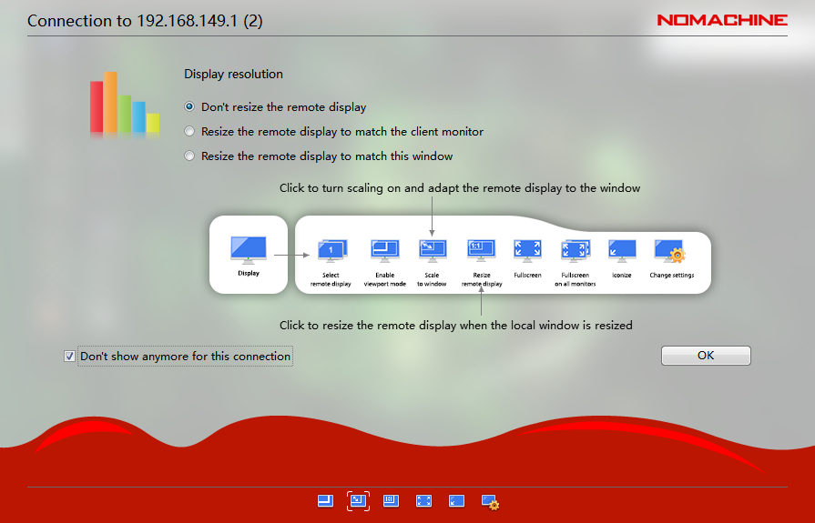

(6) Tick the below box and click OK. (If you do not tick this option, the pop-up window will occur next time.)
After starting up and connecting for the first time, the resolution may be abnormal. You can navigate to the section 1.6.8 Remote Desktop Resolution Settings.

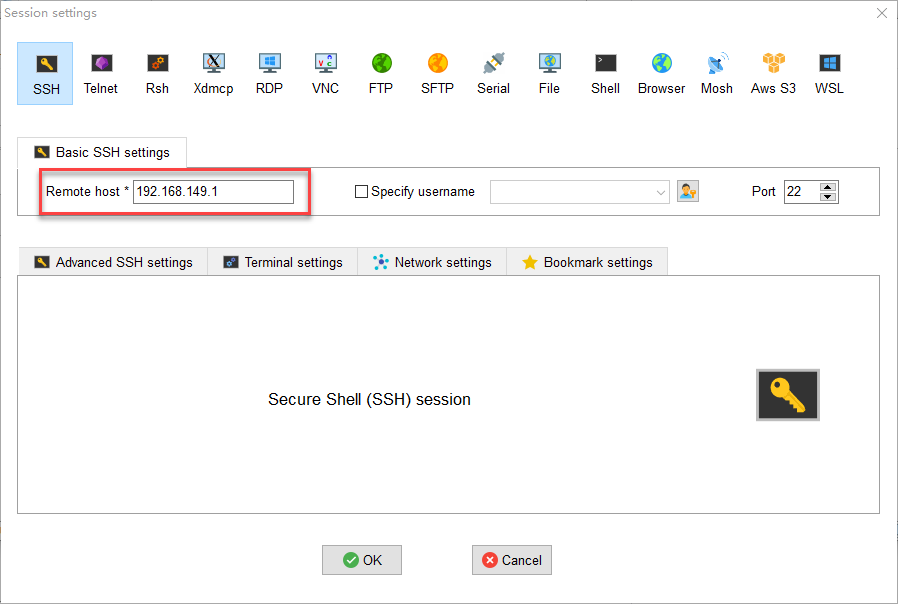

Connection Through MobaXterm
This example demonstrates the method for Direct Connection Mode. The same steps can be followed in Local Area Network Mode, simply by changing the IP address.

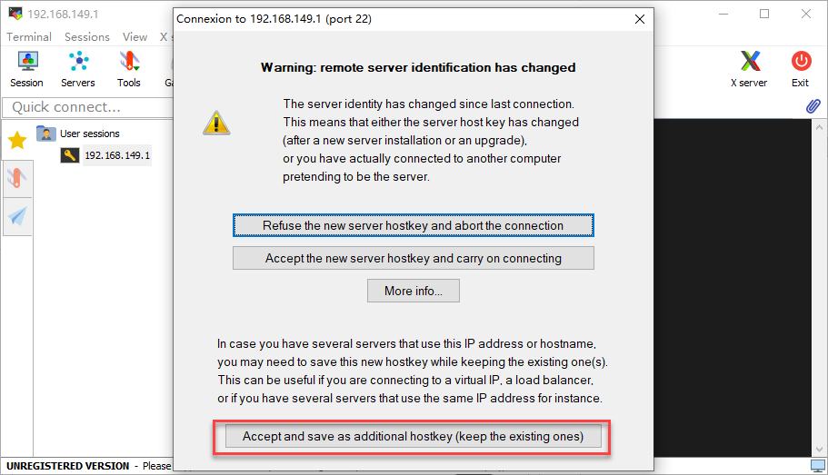

  • MobaXterm Connection Process
(1) Open MobaXterm. Click-on Session at the upper right corner to create a new session. Enter the IP 192.168.149.1, and click-on OK.
(2) Select SSH.
(3) Enter the fixed IP address under the Direct Connection Mode: 192.168.149.1
(4) If the following pop-up appears, please select the third option.
(5) The interface prompts you to enter the username (login as) and password (password), which should be filled in according to the main controller version below. The following image illustrates the Jetson Nano version as an example:
  • The username must be in lowercase. Even if the username contains uppercase letters during the setup, it should be entered in lowercase when logging in.
  • The username will be displayed visually. After entering it, you must press Enter before inputting the password.
  • The password will not be displayed visually. Similarly, after entering the password, you must press Enter to log in.
(6) When you log in successfully to the system, the interface will appear as shown in the image.

(1) In LAN mode, search for and connect to the Wi-Fi you have set up on your computer, as shown in the image below.
(2) Open NoMachine and enter the IP address 192.168.11.244 in the search bar on the software interface. Click Configure connection to new host 192.168.11.244.
(3) Once opened, modify the Name field to Robot while keeping the other options unchanged, then click Add.
(4) For the Username and Password fields, please fill in the information based on the control version you are using:

(8) Connect your mobile phone to the 5G network, for example, connect to the Hiwonder_5G Wi-Fi.
(9) Open the mobile app WonderAi, then click through Advanced Kit and JetArm.
(10) After a moment, the main interface will display the corresponding icon and name of the robot.
(11) Long-press the robot icon in the app to view the assigned IP address and device ID for the robot.

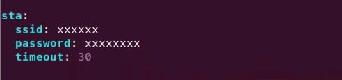

  • Orin Series Wi-Fi Configuration Steps
(1) Double-click on the system desktop to open the command line terminal.
(2) Enter the following command and press Enter to navigate to the configuration file directory.
cd wifi_manager/
(3) Enter the command below and press Enter to open the configuration file.
vim hiwonder_wifi_conf.py
(4) First, modify the value of HW_WIFI_MODE to 2. The values are defined as follows:
1: Direct connection mode
2: LAN mode
3: Direct sharing mode
(5) Next, modify HW_WIFI_STA_SSID and HW_WIFI_STA_PASSWORD to set the router’s Wi-Fi name and password.
Choosing a 5G Wi-Fi signal will provide a higher transmission rate. If you experience lag while connected to a regular Wi-Fi, consider switching to a 5G Wi-Fi network.
(6) After confirming the entries are correct, press the ESC key, then type :wq to exit and save the file.
(7) Enter the following command to restart the robot’s Wi-Fi service. After a moment, LED1 on the expansion board will remain lit.
After restarting the robot’s Wi-Fi service, NoMachine will automatically disconnect. This happens because the device is set to LAN mode, and connecting to a different Wi-Fi network changes the IP address, making it inconsistent with the previous one.
(12) Enter the retrieved IP address into NoMachine to establish a remote connection. For more details, refer to the tutorial 1.6.2 AP Direct Connection Mode.
(13) If you need to switch to direct connection mode, re-edit the configuration file, comment out all the lines, then save and restart the robot.

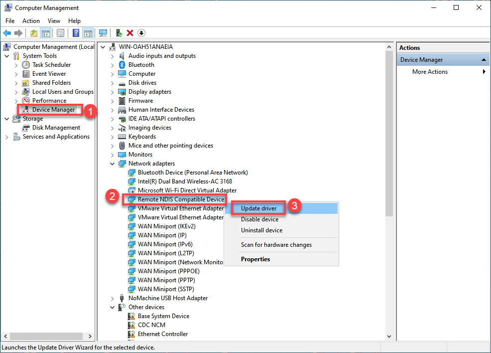

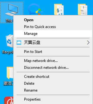

(3) Right-click This computer to choose Manage.
(4) Click on Device Manager in the left-hand menu of the interface. Locate the NDIS driver under Network adapters and right-click on the driver. Choose the Update driver option from the menu.
(5) After the installation of driver, refer to 1.6.2 AP Direct Connection Mode to login the system. In addition, you need to replace the IP address with 192.168.55.1.

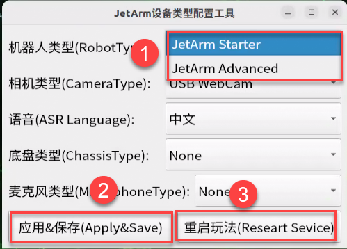

This section introduces the built-in Version Configuration Tool, which allows switching between different chassis types, various radar and camera models, and English or Chinese voice options.
This content is primarily intended for the following users:
(1) Those who purchased a version without a controller
(2) Those who have re-flashed the system image
(3) Those who have replaced compatible components, such as switching from a Mecanum wheel chassis to a tracked chassis
For users who purchased a complete system with a controller included, this section is for reference only, and no action is required. Before using the tool, confirm the system version configuration based on the main control model you have purchased.
Introduction and Use of the Tool

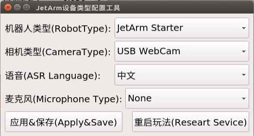

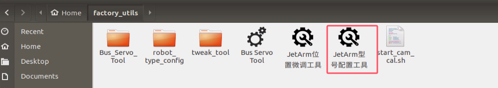

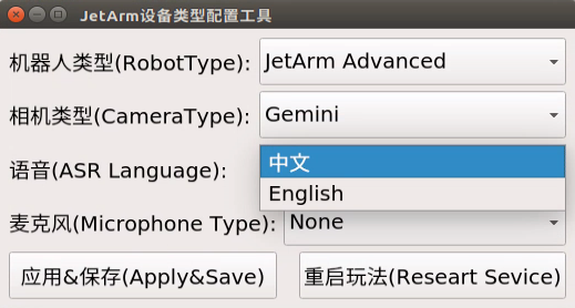

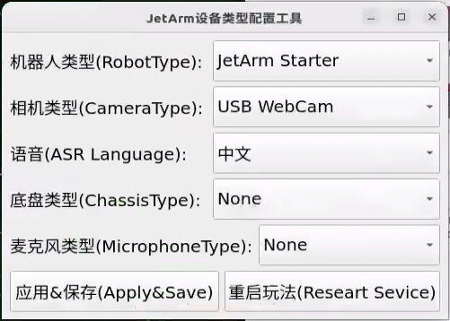

  • Jetson Nano Controller Version Configuration
(1) Remotely connect JetArm to Nomachine software.

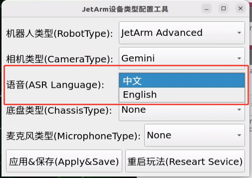

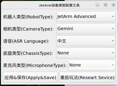

(2) After opening the remote desktop, locate and open the robot system configuration tool according to the path as pictured:
(3) As shown in the image below, if you’re using JetArm starter kit, you should select the robot type as JetArm Starter and the camera type as USB WebCam.
For Standard, Advanced, and Ultimate kits, users should select the robot type as JetArm Advanced and the camera type as Gemini.
For advanced and ultimate kits, users can select the voice language between Chinese and English, and select the microphone type as xf.
(4) The hardware version of your robot can be confirmed by reviewing your order information. The Robot Type, Camera Type, ASR Language, and Microphone Type must be configured in the robot system configuration tool to match your current robot, which can be referenced in the table below. Please keep all other options at their default values and avoid making modifications to prevent any issues!
Option Configuration
Robot Type JetArm Starter
JetArm Advanced
Camera Type USB WebCam
Gemini
ASR Language 中文
English
Microphone Type None
xf
wonderechopro

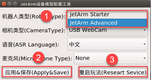

(5) For instance, if you need to switch the robot type from JetArm Starter to JetArm Advanced, the following steps can be referenced:
(6) Click Apply & Save followed by Restart Service in that order to ensure the robot type is successfully updated.
(7) Once the robot’s buzzer beeps, the switch has been successful. You can then open the terminal interface according to your main controller version to verify the changes.

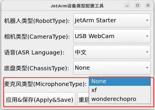

  • Jetson Orin Nano/Jetson Orin NX Controller Version Configuration
(2) Click on to open the robot system configuration tool.
JetArm Advanced
Gemini
ASR Language 中文
English
Chassis Type None
Tank
Mecanum
Slide_Rails
Conveyor_Belt
xf
wonderechopro

  • Jetson Nano Controller Version Verification
Click to initiate the ROS1 command-line terminal to check.
  • Jetson Orin Nano/Jetson Orin NX Controller Version Verification
Open the command line terminal to verify the configuration.
If the package includes a 7-inch touchscreen display or a monitor, using remote connection tools may result in low or blurry screen resolution. We can follow the steps below to adjust the remote desktop resolution, typically setting it to 1920x1080.
For the Jetson Nano version, make sure to disconnect the HDMI cable from the screen before powering on to ensure the desktop resolution syncs properly.
  • Jetson Orin Nano Version Resolution Configuration
After connecting via NoMachine, follow these steps to set up the resolution (you will need to repeat these settings for subsequent connections):
(1) On the first boot, the resolution may appear abnormal. Click the top left corner to manually adjust the resolution.
(2) Then, click the top right corner to close this page, and click the connection icon again to re-enter.

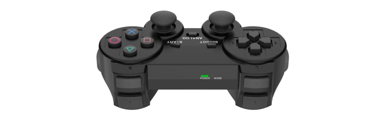

1.7 Wireless Handle Control
1.7.1 Preparation
  • Controller Setup Requirements
(1) Insert the handle receiver into any USB interface on Jetson Nano. Before powering on the device, please ensure that the controller receiver is inserted. If it is already inserted, you can ignore this step (the USB controller receiver is pre-inserted at the factory).
(2) Please bring your own two AAA dry batteries. And insert them into the battery slot. And do not invert the positive and negative poles.
(3) Each time the robot powers on, the app auto-start service (which includes controller functionality) will launch automatically. If it hasn’t been turned off, no further action is needed—just connect and control directly.
(4) As controller signals may interfere with each other, it is recommended not to use this feature if multiple robots are in the same area to avoid unintentional connections or control.
(5) After turning on the controller, it will enter sleep mode if it doesn’t connect to the robot within 30 seconds or if left unused for 5 minutes after connecting. To wake the controller from sleep mode, press the START button.
1.7.2 Device Connection
  • Connection Process
(1) Start JetArm. Switch on handle. At this point, two LEDs (red and green) on the handles will flash simultaneously.
(2) Please wait for a while. Then the robot will pair with the handle automatically. After successful pairing, the green light will keep lighting up and red LED light goes out.
1.7.3 Control Mode Introduction
The handle control for the robotic arm are divided into two modes: coordinate mode and single servo mode. When the handle is successfully connected, it defaults to the coordinate mode.
Single servo mode: by pressing the buttons on handle, you can control individual servos on the robotic arm for forward and reverse movements.
Coordinate mode: by pressing the buttons on handle, you can control the robotic arm as a whole along the trajectory of three axes (X, Y, Z) and combined with angular deviation for motion.
The way to switch between the two modes: press the SELECT and START buttons. Once you hear a beep sound, the mode has been successfully switched. Switching from single servo mode to coordinate mode, you will be prompted through two beeps sound. One beep sound represents the switch from coordinate mode to single servo mode.
1.7.4 Button Function
  • Single Servo Mode
Following is the button function instruction for single servo mode:
Button Function (from the first-person perspective of robotic arm)
START Return the robotic arm to its initial posture
SELECT+START Switch the servo control modes (singe servo mode/coordinate mode)
UP / ↑ Raise servo No.2
DOWN / ↓ Lower servo No.2
LEFT / ← Rotate Servo No.1 to the left
RIGHT / → Rotate Servo No.1 to the right
TRIANGLE / ∆ Close robotic claw (servo No.10)
CROSS / X Open robotic claw (servo No.10)
CIRCLE / ⃝ Rotate No.5 servo to the right (the robotic claw turns right)
SQUARE / ◻ Rotate No.5 servo to the left (the robotic claw turns left)
L1 Raise servo No.3
L2 Lower servo No.3
R1 Raise servo No.4
R2 Lower servo No.4
1.7.5 Coordinate Mode
Following is the button function instruction for coordinate mode:
START Return robotic arm to its initial posture
UP / ↑ Robotic arm moves along the positive direction of X-axis (the front of robotic arm)
DOWN / ↓ Robotic arm moves backward along the negative direction of X-axis
LEFT / ← Robotic arm moves along the negative direction of X-axis (robotic arm's left side)
RIGHT / → Robotic arm moves along the negative direction of Y-axis (robotic arm's right side)
TRIANGLE / ∆ The robotic gripper closes (ID10 servo)
CROSS / X The robotic gripper opens(ID10 servo)
CIRCLE / ⃝ The ID5 servo turns right (Robotic gripper turns right )
SQUARE / ◻ The ID5 servo turns left (Robotic gripper turns left )
L1 Robotic arm moves along the positive direction of Z-axis (above the robotic arm )
L2 Robotic arm moves along the negative direction of Z-axis (under the robotic arm)
R1 Increase the reflection angle (based on the horizontal line)
R2 decrease the reflection angle (based on the horizontal line)

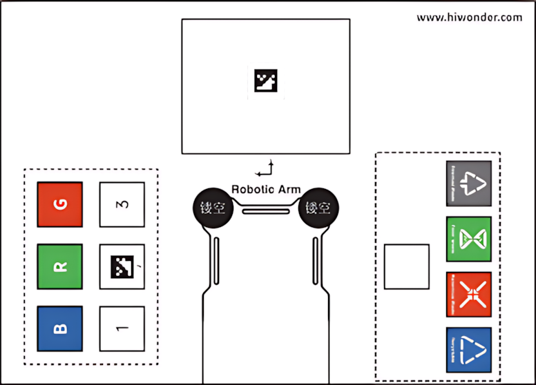

1.8 Position Adjustment for Object Gripping and Placing
  1. Once the parameters adjusted take effect, the gripping and placing effects of color sorting, tag sorting, intelligent stacking (it can only be executed via app), and waste sorting.
  2. Prior to shipment, the robotic arm has undergone calibration. However, discrepancies between the calibration environment and the actual usage environment, coupled with potential vibrations during transport, may result in suboptimal execution of sorting, stacking, and other games, causing the gripper to inaccurately pick up and place blocks.
  3. In the event of the aforementioned issues, refer to the following instructions to adjust the gripping and placing positions of the robotic arm.

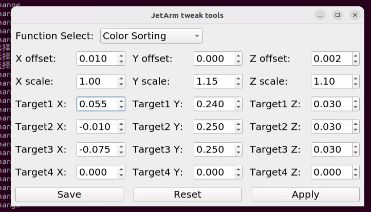

  • Position Adjustment Tool
(1) Refer to 1.6 Development Environment Setup and Configuration to remotely connect the device to the system desktop.
(2) Click the system desktop icon to open the JetArm Position Calibration Tool.
  • The positive direction of the X-axis is the front of the robotic arm, the positive direction of the Y-axis is to the left of the arm, and the positive direction of the Z-axis is above the arm.
  • The offset unit is in meters. For example, increasing the X-axis value by 0.01 shifts the grasping position of the arm forward by 1 cm.
The parameters are defined as follows:
Parameter Name Parameter Definition Adjustment Position
Positioning X Offset X-axis offset of the robotic claw during grasping; decrease if the claw is ahead of the object, and vice versa.
Positioning Y Offset Y-axis offset of the robotic claw during grasping; decrease if the claw is to the left of the object, and vice versa.
Positioning Z Offset Z-axis offset during grasping; decrease if the claw is above the object, and vice versa.
Positioning X Scaling Scaling factor in the X-axis direction for the return image of the grasping area (positive values only).
Positioning Y Scaling Scaling factor in the Y-axis direction for the return image of the grasping area (positive values only).
Positioning Z Scaling Scaling factor in the Z-axis direction for the return image of the grasping area (positive values only).
Target 1 X X-axis offset for placement at Target Position 1. Target 1
Target 1 Y Y-axis offset for placement at Target Position 1.
Target 1 Z Z-axis offset for placement at Target Position 1.
Similar for Target 2, Target 3, etc.

  • Grasping Position Adjustment
(1) Open the position adjustment tool. Here, we will use the grasping position for color sorting as an example; other grasping-related activities will follow the same adjustment method.
(2) If we need to adjust the grasping position, we must modify the offset values for Positioning X, Y, Z.
(3) Before starting the adjustment, open the color sorting feature in the app, place the colored blocks in the grasping area, and observe the offset when the gripper grasps the colored block.
(4) For this example, we will consider the scenario where the gripper is positioned in front of the colored block; the same adjustment method applies to other situations.
(5) If the gripper is offset forward when grasping, reduce the Positioning X offset value by 0.01. Click Apply -> Save (the offset unit is in meters; reducing by 0.01 m means that when the claw grasps again, it will shift down by 1 cm. Adjustments should be made based on the actual situation, either increasing or decreasing the offset value by 0.01 or 0.001).
(6) Return to the mobile app’s mode selection screen and wait for the robotic arm to start grasping. Check the adjustment effect (the effect takes effect in real-time; after clicking the Apply button, it will take effect during the next grasping action without needing to re-enter the activity).
(7) If the colored block is still not grasped or there are deviations in the Y or Z axes, follow steps 3-7 to adjust the corresponding offset values.
(8) If the wooden block is at the edge of the grasping area and the gripper’s grasping position is offset inconsistently, we can adjust the scaling values for Positioning X, Y, Z.
(9) Before starting the adjustment, open the color sorting feature in the mobile app, place the colored block at the edge of the grasping area, and observe the offset when the gripper grasps the colored block.
(10) You may find that when the wooden block is at the left edge of the grasping area, the gripper tends to offset slightly to the right when grasping; conversely, when the block is at the right edge, the gripper tends to offset slightly to the left. In this case, you need to increase the Positioning X scaling value to 1.10 (after adjusting the scaling value to 1.10, the original position of 0.1 will change to 0.1 × 1.10 = 0.11, meaning that during the next grasping action, the gripper will offset by 1 cm towards the edge. Adjustments should be made based on the actual situation, either increasing or decreasing the scaling value by 0.01 or 0.1). Click Apply -> Save. The same adjustment method applies to other situations.
(11) Return to the mobile app’s mode selection screen, wait for the robotic arm to start grasping, and check the adjustment effect (the effect takes effect in real-time; after clicking the Apply button, it will take effect during the next grasping action without needing to re-enter the activity).
(12) If there are still deviations while grasping in the edge area, follow steps 9-11 to adjust the corresponding scaling values.
  • Placement Position Adjustment
The method for adjusting the placement position is consistent with that of the grasping position. It is important to pay attention to the target placement position.
  • Placement Adjustment Steps
(1) Here, we will take the example of adjusting the X-axis coordinate to move forward and the Y-axis coordinate to move left while sorting red objects.
(2) In this case, it is necessary to decrease the X and Y-axis coordinates of Target 1. For preliminary adjustments, reduce the values by increments of 0.01. If a larger adjustment was made, fine-tuning can also be done using increments of 0.005. Users should modify the values based on specific situations.
(3) Once adjustments are complete, click Apply -> Save.
(4) Return to the mobile app’s mode selection screen, re-enter the color sorting feature, and check the adjustment effect.
(5) If the colored block is still not placed accurately or there are deviations on the Z-axis, follow steps 2-4 to adjust the corresponding offset values.

  • Jetson Nano Version
  • Jetson Orin Nano/Jetson Orin NX Version

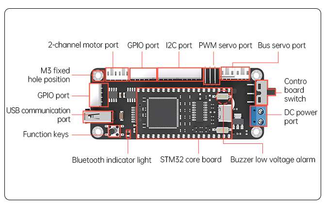

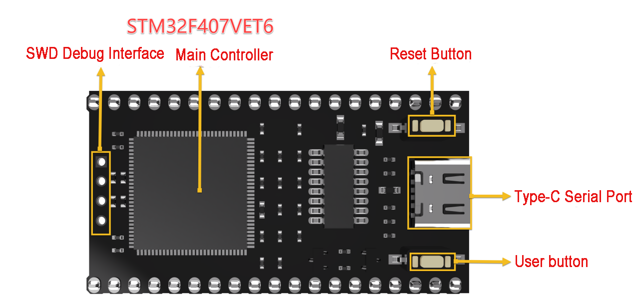

  • STM32 Controller
The STM32 open-source controller is specially designed for robot development, small and exquisite.
The controller deploys STM32F407VET6 as the main control, utilizing Arm’s Cortex-M4 core, running at 168MHz. It has an onboard FLASH capacity of 512K, an SRAM capacity of 192K, and integrates FPU and DSP instructions.
The STM32F40x/41x series system block diagram is shown below:
With ample onboard resources and extension port, the controller is highly suitable for ROS robot development. It can be seamlessly integrated with the Jetson series ROS main control to make a ROS-based robot.
The front resource configuration of the control board is shown below:
The control board also provides schematics and supports USB serial port program downloads, enabling STM32 programming for secondary development. It offers onboard resources and peripheral sample codes, facilitating user learning and application.
The resources and peripherals of STM32F407VET6 processor is shown as in the table below.

  • Jetson Orin Nano & Jetson Orin NX Controller Power System
These two main controllers use a dual power supply scheme. A 12V 5A adapter (DC 4.0mm) connects to the STM32 controller, directly powering the bus servos. Meanwhile, a 19V 2.37A adapter (DC 5.5mm) supplies power directly to the Jetson Orin Nano and Jetson Orin NX main controllers.
The Jetson Nano version comprises a Jetson Nano controller and a Jetson expansion board. The controller is a compact yet powerful computer capable of running popular deep learning frameworks, providing the computational power required for most artificial intelligence projects.
The expansion board features LED indicators and buttons, enabling users to monitor network status through LED blinking and switch network modes with the buttons. It also includes reserved GPIO and I2C interfaces.
The controller operates on Ubuntu 18.04 and is configured with the ROS Melodic environment for robotics. For foundational courses on ROS main controllers.
The Jetson Orin Nano version consists of a Jetson Orin Nano controller and a Jetson expansion board. Compared to the Jetson Nano, the Jetson Orin Nano offers significantly faster processing speeds and improved memory read/write performance, with an overall performance boost of 40-80 times.
The expansion board includes LED indicators and buttons, allowing users to check network status through LED blinking and switch network modes via the buttons. It also provides reserved GPIO and I2C interfaces.
The controller runs on Ubuntu 20.04 and is set up with the ROS1 Noetic environment for robotics. For basic courses on ROS main controllers.
  • Jetson Orin NX Version
The Jetson Orin NX is offered in 8GB and 16GB versions, comprising the Jetson Orin NX controller and an expansion board. The Jetson Orin NX 16GB significantly outperforms the Jetson Orin Nano 4GB, delivering faster computation speeds, enhanced memory read/write rates, and up to 5 times the performance.
The expansion board is equipped with LEDs and buttons for user convenience, allowing users to monitor network status through LED indicators and switch network modes with a button. It also includes GPIO and I2C interfaces.
