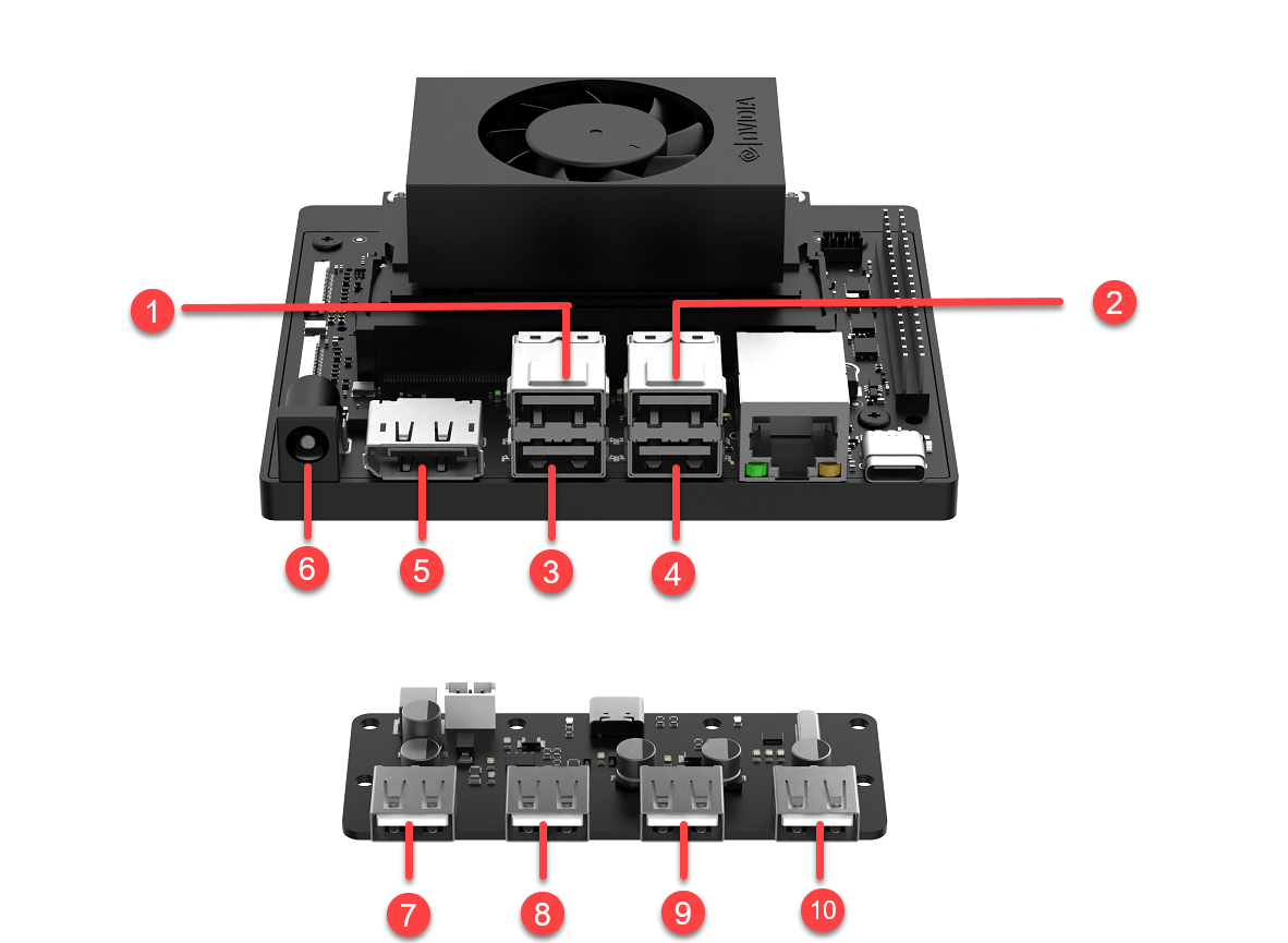

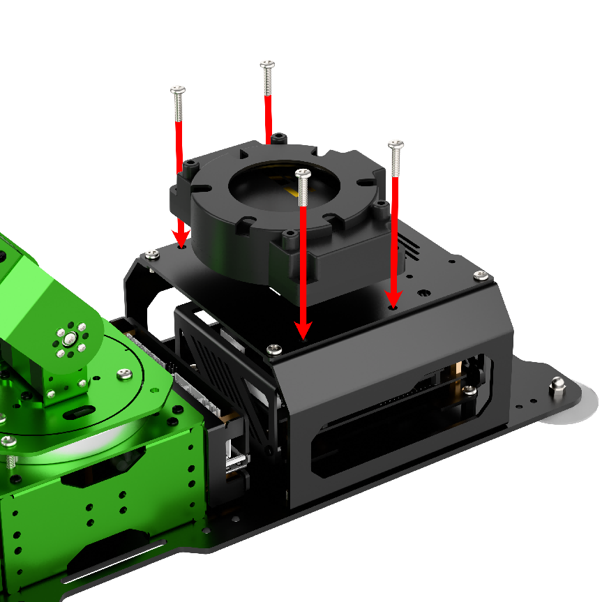

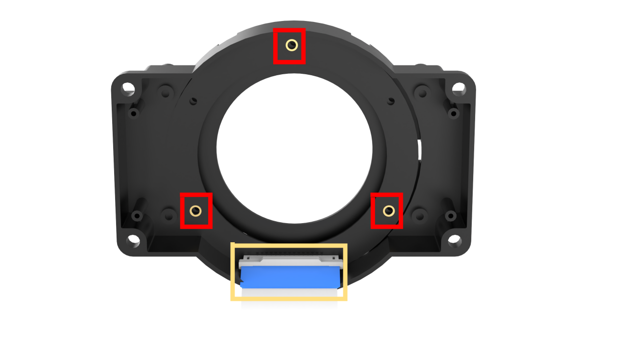

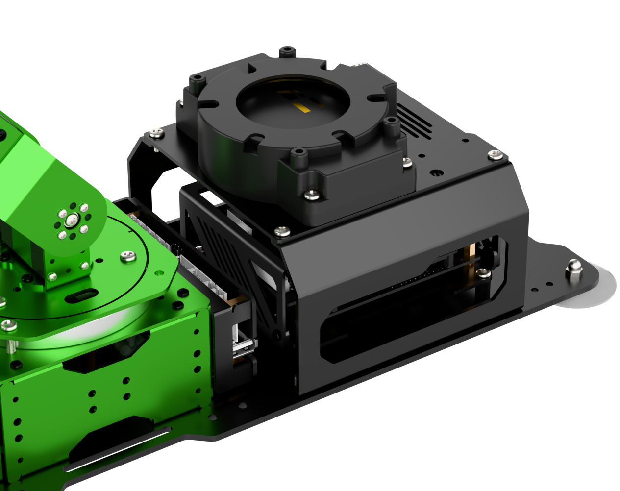

(1) Fix the 6-Microphone array to the JetArm using four M4*6 screws.

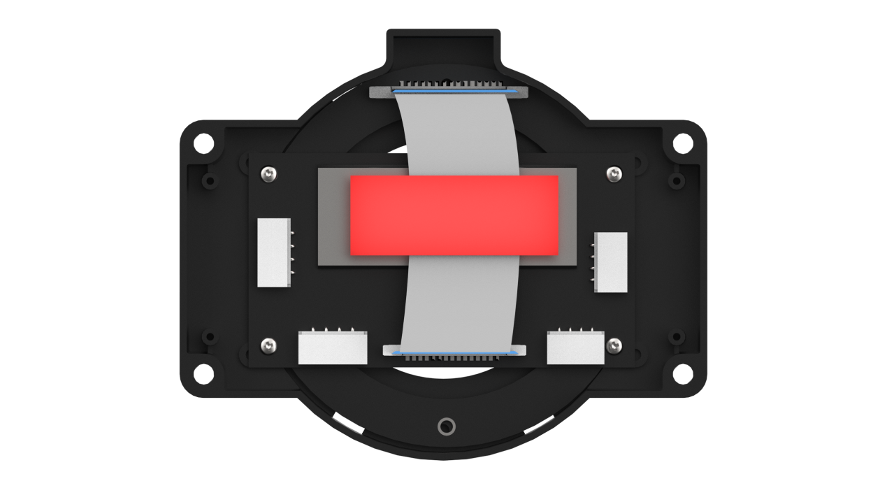

(2) The image below shows the assembled configuration of the 6-microphone array.
(3) Connect the 6-CH microphone array to USB Port 2 on the controller, as shown below.

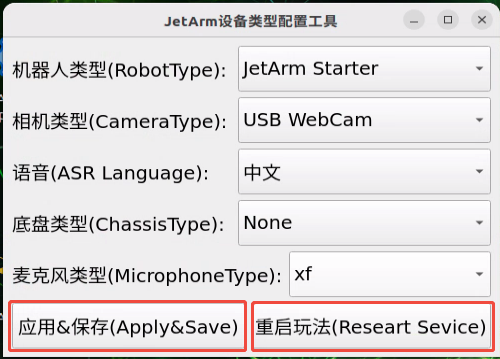

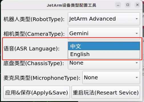

18.2 Switching Between Chinese and English Wake Words
The system is preconfigured to use the English wake word “hello hiwonder” for voice activation. If you prefer to use a custom command, please follow the steps below:

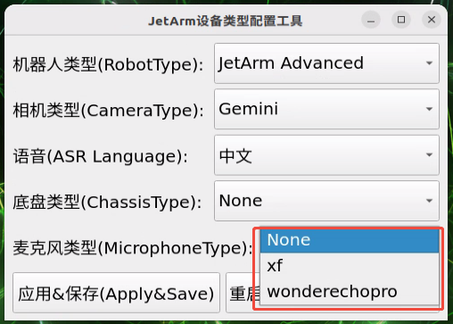

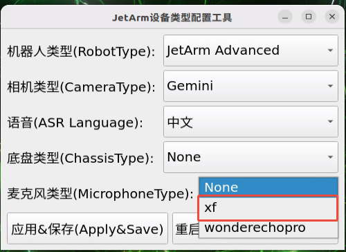

(1) The robot is equipped with a 6-microphone array. To change the recognition language, open the configuration tool by double-clicking the “Tool” icon on the desktop . In the tool interface, select your preferred language.
(2) If you are using the 6-microphone array, select “xf” as the microphone type (as shown in the image below).
(3) Click “Apply & Save” to confirm and save your settings.

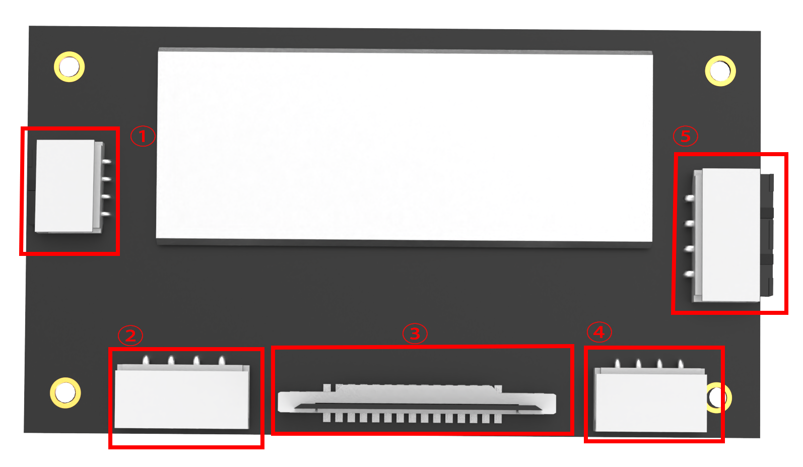

The purpose of the interface on the R818 noise reduction board is outlined below:
Interface NO. Name Function
1 Serial port For PC software communication
2 Reference signal port Power amplifier/echo cancellation reference signal
3 Microphone port Connect to 6-channel microphone array
4 Independent power port Power input port
5 UAC port Audio output port

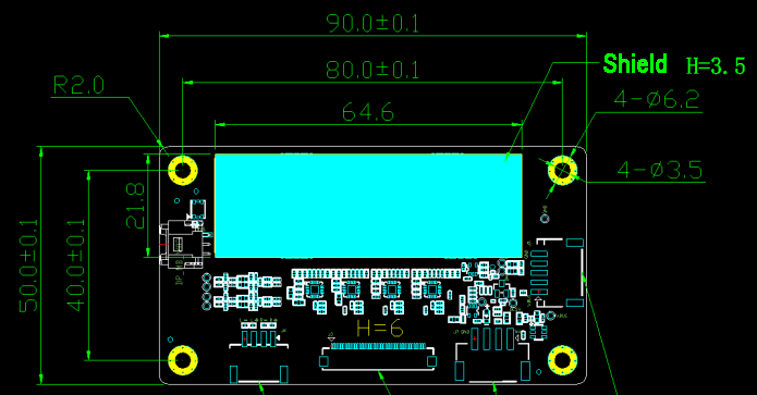

(2) Structure & Size
Front view:

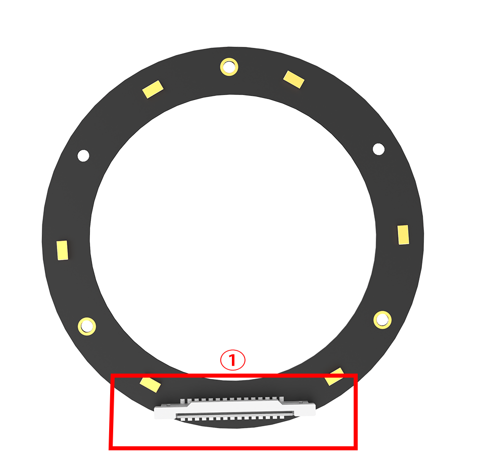

The structure of the ring 6-channel microphone array is as below:
Front: Back:

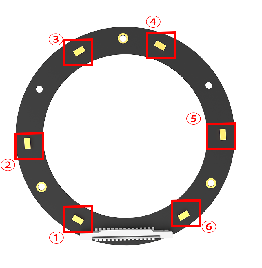

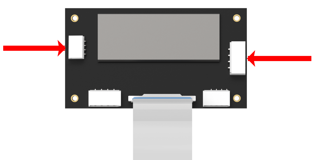

① Signal interface: connects to R818 noise reduction board.
② At the rear, six analog silicon microphones are strategically arranged in a circular pattern to optimize audio reception.

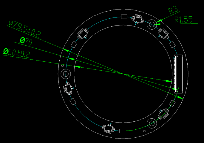

② Product Structure & Size
Front view:
Back view:

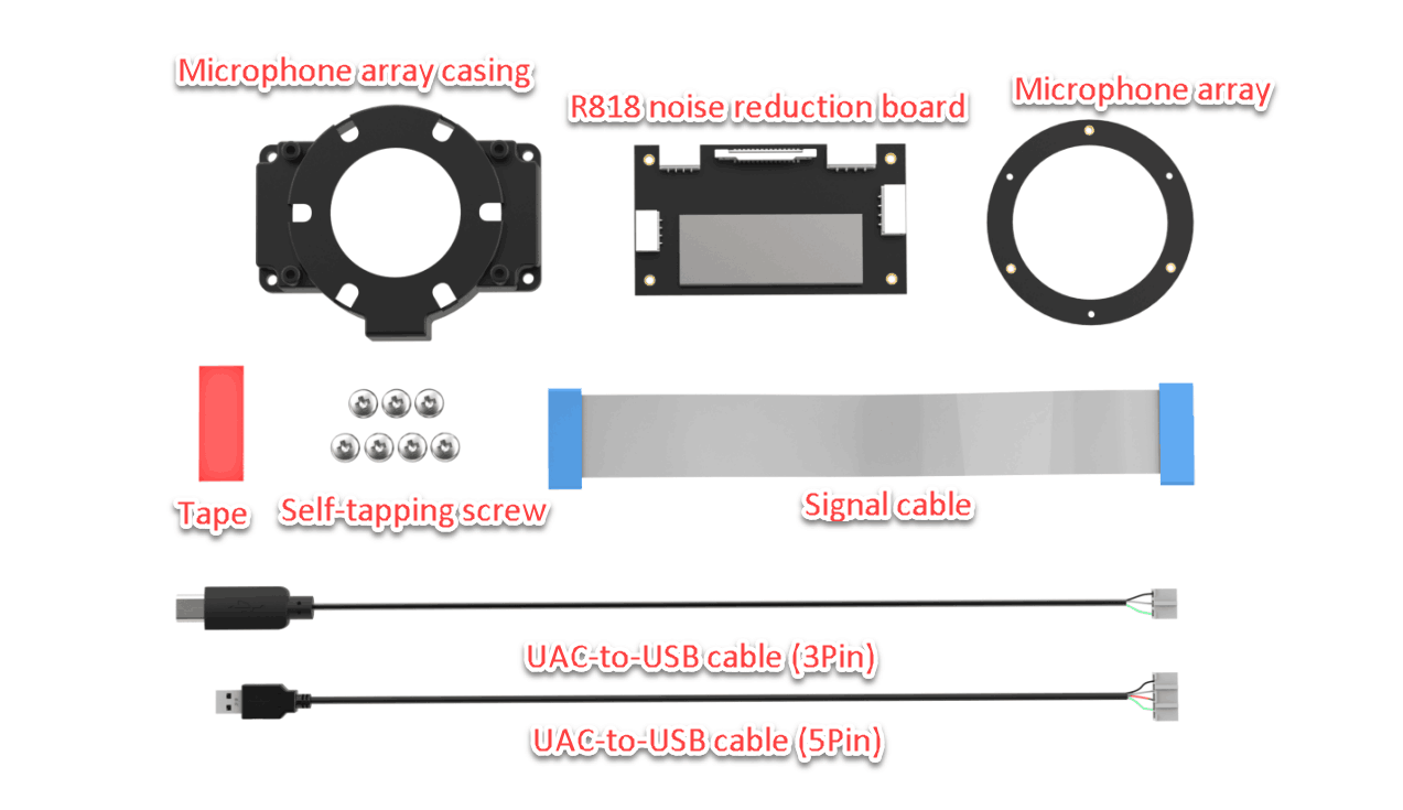

18.3.2 Wiring

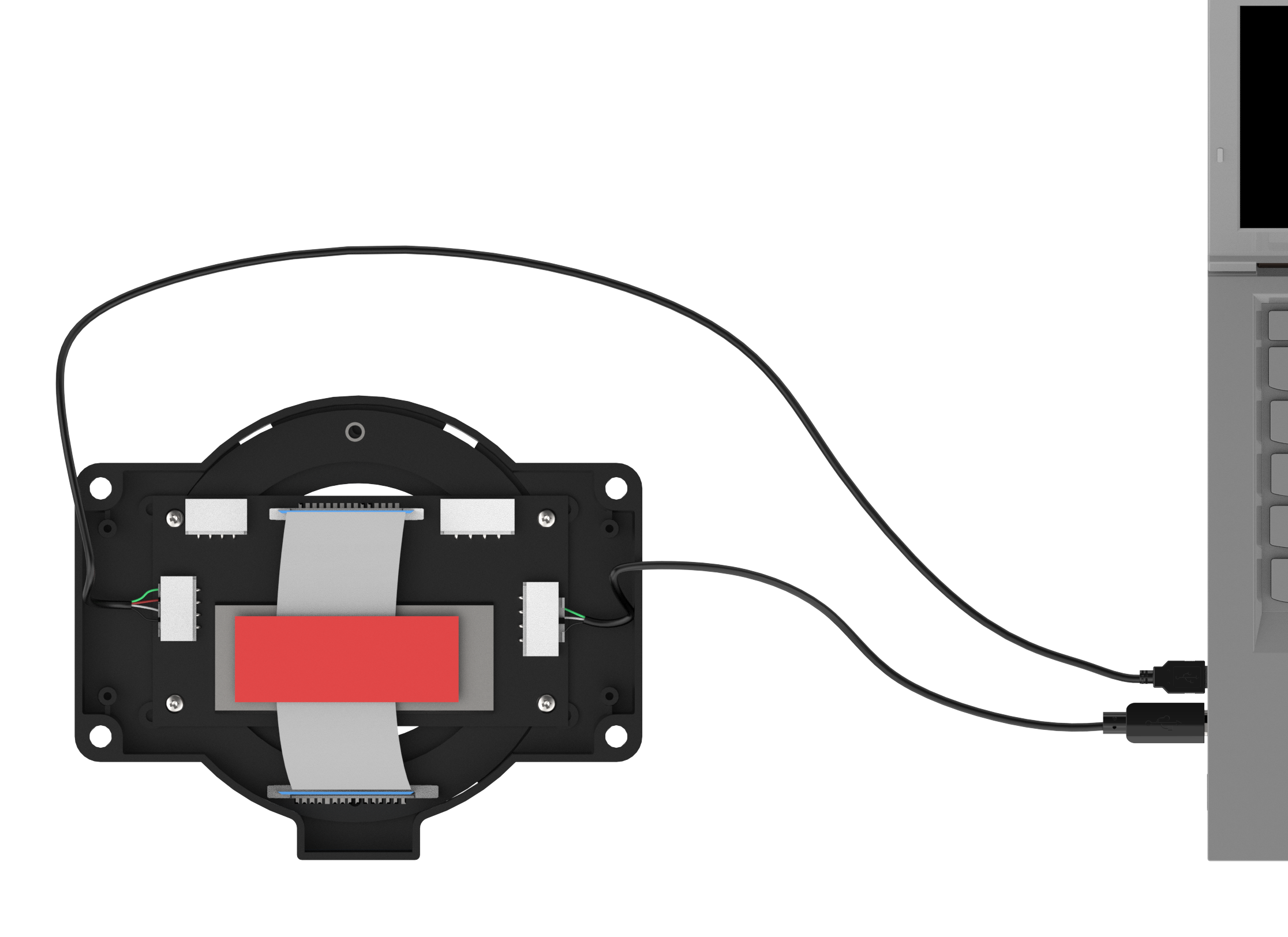

(1) Please gather the items depicted in the picture below:

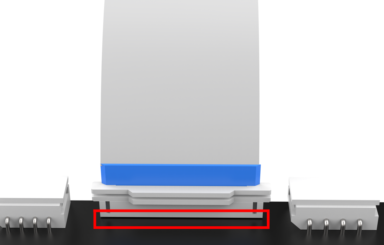

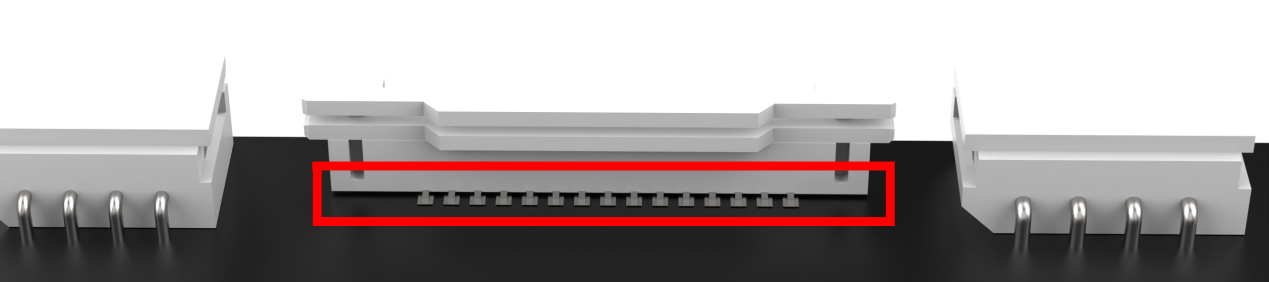

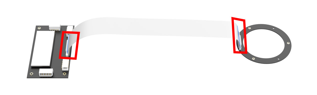

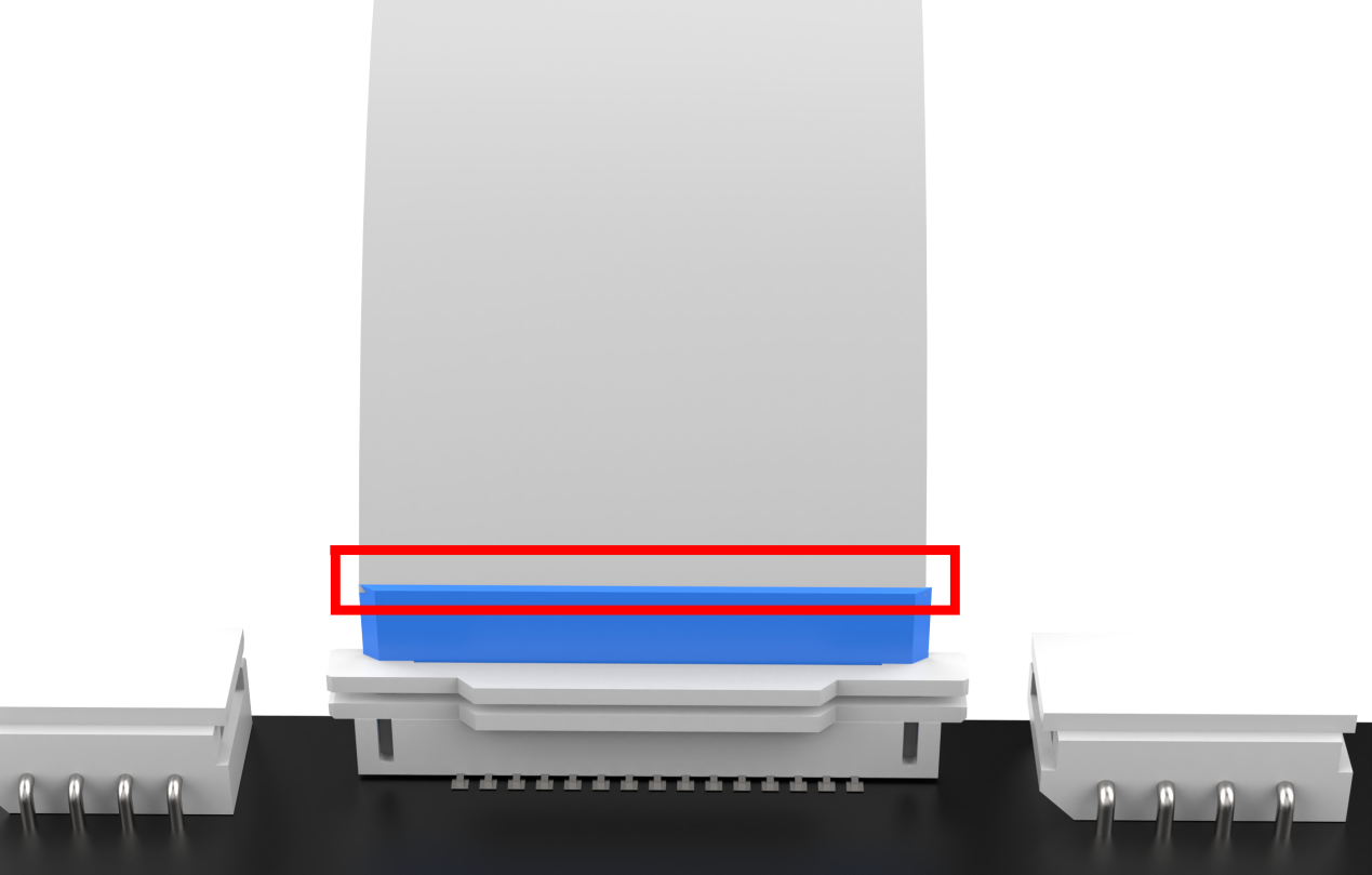

(2) Connect the microphone array to the noise reduction board. Be cautious while inserting the connection cable to avoid any forceful insertion that may lead to damage to the port.

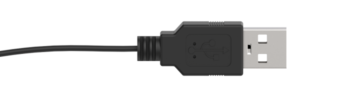

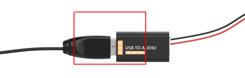

(3) Connect the two UAC-to-USB cables to the noise deduction board as below:
(4) Connect the serial port connection cable and UAC cable to the corresponding port on the noise reduction board. First, attach the ring microphone array to the casing. Use the screws to secure it in the three holes highlighted by the red boxes in the image below. Additionally, be sure to align the signal cable connector properly, as shown in the yellow box in the image below.

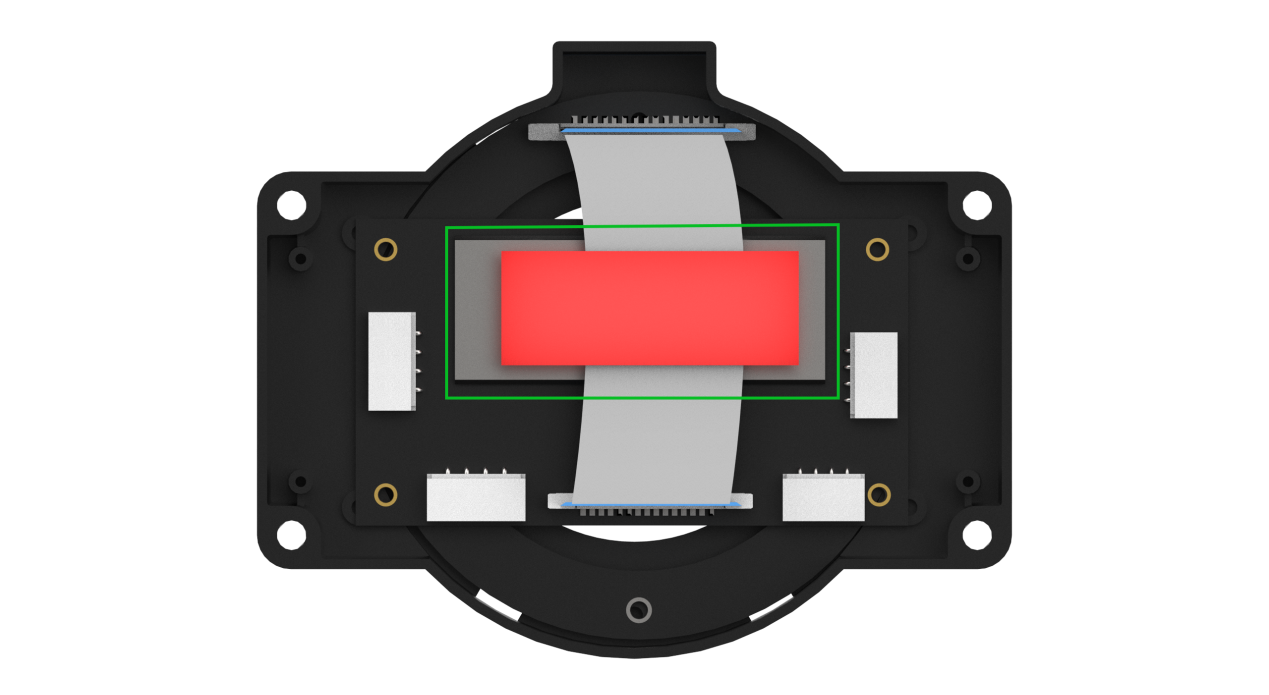

(5) Next, connect the noise reduction board, which has already been wired, to the corresponding slots in the casing. Pay attention to the orientation of the noise reduction board, as shown in the image below. Use 3M adhesive to secure the signal cable in place, as indicated by the green box in the image.
Tighten the four screws:
(6) Connect the two USB cables to the laptop and run a test to check if the computer recognizes the port numbers. This completes the wiring and installation of the microphone array.

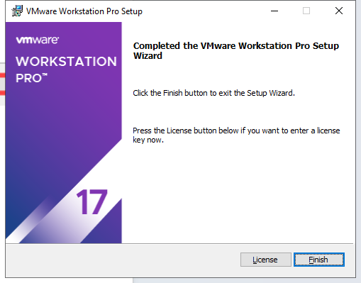

18.3.3 Virtual Machine Installation and Configuration
  • Install VMware Workstation Software
A virtual machine is essentially a computer generated through software emulation, offering a usage experience similar to that of a physical computer. Popular virtual machine software options include VMware Workstation (often called VMware), VirtualBox, Microsoft Virtual PC, and more. In this section, we’ll use the example of installing VMware Workstation, initiating, and configuring a virtual machine for explanation.

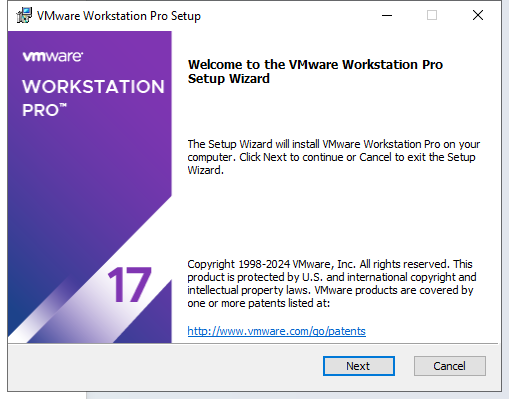

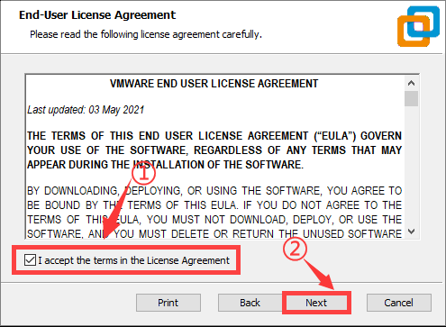

(1) Extract the virtual machine software package saved in 2. Software Tool/ 6. Voice Environment Setup Tool/ Virtual Machine Installation Pack.
(2) Find the folder where the virtual machine was extracted, and double-click on the virtual machine executable file.

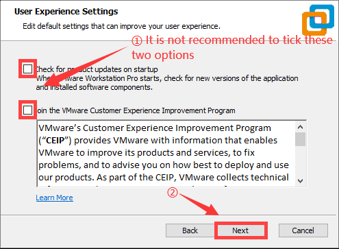

(3) Follow the images below to complete the virtual machine installation.

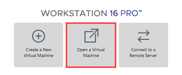

After entering the virtual machine interface, click on “Open Virtual Machine”.
(1) In the popup window, locate the image file under the directory “2 Tools/6 Voice Recognition Environment Set Up Tool/6-Channel Microphone Array Image”. Open the image file (the actual name of the image may vary; this image is for reference only).
(2) After opening, you can change the virtual machine’s name and local storage path.

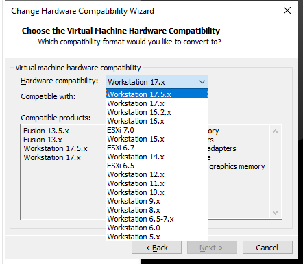

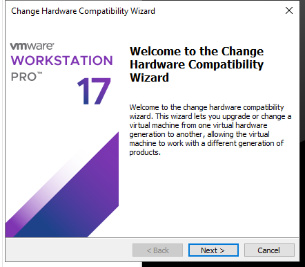

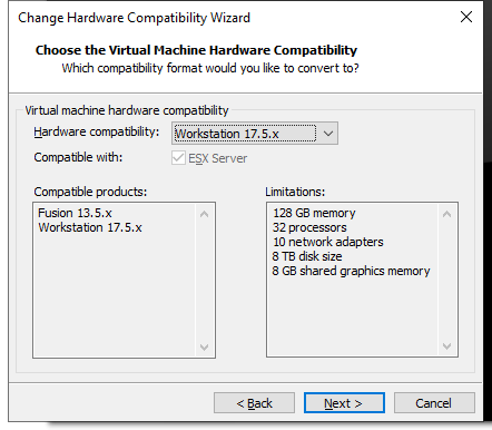

  • Upgrade Virtual Machine
(1) If upgrading the virtual machine is available after selecting it, proceed with the upgrade; otherwise, skip this step.
(2) Pop-up with the following content, click “Next”.
(3) Pop-up with the following content, select Virtual Machine 17.5.
(4) Then click Next.
(5) Choose Modify this virtual machine, then click Next.
(6) Click Finish.
(7) Click Close.

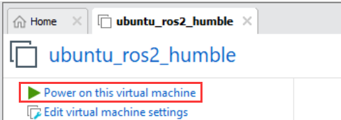

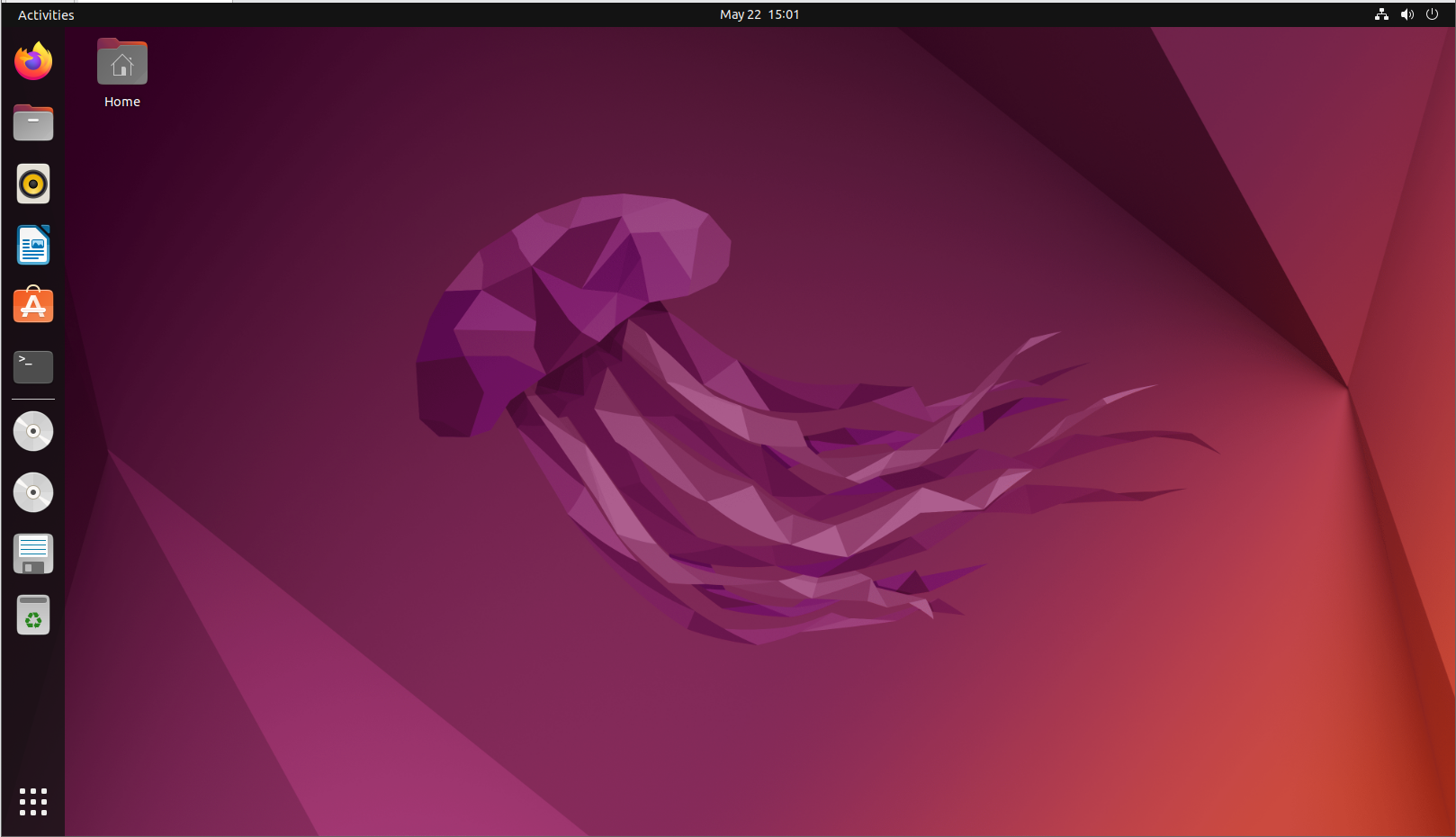

  • Start Virtual Machine
(1) Click-on Power on this virtual machine.
(2) After start-up, you will enter the desktop of the virtual machine.

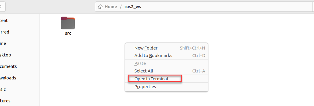

(1) Click-on to open the command-line terminal, and run the following command to create a folder.
sudo mkdir ros2_ws
When the prompt as shown in the following image appears, enter the password ubuntu.

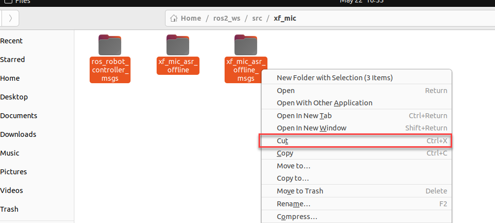

  • Import Feature Pack

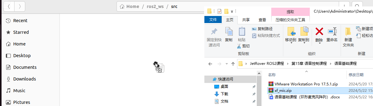

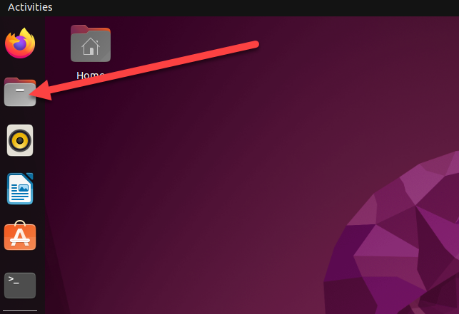

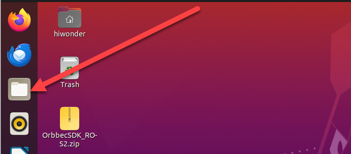

(1) Click on the location shown in the image below to open the folder.
(2) Drag the files from the same directory into the virtual machine folder.

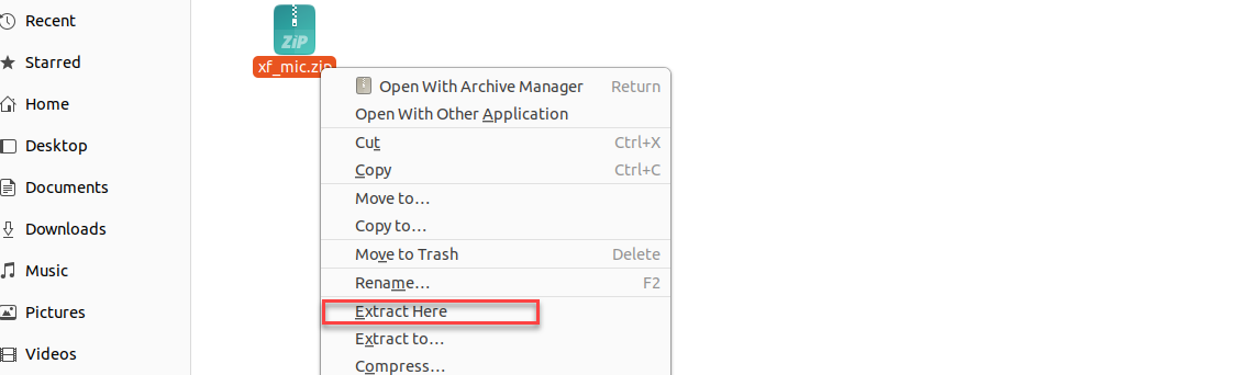

(3) Extract the two files into the current directory.

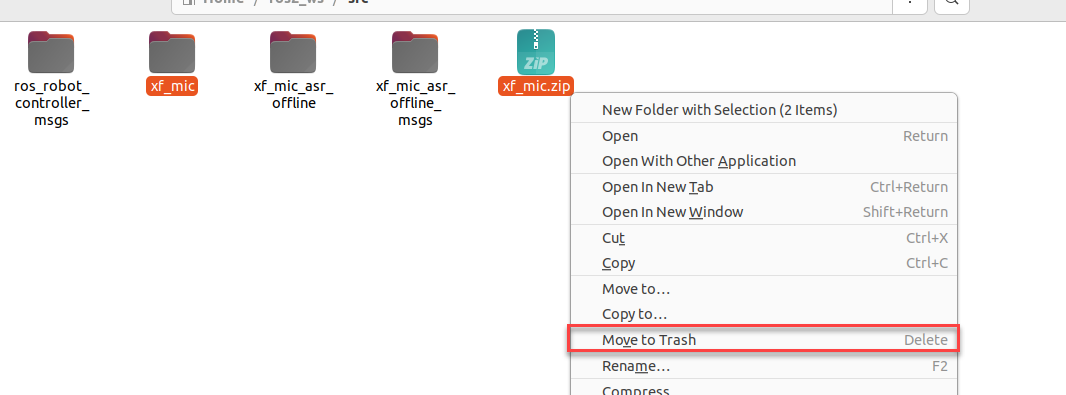

(4) Enter the extracted folder and move the three folders to /ros2_ws/src.
(5) Delete unnecessary files inside /ros2_ws/src.

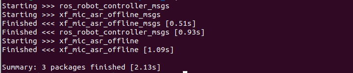

(7) Enter the command to start compiling the package:
colcon build
Compilation completion will be as shown below:

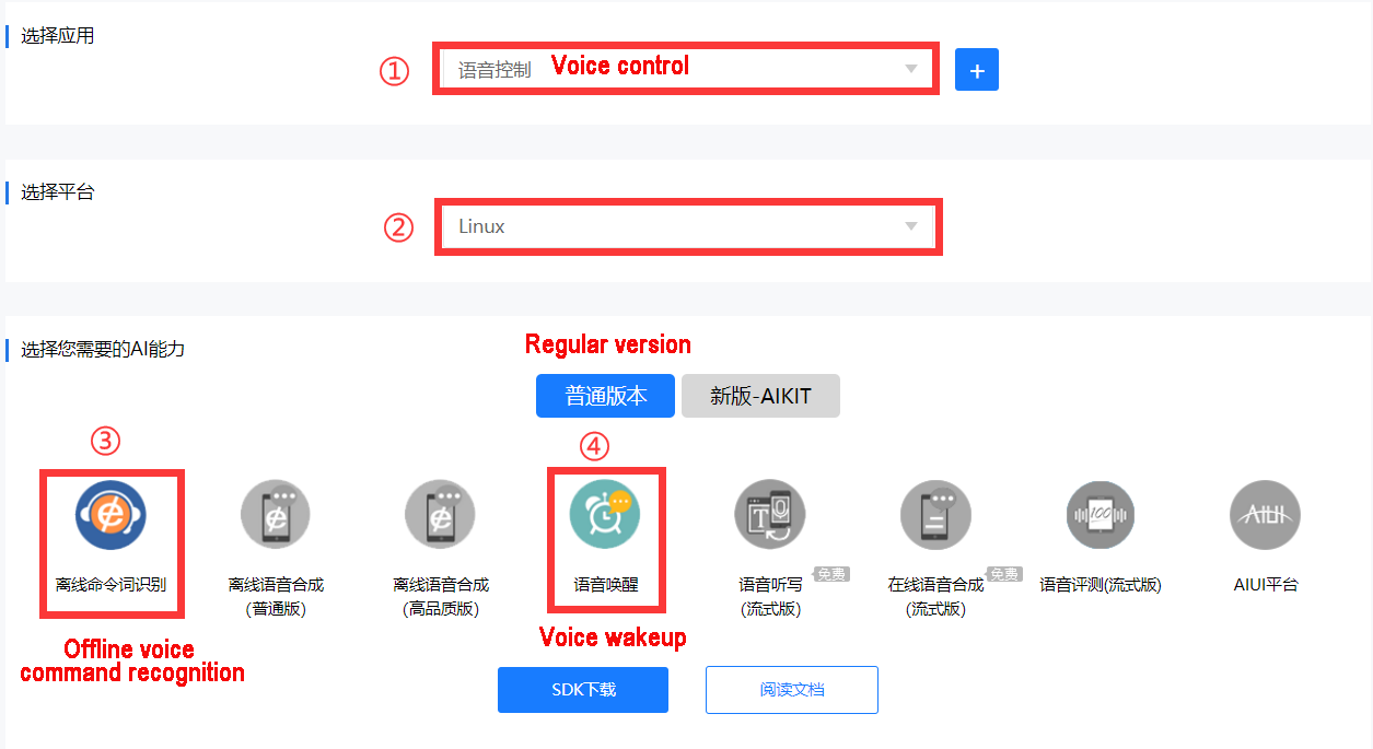

  • 6-Channel Microphone Array Configuration: Apply for offline voice resources and APPID
As the robot utilizes offline voice recognition, you will require offline voice resources available exclusively on the iFLYTEC Chinese website. Please note that you need to switch the language to Chinese and follow the provided instructions for the process.

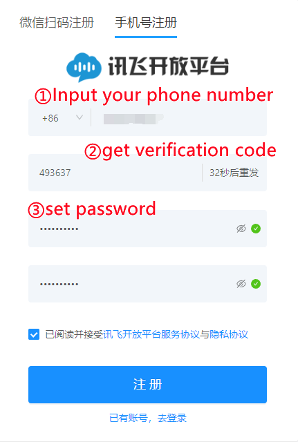

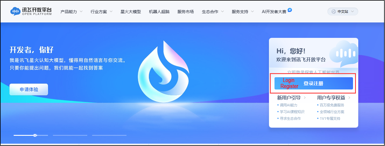

(1) Enter iFLYTEC website, https://www.xfyun.cn/, then click "sign in" to create an account.
(2) Choose Sign up with phone number, and fill in the required information. (select corresponding country code)

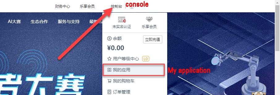

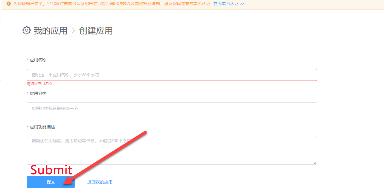

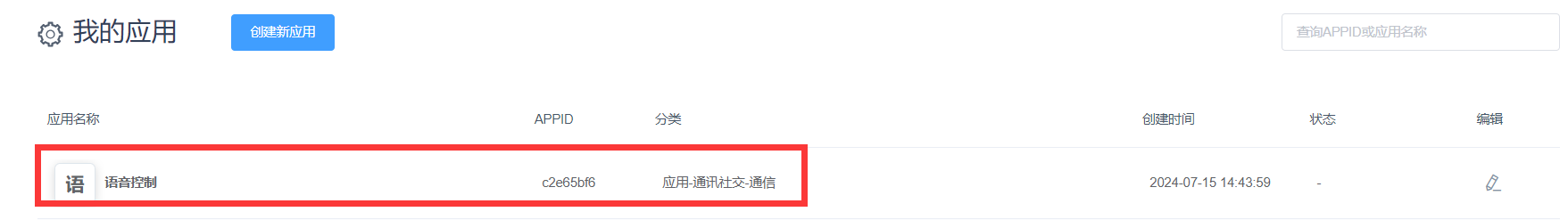

(3) After registration, click console->my application to add new application.
(4) Fill in the required information, and click Submit.
(5) Open the application you just added.

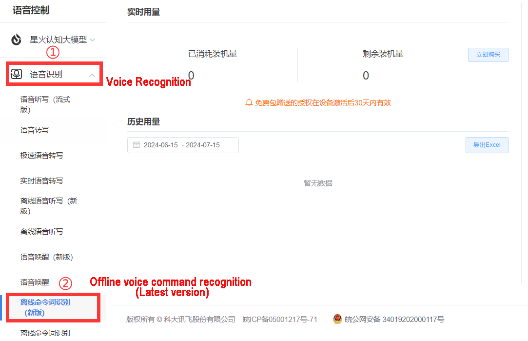

(6) Click Voice recognition->Offline voice command recognition (Latest version)
(7) Download Linux AIKit.
Each new application offers 90-day free trial, and you will be charged if you continue to use it. When free trial expires, you can add new application again, and each person can only request 5 new applications.
(8) Select the username you created and the Linux platform. After making your choices, select the Regular Version below, check Offline Command Word Recognition and Voice Wakeup options, then click SDK Download.
(9) ChooseOK to start downloading.

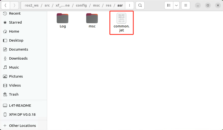

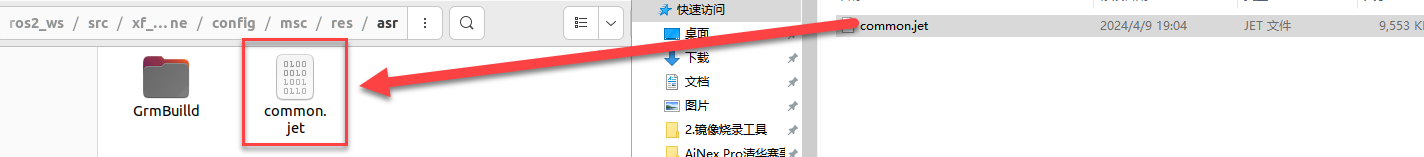

  • Replace Offline Voice Resources and ID

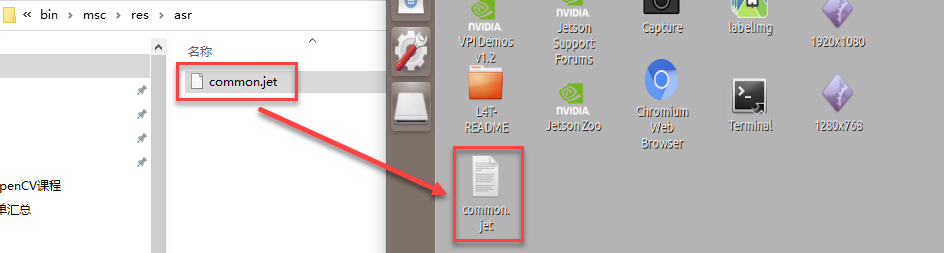

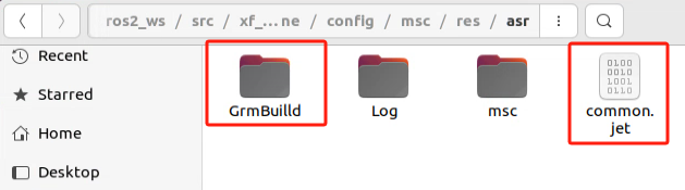

(1) Unzip the file below and locate the offline voice resource common.jet.
(2) Click the icon below.
(3) Drag the Common.jet file into the specified folder within the virtual machine (as illustrated in the image) to complete the replacement.

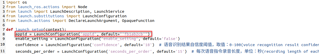

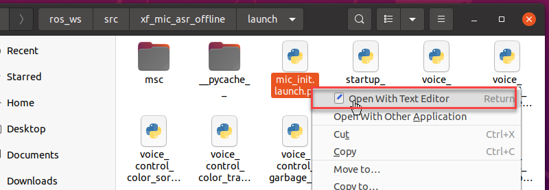

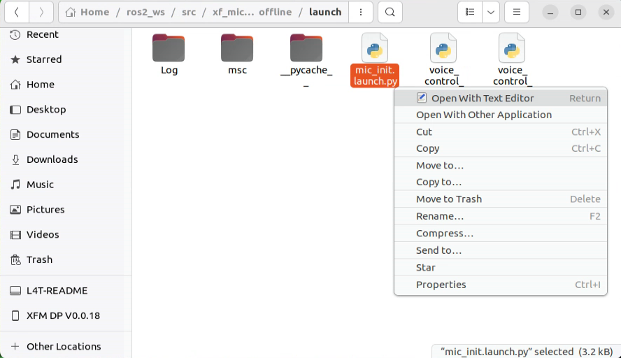

(4) Navigate to the folder ros_ws/src/xf_mic_asr_offline/launch and right click the file mic_init.launch and choose ‘Open With Text Editor’.
(5) Replace the existing appid with the one obtained from the iFLYTEC website. Afterward, press ‘Ctrl+S’ to save the changes. (Note: the offline voice resource should be consistent with the appid)

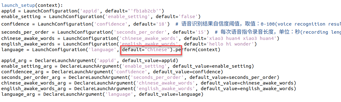

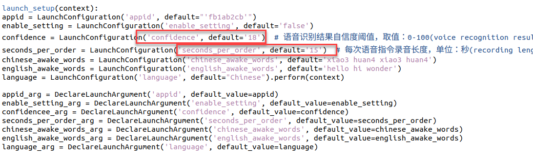

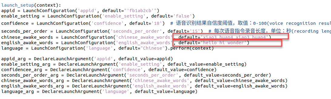

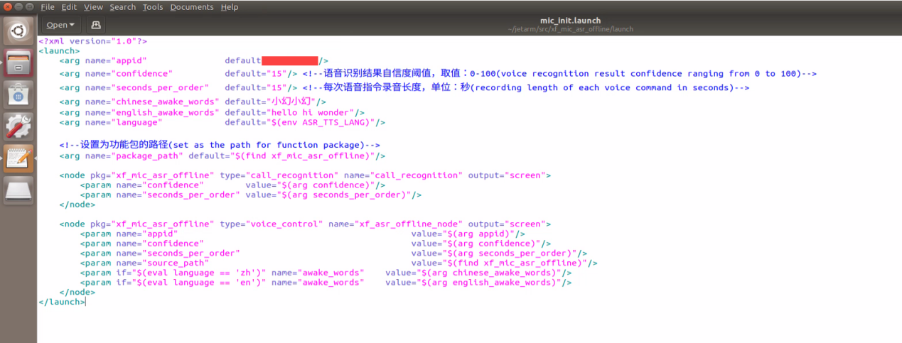

After modifying the APPID, if you wish to make changes to the speech recognition threshold, recording duration, wake-up word, or wake-up speech, you can refer to the methods described below.
(1) Locate the folder ros_ws/src/xf_mic_asr_offline/launch, and right-click mic_init.launch, then select Open With Text Editor.
(2) Set confidence thresholds for speech results and the duration of each voice command entry based on the two parameters highlighted in the red box in the following diagram.
(3) Modify the parameter highlighted in the red box below to change the wake-up word.
English wakeup word format: word1 word2 word3
(1) To change the wakeup language, you can directly change the below parameter.
(2) After modification, press Ctrl+S to save the editing.

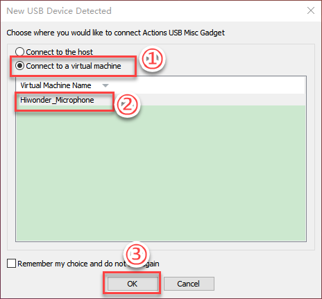

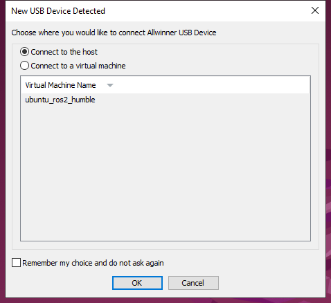

(1) Connect the microphone array to the computer according to section 18.3.2 Wiring.
(2) Connect the device to the virtual machine.

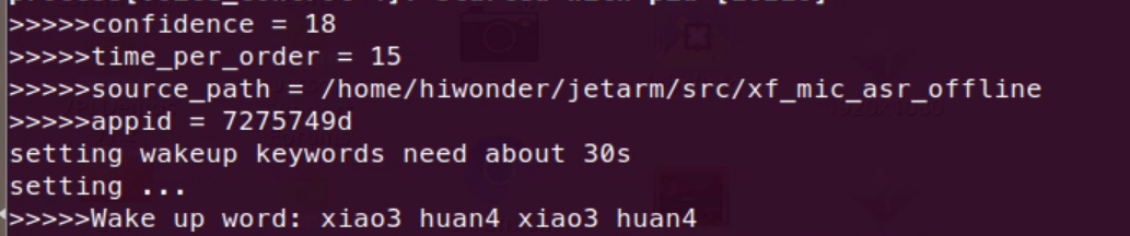

(3) Enter the command to start the initialization node of the six-channel microphone array and burn the wake-up word.
ros2 launch xf_mic_asr_offline mic_init.launch.py enable_seting:=true

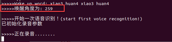

(4) After initialization is complete, the following content will appear. The initial startup may be slightly slow, and completion will appear as shown below:
(5) If you want to close this node, use short-cut 'Ctrl+C'.

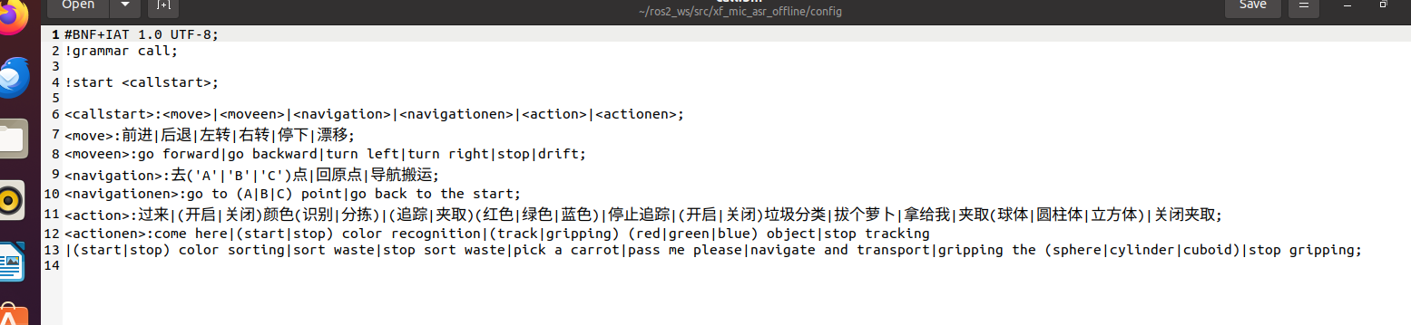

Command location: ros2_ws/src/xf_mic_asr_offline/config/call.bnf

After waking up the microphone, it will print the angle of the sound relative to the microphone.

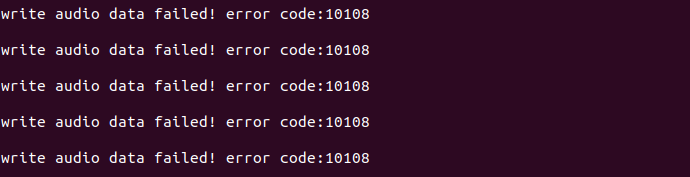

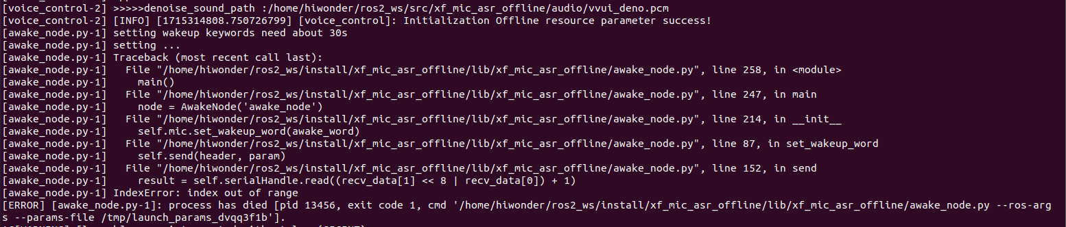

(1) 10108 Error Code
Initiating the initialization service for the 6-channel microphone array multiple times may lead to the problem shown in the following image. However, this issue does not impact functionality. To restore normal operation, just repeat the wake-up words Hello Hiwonder.

If the error shown in the image below occurs, follow these steps to recover:
Enter the following command to clear the occupation:
sudo apt remove brltty -y
Enter the following three commands one by one to update the USB mapping rules:
sudo udevadm control --reload-rules
sudo service udev restart
sudo udevadm trigger

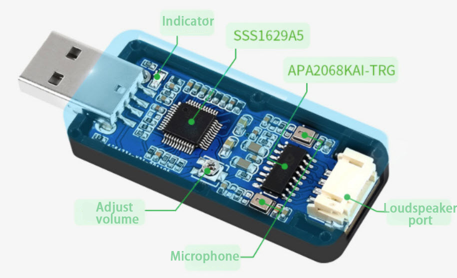

18.3.7 Sound Card Introduction
  • Sound Card Introduction
As a fundamental component of multimedia systems, a sound card converts analog sound waves into digital signals and vice versa. The primary function of a sound card is to convert raw audio signals from sources such as microphones, tapes, and disks, and output them to various devices such as speakers, headphones, amplifiers, and recorders. Additionally, sound cards can support the playback of the converted audio signals through MIDI interfaces.
Below is about the introduction to USB to audio driver-free sound card.
(1) Sound Card Interface
NO. Name Function
1 USB interface connect to PC or embedded devices
2 power indicator remains on red when the sound card is powered on
3 speaker interface connect to external speaker
4 Echo cancellation interface An external speaker can be connected for echo cancellation
(2) Interior Structure
(3) Parameter
Power supply voltage 5V
Audio encoding decoding chip SSS1629A5
Control interface USB
Audio interface PH2.0
Speaker driver 2.6W per channel (4Ω BTL)

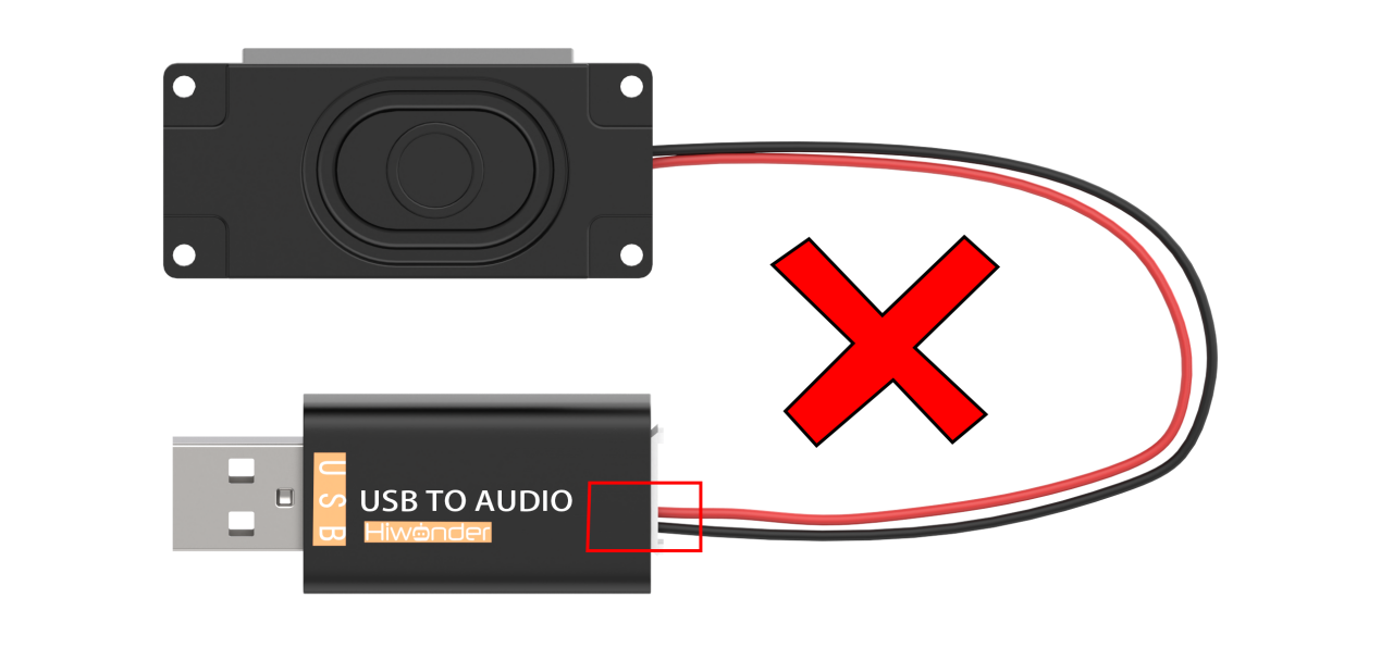

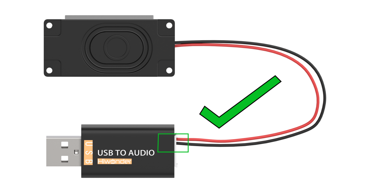

  • Wiring
(1) Ensure that the power is off when connecting the speaker wires to the SPK- and SPK+ ports on the right side of the sound card to enable sound playback. (The speaker connection wire has a design to prevent incorrect insertion; if it does not fit, do not force it. Instead, try inserting it in the opposite direction.) If connected to the RLN and RLP ports, the speaker will not produce sound.
(2) Then connect the USB extension cable to sound card.
(3) After completing the connections, insert the USB connectors of the sound card and microphone into the USB ports on the computer. The sound card and microphone can also be connected to a Raspberry Pi or Jetson Nano motherboard using the same method.

(1) Start the virtual machine. Regarding the configuration and installation method of the virtual machine, please refer to the section “18.1.3 Virtual Machine Installation and Configuration
(2) Connect sound card and speaker to any USB interface on computer according to the instruction in “18.3.2 Wiring”.
Warm tip: if the virtual machine is still powered on after configuration, the following prompt will pop up when you insert microphone.

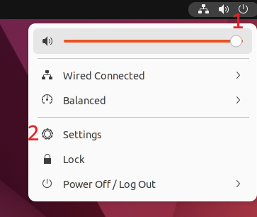

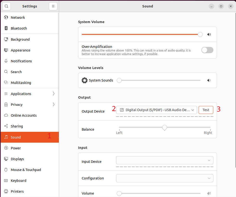

(3) Open settings.
(4) Click "Sound\>Output device\>Test".
(5) Once opened, users should connect the wires to the SPK- and SPK+ ports correctly. Since the speaker is mono, you can test it by selecting Front Right. For detailed information on wiring connections, please refer to “18.3.2 Wiring
If the speaker plays English voice, it means that the speaker functions normally.

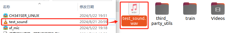

  • Import External Music File
Virtual machine only supports audio file of the format of wav. Abundant materials are available on the Internet teaching you how to convert the format into wav.
(1) Copy the converted audio file (e.g., test_sound.wav) to the same directory as this document. You can also download WAV format files from the internet for import, which will be used as an example for demonstration.
(2) Next, switch back to the virtual machine and click on the file manager located on the left side of the screen. Select the test_sound file by left-clicking on it, then drag it into the file manager. This will save it in the home directory of the user group.
(3) Double-click the test_sound.wav file to play the music.

(1) Use NoMachine to remotely log in to the device, then click the microphone configuration icon located on the desktop
(2) Select the correct microphone version based on your hardware.
For devices using a six-microphone array, select xf as the microphone type (as shown in the image below).
(3) Click “Apply & Save”, then click “Restart Service” to complete the setup.

(1) Requesting the Offline Speech Resource Package and App ID
To obtain the required offline speech resources and App ID, please refer to the following tutorial:
Path:
9.7.2 Replace Offline Voice Resources and ID
(2) Replacing the Offline Speech Resource and App ID

② Locate the extracted folder named similar to: Linux_aitalk_exp1227_21****8f,Navigate to the following subfolder within it: /bin/msc/res/asr/
Copy the file common.jet and move it to the desktop of your system image.
21****8f** is a version-specific identifier and may vary depending on the source.
③ On the target device, open the directory:
/home/ubuntu/ros2_ws/src/xf_mic_asr_offline/config/msc/res/asr
Delete all existing files in this folder.
④ Move the common.jet file from the desktop into the above directory.
⑤ Navigate to: /home/ubuntu/ros2_ws/src/xf_mic_asr_offline/launch Right-click on the mic_init.launch file and open it with a text editor (as indicated in the green box in the tutorial image).
⑥ Locate the appid field (highlighted in red in the tutorial image) and replace its value with the App ID obtained from the iFLYTEK developer platform.
Save the file using Ctrl + S.

(5) To ensure proper functionality, it is essential to run the microphone activation file after the initial use of the voice control feature or when modifying the wake-up word. Failure to do so may result in the microphone not functioning correctly.
Open the terminal, and run this command.
ros2 launch xf_mic_asr_offline mic_init.launch.py enable_setting:=true
The terminal will display pertinent prompts. During the initial activation, a 30-second wait is required. Once the terminal prints the designated wake-up word, for instance, Wake up word: xiao3 huan4 xiao3 huan you can proceed to speak the wake-up word to activate the microphone.
Press Ctrl+C to exit after activating the wake-up word.

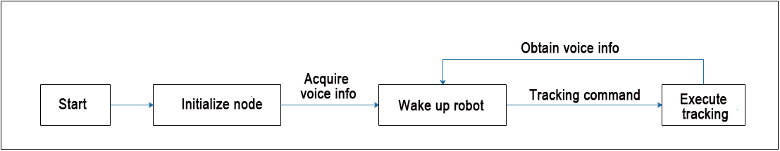

The program flowchart is as below:
As indicated in the diagram, the program’s logic revolves around obtaining voice information and executing voice commands. The subsequent content will further clarify this logic using the provided diagram.

(5) For the first time using the voice control feature or when modifying the wake-up word, it is necessary to execute the microphone activation file to enable the wake-up word. Otherwise, the microphone will not function properly.
Open the terminal, and execute the following command.
The terminal will print relevant prompts, and for the initial activation, it is necessary to wait for 30 seconds. When the terminal prints the corresponding wake-up word, such as “Wake up word: xiao3 huan4 xiao3 huan”, you can then speak the wake-up word to activate the microphone.

(1) launch_setup Function
def launch_setup(context):
    mic_type = os.environ['MIC_TYPE']
    if compiled == 'True':
        xf_mic_asr_offline_package_path = get_package_share_directory('xf_mic_asr_offline')
        xf_mic_asr_offline_package_path = '/home/ubuntu/ros2_ws/src/xf_mic_asr_offline'
    color_track_node_launch = IncludeLaunchDescription(
            os.path.join(example_package_path, 'example/opencv/color_track_node.launch.py')),
        launch_arguments={
            'broadcast': 'true',
        }.items(),
    if mic_type == 'xf':
        mic_launch = IncludeLaunchDescription(
                os.path.join(xf_mic_asr_offline_package_path, 'launch/mic_init.launch.py')),
                os.path.join(xf_mic_asr_offline_package_path, 'launch/wonderechopro_init.launch.py')),
    voice_control_color_track_node = Node(
        package='xf_mic_asr_offline',
        executable='voice_control_color_track.py',
        output='screen',
    return [
            color_track_node_launch,
            mic_launch,
            voice_control_color_track_node,
def launch_setup(context): Defines a function for launch configuration, used to start ROS2 nodes based on environmental settings and conditions.
compiled = os.environ['need_compile']: Retrieves the need_compile flag from the environment variable to determine whether compilation is required.
if compiled == 'True': ... else: ...: Based on the value of need_compile, determines the paths for the example and xf_mic_asr_offline packages.
color_track_launch = IncludeLaunchDescription(...): Configures the color_track_node.launch.py launch file, setting the start parameter to ‘false’.
mic_launch = IncludeLaunchDescription(...): Configures the mic_init.launch.py launch file.
voice_control_color_track_node = Node(...): Creates the voice_control_color_track.py node, specifying the package and executable file, and sets the output to screen.
return [color_track_launch, mic_launch, voice_control_color_track_node]: Returns a list containing the three launch items, used to start the related nodes in ROS2.
(2) generate_launch_description Function
    return LaunchDescription([
def generate_launch_description(): Defines the generate_launch_description function, which is used to generate a launch description object.
return LaunchDescription([OpaqueFunction(function = launch_setup)]): Returns a LaunchDescription object, where the launch_setup function is executed using OpaqueFunction, and its result is used as the launch configuration.
Judging from the diagram, the program’s logic primarily involves acquiring voice information and executing voice commands.

(2) init_process Function
    def init_process(self):
        self.timer.cancel()
        self.play('running')
        self.get_logger().info('\033[1;32m%s\033[0m' % '唤醒口令: 小幻小幻(Wake up word: hello hiwonder)')
        self.get_logger().info('\033[1;32m%s\033[0m' % '唤醒后15秒内可以不用再唤醒(No need to wake up within 15 seconds after waking up)')
        self.get_logger().info('\033[1;32m%s\033[0m' % '控制指令: 追踪红色 追踪绿色 追踪蓝色 停止追踪(Voice command: track red/green/blue object)')
self.timer.cancel(): Cancels the current timer, stopping any scheduled operations.
res = self.send_request(self.start_client, Trigger.Request()): Sends a trigger request to start the color tracking function.
if res.success: Checks if the color tracking startup request was successful.
self.get_logger().info('open color_track'): If successful, logs a message indicating that color tracking has started.
else: If unsuccessful, logs a message indicating that color tracking failed to start.
self.play('running'): Plays the “running” voice prompt.
self.get_logger().info('唤醒口令: 小幻小幻(Wake up word: hello hiwonder)'): Logs a message displaying the wake-up word information.
self.get_logger().info('唤醒后15秒内可以不用再唤醒(No need to wake up within 15 seconds after waking up)'): Logs a message informing that there’s no need to repeat the wake-up command within 15 seconds after the initial wake-up.
self.get_logger().info('控制指令: 追踪红色 追踪绿色 追踪蓝色 停止追踪(Voice command: track red/green/blue object)'): Logs the control commands for tracking red, green, or blue objects, and stopping the tracking.
self.create_service(Trigger, '~/init_finish', self.get_node_state): Creates a service indicating that initialization is complete and the system is ready to receive further requests.
self.get_logger().info('\033[1;32m%s\033[0m' % 'start'): Logs the start of the node and displays the text “start” in green on the console.
