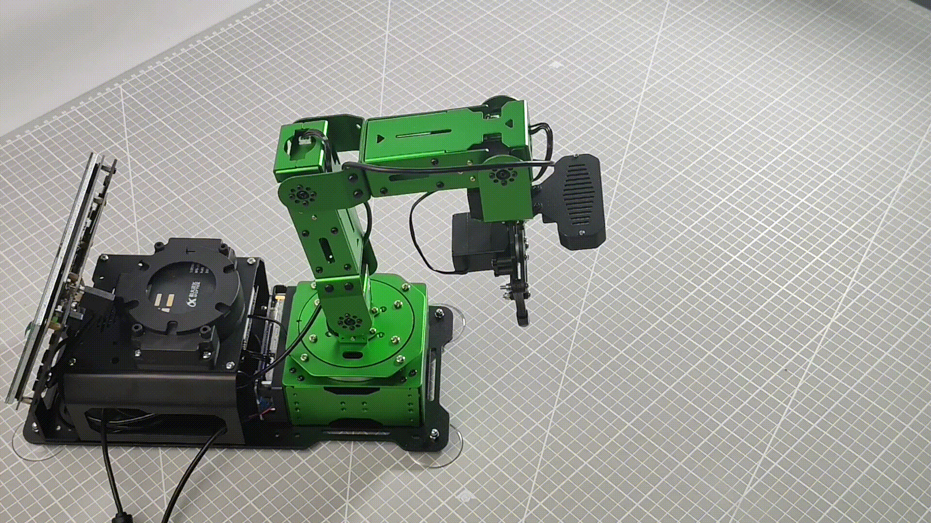

12.2.2 JetArm DH Model
(1) JetArm DH coordinate system:
(2) DH Model List:
Please refer to the file below:
/home/jetarm/src/jetarm_driver/jetarm_kinematics/src/jetarm_kinematics/jetarm_6dof_params.py

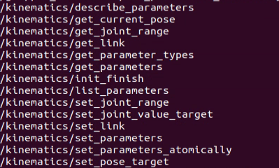

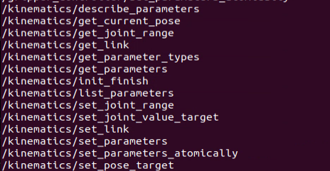

(3) Open a new terminal, and type the command below to access the robot arm kinematics service.
ros2 service list
Service Function
/kinematics/get_current_pose Acquire robot's current pose
/kinematics/get_joint_range Retrieve the motion range of each joint
/kinematics/get_link Get joint link information of the robot
/kinematics/get_loggers Retrieve the log information from the kinematics module
/kinematics/set_joint_range Set the motion range of the robot's joints
/kinematics/set_joint_value_target Set the angle of the target joint to achieve the pose control
/kinematics/set_link Configure the joint linkage information for the robot
/kinematics/set_logger_level Set the logging level for the kinematics module
/kinematics/set_pose_target Set the target pose for the robot's end effector

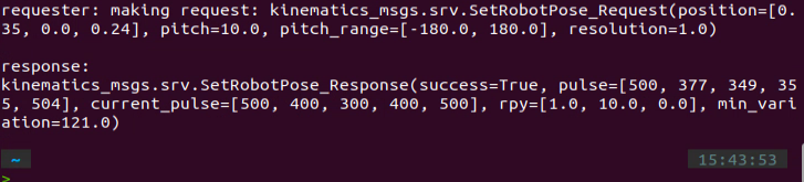

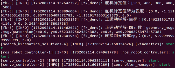

Programe outcome

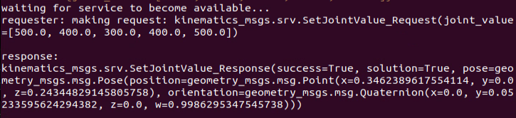

(1) Open a new terminal , and execute the command below.
ros2 service call /kinematics/set_joint_value_target kinematics_msgs/srv/SetJointValue "{joint_value: \[500.0, 400.0, 300.0, 400.0, 500.0 \]}"
(2) By inputting the rotation angles of servos 1-5, you can obtain the pose information of the robotic arm after movement. The information includes coordinates along the XYZ axes and the orientation represented using quaternions.
The service call here only displays the pose information; the robotic arm does not physically move.
  • Programe outcome

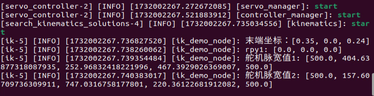

(2) Next, enter the command to start the forward kinematics service program. The robotic arm will calculate and move to the target position based on the configured servo pulse width. Relevant information will be displayed in the terminal.
ros2 launch example fk.launch.py
(3) If you want to terminate the program, press ‘Ctrl+C’. If the program fails to stop, please have retry.

(2) Print the radian value on the terminal.
        # Output the pulse width value of the servo and the forward kinematic solution. 输出舵机脉宽值和正运动学解
        self.servo_list = [500, 400, 300, 400, 500]
        self.duration = 1.0
        self.get_logger().info("舵机脉宽值:{}".format(self.servo_list))
        pulse = transform.pulse2angle([i for i in self.servo_list])  # The pulse width value of the servo is converted to radian. 舵机脉宽值转为弧度
        self.get_logger().info("舵机脉宽值转为弧度:{}".format(pulse))
  • Obtain the Forward Kinematics Solution
(1) Display the forward kinematics solution in the form of coordinate systems, quaternions, and Euler angles.
        res = self.fk.get_fk(pulse)  # Obtain the forward kinematic solution. 获取运动学正解
        self.get_logger().info('正运动学解-坐标:{}'.format(res[0]))
        self.get_logger().info('正运动学解-四元数:{}'.format(res[1]))
	        self.get_logger().info('转换四元数成rpy:{}'.format(transform.qua2rpy(res[1])))
        self.set_servo_position(self.servos_pub, self.duration, self.servo_list)# Release the information of the servo and drive the robotic arm. 发布舵机信息,驱动机械臂
