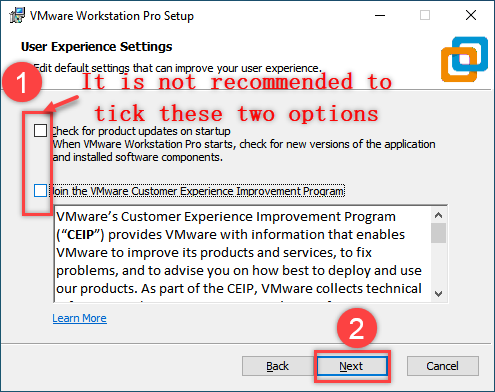

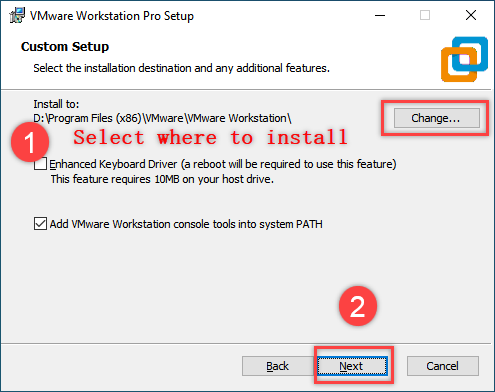

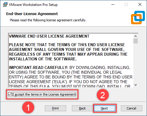

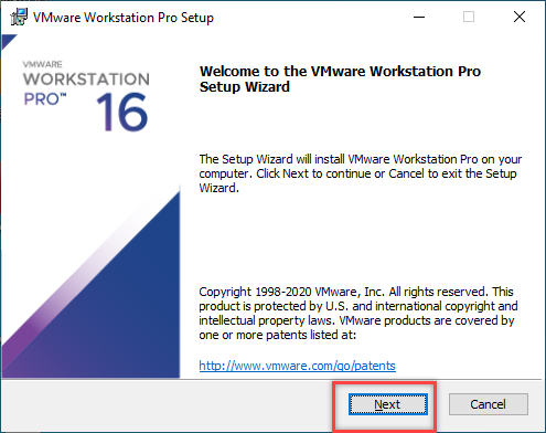

(1) VMware Installation
A virtual machine allows us to run other operating systems within our current operating system. In this section, we will demonstrate the installation process using VMware Workstation as an example:
① Unzip the virtual machine software package located under the “Configuration File -> VMware” path.
② After unzipping, locate the virtual machine folder and double-click the executable file (with the “.exe” extension).

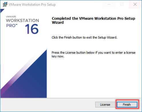

③ Follow the on-screen instructions to complete the installation of the virtual machine.

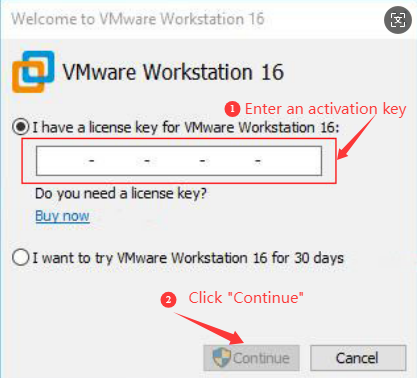

④ Alicense key is required during the first boot. In this case, enter any key from the “VMware 16 Activation Keys” file located in the virtual machine folder, and click “Continue”.

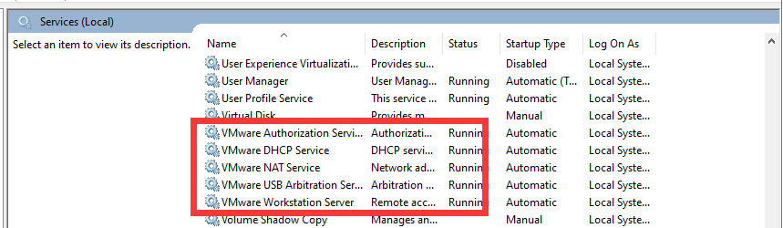

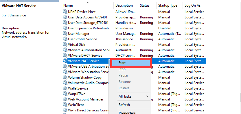

Starting Local VMware Services

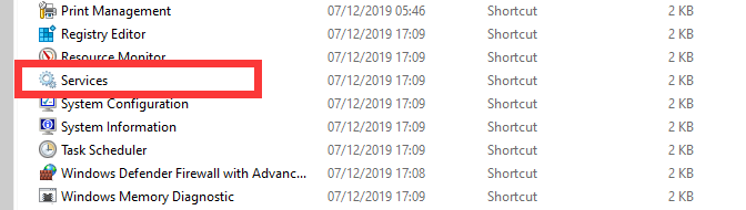

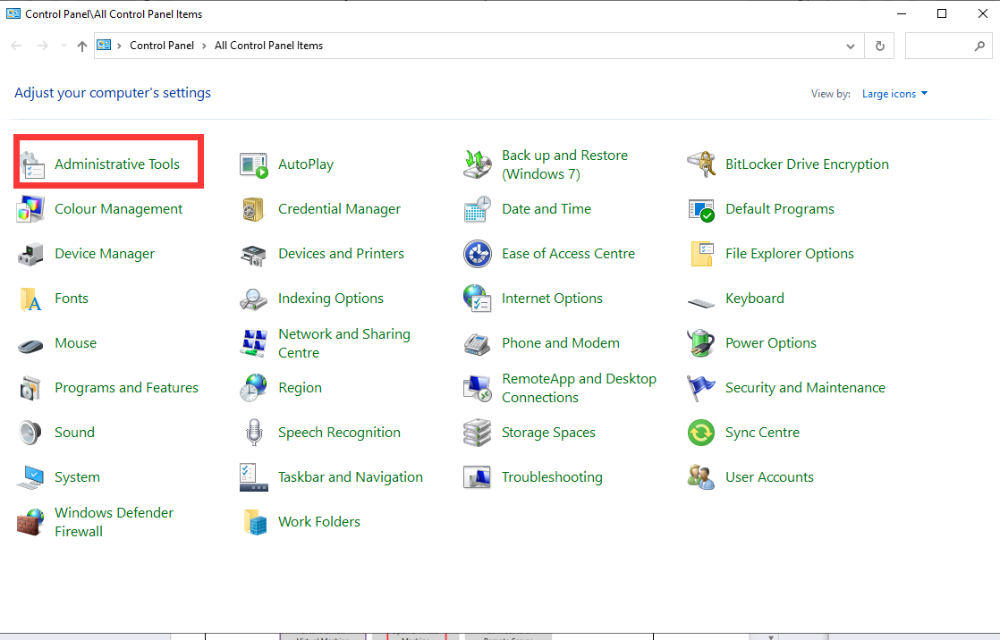

① On your computer, press the “WIN+R” keys to open the Run window. Then, type “control” and press Enter to open the Control Panel.
② Click on “Administrative Tools” and then double-click on “Services”.
③ Locate the VMware-related services as shown in the image below.
④ Right-click on the “Start” button and select it to start all VMware-related services.

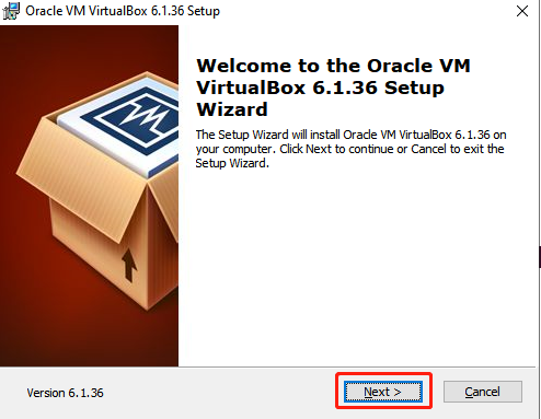

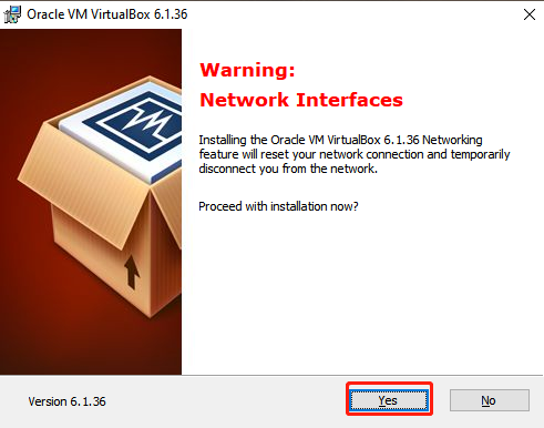

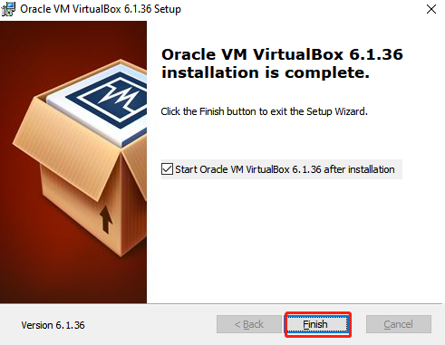

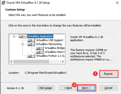

(2) VirtualBox Installation
① Open the software installation package in the same directory and click “Next”.
② Modify the installation path if needed, then click “Next”.
③ No changes needed, just click “Next”.
④ Confirm the installation and click “Start Installation”.
⑤ Once the installation is complete, click “Finish”.

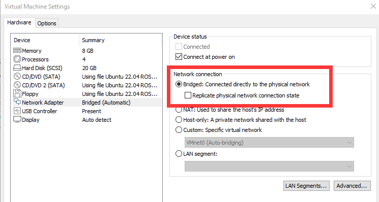

(1) Find the imported virtual machine and click “Edit virtual machine settings.”
(2) Click “Network Adapter” and select “Bridged Mode.”

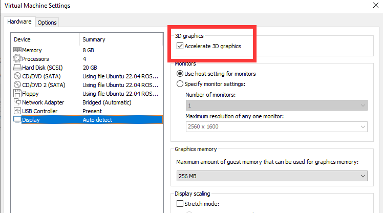

(3) Click “Display” and uncheck “Accelerate 3D graphics.”
Enabling the “Accelerate 3D graphics” option may affect virtual machine performance and cause lag during simulation.

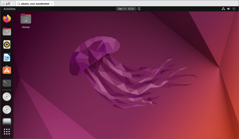

The virtual machine interface is as below:
  • Package Import (Performed on Virtual Machine)
(1) Start the virtual machine. Click the system desktop icon to open the command-line terminal.

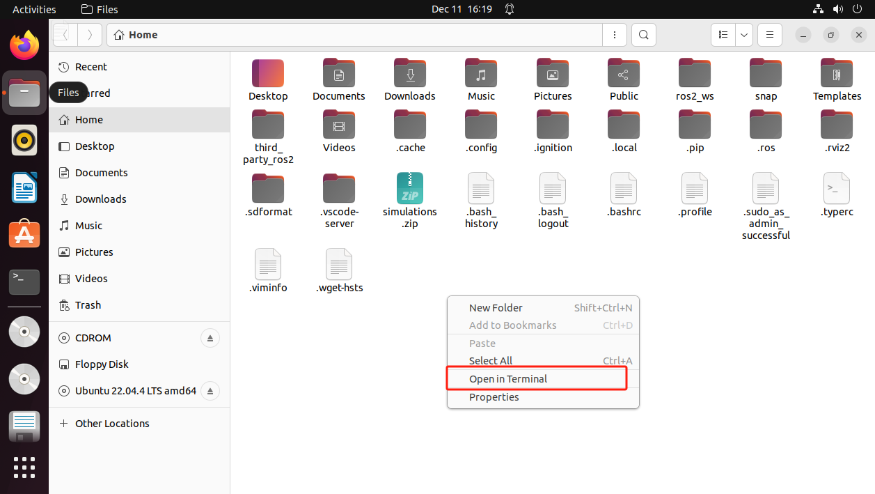

(3) Locate the “Simulations” compressed file`in the same directory. Drag the compressed file into the Home directory of the virtual machine.
(4) Locate the “jetauto_description.zip”, “robot_gazebo.zip” and “robot_moveit_config.zip” compressed file in the same directory. Drag the compressed file into the Home directory of the virtual machine.
Only drag one file at a time.
(5) Right-click in the Home directory and select “Open in terminal” to open the terminal.
(6) Enter the following command to create a directory:
mkdir -p ~/ros2_ws/src

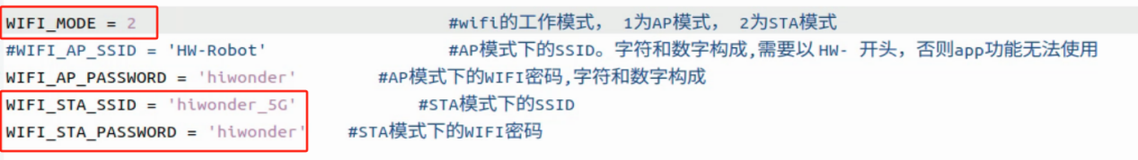

(3) Modify the configuration to LAN mode and enter the WiFi name and password
(4) Press Ctrl+S to save and close the file.

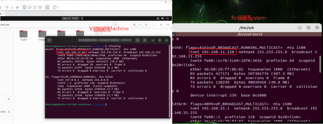

(5) For subsequent connections, ensure that the device and virtual machine are on the same network segment. You can check this by running the following command in the terminal:
ifconfig
In this example, both the virtual machine and the robot are on the 192.168.11 network segment, allowing for normal communication.

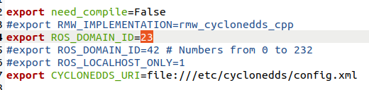

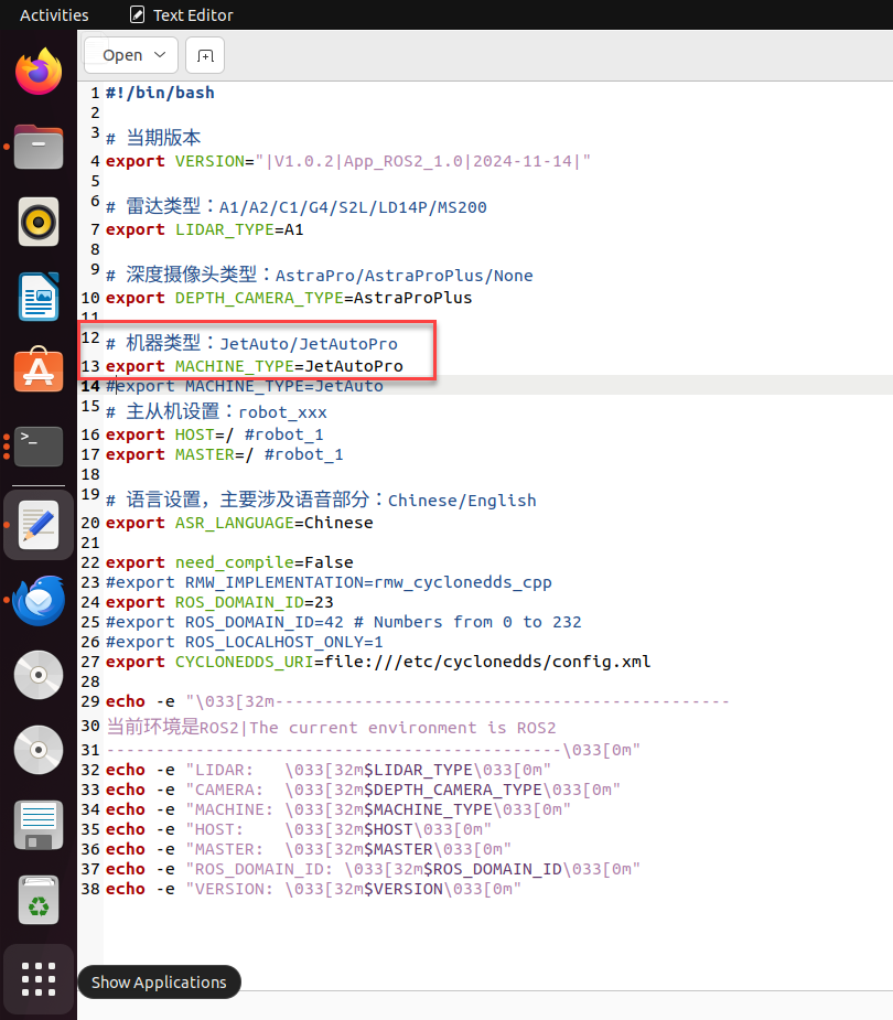

  • Device ID Configuration (To Be Performed on the Virtual Machine)
In the previous section, we configured the network environment. However, for the virtual machine and the robot to communicate on the same network, they must have matching ID numbers. Below are the steps to configure the ID:

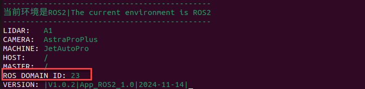

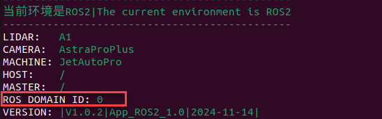

(1) Start the robot and open a terminal from the desktop.
(2) The terminal will display the device’s DOMAIN_ID, as shown below:
For example, if the DOMAIN_ID is 23, we will configure the virtual machine accordingly.

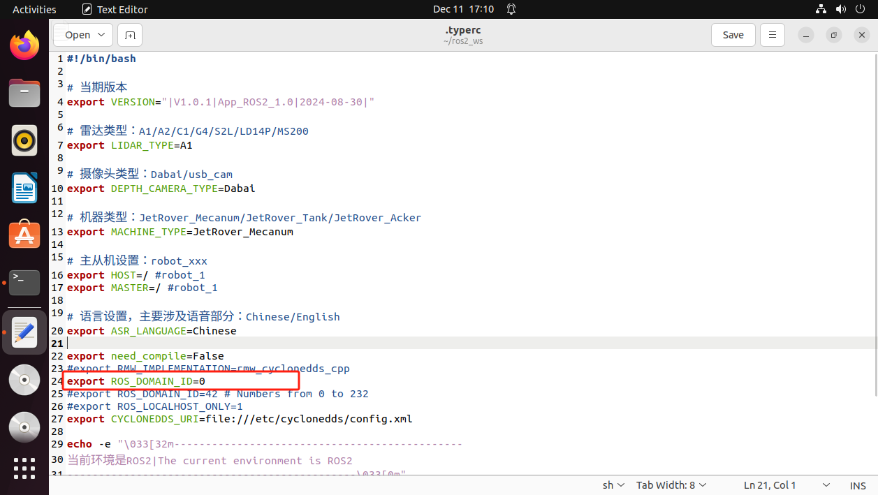

(3) Start the virtual machine and open a terminal from the desktop.
(4) Enter the following command to open the configuration file:
gedit ~/ros2_ws/.typerc
(5) Modify the ID in the configuration file to match the robot’s DOMAIN_ID (e.g., 23):
(6) Press Ctrl+S to save the changes and close the file.
(7) Close the current terminal, then open a new terminal. You will observe that the ID has been successfully updated to 23.

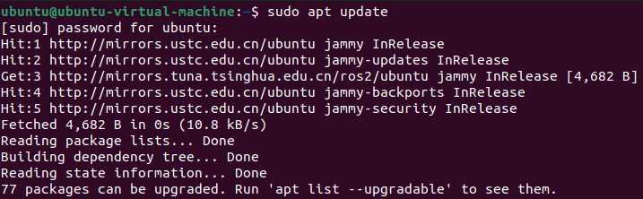

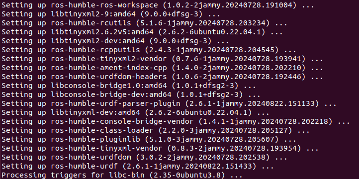

(1) Run the following command and press Enter to update the package information:
sudo apt update
(2) Run the following command and press Enter to install the URDF dependencies:
sudo apt-get install ros-humble-urdf
When the output matches the image below, the installation is successful:

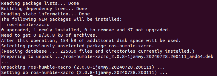

(3) Run the following command and press Enter to install the Xacro model extension for URDF:
sudo apt-get install ros-humble-xacro

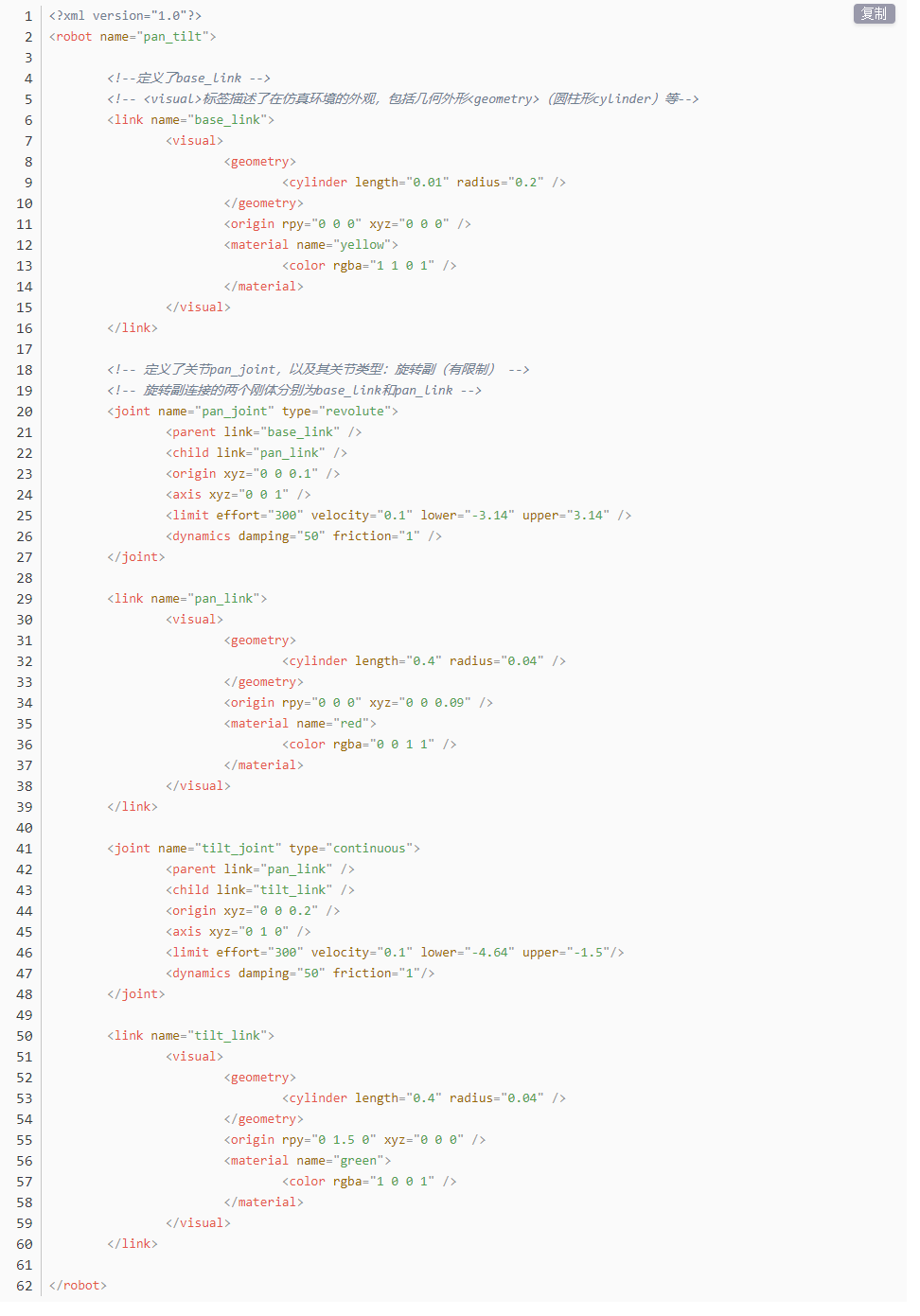

(6) Write Simple URDF Model
Name the model of the robot
To start writing the URDF model, we need to set the name of the robot following this format: “<robot name=”robot model name”>”. Lastly, input “</robot>” at the end to represent that the model is written successfully.
Set links
① To write the first link and use indentation to indicate that it is part of the currently set model. Set the name of the link using the following format: <link name=”link name”>. Finally, conclude with “</link>” to indicate the successful completion of the link definition.
② Write the link description and use indentation to indicate that it is part of the currently set link, and conclude with “</visual>”.
③ The “<geometry>” tag is employed to define the shape of a link. Once the description is complete, include “</geometry>”. Within the “<geometry>” tag, indentation is used to specify the detailed description of the link’s shape. The following example demonstrates a link with a cylindrical shape: “<cylinder length=”0.01” radius=”0.2”/>”. In this instance, “length=”0.01”” signifies a length of 0.01 meters for the link, while “radius=”0.2”” denotes a radius of 0.2 meters, resulting in a cylindrical shape.
④ The “<origin>” tag is utilized to specify the position of a link, with indentation used to indicate the detailed description of the link’s position. The following example demonstrates the position of a link: “<origin rpy=”0 0 0” xyz=”0 0 0” />”. In this example, “rpy” represents the roll, pitch, and yaw angles of the link, while “xyz” represents the coordinates of the link’s position. This particular example indicates that the link is positioned at the origin of the coordinate system.
⑤ The “<material>” tag is used to define the visual appearance of a link, with indentation used to specify the detailed description of the link’s color. To start describing the color, include “<material>”, and end with “</material>” when the description is complete. The following example demonstrates setting a link color to yellow: “<color rgba=”1 1 0 1” />”. In this example, “rgba=”1 1 0 1”” represents the color threshold for achieving a yellow color.
Set joint
① To write the first joint, use indentation to indicate that the joint belongs to the current model being set. Then, specify the name and type of the joint as follows: “<joint name=”joint name” type=”joint type”>”. Finally, include “</joint>” to indicate the completion of the joint definition.
to learn about the type of the joint, please refer to “joint”.
② Write the description section for the connection between the link and the joint. Use indentation to indicate that it is part of the currently defined joint. The parent parameter and child parameter should be set using the following format: “<parent link=”parent link”/>”, and “<child link=”child link” />”. With the parent link serving as the pivot, the joint rotates the child link.
③ “<origin>” describes the position of the joint using indention. This example describes the position of the joint: “<origin xyz=”0 0 0.1” />”. xyz is the coordinate of the joint.
④ “<axis>” describes the position of the joint adopting indention. “<axis xyz=”0 0 1” />” describes one posture of a joint. xyz specifies the pose of the joint.
⑤ “<limit>” imposes restrictions on the joint using indention. The below picture The “<limit>” tag is used to restrict the motion of a joint, with indentation indicating the specific description of the joint angle limitations. The following example describes a joint with a maximum force limit of 300 Newtons, an upper limit of 3.14 radians, and a lower limit of -3.14 radians. The settings are defined as follows: effort=”joint force (N)”, velocity=”joint motion speed”, lower=”lower limit in radians”, upper=”upper limit in radians”.
⑥ “<dynamics>” describes the dynamics of the joint using indention. “<dynamics damping=”50” friction=”1” />” describes dynamics parameters of a joint.

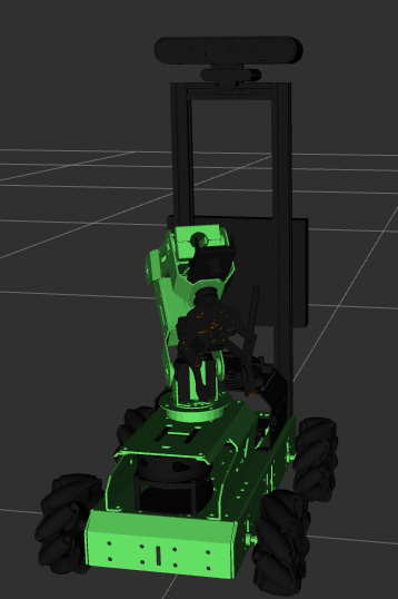

  • Viewing the Robot Model Code

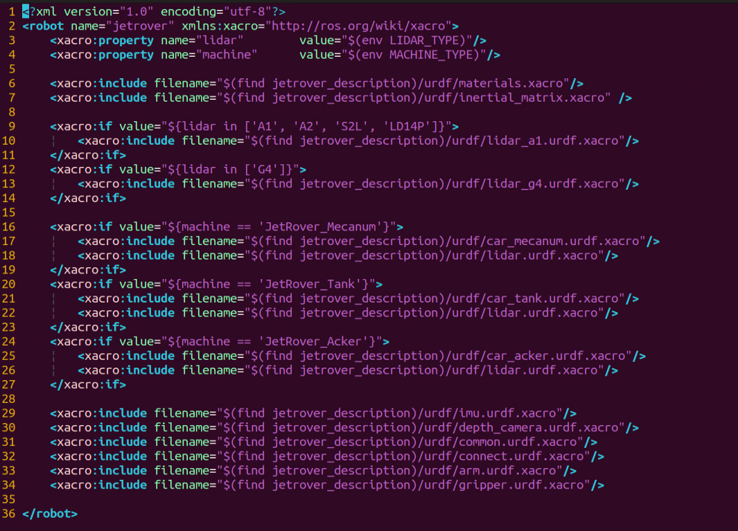

(1) Start the virtual machine and click the icon to open the command-line terminal.
(2) Enter the following command and press Enter to navigate to the startup program directory:
cd ros2_ws/src/jetauto_description/urdf/
(3) Enter the following command to open the robot simulation model file:
vim jetauto.xacro

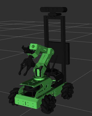

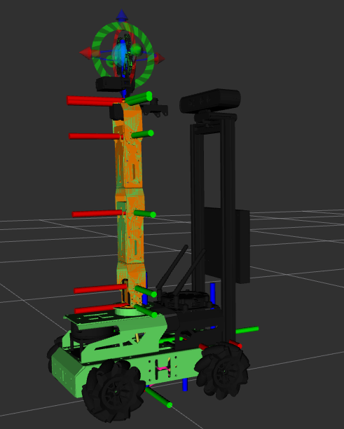

(4) Find the code section shown in the image below:
Multiple URDF models are called to form the complete robot.
File Name Device
materials Color
inertial_matrix Inertia Matrix
lidar_a1 A1 Lidar
lidar_g4 G4 Lidar
jetauto_car Chassis
Imu Inertial Measurement Unit (IMU)
screen Screen
depth_camera Depth camera
usb_camera Monocular camera
jetauto_arm Robotic arm
gripper Mechanical gripper

<xacro:property name="base_link_h"        value="1.145"/>
<xacro:property name="base_link_d"        value="0.11255"/>
The next section of code defines a joint called “base_joint”, which is of the “fixed” type, indicating that it is a fixed joint. This joint connects a parent link named “base_footprint” and a child link named “base_link”.
<joint name="base_joint" type="fixed">
    <parent link="base_footprint"/>
    <child link="base_link"/>
    <origin xyz="0.0 0.0 0.005" rpy="0 0 0"/>
  </joint>
The joint’s position (origin) is specified using an xyz attribute, where
0.0 0.0 0 is an expression representing the location information. All are set
as “0” for the default position and direction. The code then defines a link named “w_link”, which represents a link
component. The joint’s position (origin) and axis (axis) are set with some
default values.
 <link
    name="base_link">
    <xacro:box_inertial m="${base_link_mass}" w="${base_link_w}" h="${base_link_h}" d="${base_link_d}"/>
    <visual>
      <origin
        xyz="0 0 0"
        rpy="0 0 0" />
      <geometry>
        <mesh
          filename="[file://](https://tool.oschina.net/)\$(find jetauto_description)/meshes/base_link.stl" />
      </geometry>
      <material name="green"/>
    </visual>
    <collision>
      <origin
        xyz="${base_link_w/2.0 - 0.14810} 0 ${0.126437/2 + 0.02362364}"
        rpy="0 0 0" />
      <geometry>
        <box size="${base_link_w} ${base_link_h} ${base_link_d}" />
      </geometry>
    </collision>
  </link>

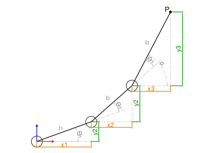

  • Inverse Kinematics Analysis

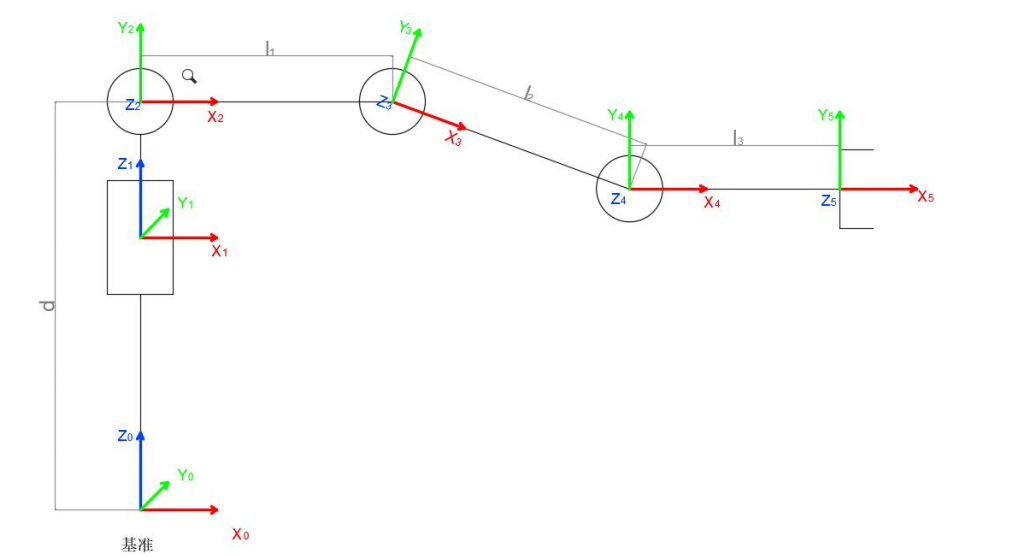

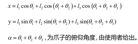

(1) Geometric Method
For a robotic arm, the geometric method involves determining the rotation angles of each joint after specifying the position and orientation of the end effector. Since the 3D motion of a robotic arm is quite complex, we simplify the model by removing the rotational joint of the lower platform. This allows us to analyze the kinematics in a 2D plane.
Inverse kinematics analysis generally involves extensive matrix computations, making the process complex and computationally intensive, which can make implementation challenging. To better suit our needs, we use the geometric method for analyzing the robotic arm.
We simplify the model of the robotic arm by removing the base platform and actuator section, resulting in the main body of the arm. From the diagram above, we can see that the coordinates (x, y) of the end effector P are composed of three parts: (x1 + x2 + x3, y1 + y2 + y3).
In the diagram, θ1, θ2, and θ3 are the joint angles of the servos that we need to calculate, and α is the angle between the gripper and the horizontal plane. From the diagram, it is clear that the angle of the gripper from the top view, α, is equal to θ1 + θ2 + θ3. Using this, we can derive the following equation:
Where x and y are provided by the user, and l1, l2, and l3 are the inherent properties of the robotic arm’s structure.
To simplify the calculations, we process the known parts and consider them as a whole:
Substituting m and n into the existing equation and simplifying, we get:
By solving this equation, we obtain:
This result corresponds to the quadratic formula for solving a single-variable equation, where:
From this, we can calculate the angle of θ1, and similarly, we can calculate θ2. With all three servo angles determined, we can then control the servos based on these angles to achieve the desired position.

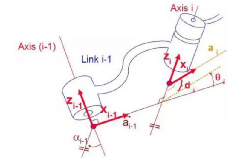

(2) DH Modelling
Introduction
The DH Parameter Table (Denavit-Hartenberg Parameter Table) is a standardized method used to describe the relative position and orientation of robotic arm joints and links. It uses four parameters to represent the relationship between each pair of adjacent joints. These four DH parameters have very clear physical meanings, as described below:
① Link Length: The length of the common normal between the axes of two adjacent joints (the rotation axis for rotational joints, the translation axis for prismatic joints).
② Link Twist: The angle by which the axis of one joint is rotated around the common normal relative to the axis of the adjacent joint.
③ Link Offset: The distance along the axis of a joint between the common normal of the current joint and the common normal of the next joint.
④ Joint Angle: The angle of rotation around the joint axis between the common normal of the current joint and the common normal of the next joint.
While these definitions might seem complex, they become much clearer when viewed in the context of coordinate systems.
First, you should focus on the two most important “lines”:
- The axis of a joint (axis).
- The common normal between the axis of one joint and the axis of the adjacent joint (common normal).
In the DH parameter system, we define the axis as the z-axis, and the common normal as the x-axis, where the direction of the x-axis is from the current joint to the next joint.
However, these two rules alone are not enough to fully determine the coordinate system of each joint. Let’s now go over the detailed steps for determining the coordinate system.
In applications such as robotic arm simulations, we may use other methods to establish coordinate systems. However, understanding the method described here is crucial for grasping the mathematical expressions of robotic arms and for understanding the subsequent analyses.
The diagram below shows two typical robot joints. Although these joints and links may not resemble any specific joints or links from real robots, they are quite common and can easily represent any joint in a real robot.
This revision simplifies and clarifies the explanation, making it easier for users to understand the concepts and how they relate to the coordinate system in robotic arms.
Determine Coordinate System
There are generally several steps involved in determining the coordinate system:
To model a robot using the DH (Denavit-Hartenberg) notation, the first step is to assign a reference coordinate system to each joint. For each joint, both the Z-axis and the X-axis must be specified.
① Defining the Z-axis:
- For a rotational joint, the Z-axis is aligned with the direction of rotation according to the right-hand rule. The joint variable is the rotation angle around the Z-axis.
- For a prismatic joint (sliding joint), the Z-axis aligns with the direction of linear motion. The joint variable is the length of travel along the Z-axis.
② Defining the X-axis:
- When two joints are neither parallel nor intersecting, the Z-axis is typically diagonal. However, there is always one shortest perpendicular line (common normal) between them, which is orthogonal to both Z-axes. The X-axis is defined along this common normal.
- If \ a_n \ represents the common normal between the Z-axes of joint \ n \ and joint \ n+1 \, then the direction of the X-axis, \ X_n \, will be along \ a_n .
③ Special Cases:
- When the Z-axes of two joints are parallel, there are infinitely many common normal lines. In this case, one can choose the common normal that is collinear with the common normal of the previous joint, simplifying the model.
- When the Z-axes of two joints intersect, there is no common normal. In this case, the X-axis can be defined along the line perpendicular to the plane formed by the two axes, simplifying the model.
Once the coordinate system is assigned to each joint, the model can be represented as shown in the diagram below:
After determining the coordinate system, we can represent the four parameters more simply:
Link Length \(l_{i}\): Defined as the distance along the positive \(X_{i - 1}\) axis from \(Z_{i - 1}\) axis to \(Z_{i}\).
Link Twist \(\alpha_{i}\): Defined as the angle of rotation along the positive direction \(X_{i - 1}\) (using the left-hand or right-hand rule?) between \(Z_{i - 1}\) and \(Z_{i}\).
Joint Offset \(d_{i}\): Defined as the distance along the positive \(Z_{i - 1}\) axis from \(X_{i - 1}\) axis to the \(X_{i}\).
Joint Angle\({\ \theta}_{i}\): Defined as the rotational angle between two axes, measured in the positive direction (using the left-hand or right-hand rule).
Joint Angle \({\ \theta}_{i}\): Defined as the rotational angle between \(X_{i - 1}\) and \(X_{i}\) along the positive direction \(Z_{i - 1}\), using the right-hand rule (or left-hand rule, depending on the convention).

  • Select Robot Version
(1) Change the section highlighted in the red box below to the JetAutoPro version. After completing the modification, press “Ctrl+S” to save and close.
(2) Return to the terminal. Enter the following command to update the environment configuration.
source ~/.bashrc

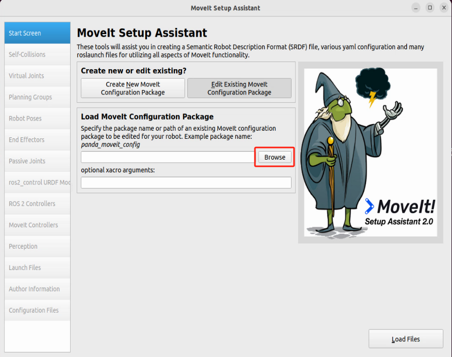

(2) Execute the following command to launch the MoveIt2 setup assistant.
ros2 launch moveit_setup_assistant setup_assistant.launch.py

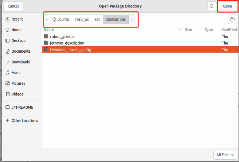

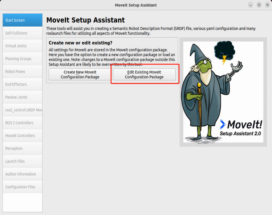

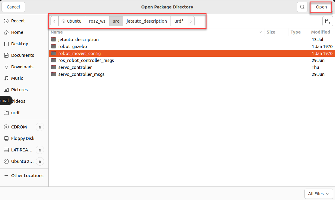

(3) Click “Edit Existing MoveIt2 Configuration Package” to begin editing an existing configuration package.

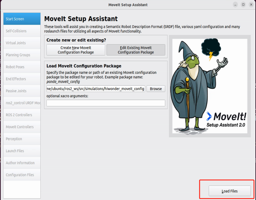

(4) Click “Browse” and navigate to the following directory: home/ubuntu/ros2_ws/src/; Select “robot_moveIt_config” the folder and click “Open”.
(5) Click “Load Files” and wait for the files to load.
Once the progress reaches 100%, the robot model will appear on the right side, indicating a successful load.

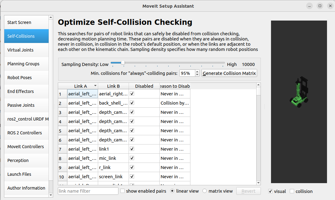

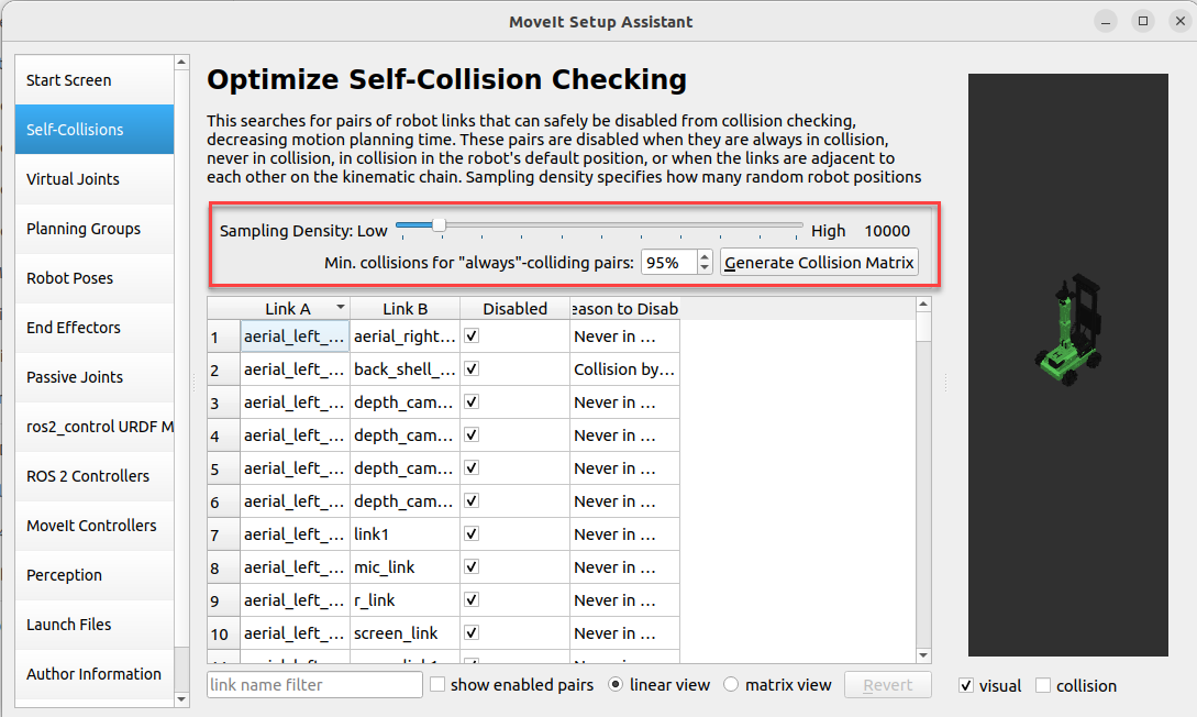

(1) Self-Collisions
The default collision matrix generator scans all joints of the robot. This custom collision matrix can safely disable specific collision checks, thereby reducing the processing time for motion planning.
Sampling Density:
Sampling density refers to the number of random joint configurations sampled to check for collisions. Higher density increases computation time. The default value is 10,000 collision checks.

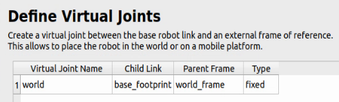

(2) Virtual joints
Virtual joints are primarily used to connect the robot to a simulation environment. In this step, a virtual joint is defined to link the base_footprint frame to the world_frame.

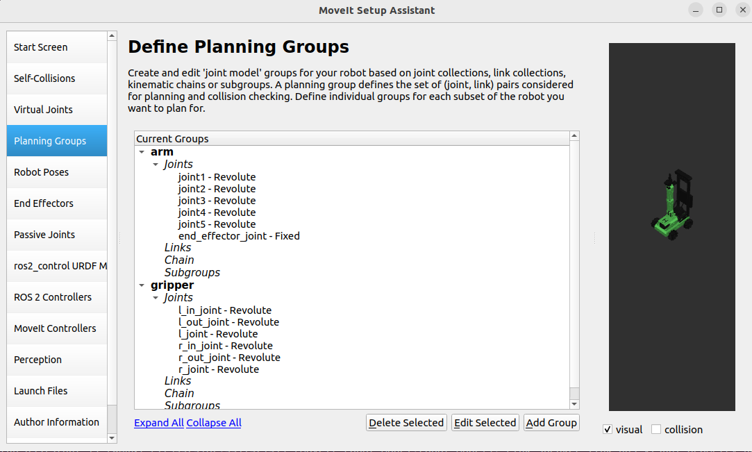

(3) Planning Groups
Joint groups are used to define the various joint components required to assemble the robot.

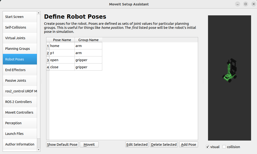

(4) Robot Poses
Define custom pose names for the robot and specify the joint groups involved in achieving each pose.

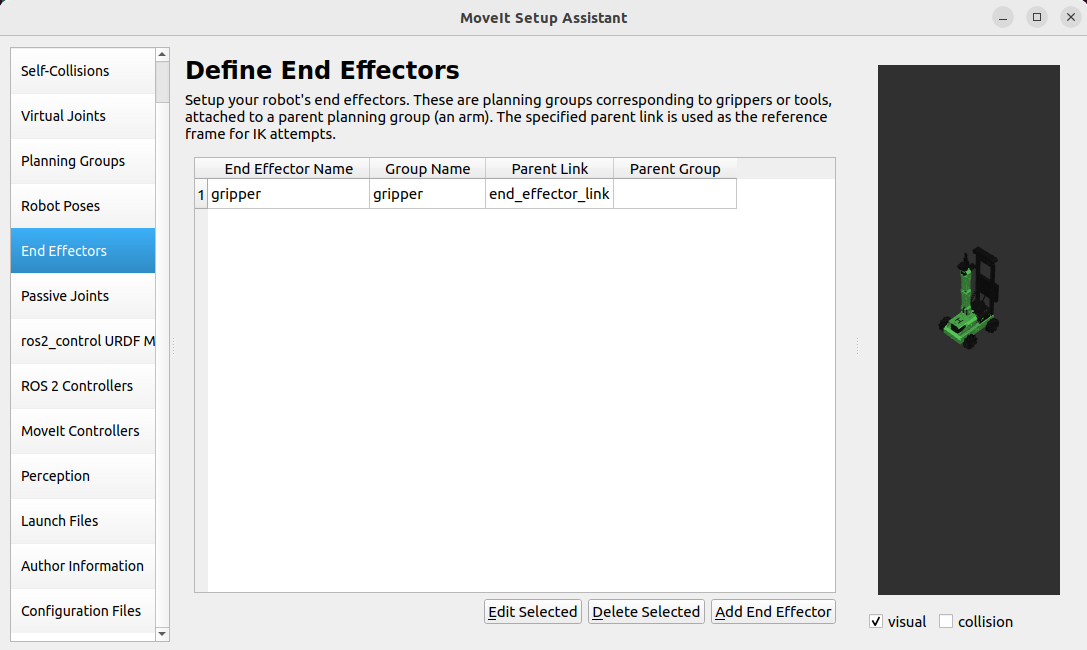

(5) End Effectors
Define the end-effector, that’s the gripper of the robotic arm.

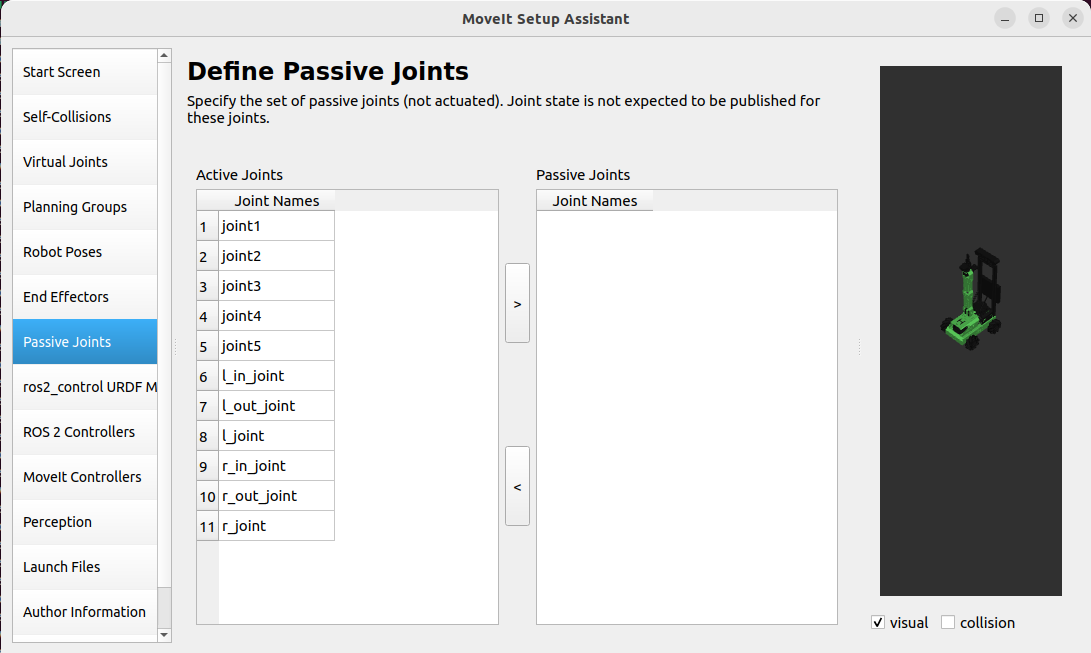

(6) Passive Joints
Defining unused joints. Specify which joints are available and which are disabled, based on the robot’s configuration.

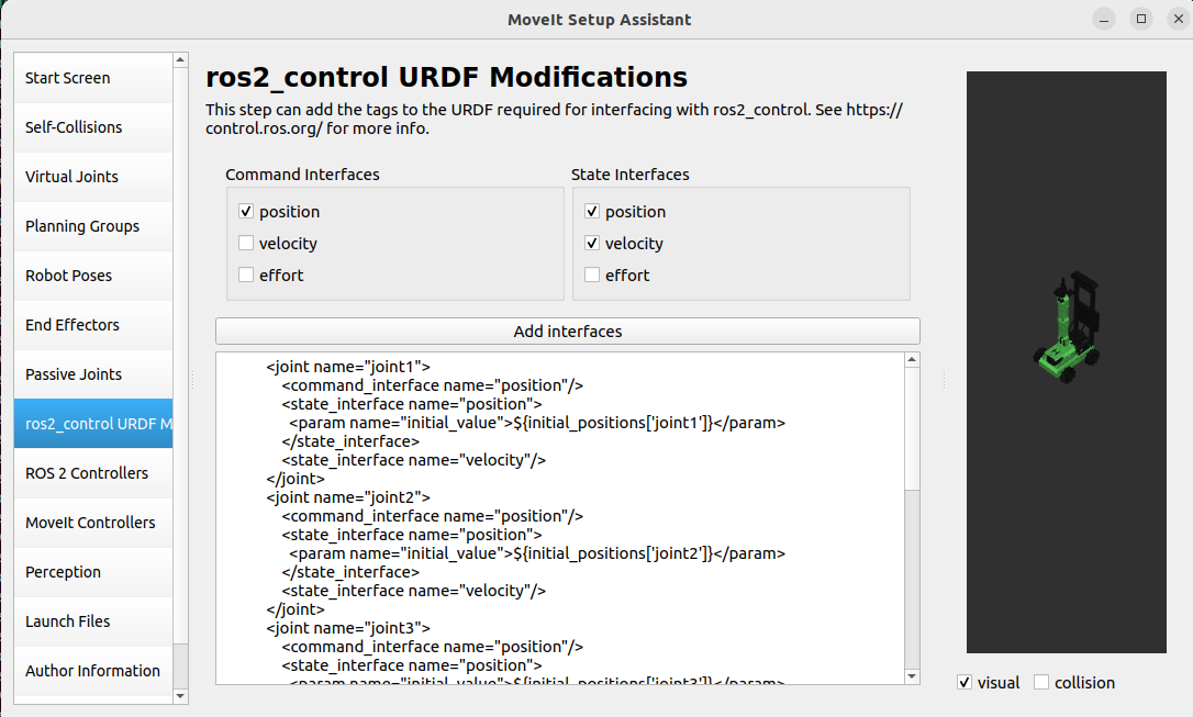

(7) ros2_control URDF Modifications
Configure the URDF file required for simulation.

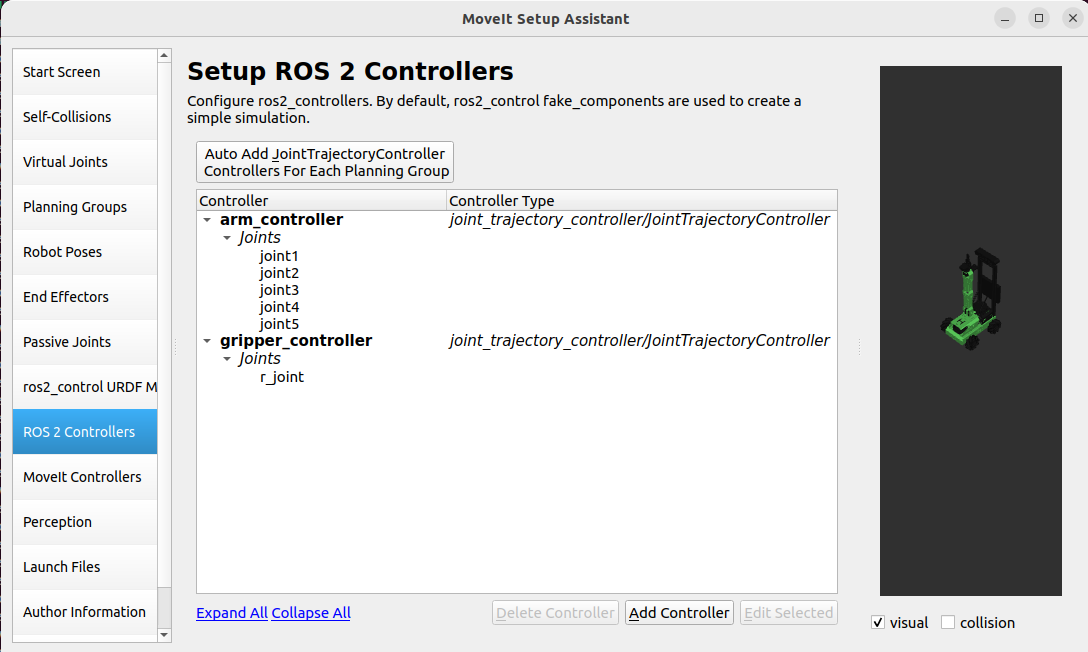

(8) ROS2 Controllers
Using the ROS2 Controllers panel, you can add simulated controllers for the joints. This enables MoveIt2 to simulate the motion of the robotic arm.

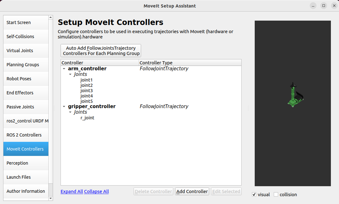

(9) Movelt controllers
Configure the controller to execute trajectories in MoveIt.

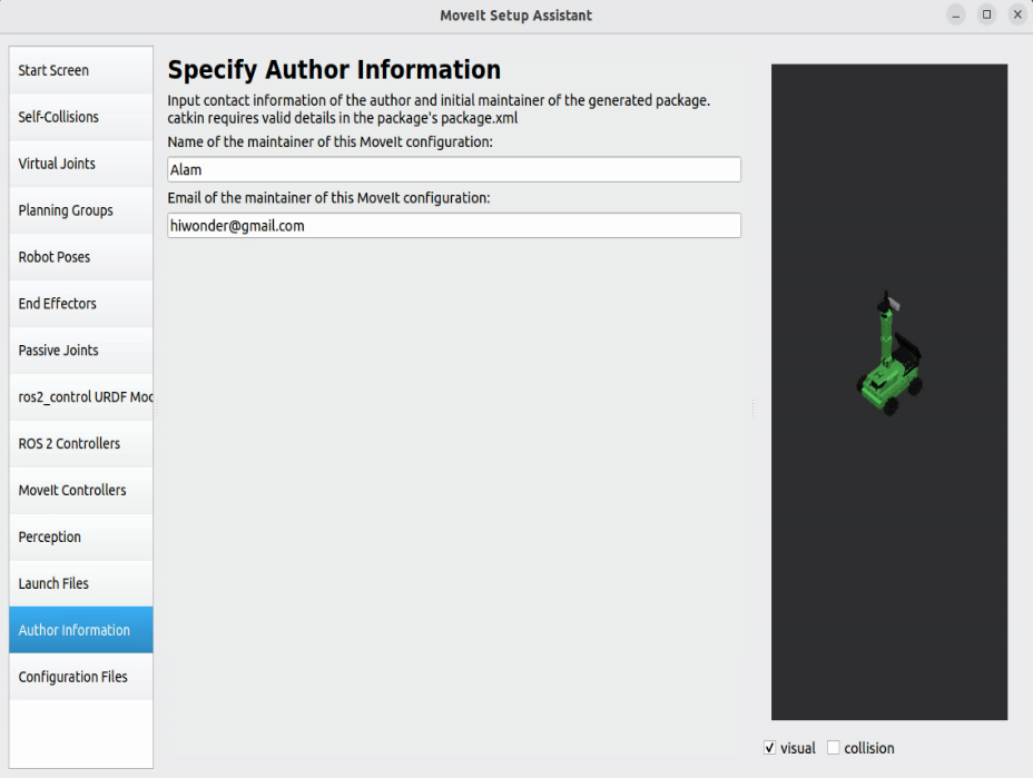

(10) Author Information
Provide the author’s details for documentation purposes.

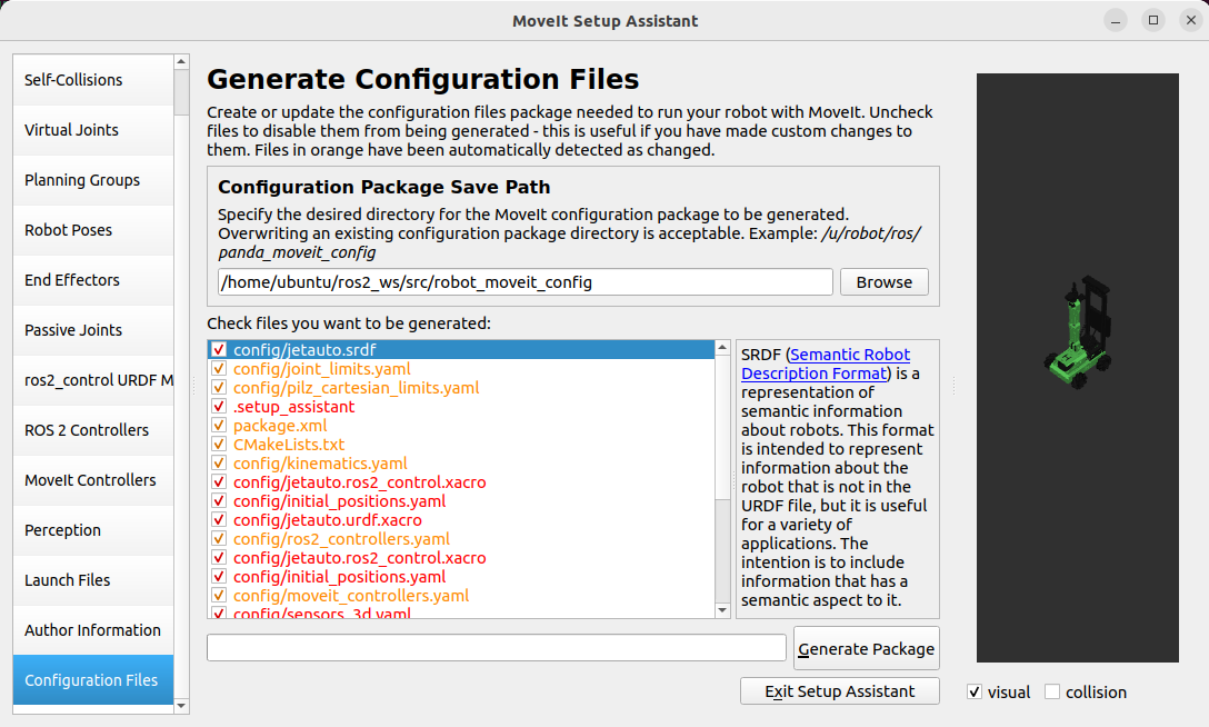

(11) Configuration Files
Factory Configuration
The factory configuration is pre-set, and no reconfiguration is required. If reconfiguration is needed, ensure to save the original program and compare it before making modifications.
Generating Configuration Files
After confirming the file path, click “Generate Package” to generate the configuration package.

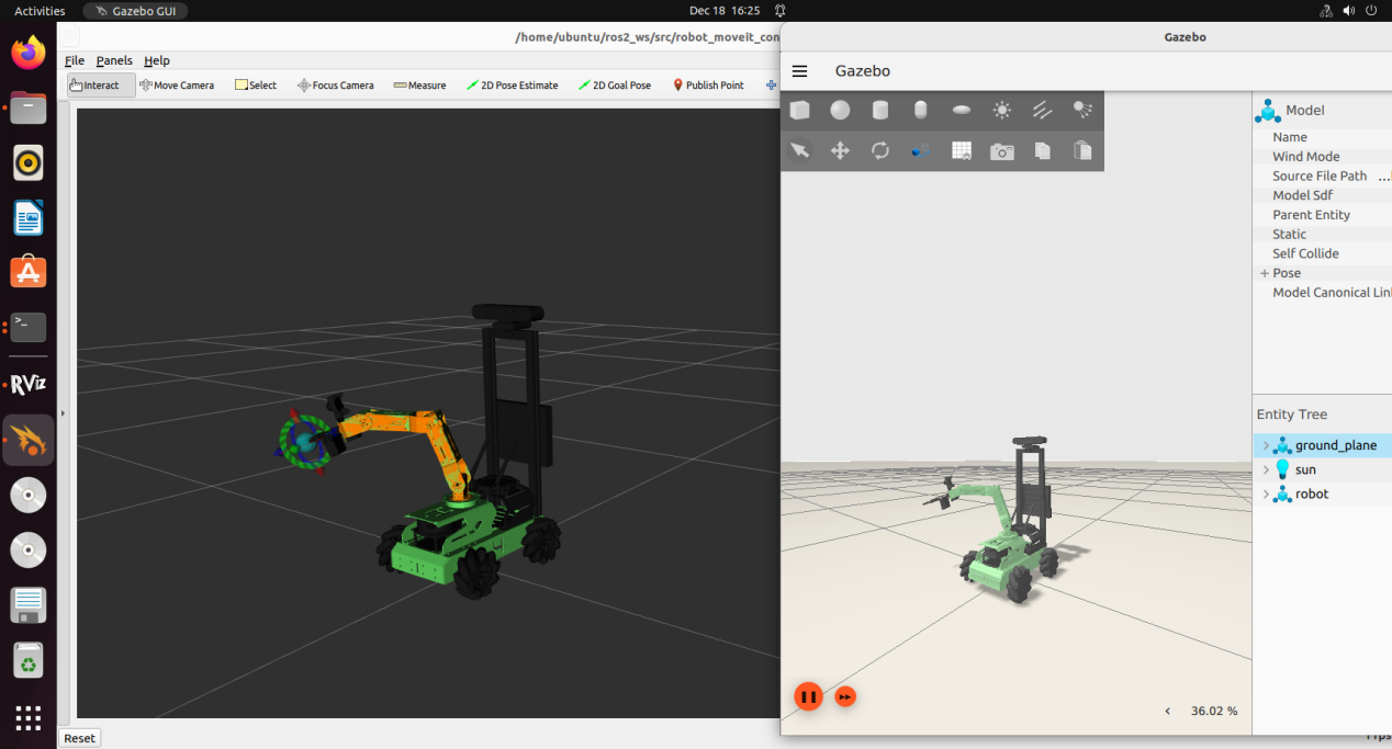

In this section, MoveIt2 will be used to plan the path and control the simulation model and robotic arm to move along the path to the specified position.
  • Start MoveIt2 Tool

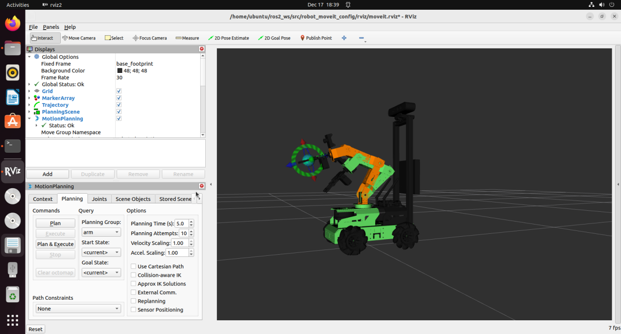

(1) Start a new command-line terminal, and run the following command to launch the MoveIt2 tool.
ros2 launch robot_moveit_config demo.launch.py

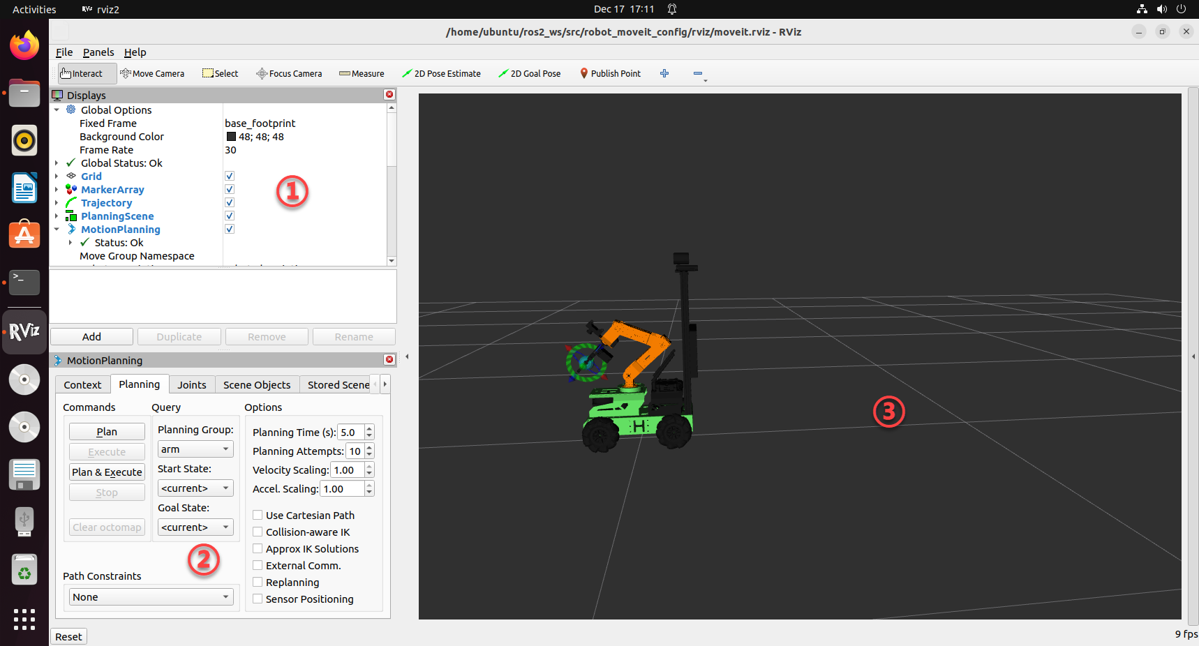

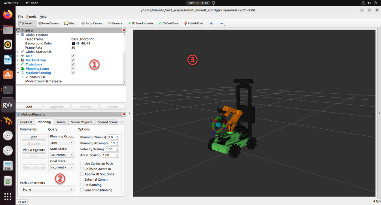

Program Interface Overview
The program interface is shown in the image below:
Position 1: RViz Toolbar
Position 2: MoveIt Debugging Area
Position 3: Simulation Model Adjustment Area

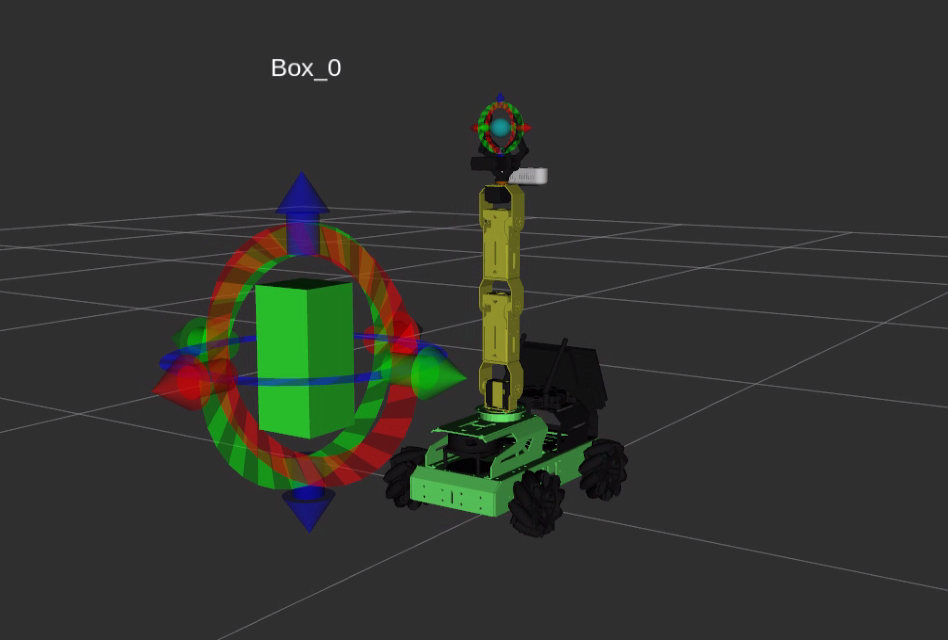

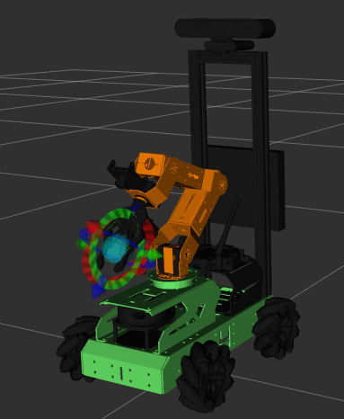

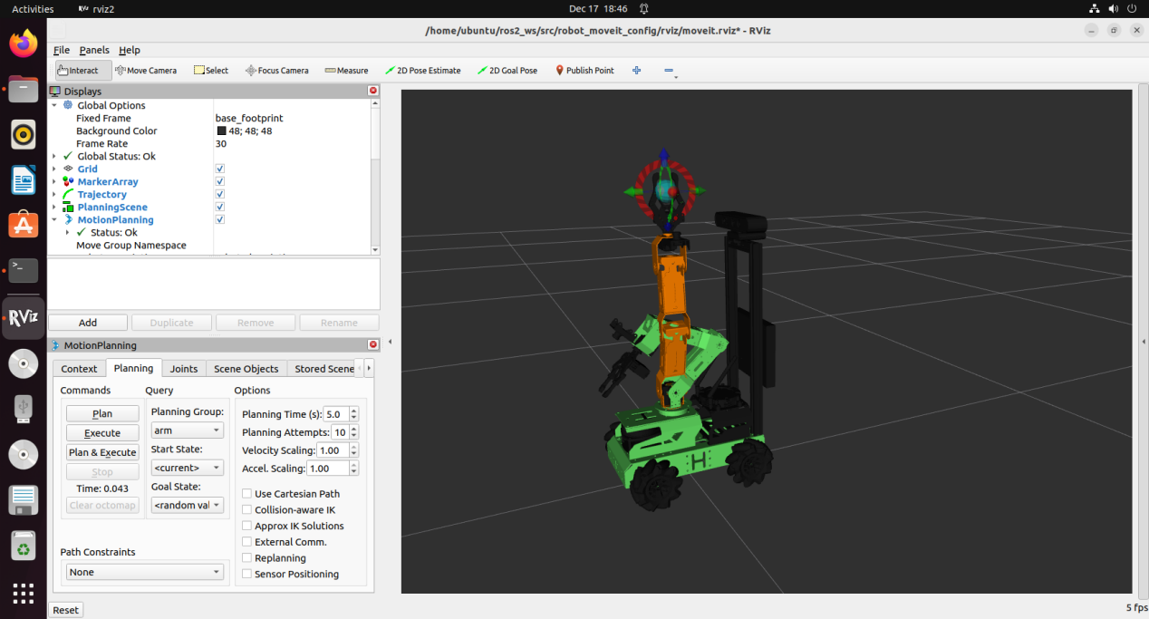

  • Control Instructions

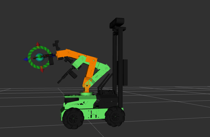

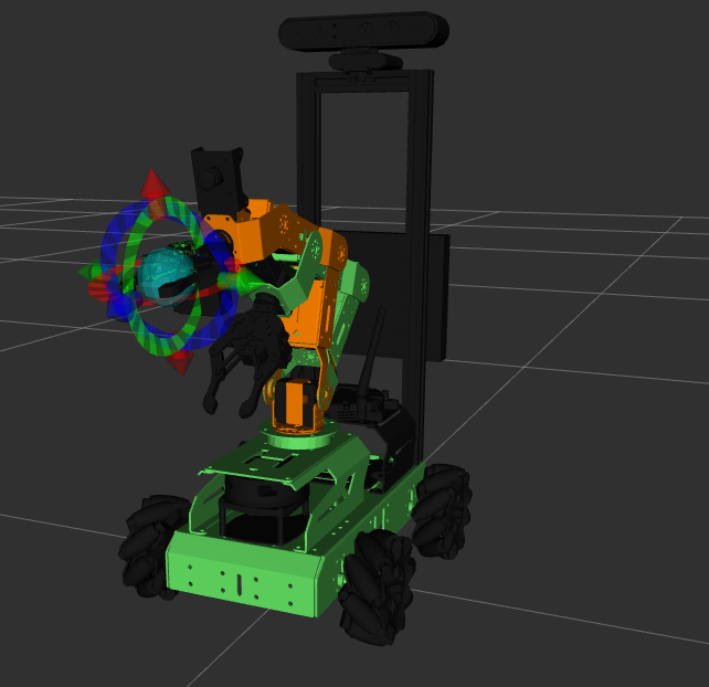

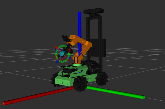

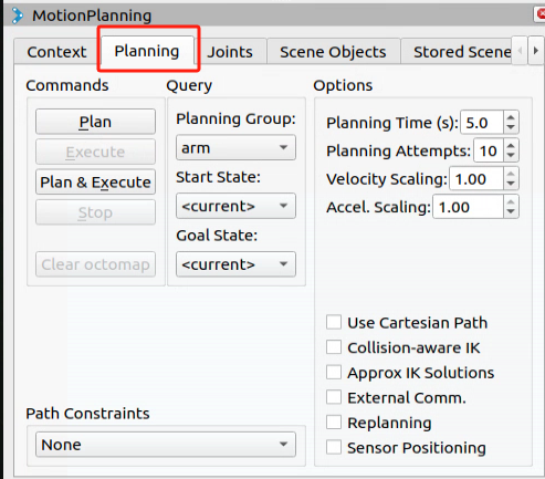

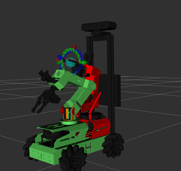

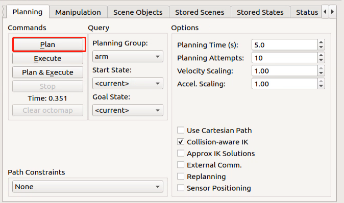

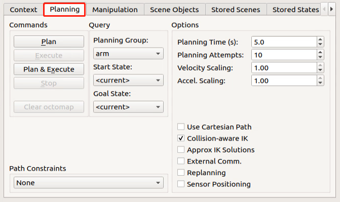

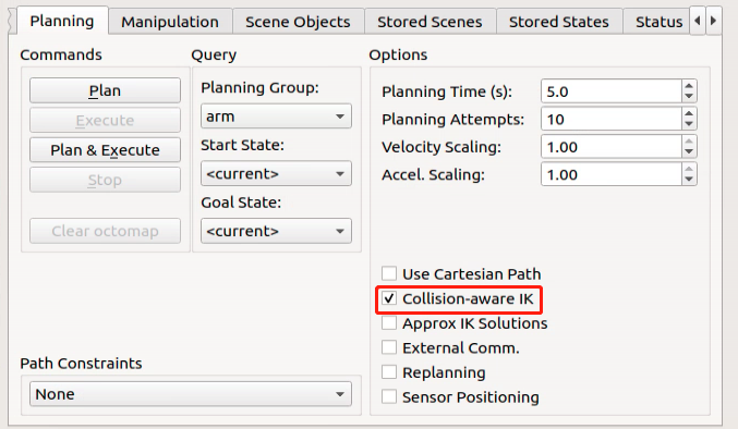

(1) In the MoveIt2 Debugging Area, find and click the Planning section.

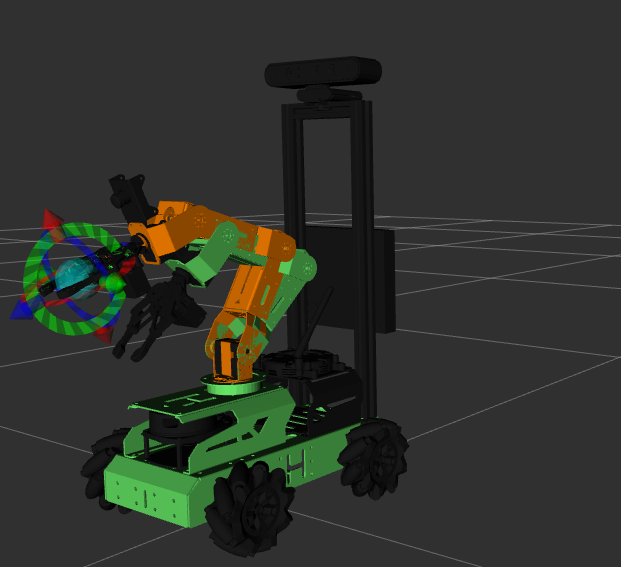

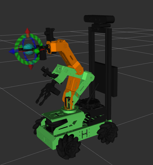

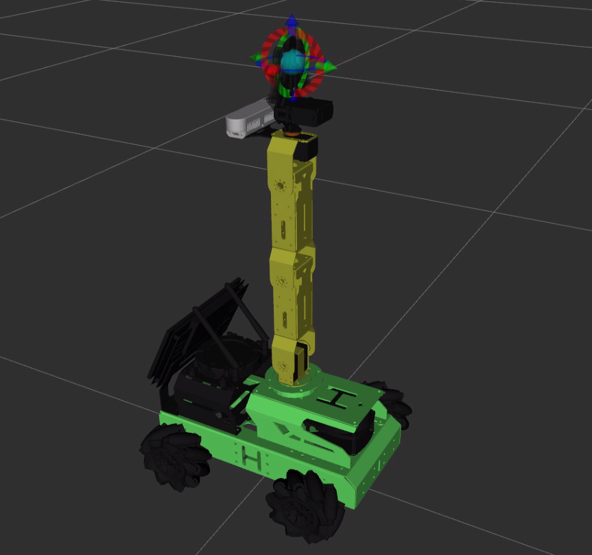

(2) In the Simulation Model Adjustment Area, you will see arrows in red, green, and blue colors. Click and drag the arrows to adjust the robotic arm’s pose. In the robot’s first-person view:
Green represents the X-axis, with the positive direction pointing to the robot’s left.
Red represents the Y-axis, with the positive direction pointing to the robot’s front.
Blue represents the Z-axis, with the positive direction pointing upwards from the robot.

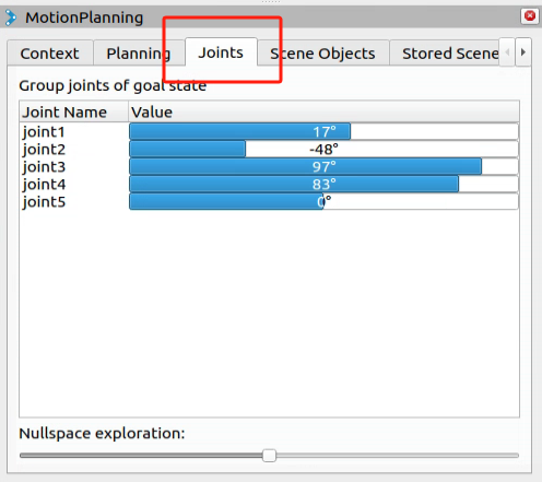

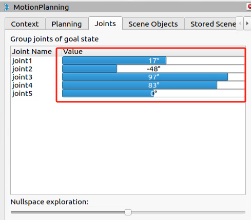

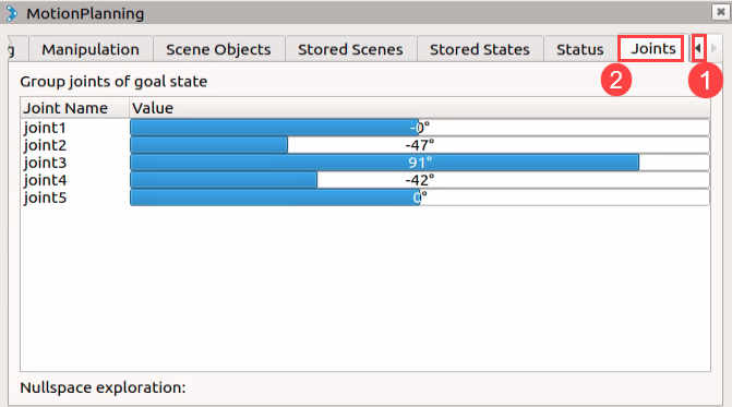

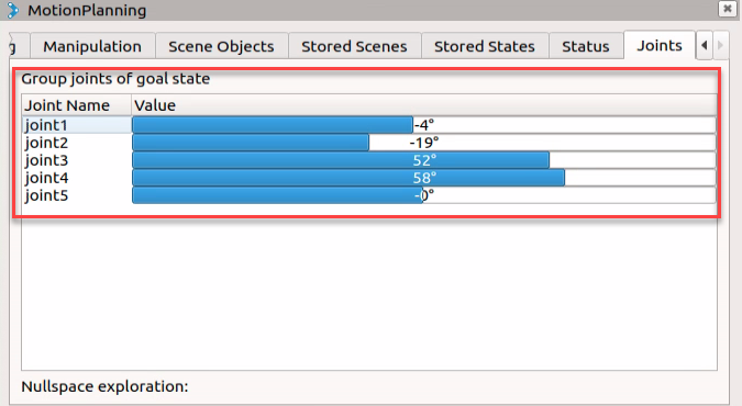

(3) Besides adjusting the pose using the arrows, you can also adjust individual joints directly. Click the triangle icon on the right and find the Joints panel.
(4) Drag the sliders for the corresponding joints to adjust their angles individually.

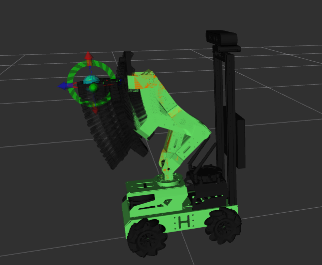

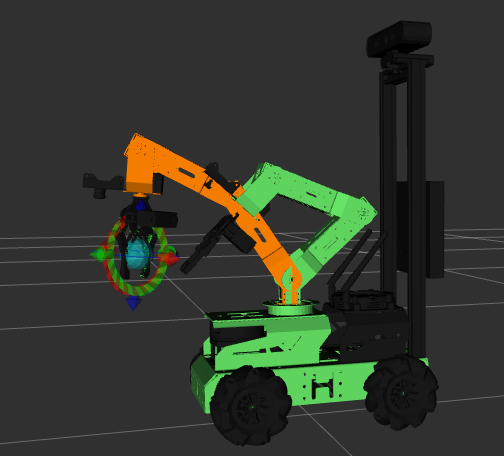

(5) After successfully planning the robotic arm’s motion path, the new position will be highlighted in orange. If the new position causes a collision with other parts of the robot, it will be marked in red. You must adjust the configuration to avoid collisions; otherwise, the motion cannot be executed.
Orange (Executable State) is shown in the following image.
For example, if the robotic arm is planned to be in the position shown in the image, it will collide with the depth camera, turning the state red (Non-executable).

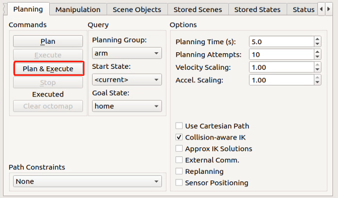

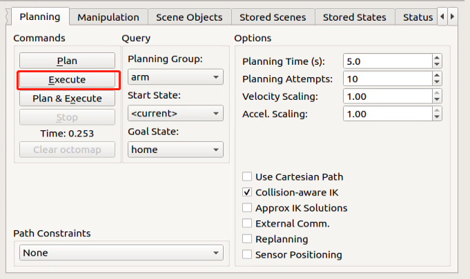

(6) After planning the path, return to the “Planning” section and click the “Plan” option. The simulation model will display the motion path from the original position to the newly planned position.
(7) Then, click the “Execute” option to make both the simulation model and robotic arm follow the planned motion path.
(8) Alternatively, you can click “Plan & Execute”, where the robotic arm will first display the new planned motion path and then execute the movement.
(9) To close this mode, press “Ctrl+C” in the terminal. If the process fails to stop, try again.

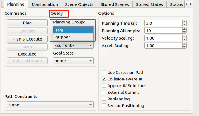

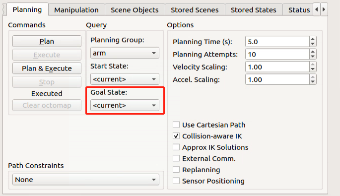

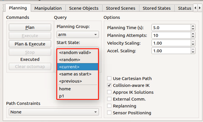

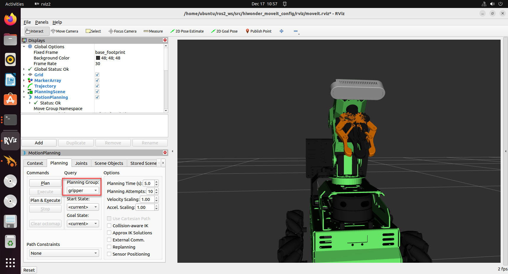

(3) In the “Query” category, click the dropdown menu under “Planning Group” and select the joint group (servo group) you wish to control. For example, the default selection is the “arm” group.
(4) Click the dropdown menu under “Goal State” and choose the desired target position.
(5) The parameter list in the dropdown menu is as follows:
random valid”: A valid random position where no collisions will occur.
random”: A random position that may potentially result in a collision.
current”: The current position.
same as start”: The same as the starting position.
previous”: The previous target position.
home” and “p1” are the default positions set by the program.

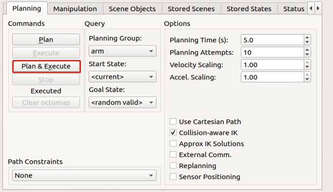

(6) To avoid the possibility of collisions, select “random valid” to randomly generate a valid target position. Each time you click this option, a new target position will be randomly generated and displayed in the simulation model.
(6) Click “Plan & Execute”, and both the simulation model and robotic arm will perform the motion simultaneously. The simulation model will show the newly planned movement path, and the robotic arm will execute the motion.

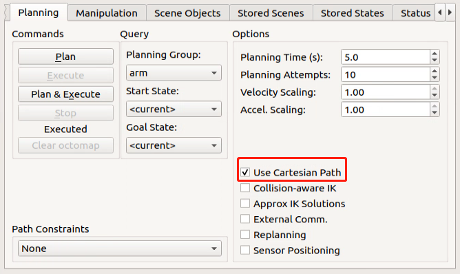

(3) Cartesian Path Planning Steps
① Set Up the Motion Group: First, specify the motion group in MoveIt2. A motion group is a set of robot joints used to define the robot’s degrees of freedom and controllable parts. By defining the motion group, you can limit the degrees of freedom in the planning process, allowing for better control over the robot’s movement.
② Set Path Constraints (Optional): If you need to constrain the robot’s motion path, such as keeping a specific joint’s orientation fixed, you can set path constraints. These constraints ensure that certain conditions are met during the planning process.

  • Launch MoveIt2 Tool
(1) Open a new command-line terminal, and run the following command to launch the MoveIt2 tool.
The program interface is shown in the figure below:
Position 1: RVIZ Toolbar
Position 2: MoveIt2 Debug Area
(2) Locate the ‘Planning’ section, and tick ‘Use Cartesian Path’ to enable Cartesian path planning.
(3) Next, use the mouse to drag the arrows in the “Simulation Model Adjustment Area” to plan the robot arm’s path. From the robot’s perspective, the green arrow represents the X-axis, with the positive direction to the robot’s left; the red arrow represents the Y-axis, with the positive direction to the robot’s front; and the blue arrow represents the Z-axis, with the positive direction upwards from the robot.
(4) Once the planning is complete, click “Plan & Execute.” The simulation model will execute the action and attempt to linearly move the end effector in Cartesian space. If the action cannot be performed within the Cartesian path constraints, it will display a failure message.
(5) To exit this mode, press “Ctrl+C” in the terminal. If it fails to close, please try again.

(1) Open a new terminal. Execute the following command to initiate the MoveIt2 tool.
Position 2: MoveIt Debug Area
(2) In the Simulation Model Adjustment Area, there are arrows in three colors: green, red, and blue. Click and drag the arrows to adjust the robot arm’s posture. From the robot’s perspective, the green arrow represents the X-axis (positive direction is to the left of the robot), the red arrow represents the Y-axis (positive direction is in front of the robot), and the blue arrow represents the Z-axis (positive direction is above the robot).
After planning the path, the new position will be highlighted in orange, as shown in the image below:

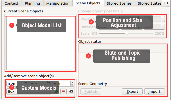

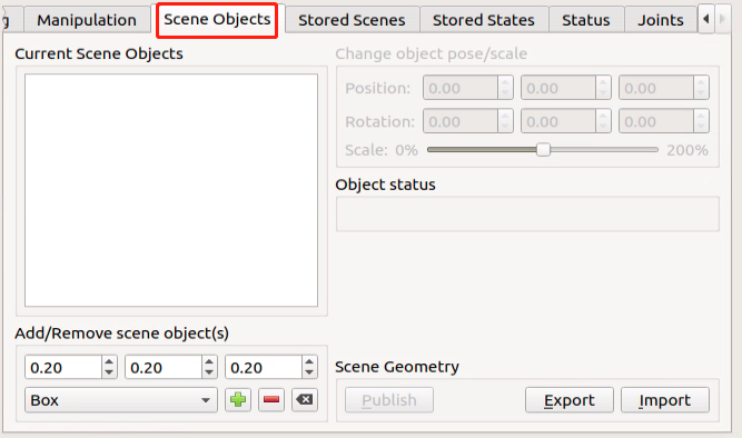

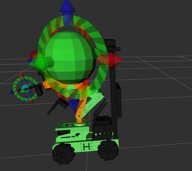

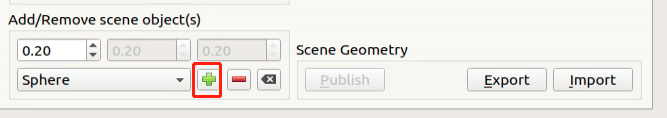

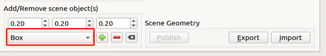

(3) Once the robot arm’s path is planned, click the “Scene Objects” section to add a collision model.
(4) The section is divided into 4 areas, as described below:

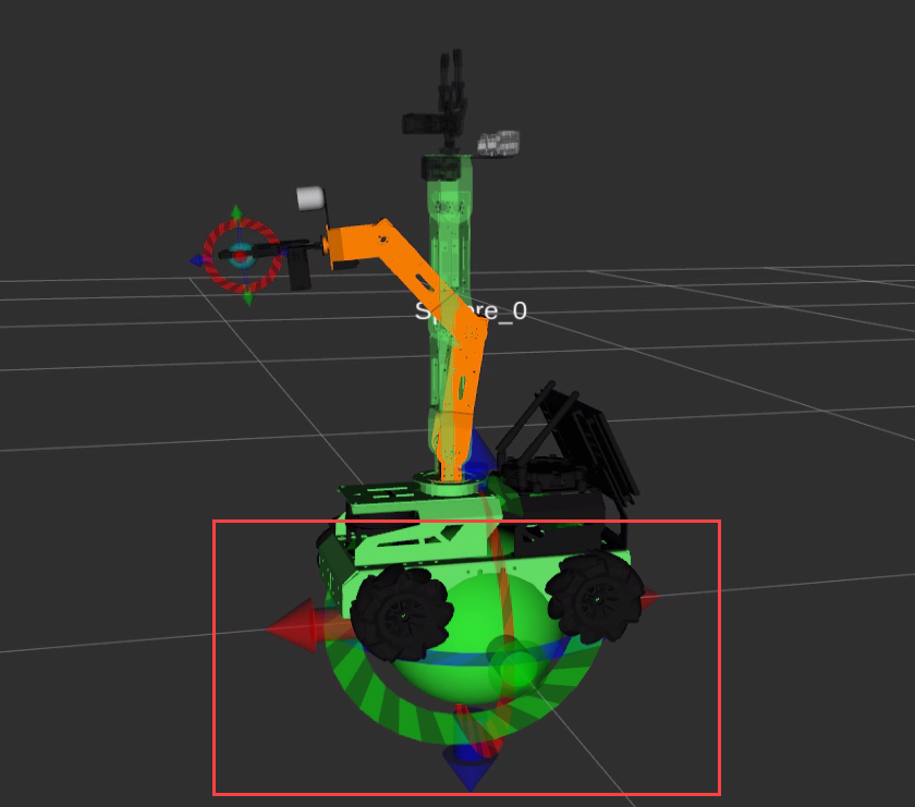

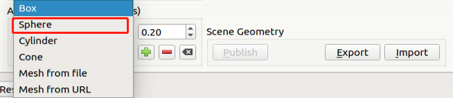

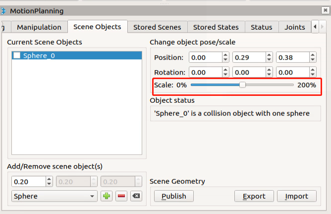

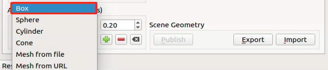

(5) Click the “Box” dropdown menu and select a collision model. Here, we will use the “Sphere” model as an example.
(6) Click the plus icon to add the currently selected collision model.
The model will be placed at the robot’s base by default, as shown in the image below:
(7) Use the slider to adjust the size of the collision model. It is recommended to shrink it to about 50% of the original size.
(8) Drag the 3D arrows on the sphere to move the collision model between the start and target positions to test the collision detection effect.

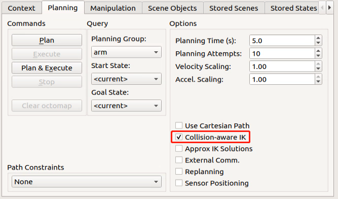

(9) Click the “Planning” section and check the “Collision-aware IK” option to enable the collision detection for the model.
(10) Next, click “Plan & Execute” to begin moving along the planned path. When the following prompt appears, select “Yes”.
(11) After confirming, the robot arm will plan the movement path, avoiding any obstacles along the way to prevent collisions.
(12) If you wish to exit this mode, press “Ctrl+C” in the terminal. If it doesn’t close successfully, please try again.
(1) Open a new terminal window and enter the following command to launch the MoveIt2 tool.
The program interface will appear as shown in the image below:
After planning the path, the new position will be highlighted in orange, as shown in the image below.

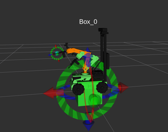

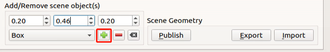

(2) In the debugging area, locate the “Scene Objects” section to add scene object models.
(3) This section is divided into 4 areas, as shown below.

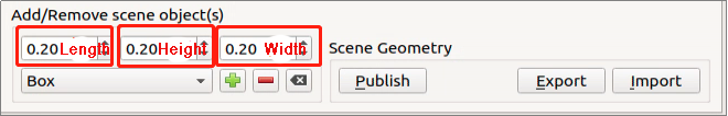

(4) In the “Custom Models” section, select the required basic model. Here, we use the cube model as an example.
(5) Above the model selection, adjust the initial size of the object model in meters, as shown below.
(6) After adjusting, click the “+” button to add the currently configured object model to the scene.
(7) Once added, the model list will be updated with the newly added model, which will appear at the center of the scene (i.e., the robot’s center).
(8) In the simulation model adjustment area, there are arrows in red, green, and blue colors. Click and drag these arrows to adjust the robot’s pose. In the robot’s first-person view:
Green Arrow: X-axis direction, positive direction is to the left of the robot.
Red Arrow: Y-axis direction, positive direction is in front of the robot.
Blue Arrow: Z-axis direction, positive direction is above the robot.

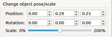

(9) In addition to using arrow dragging, you can also make adjustments in the “Position and Size” adjustment area.
Position: Adjust the object’s position on the X, Y, and Z axes.
Rotation: Adjust the object’s angle along the X, Y, and Z axes.
Scale: Adjust the object’s size by dragging the slider.

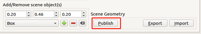

(10) After making adjustments, click “Publish” to send the model’s topic message. MoveIt2 will automatically subscribe to this message.
(11) To prevent object models from colliding, go to the “Planning” section and check the “Collision-aware IK” box to enable collision detection for the model.
(12) If you wish to close this feature, press “Ctrl+C” in the terminal. If the closing fails, please try again.

This section integrates the OMPL and CHOMP planners. By default, the OMPL planner is used. Below, we will demonstrate how to switch to and use the CHOMP planner.
(1) Start the Virtual Machine: Click the system desktop icon to open the command-line terminal.
(2) Launch MoveIt2 Tool: Enter the following command to launch the MoveIt2 tool:
The program interface is displayed as shown below:
  • Position 1: RVIZ Toolbar
  • Position 2: MoveIt2 Debugging Area
  • Position 3: Simulation Model Adjustment Area
(3) Adjust Robot Pose: In the simulation model adjustment area, there are red, green, and blue arrows. Click and drag the arrows to adjust the robotic arm’s pose. The robot is viewed from its first-person perspective, with:
  • Green: X-axis (positive direction is to the left of the robot)
  • Red: Y-axis (positive direction is in front of the robot)
  • Blue: Z-axis (positive direction is above the robot)
(4) Adjust Individual Joints: In addition to adjusting the pose with the arrows, you can directly adjust the individual joints. Click the triangle icon on the right side, then find and click the “Joints” panel.
(5) Fine-tune Joint Angles: Drag the corresponding sliders to adjust the angles of the individual joints.

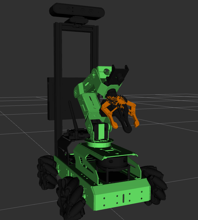

(6) Path Planning and Collision Detection: After successfully planning the robotic arm’s movement path, the new position will be indicated in orange. If there is a collision with other parts of the robot, the position will be marked in red. In this case, you need to adjust the pose to avoid collisions, or the action cannot be executed.
Orange indicates an executable position, as shown below:

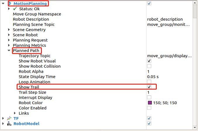

(7) Visualize the Motion Path: In the RVIZ toolbar, click “Motion Planning” and “Planned Path,” then check the “Show Trail” option. This will display the visual trail of each frame of the robotic arm’s movement.
(8) Demonstrate the Movement Path: Return to the “Planning” section, and click the “Plan” button. The simulation model will demonstrate the path from the original position to the newly planned position.
(9) Execute the Planned Path: After observing the demonstration, uncheck the “Show Trail” option. Then, click the “Execute” button. The simulation model and the robot will simultaneously execute the planned motion.
(10) To close this mode, press “Ctrl+C” in the terminal. If the shutdown fails, try again.

Network Requirements: The virtual machine and the robot must be on the same network segment and able to communicate with each other in order to control the robot. Otherwise, only simulation is possible, and the robot will not execute the planned movements.

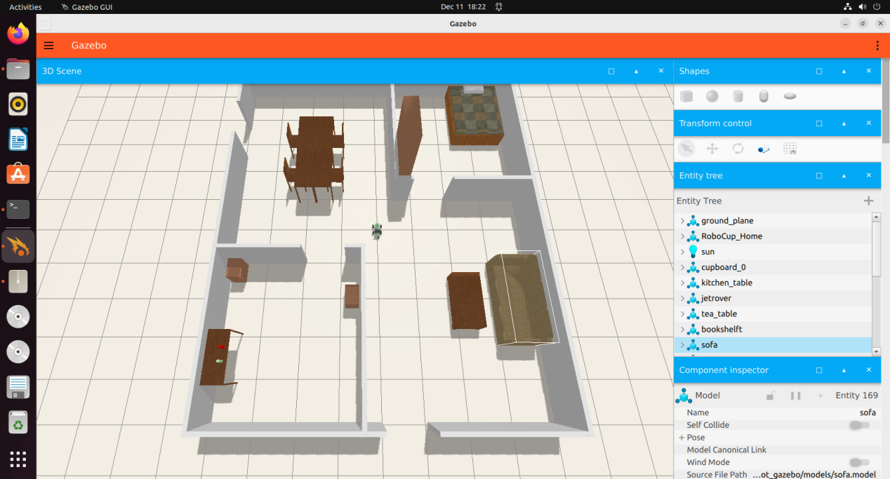

10.4.1 Introduction to Gazebo
To simulate a realistic virtual physical environment where robots can perform tasks more effectively, we use a simulation software: Gazebo.
Gazebo is standalone software and is the most commonly used simulation tool in the ROS ecosystem. It provides:
  • High-fidelity physical simulation conditions.
  • A comprehensive set of sensor models.
  • A user-friendly interactive interface.
These features enable robots to function effectively even in complex environments.
Gazebo supports URDF and SDF file formats for describing simulation environments. The robot models use the URDF format. Additionally, Gazebo provides many pre-built model modules that can be used directly.

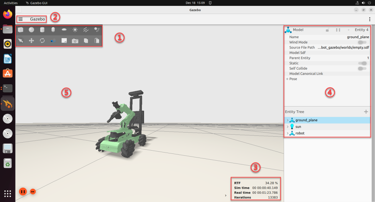

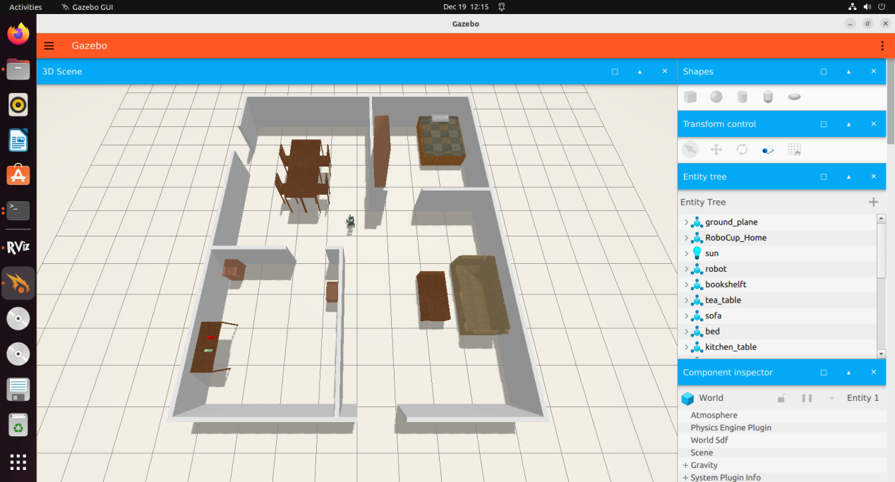

Gazebo GUI Introduction
The simulation software interface is as below:
The specific functions of each position are detailed in the table below:
Name Function
Tool bar (1) Provides commonly used options for interacting with the simulator.
Menu bar (2) Configures or modifies simulation parameters and offers interaction features.
Action Bar(3) Allows manipulation of models and adjustment of parameters.
Timestamp (4) Controls the time in the virtual environment.
Scene (5) The main part of the simulator where the simulation models are displayed.
For more information about Gazebo, please visit the official website: http://gazebosim.org/.

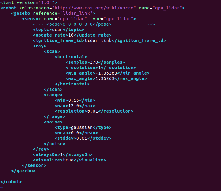

  • LiDAR Simulation
When entering commands, ensure correct capitalization and use the “Tab” key to auto-complete keywords where possible.
(1) Start the VMware virtual machine.
(2) Click the terminal icon on the desktop to open the command-line interface.
(3) Enter the following command and press Enter key to move to the relevant directory:
cd /home/ubuntu/ros2_ws/src/robot_gazebo/urdf
(4) Use the following command to open the LiDAR simulation file for editing:
vim lidar.gazebo.xacro
This file contains details about the LiDAR simulation model, including its name, detection range, position, noise reduction settings, and topic messages.
To better understand this file, refer to the “Introduction to URDF Models” section for learning the relevant syntax.

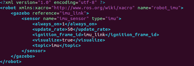

  • IMU Simulation
Please ensure that you enter the commands with correct capitalization. You can use the “Tab” key to autocomplete keywords.
(1) Start the virtual machine. Click-on the icon to initiate the command-line terminal.
(2) Run the following command and hit Enter key to navigate to navigate to the program directory:
(3) Enter the following command to open the IMU simulation model file:
vim imu.gazebo.xacro
This file defines properties of the IMU simulation model, such as name, offset settings, noise reduction settings, acceleration settings, topic messages, and more. To understand this file, please refer to the “Introduction to URDF Models” for relevant syntax.

(1) Start the virtual machine. Click-on the icon to launch the command-line terminal.
Wait for each service to fully start before launching the next one to avoid simulation failure.

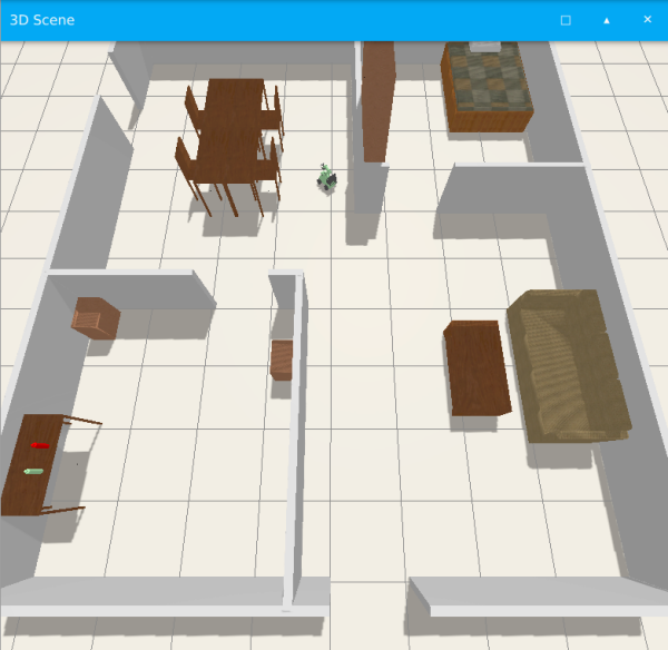

(2) Enter the following command to start the Gazebo simulation:
ros2 launch robot_gazebo room_worlds.launch.py
(3) Enter the following command in the new terminal to launch the mapping service:
ros2 launch robot_gazebo slam.launch.py

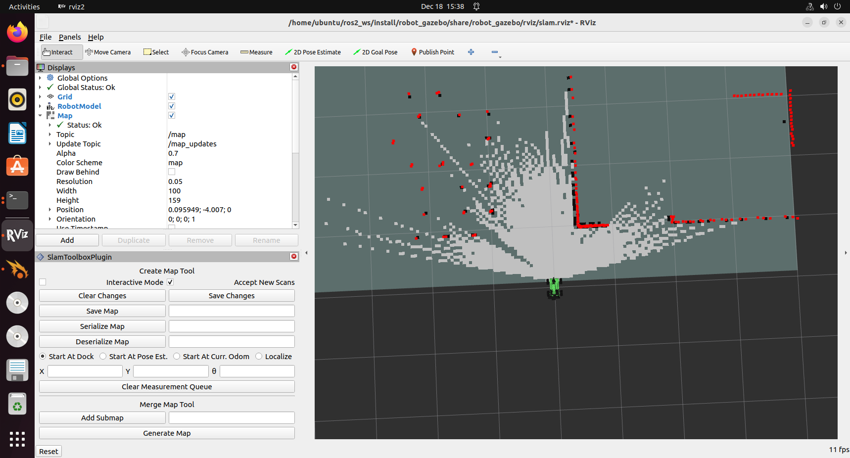

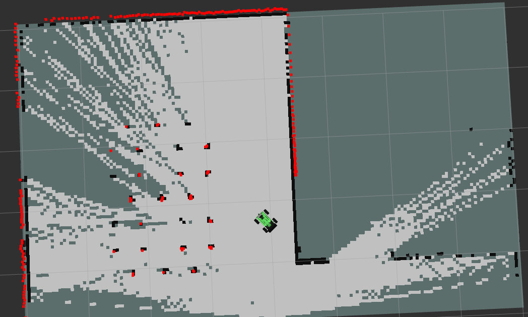

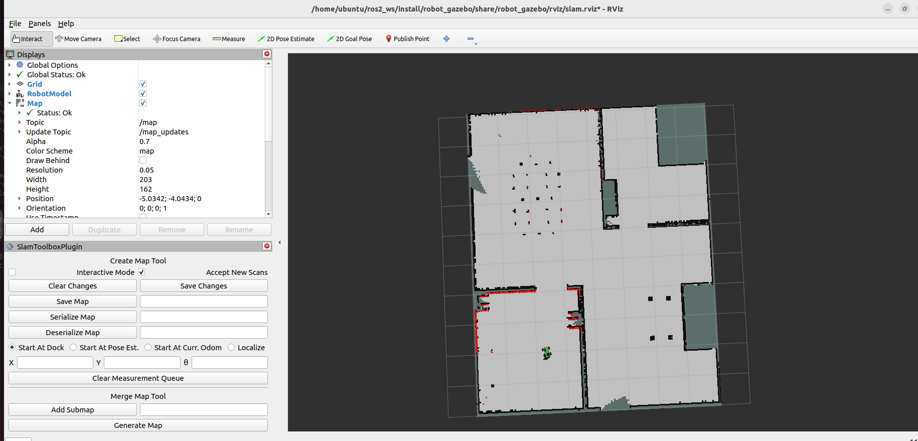

(2) The mapping process will be displayed synchronously in the RVIZ tool, as shown in the image below.
Continue the scanning until the map reaches a state similar to the one shown below.

(2) Enter the following command to start the simulation map:
ros2 launch robot_gazebo room_worlds.launch.py nav:=true

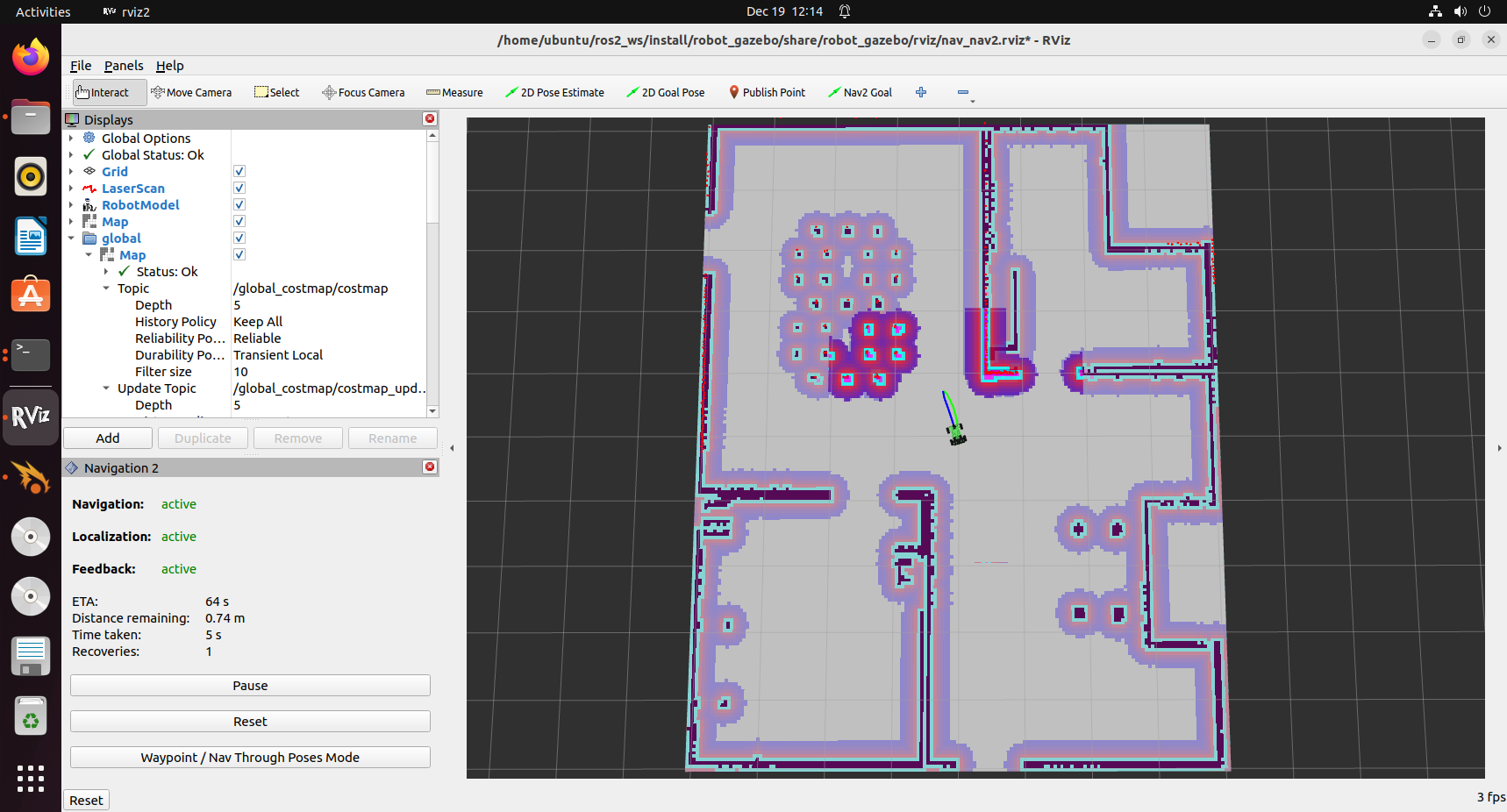

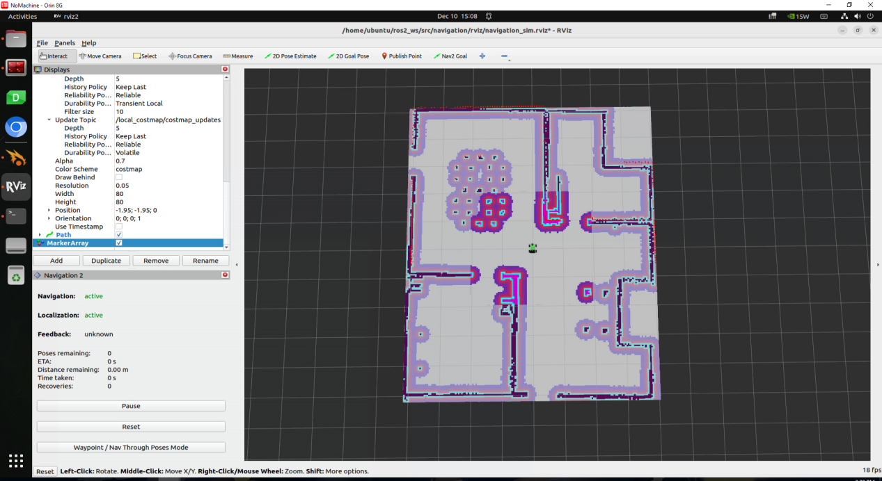

  • Start Navigation
The software menu bar includes three tools: 2D Pose Estimate, 2D Nav Goal, and Publish Point.
2D Pose Estimate is used to set the robot’s initial position.
2D Nav Goal is used to set a single target point for the robot.
Publish Point is used to set multiple target points for the robot.
(1) Click on the 2D Nav Goal tool in the software menu bar. Then, click on the map to select a target point. If you press and hold the mouse button while dragging, you can also adjust the robot’s orientation after reaching the target point. Once selected, the robot will automatically generate a route and move to the target point.
(2) After confirming the target point, the map will display the robot’s planned path, and the robot’s simulation model will move to the corresponding location.

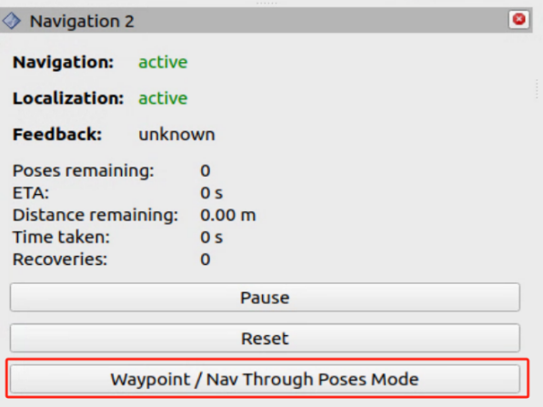

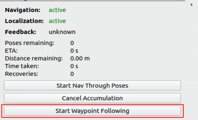

(3) To use the multi-point navigation feature, first click the button shown in the lower-left corner, as illustrated in the image.
(4) Click the icon , then left-click and drag on the map at a specific point to set the direction and define a target point. To set multiple target points, repeat the above steps.
(5) Click the button shown in the lower-left corner to start navigation.

(2) Execute the following command to initiate the integration of the Gazebo and MoveIt2.
ros2 launch robot_gazebo worlds.launch.py moveit_unite:=true
(3) Enter the following command to start the MoveIt2.
ros2 launch robot_moveit_config demo.launch.py use_sim_time:=true use_gazebo:=true

Robot Arm Control
The MoveIt2 interface is shown below:
Position 1: RVIZ toolbar

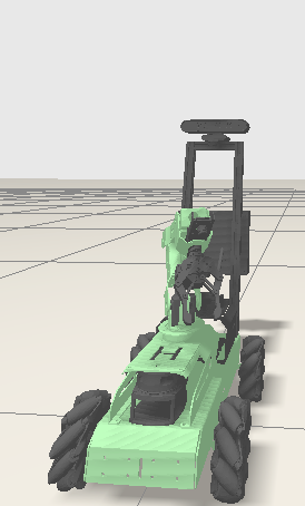

(1) In the MoveIt2 Debugging Area, find and click on the “Planning” section.
(2) In the Simulation Model Adjustment Area, there are three colored arrows: red, green, and blue. Click and drag the arrows to adjust the robotic arm’s orientation. From the robot’s perspective:
Green represents the X-axis (positive direction is to the left of the robot).
Red represents the Y-axis (positive direction is in front of the robot).
Blue represents the Z-axis (positive direction is above the robot).
(3) After successfully planning the arm’s motion path, the new position will be highlighted in orange. If the new position causes a collision with other parts of the robot, it will be marked in red. In this case, you need to adjust the position to avoid the collision; otherwise, the action cannot be executed.
Orange indicates an executable state, as shown below:
For example, if the robotic arm is positioned as shown in the image, it will collide with the depth camera, turning red (non-executable state) as shown below:
(4) Once the path is planned, return to the “Planning” section and click “Plan”. The simulation model will demonstrate the movement path from the original position to the newly planned position.
(5) Next, click “Execute” to make both the simulation model and the robotic arm follow the planned path.
(6) Alternatively, click “Plan & Execute”, and the robotic arm will first display the newly planned movement path, then execute the motion.
(7) You can also observe that the path planned in MoveIt2 is synchronized with the Gazebo interface.
  • Gripper Control

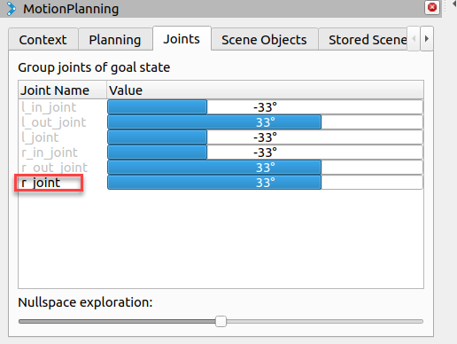

(1) To control the gripper movement, select “gripper” in the “Planning Group”.
(2) Drag the r joint to control the gripper’s rotation.
(3) Once the motion trajectory is planned, return to “Planning” and click “Plan & Execute” to execute the movement.
