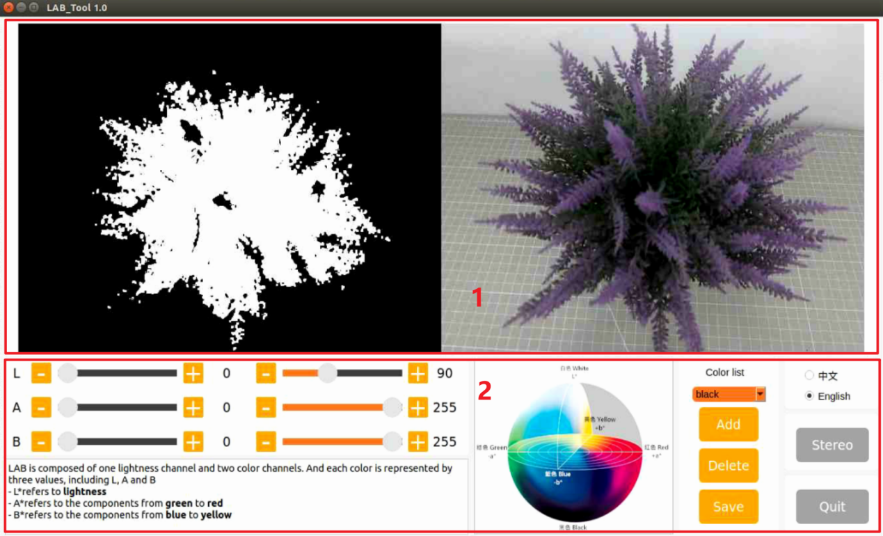

6.1.2 LAB TOOL Interface Layout Instruction
(1) Image display area: the left displays the processed image and the right is the raw image.
If the transmitted image does not display normally, it’s the issue of camera connection. In this case, you need to examine if the wiring is connected properly or reconnect it.

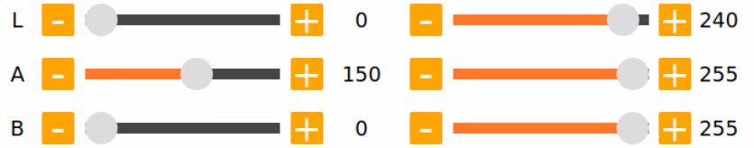

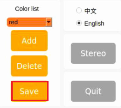

(2) Recognition adjustment area: adjust the color threshold. The function of each button refer to the following table:
Icon Function instruction

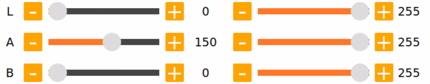

The sliders L, A and B are used respectively to adjust the values of the corresponding L, A and B components of the image.
The sliders on the left are the "min" value for each component while the slider on the right are the "max" value for each component.
Add recognizable color.
Close LAB TOOL.

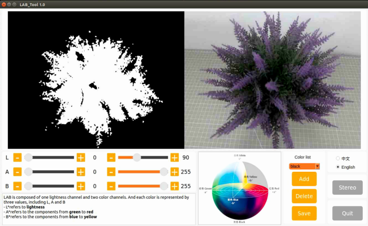

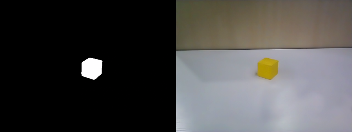

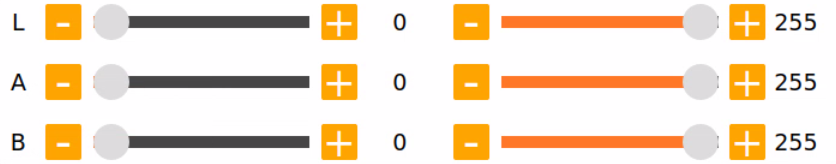

6.1.3 Adjust Color Threshold

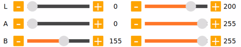

(1) Open LAB tool. Choose the color in the color drop-down list of color recognition area. Take a color “red” as example.
(2) Adjust the “min” values of L, A and B components to “0”, the “max” values to “225”.
(3) Place the target within the camera’s field of view. Adjust the values of L, A and B component towards the interval representing the target recognition color according to the LAB color space distribution chart.
(4) Adjust the L and B components according to your surroundings. If the red color is light, increase the “min” value of the L component; if it is dark, decrease the “max” value of the component. If the red color tends to be warm, increase the “min” value of the B component; if it tends to be cool, decrease the “max” value of the B component.
L 0~255 Black-white (-L~+L)
A 0~255 green-red(-a ~ +a)
B 0~255 Blue-yellow(-b ~ +b)

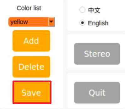

(5) Click “Save” button in adjustment area to save the adjustment parameters.

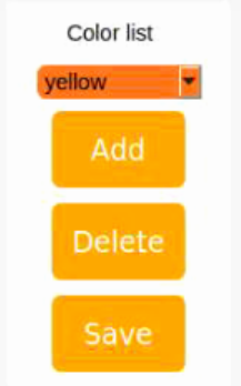

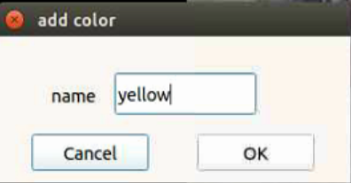

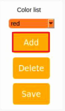

6.1.4 Add New Color
(1) Open LAB tool and click on “Add” button.
(2) Fill in the “name” column with the color name, and click the “OK” button.
(3) Choose the added color in the color drop-down menu.
(4) Place the target within the camera’s field of view, and adjust the threshold by dragging the L, A, and B component sliders until the area of the colored object within the left screen turns white, while the other areas turn black.
the adjustment method of color threshold refers to “6.1.3 Adjust Color Adjustment”.
(5) Click “Save” button in recognition adjustment area to save the adjustment parameters of color threshold.
After adjusting the color thresholds, press ‘Ctrl+C’ to stop the camera service, then click ‘Close Software’ to close the interface.

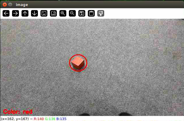

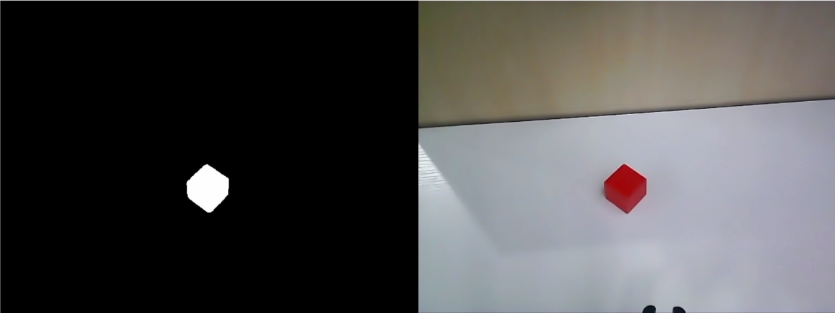

6.2.3 Program Outcome
After the game starts, please ensure that there are no other objects containing recognized colors within the field of view of the camera to avoid affecting the implementation effect.
After the game starts, place the target object within the field of view of the camera. When recognizing the target object, it will be circled up in the same color and the color name will be printed in the lower-left corner of the screen. The program supports red, blue and green object recognition.

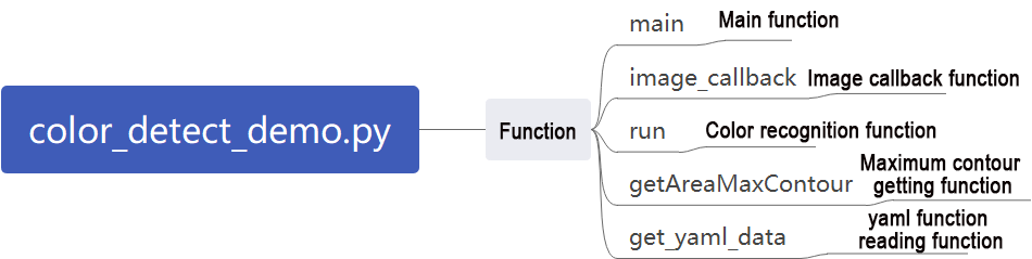

6.2.4 Program Analysis
The source code of the program is located in : /home/ubuntu/ros2_ws/src/example/example/color_detect/color_detect_demo.py
  • Main Function
Initialize the ROS node, create a color recognition node named color_detect_node, subscribe to the image topic /depth_cam/rgb/image_raw, and set its callback function to image_callback. Start the main function for color recognition using multiple threads. Wait for the node to shut down.

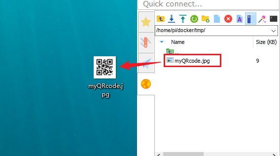

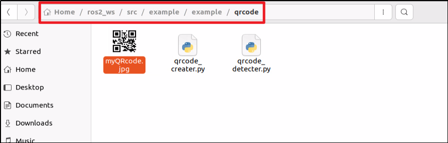

(4) Input the command to access the program directory and start the QR code creation program.

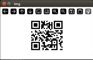

cd ~/ros2_ws/src/example/example/qrcode && python3 qrcode_creater.py
After start the program, it’s necessary to enter characters in the terminal to generate the QR code. Take the input of “ubuntu” as example.
Press “Enter” to display a QR code image containing the input data.
(5) Next, press the ESC key or q key to exit the QR code interface.
(6) When you return to the command-line terminal and see the prompt shown in the image below, it means the QR code has been successfully saved.
(7) Next, click on to open the file manager. Navigate to the directory highlighted in red in the image below, where you will find the generated QR code exported to the host system.
(8) You can then drag the image to your PC desktop using the NoMachine tool, and print it or transfer it to your phone’s photo gallery.

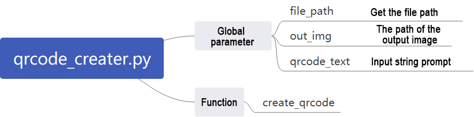

The source code of this program is located at: /home/ubuntu/ros2_ws/src/example/example/qrcode/qrcode_creater.py
(1) Creating QR Code Utility Object
Using the qrcode module to create the necessary object and setting various parameters for the QR code.
    qr = qrcode.QRCode(
        version=1,
        box_size=5,
        border=4)
    # Add data(添加数据)
    qr.add_data(data)
The parameters of the above function are as follows:
The first parameter version is an integer ranging from 1 to 40, used to control the size of the QR code. If you want the program to automatically determine the size, set this value to None and use the “fit” parameter.
The second parameter error_correction controls the error correction capability of the QR code, with the following options:
① ERROR_CORRECT_L: can correct approximately 7% or fewer errors.
② ERROR_CORRECT_M: default value, can correct approximately 15% or fewer errors.
③ ERROR_CORRECT_H: can correct approximately 30% or fewer errors.
The third parameter box_size controls the number of pixels contained in each small box of the QR code.
The fourth parameter border controls the number of boxes included in the border (distance between the QR code and the image boundary), with a default value of 4, which is the minimum value specified by relevant standards.
(2) Generating QR Code
Using the add_data and make functions to retrieve and fill data, and then using the make_image function to generate the image.
# Add data(添加数据)
    qr.add_data(data)
    # Fill data(填充数据)
    qr.make(fit=True)
    # Generate image(生成图片)
The first parameter fill_color=(0, 0, 0) is the fill color of the image, which is black in this case.
The second parameter back_color=(255, 255, 255) is the background color of the image, which is white in this case.
(3) Displaying Image
Converting the color space of the image using the cvtColor function, and then displaying it on the window using the imshow function.
        cv2.imshow('img', opencv_img)
        k = cv2.waitKey(1)
        if k != -1:
(4) Saving Image
Using the imwrite function to store the generated QR code image and printing relevant information.
The first parameter file_name is the storage path of the image.
The second parameter opencv_img is the image to be stored.

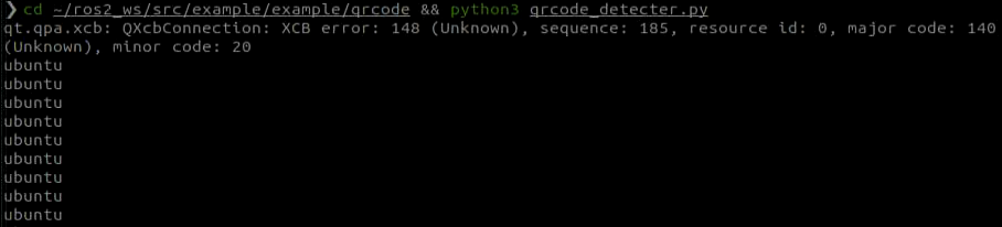

(5) Open a new ROS2 command line terminal, enter the command to switch to the program directory, and start the QR code recognition program:
cd ~/ros2_ws/src/example/example/qrcode && python3 qrcode_detecter.py
To close this game, press “Ctrl+C” in the terminal interface. If closing fails, please try again repeatedly.

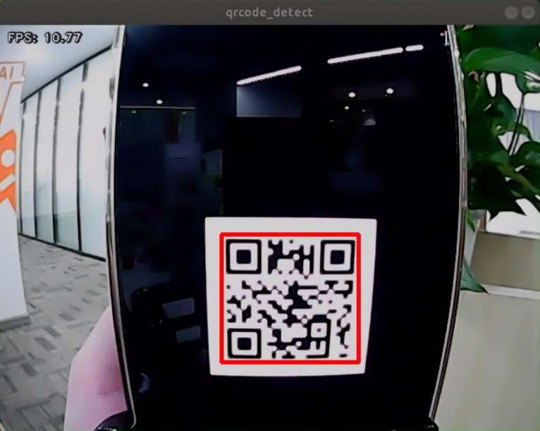

  • Program Outcome
After starting the game, it will recognize the QR code images appearing in the feedback screen, mark them with a red box, and print out the content of the QR code.

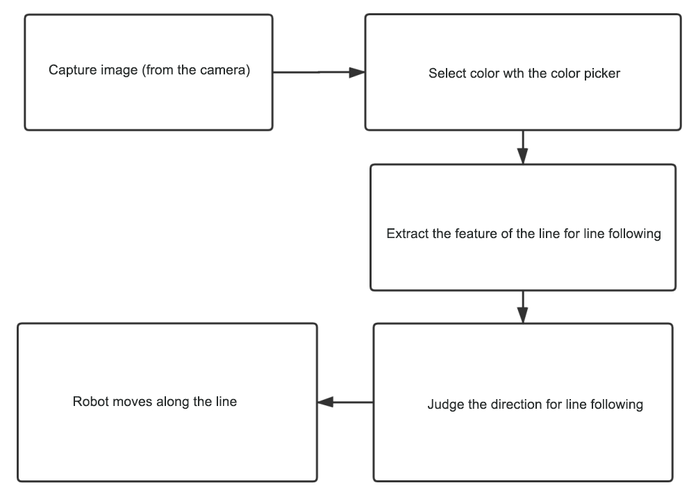

First, obtain the RGB image from the camera and resize it. Apply Gaussian blur to the image and convert the color space from RGB to Lab.
Then, perform color recognition on the objects in the circle using color thresholding. Apply masking to parts of the image. (Masking is used to globally or locally mask the processed image using selected images, graphics, or objects).
Afterward, perform opening and closing operations on the object images. Finally, outline the largest object with a circle.
Opening operation: First, erode the image and then dilate it. Purpose: Used to eliminate small objects, smooth the shape boundary, and not change its area. It can remove small grain noise and break the adhesion between objects.
Erosion: Eliminate the boundary points of the object, causing the boundary to shrink inward, and can remove objects smaller than the structural element.
Dilation: Expand the boundary points of the object, merge all background points in contact with the object into the object, and expand the boundary outward.
Finally, feedback the recognition results on the feedback screen.

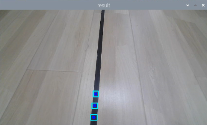

(7) Click on the position of the line in the image to select the corresponding color of the track line, and you can start line following by color picking.
(8) If you need to close this function, you need to return to the command line terminal and enter the command to stop it.

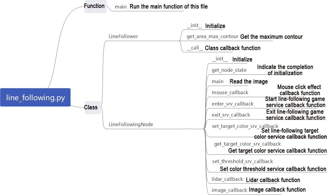

(4) Source Code Analysis:
The program file corresponding to this section of the course document is located at:
/home/ubuntu/ros2_ws/src/app/app/line_following.py
It’s necessary to back up the original program file before making any modification to the program. You’re forbidden to modify the original source code file to avoid causing robot malfunctions that may be irreparable due to incorrect parameter modifications!

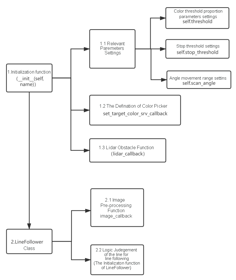

Then, the color picker object is defined (used in the game to pick colors), along with the setting of additional Lidar obstacle avoidance functionality. Next is the implementation of the LineFollower class, which mainly includes functions for image preprocessing and logic for line following.
Function:
Main:
333
334
335
336
337
def main():
    node = LineFollowingNode('line_following')
    rclpy.spin(node)
    node.destroy_node()
    rclpy.shutdown()
Initiate line following node:
Class:
LineFollower:
class LineFollower:
    def __init__(self, color, node):
        self.node = node
Init:
        self.node = node
        self.target_lab, self.target_rgb = color
        if os.environ['MACHINE_TYPE'] == 'JetAuto':
            self.rois = ((0.90, 0.92, 0, 1, 0.7), (0.78, 0.80, 0, 1, 0.2), (0.66, 0.68, 0, 1, 0.1))
            self.rois = ((0.81, 0.83, 0, 1, 0.7), (0.69, 0.71, 0, 1, 0.2), (0.57, 0.59, 0, 1, 0.1))
        self.weight_sum = 1.0
Set the line-following color and ROI list.

Exit autonomous line-following service, close various reading nodes, reset PID, and stop line following.
set_target_color_srv_callback:
212
213
214
215
216
217
218
219
220
221
222
223
224
        with self.lock:
            self.follower = None
            if x == -1 and y == -1:
                self.color_picker = None
        response.success = True
        return response
Set line-following color service.
