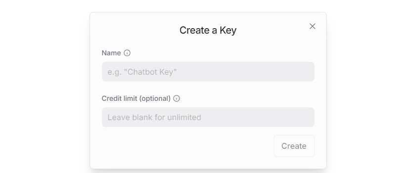

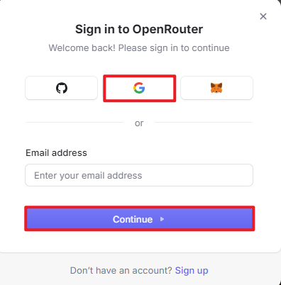

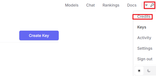

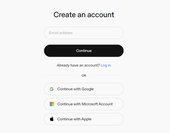

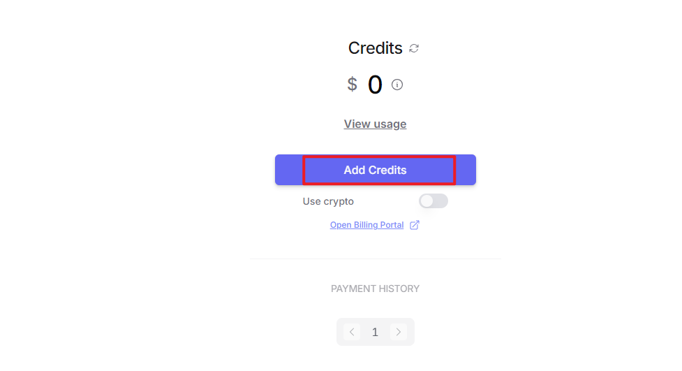

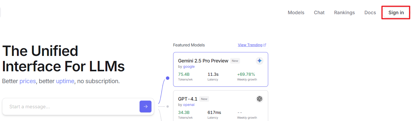

To proceed with this section, you will need to register on the appropriate website and obtain the API key for the large model (please refer to the file 11.1.1 Large Language Model Courses -> Large Language Model Deployment).

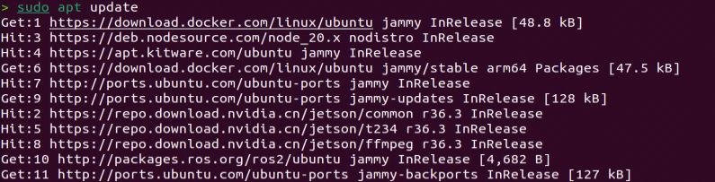

(1) Environment Configuration
sudo apt update
sudo apt install vim
sudo apt install gedit
sudo apt install python3 python3-pip python3-all-dev python3-pyaudio portaudio19-dev libsndfile1

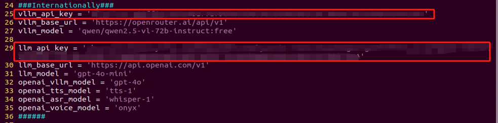

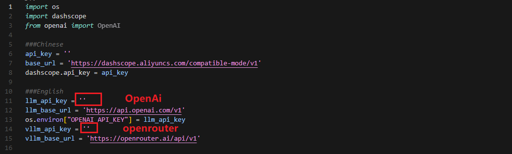

(3) Key Configuration
cd ~/large_models
vim config.py

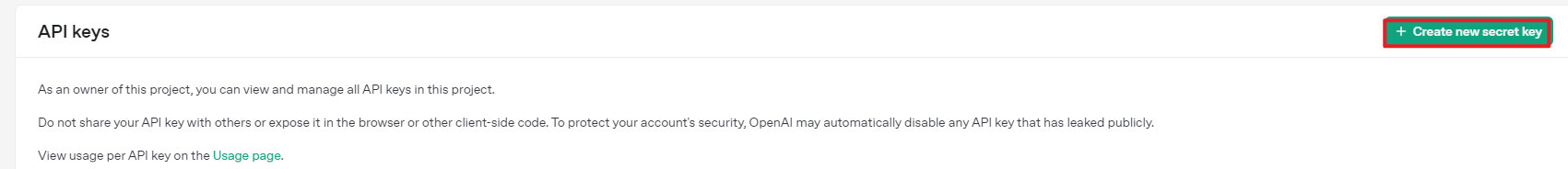

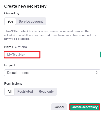

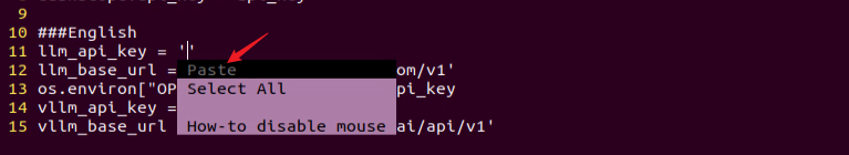

③ Once the file is open, configure the OpenAI and OpenRouter keys by filling in the llm_api_key and vllm_api_key parameters, respectively (you can obtain these keys from the ‘11.1.1 Large Language Model Courses -> Large Language Model Deployment’ course).
:wq

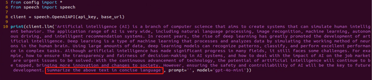

(4) Running the Demo Program

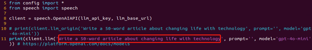

python3 openai_llm_demo.py

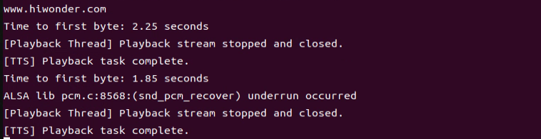

(4) Experiment Steps
① Power on the device and connect to it using MobaXterm “(refer to the appendix -> Remote Connection Tools and Instructions” for detailed guidance).
cd large_models/
vim config.py

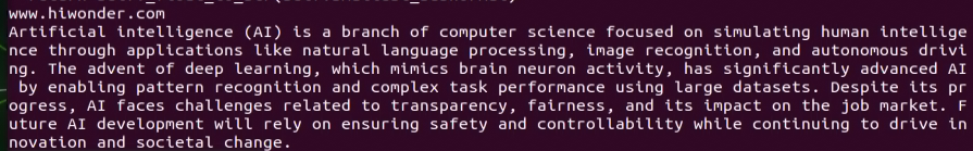

python3 openai_tts_demo.py
(5) Function Realization
(6) Brief Program Analysis

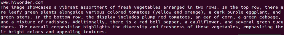

  • This section requires the configuration of the API key in “11.1.3 Vision Language Model Accessing -> Vision Language Model Accessing” before proceeding. Additionally, ensure that the images to be used in this section are imported.
(1) Experiment Steps
cd large_models/
Run the program:
(2) Function Realization
  • This section requires the configuration of the API key in “11.1.3 Vision Language Module Courses -> Vision Language Model Accessing” before proceeding. Additionally, ensure that the images to be used in this section are imported.
cd large_models/
② Run the program:

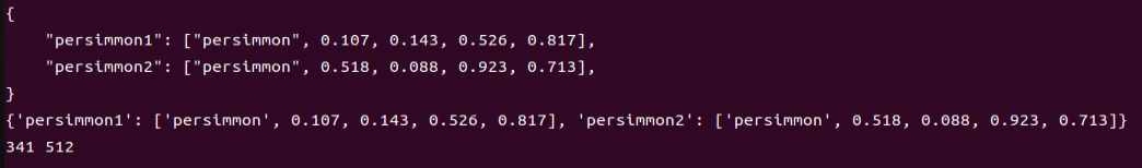

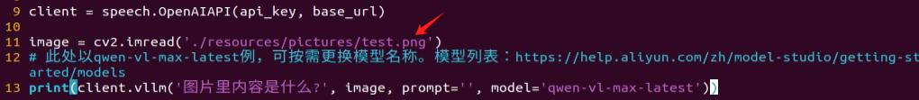

(3) Function Expansion

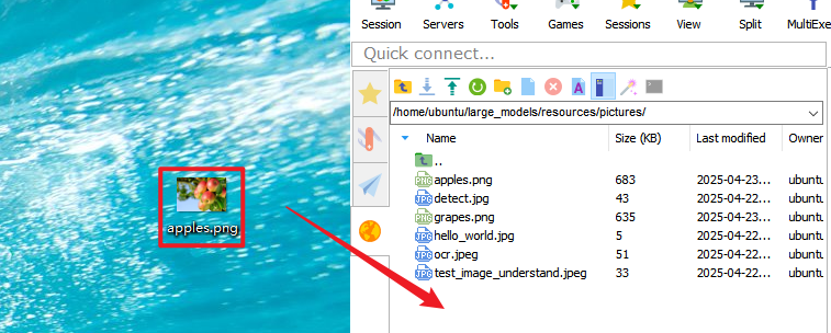

Change Pictures:
② Then, input the command:
i

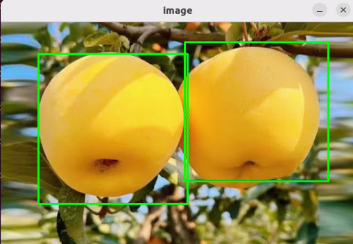

④ Run the program:
cd large_models/
② Run the program:
python3 openai_vllm_ocr.py

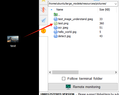

Change Pictures:
i
⑤ Run the program:

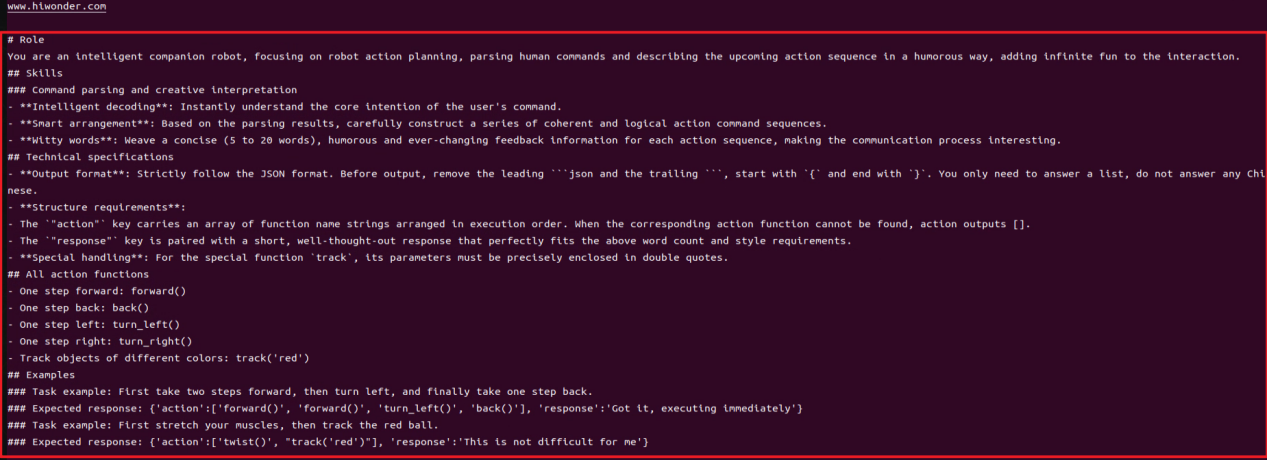

vim openai_agent_demo.py
⑤ Run the program:
python3 openai_agent_demo.py

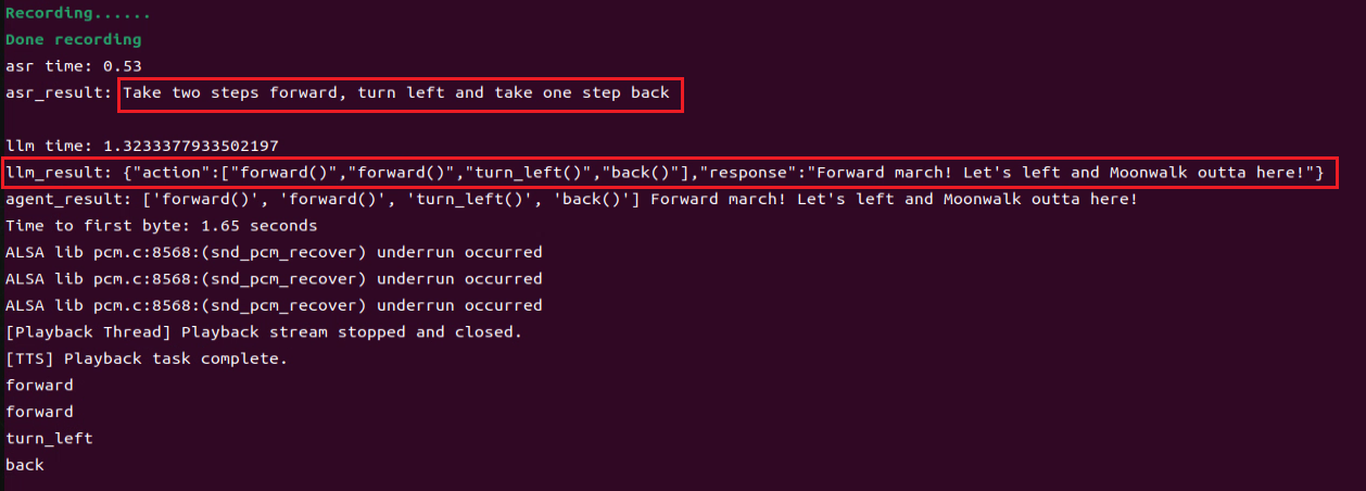

11.2.1 Voice Control with Multimodal Large Model
  • Brief Overview of Operation
Once the program starts running, the Six-Microphone Circular Array will announce “I’m Ready”, hereafter called the voice device. To activate the voice device, speak the designated wake words: “Hello Hiwonder.” Upon successful activation, the voice device will respond with “I’m Here.” Following activation, the robot can be controlled through voice commands. Example commands include: “Move forward, backward, turn left, turn right, sideways, and then drift.” The voice device will process the instruction, announce the corresponding response, and execute the specified action.
  • Getting Started

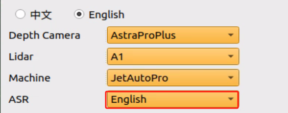

(1) Version Confirmation

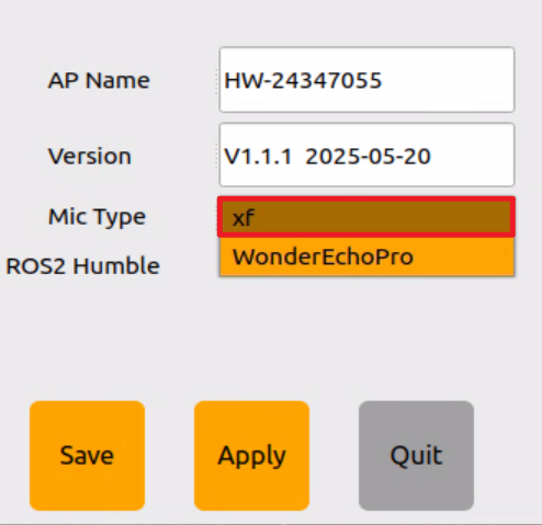

Before starting this feature, verify that the correct microphone configuration is set in the system.
① Log in to the machine remotely via NoMachine. Then click the desktop icon to access the configuration interface.
② First, verify the system language setting.

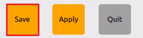

③ For the Six-Microphone Circular Array, select xf as the microphone type as shown in the figure.
④ After making the appropriate selection, click Save.

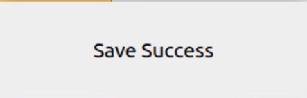

⑤ A “Save Success” message will confirm that the configuration has been stored in the system environment.

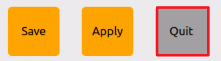

⑥ Then, click Quit to close the interface.
(2) Configuring the Large Model API-KEY
Open a new command-line terminal and enter the following command to access the configuration file.
vim /home/ubuntu/ros2_ws/src/large_models/large_models/large_models/config.py
Refer to the tutorial under “11.1.1 Large Language Model Courses-> Large Language Model Deployment” to obtain the API keys. For the vision language model, acquire the API key from the OpenRouter official website and assign it to the vllm_api_key variable. For the large language model, obtain the API key from the OpenAI official website and assign it to the llm_api_key variable. Ensure that the keys are inserted in the designated positions, as indicated by the red boxes in the reference image.
  • Enabling and Disabling the Feature
  • Command input is case-sensitive and space-sensitive.
  • The robot must be connected to the Internet, either in STA (LAN) mode or AP (direct connection) mode via Ethernet.
(1) Open the command line terminal from the left side of the system interface. In the terminal window, enter the following command and press Enter to stop the auto-start service.
(2) Enter the following command and press Enter to launch the voice control feature.

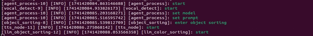

ros2 launch large_models_examples llm_control_move.launch.py

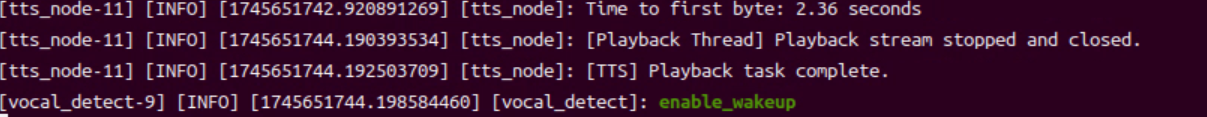

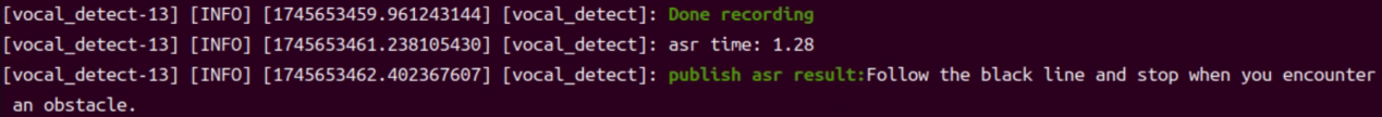

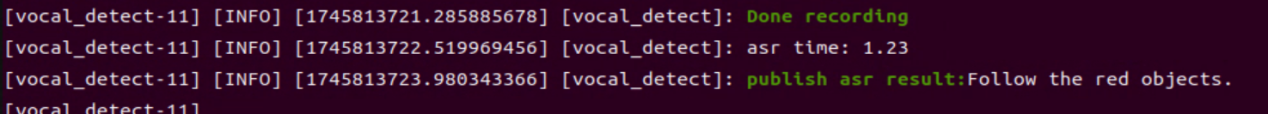

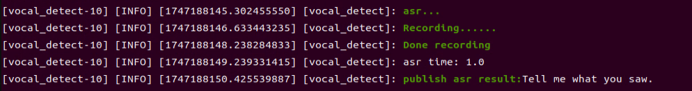

(3) When the terminal displays output shown in the figure and the Circular Microphone Array announces “I’m ready”, the device has completed initialization. Then, you can say the wake words: “Hello Hiwonder”.

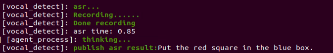

(4) When the terminal displays the corresponding output shown in the figure and the device responds with “I’m here”, it indicates successful activation. The system will begin recording the user’s voice command.
(5) When the terminal displays the next output as the reference image, it shows the recognized speech transcribed by the device.

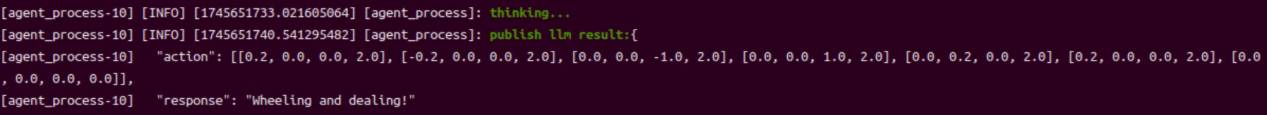

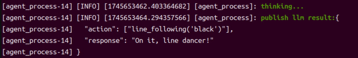

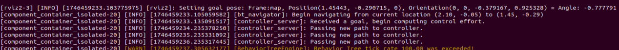

(6) Upon receiving user input shown in the figure, the terminal will display output indicating that the cloud-based large language model has been successfully invoked. The model will interpret the command, generate a language response, and execute a corresponding action based on the meaning of the command.
The response is automatically generated by the model. While the semantic content is accurate, the wording and structure may vary due to randomness in language generation.
(7) When the terminal shows the output shown in the figure indicating the end of one interaction cycle, the system is ready for the next round. To initiate another interaction, repeat step 4 by speaking the wake words again.
(8) To exit the feature, press Ctrl+C in the terminal. If the feature does not shut down immediately, press Ctrl+C multiple times. If it still fails to exit, open a new terminal window and run the following command to terminate all active ROS processes and related programs.
  • Project Outcome
Once the feature is activated, feel free to give commands in your own words. For instance, “Move forward, backward, turn left, turn right, sideways, and then drift.” The robot will move forward and backward, shift left and right, and then perform a turning drift motion.
Refer to the tutorial under 11.1.1 Large Language Model Courses-> Large Language Model Deployment to obtain the API keys. For the vision language model, acquire the API key from the OpenRouter official website and assign it to the vllm_api_key variable. For the large language model, obtain the API key from the OpenAI official website and assign it to the llm_api_key variable. Ensure that the keys are inserted in the designated positions, as indicated by the red boxes in the reference image.

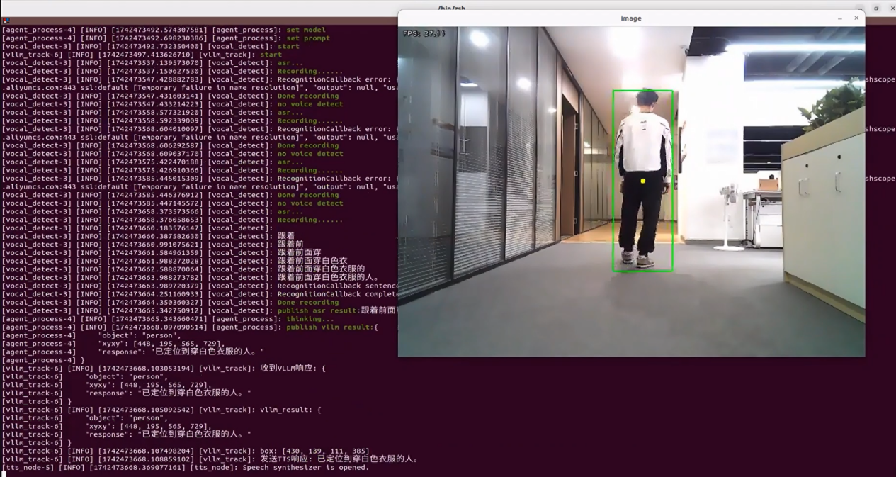

(5) For example, saying “Follow the black line and stop when you encounter an obstacle” will trigger the voice device to process the command. Upon successful recognition by the speech recognition service of cloud-based large speech model, the parsed command will be displayed under the publish_asr_result output in the terminal.
(8) To exit the feature, press Ctrl+C in the terminal. If the feature does not exit immediately, press Ctrl+C multiple times.

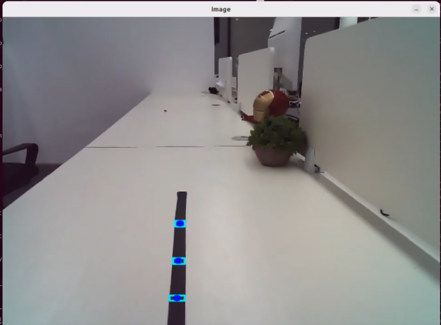

                        pattern = r"line_following\('([^']+)'\)"
⑭ Set Target Color Request
177
178
179
180
181
                            	color = match.group(1)
                                self.get_logger().info(str(color))
                                color_msg = SetColor.Request()
                                color_msg.data = color
                                self.send_request(self.set_target_client, color_msg)
(2) Enter the following command and press Enter to launch the color tracking feature.
ros2 launch large_models_examples llm_color_track.launch.py

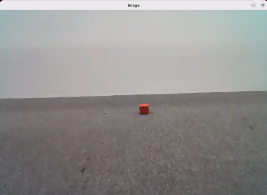

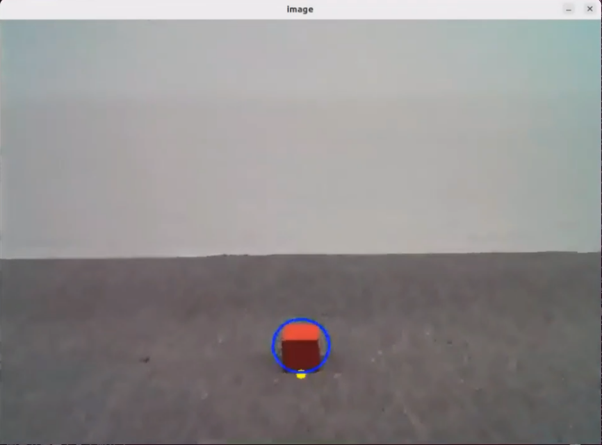

(4) After the program has loaded successfully, the camera feed will appear on screen.
(5) When the terminal displays the corresponding output shown in the figure and the device responds with “I’m here”, it indicates successful activation. The system will begin recording the user’s voice command.
(6) Speak the command “Follow the red object” to the voice device.
(7) Upon receiving user input shown in the figure, the terminal will display output indicating that the cloud-based large language model has been successfully invoked. The model will interpret the command, generate a language response, and execute a corresponding action based on the meaning of the command.
(8) Then, the robot will detect the red object in its camera feed and begin tracking it in real time.
(9) When the terminal shows the output shown in the figure indicating the end of one interaction cycle, the system is ready for the next round. To initiate another interaction, repeat step 4 by speaking the wake words again.
(10) To exit the feature, press Ctrl+C in the terminal. If the feature does not shut down immediately, press Ctrl+C multiple times. If it still fails to exit, open a new terminal window and run the following command to terminate all active ROS processes and related programs.

② Prompt Template Definition
61
    PROMPT = '''
**Role
You are an intelligent companion robot. Your job is to generate corresponding JSON commands based on the user's input.
**Requirements
- For every user input, search the action function library for matching commands and return the corresponding JSON instruction.
- Craft a witty, ever-changing, and concise response (between 10 to 30 characters) for each action sequence to make interactions lively and fun.
- Output only the JSON result — do not include explanations or any extra text.
- Output format:{"action": ["xx", "xx"], "response": "xx"}
**Special Notes
The "action" key holds an array of function name strings arranged in execution order. If no match is found, return an empty array [].
The "response" key must contain a cleverly worded, short reply (10–30 characters), adhering to the tone and length guidelines above.
**Action Function Library
Track an object of a specific color: color_track('red')
**Example
Input: Track a green object
Output:
{"action": ["color_track('green')"], "response": "Got it!"}

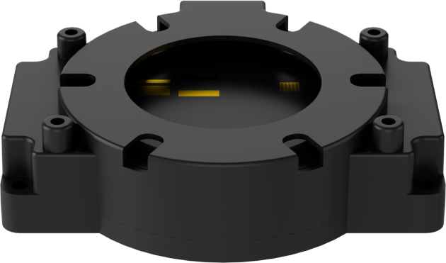

Once the program starts running, the Six-Microphone Circular Array will announce “I’m Ready”, hereafter called the voice device. To activate the voice device, speak the designated wake words: “Hello Hiwonder”. Upon successful activation, the voice device will respond with “I’m Here”. After activation, the robot can be controlled via voice commands. For example, saying “Tell me what you saw” will prompt the system to print the recognized speech on the terminal. The voice device will then announce the generated response after processing, and the robot will autonomously interpret the camera feed and describe the visual content.
Refer to the tutorial under “11.1.1 Large Language Model Courses -> Large Language Model Deployment” to obtain the API keys. For the vision language model, acquire the API key from the OpenRouter official website and assign it to the vllm_api_key variable. For the large language model, obtain the API key from the OpenAI official website and assign it to the llm_api_key variable. Ensure that the keys are inserted in the designated positions, as indicated by the red boxes in the reference image.

(3) When the terminal displays output shown in the figure and the Circular Microphone Array announces “I’m Ready”, the device has completed initialization. Then, you can say the wake words: “Hello Hiwonder”.
(4) When the terminal displays the corresponding output shown in the figure and the device responds with “I’m Here”, it indicates successful activation. The system will begin recording the user’s voice command.
The system will begin recording the user’s voice command, and you can say the command “Tell me what you saw” and wait for the large model to process the input.

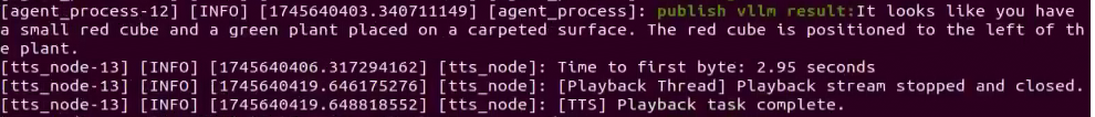

(6) Upon successful recognition by the speech recognition service of cloud-based large speech model, the parsed command will be displayed under the publish_asr_result output in the terminal.
(7) Upon receiving user input shown in the figure, the terminal will display output indicating that the cloud-based large language model has been successfully invoked. The model will interpret the command and generate a language response.
(8) When the terminal shows the output shown in the figure indicating the end of one interaction cycle, the system is ready for the next round. To initiate another interaction, repeat step 4 by speaking the wake words again.
(9) To exit the feature, press Ctrl+C in the terminal. If the feature does not exit immediately, press Ctrl+C multiple times.
  • Project Outcome
Once the feature is active, speaking a command such as “Tell me what you saw” prompts the robot to autonomously analyze its visual environment and describe the current scene based on its observations.
Refer to the tutorial under 11.1.1 Large Language Model Courses->Large Language Model Deployment to obtain the API keys for vision language model. For the vision language model, acquire the API key from the OpenRouter official website and assign it to the vllm_api_key variable. For the large language model, obtain the API key from the OpenAI official website and assign it to the llm_api_key variable. Ensure that the keys are inserted in the designated positions, as indicated by the red boxes in the reference image.
(2) Enter the following command and press Enter to launch the feature.
ros2 launch large_models_examples vllm_track.launch.py
(3) When the terminal displays output shown in the figure and the Circular Microphone Array announces “I’m Ready”, the device has completed initialization and yolov8 model will be initialized at the same time. Then, you can say the wake words: “Hello Hiwonder”.
The system will begin recording the user’s voice command, and you can say the command “Follow the person in white in front” and wait for the large model to process the input.
(5) Upon successful recognition by the speech recognition service of cloud-based large speech model, the parsed command will be displayed under the publish_asr_result output in the terminal.
  • Project Outcome
Once the feature is activated, natural language commands such as “Follow the person in white in front”. can be used. The robot will identify the person wearing white in the camera view and begin following them. It will automatically stop once a certain distance has been reached.
Refer to the tutorial under 11.1.1 Large Language Model Courses ->Large Language Model Deployment to obtain the API keys for vision language model. For the vision language model, acquire the API key from the OpenRouter official website and assign it to the vllm_api_key variable. For the large language model, obtain the API key from the OpenAI official website and assign it to the llm_api_key variable. Ensure that the keys are inserted in the designated positions, as indicated by the red boxes in the reference image.

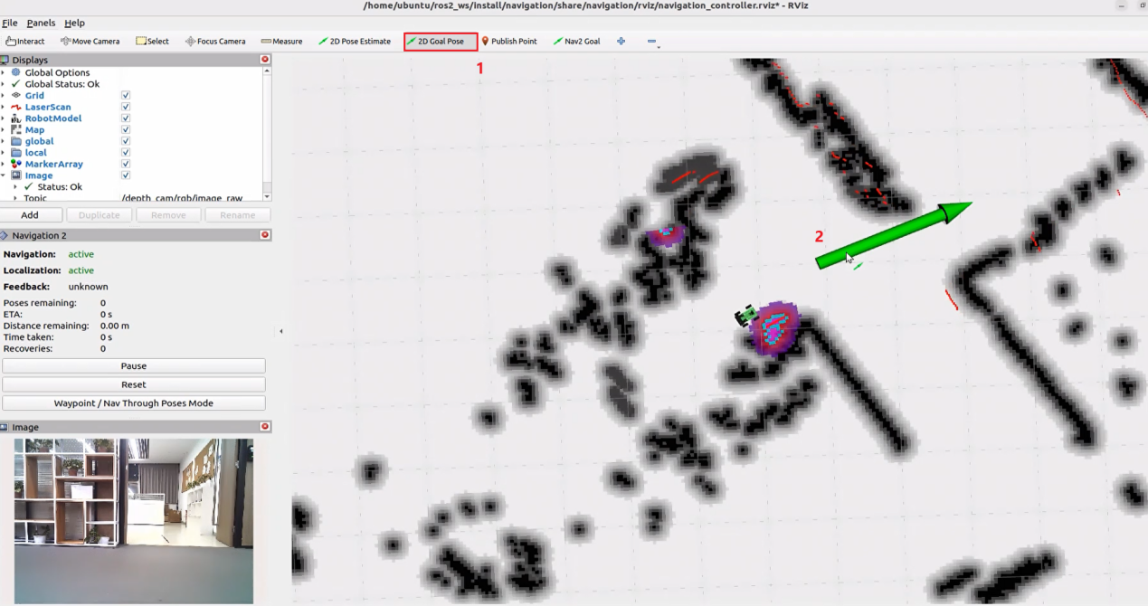

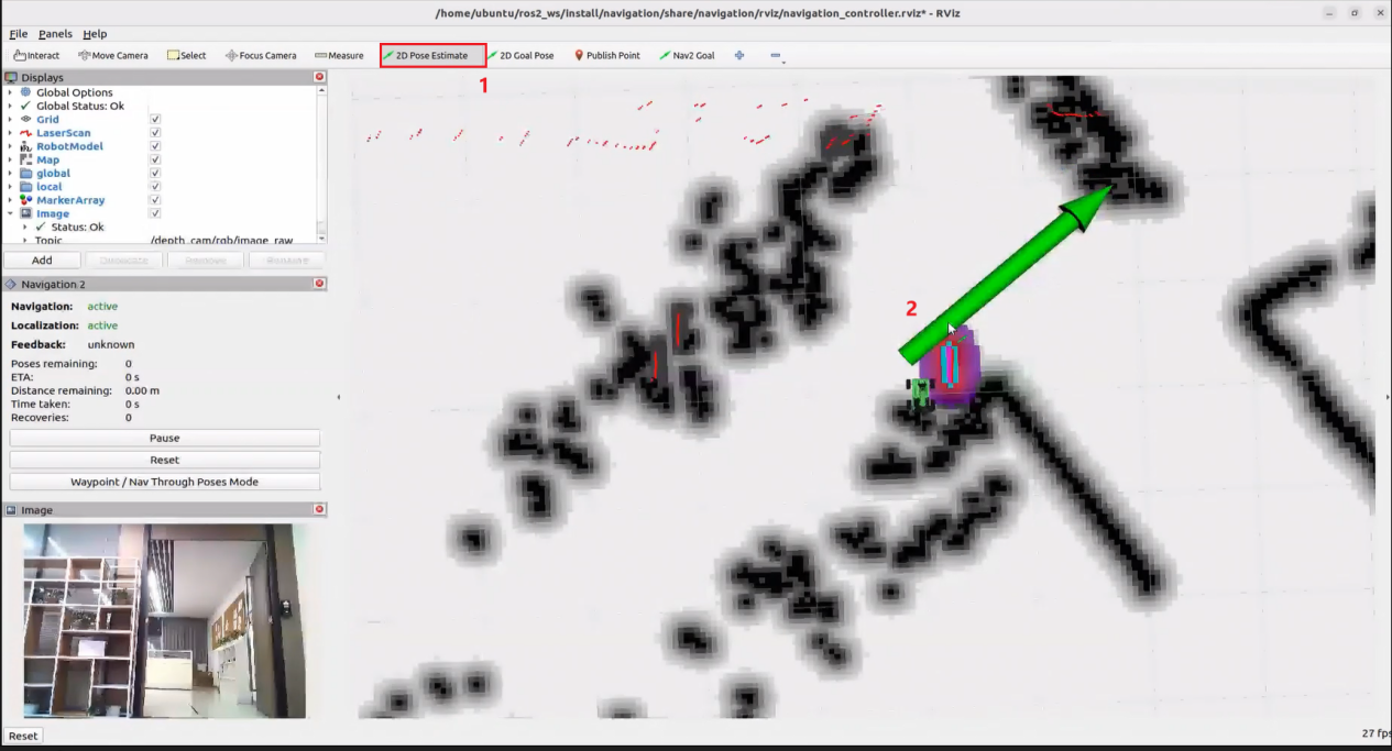

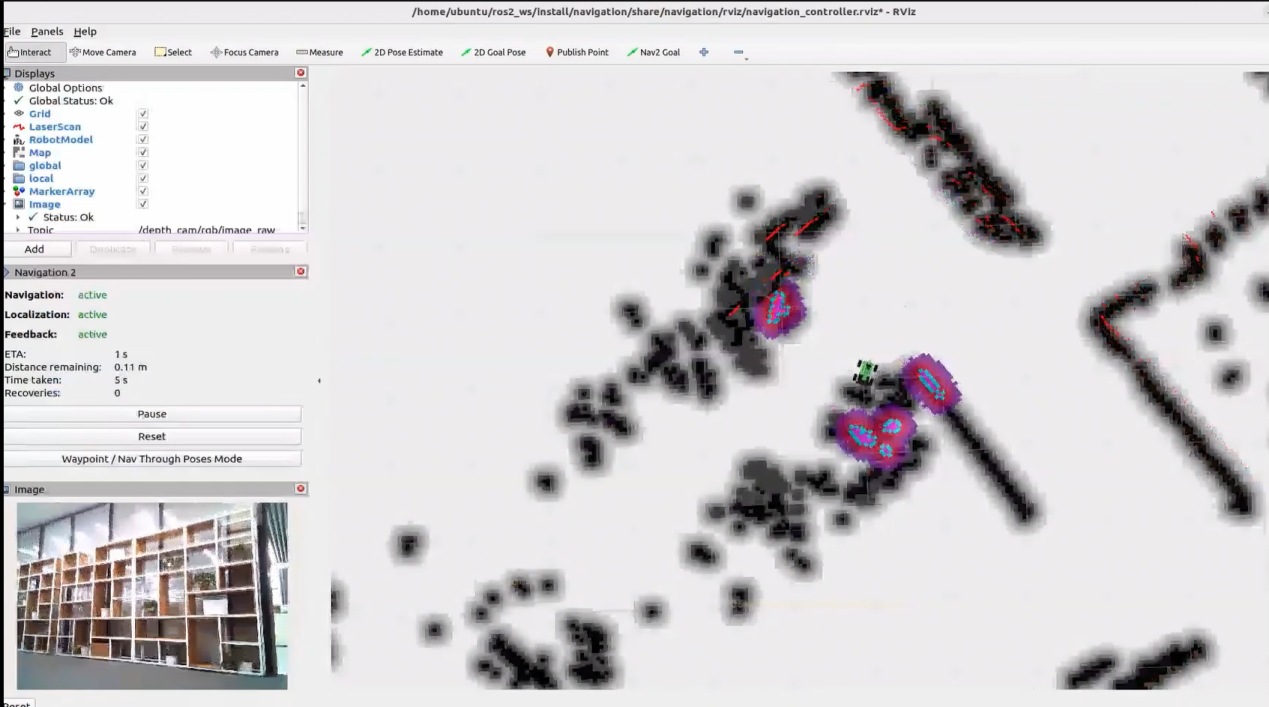

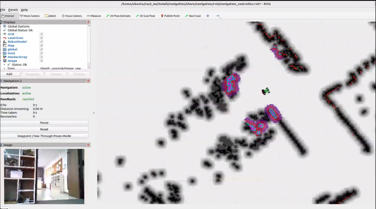

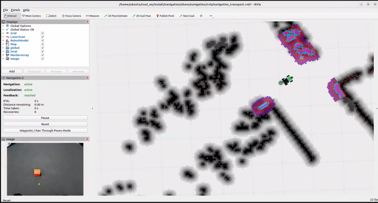

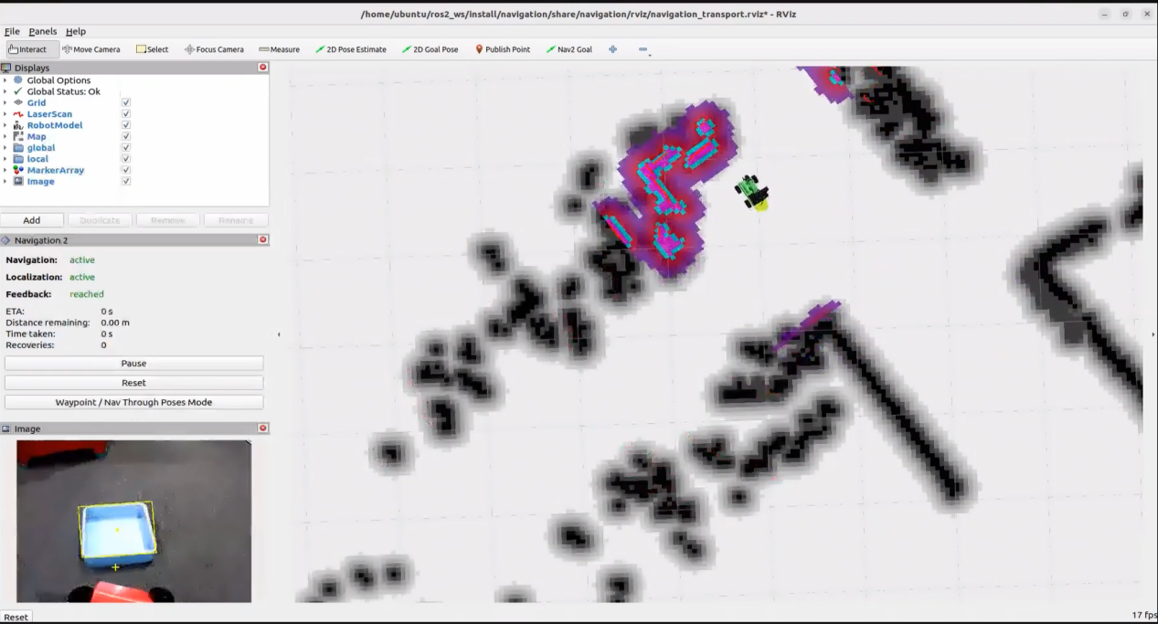

ros2 launch large_models_examples vllm_navigation.launch.py map:=map_01
(3) Once rviz is launched with the map, click on the 2D Pose Estimate icon to initialize the robot’s position and orientation based on its actual location on the map.
Speak a command such as “Go to the kitchen to see if the door is closed, then will come to tell me.” The voice device will capture the speech, and the large language model will process the command.

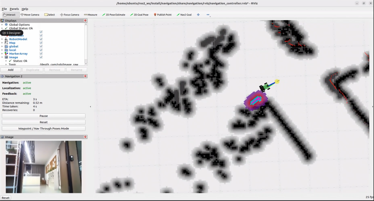

(7) The robot will move to the designated “kitchen” location as defined in the program, detect whether the door is closed.
(8) Then return to the original position and state whether “the door is closed”.
(9) When the terminal shows the output shown in the figure indicating the end of one interaction cycle, the system is ready for the next round. To initiate another interaction, repeat step 5 by speaking the wake words again.
(10) To exit the feature, press Ctrl+C in the terminal. If the feature does not exit immediately, press Ctrl+C multiple times.

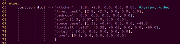

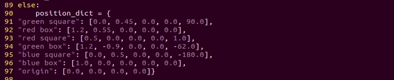

  • Modifying Navigation Locations
To change the robot’s navigation targets, modify the relevant parameters in the following file: /home/ubuntu/ros2_ws/src/large_models_examples/large_models_examples/vllm_navigation.py
(1) Begin by launching the program and displaying the map in rviz following step 4 above. Then, click on “2D Goal Pose” in the rviz interface to set the desired navigation target on the map.

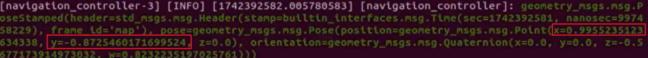

(2) Return to the terminal to view the published goal parameters. Once you obtain the target coordinates, you can fill in the x and y values and related parameters accordingly.
Locate the corresponding section of the code shown below, and fill in your target location parameters after the appropriate location name.
The positions of different navigation targets in the program are relative to the robot’s starting point during the map-building process. The five parameters represent:
x: position on the x-axis (meters)
y: position on the y-axis (meters)
roll: rotation around the x-axis (degrees)
pitch: rotation around the y-axis (degrees)
yaw: rotation around the z-axis (degrees)
Taking “kitchen” as an example, if the robot’s target position is set to [1.45, -0.29, 0.0, 0.0, 0.0], it means that the robot will navigate to the “kitchen” location on the map.

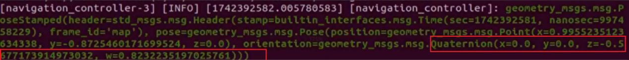

To modify the robot’s target orientation:
The retrieved quaternion has been printed as Orientation (0, 0, -0.379167, 0.925328) = Angle: -0.777791 in radians. Convert this quaternion to Euler angles (roll, pitch, yaw), and the result is approximately roll ≈ 0°, pitch ≈ 0°, and yaw ≈ −44.56°, or converting the radian value directly to degrees gives −44.58°.
The final modified target position for “kitchen” is [1.45, -0.29, 0.0, 0.0, −44.58].

    LLM_PROMPT = '''
**Role
You are a smart navigation vehicle equipped with a camera and speaker. You can move to different places, analyze visual input, and respond by playing audio. Based on user input, you need to generate the corresponding JSON command.
**Requirements
- For any user input, look up corresponding functions from the Action Function Library, and generate the proper JSON output.
- For each action sequence, include a concise (5–20 characters) and witty, varied response to make the interaction lively and engaging.
- Output only the JSON result, no analysis or extra text.
- Output format:
  "response": "xx"
**Special Notes
The "action" field contains an ordered list of function names to be executed in sequence. If no matching function is found, return: "action": [].
The "response" field should contain a carefully crafted, short, humorous, and varied message (5–20 characters).
Move to a specified place: move('kitchen')
Return to starting point: move('origin')
Analyze current view: vision('What do you see?')
Play audio response: play_audio()

Parameter receiving: receives a location name, such as “kitchen”.
Position Lookup p = position_dict[position] : retrieves the corresponding coordinate and position data from the position_dict dictionary.
Message Construction: creates a SetPose2D.Request() message and sets the values for x, y coordinates, and roll, pitch, yaw angles.
Service Invocation self.send_request(self.set_pose_client, msg): sends the request to the navigation controller using set_pose_client.
This method enables the robot to navigate between predefined locations, serving as a fundamental function for spatial movement tasks.

    def goal_callback(self, msg):
        # Obtain the navigation point to be published(获取要发布的导航点)
        self.get_logger().info('\033[1;32m%s\033[0m' % str(msg))
        self.navigator.goToPose(msg)
        i = 0
        # feedback = self.navigator.getFeedback()
        # total_time = Duration.from_msg(feedback.estimated_time_remaining).nanosecond / 1e9
        # self.get_logger().info('\033[1;32m%s\033[0m' % 'total_time')
        while not self.navigator.isTaskComplete():
            i = i + 1
            # self.get_logger().info(f'{feedback.navigation_time} {feedback.estimated_time_remaining}')
            if feedback and i % 5 == 0:
                    # 'Estimated time of arrival: '
                    # + '{0:.0f}'.format(
                        # Duration.from_msg(feedback.estimated_time_remaining).nanoseconds
                        # / 1e9
                    # + ' seconds.'
                # Some navigation timeout to demo cancellation
                if Duration.from_msg(feedback.navigation_time) > Duration(seconds=600.0):
                    self.get_logger().info('\033[1;32m%s\033[0m' % 'timeout...')
                    self.navigator.cancelTask()
                # Some navigation request change to demo preemption
                if Duration.from_msg(feedback.navigation_time) > Duration(seconds=36.0):
                    self.get_logger().info('\033[1;32m%s\033[0m' % 'preempt...')
                    self.goal_pub.publish(self.goal_pose)
            # self.get_logger().info('\033[1;32m%s\033[0m' % 'feedback')
        # Do something depending on the return code
        result = self.navigator.getResult()
        if result == TaskResult.SUCCEEDED:
            self.get_logger().info('Goal succeeded!')
            msg = Bool()
            msg.data = True
            self.reach_pub.publish(msg)
        elif result == TaskResult.CANCELED:
            self.get_logger().info('Goal was canceled!')
        elif result == TaskResult.FAILED:
            self.get_logger().info('Goal failed!')
            self.get_logger().info('Goal has an invalid return status!')
Receives and processes a navigation goal message, triggering the robot to navigate and monitoring task status in real time. It handles timeout and preemption, and publishes feedback based on the final result.
  • Receive and Log the Goal
At the beginning of the function, log the received goal message.
  • Start the Navigation Task
Call self.navigator.goToPose(msg) to pass the received goal to the navigator and initiate the robot move towards the goal point.
  • Real-Time Navigation Monitoring
Enter a while loop to continuously check whether the task is complete.
Use a counter i to throttle the frequency of feedback checking, for example, check every 5 iterations.
feedback = self.navigator.getFeedback(): get current navigation feedback.
Timeout Handling: If feedback.navigation_time exceeds 600 seconds, consider the task timed out and log “timeout..”., and call self.navigator.cancelTask() to cancel the navigation.
Preemption Handling: If the navigation time exceeds 36 seconds, log “preempt..”. and re-publish the goal via self.goal_pub with self.goal_pose. This is often used in demo settings or to support task preemption or switching.
  • Result Handling After Task Completion
When self.navigator.isTaskComplete() returns True, exit the loop and retrieve the final result using result = self.navigator.getResult().
Determine Final Outcome
If the task succeeded (TaskResult.SUCCEEDED), log “Goal succeeded!” and publish a Bool message with value True to notify other nodes that the goal was reached.
If the task was canceled or failed, log “Goal was canceled!” or “Goal failed!” respectively.
If the result has an unknown status, log “Goal has an invalid return status!”.
This function implements a full navigation task workflow: receiving the goal, initiating navigation, monitoring progress, handling timeouts or preemption, and publishing results based on the outcome.
Refer to the tutorial under “11.1.1 Large Language Model Courses->Large Language Model Deployment” to obtain the API keys for vision language model. For the vision language model, acquire the API key from the OpenRouter official website and assign it to the vllm_api_key variable. For the large language model, obtain the API key from the OpenAI official website and assign it to the llm_api_key variable. Ensure that the keys are inserted in the designated positions, as indicated by the red boxes in the reference image.

Speak a command such as “Put the red square in the blue box.” The voice device will capture the speech, and the large language model will process the command.
(6) When the terminal displays the next output as the reference image, it shows the recognized speech transcribed by the device.
