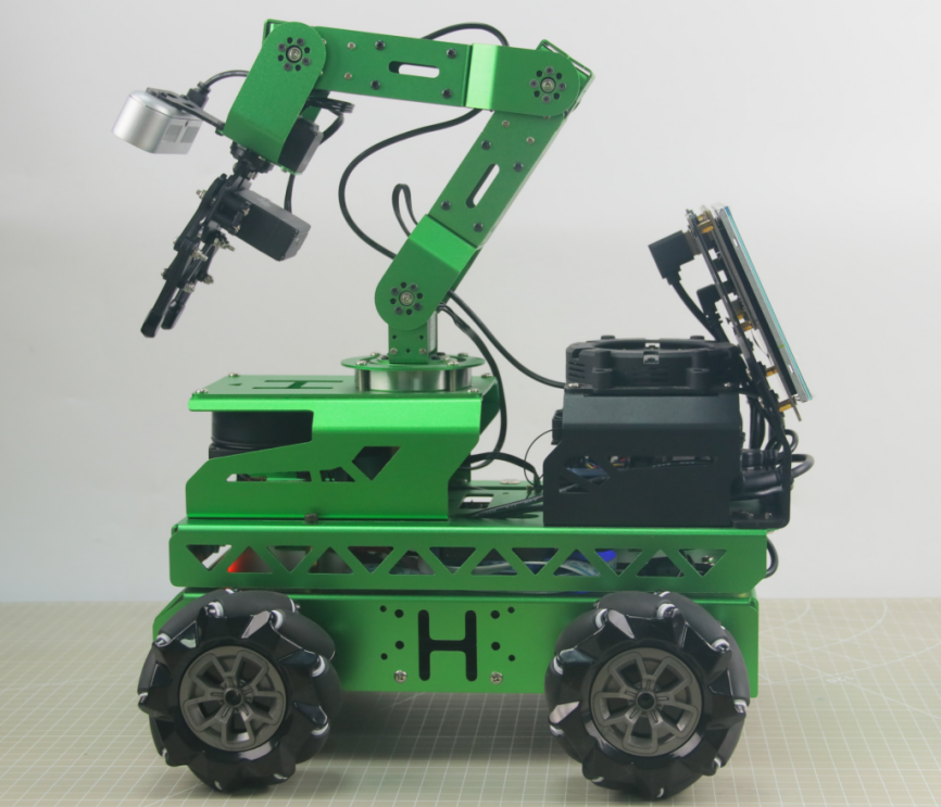

7.1.1 Get to Know Robotic Arm

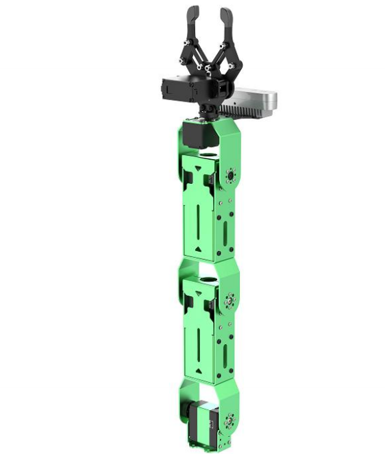

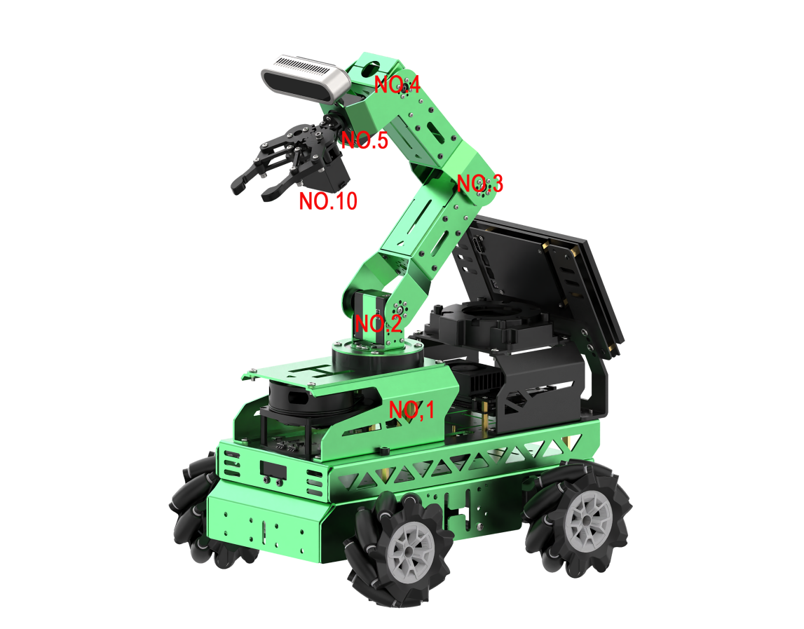

JetRover is equipped with a 6DOF robotic arm, composed of intelligent bus servos and metal connection components, which can reach any position in feasible space. Six degrees of freedom consist of X-axis movement, Y-axis movement, Z-axis movement, X-axis rotation, Y-axis rotation, and Z-axis rotation, completing actions such as extension, rotation, and lifting. Additionally, it is equipped with a Dabai DCW depth camera, enabling different functions such as hand tracking, color recognition and sorting, color tracking, line following and obstacle avoidance, waste sorting, navigation and transportation.
The below table illustrates the relevant parameters of the robotic arm:
Name Instruction Name Instruction
Servo Composition 35kg3 + 20kg2 + 12kg*1 high-voltage bus servo Servo Accuracy HTD-35H bus servos (3 units), HTS-20H bus servo, and HTS-21H bus servo have a precision of 0.2°; HX-12H bus servo has a precision of 0.3°
Material Anodized aluminium alloy Control Method UART serial port command
Degree of Freedom 6DOF + gripper Communication Baud Rate 115200
Load 500g (gripping and transporting weight) Servo Memory User settings Power-off protection
Wingspan 410mm Read-back Function Support angle value read-back
Effective Gripping Range Radius≤30cm Servo Protection Locked protection/ over-heat protection
Camera Name Dabai DCW depth camera Parameter feedback Temperature, voltage, position
Pixel 200W System Support windows, Linux and Openwrt
Resolution 1920×1080 Frame Rate 60FPS
Connection USB driver-free Focusing Method Auto-focusing
  • Prior to shipment, our company has completed the debugging of the robotic arm, eliminating the need for users to adjust.
  • This instruction facilitates users in restoring the robotic arm’s status after make modification.

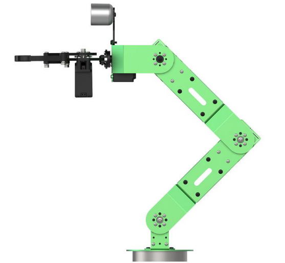

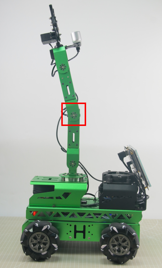

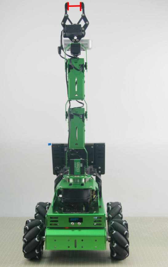

  • The robotic arm is equipped with 6 joints, where the first joint controls the overall horizontal rotation of the robotic arm. During adjustment, it should be ensured that the robotic arm faces forward in relation to the vehicle, avoiding left or right deviation as much as possible.

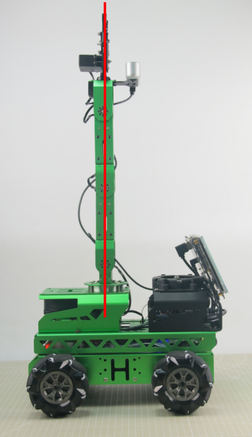

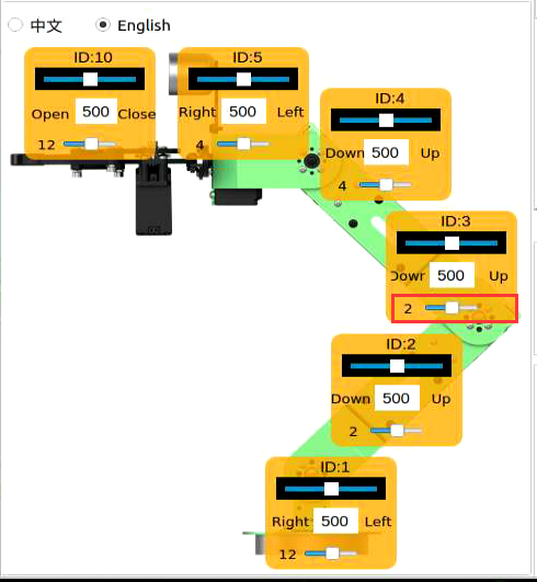

  • Whether there is deviation in the robotic arm servo can be referenced from the side view and top view diagrams provided in this document.

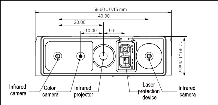

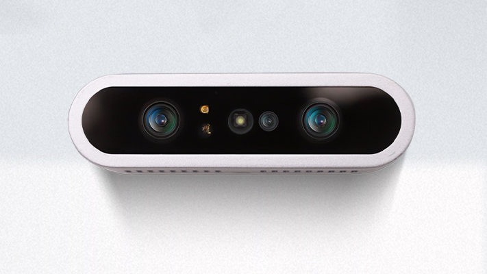

Dabai DCW depth camera is designed for service robot scenarios. Based on self-developed ASIC chips, Orbbec developed the Dabai DCW depth camera, a high-performance binocular structured light camera. The depth image resolution of up to 1920×1080@5/10fps, with an average power consumption of less than 1.2W. With just a USB 2.0 interface, the terminal can obtain high-precision 3D depth information for backend utilization, empowering robots to achieve functions such as perception, obstacle avoidance, and navigation.
Its specification parameters are illustrated below:
The specification of the depth camera:
Parameter Description
Dimension 89.82 ×25.10 ×25.10 mm
Working range 0.2m - 2.5m
Fan Do not support
Baseline 40mm
Power consumption Average power consumption <2.3W; The maximum power is less than 5.0W (During operation, the duration should be equal to or less than 3ms every 33ms)
Depth FOV When the camera D2C is not in use, it is H79° V62° D91°±3°. When the camera D2C is in use, it is H79° V55° D88.5°±3°.
Infrared FOV H79° V62° D91°±3°
Color FOV 16:9: H86° V55° D93.5°±3°; 4:3: H64° V55°
Relative accuracy 1.0%(center 81% area) @1000mm; 1.1%(center 81% area) @2000mm
Depth resolution @ frame rate 640400@5/10/15/30fps; 320200@5/10/15/30fps
Operating system Support Android and Windows7/10
Data transmission USB2.0 Type-C
Power Port Type-C
Application scenario Indoor
Safety Class1 laser
Operating temperature 10℃ ~ 40℃
There may be individual differences in 3D camera products. The product specifications provided are theoretical values and are for reference only. Please rely on actual performance for accuracy.

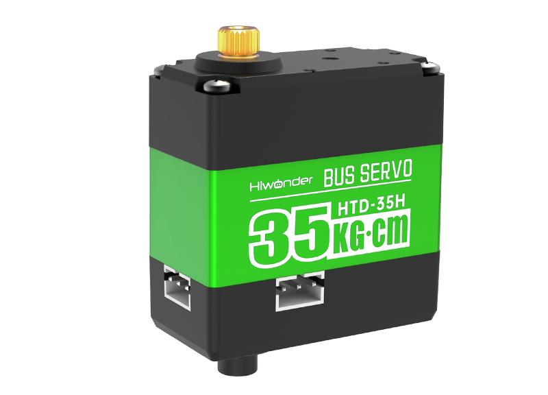

7.1.2 HTD-35H Serial Bus Servo Instructions
HTD-35H bus servo is controlled by serial port commands. The serial port baud rate is 115200. According to the provided communication protocol, user can send corresponding commands to servo to control servo rotation or read servo information. Servo parameters and ID are required to be set before controlling.
The interface of this servo is a half-duplex UART asynchronous serial interface so that the signal terminal can send and receive signals. When in use, we can send different commands to different ID through the serial port, which controls servo individually. It is widely applicable in different robotic arm joints.

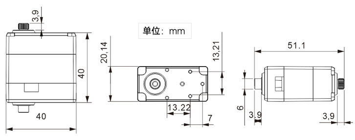

  • Structure & Specification Parameters
Servo Dimension Diagram:
Servo Motor Specifications
Specification Details
Operating voltage DC 9-12.6V
Rotation speed 0.18sec/60° (DC 11.1V)
Rotation torque 3.5kg.cm (DC 11.1V)
Static maximum torque 3.5kg.cm (DC 11.1V)
Servo accuracy 0.2°
Angle range 0-1000 (0°~240°)
Control method UART serial command
Communication band rate 115200
Memory Servo settings are automatically saved when power off
Servo ID number 0~255 for user setting, ID 1 is default
Read back Function Support angle read back function
Protection Avoid stalling and overheat
Parameter feedback Temperature, voltage and position
Operating mode Servo mode and deceleration motor mode
Gear type Metal Gear
Servo Wire 2Ocw, other line length can be selected
Plug-in model PH2.0-3P
Weight 64g
Size S4.38mm*20.14mm*45.5mm
Application All kinds of bionic robot joints

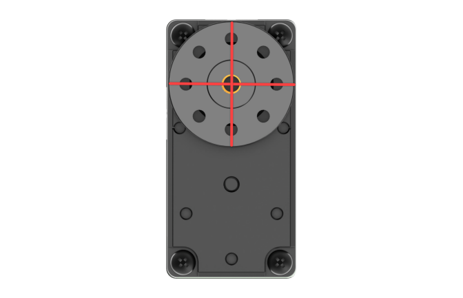

  • Installation
Servo horn aims red “+” to install, please refer to the following picture.

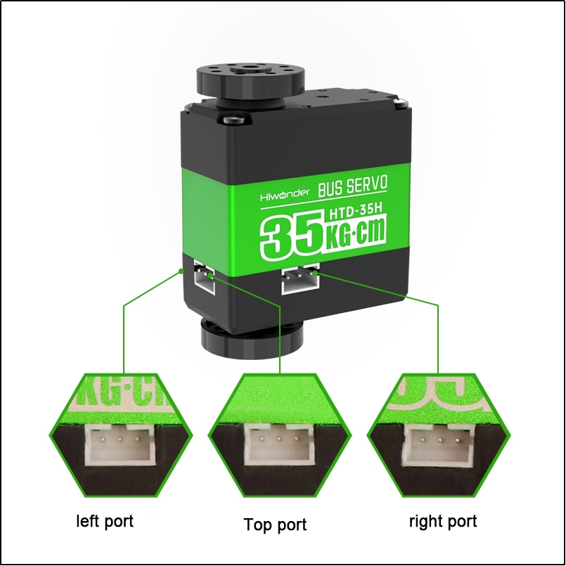

The interface distribution and instruction refer to the below diagram and table:
PIN PIN Instruction
GND GND
VIN Power input
SIG Signal terminal, half-duplex UART asynchronous serial interface

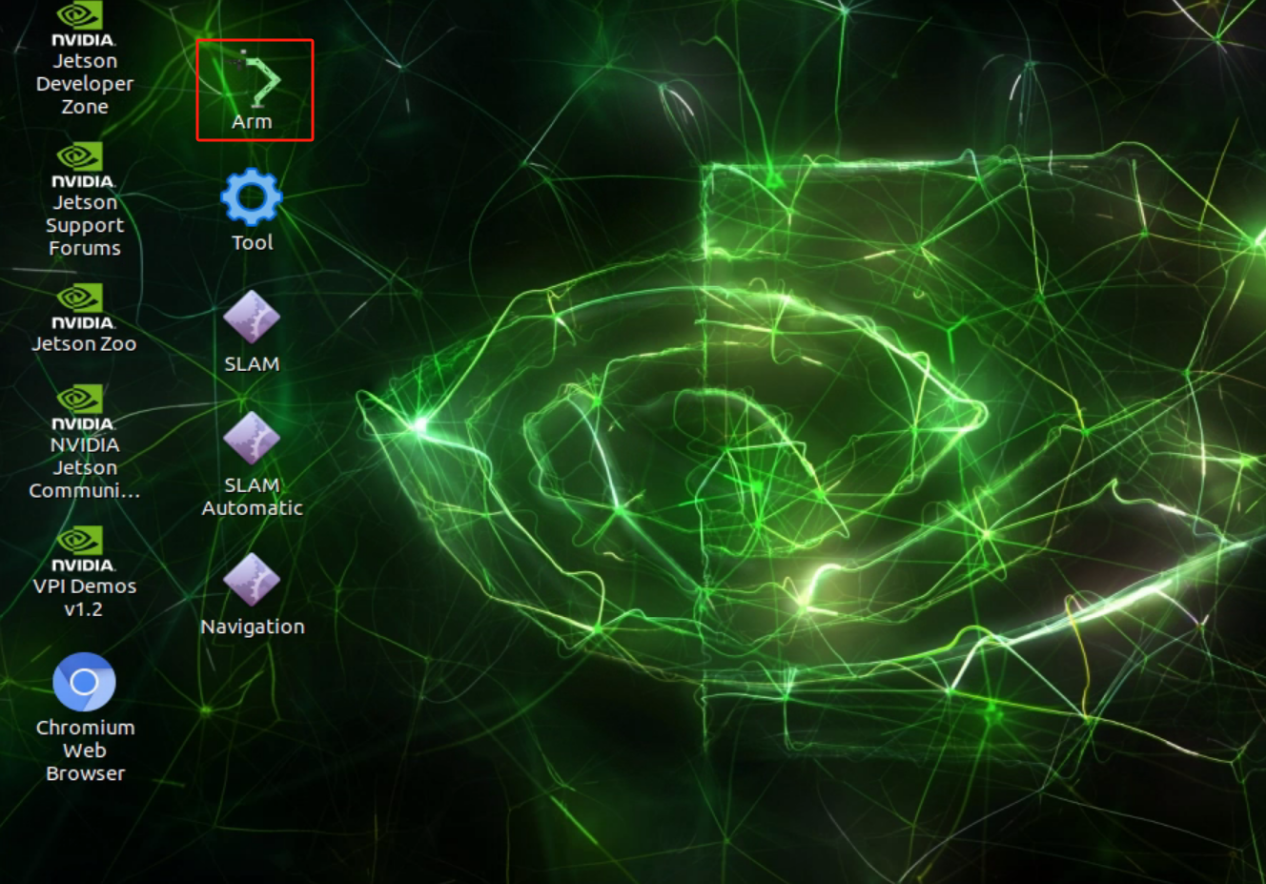

  • Open PC Software
(1) Double-click to open the ROS1 command-line terminal. Before adjusting the deviations and the robotic arm’s position, first disable the app’s auto-start service.
(2) Click the Arm icon on the desktop to launch the control software.

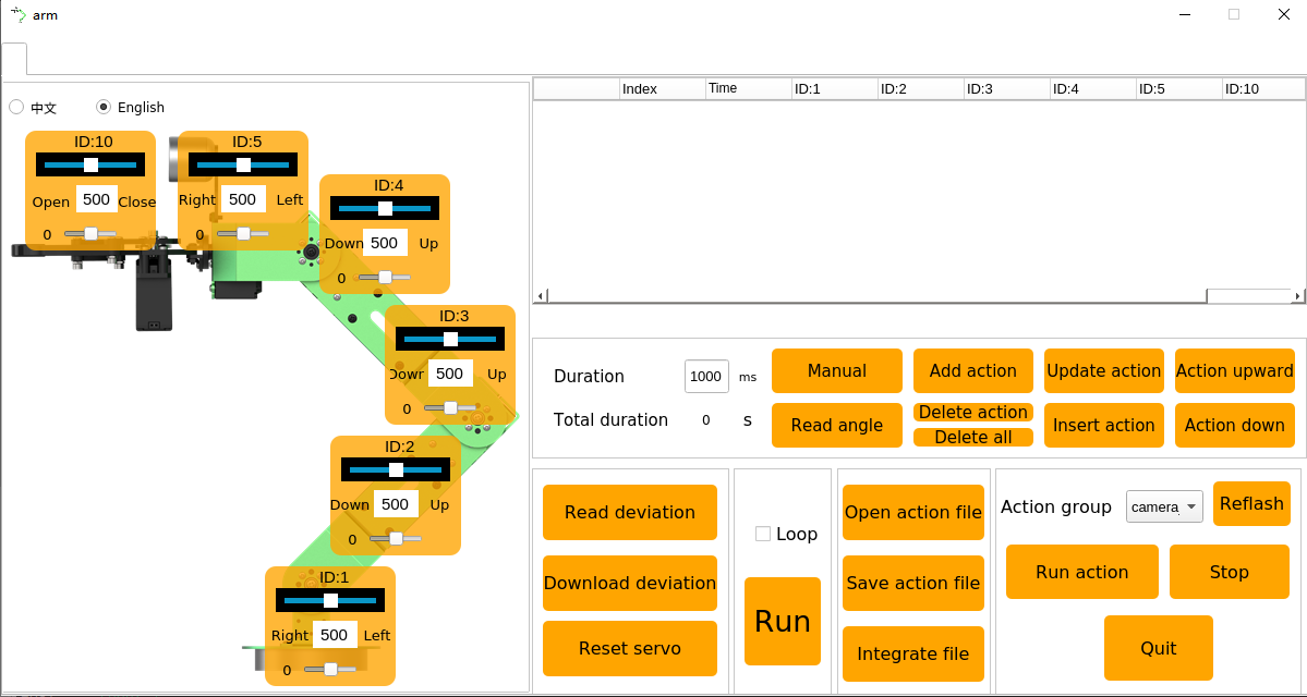

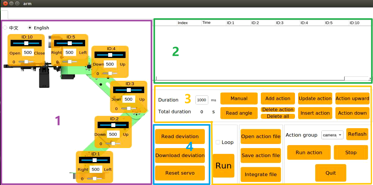

  • PC Software Interface Layout

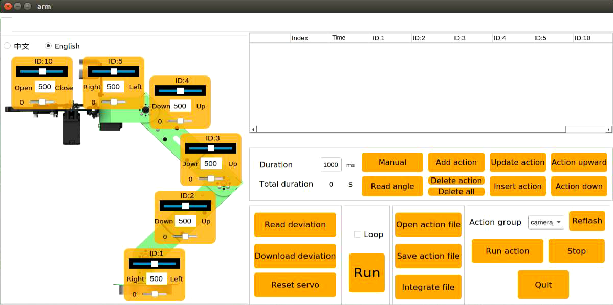

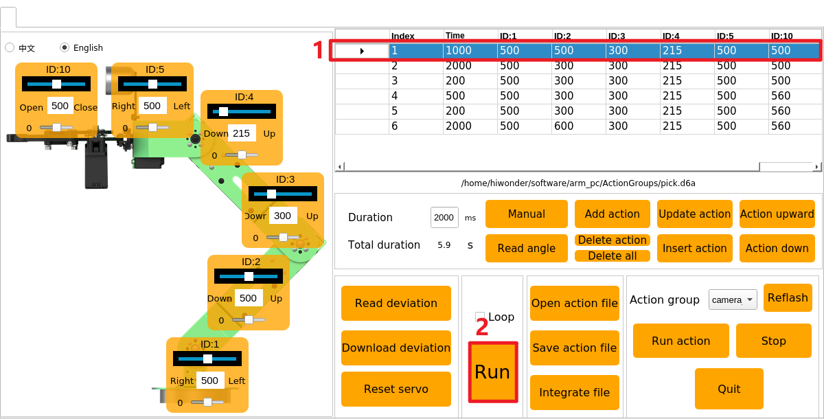

The interface under “normal mode” is as follow.

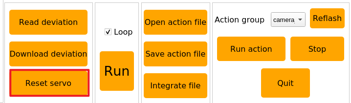

You can switch to “Servo Debug Tool” through the options on the upper left corner. Prior to the shipment, all the robots have been debugged, eliminating the need for the user to debug. If any issues require the use of this tool, it is mandatory to operate under the guidance of our support team, as improper use may result in robotic arm malfunctions.
The interface of the normal mode is divided into below areas:

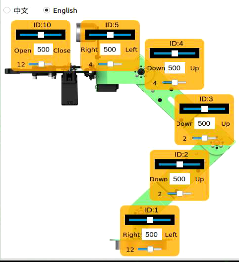

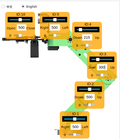

(1) Servo control area
Servo control area displays the icon of the selected servo. You can adjust the servo value by dragging the corresponding slider.
ID number of servo
Adjust servo position from 0 to 1000.
Adjust servo deviation from -125 to 125.

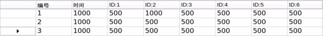

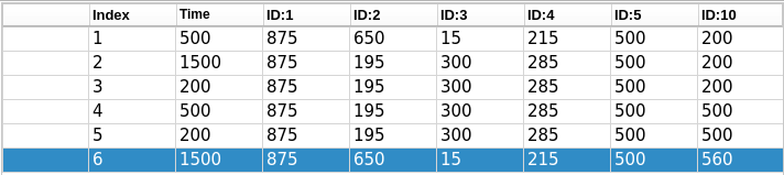

(2) Action list
The running time and servo data of the current action are displayed on the action list.
Action group number
Running time of the action that is time taken to complete this action
Servo value. Double click the figure below to revise.
(3) Action group setting
Action running duration time. Directly click to modify.
Total running time taking for all the actions in an action group
If you click this button, joints of robot become loose, and you can drag servos to design any posture
Read the servo angle you have designed before. This button should be used with
Add the servo value as a action to the last line of the action list
Delete action: delete the action selected in the action list; Delete all: delete all the action in action list
Replace the angle value of the action selected in the action list with the servo value in the servo control area. And update the running time as the time set in "Time"
Insert a new action above the selected action. The running time of this new action is the time set in "Time" and angle value is the current value in servo control area.
Move the selected action up one line
Move the selected action down one line
Click to run all the actions on the action list once (If "Loop" is ticked, JetAuto Pro will repeat the action.)
Load the data of the saved action group to the action list
Save the current actions in the action list into the designated path.
Firstly, open one action group, then click this button, and then open other action group. And these two action groups will be integrated into one.
Display the saved action groups. You can select the action to run.
Refresh action group drop-down menu.
Run the selected action group once.
Stop running the action group.
Exit PC software interface
(4) Servo deviation setting area
Click to read the saved servo deviation.
Click to download the adjusted deviation to the robot.
Click to return all the servos to the mid point(500).

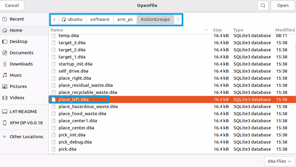

Action calling is to directly call the edited action group via PC software to let robot perform this action.

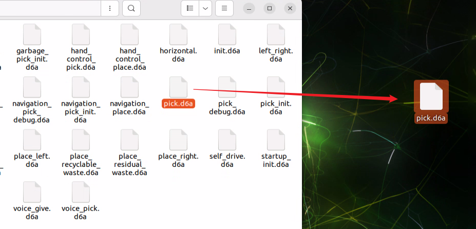

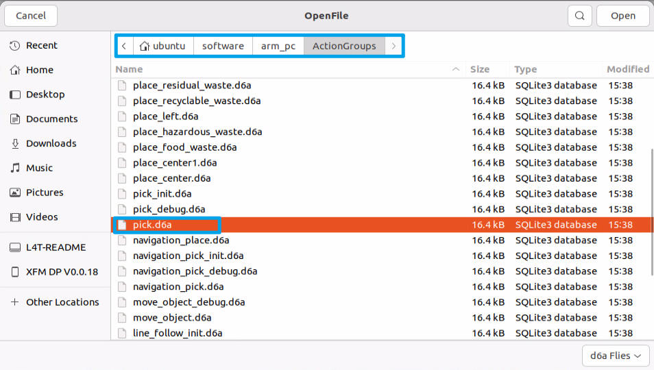

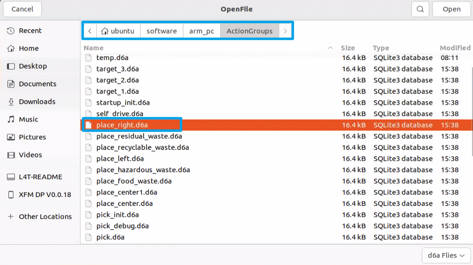

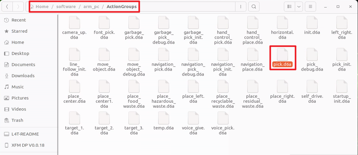

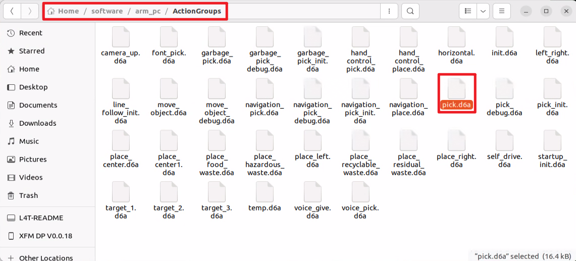

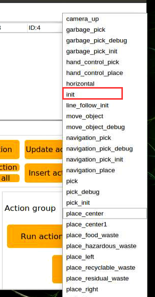

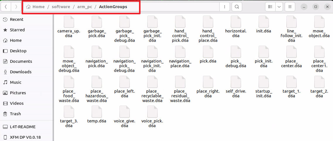

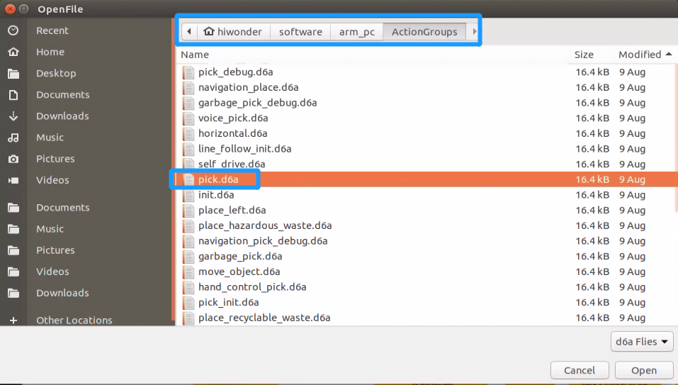

JetRover has built-in action groups, and its action group files are stored in /ubuntu/software/arm_pc/ActionGroups. You can check and call built-in actions via PC software or command.
The specific operation steps are as follow:
Only if action files are saved in /ubuntu/software/arm_pc/ActionGroups, can the files be called
(1) Double click to enter PC software interface.

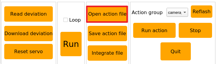

(2) Click “Open action file” button.
(3) Select action group you want, then click “Open”.

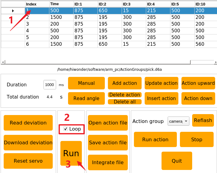

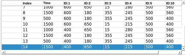

(4) Running time of each action and servo values are displayed on the action list
(5) You can first select number “1” and click “Run” button to run the selected action in action list. If you want to make robot repeat this action group, you can tick “Loop” and click “Run”.

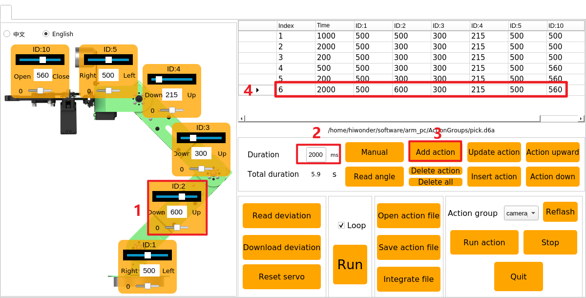

  • Design Action

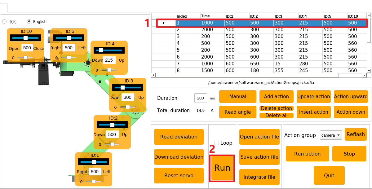

(1) Put down antenna before operation to avoid robot arm of hitting antenna when it is moving.
(2) Double click to enter PC software interface.
(3) Click “Reset servo” to make servo return back to mid-point.

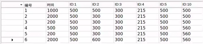

(4) Drag the slider to set servo values as pictured to make robot arm bend to left.

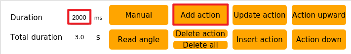

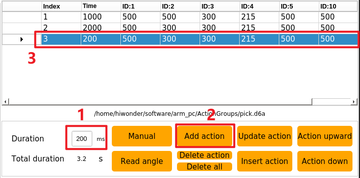

(5) Click “Add Action” to add current action to action list.

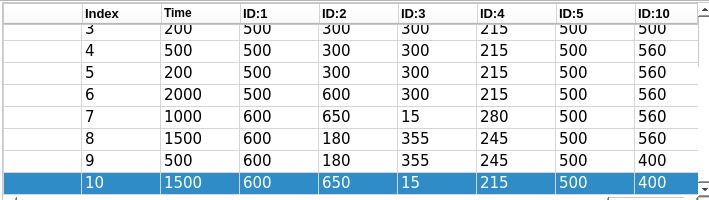

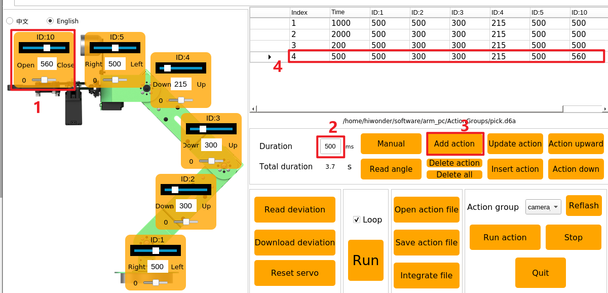

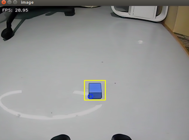

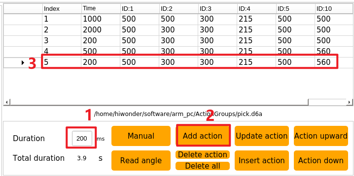

(6) Align robot arm with the block. Adjust value of corresponding servos as follow.
(7) Set the time as “2000ms”. Click “Add Action” to update NO.2 action.
(8) Add another transitional action. Set the time as 200ms and click “Add Action”.

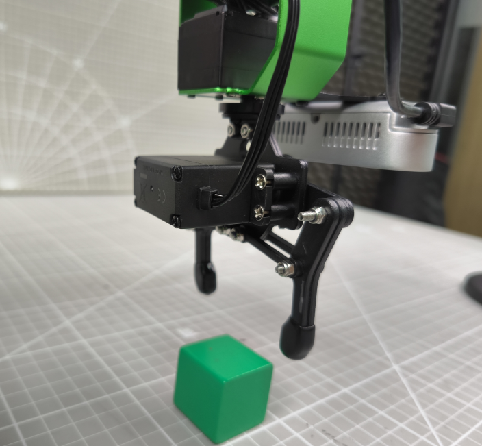

(9) Adjust NO.10 servo to let robot arm pick the block. Set times as 500ms, then click “Add Action”
(10) Add a transitional action again. Set the time as “200ms”, and click “Add action” to form NO.5 action.
(11) Adjust servo value to make robot arm pick the block to specific height. Set the time as 2000 ms, and click “Add action”
(12) After NO.6 action is edited, action group of “picking block at left” is complete.
(13) Next, let robot arm run the whole action group. Select NO.1 action, then click “Run”. If you want to repeat this action, tick “Loop” box.

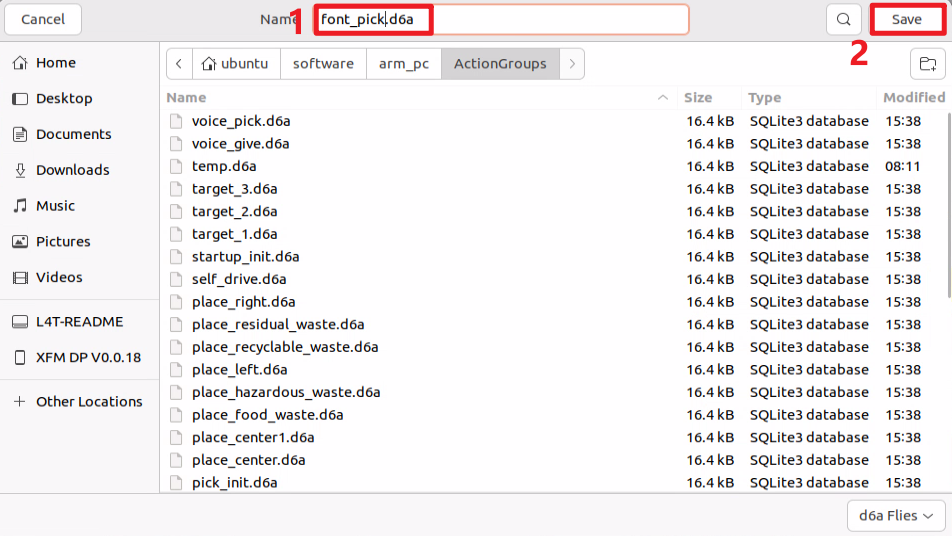

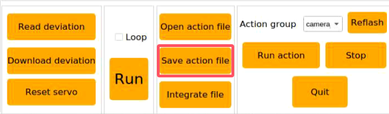

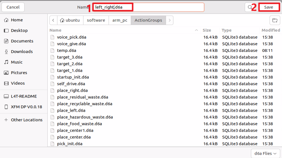

  • Save Action
The name of action group cannot contain “Space”, otherwise the file cannot be saved in later debugging.
In case of future debugging and management, save the edited action group. Click “Save action file” and select this path, /ubuntu/software/arm_pc/ActionGroups.
Here takes the name of “font_pick” as example, and then click “Save” to save the action group.

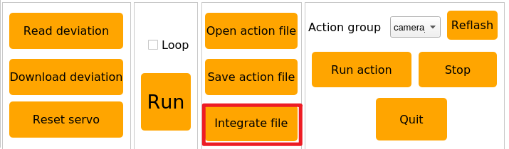

7.1.6 Integrate Action Files
  • Introduction
Integrating action files is to integrate two action groups to form a new action group.
(3) Click “Integrate files” button, and select the following path.
(4) Select and open “place_left.d6a” on the pop-up window.
(5) This action group is added to the action list.
(6) Click “Integrate action files” button again. Select and open “place_right.d6a”. After that, this action group is added to the end of the first action group.
(7) Click NO.1 action, then click “Run” to let robot arm perform this integrated action.
(8) Click “Save action files” button to save this new action group in case of future debugging.
(9) Name this new action group, for example “left_right”.
Action group name cannot contain “Space”.

  • Export Action
This section illustrates the export and import of the “pick.d6a” action group file as an example.

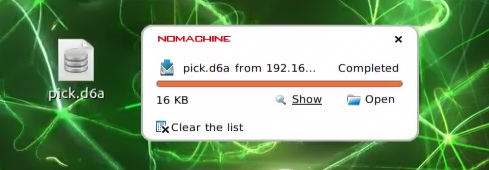

(1) Click
(2) Find “pick.d6a” file.
(3) Directly drag the action file to the computer desktop to export this file.
  • Import Action
(2) Directly drag “pick.d6a” action file to robot system desktop.
(3) Then directly drag or copy “pick.d6a” file to following path.
(4) Double click to enter PC software interface.
(5) Click “Open action files” button. Find the file you just import, and open it.
Or directly select the imported action group in this drop-down menu.
(6) Click “Run” button to let robot arm execute this action group.

  • Introduction to Robot Arm
This car features a 6-degree-of-freedom robotic arm, constructed with intelligent bus servos and metal sheet components, allowing it to move to any position within its operational space. It has six degrees of freedom: X movement, Y movement, Z movement, X rotation, Y rotation, and Z rotation, enabling it to perform actions such as extension, rotation, and lifting. Additionally, it is equipped with a depth camera (Dabai DCW) that can be used in conjunction with the robotic arm for various functions, including hand-following color block recognition and sorting, color block tracking, line-following obstacle clearance, waste sorting, and fixed-point navigation and transport.
JetRover is a 6-degree-of-freedom robotic arm, composed of intelligent bus servos and metal sheet components.
The JetRover’s 6-degree-of-freedom robotic arm consists of six intelligent bus servos: HTD-35H3 (body), HTS-20H1 (pan-tilt), HTS-21H*1 (claw), and HTD-35H bus servo (wrist).
The bus servos use serial communication to connect multiple servos through a single bus control system. This allows multiple servos to be connected through a single I/O port, providing higher precision compared to digital servos, albeit at a slightly higher cost.
The interface distribution and description are exemplified by one of the HTD-35H servos, as shown below:
PIN Description
GND Power Ground
VIN Power Input
SIG Signal End (Half-Duplex UART Asynchronous Serial Interface)

Before adjusting the servo deviations, it is essential to identify and understand the corresponding ID numbers for each servo on the robotic arm. These IDs will be used during the adjustment process.
The IDs are as follows:
ID 1: Pan-tilt Servo
IDs 2, 3, 4: Robotic Arm Joint Servos
ID 5: Wrist Servo
ID 10: Claw Servo
In total, six servos are controlled on the robotic arm. These servos may develop deviations over time, requiring adjustment to the mid-position standard of the robotic arm.
When adjusting servo deviations, refer to the standard servo deviation adjustment diagram. The robotic arm can be considered deviation-free only if it meets both of the following standards:
Standard 1: The servos with IDs 1, 2, 3, 4, and 5 must be horizontally and vertically aligned with the base of the car in the mid-position state. As shown in the diagram, the central screws on the servo discs should form a line that vertically passes through these servos.
Standard 2: The claw on the robotic arm must maintain an opening distance of 2-3 cm (this represents the mid-position standard for the claw servo). This can be measured using two fingers (index and middle), which should fit snugly within the gap.

(3) Double-click the “arm” icon on the desktop to enter the interface of the robotic arm’s PC software, as shown in the following image:
For details about the interface and related content of the “arm” software, please refer to the Basic Control document. This document focuses specifically on adjusting servo deviations.
(4) Clicking the “Reset Servo” button, it was found that Servo 3 of the robotic arm has a deviation.
(5) Click the “Read Deviation” button to obtain the current deviation values for the servos installed on the robotic arm.
(6) After the “Read Deviation Successful” popup appears, click the “OK” button.
(7) Check the deviation value for Servo ID: 3, as shown in the diagram below. In this diagram, each servo is identified by its respective ID number. The slider above indicates the current position, the middle number displays its position value, and the bottom slider represents the set deviation value for the servo.
(8) You can see that the deviation value for Servo ID: 3 is -18. When Servo 3 has such a deviation, adjustment should be made in the opposite direction until it reaches the “Standard (1)” state specified in the “Adjustment Standard”.
Now you can see that the deviation value for Servo ID: 3 has been adjusted to “2”, bringing the robotic arm’s status to the “Standard (1)” state as specified in the “Adjustment Standard”. This completes the setting for adjusting the deviation of Servo 3. Next, you need to save the current value to the local computer of the robot. After the robot is restarted, it will use these saved values for servo control. The procedure for reading other servo IDs is the same.
(9) Click-on ‘Download Deviation’ button.
(10) Wait for the prompt “Download Deviation Successful” to appear, then click “OK” to exit the window.
This completes the adjustment of Servo 3’s deviation.
(11) When we need the robotic arm to return to its initial state, we can select “camera” within the action group range.
(12) Choose ‘init’.
(13) Click “Execute Action” to have the robotic arm perform the “init” action group.
After clicking, the robot’s status is as shown in the following image:

(1) When adjusting the position of the gripper, I found that no matter how much I adjusted it beyond a certain point, the gripper on the robotic arm did not respond?
Our company has implemented mechanical limits on the gripper of the robotic arm, specifically Servo 10 corresponding to the mechanical gripper. When the position set through the PC software exceeds 700, it reaches the mechanical limit of the gripper, preventing it from further tightening. Exceeding this limit may risk damaging the servo. In such cases, simply adjust in the opposite direction.
It is recommended to adjust Servo 10 within the range of [200, 700] during this adjustment.

After the game starts, the robotic arm turns left to prepare itself for the sorting. Place the target block within the yellow box in the middle of the transmitted image. Once the block is recognized, the robotic am will transport them to their corresponding areas.
The red color block will be transported to the position directly in front and center of the robot; the green color block will be transported to the position in front of the robot, towards its left side; the blue color block will be transported to the position in front of the robot, towards its right side.

7.2.3 Color Tracking
The first-person view is the perspective of the robot itself. In this game, robot will take the first-person view to complete the color tracking task.
Before starting the game, prepare yourself the required colored blocks.
First of all, subscribe to the topic messages published by color recognition node to obtain the color information.
Subsequently, after matching the target color, obtain the center of the target image.
Finally, by using inverse kinematics, calculate the required angle to align the center position of the screen with the center of the target image. Publish the corresponding topic message, control the servo motion and make the robotic arm follow the movement of the target.
The source code of the program is stored in: /home/ubuntu/ros2_ws/src/example/example/color_track/color_track_node.py
The input command should be case sensitive, and the “Tab” key can be used to complement the key words.
(1) Start JetRover and connect it to NoMachine.
(2) Double click on to start the command line terminal.
(3) Input the command and press Enter to disable the app service.
(4) Input the command to start the game.
ros2 launch example color_track_node.launch.py
(5) To close this feature, press ‘Ctrl+C’ in the terminal window. If this doesn’t work, open a new command-line terminal and use the appropriate command to stop all running ROS processes.
  • Outcome
After the game starts, place the red block in front of the camera. The recognized color will be displayed in the image and the robotic arm will follow the movement of the target block.

The program defaults to recognize red. However, you can change the recognition color to green or blue through modifying the codes in corresponding program. In this section, the default recognition color is changed to green as example. The specific operation steps area as follow:
(3) Input the command and press Enter to access the program directory.
cd /home/ubuntu/ros2_ws/src/example/example/color_track/
(4) Input the command below to open the program file.
vim color_track_node.py
(5) Press “i” key to enter edit mode and modify the assignment of the request.data parameter to “green”.
(6) After the modification is completed, hit ‘ESC’ key and input ‘:wq’ to exit and save the program.

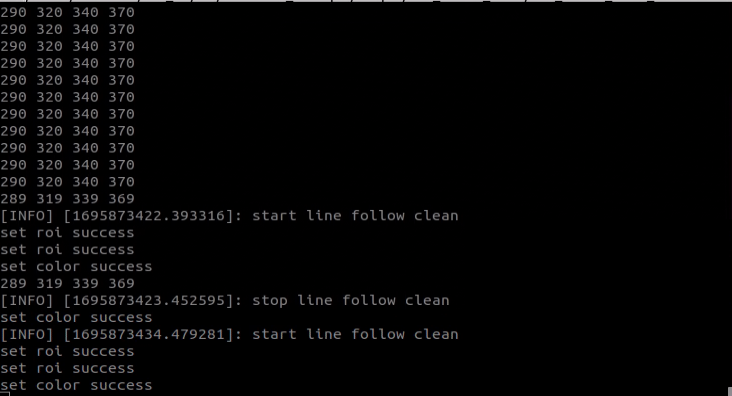

        self.get_logger().info('\033[1;32m%s\033[0m' % "start line follow clean")
        line_roi = LineROI()

Upon invocation, reads ROI parameters, sets the desired color for picking, publishes color information to the color recognition node, and starts the sorting process.
  • stop_srv_callback:
    def stop_srv_callback(self, request, response):
        self.get_logger().info('\033[1;32m%s\033[0m' % "stop line follow clean")
        res = self.send_request(self.set_color_client, SetColorDetectParam.Request())
        if res.success:
            self.get_logger().info('set color success')
            self.get_logger().info('set color fail')
        response.message = "stop"
Upon invocation, stops the current program and publishes empty information to the color recognition node to halt recognition.

  • Gripping Adjustment
In the program, the recognition and gripping area are located in the middle of the image by default, no need for adjustment. However, due to the discrepancy in camera parameters, there might be cases where the robot arm cannot grip the color black. In such situations, you can adjust the position of this area using commands. Here are the specific steps:
(2) Double click on to open the command line terminal.
(3) Input the command and hit Enter key to initiate testing program.
ros2 launch example line_follow_clean_node.launch.py debug:=true
(4) This mode will disable the line-following function while keeping the color block gripping function active. Place the color block in the center of the gripper when the robotic arm reaches the gripping position. Wait for the arm to reset and mark the recognition box’s position. Then, wait for the arm to execute the gripping action. After calibration, the terminal will display the pixel coordinates of the color block in the image along with a completion message.
(5) Finally, run the program according to “Operation Steps”.

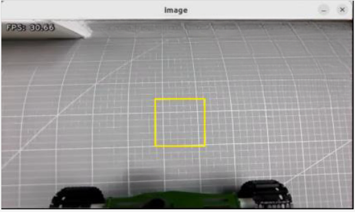

(5) Before the robotic arm begins the identification and grasping process, it first undergoes a calibration phase. During this phase, the arm performs a downward grasping motion with the gripper open. At this point, the piece of waste wood should be positioned in the center of the gripper.
(6) The robotic arm will then lift upward and enter the identification mode. On the remote interface, the software will display a red box that highlights the area currently being calibrated and identified.
The program uses colored boxes to identify different objects and cards. Each object’s name is accompanied by a number less than 1 that indicates the recognition accuracy. For instance, a number like 0.96 next to “BananaPeel” reflects the accuracy of the recognition, with the range being from 0 to 1. A higher number signifies greater accuracy in identifying the object as a BananaPeel. Recognition accuracy typically improves in well-lit conditions.
(7) Once calibration is complete, the red box in the image will turn yellow to indicate the recognition area. Only waste cards or wood blocks placed within this yellow area will be identified and grasped.

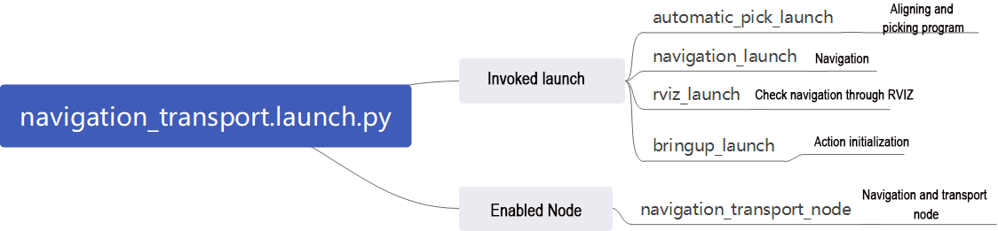

(1) Launch analysis
The source code of this program is located in ros2_ws/src/example/example/navigation_transport/navigation_transport.launch.py
① Start other Launch files
    automatic_pick_launch = IncludeLaunchDescription(
        PythonLaunchDescriptionSource(os.path.join(example_package_path, 'example/navigation_transport/automatic_pick.launch.py')),
            'broadcast': broadcast,
            'debug': debug,
            'place_without_color': place_without_color,
            'place_position': place_position,
            'master_name': master_name,
            'robot_name': robot_name,
            'enable_display': 'false',
        }.items(),
            'use_sim_time': 'false',
            'namespace': robot_name,
            'use_namespace': 'false',
            'autostart': 'true',
        }.items(),
    navigation_transport_node = Node(
        package='example',
        executable='navigation_transport',
    rviz_node = ExecuteProcess(
            cmd=['rviz2', 'rviz2', '-d', os.path.join(navigation_package_path, 'rviz/navigation_transport.rviz')],
            output='screen'
    bringup_launch = GroupAction(
     actions=[
         PushRosNamespace(robot_name),
         automatic_pick_launch,
         TimerAction(
             period=10.0,  # 延时等待其它节点启动好(wait for other nodes to start up with a delay)
             actions=[navigation_launch],
automatic_pick_launch: Automatically picks up items based on color alignment.
navigation_launch: Launches navigation.
rviz_launch: Uses RVIZ to visualize navigation effects.
bringup_launch: Initializes actions.
② Start the Node
        package='example',
navigation_transport_node: Starts the navigation transport node.

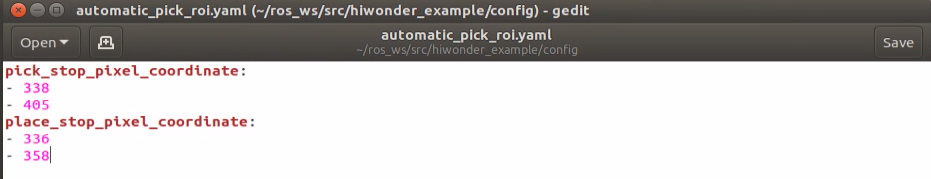

  • Gripping Calibration
The default recognition and gripping area of the program is located in the center of the image. No adjustments are required for the normal circumstance. If the robotic arm fails to grip the colored blocks during the game, you can adjust the position of this area through the program command. The specific steps are as follow:
(1) Start JetRove and connect it to Nomachine remote control software.
(2) Click on to open the command line terminal.
(3) Input the command to disable the app auto-start service:
(4) Execute the following command to initiate gripping position calibration:
ros2 launch example automatic_pick.launch.py debug:=true
(5) Once the robotic arm reaches the grasping position, place the color block in the center of the gripper. Then, wait for the arm to return to its original position and perform another grasp to finish the calibration process. After calibration is complete, the terminal will show the pixel coordinates of the color block and display a confirmation message.
The data after automatic calibration will be saved in the /home/ros_ws/src/example/config/automatic_pick_rol.yaml file.
pick_stop_pixel_coordinate refers to the pixel coordinates of the gripping position in the image. The first parameter represents the x-axis coordinate. Decreasing this value shifts the horizontal position to the left, while increasing it shifts the gripping horizontal position to the right. The second parameter represents the y-axis coordinate. Decreasing this value moves the gripping position closer, while increasing it moves the gripping position farther away. Generally, you can rely on automatic calibration results, but you can also adjust it according to your personal preference.
place_stop_pixel_coordinate refers the pixel coordinates of the placement position in the image. The first parameter represents the x-axis coordinate. Increasing this value shifts the placement position to the left, while decreasing it shifts the placement position to the right. The second parameter represents the y-axis coordinate. Decreasing this value adjusts the placement position closer, while increasing it moves the gripping position farther away.
Automatic calibration solely calibrates the coordinates of the gripping position. The coordinates of the placement position are not automatically calibrated. If a placement target is set and the placement effect is not satisfactory, manual adjustment is required.
(6) Upon the completion of the modification, please start the game according to “Operation Steps”.

7.3.3 Object Tracking
  • Overview
Object Tracking involves implementing vision-based object tracking and robot motion control. It combines functionalities such as image processing, point cloud processing, PID control, robot motion control, visualization, and interaction. It can be used to guide the robot to automatically track and approach specific objects.
The entered command should be case sensitive, and the “Tab” key can used to complemented the key words.
(1) Start JetRover and connect it to Nomachine remote control system.
ros2 launch example track_object.launch.py
The Ackermann chassis doesn’t support this function.
(5) If you want to exit this game, press “Ctrl+C” in the terminal. Fail to do so requires multiple tries.
  • Outcome
After initiating the game, the camera will track the object and control the robot to move accordingly.
(1) launch Analysis
Program path: ~/ros2_ws/src/example/example/rgbd_function/track_object.launch.py
① Initiate Other Launch Files
depth_camera_launch is used to start the camera.
controller_launch is used to start chassis, servo, and other controls.
② Start the Node
    track_object_node = Node(
        package='example',
        executable='track_object',
track_object_node is used to launch the object tracking node.
(2) Python Program Analysis
This section analyzes the programming of anti-fall game. The program source code is located at: ~/ros2_ws/src/example/example/rgbd_function/track_object_node.py
① Function: Main
    node = TrackObjectNode('track_object')
Initiate object tracking node.
② Class: CrossBridgeNode
  • Init:
        self.pid_x = pid.PID(1.5, 0, 0)
        self.pid_y = pid.PID(1.5, 0, 0)
        self.pid_z = pid.PID(3, 0, 0)
        self.x_speed, self.y_speed, self.z_speed = 0.007, 0.007, 0.04
        self.stop_distance = 0.4
        self.x_stop = -0.1
        self.scale = 4
        self.proc_size = [int(640/self.scale), int(480/self.scale)]
        self.linear_x, self.linear_y, self.angular = 0, 0, 0
        self.haved_add = False
        self.get_point = False
        self.display = 1
        self.pc_queue = queue.Queue(maxsize=1)

7.3.4 Tracking and Gripping
  • Overview
Combining depth vision and robot control techniques, this system identifies and tracks objects of specific colors, completing precise grasping actions. It utilizes a depth camera to capture images and depth information, employs color tracking algorithms to locate the target object, and uses a robotic arm for object operations. Features include using the OpenCV library to identify objects of specific colors in images, computing the exact position of objects in three-dimensional space using depth information, adjusting the movement of the robotic arm using PID controllers to precisely track and approach the target object. This system can be applied in automated production lines to achieve precise object picking and placing tasks, such as in service robots and automation.
(4) Execute the following command to initiate tracking and gripping program.
ros2 launch example track_and_grab.launch.py
  • Outcome
After initiating the game, the robot will identify objects such as cylinders, cubes, spheres, etc., in the scene, then the robotic arm will track there items and perform gripping action once they are recognized.

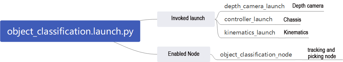

(1) launch Analysis
Program path: ~/ros2_ws/src/example/example/rgbd_function/track_and_grab.launch.py
① Initiate other Launch files
    kinematics_launch = IncludeLaunchDescription(
            os.path.join(kinematics_package_path, 'launch/kinematics_node.launch.py')),
controller_launch is used to start the chassis, servos, and other controls.
kinematics_launch starts the kinematics node, which computes the servo angles required for three-dimensional coordinates.
② Start the Node
    track_and_grab_node = Node(
        package='example',
        executable='track_and_grab',
        parameters=[{'color': color}, {'start': start}]
track_and_grab_node is used to launch the tracking and grasping node.

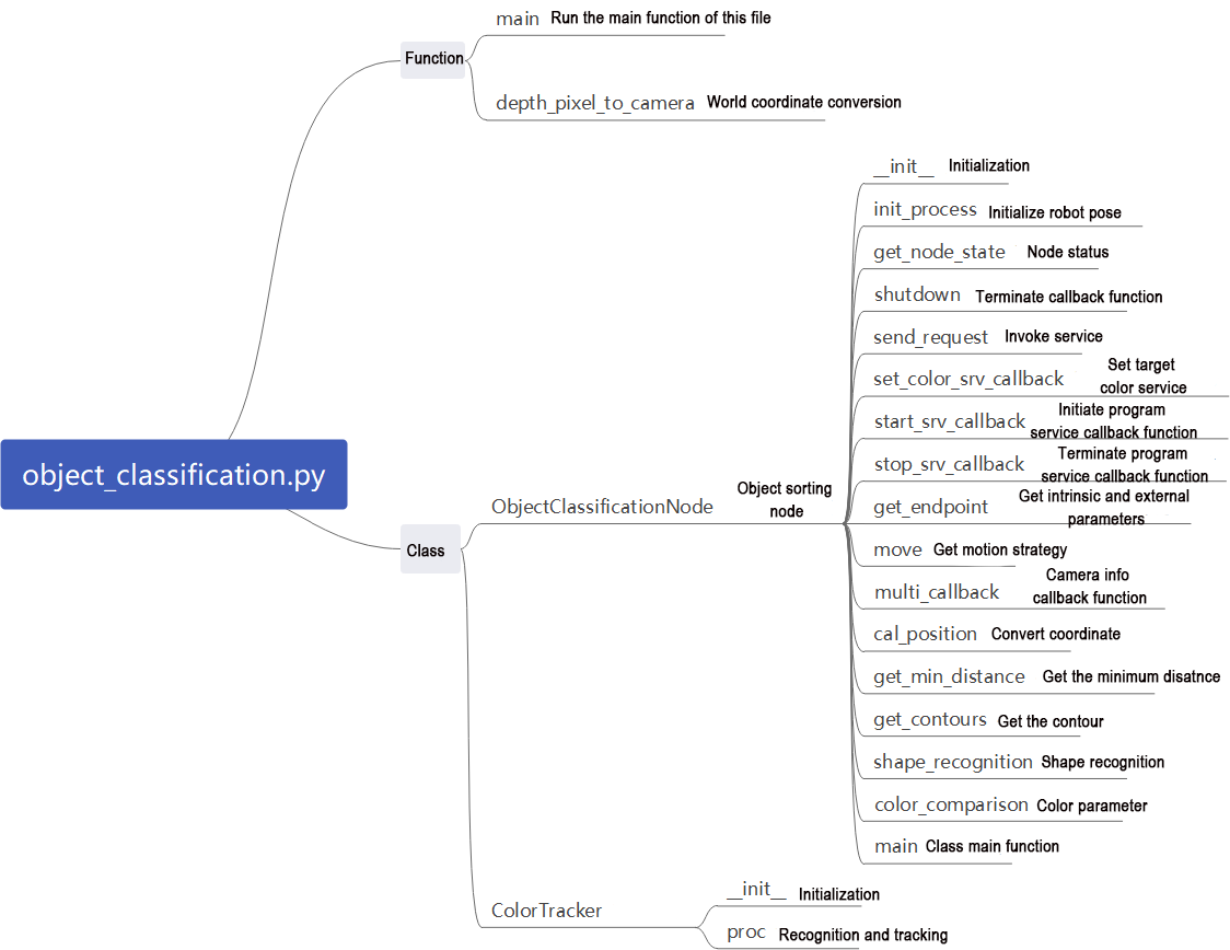

  • Main:
369
370
371
372
373
374
    node = TrackAndGrabNode('track_and_grab')
Starts the tracking and grasping node.

Recognize colors based on the specified tracking color, and process the recognized images.
  • TrackAndGrabNode:

                ros_rgb_image, ros_depth_image, depth_camera_info = self.image_queue.get(block=True, timeout=1)
                rgb_image = np.ndarray(shape=(ros_rgb_image.height, ros_rgb_image.width, 3), dtype=np.uint8, buffer=ros_rgb_image.data)
                depth_image = np.ndarray(shape=(ros_depth_image.height, ros_depth_image.width), dtype=np.uint16, buffer=ros_depth_image.data)
                h, w = depth_image.shape[:2]
                depth = np.copy(depth_image).reshape((-1, ))
                depth[depth<=0] = 55555
                sim_depth_image = np.clip(depth_image, 0, 2000).astype(np.float64)
                sim_depth_image = sim_depth_image / 2000.0 * 255.0
                bgr_image = cv2.cvtColor(rgb_image, cv2.COLOR_RGB2BGR)
                depth_color_map = cv2.applyColorMap(sim_depth_image.astype(np.uint8), cv2.COLORMAP_JET)
                if self.tracker is not None and self.moving == False and time.time() > self.start_stamp and self.start:
                    result_image, p_y, center, r = self.tracker.proc(rgb_image, result_image, self.lab_data)
                    if p_y is not None:
                        set_servo_position(self.joints_pub, 0.02, ((1, int(p_y[1])), (4, int(p_y[0]))))
                        center_x, center_y = center
                        if center_x > w:
                            center_x = w
                        if center_y > h:
                            center_y = h
                        if abs(self.last_pitch_yaw[0] - p_y[0]) < 3 and abs(self.last_pitch_yaw[1] - p_y[1]) < 3:
                            if time.time() - self.stamp > 2:
                                self.stamp = time.time()
                                roi = [int(center_y) - 5, int(center_y) + 5, int(center_x) - 5, int(center_x) + 5]
                                if roi[0] < 0:
                                    roi[0] = 0
                                if roi[1] > h:
                                    roi[1] = h
                                if roi[2] < 0:
                                    roi[2] = 0
                                if roi[3] > w:
                                    roi[3] = w
                                roi_distance = depth_image[roi[0]:roi[1], roi[2]:roi[3]]
                                    dist = round(float(np.mean(roi_distance[np.logical_and(roi_distance>0, roi_distance<10000)])/1000.0), 3)
                                except BaseException as e:
                                    self.get_logger().info('error2: ' + str(e))
                                    txt = "DISTANCE ERROR !!!"
                                    return
                                if np.isnan(dist):
                                    return
                                dist += 0.015 # Object radius compensation(物体半径补偿)
                                dist += 0.015 # Error compensation(误差补偿)
                                K = depth_camera_info.k
                                self.get_endpoint()
                                position = depth_pixel_to_camera((center_x, center_y), dist, (K[0], K[4], K[2], K[5]))
                                position[0] -= 0.01  # The RGB camera and depth camera TFs have a 1cm offset(rgb相机和深度相机tf有1cm偏移)
                                pose_end = np.matmul(self.hand2cam_tf_matrix, common.xyz_euler_to_mat(position, (0, 0, 0)))  # The relative coordinates at the end of the transformation(转换的末端相对坐标)
                                world_pose = np.matmul(self.endpoint, pose_end)  # Transform into the world coordinates of the robotic arm(转换到机械臂世界坐标)
                                pose_t, pose_R = common.mat_to_xyz_euler(world_pose)
                                self.moving = True
                                threading.Thread(target=self.pick, args=(pose_t,)).start()
                        dist = depth_image[int(center_y),int(center_x)]
                        if dist < 100:
                            txt = "TOO CLOSE !!!"
                            txt = "Dist: {}mm".format(dist)
                        cv2.circle(result_image, (int(center_x), int(center_y)), 5, (255, 255, 255), -1)
                        cv2.circle(depth_color_map, (int(center_x), int(center_y)), 5, (255, 255, 255), -1)
                        cv2.putText(depth_color_map, txt, (10, 400 - 20), cv2.FONT_HERSHEY_PLAIN, 2.0, (0, 0, 0), 10, cv2.LINE_AA)
                        cv2.putText(depth_color_map, txt, (10, 400 - 20), cv2.FONT_HERSHEY_PLAIN, 2.0, (255, 255, 255), 2, cv2.LINE_AA)
                        self.last_pitch_yaw = p_y
                if self.enable_disp:
                    result_image = np.concatenate([cv2.cvtColor(result_image, cv2.COLOR_RGB2BGR), depth_color_map, ], axis=1)
                    cv2.imshow("depth", result_image)
                    if key == ord('q') or key == 27:  # Press q or esc to exit(按q或者esc退出)
                self.get_logger().info('error1: ' + str(e))
This is the main function of the tracking and grasping class. It utilizes camera data for simple localization based on color, then adds depth information to convert to world coordinates. Based on the current state of the robotic arm, it can then begin tracking and grasping.
This section will analyze the programming of the anti-fall game. The program source code is located at: ~/ros2_ws/src/example/example/rgbd_function/object_classification.py
① Function: Main
511
512
513
514
515
516
    node = ObjectClassificationNode('object_classification')
Starts the object classification and grasping node.
  • depth_pixel_to_camera:
def depth_pixel_to_camera(pixel_coords, intrinsic_matrix):
    fx, fy, cx, cy = intrinsic_matrix[0], intrinsic_matrix[4], intrinsic_matrix[2], intrinsic_matrix[5]
    px, py, pz = pixel_coords
    x = (px - cx) * pz / fx
    y = (py - cy) * pz / fy
    z = pz
    return np.array([x, y, z])
Converts pixel coordinates to world coordinates.
② Classes: ObjectClassificationNode
