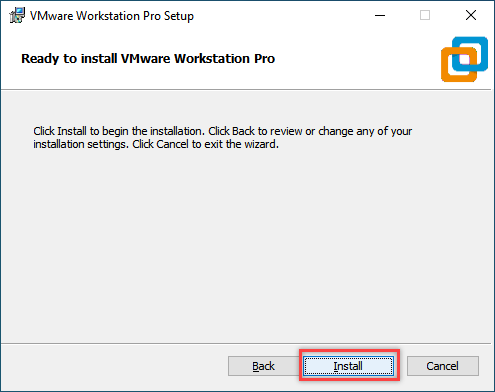

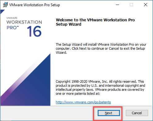

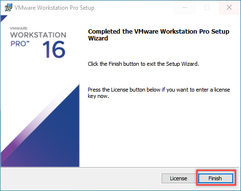

  • VMware Installation
A virtual machine allows us to run other operating systems within our current operating system. In this section, we will demonstrate the installation process using VMware Workstation as an example:
(1) Unzip the virtual machine software package located under the “Configuration File -> VMware” path.
(2) After unzipping, locate the virtual machine folder and double-click the executable file (with the “.exe” extension).

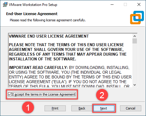

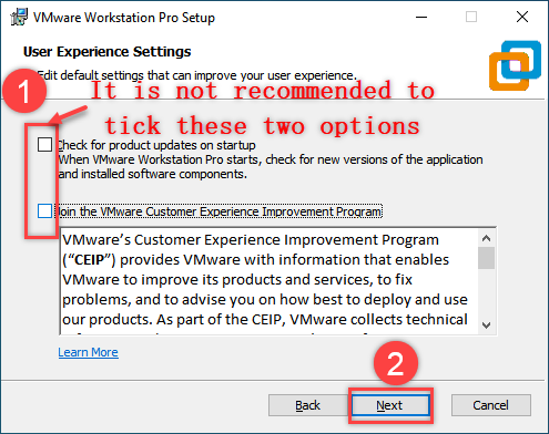

(3) Follow the on-screen instructions to complete the installation of the virtual machine.
(4) VMware Workstation offers 30-day free trial. After 30-day trial, you can purchase a license key to activate this software. If you need free resource, please contact us via email.

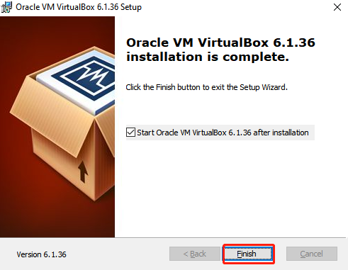

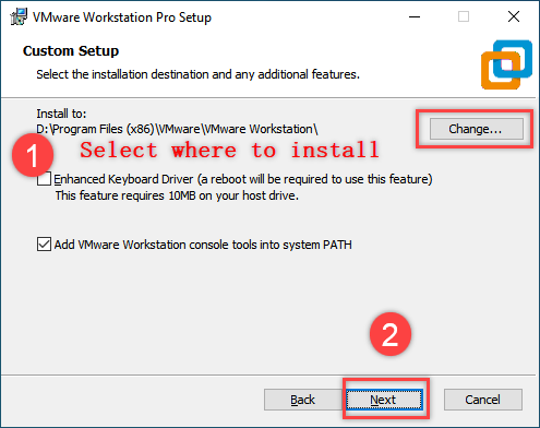

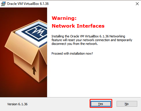

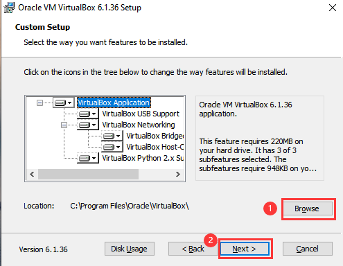

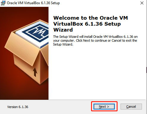

  • VirtualBox Installation
(1) Open the software installation package in the same directory and click “Next”.
(2) Modify the installation path if needed, then click “Next”.
(3) No changes needed, just click “Next”.
(4) Confirm the installation and click “Start Installation”.
(5) Once the installation is complete, click “Finish”.

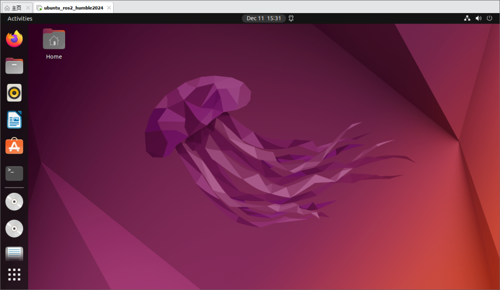

The virtual machine interface is as below:

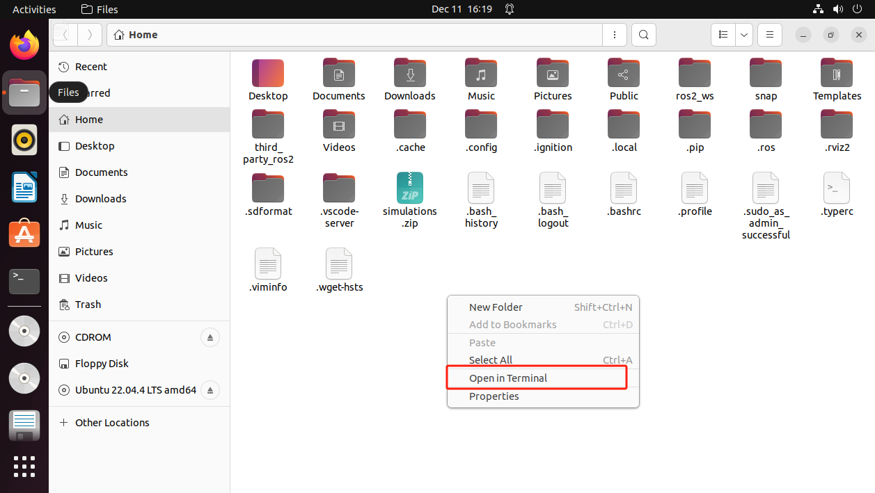

(4) Right-click in the Home directory and select “Open in terminal” to open the terminal.

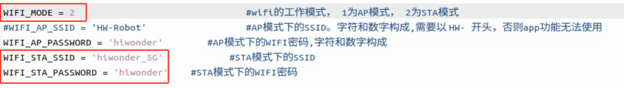

(2) Enter the following command to configure the WiFi file:
cd ~/wifi_manager && gedit wifi_conf.py
(3) Modify the configuration to LAN mode and enter the WiFi name and password
(4) Press Ctrl+S to save and close the file.

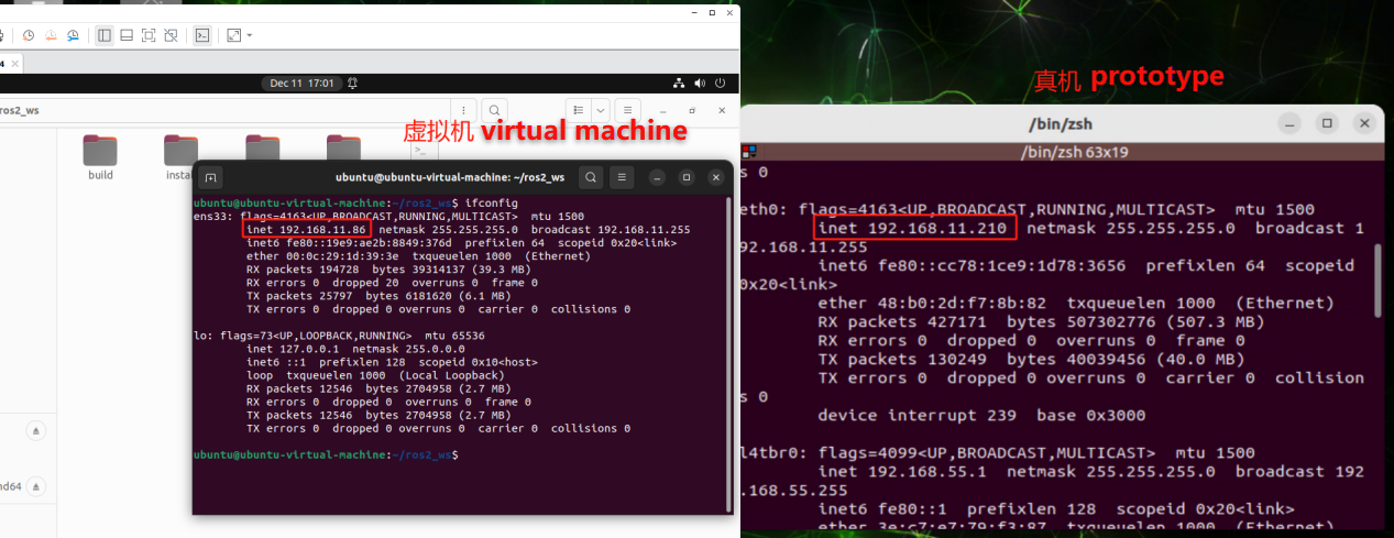

(5) For subsequent connections, ensure that the device and virtual machine are on the same network segment. You can check this by running the following command in the terminal:
ifconfig
In this example, both the virtual machine and the robot are on the 192.168.11 network segment, allowing for normal communication.

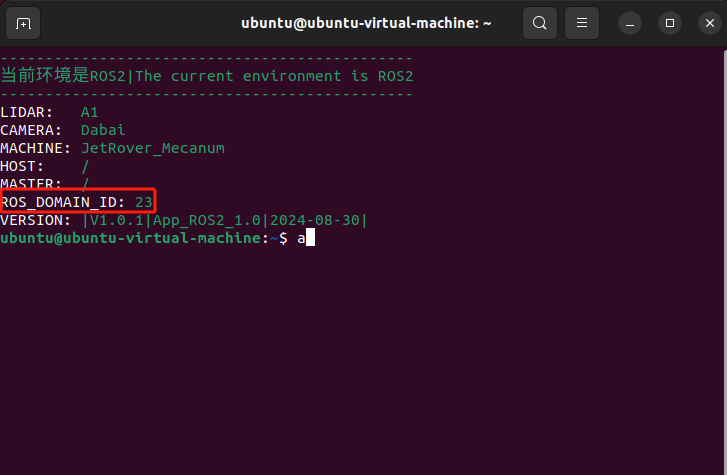

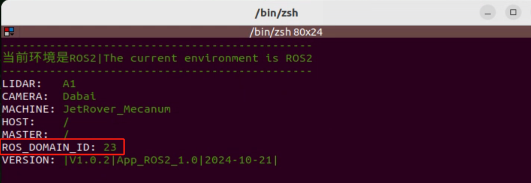

(1) Start the robot and open a terminal from the desktop.
(2) The terminal will display the device’s DOMAIN_ID, as shown below:

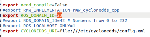

For example, if the DOMAIN_ID is 23, we will configure the virtual machine accordingly.

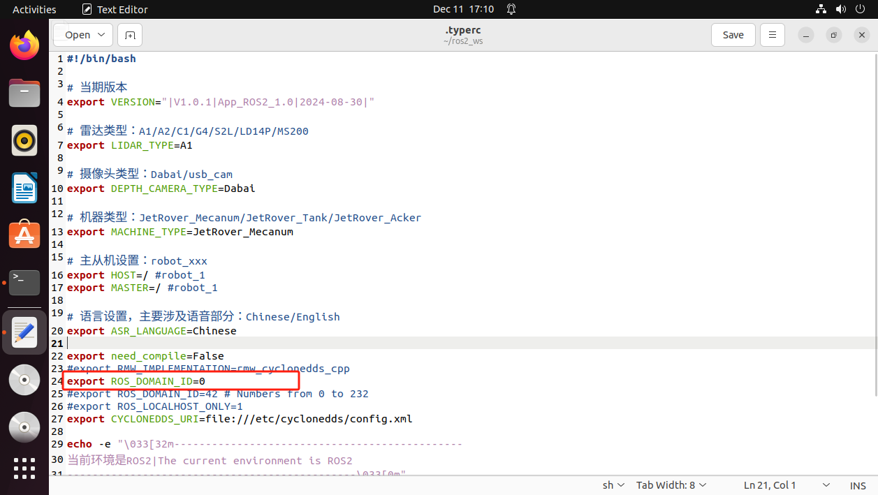

(3) Start the virtual machine and open a terminal from the desktop.
(4) Enter the following command to open the configuration file:
gedit ~/ros2_ws/.typerc
(5) Modify the ID in the configuration file to match the robot’s DOMAIN_ID (e.g., 23):
(6) Press Ctrl+S to save the changes and close the file.
(7) Close the current terminal, then open a new terminal. You will observe that the ID has been successfully updated to 23.

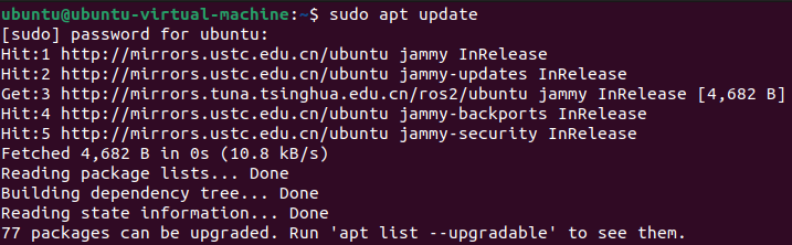

(1) Run the following command and press Enter to update the package information:
sudo apt update

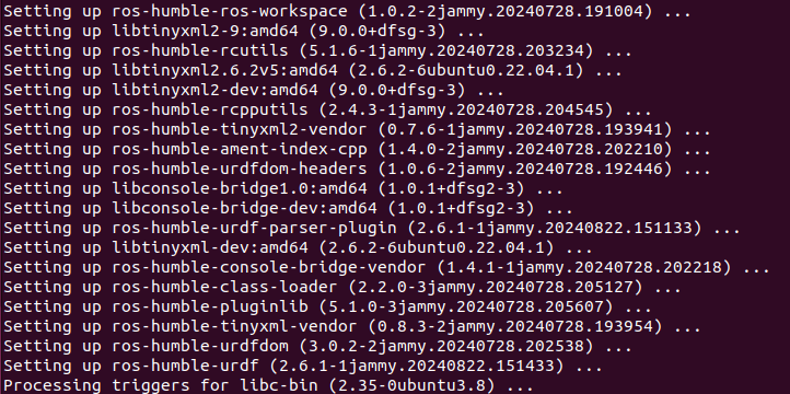

(2) Run the following command and press Enter to install the URDF dependencies:
sudo apt-get install ros-humble-urdf
When the output matches the image below, the installation is successful:

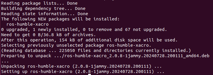

(3) Run the following command and press Enter to install the Xacro model extension for URDF:
sudo apt-get install ros-humble-xacro

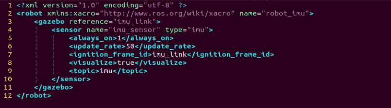

  • gazebo Tag

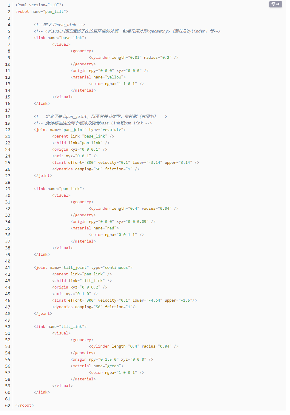

  • Write Simple URDF Model
(1) Name the model of the robot
To start writing the URDF model, we need to set the name of the robot following this format: <robot name="robot model name">. Lastly, input </robot> at the end to represent that the model is written successfully.
(2) Set links
① To write the first link and use indentation to indicate that it is part of the currently set model. Set the name of the link using the following format: <link name="link name">. Finally, conclude with </link> to indicate the successful completion of the link definition.
② Write the link description and use indentation to indicate that it is part of the currently set link, and conclude with </visual>.
③ The <geometry> tag is employed to define the shape of a link. Once the description is complete, include </geometry>. Within the <geometry> tag, indentation is used to specify the detailed description of the link’s shape. The following example demonstrates a link with a cylindrical shape: <cylinder length="0.01" radius="0.2"/>. In this instance, length="0.01" signifies a length of 0.01 meters for the link, while radius="0.2" denotes a radius of 0.2 meters, resulting in a cylindrical shape.
④ The <origin> tag is utilized to specify the position of a link, with indentation used to indicate the detailed description of the link’s position. The following example demonstrates the position of a link: <origin rpy="0 0 0" xyz="0 0 0" />. In this example, rpy represents the roll, pitch, and yaw angles of the link, while xyz represents the coordinates of the link’s position. This particular example indicates that the link is positioned at the origin of the coordinate system.
⑤ The <material> tag is used to define the visual appearance of a link, with indentation used to specify the detailed description of the link’s color. To start describing the color, include <material>, and end with </material> when the description is complete. The following example demonstrates setting a link color to yellow: <color rgba="1 1 0 1" />. In this example, rgba="1 1 0 1" represents the color threshold for achieving a yellow color.
Set joint
(1) To write the first joint, use indentation to indicate that the joint belongs to the current model being set. Then, specify the name and type of the joint as follows: <joint name="joint name" type="joint type">. Finally, include </joint> to indicate the completion of the joint definition.
To learn about the type of the joint, please refer to “Joint” section.
(2) Write the description section for the connection between the link and the joint. Use indentation to indicate that it is part of the currently defined joint. The parent parameter and child parameter should be set using the following format: <parent link="parent link"/>, and <child link="child link" />. With the parent link serving as the pivot, the joint rotates the child link.
(3) <origin> describes the position of the joint using indention. This example describes the position of the joint: <origin xyz="0 0 0.1" />. xyz is the coordinate of the joint.
(4) <axis> describes the position of the joint adopting indention. <axis xyz="0 0 1" /> describes one posture of a joint. xyz specifies the pose of the joint.
(5) <limit> imposes restrictions on the joint using indention. The <limit> tag is used to restrict the motion of a joint, with indentation indicating the specific description of the joint angle limitations. The following example describes a joint with a maximum force limit of 300 Newtons, an upper limit of 3.14 radians, and a lower limit of -3.14 radians. The settings are defined as follows: effort="joint force (N)", velocity="joint motion speed", lower="lower limit in radians", upper="upper limit in radians".
(6) <dynamics> describes the dynamics of the joint using indention. <dynamics damping="50" friction="1" /> describes dynamics parameters of a joint.

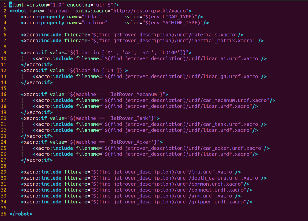

(1) Start the virtual machine and click the icon to open the command-line terminal.
(2) Enter the following command and press Enter to navigate to the startup program directory:
cd ros2_ws/src/jetrover_description/urdf/
(3) Enter the following command to open the robot simulation model file:
vim jetrover.xacro
(4) Find the code section shown in the image below:
Multiple URDF models are called to form the complete robot.
File Name Device
materials Color
inertial_matrix Inertia Matrix
lidar_a1 A1 Lidar
lidar_g4 G4 Lidar
car_mecanum Mecanum Wheel Chassis
car_tank Tank Chassis
car_acker Ackermann Chassis
Imu Inertial Measurement Unit (IMU)
depth_camera Depth Camera
common Shared or Common Components/Attributes
connect Connectors, Describing Physical Connections between Components
arm Robotic Arm
gripper Gripper (Claw)
arm.transmission Robotic Arm Transmission Structure
gripper.transmission Gripper Transmission Structure

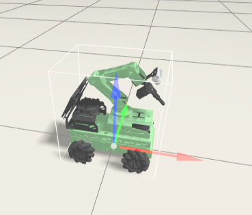

  • Brief Analysis of the Robot’s Main Model
The JetRover has three types of chassis: Mecanum, Tank, and Ackermann. This section explains the Ackermann chassis model, while the Mecanum and Tank chassis model files are largely the same, with differences explained later in this document.
Open a new terminal and enter the command to open the robot model file. This file contains descriptions of the various parts of the robot model.
vim car_acker.urdf.xacro

<?xml version="1.0" encoding="utf-8"?>
<robot name="jetrover" xmlns:xacro="http://ros.org/wiki/xacro">
    <xacro:property name="lidar"        value="$(env LIDAR_TYPE)"/>
    <xacro:property name="machine"      value="$(env MACHINE_TYPE)"/>
    <xacro:include filename="$(find jetrover_description)/urdf/materials.xacro"/>
    <xacro:include filename="$(find jetrover_description)/urdf/inertial_matrix.xacro" />
    <xacro:if value="${lidar in ['A1', 'A2', 'S2L', 'LD14P']}">
        <xacro:include filename="$(find jetrover_description)/urdf/lidar_a1.urdf.xacro"/>
    </xacro:if>
    <xacro:if value="${lidar in ['G4']}">
        <xacro:include filename="$(find jetrover_description)/urdf/lidar_g4.urdf.xacro"/>
    </xacro:if>
    <xacro:if value="${machine == 'JetRover_Mecanum'}">
        <xacro:include filename="$(find jetrover_description)/urdf/car_mecanum.urdf.xacro"/>
        <xacro:include filename="$(find jetrover_description)/urdf/lidar.urdf.xacro"/>
    </xacro:if>
    <xacro:if value="${machine == 'JetRover_Tank'}">
        <xacro:include filename="$(find jetrover_description)/urdf/car_tank.urdf.xacro"/>
    </xacro:if>
    <xacro:if value="${machine == 'JetRover_Acker'}">
        <xacro:include filename="$(find jetrover_description)/urdf/car_acker.urdf.xacro"/>
    </xacro:if>
    <xacro:include filename="$(find jetrover_description)/urdf/imu.urdf.xacro"/>
    <xacro:include filename="$(find jetrover_description)/urdf/depth_camera.urdf.xacro"/>
    <xacro:include filename="$(find jetrover_description)/urdf/common.urdf.xacro"/>
    <xacro:include filename="$(find jetrover_description)/urdf/connect.urdf.xacro"/>
    <xacro:include filename="$(find jetrover_description)/urdf/arm.urdf.xacro"/>
    <xacro:include filename="$(find jetrover_description)/urdf/gripper.urdf.xacro"/>
</robot>
The following code describes a fixed joint that connects two links, named base_link and wheel_right_front_link. The joint’s starting position and rotation are specified using the <origin> tag.
(1) name="wheel_right_front_joint": This attribute specifies the name of the joint, which is wheel_right_front_joint.
(2) type="fixed": This attribute specifies the type of the joint, which is “fixed”. This means the joint is stationary and does not allow movement.
(3) <origin> tag: This tag defines the joint’s starting position and rotation. Specifically, it specifies the joint’s xyz coordinates as “-0.10658 0.091851 -0.065487” and the rpy (roll, pitch, yaw) rotation angles as “0 0 3.1416”.
(4) <parent> tag: This tag specifies the parent link of the joint, which is base_link. This means the joint is attached to the base_link link.
(5) <child> tag: This tag specifies the child link of the joint, which is wheel_right_front_link. This means the joint connects to the wheel_right_front_link link.
(6) <axis> tag: This tag defines the joint’s axis. In this case, the axis is set to (0, 0, 0), indicating that there is no specific axis.

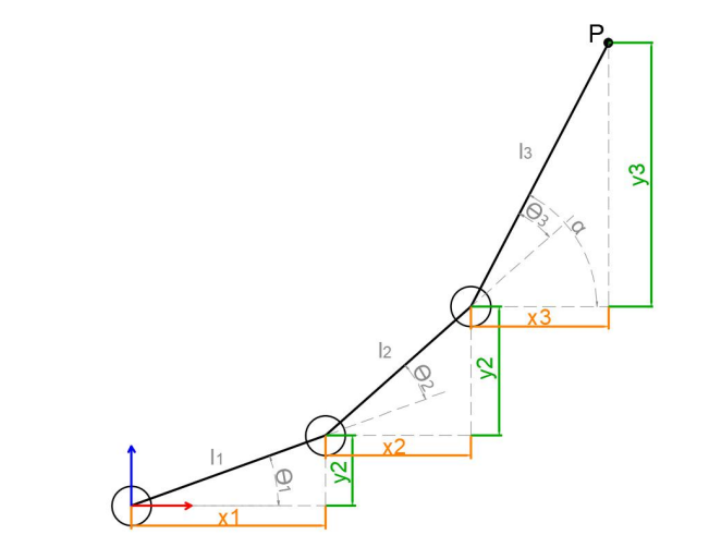

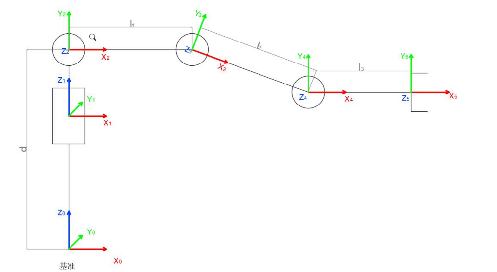

  • Geometric Method
For a robotic arm, the geometric method involves determining the rotation angles of each joint after specifying the position and orientation of the end effector. Since the 3D motion of a robotic arm is quite complex, we simplify the model by removing the rotational joint of the lower platform. This allows us to analyze the kinematics in a 2D plane.
Inverse kinematics analysis generally involves extensive matrix computations, making the process complex and computationally intensive, which can make implementation challenging. To better suit our needs, we use the geometric method for analyzing the robotic arm.
We simplify the model of the robotic arm by removing the base platform and actuator section, resulting in the main body of the arm. From the diagram above, we can see that the coordinates (x, y) of the end effector P are composed of three parts: (x1 + x2 + x3, y1 + y2 + y3).
In the diagram, θ1, θ2, and θ3 are the joint angles of the servos that we need to calculate, and α is the angle between the gripper and the horizontal plane. From the diagram, it is clear that the angle of the gripper from the top view, α, is equal to θ1 + θ2 + θ3. Using this, we can derive the following equation:
Where x and y are provided by the user, and l1, l2, and l3 are the inherent properties of the robotic arm’s structure.
To simplify the calculations, we process the known parts and consider them as a whole:
Substituting m and n into the existing equation and simplifying, we get:
By solving this equation, we obtain:
This result corresponds to the quadratic formula for solving a single-variable equation, where:
From this, we can calculate the angle of θ1, and similarly, we can calculate θ2. With all three servo angles determined, we can then control the servos based on these angles to achieve the desired position.

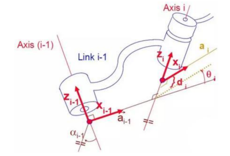

  • DH Modelling
The DH Parameter Table (Denavit-Hartenberg Parameter Table) is a standardized method used to describe the relative position and orientation of robotic arm joints and links. It uses four parameters to represent the relationship between each pair of adjacent joints. These four DH parameters have very clear physical meanings, as described below:
(1) Link Length: The length of the common normal between the axes of two adjacent joints (the rotation axis for rotational joints, the translation axis for prismatic joints).
(2) Link Twist: The angle by which the axis of one joint is rotated around the common normal relative to the axis of the adjacent joint.
(3) Link Offset: The distance along the axis of a joint between the common normal of the current joint and the common normal of the next joint.
(4) Joint Angle: The angle of rotation around the joint axis between the common normal of the current joint and the common normal of the next joint.
While these definitions might seem complex, they become much clearer when viewed in the context of coordinate systems.
First, you should focus on the two most important “lines”:
(1) The axis of a joint (axis).
(2) The common normal between the axis of one joint and the axis of the adjacent joint (common normal).
In the DH parameter system, we define the axis as the z-axis, and the common normal as the x-axis, where the direction of the x-axis is from the current joint to the next joint.
However, these two rules alone are not enough to fully determine the coordinate system of each joint. Let’s now go over the detailed steps for determining the coordinate system.
In applications such as robotic arm simulations, we may use other methods to establish coordinate systems. However, understanding the method described here is crucial for grasping the mathematical expressions of robotic arms and for understanding the subsequent analyses.
The diagram below shows two typical robot joints. Although these joints and links may not resemble any specific joints or links from real robots, they are quite common and can easily represent any joint in a real robot.
This revision simplifies and clarifies the explanation, making it easier for users to understand the concepts and how they relate to the coordinate system in robotic arms.
  • Determine Coordinate System
There are generally several steps involved in determining the coordinate system:
To model a robot using the DH (Denavit-Hartenberg) notation, the first step is to assign a reference coordinate system to each joint. For each joint, both the Z-axis and the X-axis must be specified.
(1) Defining the Z-axis:
① For a rotational joint, the Z-axis is aligned with the direction of rotation according to the right-hand rule. The joint variable is the rotation angle around the Z-axis.
② For a prismatic joint (sliding joint), the Z-axis aligns with the direction of linear motion. The joint variable is the length of travel along the Z-axis.
(2) Defining the X-axis:
① When two joints are neither parallel nor intersecting, the Z-axis is typically diagonal. However, there is always one shortest perpendicular line (common normal) between them, which is orthogonal to both Z-axes. The X-axis is defined along this common normal.
② If a_n represents the common normal between the Z-axes of joint n and joint n+1, then the direction of the X-axis, X_n, will be along a_n.
(3) Special Cases:
① When the Z-axes of two joints are parallel, there are infinitely many common normal lines. In this case, one can choose the common normal that is collinear with the common normal of the previous joint, simplifying the model.
② When the Z-axes of two joints intersect, there is no common normal. In this case, the X-axis can be defined along the line perpendicular to the plane formed by the two axes, simplifying the model.
Once the coordinate system is assigned to each joint, the model can be represented as shown in the diagram below:
After determining the coordinate system, we can represent the four parameters more simply:
Link Length l_i: Defined as the distance along the positive X_{i-1} axis from Z_{i-1} axis to Z_i.
Link Twist α_i: Defined as the angle of rotation along the positive direction X_{i-1} (using the left-hand or right-hand rule?) between Z_{i-1} and Z_i.
Joint Offset d_i: Defined as the distance along the positive Z_{i-1} axis from X_{i-1} axis to the X_i.
Joint Angle θ_i: Defined as the rotational angle between X_{i-1} and X_i along the positive direction Z_{i-1}, using the right-hand rule (or left-hand rule, depending on the convention).

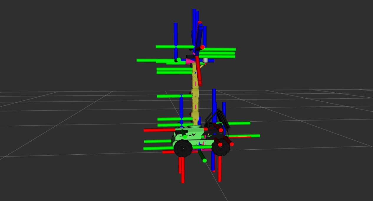

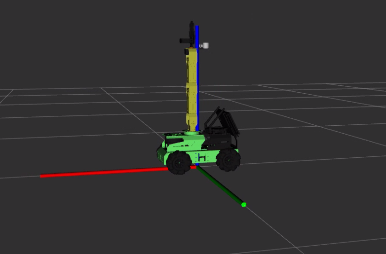

  • Base Coordinate System
At the position of the robotic arm’s base, in the diagram below, the origin is located at the bottom servo, with the green axis representing the X-axis, the red axis representing the Y-axis, and the blue axis representing the Z-axis.
  • Joint Coordinate System
The robotic arm consists of two key components: the rotational joints and the links. In the robotic arm model shown below, the coordinate system for each joint is represented with the origin at the position of the pink cone, where the green axis is the X-axis, the red axis is the Y-axis, and the blue axis is the Z-axis.
  • Tool Coordinate System
At the end of the robotic arm, a tool is typically attached to meet the requirements of different tasks. The default tool on the robotic arm is the gripper. In the robotic arm model shown below, the coordinate system of the gripper tool has its origin at the position of the pink cone, with the green axis as the X-axis, the red axis as the Y-axis, and the blue axis as the Z-axis.

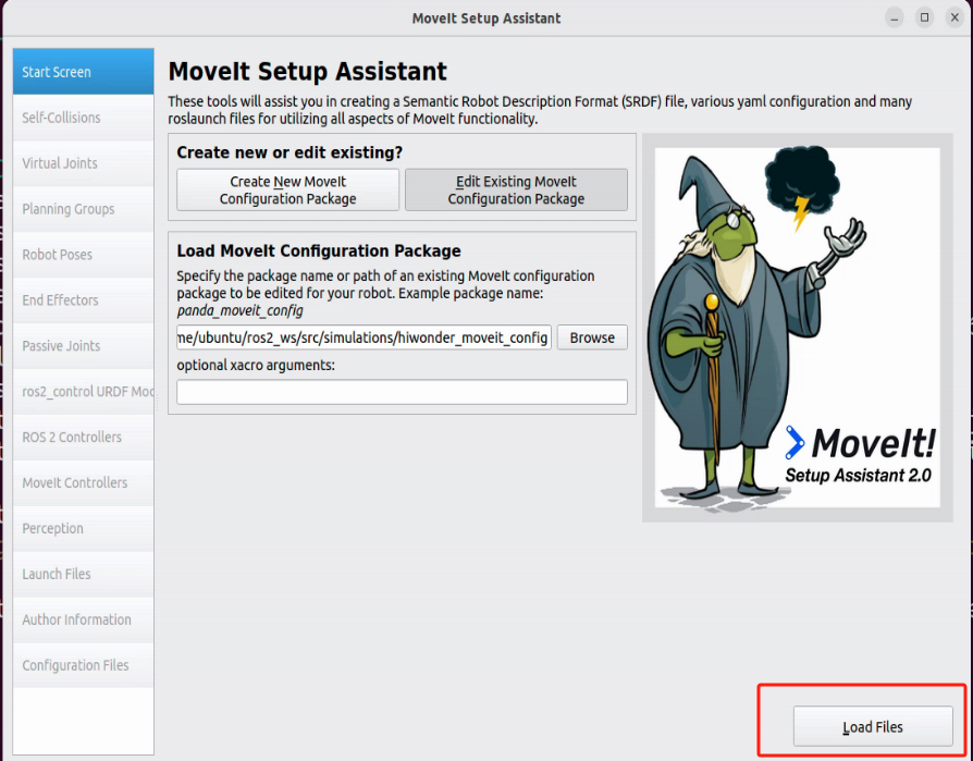

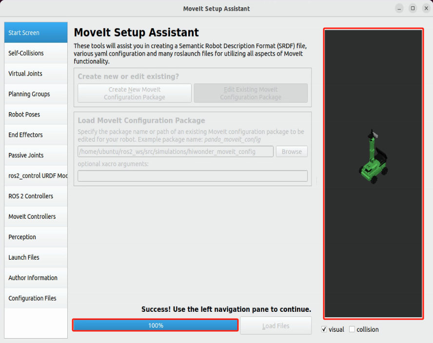

  • Launching the Configuration Program
When entering commands, ensure case sensitivity is strictly observed. You can use the “Tab” key to auto-complete keywords.
(1) Start the virtual machine. Click the icon on the system desktop to open the terminal command line.

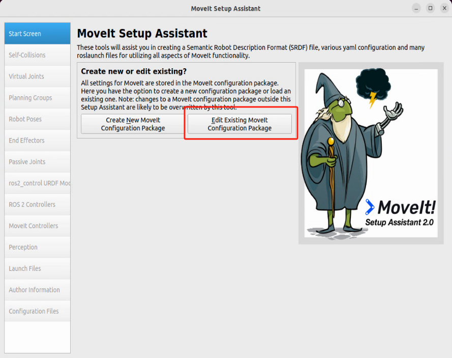

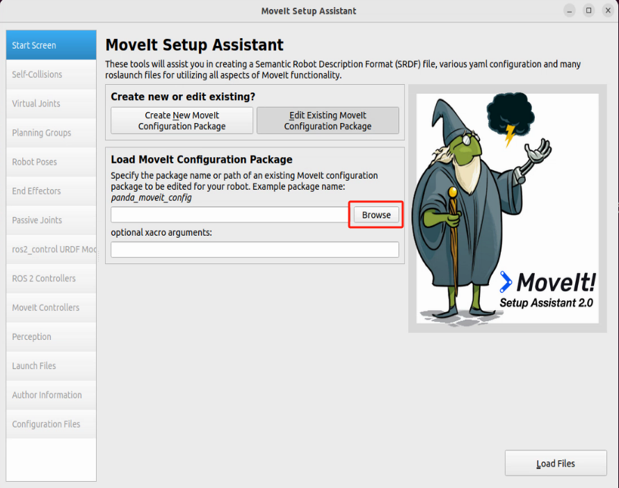

(2) Execute the following command to launch the MoveIt2 setup assistant.
ros2 launch moveit_setup_assistant setup_assistant.launch.py

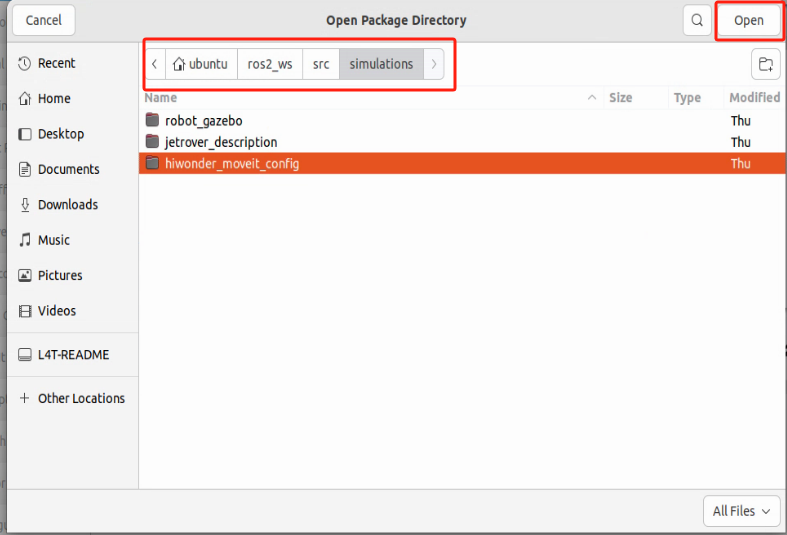

(3) Click “Edit Existing MoveIt2 Configuration Package” to begin editing an existing configuration package.
(4) Click “Browse” and navigate to the following directory: home/ubuntu/ros2_ws/src/hiwonder_moveIt_config; Select the folder and click “Open”.
(5) Click “Load Files” and wait for the files to load.
Once the progress reaches 100%, the robot model will appear on the right side, indicating a successful load.

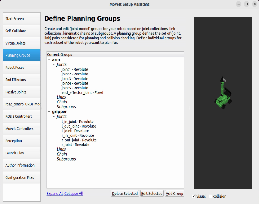

(6) Adjust settings for options such as “Virtual Joints” and “Robot Pose” in the left-hand menu.
Reconfiguring will overwrite previous settings. Errors during this process may result in functionality issues.

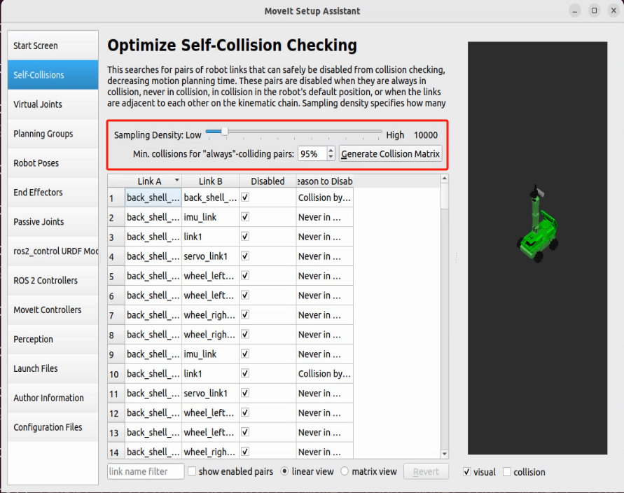

  • Configuration Introduction
The default collision matrix generator scans all joints of the robot. This custom collision matrix can safely disable specific collision checks, thereby reducing the processing time for motion planning.
Sampling Density:
Sampling density refers to the number of random joint configurations sampled to check for collisions. Higher density increases computation time. The default value is 10,000 collision checks.

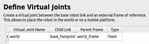

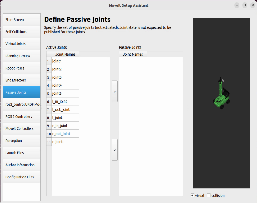

  • Virtual joints
Virtual joints are primarily used to connect the robot to a simulation environment. In this step, a virtual joint is defined to link the base_footprint frame to the world_frame.
  • Planning Groups
Joint groups are used to define the various joint components required to assemble the robot.

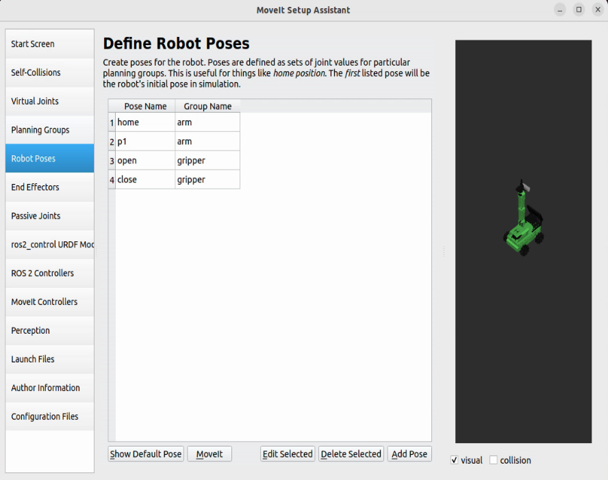

  • Robot Poses
Define custom pose names for the robot and specify the joint groups involved in achieving each pose.
  • Passive Joints
Defining unused joints. Specify which joints are available and which are disabled, based on the robot’s configuration.

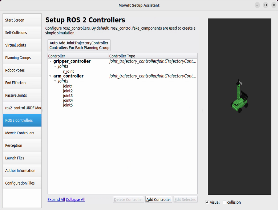

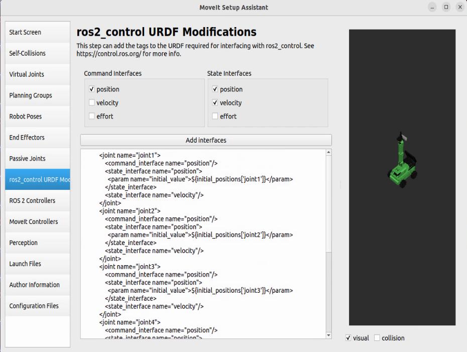

  • ROS2 Controllers
Using the ROS2 Controllers panel, you can add simulated controllers for the joints. This enables MoveIt2 to simulate the motion of the robotic arm.
  • ros2_control URDF Modifications
Configure the URDF file required for the simulation.

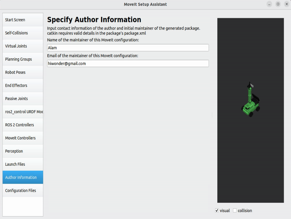

  • Author Information
Provide the author’s details for documentation purposes.

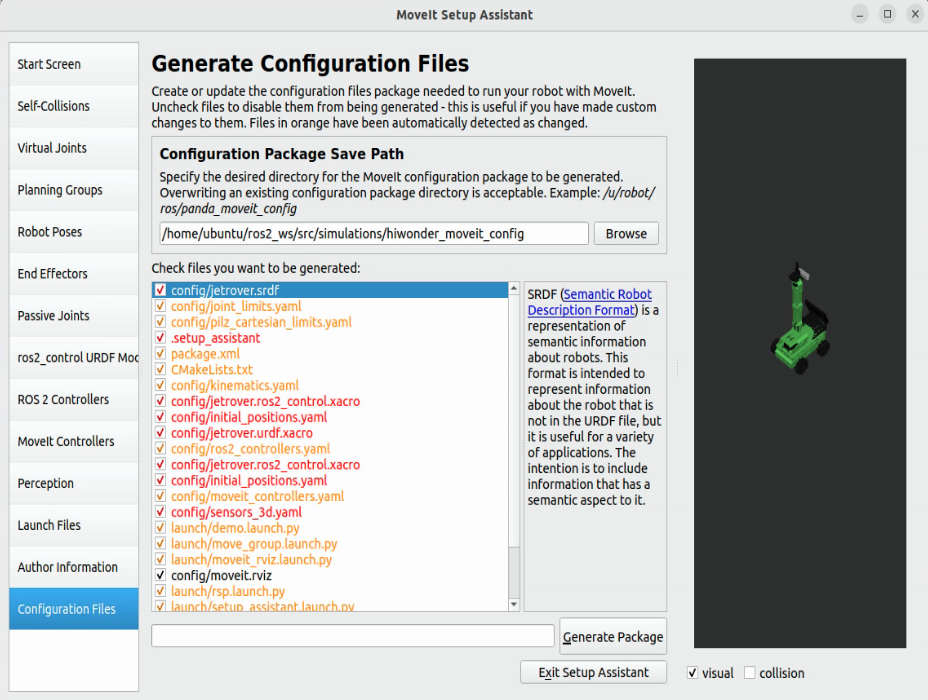

Generating Configuration Files
After confirming the file path, click “Generate Package” to generate the configuration package.

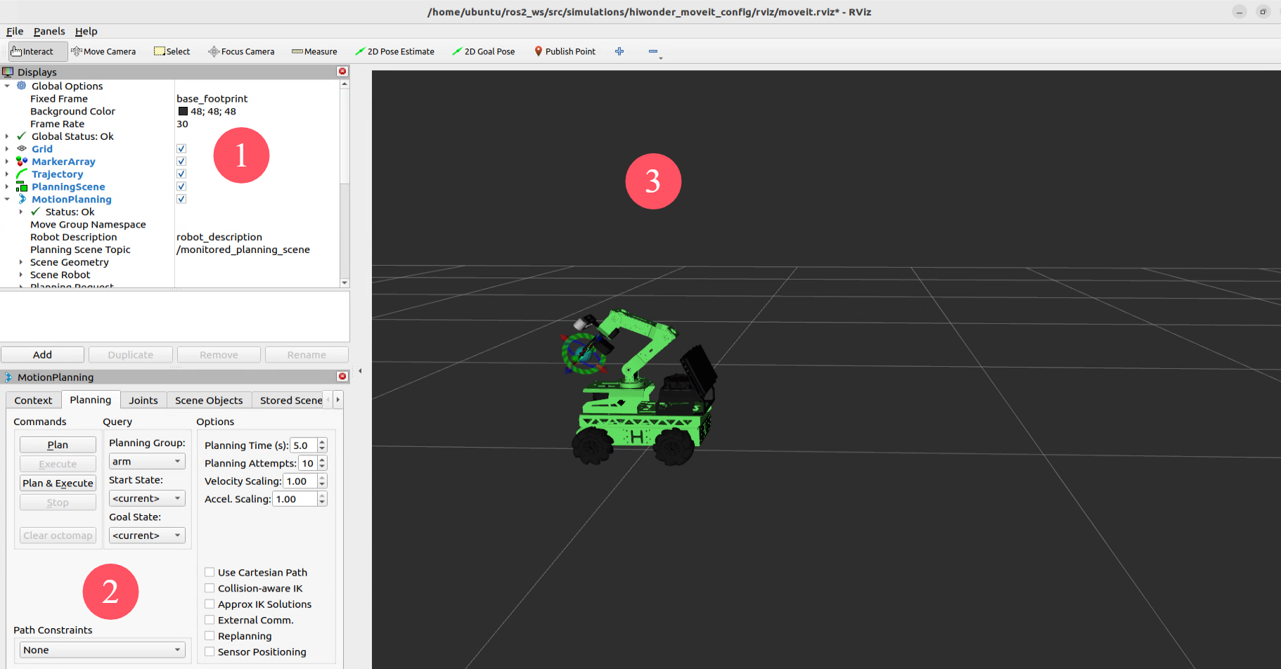

Program Interface Overview
The program interface is shown in the image below:
Position 1: RViz Toolbar
Position 2: MoveIt Debugging Area
Position 3: Simulation Model Adjustment Area

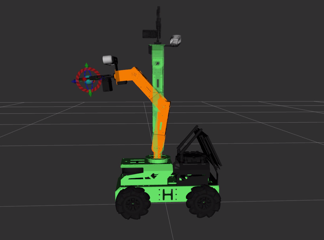

  • Control Instructions

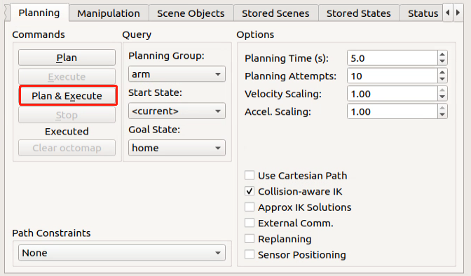

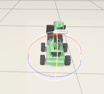

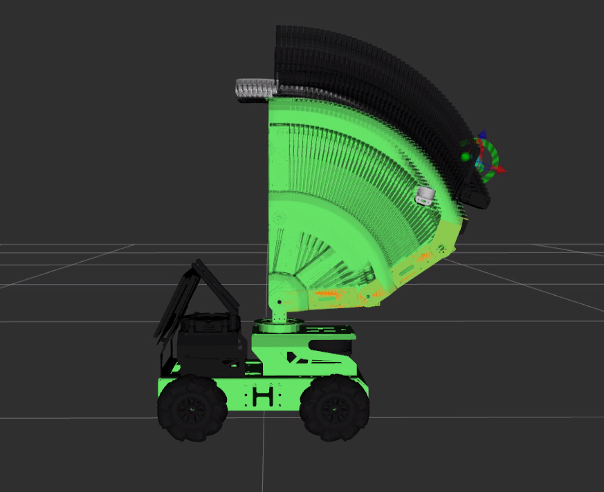

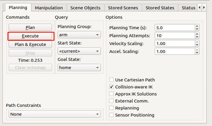

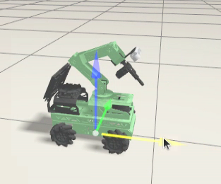

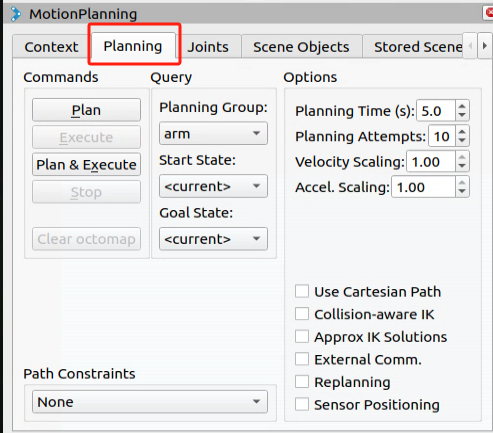

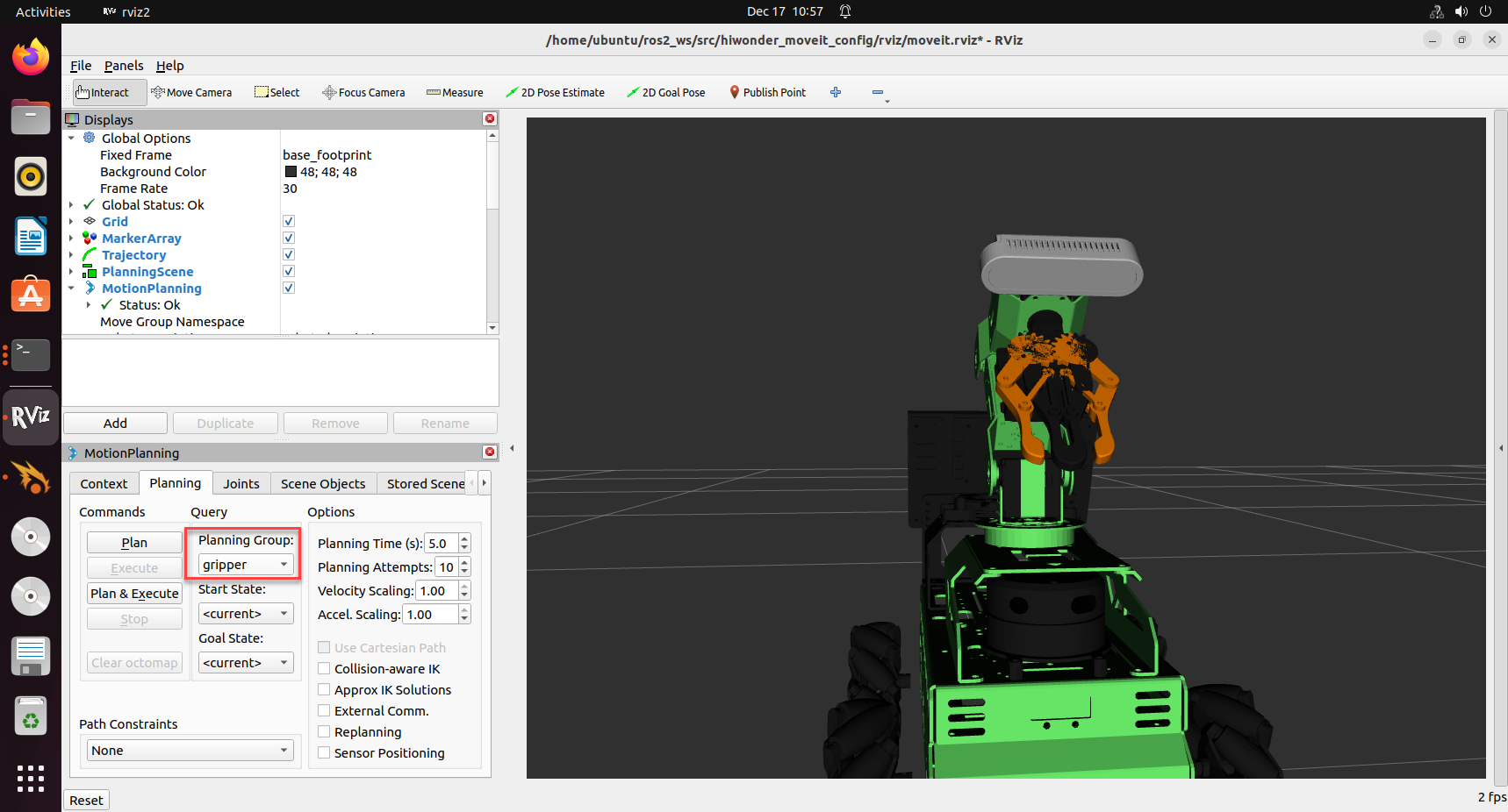

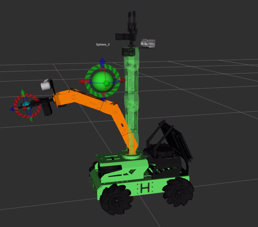

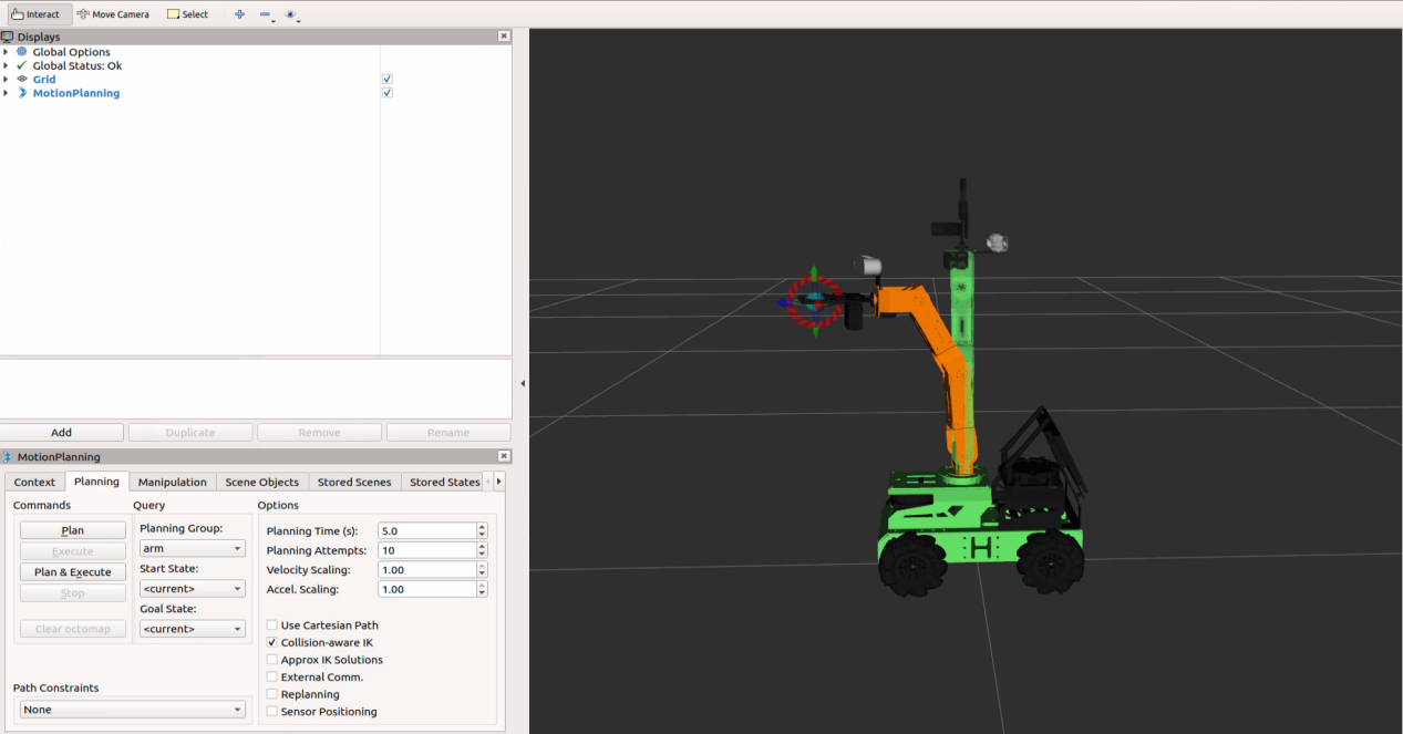

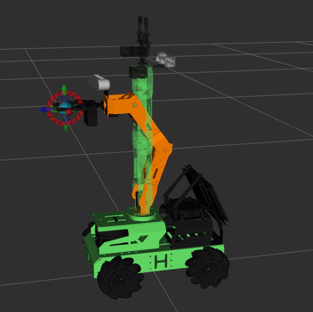

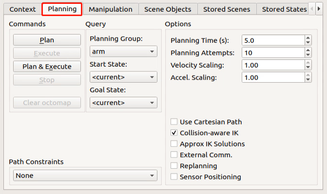

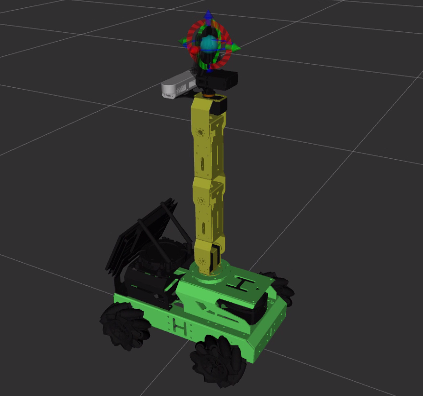

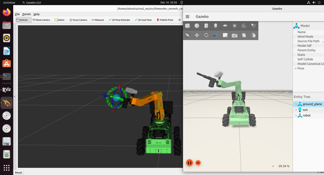

(1) In the MoveIt2 Debugging Area, find and click the “Planning” section.

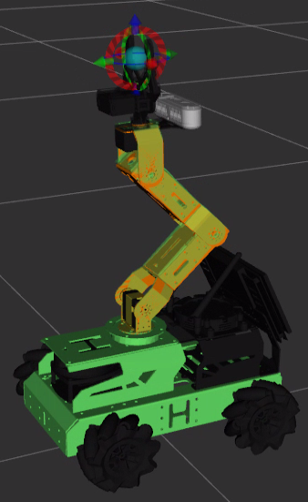

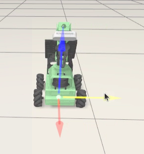

(2) In the Simulation Model Adjustment Area, you will see arrows in red, green, and blue colors. Click and drag the arrows to adjust the robotic arm’s pose. In the robot’s first-person view:
Green represents the X-axis, with the positive direction pointing to the robot’s left.
Red represents the Y-axis, with the positive direction pointing to the robot’s front.
Blue represents the Z-axis, with the positive direction pointing upwards from the robot.

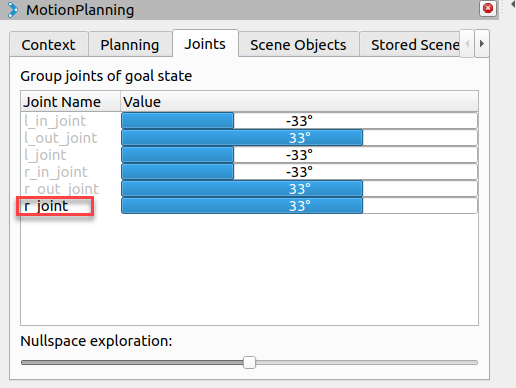

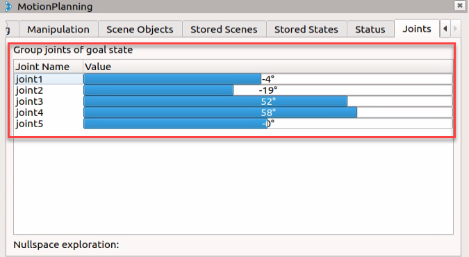

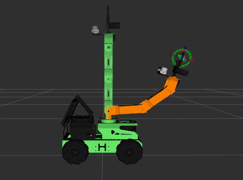

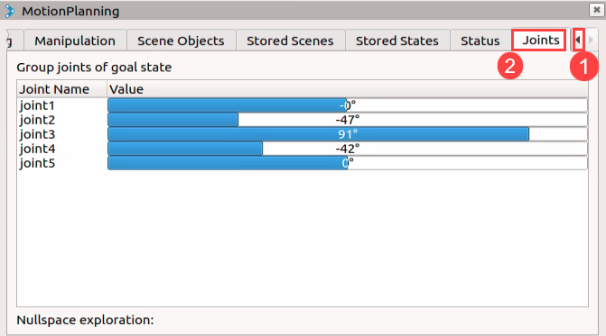

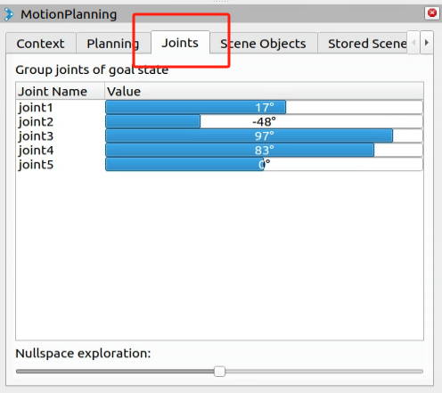

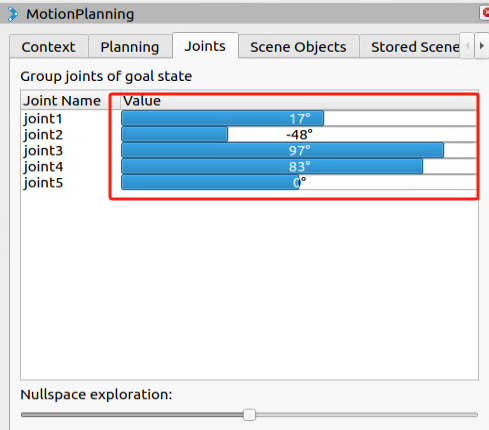

(3) Besides adjusting the pose using the arrows, you can also adjust individual joints directly. Click the triangle icon on the right and find the “Joints” panel.
(4) Drag the sliders for the corresponding joints to adjust their angles individually.

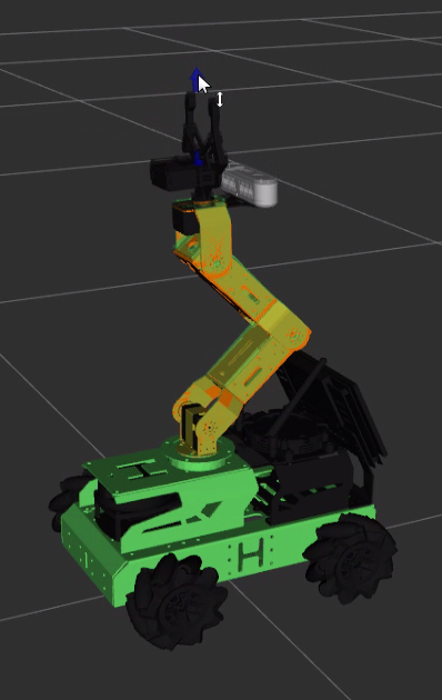

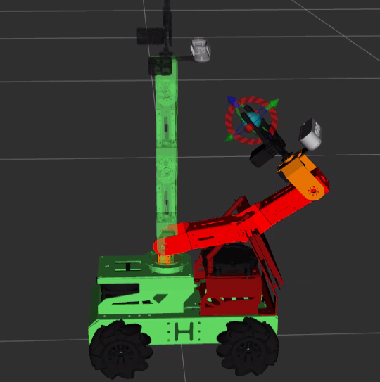

(5) After successfully planning the robotic arm’s motion path, the new position will be highlighted in orange. If the new position causes a collision with other parts of the robot, it will be marked in red. You must adjust the configuration to avoid collisions; otherwise, the motion cannot be executed.
Orange (Executable State) is shown in the following image.
For example, if the robotic arm is planned to be in the position shown in the image, it will collide with the depth camera, turning the state red (Non-executable).

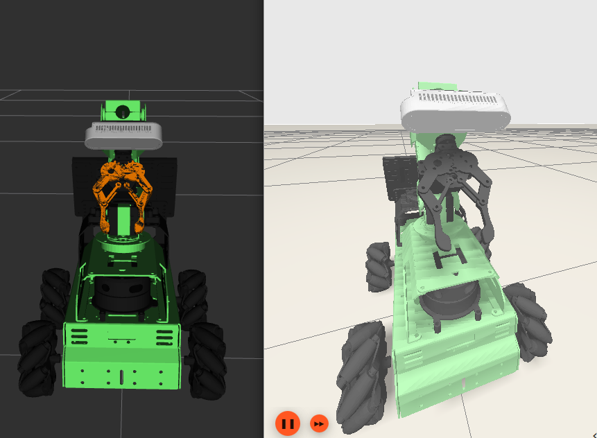

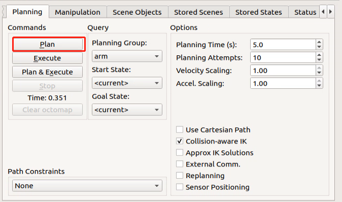

(6) After planning the path, return to the “Planning” section and click the “Plan” option. The simulation model will display the motion path from the original position to the newly planned position.
(7) Then, click the “Execute” option to make both the simulation model and robotic arm follow the planned motion path.
(8) Alternatively, you can click “Plan & Execute”, where the robotic arm will first display the new planned motion path and then execute the movement.
(9) To close this mode, press “Ctrl+C” in the terminal. If the process fails to stop, try again.

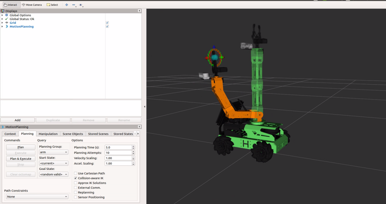

(1) In the MoveIt2 Debugging Area, locate and click the “Planning” section.
(2) In the Simulation Model Adjustment Area, there are arrows in green, red, and blue colors. From the robot’s first-person perspective:

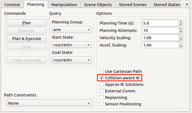

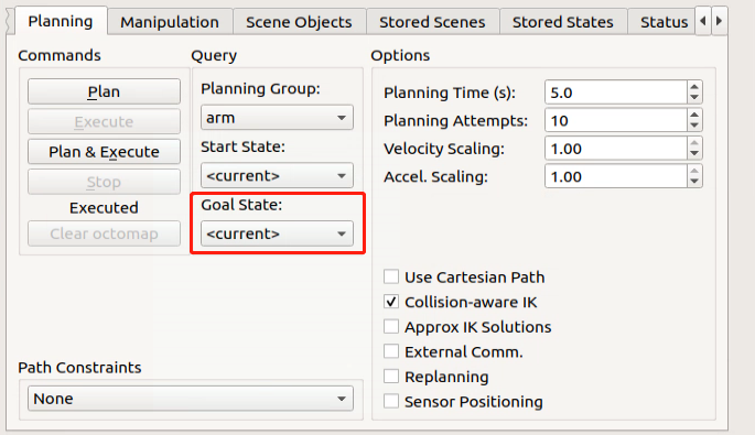

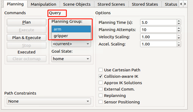

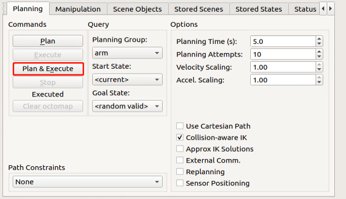

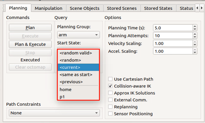

(3) In the “Query” category, click the dropdown menu under “Planning Group” and select the joint group (servo group) you wish to control. For example, the default selection is the “arm” group.
(4) Click the dropdown menu under “Goal State” and choose the desired target position.
(5) The parameter list in the dropdown menu is as follows:
random valid: A valid random position where no collisions will occur.
random: A random position that may potentially result in a collision.
current: The current position.
same as start: The same as the starting position.
previous: The previous target position.
home and p1 are the default positions set by the program.
(6) To avoid the possibility of collisions, select random valid to randomly generate a valid target position. Each time you click this option, a new target position will be randomly generated and displayed in the simulation model.
(7) Click “Plan & Execute”, and both the simulation model and robotic arm will perform the motion simultaneously. The simulation model will show the newly planned movement path, and the robotic arm will execute the motion.
(8) To exit this mode, press “Ctrl+C” in the terminal. If the process fails to stop, try again.

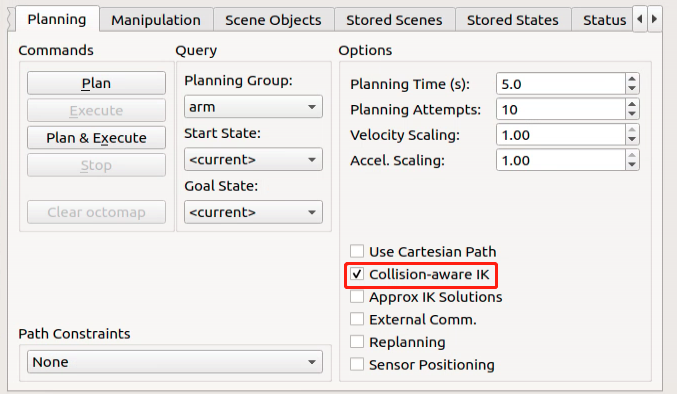

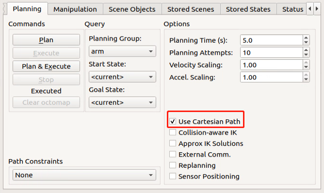

(3) Locate the “Planning” section, and tick “Use Cartesian Path” to enable Cartesian path planning.
(4) Next, use the mouse to drag the arrows in the “Simulation Model Adjustment Area” to plan the robot arm’s path. From the robot’s perspective, the green arrow represents the X-axis, with the positive direction to the robot’s left; the red arrow represents the Y-axis, with the positive direction to the robot’s front; and the blue arrow represents the Z-axis, with the positive direction upwards from the robot.
(5) Once the planning is complete, click “Plan & Execute”. The simulation model will execute the action and attempt to linearly move the end effector in Cartesian space. If the action cannot be performed within the Cartesian path constraints, it will display a failure message.
(6) To exit this mode, press “Ctrl+C” in the terminal. If it fails to close, please try again.

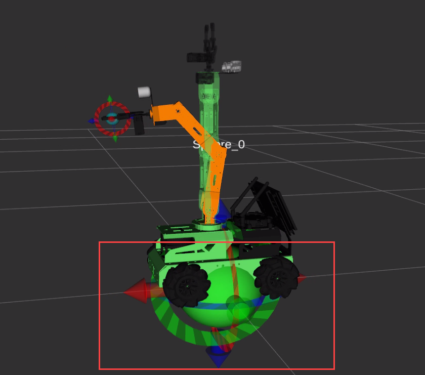

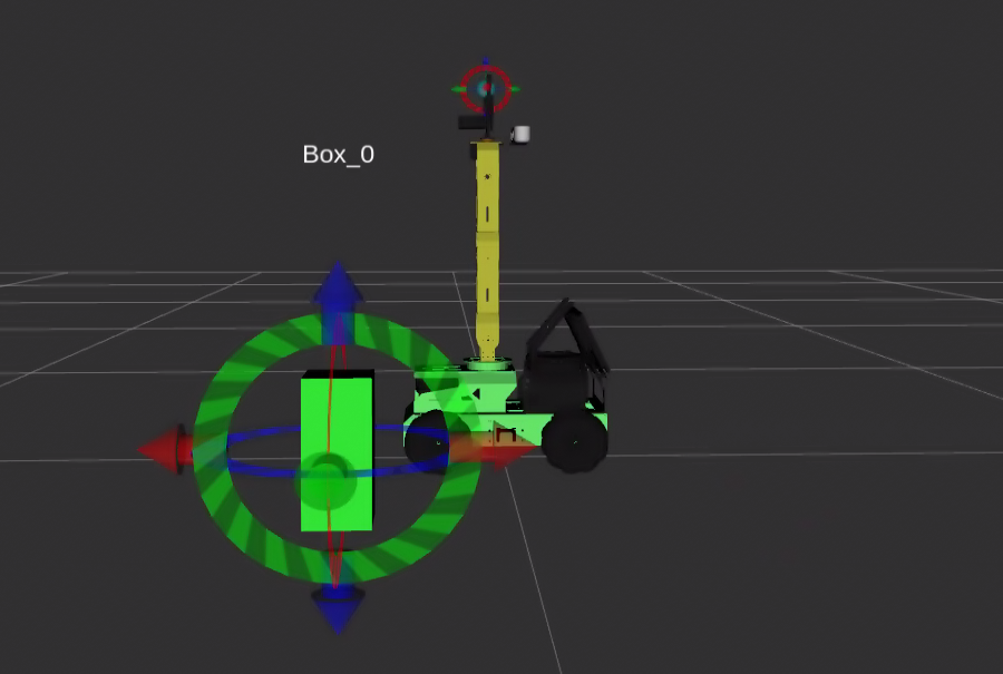

8.3.6 MoveIt2 Collision Detection
  • MoveIt2 Collision Detection Explanation
MoveIt2’s collision detection is a critical feature that uses the robot’s motion planning path and information about surrounding objects to detect potential collisions. This ensures that the robot does not collide with any objects in its environment while performing its movements.
  • Collision Detection Configuration Overview

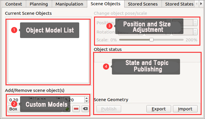

In MoveIt2, collision detection is configured using the CollisionWorld object in the planning scene. The collision detection in this configuration primarily uses the FCL (Flexible Collision Library) package, which is a key C++ library in MoveIt2.
  • Collision Object Introduction

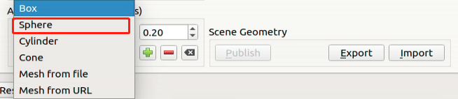

MoveIt2 supports collision detection for various types of objects, including:
(1) Meshes
(2) Basic Shapes – such as cuboids, cylinders, cones, spheres, and planes.
(3) Octomap – Octomap objects can be directly used for collision detection.
  • Allowed Collision Matrix (ACM)
The Allowed Collision Matrix (ACM) encodes a binary value indicating whether collision detection is required between objects (which may be on the robot or in the robot’s environment).
If the value corresponding to two objects in the ACM is set to 1, it means collision detection between these objects is not required. Otherwise, collision detection will be performed.
Position 1: RVIZ Toolbar
Position 2: MoveIt Debug Area

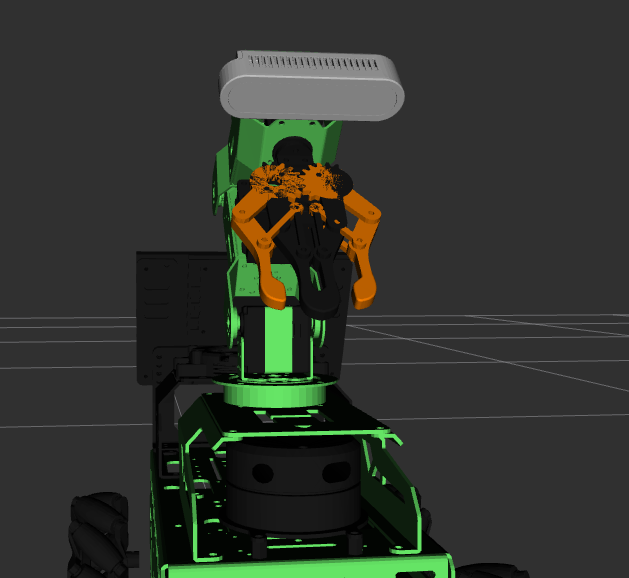

(3) In the Simulation Model Adjustment Area, there are arrows in three colors: green, red, and blue. Click and drag the arrows to adjust the robot arm’s posture. From the robot’s perspective, the green arrow represents the X-axis (positive direction is to the left of the robot), the red arrow represents the Y-axis (positive direction is in front of the robot), and the blue arrow represents the Z-axis (positive direction is above the robot).
After planning the path, the new position will be highlighted in orange, as shown in the image below:

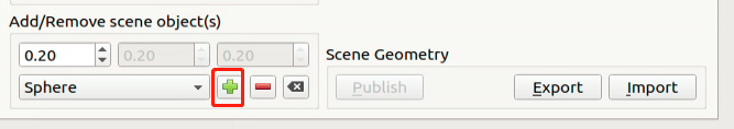

(4) Once the robot arm’s path is planned, click the “Scene Objects” section to add a collision model.
(5) The section is divided into 4 areas, as described below:

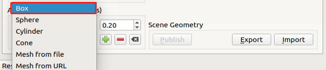

(6) Click the “Box” dropdown menu and select a collision model. Here, we will use the “Sphere” model as an example.
(7) Click the plus icon to add the currently selected collision model.
The model will be placed at the robot’s base by default, as shown in the image below:
(8) Use the slider to adjust the size of the collision model. It is recommended to shrink it to about 50% of the original size.
(9) Drag the 3D arrows on the sphere to move the collision model between the start and target positions to test the collision detection effect.
(10) Click the “Planning” section and check the “Collision-aware IK” option to enable the collision detection for the model.
(11) Next, click “Plan & Execute” to begin moving along the planned path. When the following prompt appears, select “Yes”.
(12) After confirming, the robot arm will plan the movement path, avoiding any obstacles along the way to prevent collisions.
(13) If you wish to exit this mode, press “Ctrl+C” in the terminal. If it doesn’t close successfully, please try again.

ros2 launch hiwonder_moveit_config demo.launch.py
The program interface will appear as shown in the image below:
After planning the path, the new position will be highlighted in orange, as shown in the image below.
(3) In the debugging area, locate the “Scene Objects” section to add scene object models.
(4) This section is divided into 4 areas, as shown below.

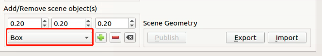

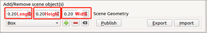

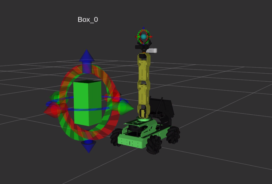

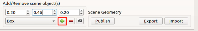

(5) In the “Custom Models” section, select the required basic model. Here, we use the cube model as an example.
(6) Above the model selection, adjust the initial size of the object model in meters, as shown below.
(7) After adjusting, click the “+” button to add the currently configured object model to the scene.
(8) Once added, the model list will be updated with the newly added model, which will appear at the center of the scene (i.e., the robot’s center).
(9) In the simulation model adjustment area, there are arrows in red, green, and blue colors. Click and drag these arrows to adjust the robot’s pose. In the robot’s first-person view:
Green Arrow: X-axis direction, positive direction is to the left of the robot.
Red Arrow: Y-axis direction, positive direction is in front of the robot.
Blue Arrow: Z-axis direction, positive direction is above the robot.

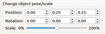

(10) In addition to using arrow dragging, you can also make adjustments in the “Position and Size” adjustment area.
Position: Adjust the object’s position on the X, Y, and Z axes.
Rotation: Adjust the object’s angle along the X, Y, and Z axes.
Scale: Adjust the object’s size by dragging the slider.

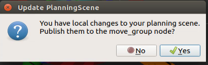

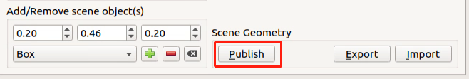

(11) After making adjustments, click “Publish” to send the model’s topic message. MoveIt2 will automatically subscribe to this message.
(12) To prevent object models from colliding, go to the “Planning” section and check the “Collision-aware IK” box to enable collision detection for the model.
(13) If you wish to close this feature, press “Ctrl+C” in the terminal. If the closing fails, please try again.

  • Start MoveIt2 Tool
(1) Start the Virtual Machine: Click the system desktop icon to open the command-line terminal.
(2) Launch MoveIt2 Tool: Enter the following command to launch the MoveIt2 tool:
The program interface is displayed as shown below:
① Position 1: RVIZ Toolbar
② Position 2: MoveIt2 Debugging Area
③ Position 3: Simulation Model Adjustment Area

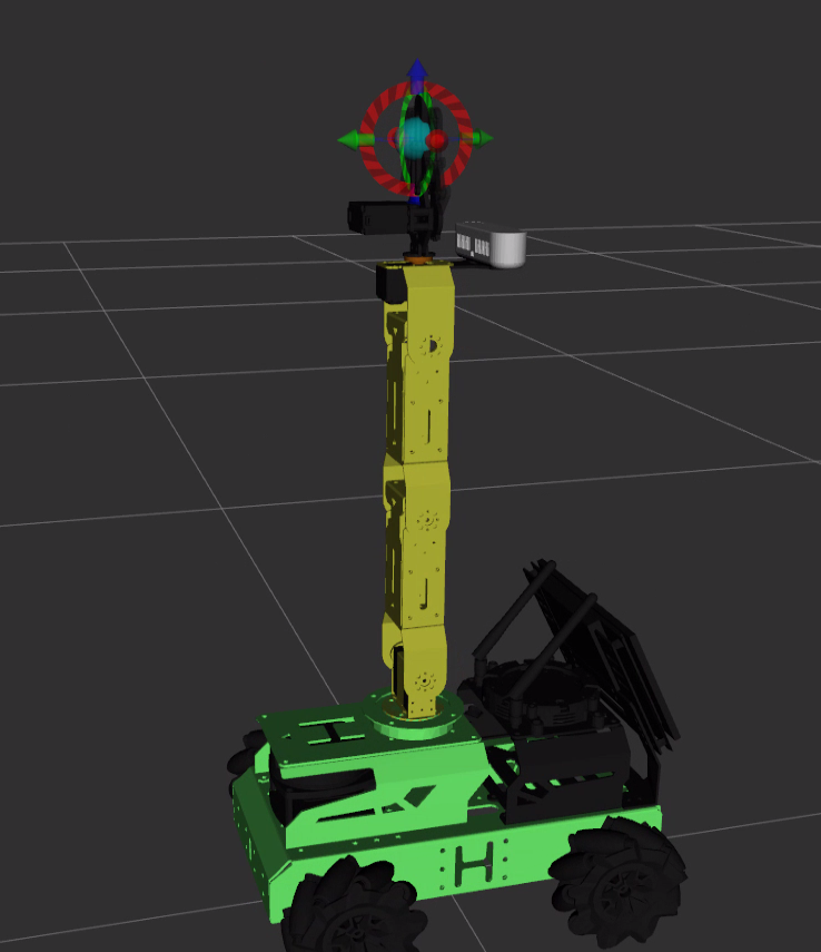

(3) Adjust Robot Pose: In the simulation model adjustment area, there are red, green, and blue arrows. Click and drag the arrows to adjust the robotic arm’s pose. The robot is viewed from its first-person perspective, with:
① Green: X-axis (positive direction is to the left of the robot)
② Red: Y-axis (positive direction is in front of the robot)
③ Blue: Z-axis (positive direction is above the robot)
(4) Adjust Individual Joints: In addition to adjusting the pose with the arrows, you can directly adjust the individual joints. Click the triangle icon on the right side, then find and click the “Joints” panel.
(5) Fine-tune Joint Angles: Drag the corresponding sliders to adjust the angles of the individual joints.
(6) Path Planning and Collision Detection: After successfully planning the robotic arm’s movement path, the new position will be indicated in orange. If there is a collision with other parts of the robot, the position will be marked in red. In this case, you need to adjust the pose to avoid collisions, or the action cannot be executed.
Orange indicates an executable position, as shown below:

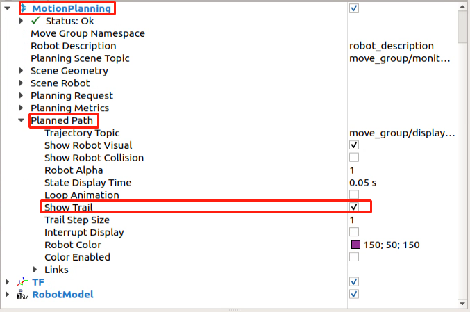

(7) Visualize the Motion Path: In the RVIZ toolbar, click “Motion Planning” and “Planned Path”, then check the “Show Trail” option. This will display the visual trail of each frame of the robotic arm’s movement.
(8) Demonstrate the Movement Path: Return to the “Planning” section, and click the “Plan” button. The simulation model will demonstrate the path from the original position to the newly planned position.
(9) Execute the Planned Path: After observing the demonstration, uncheck the “Show Trail” option. Then, click the “Execute” button. The simulation model and the robot will simultaneously execute the planned motion.
(10) To close this mode, press “Ctrl+C” in the terminal. If the shutdown fails, try again.

In this section, we will plan a motion trajectory in the simulation and execute it to synchronize the real robotic arm’s movements.
  • Important Notes
(1) Network Requirements: The virtual machine and the robot must be on the same network segment and able to communicate with each other in order to control the robot. Otherwise, only simulation is possible, and the robot will not execute the planned movements.
(2) Safety Precautions: Before starting, ensure there is enough space around the robot for movement. Maintain a safe distance from the robot during execution to prevent any collisions between the robotic arm and your body that could cause injury.
  • Starting Robot Services
(1) Start the Robot: Click on the system desktop icon to open the command terminal, then enter the command to disable the auto-start service:
(2) Start the Robot Chassis Control Node: This node is responsible for enabling synchronization between the simulation and the real robotic arm.
  • Starting Services on the Virtual Machine
(1) Start the Virtual Machine: Click the system desktop icon to open the command terminal.
(2) Start the Servo Control Node: In the terminal, enter the following command to start the servo control node, enabling synchronization between the simulation and the real robotic arm:
ros2 launch servo_controller servo_controller.launch.py
(3) Start MoveIt2 Tool: Open a new terminal and enter the following command to launch MoveIt2:
(4) Control Robotic Arm Movement: Use the slider to adjust the motion planning for the robotic arm, then click “Plan & Execute”. The simulated robotic arm and the real robotic arm will execute the action synchronously.
In practice, the software execution of actions may appear slower, which is normal!

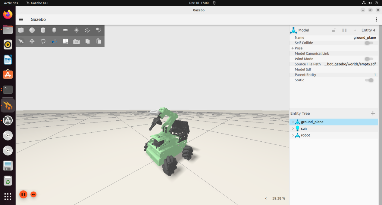

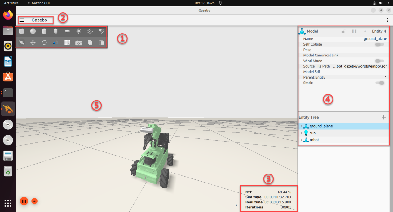

8.4.2 Gazebo GUI Introduction
The simulation software interface is as below:
The specific functions of each position are detailed in the table below:
Name Function
Tool bar (1) Provides commonly used options for interacting with the simulator.
Menu bar (2) Configures or modifies simulation parameters and offers interaction features.
Action Bar(3) Allows manipulation of models and adjustment of parameters.
Timestamp (4) Controls the time in the virtual environment.
Scene (5) The main part of the simulator where the simulation models are displayed.

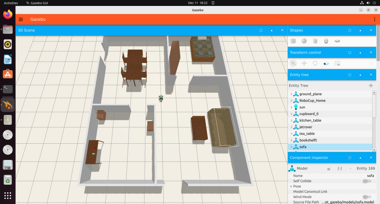

(2) Execute the command below to launch the Gazebo model.
ros2 launch robot_gazebo worlds.launch.py moveit_unite:=true
The interface below indicates successful launch.

① Introduction to Shortcuts and Tools
Here, we will introduce some commonly used shortcuts and tools in Gazebo, using mouse controls as examples:
② Mouse Shortcuts
Left Mouse Button:
Drag the Map: Press and hold the left mouse button on the map to drag it.
Select Target: Click on a model to select it.
③ Middle Mouse Button or Shift + Left Mouse Button:
Press and hold while moving the mouse to rotate the view around the current target position.
④ Right Mouse Button or Mouse Wheel:
Hold the right mouse button or scroll the wheel to zoom in and out, focusing on the point under the cursor.
  • Toolbar Tools
We’ll explain a few tools from the toolbar using the following example:

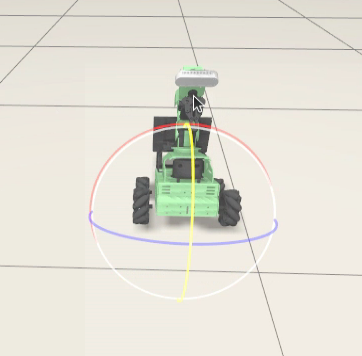

(1) Selection tool :This is Gazebo’s default tool, used to select models.
(2) Move Tool :Use this tool to select a model and drag the three axes to control its movement.
(3) Rotate Tool : Use this tool to select a model and drag the three axes to control its rotation.

cd /home/ubuntu/ros2_ws/src/robot_gazebo/urdf
(4) Use the following command to open the LiDAR simulation file for editing:
vim lidar.gazebo.xacro
This file contains details about the LiDAR simulation model, including its name, detection range, position, noise reduction settings, and topic messages.
To better understand this file, refer to the “Introduction to URDF Models” section for learning the relevant syntax.
  • IMU Simulation
Please ensure that you enter the commands with correct capitalization. You can use the “Tab” key to autocomplete keywords.
(1) Start the virtual machine. Click-on the icon to initiate the command-line terminal.
(2) Run the following command and hit Enter key to navigate to navigate to the program directory:
(3) Enter the following command to open the IMU simulation model file:
vim imu.gazebo.xacro
This file defines properties of the IMU simulation model, such as name, offset settings, noise reduction settings, acceleration settings, topic messages, and more. To understand this file, please refer to the “Introduction to URDF Models” for relevant syntax.

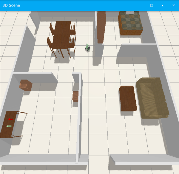

8.4.6 Gazebo Mapping Simulation
  • Operation
When entering commands, be sure to distinguish between uppercase and lowercase letters, and use the “Tab” key to auto-complete keywords.
If you need to perform mapping in an ideal environment but cannot do so in a real-world setting, you can create the desired scene in Gazebo for simulation-based mapping.
(1) Start the virtual machine. Click-on the icon to launch the command-line terminal.
Wait for each service to fully start before launching the next one to avoid simulation failure.
(2) Enter the following command to start the Gazebo simulation:
ros2 launch robot_gazebo room_worlds.launch.py
(3) Enter the following command in the new terminal to launch the mapping service:
ros2 launch robot_gazebo slam.launch.py
  • Mapping Instructions
(1) Execute the following command to initiate the keyboard control.
ros2 run robot_gazebo teleop_key_control
After the following window appears, click anywhere inside the window to start controlling the robot. The specific key functions are as follows:
Key Function Description
w Move forward Click
s Move backward Click
a Turn left Hold
d Turn right Hold
(2) The mapping process will be displayed synchronously in the RVIZ tool, as shown in the image below.
Continue the scanning until the map reaches a state similar to the one shown below.
(3) Enter the directory to save the map and save the map:
cd ~/ros2_ws/src/robot_gazebo/maps && ros2 run nav2_map_server map_saver_cli -f "map_01" --ros-args -p map_subscribe_transient_local:=true
In the command, map_01 is the name of the map. You can rename it according to your needs. If the following message appears, the map has been saved successfully.
(4) To stop the program running in the current terminal window, press the shortcut Ctrl+C.

(2) Execute the following command to initiate the integration of the Gazebo and MoveIt2.

(1) In the MoveIt2 Debugging Area, find and click on the “Planning” section.
(2) In the Simulation Model Adjustment Area, there are three colored arrows: red, green, and blue. Click and drag the arrows to adjust the robotic arm’s orientation. From the robot’s perspective:
Green represents the X-axis (positive direction is to the left of the robot).
Red represents the Y-axis (positive direction is in front of the robot).
Blue represents the Z-axis (positive direction is above the robot).
(3) After successfully planning the arm’s motion path, the new position will be highlighted in orange. If the new position causes a collision with other parts of the robot, it will be marked in red. In this case, you need to adjust the position to avoid the collision; otherwise, the action cannot be executed.
Orange indicates an executable state, as shown below:
For example, if the robotic arm is positioned as shown in the image, it will collide with the depth camera, turning red (non-executable state) as shown below:
(4) Once the path is planned, return to the “Planning” section and click “Plan”. The simulation model will demonstrate the movement path from the original position to the newly planned position.
(5) Next, click “Execute” to make both the simulation model and the robotic arm follow the planned path.
(6) Alternatively, click “Plan & Execute”, and the robotic arm will first display the newly planned movement path, then execute the motion.
(7) You can also observe that the path planned in MoveIt2 is synchronized with the Gazebo interface.

(1) To control the gripper movement, select gripper in the “Planning Group”.
(2) Drag the r joint to control the gripper’s rotation.
(3) Once the motion trajectory is planned, return to “Planning” and click “Plan & Execute” to execute the movement.
