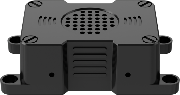

WonderEcho Pro, also known as the AI Voice Interaction Box, is equipped with a high-performance noise-canceling microphone and a high-fidelity speaker. It uses a USB-to-audio module that is plug-and-play and requires no driver installation, and supports both playback and recording across multiple operating systems.
By integrating various voice processing modules, the voice recognition module uses advanced noise suppression algorithms to effectively filter background noise. It supports the entire voice interaction process—from wake word detection to speech recognition and response. Thanks to its modular design, each component can be independently developed and tested, such as wake word detection, voice activity detection, speech recognition, and synthesis.
11.1.2 Key Features & Specifications
  • Built-in microphone and speaker interface, supporting both audio input and output
  • Plug-and-play functionality with driver-free operation. Compatible with multiple operating systems: Windows, macOS, Linux, Android
  • USB 2.0 standard interface
  • Control interface: USB
  • Voice processing chip: CL1302
  • Speaker output: 3.0W per channel (4Ω BTL)
  • Power supply: 5V DC

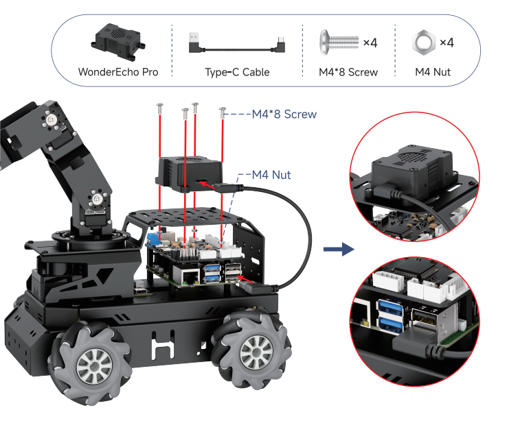

11.2 WonderEcho Pro Installation
When installing the WonderEcho Pro, ensure that the front of the robot is facing forward, and the USB port of the WonderEcho Pro is facing to the left, which is the direction of the Raspberry Pi’s USB port.

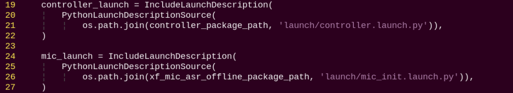

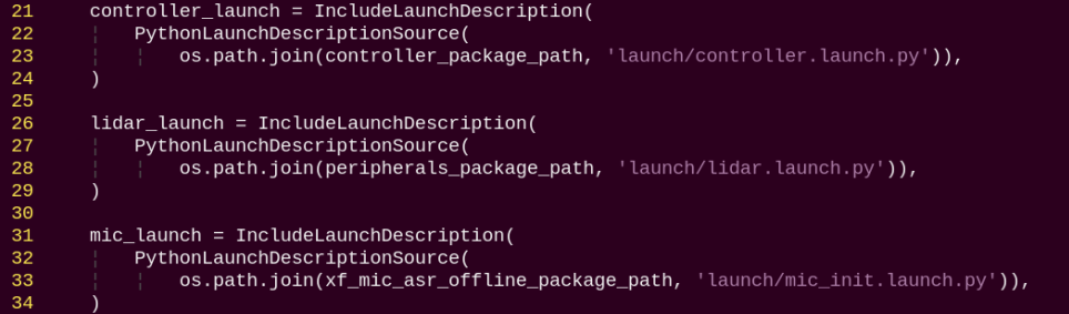

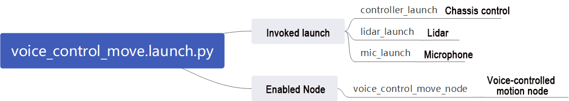

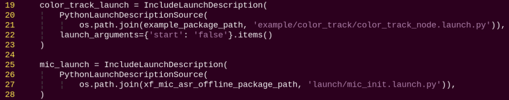

1. launch File
The launch file is located at:
/home/ubuntu/ros2_ws/src/xf_mic_asr_offline/launch/voice_control_move.launch.py
launch File
controller_launch: Used to start the chassis control node. After launching, it allows control of the servo motors.
lidar_launch: Starts the lidar node, which will publish lidar data.
mic_launch: Starts the microphone functionality.

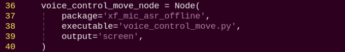

Start Nodes
voice_control_move_node: Used to invoke the voice control move source code and start the program.

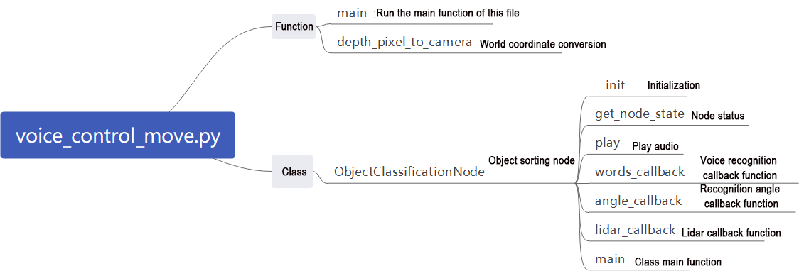

2. Python Launch File

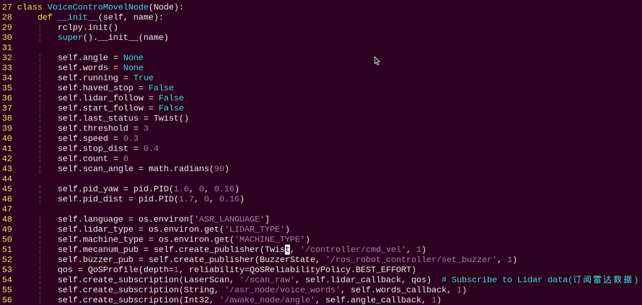

The source code for this program is located at:
/home/ubuntu/ros2_ws/src/xf_mic_asr_offline/scripts/voice_control_move.py
Functions

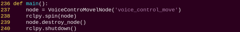

Main:
Starts the voice control movement.
Class:
VoicecontroMovelNode:
Init:
Initializes various parameters, calls chassis node, buzzer node, lidar node, and voice recognition node, and finally starts the main function.
get_node_state:
Initializes the node state.

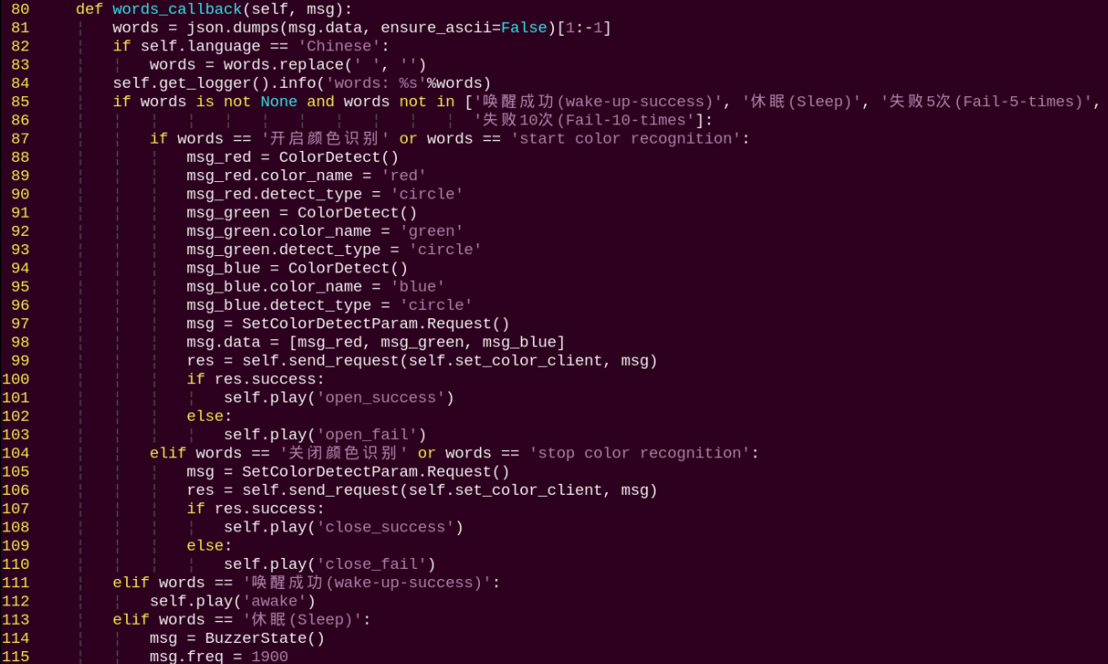

Play:
Plays audio.

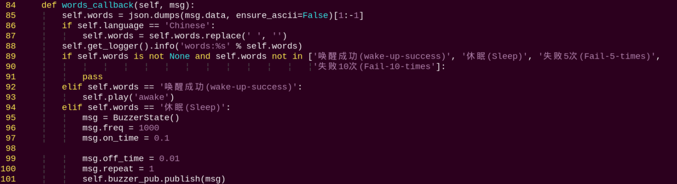

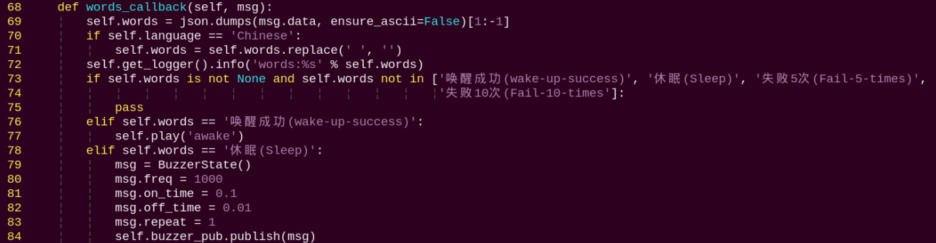

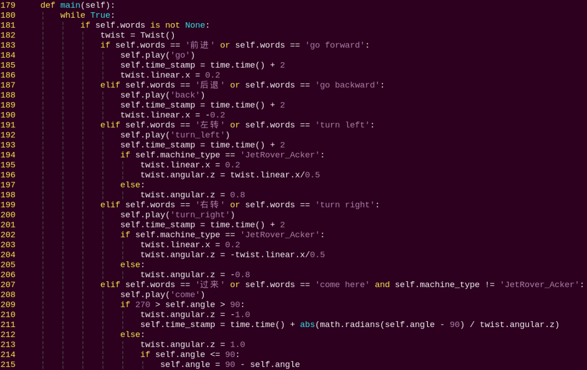

words_callback:
The voice recognition callback function, which reads the data sent back by the microphone through the node.
angle_callback:
The sound source recognition callback function, which reads the angle of the sound source based on the direction of the wake word. The angle is detected by the microphone’s sound source localization.

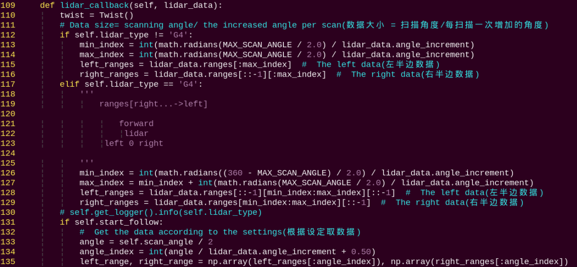

lidar_callback:
The lidar callback function processes lidar data. The robot follows the detected sound source angle and uses PID to compute the angular velocity. It then tracks the nearest object by combining the radar’s scan data, and adjusts the linear and angular velocities according to the radar’s location of the object.
Main:
The execution strategy after receiving a command involves publishing different linear and angular velocities based on the command, used to control the robot’s movement in various directions.

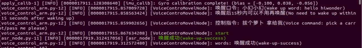

  • Program Outcome

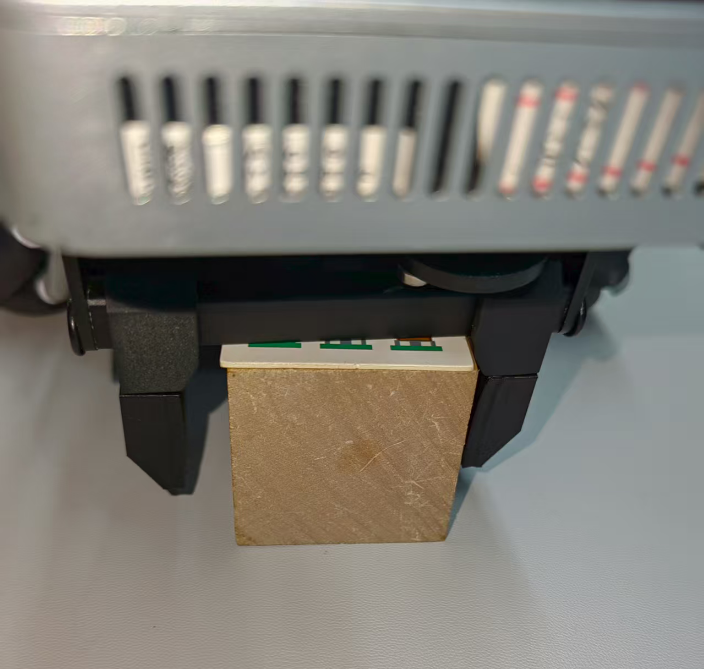

Once the program has loaded successfully, say the wake word Hello Hiwonder and wait for the device to respond I’m here.
Next, issuing the command Pick a carrot will make the robotic arm grasp the object directly in front. Saying Pass me please will prompt the arm to deliver the grasped object to the user from the side.

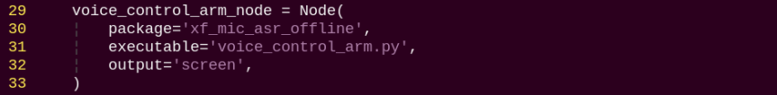

1. launch File
/home/ubuntu/ros2_ws/src/xf_mic_asr_offline/launch/voice_control_arm.launch.py

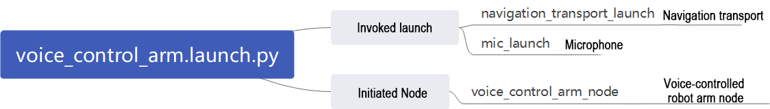

launch File
Start Nodes

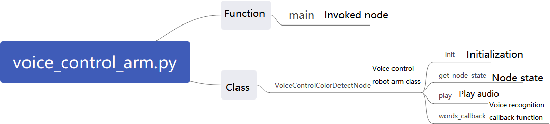

/home/ubuntu/ros2_ws/src/xf_mic_asr_offline/scripts/voice_control_arm.py
Functions
Main:
Class:
VoiceControlColorDetectNode:
Init:
Initializes various parameters, calls servo node, buzzer node, and voice recognition node, and finally starts the main function.
get_node_state:
Play:
Plays audio.

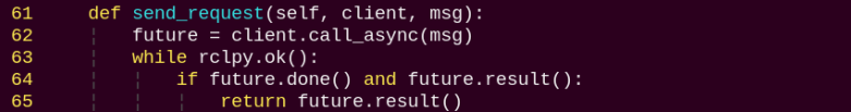

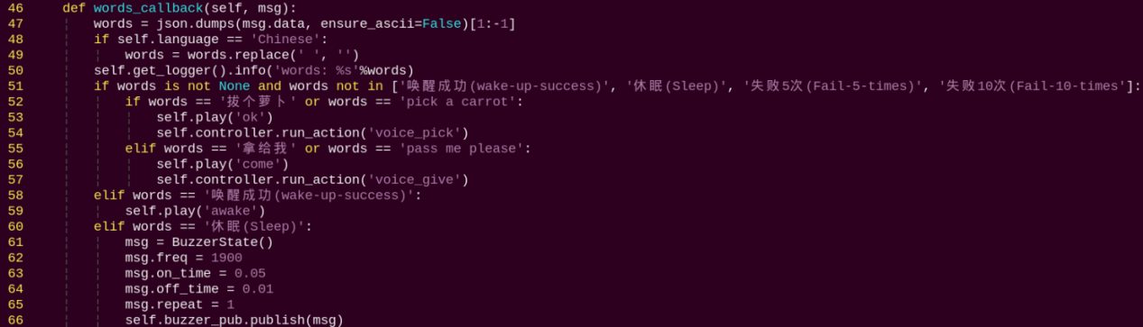

words_callback:
The speech recognition callback function reads the data returned by the microphone through the node and executes the corresponding action group based on the recognized speech.

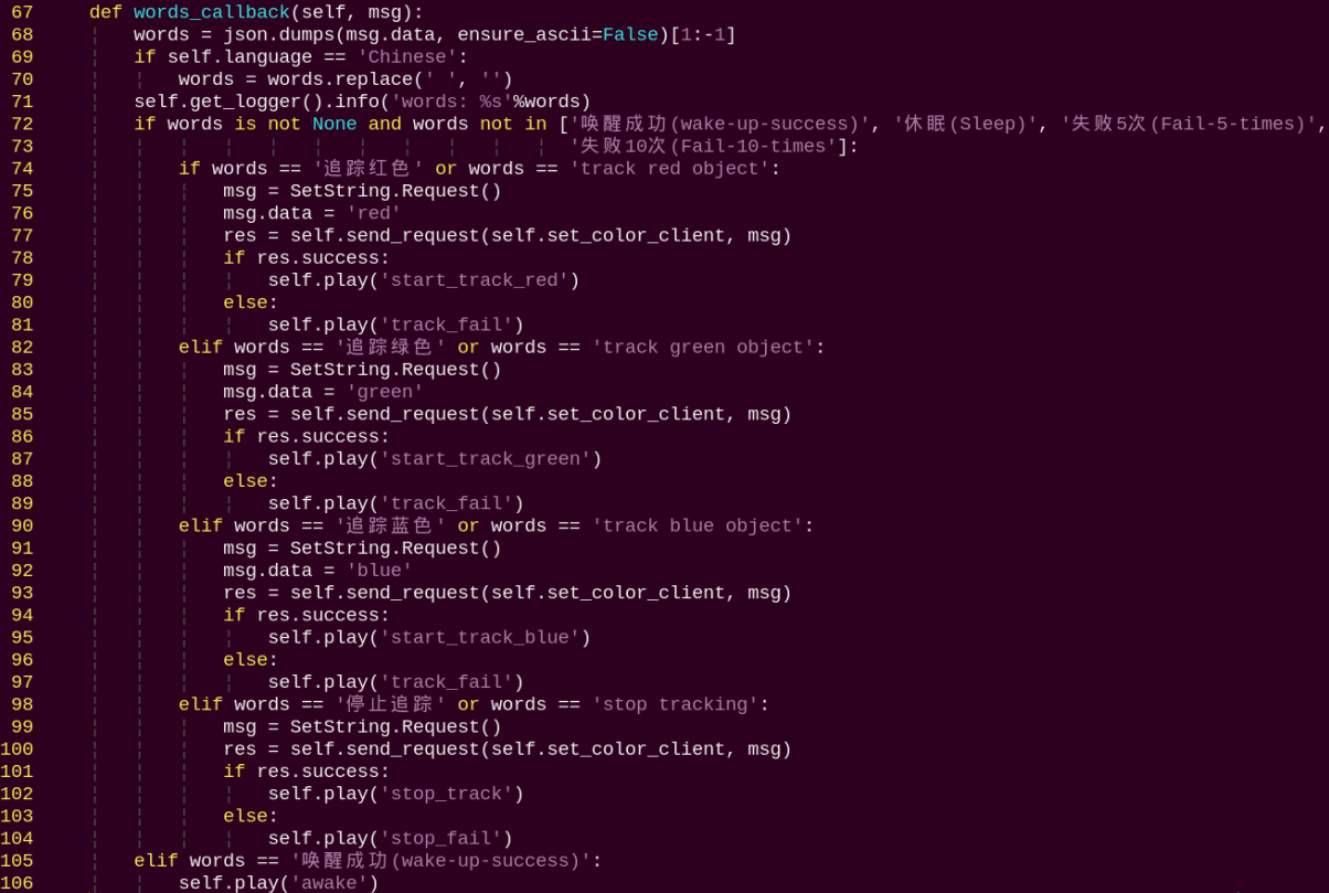

11.3.3 Voice Control for Color Recognition
  • Overview
This experiment uses the robot’s built-in speech recognition in combination with the vision-equipped robotic arm to identify objects in three different colors: red, green, and blue.
From a programming perspective, the system subscribes to the voice recognition service to process the incoming voice data through localization, noise reduction, and recognition, and then retrieve the recognized sentence and the angle of the sound source. Once the robot is successfully awakened and a specific voice command is issued, it provides corresponding voice feedback. At the same time, the onboard camera detects objects in red, green, and blue.
To complete this feature, refer to the Preparation section below, followed by the Operation Steps section to proceed with the setup and usage.
  • Preparation
Before starting this section, you need to follow the section 11.2 WonderEcho Pro Installation to install it on the robot. If already installed, you may skip this step. After installation, connect it to the USB port 4 of the Raspberry Pi.
  • Operation Steps
  • Ensure that no objects with similar or identical colors to the target block appear in the background, as this may cause interference during recognition.
  • If the color detection is inaccurate, the color thresholds can be adjusted in the 7. ROS+OpenCV Course.
  1. Power on the robot and connect it to a remote control tool like VNC. For detail informations, please refer to 1.4 Development Environment Setup and Configuration in the user manual.
  2. By default, the system uses the English wake word Hello Hiwonder to activate the robot. If you wish to change the language to Chinese or modify the wake word, please refer to the section on 11.4 Switching Wake Words Between Chinese and English for guidance.
  3. Click the terminal icon in the system desktop to open a command-line window.
  4. Enter the command to disable the app auto-start service.
  1. Enter the following command and press Enter to launch the feature.
ros2 launch xf_mic_asr_offline voice_control_color_detect.launch.py
  1. To disable this feature, open a new command-line terminal and enter the following command:
  1. Next, simply close all the open terminals.
  • Program Outcome

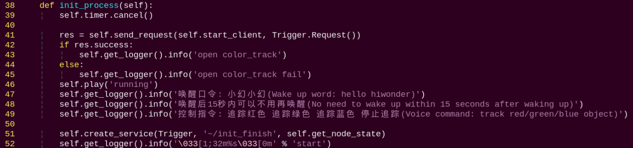

After starting the program, first say the wake-up phrase Hello Hiwonder, then say the command Start color recognition to make the robot begin detecting colors. The robot will identify the color and announce its name. For example, place a red block within the camera’s field of view. When the red object is detected, the robot will announce Red.
To stop the feature, say the wake word Hello Hiwonder followed by the command Stop color recognition.

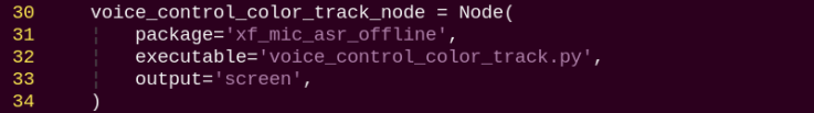

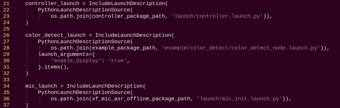

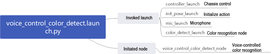

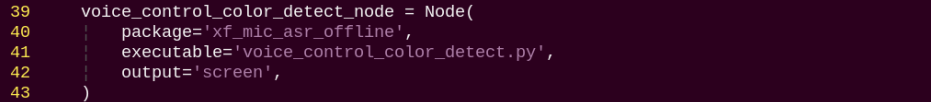

1. launch File
/home/ubuntu/ros2_ws/src/xf_mic_asr_offline/launch/voice_control_color_detect.launch.py
launch File

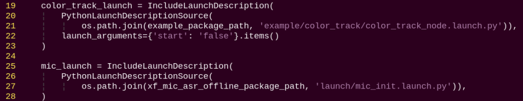

color_detect_launch: Starts the color recognition node.

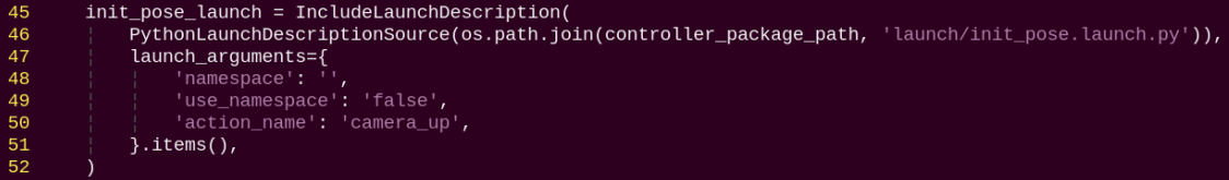

init_pose_launch: Initializes the robot’s actions.
Start Nodes

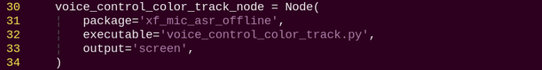

voice_control_color_detect_node: Used to call the source code for voice-controlled color detection and launch the program.

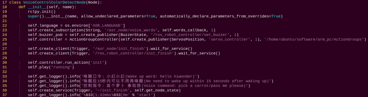

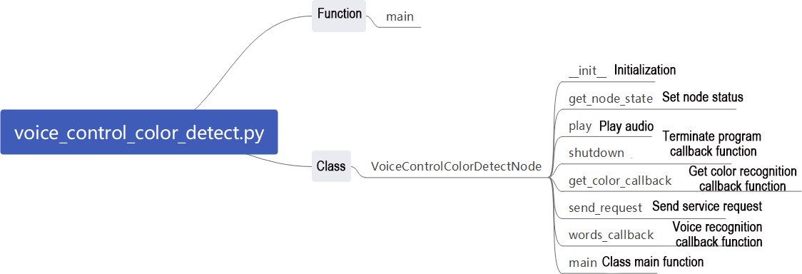

2. Python Program
/home/ubuntu/ros2_ws/src/xf_mic_asr_offline/scripts/voice_control_color_detect.py

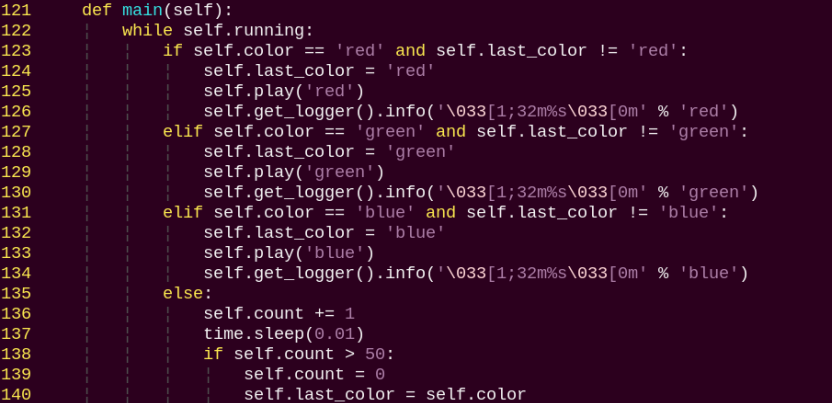

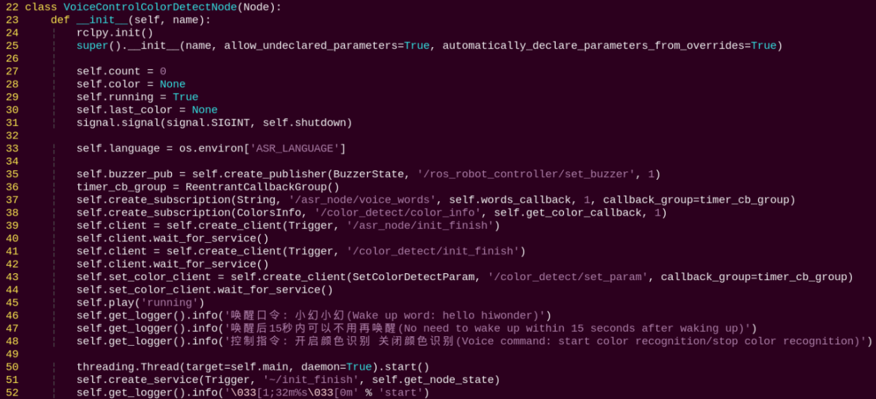

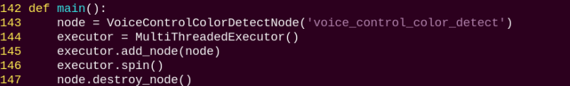

Functions
Main:
Starts the voice-controlled color detection.
Class:

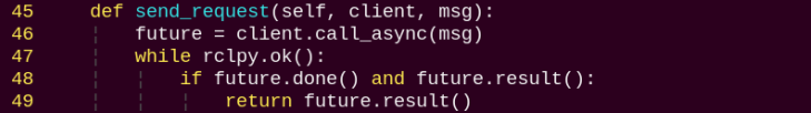

Init:
Initializes various parameters and calls the chassis node, buzzer node, lidar node, voice recognition node, and color recognition node. Finally, the main function is launched.

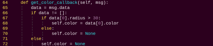

get_color_callback:
Receives information from the color recognition node and provides the current color recognition result.

words_callback:
Voice recognition callback function that controls whether color recognition should be started based on the recognized voice. If started, it will respond according to the color recognition node’s information.
Main:
Based on the recognized color, it announces the corresponding color name.

1. launch File
/home/ubuntu/ros2_ws/src/xf_mic_asr_offline/launch/voice_control_color_track.launch.py
launch File
color_track_launch: Starts the color tracking node.
Start Nodes
voice_control_color_track_node: Used to call the source code for voice-controlled color tracking and launch the program.

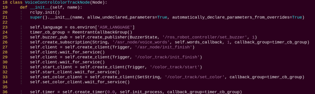

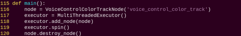

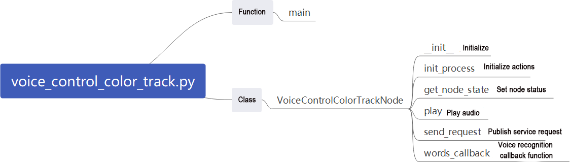

2. Python Program
/home/ubuntu/ros2_ws/src/xf_mic_asr_offline/scripts/voice_control_color_track.py
Functions
Main:
Launches the voice control color tracking.
Class:
VoiceControlColorTrackNode:
Init:
Initializes various parameters, calls the buzzer node, voice recognition node, and color tracking node, then initializes the actions.
init_process:
Starts the color tracking feature and provides command prompts and node initialization markers.
get_node_state:
Sets the current node state.
Play:
Plays audio.

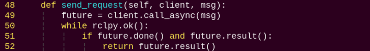

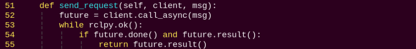

send_request:
Publishes a service request.
words_callback:
Voice recognition callback function that controls whether to start color tracking based on the recognized speech. It reports the corresponding audio based on the recognition result, passes the color to be tracked to the color tracking node, and the tracking logic is implemented within the color tracking node.

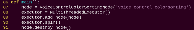

Main:
Starts the voice control for color sorting.

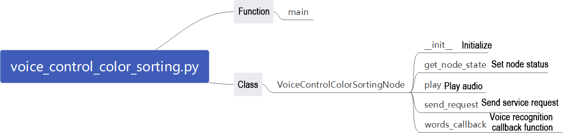

Class:

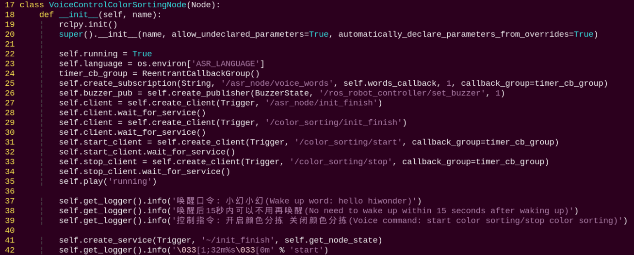

VoiceControlColorSortingNode:
Init:
Initializes parameters and calls the voice recognition and color sorting nodes.
get_node_state:
Play:
Plays audio.
send_request:
words_callback:
Voice recognition callback function that controls whether to start sorting and announces the corresponding result based on the recognized speech. The sorting is implemented within the color sorting node.

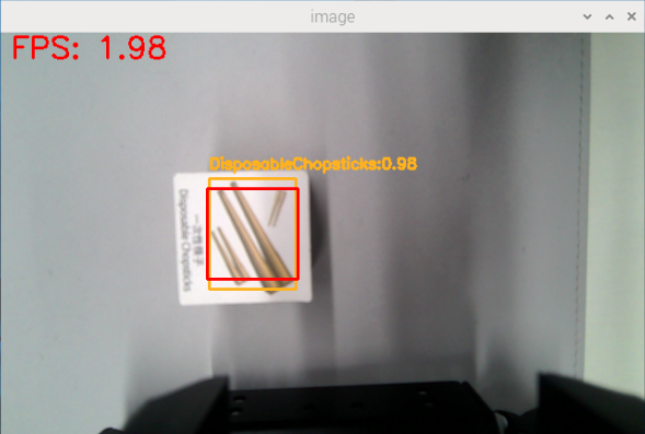

  • Program Outcome

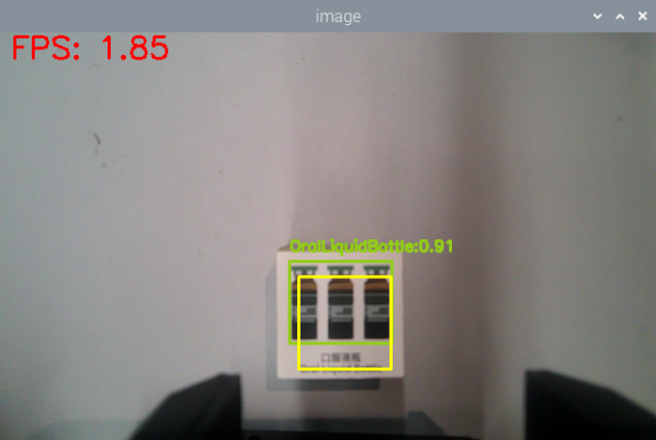

  1. The robot arm will then lift up, entering the ready-to-recognize state. Say the wake word Hello Hiwonder, and then issue the command Sort waste. On the remote interface, a red bounding box will appear on the software screen indicating the calibration recognition area.
  1. Once the calibration and recognition are successful, the red frame in the image turns yellow, indicating the recognition area. Only the block with waste card placed within this yellow area will be detected and picked up by the robot arm.
The program uses colored bounding boxes to indicate detected objects. Next to each object name is a number between 0 and 1 representing the confidence score. For example, oral liquidBotte 0.91 means the model is 91% confident that the detected object belongs to the oral liquidBotte category. Better lighting conditions generally result in higher recognition accuracy.
  1. Next, the robot will place the waste block into the corresponding color area which can be replaced, as shown below.

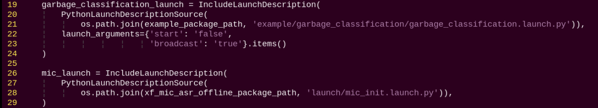

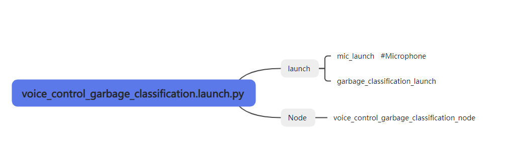

1. launch File
Voice-controlled waste sorting allows the voice control node to establish a connection with the camera node. By issuing voice commands, the robot can either enable or disable the sorting feature. Once the robot successfully grabs the corresponding waste card, it will report its classification via voice feedback.
/home/ubuntu/ros2_ws/src/xf_mic_asr_offline/launch/voice_control_garbage_classification.launch.py
launch File
garbage_classification_launch: Starts the waste classification node.
Start Nodes
voice_control_garbage_classification_node: Used to call the source code for voice-controlled color sorting and launch the program.

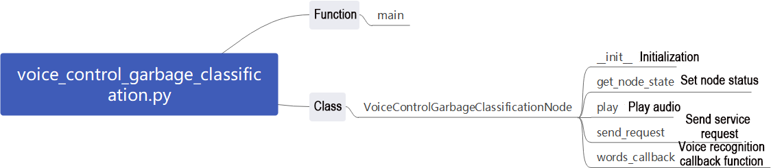

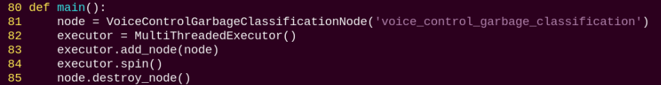

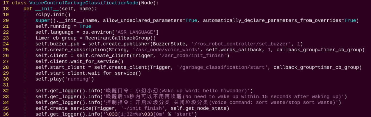

2. Python Program
/home/ubuntu/ros2_ws/src/xf_mic_asr_offline/scripts/voice_control_garbage_classification.py
Functions
Main:
Starts the voice control for waste classification.
Class:
Init:
Initializes all parameters, calling the buzzer node, voice recognition node, and waste sorting node.
get_node_state:
Play:
Plays audio.

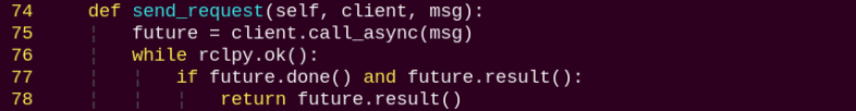

send_request:
words_callback:
Voice recognition callback function that controls whether to start waste classification and announces the corresponding result based on the recognized speech. The sorting is implemented within the waste classification node.

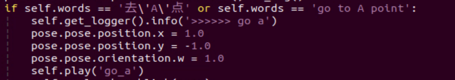

11.3.7 Voice Control for Multi-Point Navigation
In this section, voice control will be used to navigate the robot on a pre-built map.
  • Overview
First, open the robot’s navigation service and load the map, then start the multi-point navigation service.
Next, subscribe to the voice recognition service published by the voice box node, performing operations such as source localization, noise reduction, and speech recognition, to obtain the recognized command and sound source angle.
Afterward, the microphone will recognize the spoken commands. Once the wake-up word and control commands are detected and the recognition threshold is met, the robot will respond with the corresponding voice feedback.
Finally, based on the recognized language, the robot will navigate to the corresponding location on the map. Navigation will first perform global planning, and during movement, local planning will be applied when encountering obstacles.
  • Preparation
  1. Before starting this section, you need to follow the section 11.2 WonderEcho Pro Installation to install it on the robot. If already installed, you may skip this step. After installation, connect it to the USB port 4 of the Raspberry Pi.
  2. Create a map of the current area where the robot is located. For instructions on how to build a map, refer to the tutorials under 6. Mapping & Navigation Course.
  3. Place the robot on an open platform, ensuring that there is enough space for movement, with at least 3 meters around the robot.
  • Operation Steps
When entering commands, be sure to use correct case and spacing. You can use the Tab key to auto-complete keywords.
  2. By default, the system uses the English wake word Hello Hiwonder to activate the robot. If you wish to change the language to Chinese or modify the wake word, please refer to the section 11.4 Switching Wake Words Between Chinese and English for guidance.
ros2 launch xf_mic_asr_offline voice_control_navigation_transport.launch.py map:=map_01
The map_01 at the end of the command is the map name and can be modified according to your needs. The map is stored at the directory of /home/ubuntu/ros2_ws/src/slam/maps.
  • Program Outcome

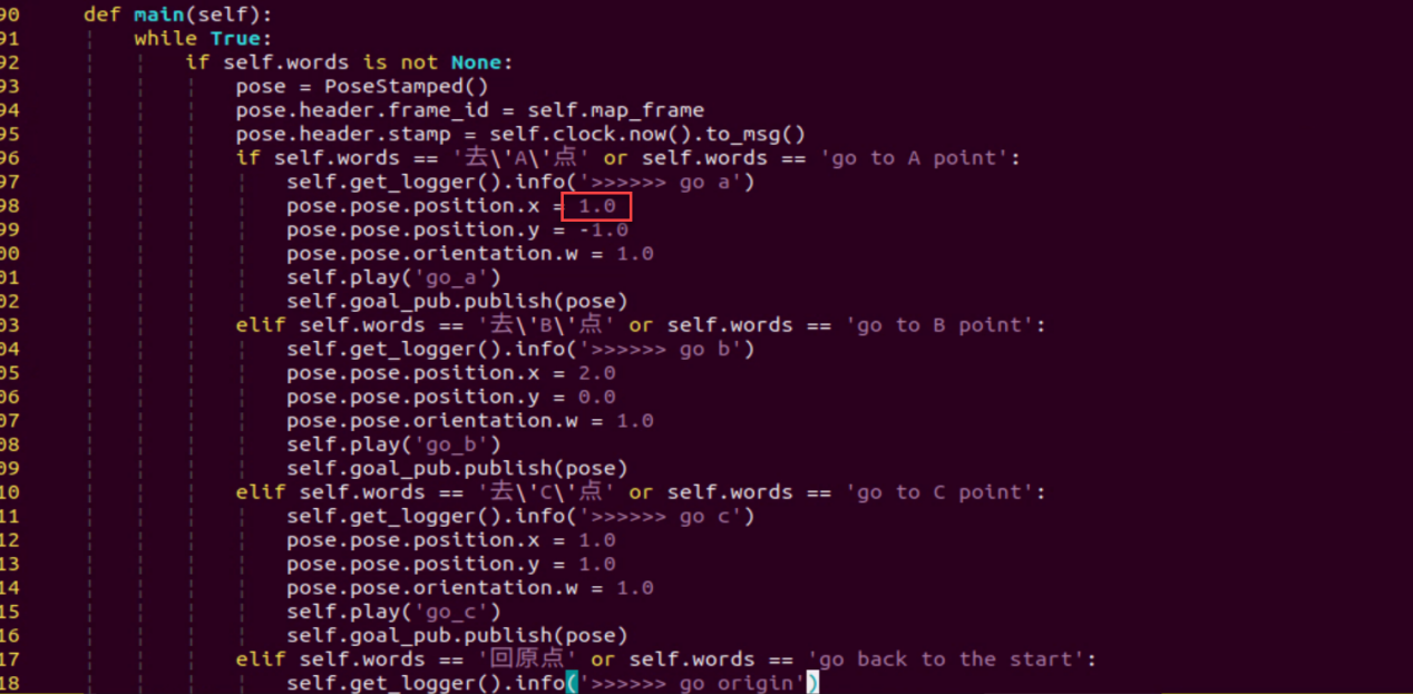

After launching the feature, say the wake word Hello Hiwonder, then issue a command to control the robot’s movement.
For example, first say Hello Hiwonder, and the robot will reply with I’m here. Next, you can say Go to A point, and the robot will move to the top-right of the starting position.
The command phrases and their corresponding functions are as follows. From the robot’s first-person perspective:
Command Phrase Function
Go to A point Move the robot to point A, top-right of the starting position.
Go to B point Move the robot to point B, top-left of the starting position.
Go to C point Move the robot to point C, directly below point A.
Go back to the start Move the robot back to the starting position.
  • Program Brief Analysis

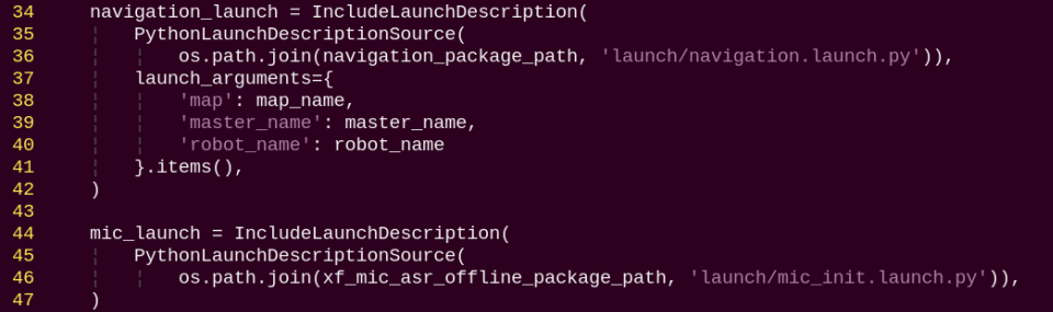

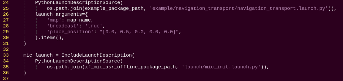

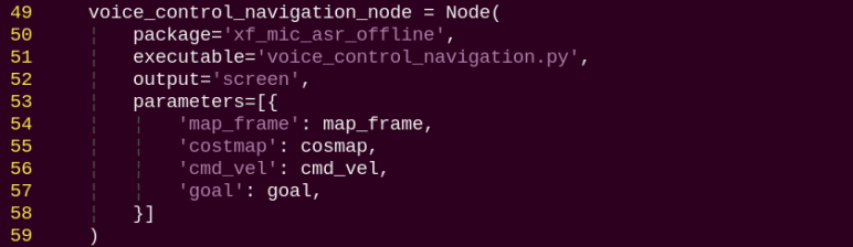

1. launch File
/home/ubuntu/ros2_ws/src/xf_mic_asr_offline/launch/voice_control_navigation.launch.py
launch File
navigation_launch: Starts the navigation system.
Start Nodes
voice_control_navigation_node: Used to invoke the voice control multi-point navigation source code and start the program.

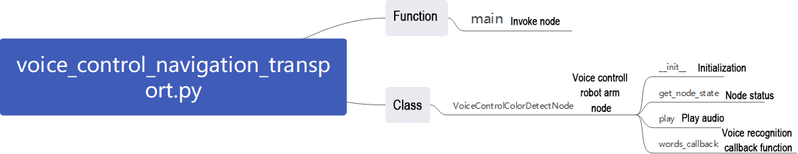

  • Python Program
/home/ubuntu/ros2_ws/src/xf_mic_asr_offline/scripts/voice_control_navigation.py
Functions

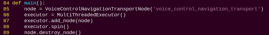

Main:
Starts the voice control for multi-point navigation.

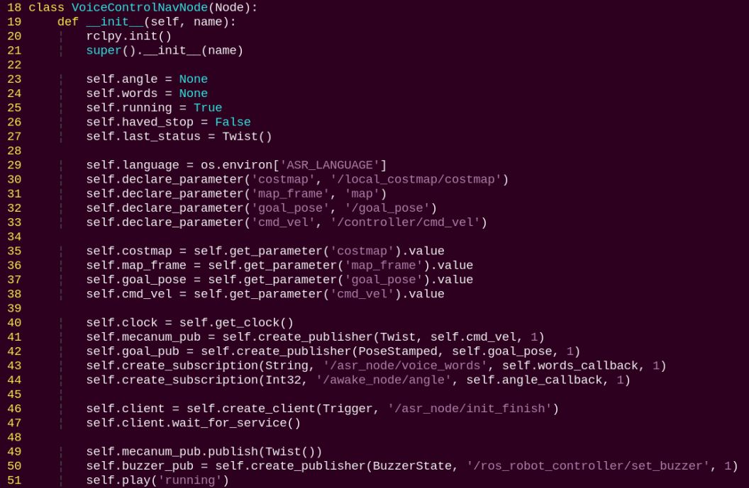

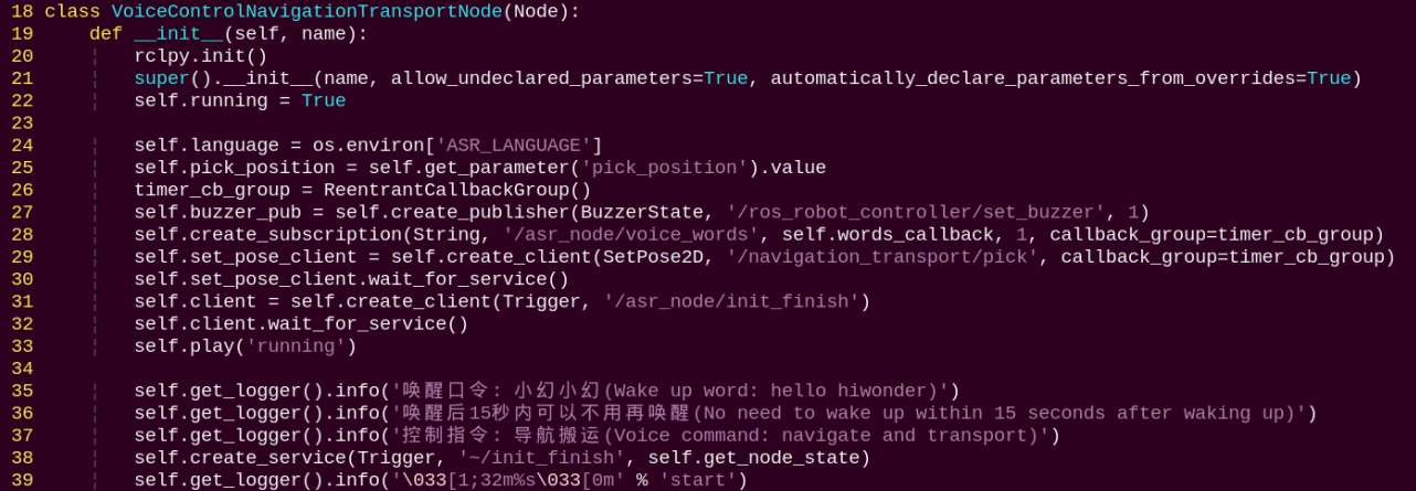

Class:
VoiceControlNavNode:
Init:
Initialize various parameters, set the navigation parameters, call the voice recognition node, the buzzer node, and then start the main function.
get_node_state:
Play:
Plays audio.

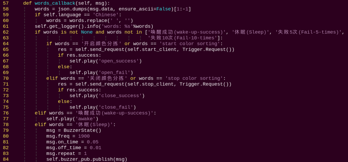

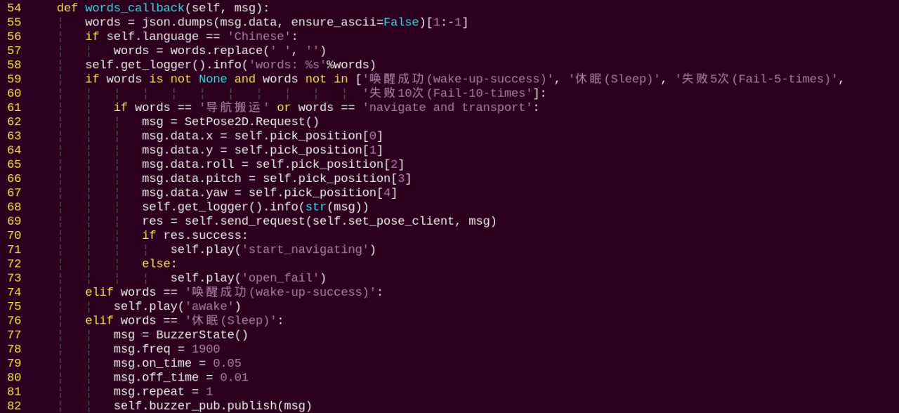

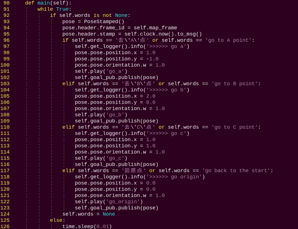

words_callback:

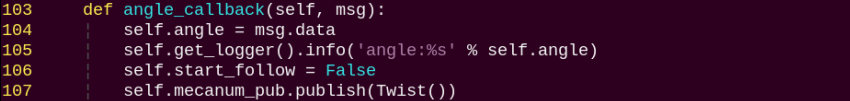

angle_callback:
The sound source recognition callback function, which reads the angle of the sound source relative to the microphone after waking up.
Main:
Based on the node recognized by the speech, publish the navigation points to the navigation node and provide voice feedback.

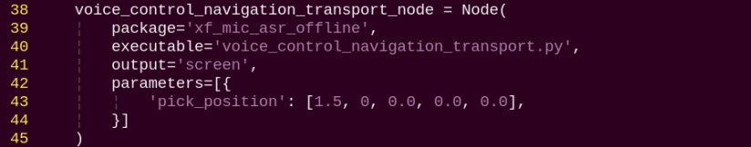

  • Feature Extension
The default position of Point A is at the top-right corner of the robot’s starting position on the map, with coordinates (1, -1) in meters. To change the location of Point A, modify the coordinate values. For example, to place Point A at the bottom-right corner of the starting position, follow these steps:
  • You can refer to this process to modify the locations of Points B and C.
  • The input command should be case sensitive, and the keywords can be complemented by “Tab” key.
  3. Enter the command to disable the app auto-start service.
  1. Open the program file by entering the command.
vim ./ros2_ws/src/xf_mic_asr_offline/scripts/voice_control_navigation.py
  1. In the opened file, locate the APPID section as shown in the reference image.
  1. Press the key i to enter edit mode, change the value 1 to -1.
The positive direction of the X-axis is considered the front, while the positive direction of the Y-axis is to the left. To place Point A in the bottom-right corner of the robot’s starting position, change the X-axis coordinate of Point A from positive to negative.
  1. Once the modification is complete, press the Esc key, type :wq, and press Enter to save and exit the file.
  2. Refer to Operation Steps to restart the feature and observe the effect of the modified setup.

1. launch File
/home/ubuntu/ros2_ws/src/xf_mic_asr_offline/launch/voice_control_navigation_transport.launch.py
launch File
navigation_transport_launch: Starts the navigation and transport feature.
Start Nodes
2. Python Program
/home/ubuntu/ros2_ws/src/xf_mic_asr_offline/scripts/voice_control_navigation_transport.py
Functions
Main:
Class:
VoiceControlNavigationTransportNode:
Init:
Initialize all parameters, set the necessary parameters for navigation and transportation, call the voice recognition node and the navigation transport node, and start the main function.
get_node_state:
send_request:
Play:
Plays audio.
words_callback:
Voice recognition callback function that controls whether navigation should be started based on the recognized voice.

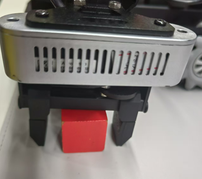

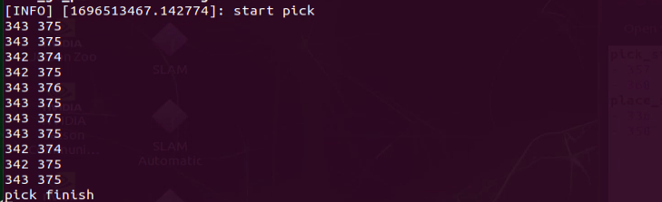

  • Grasp Calibration
The program defaults to recognizing and gripping objects in the center of the screen, so normally no adjustments are needed. However, if during feature the robot arm fails to grip the object, you can adjust the gripping area by using program instructions. The specific steps are as follows:
  1. To begin grasp calibration, enter the following command:
ros2 launch example automatic_pick.launch.py debug:=true
  1. Wait for the robot arm to reach the gripping position, then place the color block in the center of the gripper. Wait for the arm to reset and grab the block again to complete the calibration. Once calibrated, the terminal will display the pixel coordinates of the color block in the camera view along with a completion message.
  1. After calibration, follow the steps in section Operation Steps to operate the feature again.

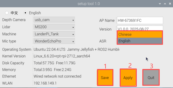

The system’s default wake word is Hello Hiwonder. To switch to a Chinese wake word or modify the wake word, follow the steps below.
  1. First, burn the corresponding language firmware. For detailed instructions, refer to the section Voice Module Introduction and Installation in 12. Large AI Model Course for burning the Chinese firmware. If you need to modify the wake word, you can refer to 12.2.4 Firmware Creation to create and burn the desired firmware.
WonderEcho Pro
  1. Connect to the robot via VNC, use the configuration tool on the desktop to set and save, and double-click the Tool icon on the system desktop.
  2. Set the language to Chinese, then click Save > Apply > Quit.
