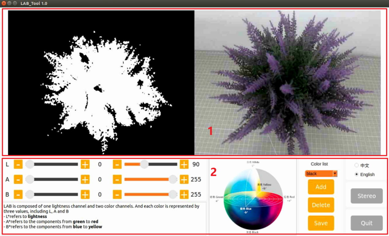

7.1.2 LAB TOOL Interface Introduction
LAB TOOL is divided into two parts, including image display area and recognition adjustment area.
  1. Image display area: at left is the processed image, and at right is the raw image.
If the camera returned image doesn’t occur, it is possible that the camera fails to connect. And you need to check the camera wiring.

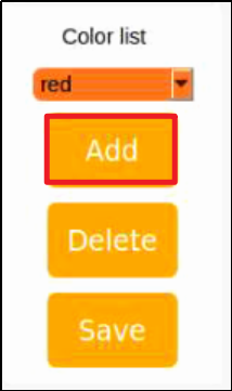

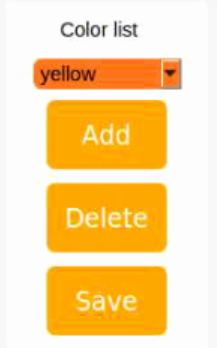

  1. In the recognition adjustment area, you can adjust the color threshold in this area. The functions of the buttons are listed below.
Icon Function
Slider L, A and B are respectively used to adjust L, A and B components of the camera returned image.
The sliders at left represent min value, and the sliders at right represent max value.
Select the color to be adjusted
Delete the selected color
Add new colors

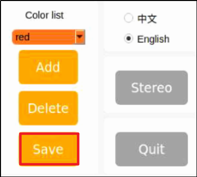

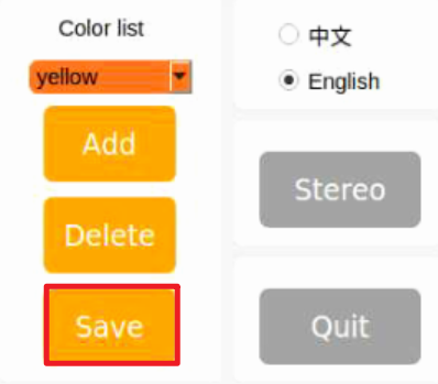

Save the adjusted value
Switch the camera between depth camera and monocular camera
Exit from the LAB TOOL

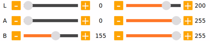

7.1.3 Adjusting Color Threshold
  1. Open LAB TOOL, and select the color in the drop down menu, and adjusting red color for an example in this section.

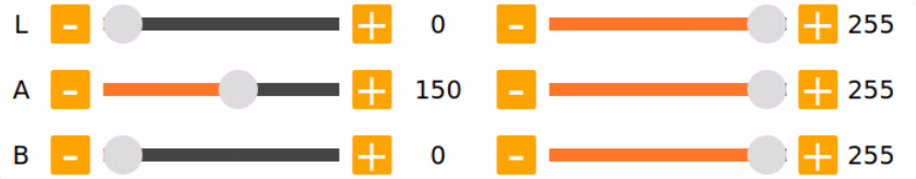

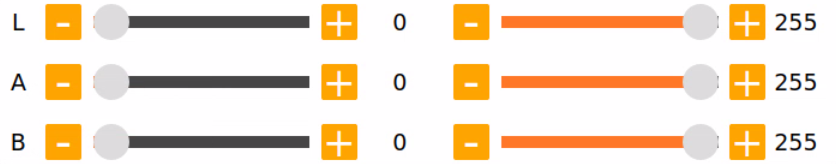

  1. Modify all min values of L, A and B as 0, and max values as 255.

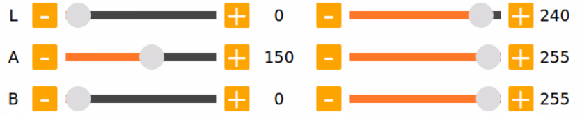

  1. Put the red block within the camera frame. According to the LAB color space, adjust L, A and B components to approach the zone of the target color.
Red is around +a zone, hence you need to increase A component that is remain max value of A component the same and increase min value till the red block at left turns white and other area turns black.
  1. Based on the environment, modify the value of L and B. If the red appears too light, increase the min value of the L component. If it appears too dark, decrease the max value of the L component. If the red looks too warm, increase the min value of the B component. If it looks too cool, decrease the max value of the B component.
LAB Threshold Adjustment Parameter
Color Component Range Corresponding Color Zone
L 0~255 Black-White(-L ~ +L)
A 0~255 Green-Red(-a ~ +a)
B 0~255 Blue-Yellow(-b ~ +b)
  1. Click Save to save the adjusted color threshold parameter.

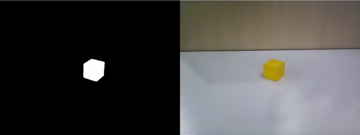

7.1.4 Add a New Recognition Color
Besides the built-in recognition colors, you can add new colors. For example, yellow.

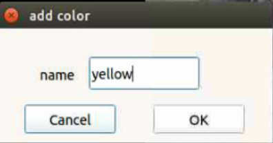

  1. Open LAB TOOL and click Add button.
  1. Then fill in yellow, and click OK.
  1. Select the color you added before in the drop-down menu.
  1. Face the camera to the yellow block. And then drag the slider of L, A and B to adjust the color threshold till the object at left turns white and other area turns black.
For how to adjust the color threshold, please scroll up to 7.1.3 Adjusting Color Threshold in this document.
Once the adjustment is completed, press Ctrl + C to disable the camera service, then click Close to exit the interface.

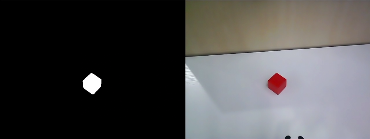

7.2.3 Program Outcome

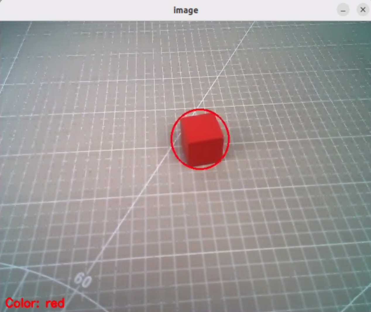

After the feature starts, please ensure there is no other object containing the recognition color except the target object within the camera view, otherwise the recognition result will be affected.
After the feature starts, put the objects within the camera’s view. When the target object is detected, the program will highlight it with a circle of the corresponding color and display the color name in the lower-left corner of the window. The program can recognize objects in red, blue, and green.

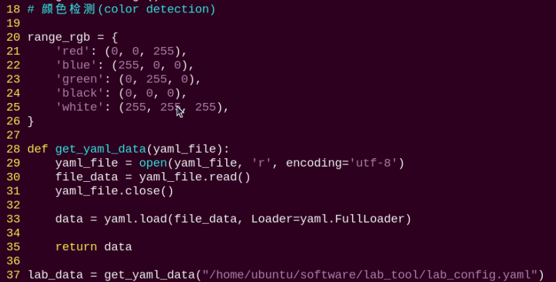

The source code for this program is located at:
/home/ubuntu/ros2_ws/src/example/example/color_detect/color_detect_demo.py

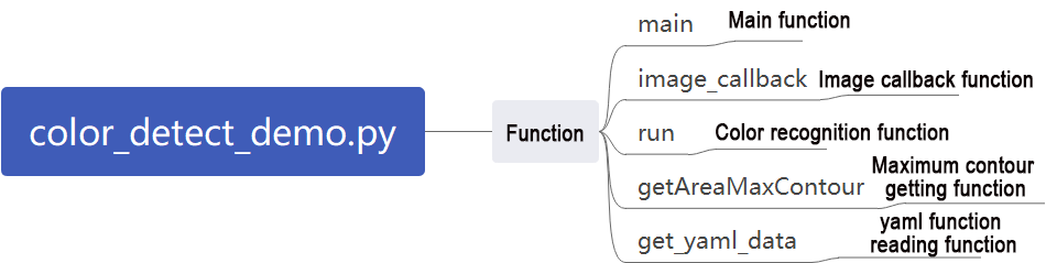

  • Main Function

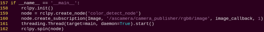

Initializes the ROS node and create the color detection node named color_detect_node, subscribes to the image topic /depth_cam/rgb/image_raw with image_callback as its callback function, runs the color detection main function using multi-threading, and waits for the node to shut down.
  • Functions
1. Camera Callback Function

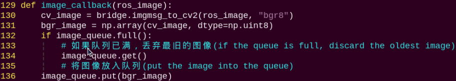

Reads the video stream from the topic and pushes frames into a queue to ensure real-time display.
2. Color Detection main Function
Reads images from the queue and feeds them into the run function to obtain color-detected frames. Finally, displays the processed frames using cv2.

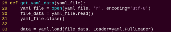

3. YAML File Reading Function

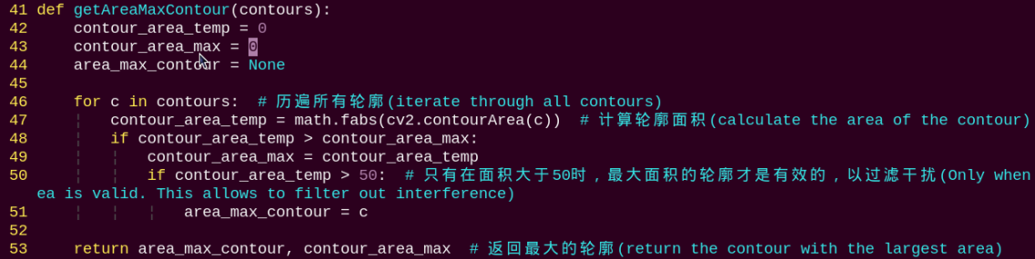

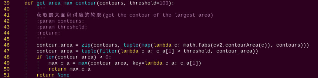

4. Maximum Contour Function
Takes contours detected by OpenCV as input, identifies the largest contour, and returns both the contour and its area.

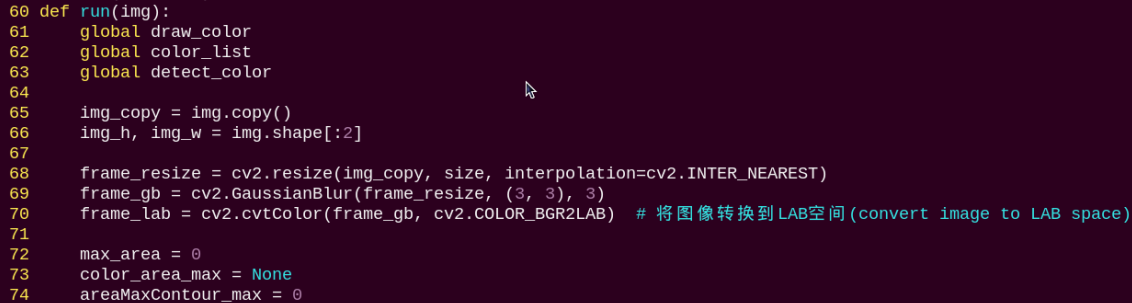

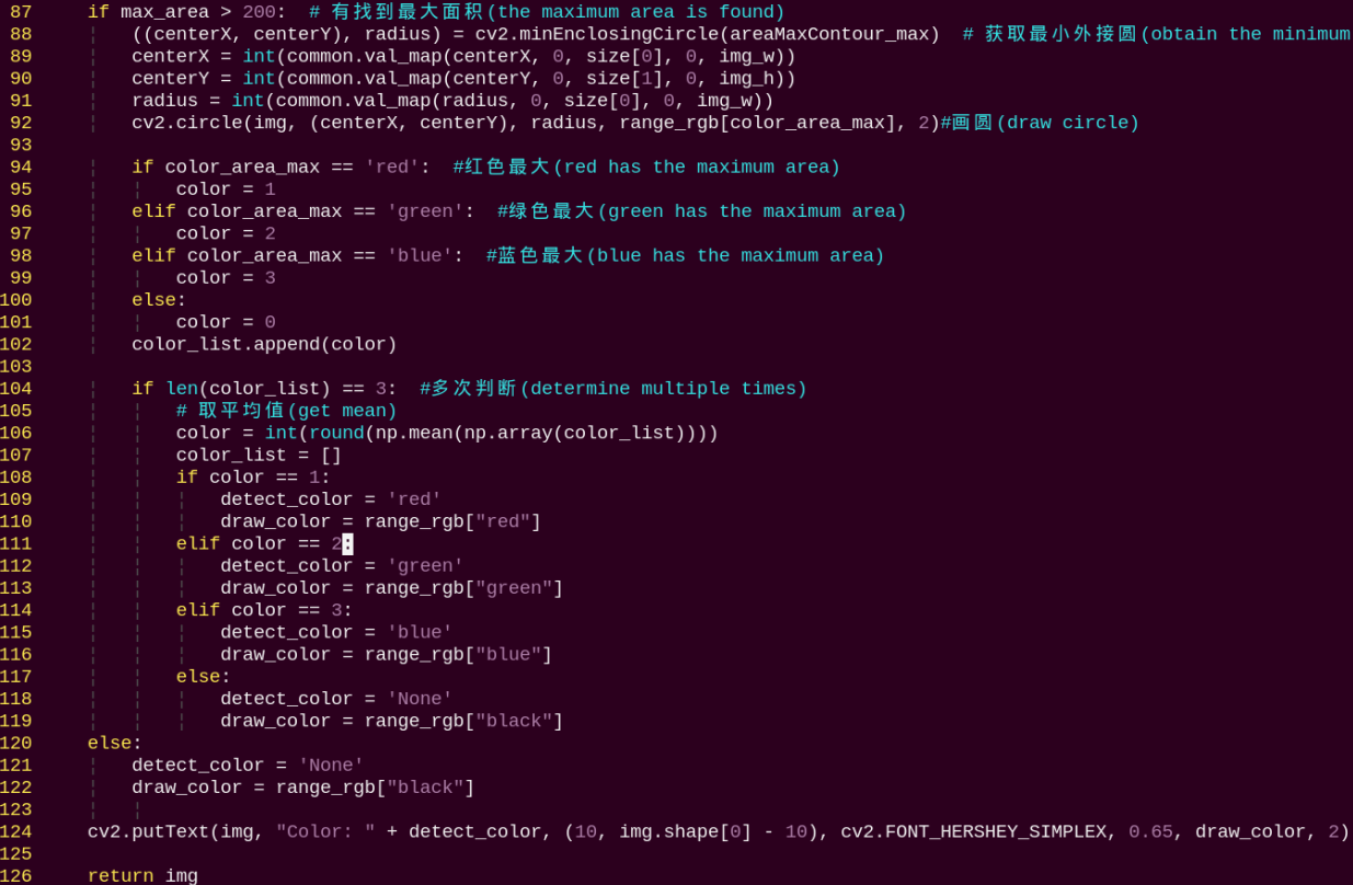

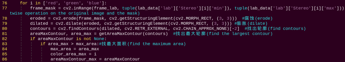

5. Color Detection Function
Inputs an image and resizes it to size(320, 240) for faster processing, then applies Gaussian blur and converts the image to the LAB color space.
Iterates through a list of target colors to detect the color of the largest contour.
Filters out contours with an area smaller than 200. For valid contours, calculates contour coordinates and draws the detected color’s position on the frame.

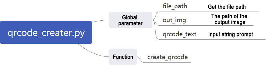

  • Program Brief Analysis
/home/ubuntu/ros2_ws/src/example/example/qrcode/qrcode_creater.py

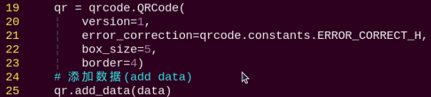

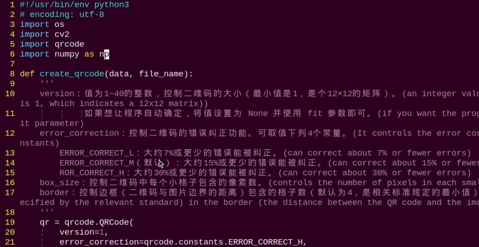

1. Creating a QR Code Tool Object
Use the qrcode module to create the required object and set the parameters for the QR code.
The meanings of the parameters in the function above are as follows:
(1) version – an integer from 1 to 40 that controls the size of the QR code. If you want the program to determine the size automatically, set it to None and use the fit parameter.
(2) error_correction – controls the QR code’s error correction capability. Possible values:
ERROR_CORRECT_L: can correct approximately 7% or fewer errors.
ERROR_CORRECT_M: default value, can correct approximately 15% or fewer errors.
ERROR_CORRECT_H: can correct approximately 30% or fewer errors.
(3) box_size – sets the number of pixels contained in each small square of the QR code.
(4) border – sets the number of squares in the border, which is the distance between the QR code and the edge of the image. Default is 4, which is the minimum specified by the standard.

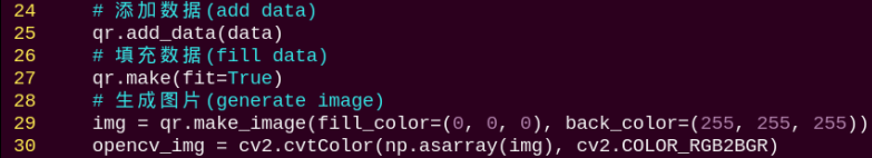

2. Generating a QR Code
Use the add_data and make functions to input and encode the data, then generate the QR code image using the make_image function.
(1) fill_color=(0, 0, 0) – the color of the QR code itself, here set to black.
(2) back_color=(255, 255, 255) – the background color of the image, here set to white.

4. Saving the Image
Save the generated QR code image using imwrite and print out the relevant information.

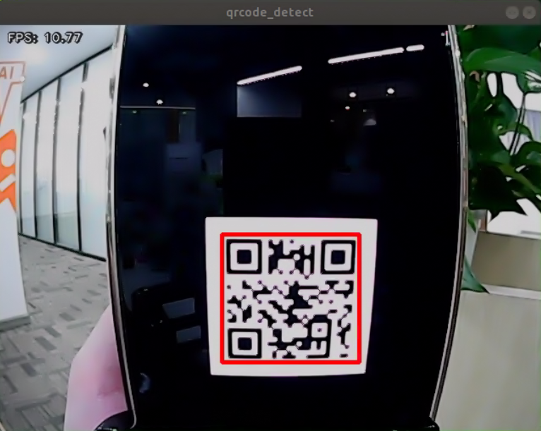

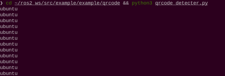

  1. Open a new ROS2 terminal, navigate to the program directory, and start the QR code recognition program by entering the following command:
cd ~/ros2_ws/src/example/example/qrcode && python3 qrcode_detecter.py
To exit the feature, press Ctrl + C in the terminal. If the program does not close successfully, try pressing Ctrl + C again.
  • Program Outcome
After starting the program, the camera feed window will appear. Place the QR code you created in previous section in front of the camera. The program will detect the QR code in the feed, highlight it with a bounding box, and print its content.

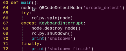

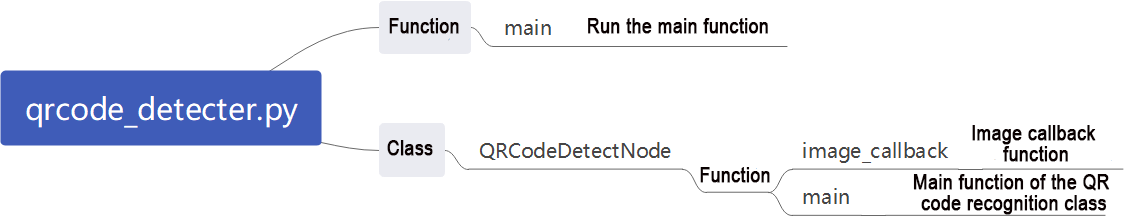

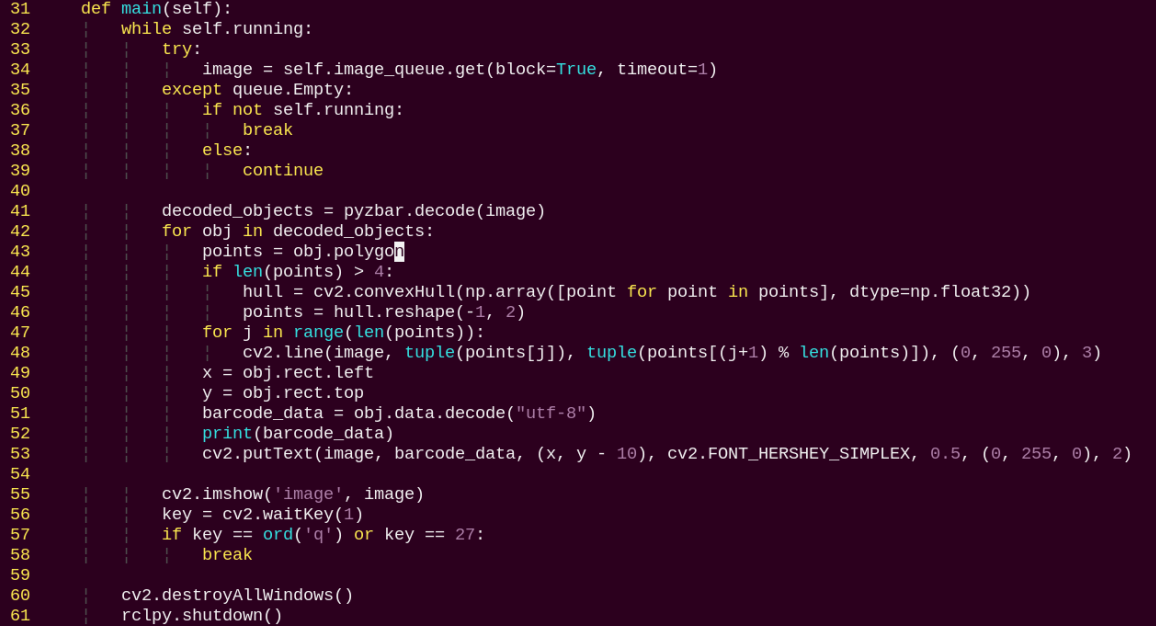

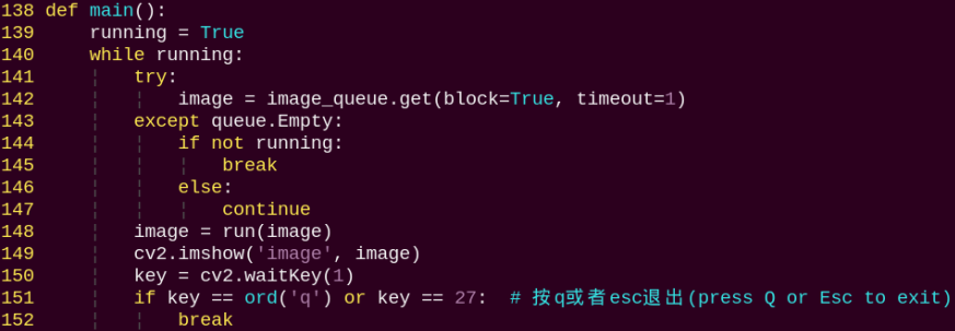

1. Main Function
Initializes the QRCodeDetectNode with the node name qrcode_detect, waits for the ROS node to shut down, and deregisters the node upon closure.

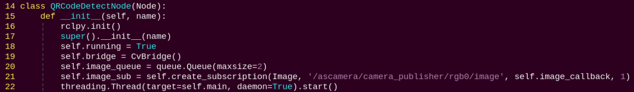

2. QRCodeDetectNode Class
Initializes the ROS node, sets parameters, and starts the self.main function.
Parameters:
self.running: Indicates whether detection is active.
self.model_path: Path to the detection model.
self.image_queue: Image queue.
self.image_sub: Subscriber to read camera frames.
Functions:

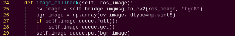

Camera callback function reads frames from the camera and places them into self.image_queue, automatically updating and discarding outdated images.

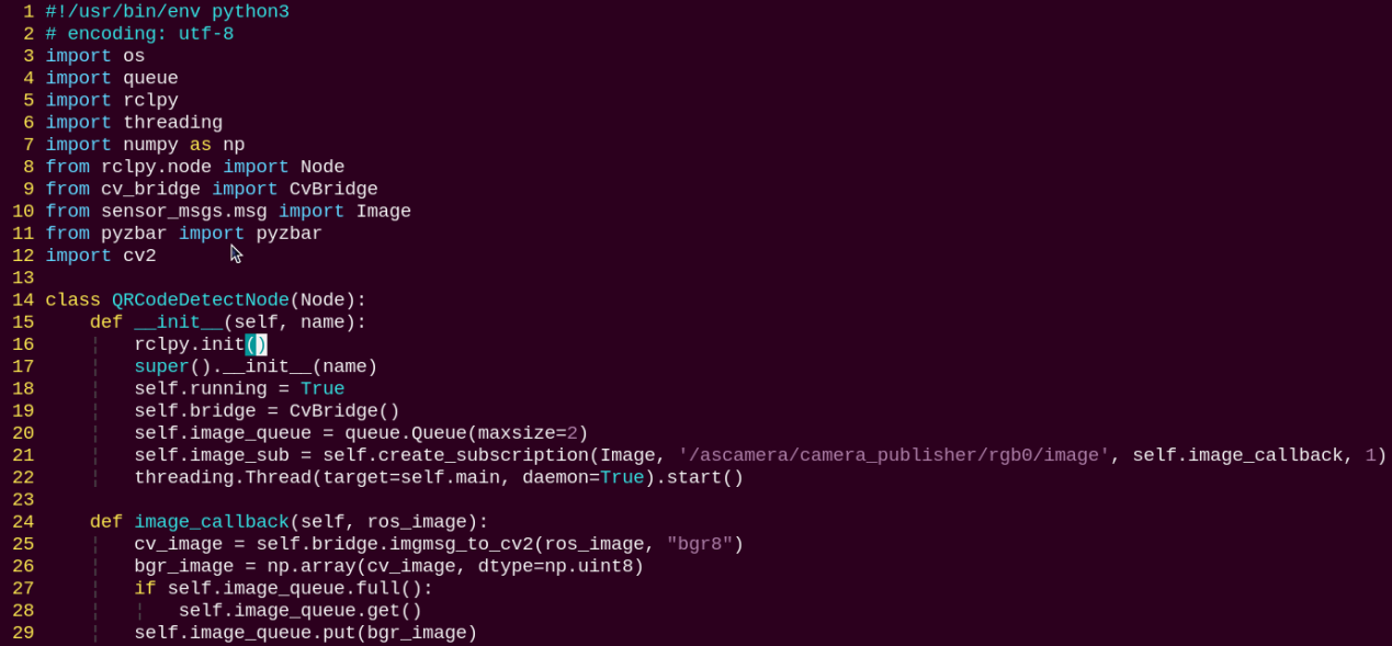

Main function performs QR code detection. It checks self.running to determine whether to start detection.
If True, it reads images from self.image_queue, feeds them to the initialized detection model self.qcd, and finally prints the detected QR code content and draws bounding boxes around the detected codes.

Firstly, the program will acquire the RGB image of the camera, scale the image, and perform Gaussian filtering on the image to convert the image color space from RGB into LAB. For more details on the Lab color space, please refer to OpenCV Computer Vision Course.
Based on this, color thresholds are used to identify the color of the object within the circle. A mask is then applied to the image, which involves selecting parts of the image, graphics, or objects to globally or locally block out areas in the image for processing.
After masking, morphological operations including opening and closing are performed on the object image to refine the results.
Opening operation: Involves erosion followed by dilation. Effect: Removes small objects, smooths object boundaries, and does not affect object area.
It can remove small particle noise and separate objects that are stuck together.
Erosion: Removes boundary pixels of an object, causing the edges to shrink inward. This operation can eliminate objects smaller than the structuring element.
Dilation: Expands the boundary pixels of an object by merging surrounding background pixels that are in contact with the object, causing the edges to grow outward.
Finally, the recognition results are overlaid on the return image.

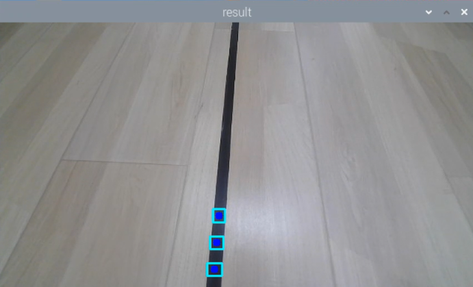

7.4.3 Program Outcome
After starting the feature, the camera feed will appear. In the feed, the selected color track will be highlighted, and the robot will move along the track accordingly.

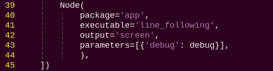

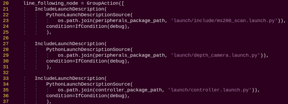

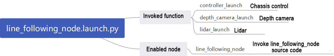

  • launch File Analysis
The program file of the feature is located at:
/home/ubuntu/ros2_ws/src/app/launch/line_following_node.launch.py
1. Path Retrieval
Use get_package_share_directory to obtain the path of the package.
2. Launch
controller_launch launches the motion control launch file.
depth_camera_launch launches the depth camera.
ms200_scan_launch launches the Lidar.
3. Node
line_following_node is responsible for enabling the robot to follow lines.

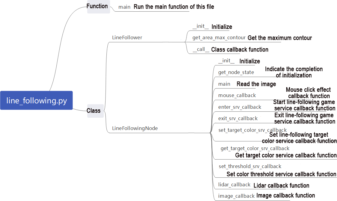

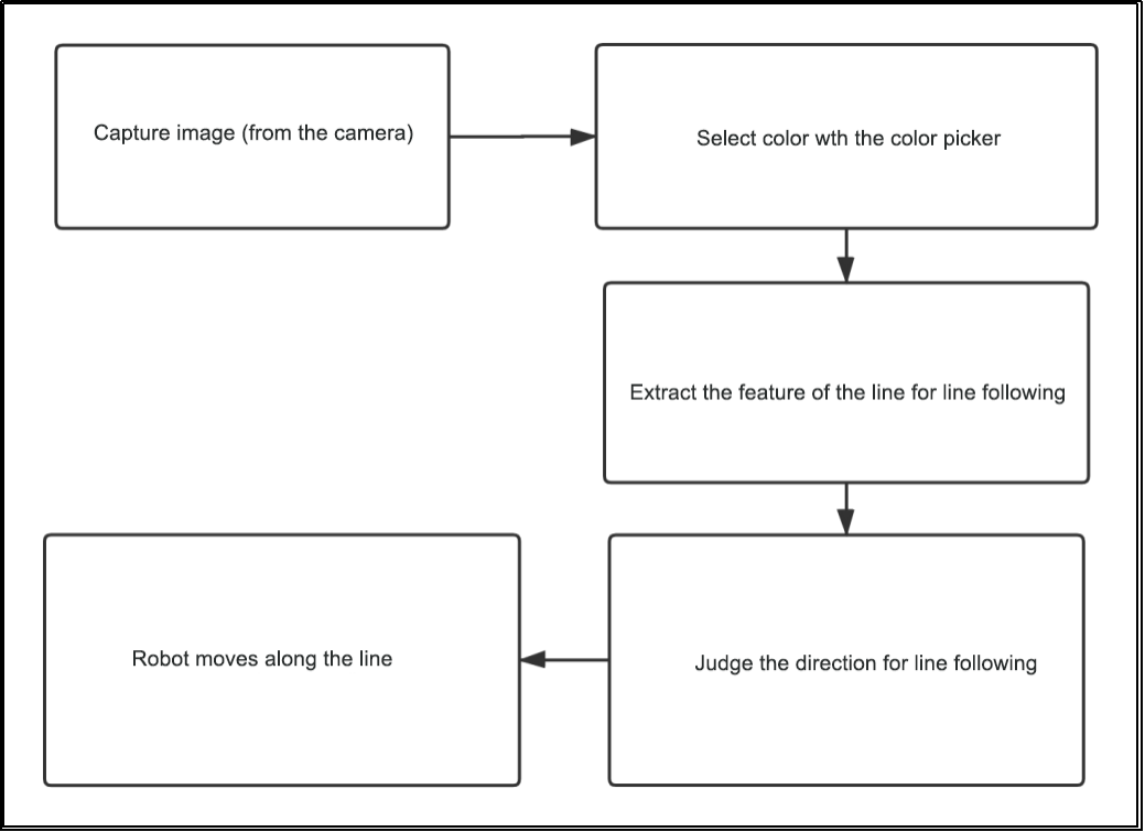

Based on the effects of the feature, the process logic has been outlined as shown in the diagram below:
First, the robot subscribes to the topic published by the camera node to acquire RGB images. Detect the line to be followed in the image and select it. By sampling its color, obtain the color threshold. Based on the line color information, extract the features of the line. Calculate the robot’s offset relative to the line within the camera’s field of view, and control the robot to move along the line, continuously correcting its position so that the line remains at the center of the view. Use the Lidar to detect obstacles and perform avoidance.
The flowchart below outlines the logic of the program based on this file.

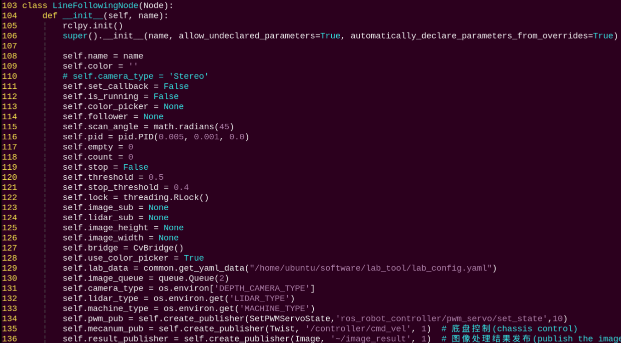

The initialization function first defines several preset parameters, such as the color threshold ratio, stop limit parameters, and angle swing parameters, which can all affect the final recognition results. Next, the color picker object is defined, which is used for selecting colors in the feature, along with additional Lidar obstacle avoidance settings. Then comes the implementation of the LineFollower class, which mainly includes image preprocessing functions and the logic for line-following decisions.
1. Functions

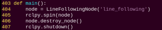

Main:
Starts the line-following node.
2. Class:

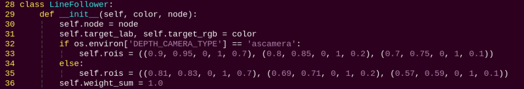

LineFollower:
Sets the line-following color and ROI list.
get_area_max_contour:
Gets the contour with the largest area.
Call:
Performs color recognition based on the set color and provides feedback on the recognized image and angle.
LineFollowingNode:
Initializes parameters required for the program, calls the chassis and camera nodes, and starts services such as enter, exit, start, set color, get color, and set threshold.
get_node_state:
Sets the current node state.
main:

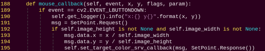

Reads the image and uses the mouse for color selection.
mouse_callback:
Mouse color selection callback function to obtain the pixel coordinates of the current mouse position.
enter_srv_callback:
Service for entering autonomous line-following reads camera and Lidar data and initializes actions.

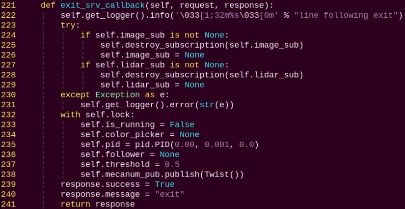

exit_srv_callback:
Service for exiting autonomous line-following closes all reading nodes, resets PID, and stops line-following.

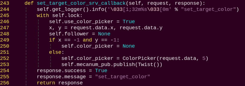

set_target_color_srv_callback:
Service to set the target line-following color.

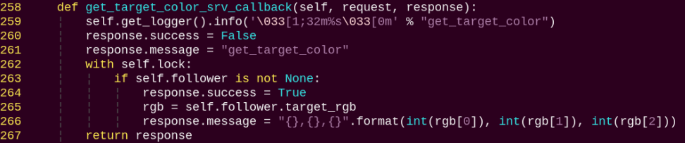

get_target_color_srv_callback:
Service to get the target line-following color.

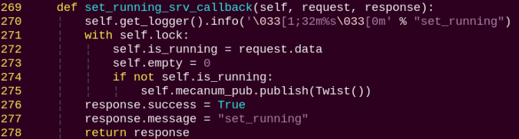

set_running_srv_callback:
Service to start the autonomous patrolling mode.
set_threshold_srv_callback:
Service to set the color threshold.
lidar_callback:
Lidar callback function processes the received data and determines whether to stop moving.

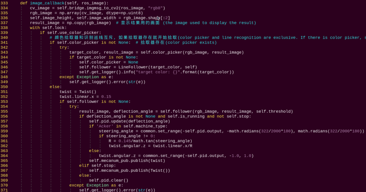

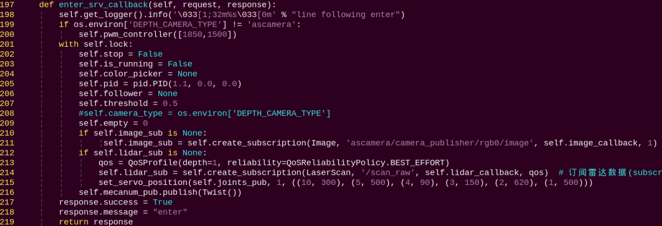

image_callback:
Camera callback function uses the received data to invoke the color picker and controls the robot’s movement along the recognized line using PID.
