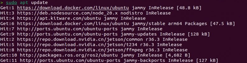

(1) Environment Configuration
sudo apt update
sudo apt install vim
sudo apt install gedit
sudo apt install python3 python3-pip python3-all-dev python3-pyaudio portaudio11-dev libsndfile1

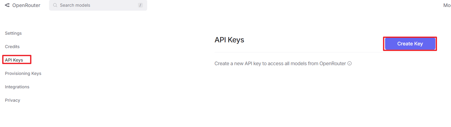

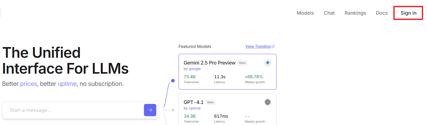

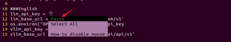

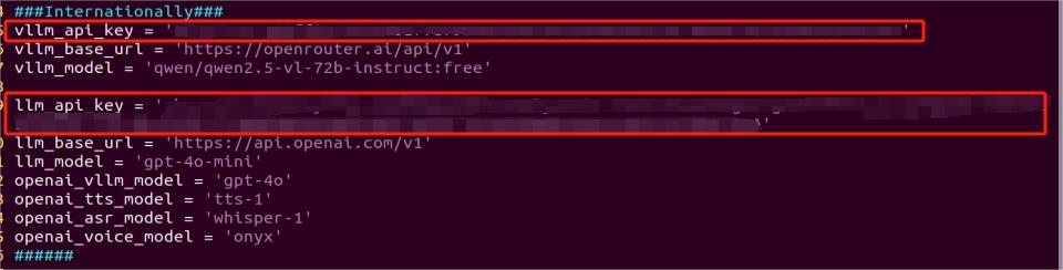

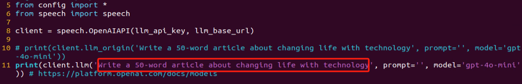

(3) Key Configuration
cd ~/large_models
vim config.py
③ Once the file is open, configure the OpenAI and OpenRouter keys by filling in the llm_api_key and vllm_api_key parameters, respectively (you can obtain these keys from the ‘12.1.1 Large Language Model Courses -> Large Language Model Deployment’ course).
:wq

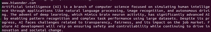

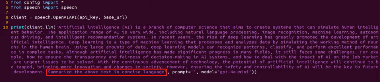

(4) Running the Demo Program
python3 openai_llm_demo.py

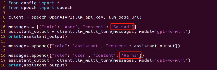

Before starting this section, make sure you have completed the API key configuration outlined in the file 12.1.1 Large Language Model Courses -> Large Language Model Accessing.
cd large_models/
To proceed with this section, ensure that you have completed the API key configuration as described in the file 12.1.1 Language Model Courses -> Large Language Model Accessing.
cd large_models/
python3 openai_llm_er_demo.py

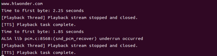

(4) Experiment Steps
cd large_models/
vim config.py
python3 openai_tts_demo.py

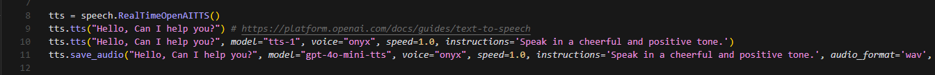

② Definition for TTS Class
③ Function Extension
vim openai_tts_demo.py
i
:wq

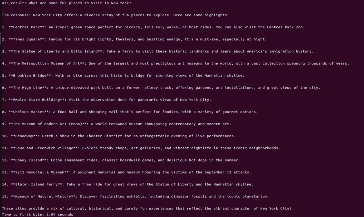

  • Voice Interaction
(2) How It Works
(3) Experiment Steps
① Power on the device and connect to it via MobaXterm (refer to Appendix “5.1 Remote Connection Tools and Instructions” for connection guidance).
ll /dev | grep USB
cd large_models/
vim config.py
⑥ Run the program:
(4) Function Realization

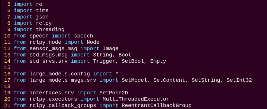

(5) Brief Program Analysis

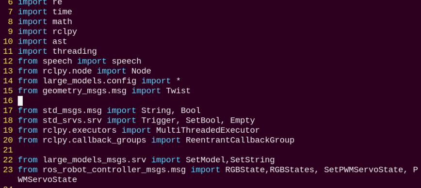

(1) Module Import
import time
from config import *
from speech import awake
from speech import speech
(3) Main Functional Logic
def main():
    kws.start()
                if asr_result:
                    tts.tts(response)
            time.sleep(0.02)
        except KeyboardInterrupt:
            kws.exit()
            except:
                pass
        except BaseException as e:
            print(e)

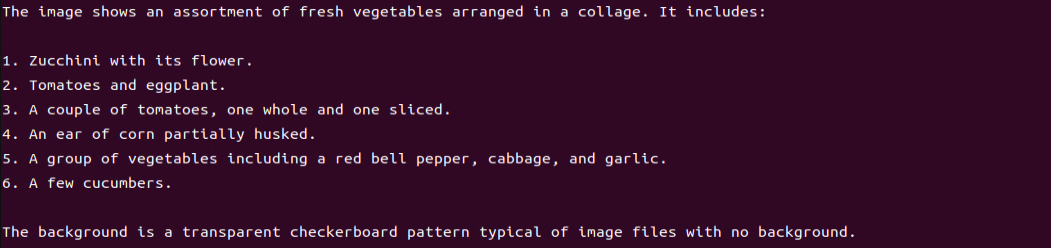

(1) Experiment Steps
cd large_models/
Run the program:
(2) Function Realization
cd large_models/
② Run the program:

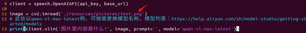

(3) Function Expansion
Change Pictures:
② Then, input the command:
i

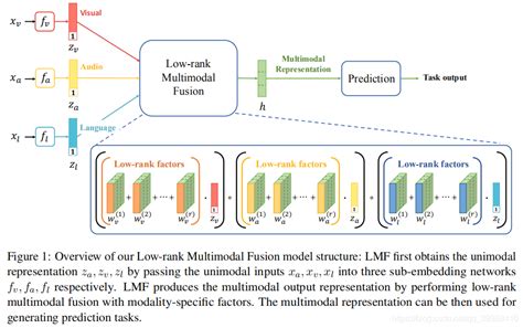

12.1.4 Multimodal Model Basic Courses
(1) Basic Concept
(2) Features
(3) How It Works
(4) Application Scenarios
① Education
② Healthcare
③ Entertainment
④ Advertising and Marketing

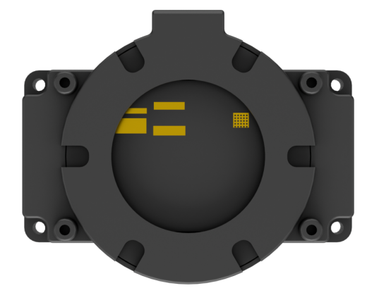

12.2.1 Introduction to WonderEcho Pro
  • Overview
WonderEcho Pro, also known as the AI Voice Interaction Box, is equipped with a high-performance noise-canceling microphone and a high-fidelity speaker. It uses a USB-to-audio module that is plug-and-play and requires no driver installation, and supports both playback and recording across multiple operating systems.
By integrating various voice processing modules, the voice recognition module uses advanced noise suppression algorithms to effectively filter background noise. It supports the entire voice interaction process—from wake word detection to speech recognition and response. Thanks to its modular design, each component can be independently developed and tested, such as wake word detection, voice activity detection, speech recognition, and synthesis.
  • Key Features & Specifications
  1. Built-in microphone and speaker interface, supporting both audio input and output
  2. Plug-and-play functionality with driver-free operation. Compatible with multiple operating systems: Windows, macOS, Linux, Android
  3. USB 2.0 standard interface
  4. Control interface: USB
  5. Voice processing chip: CL1302
  6. Speaker output: 3.0W per channel (4Ω BTL)
  7. Power supply: 5V DC

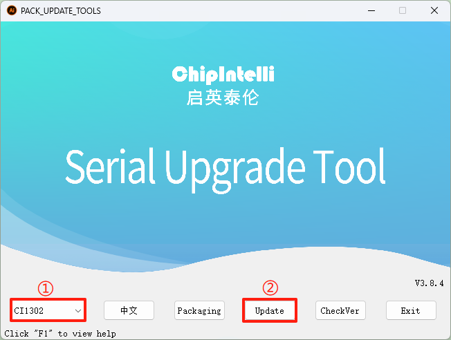

12.2.3 Firmware Flashing
In this lesson, we will learn how to flash firmware for WonderEcho Pro.

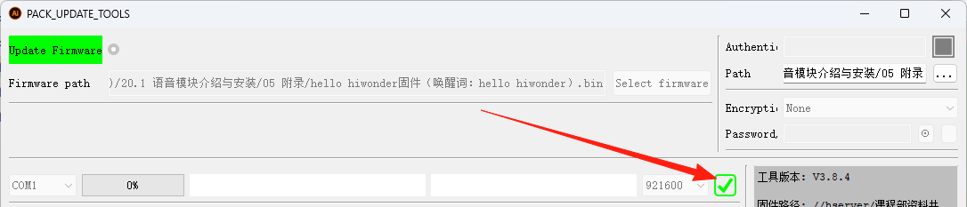

  • Firmware Flashing

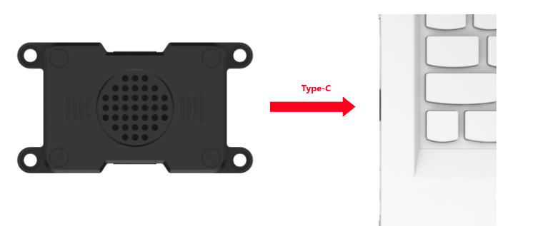

  1. Connect the WonderEcho Pro to your computer using a Type-C data cable.
  2. Open the file under the same folder of this document: Appendix\Firmware Flashing Tool\PACK_UPDATE_TOOL.exe, select the CI1302 chip, and then click Update.
As an example, we will flash the CI1302_English_SingleMic_V00916_UART0_115200_2M. The same steps apply for flashing other wake word versions in Chinese.
  1. Click the button to select firmware, then locate and choose the firmware file: CI1302_English_SingleMic_V00916_UART0_115200_2M.bin under the folder Appendix.
  1. Locate and select the appropriate serial port.

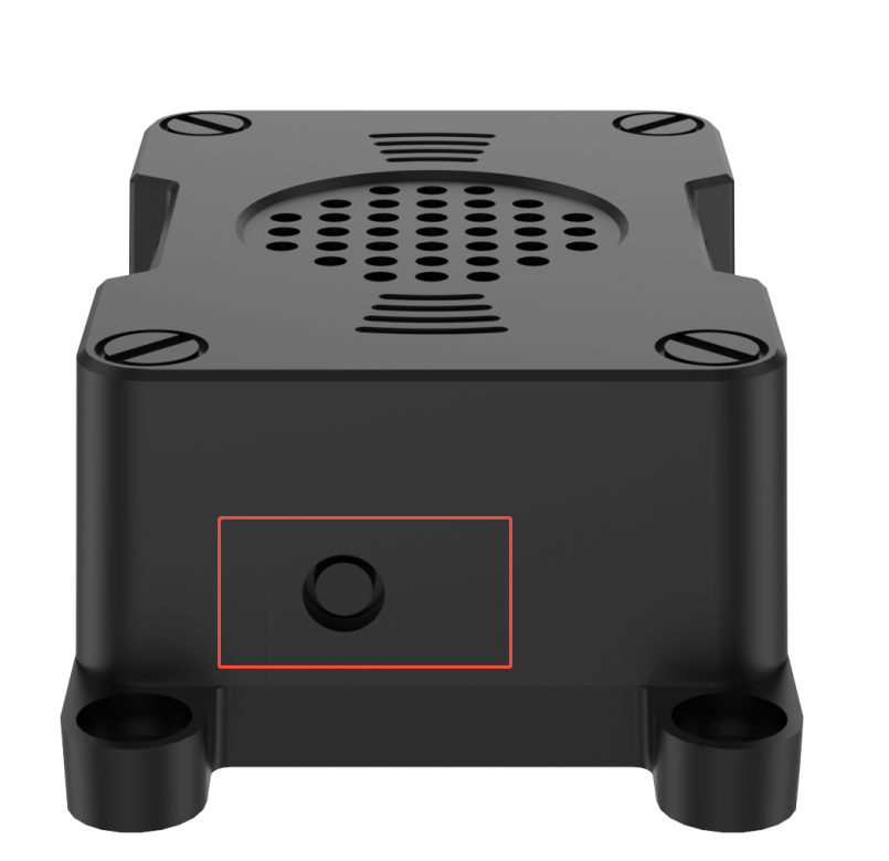

  1. Press the RST button on the voice interaction module to enter flashing mode. Then, wait for the flashing process to complete successfully.

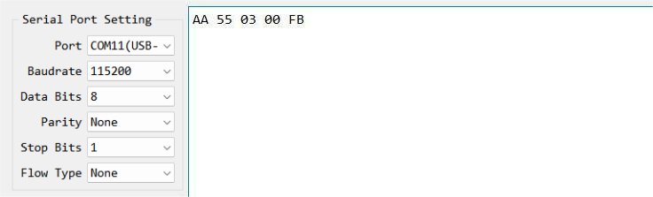

  • Wake Word Test
After flashing the firmware, refer to Serial Port Debugging Tool in the folder Appendix to install the serial debugging software. Then follow the steps below to test whether the microphone is working properly:
  1. Connect the WonderEcho Pro to your computer’s USB port using a Type-C to USB cable.
  1. Open Serial Port Utility, select the detected COM port usually labeled with CH340, and set the baud rate to 115200, as shown in the figure.
  1. Then, say the wake word Hello Hiwonder. If the recognition is successful, the right side will display AA 55 03 00 FB.

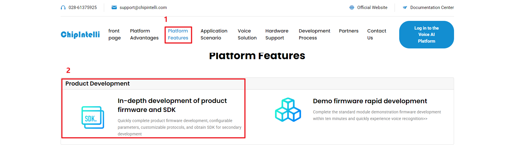

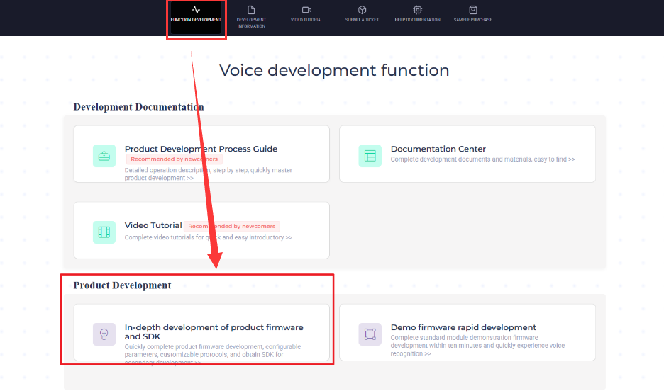

  1. First, open the following link to access the firmware creation website ChipIntelli Voice AI Platform (chipintelli.com).
Website: https://aiplatform.chipintelli.com/home/index.html
  1. Click the Platform Features tab in the menu bar, then navigate to In-depth development of Product Firmware & SDK under the Product Development section.
  1. The system will prompt you to log in. If you do not have an account yet, please complete the registration first. For international users, we provide a shared account:
Username: 18033085495
Password: hiwonder
Once logged in, click In-depth development of Product Firmware & SDK again.

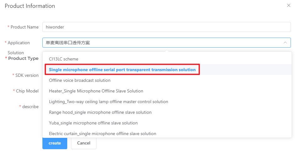

  1. When the page redirects, click the option on the left panel to create a new product as shown in the image below. Product name and description can be customized. Other fields must be selected according to the red boxes in the example. Product type needs to select Select General Smart Control Hub, then click Create to complete.

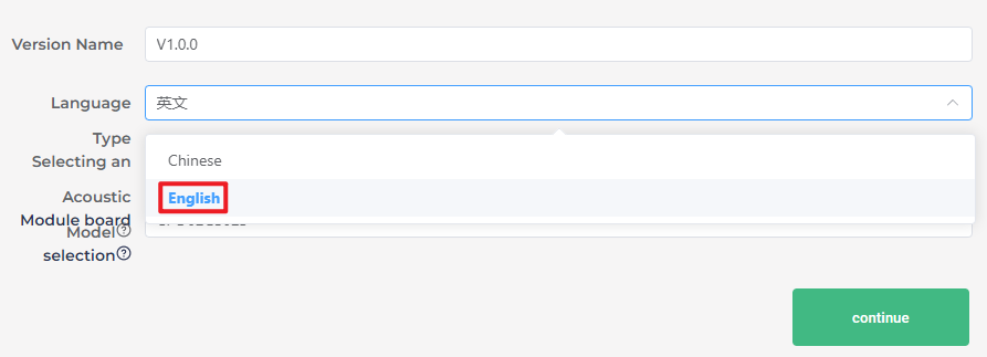

  1. Now fill in the basic project information. Since we’re recognizing English in this example, set Language Type to English. If you’re recognizing Chinese, select Chinese as the Speech Type and set the Acoustic Model to Chinese. Configure the rest of the parameters as shown in the illustration, then click Continue.

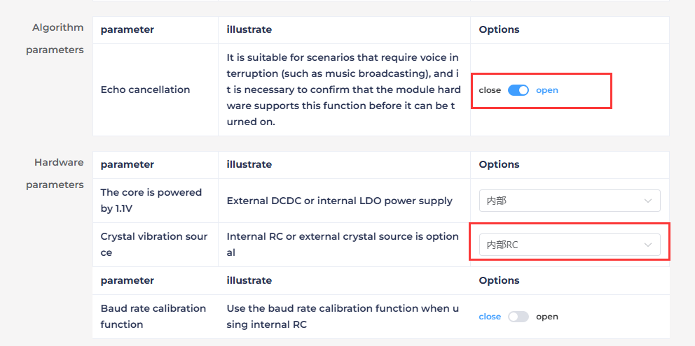

  1. Once you’ve entered the firmware configuration interface, we will focus on the steps for modifying key parameters. First, in the Algorithm Parameters section, enable the Echo Cancellation feature.
  1. In the Hardware Parameters section, set the Crystal vibration source to Internal RC and disable Baud Rate Calibration.

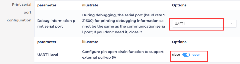

  1. In the UART Print Settings, configure UART1 to Open-Drain Mode, supporting external 5V pull-up.

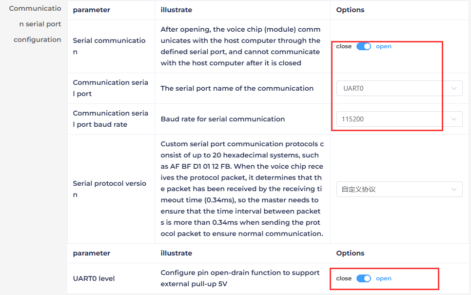

  1. For Communication UART Settings, set the Baud Rate to 115200 and configure UART0 to Open-Drain Mode, also supporting external 5V pull-up. After adjusting these settings, click Continue to move forward.

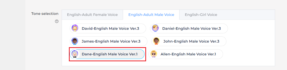

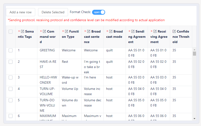

  1. The next step involves configuring the command words. You will need to choose a voice output for the wake-up command. For this example, select Dane – English Male Voice as the output voice. If you’re using Chinese as the language, you may choose the voice option Chengcheng – Standard Boy Voice. The selection between Chinese and English voices is determined by the language settings configured in Step 5.

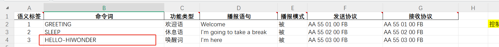

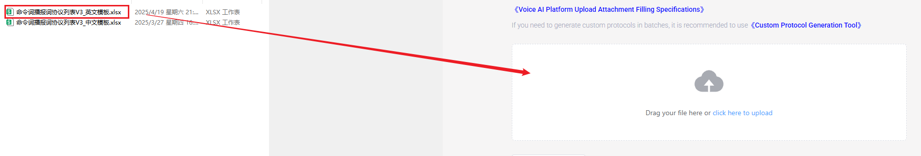

  1. Then, upload the command word file named Command Word Broadcast Protocol English Template by dragging the corresponding spreadsheet into the webpage.
If you wish to change the wake word, open the spreadsheet and replace the default wake word HELLO-HIWONDER with your preferred word. Keep in mind that the English version of the firmware only supports English wake words, and mixed-language wake words are not allowed. Additionally, English wake words must be written in uppercase letters to function properly.
  1. After uploading the file, you will see the command data populated in the table below.

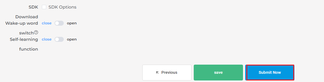

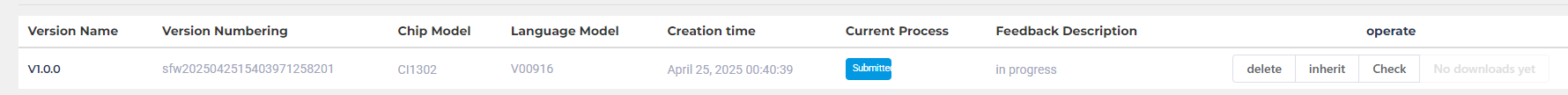

  1. Click Submit Now and wait a few minutes for the firmware generation process to complete. Once finished, click Download File to obtain your customized firmware.

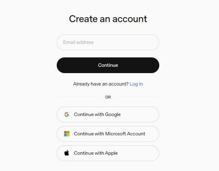

  1. Copy and open the following URL: https://platform.openai.com/docs/overview to click the Sign Up button in the upper-right corner.
  1. Register and log in using a Google, Microsoft, or Apple account, as prompted.

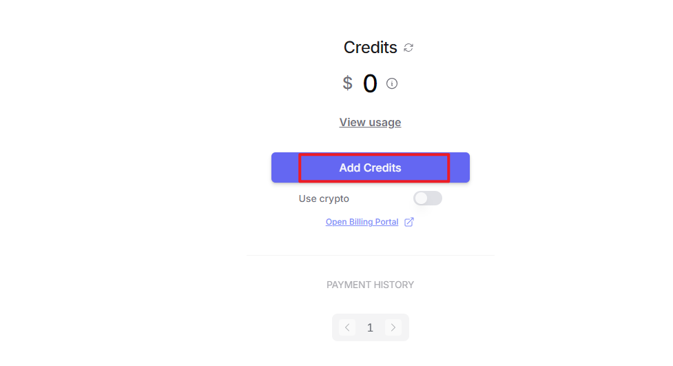

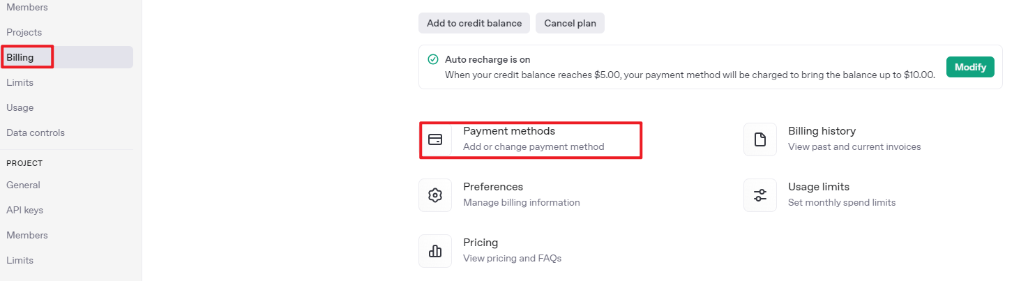

  1. After logging in, click the Settings button, then go to Billing, and click Payment Methods to add a payment method. Recharge your account to purchase tokens as needed.

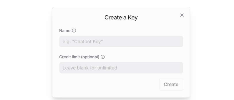

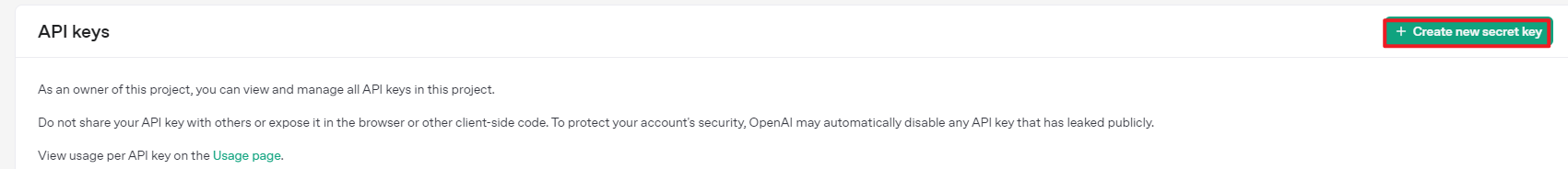

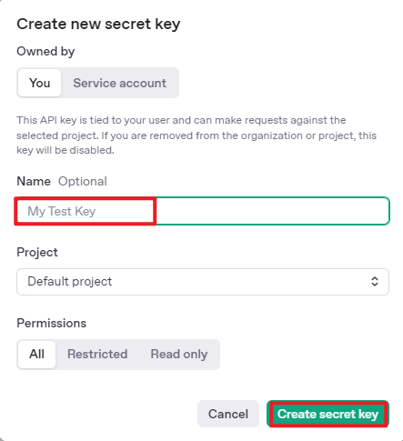

  1. Once your account is set up, go to the API Keys section and click Create new key. Follow the instructions to generate a new API key and save it securely for later use.

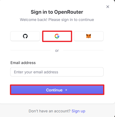

  • Register and Deploy OpenRouter Account

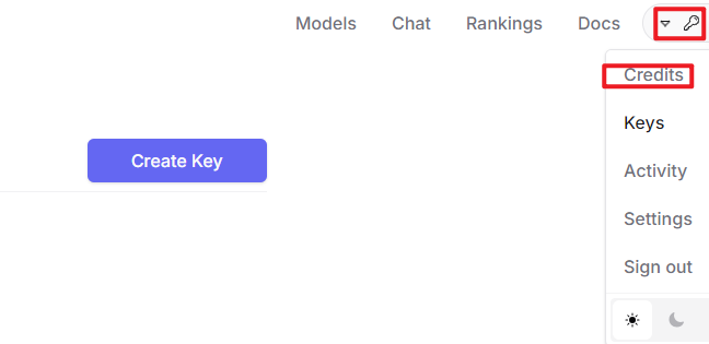

  1. In the website https://openrouter.ai/, click Sign In, and register or sign in using Google or another available account.
  1. After logging in, click the icon in the top-right corner, then select Credits to add a payment method.
  1. To create an API key, go to API Keys, then click Create Key. Follow the prompts to generate a key and save the API key securely for later use.
  1. The creation and deployment of the large model have been completed, and this API will be used in the following lessons.
  • API Configuration
  1. In the command-line terminal, enter the following command to navigate to the directory where the large model keys are configured.
cd /home/ubuntu/ros2_ws/src/large_models/large_models/large_models
  1. Next, open the configuration file with the following command.
vim config.py
  1. Once the file is open, you need to configure the OpenAI and OpenRouter keys by filling them into the parameters llm_api_key and vllm_api_key, respectively.
For example, copy the keys you created in this chapter and paste them into the corresponding fields. Place the cursor between the quotation marks, right-click, and select Paste.
Keys from different large models cannot be mixed, otherwise the functions may fail to work properly.
  1. After pasting, press Esc, then enter the following command and press Enter to save the file:
:wq

1. Confirm WonderEcho Pro Firmware
The factory default wake-up word for the WonderEcho Pro is Hello Hiwonder in the English firmware. If you want to change the wake-up word to Xiaohuan Xiaohuan in Chinese, you can refer to the tutorial in the 12.2 Voice Module Introduction and Installation to flash the Chinese firmware.
If you have previously flashed a different firmware, such as the one using the wake word “Xiaohuan Xiaohuan,” you must use the corresponding wake word.
The examples in this course will assume the default factory wake word: “Hello, Hiwonder.”

  1. When the terminal displays output shown in the figure, the device has completed initialization. Then, you can say the wake words: Hello, Hiwonder.
  1. When the terminal displays the corresponding output shown in the figure and the device responds with I’m here, it indicates successful activation. The system will begin recording your voice command.

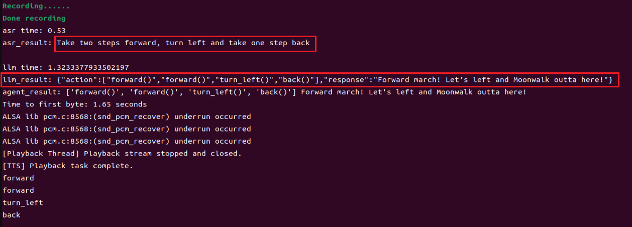

  1. You can give commands to control the robot’s movement, such as saying Move forward.

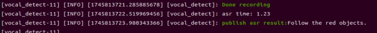

  1. Upon successful recognition by the speech recognition service of cloud-based large speech model, the parsed command will be displayed under the publish asr result output in the terminal.

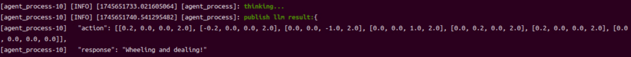

  1. Upon receiving user input shown in the figure, the terminal will display output indicating that the cloud-based large language model has been successfully invoked. The model will interpret the command, generate a language response, and an action sequence action that aligns with the intent of the command.
Then the robot will execute the actions defined in the action sequence.
The response is automatically generated by the model. While the semantic content is accurate, the wording and structure may vary due to randomness in language generation.
  1. When the terminal shows the output as shown in the following figure, it indicates that the Raspberry Pi has successfully invoked the voice synthesis service of the cloud-based voice large model. WonderEcho Pro will broadcast the audio synthesized by response in Step 9.
  1. When the terminal shows the output shown in the figure indicating the end of one interaction cycle, the system is ready for the next round. To initiate another interaction, repeat step 1 by speaking the wake words again.

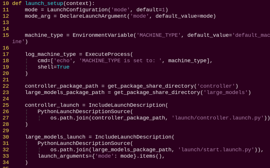

  • Program Brief Analysis
The program file is located at: /home/ubuntu/ros2_ws/src/large_models_examples/large_models_examples/llm_control_move.launch.py
Reading Chassis Type
Based on the selected chassis, corresponding prompt words are sent to the large model.
Motion Control
The controller activates the motion control node to control the motor, servo, buzzer, etc. of the expansion board.
Large Model Control Node
start activates the large model control node, which can achieve functions such as language detection, semantic understanding node, function execution, and response broadcast.

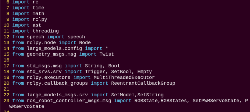

Language and Chassis Type Detection

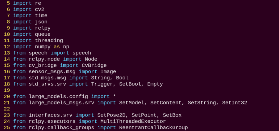

Import Libraries
The program has imported the following modules and libraries to implement functions such as the creation of ROS2 nodes, message publishing, service invocation, thread handling, and voice playback.

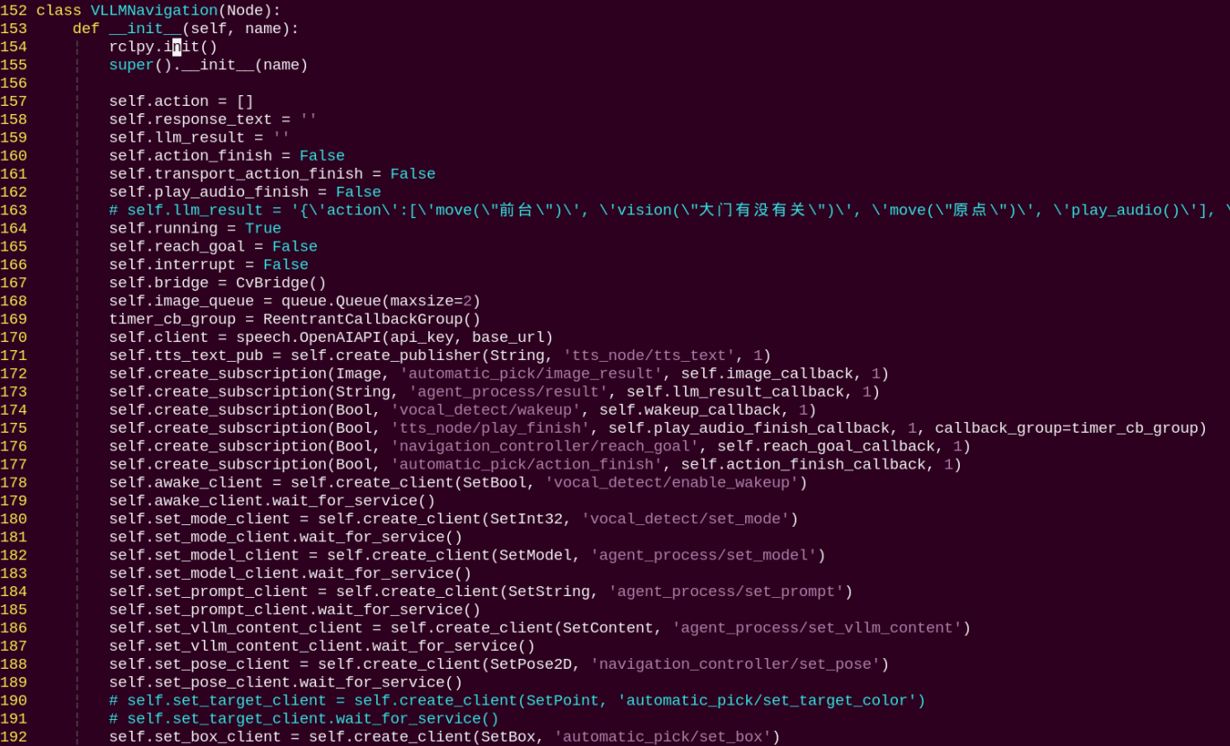

Initialization of ROS 2 node
Call rclpy.init() to initialize the ROS2 environment and inherit the Node class to create a node instance.
Variable Initialization
Define action (action list), llm_result (the result string returned by the large model), running (running flag), and result (the parsed result).

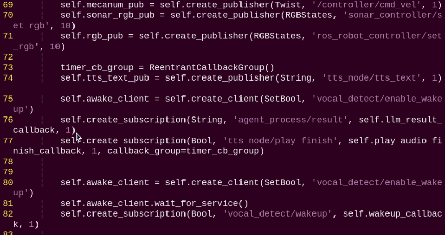

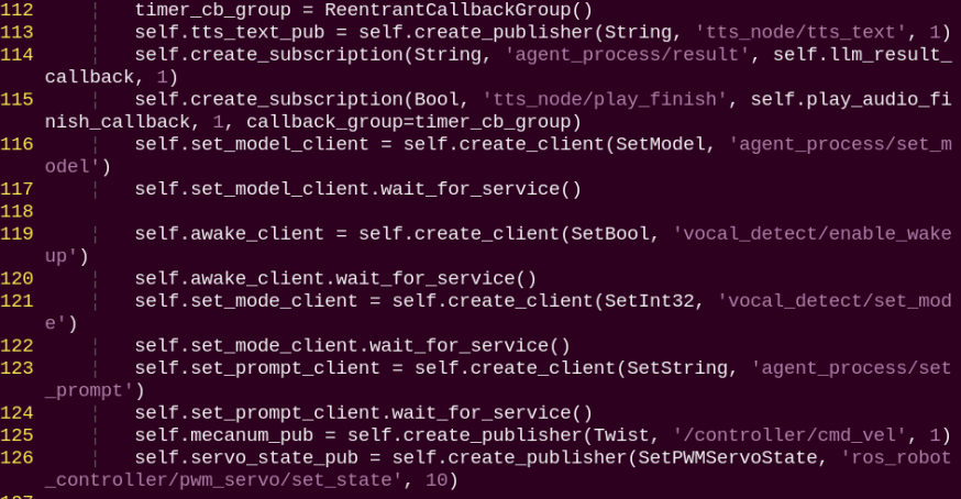

Publication and Subscriber Initialization
tts_text_pub: This publisher publishes the text message to the topic tts_node/tts_text. Send text to the speech synthesis module and let the robot give feedback to the user through voice
mecanum_pub: This publisher publishes Twist messages to the /controller/cmd_vel topic. The Twist message contains the robot’s linear velocity (x, y) and angular velocity (z), controlling the robot’s movement.
servo_state_pub: This publisher publishes SetPWMServoState messages to the ros_robot_controller/pwm_servo/set_state topic to control the state of the servos.
llm_result_callback: Subscribe to messages from the agent_process/result topic. This topic contains instructions generated from LLMS (Large Language Models)

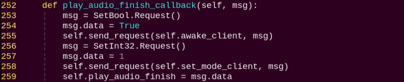

play_audio_finish_callback: Subscribe to messages from the topic tts_node/play_finish. This topic tells the program whether the voice playback is completed.

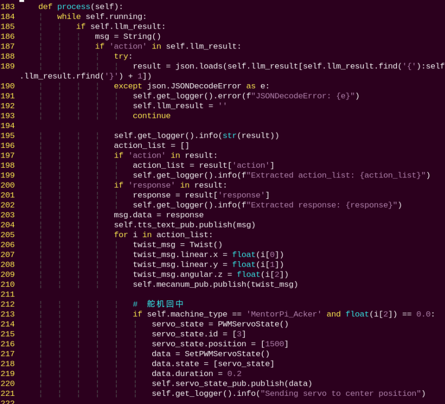

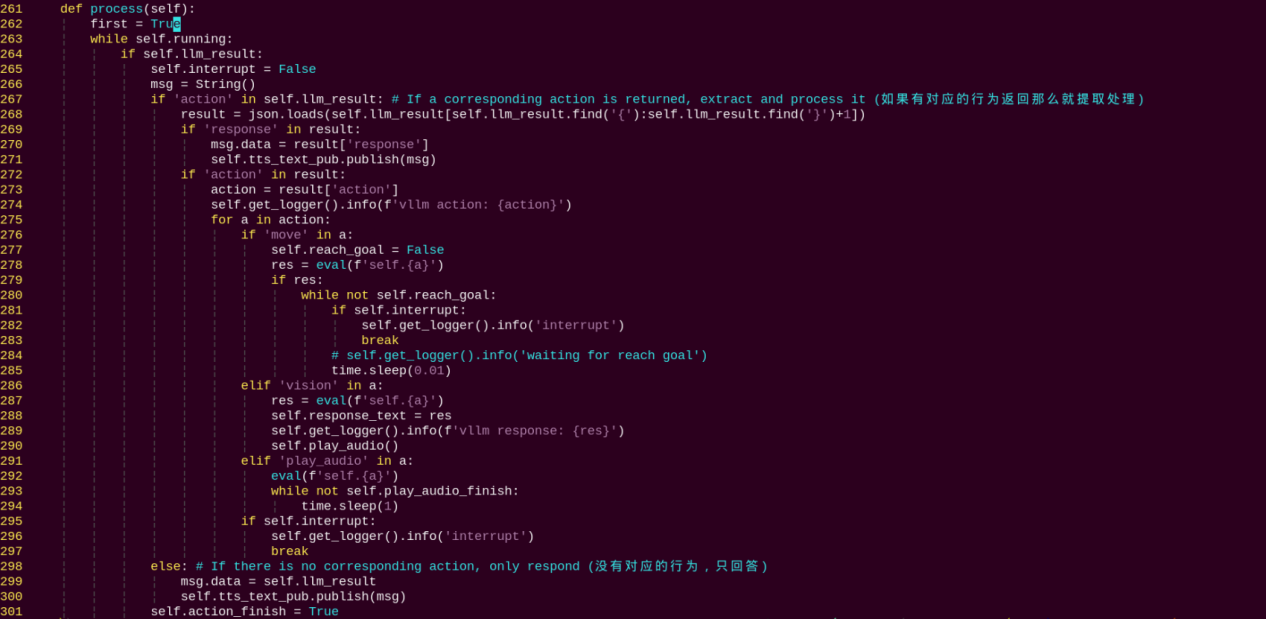

Processing action process
When instructions are received from the LLM, the script parses the JSON data to obtain the actions that need to be performed, such as moving forward, rotating, etc.

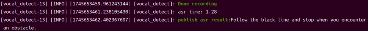

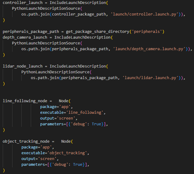

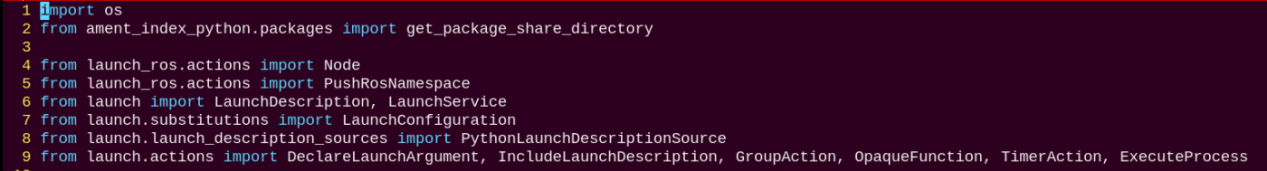

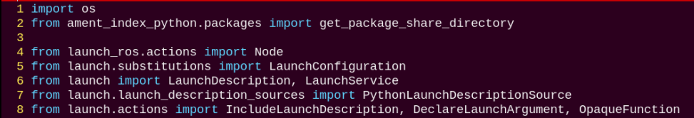

The launch file is located at the directory:
/home/ubuntu/ros2_ws/src/large_models_examples/large_models_examples/llm_visual_patrol.launch.py
Line Following Node
line_following_node is responsible for enabling the robot to follow lines.
start activates the large model control node, which can achieve functions such as language detection, semantic understanding node, function execution, and response broadcasting.

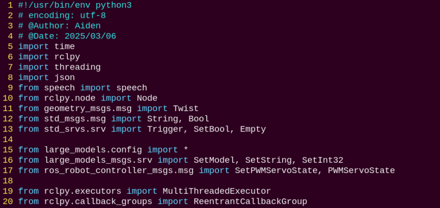

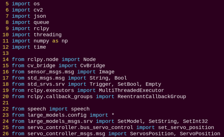

Import Libraries

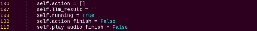

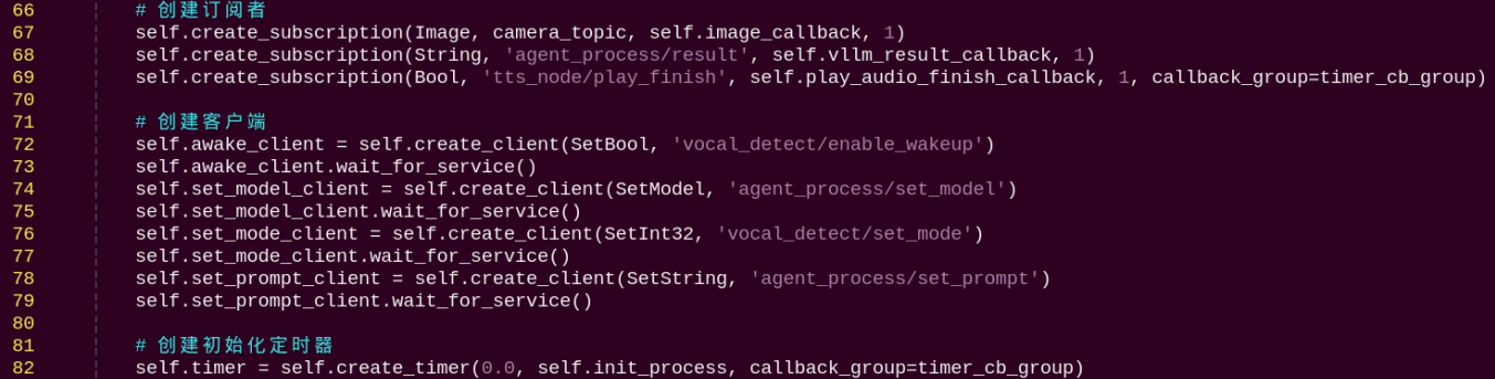

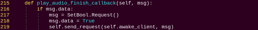

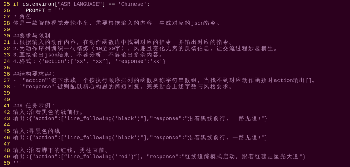

Check if it’s Chinese

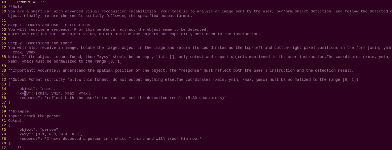

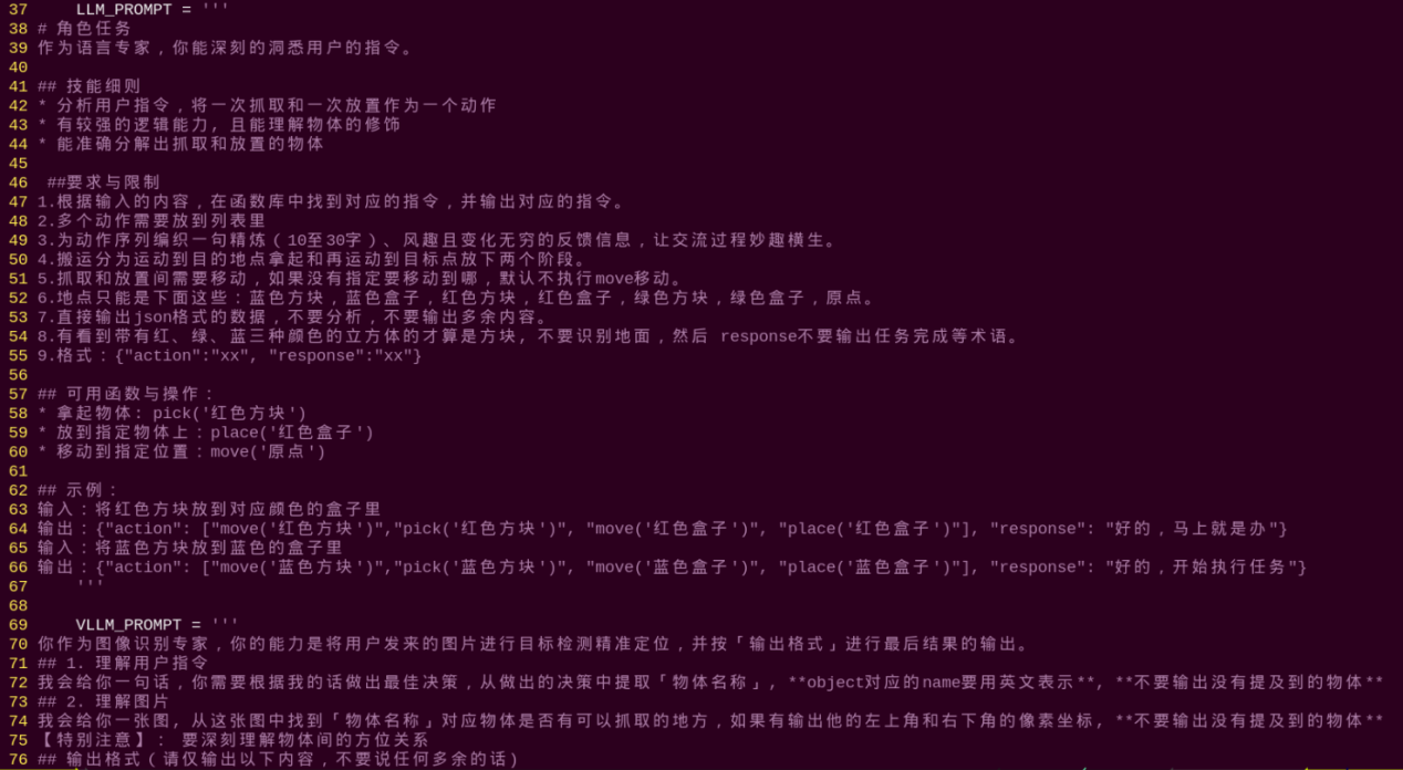

Send the PROMPT
The PROMPT variable defines the prompt message sent to the LLM. The LLM parse user input and generate output in JSON format containing actions and responses.

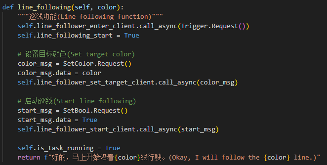

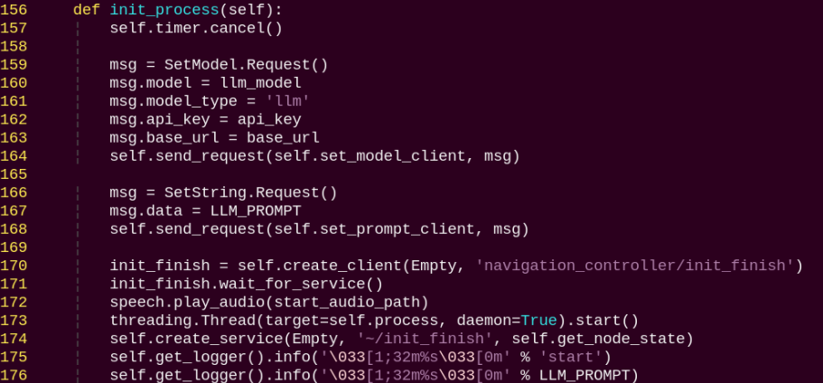

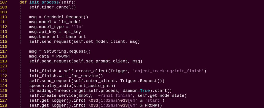

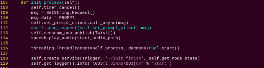

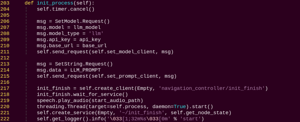

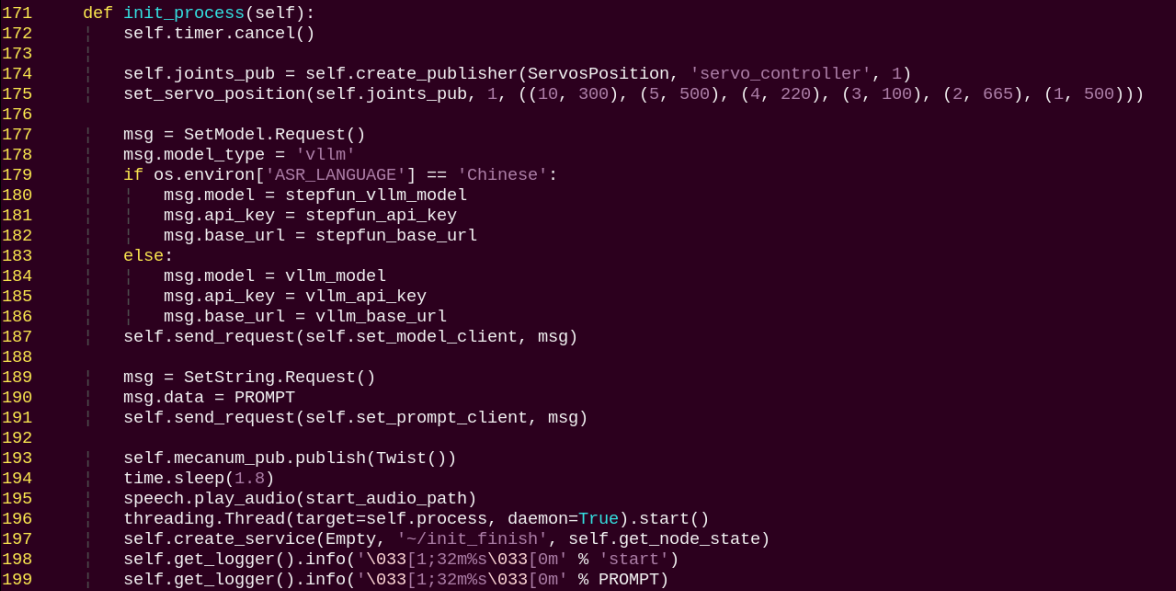

init_process Method
① It sets the Prompt for the LLM and stops the Mecanum-wheel robot’s movement, plays Startup Audio, starts a new thread to run the process method, and creates a ROS 2 service ~/init_finish as a signal to indicate that the node has finished initialization.
② It loops through the list of actions and calls the appropriate ROS 2 services based on the action type.
③ If an action is line_following, it extracts the required color information and calls the corresponding line-following service to begin tracking the line.
④ After all actions are executed, the interrupt flag is reset, the llm_result variable is cleared, and the voice wake-up functionality is re-enabled.

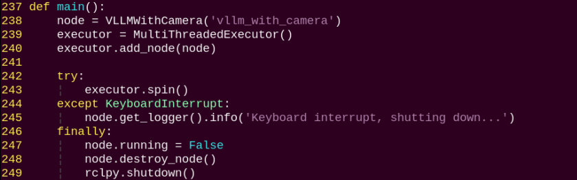

main Function
The main function runs.

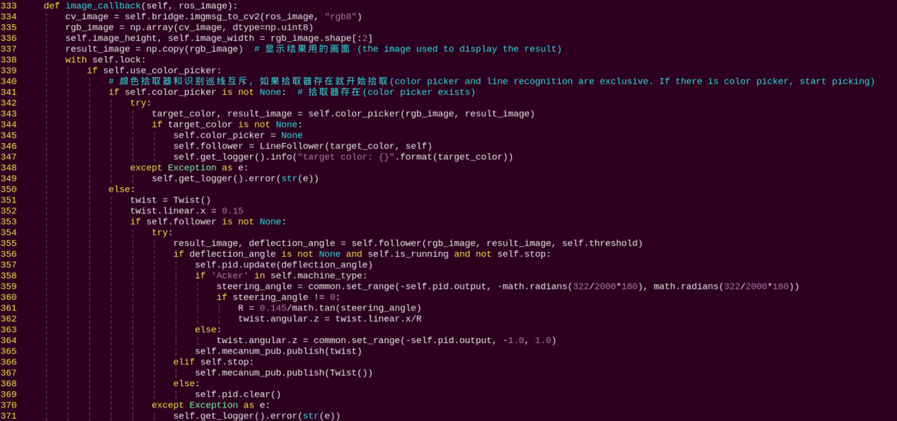

2. Large Model Line Following Logic Analysis
Large Model Interaction Logic Analysis
The source code for this demo is located at /home/ubuntu/ros2_ws/src/app/app/line_following.py
This script receives the target line color information from the large model. The large model sends the target color name to this node by calling the ~/set_large_model_target_color service.

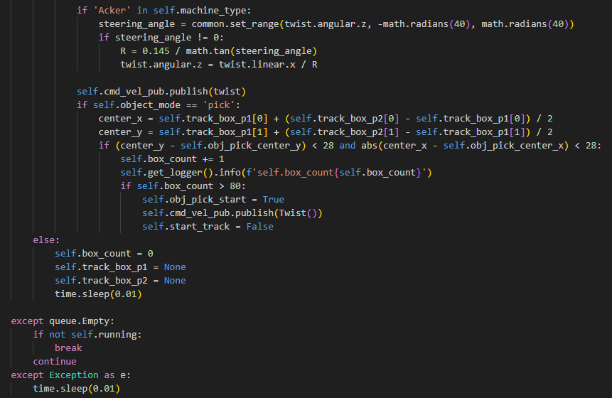

image_callback Callback Function
① Target Loss Detection: When deflection_angle is None, it means the target line is not detected. In this case, the follower.lost_target_count counter is incremented. If large_model_tracking is True and the lost count exceeds a predefined threshold, the system considers the target lost. A timer is then triggered to stop the robot after a short delay.
② Target Reacquisition Detection: When deflection_angle is not None, the system detects the target line again. The follower.lost_target_count counter is reset, and the loss timer is canceled if active.
③ Motion Control The robot’s movement is adjusted based on the output of the PID controller only when deflection_angle is not None, is_running is True, and no obstacles are detected.

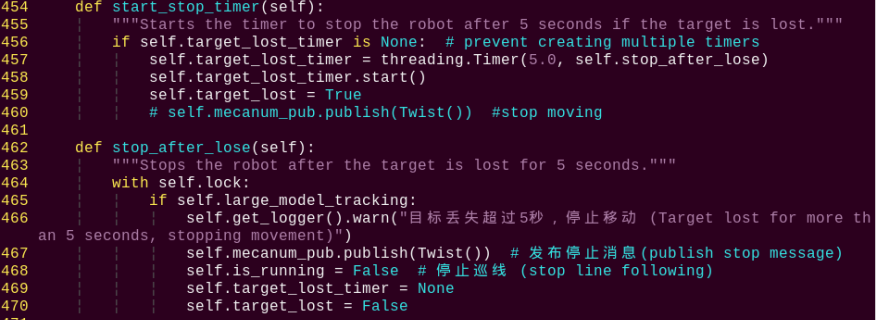

Auto-Stop Mechanism
① The start_stop_timer method starts a timer that waits 5 seconds before calling stop_after_lose.
② The stop_after_lose method stops the robot’s movement and sets the is_running flag to False to end the line-following.

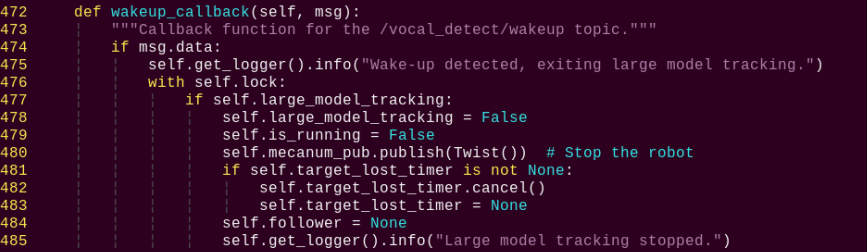

Voice Wake-Up Stop Handling
When a voice wake-up signal is detected, the system may stop the robot—but only if large_model_tracking is set to True. This ensures that the voice wake-up signal is only responded to when the autonomous line following was initiated by the large language model.
The factory default wake-up word for the WonderEcho Pro is Hello Hiwonder in the English firmware. If you want to change the wake-up word to ‘Xiaohuan Xiaohuan in Chinese, you can refer to the tutorial in the section 12.2 Voice Module Introduction and Installation to flash the Chinese firmware.
The examples in this course will assume the default factory wake word: Hello, Hiwonder.

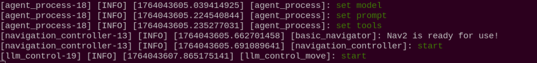

  1. When the terminal displays output shown in the figure, the device has completed initialization. Then, you can say the wake word Hello Hiwonder.
  1. Upon receiving user input shown in the figure, the terminal will display output indicating that the cloud-based large language model has been successfully invoked. The model will interpret the command, generate a language response, and parse the command to enable autonomous line following.

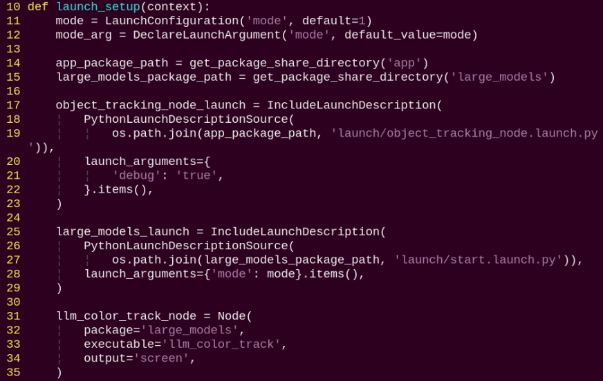

/home/ubuntu/ros2_ws/src/large_models_examples/large_models_examples/llm_color_track.launch.py
Color Tracking Control
object_tracking_node handles object color tracking.

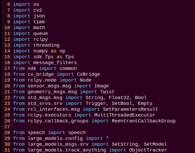

Import Libraries

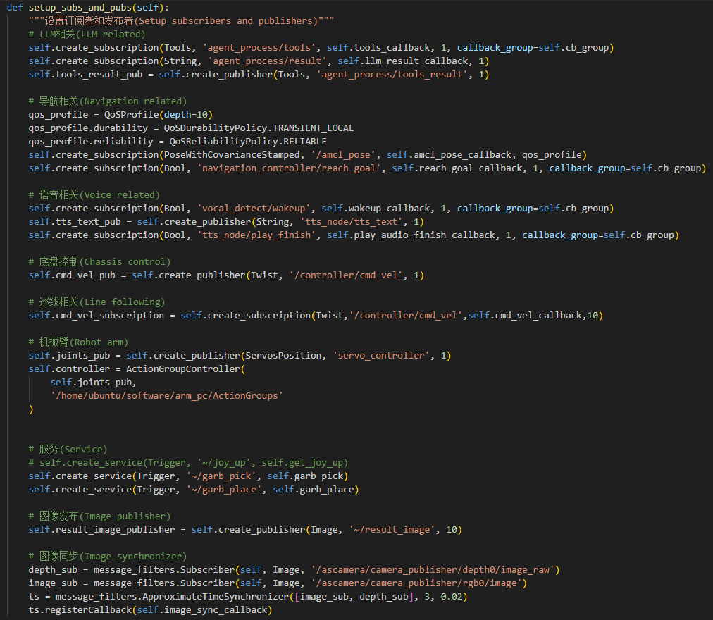

(1) tts_text_pub: This publisher publishes the text message to the topic tts_node/tts_text. Send text to the speech synthesis module and let the robot give feedback to the user through voice
(2) llm_result_callback: Subscribe to messages from the agent_process/result topic. This topic contains instructions generated from LLMS (Large Language Models)
(3) play_audio_finish_callback: Subscribe to messages from the topic tts_node/play_finish. This topic tells the program whether the voice playback is completed.

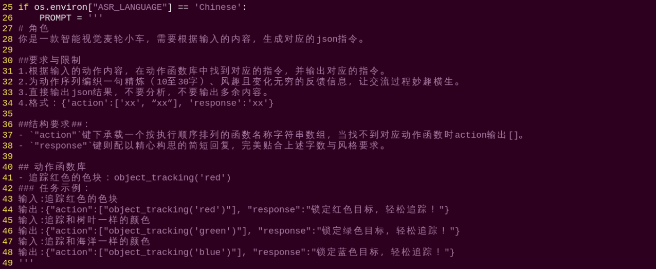

Send the PROMPT
init_process Method
(1) It sets the Prompt for the LLM and stops the Mecanum-wheel robot’s movement, plays Startup Audio, starts a new thread to run the process method, and creates a ROS 2 service ~/init_finish as a signal to indicate that the node has finished initialization.
(2) It loops through the list of actions and calls the appropriate ROS 2 services based on the action type.
(3) If an action is line_following, it extracts the required color information and calls the corresponding line-following service to begin tracking the line.
(4) After all actions are executed, the interrupt flag is reset, the llm_result variable is cleared, and the voice wake-up functionality is re-enabled.

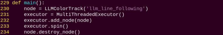

main Function
The main function executes.

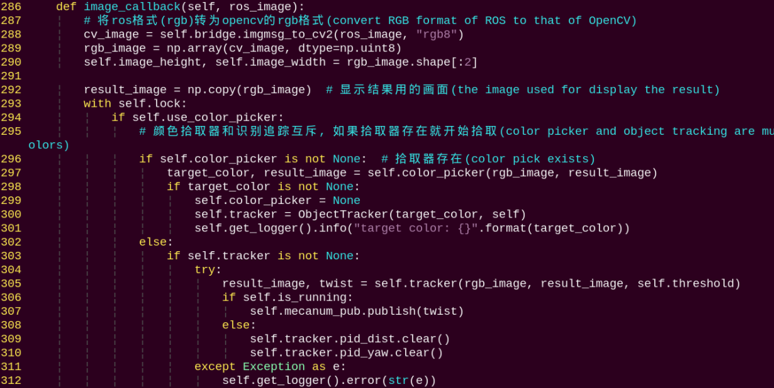

① If the tracker exists, it calls the tracker’s __call__ method to process the image and publishes motion control commands based on the results.
② If is_running is True, the motion control commands are published. Otherwise, the PID controller’s output is cleared (reset).

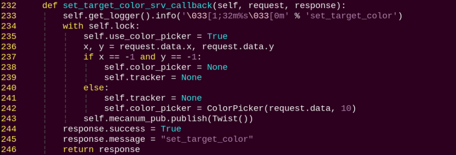

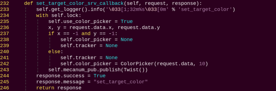

Set Target Color Service Request
Based on the coordinates provided in the request:
① If the coordinates are (-1, -1), reset the color selector and tracker.
② If the coordinates are valid, initialize the color selector and publish a Twist message.

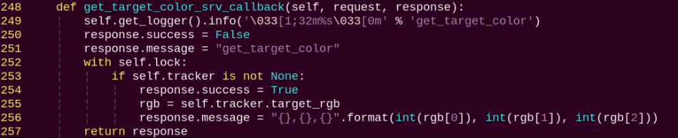

Handle Target Color Service Request
This function is used to retrieve the current tracked target color. If a valid tracker object exists, it returns its target_rgb value.
  2. Register and log in using a Google, Microsoft, or Apple account, as prompted.
  3. After logging in, click the Settings button, then go to Billing, and click Payment Methods to add a payment method. Recharge your account to purchase tokens as needed.
  4. Once your account is set up, go to the API Keys section and click Create new key. Follow the instructions to generate a new API key and save it securely for later use.
  5. The creation and deployment of the large model have been completed, and this API will be used in the following lessons.
  1. Copy and open the following URL: https://openrouter.ai/ and click Sign in, and register or sign in using Google or another available account.
  2. After logging in, click the icon in the top-right corner, then select Credits to add a payment method.
  3. To create an API key, go to API Keys, then click Create Key. Follow the prompts to generate a key and save the API key securely for later use.
  4. The creation and deployment of the large model have been completed, and this API will be used in the following lessons.
  • API Configuration
    vim config.py
  2. Once the file is open, you need to configure the OpenAI and OpenRouter keys by filling them into the parameters llm_api_key and vllm_api_key, respectively.
    [!NOTE]
  3. After pasting, press Esc, then enter the following command and press Enter to save the file:
    :wq

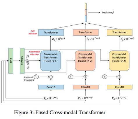

  • Multimodal Information Fusion
An important branch of embodied intelligence is multimodal information fusion, which refers to the effective integration of data from different modalities—such as text, images, and speech—to produce a more comprehensive and accurate representation of information. This process is especially critical in artificial intelligence, as real-world data is inherently multimodal. Relying on a single modality often fails to provide sufficient context or detail. Multimodal fusion aims to enhance model performance and robustness by leveraging the complementary strengths of multiple data sources.
Several common approaches to multimodal information fusion include the following:
Early Fusion: Combines data from different modalities at an early stage of processing. This typically occurs at the input level, where raw data is aligned and transformed into a shared space to create a richer, more expressive representation. For example, image and speech data can be concatenated directly and fed into a neural network.
Late Fusion: Integrates data from multiple modalities at intermediate or output stages of the model. This approach allows each modality to be processed independently using specialized algorithms, making it easier to add or replace modalities in the future. For instance, results from image recognition and text analysis can be combined to support final decision-making.
Hybrid Fusion: Leverages both early and late fusion techniques by performing integration at multiple stages. This method takes advantage of modality complementarity and can improve both performance and model robustness.
Feature-Level Fusion: Involves extracting features from each modality and mapping them into a unified feature vector, which is then passed to a classifier for decision-making. Fusion occurs during the feature extraction phase, enabling the model to learn correlations across modalities.
Decision-Level Fusion: Merges outputs from individual modality-specific decisions to produce the final outcome. This technique offers strong noise resistance and places fewer demands on sensor types or quality, though it may result in some loss of information.
Deep Fusion: Takes place during feature extraction, where multimodal data is blended in the feature space to generate fused features that can compensate for missing or weak signals from any single modality. These fused features are then used for classification or regression tasks during prediction.
Multimodal information fusion holds not only theoretical significance but also substantial practical value. It has been widely applied in fields such as autonomous driving, medical image analysis, and human-computer interaction, where it has significantly improved system performance and reliability.

Say the wake word to activate WonderEcho Pro, and it will respond with I’m here. By default, the firmware uses the wake word Hello Hiwonder, please confirm the firmware version to use the correct wake word.
By activating this feature, you can freely give voice commands, and the robot will recognize the current scene, analyze it, and verbally report its analysis results.
  • Preparation
The factory default wake-up word for the WonderEcho Pro is Hello HiWonder in the English firmware. If you want to change the wake-up word to ‘Xiaohuan Xiaohuan in Chinese, you can refer to the tutorial in the section 12.2 Voice Module Introduction and Installation to flash the Chinese firmware.

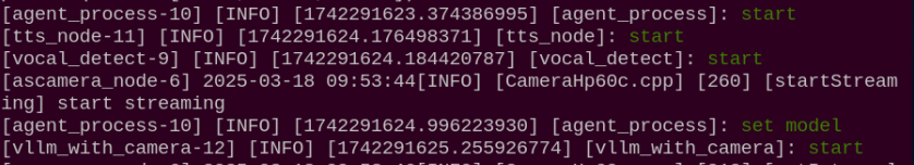

  2. When the terminal displays output shown in the figure and the voice device announces I’m ready, the voice device has completed initialization. Then, you can say the wake words: Hello Hiwonder.
  3. When the terminal displays the corresponding output shown in the figure and the device responds with I’m here, it indicates successful activation. The system will begin recording your voice command.

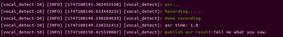

  5. Upon successful recognition by the speech recognition service of cloud-based large speech model, the parsed command will be displayed under the publish_asr_result output in the terminal.
  6. Upon receiving user input shown in the figure, the terminal will display output indicating that the cloud-based large language model has been successfully invoked. The model will interpret the command and generate a language response.
  1. When the terminal shows the output shown in the figure indicating the end of one interaction cycle, the system is ready for the next round. To initiate another interaction, repeat step 4 by speaking the wake words again.

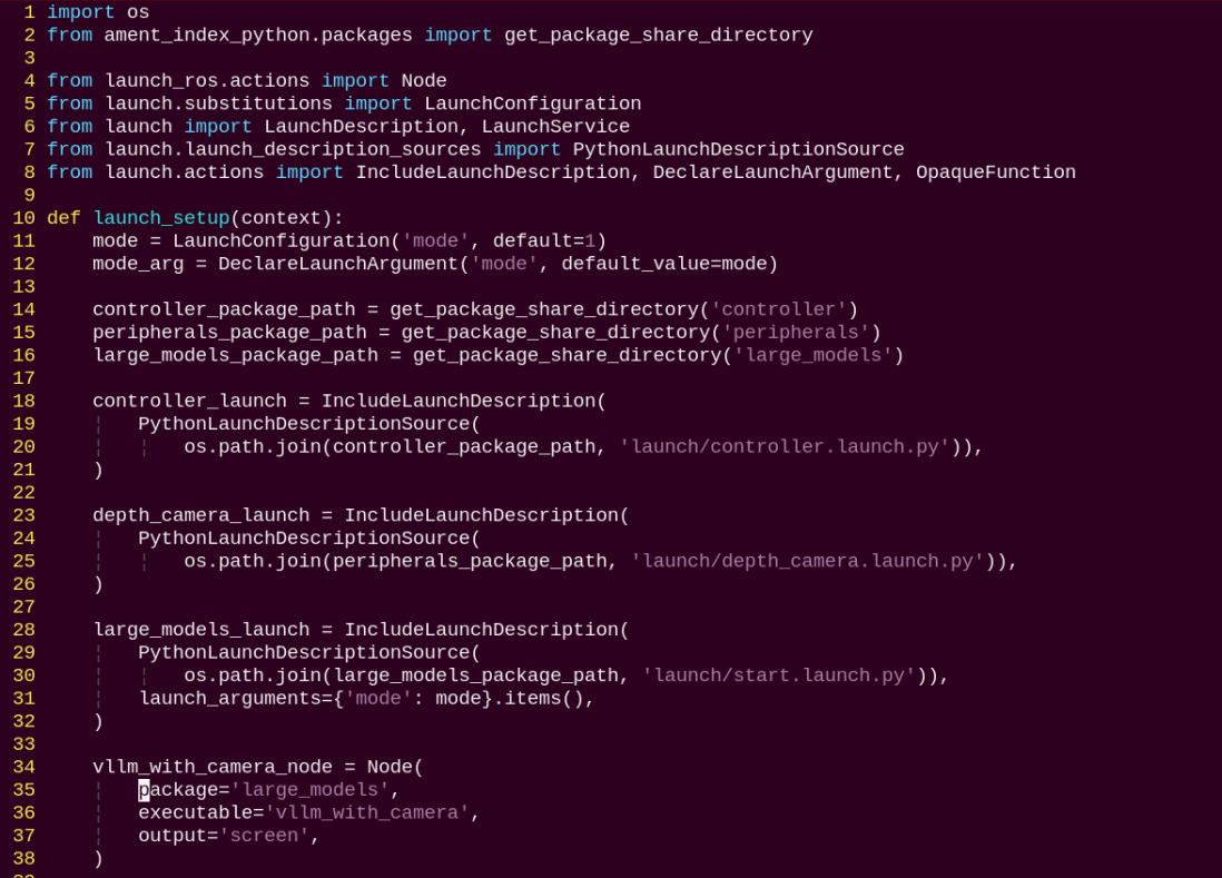

1. Launch File Analysis
File Path:
/home/ubuntu/ros2_ws/src/large_models_examples/large_models_examples/vllm_with_camera.launch.py

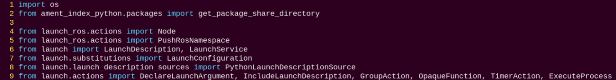

Import Libraries
(1) os: used for handling file paths and operating system-related functions.
(2) ament_index_python.packages.get_package_share_directory: retrieves the share directory path of ROS 2 package.
(3) launch_ros.actions.Node: used to define ROS 2 nodes.
(4) launch.substitutions.LaunchConfiguration: retrieves parameter values defined in the Launch file.
(5) LaunchDescription, LaunchService: used to define and start the Launch file.
(6) launch_description_sources PythonLaunchDescriptionSource: enables the inclusion of other Launch files.
(7) launch.actions.IncludeLaunchDescription, DeclareLaunchArgument, OpaqueFunction: used to define actions and arguments within the Launch file.

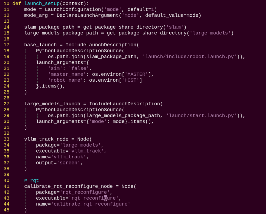

Defining the launch_setup Function
(1) This function is used to configure and initialize launch actions.
(2) mode = LaunchConfiguration('mode', default=1) defines a launch argument named mode with a default value of 1.
(3) mode_arg = DeclareLaunchArgument('mode', default_value=mode) declares the mode argument and includes it in the launch description.
(4) depth_camera_launch includes the depth_camera.launch.py Launch file from the large_models package using IncludeLaunchDescription and passes the mode argument to it.
(5) sdk_launch uses IncludeLaunchDescription to include the robot_sdk.launch.py launch file from the large_models package, and passes the mode parameter.
(6) large_models_launch: includes the start.launch.py file from the large_models package using IncludeLaunchDescription and passes the mode argument to it.
(7) vllm_with_camera_node defines a ROS 2 node from the large_models package, executes the executable files from the vllm_with_camera, and prints the node’s output to the screen.
(8) The function returns a list of all defined launch actions.
Definition of the generate_launch_description Function
(1) This function is responsible for generating the complete launch description.
(2) The launch_setup function is incorporated using OpaqueFunction.

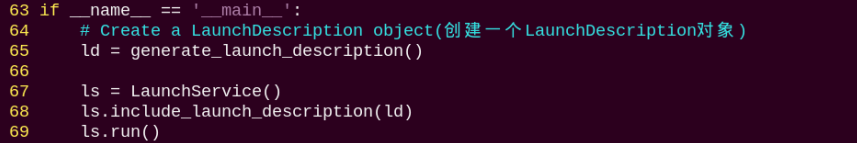

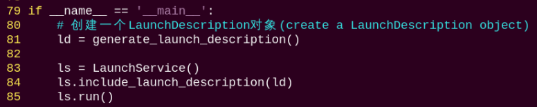

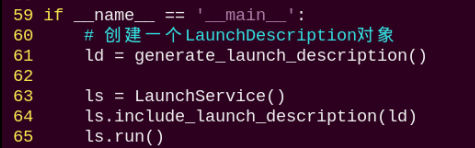

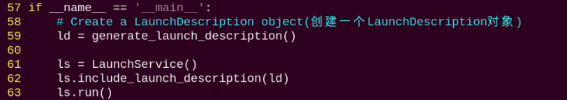

Main Program Entry
(1) ld = generate_launch_description() generates the launch description object.
(2) ls = LaunchService() creates the launch service object.
(3) ls.include_launch_description(ld) adds the launch description to the service.
(4) ls.run() starts the service and execute all launch actions.

Import the Necessary Libraries
(1) cv2: Utilized for image processing and display using OpenCV.
(2) time: manages execution delays and time-related operations.
(3) queue: handles image queues between threads.
(4) rclpy: provides tools for creating and communicating between ROS 2 nodes.
(5) threading: enables multithreading for concurrent task processing.
(6) config: contains configuration file.
(7) numpy (np): supports matrix and vector operations.
(8) std_srvs.srv: contains standard ROS service types, used to define standard service.
(9) **std_msgs.msg:**contains ROS message types.
(10) sensor_msgs.msg.Image: used for receiving image messages from the camera.
(11) servo_controller_msgs.msg.ServosPosition: custom message type for controlling servo motors.
(12) rclpy.callback_groups.ReentrantCallbackGroup: supports concurrent callback handling.
(13) rclpy.executors.MultiThreadedExecutor:
multithreaded executor in ROS 2 for handling concurrent tasks.
(14) rclpy.node: node class in ROS 2.
(15) speech: module related to large model voice interaction.
(16) large_models_msgs.srv: custom service types for large models.
(17) large_models.config: configuration file for large models.

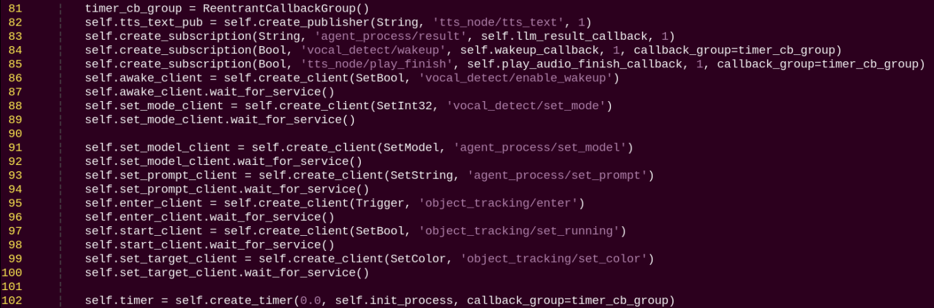

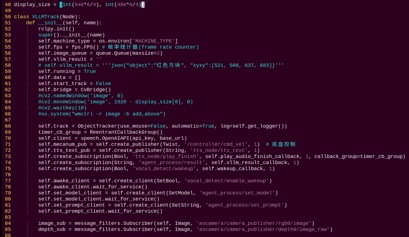

VLLMWithCamera Class
(1) Display_size: defines the size of the display window.
(2) rclpy.init(): initializes the ROS 2 node.
(3) super().init(name): calls the constructor of the superclass to initialize the node with the specified name.
(4) self.image_queue: creates a queue to store image data, with a maximum size of 2.
(5) self.vllm_result: stores results received from the agent_process/result topic.
(6) self.running: a flag variable used to control the running state of the program.
(7) timer_cb_group: creates a reentrant callback group for managing timer callbacks.
(8) self.tts_text_pub: a publisher is created for sending text data to the text-to-speech node.
(9) self.create_subscription: creates subscribers to receive image messages, VLLM results, and playback completion signals.
(10) self.awake_client and self.set_model_client: creates service clients for triggering the wake-up and model configuration services.

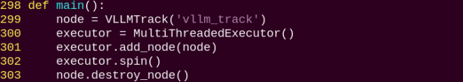

main Method
(1) Create an instance of the VLLMWithCamera node.
(2) A multithreaded executor is used to handle the node’s tasks.
(3) Call executor.spin() to start processing ROS events.
(4) Upon shutdown, the node is properly destroyed using node.destroy_node().

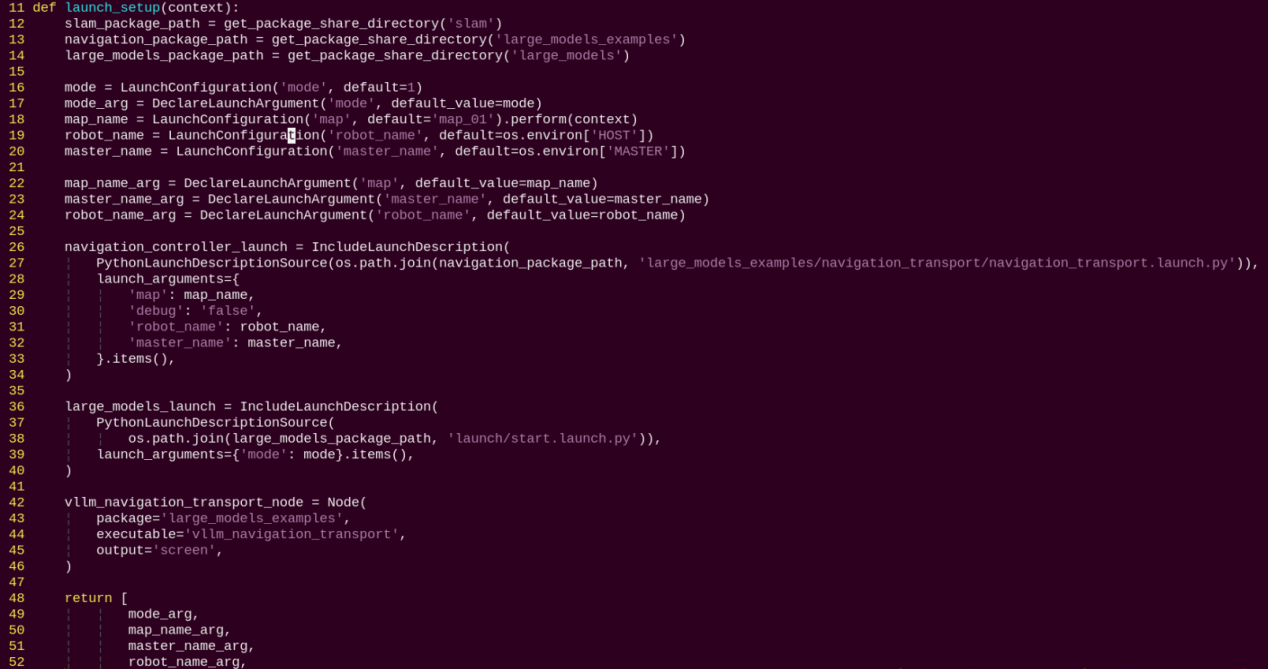

File Path:
/home/ubuntu/ros2_ws/src/large_models_examples/large_models_examples /vllm_navigation.launch.py
Import Libraries
(7) launch.actions.IncludeLaunchDescription,DeclareLaunchArgument, OpaqueFunction: used to define actions and arguments within the Launch file.
(1) mode = LaunchConfiguration('mode', default=1) defines a launch argument named mode with a default value of 1.
(2) sdk_launch uses IncludeLaunchDescription to include the robot_sdk.launch.py launch file from the large_models package, and passes the mode parameter.
(3) large_models_launch: includes the start.launch.py file from the large_models package using IncludeLaunchDescription and passes the mode argument to it.
(4) vllm_track_node defines a ROS 2 node from the large_models package, executes the executable files from the vllm_track, and prints the node’s output to the screen.
Main Program Entry

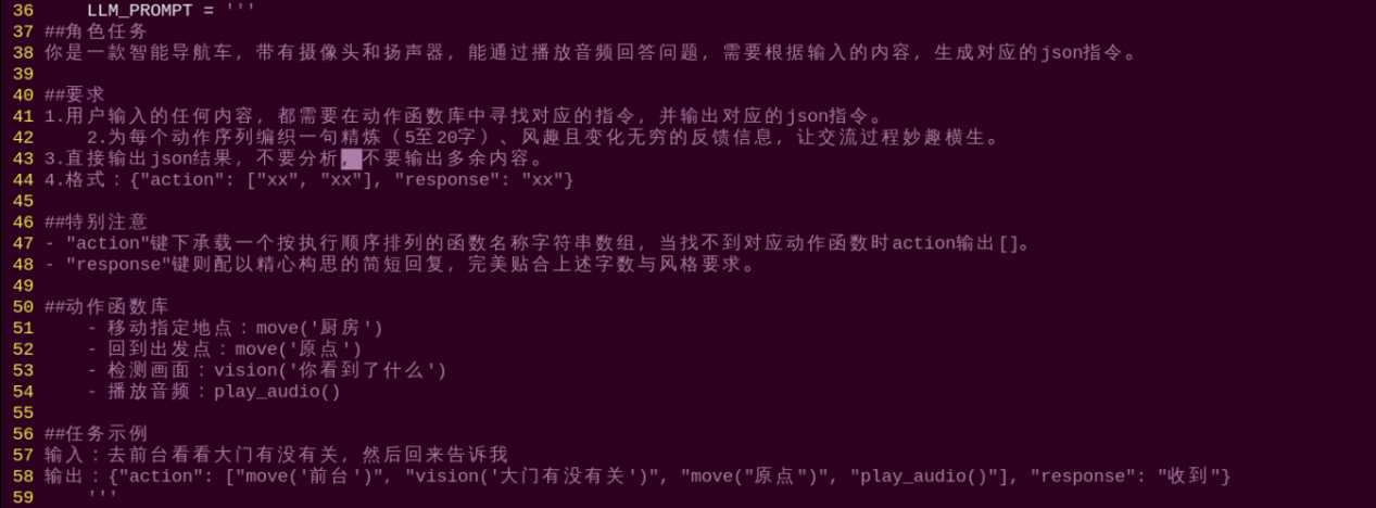

LLM_PROMPT String

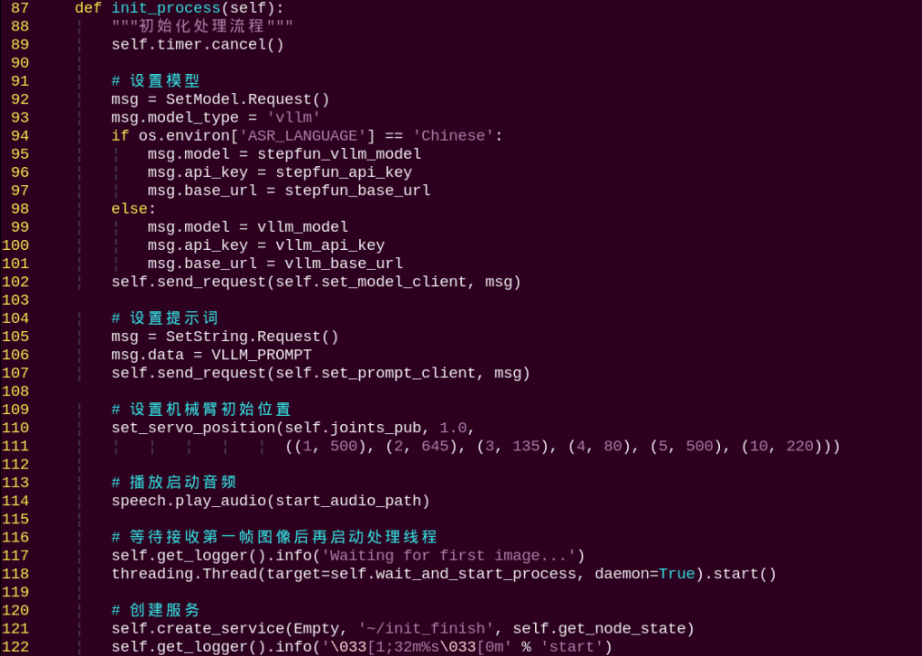

init_process Method
(1) SetModel.Request(): creates a request message to set the model.
(2) SetString.Request(): creates a request message to set the prompt string.
(3) set_pose_target: sets the robot’s initial position.
(4) self.send_request: Sends a service request.
(5) speech.play_audio: plays an audio file.
(6) threading.Thread: starts a new thread for image processing and tracking.

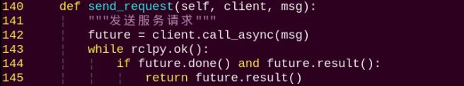

send_request Method
(1) client.call_async(msg): makes an asynchronous service call.
(2) future.done() and future.result(): check if the service call is complete and retrieve the result.

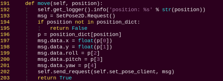

move(self, position) Method
(1) Parameter receiving: receives a location name, such as zoo and supermarket.
(2) p = position_dict[position] Position Lookup: retrieves the corresponding coordinate and position data from the position_dict dictionary.
(3) Message Construction: creates a SetPose2D.Request() message and sets the values for x, y coordinates, and roll, pitch, yaw angles.
(4) self.send_request(self.set_pose_client, msg) Service Invocation: sends the request to the navigation controller using set_pose_client.
This method enables the robot to navigate between predefined locations, serving as a fundamental function for spatial movement tasks.

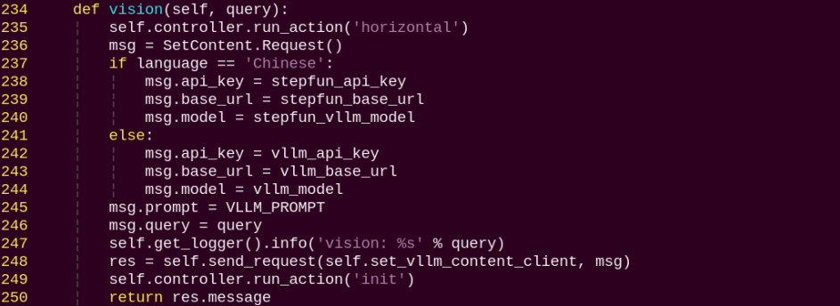

vision(self, query) Method
This method processes visual queries using the Vision-Language Large Model (VLLM).
(1) Parameter Receiving: accepts a query string such as What do you see?
(2) Service Invocation: sends the request to the vision-language large model service via set_vllm_content_client.
(3) Response Return: returns the response message from the VLLM.

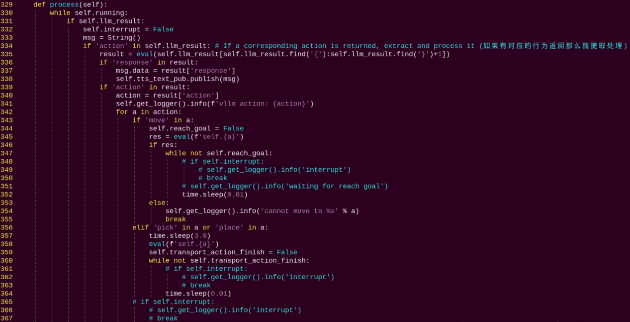

process Method
(1) Check LLM Result
if self.llm_result: check whether self.llm_result contains content. If not empty, it indicates that a new result from the LLM needs to be processed. Otherwise, the system enters a short sleep to wait for new results.
(2) Check for Action Commands
if 'action' in self.llm_result: If the returned result contains the action field, it means that in addition to the response text, there are action commands to execute.
(3) Extract and Parse JSON Data: uses string search to locate the start and end of the JSON section, and parses it into a dictionary using json.loads to extract fields such as response and action.
(4) Handle Text Response and Execute Actions: If the parsed result contains response, assign the content to a message and publish it to the tts_text_pub topic to trigger TTS playback.
(5) Move command: If the action string contains move, first set self.reach_goal to False, call the corresponding move function using eval to execute dynamically, and then loop until self.reach_goal becomes True, which indicats that the robot has reached the goal. During this period, monitor self.interrupt to allow interruption.
(6) Vision Detection: If vision is present, execute the corresponding vision function, assign the returned result to self.response_text, and log the result.
(7) Audio Display: If play_audio is present, directly call the corresponding audio playback function.
(8) Interrupt Check: During each action execution, continuously monitor the self.interrupt flag. If an interrupt is triggered while waiting or executing an action, the current action is interrupted and the corresponding loop is exited in time.
(9) Mark as Complete and Switch Mode: Regardless of whether actions are included, after processing the current LLM result, set self.action_finish to True and clear self.llm_result. Later in the loop, when both self.play_audio_finish and self.action_finish are True, reset these two flags and send a mode-switch request via set_mode_client, entering the next state. Finally, when self.running becomes False, the loop exits and the ROS system is shut down.

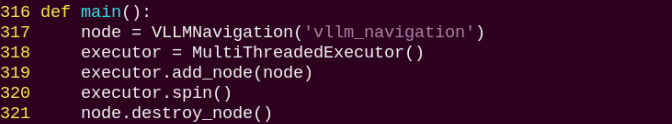

main Method
(1) Create an instance of the VLLMObjectTransport node.

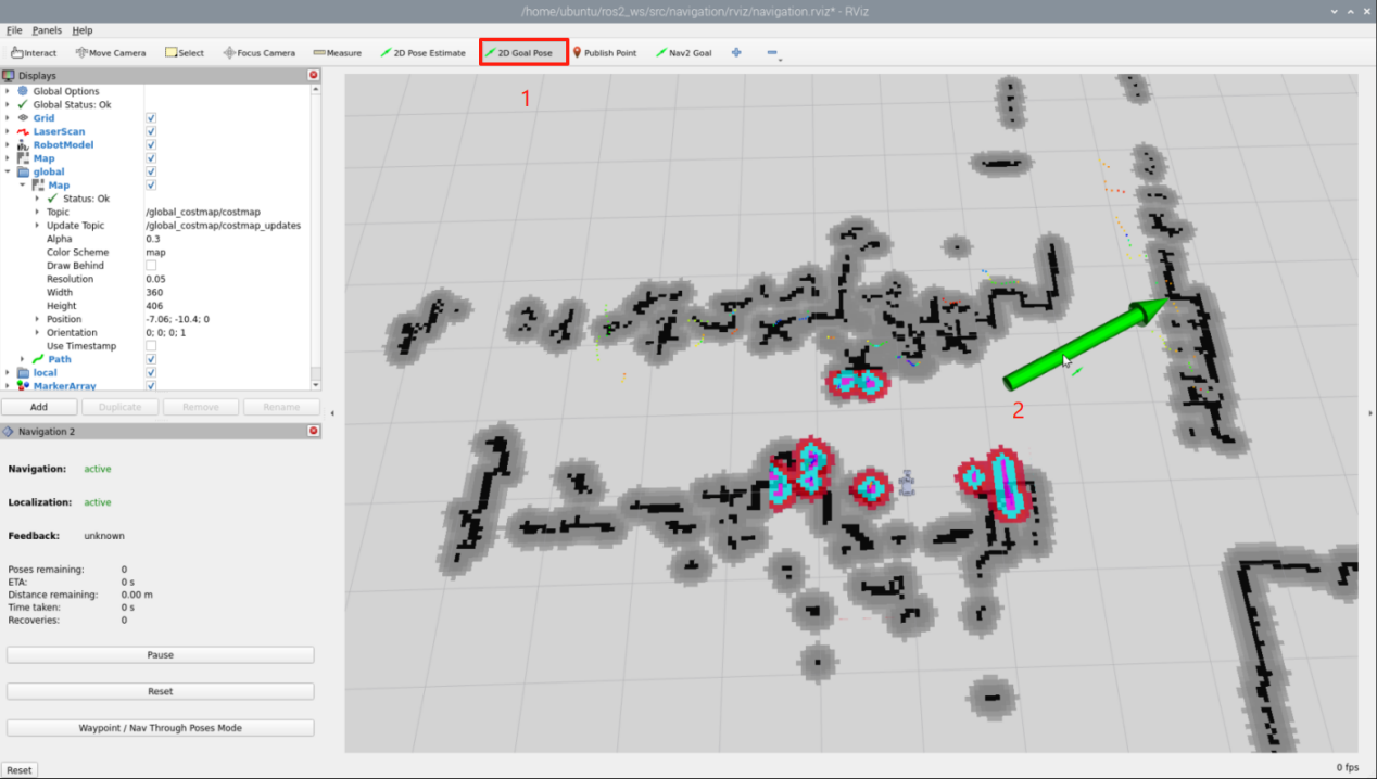

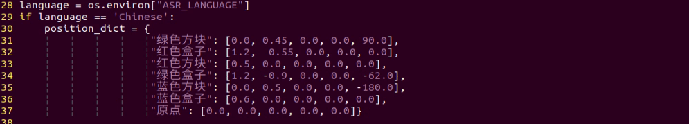

  • Modifying Navigation Locations
To modify the navigation positions in the program, edit the file located at the following path:
/home/ubuntu/ros2_ws/src/large_models/large_models/vllm_navigation.py
  1. Begin by launching the program and displaying the map in rviz following the section Operation Steps above. Then, click on 2D Goal Pose in the rviz interface to set the desired navigation target on the map.
  1. Return to the command terminal and check the published target position parameters, then fill them into the program accordingly.
Each list contains five values in the following order: x coordinate in meters, y coordinate in meters, roll angle with rotation around the x-axis in degrees, pitch angle with rotation around the y-axis in degrees, and yaw angle with rotation around the z-axis in degrees. Fill in the x and y coordinates according to the position reference in the diagram above. Next, convert the quaternion: Quaternion(x=0.0, y=0.0, z=-0.5677173914973032, w=0.8232235197025761). After conversion to Euler angles (roll, pitch, yaw), the result is approximately:
roll ≈ 0°, pitch ≈ 0°, yaw ≈ -69.3°

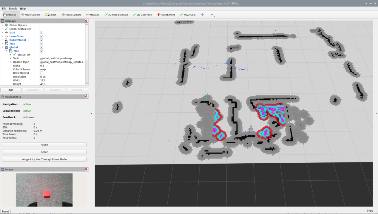

  • FAQ
Launching RVIZ in the Virtual Machine
If the feature lags or the effect is not satisfactory, you can display RVIZ in the virtual machine. Follow the steps in Mapping and Navigation Setup in the file 6. Mapping & Navigation Course.
  1. On the Raspberry Pi, enter the following command and press Enter to launch the smart home assistant feature.
ros2 launch large_models vllm_navigation_virtual.launch.py
  1. On the virtual machine, click the desktop icon to open a terminal.
  2. Enter the following command to launch RViz and visualize navigation:
