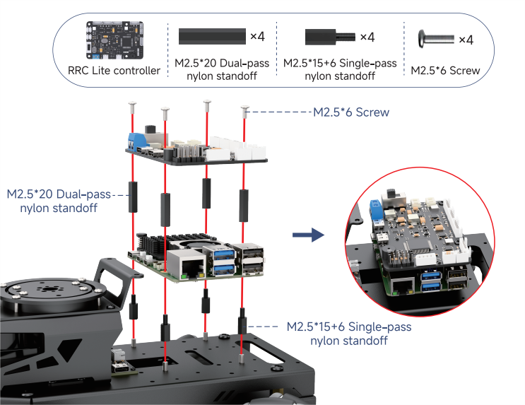

1.2 Accessories Installation and Startup Preparation

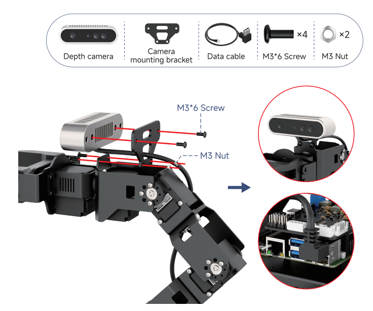

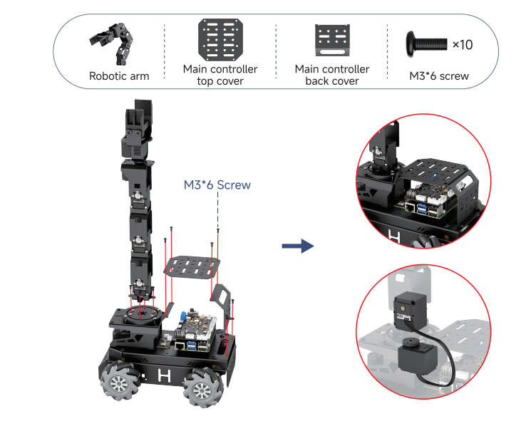

1.2.1 Assembly Instructions

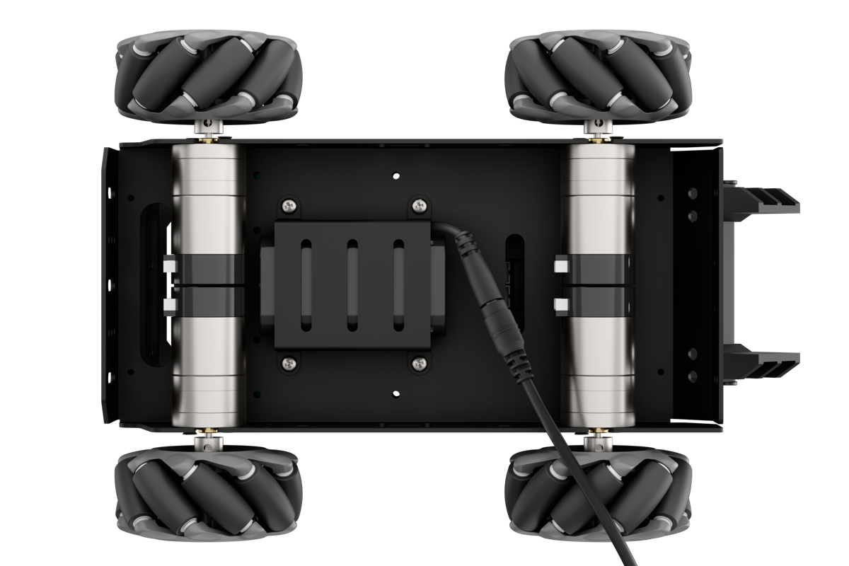

Wiring for the Mecanum chassis:

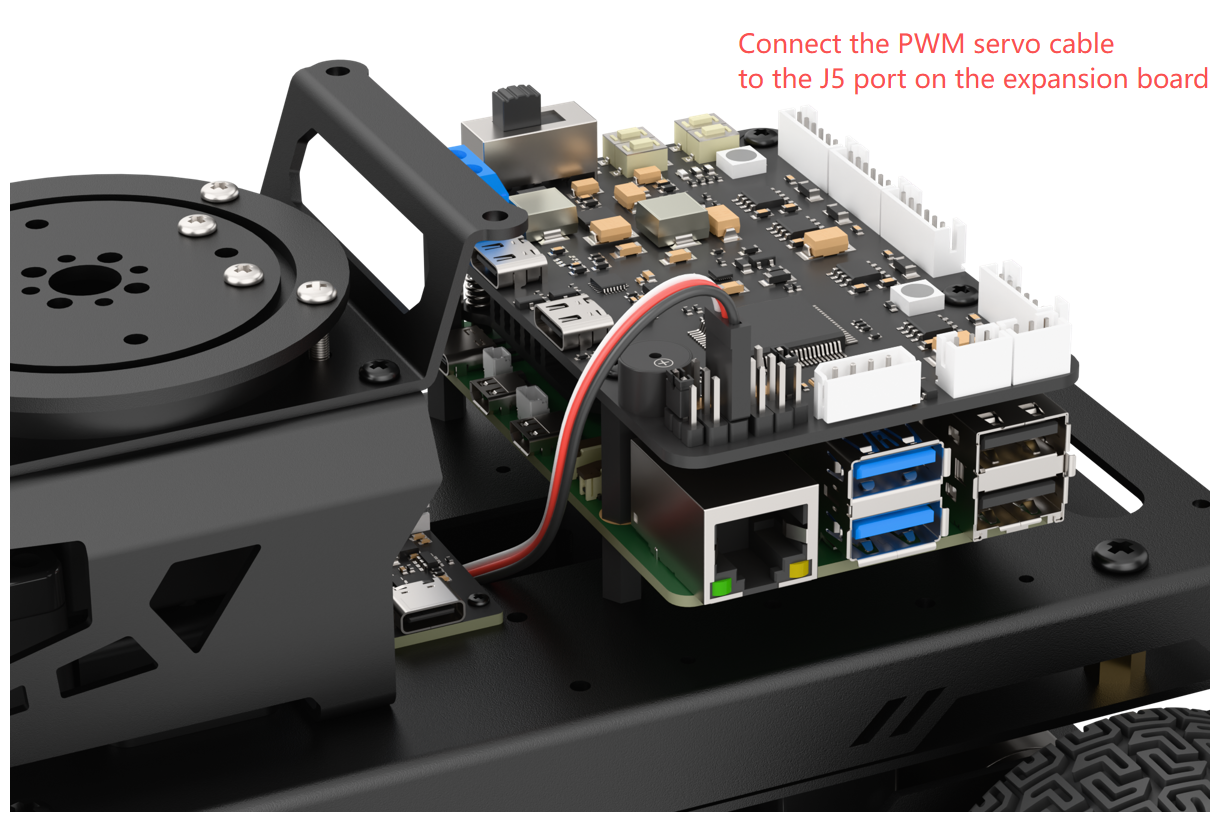

The two 3-pin servo wires from the pan-tilt on the three chassis should be connected as follows: one to the servo port on the STM32 controller, and the other to the servo at the bottom of the robot arm.
Wiring for the Ackerman chassis:

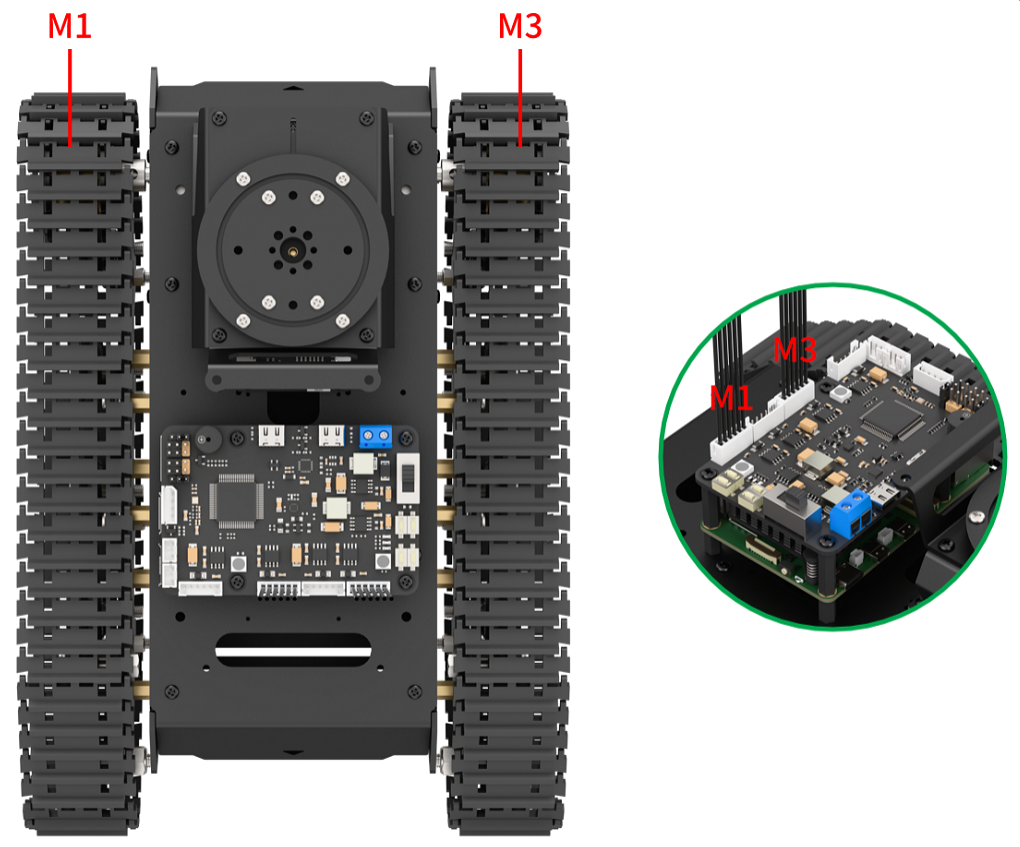

Wiring for the Tank chassis:

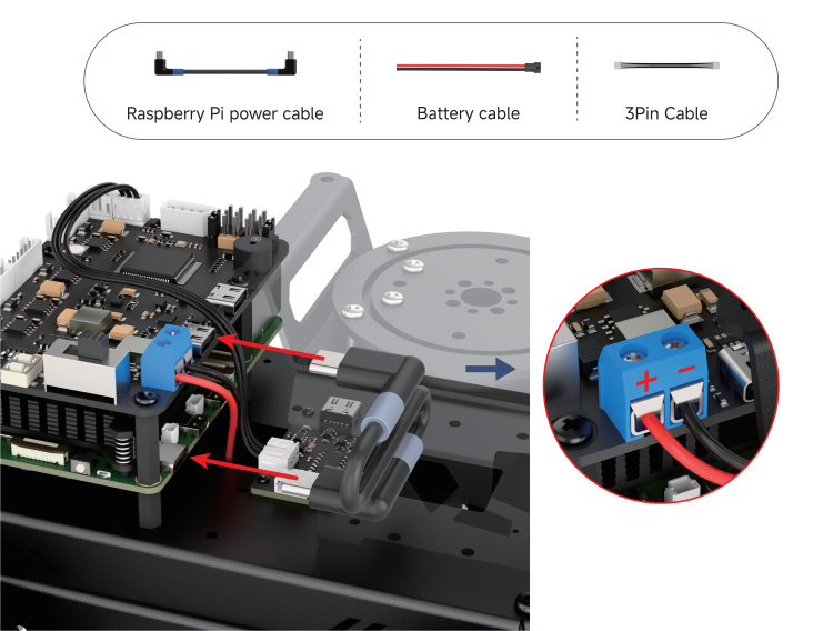

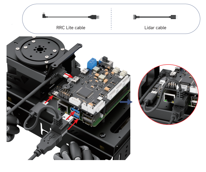

1.2.2 Wiring Instruction
The diagram below shows the port numbers on the Raspberry Pi controller for the Advanced kit. Please follow the table for wiring. If your kit does not include certain modules, you may skip the corresponding ports.

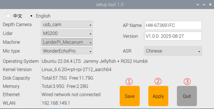

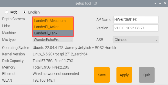

The factory image of the robot is set for the mecanum chassis by default. If a different chassis type was purchased, after assembly and wiring, refer to 1.4.3 Switching Robot Configurations to change the chassis type to match your robot, Ackermann or Tank chassis.
No. Name
1 Lidar port
2 Monocular/Depth camera port
3 STM32 controller communication cable
4 WonderEcho Pro/USB wireless controller receiver

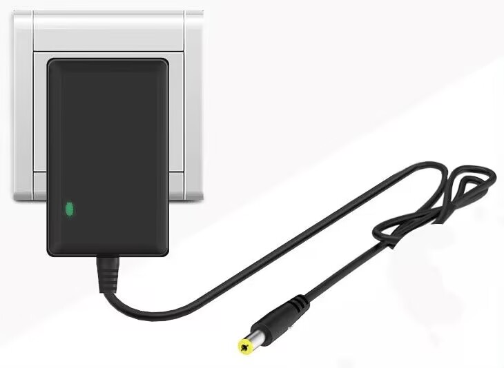

  • Charging Instructions
Charging Steps:
  1. Make sure the device’s power switch is set to OFF.

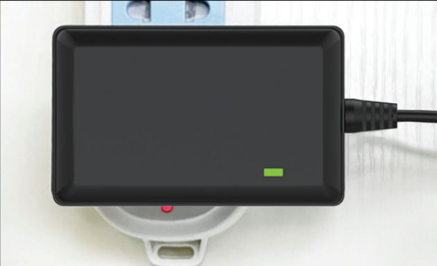

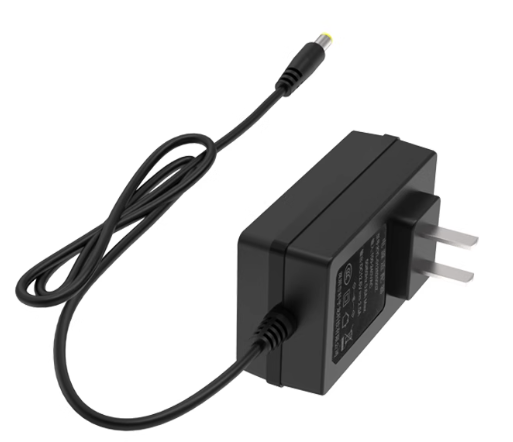

  2. Take out the battery’s DC connector from the side of the robot and plug in the charger.
For the tracked base, you need to remove the bottom screws and detach the bracket before charging.
  1. Check the indicator light on the charger to monitor the charging status. The indicator shows red while charging and turns green when charging is complete.
After charging is complete, unplug the charger promptly to prevent overcharging.

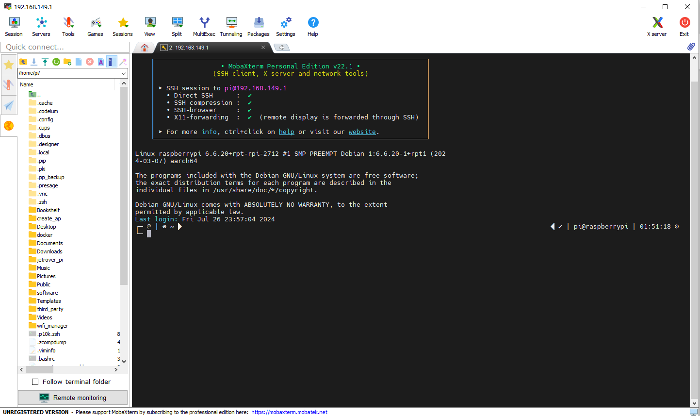

If you need to connect to the robot using remote development tools, or wish to further explore advanced functions and review sample programs, please refer to the section 1.4 Development Environment Setup and Configuration in this document.

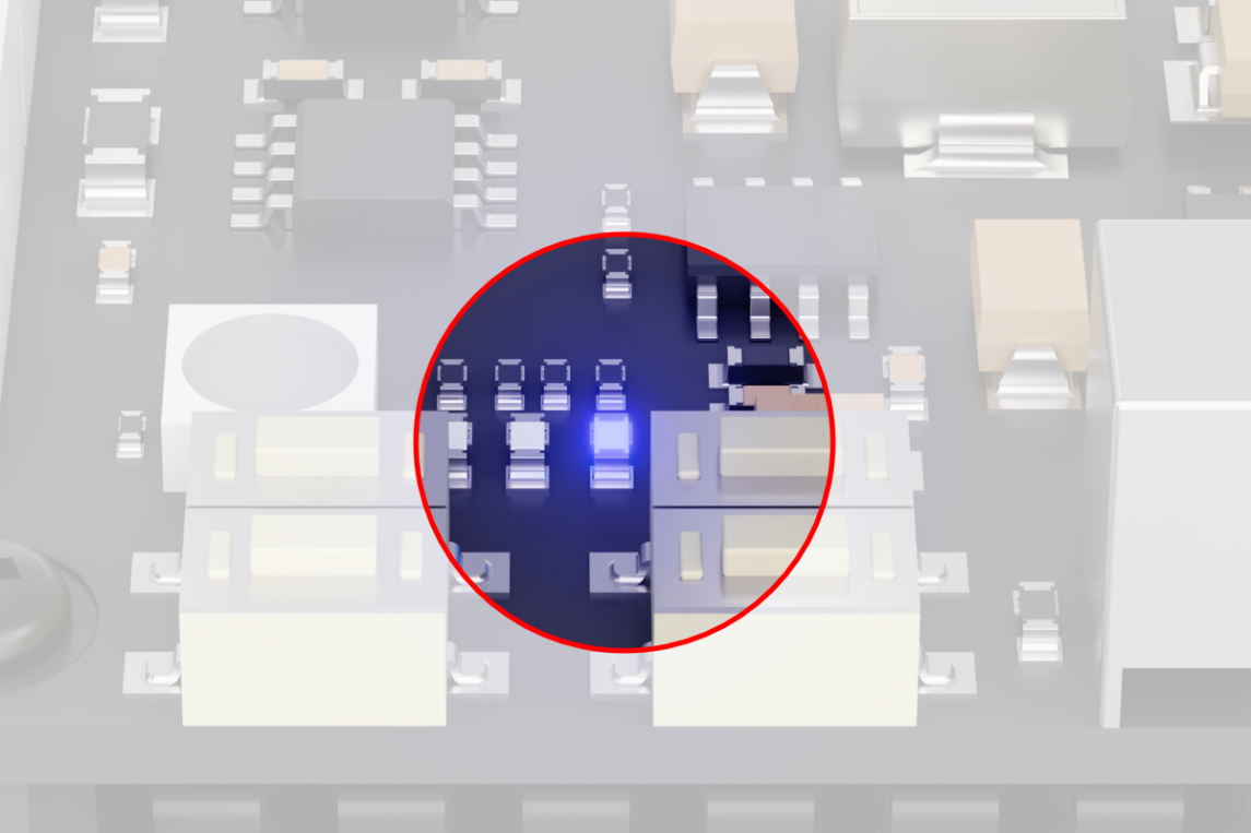

  1. Place the robot on a flat, smooth surface and switch it on from the power button on the right side.
  1. The blue LED1 at the lower right of the expansion board on the Raspberry Pi will light up and start blinking. At this stage, only the network configuration service is running, the ROS system and other services are still starting up. Wait until the buzzer emits a short beep — this indicates the system has finished booting.
If the buzzer does not beep, hardware such as the IMU, buzzer, or buttons may be malfunctioning. This is rare during normal use. If it occurs, please contact customer support.
  1. By default, the device is configured in AP direct-connect mode. After startup, a Wi-Fi hotspot beginning with “HW” will appear. To connect via mobile app or remote desktop, enter the default password: hiwonder.
If the hotspot does not appear after startup, follow these troubleshooting steps:
  1. Verify all steps in Startup Status and Test have been followed.
  2. If LED1 stays solid blue instead of blinking, the system may be in LAN mode. Long-press the KEY1 button on the expansion board for 5–10 seconds. If LED1 starts blinking, the HW Wi-Fi hotspot has been re-enabled.
  3. If LED1 does not blink after pressing KEY1, the system may not detect the SD card. Remove and reinsert the SD card.
  4. If LED1 still stays solid after reinserting, the SD card may be faulty or the system image may not have been written properly. Replace the SD card or re-flash the image.
  5. If the issue persists after replacing the SD card and re-flashing, the Raspberry Pi core board may be defective. Please contact customer support.

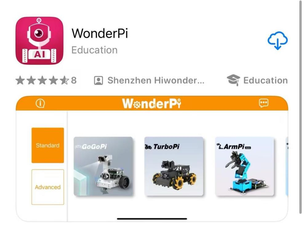

To control the robot with the WonderPi app, you can download the app from the App Store or the Hiwonder official website. This section explains how to get the app installation package.
  • Please grant all permissions requested during installation to ensure the app functions properly.
  • Turn on your phone’s GPS and Wi-Fi before opening the app.
  • App Installation
Method 1: App Store
  1. Android devices: Locate the installation package in the directory of App Installation Package and import it to your phone to install.
  2. iOS devices: Search for WonderPi in the App Store, and download the app.

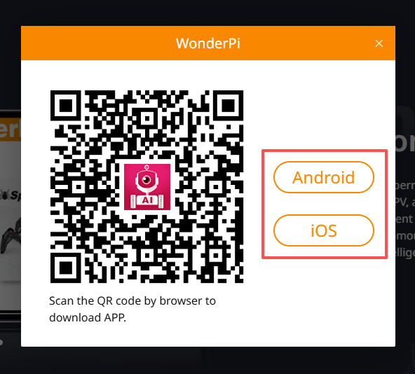

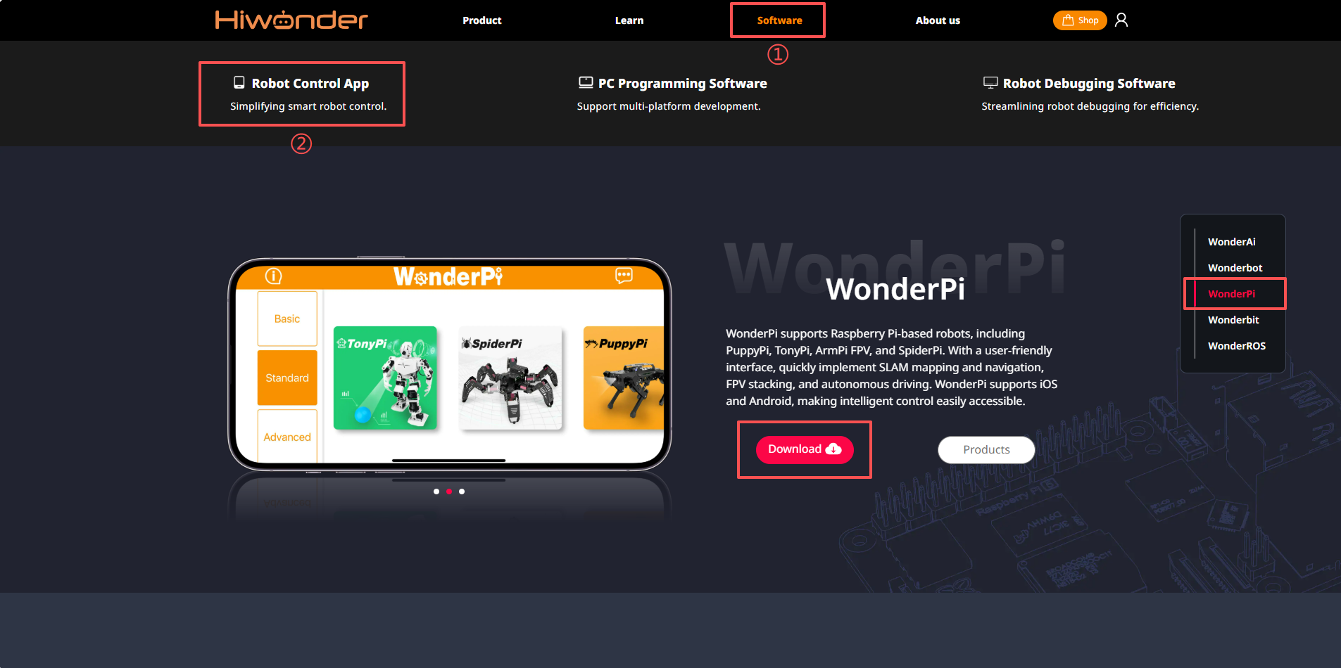

Method 2: Hiwonder Official Website
  1. Visit the Hiwonder tutorials website: https://www.hiwonder.net/app-software
  1. Navigate to the software download page.
  1. Locate WonderPi and choose the installation package suitable for your device.
Download Options in Different Scenarios:
Device System Operation Result
PC Android Click "Android Download." The browser automatically downloads the installation package. Once the download is complete, transfer it to your phone for installation.
Mobile Android Click "Android Download." The installation package is downloaded automatically. After the download is complete, install it directly on your phone.
Scan the QR code.
iOS Click "iOS Download." Redirects to the App Store for direct installation.

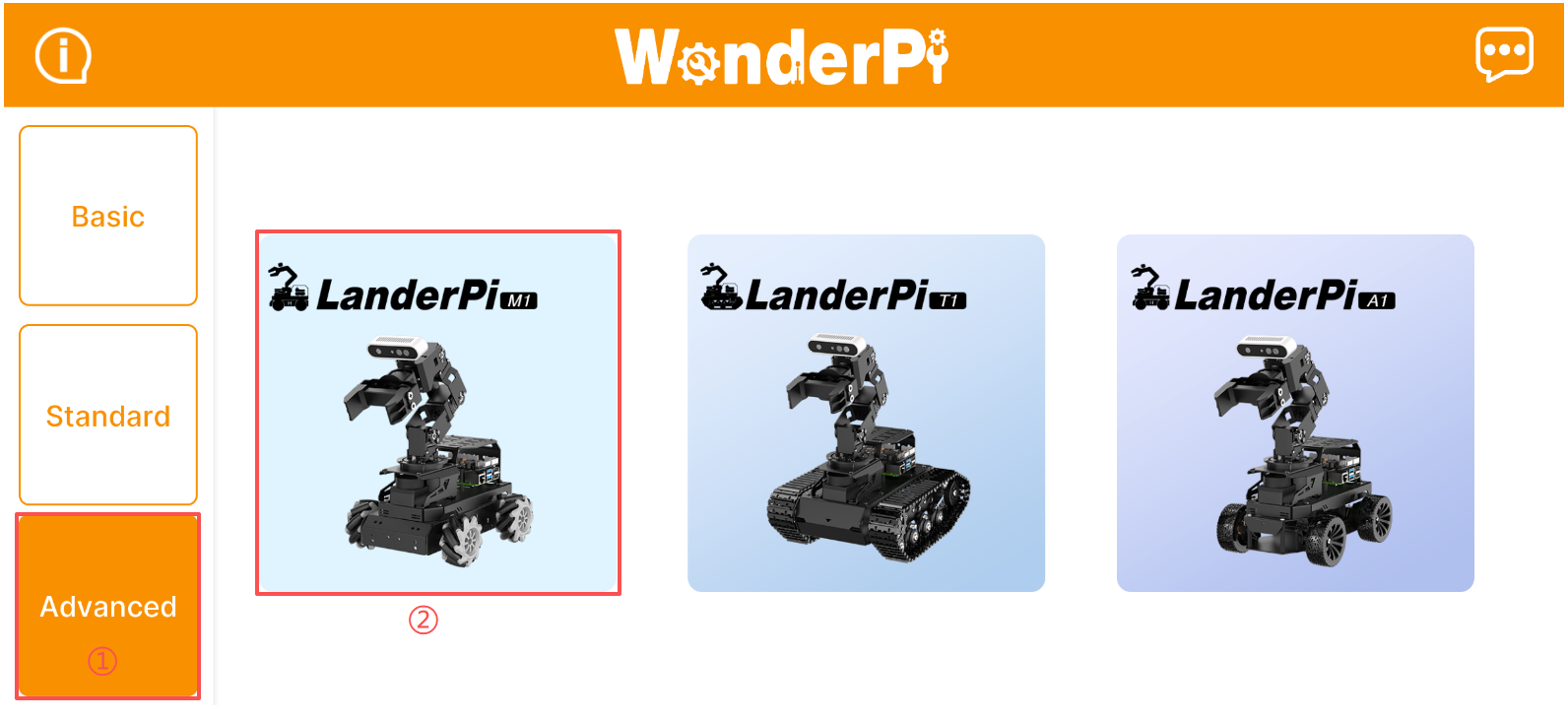

  1. Open the WonderPi and select Advanced > LanderPi(M1).
For the Ackerman chassis and Tank chassis versions, select LanderPi (A1) or LanderPi (T1), respectively.

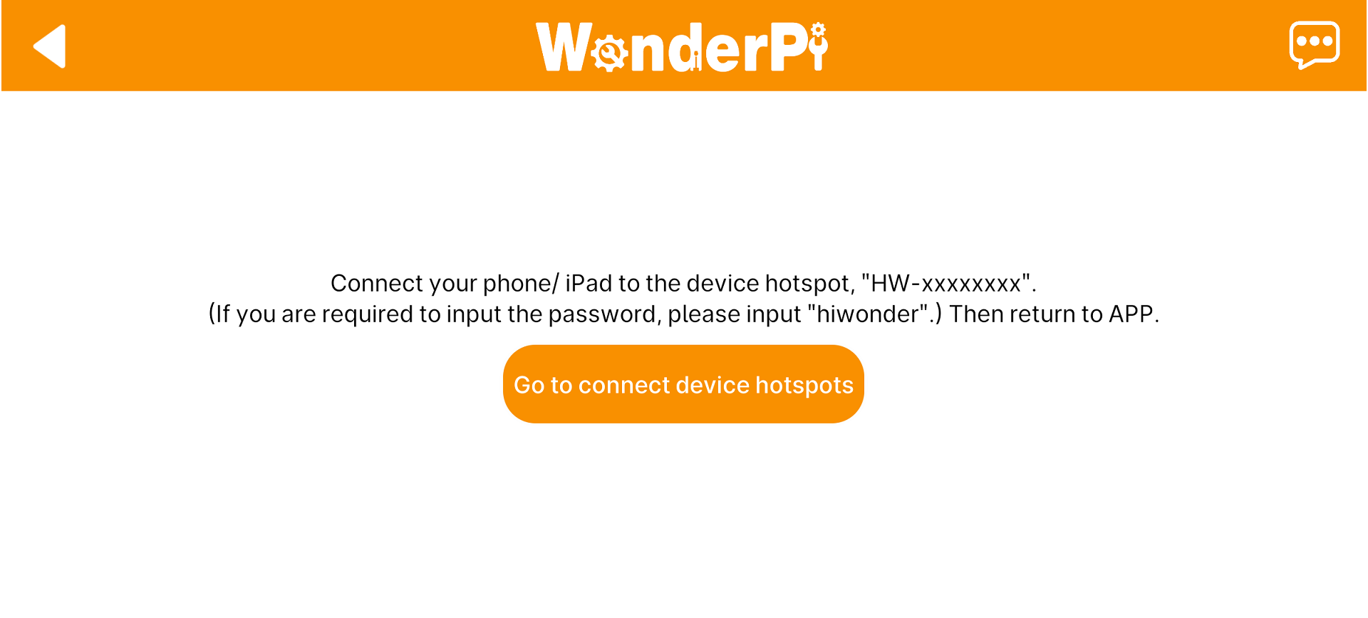

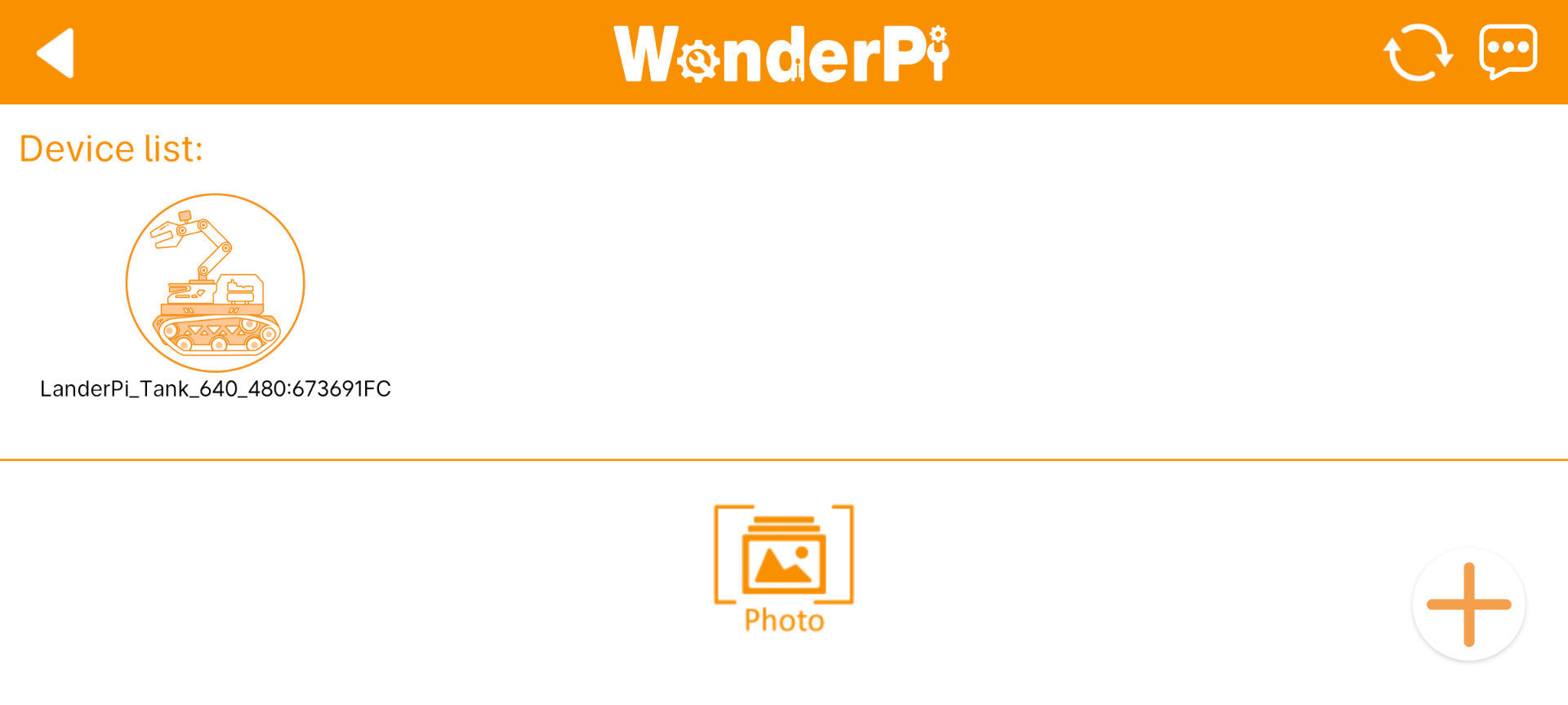

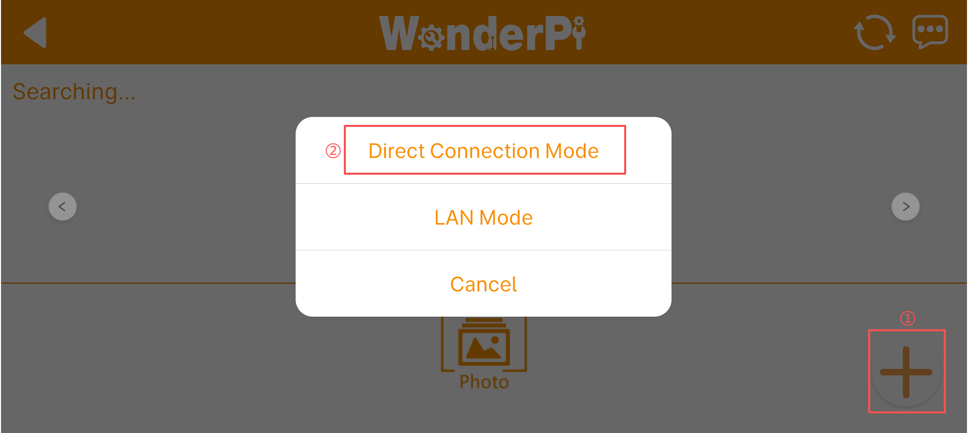

  1. Tap the + button in the bottom-right corner and choose Direct Connection Mode.
If you want to use LAN mode for connection, refer to the section LAN Mode Connection (optional).

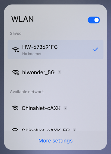

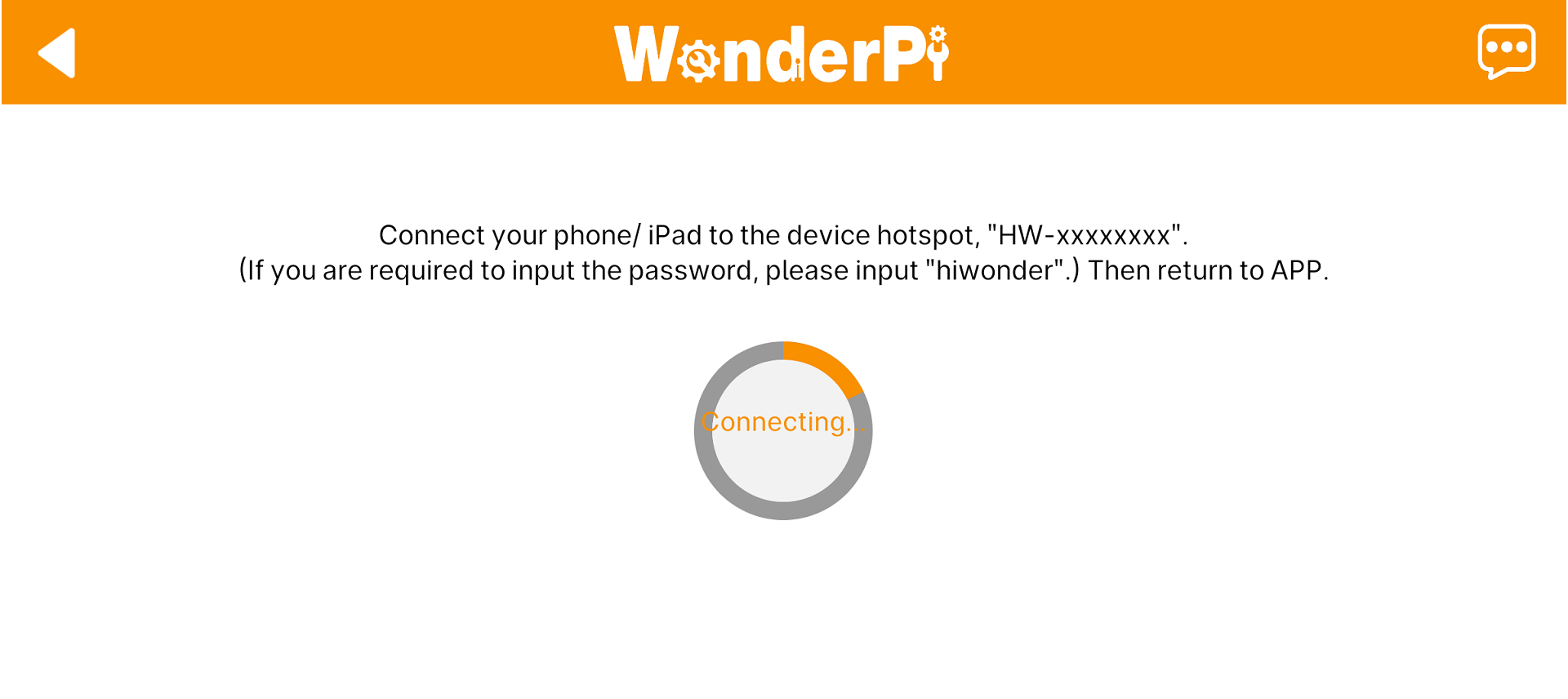

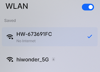

  1. Tap Go to connect device hotspots, which will take you to the Wi-Fi settings page to connect the hotspot generated by the robot.
  1. The hotspot starts with HW and connect to it by entering the password: hiwonder.
For iOS users: Make sure the Wi-Fi icon appears in the status bar before switching back to the app, or the device might not be detected. If the app doesn’t detect the device right away, tap the refresh icon in the upper-right corner.
  1. Tap the corresponding robot icon in the app, and enter the mode selection screen.
If a message pops up saying “Network is unavailable, continue?”, tap “Keep Connection” to proceed.

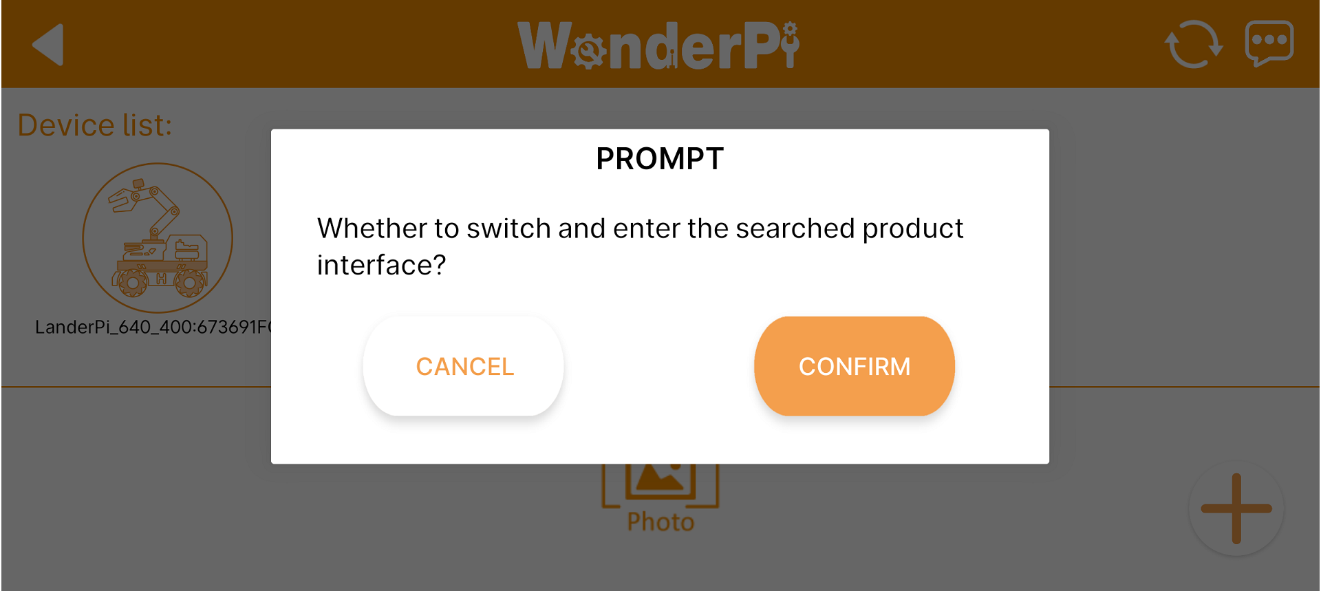

  1. If a message appears saying Whether to switch and enter the searched product interface? it means the wrong product was selected in Step 1. Tap CONFIRM to automatically switch to the correct version’s mode selection screen.
  1. The mode selection interface is shown below.

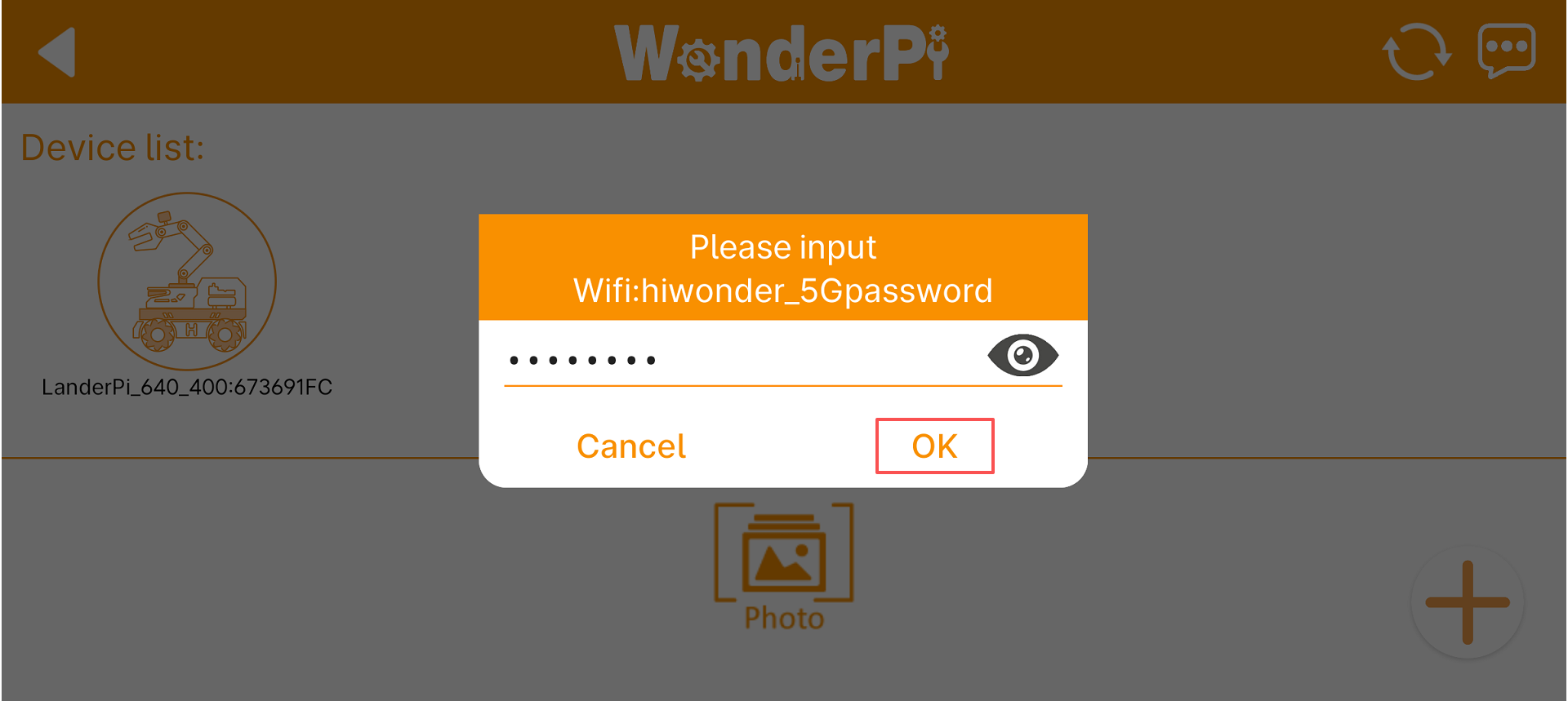

  1. First, connect your phone to a 5G Wi-Fi network. For example, connect to “Hiwomder_5G.” If you are using a dual-band router with separate SSIDs, the 2.4G and 5G networks will have different names, for example, “Hiwonder” for 2.4G and “Hiwonder_5G” for 5G.

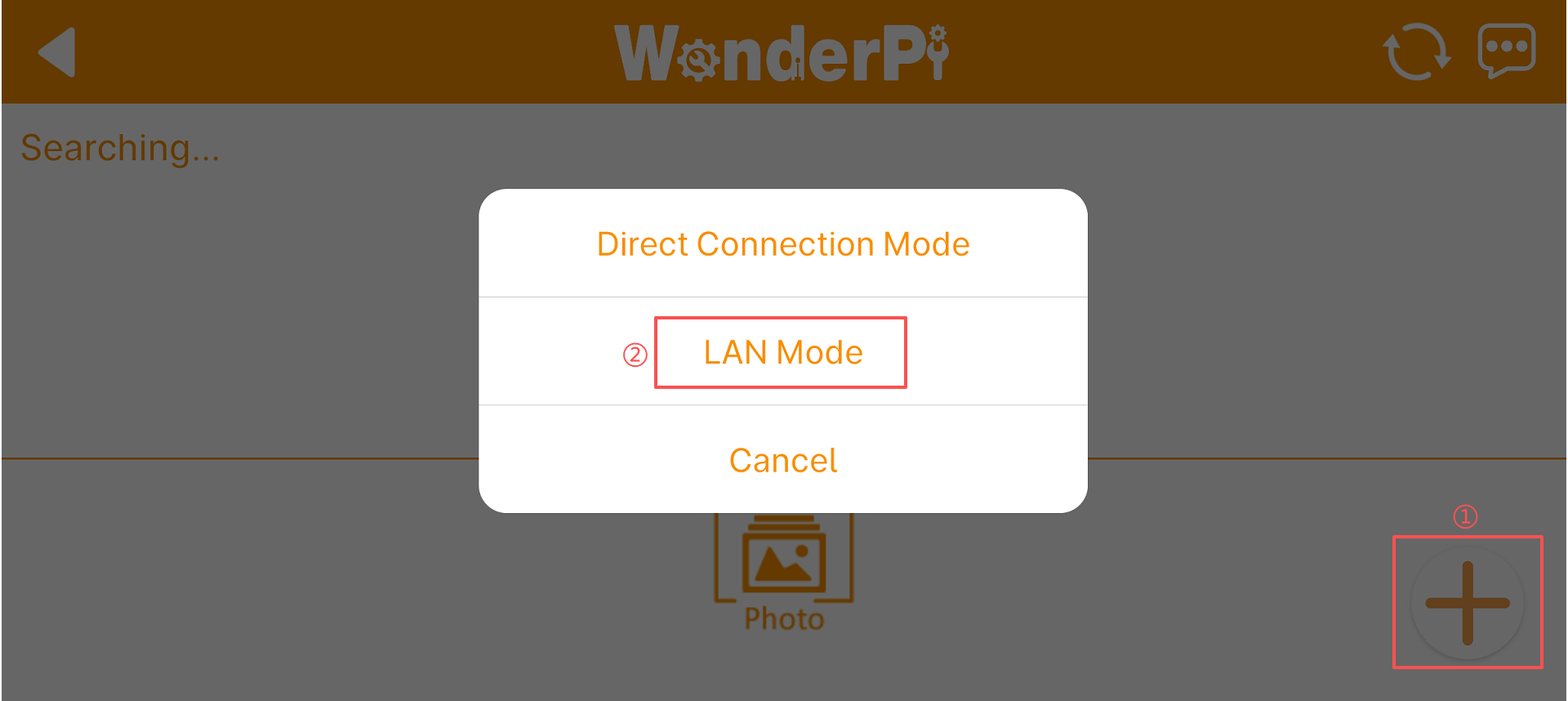

  1. Tap the + button in the bottom-right corner and choose LAN Mode.
  1. The app will prompt you to enter the Wi-Fi password for the network you’re connected to. Make sure you enter the correct password, a wrong password will prevent the connection. After entering the password, tap OK.

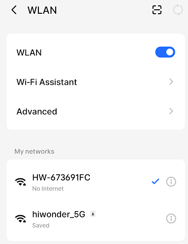

  1. Tap Go to connect device hotspots to switch to the Wi-Fi settings.
  1. In the Wi-Fi list, find the hotspot starting with HW, and connect to it using the password: hiwonder. After connecting, tap the Back button to return to the app.
  1. You will see that the app has started connecting to the robot.

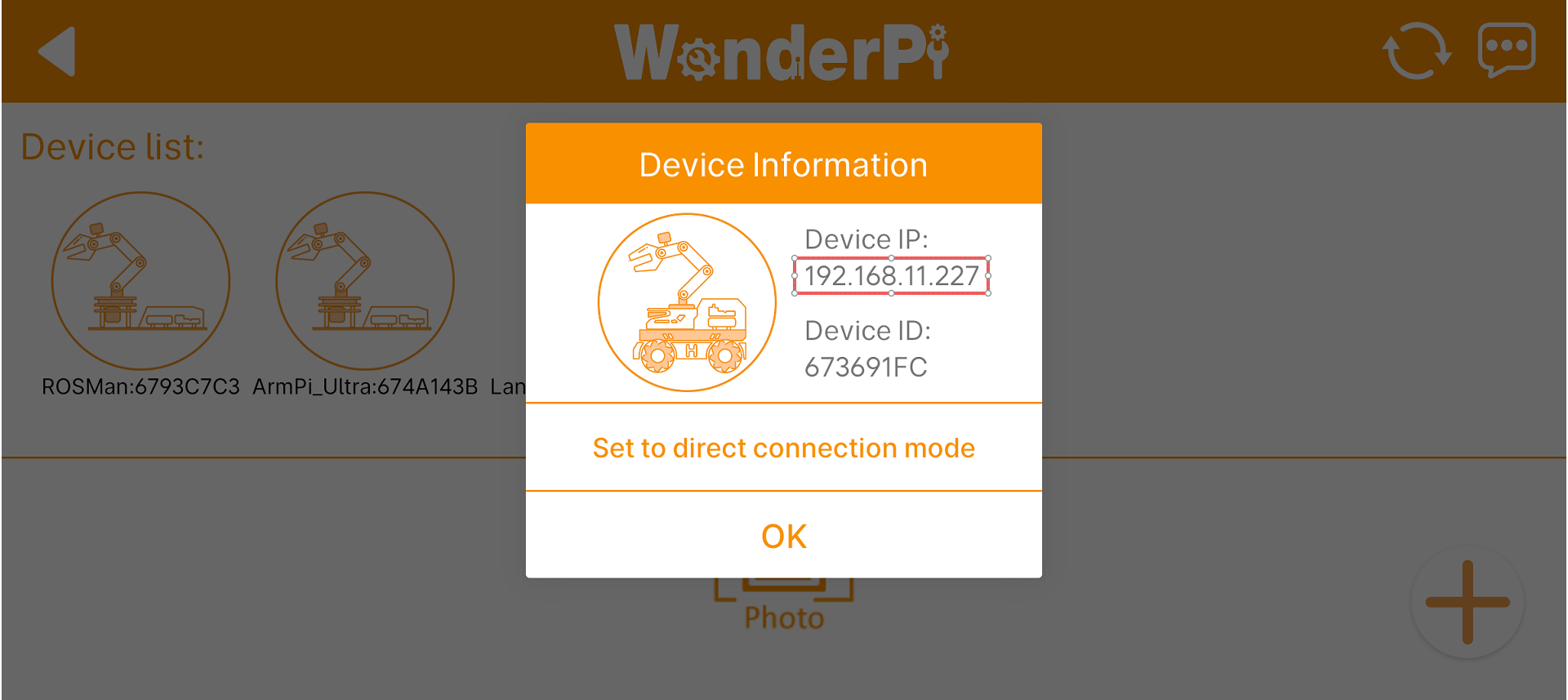

  1. After a few seconds, the robot’s icon and name will appear on the main screen. The LED1 indicator on the expansion board will stay on.

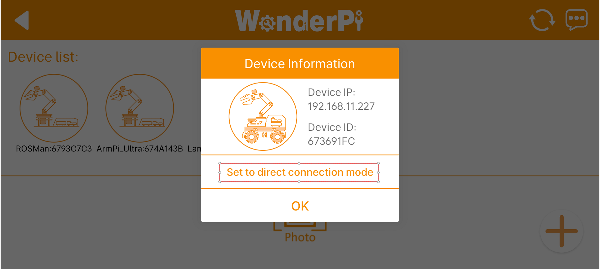

  1. Long-press the corresponding icon of your robot in the app to view its assigned IP address and Device ID.
  1. You can search for this IP in the remote desktop tool and establish a connection. For detailed instructions, refer to section 1.4 Development Environment Setup and Configuration.
  2. If you want to switch back to direct connection mode, long-press the robot icon and select Set to direct connection mode. The blue indicator light will start blinking, indicating that the switch was successful.

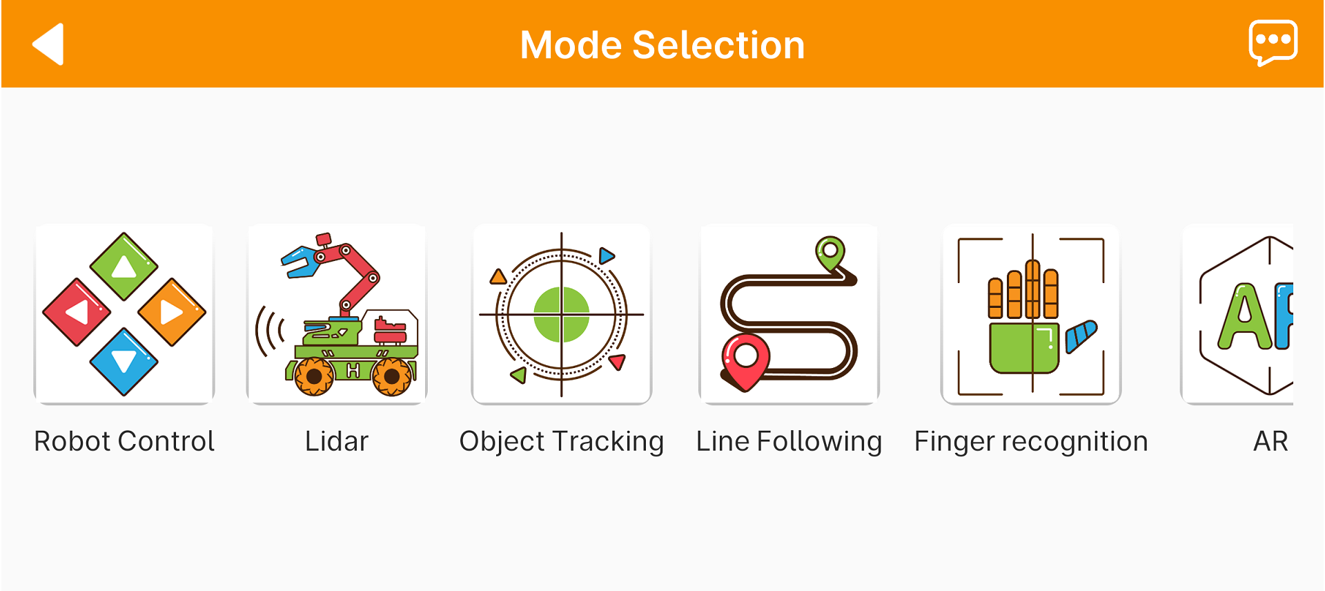

  • Overview of App Modes

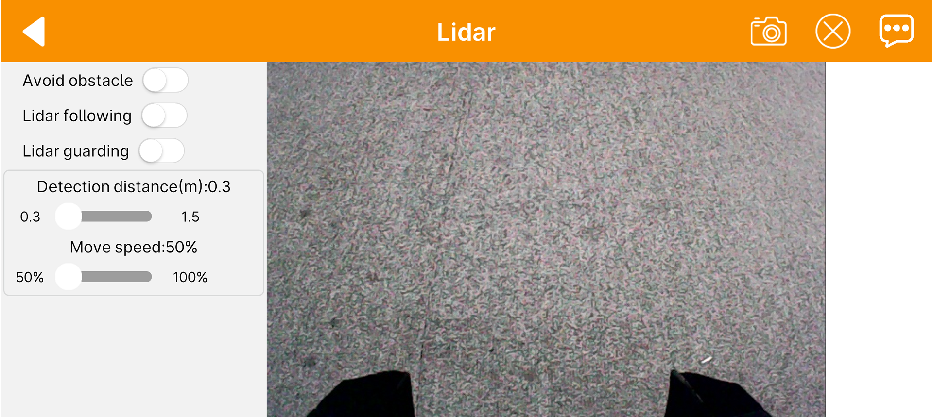

The app provides six modes, including Robot Control, Lidar, Object Tracking, Line Following, Finger Recognition, and AR.
The table below offers a detailed overview of each mode.
Icon Mode Description
Robot Control Control the robot's movement.
Lidar Includes three modes: obstacle avoidance, following, and sentry.

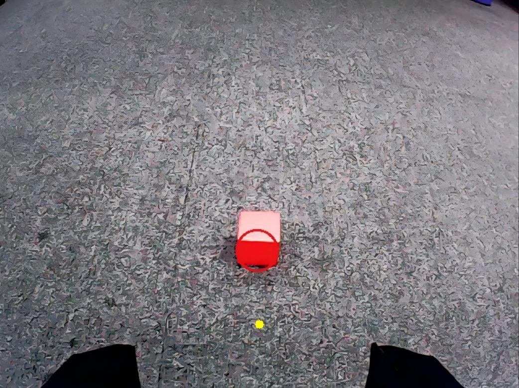

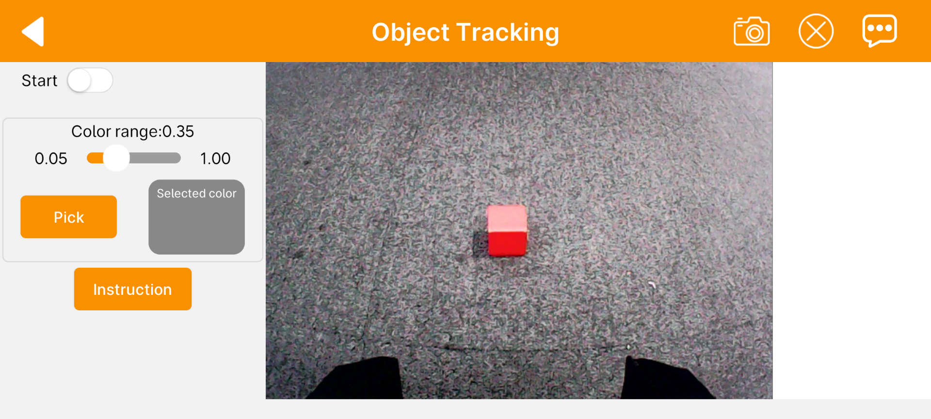

Object Tracking Select an object by color, and the robot will track it.
Line Following Set a line and define its color as the target. The robot follows the line.

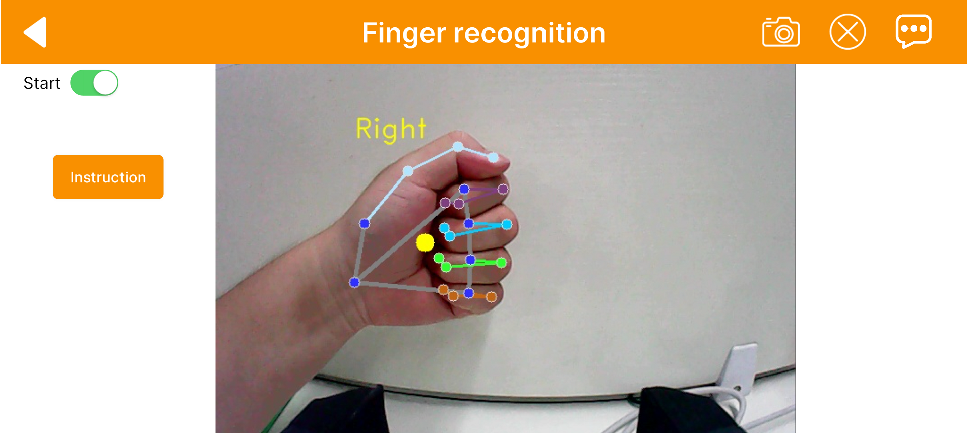

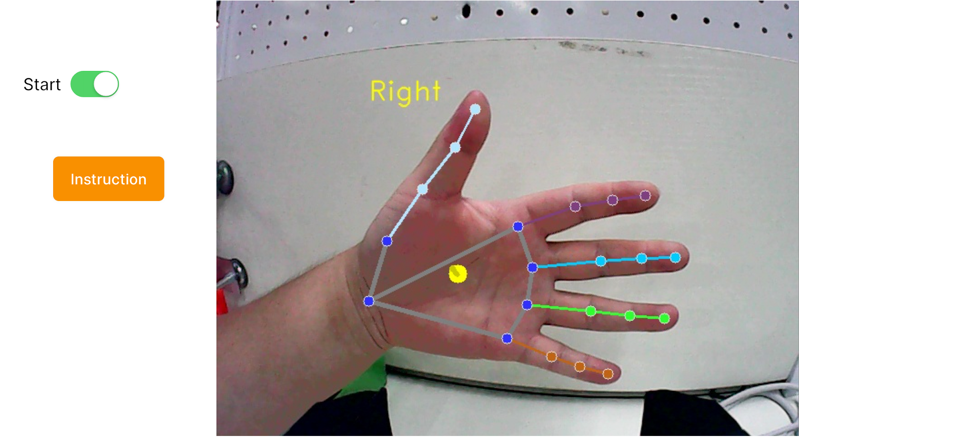

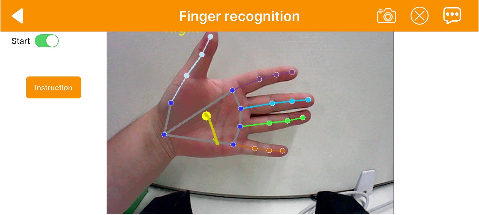

Finger Recognition Control the robot to move forward, backward, left/right turn, and strafing by tracing hand gestures. Strafing is only available with the Mecanum chassis version.

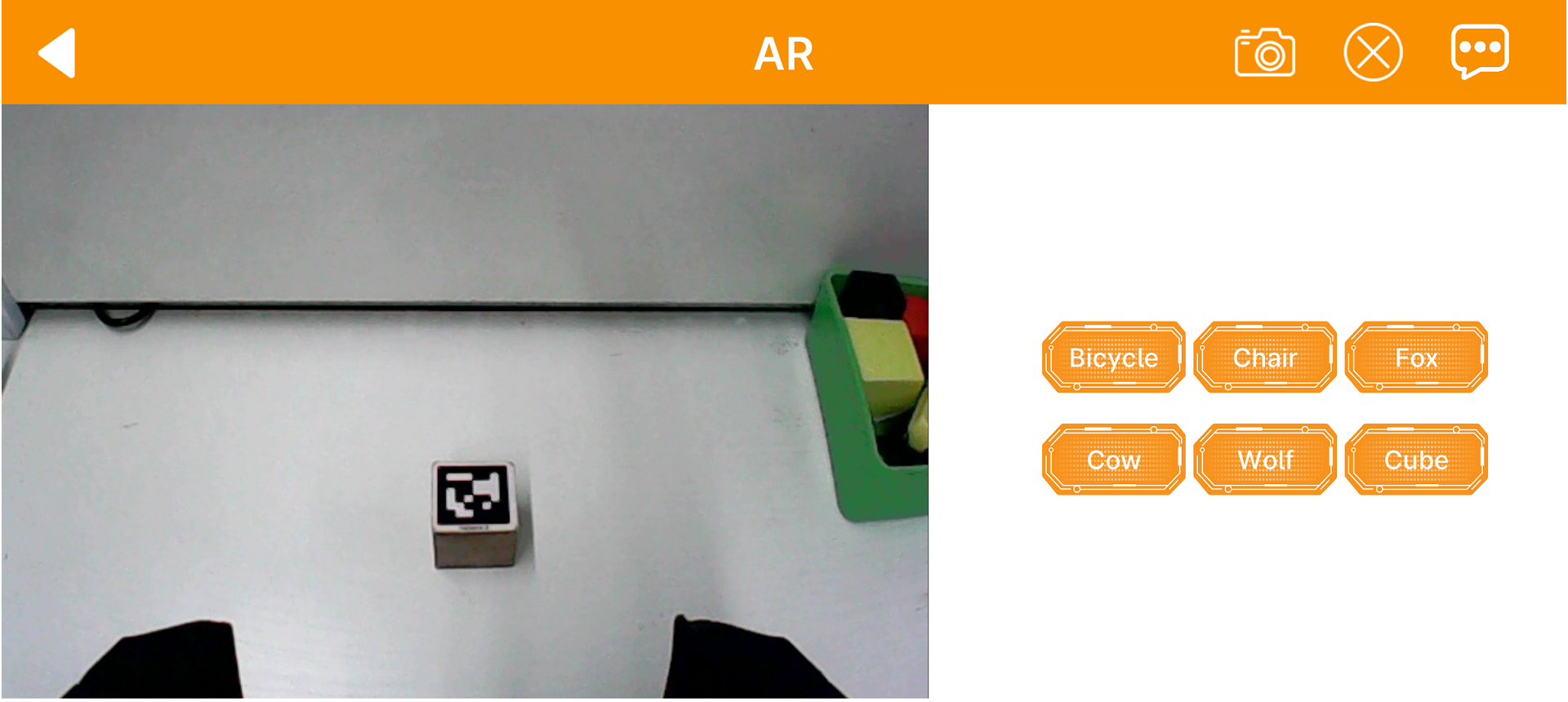

AR Display predefined 3D images on tags within the camera view.

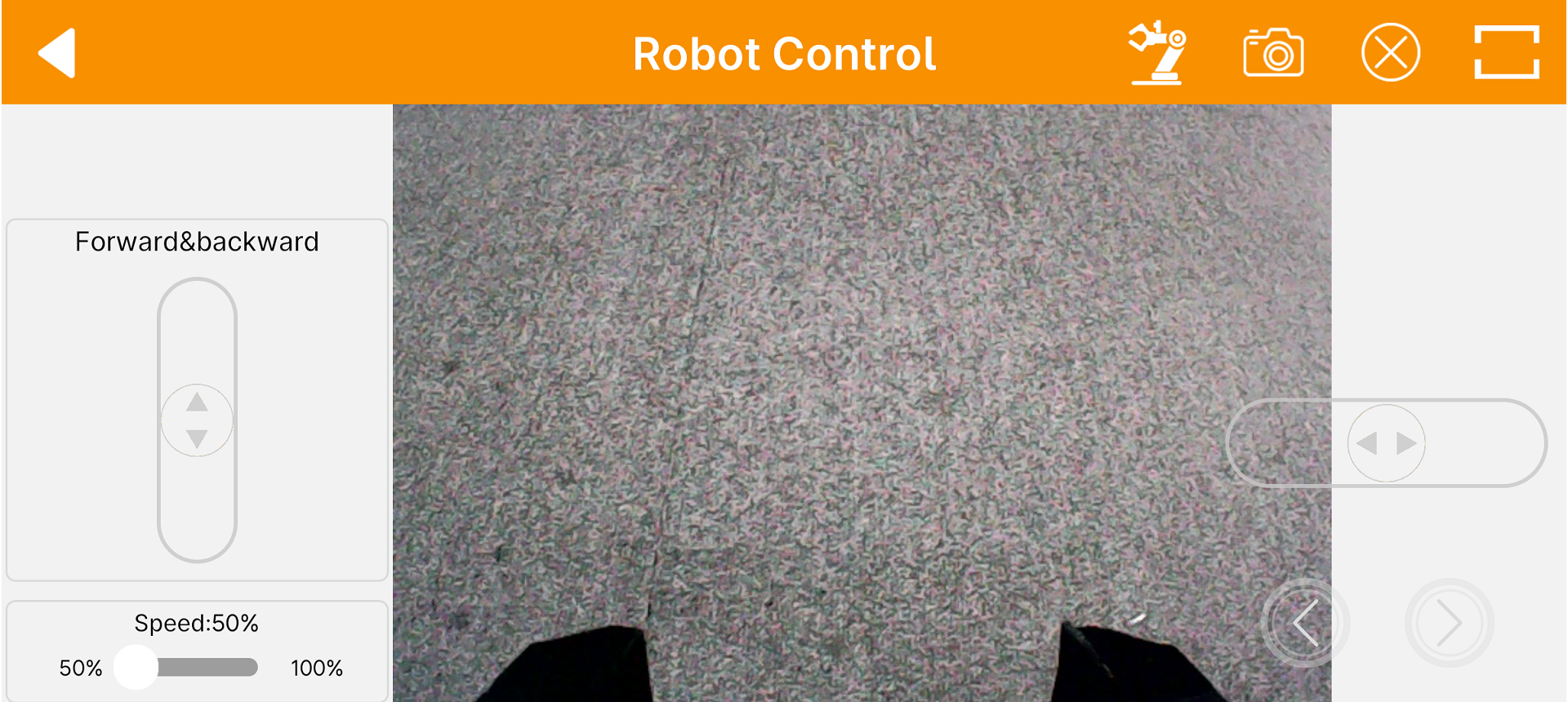

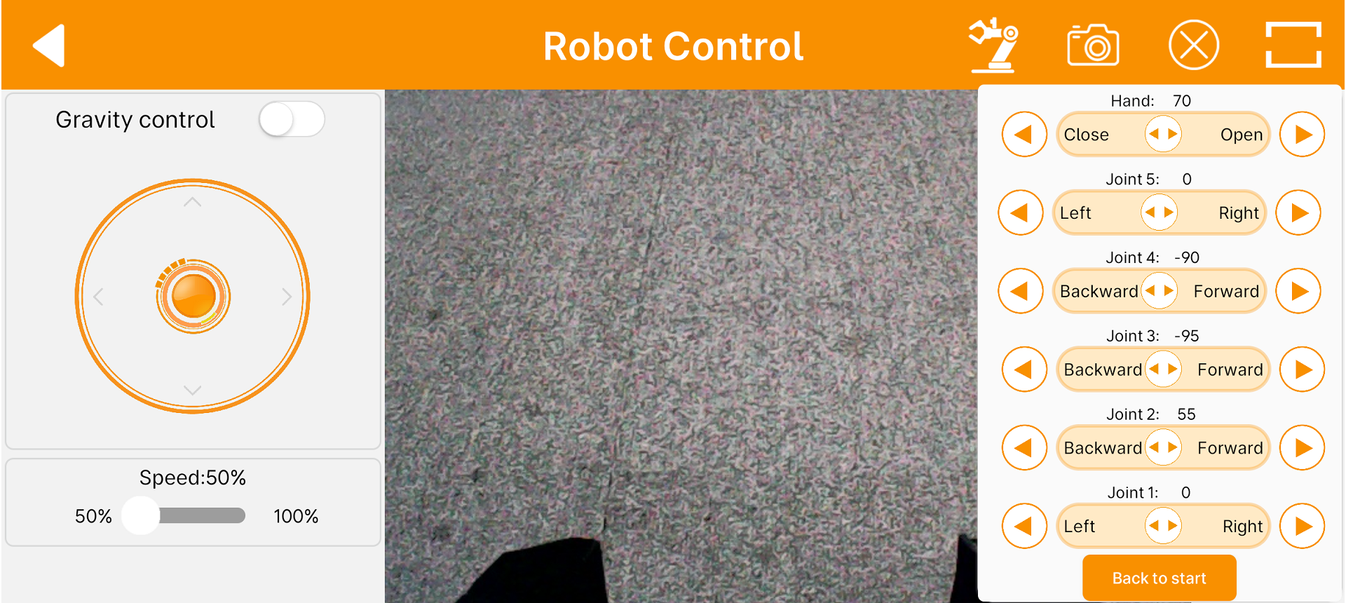

  • Robot Control

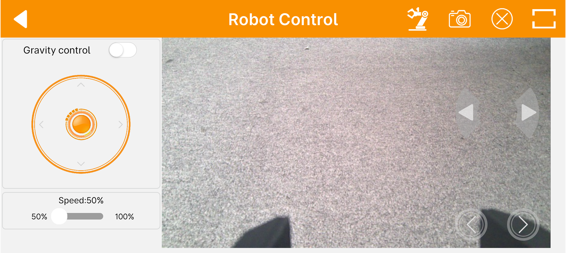

Tap Robot Control on the mode selection screen to enter the control interface. The interface layout differs slightly between the Mecanum/Tank versions and the Ackerman version. The Robot Control interface for Mecanum & Tracked versions is shown below:
  1. Left panel from top to bottom: Motion control via gravity sensor, forward/backward movement, and speed adjustment.
  2. Center panel: Live video feed, drag to adjust the pan-tilt angle.
  3. Right panel from top to bottom: Steering controls and pan-tilt rotation.
  4. Top menu bar from left to right: Robot arm control, screenshot, toggle navigation bar, full-screen mode, which is mainly used with a wireless controller.
The Robot Control interface for Ackerman version version is shown below:
  1. Left panel from top to bottom: Forward/backward movement and speed adjustment.

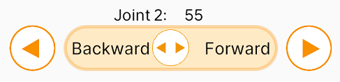

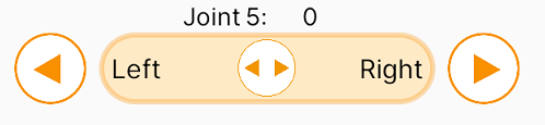

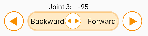

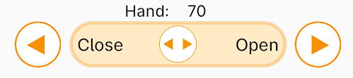

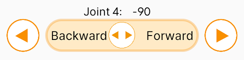

The interface to control the robot arm is shown in the image below:
Tap the robot arm control icon to open the control panel for each servo of the robot arm, then you can control the arm’s joints and adjust its movement posture.
Icon Function
Controls the gripper for picking up and holding objects.
Moves the wrist joint left and right.
Moves Joint 4 forward and backward.
Moves Joint 3 forward and backward.
Moves Joint 5 forward and backward.
Control the base servo of the robot arm to rotate it left or right.
Tap the full-screen icon to display the live video feed in full screen. This is especially useful when using a wireless controller to control the robot, as it allows you to monitor the real-time camera view.

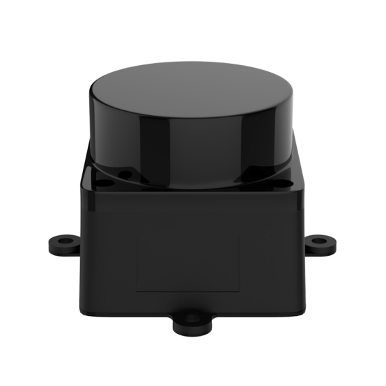

  • Lidar
  • Before stating the feature, ensure to place the robot on a spacious surface with enough room to move freely.
  • In LiDAR Obstacle Avoidance and LiDAR Following modes, the detection range is a 90° fan-shaped area in front of the robot.
  • The LiDAR Guard mode is not supported when using the Ackerman chassis.
1. Interface Overview
Tap Lidar on the mode selection screen to enter the control interface. The Lidar mode includes three features: Avoid obstacle, Lidar following, and Lidar guarding. This interface is divided into two sections:
(1) The left panel is for enabling or disabling the different features.
(2) The right panel displays the live video feed from the camera.
2. Function
Icon Function
Enable/disable the Avoid obstacle feature.
Enable/disable the Lidar following feature.
Enable/disable the Lidar guarding feature.
Display the current camera feed.
3. Operating Steps and Effects
(1) Avoid obstacle
The robot continuously moves forward. When an obstacle is detected, it automatically changes direction to avoid it.
(2) Lidar following
When an obstacle is detected, the robot adjusts its position to maintain a safe distance from the object.
(3) Lidar guarding
When an obstacle is detected, the robot turns to face the object.

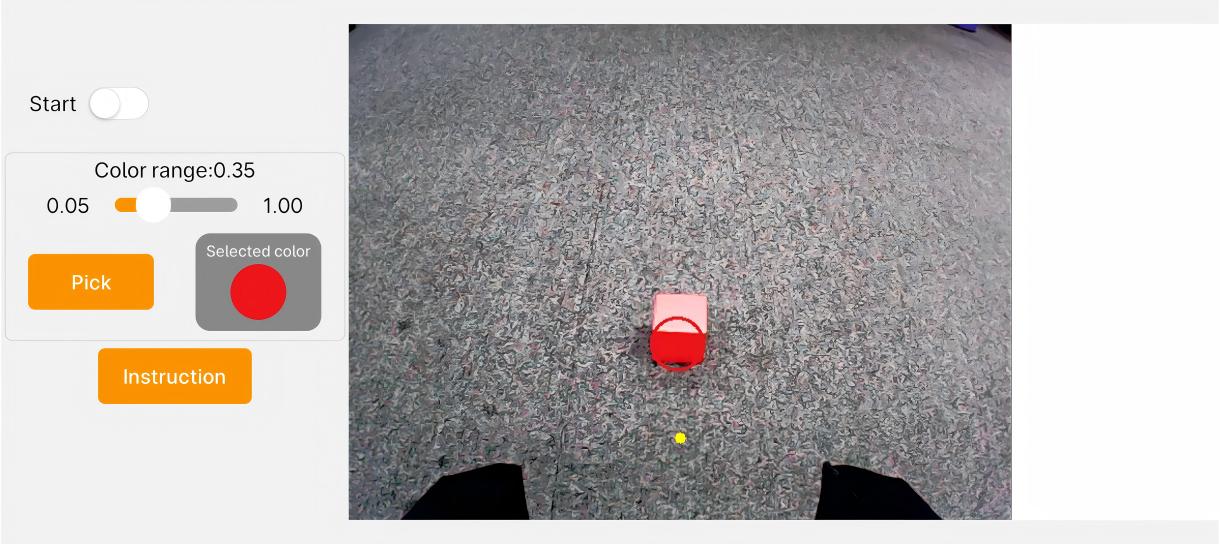

  • Object Tracking
  • Place the target object on the same surface as the robot and move it in a horizontal direction, which ensures a smoother tracking experience.
  • Choose an appropriate color range for target extraction. If the range is too wide, unwanted colors may be included. If the range is too narrow, the target may be lost. Also, avoid having objects with similar colors to the target in the camera’s view.
Tap Object Tracking on the mode selection screen to enter the control interface. This interface is divided into two sections:
(1) The left panel contains the mode switch and color extraction tools.
2. Function
Icon Function
Enabling and disabling the feature

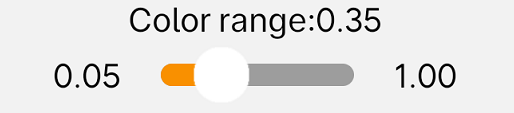

Adjust the color threshold range of 0.05–1.00.
Extract a color from a selected area in the video feed.
After tapping Pick, the button changes to OK, then tap it to confirm the extracted color.
Display the extracted color.
(1) Tap the Pick button, then drag the red circle in the video feed to the target object to select its color.
(2) Tap the OK button, and the selected color will be displayed in the Selected color area.
(3) Tap the Start button to activate the feature. Move the target object, and the robot will follow accordingly.

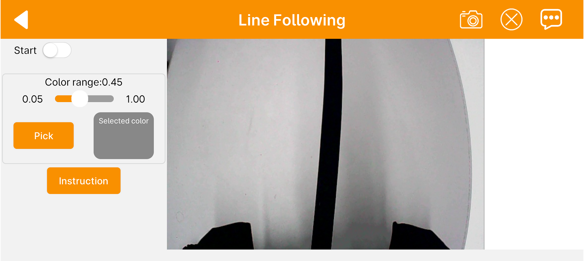

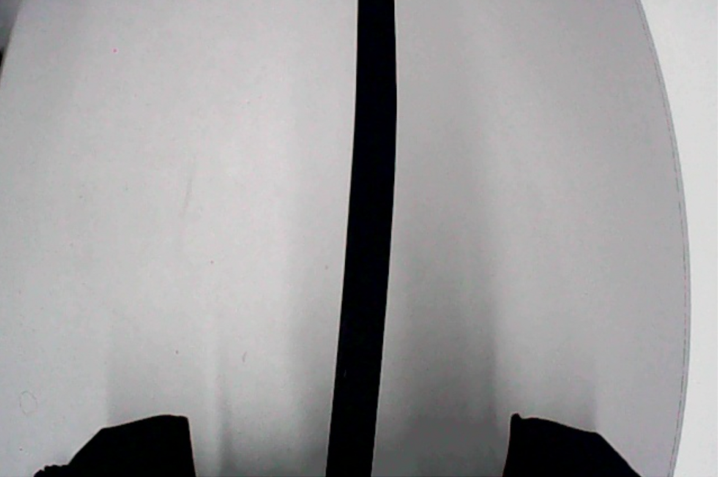

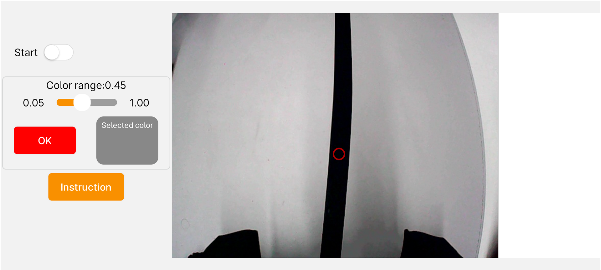

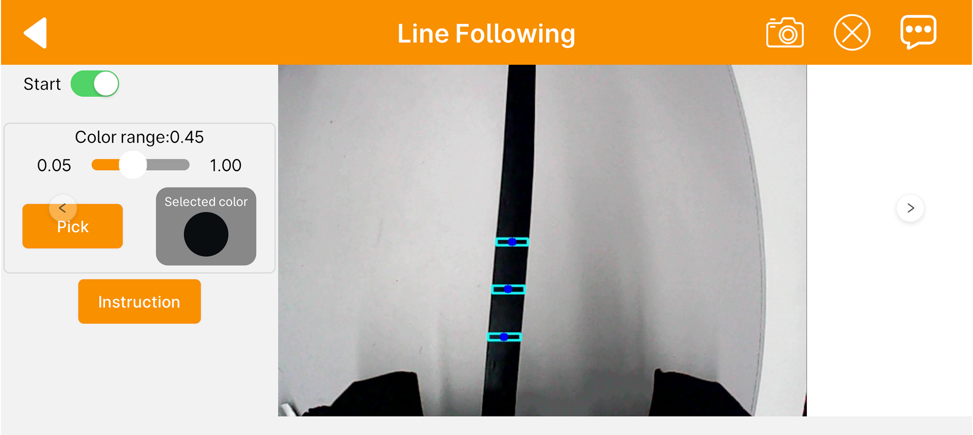

  • Line Following
  • Before starting this feature, lay out the tracking path with tape and place the robot on the track.
  • After the feature starts, please ensure there is no other object containing the recognition color except the target object within the camera view, otherwise the recognition result will be affected.
Tap Line Following on the mode selection screen to enter the control interface. This interface is divided into two sections:
2. Function
Icon Function
After tapping the Pick button, it changes to OK. Use it to confirm the extracted color.
(1) In this section, red tape is used as an example. After clicking the Pick button, drag the red circle in the live feed to the track to select its color.
(3) Tap Start to begin the feature, and the robot will follow the colored line automatically.

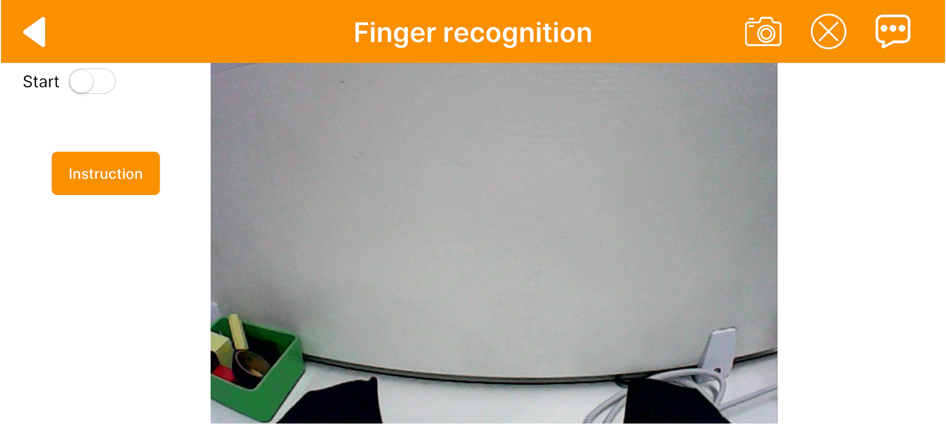

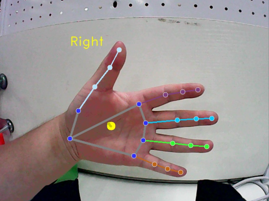

  • Finger Recognition
  • This feature only supports the right hand.
  • During recognition, make sure the entire palm is visible in the camera view.
  • Avoid moving your hand too quickly.
Tap Finger Recognition on the mode selection screen to enter the control interface. This interface is divided into two sections:
(1) The left side of the interface contains the feature switch along with gesture control instructions.
2. Function
Icon Function
Enable/disable Gesture Control
Display the real-time camera feed. Keep your hand open with the palm facing the camera to draw a trajectory. When you make a fist, the robot will turn right. Draw a trajectory in the forward, backward, left, or right direction, and the robot will move accordingly.

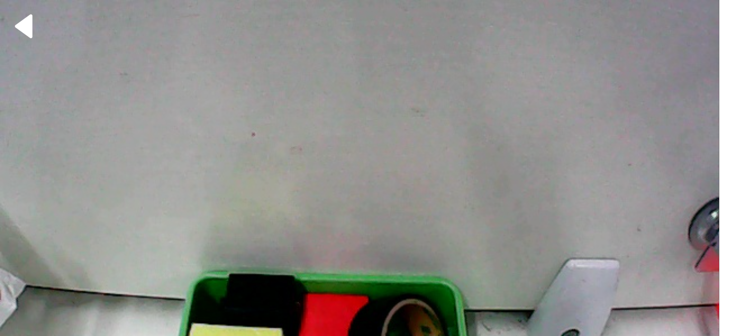

(1) Raise your right hand, make a fist, and place it at the center of the camera’s field of view, then open your fingers. When you hear a beep, move your hand to draw a trajectory.
(2) Move your open hand in one of the four directions for a short distance, including up, down, left, or right.
(3) Make a fist again. When you hear the beep, the robot will move in the direction of the drawn trajectory.

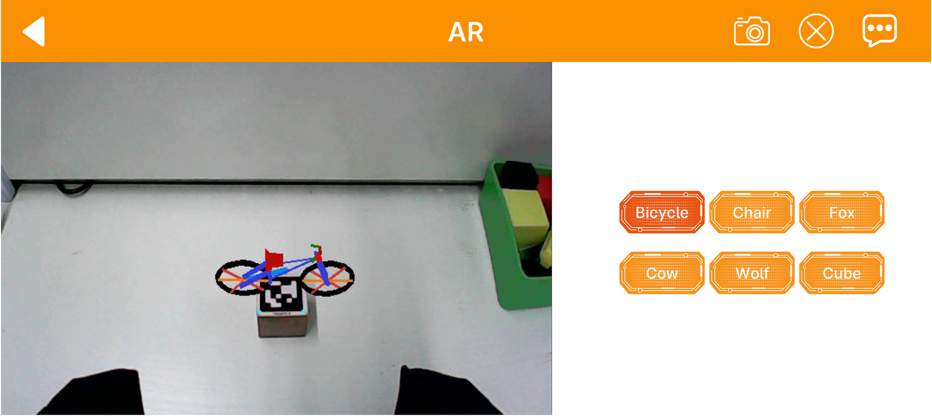

  • AR
Tap AR on the mode selection screen to enter the control interface. This interface is divided into two sections:
(1) The left panel displays the live video feed from the camera.
(2) The right panel allows selection of 3D models.
2. Function
Icon Function
Select a 3D model to display on the marker.
Place any of the provided tags within the camera’s view, then tap a 3D model from the selection panel, for example, Bicycle. The selected 3D model will appear over the tag in the live camera feed.

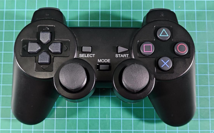

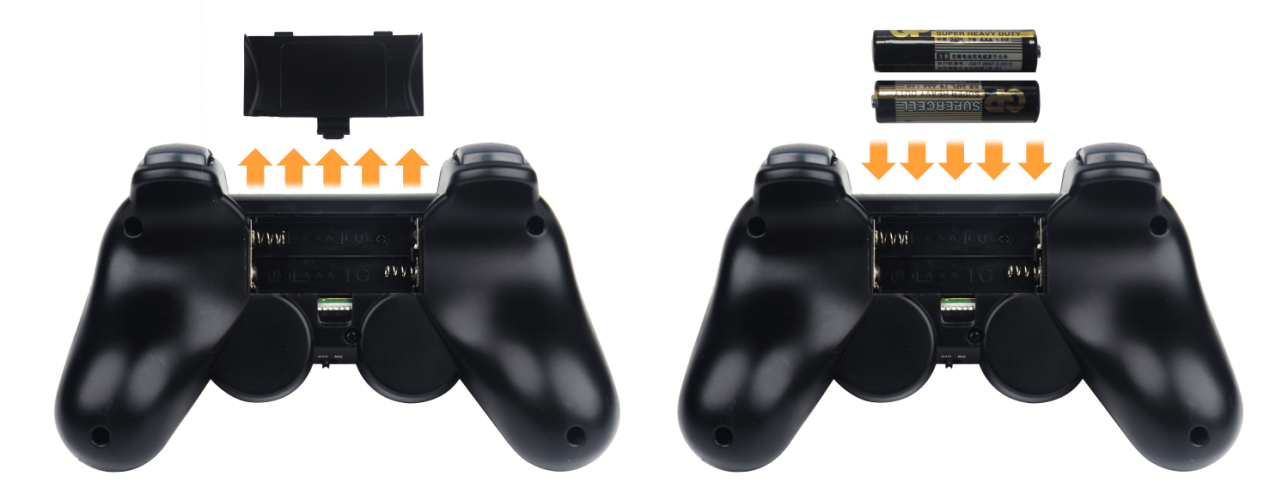

1.3.5 Wireless Controller Control
  • Notes

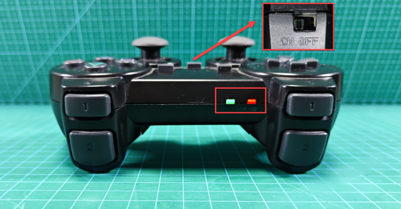

  1. Before powering on the device, make sure the wireless controller receiver is properly inserted. This can be ignored if the receiver was pre-inserted at the factory.
  2. Pay attention to battery polarity when placing the batteries.
  1. Each time the robot is powered on, the app auto-start service will launch which includes the wireless controller control service. If this service has not been closed, no additional actions are needed—simply connect and control.
  2. Since signals from wireless controller can interfere with each other, it is recommended not to use this function when multiple robots are in the same area, to avoid misconnection or unintended control.
  3. After turning on the wireless controller, if it does not connect to the robot within 30 seconds, or remains unused for 5 minutes after connection, it will enter sleep mode automatically. To wake up the wireless controller and exit sleep mode, press the “START” button.

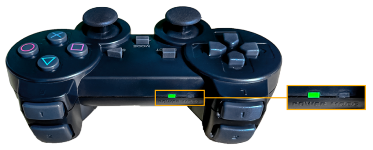

  • Device Connection
After the robot powers on, slide the wireless controller switch to the ON position. At this point, the red and green LED indicators on the wireless controller will start flashing simultaneously.
Wait a few seconds for the robot and wireless controller to pair automatically. Once pairing is successful, the green LED will remain solid while the red LED turns off.
  • Button Instruction
The following table describes the functions of the controller buttons and joysticks from the robot’s first-person perspective:
Lightly pushing the joysticks in any direction allows low-speed movement.
Button Function Description
START Stop and reset the robot. Press
Left joystick up Move forward. Push
Left joystick down Move backward. Push
Left joystick left Move left, only for Mecanum chassis. Push
Left joystick right Move right, only for Mecanum chassis. Push
Right joystick left Turn left, only controls front wheels on Ackerman chassis Push
Right Joystick Right Turn right, only controls front wheels on Ackerman chassis Push

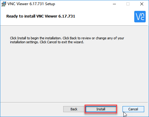

1.4.1 Remote Control Tool Introduction and Installation
In the following chapters, the VNC remote connection tool will be used to access the robot’s system desktop. This software allows you to control the robot remotely, providing a graphical interface similar to a standard Windows desktop.

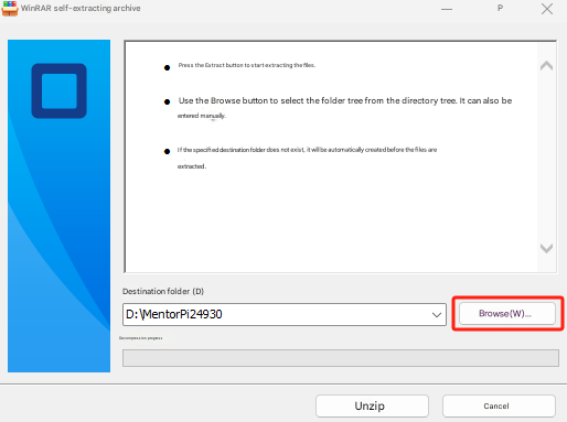

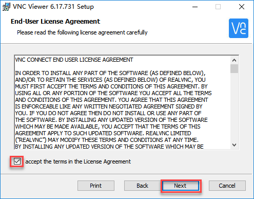

  1. Locate the tutorial folder at: Graphical Remote Desktop Access Tool to install it. Double-click the file VNC-Viewer-6.17.731-Windows in this folder. In the pop-up dialog, select English as the installation language and click OK.
  1. On the next screen, click Next.
  1. Agree to the license agreement, then click Next. Keep the default installation path, and click Next.
  1. Click Install to begin installation.
  1. Wait for the installation to complete. Once the installation complete screen appears, click Finish to complete the setup.
  1. After installation, launch VNC Viewer by clicking its desktop icon .
1.4.2 Connecting to the Remote Device
  • AP Mode Connection
AP Mode (Direct Connection): The controller creates a hotspot that your phone can connect to directly, but cannot access external networks.
  1. The robot is set to AP mode by default. After powering it on, it will generate a Wi-Fi hotspot starting with HW. On your computer, search for and connect to the hotspot as shown in the figure by entering the password hiwonder.
  1. Launch the VNC Viewer application that you installed earlier. In VNC Viewer, enter the Raspberry Pi IP address, for example: 192.168.149.1 in AP mode, and press Enter. If a warning about an unsecure connection appears, click Continue.
  1. Wait for the login window to appear, then follow the steps in order: enter the usernameenter the passwordcheck Remember passwordclick OK.
Username:pi
Password:raspberrypi
  1. Once connected, the Raspberry Pi remote desktop will be displayed as shown below.

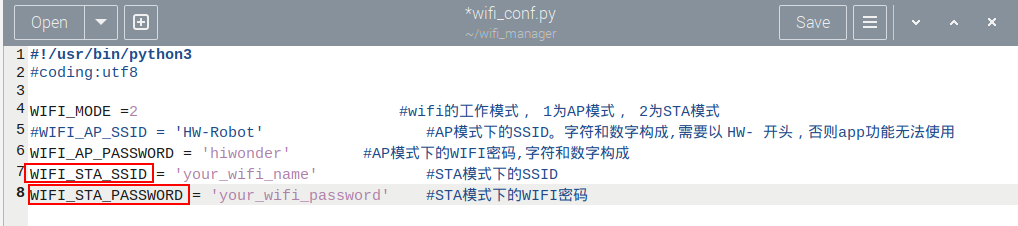

  • LAN Mode Connection
STA Mode (LAN Connection): The controller connects to a specified Wi-Fi network, and Internet access is available in this mode.
  • If you want to configure the robot to use LAN Mode via your smartphone, make sure to enable the location service on your phone beforehand.
  • You cannot switch to LAN mode through the system’s default network settings, as shown in the figure below. Since the Wi-Fi has been specially configured, you will need to follow the network setup instructions provided later in this document.
Configuration steps:

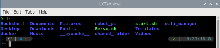

  1. Use the VNC remote connection tool to access the Raspberry Pi desktop.
  2. Click the icon in the system desktop to open a command-line window.
  3. Enter the following command and press Enter to go to the configuration directory.
cd wifi_manager
  1. Then enter the following command and press Enter to open the configuration file:
gedit wifi_conf.py
  1. In the editor, set the value of WIFI_MODE to 2. 1 means AP mode, where the robot creates its own Wi-Fi hotspot. 2 means LAN Mode, where the robot connects to your local network.
  1. Next, modify WIFI_STA_SSID and WIFI_STA_PASSWORD with your router’s Wi-Fi name and password. Make sure the values are enclosed in single quotes ‘’.
The robot also supports connecting to 5G Wi-Fi networks.
  1. Once finished, press Ctrl + S to save, then click the close button in the top-right corner.
  2. Back in the terminal, restart the Wi-Fi service with the following command:
After entering this command, the robot will no longer create a hotspot starting with “HW” and will automatically connect to the configured Wi-Fi network.
  1. Now, reconnect to the robot through your router’s Wi-Fi network.
  2. To switch back to AP mode, edit the same configuration file again, set WIFI_MODE = 1, and restart the Wi-Fi service as shown above.

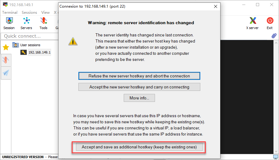

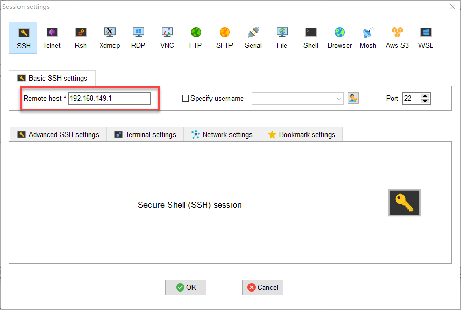

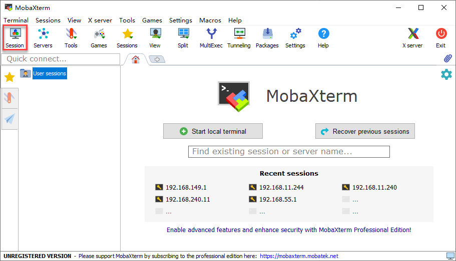

  • SSH Connection
Unlike VNC remote tools, MobaXterm does not display the robot’s desktop,but provides only a command-line interface. This allows for faster command execution and reduces the CPU and memory load compared to a full VNC session.
(1) Locate the installer in the folder: SSH Remote Client, and open the installer and follow the prompts to complete a one-click installation.
(2) Connect the Raspberry Pi 5 to the network by following the sections AP Mode Connection or LAN Mode Connection in this manual to get the corresponding IP address.

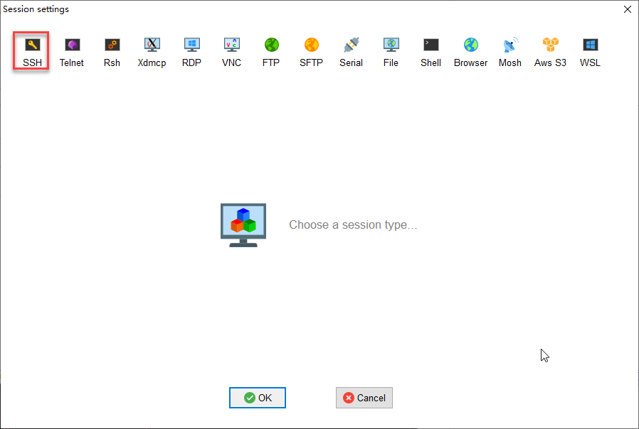

1. Creating a New Session and Connecting
Taking the AP mode as an example, the same steps also apply to LAN mode, but you need to replace the IP address accordingly.
(1) On the main interface, click Session in the upper-right corner to create a new session. In the session window, enter the Raspberry Pi 5 controller’s recorded IP address 192.168.149.1 and then click OK.
If a window like the one below appears, click the third option.
(2) You will be prompted to enter your username and password. The default credentials for a fresh Raspberry Pi installation are:
Username: pi
Password: raspberrypi
If you’ve configured your own credentials, use those instead. Note: In Linux systems, when you type the password, no characters will be displayed on the screen for security reasons.
(3) If the password is correct, you’ll successfully log in and see the system interface as shown below:
The LanderPi series robots support multiple chassis configurations: Mecanum chassis, Ackerman chassis, and Tank chassis. To switch between different robot configurations, follow these steps:
  1. Connect to the robot using the VNC remote desktop tool. Refer to section 1.4.2 Connecting to the Remote Device for detailed instructions.
  2. Double-click the Tool icon to launch the robot system configuration tool, then click Execute.
  1. In the interface, select the desired chassis type from the Robot Type option, as highlighted in the figure below:
(1) LanderPi_Mecanum – Mecanum chassis
(2) LanderPi_Tank – Tank chassis
(3) LanderPi_Acker – Ackerman chassis
  1. After selection, click Save > Apply > Quit to activate the new chassis configuration.
  1. Wait until the robot’s buzzer emits a short beep, indicating the chassis switch has been completed. Open the terminal again to view the ROS2 environment.

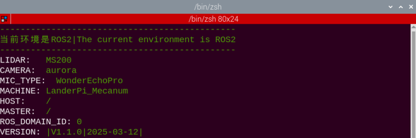

1.4.4 System Command-Line Terminals
There are two types of command-line terminals in the system:
ROS2 Environment Terminal: This terminal provides access to robot-related features and functions. It will be frequently used in the following lessons. The following figure illustrates the icon styles.
System Terminal: This is the default terminal of the operating system, containing system-level files of the robot. It can be found on the taskbar at the top of the system interface, which is rarely used. See the red box in the image.
In the upcoming lessons, carefully follow the instructions regarding which terminal to use for each step. Using the wrong terminal may prevent certain robot functions from starting properly.

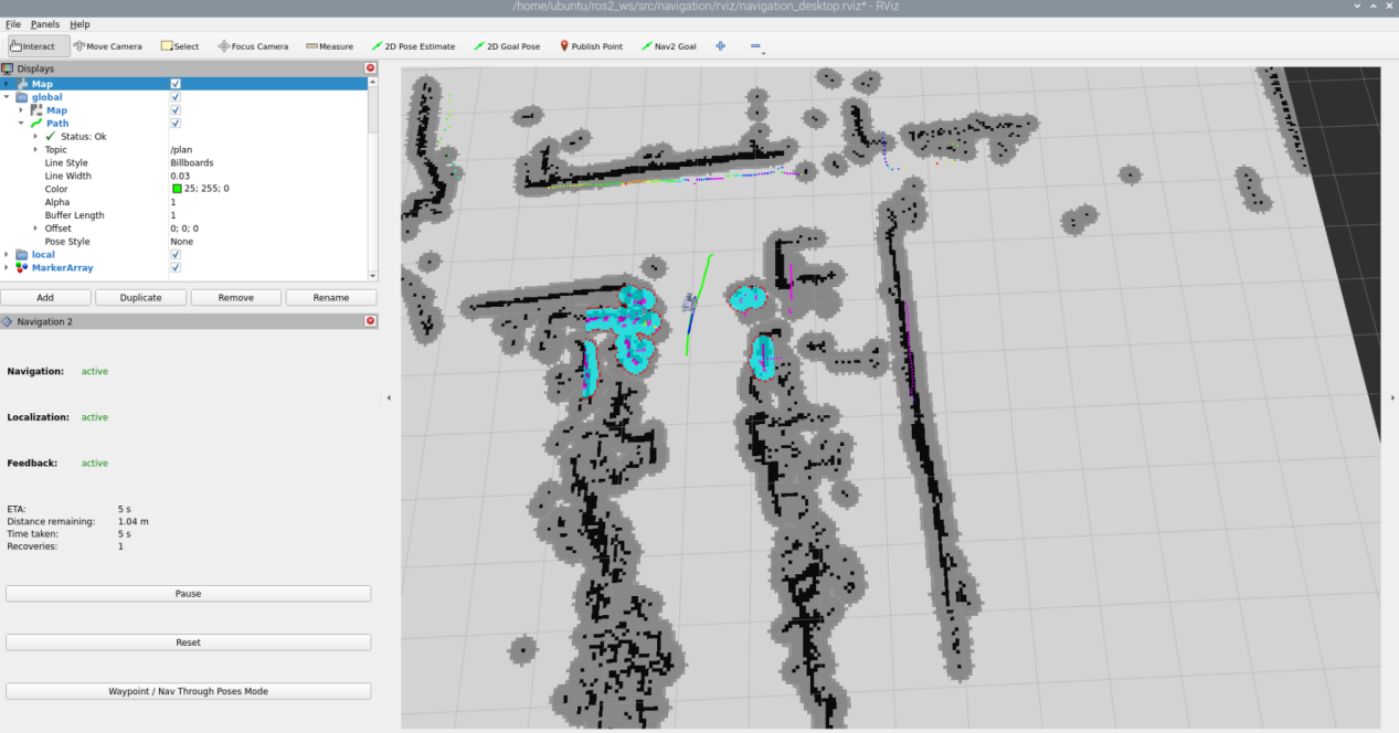

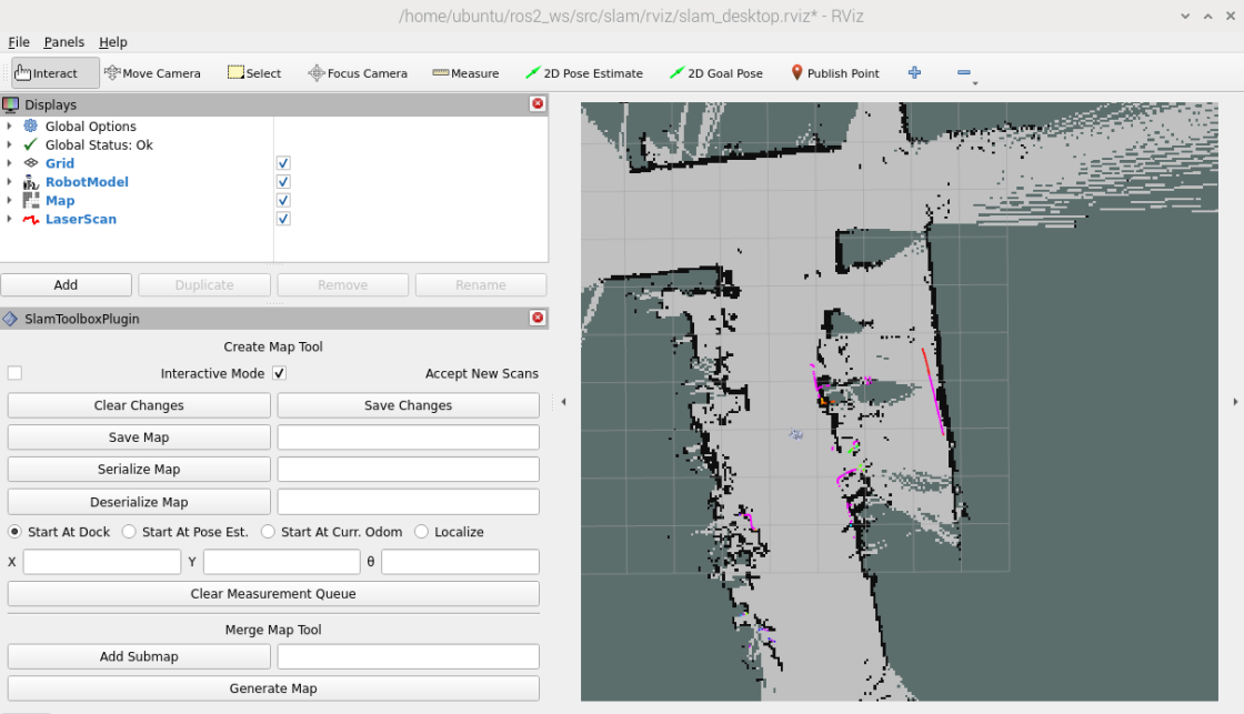

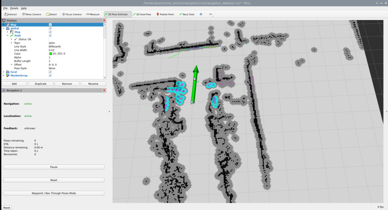

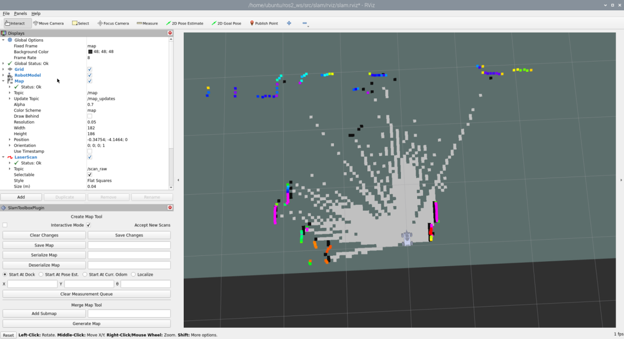

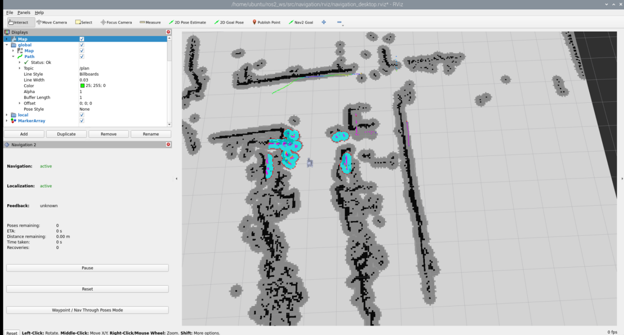

1.5 Mapping and Navigation
1.5.1 Mapping
This section provides a quick way to experience the robot’s mapping and navigation features.
The available mapping methods are quick mapping and manual mapping. Manual mapping requires controlling the robot using either a wireless controller or a keyboard. For a single-robot environment, using a controller is recommended for convenience. In a multi-robot environment, it is recommended to use a keyboard to avoid signal interference. Since signals from wireless controller can interfere with each other, it is recommended not to use this function when multiple robots are in the same area, to avoid misconnection or unintended control.
After mapping is completed, the generated map will be saved. You can then enable the autonomous navigation feature to test navigation using the created map. Please note that the autonomous navigation feature will always use the most recently created map. Any newly created map will overwrite the previous map, regardless of the mapping method used.
Manual mapping uses the slam_toolbox algorithm. The Slam Toolbox package combines data from the Lidar using LaserScan messages and applies a TF transformation from the odom frame to the base_link frame, creating a 2D spatial map. This package allows full serialization of SLAM map data and pose graphs, enabling reloading for continuous mapping, localization, merging, or other operations. Slam Toolbox can operate in both synchronous mode to process all valid sensor measurements even if delayed, and asynchronous mode to process valid sensor measurements whenever possible.
For more details on the mapping algorithm, starting mapping and navigation via commands, and saving multiple maps, refer to the file 6. Mapping & Navigation Course -> 6.1 Mapping Instruction.
The wireless controller receiver is pre-installed on the robot’s STM32 controller at the factory for signal reception.
For instructions on using the controller, see section 1.3.5 Wireless Controller Control, and details will not be repeated here.

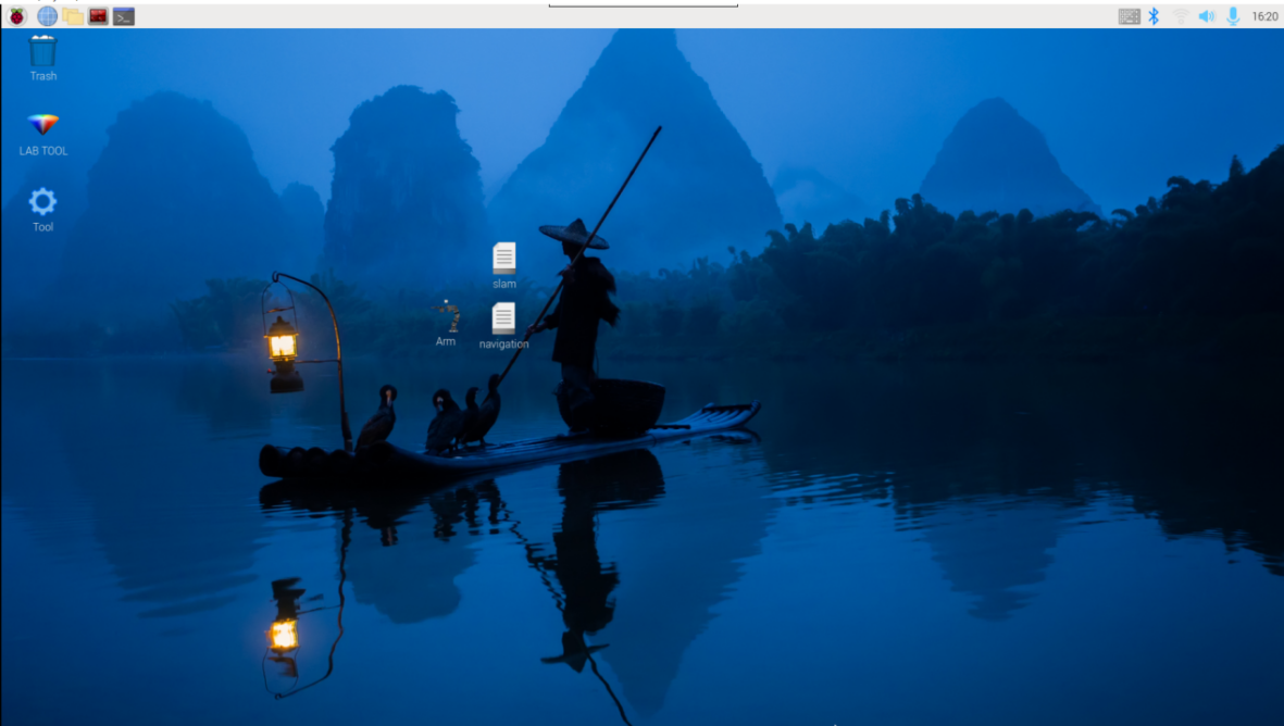

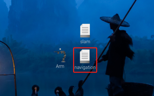

After the robot is powered on, the system desktop icons correspond to the following functions:
Icon Function
Manual Mapping
Quick Mapping
This mode requires a pre-prepared enclosed space on a flat surface. If obstacles are placed, their height must exceed the Lidar’s horizontal level.

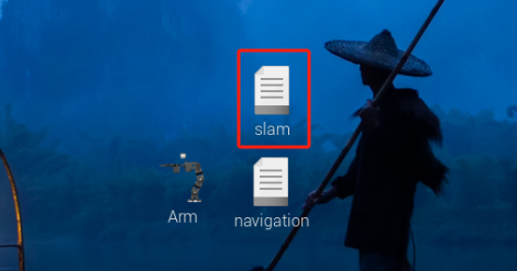

  1. Place the robot in the area where mapping will take place.

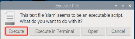

  2. Double-click the manual mapping (SLAM) icon on the desktop.
  1. Click Execute to start the program.
  1. Multiple terminals will launch and run automatically, so it might take some time for the interface to fully load.
  1. When the display interface appears, the system has started successfully.
  1. You can now control the robot for mapping using the wireless controller. Function descriptions for each button are listed below:
Keep the controller within a reasonable distance to avoid disconnection.
Button/Joystick Operation Function
START Press Exit sleep mode.
Left joystick Push forward or backward. Move the robot forward or backward.
Push left or right Move the robot left or right, only for Mecanum chassis.
Right joystick Push left Turn the robot left.

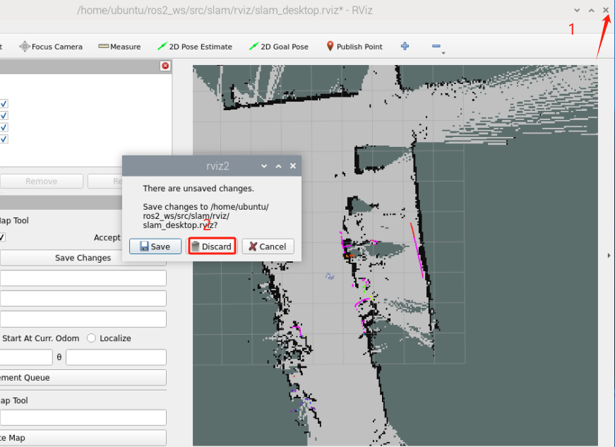

  1. The constructed map will appear as shown below.
  1. Click the Save Map button on the left to save the generated map.
  1. Exit the rviz interface in the order shown below.
  1. Finally, close all open software windows and terminals as highlighted in the red box.

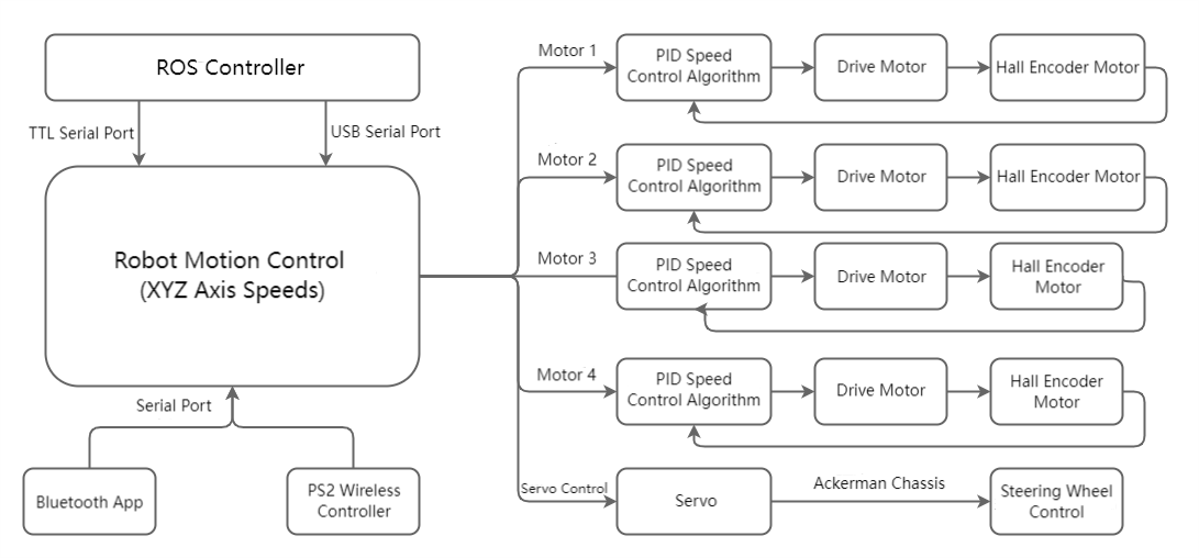

1.7.2 Control Process
The robot supports multiple control methods, all based on adjusting the robot’s target velocity. The target velocity is processed through inverse kinematics to calculate the desired motor speeds, which serve as inputs to the motor PID controllers. After PID computation, PWM control signals are output via the STM32 timers to the motor drivers. The motor drivers then control the motor rotation, while encoders collect the real-time motor speed and feed it back to the PID controllers, forming a closed-loop speed control system. The STM32 motor control flow for the robot is shown below.
Different robot types have variations. The robots with Mecanum chassis require four motors, while the robots with Tank chassis and Ackerman chassis require two motors, with Ackerman front wheels also using a servo for steering.

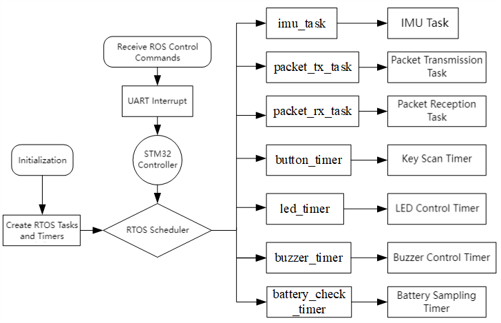

1.7.3 Program Framework
The low-level firmware is built on FreeRTOS. Unlike interrupt-driven systems, tasks in RTOS are executed in a time-sliced manner, with higher-priority tasks running before lower-priority ones, while interrupts always have higher priority than RTOS tasks. Robot task allocation is as follows:
Robot_Task: Main robot task responsible for overall control, kinematics processing, IMU data collection, and data transmission. Miscellaneous Task: Handles lower-frequency operations such as battery management, IMU calibration, and buzzer control.

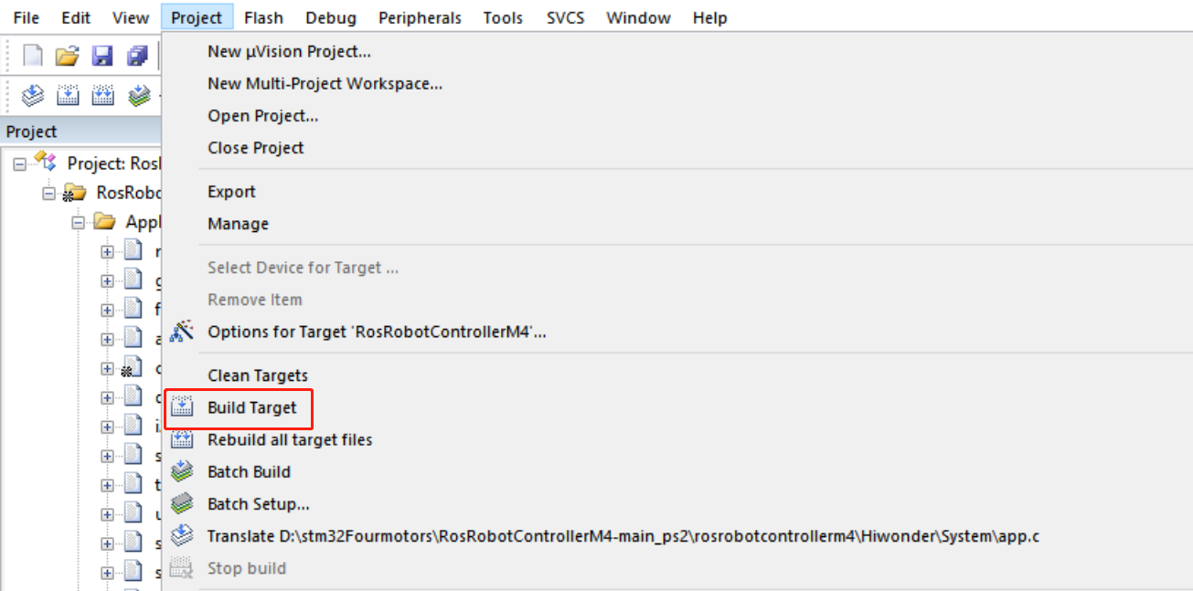

1.7.5 Project Compilation
The STM32 controller installed on the robot requires the corresponding hex firmware to operate properly. This firmware is preloaded before the robot leaves the factory, so the following steps are provided for informational purposes.
The compiler generates target files based on the processor architecture and instruction set. Additionally, the compiler can optimize the code to produce a more efficient and stable executable. The compilation process is as follows:

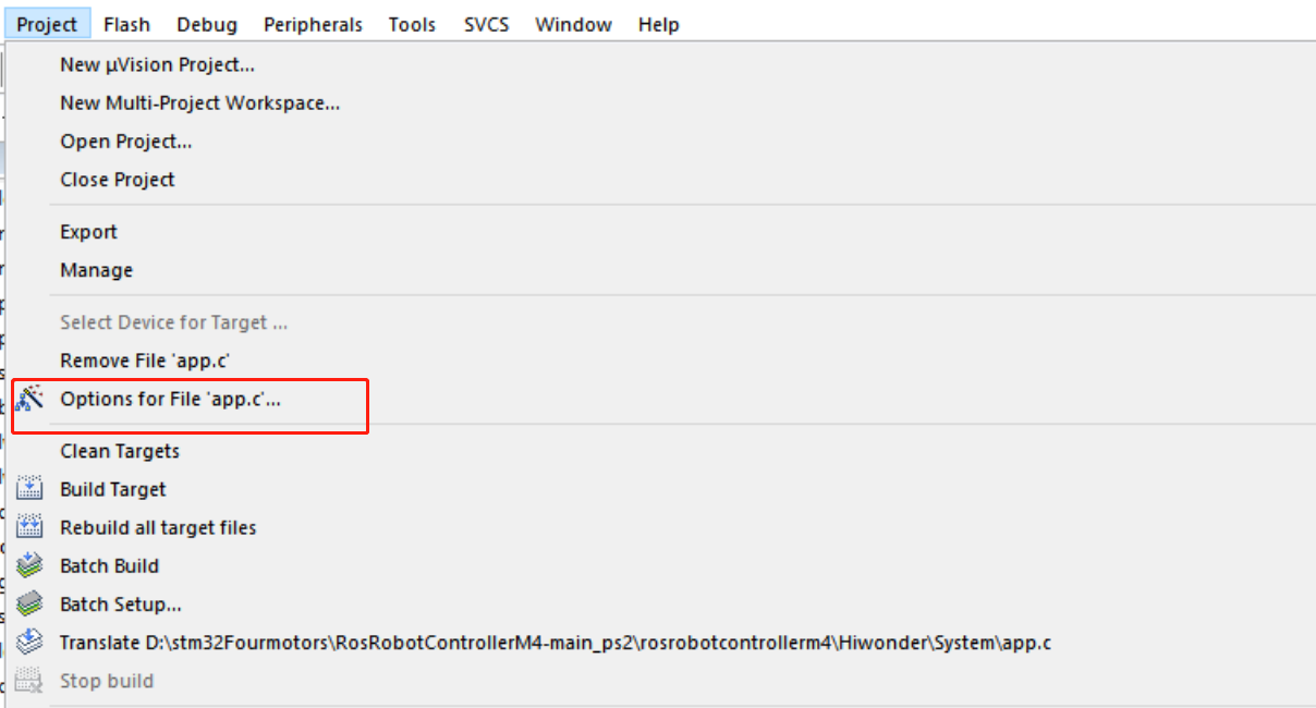

Open Keil5 and configure the hex file generation settings:
  1. In the menu bar, click Project, then select Options for File ‘app.c’.
  1. Click the Output tab, check the three options shown in red, and click OK.
  1. In the menu bar, click Project and select Build Target from the dropdown to compile the project.
Alternatively, click the build icon on the toolbar to start compilation.
Once compilation completes successfully, the Build Output window at the bottom of the interface will display a success message.
If the Build Output window shows Error(s) after compilation, double-click the error to jump to the corresponding line, fix the issue, and recompile. Warning(s) can be ignored.

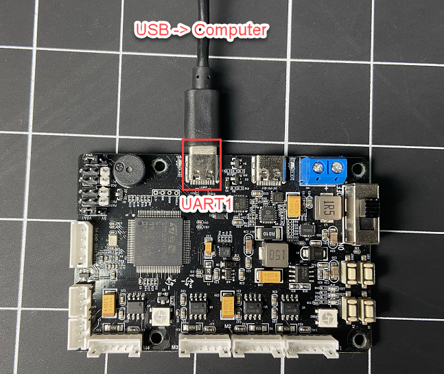

  1. Use a Typc-C cable to connect your computer to STM32 controller.
  • Programming Steps

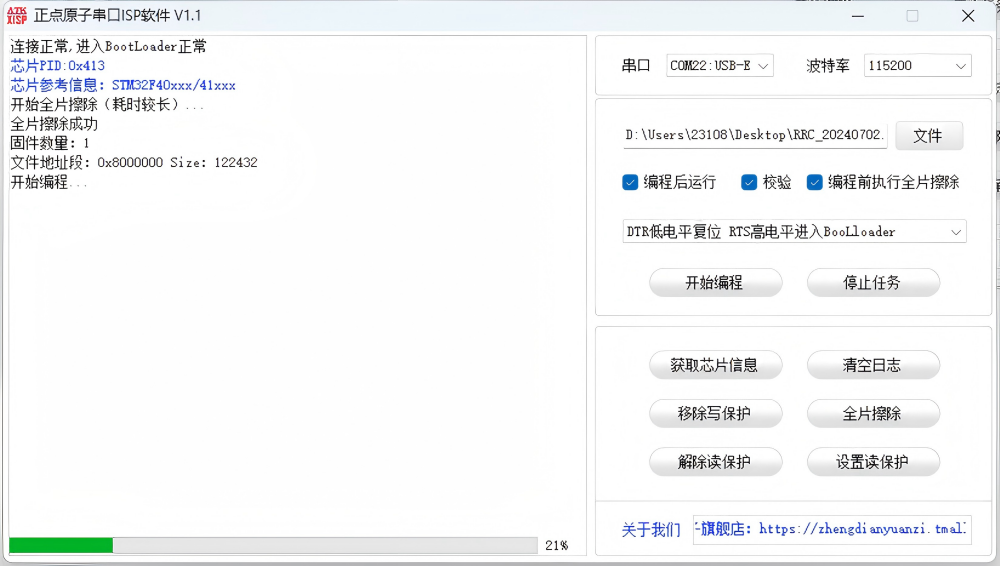

The following steps illustrate the procedure, using the program RosRobotControllerM4-ros as an example:
  1. Hardware Connection
Connect the Type-C cable to the STM32 controller’s Type-C port on UART1, which is marked in red in the figure, and to the computer’s USB port.

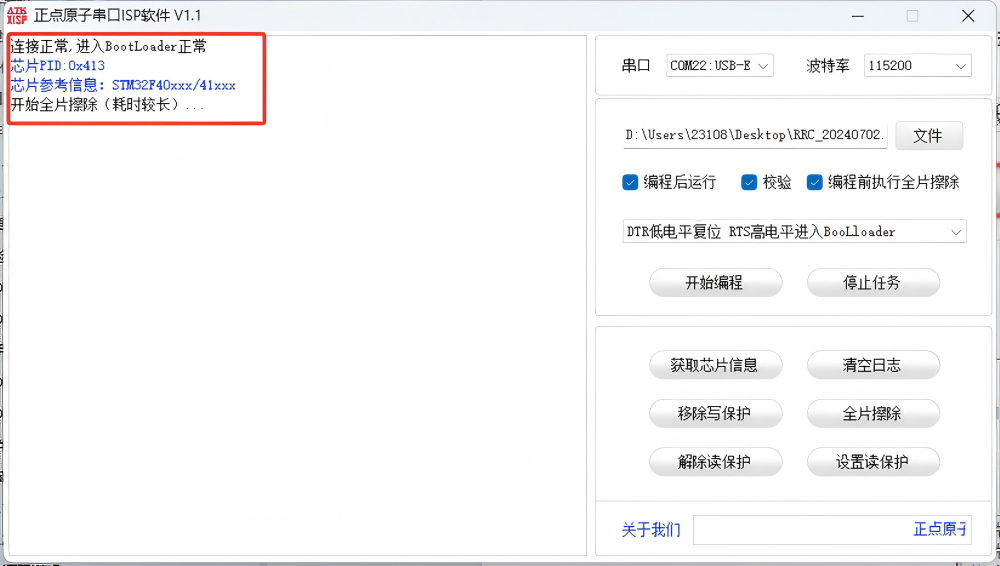

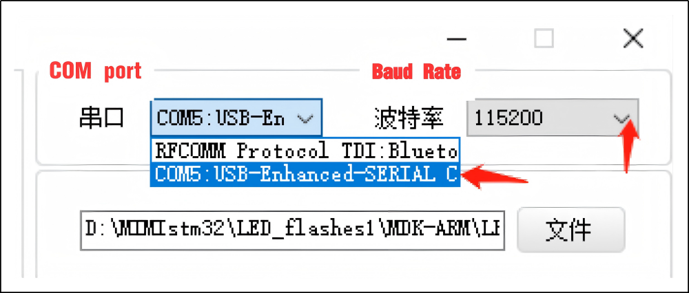

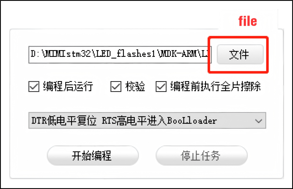

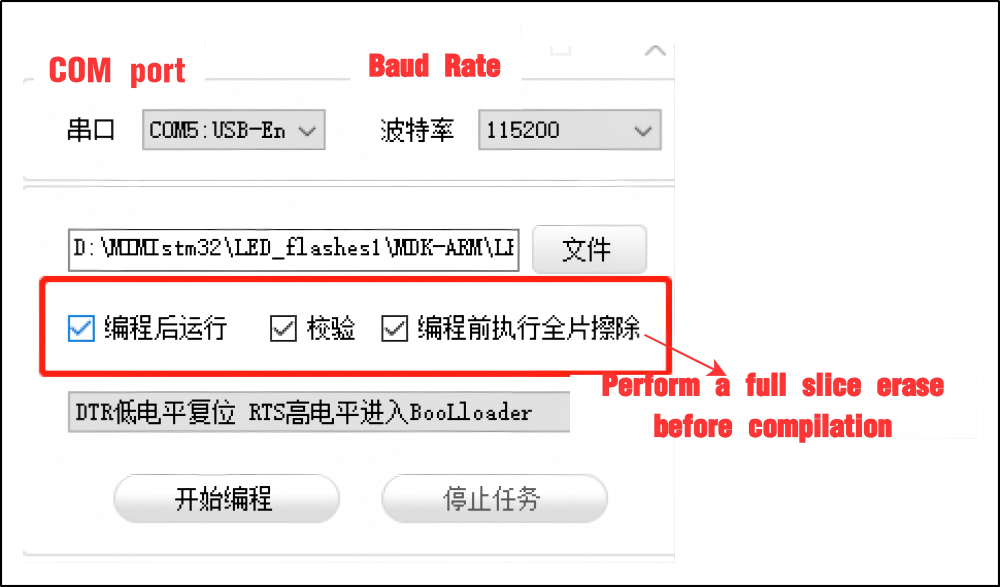

  1. Basic Settings
Open the ATK-XISP software, select the correct serial port in the software, for example here it is recognized as COM22 starting with USB, and then set the baud rate to 115200.
In the software interface, check the options: Run After Programming, Verify, and Full Chip Erase Before Programming.
Select DTR Low Reset, RTS High Enter BootLoader.

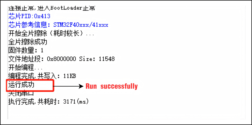

  1. Firmware Download
In ATK-XISP, click the button in the red frame to select the hex file to flash.
Click Start Programming to write the hex file to the STM32 controller.
The process is flashing.
Once complete, a confirmation message will appear in the sidebar as shown in the image.
The STM32 controller is preloaded with firmware at the factory. If needed, you can flash the provided file RosRobotControllerLite20250722.hex in source code.

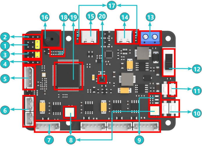

The front panel layout of the controller is shown in the figure below:
No. Function
(1) First set of PWM servo ports x 2: for controlling high-current, high-torque servos.
(2) First PWM servo power selection pins: use jumper to choose between main power and 5V for servo supply.
(3) Second set of PWM servo ports x 2: for controlling high-current, high-torque servos.
(4) Second PWM servo power selection pins: use jumper to choose between main power and 5V for servo supply.
(5) I2C expansion port: for modules with I2C communication.
(6) Bus servo ports x 2: for controlling robot arm movement with bus servos.
(7) Four motor encoder ports x 4: can drive up to four motors simultaneously. The wiring depends on robot type, please refer to corresponding tutorials.
(8) RGB LEDs x 2: programmable color lighting.
(9) User indicator LED: customizable LED.
(10) User buttons x 2: for custom functions or combined key operations.
(11) Reset button: resets the controller.

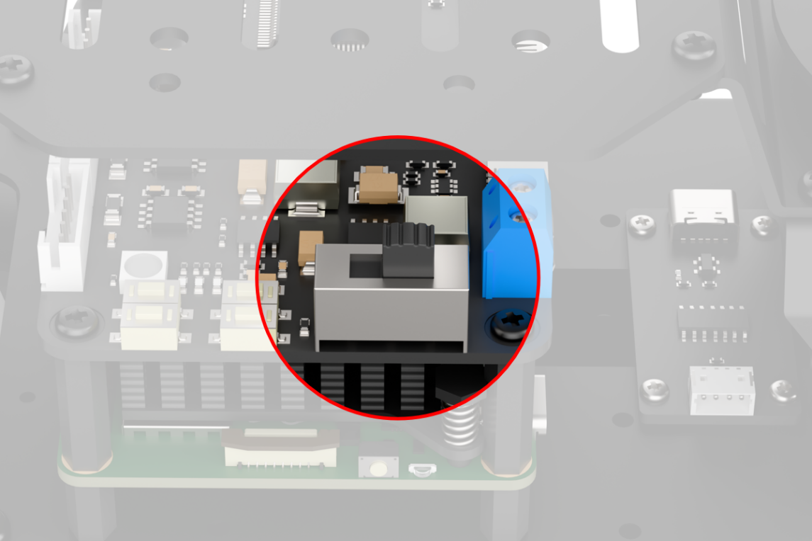

(12) Power switch: main power switch for the controller.
(13) Power input: DC 5V to 12.6V, supports both battery and external power supply.
(14) 5V 5A output: dedicated power supply for Raspberry Pi, Jetson Nano, or similar controllers.
(15) USB serial port 1 / firmware download: for program uploading or serial communication.
(16) Buzzer: for user alerts or notifications.
(17) On-board power indicator LED: shows if voltages are normal.
(18) GPIO expansion and SWD debug port: for external modules and debugging.

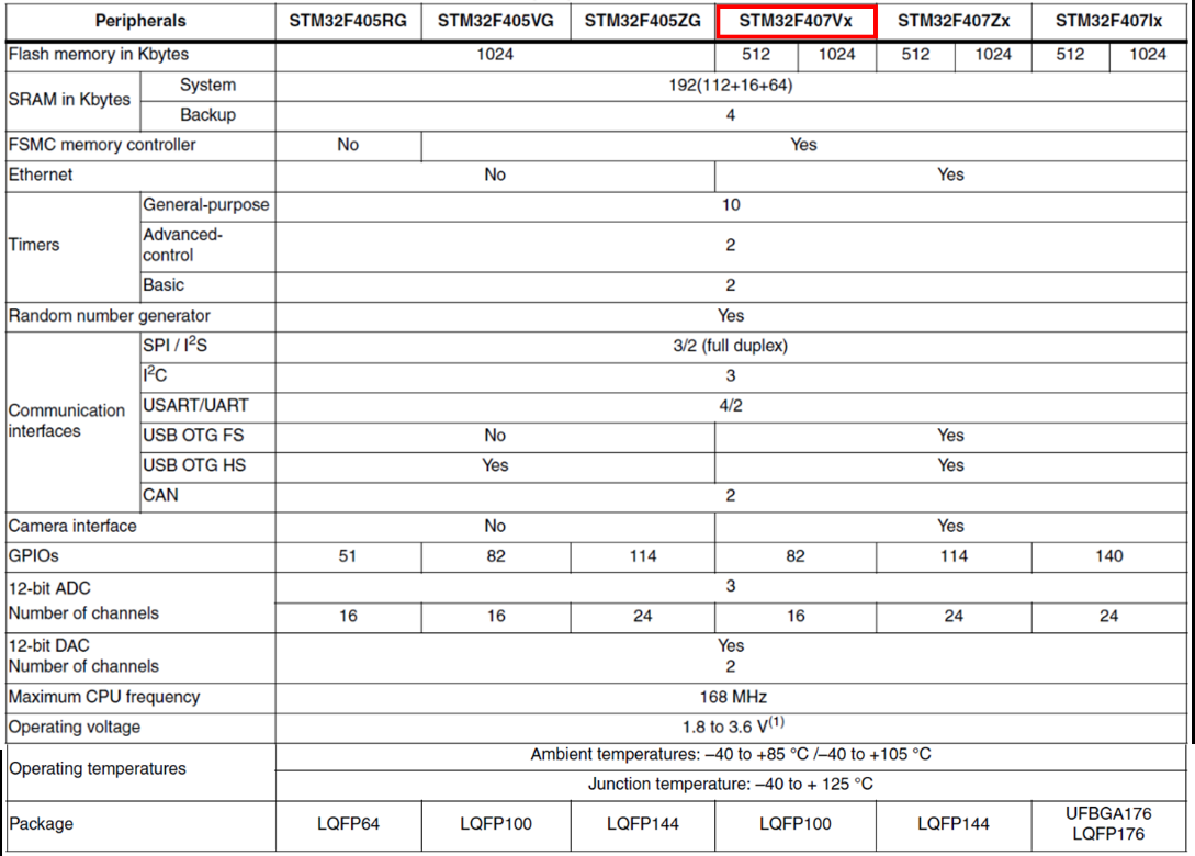

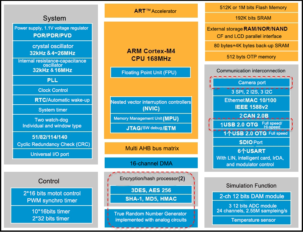

(19) STM32F407VET6 main controller: 168MHz ARM Cortex-M4, 512KB Flash, 192KB RAM, 82 general-purpose IO pins.
(20) QMI8658 IMU sensor: provides current orientation of the controller.
The microcontroller manages components such as the buzzer, robot arm, servo pan-tilt, buttons, motor encoder ports, QMI8658 accelerometer and gyroscope, USB serial port, display port, I2C port, RGB LEDs, standard LEDs, and GPIO expansion ports.
The controller provides the circuit schematic and features an SWD debug port. It supports USB serial programming for STM32 firmware updates and enables secondary development. On-board resources and peripheral example code are provided to facilitate learning and usage.
For details on the STM32F407VET6 processor’s internal resources and peripherals, refer to the diagram below and the datasheet available at STM32F407VET6 Main Controller Datasheet.

The robot must be charged using the supplied dedicated charger. The charger indicator lights function as follows: red light indicates charging, green light indicates fully charged or no battery connected.
Do not charge the robot while it is powered on. Charging should only be done when the robot is turned off.

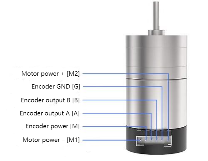

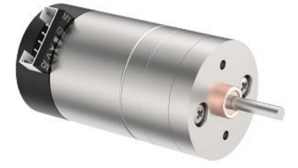

  • Hall Encoder DC Geared Motor
The JGA27-310R20 is a micro high-precision DC geared motor with an AB-phase Hall encoder for speed feedback, rated at 7.4V.
For more details:
  1. The voltage between VCC and GND depends on the microcontroller supply, typically 3.3V or 5V.
  2. The square wave frequency on A and B outputs depends on the motor speed and the number of pole pairs on the magnetic disk.
  3. The voltage between M1 and M2 is determined by the motor’s rated voltage.
Motor JGA27-310R20 Stall current ≤1.4A
Rated Voltage 7.4V Rated Current ≤0.65A
Motor Type Permanent magnet brushed Gear Ratio 1:20
Output Shaft 3 mm D-shaped eccentric shaft Encoder Type AB incremental Hall encoder
Stall Torque ≥1.0 kg·cm Encoder Supply Voltage 3.3–5 V
Rated Torque 0.4 kg·cm Magnetic Pole Count 13
Rated Speed 9000 rpm Connector Type PH 2.0 6-pin
Reduced Speed After Gearbox 450 ± 10 rpm Function Built-in pull-up and signal shaping, allowing direct pulse reading by the microcontroller.
Rated Power 4.8W Motor Weight ≈ 70 g

  • PS2 Wireless Controller
The robot is equipped with a USB controller receiver, allowing the PS2 wireless controller to control the chassis movement.
START Stop and reset the robot, wake up the controller connection. Short press START
Left joystick left Move forward Long press
Left joystick right Move backward Long press
Right joystick left Turn left, and strafe left for Mecanum chassis only. Long press
Right Joystick right Turn right, and strafe right for Mecanum chassis only. Long press

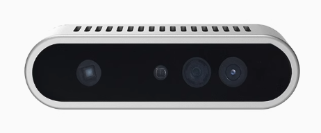

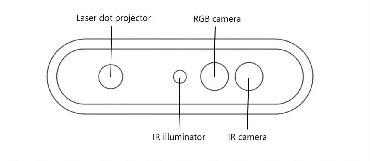

1.8.3 Depth Camera
The Aurora930, part of the Deptrum® Aurora 930 series, uses 3D structured light technology to capture the three-dimensional structure of objects and spaces. By fusing RGB images from the color camera with depth data, it provides efficient and convenient 3D perception capabilities.
Please refer to the tutorials under the directory of 5. Camera Basic Course.
The parameters of the camera are listed in the table below:
Category Parameter Specification
Module Parameters Overall Dimensions 76.5*20.7*21.8 (mm)
Baseline 40mm
Interface USB 2.0 Wafer Connector
Depth Accuracy 8mm@1m
Depth Precision 3mm@0.5m,7mm@1m
Operating Range 30 – 300 cm
Operating Temperature -10℃~55℃
Operating Humidity 0% – 95%, non-condensing
Operating Illumination 3~80000Lux
Power Supply 5 V ± 10%, 1.5 A
Power Consumption Average Power Consumption < 1.6W
Safety Features Class 1 Laser Safety
Imaging Performance Depth Data Format Raw 16
Depth Resolution / Frame Rate
640 × 400 (320 × 240)
/ 5–15 fps / H71° × V46°
RGB Data Format NV12
RGB Resolution / Frame Rate
Infrared Data Format Raw 8
Infrared Resolution / Frame Rate
System Compatibility System Compatibility Linux\ARMv8\ROS\Windows\Android
3D Camera products may show slight individual differences. The specifications provided are theoretical values for reference only. Please refer to the actual performance as the final standard.

The robot is equipped with the MS200 Lidar, which connects to external systems through a connector for both power supply and data transmission. Detailed interface definitions and specifications are provided in the table below.
Pin Signal Properties Description
1 Tx UART data transmit Tx (transmit from device, 0–3.3 V)
2 Rx UART data receive Rx
3 GND Power input ground GND
4 VCC Power input ground DC 5 V (4.5–5.5 V)
  • Electrical Specifications
Before use, ensure the Lidar is operated within the specified power and environmental conditions. Design or provide an appropriate external power supply based on the Oradar MS200 voltage range and startup peak current to guarantee normal operation.
Item Min Typical Max Notes
Operating Voltage 4.5V 5.0V 5.5V DC supply
Voltage Ripple - - 100mV
Startup Current - - 400mA
Operating Current 180mA 230mA 280mA
Operating Temperature -10℃ 25℃ 50℃
Storage Temperature 20℃ 25℃ 70℃
Operating Humidity 0 30% 80% Non-condensing
  • Specifications
Model MS200
Type Short-range
Measurement Principle TOF (Time-of-Flight) distance measurement, suitable for indoor and outdoor.
Scan Angle 360°
Angular Resolution 0.8°
Measurement Frequency 4500 times per second
Scan Rate 7-15Hz
Dimensions 37.7 x 37.5 x 33mm
Weight 40g
Measurement Accuracy 3–12 m: ±20 mm
Light Source 905 nm laser
Measurement Radius White object: 13.4 m, Black object: 13.4 m
Minimum Measurement Distance 0.1m
Ambient Light Tolerance 30,000 Lux
Power Supply DC5V±0.5V
Temperature Range Operating: -10°–50°, Storage: -30°–70°
Drive Built-in brushless motor
Windows Support Includes Windows control software
ROS Support ROS1 / ROS2
Communication Interface Standard UART

1.9.1 Introduction to Configuration Files
  • Overview of the Main Directory and Functional Files
The robot’s system home directory contains the essential files required during startup.

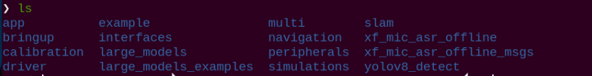

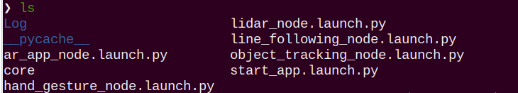

To view these files, click the terminal icon at the top of the Raspberry Pi desktop, open the command-line terminal, and enter the following command under the pi user’s home directory, then press Enter:
ls
The following table lists the main directories in the system.
Directory Name Function
wifi_manager Wi-Fi management tool
software Directory for installed software
ros2_ws Workspace containing all feature functionalities
third_party_ros2 Directory for additional ROS2 packages, such as trained YOLOv8 models
Music Music files
Pictures Directory storing images
Public User-defined folder
Templates User-defined template folder
Videos Video storage
Downloads Downloaded files
Bookshelf Directory containing official system documentation

(1) To open the ROS2 environment, double-click the desktop icon to launch the terminal. Enter the command below and press Enter to view the directories under the ROS2 environment.
ls
(2) Folder descriptions:
software Stores related software
Share Shared folder with the Raspberry Pi system

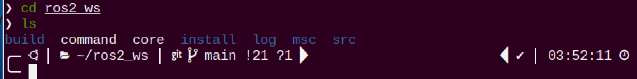

(3) Enter the following commands sequentially, pressing Enter after each one, to navigate to the robot’s package directory and list its contents:
cd ros2_ws
ls
(4) Folder descriptions:
Directory/File Name Description
build Build space which stores cache files generated during compilation
command Contains command files for implementing various functions, making them easy to locate.
devel Contains compiled target files and executables
logs Folder for storing log files
src Source code folder for function packages
(5) Next, enter the following commands sequentially, pressing Enter after each, to navigate into the robot’s package directory and list the contents of the src folder:
cd src
ls
(6) Folder descriptions:
Directory Name Type Description Function
app App feature directory Gesture control, Lidar, line tracking, etc.
interfaces Communication interface files ROS message and service communication files
simulations Directory for simulation files Gazebo, MoveIt, URDF, etc.
xf_mic_asr_offline_msgs Microphone interface files Microphone ROS messages and service files
bringup System services Launches app, wireless controller control, etc.
driver Driver files Kinematics, communication between Raspberry Pi 5 and STM32
navigation Navigation features Waypoint publishing, RViz navigation, etc.
slam Mapping features SLAM algorithms, map saving
yolov8_detect Yolov8 related features Model training and recognition with machine learning
calibration Calibration parameters IMU, linear velocity, angular velocity calibration
example Example projects Creative demos: gesture control, posture control, color tracking, etc.
peripherals Peripheral setup Different Lidar models, wireless controller control, keyboard control, etc.
xf_mic_asr_offline Voice control features Voice-controlled functions

(1) Enter the command to navigate into the feature file directory. You will see two subdirectories: launch and scripts.
cd app
ls
(2) launch directory Contains launch files for starting different features.
The corresponding launch and scripts directories in other packages serve similar purposes.

  1. You will need to install an SD card formatting tool named SD Card Formatter and an image writing tool Win32DiskImager. This section uses these two tools as examples.
  2. The image file in the package is compressed. To extract it, open the file with the “Application” (.part01) suffix. Click Browse to extract the image file to a directory without Chinese characters in its path. After extraction, you will get an image file with the .img extension.

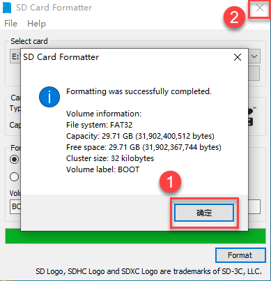

1.10.2 SD Card Formatting
If the SD card is blank, formatting is not required.
  1. Insert the SD card into the card reader and connect the reader to the computer.
  2. Open the SD card formatting tool SD Card Formatter, select the SD card drive under Select card, and click Format to format the SD card.
  1. If the prompt shown below appears, click Yes to continue. Wait for the formatting process to complete.
  1. Once finished, click OK and then close the window.
1.10.3 Image Flashing
  1. Open the image writing tool Win32DiskImager and follow these steps:
(1) Click the folder icon to select the image file. The image file is located in the same directory as this document. You need to download and extract it yourself. The screenshot below is for reference only—please use the actual image file.
(2) Under Device, select the drive letter of your SD card.
(3) Leave MD5 Hash unchecked. This option verifies the image, but since it greatly increases the writing time, it is not recommended.
(4) Click Write to start writing the image to the SD card.
  • The image file path must not contain Chinese characters.
  • Please use the actual image file name as provided.
  1. If prompted the figure below, click Yes to continue.
Writing the image may take a while, so allow the process to complete without interruption.
  1. Once you see Write Successful, the image has been written successfully. If an error occurs, disable firewall software, reinsert the SD card, and repeat the steps in this section.
  1. Once the burn is complete, a format prompt may appear—choose Cancel to avoid erasing the image. Do not choose Format Disk, otherwise the newly written image will be erased.
  1. Once burning is complete, safely eject the SD card, remove it from the card reader, and insert it into the Raspberry Pi controller to power it on.
