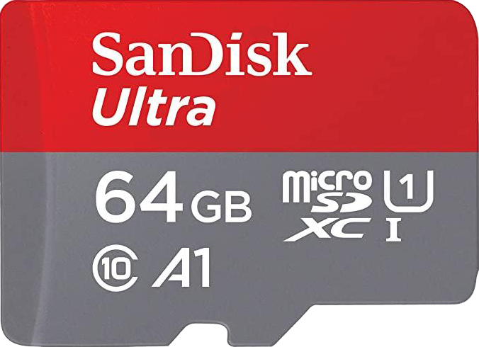

| 6 | 64GB SD Card | 1 | ![]() |

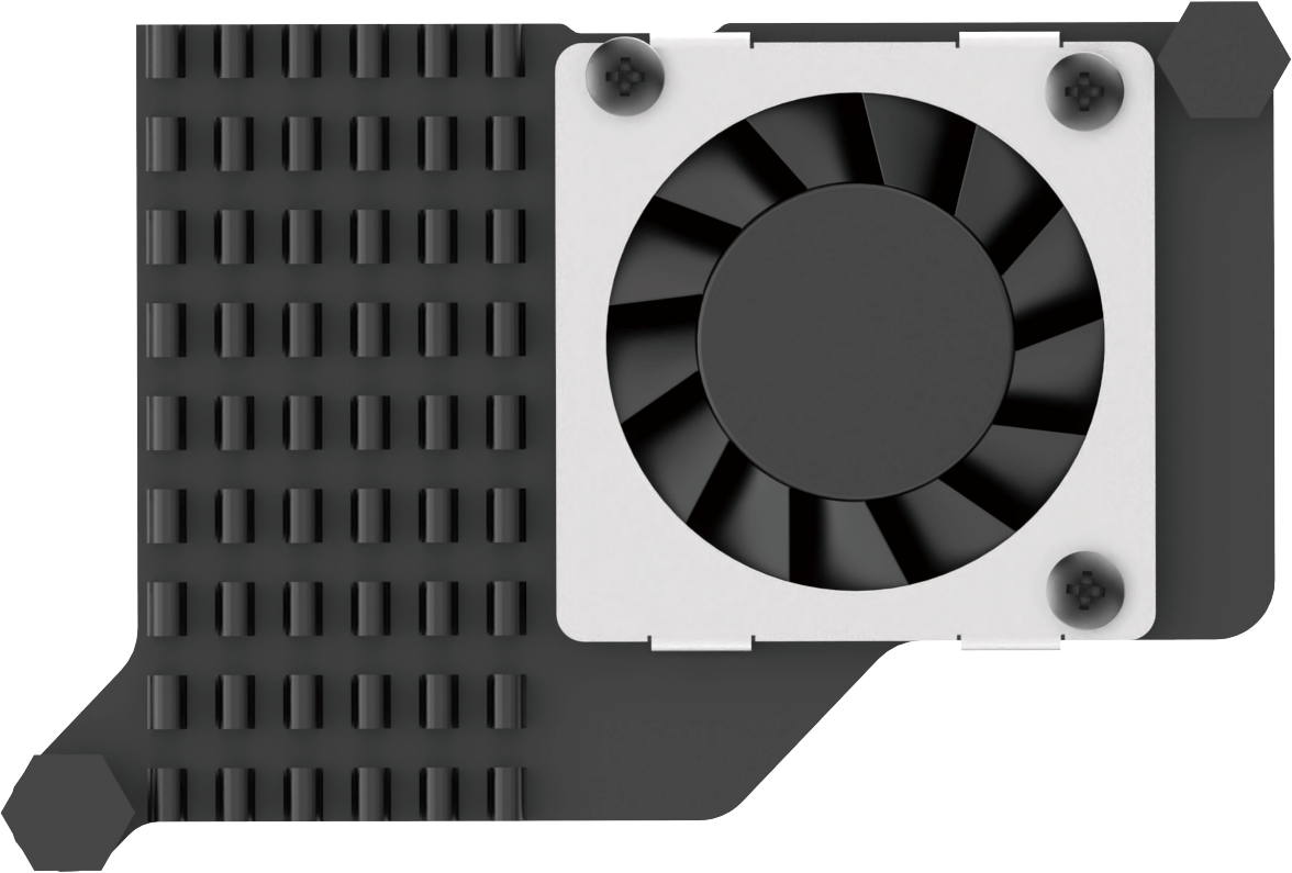

| 7 | Cooling fan | 1 | ![]() |

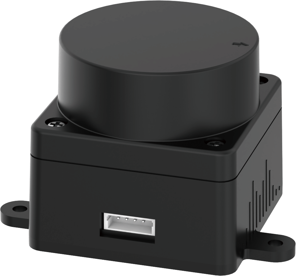

| 9 | Lidar | 1 | ![]() |
| 10 | 4 PIN Lidar wire | 1 | ![]() |

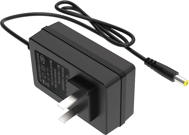

| 12 | 8.4V 2A charger(DC5.5*2.5 male connector) | 1 | ![]() |

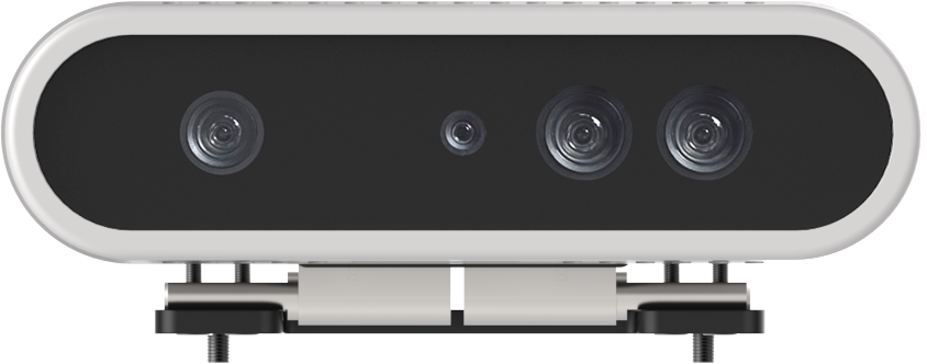

| 13 | Aurora930 Pro depth camera | 1 | ![]() |

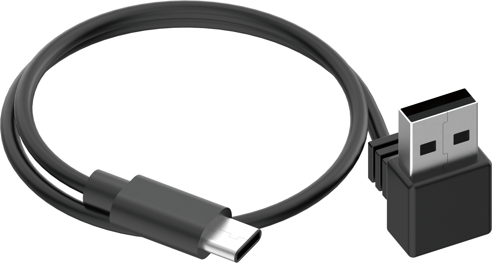

| 14 | USB to Type-C data cable | 1 | ![]() |

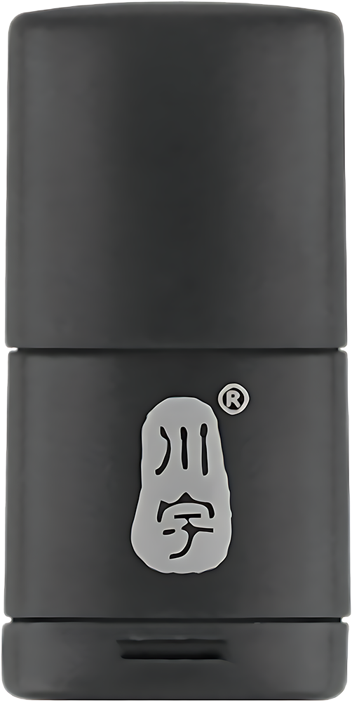

| 17 | Card reader | 1 | ![]() |

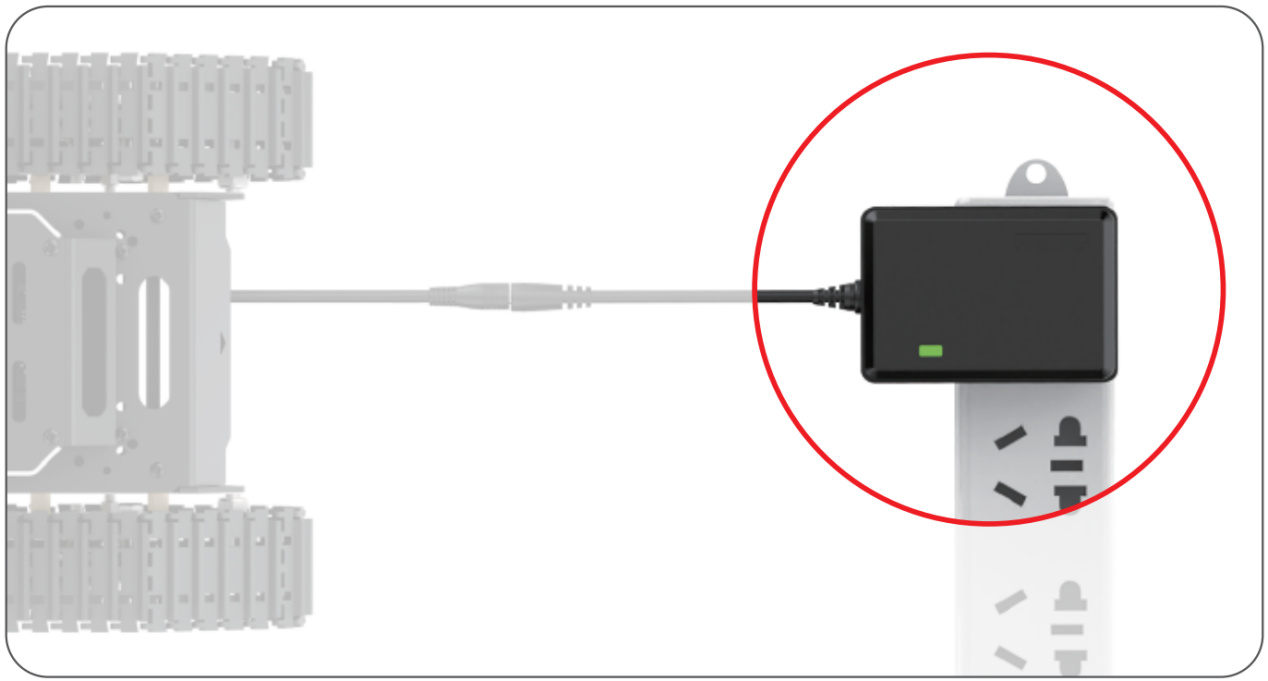

1.3.3 How to Charge the Battery
Follow these steps to safely charge the battery:
(1) First, make sure the device is switched off.
(2) Then, connect the battery cables—match red to red and black to black.
(3) Next, locate the DC charging port on the side or bottom of the device, take it out, and plug in the charger to begin charging.
(4) You can check the charging status using the indicator light on the charger: A red light means the battery is still charging. A green light means charging is complete.
Reminder: Once the battery is fully charged, please unplug the charger promptly to avoid overcharging.

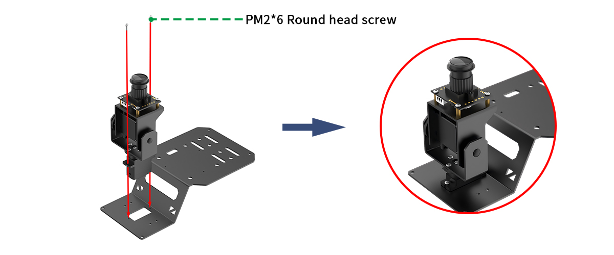

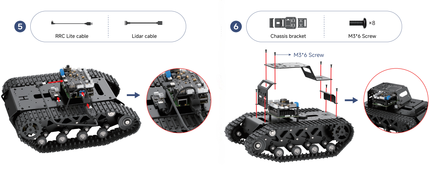

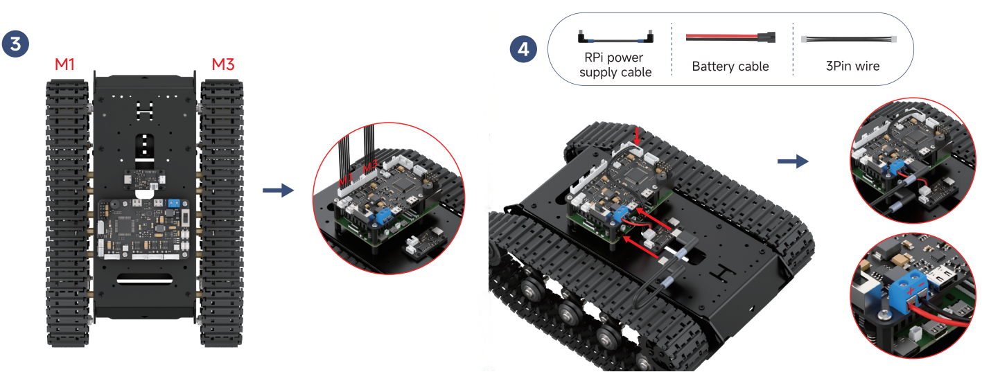

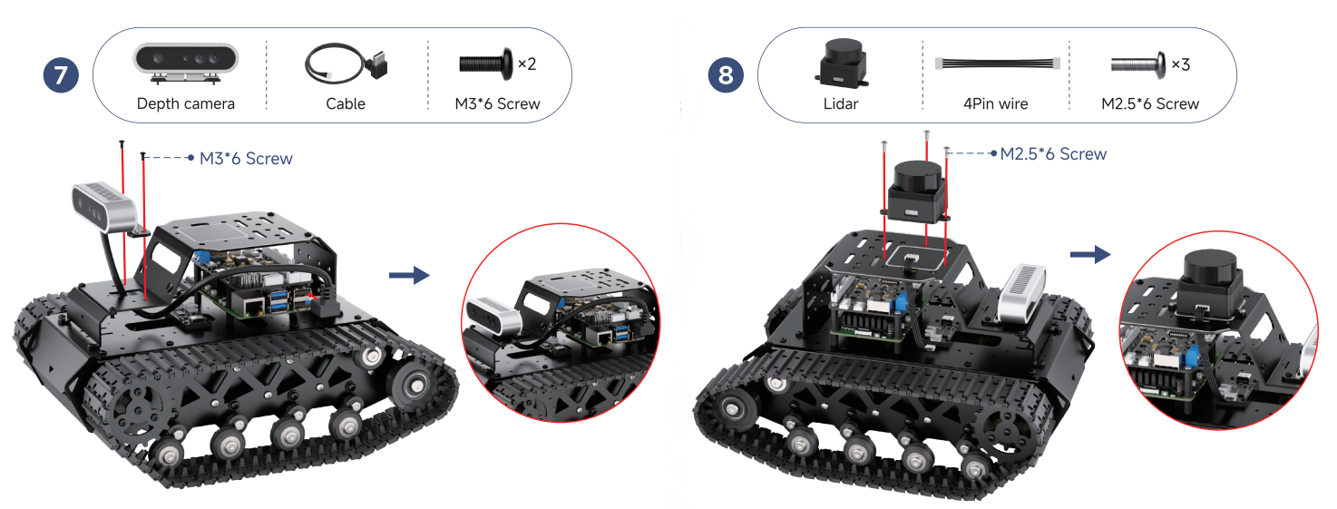

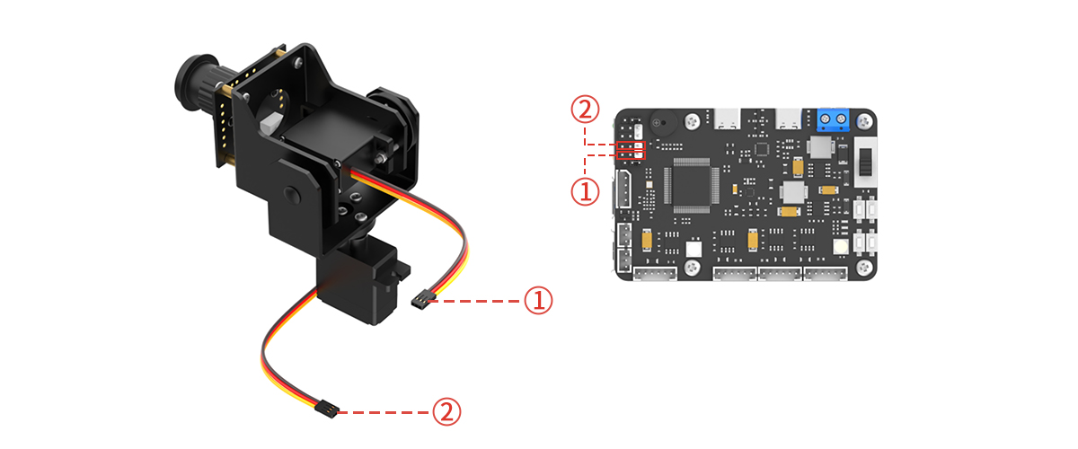

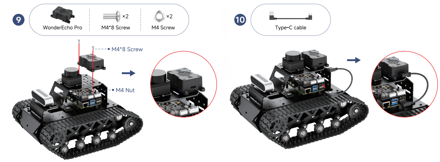

1.4 Robot Assembly & Wiring
The assembly Instruction uses the Advanced Kit as an example, but the steps are also applicable to the Standard Kit.
If the camera module included with your MentorPi system is a monocular type, please consult the following installation procedures for implementation.
Interface indication:

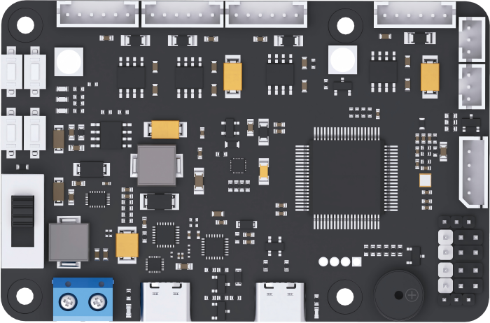

Turn on the expansion board and wait for approximately 1 minute. When LED1 on the expansion board lights up blue and the buzzer emits a “beep” sound, it indicates that the ROS configuration is complete and the device has successfully started.
Once the robot has fully powered on, LED2 will blink once every second, and a Wi-Fi hotspot prefixed with “HW” will be broadcast.
The default network mode is AP (Access Point) direct connection. When connecting via the mobile app or remote desktop, use the password: hiwonder.
You can now refer to the table below to verify the device status.
| Module | Check Steps | Outcome |
| Expansion Board LEDs | Observe the status of the LEDs |
Default AP (Access Point) mode: LED1 is steady on; LED2 blinks once per second. |
| Buzzer | Listen for a beep sound | A single beep indicates that the expansion board's onboard hardware is functioning normally. |
| Lidar | Observe for rotation a few seconds after power-on. | The LiDAR begins to rotate, indicating normal startup. |

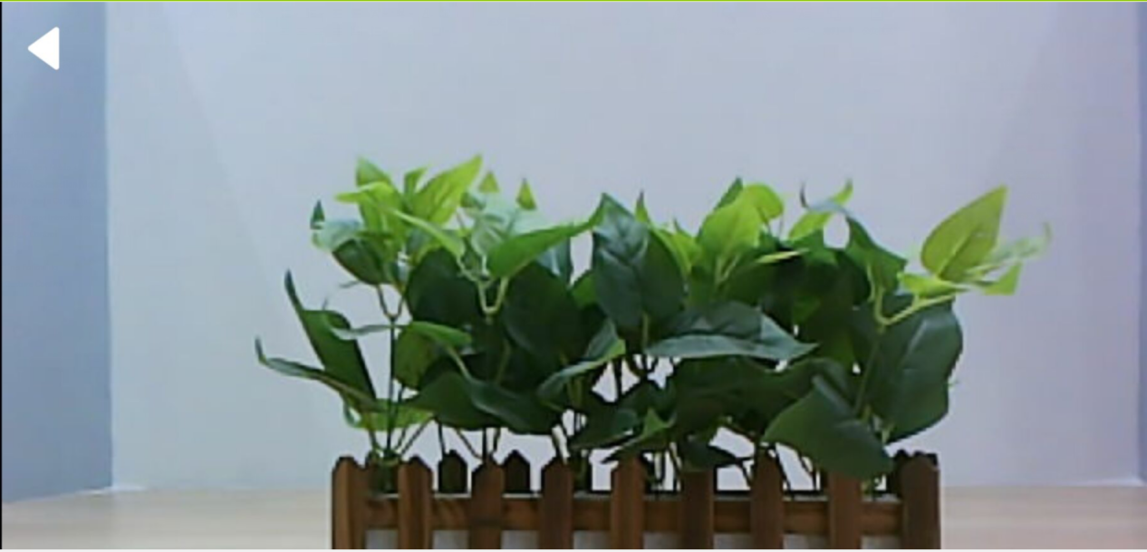

| Depth Camera / Monocular Camera | (1) Open the mobile app and connect to the robot. (2) Navigate to the "Robot Control" interface to view the live camera feed. (3) Drag the screen to adjust the camera pan-tilt angle (monocular version only). |
The live video feed is displayed, and the pan-tilt mechanism responds to screen gestures (monocular only). |
Encoder Motors + STM32 Controller |

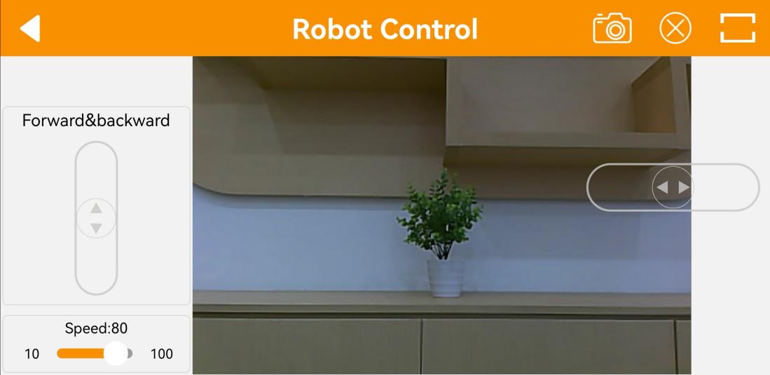

After powering on, use the wireless controller or the app's "Robot Control" function to operate the robot. | After powering on, use the wireless controller or the app's "Robot Control" function to operate the robot. |
If the buzzer does not emit a beep, the onboard hardware—such as the
IMUor buzzer—may be malfunctioning. This issue is rare under normal use. If it occurs, please contact our support team atsupport@hiwonder.com.If the device’s
Wi-Fihotspot is not visible, check whetherLED1on the expansion board is steadily lit andLED2is flashing once per second.

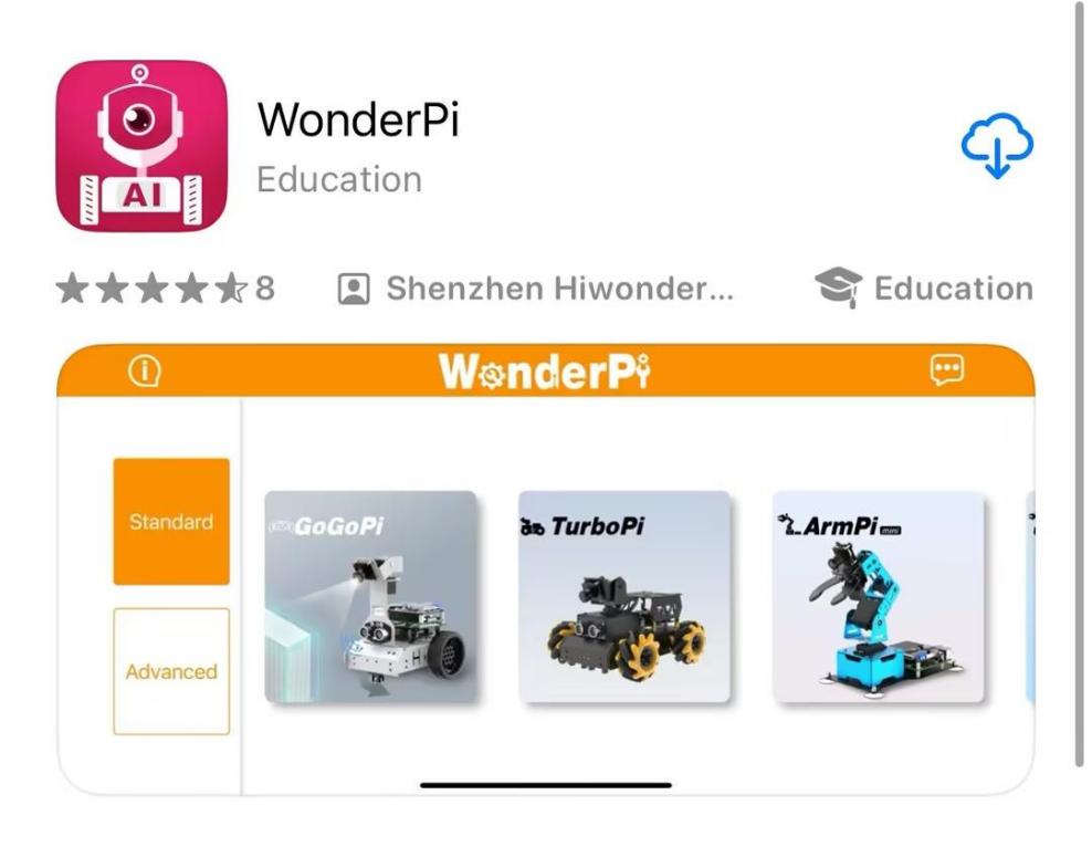

You can control the robot using the mobile app “WonderPi.” This lesson explains how to download and install the app.
Please ensure that all permissions are granted to the app during installation to ensure its proper functionality.
Before launching the app, make sure that both
GPSandWi-Fiare enabled on your phone.
App Installation
(1) Method 1:
For Android users: Locate the app installation package in WonderPi, then transfer it to your smartphone and install it manually.
For iOS users: Download WonderPi directly from the App Store.

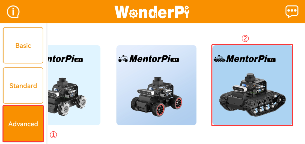

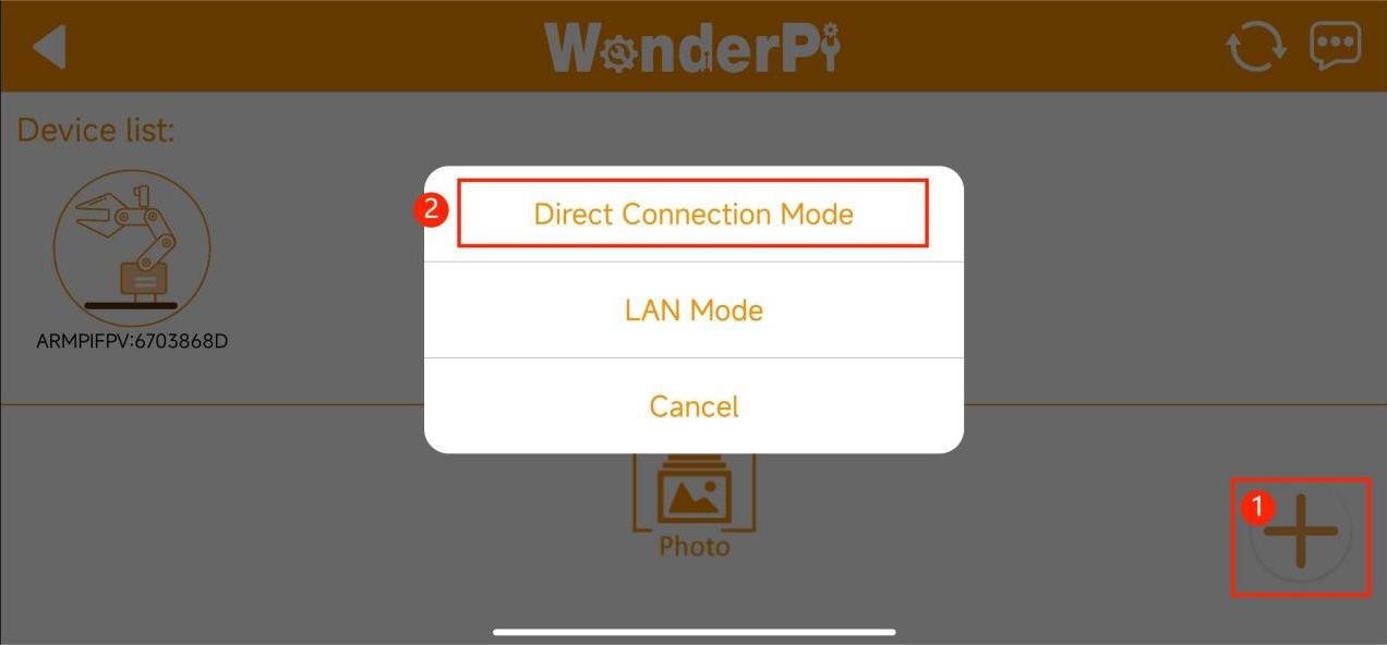

① Open the WonderPi app and select Advanced → MentorPi-T1 in sequence.
② Click the “+” button at the lower right corner to select direct connection mode.

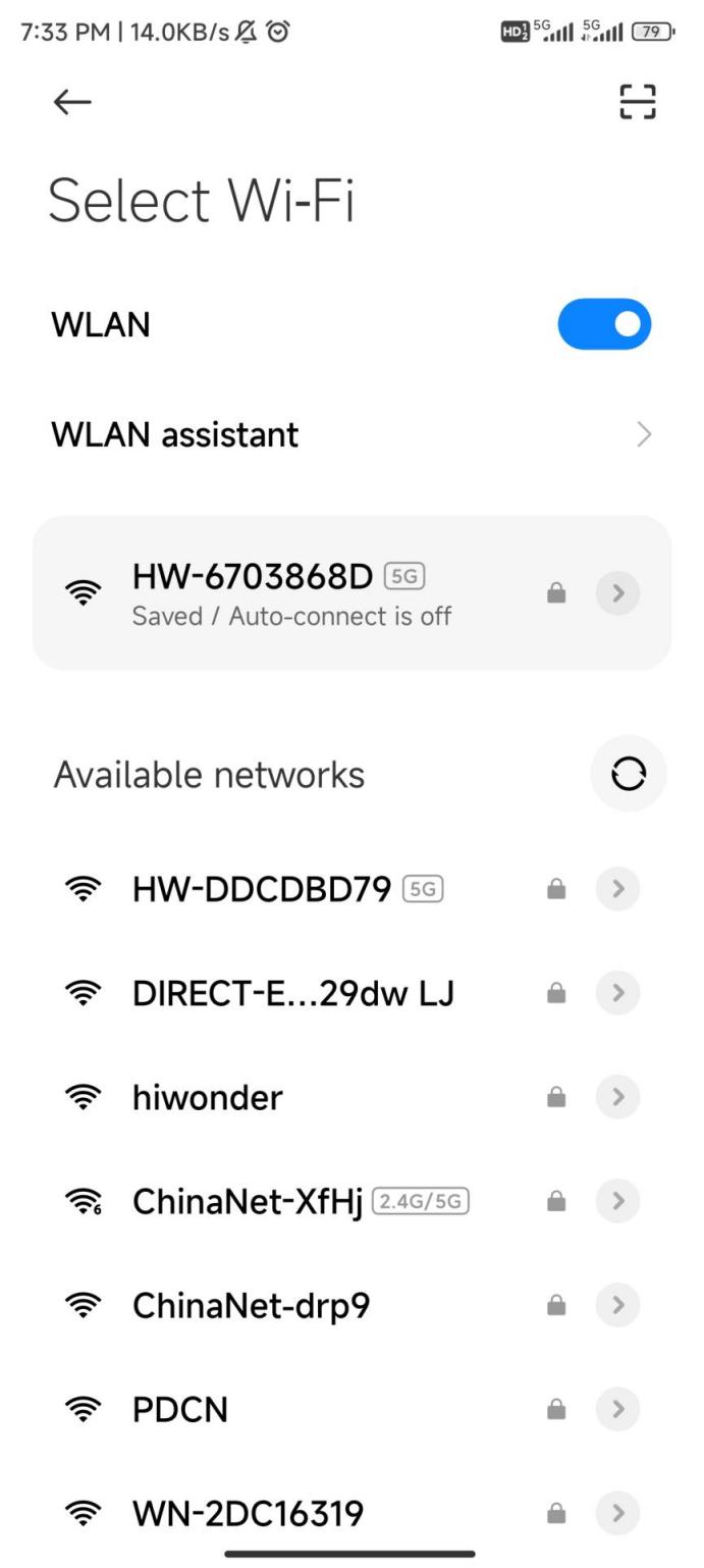

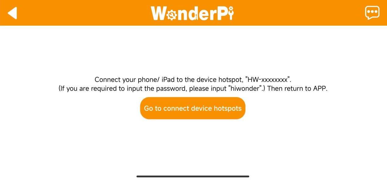

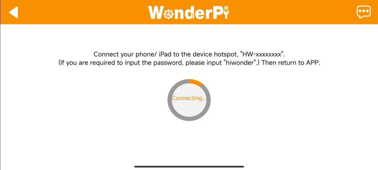

③ Tap “Go to connect device hotspots” to open the settings page, and connect to the Wi-Fi hotspot broadcasted by MentorPi.
④ When prompted, enter the password: hiwonder.
For iOS users:
After connecting to the hotspot, wait until the message “Wi-Fi connected successfully” appears before returning to the app. If you return too early, the device may not be detected. In that case, tap the Refresh button
several times to search for the device again.

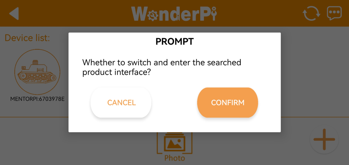

⑥ If the message “Whether to switch and enter the searched product interface?” appears, it means the selected product version in Step 1 was incorrect. Tap “OK” to automatically switch to the correct version selection screen.

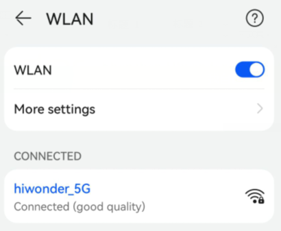

① Connect your phone to a 5G Wi-Fi network. For example, connect to “Hiwonder_5G”.
If your router supports both 2.4G and 5G bands and they are configured with separate SSIDs, the Wi-Fi names will typically reflect this—for instance, “Hiwonder” for 2.4G and “Hiwonder_5G” for 5G.

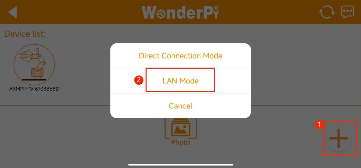

② Open the WonderPi app and, select Advanced → MentorPi-T1.
③ Tap the “+” button in the lower-right corner and choose LAN Mode.
④ The app will prompt you to enter the Wi-Fi password.
Please make sure to enter the correct password—otherwise, the connection will fail. Once entered, tap “OK”.

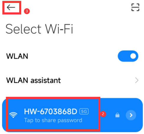

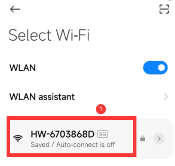

⑥ Your phone will automatically open the Wi-Fi settings page.
Look for a hotspot beginning with “HW”, and connect using the password: hiwonder.
Once connected, return to the app.

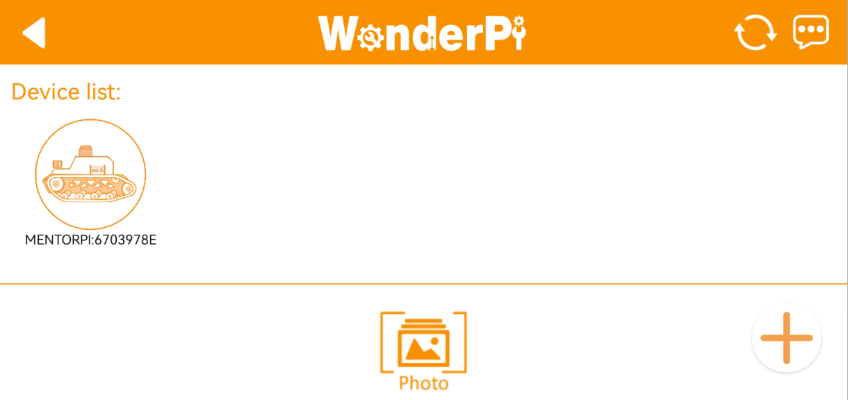

⑦ The app will then begin automatic network configuration.

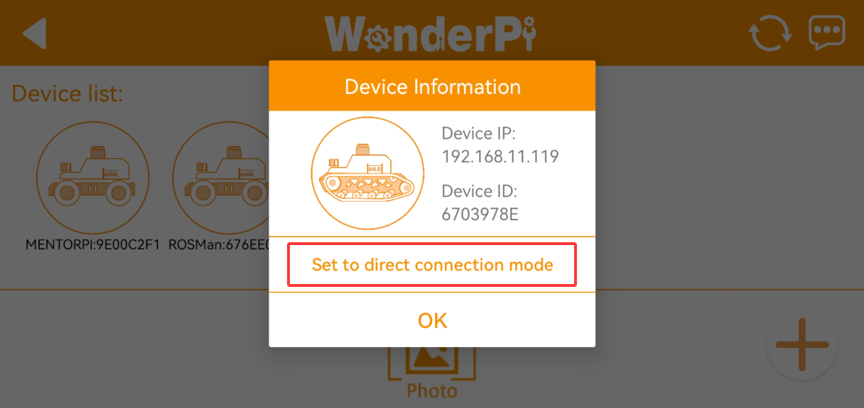

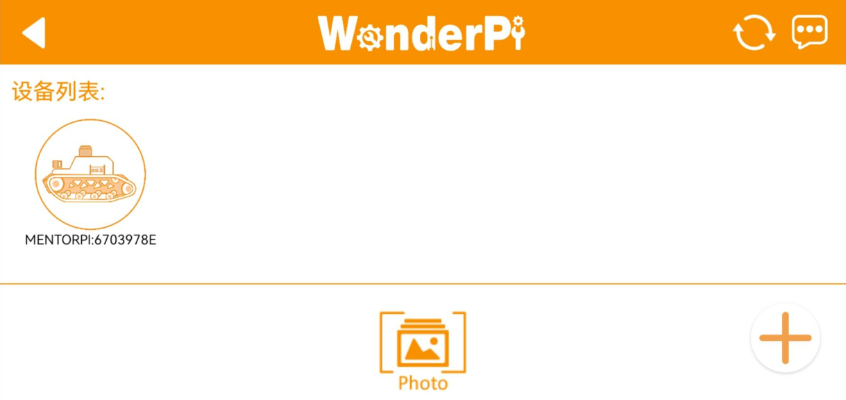

⑧ After a short while, the main interface will display the MentorPi icon, and the LED light on the expansion board will remain steady—indicating a successful connection.

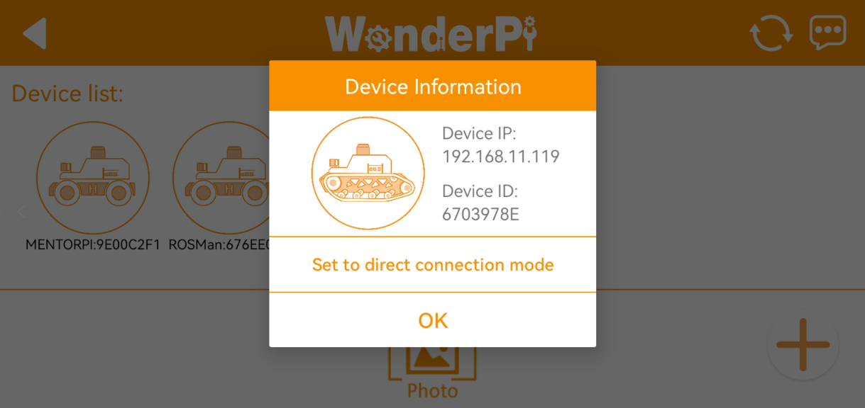

⑨ Long-press the MentorPi icon in the app to view its assigned IP address and device ID.
⑩ You can use this IP address with a remote desktop tool to access the device.
For detailed steps, please refer to 2. Set Up Development Environment.
⑪ If you need to switch the LAN mode back to the direct connection mode, long press the robot icon in the APP again, click “Set to Direct Connection Mode” in the pop-up window, wait for a while, and the LED2 on the expansion board will keep flashing, indicating that it has been switched to the direct connection mode. You can search for the hotspot generated by MentorPi again.

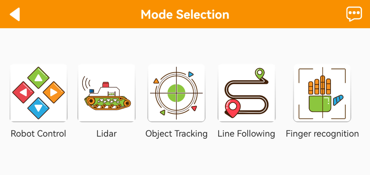

1.6.2 App Games Introduction
In this section, we’ll use the iOS system for demonstration purposes. The instructions also apply to Android devices. The app offers five game modes: Robot Control, Lidar, Object Tracking, Line Following, and Gesture Control.
The following table provides a brief description of each game mode:
| Icon | Game Mode | Function |

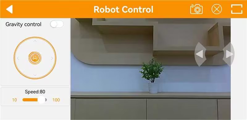

Robot control | Manually control the movement and direction of the robot |

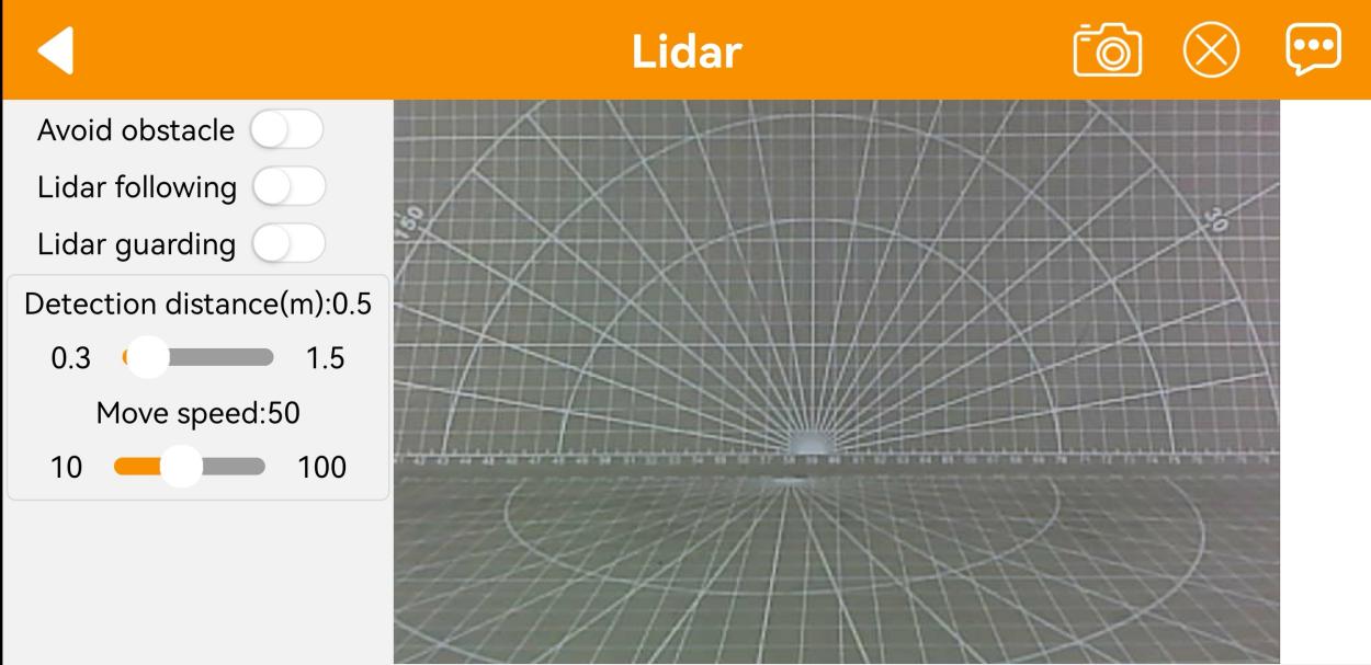

Lidar | Includes three modes: Obstacle Avoidance, LiDAR Following, and LiDAR Guarding |
Object tracking | Select a target object color; the robot will automatically track the selected object |
Line following | Place a line on the ground and set its color as the recognition target; the robot will follow the line path |
Gesture control | (Available only on the Mecanum wheel version) Use hand gestures to control the robot's movement direction based on finger movement tracking. |
Robot Control
Tap “Robot Control” on the mode selection screen to enter the game’s control interface. Note that the interface may vary slightly between the Mecanum wheel, Ackermann and tank chassis versions.
(1) The robot control interface for the Mecanum and tank chassis version are as below:
① Left Controls: From top to bottom — toggle gravity sensing, control forward/backward movement, and adjust speed.
② Center Display:
Displays the live camera feed. You can drag the screen to adjust the camera’s pan-tilt angle (available only on the 2D pan-tilt version).
③ Right Controls:
Control left and right turns.
④ Top Menu Bar:
Includes icons for taking screenshots
, toggling the navigation bar
, and switching to fullscreen mode
(commonly used when operating with a wireless controller).
(2) The robot control interface for the Ackermann wheel version is as shown:
① Left Controls:
From top to bottom — control forward/backward movement and adjust the speed.
② Center Display:
Displays the live camera feed. You can drag the screen to adjust the camera’s pan-tilt angle (this feature is available only on the 2D pan-tilt version).
③ Right Controls: Control left and right turns.
④ Top Menu Bar:
(typically used with a wireless controller).
For the monocular camera version, when the pan-tilt servo reaches its limit and you continue dragging the screen, vibration feedback will occur. This indicates the servo has reached its mechanical limit. Please avoid forcing further rotation, as the pan-tilt has built-in limit protection.
Lidar
Place the robot in a spacious area to ensure it has enough room to move.
The
Ackermannchassis version does not support theLiDARGuarding function.
(1) Interface introduction:
The “Lidar” game consists of three modes: avoid obstacle, LiDAR following, and LiDAR guarding.
The interface is divided into two parts:
① Left side: switch the games;
② Right side: displays the live camera feed.
(2) Function Description
| Icon | Function |
Turn on/off the avoid obstacle game. |
Turn on/off the LiDAR following game. |
Turn on/off the LiDAR guarding game. |
Display the live camera feed. |
(3) Operation Steps
① Avoid Obstacle
The robot moves forward and, upon detecting an obstacle, will automatically turn to avoid it.
② Lidar Following
When an obstacle is detected, the robot adjusts its posture to maintain a specified distance from the obstacle.
③ Lidar Guarding
The robot will adjust its orientation to face the obstacle when detected.

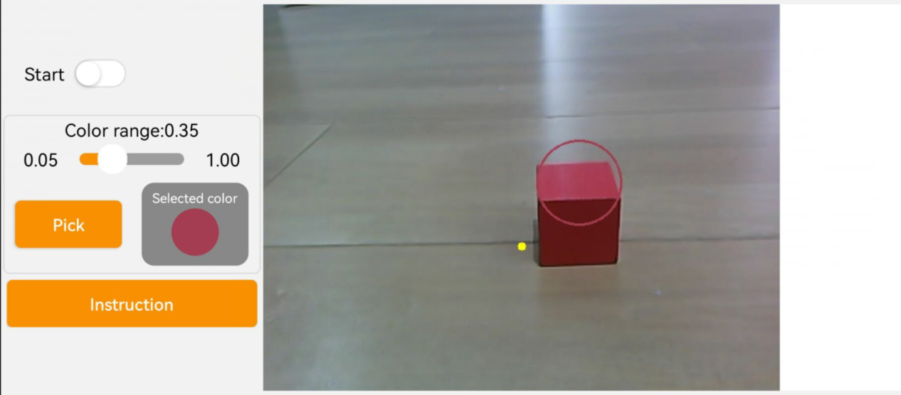

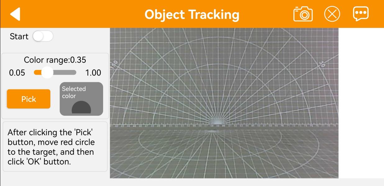

Object Tracking
For optimal tracking performance, it is recommended to tilt the camera slightly downward and move the target object along the ground. This allows the robot to track and follow the object more effectively.
Carefully adjust the color detection range—avoid setting it too wide or too narrow. A range that is too wide may include unintended colors, while one that is too narrow might prevent the target from being detected. Additionally, ensure that there are no similarly colored objects within the camera’s field of view to avoid interference.
(1) Interface Introduction
The interface consists of two parts:
① Left side: contains the game switch and color picking area;
| Icon | Function |
Turn the game on or off. |
Adjust the color threshold range (0.05 to 1.00). |
Select a color from the specified area in the live camera feed. |
After clicking "Pick," the button changes to "OK" for confirming the selected color. |
Display the selected color. |
Show the live camera feed. |
(3) Operation Steps
① After tapping the “Pick” button, drag the red circle on the live camera feed to the target area to select the color.
② Once you’ve tapped the “OK” button, the selected color will appear in the box on the right.
③ Tap the “Start” button. The robot will then begin tracking and follow the target object as it moves.

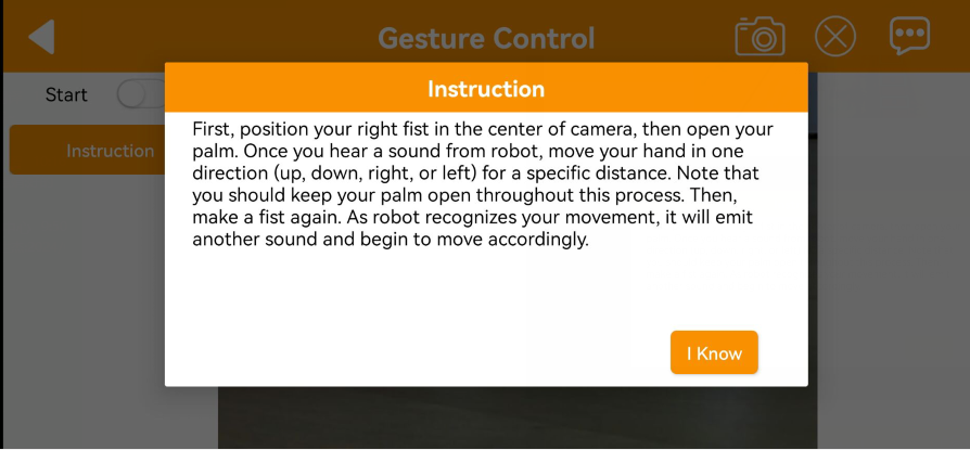

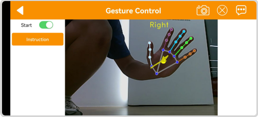

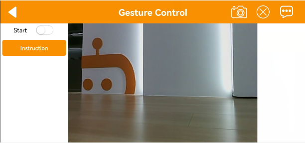

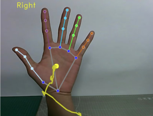

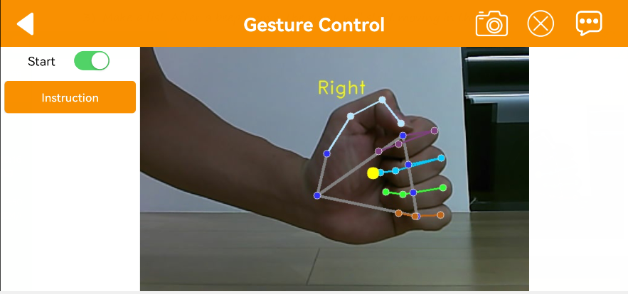

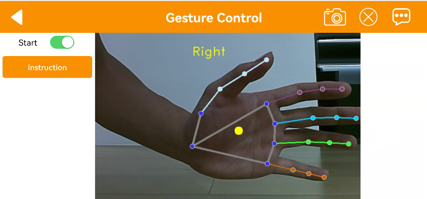

Gesture Control
This mode only works with your right hand.
For proper recognition, your entire palm must be visible on the screen.
Move your hand slowly.
Click the “Gesture Control” on mode selection interface to enter the game interface. The interface consists of two parts:
① Left side: contains the game switch and operation instructions;
| Icon | Function |
Turn the gesture control game on or off. |
Display the real-time camera feed. When the palm is open and facing to the right, a trajectory is drawn. When the fist is clenched, the robot will turn right. Draw a trajectory for forward, backward, left, and right movements, and the robot will move accordingly—forward, backward, left, or right. |
(3) Operation Steps
① Clench your fist and position your hand at the center of the camera’s field of view. Open your fingers and begin moving your hand to draw a trajectory once you hear a beep.
② While keeping your hand open, move it in one of the following directions—up, down, left, or right—for a certain distance.
③ Make a fist again. After hearing a beep, the robot will start moving in the direction of the drawn trajectory.
