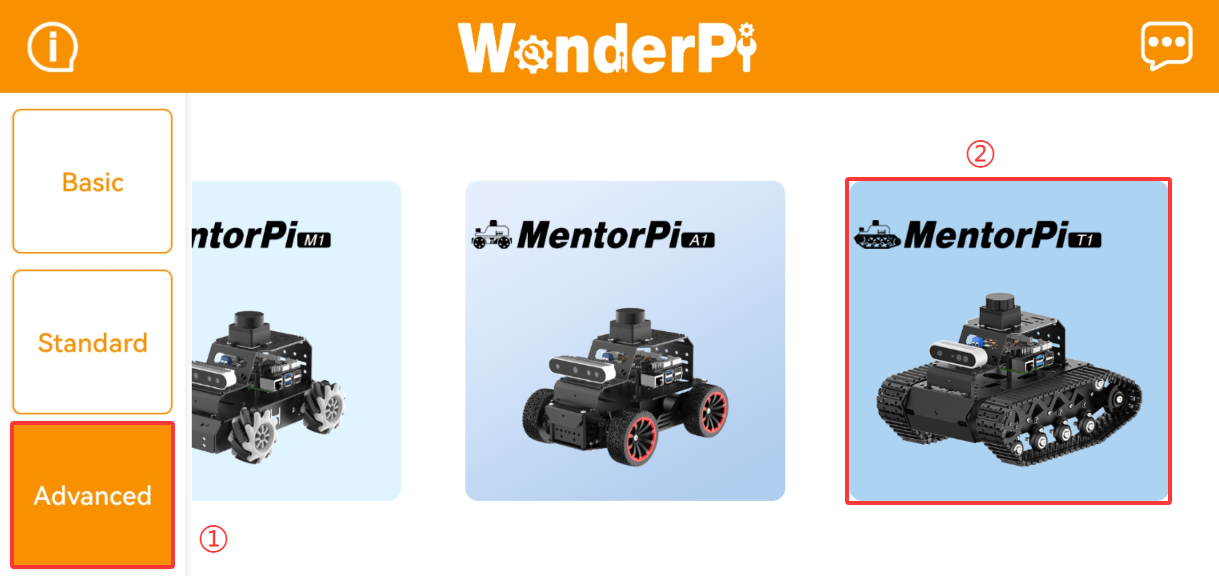

(1) Open the “WonderPi” app on your phone. Then, go to “Advanced” and select “MentorPi T1”.

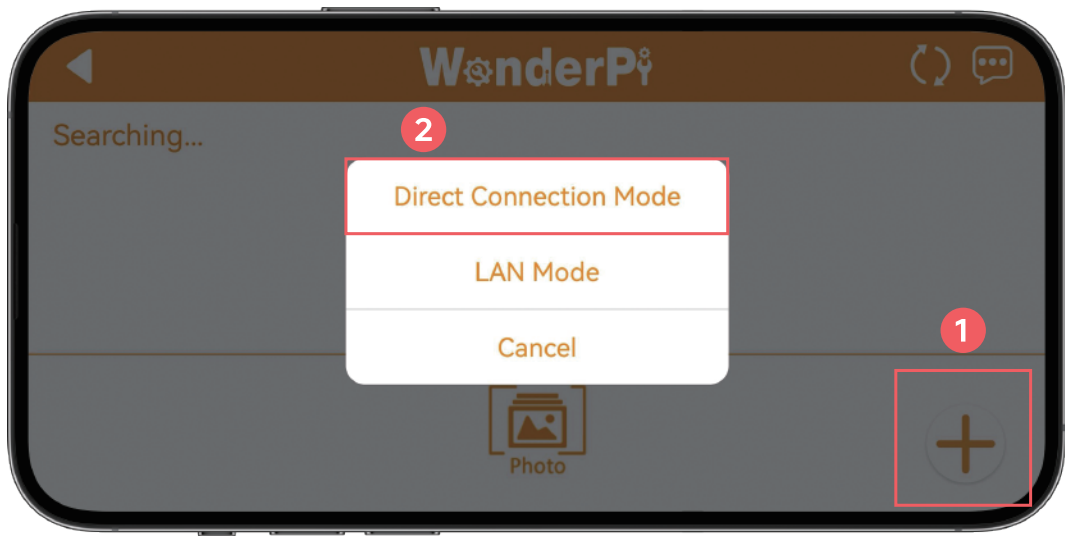

(2) Tap the “+” button in the bottom right corner of the screen, and choose “Direct Connection Mode”.

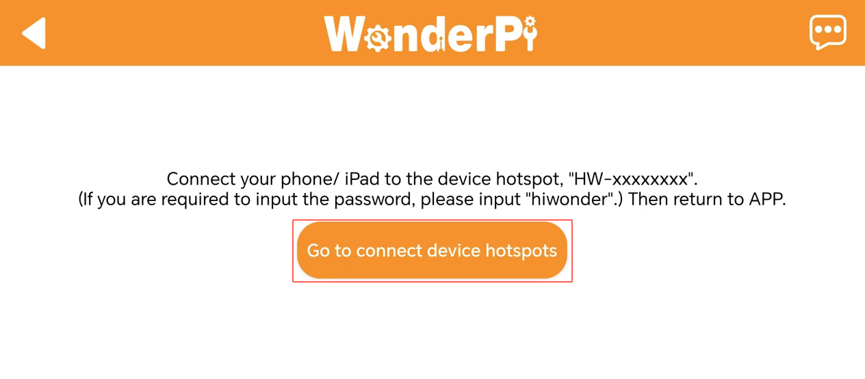

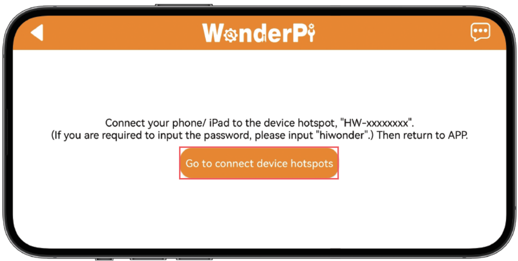

(3) Tap “Go to Connect Device Hotspot”. This will take you to your phone’s settings to connect to the hotspot created by the robot.

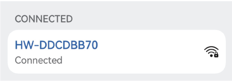

(4) Look for a hotspot name starting with “HW”. The password is “hiwonder”.

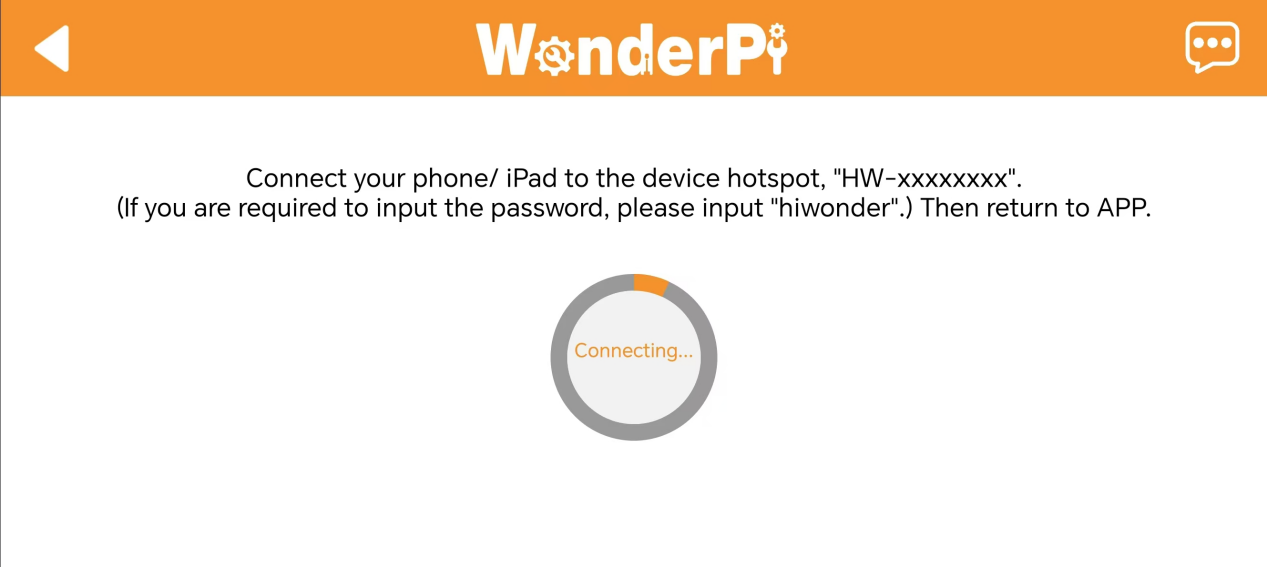

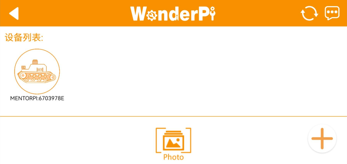

(5) Return to the app, and tap the robot icon to enter the mode selection screen.
If a pop-up message appears saying “Network Unavailable, Continue Connection?”, simply tap “Keep Connection”.

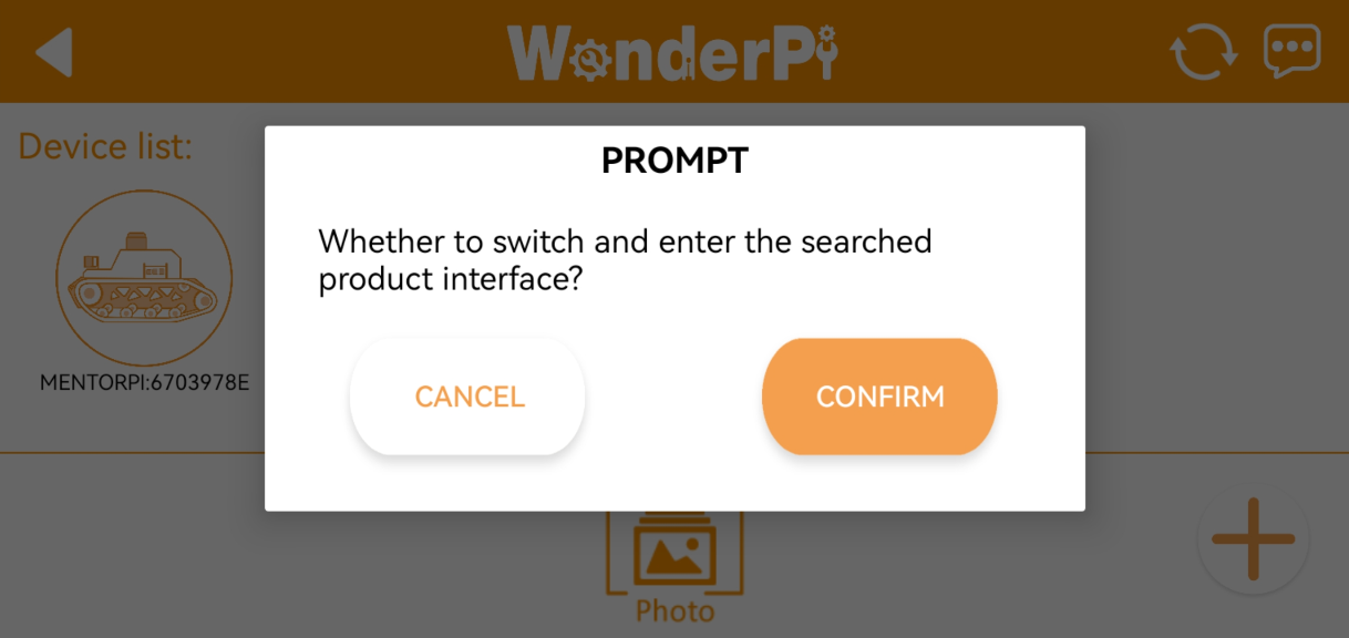

(6) If you see a prompt asking “Whether to switch to and enter the searched interface?”, it indicates that an incorrect product version was selected in Step 1. Tap “CONFIRM” to switch directly to the correct version’s mode selection screen.

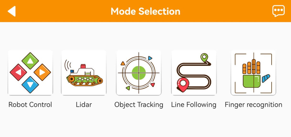

(7) The mode selection screen appears as shown below:
For details on each mode, refer to the documentation provided earlier.

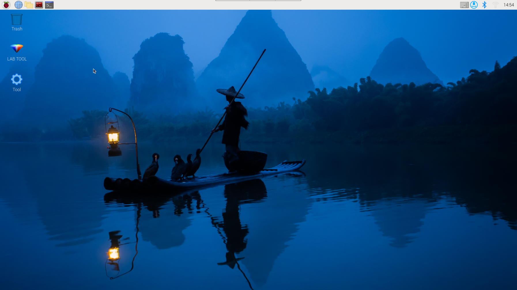

(1) Power on the robot and connect it to the remote control software, VNC.
(2) Double-click the terminal icon on the desktop to open the command line terminal.

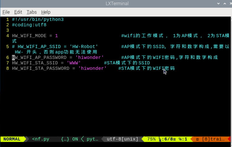

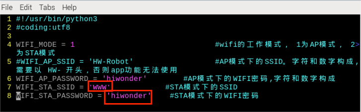

(4) Enter the command vim wifi_conf.py and press Enter to open the configuration file.
vim wifi_conf.py
The configuration file defaults to AP Direct Connection Mode. If all code lines are commented out, it will be set to AP Direct Connection Mode.

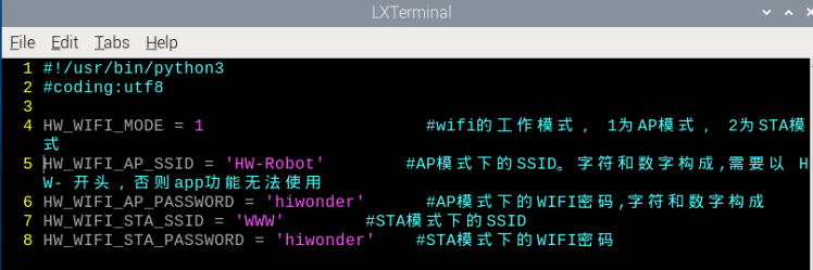

(5) If there are multiple devices nearby, you can modify HW_WIFI_AP_SSID and HW_WIFI_AP_PASSWORD to set a unique name and password for each device. For example, use “HW-Robot” as the name and “hiwonder” as the password, as shown below.
(6) After verifying the entries, press the ESC key, then type :wq to save and exit the file.
:wq

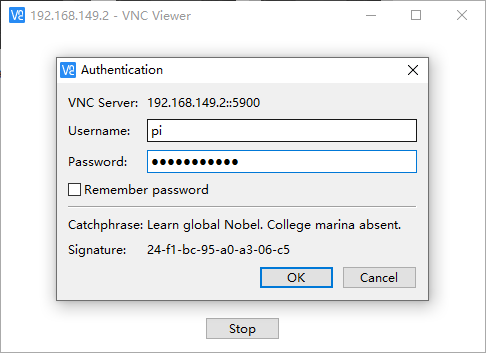

(9) To connect using VNC, enter the new IP address in the search bar, and click on the connection icon that appears. Log in with the username “pi” and password “raspberrypi”, then click “OK” to access the system desktop.

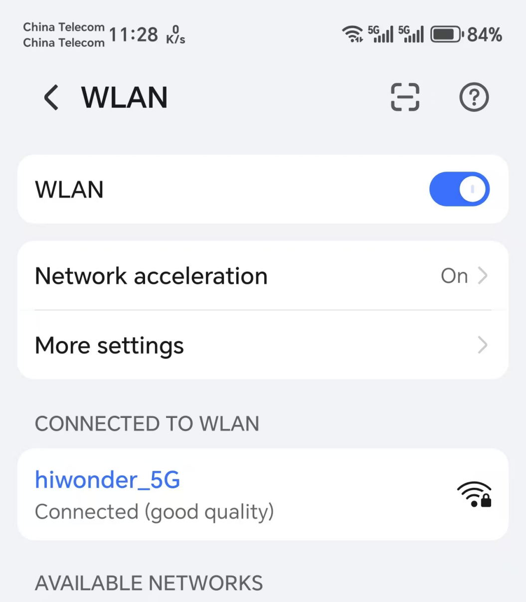

(1) First, connect your phone to Wi-Fi. In this example, we connect to “Hiwonder_5G” Wi-Fi. (For dual-band routers with separated frequencies, the Wi-Fi names may differ, such as “Hiwonder” for the 2.4G band and “Hiwonder_5G” for the 5G band.)

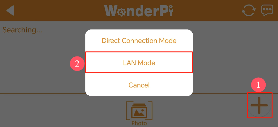

(3) Tap the “+” button in the bottom right corner, and choose “LAN Mode”.

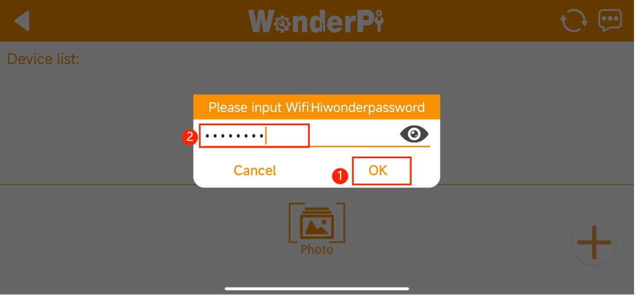

(4) The app will prompt you to enter the password for the connected Wi-Fi network. (Please ensure the password is correct, as an incorrect password will result in connection failure.) After entering the password, tap “OK”.

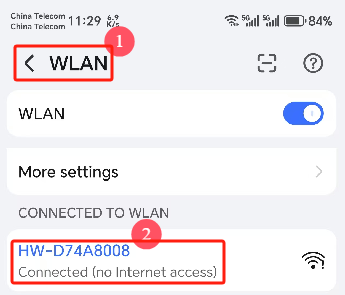

(5) Tap “Go to connect device hotspot”.
(6) Your phone will automatically navigate to the Wi-Fi settings page. Find the hotspot starting with “HW” and enter the password “hiwonder”. Once connected, tap the “Return” button.

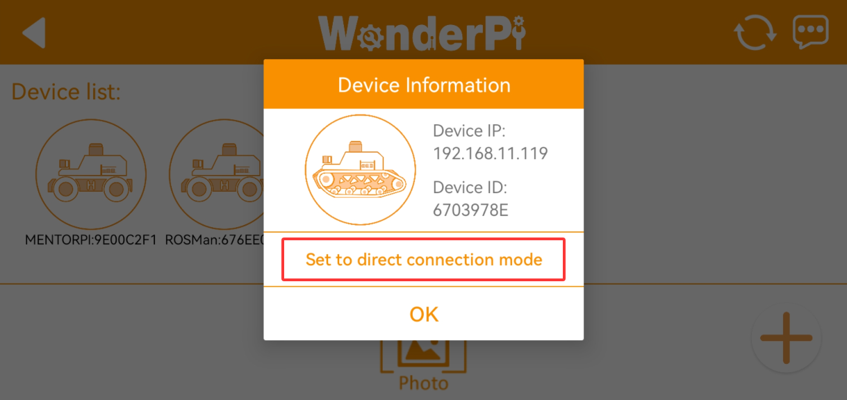

(9) Press and hold the robot icon in the app to view the robot’s assigned IP address and device ID.

(11) To switch back to direct connection mode from LAN mode, press and hold the KEY1 button on the expansion board until the blue LED flashes, indicating that the switch is complete.

vim wifi_conf.py
(5) First, change the value of HW_WIFI_MODE to 2:
- 1 represents Direct Connection Mode
- 2 represents LAN Mode
- 3 represents Direct Sharing Mode
(6) Next, modify HW_WIFI_STA_SSID and HW_WIFI_STA_PASSWORD to match your router’s Wi-Fi name and password.
Selecting a 5G Wi-Fi signal will provide higher transfer speeds. If there is lag on standard Wi-Fi, consider switching to a 5G signal.
(7) After confirming the entries are correct, press the ESC key, then type :wq to save and exit the file.
