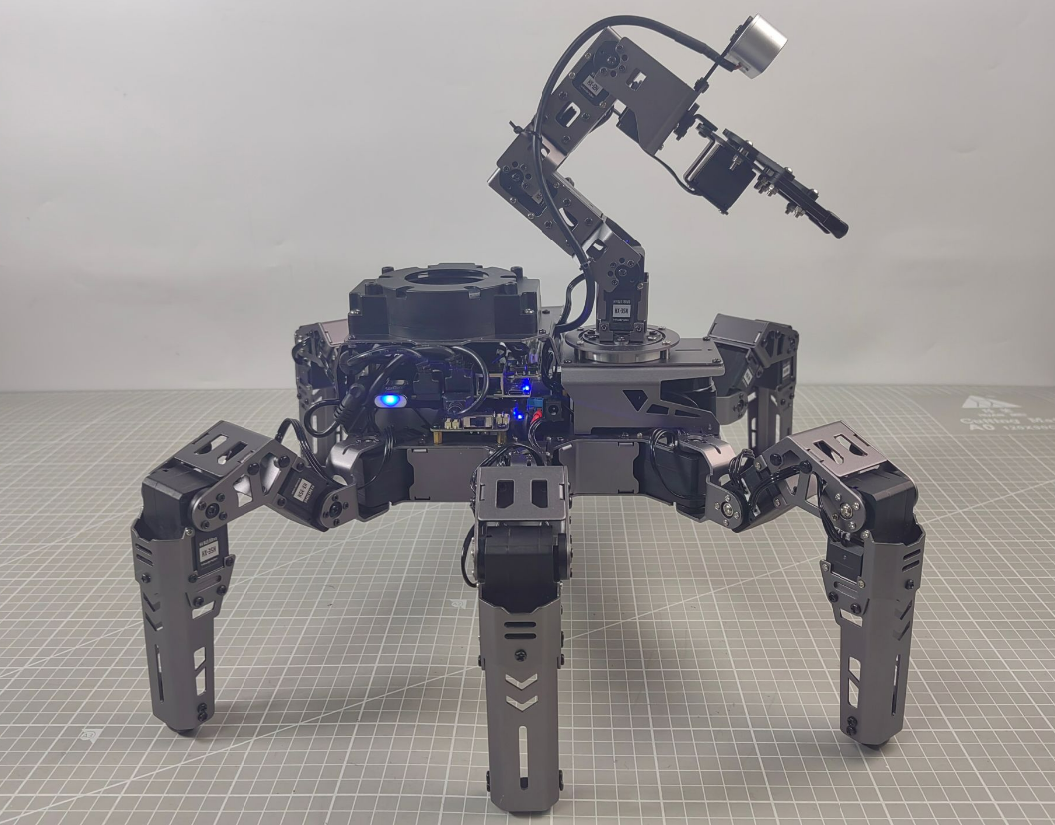

ROSpider is a comprehensive hexapod robot developed for ROS educational scenarios, operating on Ubuntu 22.04 and equipped with the ROS2 Humble robot system.
It is equipped with high-performance hardware configurations such as NVIDIA Jetson Orin Nano, high-voltage bus servos, LiDAR, a depth camera, and a 6-microphone array. It supports applications including robot motion control, mapping and navigation, tracking and obstacle avoidance, autonomous patrolling, human feature recognition, body motion interaction, and large AI models.

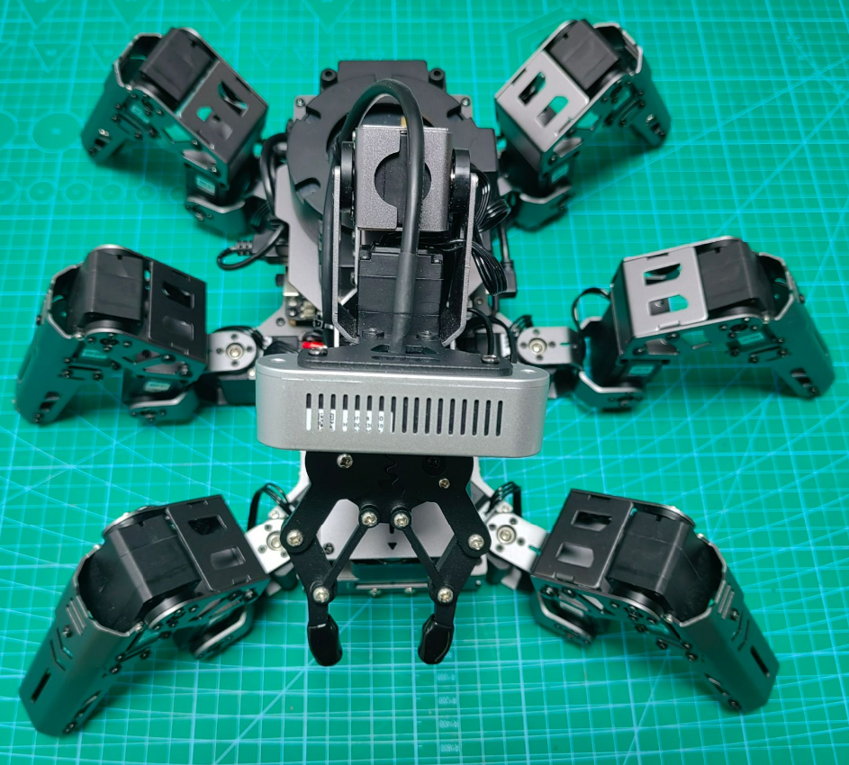

Furthermore, the robot integrates the depth camera with a robotic arm, allowing it to function as both a desktop visual robotic arm and a mobile visual robotic arm. The robot can perform tasks such as navigation and handling, autonomous grasping, and garbage classification, fulfilling requirements for learning and verifying ROS2 and machine vision.
Regarding mobility, a hexapod ripple gait is adopted, and the body’s running posture, height, and speed are adjustable, providing a smoother control experience.

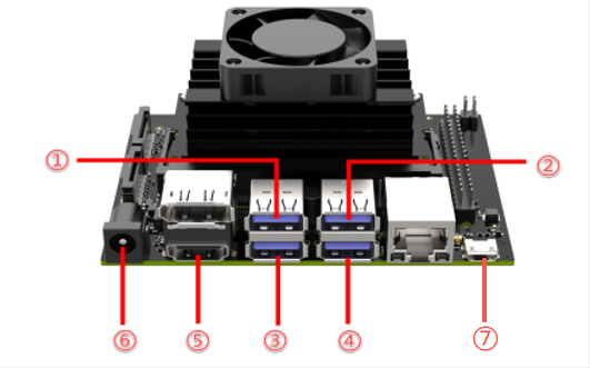

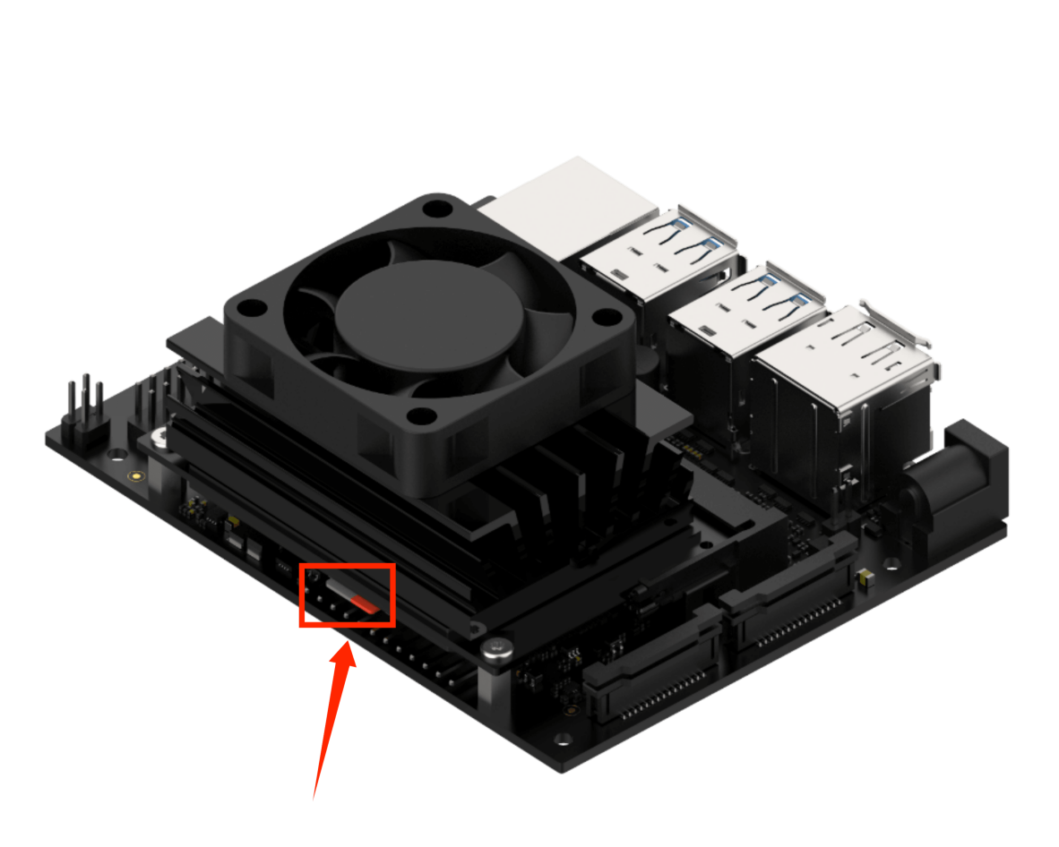

  • Jetson Nano Controller
The following figure illustrates the interfaces connecting various modules to the Jetson Nano controller in the flagship edition. Wiring can be performed according to the standards in the table below. Skip this interface if the purchased package does not include the relevant modules.
No. Interface / Port
Depth Camera / Monocular Camera
STM32 Controller Communication
Custom Expansion
Microphone Array Module / WonderEcho Pro AI Voice Box
LCD Display HDMI / DP

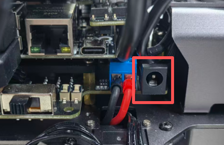

Jetson Nano Controller Power Supply
Wired Connection

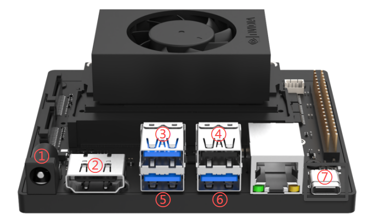

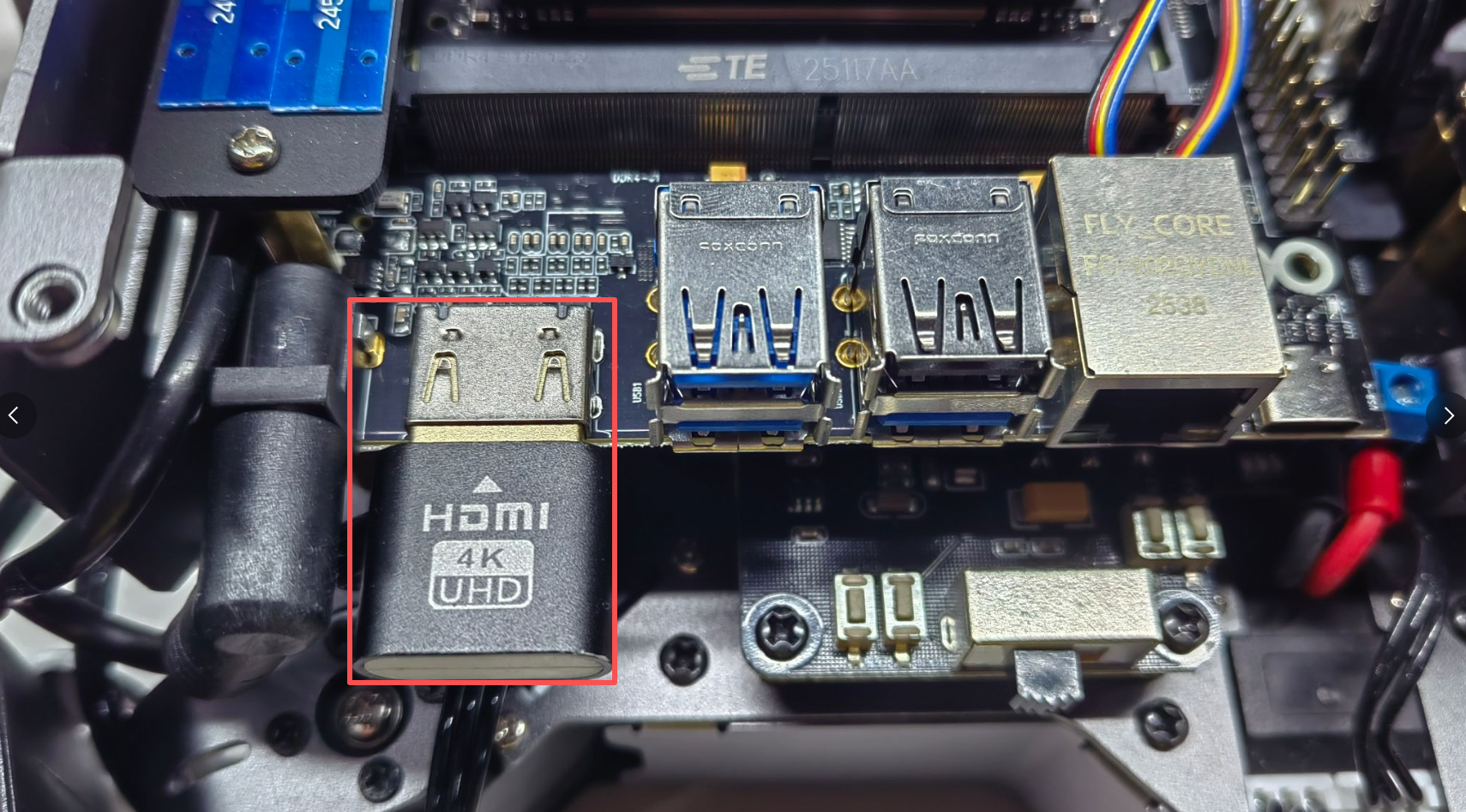

  • Jetson Orin Nano/Orin NX Controller
The following figure illustrates the interfaces connecting various modules to the Jetson Orin Nano controller in the flagship edition. Wiring can be performed according to the standards in the table below. Skip this interface if the purchased package does not include the relevant modules.
Jetson Orin Nano Controller Power Supply
Virtual Display Emulator HDMI / DP
Custom Expansion
Wired Connection

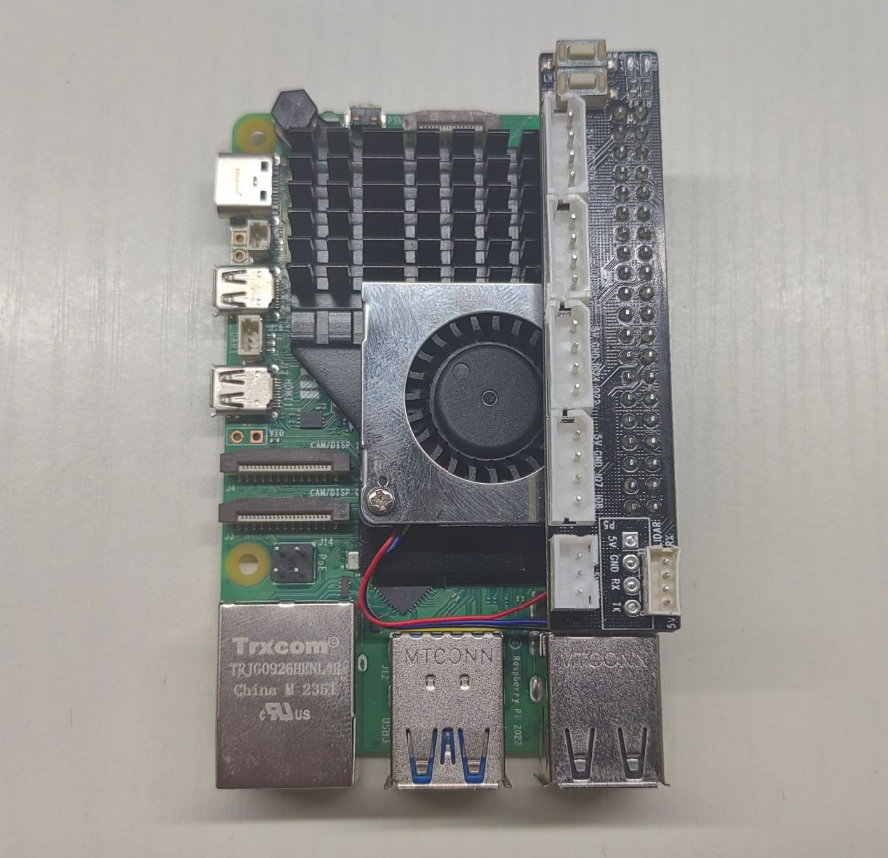

  • Raspberry Pi 5 Controller
Custom Expansion

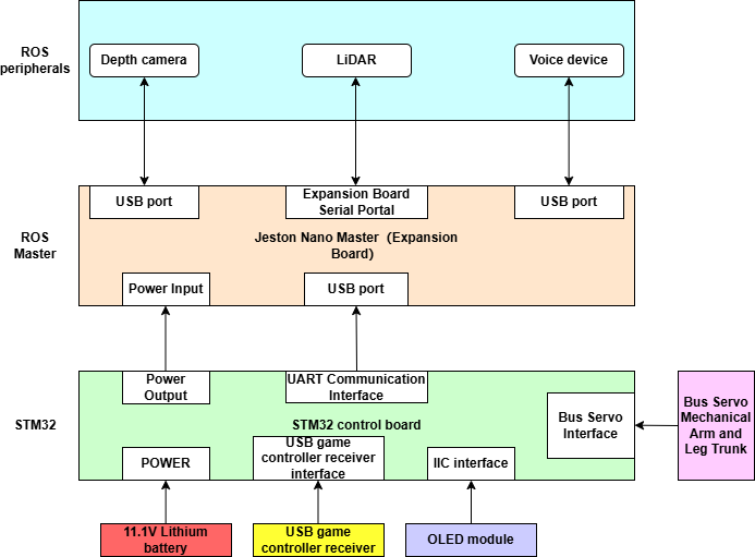

1.2.2.2 Hardware System Connection Diagram
The robot hardware connection system diagram based on the ROS controller Jetson Nano is shown below:

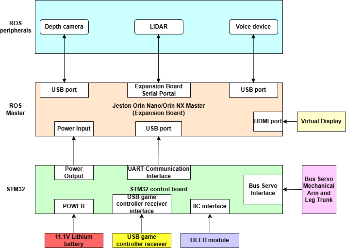

The robot hardware connection system diagram based on the ROS controller Jetson Orin Nano/Orin NX is shown below:

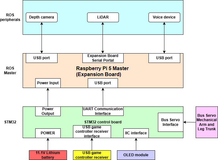

The robot hardware connection system diagram based on the ROS controller Raspberry Pi 5 is shown below:

Raspberry Pi 5:
The robot uses Jetson Nano, Jetson Orin Nano/Orin NX, or Raspberry Pi 5 as the ROS controller. It consists of a Jetson/Raspberry Pi controller and an expansion board. The controller is a compact yet powerful computer capable of running mainstream deep learning frameworks, satisfying the computing power required for most artificial intelligence projects.
The expansion board routes out LEDs and buttons, making it convenient to check the network status via LED flashes and to switch network modes via a mobile phone. It also reserves GPIO and I2C interfaces, as well as a LiDAR communication interface.
The controller is installed with the Ubuntu 22.04.5 system, along with the ROS2 Humble robot operating system environment.

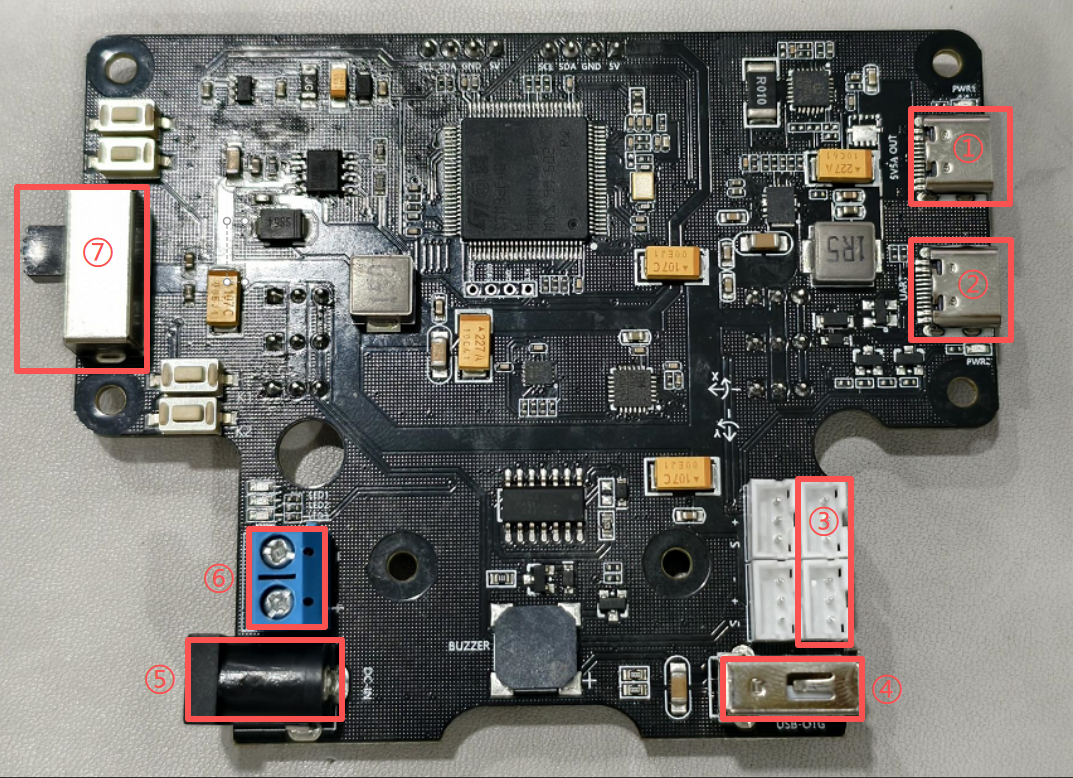

1.2.3.2 STM32 Controller
No. Function Description
5V output port for Jetson Nano/Raspberry Pi 5 power supply
UART serial port for communication with the main controller
Jetson Orin Nano/Orin NX power supply port and robotic arm servo port
USB wireless controller receiver port
12.6V charger port
Lithium battery power supply port
Power switch

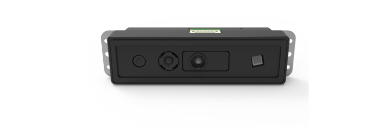

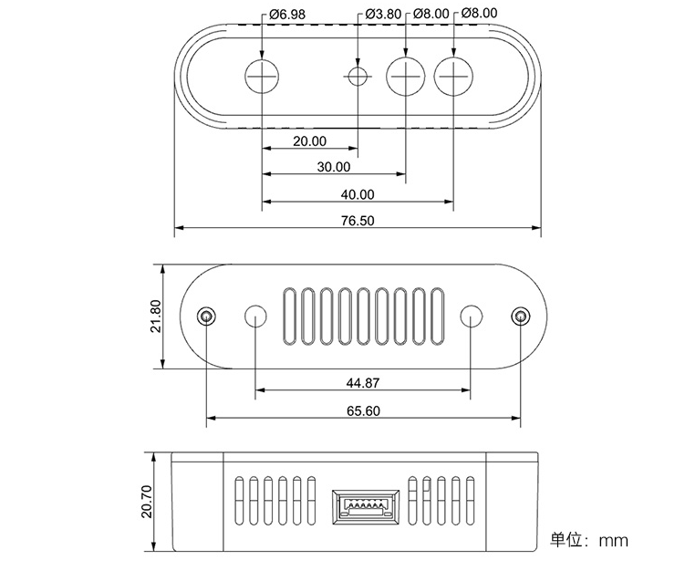

1.2.3.3 Depth Camera
As one of the most critical components in the robot structure, the camera functions similarly to human eyes.
This robot utilizes the Orbbec Binocular Structured Light Depth Camera Aurora930. The Deptrum® Aurora 930 series depth camera uses 3D structured light technology to acquire the three-dimensional structure of objects and spaces, fusing the RGB image of the color camera with depth data to provide convenient and efficient 3D perception capabilities.
Within the robot, it is primarily used to implement functions related to OpenCV, while also supporting visual applications such as deep learning and KCF object tracking. For fundamental courses on the depth camera, please refer to the tutorial Monocular and Depth Camera Foundation Course\Depth Camera Basics Study.
Specific camera parameters are shown in the table below:
Parameter Category Parameter Name Parameter Details
Module Parameters Overall Dimensions 76.5*20.7*21.8 mm
Baseline 40mm
Interface USB 2.0 Wafer Interface
Depth Accuracy 8mm@1m
Depth Precision 3mm@0.5m, 7mm@1m
Working Distance 30~300cm
Operating Temperature -10℃~55℃
Operating Humidity 0%~95%, non-condensing
Operating Illuminance 3~6000Lux
Power Supply 5V±10%, 1.5A
Device Power Consumption Overall Power Consumption Avg<1.6W
Safety Class 1 Laser Safety
Image Performance Depth Data Format Raw 16
Depth Resolution/Frame Rate 640*400 (320*240) / 5~15fps/ H71° x V46°
Color Data Format NV12
Color Resolution/Frame Rate 640*400 (320*240) / 5~15fps/ H71° x V46°
Infrared Data Format Raw 8
Infrared Resolution/Frame Rate 640*400 (320*240) / 5~15fps/ H71° x V46°
System Compatibility System Compatibility Linux/armv8/ROS/windows/Android
3D camera products may exhibit individual differences. Product specifications are theoretical values for reference only; please refer to actual performance.

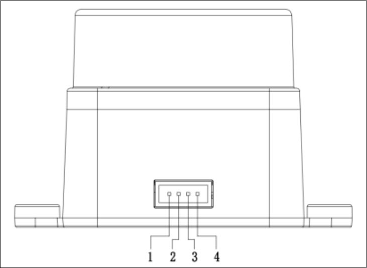

1.2.3.4 LiDAR
LiDAR is a sensor that acquires precise location information through laser beams. LiDAR has numerous application scenarios; those related to the robot’s functions include radar obstacle avoidance, following, SLAM mapping, and navigation. For courses related to LiDAR, please check the LiDAR Course.
This robot can be equipped with the LD19 LiDAR. This radar primarily consists of a laser ranging core, a wireless power transmission unit, a wireless communication unit, an angle measurement unit, a motor drive unit, and a mechanical shell. After power-on, the rotation speed stabilizes to 10±0.1Hz within 3 seconds. It also provides a PWM external input interface to support external speed control. After the external control unit obtains the rotation speed, closed-loop control is performed via the PID algorithm, and a PWM signal is input to make the LD19 reach the specified rotation speed.
The LD19 LiDAR uses a ZH1.5T-4P 1.5mm connector to connect with the external system for power supply and data reception. Specific interface definitions and parameter requirements are detailed in the figure and table below:
No. Signal Name Type Description Min Typ Max
1 Tx Output Radar data output 0V 3.3V 3.5V
2 PWM Input Motor control signal 0V 3.3V
3 GND Power Power ground 0V
4 P5V Power Positive power supply 4.5V 5V 5.5V

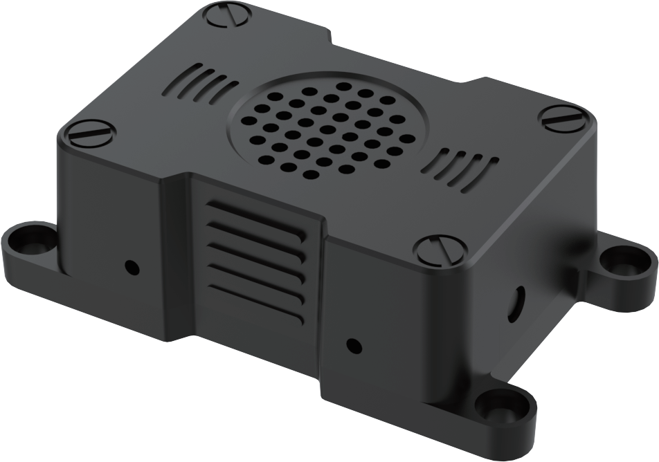

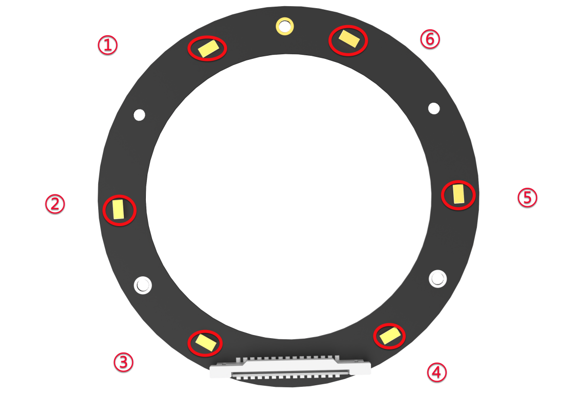

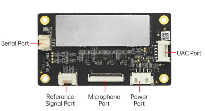

1.2.3.5 6-Microphone Array Module
This module is an optional hardware component. It enables voice wake-up and voice control functions on the robot. For courses related to the microphone array module, please refer to 1. Tutorials\9. Voice Control Course.
This robot utilizes a six-channel microphone array adopting a planar distribution structure. It consists of six microphones that sample and process the spatial characteristics of the sound field. It can perform sound source localization and suppress background noise, interference, reverberation, and echo, achieving 360° equivalent audio reception.
Interface Description
UAC Interface Audio output interface
Reference Signal Interface Amplifier/Echo cancellation reference signal
Independent Power Interface Power input interface used for external power connection
Microphone Interface Connects the 6-microphone array and supports linear microphones
Serial Interface Upper-level computer communication interface, used to communicate with PC or embedded devices
For more information, please consult the 4. Hardware Materials\Microphone Array document content.

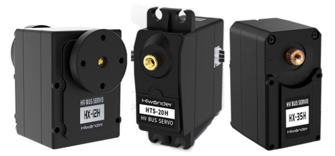

1.2.3.7 Bus Servo
ROSpider is composed of 24 intelligent high-voltage bus servos connected by metal sheet parts. There are three types of servos: HX-12H bus servo, HTS-20H bus servo, and HX-35H bus servo.
For more detailed information, please consult the 4. Hardware Materials\Bus Servo document content.

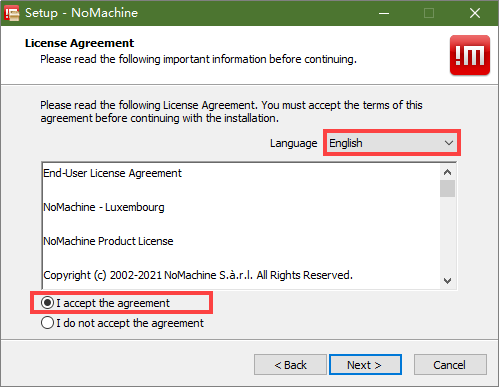

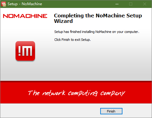

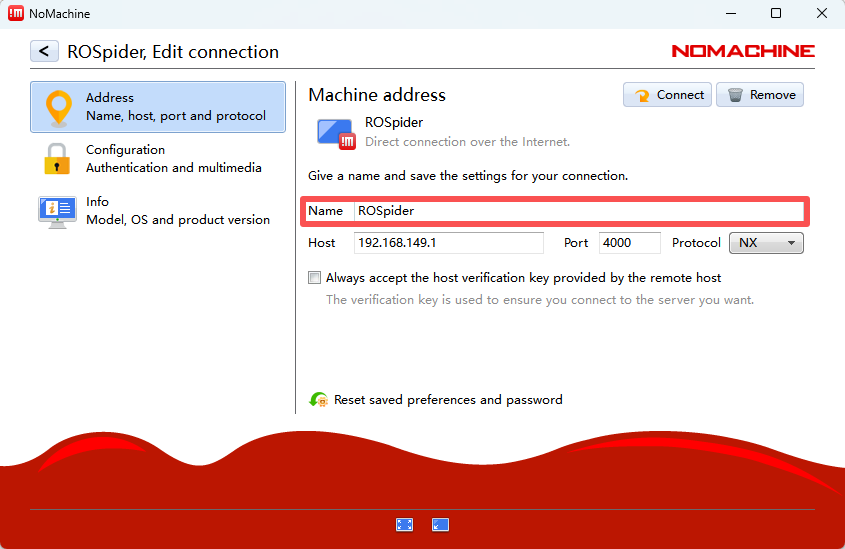

If remote tools are required to connect to the robot for further learning of related applications and to view programs, please refer to the content under section 1.4 Development Environment Setup in this document.

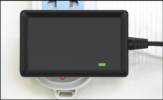

Before using the robot for the first time, ensure that the battery at the bottom of the robot and the adapter cable are properly connected. The two screws at the bottom can be unscrewed to open the sheet metal parts for inspection.
  1. Ensure the robot’s switch is toggled to OFF.
  1. Insert the 12.6V charger plug into the charging port of the STM32 controller from the side to charge.
  1. The charging status can be checked by observing the indicator light on the charger. Red indicates charging, and green indicates charging is complete.
After charging is complete, promptly unplug the charger to avoid battery overcharging.

  7. Inspection requires ensuring correct wiring, correct connection of the virtual display emulator and wireless controller receiver, audio turned on at the top right corner of the desktop, and the robot being fully charged.

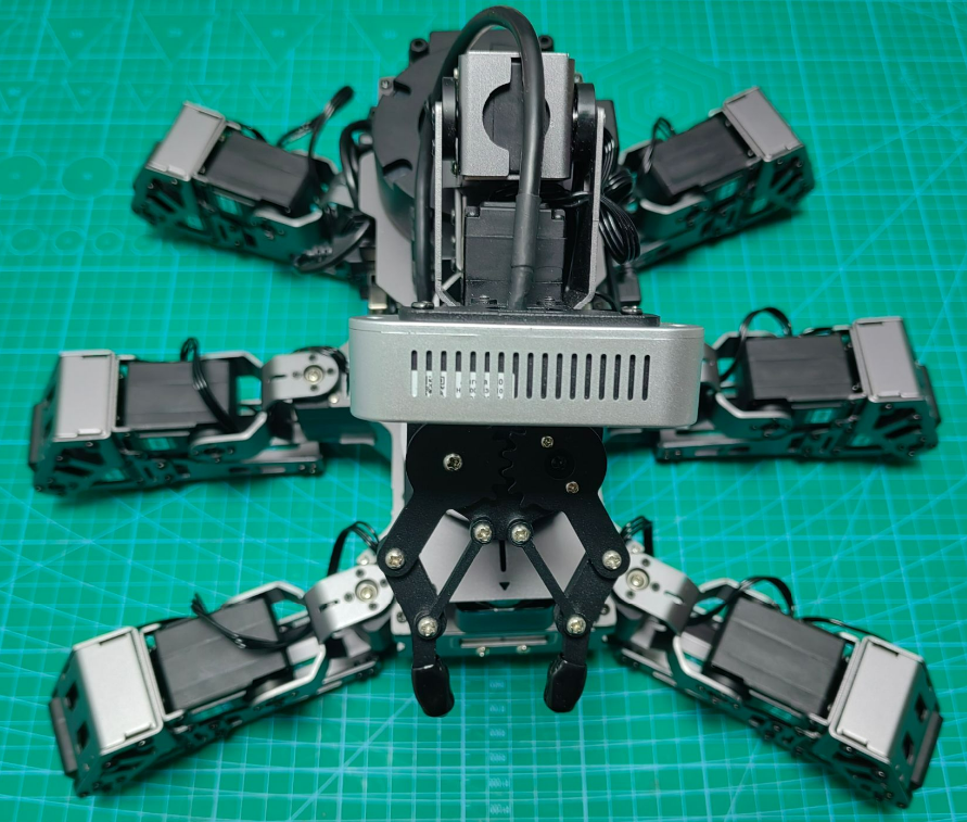

Correct Posture:
Incorrect Posture:

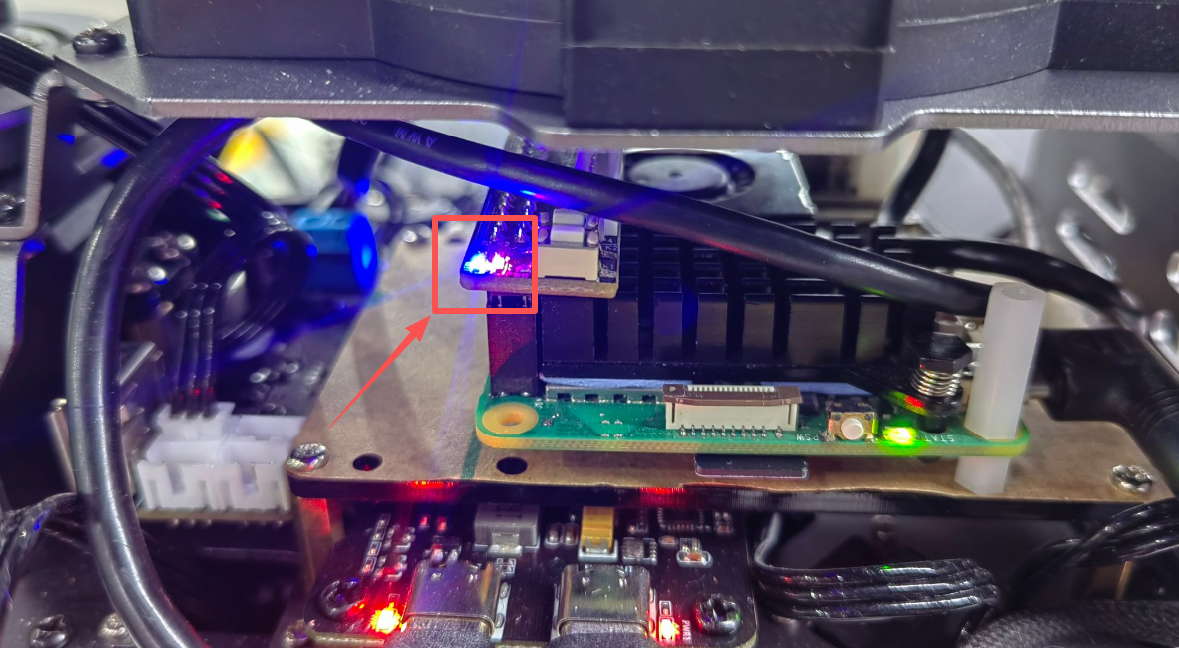

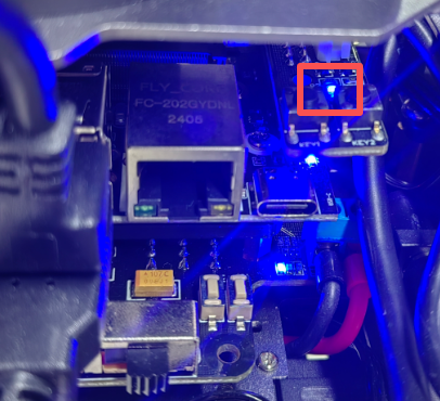

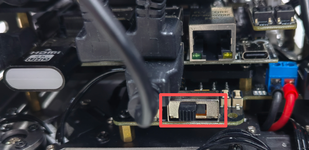

  1. Place the robot on a flat, smooth surface and turn on the switch on the right side of the robot. At this time, the red LED (PWR) light and the blue LED light on the STM32 control board will illuminate and remain steady.
  1. The blue LED 1 at the bottom right of the expansion board will illuminate and keep blinking. At this time, only the network configuration service is started, but the ROS system and other services have not finished booting. Wait for the buzzer to emit a short beep for machine reset, indicating the device has finished booting.

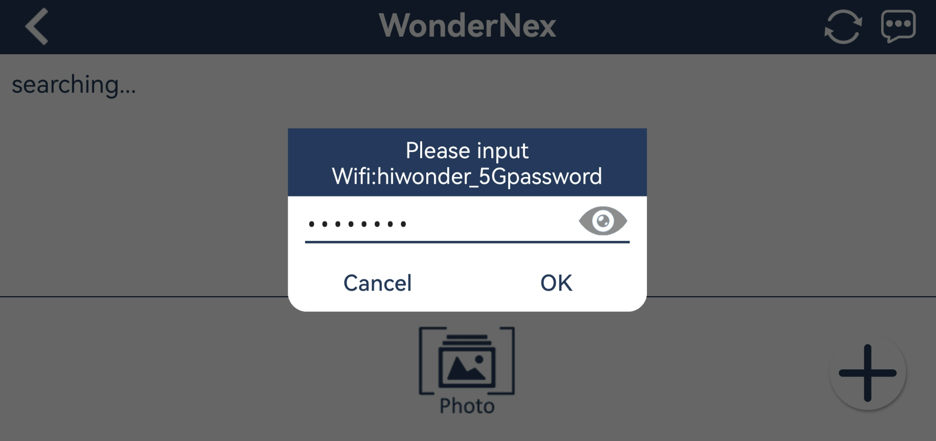

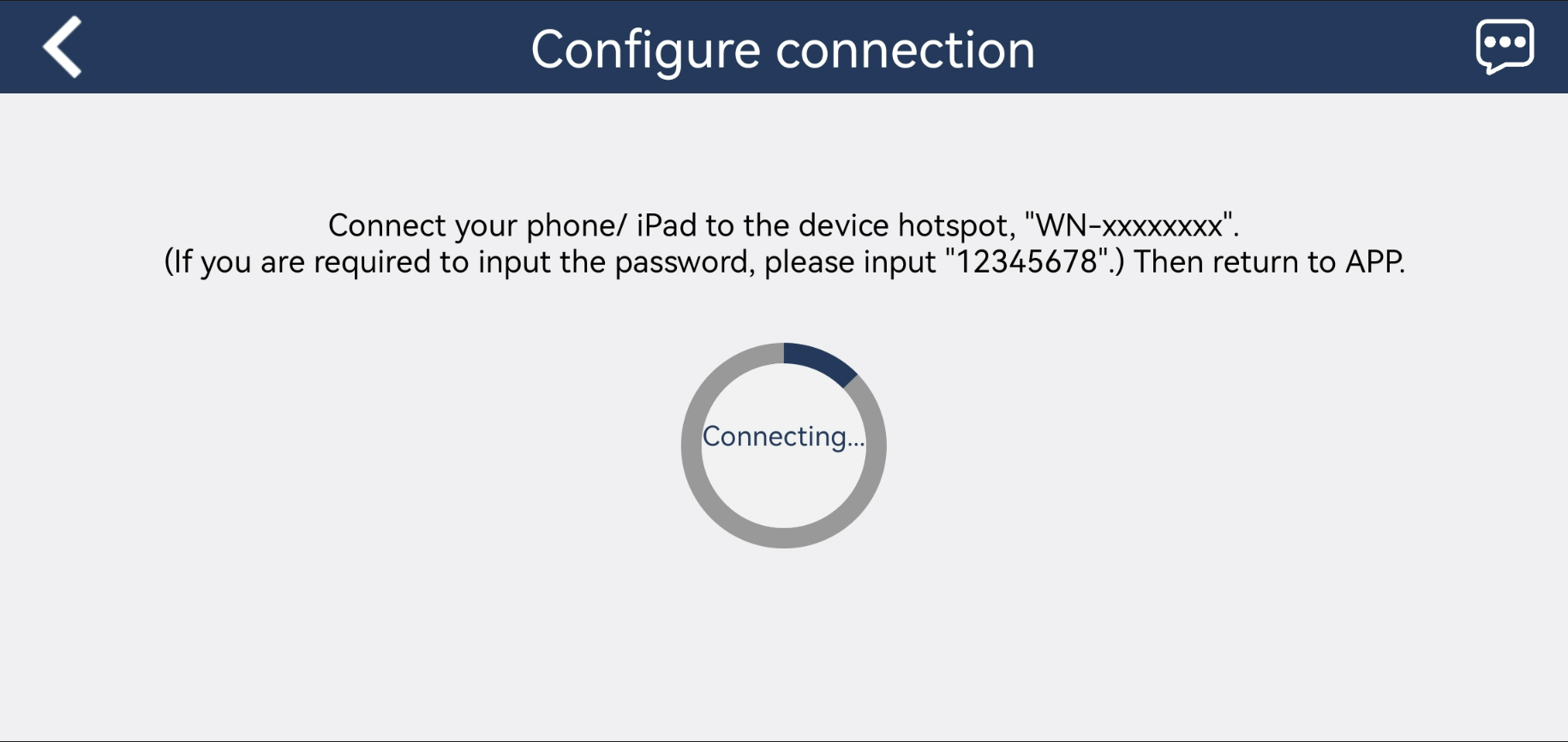

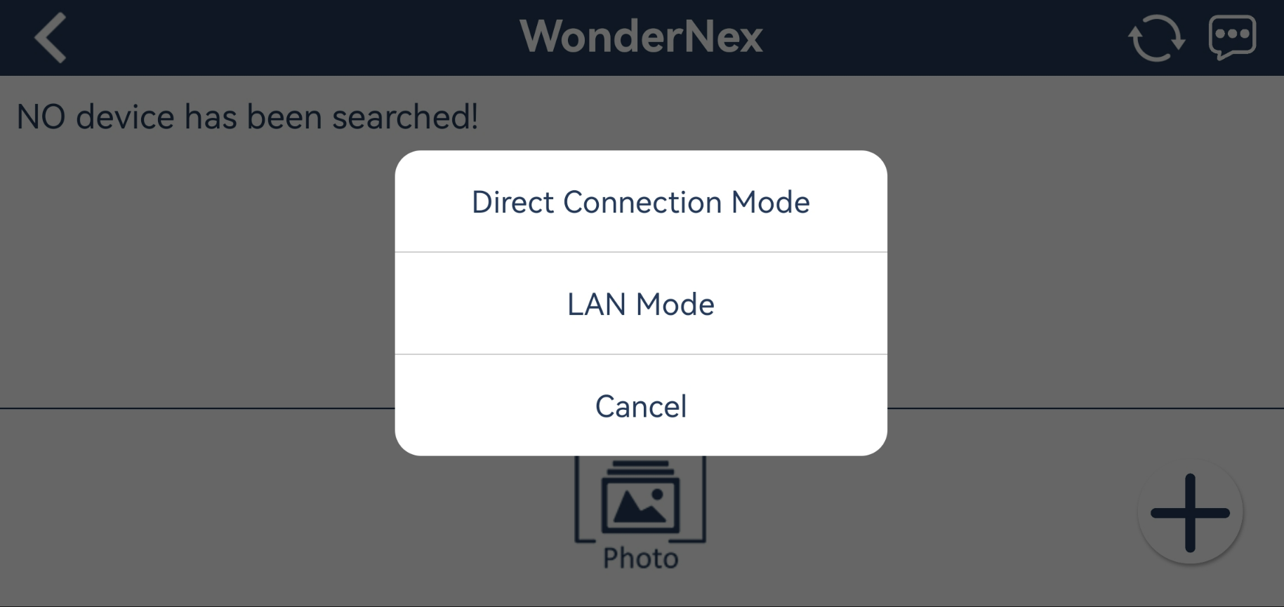

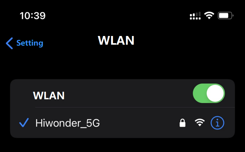

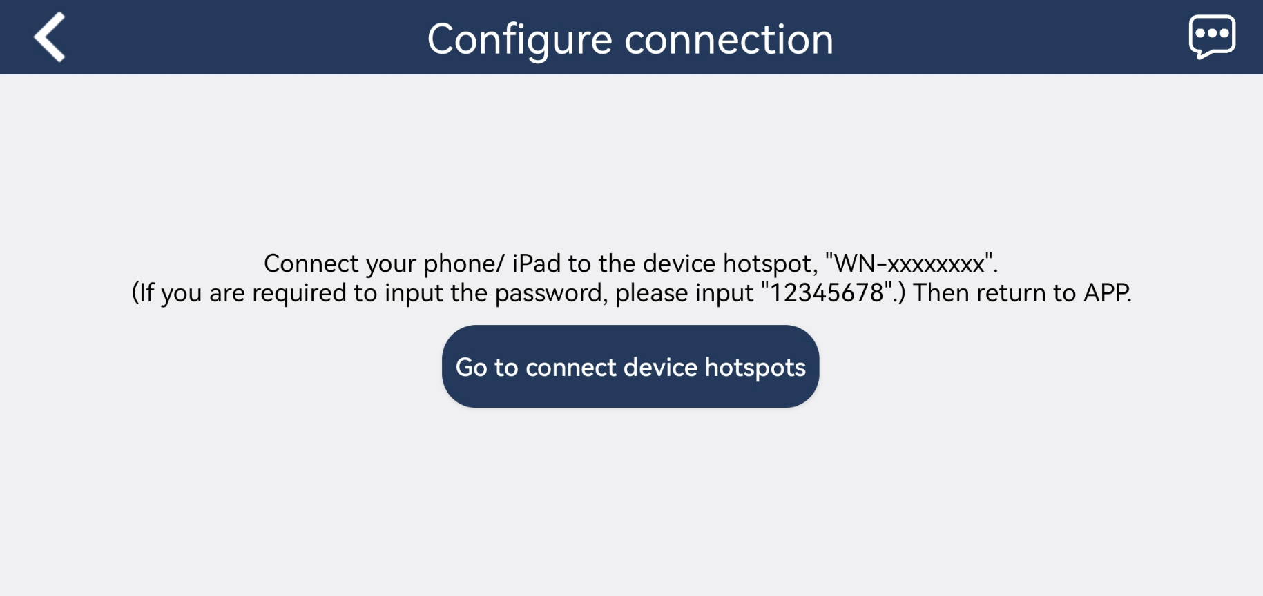

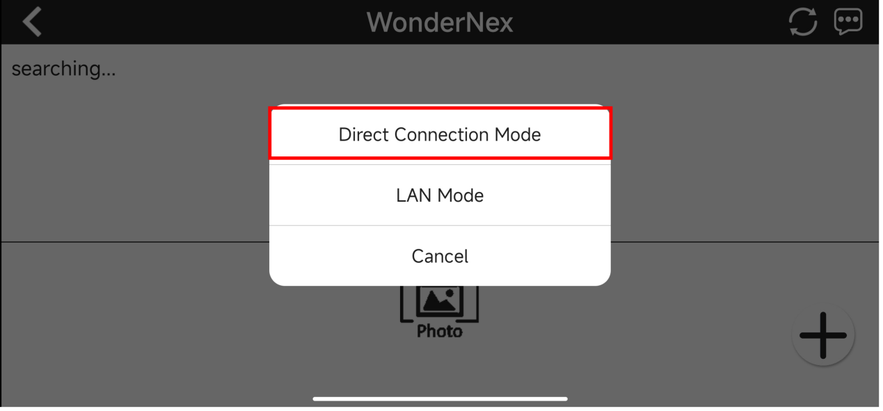

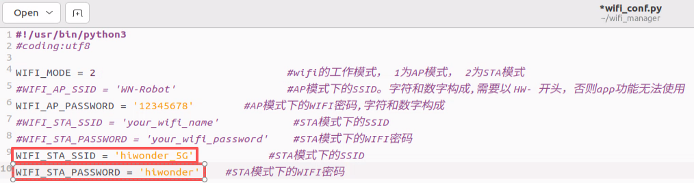

  1. The factory default setting is AP Direct Connection Mode. After a successful boot, a hotspot starting with WN will be generated. The password 12345678 must be entered when connecting via the app or remote desktop.
If the device hotspot cannot be found, troubleshooting can be performed from below:
  • Check step 2 above to ensure whether LED1 on the expansion board is solid blue and blinking.

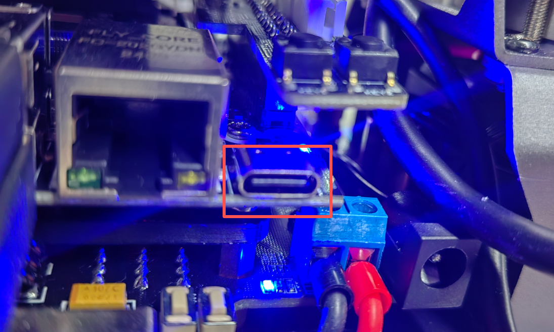

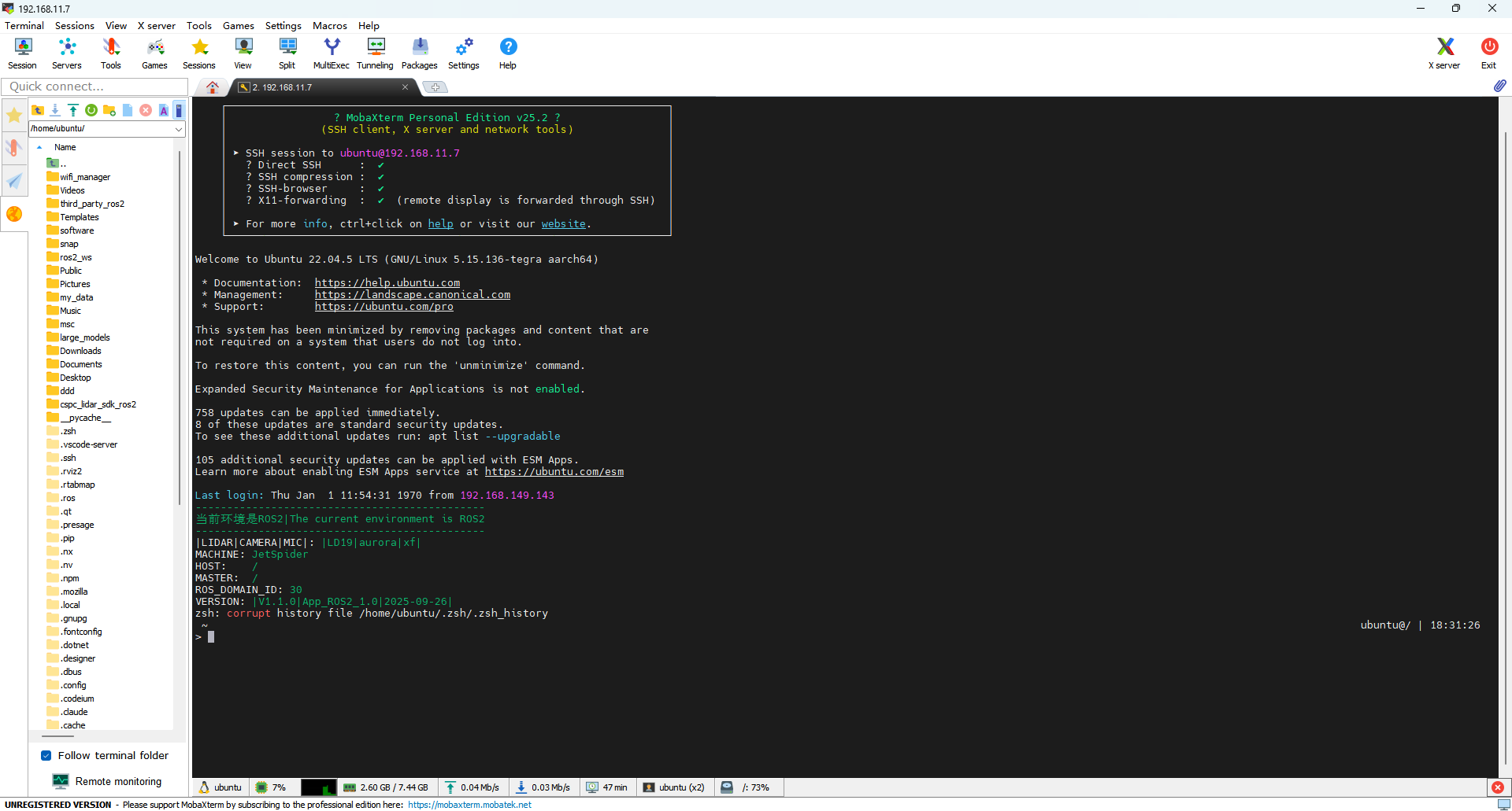

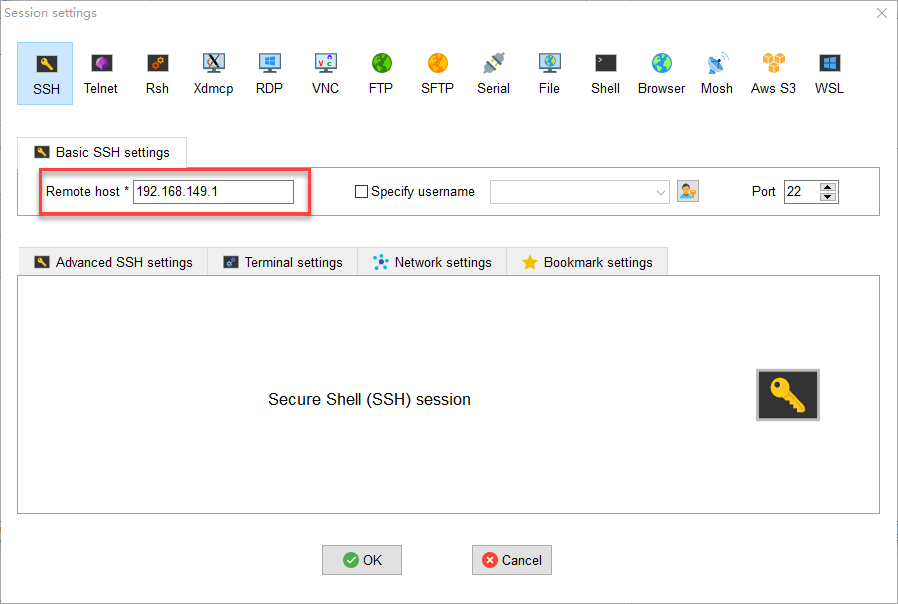

  • Insert a Type-C cable into the Type-C port of the Jetson controller, and remotely connect to the robot system desktop to check if the robot boots normally. For how to remotely connect, please refer to 1.4.2.3 Type-C Data Cable Fixed IP Connection.

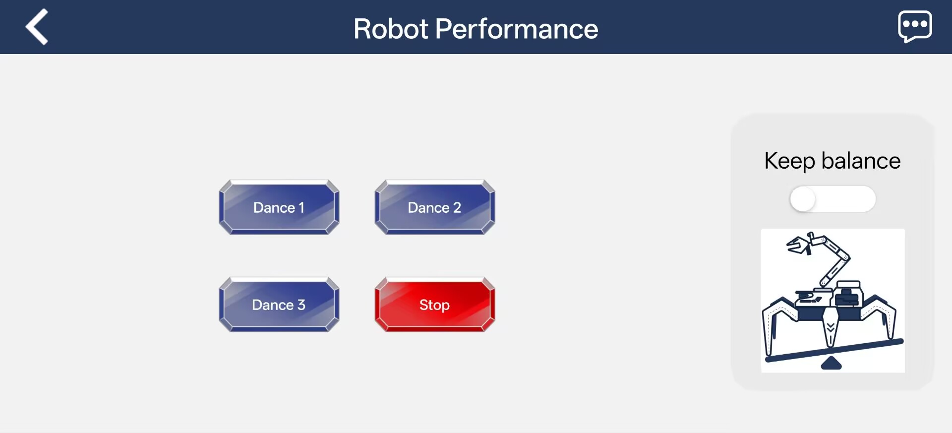

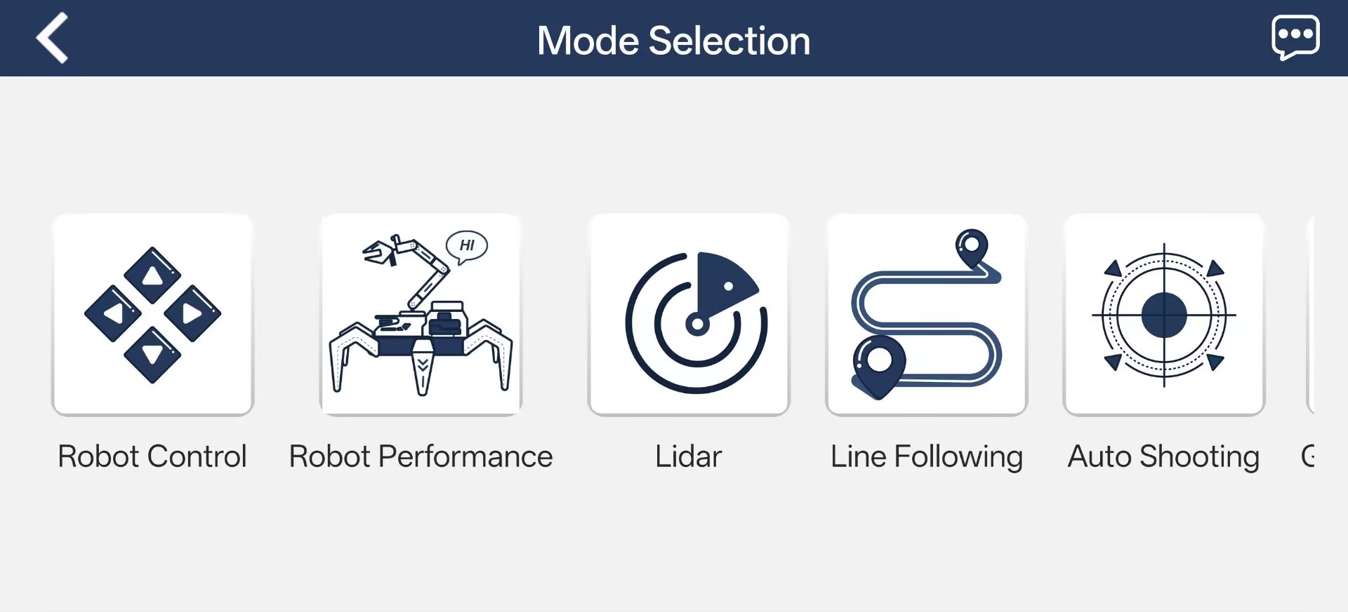

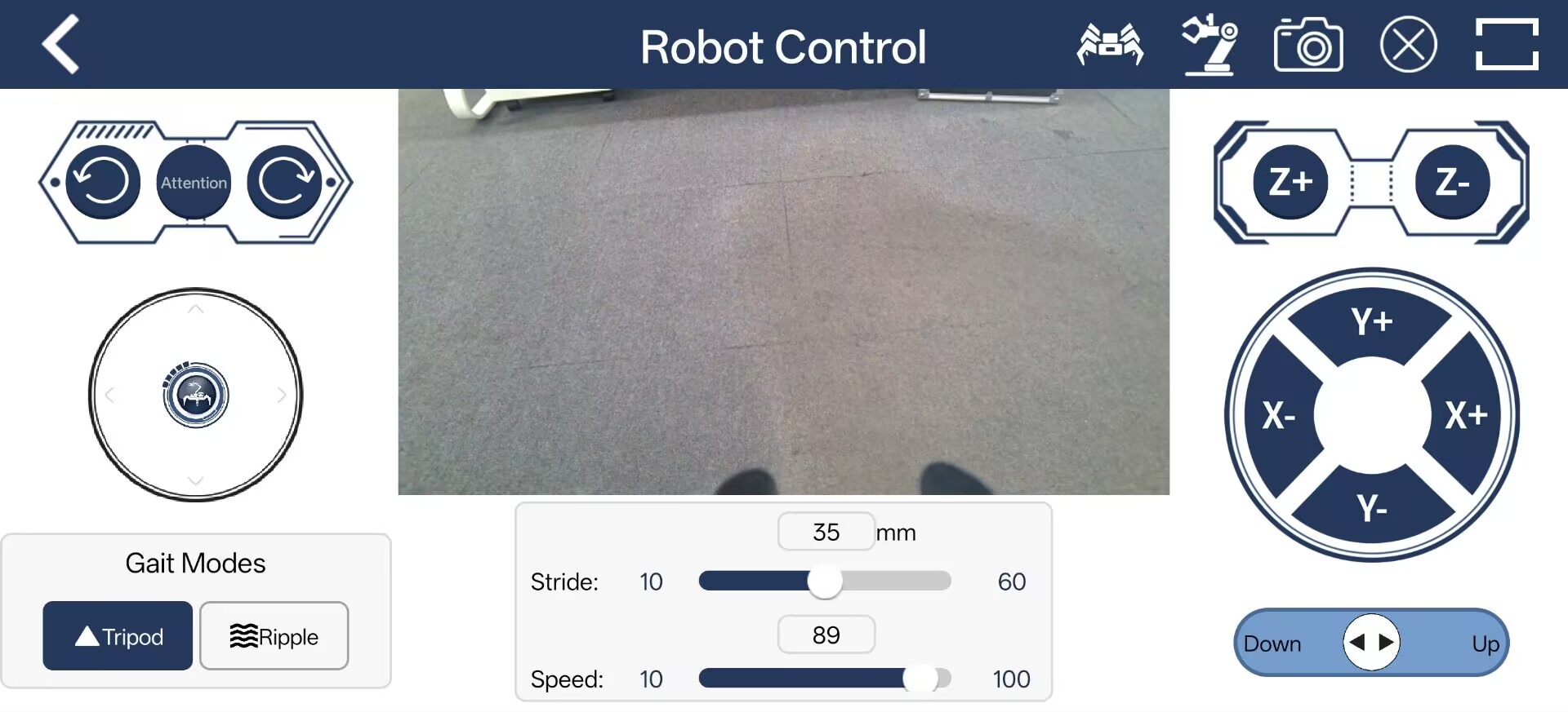

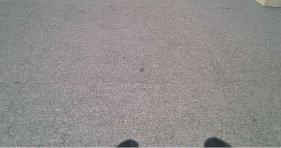

Depth Camera + Robotic Arm 1) Open the app and connect to the robot. 2) Open the "Robot Control" interface to view the current return image from the depth camera. 3) Bring up the robotic arm control buttons and drag each joint servo sequentially. Real-time return image is displayed and servos rotate

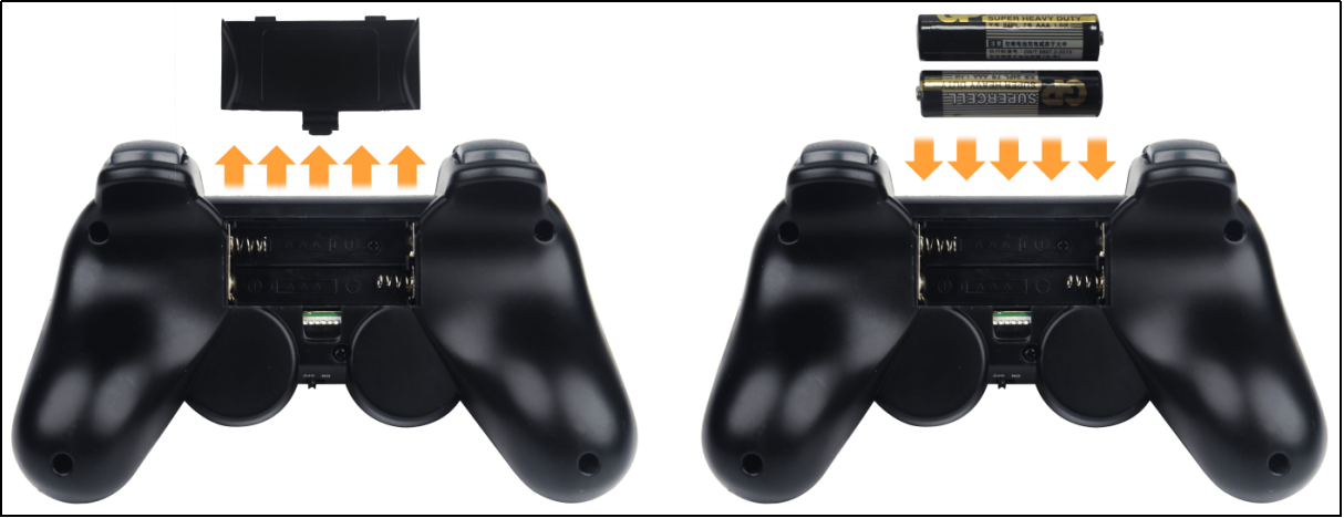

STM32 Controller After booting, control via wireless controller or the app's "Robot Control" interface. The robot can be controlled normally.

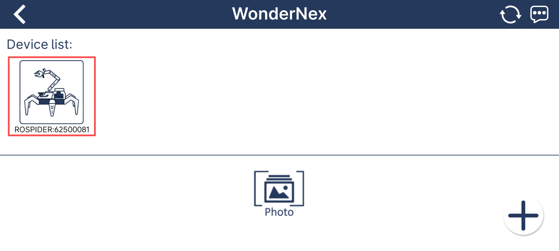

1.3.3 App Installation and Connection

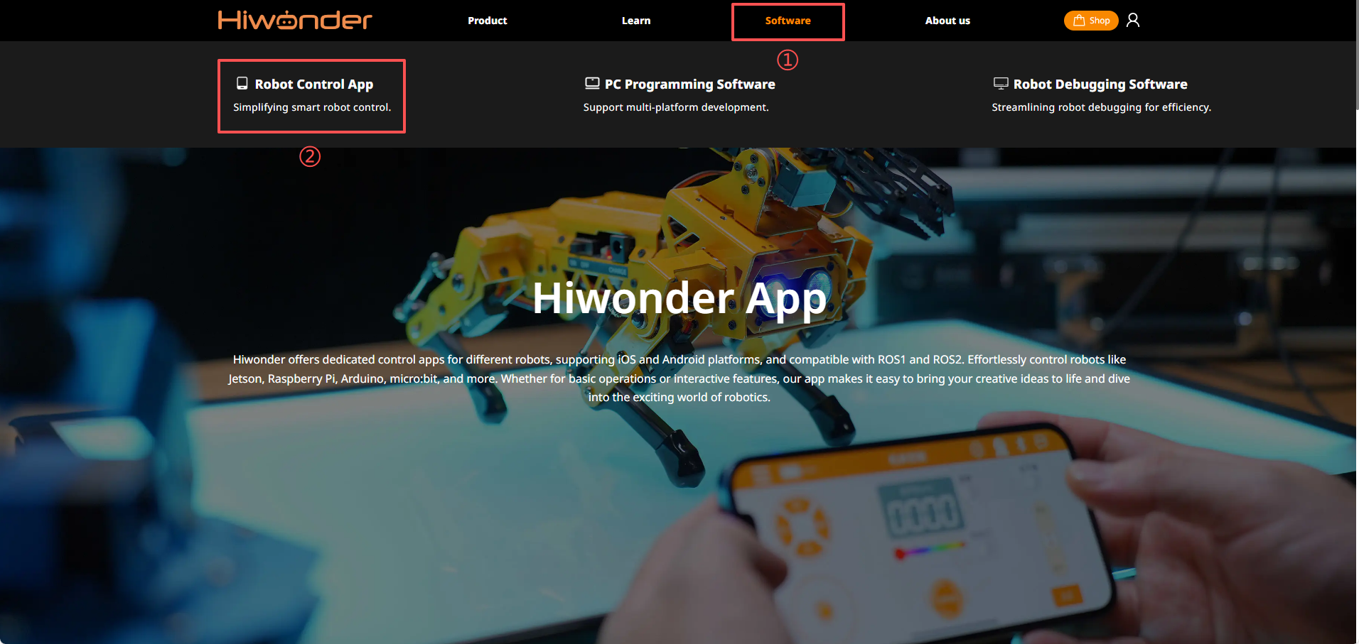

The app WonderNex can be used to control the robot. This section explains how to obtain the app installation package.
There are two ways to obtain the app: one is to download and install from the application store, and the other is to obtain the installation package from the Hiwonder official website.
  • Please grant all permissions to the app to avoid affecting its normal use.
  • Before opening the app, turn on the phone’s GPS location and Wi-Fi functions, and turn off cellular data.

  • Method Two: Hiwonder Official Website
  1. Visit the Hiwonder course official website at https://www.hiwonder.net/app-software.
  1. Click Software and switch to the Robot Control App interface.
  1. Locate WonderNex. The method to obtain the app installation package can be chosen based on actual circumstances.
The following table details feasible download schemes for various situations:

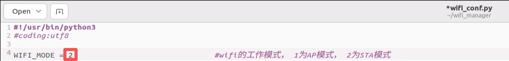

  1. AP Direct Connection Mode: The development board can activate a hotspot to be connected by the phone, but cannot connect to external networks.
  2. STA LAN Mode: The development board can proactively connect to a specified hotspot/Wi-Fi and can connect to external networks.
The robot defaults to AP Direct Connection Mode. Regardless of whether AP Direct Connection or STA LAN Mode is chosen, the robot’s application functions remain identical.
It is recommended to first learn the configuration method of the direct connection mode to experience the corresponding functions, while the LAN mode can be reviewed selectively based on needs.

  1. Open the app WonderNex and tap ROSpider.
  1. Click the + button at the bottom right of the interface and select Direct Connection Mode.
If a LAN mode connection is desired, refer to the directory 1.3.3.4 LAN Mode Connection (Optional).
  1. Click the Go to connect device hotspots button to proceed to the settings interface and connect to the hotspot generated by the robot.
  1. The hotspot name starts with WN, and the hotspot password is 12345678.
In the iOS system, it is necessary to wait for the phone status bar to display the Wi-Fi icon before returning to the app; otherwise, the device may not be found. If the device cannot be found, click the refresh icon at the top right of the app interface .
  1. Return to the app, click the corresponding robot icon to enter the mode selection interface.
If the prompt “Network unavailable, do you want to continue connecting?” appears, simply click the “Keep Connection” button.
  1. If prompted Whether to switch and enter the searched product interface?, it indicates an incorrect product selection in Step 1. Click the OK button to switch directly to the mode selection interface of the correct version.
  1. The mode selection interface is shown as follows:
  1. First connect the phone to a 5G network. Here, connecting to the “Hiwonder_5G” Wi-Fi is taken as an example. For dual-band routers, when dual bands are configured separately, the Wi-Fi names are separated by default. For instance, Hiwonder is the 2.4G band, and 5G is the 5G band.
  1. Open the app WonderNex and click ROSpider.
  2. Then click the + button at the bottom right and select LAN Mode.
  1. The app will prompt for the password of the connected Wi-Fi. Please confirm whether the entered password is correct, because an incorrect entry will lead to connection failure. Once entered, click OK.
  1. Then click Go to connect device hotspots.
  1. It will automatically redirect to the Wi-Fi connection page. Locate the hotspot starting with WN, enter the password 12345678, and then click the Return icon upon completion.
  2. At this point, the app will be observed to have started connecting.
  1. Wait a moment, the main interface will display the corresponding robot icon and name, and LED1 on the expansion board will remain steady.

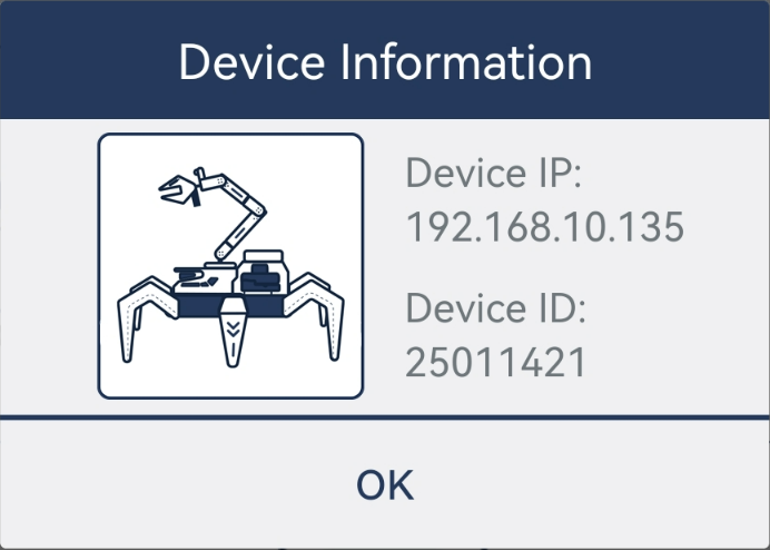

  2. Long-press the robot icon in the app to view the IP address and device ID assigned to the robot.

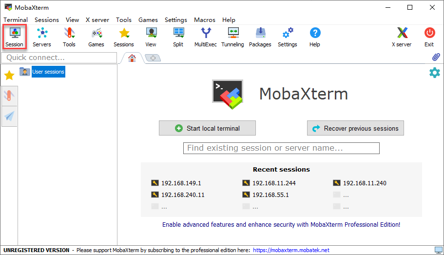

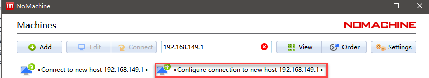

  1. Its IP address can be searched on a remote desktop connection tool to establish a connection. Specific connection methods can be referred to in the 1.4 Development Environment Setup course content.

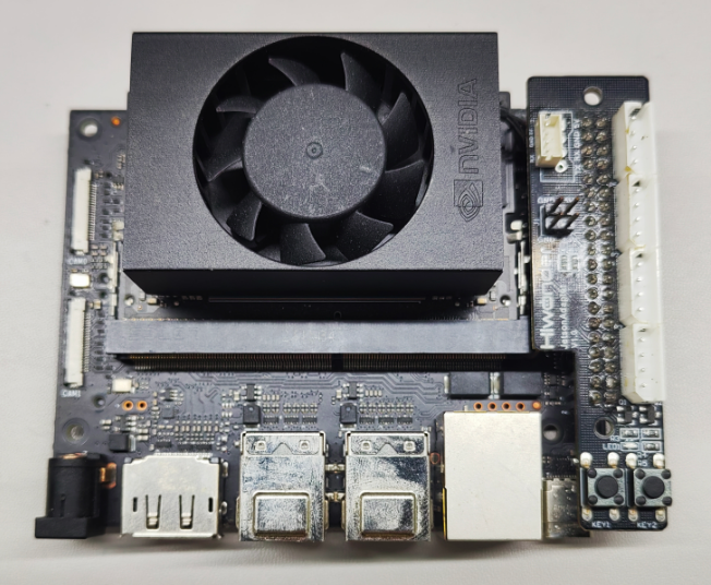

  2. To switch the LAN mode back to the direct connection mode, long-press the KEY1 button on the expansion board until the blue light blinks, indicating the switch is complete.

1.3.4.2 App Application Overview
The app provides 6 application modes: Robot Control, Robot Performance, LiDAR, Line Following, Target Tracking, and Gesture Control.
The following table presents a brief description of each application mode:
Icon Application Mode Description
Body Remote Control Controls the movement of the robot, allows switching of gaits, and adjusts parameters such as stride length, speed, and pitch angle.
Robot Performance Can execute built-in action groups and custom action groups, and the self-balancing function can be enabled.
LiDAR Provides three modes: LiDAR obstacle avoidance, LiDAR following, and LiDAR guarding.
Line Following Prepares lines, select the line color as the target recognition color, and the robot will travel along the line.
Auto Shooting Select the color of the target object, and the robot will track it.
Gesture Control Recognizes specific gesture actions, and the robot will provide corresponding feedback.
1.3.4.3 Robot Control
  • Interface Introduction
Click Robot Control in the mode selection interface to enter the operational interface for this application.
  • Function Description
Icon Function Description
The buttons on both sides are used to control the robot's left and right rotation. The "Attention" button is used to restore the robot to its initial posture.
Dragging the joystick controls the hexapod robot to move forward, backward, left, and right.

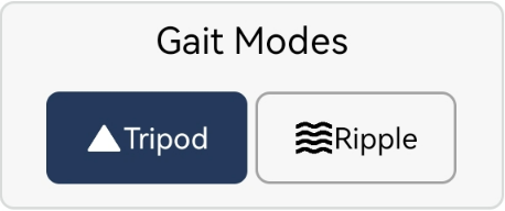

Selects the robot's movement gait.
Displays the current real-time image return.

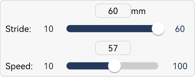

Adjusts the robot's movement stride, numerical range is 10-60.
Adjusts the robot's movement speed, numerical range is 10-100.
Adjusts the height of the robot body.
From the robot's first-person perspective, the "Z+" button controls the hexapod robot to twist left, and the "Z-" button controls the hexapod robot to twist right.
From the robot's first-person perspective, the "Y+" button controls the hexapod robot to pitch forward, i.e., body lower in front and higher in back.
The "Y-" button controls the hexapod robot to pitch backward, i.e., body higher in front and lower in back.
The "X-" button controls the hexapod robot to tilt left, i.e., body lower on the left and higher on the right.
The "X+" button controls the hexapod robot to tilt right, i.e., body higher on the left and lower on the right.
Add executable action group.
Controls the movement of the robotic arm.
1.3.4.4 Robot Performance
Click Robot Performance in the mode selection interface to enter the operational interface for this application.
  1. The left side of the interface is the action group selection area, offering built-in actions and custom actions for selection.

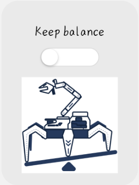

  2. The right side of the interface is the self-balancing function switch area.
Click the button to control the robot to execute built-in action groups and custom action groups.
Enable/disable the self-balancing function of the hexapod robot.****

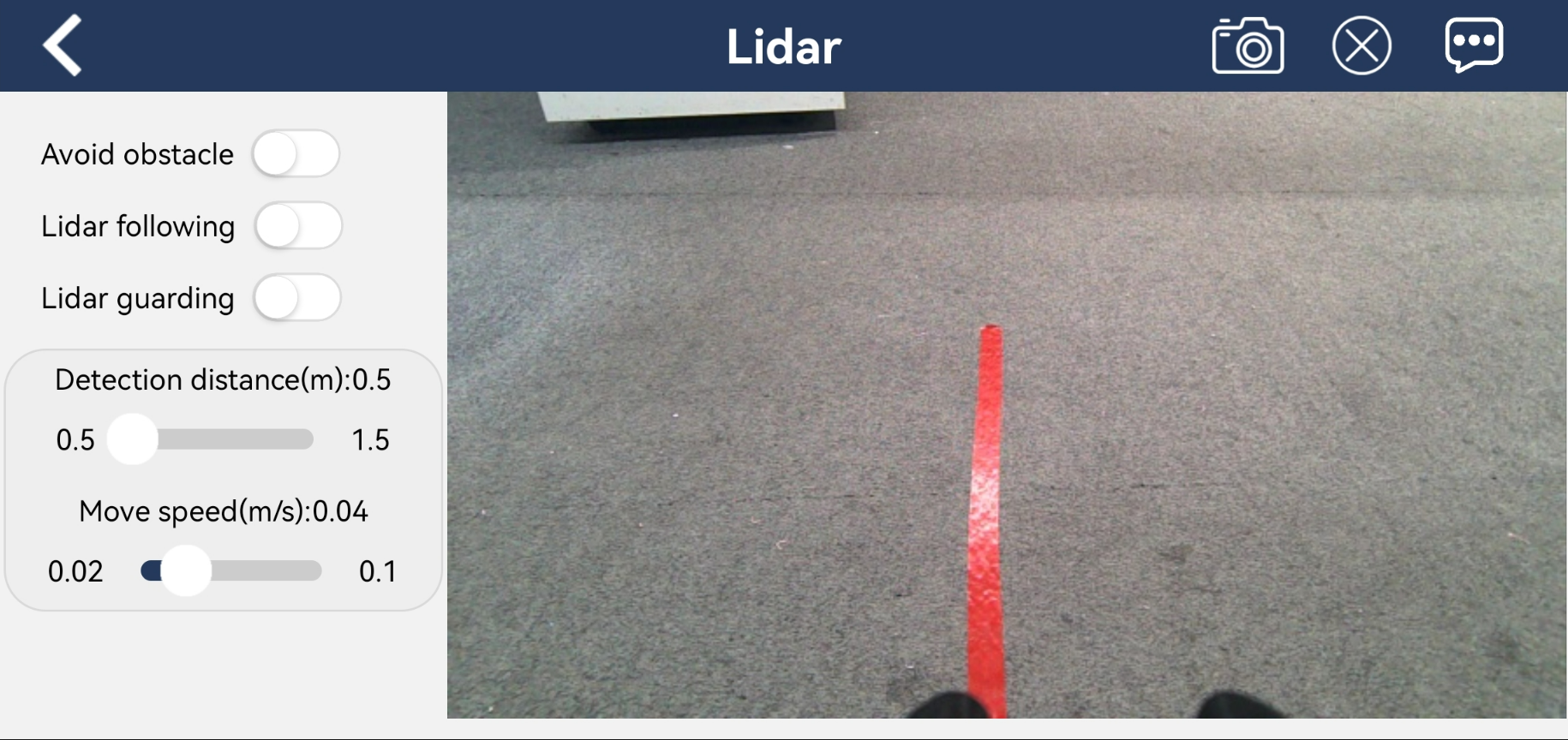

1.3.4.5 LiDAR
Click LiDAR in the mode selection interface to enter the operational interface for this application. This interface can be divided into two parts:
  1. The left side of the interface is the feature switch and parameter adjustment area.
  2. The right side of the interface is the camera return image display area.
Enable/disable the LiDAR obstacle avoidance application.
Enable/disable the LiDAR following application.
Enable/disable the LiDAR guarding application.

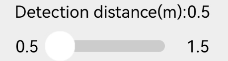

Adjusts the detection distance of the radar, numerical range is 0.5-1.5, unit is meters (m).

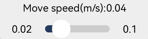

Adjusts the movement speed of the hexapod robot, numerical range is 0.02-0.1, unit is meters per second (m/s).
  • Operation Steps and Outcome
In this application, the LiDAR’s detection range is an unobstructed fan-shaped area in front. After starting the application, please place obstacles within the effective detection area, otherwise, the implementation of the feature may be affected.
  1. Avoid Obstacle Click the switch button on the right of Avoid obstacle to start this feature, and ROSpider will continuously move forward. When an obstacle is detected, ROSpider will automatically steer to avoid the obstacle.
  2. LiDAR Following Click the switch button on the right of LiDAR following to start this feature. When an obstacle is detected, ROSpider will adjust its position to maintain a certain distance between the body and the obstacle.
  3. LiDAR Guarding Click the switch button on the right of LiDAR guarding to start this feature. When an obstacle is detected, ROSpider will adjust its body orientation so that the body faces the obstacle.

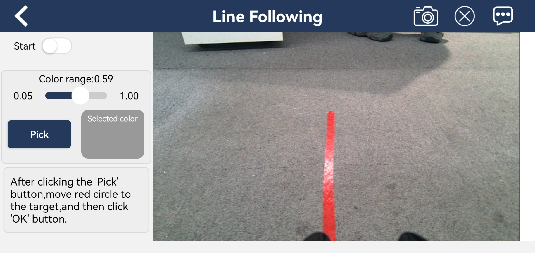

1.3.4.6 Line Following
  • Before starting the feature, please lay out a tracking track with tape and place the robot on the track.
  • The color picking range should be moderate, neither too large nor too small. An overly large range will include colors other than the target, while an overly small range easily loses the target. At the same time, objects with colors similar to the target color should not appear in the camera’s view.
  • After starting the feature, ensure that there are no other objects containing the target recognition color within the camera’s field of view to avoid affecting the implementation results of the feature.
Click Line Following in the mode selection interface to enter the operational interface for this feature. This interface can be divided into two parts:
  1. The left side of the interface is the feature switch and color picking area.
Enable/disable application.

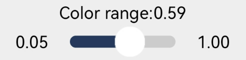

Adjusts the color threshold range, numerical range is 0.05-1.00.
Extracts the color of a designated area within the return image.
Displays the extracted color.
After clicking the "Pick" button, the button switches to the "OK" button. Used to confirm the extracted color.
Displays the current camera image.
  1. After clicking the Pick button, drag the circle within the return image to the track to select the color.
  2. After clicking the OK button, the currently selected color will be displayed at Selected Color.
  3. Click the Start button to launch the feature, and the robot will travel along the track.

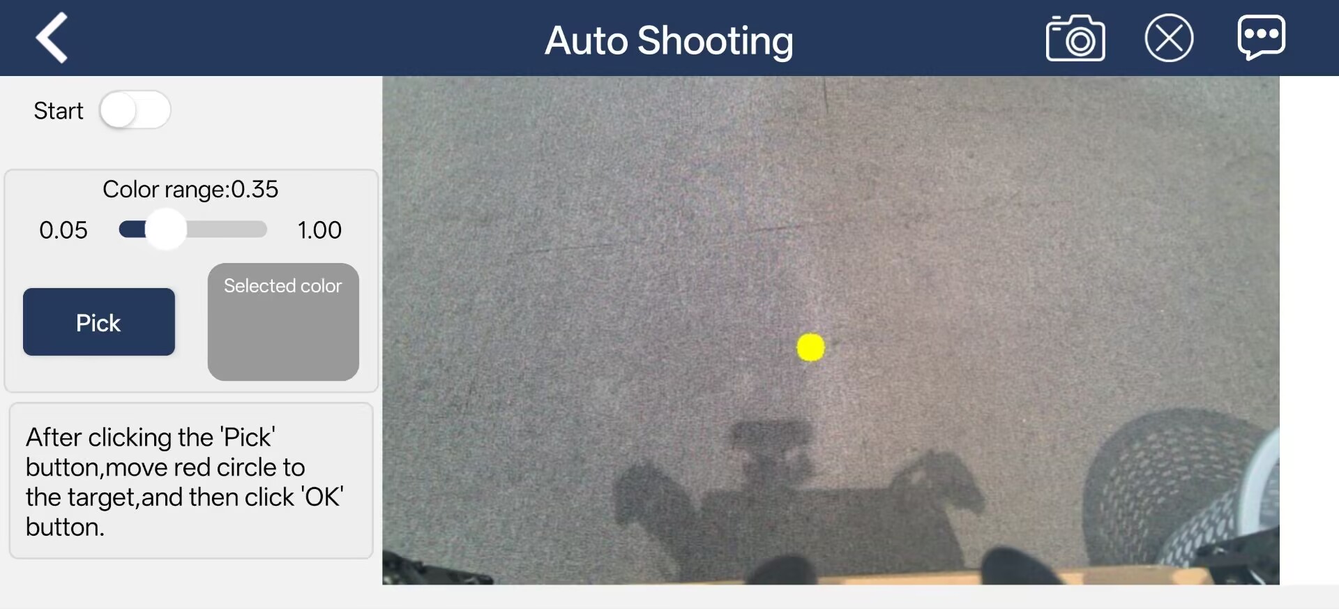

1.3.4.7 Auto Shooting
  • Ensure the target object and the robot are on the same ground level, and move the target object translationally. This provides a better experience.
Click Auto Shooting in the mode selection interface to enter the operational interface for this feature. This interface can be divided into two parts:
  1. After clicking the Pick button, drag the circle within the return image to the ball to select the color.
  2. After clicking the OK button, the currently selected color will be displayed in the Selected Color area.
  3. Click the Start button to launch the feature, and the robot will track the ball and kick it.

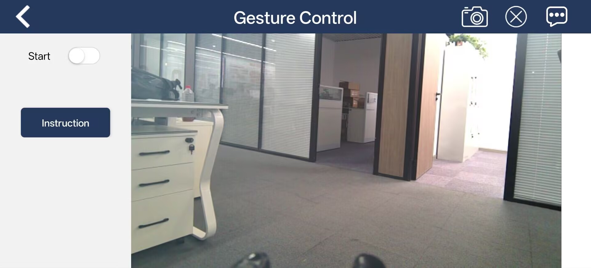

Click Gesture Control in the mode selection interface to enter the operational interface for this feature. This interface can be divided into two parts:
  1. The left side of the interface is the feature switch and operation instructions.
Enable/disable feature.
Click to obtain operation help.****
Click the Start button to launch the application. Perform different gestures, and the robot will provide different action feedback.

  • If the robot’s mainboard is a Jetson Orin Nano/Orin NX, the HDMI virtual display emulator must be connected to the controller interface for the remote connection desktop to display correctly.

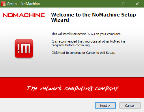

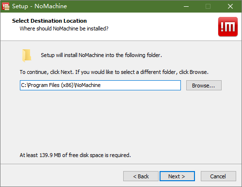

NoMachine is a graphical remote control software. Upon installation, the robot can be controlled directly on a computer by connecting to the robot’s hotspot. Prior to starting, it is recommended to prepare a 5G band wireless network card for desktop computers to ensure a better experience.
Installation steps are as follows:
  1. Enter the directory of this document, navigate to folder 2. Softwares\2. Remote Desktop Software\1. Graphical Remote Desktop Access Tool, and double-click to open the installation package nomachine_8.4.2_10_x64.exe.
  2. Click the Next button.
  1. Select the installation language as English, check to accept the license agreement, and click the Next button.
  1. Keep the default installation location and click the Next button.

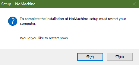

  1. Wait a moment until the installation completion prompt interface appears, then simply click the Finish button.
  1. Click the Yes button to restart the computer. Do not skip this step!

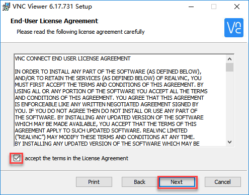

Raspberry Pi 5 Controller:
VNC is a graphical remote control software. Upon installation, the robot can be controlled directly on a computer by connecting to the robot’s hotspot. Prior to starting, it is recommended to prepare a 5G band wireless network card for desktop computers to ensure a better experience.
  1. Enter the directory of this document, navigate to folder 2. Softwares\2. Remote Desktop Software\1. Graphical Remote Desktop Access Tool, and double-click to open the installation package VNC-Viewer-6.17.731-Windows .exe.
  2. Select the installation language as English and click the OK button.
  1. Click the Next button.
  1. Check to accept the license agreement, and click the Next button.
  1. In the newly popped-up page, click Install.
  1. Once the VNC installation is complete, simply click the icon to launch it.

AP Direct Connection Mode: The development board can activate a hotspot to be connected by a phone, but cannot connect to external networks.
Jetson Series Controller:

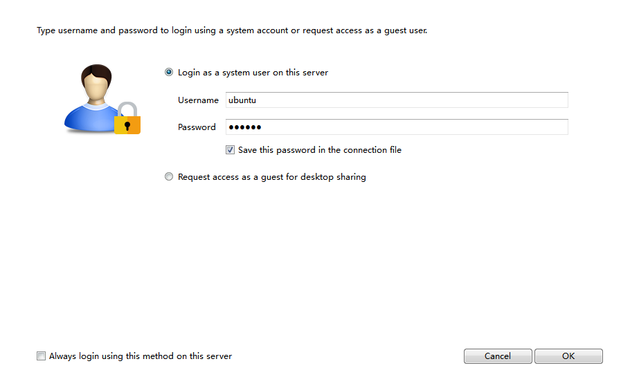

  1. The factory default setting for the robot is AP Direct Connection Mode. After a successful boot, a hotspot starting with WN will be generated. This hotspot can be searched for and connected to on the computer terminal, as shown below:
  1. Open NoMachine, enter the IP address 192.168.149.1 into the search bar of the software interface, and click Configure connection to new host 192.168.149.1.
  1. After opening, modify the Name field to ROSpider, keep other options unchanged, and then click Connect.
  1. In the Username field, enter ubuntu, and in the Password field, enter ubuntu. Check the save password box, and click the OK button.
If the robot has been configured to STA LAN mode, the exact same steps above can be followed, merely replacing the corresponding IP, UserName, and Password in steps 2), 3), and 4).

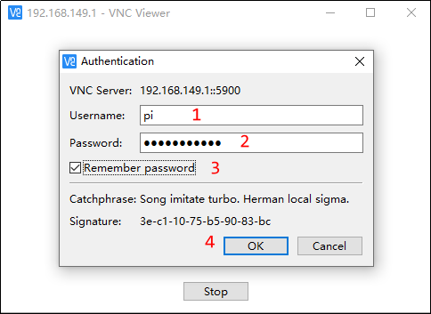

  1. The factory default setting for the robot is AP Direct Connection Mode. After a successful boot, a hotspot starting with WN will be generated. This hotspot can be searched for and connected to on the computer terminal. The connection password is: 12345678, as shown below:
  1. Next, open the installed VNC client. In the opened VNC Viewer, enter the Raspberry Pi 5 IP address: 192.168.149.1 under AP mode, and press Enter. If prompted that it is not a secure connection, click Continue.
  1. In the Username field, enter pi, and in the Password field, enter raspberrypi. Check the save password box, and click the OK button.

1.4.2.2 LAN Mode Connection
  • If a phone is to be used to configure the LAN, the phone’s location service must be turned on first.

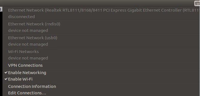

  • It is not possible to switch to LAN mode through the system’s network configuration, as shown in the figure below, because the Wi-Fi has undergone special configuration. Relevant network configurations must be performed according to the operations later in this document.
Using the Jetson controller as an example, the operational steps are as follows:
  1. Click the on the left side of the system desktop to open the command line terminal.
For Raspberry Pi 5 controller, use the black desktop terminal.
  1. Enter the command and press Enter to navigate to the configuration file directory.
cd wifi_manager
  1. Enter the command and press Enter to open the configuration file.
gedit wifi_conf.py
  1. First, modify the value of WIFI_MODE to 2. A value of 1 represents direct connection mode, where the robot autonomously generates Wi-Fi, while 2 represents LAN mode, where the robot connects to an internal local area network. Set it to 2 here.
  1. Next, modify WIFI_STA_SSID and WIFI_STA_PASSWORD to set them to the account and password of the router Wi-Fi. Note that the content must be enclosed in ‘’. Similarly, the robot supports connecting to 5G Wi-Fi networks.
  1. After confirming the input is correct, use the key combination Ctrl + S to save, and then click the exit button at the top right.
  2. Return to the command line terminal and enter the command to restart the robot Wi-Fi service.
  1. To switch back to direct connection mode, re-edit this configuration file, set WIFI_MODE to 1, and then restart the robot Wi-Fi service following the previous step.

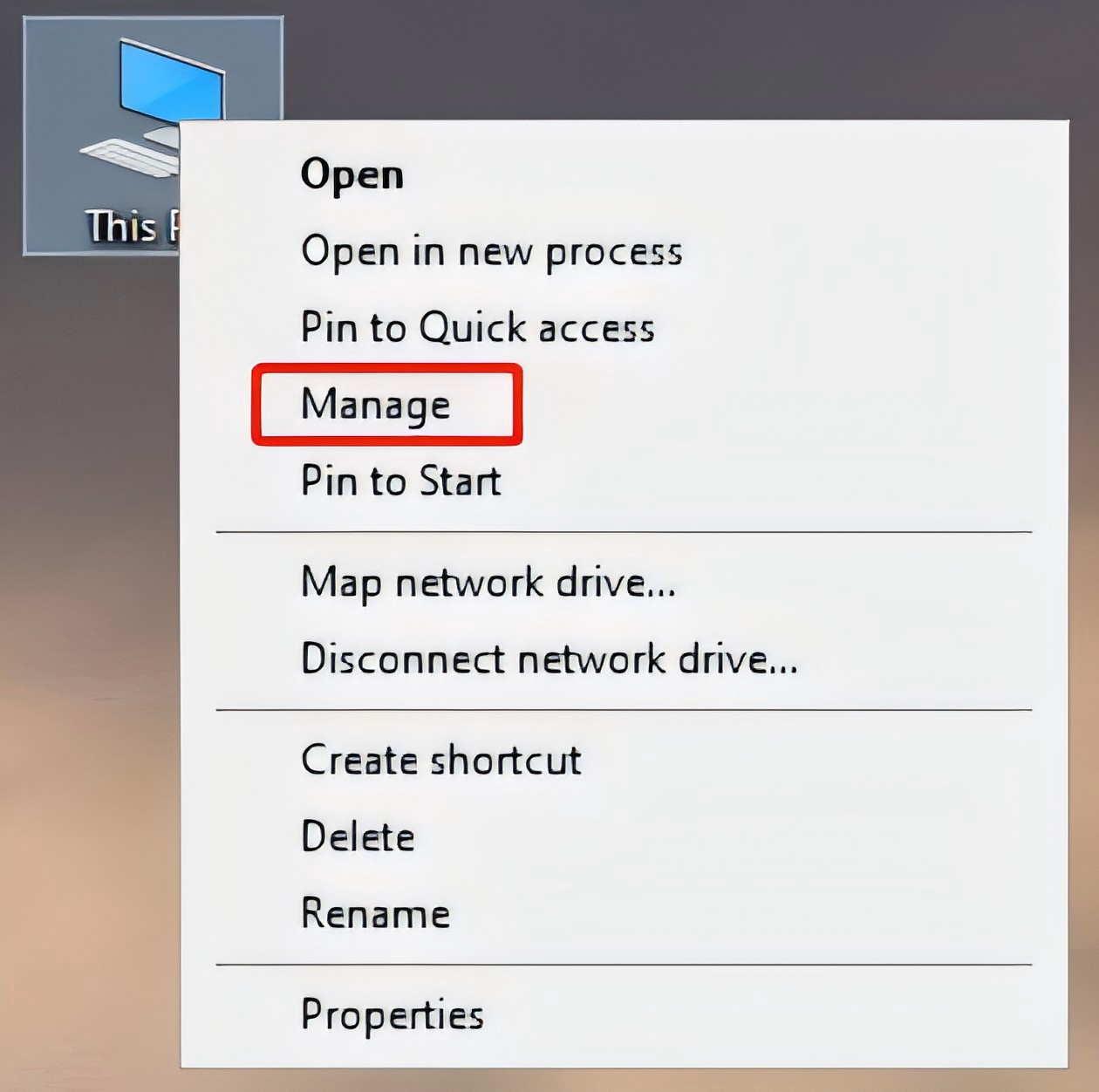

This connection method is only applicable to the Jetson series controllers.

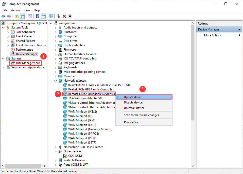

The robot can enhance remote operational fluency by enabling Remote NDIS compatible devices and utilizing a fixed IP 192.168.55.1. This method eliminates the need to connect to the robot’s hotspot or Wi-Fi under a LAN. The specific operational steps are as follows:
  1. Use a Type-C data cable to connect the robot to the computer.
  1. Right-click This PC on the computer desktop and select the Manage option.
  1. Click Device Manager in the left-side directory of the interface, locate the NDIS driver under the Network Adapters section, right-click this driver item, and select the Update Driver option.
  1. After completing the driver installation, refer to Direct Connection Mode and use the NoMachine remote connection tool to connect via the IP address 192.168.55.1.

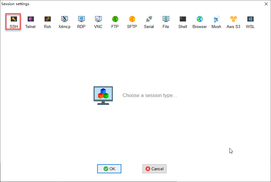

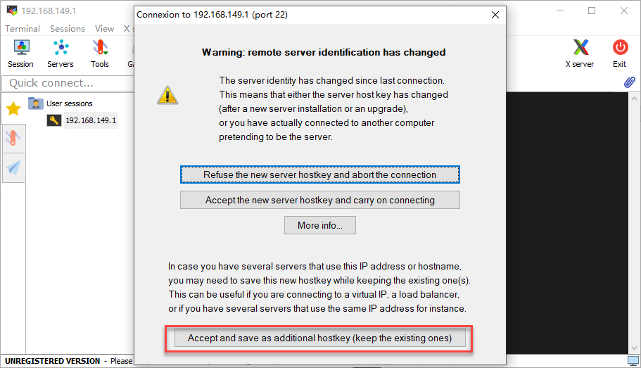

1.4.2.4 SSH Connection
Compared to NoMachine/VNC, MobaXterm does not display the robot system’s desktop. It only provides a command line window, facilitating quick use of commands to control the robot. Because it does not open excessively large or numerous windows, the SSH tool also saves a portion of the computational power and memory required by NoMachine/VNC.
  1. Locate the installation package in the 2. Softwares\2. Remote Desktop Software\2. SSH Remote Login Client folder under the same directory as 1. Tutorials. Open it and follow the prompts for a one-click installation.
  2. Obtain the corresponding IP by connecting the ROS mainboard via the previously mentioned Direct Connection Mode Connection or LAN Mode Connection methods.
New Session and Connection:
Taking the direct connection mode method as an example for explanation, the exact same steps can be referenced under LAN mode, simply replacing the IP.
(1) On the main interface, click Session in the upper right corner to create a new session. On the session interface, enter the recorded IP for direct connection mode 192.168.149.1, and click the OK option.
If the following image appears, simply click the third option.
(2) The interface will prompt for an account name and password, which are identical to the account name and password of the corresponding controller under direct connection mode or LAN mode. After entering, press Enter. Note that password entry is the same as in Linux systems, with no visual display whatsoever.
Special Note: The account name must be in lowercase. Even if the set account name contains uppercase letters, it must be lowercase upon login.
(3) If the password is correct, system entry will be successful. The system interface is shown below:

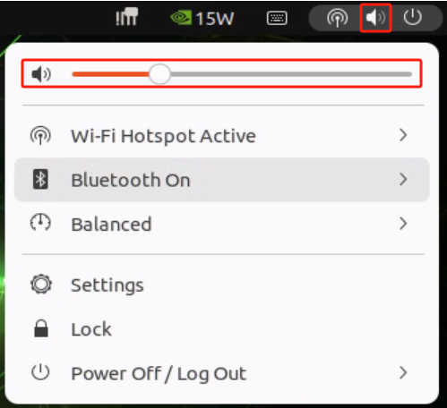

1.4.3 Volume Adjustment
According to default system settings, if a remote connection tool such as NoMachine connects to the robot system desktop before the robot fully boots up, the speaker volume will automatically be lowered. The sound button at the top right of the system desktop can be clicked to adjust the robot speaker’s playback volume. This adjustment method also applies to subsequent voice courses.

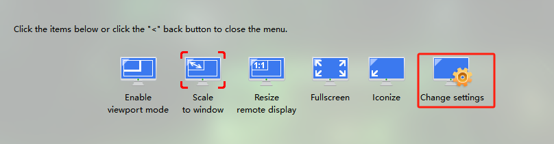

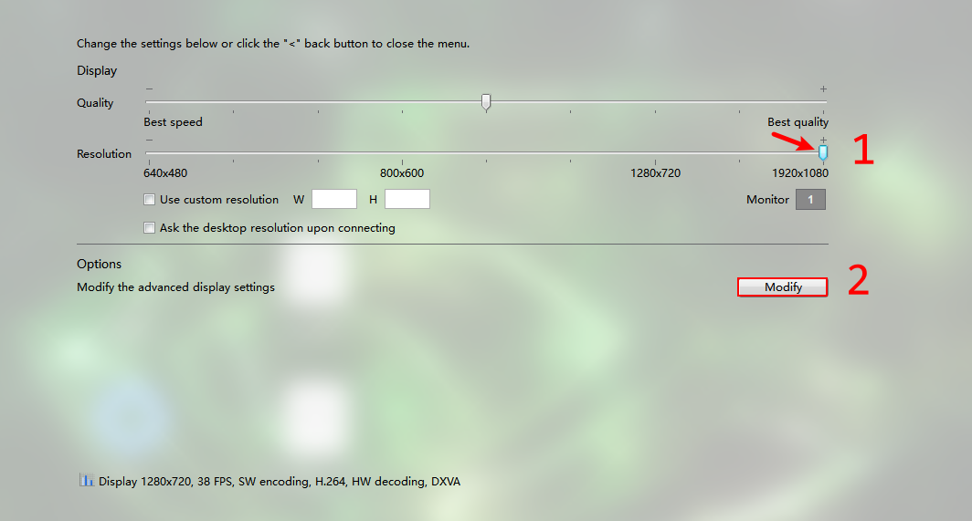

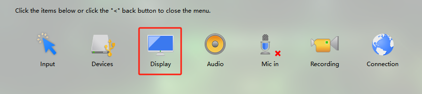

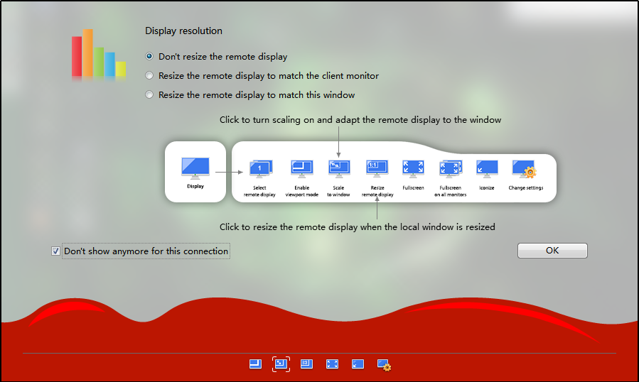

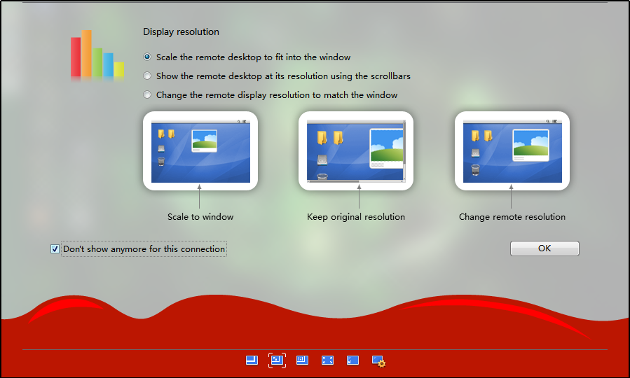

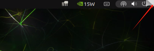

1.4.4 Remote Connection Resolution Setup (Optional)
If the resolution is incorrect after logging in remotely using the NoMachine remote connection tool, the following steps are required to set the remote connection resolution. This setup will need to be repeated upon subsequent reconnections:
  1. Move the mouse cursor to the upper right of the remote connection tool and wait for the page curl status to display, as indicated by the red arrow in the figure below:
  1. Next, press the left mouse button and select Display in the pop-up interface.
  1. Then click Change settings.
  1. Adjust the Resolution slider to 1920x1080 or appropriate for the local computer resolution, then click Modify to implement the change.
  1. Continuously click the return button to return to the desktop, and the remote desktop resolution will be observed to have changed.

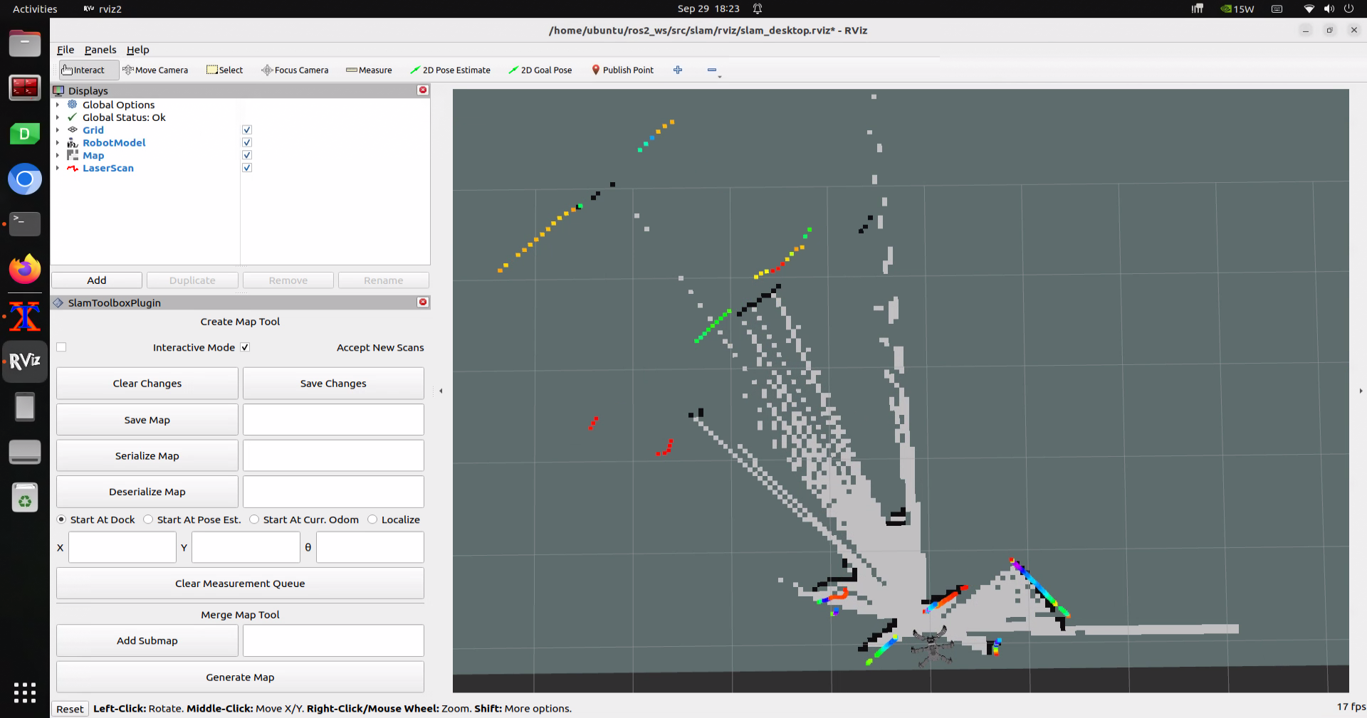

1.5 Quick Mapping and Navigation
The Jetson controller is used below as a demonstration. Operations for quick mapping and navigation on the Raspberry Pi 5 are identical.

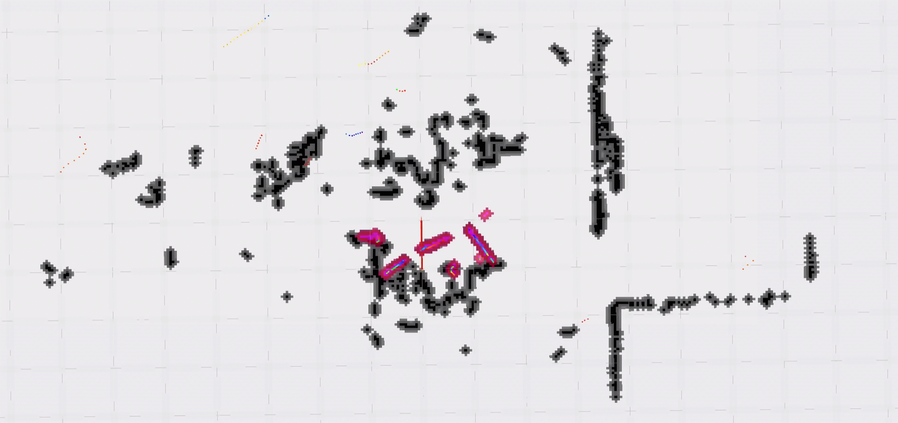

1.5.1 Quick Mapping Experience
This lesson offers a rapid experience of mapping and navigation functions without executing complex operations. Simply clicking the corresponding icons on the remote connection desktop realizes these functions.
Quick mapping requires controlling the robot’s movement via a wireless controller or keyboard. If the usage scenario involves only a single robot, controlling via a wireless controller is recommended for convenience. If there are multiple robots in the environment, controlling via a keyboard is suggested. This is because the wireless controller’s control features cause cross-interference. If multiple robots are in the same venue, it is advised not to use this function to prevent incorrect connections and control.
Once mapping is completed, the corresponding map will be saved. Subsequently, the autonomous navigation function can be enabled to view the mapping effect. Note that the map opened by the autonomous navigation function is the last successfully built map. Regardless of the mapping method used, newly created maps will overwrite the previous ones.
The manual mapping algorithm used is slam_toolbox. The SLAM Toolbox package forms a 2D map of space based on LaserScan messages combined with information from the laser rangefinder and TF transformations from odom-> base link. This package permits fully serialized reloading of the SLAM map’s data and pose graph for continuous mapping, localization, merging, or other operations. The SLAM Toolbox can run in synchronous and asynchronous modes. In synchronous mode, it processes all valid sensor measurements irrespective of lag, while in asynchronous mode, it processes valid sensor measurements when possible.
For more principles on mapping algorithms, enabling mapping and navigation via commands, and how to save multiple maps, please review 1. Tutorials\5. Mapping and Navigation Course\5.2 Mapping Tutorial.
1.5.1.1 Mapping Preparations
Before starting the robot, first confirm that the touchscreen is installed and the wires are connected properly. Next, confirm whether the USB wireless controller receiver is inserted into the robot’s USB port securely. Finally, follow 1.4 Development Environment Setup to connect to the robot via a remote connection tool and access the desktop.
Upon factory default, the wireless controller receiver is already inserted into the robot’s STM32 controller to receive wireless controller signals.
For wireless controller control methods, refer to 1.3.5 Wireless Controller Control. Further details will not be provided here.
After the robot is turned on, the icons on the system desktop correspond to functions:
Quick Mapping:
Autonomous Navigation:
In this mode, an enclosed area must be set up in advance on a flat surface. If obstacles are included, their height must at least exceed the horizontal position of the LiDAR.

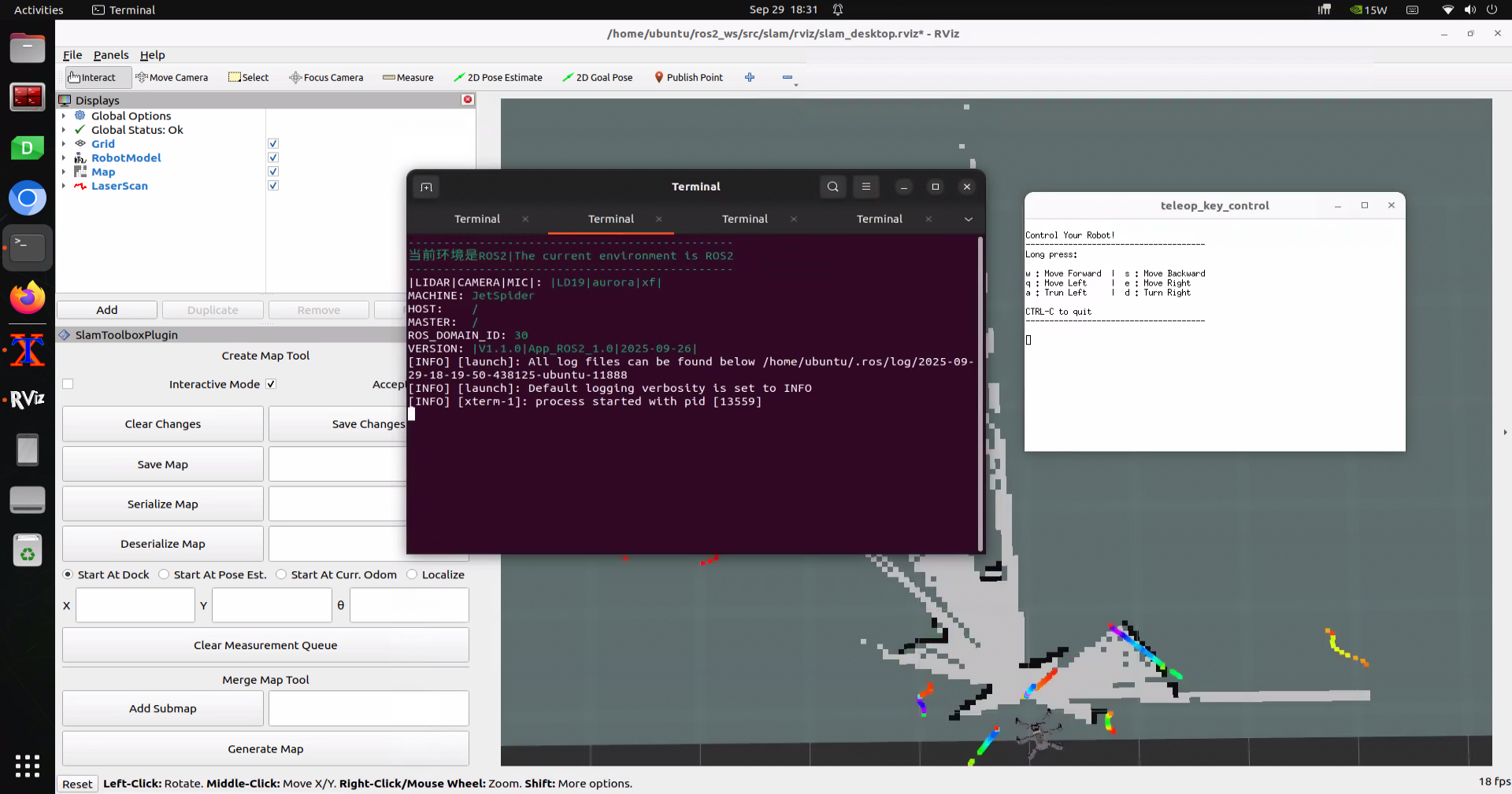

1.5.1.2 Operation Steps
  1. Place the robot inside the space to be mapped.
  2. Click the desktop icon to select and open the SLAM icon for the quick mapping application.

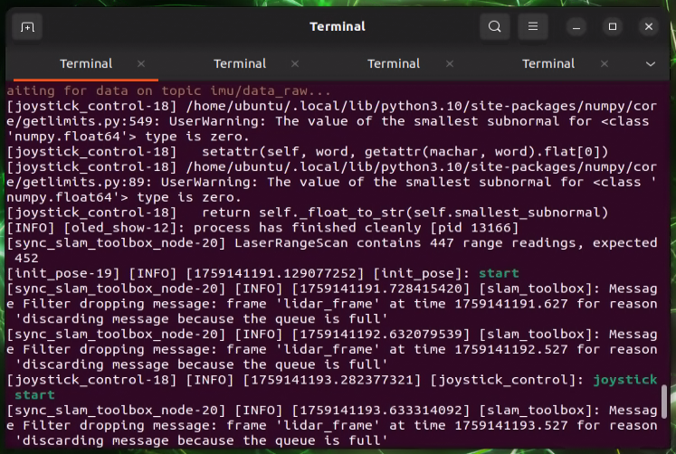

  3. Several terminals will open and run programs simultaneously. Wait a moment at this stage.
  1. Successful activation is indicated when the display interface is visible.
  2. The wireless controller can now be used to control the robot for mapping. For wireless controller control button functions, refer to 1.3.5.3 Button Descriptions.
When using the wireless controller, do not stay too far from the robot to prevent disconnection.
Alternatively, keyboard control can be chosen, although it is not recommended here. Keyboard control will be introduced in later sections. If keyboard control is used, a remote desktop connection is required, and the terminal must be configured to a terminal that accepts keyboard control.
The button descriptions for keyboard control are as follows:
Button Function Description
W Forward Short press switches to forward state, moves forward continuously.
S Backward Short press switches to backward state, moves backward continuously.
A Left turn Long press interrupts forward or backward state and turns left counterclockwise in place.
D Right turn Long press interrupts forward or backward state and turns right clockwise in place.
When the W or S key is pressed, the robot continuously moves forward or backward, respectively. When the A or D key is pressed, the robot interrupts the forward or backward motion and rotates counterclockwise or clockwise in place, while releasing the A or D key stops the rotation and holds the position in place.

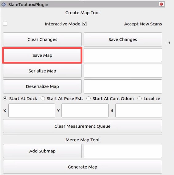

  1. After mapping is completed, click the Save Map button to save the map. The robot will save the built map.
  1. The built map is shown below:
  1. Once mapping is completed, to close the quick mapping function, enter Ctrl + C in the four command terminals.

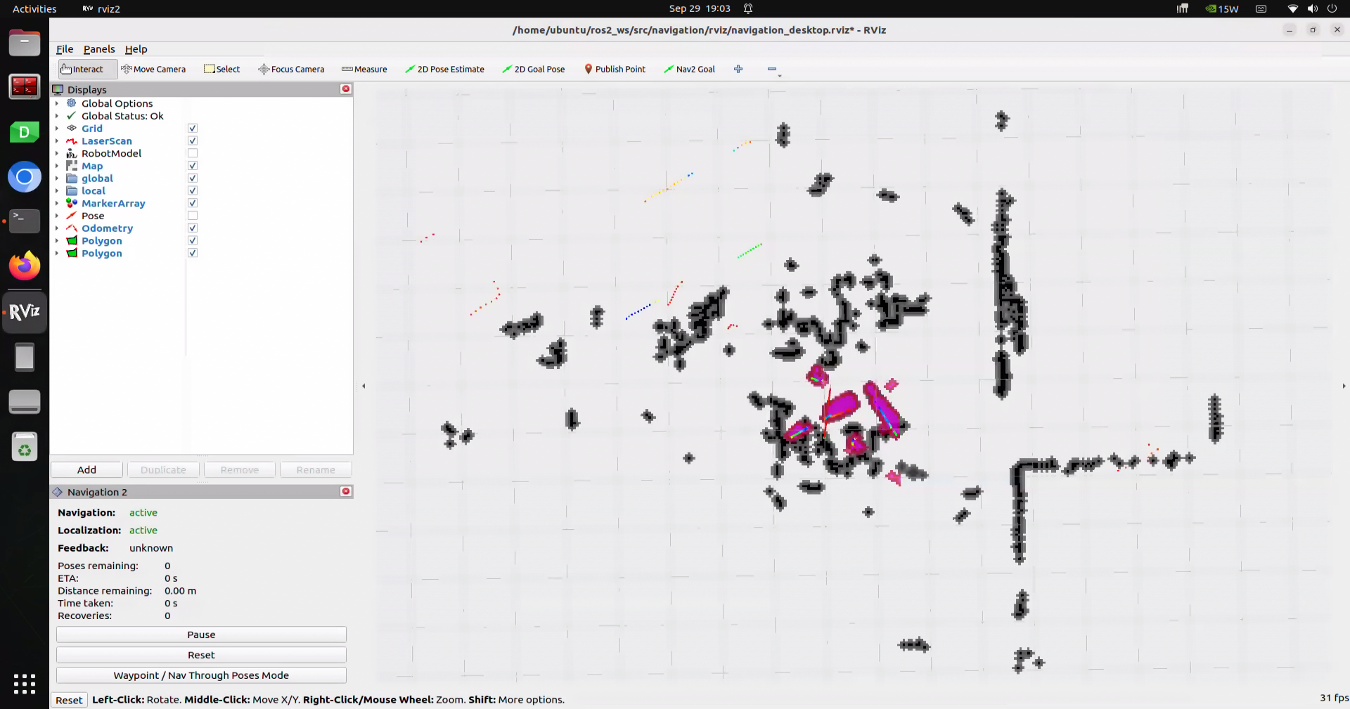

  2. Start the robot and select the Navigation icon on the touchscreen to open the quick navigation application.

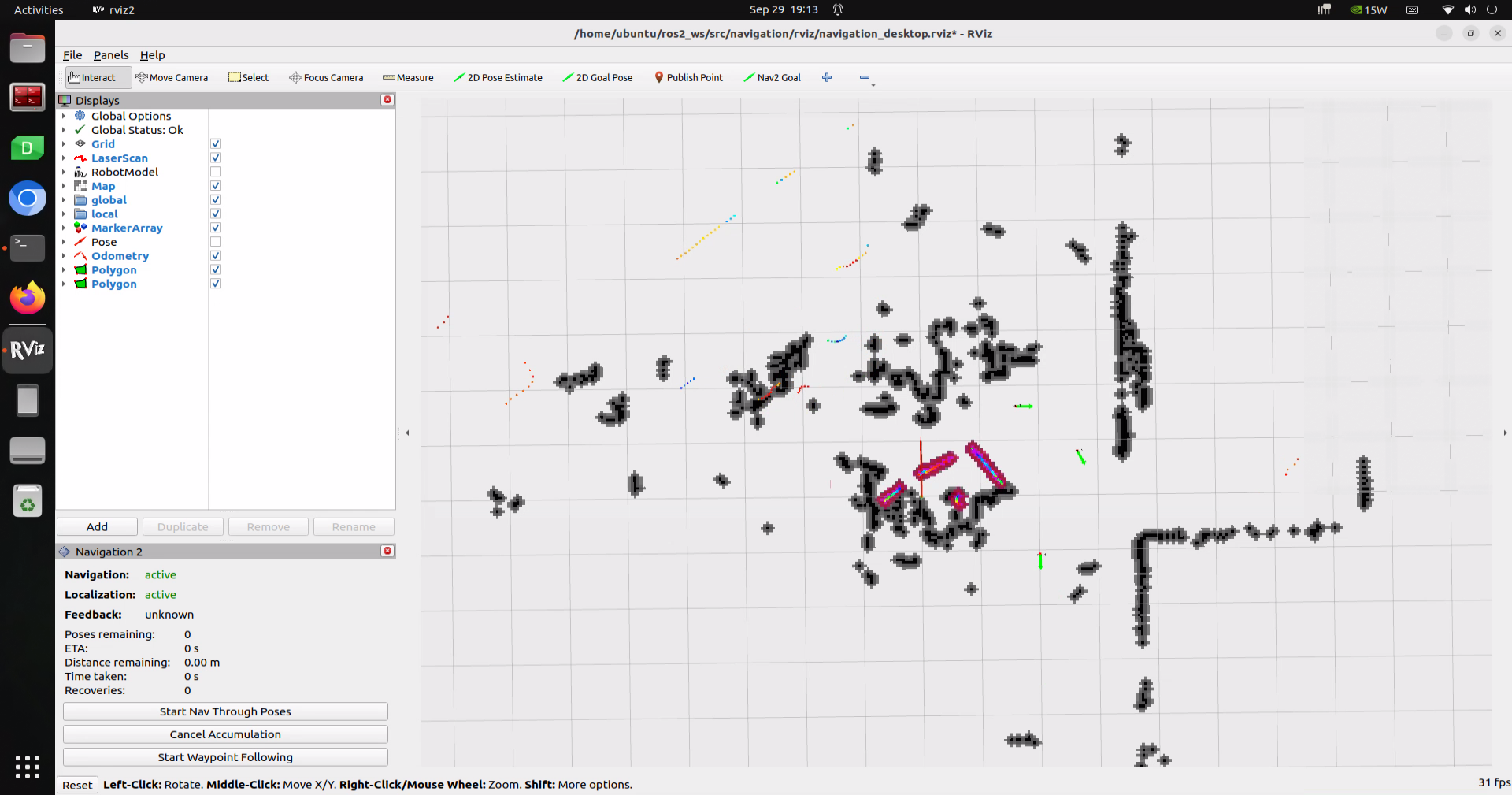

  3. Upon opening, terminals will run programs. Wait for the following interface to be visible, which indicates successful opening.

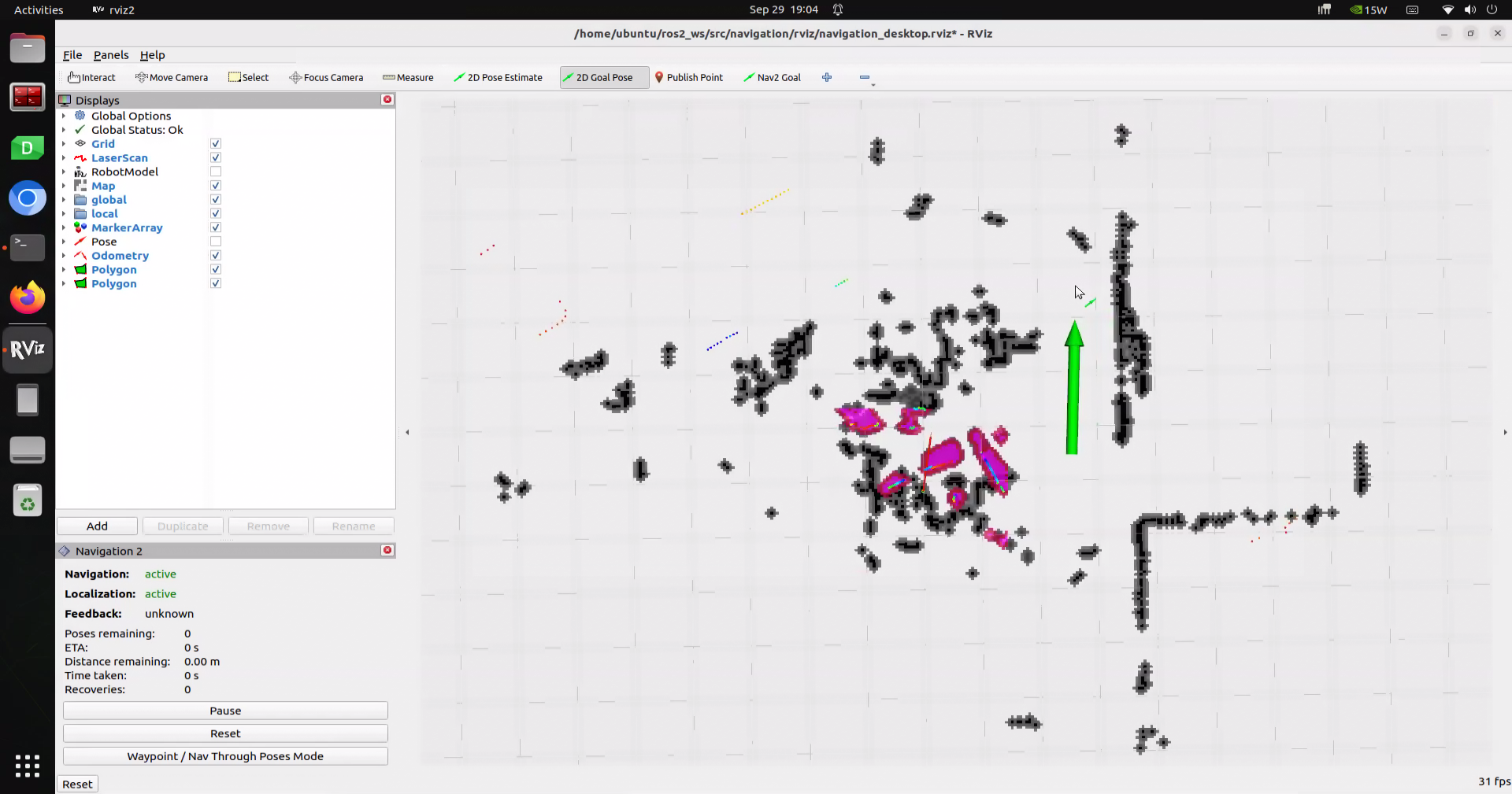

  1. In the software menu bar, 2D Pose Estimate is used to set the robot’s initial position, 2D Goal Pose sets a single target point for the robot, and Nav2 Goal sets multiple target points.
  1. Click the 2D Goal Pose icon, then single-click an area on the map interface to select it as a target point. Pressing tightly with the mouse and dragging can also determine the robot’s orientation after reaching the target point. Upon completion of selection, the robot will automatically generate a route and move to the target point.
  1. Click the icon at the bottom left to enable multi-point navigation. Then click the Nav2 Goal icon once to set a target point. Clicking and dragging the mouse can select the target point direction. Set multiple target points by repeating this operation.
  1. After setting target points, click Start Waypoint Following at the bottom left to begin multi-point navigation. During navigation, the robot will also automatically avoid obstacles.

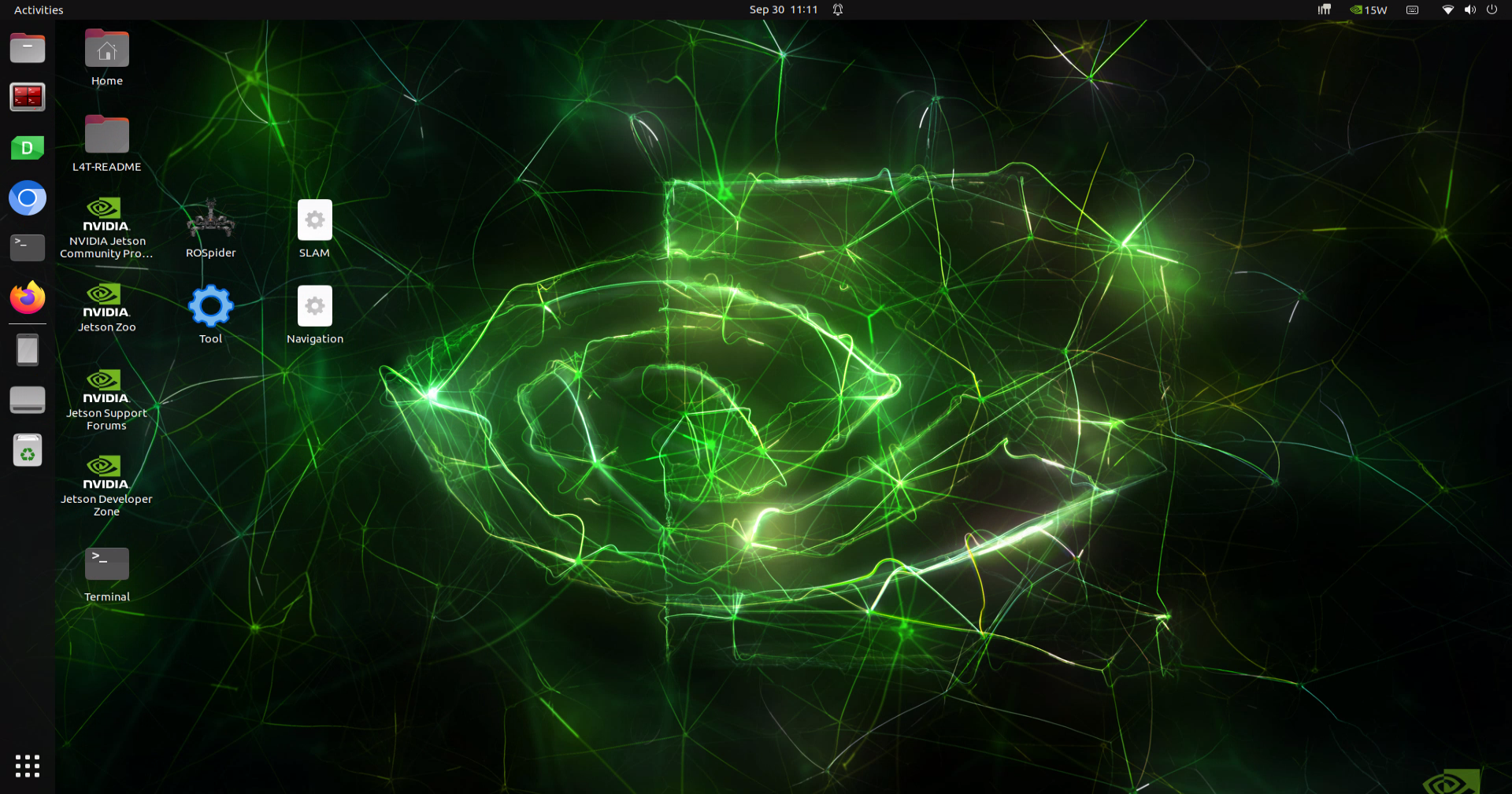

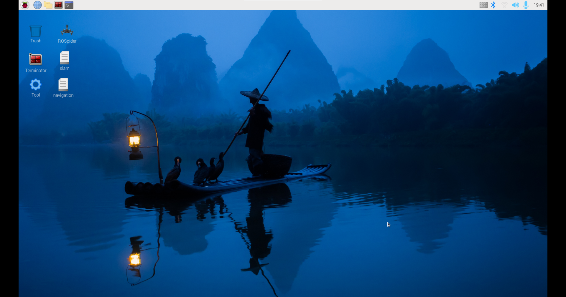

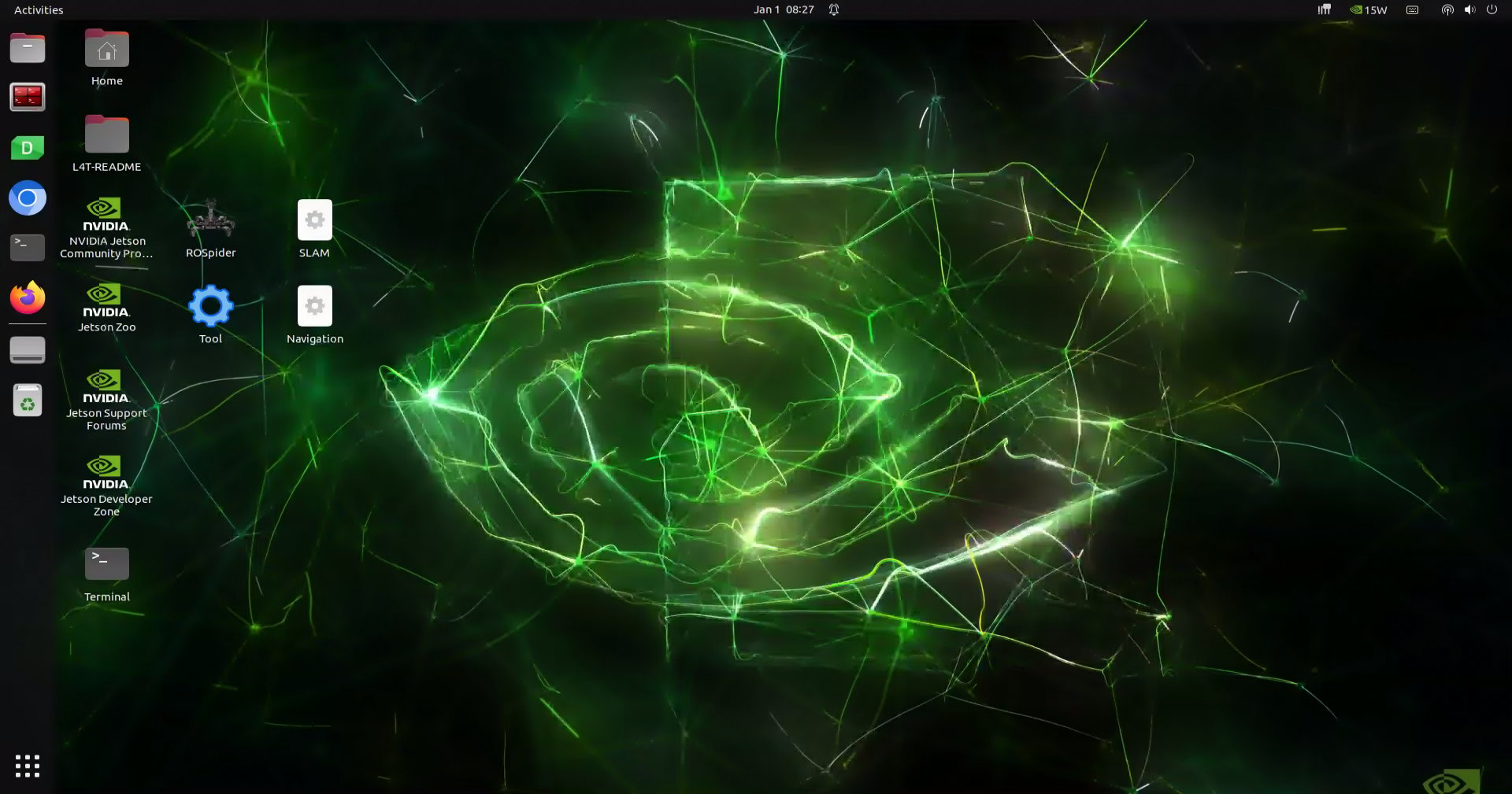

1.7.1 System Desktop
Using the Jetson Orin Nano controller as an example, start the ROSpider hexapod robot and connect it to the remote control software NoMachine. It is also applicable to other ROS controllers. The system desktop is displayed as follows:
The desktop primarily includes the following functions:
Command Line Terminal
ROSpider Upper-Level PC Software
Robot Version Configuration Tool
Quick Mapping
1.7.2 File Directory Composition Introduction

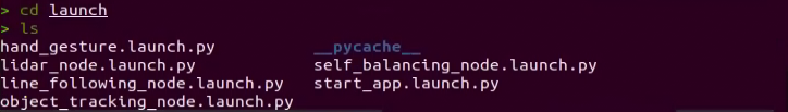

  1. Next, the function files will be introduced. Below uses /ros2_ws/src/app as an example to explain feature files. Enter the command to proceed to the feature’s file directory. Two folders, launch and app, can be seen.
cd app
ls
The launch folder corresponds to startup files, and app corresponds to the feature source code.
The corresponding startup file directories and source code directories for other feature packages are similar.

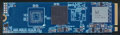

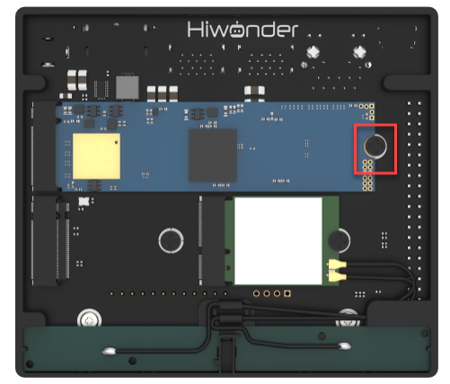

Hardware aspects:
Jetson Nano and Raspberry Pi 5 Versions: An SD card, a card reader, and a computer are required. The SD storage capacity depends on the size of the image to be burned, with the left figure below showing a 64GB SD card as an example. A Windows 10 operating system is recommended for the computer.
Jetson Orin Nano and Jetson Orin NX Versions: A solid-state drive, an SSD burner enclosure, and a computer are required. The SSD storage capacity depends on the size of the image to be burned. The SSD burner enclosure must be prepared separately. A Windows 10 operating system is recommended for the computer.

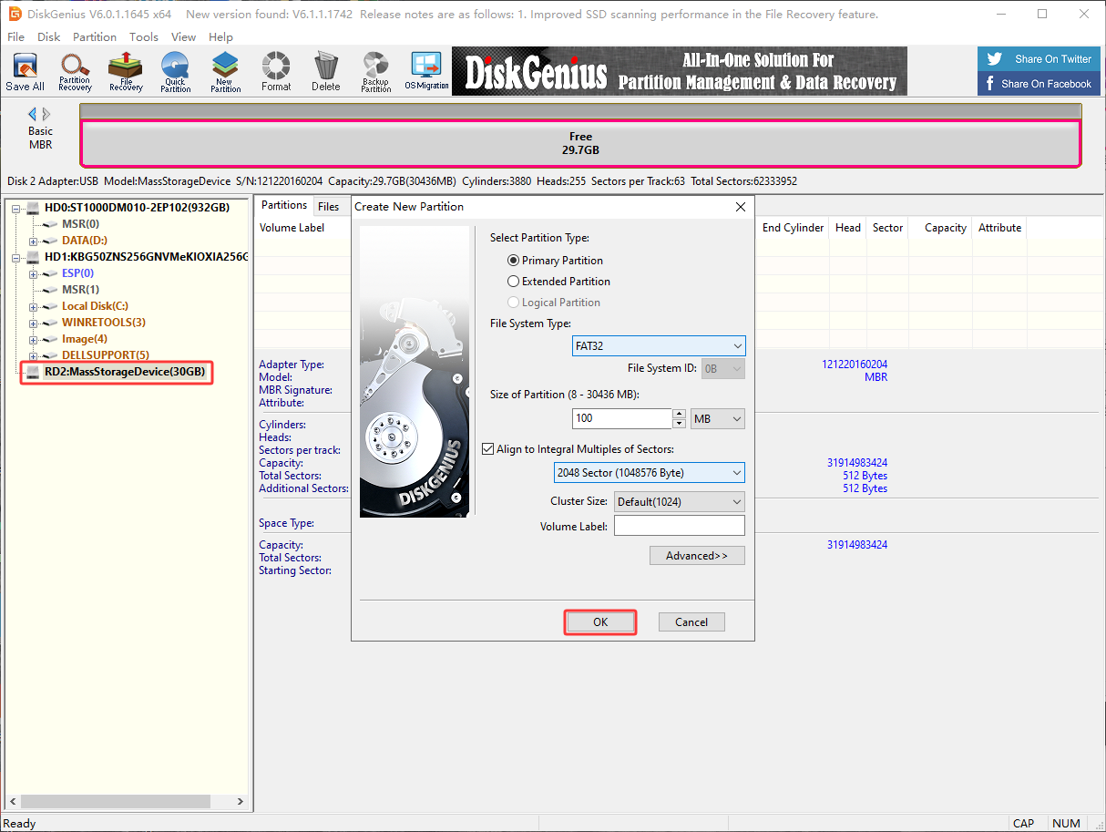

1.8.2 SD Card/SSD Formatting
If the SD card or SSD is blank, formatting operations are unnecessary.

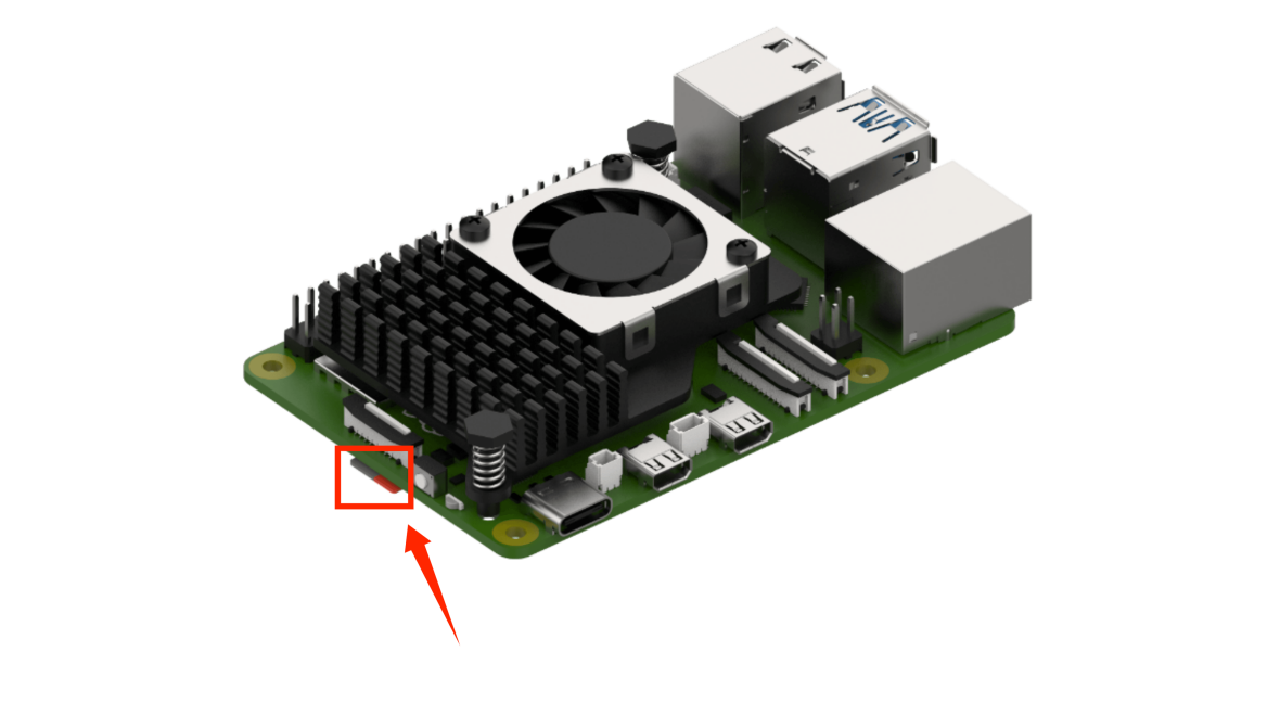

  1. Remove the SD card from the Jetson Nano or Raspberry Pi 5, or remove the SSD from the Jetson Orin Nano or Jetson Orin NX.
  • Jetson Nano
  • Raspberry Pi 5
  • Jetson Orin Nano/Jetson Orin NX

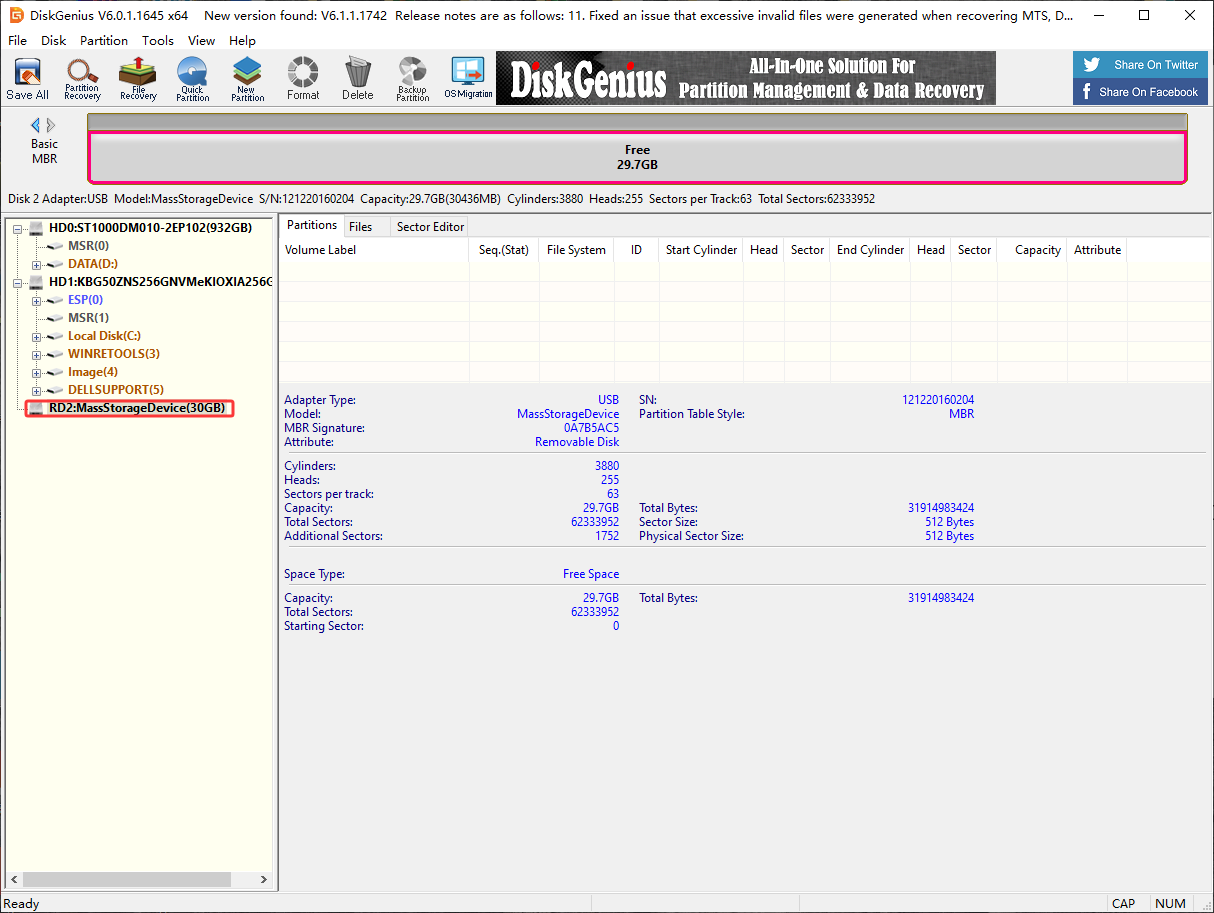

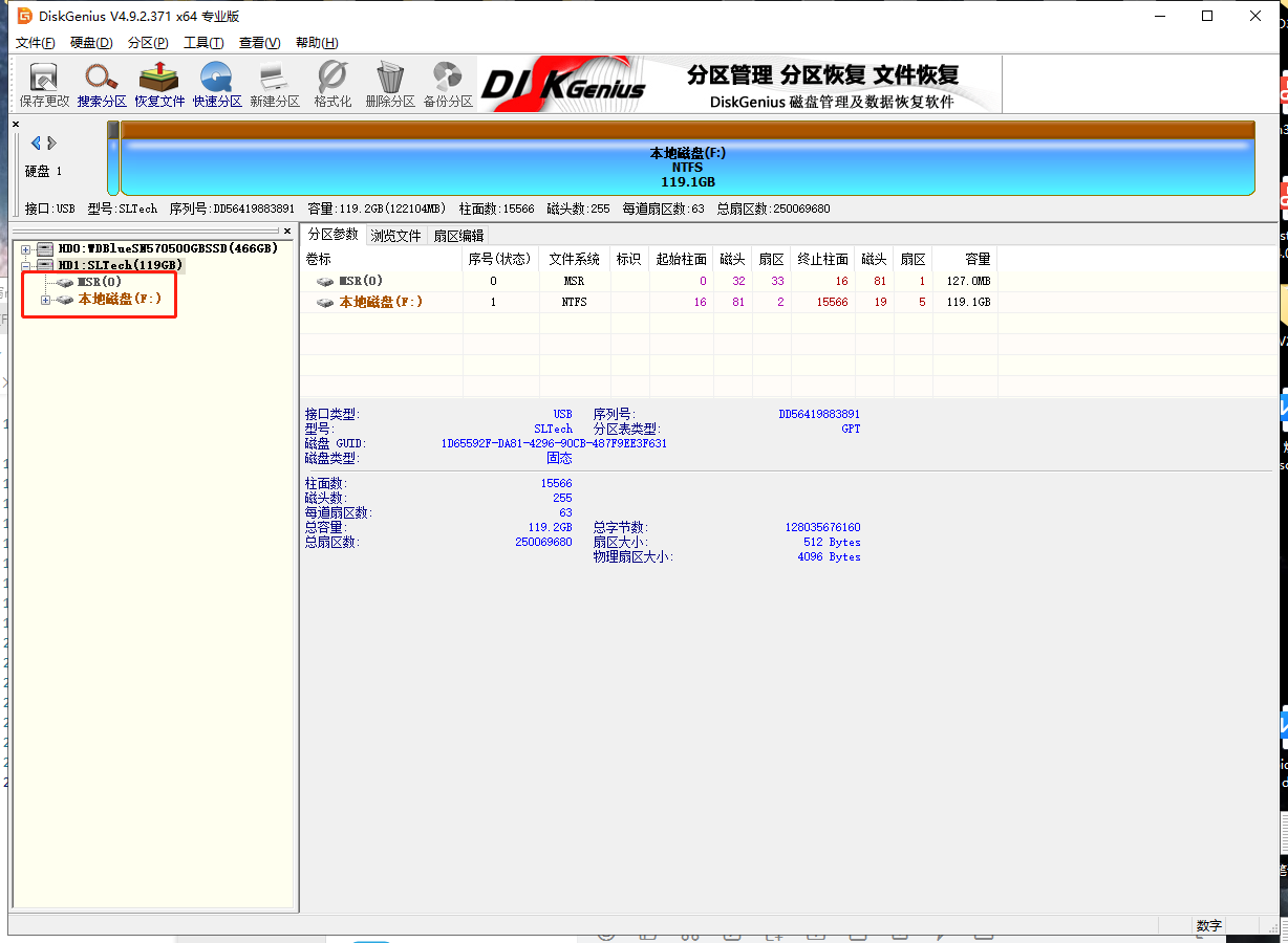

  1. Locate the compressed package in directory 2. Softwares\3. Image Burning Tool\Hard Drive Initialization Tool. After extracting, find the DiskGenius.exe tool to format the SD card or SSD. Pay attention to selecting the correct drive letter. Do not select the wrong drive letter and accidentally format the computer’s hard drive.

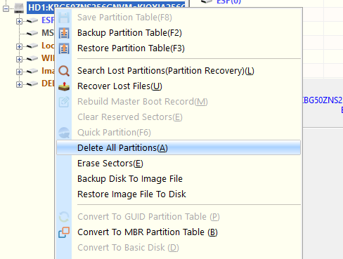

  2. After inserting the SD card or SSD into the computer, drive letters other than the computer’s own will be detected.

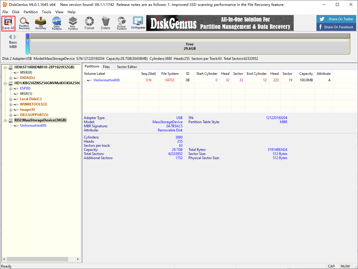

  1. Right-click and select Delete All Partitions.
  1. Upon successful deletion, it will appear as shown below:
  1. Create a new partition so the computer can recognize it properly. If informational prompts pop up, click OK, as shown below:
  1. Then click Save.
  1. Upon success, the following information will be visible, indicating the SD card/SSD formatting is complete.

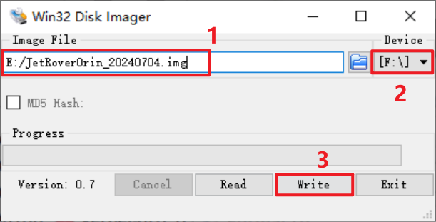

1.8.3 Image Burning
  1. Open the image burning tool Win32DiskImager and click the icon to select the image file, which must be downloaded and extracted beforehand. The screenshot is for illustrative purposes only, and the actual software image may differ. Under the Device section, select the drive letter of the SD card or SSD, and click the Write button to begin burning the image.
The storage path for the image file should contain English characters only.

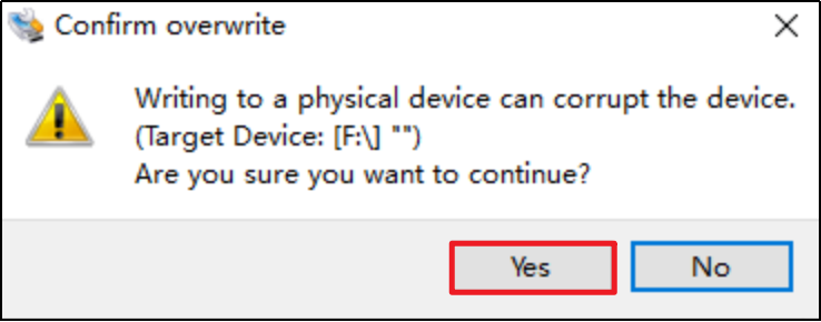

  1. If the prompt shown in the figure below appears, simply click the Yes button.
  1. If Write Successful is prompted, burning is complete. If an error occurs, close software such as firewalls, re-insert the SSD, and repeat the operations in this section.
After successful burning, if prompts regarding partition formatting appear, ignore them entirely.
  1. Wait for the image burning to complete, reinsert the SD card or SSD into the controller, power on, and after a while, a successful boot-up will be achieved.
