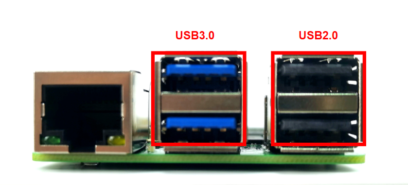

(2) Next, connect the USB keyboard and mouse to the USB ports on the Raspberry Pi. Unlike the Raspberry Pi 3B/3B+ motherboard, two of the four USB ports on the Raspberry Pi 5 are USB 3.0 ports.

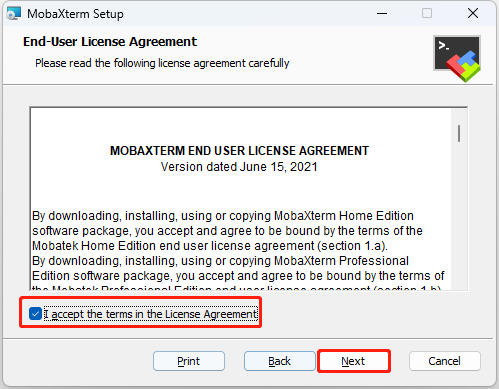

(1) Double-click the ‘MobaXterm_installer_22.1.msi’ file saved in the folder ‘Appendix’.
(2) Click-on ‘Next’ and tick ‘I accept the terms in the License Agreement’.

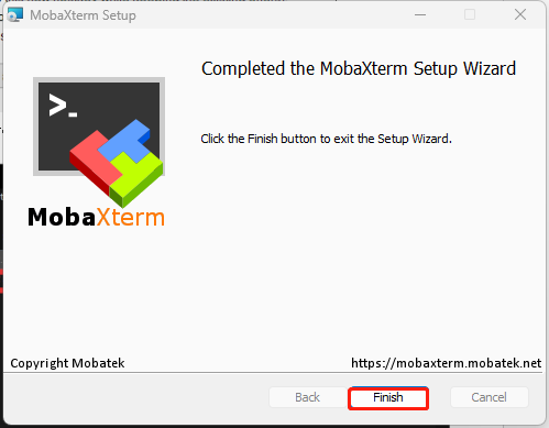

(5) Wait for the installation to complete. After a while, the installation completion prompt page will appear. Click-on the “Finish” button.

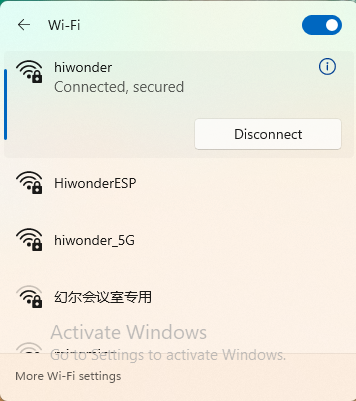

(1) Following the previous tutorial, we have connected the Raspberry Pi 5 to the LAN. Using the tutorial demonstration as an example, the Raspberry Pi 5 is connected to the “Hiwonder” hotspot. Therefore, our computer is also connected to the “Hiwonder” hotspot at this time.
(2) Open the “Run” window by pressing the Win + R keys, then enter “cmd” to open it in administrator mode.
(3) Type the command “ping raspberrypi -4” to view the IP address assigned to the Raspberry Pi 5 by the hotspot.

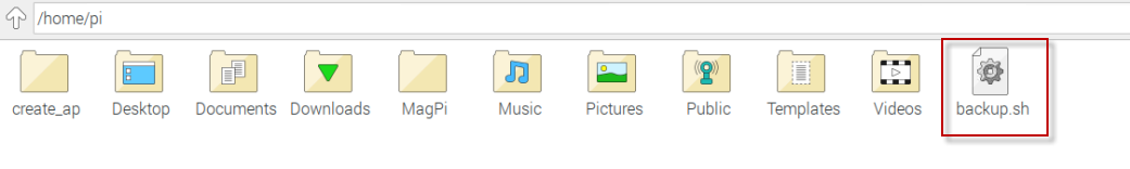

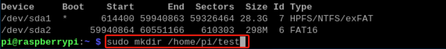

(1) Once SSH connection is established, here’s an example of creating a new file named test.txt on the desktop of your computer.
(2) Resize the MobaXterm window if needed, then simply drag the file you wish to transfer onto the MobaXterm interface.
(3) The file will be promptly transferred to the desktop of your Raspberry Pi system. Enter the command “ls” to display all files and directories, then press Enter. As depicted in the image below, you’ll see that the files imported from your computer have been successfully transferred.
  • Send Files from Computer to Raspberry Pi
Upon establishing an SSH connection, locate the desired file within the MobaXterm file area. Drag the file to your computer’s desktop using your mouse, and the file will be automatically transferred to the desktop.

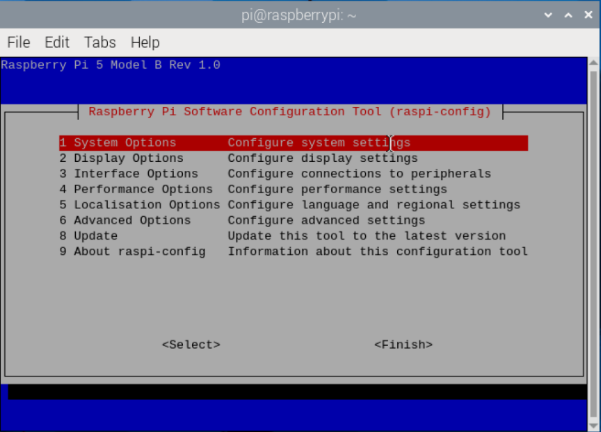

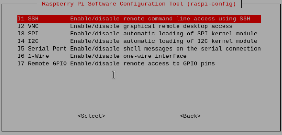

(1) After connecting via SSH, enter the “sudo raspi-config” command and press Enter to open the Raspberry Pi 5 configuration window.
sudo raspi-config
(2) In this interface, use the up and down arrow keys to navigate, press Enter to confirm selections, and press Esc to return to the previous level. Locate “Interface Options” and press Enter to access the relevant settings interface.
(3) Locate “I2 VNC” and press Enter to access the VNC switch interface.
(4) Choose ‘Yes’, and hit Enter key to enable the VNC connection.
Once VNC connection is enabled, you can establish a connection to the Raspberry Pi 5 system using VNC.

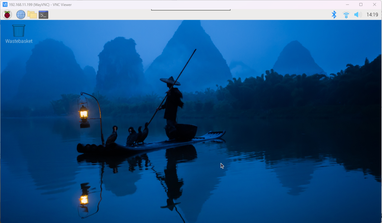

(1) Following the previous tutorial, we’ve connected the Raspberry Pi 5 to the LAN. Using the tutorial demonstration as a reference, let’s assume the Raspberry Pi 5 is connected to the “Hiwonder” hotspot. At this point, our computer is also connected to the “Hiwonder” hotspot.

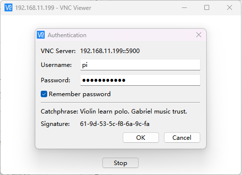

(2) Launch the installed VNC client. Enter the IP address of the Raspberry Pi 5 (192.168.11.199) in the VNC Viewer, then press Enter. If prompted that the connection is not secure, click “Continue”.
(3) A prompt will appear, requesting a password. Enter the password: “raspberrypi” (if an account is needed, use “pi”), check the “Remember password” box, then click “OK” to remotely access the Raspberry Pi desktop. (If the screen remains black with only a mouse pointer, consider restarting the Raspberry Pi and repeating the above steps.)

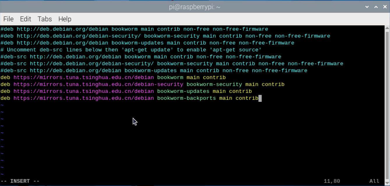

(1) Press “Ctrl+Alt+T” to open the command line terminal, then enter the command “sudo nano /etc/apt/sources.list” and press Enter to edit the sources.list file.
(2) Use the arrow keys “← →” to navigate to the position indicated in the screenshot.
(3) Press “#” to comment out all the contents of the original file.
(4) Next, navigate the cursor to the bottom empty line and add the following content sequentially. You can copy and paste, but avoid using Ctrl+V for pasting. Instead, use the middle or right mouse button and select “Paste”. Please note that the provided source is the Tsinghua University open-source software mirror station. If you opt for other sources, kindly modify it accordingly. Additionally, ensure strict adherence to the specified format and avoid line wrapping, as it could invalidate the changes and lead to a failed source modification.
deb https://mirrors.tuna.tsinghua.edu.cn/debian/ bookworm main contrib
deb https://mirrors.tuna.tsinghua.edu.cn/debian/ bookworm-updates main contrib
deb https://mirrors.tuna.tsinghua.edu.cn/debian/ bookworm-backports main contrib
deb https://security.debian.org/debian-security bookworm-security main contrib
(5) Use short-cut ‘Ctrl+O’ to save the change. When you receive the below prompt, hit Enter key.
(6) Having saved the change, use short-cut ‘Ctrl+X’ to exit.

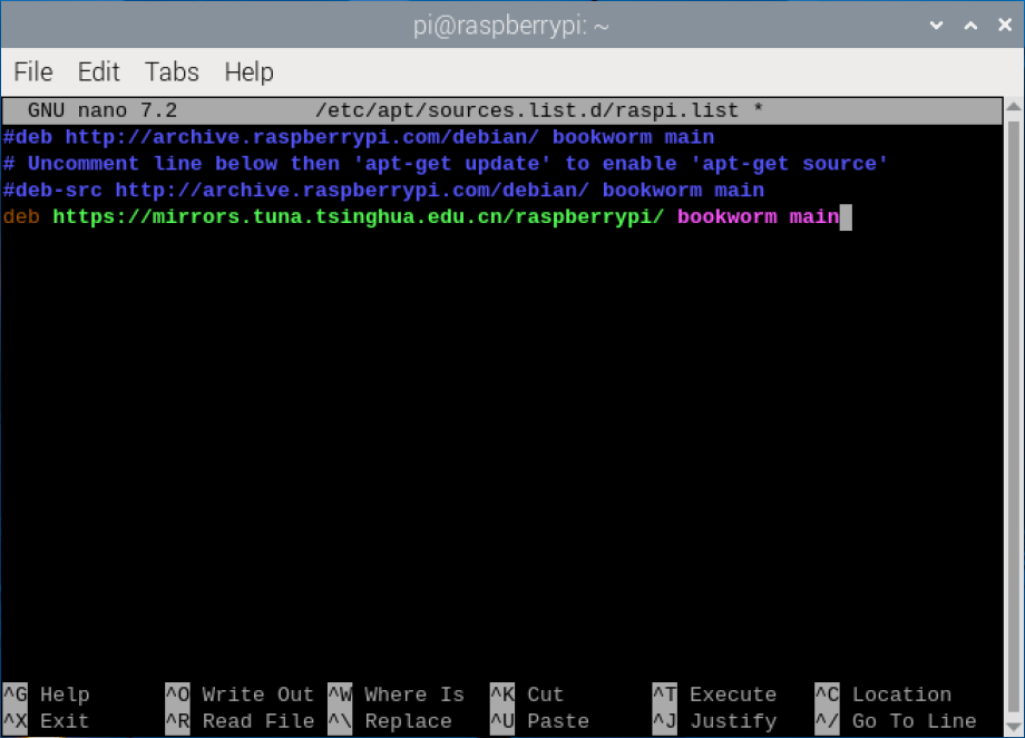

2.3.2 Revise raspi.list File
(1) Press ‘Ctrl+Alt+T’ to open the command-line terminal, and execute the command ‘sudo nano /etc/apt/sources.list.d/raspi.list’ to edit the ‘raspi.list’ file, then hit Enter key.

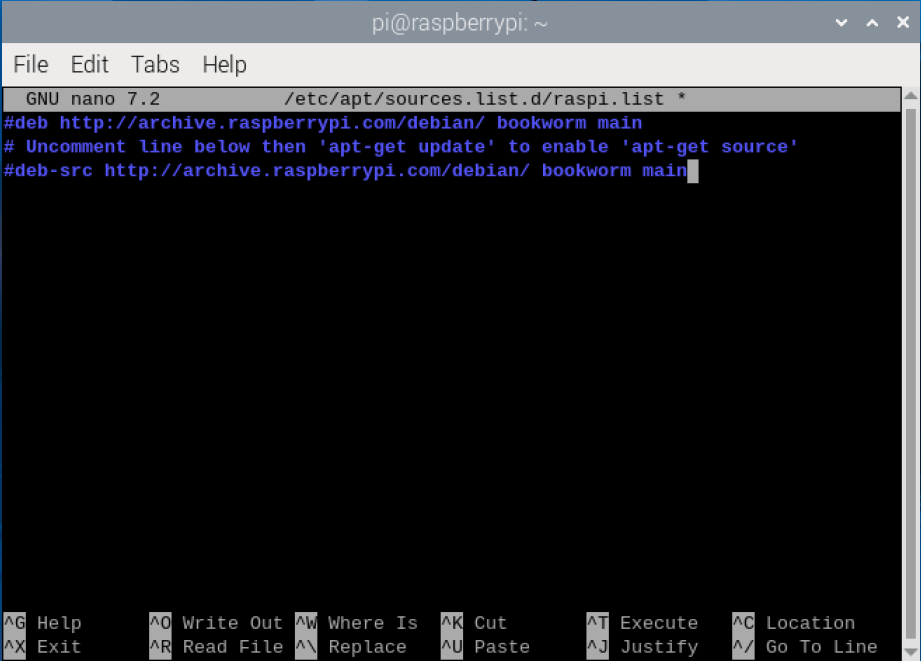

(2) Use arrow keys ‘← →’ to move the cursor to the position as pictured.
(3) Hit ‘#’ key to comment out all contents of the original file.
(4) Next, navigate the cursor to the bottom empty line and sequentially append the following content. You can copy and paste, but refrain from using Ctrl+V for pasting. Instead, utilize the middle or right mouse button and select “Paste”.
deb https://mirrors.tuna.tsinghua.edu.cn/raspberrypi/ bookworm main
(5) Use short-cut ‘Ctrl+O’ to save the change. When the following prompt appears, hit Enter key.
(6) Having saved the file, use short-cut ‘Ctrl+X’ to exit the file.

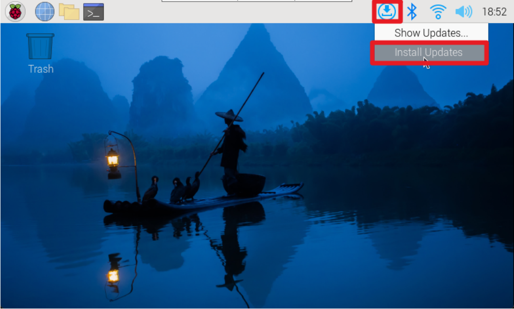

2.4 Operating System Update
Regularly updating the Raspberry Pi can enhance system security; however, it’s not advisable for developers to update randomly.
2.4.1 Graphical Interface Update
Typically, the Raspberry Pi system update prompt appears in the upper right corner of the desktop. You can click on the corresponding option to initiate the update process.
2.4.2 Command-Line Terminal Update
(1) Press “Ctrl+Alt+T” to open the command line terminal. Enter the command “sudo apt update” to update the local package cache. During the update process, you may be prompted to confirm acceptance of the changes. Type “Y” and press Enter, then wait for the update to finish.
sudo apt update
(2) Enter the command “sudo apt full-upgrade” to update the software packages. If prompted to consume additional disk space during the update process, press “Y” and then Enter to proceed. Note that the initial configuration may take some time, so please be patient while waiting.

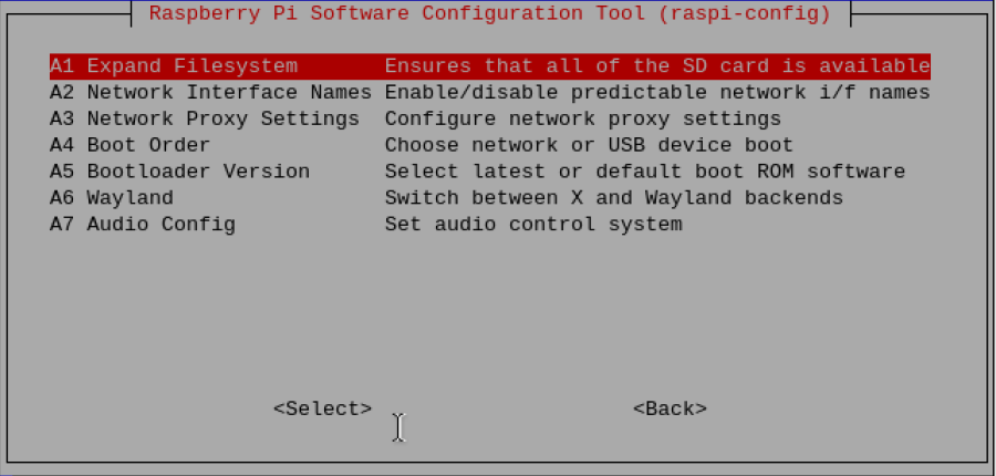

2.5 raspi-config Configuration Tool Introduction
Raspi-config is a pre-installed configuration tool in Raspberry Pi OS. It offers a straightforward command-line interface for managing Raspberry Pi system configurations, enabling users to easily customize and optimize their system settings.

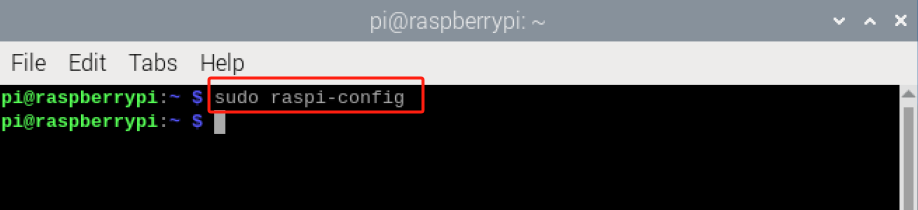

2.5.1 Launch raspi-config Tool
(1) Use short-cut ‘Ctrl+Alt+T’ to open the command-line terminal, execute the command ‘sudo raspi-config’, then hit Enter key.
(2) Use ‘↑↓’ arrow keys to choose the option, and hit Enter key to confirm the selection. Then hit Esc key to navigate to the previous level.
2.5.2 Function List
Upon entering the configuration command, you will be presented with the raspi-config tool interface, where all available options are listed within the central gray box.

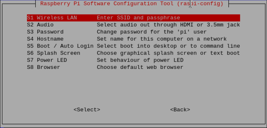

(1) System Options
The System Options menu permits configuration adjustments across various sections such as boot, login and network, sound, and more, encompassing several system-level modifications.

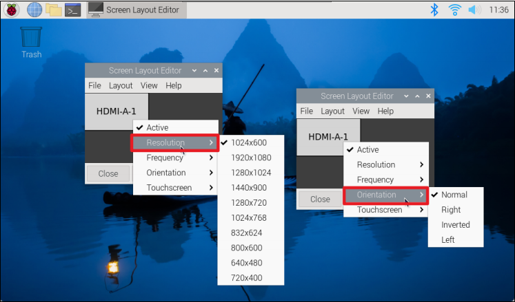

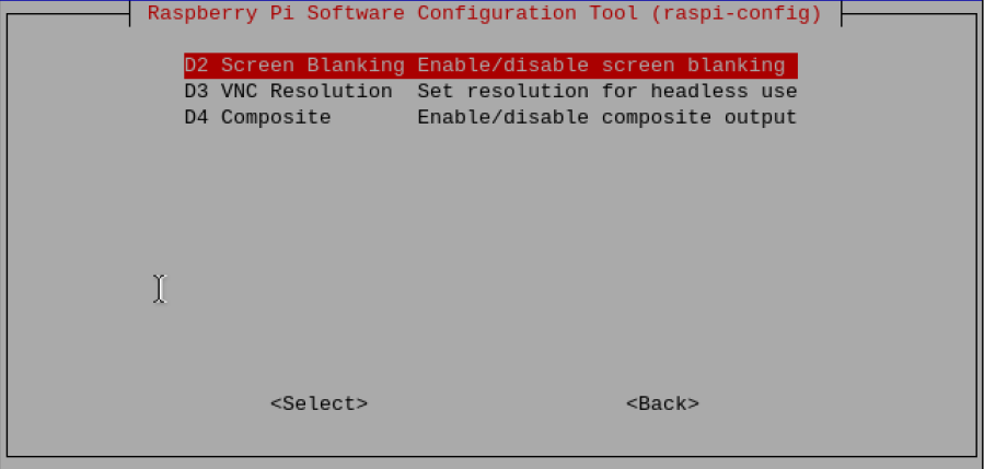

(2) Display Options
Display options facilitate configuration adjustments such as resolution settings and eliminating black borders, among other display-related configurations.
(3) Interface Options
In the Interface Options menu, you can toggle the following selections to enable/disable: Camera, SSH, VNC, SPI, I2C, Serial, 1-wire, and remote access GPIO.
(4) Performance Options
Performance options encompass features like overclocking, video memory size adjustments, fan speed control, and other related settings.
(5) Locallistion Options
Localization options offer settings for keyboard layout, time zone, regional configurations, and wireless LAN country code.
(6) Advanced Options
Advanced options provide settings for tasks such as disk expansion and boot startup configurations.
(7) Update
Update raspi-config tool to the highest version.
(8) About raspi-config
About raspi-config info.

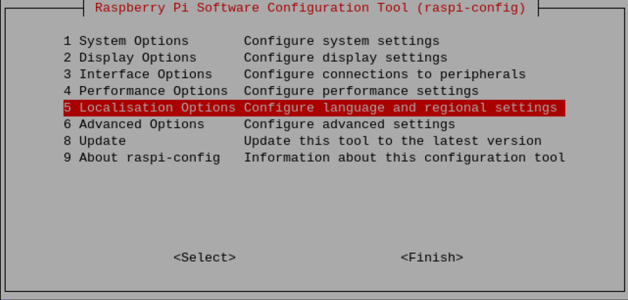

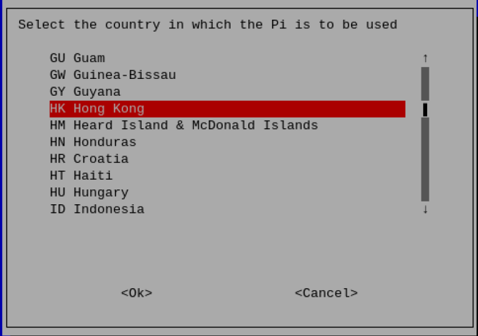

2.5.3 Set WiFi Country
(1) Choose ‘5 Localisation Options Configure language and regional settings’, then hit Enter key.
(2) Choose ‘L4 WLAN Country Set legal wireless channels for your country’, then hit Enter key.
(3) Select ‘HK Hong Kong’, then hit Enter key to save the change.

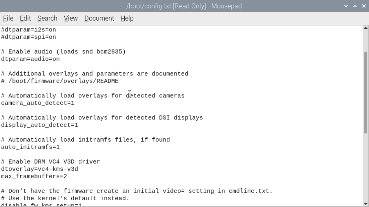

As the Raspberry Pi lacks a traditional BIOS, system configuration parameters are typically stored in the “config.txt” text file.
This file is read by the GPU before initializing the ARM kernel, serving as a unique startup configuration file for the Raspberry Pi system. It resides on the first (boot) partition of the SD card, accessible at: /boot/config.txt
2.6.1 File Format
To open the config.txt file, simply double-click on it. Each line within this file contains a single statement, where the content can be an integer or a string. Additionally, you can include comments before each statement to explain its function. It’s important to note that each line’s length is restricted to 98 characters, and any content exceeding this limit will be disregarded.
2.6.2 Common Option
  • Camera_auto_detect
When this setting is enabled, the firmware will automatically load overlays for the CSI cameras it recognizes.
Set to disable:
camrea_auto_detect=0
  • Display_auto_detect
Set to disable:
display_auto_detect=0
  • Dtoverlay
Used to load and configure device tree overlays. By configuring dtoverlay, users can add additional hardware support or functionality to the Raspberry Pi system. For instance, to load an overlay that enables the kernel graphics driver:
dtoverlaydtoverlay=vc4-kms-v3d
To access more detailed tutorials, please visit this website: https://www.raspberrypi.com/documentation/computers/raspberry-pi-5.html

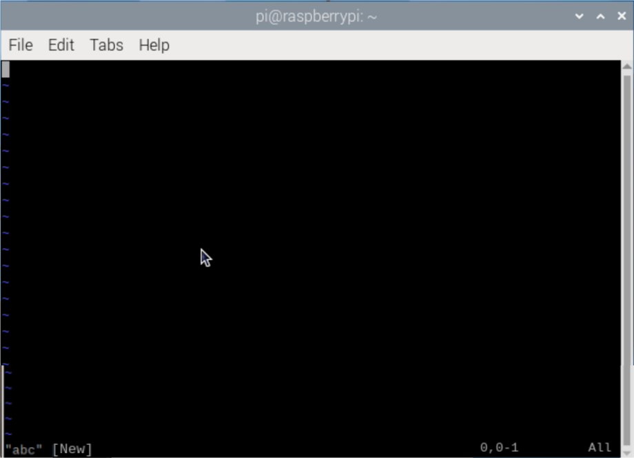

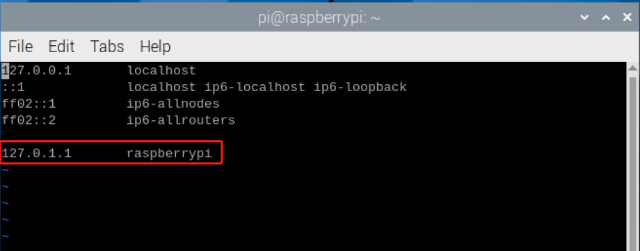

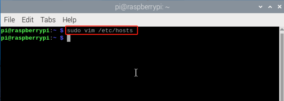

2.7 Network Configuration Method+Vim Editor Installation and Usage Tutorial
2.7.1 Network Configuration Method
The network configuration methods for Raspberry Pi 5 encompass three modes: Access Point (AP), Station (STA), and direct network connection. Below, we’ll detail the network configuration procedures for each of these modes. Please note that this lesson necessitates the use of the vim editor. If it’s not installed, please consult the “Vim Editor Installation and Usage Tutorial” located in this folder.

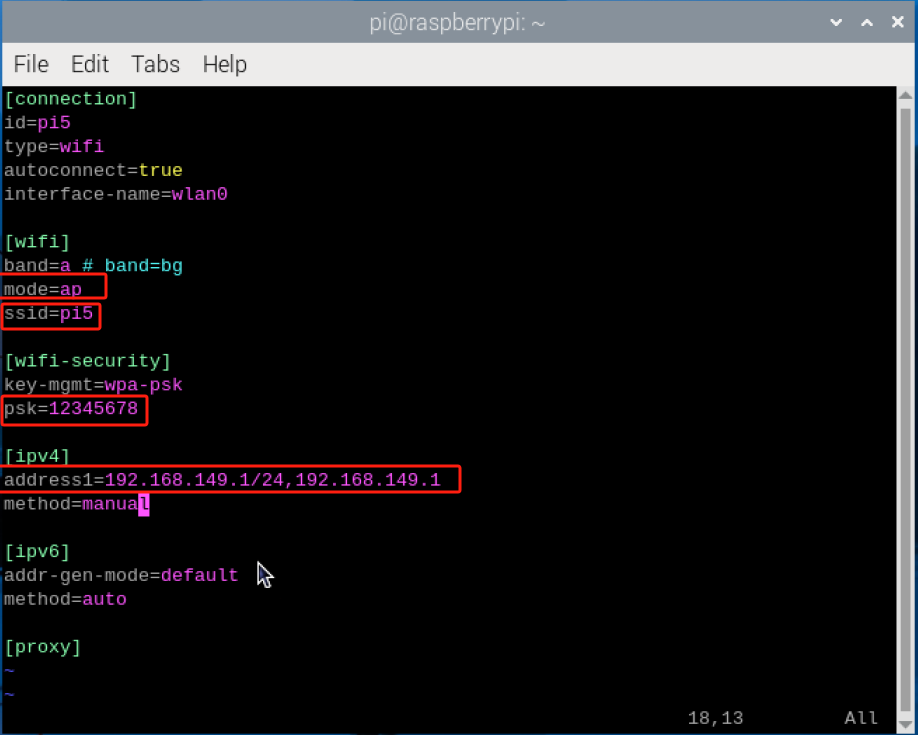

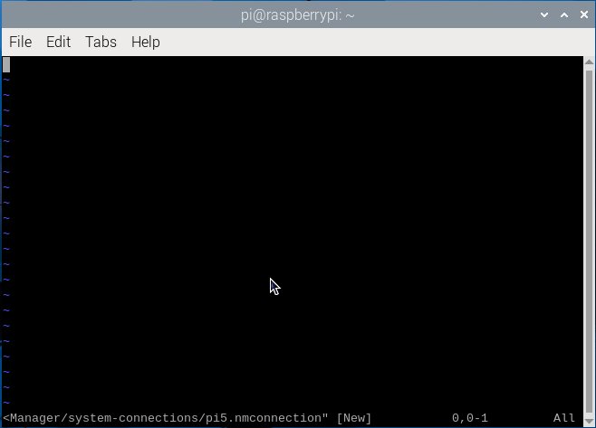

  • AP Mode
(1) Use shortcut ‘Ctrl+Alt+T’ to open the command-line terminal. Execute the command ‘sudo vim /etc/NetworkManager/system-connections/pi5.nmconnection’, then hit Enter key to create and edit pi5.nmconnection file.
(2) Input the following code.
(3) Configure the Raspberry Pi’s network mode to Access Point (AP) mode with the WiFi name set to “pi5” and password as ‘12345678’, while fixing the IP address to 192.168.149.1. After inputting the changes, press the ‘Esc’ key, input ‘:wq’, and hit Enter to save the changes and exit the operation.
(4) Execute the command ‘sudo systemctl restart NetworkManager’ to restart the network configuration.
(5) Run the command ‘sudo reboot’ to restart the system and complete the AP mode configuration.
sudo reboot
  • STA Mode

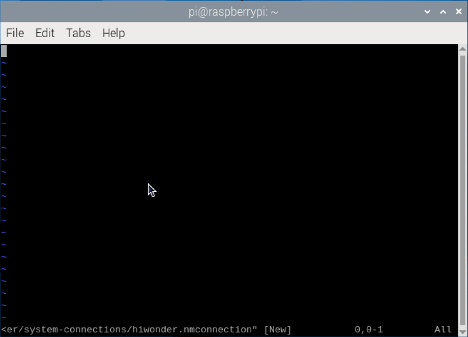

(1) Use short-cut ‘Ctrl+Alt+T’ to open the command-line terminal, and execute the command ‘sudo vim /etc/NetworkManager/system-connections/hiwonder.nmconnection’, then hit Enter key to create and edit the hiwonder.nmconnection file.
(2) Enter the following code.
(3) Configure the Raspberry Pi’s network mode to Station Mode (STA) mode with the WiFi name set to “WWW” and password as ‘hiwonder’, while fixing the IP address to 192.168.1.111. After inputting the changes, press the ‘Esc’ key, input ‘:wq’, and hit Enter key to save the changes and exit the operation.
(4) Run the command ‘sudo systemctl restart NetworkManager’ to restart the network configuration file.
(5) Enter the “sudo reboot” command to restart the system and finalize the configuration of STA mode.
sudo reboot

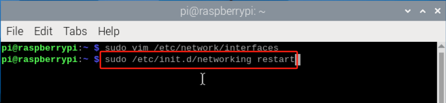

  • Direct Network Connection
(1) Press “Ctrl+Alt+T” to open the command line terminal. Enter the command “sudo vim /etc/NetworkManager/system-connections/hiwonder.nmconnection” and then press Enter to create and edit the hiwonder.nmconnection file.
(3) Configure the direct network connection mode of Raspberry Pi 5 and set it to a fixed IP address: 192.168.1.112. After entering the configuration, press the “Esc” key on the keyboard, type “:wq”, and then press Enter to save and exit.
(4) Type the command ‘sudo /etc/init.d/networking restart’ to relaunch the network configuration file.
(5) Enter the “sudo reboot” command to restart the system and finalize the configuration of the direct network cable mode.

(3) To enter the Vim editor and create or edit a file, type “vim” followed by the name of the file you wish to edit or create. For example, to create a new plain text file named “abc” for demonstration, use the following format:
vi abc
(4) Press the “ENTER” key to create a new file named “abc” and enter the Vim editor.
(5) Upon initially entering the file, we are in command mode. Press “i” on the keyboard to switch to input mode. At this point, you’ll see the “– INSERT –” prompt displayed in the lower-left corner of the terminal.
(6) Type the following characters ‘hello raspberry!’.

2.8 Configure Display Resolution and Rotation
If the display resolution is incorrectly selected, it may result in a distorted screen. You can adjust it according to the supported resolution of your monitor.
2.8.1 Display Settings of External Display

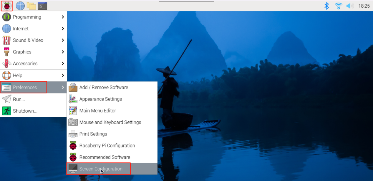

(1) Click-on the Logo in the upper left corner, select ‘Preference →Screen Configuration’.
(2) Right-click screen layout editor to set resolution and direction. After the modification is done, you need to restart the system.

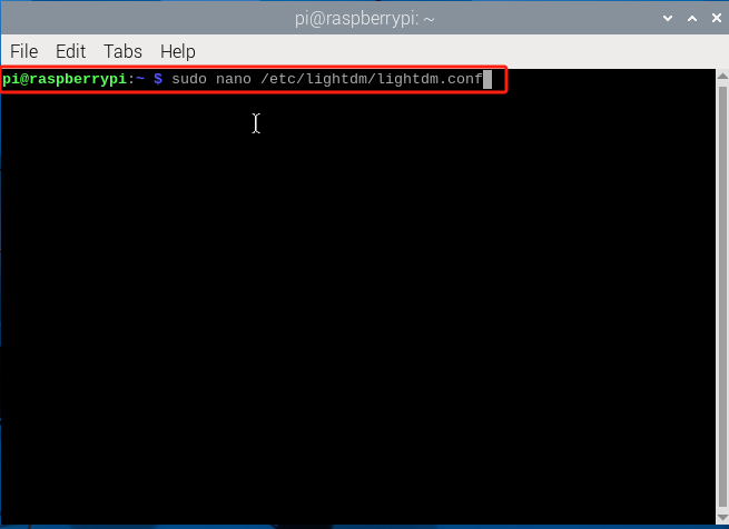

To set the screen sleep, users can change the file ‘lightdm.conf’.
(1) Use short-cut ‘Ctrl+Alt+T’ to open the command-line terminal. Then run the command ‘sudo nano /etc/lightdm/lightdm.conf’ to access the ‘lightdm.conf’ file.
sudo nano /etc/lightdm/lightdm.conf' to access the 'lightdm.conf

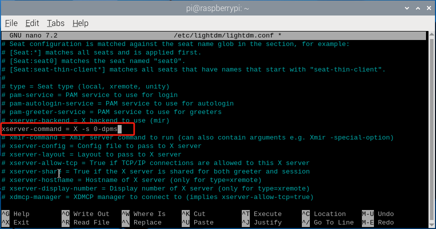

(2) Remove the comment symbol “#” before “xserver-command=X” and modify it to “xserver-command=X -s 0 -dpms”. Here, the “-s” parameter sets the screen saver to not start, and “-dpms” disables powe r management.
xserver-command=X
(3) After modification, use short-cut ‘Ctrl+X’, input ‘Y’ and hit Enter to save the file.
(4) After saving the file, restart the system.

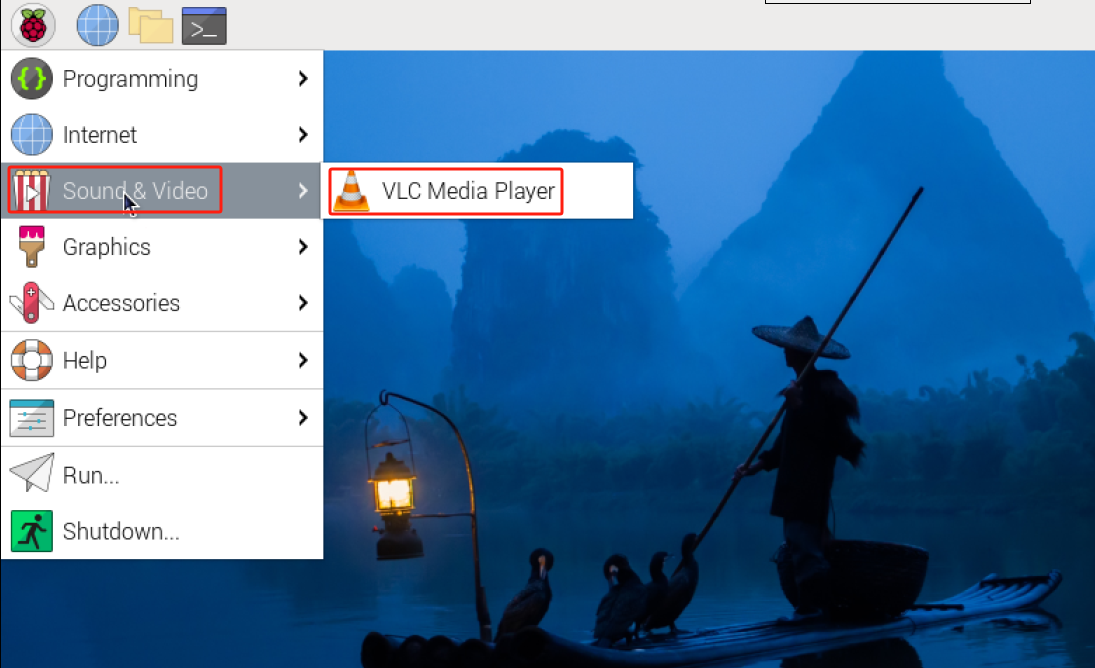

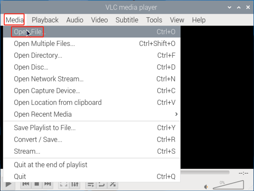

(2) Initiate VLC using graphical interface
Click on the logo in the upper-left corner, then select “Sound & Video” and click on “VLC Media Player” to open the VLC Media Player.
Open and play the file ‘demo.mp4’.

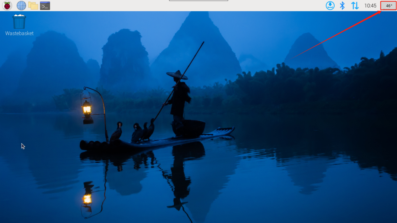

2.11 Acquire Raspberry Pi Real-time Temperature
The Raspberry Pi obtains real-time temperature data by reading system files. CPU temperature information on the Raspberry Pi is stored in a specific file, and there are two methods to retrieve this temperature data.
2.11.1 Check the Command
Press “Ctrl+Alt+T” to open the command line terminal, then type “vcgencmd measure_temp” and press Enter. “vcgencmd” is the command used in Raspberry Pi to check hardware status. Upon pressing Enter, the CPU temperature will be displayed directly. Based on the output information, we can determine that the current temperature of the Raspberry Pi 5 CPU is 60.9℃.

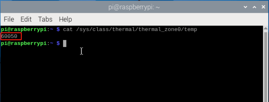

2.11.2 Read temp File
Press “Ctrl+Alt+T” to open the command line terminal, then type “cat /sys/class/thermal/thermal_zone0/temp” and press Enter to directly view the CPU temperature. The returned value (60050) divided by 1000 gives the current temperature of the CPU, which is 60.05°C.
2.11.3 Real-time Monitoring through Status Bar

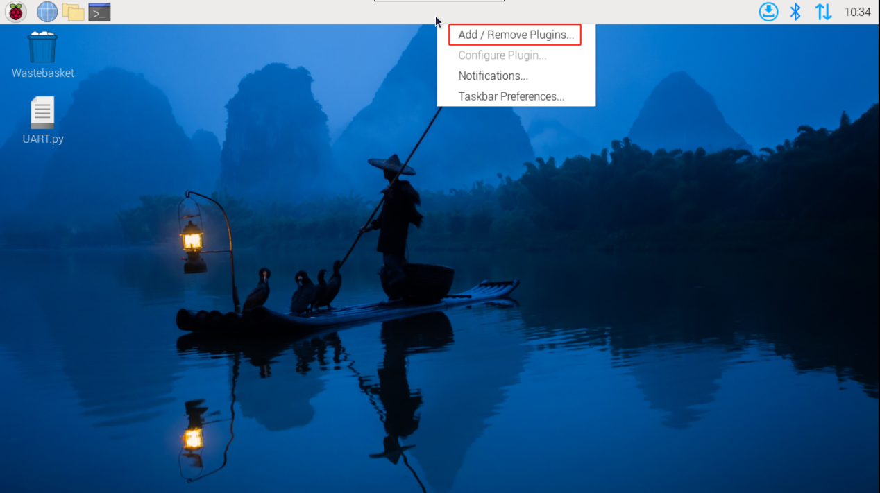

(1) Right-click the status bar, and choose ‘Add/Remove Plugins’ option.
(2) Choose ‘CPU Temp’, then click-on ‘Add to right’, lastly activate ‘OK’ button.
(3) Having finished the previous step, the temperature will be displayed at the right corner of the status bar.

The Raspberry Pi 5 is equipped with 2 USB 2.0 (black) and 2 USB 3.0 (blue) ports. These ports allow you to connect external hard drives, SSDs, or USB memory sticks to any USB port on the Raspberry Pi. Once connected, you can mount the file system to access the data stored on these devices.
By default, the Raspberry Pi automatically mounts some popular file systems, such as FAT, NTFS, and HFS+, to the directory ‘/home/pi’. If you want to mount the storage device to a specific location, you will need to do so manually.
(1) Connect the external storage device, USB flash drive, hard disk drive, or SSD, to the USB port of the Raspberry Pi.
(2) Press ‘Ctrl+Alt+T’ to open the command-line terminal, then execute the command ‘sudo fdisk -l’ to check the connected devices and their corresponding mount points, such as ‘/dev/ram0’ or ‘/dev/ram1’, which indicate the mounting points of the disks.
sudo fdisk -l
(3) Run the command ‘sudo mkdir /home/pi/test’, and create the mounting point to the directory ‘/home/pi/test’.
(4) Execute the command ‘sudo mount /dev/sda2 /home/pi/test’ to mount the external device ‘/dev/sda2’ to the previously created mount point ‘/home/pi/test’. Afterward, the external device will be mounted to the specified path.

(1) Press ‘Ctrl+Alt+T’ to open the command-line terminal, input the command ‘sudo vim /etc/hosts’ to access the hosts file.
(2) Locate this line of code ‘127.0.1.1 raspberrypi’.

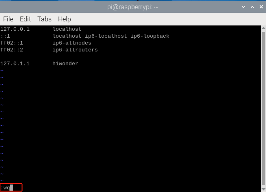

(3) Press ‘i’ key to enter the editing mode. Then replace ‘raspberrypi’ with a new name. For example, Hiwonder.
(4) Press ‘Esc’ key, and type ‘:wq’ to save the change.
(5) After modification, restart the Raspberry Pi.

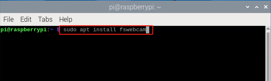

2.15.1 FSWebcam Installation
FSWebcam is a command line tool designed for Linux systems, offering an open-source solution for capturing camera images and saving them as image files. It operates by interfacing with the camera through the Video4Linux interface, allowing users to adjust various settings such as image quality, resolution, and more using available options and parameters. To begin using FSWebcam, simply install the tool through the command line interface.
(1) Press ‘Ctrl+Alt+T’ to open the command-line terminal, and run the command ‘sudo apt install fswebcam’ to install FSWebcam.

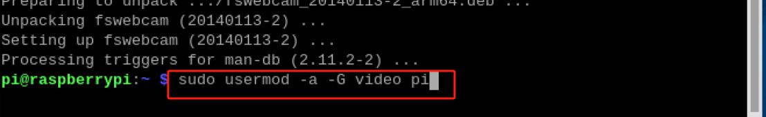

(2) Execute the command ‘sudo usermod -a -G video pi’ to grant user permissions to the video group.
(3) Type ‘groups’ to check whether users are added to the video group.

(3) Enter the ‘sudo nano backup.sh’ command in any location (e.g., under home/pi) to create a script file named ‘backup.sh’. Paste the following content into the empty space.
sudo nano backup.sh
#!/bin/sh
sudo dd if=/dev/zero of=raspberrypi.img bs=1MB count=7500
sudo parted raspberrypi.img --script -- mklabel msdos
sudo parted raspberrypi.img --script -- mkpart primary fat32 8192s 122879s
sudo parted raspberrypi.img --script -- mkpart primary ext4 122880s -1
loopdevice=\`sudo losetup -f --show raspberrypi.img\`
device=\`sudo kpartx -va \$loopdevice \| sed -E 's/.\*(loop\[0-9\])p.\*/\1/g' \| head -1\`
device="/dev/mapper/\${device}"
partBoot="\${device}p1"
partRoot="\${device}p2"
(4) Once the copying is finished, press ‘Ctrl+X’. You’ll be prompted to confirm whether to save. Press ‘Y’ to confirm, then press ‘Enter’ to exit.
(5) After exiting, enter the ‘sudo chmod 777 backup.sh’ command to grant permissions to the file so that all users can read, write, and execute.

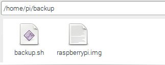

(6) When you need to execute a script to enable the backup function, enter the command ‘sh backup.sh’.
sh backup.sh
(7) After executing the command, the backup file will be generated.

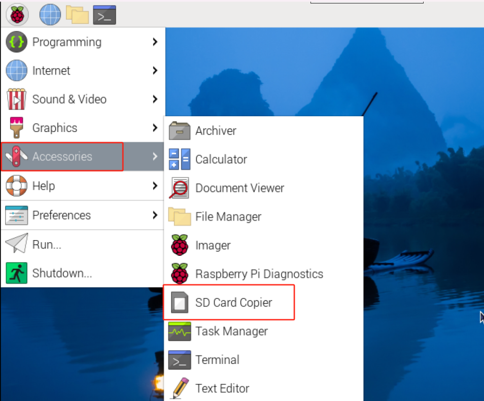

  • SD Card Copier Tool of Raspberry Pi
(1) Insert the empty SD card into the card reader, and connect to the USB port of the Raspberry Pi.
(2) After starting the Raspberry Pi successfully, click the Raspberry Pi icon in the upper left corner, select “Accessories” from the menu, and open the “SD Card Copier” tool.
(3) In the /dev/mmcblk0 path, select the SD card containing the image under “Copy From Device.” Then, in the dev/sda path, select the new SD card under “Copy To Device.”
(4) “New Partition UUIDs” below is the option for creating a new partition. Check it if you need it; uncheck it does not affect the outcome.
