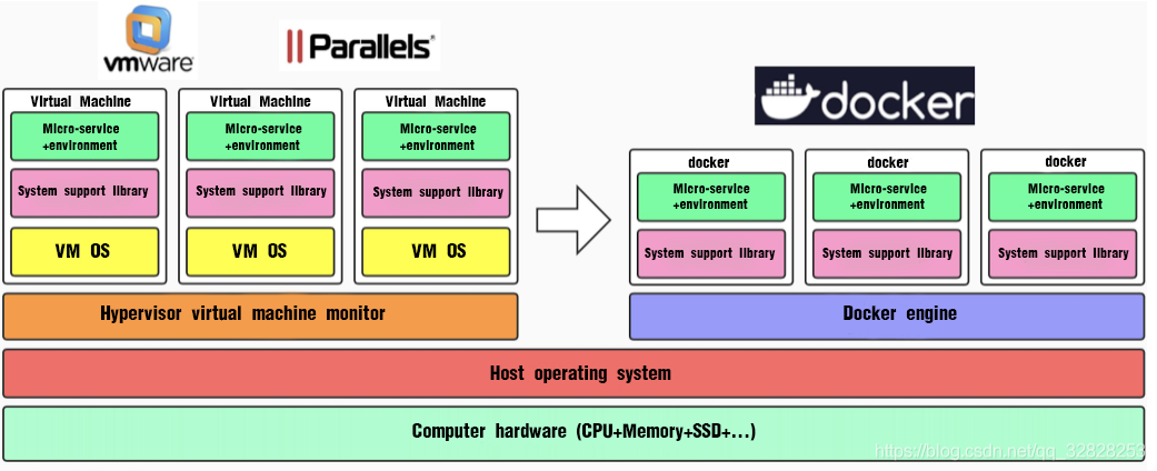

  • Virtual Machines VS Docker
(1) The Docker daemon can directly communicate with the host operating system to distribute resources for each Docker container. It can also isolate the containers from the host operating system and each other. Virtual machines take several minutes to start, while the Docker containers can start within a few milliseconds. Since Docker has no overstaffed slave operating system, it can save a significant amount of disk space and other system resources.
(2) Virtual machines are more specialized in thoroughly isolating entire running environments. For example, cloud service providers usually adopt virtual machine technology to isolate different users, instead, Docker is widely used to isolate different applications such as front-end, back-end, and database.
(3) Docker containers are more resource-efficient and faster (in starting, closing, creating, and deleting) than virtual machines.

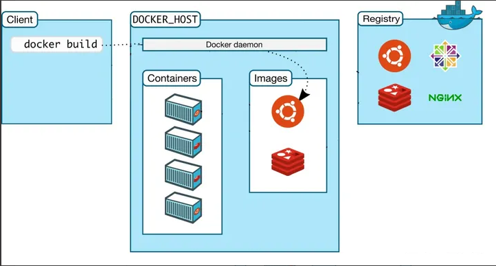

  • Docker Architecture
Docker adopts a client-server architecture, where the Docker client communicates with its daemon responsible for building, operating, and distributing Docker containers. They can run on the same system, or the Docker client can be connected to a remote Docker daemon. They communicate with REST API over UNIX sockets or network interfaces. Another Docker client is Docker Compose, which enables you to manage applications composed of a set of containers.

Docker utilizes the common CS (Client-Server) architecture, where the Docker client is responsible for processing various commands input by users. Such as “docker build” and “docker run”. The real executor is the Docker daemon which acts as the server. It’s worth noting that the Docker client can run on the same machine as the Docker daemon.
Next, let’s use a few commands to explain Docker’s workflow:
(1) docker build
This command is used when the “dockerfile” is written and handed over to Docker for “compilation”. The client forwards the request to the Docker daemon, which then creates an “executable program” image based on the “dockerfile”.
(2) docker run
The “executable program” image can be run after obtained with the “docker run” command. The Docker daemon receives the command and locates the specific image, which is then loaded into memory and executed. The running instance of the image is called a container.
(3) docker pull
Users send a command using the Docker client, and the Docker daemon receives the command to send a request to the Docker Registry to download the image. Once downloaded, the image is stored locally and can be used.

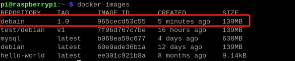

(2) Enter “docker images” in the terminal to list all images on the local master.
docker images
The relevant information of “Hello_World” can be checked, corresponding to the parameters:
REPOSITORY: image’s repository source.
TAG: image’s tag.
IMAGE ID: image’s ID.
CREATED: image’s creation time.

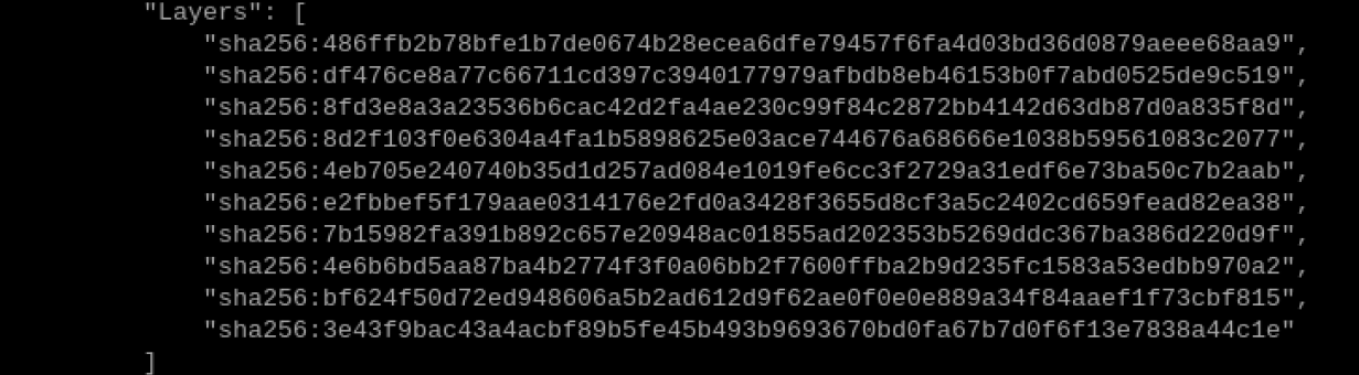

(4) Enter “docker inspect ee30efe9” in the terminal to output JSON data including detailed information about the “hello-world” image.

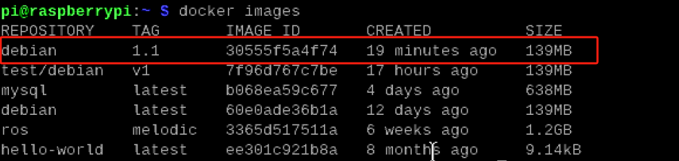

(1) “docker images” lists all images on the local master.
docker images
Corresponding Parameters:
REPOSITORY: the repository source of the image.
TAG: the tag of the image.
IMAGE ID: the ID of the image.
CREATED: the creation time of the image.
SIZE: the size of the image.
(The same repository source can have multiple tags representing different versions of the repository source. You can define different images using REPOSITORY: TAG. If a tag version for an image is not defined, Docker will use the “lastest” image by default.)
docker images” also provides some options:
-a: list all local images
-q: display image id only
–digests: display the image’s digest information

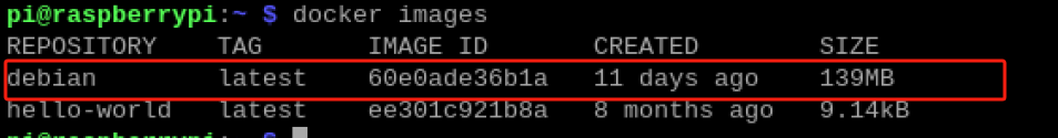

For example, download the “debian” image: Press “Ctrl+Alt+T” to open the command line terminal. Then enter “docker pull debian” and press “Enter”.
docker pull debian
Enter “docker images” to view the images on the master, and you can see a “debian” image has been added to the list of images.

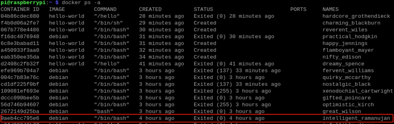

  • “docker ps” Listing All Running Containers
Command Parameters: docker ps [OPTIONS]
Commonly Used Parameters:
-a:list all running and previously run containers
-l:display the latest created container
-n=?:display multiple (n) recently created containers
-q:Default mode, only display container IDs
Enter “docker ps -a” in the command line terminal and press “Enter”. The running and run containers are displayed. “container id” is the container ID, “image” is the image name used by the container, “created” is the creation time of the container, and “status” is the current status of the container.
docker ps -a

Enter the command “docker image inspect mysql” in the terminal to check the image layering.

(1) Press “Ctrl+Alt+T” to open the command line terminal and enter “docker ps -a”. It displays all previously run containers, and you need to locate the container ID to be committed.
docker ps -a

(3) Enter “docker images” in the terminal to view the images on the master. You can see a “debain” has been added to the list of images.
docker images

(3) Enter “docker build -f dockerfile -t debain:1.1 .” in the terminal to build a new image.
(4) Enter “docker images” in the terminal, then you can see the newly built image.
docker images
