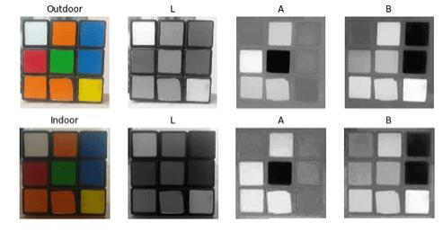

Color processing is executed through the Lab color space. Initially, the RGB color space is converted to Lab, followed by binarization processing. Subsequent operations, including expansion and corrosion, are performed to obtain an outline containing solely the target color. Finally, the color outline is encircled to achieve color identification of the object.

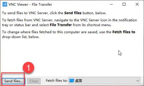

Before operation, transfer the file ‘color_discern.py’ saved in ‘5. OpenCV Computer Vision Course/5.1 Application Course/ Source Code’ to the Raspberry Pi.
For file transfer methods, please consult the documents located in the directory “2. Raspberry Pi 5 Basic Operation and Configuration > 2.2 Remote Access and Remote File Transfer”.

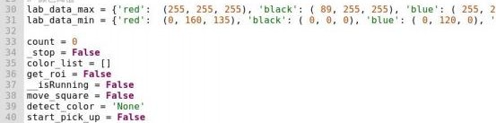

(2) Set the Color Threshold
Next, establish the threshold for color recognition. Initially, define the target thresholds for color recognition by the camera (note that OpenCV’s default color model is BGR, with “‘red’: (0, 0, 255),’blue’: (255, 0, 0),’green’: (0 , 255, 0)”). Then, specify a range for the threshold, as illustrated below:

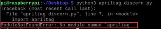

If you encounter the following prompt, it indicates that the “apriltag” package is missing and must be manually installed.
(3) Install cmake compilation tool first to ensure the packages can be successfully compiled.
(4) After installing the compilation tool, execute the command ‘pip3 install apriltag -i https://pypi.tuna.tsinghua.edu.cn/simple’, and hit Enter to install the ‘apriltag’ package.
(5) Run the command ‘python3 apriltag_discern.py’, and hit Enter to run the program.

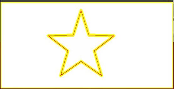

cv2.drawContours(img, [np.array(corners, np.int)], -1, (0, 255, 255), 2)
AprilTag recognition primarily utilizes the drawContours() and putText() functions from the cv2 library:
The drawContours() function is employed to draw the outline of the tag. Taking “cv2.drawContours(img, [np.array(corners, np.int)], -1, (0, 255, 255), 2)” as an example, the parameters in the brackets hold the following meanings:
The first parameter “img” represents the image where the outline will be drawn.
The second parameter “[np.array(corners, np.int)]” denotes the contour itself, which is a Python list.
The third parameter “-1” specifies the contour to be drawn from the provided contour list; the value “-1” represents all contours within it.
The fourth parameter “(0, 255, 255)” signifies the outline color, with the order representing Blue, Green, Red; here, it represents yellow.
The fifth parameter “2” determines the width of the outline; “-1” indicates filling the outline with the specified color.

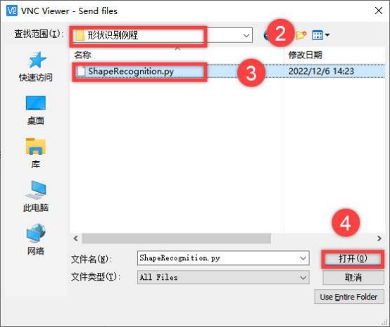

Import Shape Recognition Program Files
The camera is not hot-swappable. Please ensure it is plugged into the USB interface on the Raspberry Pi motherboard before powering on the Raspberry Pi
(1) Connect the camera to the Raspberry Pi controller and start the Raspberry Pi. After the Raspberry Pi is booted up successfully, establish the connection between the Raspberry Pi and VNC.
(2) Click-on
to transfer files.
(3) Choose ‘Send files ‘, and select the ‘ShapeRecognize.py’file, then click-on ‘Open’.

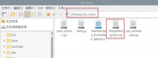

(5) At this point, the live camera feed will occur. When an object of red, green, or blue color is recognized, a circle of the corresponding color will appear to encircle the object.
(6) If you need to terminate this program, press ‘q’key to terminate the running program.
(7) To facilitate later viewing, we can move/copy this program to the directory home\pi\Ai_vision.

Then utilize the drawContours() function to sketch the edge line.
# 根据检测到边缘画边using drawContours() function(Draw edges based on detected boundaries using drawContours() function)
cv2.drawContours(image, [contour], 0, (0, 0, 255), 5)

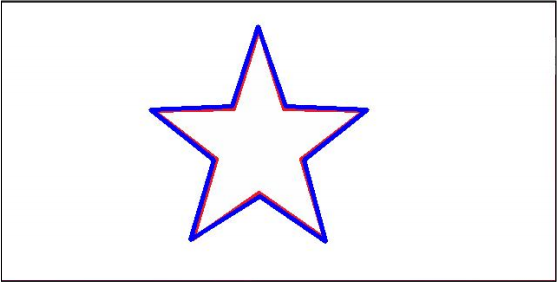

In this function:
The first parameter, image, signifies the target image.
The second parameter, [contours], denotes the input contour group, with each contour group consisting of a point vector.
The third parameter, 0, specifies which contour to draw. If negative, all contours will be drawn.
The fourth parameter, (0, 0, 255), represents the color of the outline.
The fifth parameter, 5, indicates the line width of the outline. If negative or CV_FILLED, it denotes filling the inside of the outline.

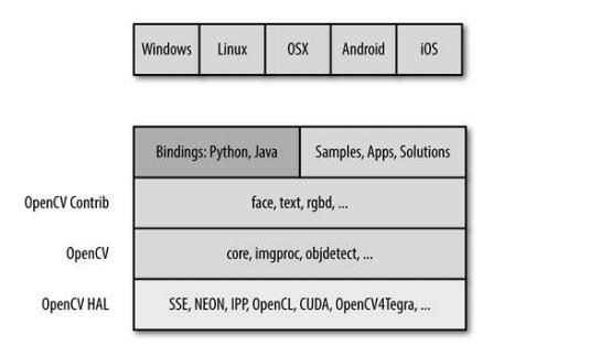

OpenCV is composed of several layers of modules.
(1) The bottom layer is the hardware optimization based on HAL (Hardware Acceleration Layer)
(2) Above the bottom layer are the codes contributed by other developers contained in opencv_contrib module. These codes, core of OpenCV, involves most of the high-level functionality.
(3) The next layer are language bindings and sample applications.
(4) The top layer is the interaction between OpenCV and operating system.

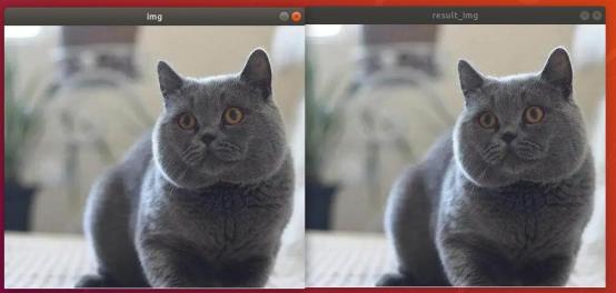

5.2.4 Picture & Video Loading and Display
Image Reading and Writing
Read image: cv2.imread(Location ,Model)
(1) Location——read the location of the image which can be the absolute path and relative path. However pay attention to the usage of the slash in different operating system.
(2) Model——model of image loading. The first model is cv2.IMREAD_COLOR used to load a color picture but will not load Alpha channel(record degree of transparency). The second one is cv2.IMREAD_GRAYSCALE which is used to load a grayscale picture. The third type is cv2.IMREAD_UNCHANGED for loading image and Alpha channel simultaneously.
(3) Display image: cv2.imshow(“Name”, Pic)
(4) Name——Display the box name of the image
Pic——Pictures to be displayed(The image read by cv2.imread() has

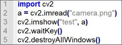

already used before) For example, create a new py file and put the picture named “camera.png” into the same folder. Then input the following codes. After the codes run, the image will be displayed and you can press any key to hide the image.
cv2 waitkey() allows users to display a window for given milliseconds or until any key is pressed. And cv2.destroyALLWindows() function will close all the windows.

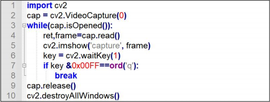

Video can be seen as pictures that are switched swiftly. Therefore, video reading is the extension of the image reading and writing. Camera initialization: cv2.VideoCapture(Number)
(1) Number——Serial number of camera, 0 usually.
Read the frame of camera:cap.read()。
(2) cap—the camera that has been defined before
Release the resources of the camera:cap.release()。
For example, the camera screen will be displayed on the desktop. When q key is pressed, the camera screen will be hidden.

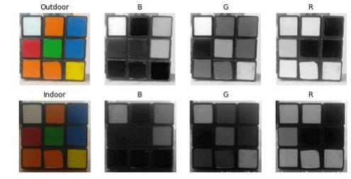

② The illumination will affect the value of each color channel and these three color channels are related. For better understanding of color space, we can divide the image into R, G and B three components
From the blue channel picture in indoor, blue is similar to white. However, from the blue channel picture in outdoor, there is distinction between blue and white. And this nonuniformity makes color-based segmentation infeasible in color space. In addition, the value of these two pictures are also different.
Therefore, there are flaws in RGB color space, including uneven color value and mixed chroma and luminance.
(2) Lab Color Space
Similar to RGB, Lab also has three image channels.
L:Luminance channel
a:Color channel a representing colors from green to carmine.
b:Color channel b representing colors from blue to yellow.
Lab is totally different from RGB color space. In RGB, colors are divided into three channels and each channel contains luminance. While in Lab, colors are divided into L channel only containing luminance, a channel and b channel.
L component: represent the luminance of the pixel. The larger L value, the greaterthe luminance.
a component: represent the range from red to green.
b component: represent the range from yellow to blue.
In OpenCV, R, G and B value in RGB color space all range from 0 to 255.
In Lab color space, L ranges from 0 to 100. When L is 0, the color is black and when it is 100, the color is white. a and b values range from -128 to 127. When both a and b are 0, the color is gray.

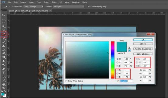

To better assist in your understanding of the comparison between RGB and Lab, operate on PS.
① Use eyedropper tool to get the color.
② Click the color picker at bottom left corner, the correspondence between Lab and RGB is listed below.
Lab color space has these features:
A perceptually uniform color space align with the way human perceive color.
Independent from device(capture or display)
Widely applied in Adobe Photoshop
It is related to the RGB color space through complex transformation equations
In OpenCV, the image converted into Lab color space is as follow.

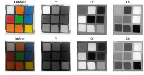

(3) Ycrcb Color Space
HVS (Human Visual System) is less sensitive to color than to luminance.
In traditional RGB color space, three primary colors, RGB, bear the same importance, but luminance is overlooked.
In YCrCb color space, Y represents luminance, and Cr and Cb stand for chroma. Cr indicates red component and Cb indicates blue component.
Luminance can reflect how bright or dark a color is, which can be calculated through a weighted sum of the light intensity. The green component has the greatest impact on RGB light while the blue component the least.
Observations focusing on intensity and color components can be made for LAB for illumination changes. Compared with LAB, the perception difference between red and orange in outdoor is smaller, while white between three components are distinguished.

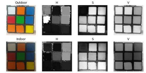

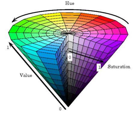

(4) HSV Color Space
HSV color space is vision perception oriented color model which is composed of these three components.
H (hue), S (saturation) and V (value)
Hue: it is related to the dominant wavelength of light in the mixed
spectrum, for example “red orange yellow green blue purple” represents
different hues respectively. In the perspective of wavelength, light of different wavelength appear as different colors, i.e. different hues.
Saturation: describes the purity of a color or pertains to the amount of white light mixed with a hue. Pure spectrum is fully saturated, and dark red (red mixed with white) and light purple (purple mixed with white) is not
saturated enough. Saturation is inversely proportional to the amount of white light mixed.
Brightness: it reflect the brightness perceived by human and it is relative to the reflection of the object. For a hue, the greater the amount of white mixed in a hue, the greater the value. And the greater the amount of black mixed in a hue, the weaker the brightness.
The most distinguished feature of HSV is that it only employs single
channel to describe hue, which make it intuitive to designate a hue. But HSV colors rely on device.
H components in outdoor and indoor are similar, which indicates the color is complete even though the lighting changes.
S components in outdoor and indoor are also similar. V stands for brightness so that it will change as the lighting changes.
The difference of red value between indoor and outdoor is large for the reason that H component represent red by angle ranging from [300,360] and [0,60].

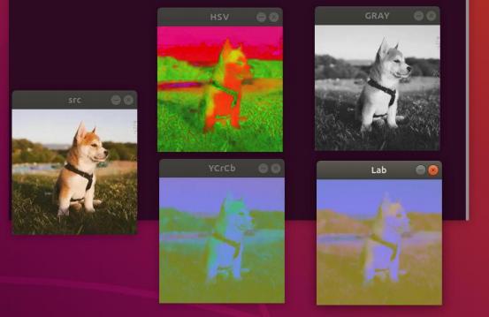

Follow the following steps to transform the pictures into some common color spaces.
(1) Operation Steps
Before operation, please move to “5. OpenCV Computer Vision Course->5.2 Basic Course->5.2.7 Image Processing—Color Space Conversion->Sample Code”, and copy the sample routine “color_conversion.py” and picture “img1.jpg” into the shared folder
The input command should be case sensitive and the keywords can be complemented by “Tab” key.
① Open virtual machine and start the system. Click
, and then
or press “Ctrl+Alt+T” to open command line terminal.
② Input command “cd /mnt/hgfs/Share/Image” and press Enter to enter the shared folder.
③ Input command “python3 color_conversion.py” and press Enter to run the code.
(2) Program Outcome
After execution, the final processed result is as follow.
(3) Program Analysis
① Firstly, import the required module with import statement.
② Call imread() function in cv2 module to read the image to be processed.
③ Next, set the size of the inserted picture. And in the bracket is the name of the picture.
④ Create four functions in sequence to convert the image into Gray, Lab, Ycrcb amd HSV respectively.
⑤ Display the image before and after conversion respectively.
⑥ Lastly, close the window through the function.

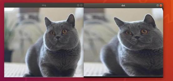

5.2.8 Image Processing —Geometric Transformation
Introduction
A spatial transformation of an image is a geometric transformation of the image coordinate system. It map the coordinate of a picture to a new
coordinate of other picture. And geometric transformation will not change the pixel of the image, but rearrange the pixels on the image plane.
According to OpenCV functions, we divide mapping into scaling, flipping,affine transformation, perspective, etc.
Scaling
Scaling is to adjust the size of the picture, for example zoom in or zoom out the picture. In OpenCV, cv2.resize() function is used to scale the image.
dst=cv2.resize(src,dsize[,fx[,fy[,interpolation]]])
dst represents the output image whose type is the same as src. And its
size is dsize (when it is not 0) or can be calculated through src.size(), fx and fy.
src represents the original picture
dsize stands for the size of the output image
fx indicates the horizontal scaling ratio
fy denotes the vertical scaling ratio
interpolation is for interpolation method.
| Type | Description |
| cv2.INTER_NEAREST | nearest neighbor interpolation |
| cv2.INTER_LINEAR | linear interpolation |
| cv2.INTER_CUBIC | Cubic spline interpolation. First, thecubic spline fitting is performed on the 4 x 4 nearest neighbors near theoriginal image, and then the cubicspline value corresponding to thetarget pixel is taken as the value of the corresponding pixel in the targetimage. |
| cv2.INTER_AREA | Area interpolation similar to nearestinterpolation. Sample the current pixel according to the pixels in thesurrounding area of the current pixel. |
| cv2.INTER_LANCZOS4 | Lanczos interpolation over 8×8 neighborhood |
| cv2.INTER_LINEAR_EXACT | Bit accurate bilinear interpolation |
| cv2.INTER_MAX | Difference encoding mask |
| cv2.WARP_FILL_OUTLIERS | Flag, fills all of the destination image pixels. If some of them correspond to outliers in the source image, they are set to zero |
| cv2.WARP_INVERSE_MAP | flag, inverse transformation. Forexample, polar transformation. If flag is not set, perform transformation:dst( ρ,ϕ)=src(x,y) For example, If flag is set, perform transformation: dst(x,y)=src(ρ,ϕ) |

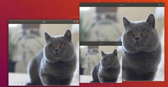

(1) Operation Steps
The program will scale the image.
Before operation, please copy the routine “Scale” in “4.OpenCV->Image Processing — Geometric Transformation->Routine Code” to the shared folder.
, and then
② Input command “cd /mnt/hgfs/Share/Scale” and press Enter to enter the shared folder.
③ Input command “python3 Scale.py” and press Enter to run the code.
python3 Scale.py
(2) Program Outcome
The final output picture is as follow.
① src: Original picture. Its size is 492*430 pixels (width*height)
② res1: The size of the picture after zoomed in. Its size is 590*512 pixels (width*height)
③ res2: The size of the picture after zoomed out. And its size is 295*258 pixels(width*height)

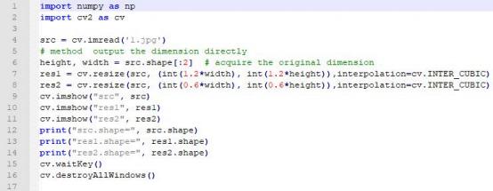

The routine “Scale.py” can be found in “5. OpenCV Computer Vision Lesson->5.2 Basic Course->5.2.8 Image Processing—Geometric Transformation->Routine Code->Scale.py” .
Firstly, import the required module through import statement.
Then call imread() function in cv2 module to read the image that needs to be scaled.
In the bracket is the name of image.
The original width of the picture is 492 pixel, and height is 430 pixel.
Parameter dsize can be used to designate the size of target image res1 and res2 (The name of the image can be customized)
The first parameter in dsize corresponds to the width after scaling. (width i.e. the number of columns which is related to parameter fx.) And the second parameter corresponds to the height after scaling. (height i.e. the number of row which is related to parameter fy)
If the value of dsize is specified, the size of the target image is determined by dsize regardless of whether the parameters fx and fy are specified.
Therefore, program to acquire the original dimension first, and then
directly scale the width and height. To zoom in this picture, this routine
enlarges the width of res1 to 1.2 times the original and height to 1.2 times the original. Through calculation, the width is 590 pixels (92x1.2) and the height is 516 pixels (430x1.2).
To zoom out the picture, this routine will shrink the res2 width to 0.6 times the original, and the height to 0.6 times the original. The final width is 295
pixels (492x0.6) and height is 258 pixels (430x0.6). And the image size, before and after processing, can printed.

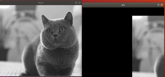

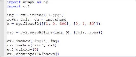

(1) Translation
Translation is the movement of the object. If the coordinates of the object translation is obtained, the following transformation matrix can be created.
Put the transformation matrix into the array whose type is np.float32, and assign M matrix to cv2.warpAffine() function so as to realize translation.
① Operation Steps
This routine will translate the image to right.
Before operation, please copy the routine code in “5.OpenCV->5.2 Basic Course->5.2.8 Image Processing — Geometric Transformation->Routine Code” to the shared folder.
, and then
or press “Ctrl+Alt+T” to open command line terminal.Input command “cd /mnt/hgfs/Share/Translation/” and press Enter to enter the shared folder.
Input command “python3 Translation.py” and press Enter to run the routine.
② Program Outcome
③ Program Analysis
The routine “Translation.py” can be found in “5. OpenCV Computer Vision Lesson->5.2 Basic Course->5.2.8 Image Processing—Geometric Transformation->Routine Code->TranslaTion” .
Then call
imread()function in cv2 module to read the image that needs to be translated.
Return the number of row, column and channel of the image pixel to rows, cols and ch.
As mentioned before, if the coordinate of the object translation can be obtained, the transformation matrix can be created.
After setting, the picture before and after translation can be displayed through imshow function.
Lastly, close the window through the function, and you can press any key to exit the program.
cv2.waitKey() is a keyboard binding function. Its time unit is milliseconds (ms). The function will wait n ms set in bracket to check if there is any
keyboard input. If there is, the ASCII value of the key is returned. -1 will be
returned if there is no keyboard input. Generally we set it to 0, the function will wait for keyboard input endlessly.
cv2.destroyAllWindows() is used to delete the window. If there is no parameter in the bracket, all the windows will be deleted. If you input the specific value of the window, the designated window will be removed.

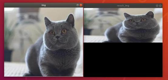

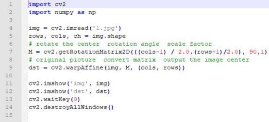

(2) Rotation
Both translation and rotation are the examples of the affine transformation, and employ cv2.warpAffine function to realize affine transformation. But their transformation matrix is different. When rotating the image with function
cv2.warpAffine(), obtain the transformation matrix with function cv2.getRotationMatrix2D().
The function format is
retval=cv2.getRotationMatrix2D(center, angle, scale)
center refers to the center of rotation.
angle stands for rotation angle. When it is positive, the image will be rotated counterclockwise. When it is negative, the image will be
rotated clockwise.
scale means scaled size
The rotation angle θ can be obtained from matrix M.
OpenCV has improved this matrix to provide scaling rotation and adjustable rotation center, as the picture shown below.
The above matrix represents a rotation around center.x and center.y by θ degrees.
For example, set the function as below to rotate the image around the image center counterclockwise by 45 degree, and zoom out the image 0.6 times the original. Then call this function to generate the matrix.
M=cv2.getRotationMatrix2D((height/2,width/2),45,0.6)
① Operation Steps
This routine will rotate the image 90 degree counterclockwise.
Before operation, please copy the routine “Revolve” in “5.OpenCV->5.2 Basic Course->5.2.8 Image Processing — Geometric Transformation->Routine Code” to the shared folder.
, and then
or press “Ctrl+Alt+T” to open command line terminal.Input command “cd /mnt/hgfs/Share/Revolve/” and press Enter to enter the shared folder.
Input the command “python3 Revolve.py” and press Enter to run the routine.
python3 Revolve.py
② Program Outcome
The output picture is as follow.
③ Program Analysis
The routine “Revolve.py” can be found in “5. OpenCV Computer Vision Lesson->5.2 Basic Course->5.2.8 Image Processing—Geometric Transformation->Routine Code->Revolve” .
Then call
imread()function in cv2 module to read the image that needs to be rotated.
The image will rotate around the image center 90 degree counterclockwise. And its size remains the same.
Output the original image center
After setting, we can call imshow function to display the pictures before and after rotation.
Lastly, call function below to close the window, and you can press any key to exit the program.

(2) Program Outcome

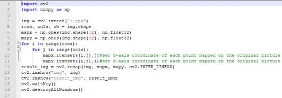

(1) Copy Pixel
① Operation Steps
All pixels in the target image are mapped to the pixels on the 100th row and 200th column in the original image.
Before operation, please copy the routine “Remap” in “5.OpenCV->5.2 Basic Course->5.2.8 Image Processing — Geometric Transformation->Routine Code” to the shared folder.
, and then
or press “Ctrl+Alt+T” to open command line terminal.Input command “cd /mnt/hgfs/Share/Remap/” and press Enter to enter the shared folder.
Input command “python3 copy.py” and press Enter to run the routine.
python3 copy.py
② Program Outcome
A pure-colored picture will be output.
③ Program Analysis
The routine “copy.py” can be found in “5. OpenCV Computer Vision Lesson->5.2 Basic Course->5.2.8 Image Processing—Geometric Transformation->Routine Code->Remap”.
Then call
imread()function in cv2 module to read the image that needs to be scaled.
mapx and mapy separately set the x axis and y axis coordinate. Map all the pixels on the target image to the pixels on 100th row, 200th column of the original image.
After setting, the picture before and after the pixels are copied can be displayed through imshow function. Lastly, close the window through the function, and you can press any key to exit the program.
cv2.waitKey() is a keyboard binding function. Its time unit is milliseconds (ms). The function will wait n ms set in bracket to check if there is any keyboard input. If there is, the ASCII value of the key is returned. -1 will be returned if there is no keyboard input. Generally we set it to 0, the function will wait for keyboard input endlessly.

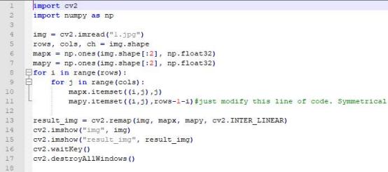

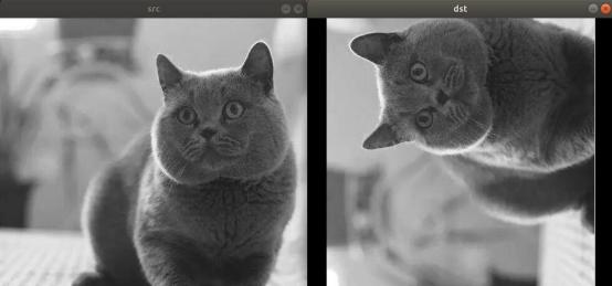

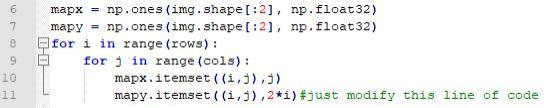

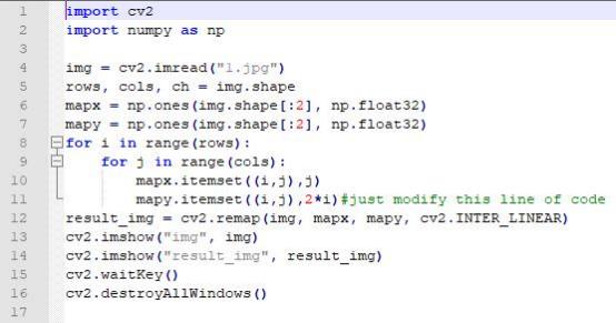

(3) Rotate Around X Axis
If make the image flip around x axis,
① x axis coordinate remains unchanged.
② The y-axis coordinate after rotation is symmetric with respect to x axis.
Or:
① map1 remains unchanged
② map2= total number of row - 1 - current row number
(4) Operation Steps
Withcv2.remap() function, the pixels can be remapped, and also be
flipped and then remapped. Ensure the x axis coordinate remains unchanged and y-axis coordinate after rotation is symmetric with respect to x axis.
Before operation, please copy the routine “Remap” in “5. OpenCV Computer Vision Course->5.2 Basic Course->5.2.8 Image Processing — Geometric Transformation->Routine Code” to the shared folder.
, and then
② Input the command “cd /mnt/hgfs/Share/Remap/” and press Enter to enter the shared folder.
③ Input command “python3 x_rotation.py” and press Enter to run the routine.

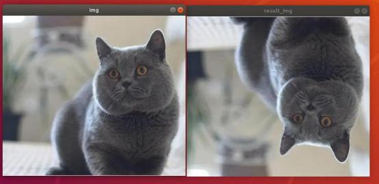

(5) Program Outcome
The final output image is as follow.
(6) Program Analysis
The routine “x_rotation.py” can be found in “5. OpenCV Computer Vision Course->5.2 Basic Course->5.2.8 Image Processing—Geometric Transformation->Routine Code” .
① Firstly, import the required module through import statement.
② Then call imread() function in cv2 module to read the image that needs to be scaled.
③ Return the number of row, column and channel of the image pixel to rows, cols and ch.
④ mapx and mapy separately set the x axis and y axis coordinate. map1 remains unchanged, and map2 = “total number of row - 1 - current row number”
⑤ After setting, the picture before and after can be displayed through imshow function. Lastly, close the window through the function, and you can press any key to exit the program.

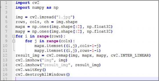

(7) Rotate Around Y Axis
If make the image flip around y axis,
① y axis coordinate remains unchanged.
② The x-axis coordinate after rotation is symmetric with respect to y axis.
Or:
① Map2 remains unchanged
② map2 = “total number of column - 1 - current column number”
(8) Operation Steps
Before operation, please copy the routine “Remap” in “5. OpenCV Computer Vision Course->5.2 Basic Course->5.2. 8 Image Processing — Geometric Transformation->Routine Code” to the shared folder.
, and then
② Input command “cd /mnt/hgfs/Share/Remap/” and press Enter to enter the shared folder.
③ Input command “python3 copy_all.py” and press Enter to run the routine.
python3 copy_all.py
(9) Program Outcome
(10) Program Analysis

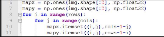

The routine “y_rotation.py” can be found in “5. OpenCV Computer Vision Course->5.2 Basic Course->5.2.8 Image Processing—Geometric Transformation->Routine Code” .
mapx and mapy separately set the x axis and y axis coordinate. mapy remains unchanged, and mapx = “total number of column - 1 - current column number”

① The x-axis coordinate after rotation is symmetric with respect to y axis.
Or:
① map1 = “total number of row - 1 - current row number”
② map2= “total number of row - 1 - current row number”
(12) Operation Steps
Before operation, please copy the routine “Remap” in “4.OpenCV->Lesson 8 Image Processing — Geometric Transformation->Routine Code” to the shared folder.
Note: The input command should be case sensitive and the keywords can be complemented by “Tab” key.
, and then
Input command “python3 xy_rotation.py” and press Enter to run the routine.
(13) Program Outcome
(14) Program Analysis
The routine “xy_rotation.py” can be found in “5. OpenCV Computer Vision Course->5.2 Basic Course->5.2.8 Image Processing—Geometric Transformation->Routine Code” .
Then call
mapx and mapy separately set the x axis and y axis coordinate. The value of mapy is changed as “total number of row - 1 - current row number”, and mapx = “total number of column - 1 - current column number”
(15) Compress Image
Compressing image is to compress the original image by half.
(16) Operation Steps
Before operation, please copy the routine “Scale” in “5. OpenCV Computer Vision Course->5.2 Basic Course->5.2.8 Image Processing— Geometric Transformation->Routine Code” to the shared folder.
, and then
Input command “python3 half_size.py” and press Enter to run the code.
(17) Program Outcome
(18) Program Analysis
The routine “half_size.py” can be found in “5. OpenCV Computer Vision Course->5.2 Basic Course->5.2.8 Image Processing—Geometric Transformation->Routine Code” .
Then call
imread()function in cv2 module to read the image.
mapx and mapy separately set the x axis and y axis coordinate and double the X axis

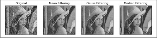

5.2.9 Image Processing - Smoothing
Image Noise
During collecting, processing and transferring, the digital image will be disturbed by different noises, which leads to low-quality image, obscure image and disappeared image feature. And image smoothing is to improve the image by removing noise, and salt-and-pepper noise as well as Gauss noise are common.
(1) Salt-and-pepper Noise
Salt-and-pepper noise is also known as pulse noise which is white dots and black dots appearing randomly, like there are black pixels in bright area and white pixels in dark area.
At left is the original picture and the right is the picture with salt-and-pepper noise.
Gauss Noise
Gauss noise is a term from signal processing theory denoting a kind of signal noise that has a probability density function (pdf) equal to that of the normal distribution (which is also known as the Gaussian distribution).
Commonly, it can be suppressed by mathematical statistics.
At left is the original picture and the right is the picture with Gauss noise.
(2) Image Smoothing
From the perspective of signal, image smoothing is to filter the high frequency part of the signal and reserve the low frequency part.
Based on filter, filtering can be divided into mean filtering, Gaussian filtering and median filtering.
① Mean Filtering

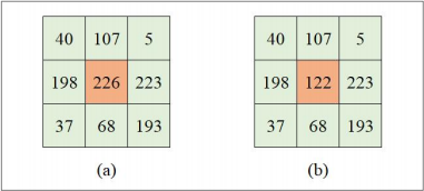

The idea of mean filtering is simply to take the mean of all the pixels of the image that is assign the mean of all the pixels in the unit of a square to the center pixel.
Take the picture below as example. In picture (a), the center pixel value is
“226” and the mean of all the pixels is “ 122” obtained from the equation below, and “ 122” is the new center pixel value.
(40 + 107 + 5 + 198 + 226 + 223 + 37 + 68 + 193) ÷ 9 = 122
Replace the original center pixel value by “ 122” as the picture (b) shown.
The algorithm of the mean filtering is simple and its calculation speed is fast. However, the details of the image are destroyed during removing noise resulting in low definition.
② Gauss Filtering
The weighted mean is calculated by multiplying each value by the corresponding weight, adding the sum, and then dividing the sum by the number of the values.
Gauss filtering is to obtain the weighted mean of all the pixels of the image that is assign the weighted mean in the unit of a square to the center pixel.
Take the picture below as example. In picture (a), the center pixel value is “226” and the weighted mean of all the pixels is “ 164” obtained from the
equation below, and “ 164” is the new center pixel value.
40 × 0.05 + 107 × 0.1 + 5 × 0.05 + 198 × 0.1 + 226 × 0.4 + 223 × 0.1 + 37 × 0.05 + 68 × 0.1 + 193 × 0.05 = 164
Replace the original center pixel value by “ 122” as the picture (c) shown.
③ Median Filtering
The median is the middle value when a data set is ordered from least to greatest.
Median filtering is to take the median of all the pixels of the image that is assign the median in the unit of square to the center pixel.
Take the picture below as example. In picture (a), the center pixel value is “226” and the medium of the pixels is “ 107” , and “ 107” is the new center pixel value.
Replace the original center pixel value by “ 107” as the picture (b) shown.
Operation Steps

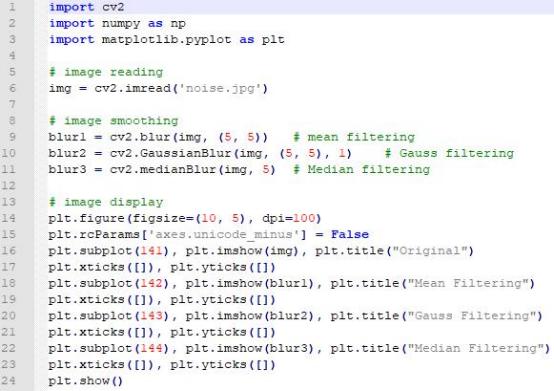

This routine will execute mean filtering, Gauss filtering and median filtering separately.
Before operation, please copy the routine “filtering.py” in”4.OpenCV->Lesson 9 Image Processing — Smoothing->Routine Code” to the shared folder.
(1) Open virtual machine and start the system. Click
, and then
(2) Input command “cd /mnt/hgfs/Share/” and press Enter to enter the shared folder.
cd /mnt/hgfs/Share/
(3) Input command “python3 filtering.py” and press Enter to run the routine.
Program Outcome
Program Analysis
The routine “filtering.py” can be found in “5. OpenCV Computer Vision Course->5.2 Basic Course->5.2.9 Image Processing — Smoothing->Routine Code” .
(1) Image Processing
① Import Module
② Read Images
Then call imread() function in cv2 module to read the image that needs to be filtered.
In the bracket is the image name.
③ Mean Filtering
Call blur() function in cv2 module to perform mean filtering on the specific image.
The format of blur() function is as follow.
cv2.blur(scr, ksize)
The first parameter scr is the input image.
The second parameter ksize is the size of convolution kernel.
④ Gauss Filtering
Call GaussianBlur() function in cv2 module to perform Gauss filtering on the specific image.
The format of GaussianBlur() function is as follow.
cv2.GaussianBlur(src, ksize, sigmaX, sigmaY, borderType)
The first parameter src is the input image.
The second parameter ksize is the size of Gaussian convolution kernel.
Both the height and width of the convolution kernel must be positive number and odd number.
The third parameter sigmaX is the horizontal standard deviation of Gaussian kernel.
The fourth parameter sigmaY is the vertical standard deviation of Gaussian kernel, 0 by default.
The fifth parameter borderType is the type of border filling.
⑤ Median Filtering
Call medianBlur() function in cv2 module to perform median filtering on the specific image.
The format of medianBlur() function is as follow
cv2.medianBlur(src, ksize)
The first parameter “scr” is the input image.
The second parameter “ksize” is the size of the convolution kernel.

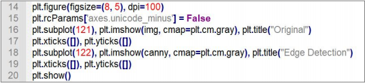

(2) Image Display
① Create Custom Image
Call figure() function in matplotlib.pyplot module to create a custom image for displaying the final output image.
The format of the figure() function is as follow.
matplotlib.pyplot.figure(num=None, figsize=None, dpi=None, facecolor=None, edgecolor=None, frameon=True, FigureClass=<class 'matplotlib.figure.Figure'>, clear=False, **kwargs)
The first parameter num is the only identifier of the image i.e. the serial number of the picture (number) or the name (string).
The second parameter figsize is the width and height of the image in inch.
The third parameter dpi is the resolution of the image i.e. the number of pixels by inch
The fourth parameter facecolor is the background color.
The fifth parameter edgecolor is the frame color
The sixth parameter frameon determines whether to draw the picture, and it is True by default.
The seventh parameter FigureClass is used to select the custom figure when generating the image
The eighth parameter clear determines whether to clear all the original images.
The ninth parameter kwargs represents other properties of the image.
② Modify matplotlib Configuration
matplotlib is plotting library of Python. User can access and modify
matplotlib configuration options through parameter dictionary rcParams.
The codes above are used to manipulate the display of the normal characters.
③ Set the Parameter of Image Display
Call subplot(), imshow() and title() functions in matplotlib.pyplot modules to designate the position, color and headline of the subplot in the Figure.
subplot() function is used to set the position of the subplot, and the function format is as follow.
matplotlib.pyplot.subplot(nrows, ncols, index, **kwargs)
The first parameter nrows and the second parameter ncols respectively are the number of row and column of subplot.
The third parameter index is the index position. Index starts at 1 in the upper left corner and increases to the right.
When both the row and column are less than “ 10”, these two values can be abbreviated to an integer. For example, the meaning of “subplot(1, 4, 1)” and “subplot(141)” are the same, both representing the image is divided into one row and four columns, and the subplot is in the first place i.e. 1st row, 1st column.
2) imshow() function is used to set the color of subplot, and its format is as follow.
matplotlib.pyplot.imshow(X, cmap=None)
The first parameter X is the image data.
The second parameter cmap is the colormap, RGB(A) color space by default.
3) title() function is used to set the title of the subplot. The parameter in the bracket is the name of the subplot and the function format is as follow.
matplotlib.pyplot.title(label, fontdict=None, loc=None, pad=None, *
y=None, **kwargs)
The first parameter label is the title composed of string.
The second parameter fontdict is the property of the font, and the current parameter refers to dictionary.
The third parameter loc is the position of the title. It can be left , center
or right, and center by default.
The fourth parameter pad is the padding distance (inside margin) between the tile and the subplot, “6.0” by default.
The fifth parameter “y” is the vertical distance between the title and the subplot, and the unit is the percentage of the height of the subplot. The default value is “None”, that is, the position of the title is automatically determined to avoid overlapping with other elements. “1.0” means the title is at the top of the subplot.
The sixth parameter **kwargs is the text object keyword property, which is used to determine the appearance of the text, such as font, text color, etc.
(4) SetAxis Tick
Call xticks() and yticks() function in matplotlib.pyplot module to set the tick and tag of X and Y axis. As the coordinate axis is not required in image display in this routine, the list is set as none that is the coordinate axis will not be displayed.
The format of xticks() function is as follow.
xticks(ticks=None, labels=None, **kwargs)
When the parameter is none, the function will return the current tick and tag of X axis. Otherwise the function is used to set the current tick and label of X axis.
The first parameter ticks is a list of the positions of the X-axis ticks. If the list is empty, the X-axis ticks will be cleared.
The second parameter labels is the label of X-axis tick. Only when parameter “ticks” is not none, can this parameter be passed.
The third parameter **kwargs is used to control the appearance of the tick and label.
The format of yticks() is the same as that of xticks(). The difference lies in the controlled object.
(5) Display Image
Call show() function in matplotlib.pyplot module to display the image on the window.
The complete codes of image display part are as follow.

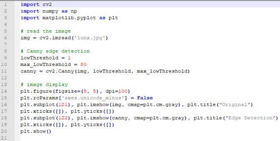

Operation Steps
This routine will perform the edge detection.
Before operation, please copy the routine “edge_detection.py”and sample picture “luna.jpg” in “5. OpenCV Computer Vision Course->5.2 Basic Course->5.2.8 Image Processing — Edge Detection->Routine Code” to the shared folder.
(1) Open virtual machine and start the system. Click “
”, and then “
“ or press “Ctrl+Alt+T” to open command line terminal.
① Import Module
② Read Image
The parameter in the bracket is the name of the image.
③ Set Threshold
Set two thresholds to determine the final edge.
④ Edge Detection
Call Canny() function in cv2 module to perform edge detection on the specific image.
The format of Canny()function is as follow.
Canny( image, threshold 1, threshold2)
The first parameter image is the input image.
The second parameter threshold1 is the low threshold minVal
The third parameter threshold2 is high threshold maxVal .
(2) Image Display
① Create Custom Figure
Call figure() function in matplotlib.pyplot module to create a custom figure for displaying the final output image.
The ninth parameter **kwargs represents other properties of the image.
When both the row and column are less than “ 10”, these two values can be abbreviated to an integer. For example, the meaning of “subplot(1, 2, 1)” and “subplot(121)” are the same, both representing the image is divided into one row and 2 columns, and the subplot is in the first place i.e. 1st row, 1st column.
The first parameter “X” is the image data.
title(label, fontdict=None, loc=None, pad=None, *, y=None, **kwargs)
The first parameter “label” is the title composed of string.
The second parameter “fontdict” is the property of the font, and the current parameter refers to dictionary.
The third parameter “loc” is the position of the title. It can be “left”, “center” or “right”, and “center” by default.
The fourth parameter “pad” is the padding distance (inside margin) between the tile and the subplot, “6.0” by default.
The fifth parameter “y” is the vertical distance between the title and the subplot, and the unit is the percentage of the height of the subplot. The default value is “None”, that is, the position of the title is automatically determined to avoid overlapping with other elements. “ 1.0” means the title is at the top of the subplot.
The sixth parameter “**kwargs” is the text object keyword property, which is used to determine the appearance of the text, such as font, text color, etc.
④ SetAxis Tick
⑤ Display Image

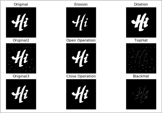

5.2.11 Image Processing — Morphological Processing
Morphology Introduction
Morphology is one of the most widely used techniques in image processing. It is mainly used to extract image components that are meaningful for describing the shape of an area, so that the most essential shape features of the target object can captured in subsequent recognition, such as boundaries and connected areas. In addition, techniques such as thinning, pixelation, and burr trimming are often used in image preprocessing and postprocessing, which can greatly strengthen the image.
The basic idea of morphology is to use a special structural element to measure or extract the corresponding shape or feature in the input image for further image analysis and target recognition.

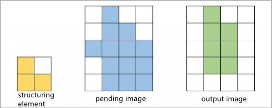

Morphological Transformation
(1) Erosion and Dilation
Both erosion and dilation are the basic and important morphological operation, and also the foundations of multiple advanced morphological processing. Many morphological algorithms are composed of these two.
① Structuring Element
Structuring element is required in erosion and dilation. A two-dimensional structuring element can be seen as a two-dimensional matrix element which is “0” or “ 1” .

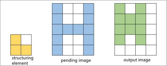

② Erosion
Erosion works to remove small and meaningless object, and the whole process is divided into three steps.
Build an image matrix upon the structuring element and determine its origin. Take the element at the upper left corner as the origin, and mark it with dark color.
Overlay the structuring element on the pending image. If the value of the pixel in the image corresponding to the elements whose value is “ 1” in the structuring elements are all “ 1”, the pixel at the corresponding position of the origin is assigned as “1”, otherwise it is “0”.
Make the structuring elements move on the pending image in order until all the images are processed completely.
③ Dilation
Dilation can enlarge the edge of the image and pad the edge of the target object or non-target pixel. The operations are divided into three steps.
Overlay the structuring element on the pending image. If at least one of the value of the pixel in the image corresponding to the elements whose value is “ 1” in the structuring elements is “ 1” , the pixel at the corresponding position of the origin is assigned as “1”, otherwise it is “0”.
(2) Opening and Closing
In opening and closing, erosion and dilation are executed in sequence.
① Open Operation
Opening indicates that erosion is executed first and dilation follows. It is useful in separating objects, removing small area, removing highlight under dark background.
② Close Operation
In closing, dilation is executed first and erosion follows. It plays an
important role in eliminating holes, that is, filling closed areas and deleting dark areas under a bright background.
(3) Top Hat and Bottom Hat
① Top Hat Operation
It is the difference between input image and the image after opening (Top hat operation= input image - image after opening), and it can obtain areas with brighter gray in the original image
② Bottom Hat Operation (Black Hat)
It is the difference between input image and the image after closing (Top hat operation= input image - image after closing), and it can obtain areas with darker gray in the original image
Operation Steps

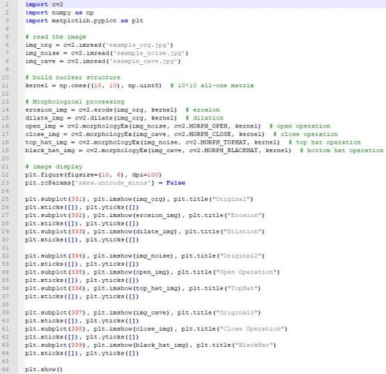

This routine will perform erosion, dilation, opening, closing, top hat operation and bottom hat operation on the designated image.
Before operation, please copy the routine “example_org.jpg” in “5. OpenCV Computer Vision Course->5.2 Basic Course->5.2.8 Image Processing — Geometric Transformation->Routine Code” to the shared folder.
, and then
cd /mnt/hgfs/Share/
(3) Input command “python3 morphology operations.py” and press Enter to run the routine.
Program Outcome
Program Analysis
The routine “morphology_operations.py” can be found in “5. OpenCV Computer Vision Course->5.2 Basic Course->5.2.8 Image Processing—Morphological Processing->Routine Code” .
① Import Module
② Read the Image
Then call imread() function in cv2 module to read the pending image.
③ Create Nuclear Structure
Call ones() function in numpy module to create the nuclear structure i.e.
array required in the operation.
The format of ones() function is as follow.
np.ones(shape, dtype=None, order='C')
The first parameter shape is a integer or integer tuple used to define the size of the array. If it designates the variable of the integer, one–dimensional array will be returned. If it designate integer tuple, the array in given shape will be returned.
The second parameter dtype refers to the data type of the array, float by default.
The third parameter order is used to designate the storing order of the returned array elements in storage.
④ Erosion and Dilation
Call erode() and dilate() function in cv2 module to perform erosion and dilation on the specific image.
The format of erode() function is as follow.
cv2.erode(src, kernel, iteration)
The second parameter kernel is the size of the kernel.
The third parameter is the umber of iteration.
The meaning of the parameter in dilate() function is the same as that of erode() function.

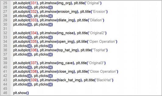

⑤ Open Operation and Close Operation
Call morphologyEx() function in cv2 module to perform open operation, close operation, top hat operation and bottom hat operation on the specific image.
The format of morphologyEx() function is as follow.
cv2.morphologyEx(img, op, kernel)
The first parameter img indicates the input image
The second parameter op represents the operation type.
| Operation Type | Meaning |
| cv2.MORPH_OPEN | open operation |
| cv2.MORPH_CLOSE | close operation |
| cv2.MORPH_GRADIENT | morphological gradient |
| cv2.MORPH_TOPHAT | top hat operation |
| cv2.MORPH_BLACKHAT | bottom hat operation |
The third parameter indicates the size of the frame.
(2) Image Display
The fifth parameter edgecolor is the frame color.
When both the row and column are less than “ 10”, these two values can be abbreviated to an integer. For example, the meaning of subplot(3, 3, 1) and subplot(331) are the same, both representing the image is divided into three rows and three columns, and the subplot is in the first place i.e. 1st row, 1st column.
y=None, **kwargs)
The third parameter loc is the position of the title. It can be left, center
④ Set Axis Tick
matplotlib.pyplot.xticks(ticks=None, labels=None, **kwargs)
The third parameter lkwargs is used to control the appearance of the tick and label.
⑤ Display Image

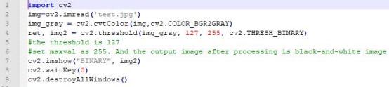

Global Thresholding
Global threshold ing will process the whole image according to the set threshold.
(1) Operation Steps
Before operation, please copy the routine “threshold_demo.py” and sample picture “test.jpg” in “5. OpenCV Computer Vision Course->5.2 Basic Course->5.2.12 Image Processing — Thresholding->Routine Code” to the shared folder.
, and then
② Input command “cd /mnt/hgfs/share/” and press Enter to enter the shared folder.
cd /mnt/hgfs/share/
③ Input command “python3 threshold_demo.py” and press Enter to run the routine.
(2) Program Outcome
The final output picture is as shown above.
(3) Code Analysis
The routine “threshold_demo.py” can be found in “5. OpenCV Computer Vision Course->5.2 Basic Course->5.2.12 Image Processing — Thresholding->Routine Code” .
Import Module:Import cv2 module
Read Picture:Call imread function to read picture and the parameter stands for the name of the picture.
Color Space Conversion: call cvtColor function to convert the image into GRAY color space, and the parameter indicates the picture and conversion mode.
Thresholding: use threshold function to execute. The specific format and parameters are as follow.
threshold(src, thresh, maxval, type)
① The first parameter src is the pending image.
② The second parameter thresh is the set threshold.
③ The third parameter maxval will be set only when the type is
THRESH_BINARY or THRESH_BINARY_INV . It refers to the new value assigned when the gray values of the picture pixels are greater (smaller) than the threshold
④ The fourth parameter type represents the type of threshold ing.
cv2.THRESH_BINARY: the part greater than threshold is set as maxval, otherwise 0.
cv2.THRESH_BINARY_INV: the part greater than threshold is set as 0, and the rest is maxval.
cv2.THRESH_TRUNC: the part greater than threshold is set as threshold, and the part smaller than threshold remains unchanged.
cv2.THRESH_TOZERO: the part greater than threshold is set as threshold, and the part smaller than threshold is set as 0.
cv2.THRESH_TOZERO_INV: the part greater than threshold is set as 0, and the part smaller than threshold remains unchanged.
Display image: Call imshow function to display image and the parameter in bracket refers to the title of the window and displayed image.

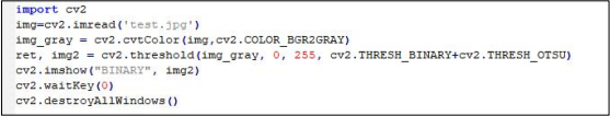

Otsu Thresholding
Appropriate threshold will be automatically calculated.
(1) Operation Steps
Before operation, please copy the routine “Otsu_demo.py” and sample picture “test.jpg” in “5. OpenCV Computer Vision Course->5.2 Basic Course->5.2.12 Image Processing — Thresholding->Routine Code” to the shared folder.
, and then
cd /mnt/hgfs/share/
③ Input command “python3 Otsu_demo.py” and press Enter to run the routine.
(2) Program Outcome
The final output picture is as above.
(3) Code Analysis
The Otsu threshold ing, also known as the maximum inter-class variance method, is a method where the inter-class variance is calculated by assigning pixels into two or more classes. When the variance reaches the maximum value, the class dividing line i.e. the gray value is used as the image segmentation threshold.
The routine “Otsu_demo.py” can be found in “5. OpenCV Computer Vision Course->5.2 Basic Course->5.2.12 Image Processing—Thresholding->Routine Code” .
Otsu threshold ing is to pass a parameter “cv2.THRESH_OTSU” in the parameter type of threshold function, so as to realize Otsu threshold segmentation.
In cv2.threshold(img, 0, 255,cv2.THRESH_BINARY+cv2.THRESH_OTSU),parameter thresh needs to set as 0, and parameter type should be set as

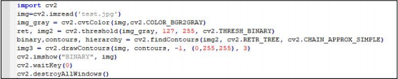

5.2.13 Image Processing—Contour Introduction and Feature
Contour is defined as the line joining all the points along the boundary of an image that are having the same color or intensity. Contour is useful tool for shape analyzing as well as object detection and recognition.
For higher accuracy, binaryzation will be performed first. After the binary image is obtained, search the contour that is find the white object under the black background. Therefore, our target is the white object and the background is black.
Search and Draw Contour
After the object is found, search for the contour points and draw the contour.
(1) Operation Steps
Before operation, please copy the routine “contours_demo.py” and sample picture “test.jpg” in “5. OpenCV Computer Vision Course->5.2 Basic Course->5.2.13 Image Processing — Contour Introduction and Feature->Routine Code” to the shared folder.
, and then
cd /mnt/hgfs/share/
③ Input command “python3 contours_demo.py” and press Enter to run the routine.
(2) Program Outcome

The routine “contours_demo.py” can be found in “5. OpenCV Computer Vision Course->5.2 Basic Course->5.2.13 Image Processing — Contour Introduction and Feature->Routine Code” .

Search for contour: findContours function is employed to search the contour, and the specific format and parameters are as follow.
findContours(img,mode,method)
The first parameter
imgrepresents the pending picture.The second parameter
moderepresents the detection mode of the contour.
RETR_EXTERNAL = 0: only the outermost contour will be detected
RETR_LIST = 1: detect all the contours without building hierarchy and all the contours will be put into one list
RETR_CCOMP = 2,detect all the contour and divide them into two layers
RETR_TREE = 3 ,Detect layer by layer from right to left according to the tree-shaped storage contour
The third parameter
methodstands for the method used to search the contour. The specific method is as follow.
CHAIN_APPROX_NONE, Preserve all the dots on the contour
CHAIN_APPROX_SIMPLE: Compress the horizontal, vertical and oblique part that is only keep their corner coordinate. For example, 4 dots are enough to save the information about the rectangle contour.
In OpenCV4.2 or above, this function will only return two values, including “contours” and “hierarchy”. And “binary” will not be returned.
Contour drawing: adopt drawContours function to draw the contour, and its specific format and parameters are as follow.
wContours(image, contours, contourIdx, color, thickness)
① The first parameter image represents the image whose contour will be drawn.
② The second parameter contours represents the coordinate of all contours are found.
③ The third parameter contoursIdx indicates the serial number of the contour drawing. -1 means that all the contours will be drawn.
④ The fourth parameter color refers to the color of the contour.
⑤he fifth parameter thickness represents the width of the contour. -1 means that the contour will be padded.

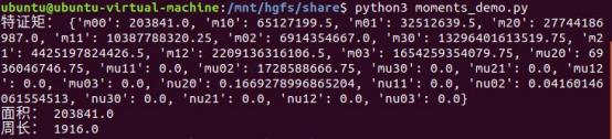

③ Input command “python3 moments_demo.py” and press Enter to run the routine.
(2) Program Outcome

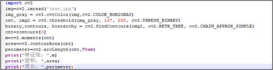

The unit of the area and perimeter is pixel. The outermost contour of the image will be calculated
(3) Code Analysis
The routine “moments_demo.py” can be found in “5. OpenCV Computer Vision Course->5.2 Basic Course->5.2.13 Image Processing — Contour Introduction and Feature->Routine Code” .
Take out the outermost contour: take the first contour with index 0 in the contour list
Feature moment calculation: use moments function to calculate the feature moment, and the function format and parameters are as follow.
moments(array,binaryImage)
① The first parameter array is the contour point.
② The second parameter binaryImage is set as False by default. If it is True, all non-zero pixels will be treated as 1, which is equivalent to image binaryzation.
Area calculation: adopt countourArea function to calculate the area, and its format and parameters are as follow.
countourArea(contour): “contour” is a contour in the contour list.
Perimeter calculation: employ arcLength function to calculate the perimeter, and its specific format and parameter is as follow.
arcLength(curve,closed)
The first parameter
curverepresents the contour.The second parameter
closeddecide whether the contour is closed or not. If it is closed, set is as True, otherwise False.

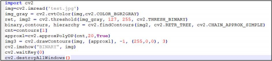

Polygon Approximation
The searched contours maybe too complex and not smooth,
approxPolyDP function can be adopted to appropriately approximate the polygon curve, which is polygon approximation.
This function uses polygons to approximate the contour, utilizing the
Douglas-Peucker algorithm (DP). The principle of the DP algorithm is simple. Its core is to continuously find the farthest point of the polygon to form a new polygon until the shortest distance is less than the specified accuracy.
Next, analyze the object contour with polygon approximation.

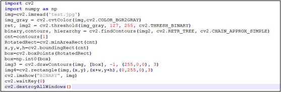

(1) Operation Steps
Before operation, please copy the routine “approx_demo.py” and sample picture “test.jpg” in “5. OpenCV Computer Vision Course->5.2 Basic Course->5.2.13 Image Processing — Contour Introduction and Feature->Routine Code” to the shared folder.
, and then
cd /mnt/hgfs/share/
③ Input command “python3 approx_demo.py” and press Enter to run the routine.
(2) Program Outcome
The contour after polygon approximation will try to fit the figure as much as possible.
(3) Code Analysis
The routine “approx_demo.py” can be found in “5. OpenCV Computer Vision Course->5.2 Basic Course->5.2.13 Image Processing—Contour Introduction and Feature->Routine Code” .
Take the contour: take the second contour with index 1 in the contour list
Polygon approximation: apporxPolyDP function is adopted. The specific format is as follow.
apporxPolyDP(curve, epsilon, closed)
1) The first parameter curve is the contour to be searched.
2) The second parameter epsilon indicates accuracy. The smaller the number, the lower the accuracy and the more consistent with the
pattern contour.
3) The third parameter closed decide whether the contour is closed or not. If it is closed, set is as True, otherwise False.

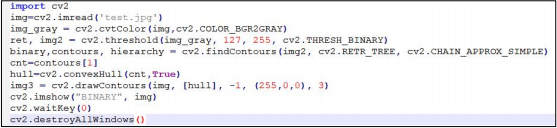

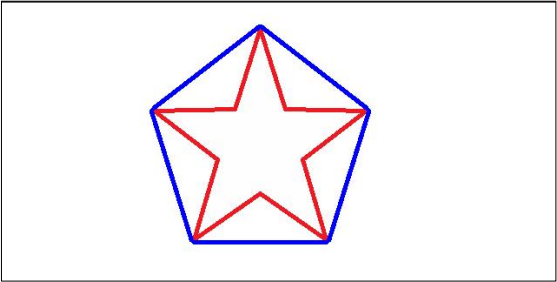

Contour Convex Hull
Convex Hull will look similar to contour approximation, but it is the convex polygon in the outermost of the object. Convex hull refers to a polygon that
completely contains the original contour and consists only of points on the
contour. Every part of the convex hull is convex, that is, the line connecting any two points in the convex hull is inside the convex hull. In the convex hull, the interior angle of any three consecutive points is less than 180.
Next, analyze the object contour through contour convex hull.
(1) Operation Steps
Before operation, please copy the routine “hull_demo.py” and sample picture “test.jpg” in “5. OpenCV Computer Vision Course->5.2 Basic Course->5.2.13 Image Processing — Contour Introduction and Feature->Routine Code” to the shared folder.
, and then
cd /mnt/hgfs/share/
③ Input command “python3 hull_demo.py” and press Enter to run the routine.
(2) Program Outcome
The convex hull will connect the vertices of the contour.
(3) Code Analysis
The routine “hull_demo.py” can be found in “5. OpenCV Computer Vision Course->5.2 Basic Course->5.2.13 Image Processing—Contour Introduction and Feature->Routine Code”
Convex hull: use convexHull function to draw the convex hull. The function format and parameters are as follow.
convexHull(points, clockwise,)
① The first parameter points is the contour to be searched.
② The second parameter clockwise refers to the drawing direction. When it is True, the convex hull will be draw clockwise. When it is False, the convex hull will be drawn counterclockwise.
Circumscribed Rectangle
The bounding rectangle is divided into the minimum bounding rectangle with rotation angle and the regular circumscribed rectangle.
Minimum bounding rectangle: it is drawn with minimum area, so it considers the rotation.
Regular bounding rectangle: frame the object with the rectangle.
Next, draw the regular bounding rectangle and minimum bounding rectangle.
(1) Operation Steps
Before operation, please copy the routine “rect_demo.py” and sample picture “test.jpg” in “5. OpenCV Computer Vision Course->5.2 Basic Course->5.2.13 Image Processing — Contour Introduction and Feature->Routine Code” to the shared folder.
, and then
cd /mnt/hgfs/share/
③ Input command “python3 rect_demo.py” and press Enter to run the routine.
(2) Program Outcome
The green one is the regular bounding rectangle, and the blue one is the minimum bounding rectangle.
(3) Code Analysis
The routine “rect_demo.py” can be found in “5. OpenCV Computer Vision Course->5.2 Basic Course->5.2.13 Image Processing—Contour Introduction and Feature->Routine Code”
Acquire minimum bounding rectangle: adopt minAreaRect function to get the minimum bounding rectangle. And the function format and parameters are as follow.
minAreaRect( points ): “points” refers to contour, and the returned value
contains the starting coordinate, width, height and angle.
Obtain the regular bounding rectangle: use boundingRect function to realize. The function format and parameters are as follow.
boundingRect(array): array refers to contour and the returned value Rect contains the starting coordinate, width and height.
Get the vertex coordinate of the minimum bounding rectangle:
boxPoints function will be employed. The function format and parameters are as follow.
boxPoints(rect): refers to the rectangle whose vertex coordinate needs to be obtained. Its data type belongs to floating point number.
Number rounding: use int0 function to execute. The function format and parameters are as follow.
int0(date): “date” is the data to be rounded.
Draw rectangle: rectangle function will be adopted to draw the rectangle.
rectangle(src,pt1,pt2,color,thickness)
① The first parameter src refers to the image to draw the contour.
② The second parameter pt1 represents one of the vertices of the rectangle.
③ The third parameter pt2 refers to the diagonal vertices of pt1
④ The fourth parameter color represents the color of the rectangle.
⑤ The fifth parameter thickness represents the width of the drawn rectangle. “-1” indicates padding rectangle.

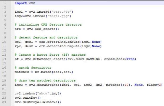

5.2.14 Image Processing—Feature Matching
Brute-Force Matching
The feature descriptor is to describe the key point with a set of vectors
after the key point is calculated. It includes not only the key point, but also the pixels around the key point that has made a contribution. It serves as the basis for target matching, and enables the key points to have more invariant
characteristics, such as illumination changes, 3D viewpoint changes, etc.
Each feature descriptor in one set of features is matched with the nearest feature descriptor of the other set, then the obtained distances are sorted, and finally the feature with the shortest distance is selected as the matching point for the two.
Next, use brute force matching to match the features of the two images.
(1) Operation Steps
Before operation, please copy the routine “bf_demo.py” and sample picture “test.jpg” in “5. OpenCV Computer Vision Course->5.2 Basic Course->5.2.14 Image Processing — Feature Matching->Routine Code” to the shared folder.
, and then
cd /mnt/hgfs/share/
③ Input command “python3 bf_demo.py” and press Enter to run the routine.
python3 bf_demo.py
(2) Program Outcome
Take out one part of the original image, and then match features between these two images.
(3) Code Analysis
The routine “bf_demo.py” can be found in “5. OpenCV Computer Vision Course->5.2 Basic Course->5.2.14 Image Processing — Feature Matching->Routine Code” .
Initialized detector: use ORB_create constructor for initialization.
Detect feature and descriptor: detectAndCompute function will be used to detect. And the specific format and parameter are as follow.
detectAndCompute(src,mask)
① The first parameter src is the image to process the threshold.
② The second parameter mask is the image in which the object is black and the rest is white. If the mask is not required, set the parameter as None.
Create BFMatcher object: BFMatcher belongs to features2d module and inherits from DescriptorMatcher. The function format is as follow.
static Ptr<BFMatcher> create( int normType , bool crossCheck )
① The first parameter normType can be set as NORM_L1, NORM_L2, NORM_HAMMING or NORM_HAMMING2. The HOG descriptors of SIFT and SURF correspond to the Euclidean distances L1 and L2; the BRIEF descriptors of ORB and BRISK correspond to the Hamming distance HAMMING; HAMMING2 corresponds to the ORB algorithm when WTA_K = 3 or 4.
② Euclidean distance: it is defined as the distance between two points in n-dimensional space.
Hamming distance: It is computer’s XOR operation suitable for binary string descriptors, such as BRIEF descriptors. Its definition is as follow.
③ The second parameter “crossCheck” is set as “FALSE” by default. If set as TRUE, the matching is valid only when the features in the two groups match with each other. In other words, only when the x point descriptor in
group A and the y point in group B are the best matching points for each other, the matching is effective.
Match descriptor: detectAndCompute function will be adopted, and its specific format and parameters are as follow.
match(queryDescriptors,trainDescriptors)
① The first parameter queryDescriptors is the image feature vector to be matched.
② The second parameter trainDescriptors is the image feature vector that needs to be matched.
Draw matches: drawMatches function will used. The specific format and parameters are as follow.
drawMatches(src1,kp1,src2,kp2,match,matchesMask,flags)
① The first parameter src1 is the matching image 1.
② The second parameter kp1 is the feature of image 1.
③ The third parameter src2 is the matching image 2.
④ The fourth parameter kp2 is the feature of the image 2.
⑤ The fifth parameter match is the set of matching points to be drawn.
⑥ The sixth parameter matchesMask determines which images to draw. If it is set as None, all the images will be drawn.
⑦ The seventh parameter flags represents the drawing flag. 0 indicates that all the features will be drawn, and 2 indicates that only the matched
feature will be drawn. 4 stands for the drawing styles.
Display image:Call imshow function to display image and the parameter in bracket refers to the title of the window and displayed image.
Close window: waitKey function will wait until the keyboard is pressed, and then execute destroyAllWindows function to close the window.

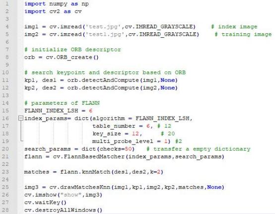

Nearest Neighbor Matching
FLANN (Fast Library for Approximate Nearest Neighbors) is a FLANN is a open-source library for performing fast approximate nearest neighbor
searches in high dimensional spaces.
The nearest neighbor matching operator FlannBased Matcher based on the FLANN library is much more efficient than BFMatcher in the field of large feature datasets or some real-time processing.
Next, adopt nearest neighbor matching to match the features of the two images.
(1) Operation Steps
Before operation, please copy the routine “flann_demo.py” and sample pictures “test.jpg” and “test1.jpg” in “5. OpenCV Computer Vision Course->5.2 Basic Course->5.2.14 Image Processing — Feature Matching->Routine Code” to the shared folder.
, and then
cd /mnt/hgfs/share/
③ Input command “python3 flann_demo.py” and press Enter to run the routine.
(2) Program Outcome
(3) Code Analysis
The routine “flann_demo.py” can be found in “5. OpenCV Computer Vision Course->5.2 Basic Course->5.2.14 Image Processing—Feature Matching->Routine Code” .
Set FLANN parameter: FlannBased Matcher function will be adopted. And its format and parameters are as follow.
FlannBased Matcher(IndexParams,SearchParams)(The two parameters in the bracket refers to the type of the dictionary)
① The first parameter IndexParams the algorithm designated to use.
② The second parameter SearchParams is the number of times the tree in the specified index should be traversed recursively. Higher values
provide better accuracy, but also take more time.
Nearest neighbor matching: knnMathch function will be used, And the function format and parameters are as follow.
knnMathch(queryDescriptors,trainDescriptors,k)
The first two parameters are consistent with match, and “k” is the best number of matches to be returned.)

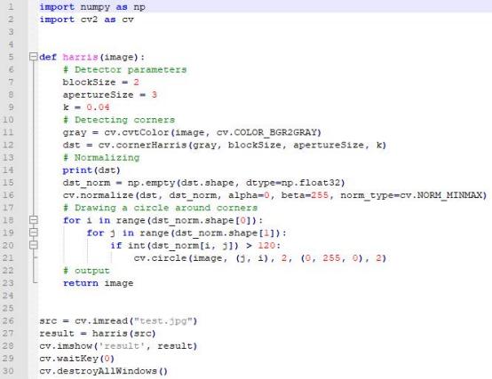

Operation Steps
Next, detect the corners of the image through Harris corner detection.
Before operation, please copy the routine “corners_demo.py” and sample pictures “test.jpg” in “5. OpenCV Computer Vision Course->5.2 Basic Course->5.2.15 Image Processing — Corner Detection->Routine Code” to the shared folder.
, and then
(2) Input command “cd /mnt/hgfs/share/” and press Enter to enter the shared folder.
cd /mnt/hgfs/share/
(3) Input command “python3 bf_demo.py” and press Enter to run the routine.
python3 bf_demo.py
Program Outcome
Code Analysis
The routine “corners_demo.py” can be found in “5. OpenCV Computer Vision Course->5.2 Basic Course->5.2.15 Image Processing — Corner Detection->Routine Code”
(1) Import Module: Import cv2 and nmupy module.
(2) Create corner detection function:harris(image):the parameter in the bracket is the image that needs to process
(3) color space conversion:cvtColor(src,mode)
The first parameter src refers to the image to convert.
The second parameter mode is the conversion mode of the color space.
(4) Corner Detection:cornerHarris(src,blockSize,apertureSize,k) The first parameter src is the image for detection.
The second parameter blockSize is the size of the domain pixel. The third parameter apertureSize is the size of the used window. The fourth parameter “k” is a free parameter ranging [0.04 ,0.06].
(5) Acquire the array of the same type:empty(shape,dtype)
The first parameter shape represents the shape of the returned array defined by the integer or a tuple of integers.
The second parameter “dtype” refers to the data type defining the type of the returned array.
(6) Normalization: Normalization is to process the data and then limit within the required range. The size of the output image of Harris corner
detection after normalization is the same as the original image. Pixel value of each point corresponds to the probability that the point is corner. The greater the value, the more likely it is a corner.
Function format: normalize(src,dst,alpha,beta,normType)
The first parameter src is the input array.
The second parameter dst is the output array after processing. The third parameter alpha is the minimum value of normalization
The fourth parameter beta is the maximum value of normalization
The fifth parameter normType indicates the types of normalization as below.
① NORM_MINMAX: The value of the array is translated or scaled to a specified range. Linearly normalized is commonly used.
② NORM_INF: it is the C-norm of the normalized array (the maximum value of the absolute value)
③ NORM_L1: L1-norm of the normalized array (sum of absolute values)
④ NORM_L2: (Euclidean) L2-norm of the normalized array
(7) Circle the corner:use a loop to traverse the normalized image array and draw a circle in the corner area.
Function format:circle(src,point,radius,color,thickness) The first parameter src is the image to be drawn.
The second parameter point is the center of the drawn circle The third parameter radius refers to the radius of the circle
The fourth parameter color is the set color
The fifth parameter thickness refers to the line thickness of the circle. When it is negative number, it is solid circle.

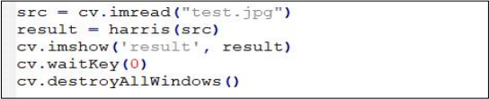

(8) Read image, process image, display image and close the window:
Read image: Use imread(image) function to read the image, and the parameter in the bracket is the name of the picture
Process image: call harris(image) function to process the image and the image parameters will be passed in.
Display image: employ imshow(title,src) function to display the output image. The parameters in the bracket are the title of window and the displayed image.
Close window: Adopt waitKey function to wait for the key to be pressed, and then call destroyAllWindows function to close the display window.
