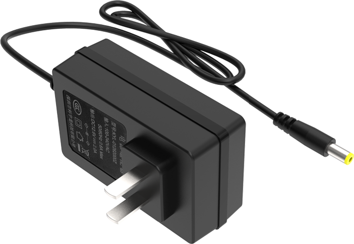

| 2 | 12.6V Lipo battery charger | 1 | ![]() |

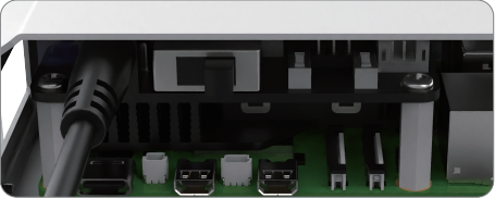

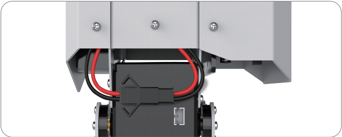

Due to transportation regulations, lithium batteries must be disconnected during transit. Therefore, you need to connect the battery connector upon receiving the robot. Then, charge it before powering it on for the first time after charging is complete.
Charging Method
Please ensure that the battery pairing wires are properly connected. The red wire should be connected to red, and the black wire to black.
(1) Connect the charger to the charging port located on the Raspberry Pi expansion board at the back of the robot.
(2) When the charger is connected to the robot’s battery but not yet plugged into an AC power outlet, the charger’s LED indicator will light up green.
Once plugged into an AC power source, the robot will begin charging. During charging, the LED indicator will turn red. The charging process takes approximately 3 hours.
When charging is complete, the LED indicator will change from red to green.
Please disconnect the charger promptly after charging is complete to avoid overcharging or damaging the battery.
