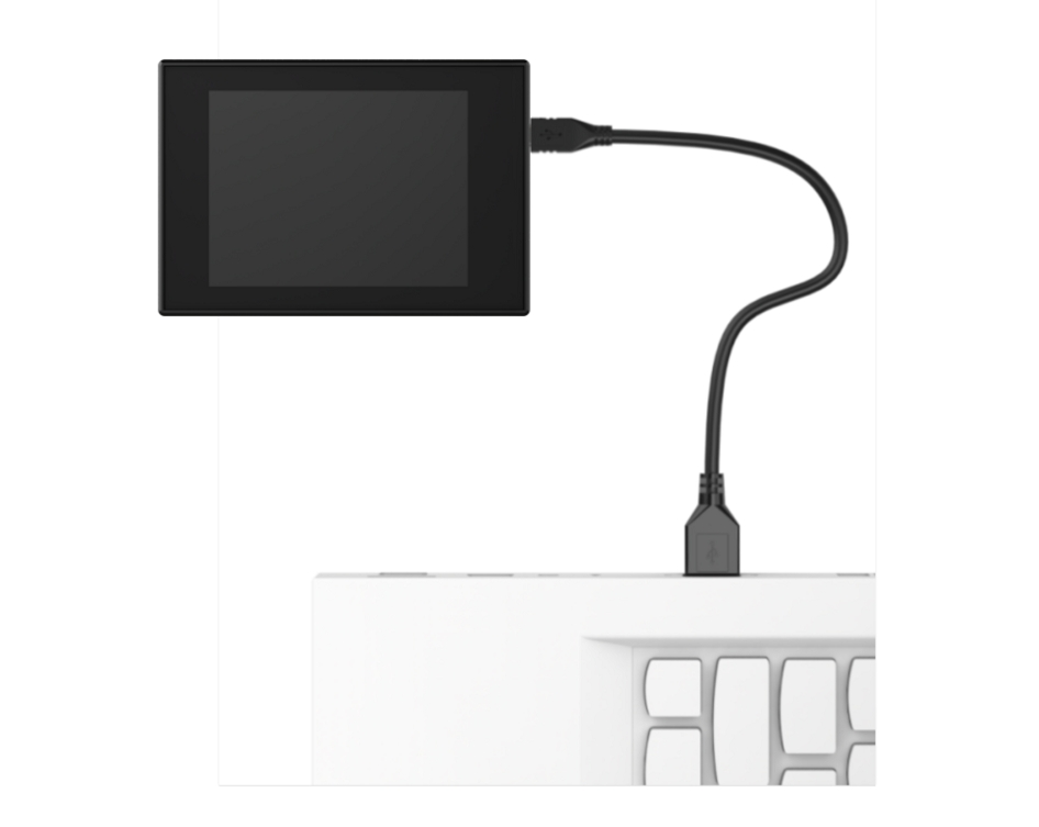

Connect the K210 Vision Module to the PC end using a Type-C data cable, as shown in the figure below:
IMG_256
Because the K210 visual module comes preloaded with firmware, when powered on, the screen of the K210 will light up, displaying the real-time feed from the camera.
If the screen does not light up properly after connecting the power supply, please proceed to 2.3 Troubleshooting for Screen Not Lighting Up for further investigation.

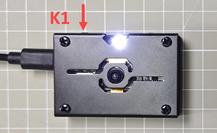

(1) Press the ‘K1’ button. The fill light will illuminate. Press the ‘K1’ button again, and the fill light will turn off.

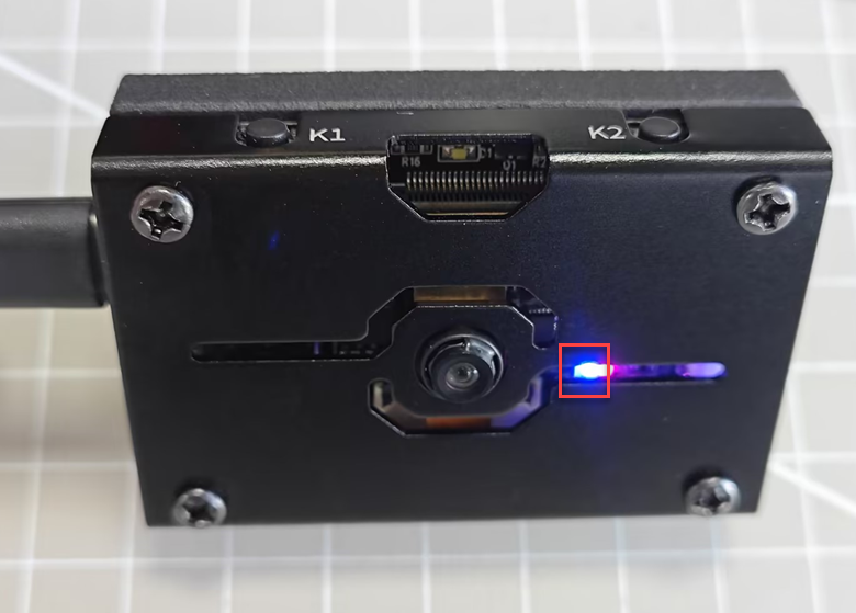

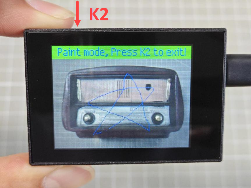

(2) Press the ‘K2’ button. The blue LED light on the visual module will illuminate, and the current image will be frozen. At this point, you can draw lines on the screen with your finger. Press the ‘K2’ button again to clear the lines, turn off the blue LED light, and resume normal display of the image.
