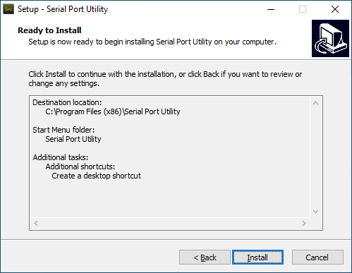

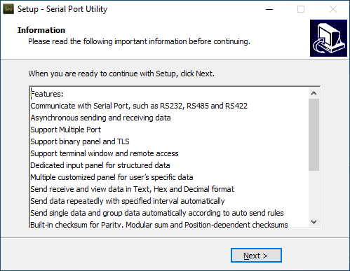

3.1.1 Serial driver installation

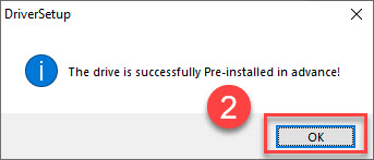

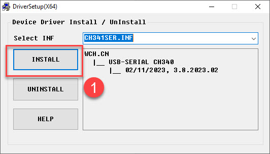

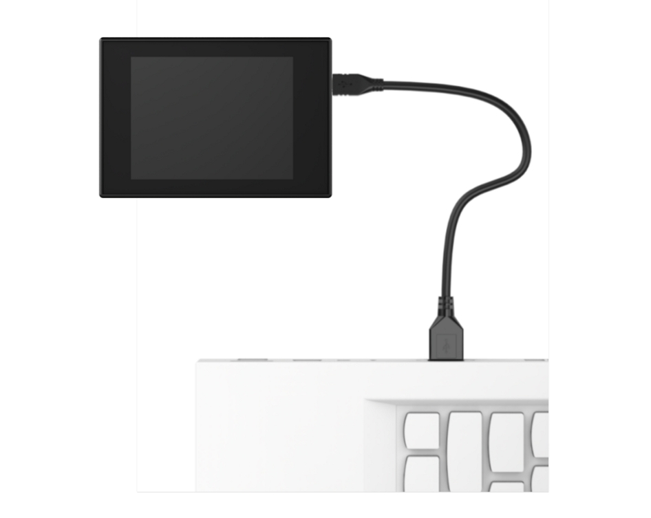

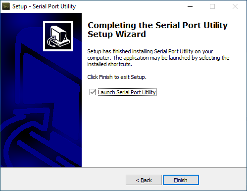

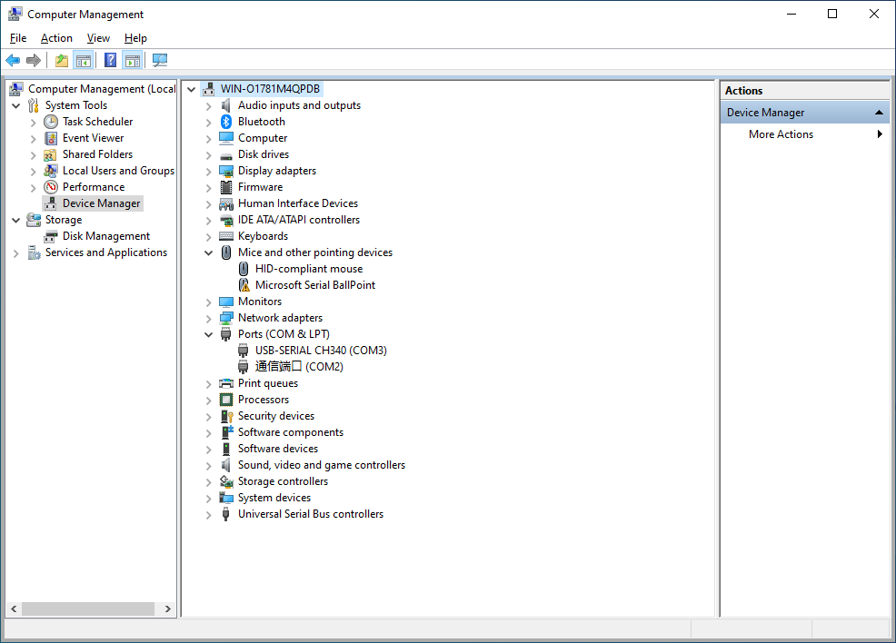

(1) Connect K210 to the computer using a Type-C cable. Before installing the software, you can check if your computer already has the CH340 driver. If the computer can recognize the corresponding serial port, there is no need to install the serial port driver. You can check the ports by connecting the module to the computer and opening the “Device Manager”, as shown in the figure below:
(2) If the driver is not available, you can find the Serial Driver Installation Package in the same directory as this section.
(3) The installation method is as follows: double-click to open the installation package, click “Install” and wait for the prompt indicating “successful installation”.

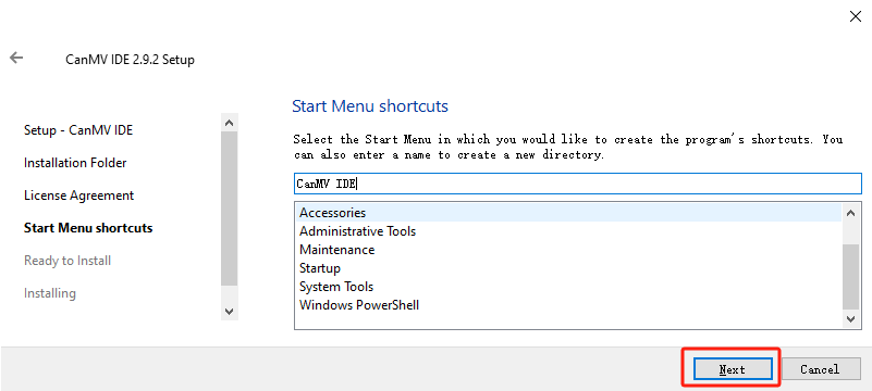

(1) Double-click to open the canmv-ide-windows-v2.9.2.exe file located in the same directory as this document.
(2) Click “Next (N)”.
(3) Click “Browse…” to choose the installation path, then click “Next (N)”.
(4) Check the “I accept the agreement” option, then click “Next (N)”.
(5) Click “Next (N)”.
(6) Click “Install”.

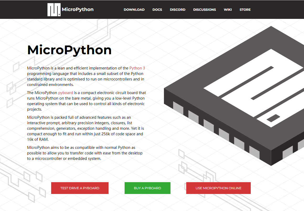

MicroPython is a streamlined and efficient implementation of the Python 3 programming language. It includes a small portion of the Python standard library and is optimized to run on microcontrollers and in constrained environments. It provides a low-level Python operating system for controlling various electronic projects.
MicroPython is rich in advanced features, such as interactive prompts, arbitrary precision integers, closures, list comprehensions, generators, and exception handling. Despite these advanced features, it is compact enough to run in just 256KB of code space and 16KB of RAM.
The goal of MicroPython is to be as compatible as possible with regular Python, allowing you to easily transition code from desktop to microcontrollers or embedded systems. This means you can use the Python language on small embedded devices.
Reference:
(1) MicroPython offical website: MicroPython - Python for microcontrollers
(2) MicroPython help documentation: mPython Help Documentation

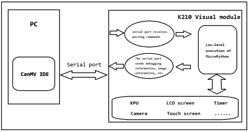

3.2.2 Principle of running MicroPython on K210 vision module
The firmware of the K210 Vision Module has already set up the MicroPython runtime environment. You can communicate directly using the Type-C interface and run MicroPython. The operational principle is illustrated in the following diagram:
CanMV IDE on the PC communicates with the K210 Vision Module through a serial port, transmitting the code from the editor to the module. The K210 Vision Module parses the content based on commands, invokes the MicroPython framework to execute the content, and eventually sends back runtime information and results through the serial port to the PC.

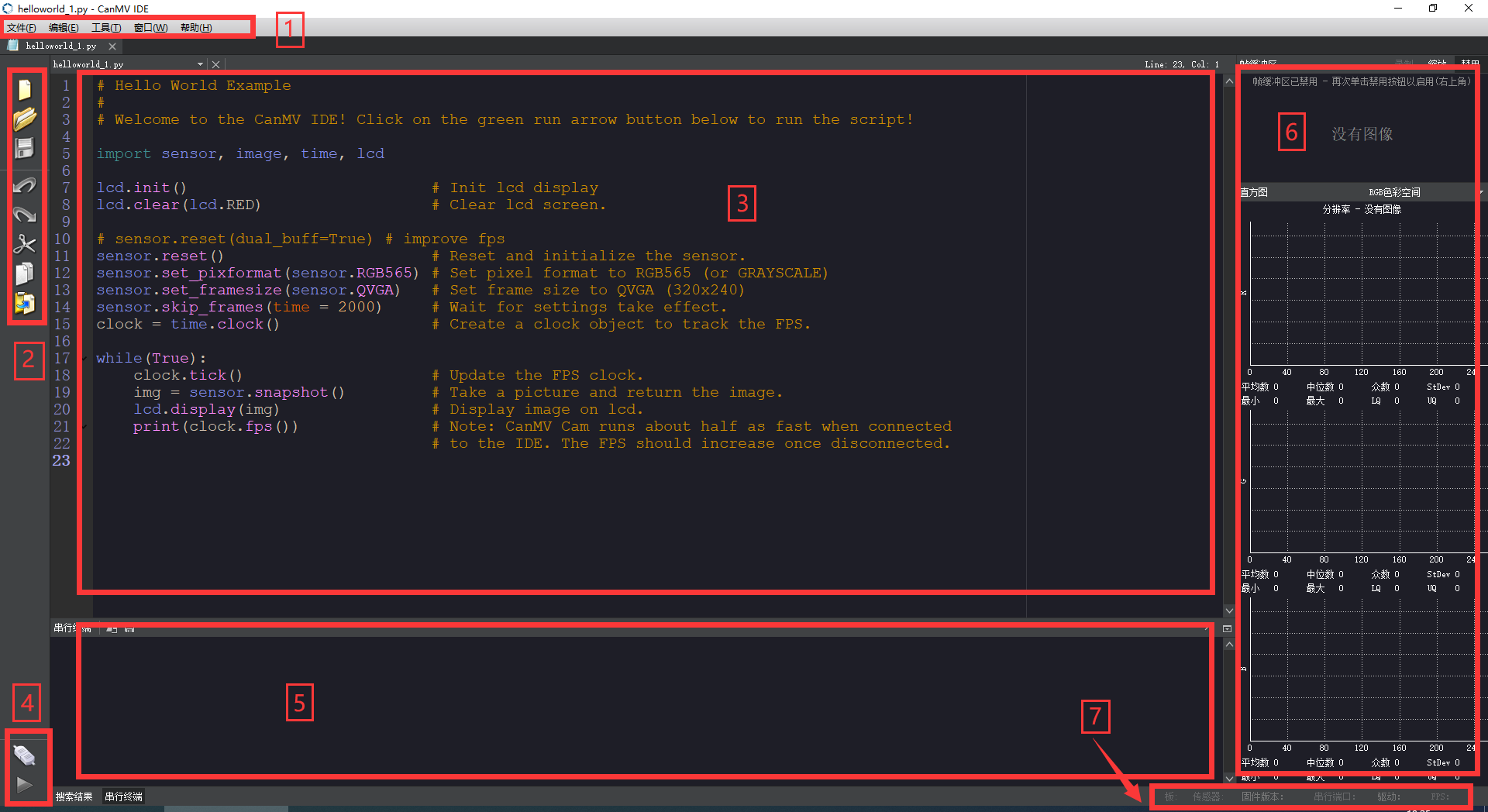

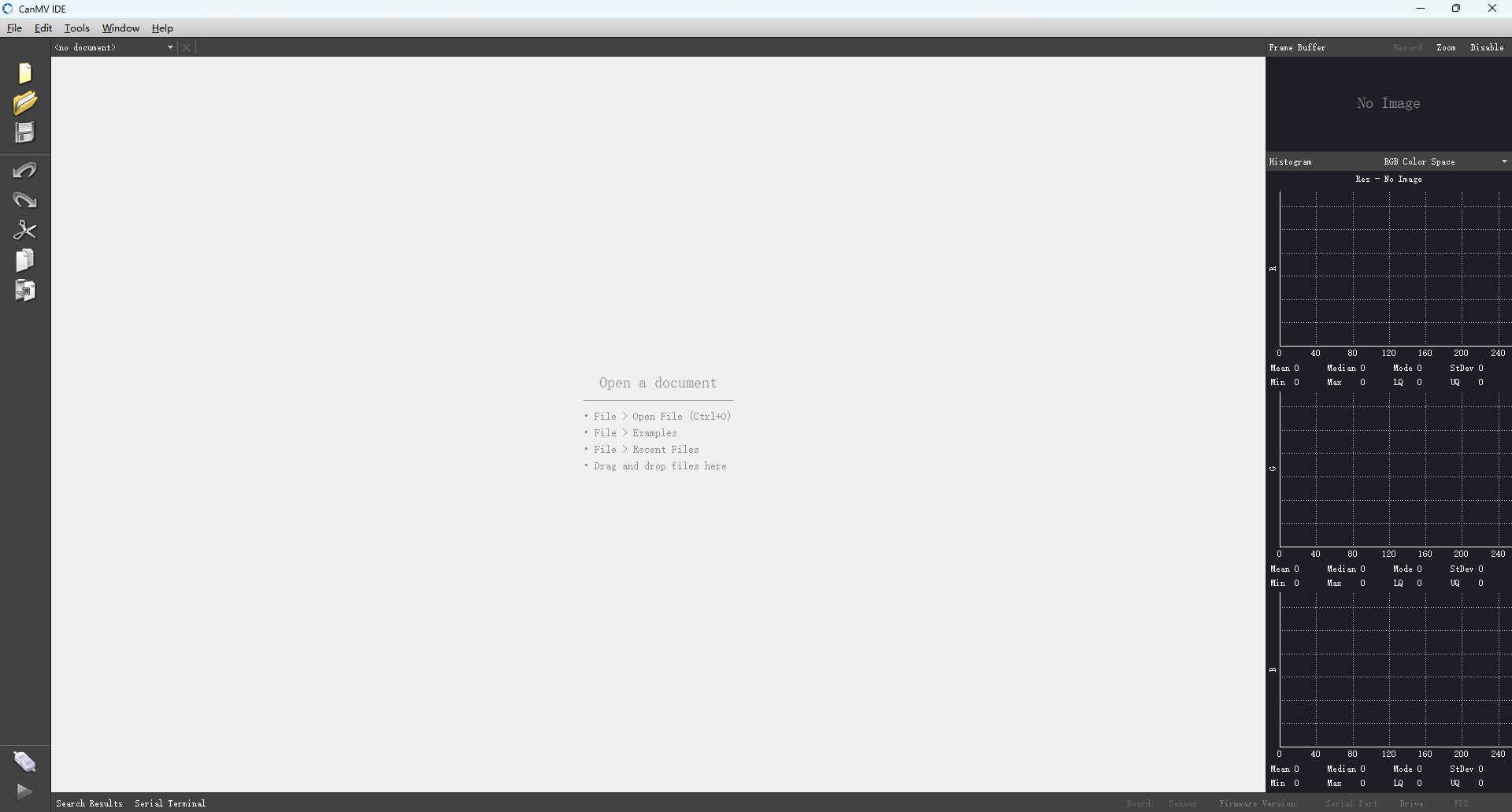

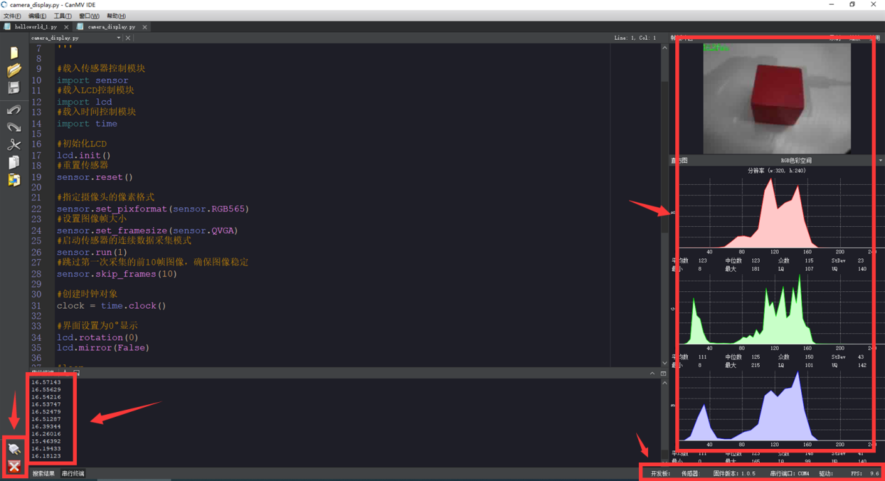

(1) The CanMV IDE interface (when not connected to the K210 Vision Module) is as follows:
① Menu Bar: Includes options for file operations, K210 flashing tools and visual-related tools;
② Quick Button: Provides convenient shortcuts for some commonly used development functions;
③ User Code Editing Area: Area for users to develop MicroPython programs;
④ Device Connection: The upper button is for connecting to the K210 Vision Module device, and the lower ones are for program execution and termination;
⑤ Debug Information Area: Displays debug information printed to the serial port and includes a search function;
⑥ Image Parameter Area: The upper part is the image preview area, and the lower part includes color space parameters;
⑦ Firmware Information: Displays the connected serial port number and other firmware information.
(2) The CanMV IDE interface (when connected to the K210 Vision Module) is as follows:
When connected to the K210 Vision Module, the device connection area in the bottom left corner changes to the above status.

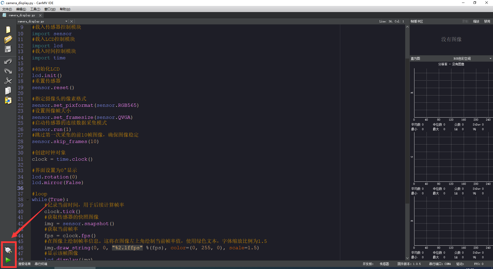

(3) The CanMV IDE interface (when running a program after connection) is as follows:
When running a program, the device connection area in the bottom left corner changes to the above status. Press
to stop online execution.

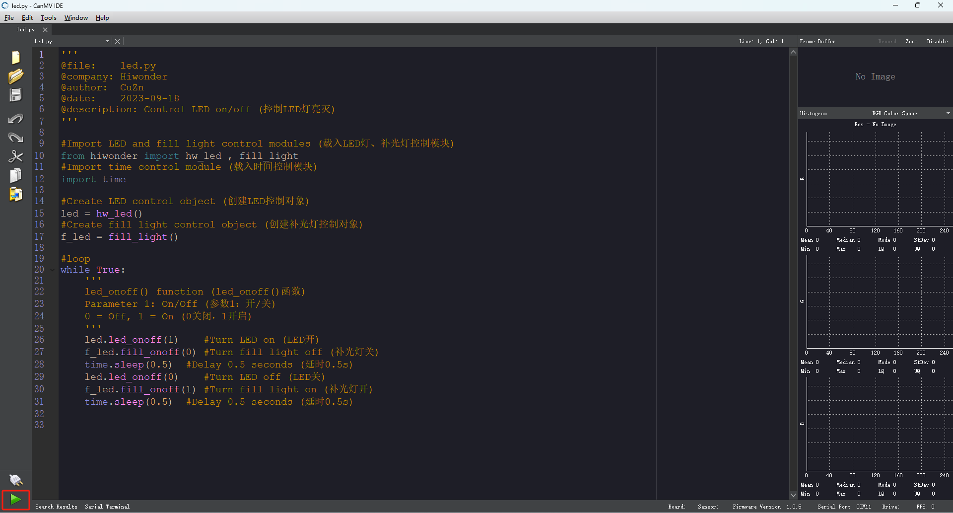

After importing, the interface will look as follows:
Online Program Execution
After importing the program, you can directly run it online without downloading. Click the “Run” button in the lower-left corner of the interface to observe the program’s running effect. During execution, you will see the fill light starting to light up and blink.
To stop the program’s execution, click the “Stop” button.

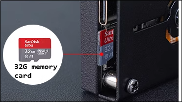

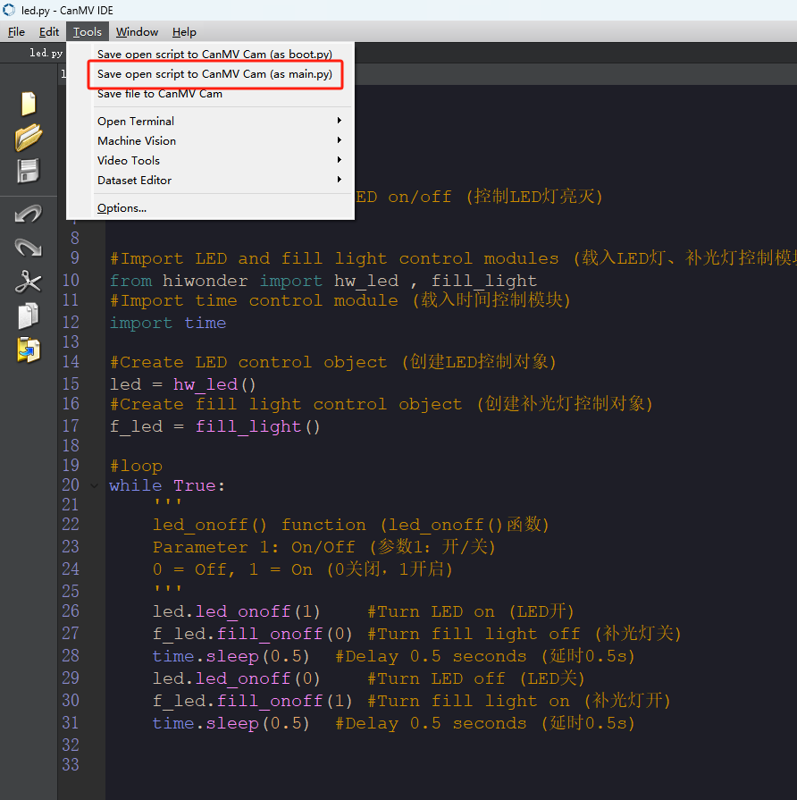

(1) Download the program into the K210 module, and it will automatically run after the module is powered up again.
If an SD card is inserted into the K210 module, the program will be prioritized to be saved in the main.py file on the SD card.

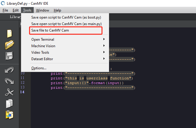

(2) While maintaining the connection, click on the menu bar, select “Tools -> Save the Currently Open Script (main.py) to CanMV Cam”.
(3) After clicking, a prompt as shown in the following picture will appear. Click “Yes” and wait for the completion prompt to appear.
(4) Once completed, disconnect from CanMV IDE, and the program will run automatically. The running effect will be the same as described in the previous section 3.4.2 Routine Test -> Online Program Execution.

① After opening CanMV IDE, import the library file, connect the K210 module, and click “Save File to CanMV Cam”.
② In the popup window, fill in the file name and select the path in the respective fields. The library file “LibraryDef.py” can be found in the same directory as this document. After completing the information, click “OK”.
The file name must include the .py extension; otherwise, it won’t take effect.

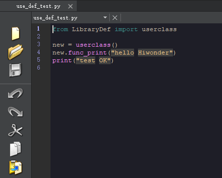

3.5.3 Call the Library File
Import the “use_def_test” program test file. The program file can be found in the same directory as this document.

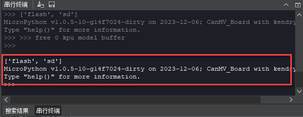

Then, after connecting the vision module, click
, and if you see the printed information in the “Serial Terminal” as shown in the picture below, it means the import was successful.

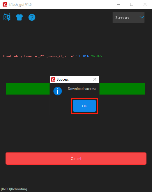

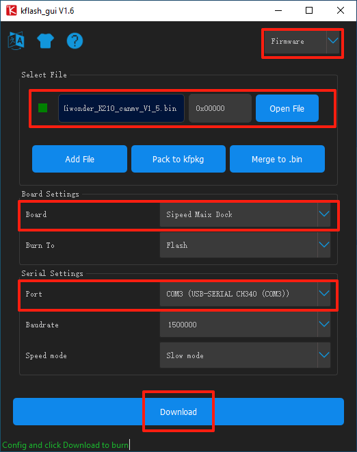

3.6.1 Burn Through Kflash GUI
(1) In the kflash_gui_v1.6.5_2_windows.7z burning tool compression package in this section’s directory, extract it and find the Kflash_gui.exe software, then open it.
(2) Choose the corresponding options as shown in the following picture. The firmware is located in the same directory as this course (Hiwonder_K210_canmv_V1_1.bin). After selecting, click “Download” to start downloading the firmware.
(3) Wait for the successful completion of the downloading process.

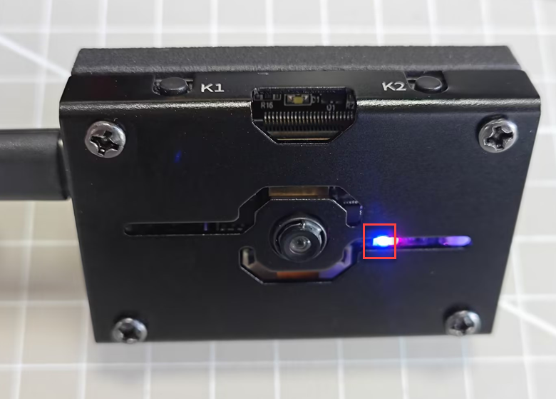

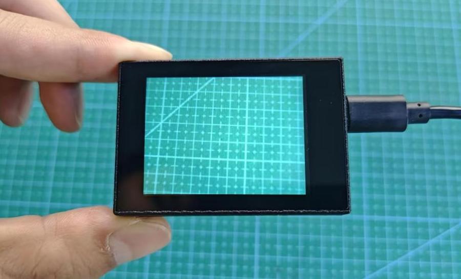

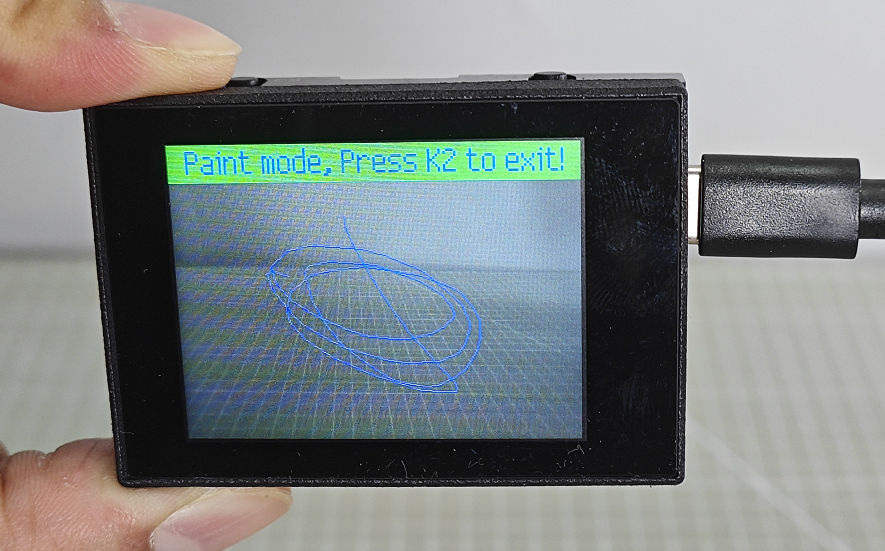

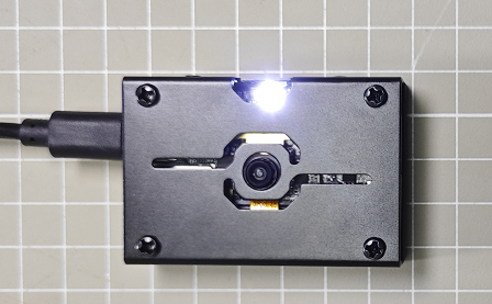

When the K210 is powered on, you should see the vision module displaying the current captured image.
(1) Press the K1 button to toggle the on/off state of the fill light.
(2) Press the K2 button to toggle the on/off state of the blue LED light.
(3) When the blue LED light is on, the current image will freeze, and the message “Paint mode, Press K2 to exit” will be displayed on the screen. At this point, you can draw lines freely on the touchscreen. Press the K2 button again to clear the screen, and the real-time image display will resume with the blue LED light turned off.

3.8 Serial Port Assistant Installation and Usage
This section is dedicated to learning the coordination between Serial Port Assistant and the K210 Vision Module. Serial Port Assistant can be used as a tool to monitor the real-time data transmitted and received by the K210. You can find the installation package for Serial Port Assistant in this section’s directory. Additionally, before getting started, you will need to prepare a USB to TTL converter tool.
3.8.1 How to Install
You can find the installation package serial_port_utility_latest.exe in the same directory as this document. You can follow the installation instructions:
(1) Double-click the installation package to open it. Then, select the installation language. Click on “Chinese (Simplified)” and then click “OK”.
(2) Follow the on-screen instructions in the images to proceed with the installation.

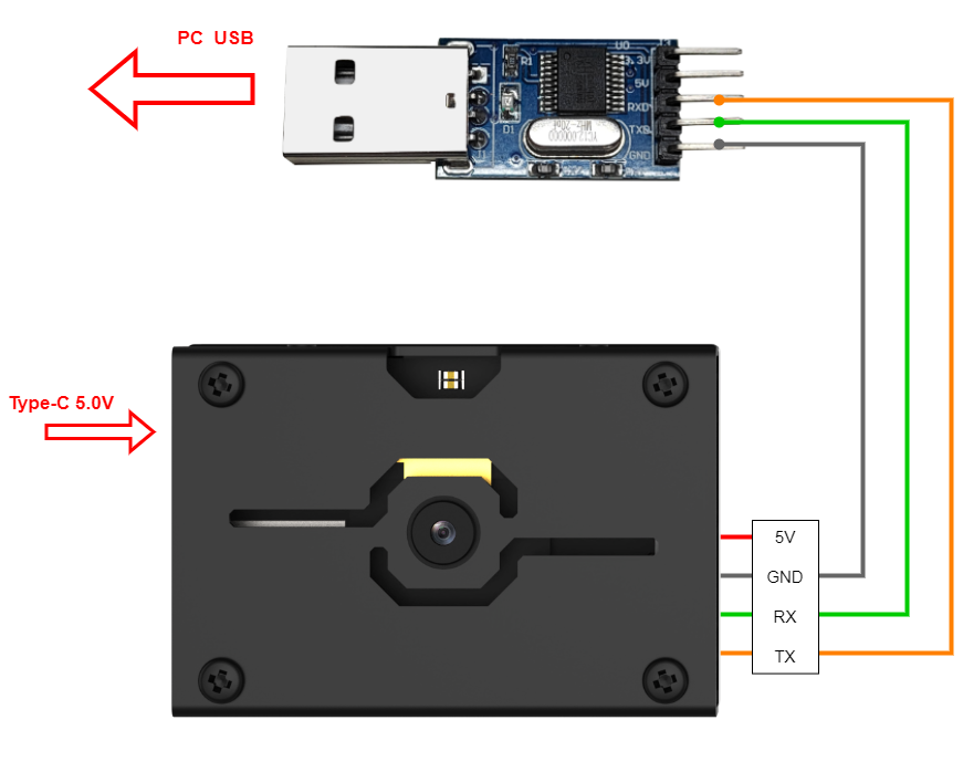

(1) Connect the serial port of the K210 Vision Module to the USB to TTL converter tool. Power the other end with a Type-C connector. The wiring is as shown in the following diagram:
Connect the RX of the K210 to the TX of the TTL tool, and the TX of the K210 to the RX, otherwise it may affect normal communication.
(2) We’ll use the program provided in 4. Basic Hardware Course->4.9 UART Serial Communication Experiment on the K210 side as an example. The program will send the following string.

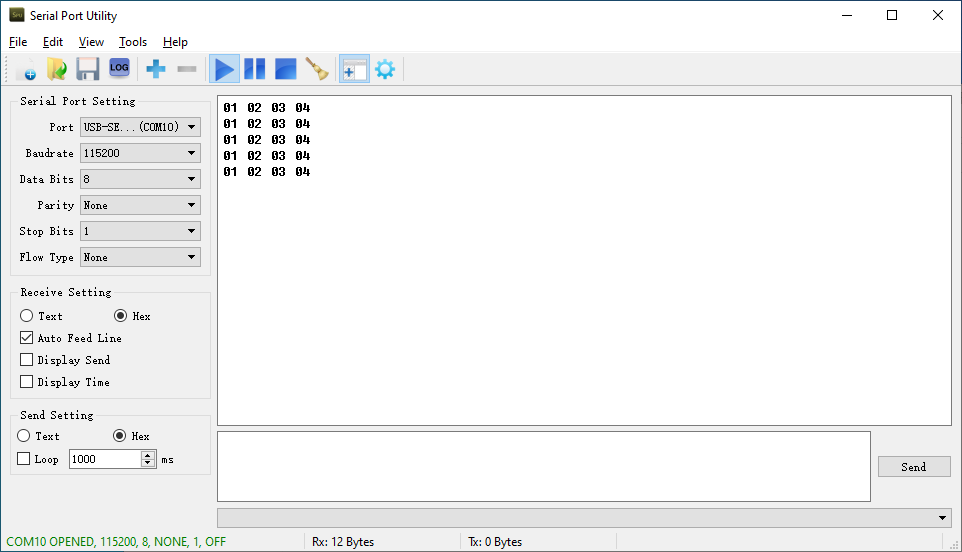

(3) After opening the Serial Port Assistant, select the port number of the Serial Port Assistant (the port where the USB to TTL converter tool is plugged in). Set the baud rate to 115200, and choose Hex for both receive and send settings.
Do not select the Type-C interface used for connecting the K210 to CanMV, otherwise it will be occupied.
For example, in this test, the Type-C interface is COM34, while the USB to TTL converter tool is COM25. Port numbers may vary depending on the user’s actual situation.
(4) After clicking
, you should be able to see the string message sent by the K210 module.
(5) Now, we can try sending string messages to the K210 Vision Module to test its receiving function. You can send a string of characters using the Serial Port Assistant. As shown in the figure below:
(6) In the serial terminal of the CanMV IDE interface, you should see that the K210 has successfully received the data, as shown in the figure below:
3.9 Usage of TF Card
Do not insert or remove the TF card while the K210 module is powered on.
The K210 module has a TF card slot located on the right side of the module. We recommend users to use first-tier brand TF cards such as SanDisk, with a capacity of up to 64GB.
After the K210 module detects the TF card upon power-up, it will automatically mount it to the K210’s file system and prioritize reading and writing operations from/to the TF card. Therefore, if you place boot.py on the TF card and insert it into the module, the boot.py from the TF card will be executed upon powering up the module.
Small files such as Python scripts within a few hundred KB can be transferred via CanMV IDE, while larger files such as AI models can be copied using a card reader.
3.9.1 Detection via CanMV IDE
After inserting the TF card into the K210 module, you can open CanMV IDE, connect to the port, create a new program file, and then enter the following code:
python import os
print(os.listdir(‘/’))
Click on
, then view the printed information in the serial terminal.
If there is no prompt indicating successful mounting, it may be due to the TF card not being detected or the TF card format being incorrect, leading to failure to recognize it. You may need to remove the TF card, clean the gold fingers of the TF card, or initialize the TF card. The method for initializing the TF card is as follows:

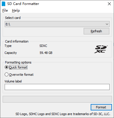

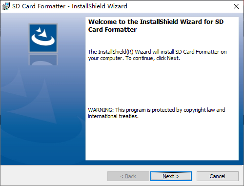

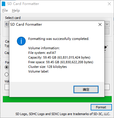

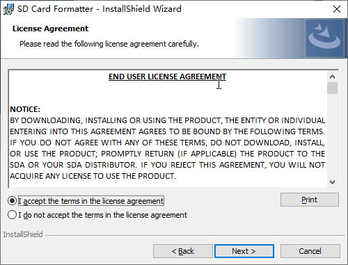

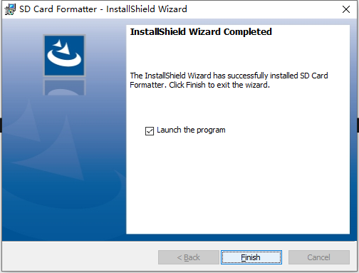

3.9.2 TF Card Initialization (Only when unable to use normally)
You can use the TF card initialization tool for this purpose, which can be found in the same directory as this program.
(1) Double-click to install it, follow the prompts, and wait for the installation to complete.
(2) After opening the TF card formatting tool, select the drive letter of the TF card, and then click on “Format”.
