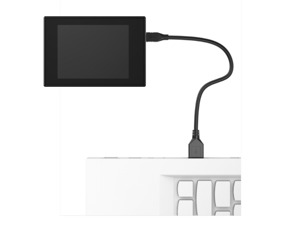

(1) Use a Type-C data cable to connect the K210 Vision Module to the PC end, as shown in the figure below:

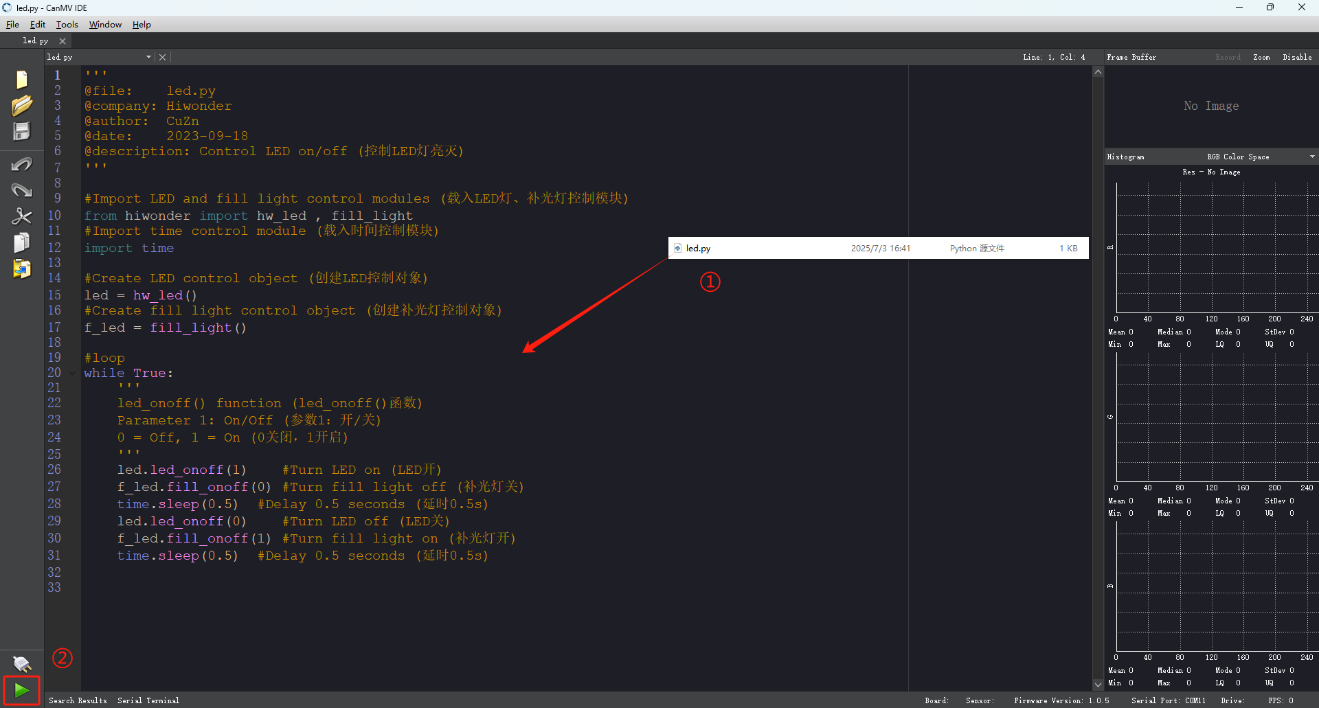

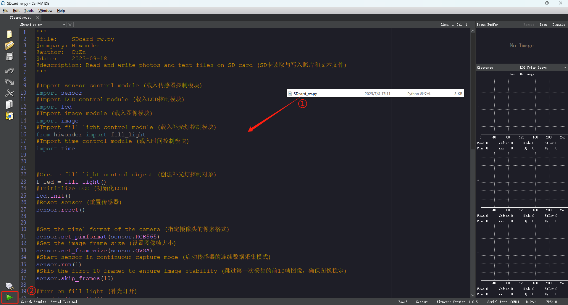

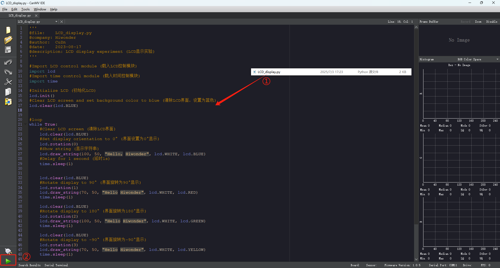

  • Program Execution and Download
Source Code
(1) Online running: After connecting, drag the program “led.py” from the same directory as this section to the code editing area of CanMV IDE, then click the run button in the bottom-left corner to run the program online, as shown in the figure below:
Programs run in this way will be lost after disconnection or shutdown, and will not be saved on the vision module.

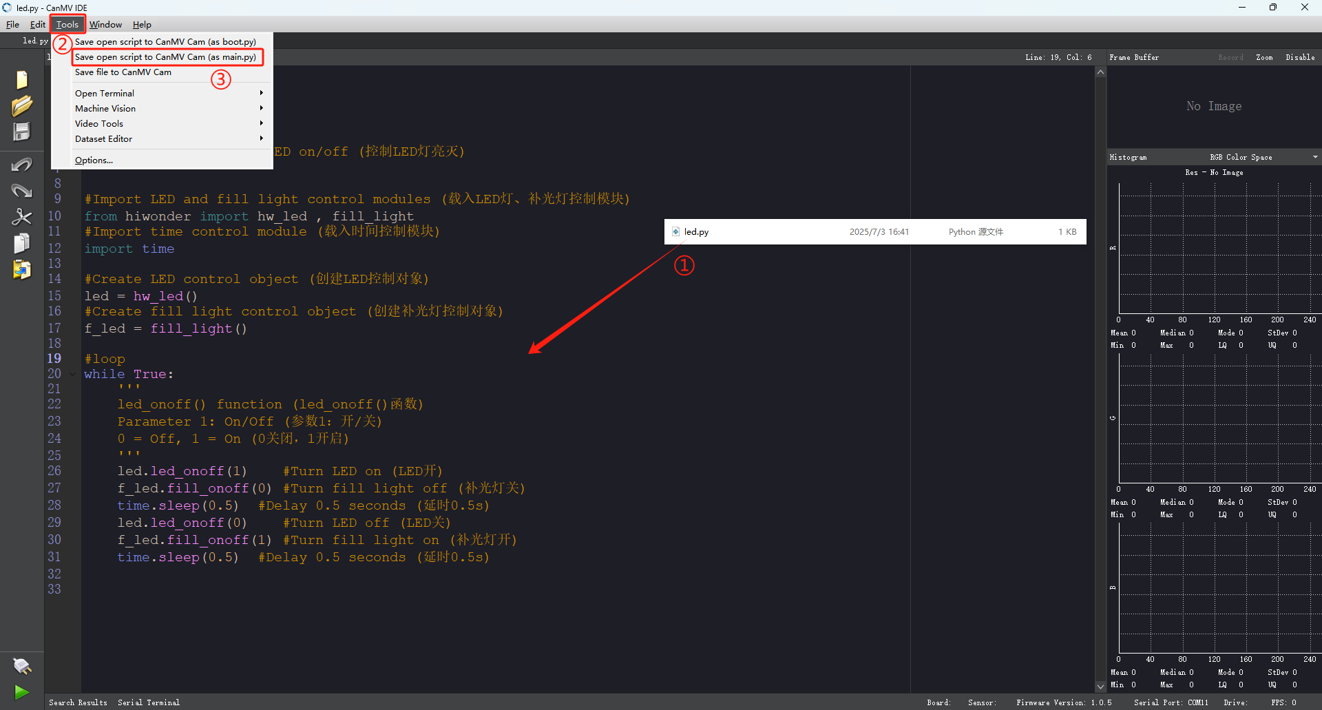

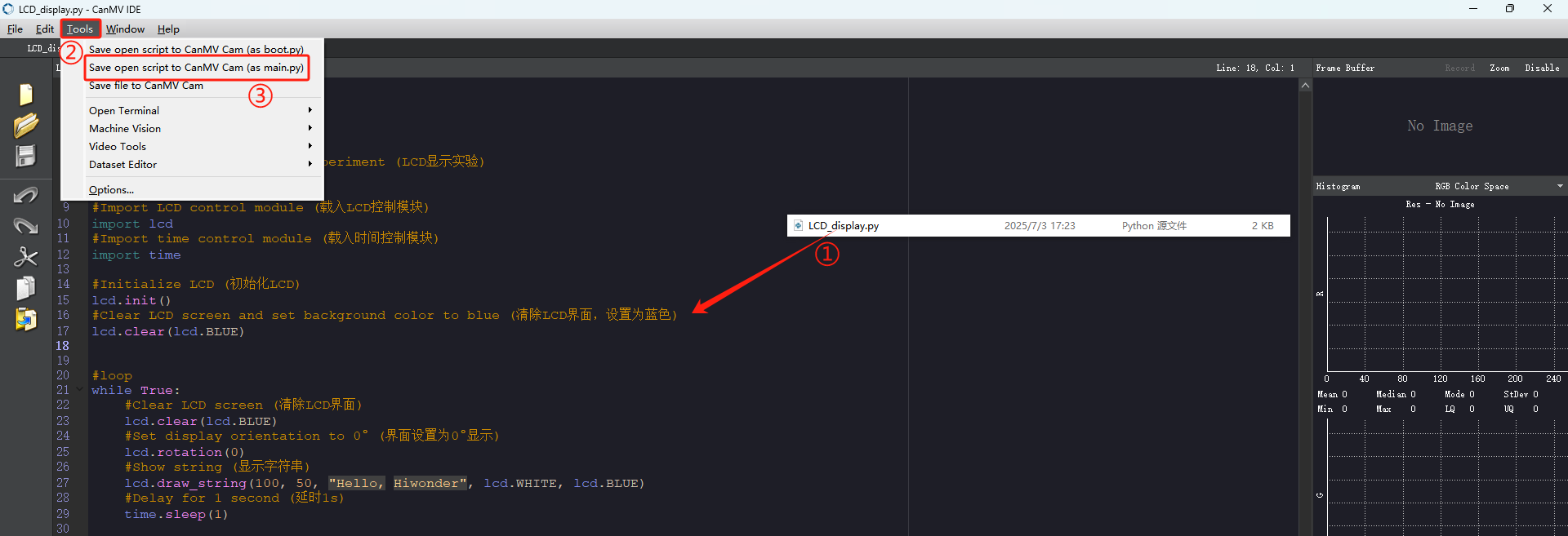

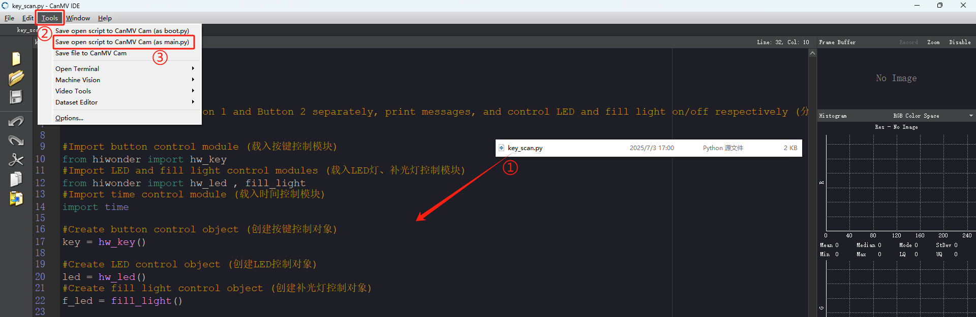

(2) Offline Running:
① After connecting, drag the program “led.py” from the same directory as this section to the code editing area of CanMV IDE. Then, click on “Tools” in the toolbar and select “Save the currently open script as (main.py) to CanMV Cam”, as shown in the figure below:
② Next, click the button “Yes”.
③ After successful writing, a prompt will appear. Click “OK”. This way, the MicroPython file will be saved to the K210 Vision Module.
By downloading in this way, you can simply power on the K210 Vision Module without connecting it later. The module will run the MicroPython file, allowing for offline execution.

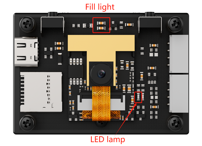

4.1.3 Running Effect
The fill light and blue LED light alternately blink at intervals of 0.5 seconds.

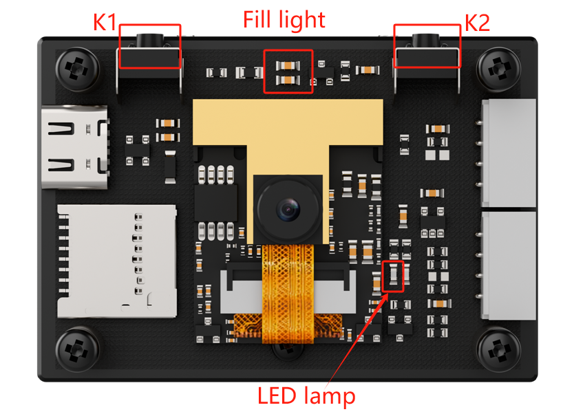

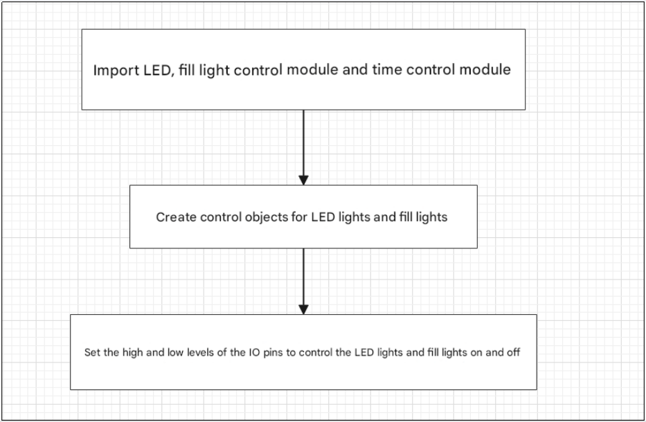

4.1.4 Experiment Analysis
Source Code
The external IO corresponding to the blue LED is IO24, and the external IO corresponding to the fill light is IO25. When the IO pin is at a high level, the LED and fill light are turned on; when the IO pin is at a low level, the LED and fill light are turned off. The programming logic of the program is as follows:
K210 supports arbitrary mapping between external IO and internal IO. The pins corresponding to peripherals (such as GPIO and I2C) on the microcontroller can be freely configured, whereas the relationship between peripherals and pins on most traditional microcontrollers is fixed, with only a few pins being reusable. Therefore, K210 offers greater flexibility.
Import the LED control module, fill light control module, and time control module for easy access in subsequent operations.
#Import LED and fill light control modules (载入LED灯、补光灯控制模块)
from hiwonder import hw_led , fill_light
#Import time control module (载入时间控制模块)
import time
Create LED control object and fill light control object.
#Create LED control object (创建LED控制对象)
led = hw_led()
#Create fill light control object (创建补光灯控制对象)
f_led = fill_light()
The main function is an infinite loop function. It controls the on/off of the LED light and the fill light using the led.led_onoff function and fill_onoff function, respectively. In these functions, 1 represents on and 0 represents off. Then, it maintains the current on/off states using the time.sleep function, where 0.5 represents a duration of 0.5 seconds.

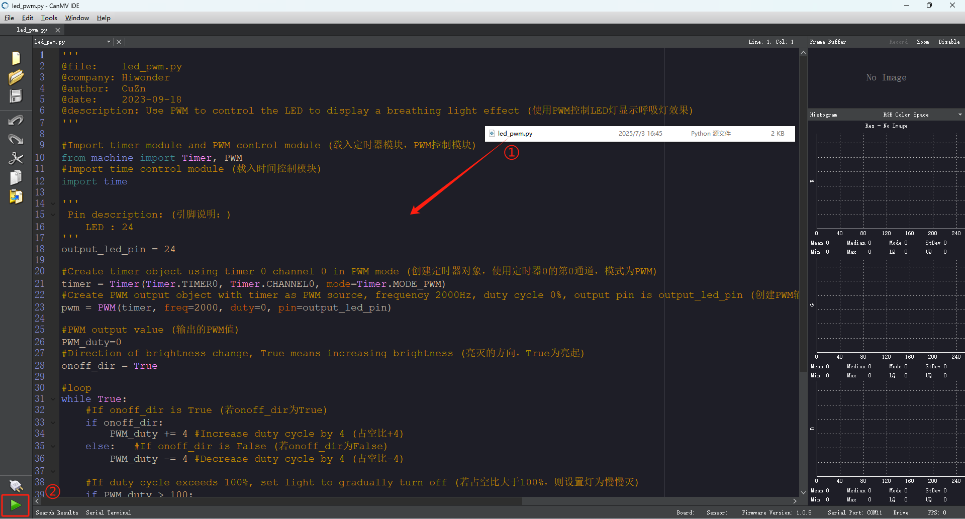

Source Code

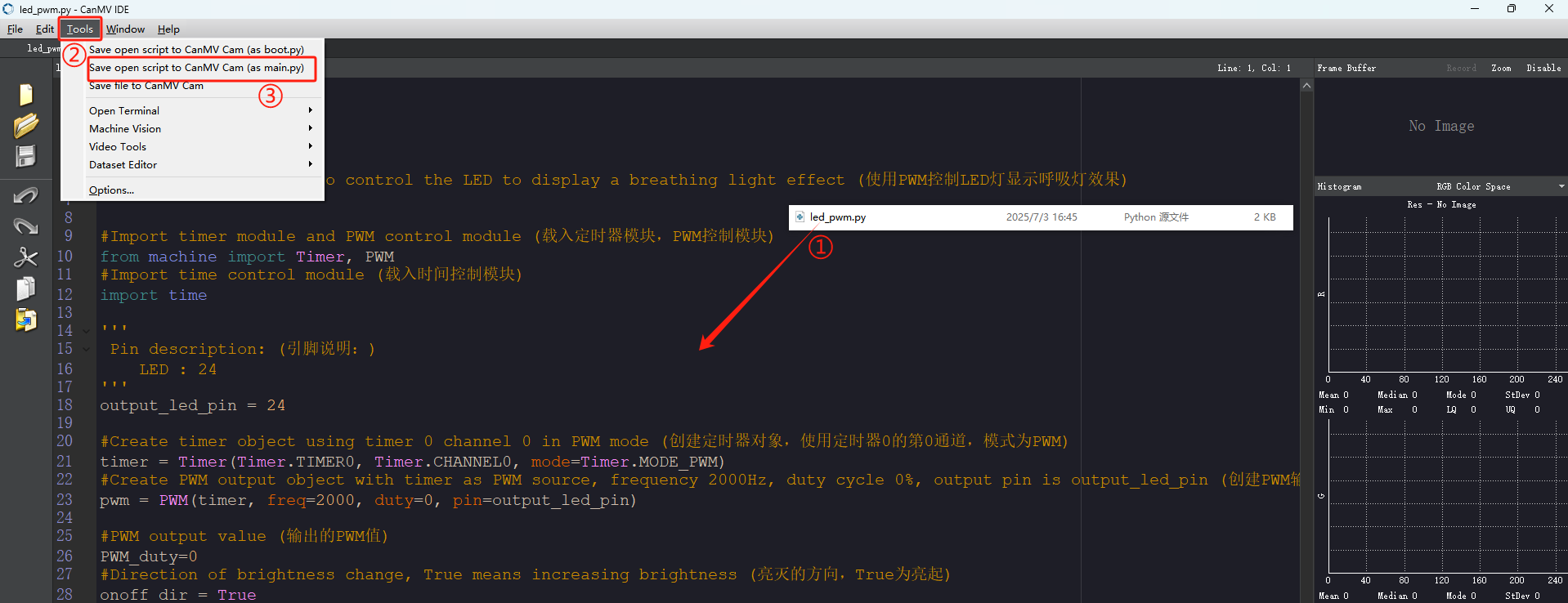

(1) Online running: After connecting, drag the program “led_pwm.py” from the same directory as this section to the code editing area of CanMV IDE, then click the run button in the bottom-left corner to run the program online, as shown in the figure below:
① After connecting, drag the program “led_pwm.py” from the same directory as this section to the code editing area of CanMV IDE. Then, click on “Tools” in the toolbar and select “Save the currently open script as (main.py) to CanMV Cam”, as shown in the figure below:

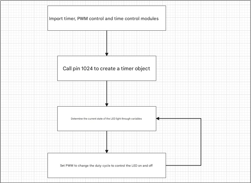

4.2.4 Experiment Analysis
Source Code
The external IO corresponding to the blue LED is IO24. We control the LED light to display the breathing light effect through PWM duty cycle. The specific programming logic is as shown in the figure below:
K210 supports arbitrary mapping between external IO and internal IO. The pins corresponding to peripherals (such as GPIO and IIC) on the microcontroller can be freely configured, whereas the relationship between peripherals and pins on most traditional microcontrollers is fixed, with only a few pins being reusable. Therefore, K210 offers greater flexibility.
Import the timer module, PWM control module, and time control module. Also, define the pin number 24 for the LED light to be used for subsequent operations.
#Import timer module and PWM control module (载入定时器模块,PWM控制模块)
from machine import Timer, PWM
import time
 Pin description: (引脚说明:)
    LED : 24
output_led_pin = 24
Create a timer object using timer 0’s channel 0, and create a PWM output object using the timer as the PWM source. Set parameters such as frequency, duty cycle, and pin for PWM. Define the initial value of PWM as 0, as well as the on/off state of the LED light.
#Create timer object using timer 0 channel 0 in PWM mode (创建定时器对象,使用定时器0的第0通道,模式为PWM)
timer = Timer(Timer.TIMER0, Timer.CHANNEL0, mode=Timer.MODE_PWM)
#Create PWM output object with timer as PWM source, frequency 2000Hz, duty cycle 0%, output pin is output_led_pin (创建PWM输出对象,使用timer作为PWM源,频率2000,占空比为0%,输出引脚为output_led_pin)
pwm = PWM(timer, freq=2000, duty=0, pin=output_led_pin)
#PWM output value (输出的PWM值)
PWM_duty=0
#Direction of brightness change, True means increasing brightness (亮灭的方向,True为亮起)
onoff_dir = True
The main function is an infinite loop function. It determines the on/off state of the LED light using the variable onoff_dir and executes different actions accordingly.
When onoff_dir is True, it indicates that the LED light needs to be on. In this case, the duty cycle will continue to increase, making the LED light brighter.
When the duty cycle reaches the set threshold of 100, the state switches, and the duty cycle gradually decreases. Consequently, the LED light will become dimmer. This process loops continuously to achieve the breathing light effect.

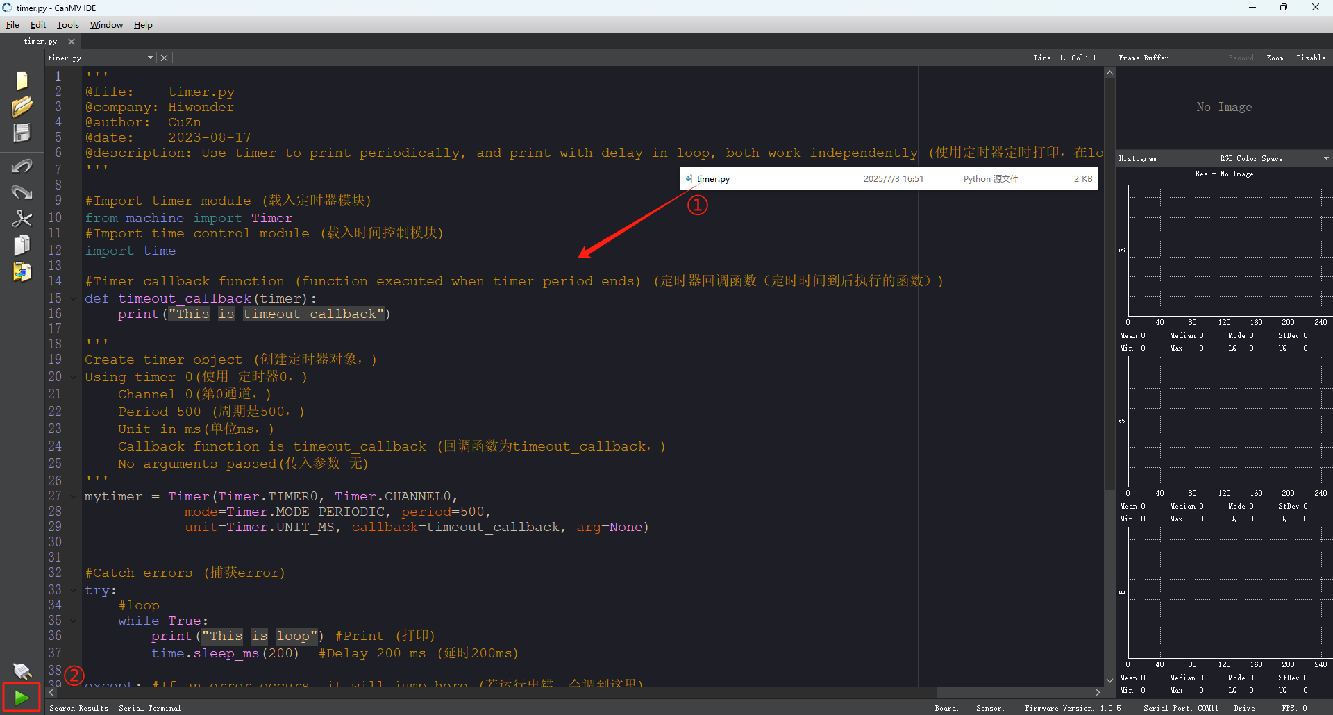

Source Code

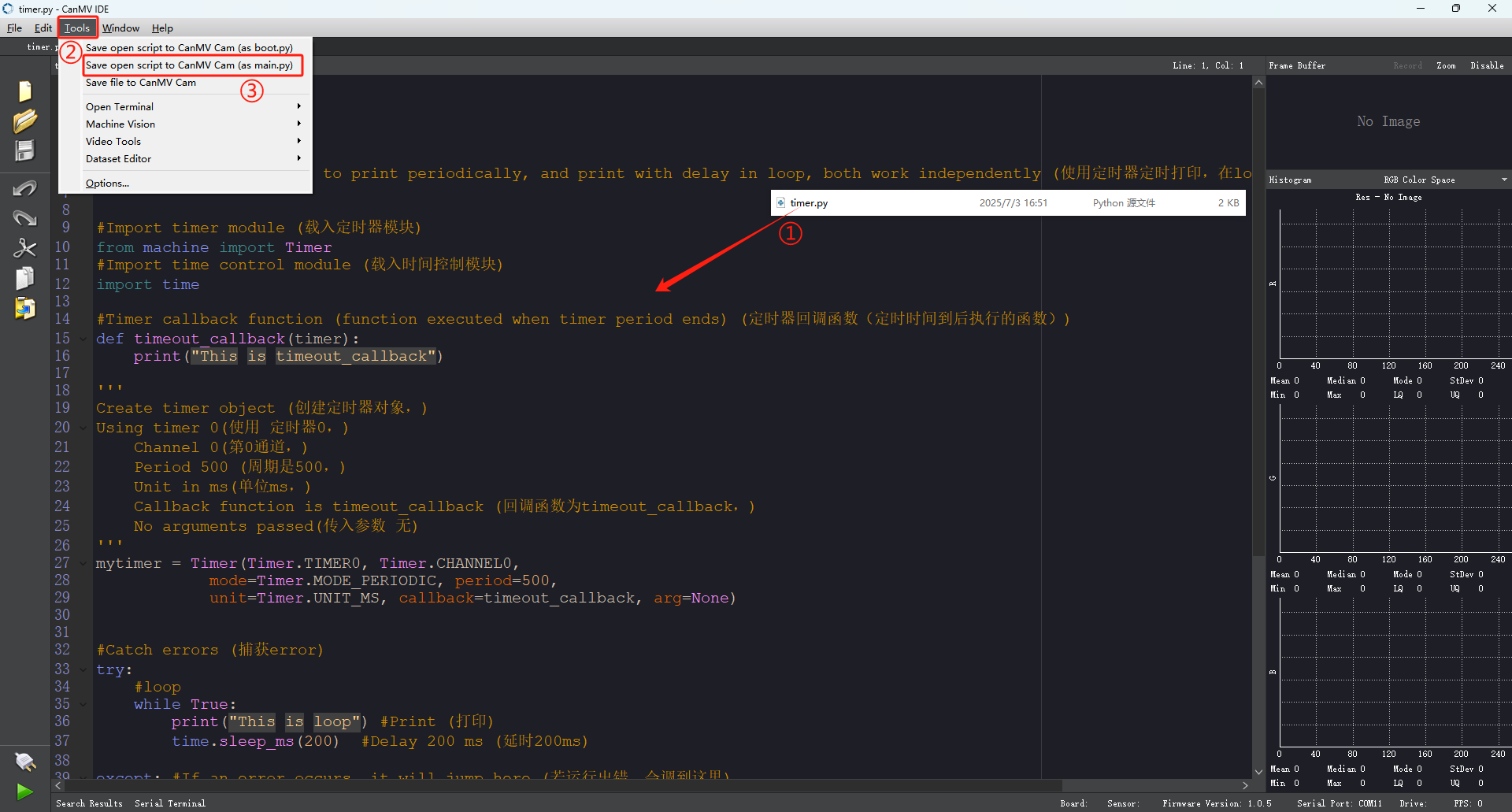

(1) Online running: After connecting, drag the program “timer.py” from the same directory as this section to the code editing area of CanMV IDE, then click the run button in the bottom-left corner to run the program online, as shown in the figure below:
① After connecting, drag the program “timer.py” from the same directory as this section to the code editing area of CanMV IDE. Then, click on “Tools” in the toolbar and select “Save the currently open script as (main.py) to CanMV Cam”, as shown in the figure below:

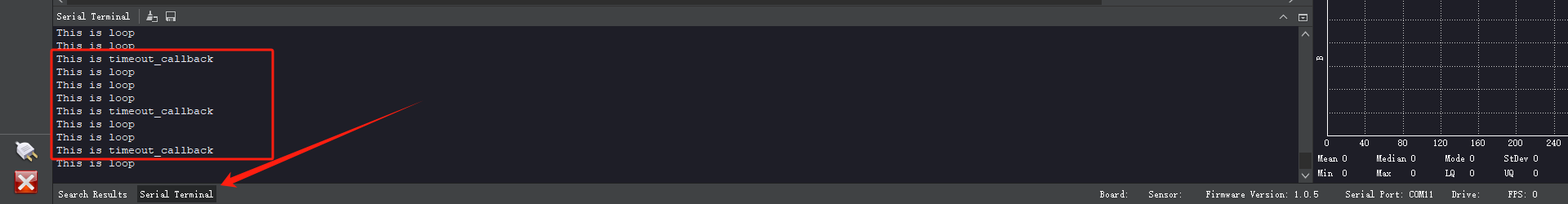

4.3.3 Running Effect
When the timer is interrupted, the serial terminal prints “This is timeout_callback”, and if it is not interrupted, it prints “This is loop”.

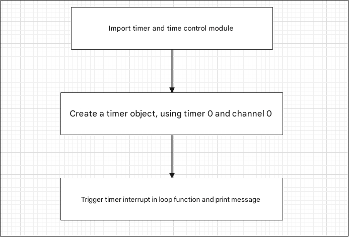

The timer is in the machine’s Timer module. It can be easily programmed through MicroPython. We only need to understand its constructor object function and usage method! The programming idea for this routine is shown in the figure below:
First import the timer module and time control module to facilitate subsequent calls.
#Import timer module (载入定时器模块)
import time
Set the timer callback function. When the timer triggers an interrupt, “This is timeout_callback” will be printed.
Create a timer object. Set timer 0, channel 0 and timer interrupt period to 500ms, and call the callback function timeout_callback.
#Timer callback function (function executed when timer period ends) (定时器回调函数(定时时间到后执行的函数))
def timeout_callback(timer):
    print("This is timeout_callback")
Create timer object (创建定时器对象,)
Using timer 0(使用 定时器0,)
    Channel 0(第0通道,)
    Period 500 (周期是500,)
    Unit in ms(单位ms,)
    Callback function is timeout_callback (回调函数为timeout_callback,)
    No arguments passed(传入参数 无)
mytimer = Timer(Timer.TIMER0, Timer.CHANNEL0,
            mode=Timer.MODE_PERIODIC, period=500,
            unit=Timer.UNIT_MS, callback=timeout_callback, arg=None)
In the main function, the instruction to print “This is loop” will be continuously executed and printed every 200ms. When the timer is interrupted, the timeout_callback function will be triggered and the content in the function will be executed. When an error occurs, the timer will be unbound through the mytimer.deinit function, controlling printing to stop and destroying the timer object.
    #loop
        print("This is loop") #Print (打印)
        time.sleep_ms(200)  #Delay 200 ms (延时200ms)

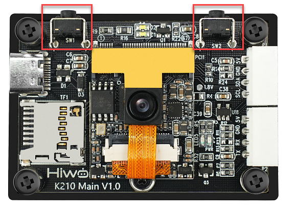

This section uses a program to read the K210 vision module button status and print it on the serial terminal, while controlling the LED light and fill light status.

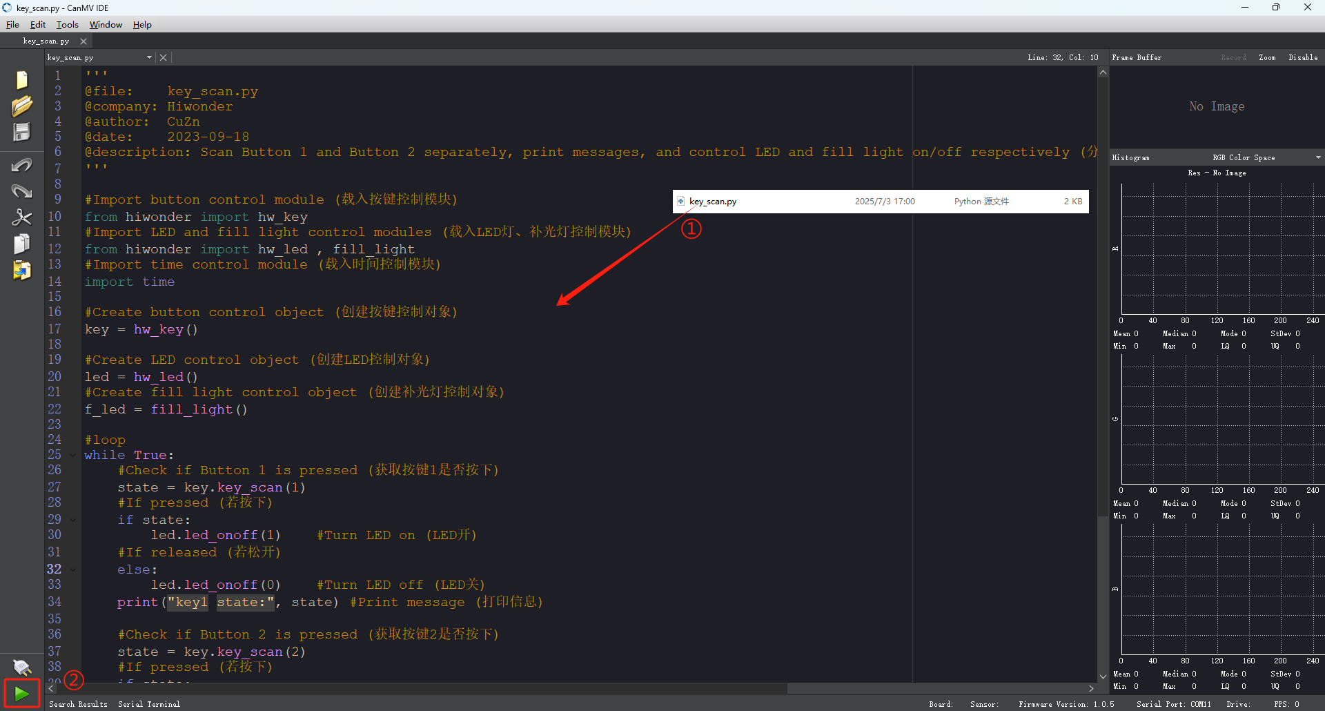

(1) Online running: After connecting, drag the program “key_scan.py” from the same directory as this section to the code editing area of CanMV IDE, then click the run button in the bottom-left corner to run the program online, as shown in the figure below:

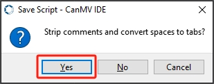

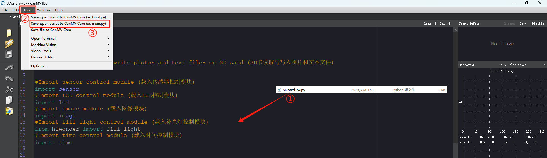

① After connecting, drag the program “key_scan.py” from the same directory as this section to the code editing area of CanMV IDE. Then, click on “Tools” in the toolbar and select “Save the currently open script as (main.py) to CanMV Cam”, as shown in the figure below:

Buttons are the most basic input device. The two function buttons of K210 are located at the positions shown in the figure below on the development board:
According to 1. Learn K210 Module -> 1.1 Module Introduction -> 1.1.3 Hardware the pins where the K1 and K2 buttons are located are IO_26 and IO_47.
For the programming ideas of this case, please refer to the following figure:
If we want to control the keys, we can do so by calling the library file.
First, import the buttons, LED lights, fill light modules and time control modules for subsequent calls.
① After connecting, drag the program “touchscreen_read.py” from the same directory as this section to the code editing area of CanMV IDE. Then, click on “Tools” in the toolbar and select “Save the currently open script as (main.py) to CanMV Cam”, as shown in the figure below:

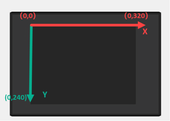

First of all, we need to know that the resolution of the touch screen of the K210 vision module is 320*240, and the origin of its pixel coordinates is located in the upper left corner of the vision module, as shown in the following figure:
The terminal will print the current state of the touchscreen along with the coordinates of the touch position, as shown in the following diagram:
There are three states in total, where the leftmost numbers 1, 2, 3 represent the current state of the screen. 1 represents the screen not being touched, 2 represents the screen being touched, and 3 represents touch movement. Subsequent parameters indicate the position information of the last touch on the touchscreen. Meanwhile, the touchscreen will also display corresponding points and trajectories.

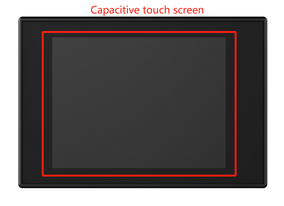

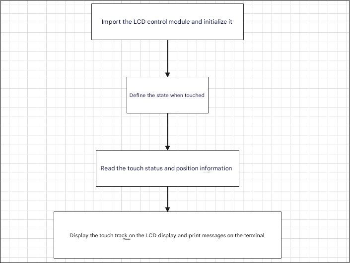

The front of the K210 vision module features a 2.0-inch capacitive touchscreen, communicating via IIC with a resolution of 320*240. For the programming approach regarding this case, you can refer to the diagram below:
Import the LCD screen touch module, image module, and time control module, and initialize the LCD screen and LCD touch module for subsequent touch control.

(1) Connect the K210 Vision Module to the PC end using a Type-C data cable, as shown in the figure below:

(1) Online running: After connecting, drag the program “SDcard_rw.py” from the same directory as this section to the code editing area of CanMV IDE, then click the run button in the bottom-left corner to run the program online, as shown in the figure below:

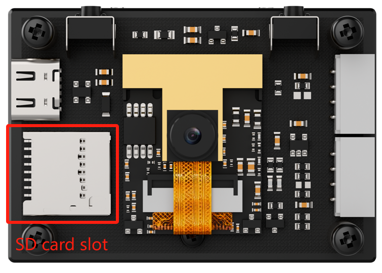

A TF card slot is provided for external TF card connection to store data (a 32GB card is recommended, but it should not exceed 64GB as exceeding 64GB might result in unreadable data).

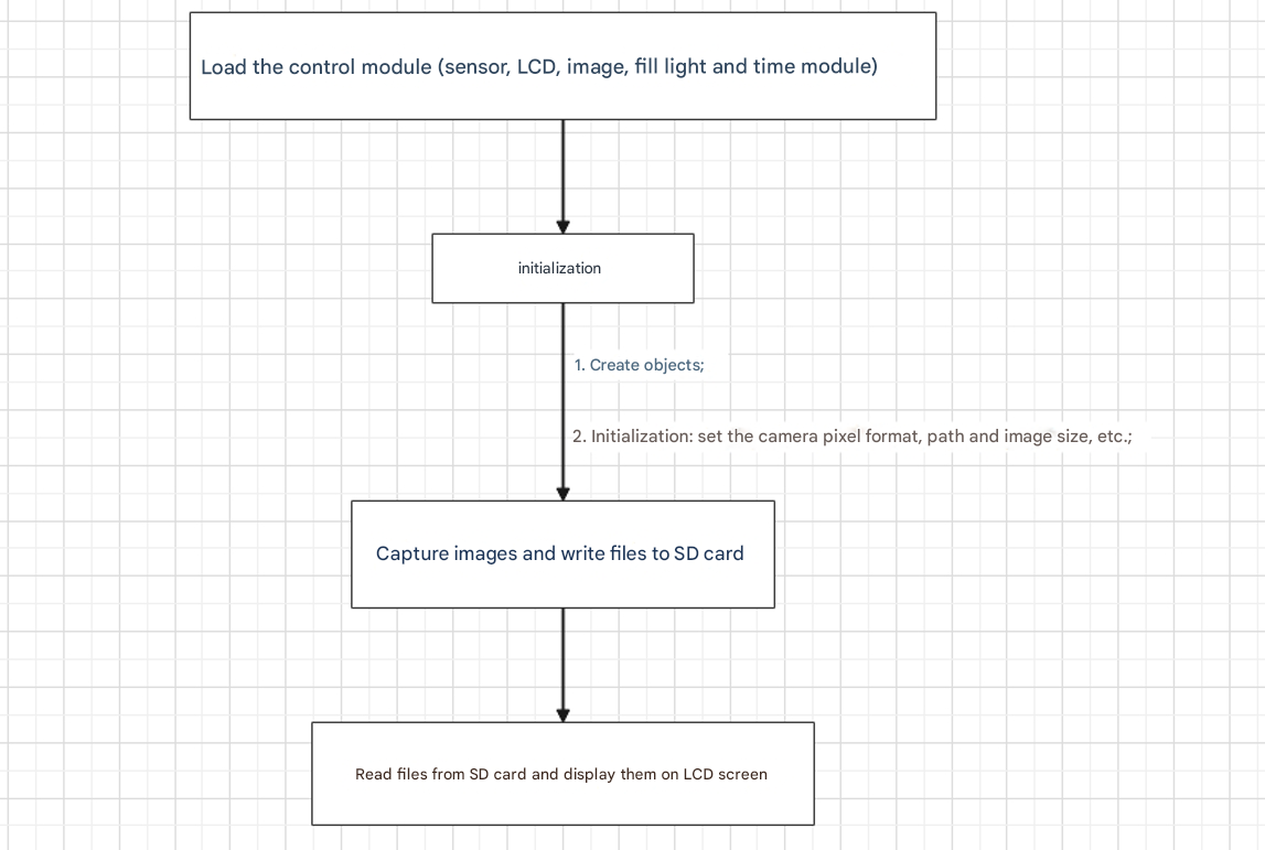

Import the sensor control module, LCD control module, image module, supplementary light control module, and time control module for ease of access in subsequent calls.

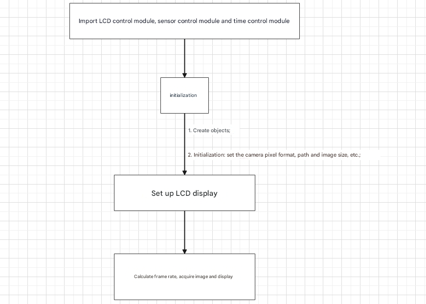

First, import the sensor control module, LCD control module, and time control module for ease of access in subsequent calls.

The main function is an infinite loop. First, use clock.tick to record the current time for subsequent frame rate calculation. Then, use sensor.snapshot to obtain the image from the sensor.
Calculate the frames per second (fps), and use img.draw_string function to draw the current fps value at the top left corner of the image. Set the text color to green and font scale to 1.5.
Finally, use lcd.display function to display the image.

(1) Online running: After connecting, drag the program “LCD_display.py” from the same directory as this section to the code editing area of CanMV IDE, then click the run button in the bottom-left corner to run the program online, as shown in the figure below:
① After connecting, drag the program “LCD_display.py” from the same directory as this section to the code editing area of CanMV IDE. Then, click on “Tools” in the toolbar and select “Save the currently open script as (main.py) to CanMV Cam”, as shown in the figure below:

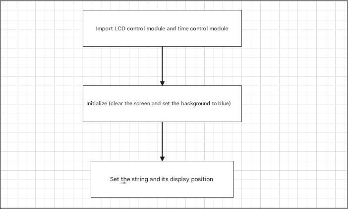

Regarding the program logic for this experiment, you can refer to the diagram below:
Import the LCD control module and the time control module for ease of access in subsequent calls.
#Import LCD control module (载入LCD控制模块)
import lcd
import time
#Initialize LCD (初始化LCD)
lcd.init()
#Clear LCD screen and set background color to blue (清除LCD界面,设置为蓝色)
lcd.clear(lcd.BLUE)
Call lcd.init to initialize the LCD display screen. Also, call lcd.clear function to clear the screen, and set the background color to blue.

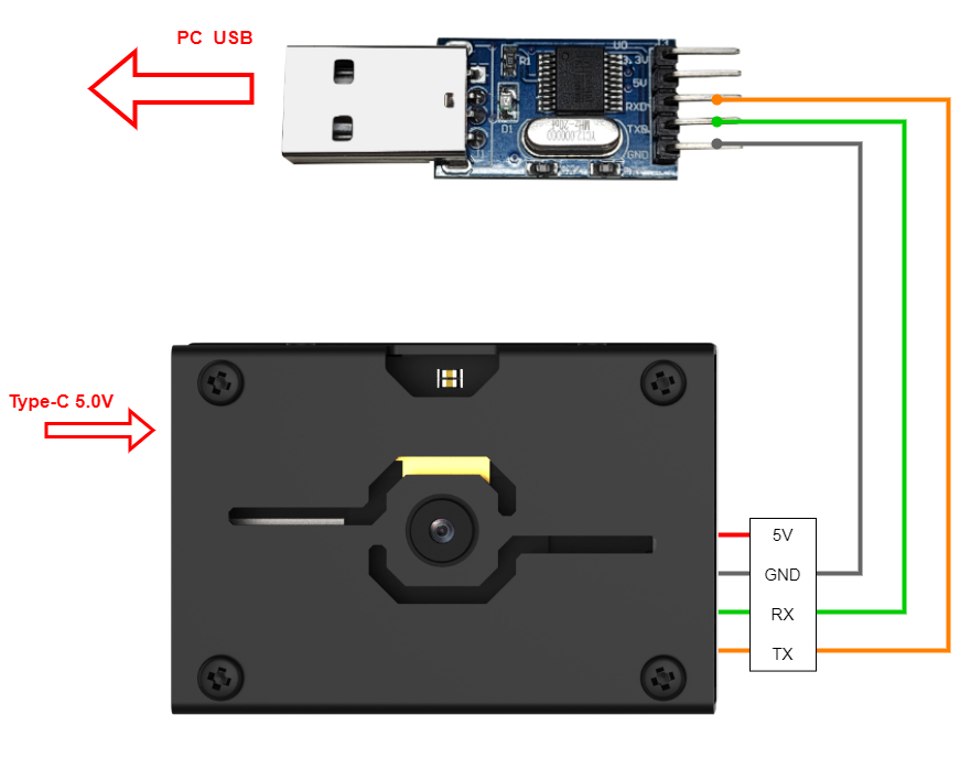

(2) Use DuPont wires to connect the GND, RX, and TX pins of the USB-to-serial module to the UART interface of the K210. Then, connect the USB-to-serial module to the PC end, as shown in the following diagram.

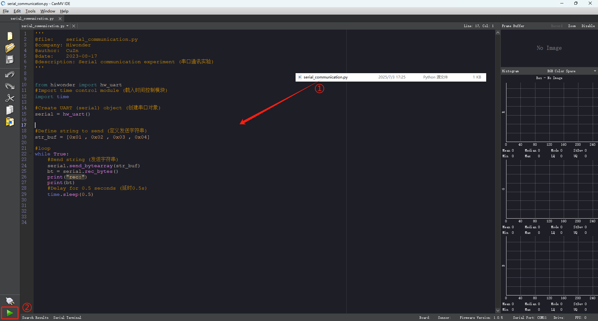

(1) Online running: After connecting, drag the program “serial_communication.py” from the same directory as this section to the code editing area of CanMV IDE, then click the run button in the bottom-left corner to run the program online, as shown in the figure below:
① After connecting, drag the program “serial_communication.py” from the same directory as this section to the code editing area of CanMV IDE. Then, click on “Tools” in the toolbar and select “Save the currently open script as (main.py) to CanMV Cam”, as shown in the figure below:

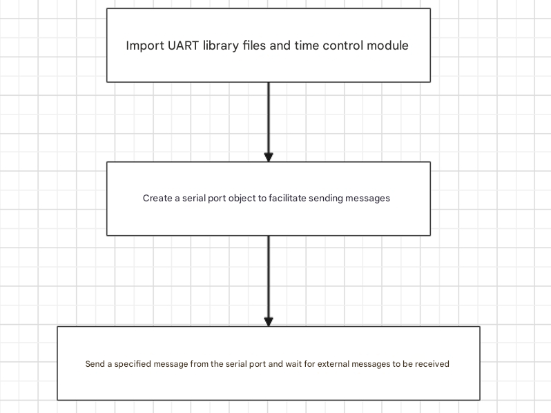

The programming approach for this case can be referenced in the diagram below:
Import the UART control module and the time control module for ease of access in subsequent calls.
from hiwonder import hw_uart
import time
Call the hw_uart function to create a UART object and define the string to be sent.
#Create UART (serial) object (创建串口对象)
serial = hw_uart()
#Define string to send (定义发送字符串)
str_buf = [0x01 , 0x02 , 0x03 , 0x04]
The main function is an infinite loop. Use the serial.send_bytearray function to send the string, then use serial.rec_bytes to receive the relevant content. Next, use the print function to print the content. Define a call to the delay function to receive and print the relevant content every 0.5 seconds.

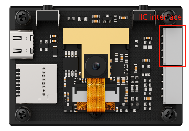

IIC (Inter-Integrated Circuit) is a serial communication bus protocol, also known as the IIC (Inter-IC) bus. It is a simple and efficient communication protocol used to connect microcontrollers with peripheral devices such as sensors, memory and displays.
The IIC bus uses two wires for data transmission: the Serial Data Line (SDA) and the Serial Clock Line (SCL). This allows for a reduction in the number of pins required when connecting devices. IIC is a convenient serial communication protocol suitable for connecting various types of chips and devices, enabling them to exchange data quickly and reliably.
The programming approach for this section can be referenced in the diagram below:
Import the I2C control module and the time control module for ease of access in subsequent calls.
from hiwonder import hw_i2c
import time
from machine import I2C
Call the I2C function to create an I2C object, specifying the pins used and the frequency (set to 100000). Define the relevant arrays, addresses, etc.
