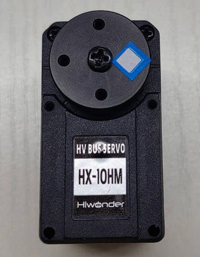

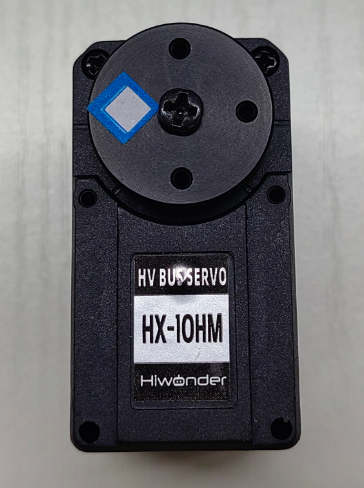

1.1.3 Servo Horn Installation & Pin Instruction

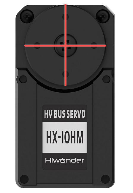

  1. Refer to the image below for servo horn installation. Using the HX-10HM as an example, align the horn with the red cross direction shown when the servo is at its central position. If the horn cannot be installed in the cross orientation at neutral, see section 1.4.3.2 Reading and Configuring Servo Information and use the position calibration in the motion control position parameters to adjust the servo offset.

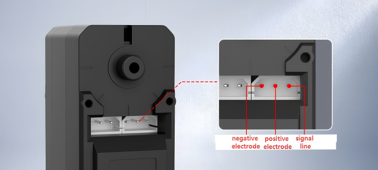

  1. The port distribution and instruction refer to the following picture and table.
Pin (from left to right) Instruction
GND Power ground
VIN Power input
SIG Signal terminal for half-duplex UART asynchronous serial interface
When the servo and the microcontroller are not using the same power supply, ensure that the two power supplies share a common ground.

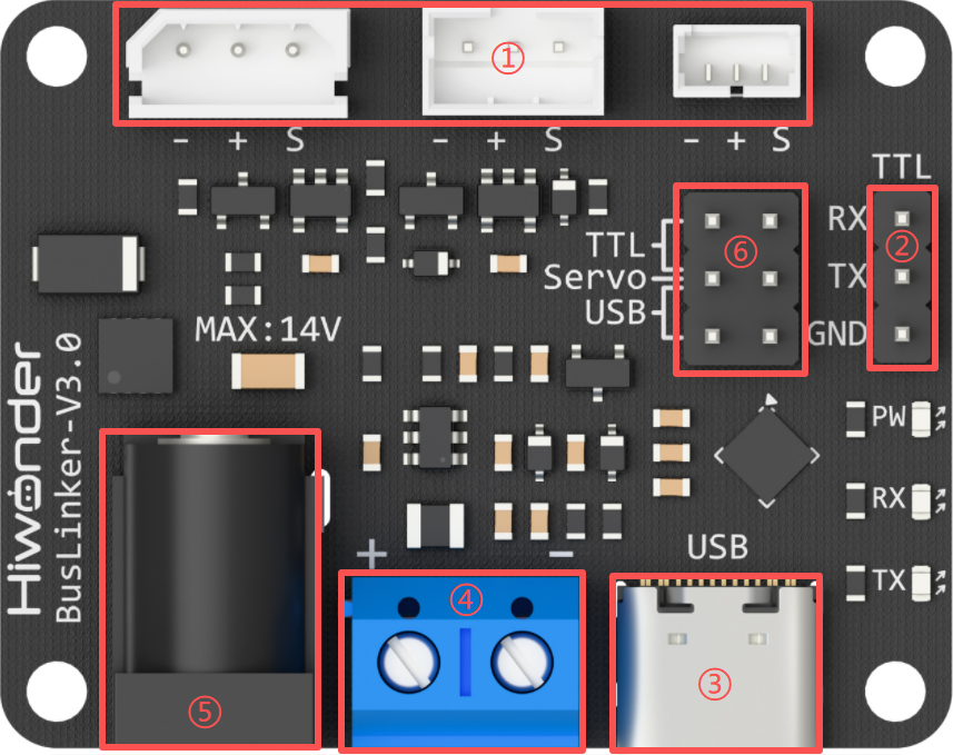

1.4.1 Magnetic Encoder Servo Debugging Board Introduction
The magnetic encoder servo debugging board is a tool for testing servos. Using the included PC software, ServoStudio, it can test servos and set their parameters. The debugging board can also communicate with a microcontroller via a serial interface to control the servos.
Index Instruction Function Instruction
① 3pin Bus Servo Interface Connecting and debugging Bus Servo
② Serial Port Pins It communicates with other MCUs via the serial port
③ Type-c Interface It communicates with PC software/hardware Controller
④ Power Terminal Lithium Battery Power Connection
⑤ DC Interface Adapter Power Connection
⑥ Communication Mode Select Pins Switch Communication Mode: USB/TTL

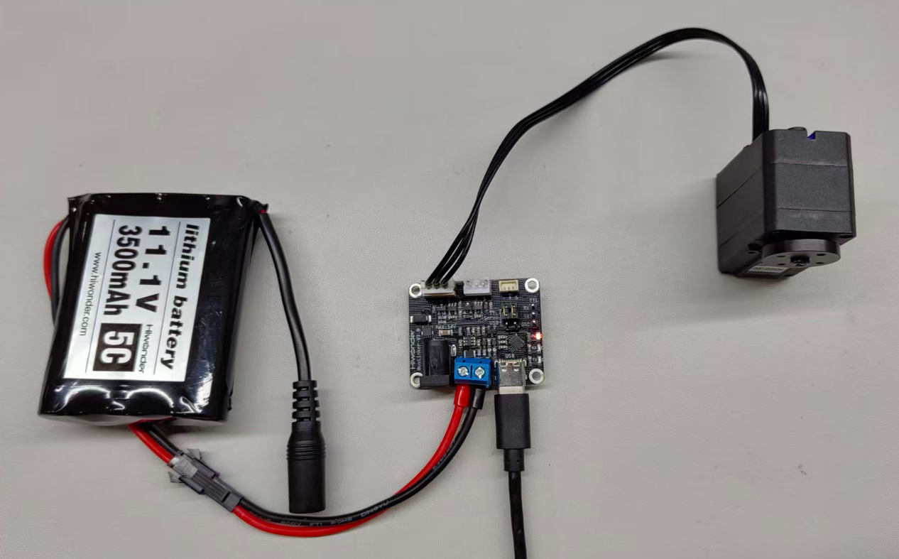

1.4.2 Hardware Connection
  1. Insert the servo cable into the servo and then into the 5264-3-pin bus servo interface on the debug board.
  2. Connect the red wire to the “+”, the black wire to “-”, then connect USB cable.
  • Avoid reversing the battery’s positive and negative connections.
  • Place the jumper cap on the Servo and USB pins.
  1. Connect the lithium battery to the docking cable. The cable features a reverse-polarity protection design. Do not force the connector if it does not fit.
    If a lithium battery is not available, please prepare a stable 12 V power supply.

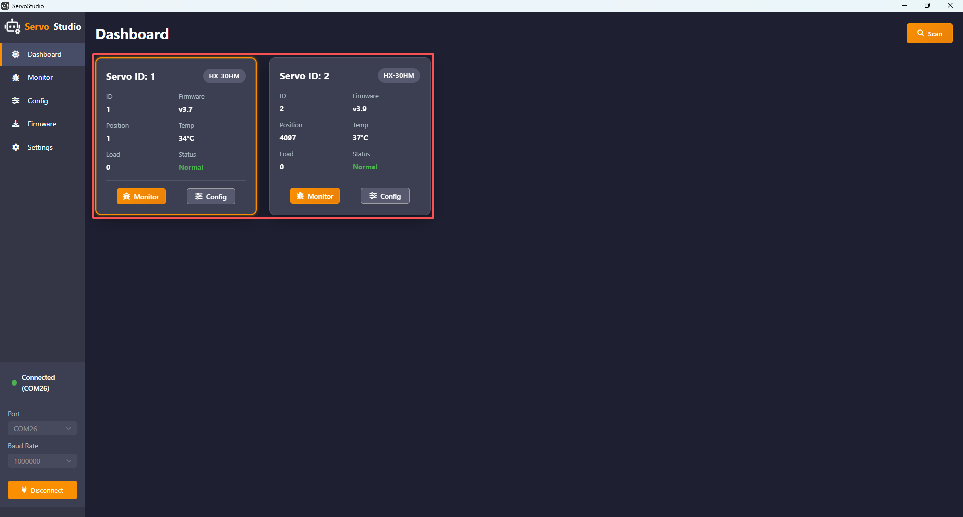

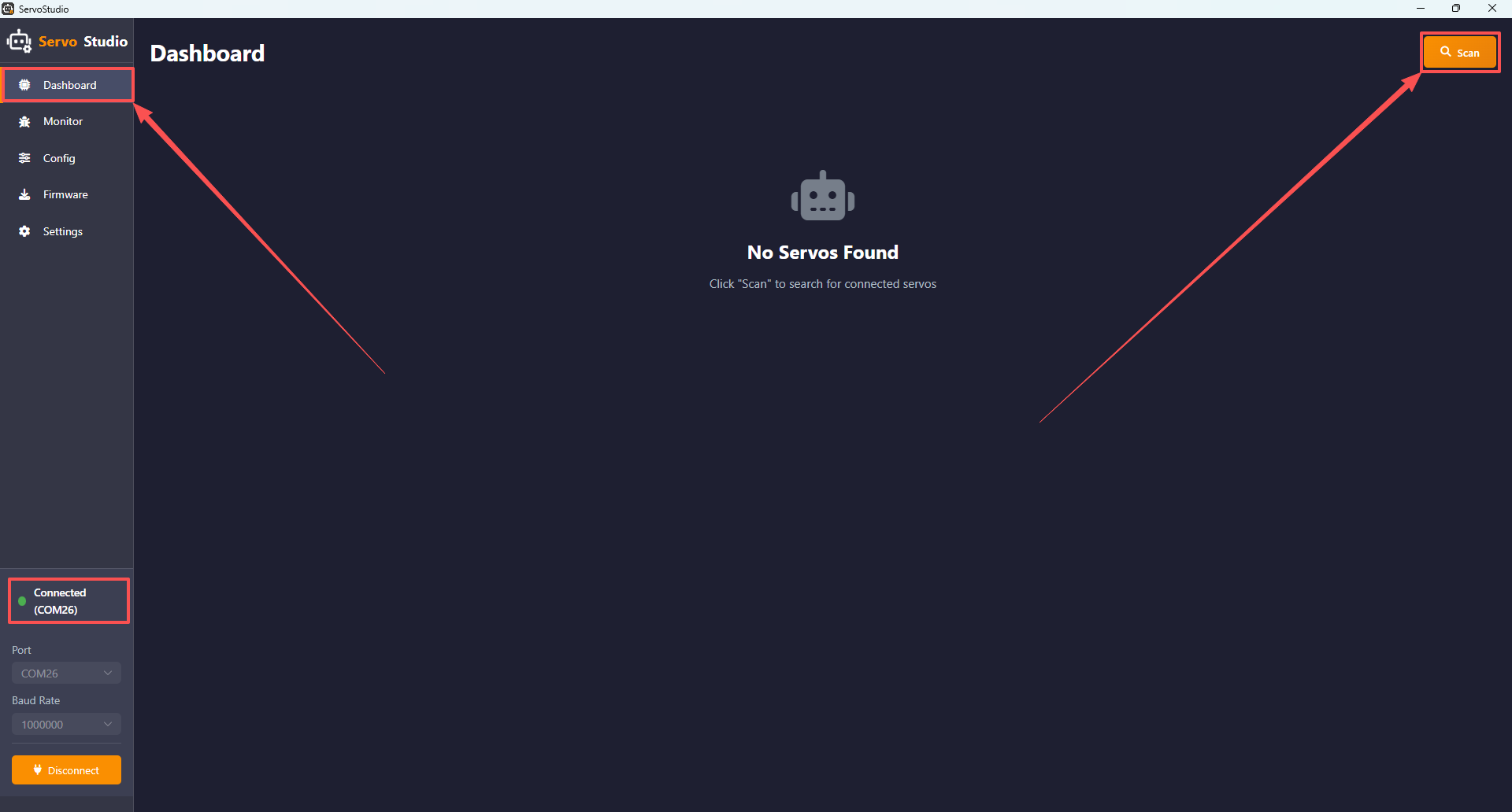

  1. After connecting via the serial port, click Scan in the Dashboard. The PC software then scans servo IDs 1–253 and displays the specific servos on the screen.

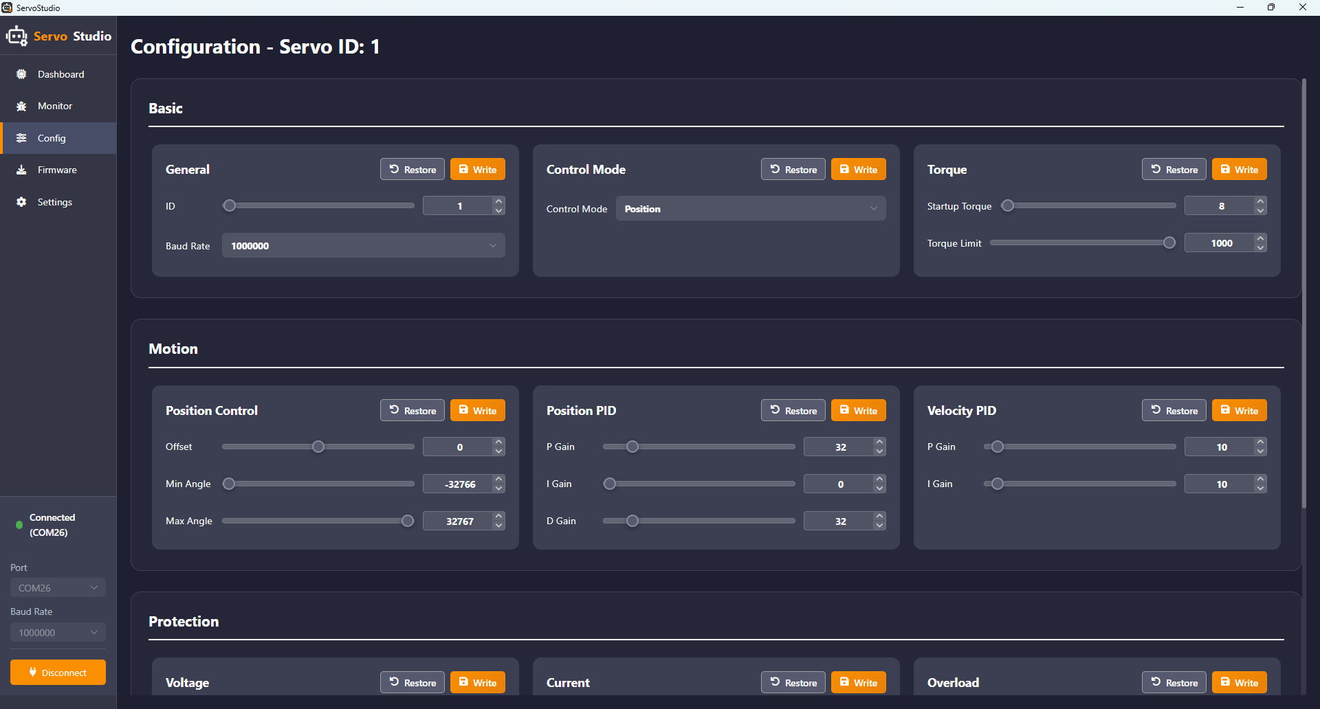

  1. Click Config to enter the parameter settings interface, where the servo’s parameter information is displayed and can be adjusted as needed.
(1) Basic Configuration
① Basic Settings
In this section of the software, the servo ID can be set from 1 to 253, and one of eight available baud rates can be selected for servo communication with the PC software.
② Operating Mode
This panel allows selection of three modes: Position, Velocity (Closed-Loop), and PWM (Open-Loop).
In position mode, the servo operates in servo mode. In both Velocity (Closed-Loop) and PWM (Open-Loop) modes, the servo operates in Motor Mode.
③ Torque Control
This control mode is used to set the servo’s minimum starting torque and maximum output torque limits. Set 1000 = 100% × Stall Torque.
Setting the torque too low may prevent the servo from operating.
(2) Motion Control
① Position Control Parameters
  • Position Calibration: Allows correction of the servo’s positional offset with a setting range from –2047 to 2047. If the servo horn cannot be aligned in the cross orientation during installation, modify this parameter to correct the deviation.
  • Angle Limit (Minimum/Maximum): Defines the allowed motion range for the servo. The valid range is –30719 to 30719. Since 0–4095 maps to 0–360°, this corresponds to about ±7.5 revolutions in absolute position mode. Configure the thresholds within this range as required.
② Position Closed-Loop Parameters
These three parameters are used to adjust the servo’s position error. The P parameter determines the influence of the current position error on the control output. The I parameter is used to eliminate long-term steady-state error and is typically left unchanged. The D parameter limits the rate of error variation, thereby improving overall system stability. These parameters can be adjusted according to requirements to achieve the desired performance.
③ Speed Closed-Loop Parameters
These two parameters are used to adjust the servo’s speed error, ensuring the servo moves at the specified velocity and maintains precise speed control. These parameters can be adjusted according to requirements to achieve the desired performance.

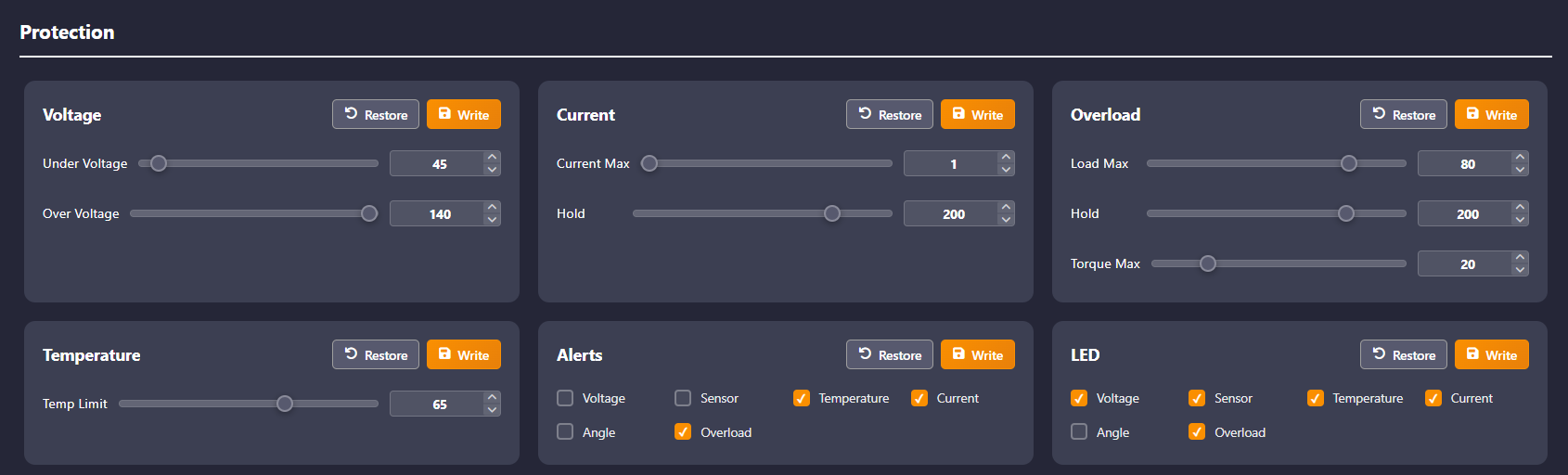

(3) Safety Protection
The thresholds for each feature in the software, and the protection and alarm targets, can be configured according to specific requirements.
  • The undervoltage and overvoltage thresholds range from 0 to 254, with each step corresponding to 0.1 V.
  • The overcurrent threshold ranges from 0 to 6000 mA. And the overcurrent protection time threshold ranges from 0 to 254, with each unit corresponding to 10 ms.
  • The overload threshold ranges from 0 to 100, with each unit representing 1 percent of the maximum torque. The overload time threshold ranges from 0 to 254, with each unit corresponding to 10 ms. The overload torque defines the maximum output torque after overload protection is triggered. It is adjustable from 0 to 100, with each unit representing 1 percent.
    The overtemperature protection threshold ranges from 0 to 100, with each unit corresponding to one degree Celsius.

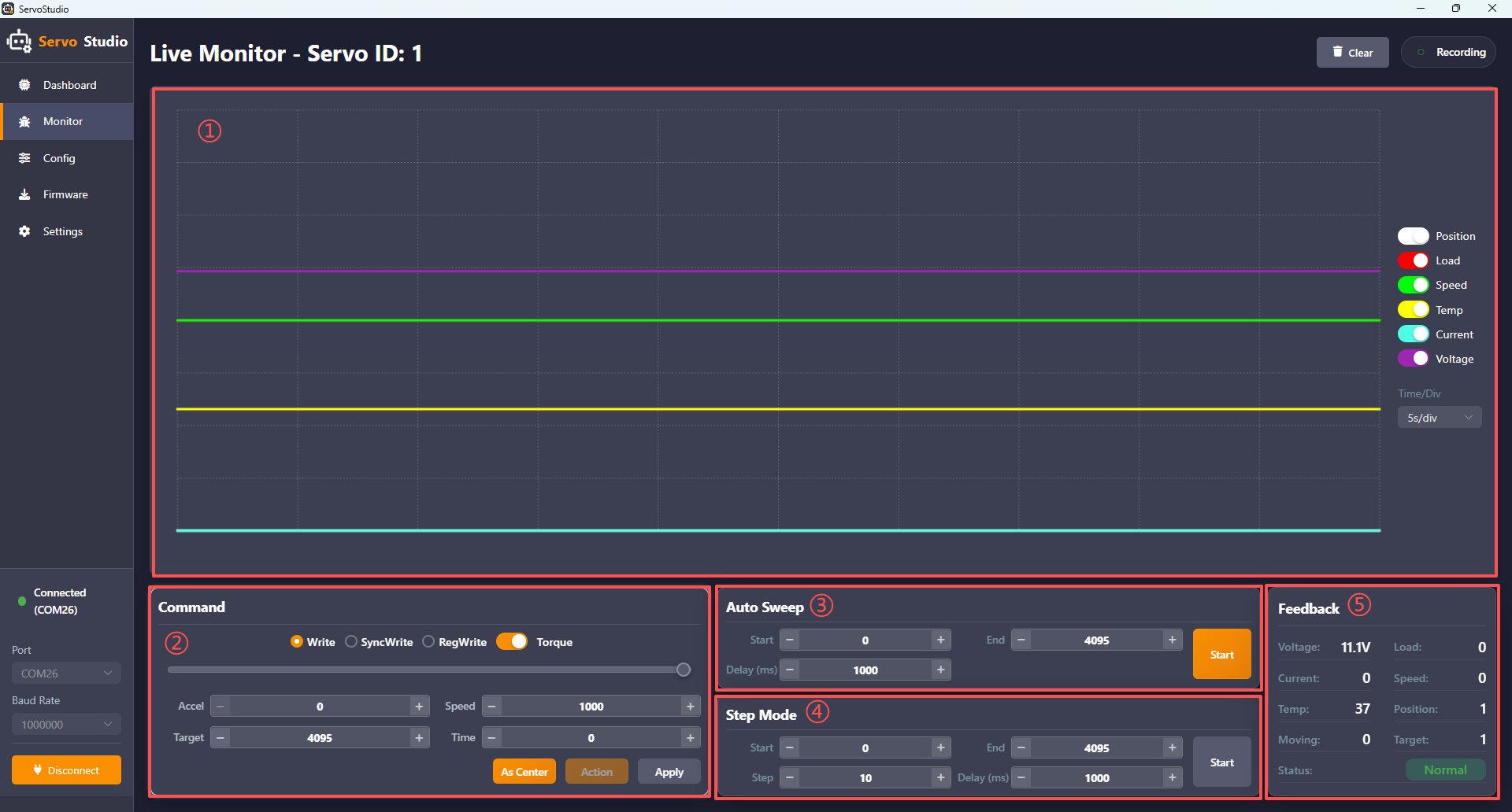

1.4.3.3 Servo Operation Control
Click the Monitor option on the left to enter the servo debugging interface.
The interface includes five sections: ① Servo operation parameter waveform area. ② Command area for servo operation. ③ Auto Sweep area. ④ Step Mode area. ⑤ Feedback area.
The five areas are described as follows:

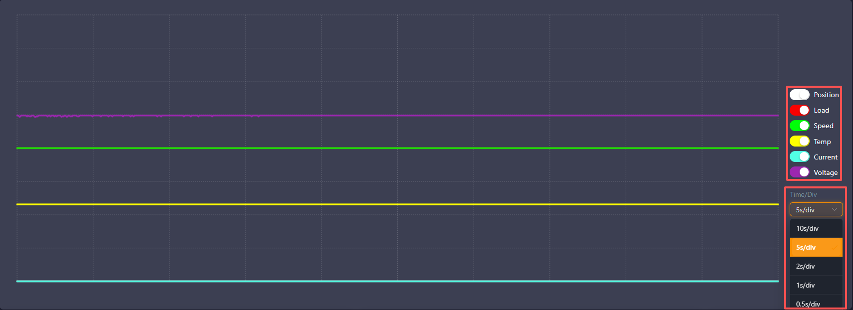

① Servo Operation Parameter Waveform Area:
This area displays the waveform graphs of six servo parameters during motion. Use the switches on the right to select which parameters to display, and use the controls below to set the time range shown.

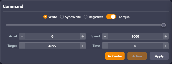

② Servo Operation Area:
This area allows configuration of the three servo write modes: Write, SyncWrite, and RegWrite. Detailed information about these write modes can be found in the Hiwonder Magnetic Encoder Bus Servo Communication Protocol Document. The Torque switch controls whether the servo is powered. When the switch is turned off, the servo stops outputting torque. If a servo horn is installed, it can then be manually rotated. The slider in the middle can be used to directly control the servo position, with a range of 0–4095. Below the slider, the following parameters can be set for servo movement: Accel — acceleration, range 0–254, unit 100 steps/s². Speed — speed, range 0–3400, unit steps/s. Target — target position, range -30719 to 30719, unit steps. Time — time, range 0–1000. At the bottom, three buttons are provided: As Center sets the current target position as the central position. Action triggers motion in asynchronous write mode. Apply sends parameters to the servo in normal write and synchronous write modes.
  • Position mode: Time parameter has no effect.
  • Velocity (Closed-Loop) mode: only Speed parameter is used.
  • PWM (Open-Loop) mode: only Time parameter is used.
