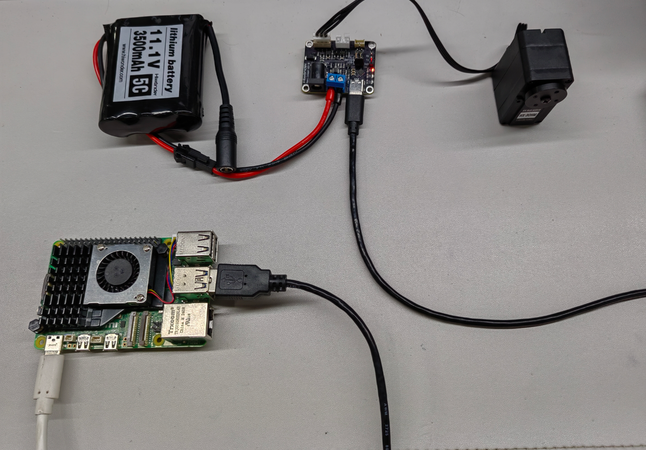

4.1.1 Wiring Instruction
This example uses a Raspberry Pi 5 controller powered by a 5 V adapter. The bus servo is connected to the debugging board, which is powered by an 11.1 V lithium battery. Finally, the debugging board is connected to any USB port of the Raspberry Pi 5 using a Type-C cable.

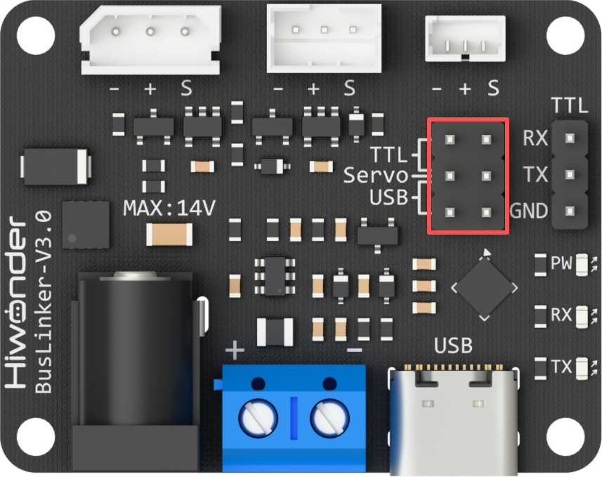

Before running this example, ensure that the jumpers on the debugging board are installed on the Servo and USB pins. Otherwise, communication will not function properly.

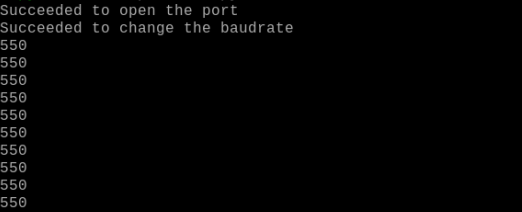

4.2.2.2 Program Outcome
After running the program, the terminal continuously prints the current position of the servo.
