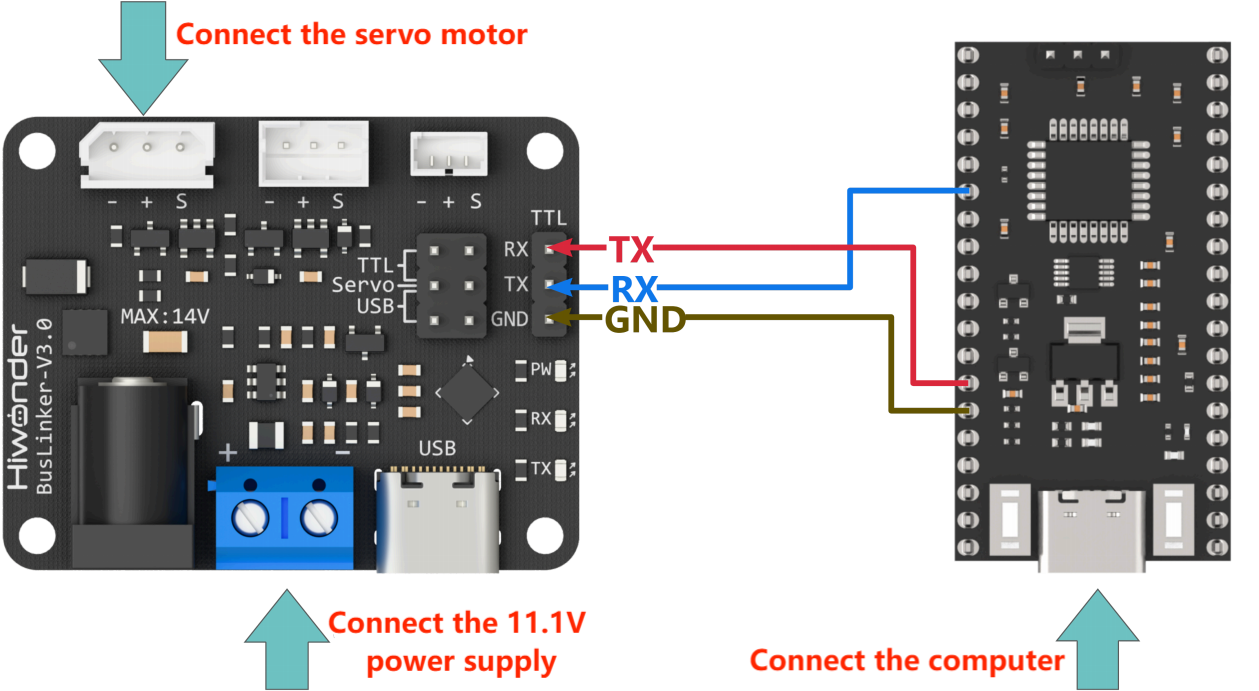

3.1.1 Wiring Instruction
This example uses the STM32 controller for development, with power, program download, and debug data handled via the data cable. The bus servo is connected to the debugging board, which is powered by an 11.1 V lithium battery. The STM32F103RBT6 microcontroller and the debugging board are then connected through the serial pins using Dupont wires.

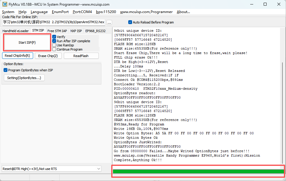

3.1.3 Program Flashing

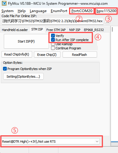

  1. Connect the controller to the computer using a USB cable.
  2. Double-click STM32 serial port programming software FlyMcu .

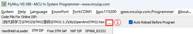

  3. Click the ① ”” icon and select the HEX file to be programmed from the path: Serial_Servo\MDK-ARM\Serial_Servo.
  1. At position ② in the figure, select the serial port corresponding to the controller. At ③, select a baud rate of 115200. Configure ④ and ⑤ according to the options shown in the figure.
  1. Click Start ISP(P), then press the RST button on the controller. The program will automatically begin downloading. Once the following content appears in the log output on the right, the program download will be complete.

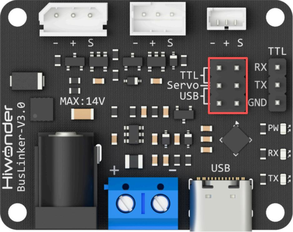

Before running this example, ensure that the jumpers on the debugging board are installed on the Servo and TTL pins. Otherwise, communication will not function properly.

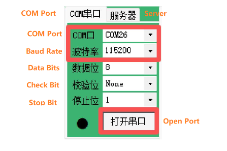

3.2.1.2 Program Outcome
After running the program, open the serial debug assistant, select the corresponding COM Port, set the Baud Rate to 115200, and click the Open Port. The debug assistant prints the sent data packets and the servo status information, which corresponds to the data frames returned by the servo.

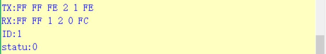

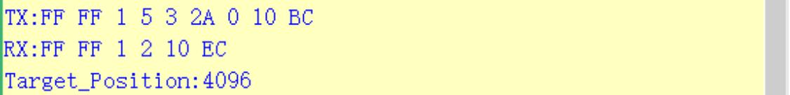

  • The ping function broadcasts to search for servos, prints the detected ID numbers, and returns the working status of the servo.
status = servo_ping(0xFE);
  • Print the sent data packets and the servo response frames to the PC serial debug assistant.
sprintf((char *)info_buf,"TX:%X %X %X %X %X %X\r\n",servo_packet.tx.header_1,\ servo_packet.tx.header_2,\
servo_packet.tx.elements.id,\
servo_packet.tx.elements.length,\
servo_packet.tx.elements.cmd,\
servo_packet.tx.elements.args[servo_packet.tx.elements.length - 2]\
serial_printf_string(info_buf);
sprintf((char *)info_buf,"RX:%X %X %X %X %X %X\r\n",servo_packet.rx.header_1,\
servo_packet.rx.header_2,\
servo_packet.rx.elements.id,\
servo_packet.rx.elements.length,\
servo_packet.rx.elements.cmd,\
servo_packet.rx.elements.args[servo_packet.rx.elements.length - 2]\
  • Print the returned servo ID and operating status parameters to the PC serial debug assistant.
sprintf((char *)info_buf,"ID:%X\r\n",status.id);
sprintf((char *)info_buf,"statu:%X\r\n",status.error_byte);

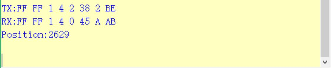

This example displays the current position of the bus servo through the serial debug assistant window.
3.2.3.1 Run Program
Double-click the Serial_Servo.uvprojx file located at the 02 STM32 Development\ Program\ Serial_Servo \ MDK-ARM folder. Change the value of the exp macro definition in the main.c file to 1, then compile the project.
/* Private define ------------------------------------------------------------*/
/* USER CODE BEGIN PD */
#define exp 1
Connect the STM32F103RBT6 microcontroller to the computer and upload the compiled HEX file to the microcontroller.
3.3.2.2 Program Outcome
After running the program, the serial debug assistant prints the sent data packets and the current position of the servo, which corresponds to the data frames returned by the servo.

  • The read_pos function reads the current position value of servo ID 1.
status = servo_read_pos(1, &read_pos);
  • Print the returned current position values of the servo to the PC serial debug assistant.
sprintf((char *)info_buf,"Position:%hu\r\n",read_pos);

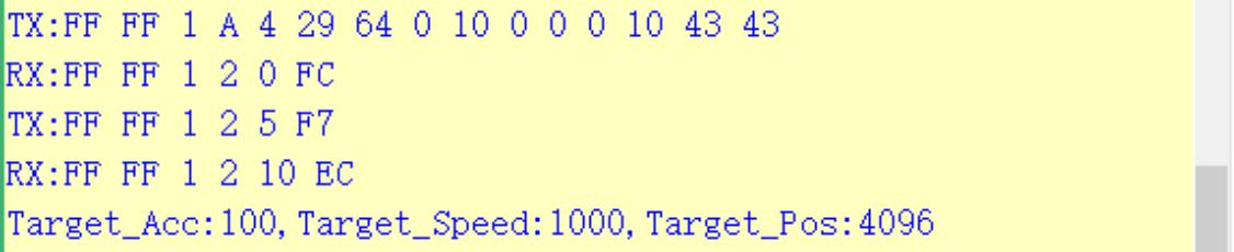

  • The write_pos function sets the target position of servo 1, and the servo moves to that position.
status = servo_write_pos(1, write_pos);
  • Print the set target position values of the servo to the PC serial debug assistant.

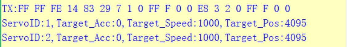

  • The write_reg_pos_ex function writes the acceleration, speed, and position to the specified register of servo 1 without executing immediately. Execution is deferred and requires calling the reg_action function.
status = servo_write_reg_pos_ex(1, write_acc, write_speed, write_pos);

  • After calling reg_action, the servo executes the previously written write_reg_pos_ex command and moves accordingly.
status = servo_reg_action(1);
  • Print the set acceleration, speed, and position parameters to the PC serial debug assistant.
sprintf((char *)info_buf,"Target_Acc:%hu,Target_Speed:%hu,Target_Pos:%hu\r\n",write_acc, write_speed, write_pos);

  • The sync_write_pos_ex function sets the acceleration, speed, and position for servo IDs 1 and 2, and the servos move to the specified positions.
// 向1号和2号舵机同时写入加速度、速度和位置信息 (Write acceleration, speed, and position information to servo 1 and 2 simultaneously)
status = servo_sync_write_pos_ex(sync_write1, 2);
  • Print the sent data packets to the PC serial debug assistant.

  • Print the set servo ID, acceleration, speed, and position parameters to the PC serial debug assistant.
sprintf((char*)info_buf,"ServoID:%hu,Target_Acc:%hu,Target_Speed:%hu,Target_Pos:%hu\r\n",\
sync_write1[0][0],sync_write1[0][1],\
sync_write1[0][2],sync_write1[0][3]);
sprintf((char
sync_write1[1][0],sync_write1[1][1],\
sync_write1[1][2],sync_write1[1][3]);

  • The select_mode function sets the operating mode of servo 1.
status = servo_select_mode(1, 0);
sprintf((char *)info_buf,"TX:%X %X %X %X %X %X %X %X\r\n",servo_packet.tx.header_1,\
servo_packet.tx.elements.args[0],\
servo_packet.tx.elements.args[1],\
