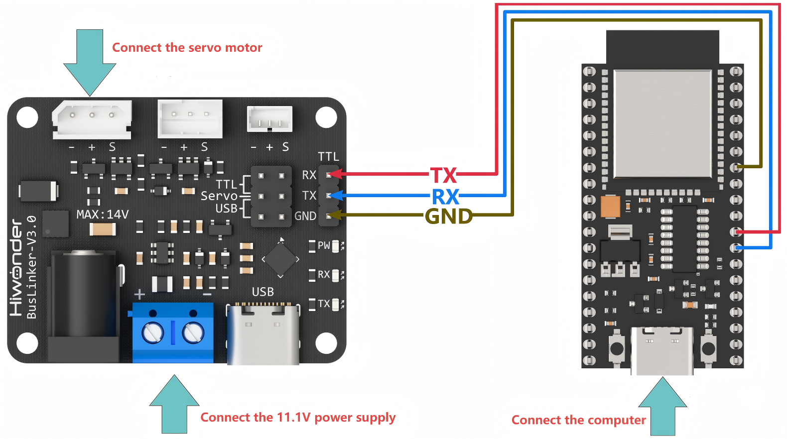

2.1.1 Wiring Instruction
The example in this section uses an ESP32 microcontroller and an ESP32 expansion board for development, powered via a USB cable. The bus servo is connected to the debugging board, which is powered by an 11.1 V lithium battery. Finally, the ESP32 microcontroller and the debugging board are connected through the serial pins using Dupont wires.

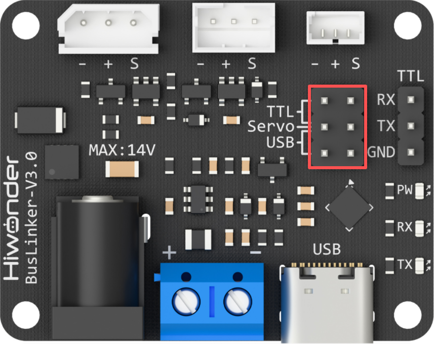

2.2 Development Example
Before running this example, ensure that the jumpers on the debugging board are installed on the Servo and TTL pins. Otherwise, communication will not function properly.

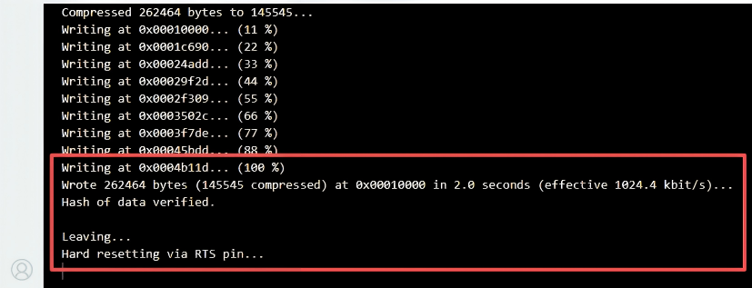

2.2.1.1 Run Program
Double-click Serial_Servo.ino located at the 01 ESP32 Development\ Program\ Serial_Servo folder.
After connecting the ESP32 microcontroller to the computer, choose as the development board type. Click to download the program.

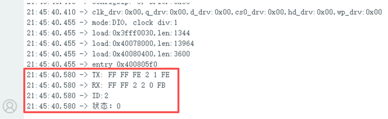

2.2.1.2 Program Outcome
Once the program is running, the serial debugger prints the sent data packets alongside the servo’s status frames returned from the device.
