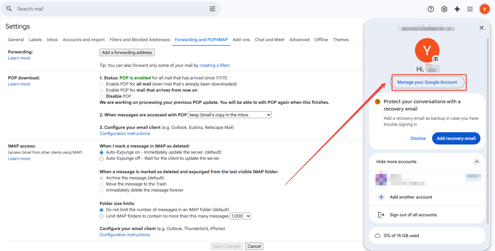

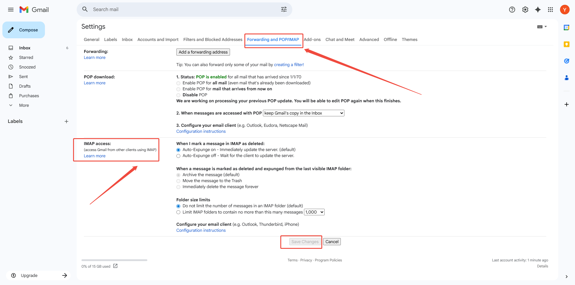

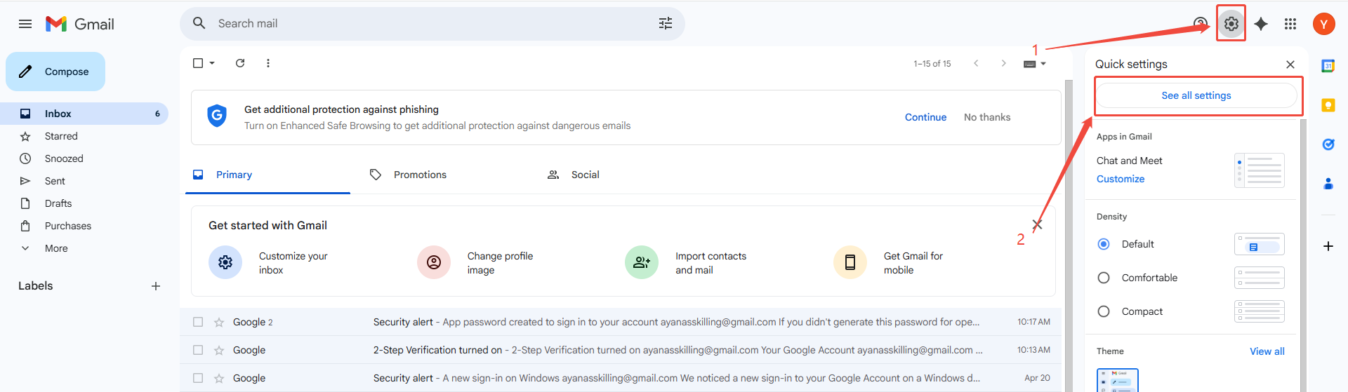

  • Enable IMAP
Open https://mail.google.com/, sign in to the Gmail account, and click the settings icon.
Open the Forwarding and POP/IMAP tab at the top of the Settings page and find the IMAP access section. Check the IMAP settings there, then click Save Changes if any changes were made.
The page above indicates that IMAP has been enabled for the Gmail account. In Gmail, SMTP is enabled automatically after IMAP is enabled. A separate SMTP option may not appear in Gmail settings, and no additional setup is required.

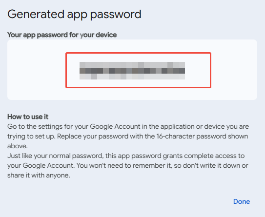

  • Generate a Google app password
Once IMAP is available, create a Google app password for OpenClaw to access the mailbox. Click the profile avatar, then select Manage your Google Account.

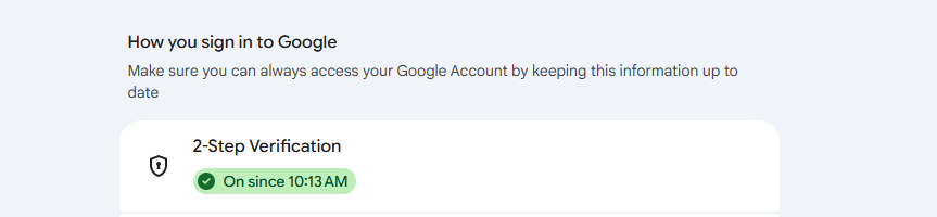

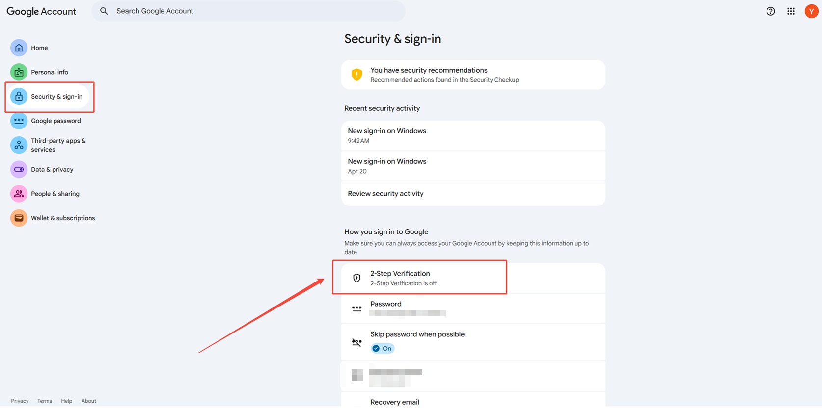

Select Security & sign-in in the left menu and enable 2-Step Verification as prompted by Google.
The following page is shown after setup.

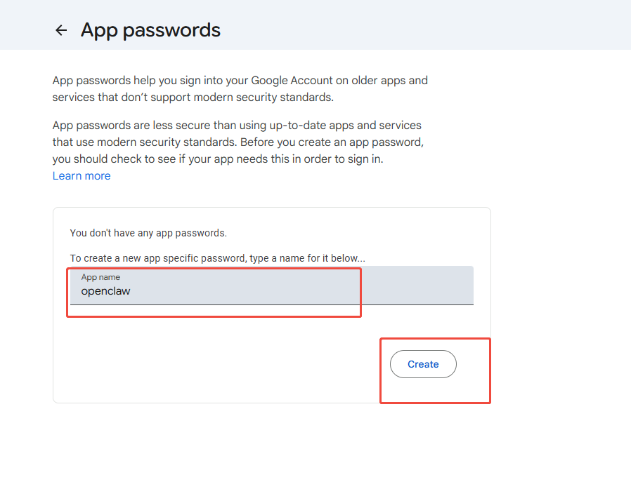

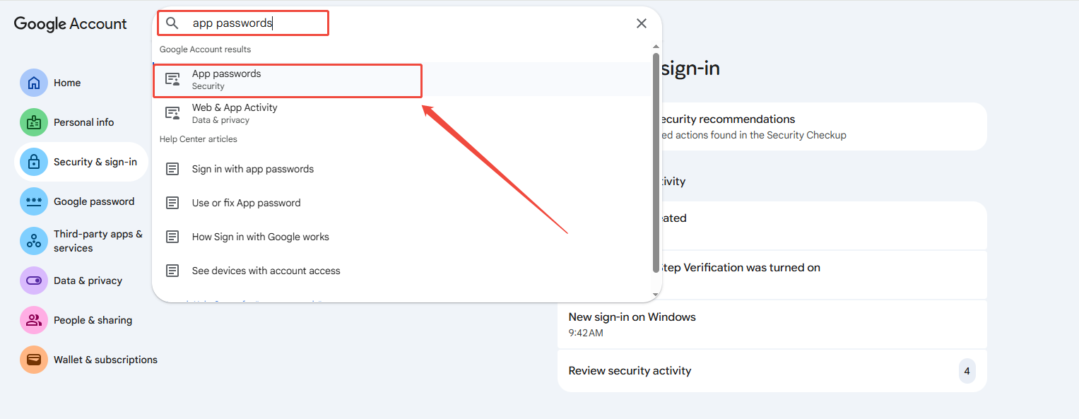

Search for app passwords in the search bar on this page.
After entering the email password and completing verification as prompted, enter a custom app name on this page and click Create.
A 16-character app password will be generated. Save it securely and do not share it. This password will be required later for the OpenClaw configuration.

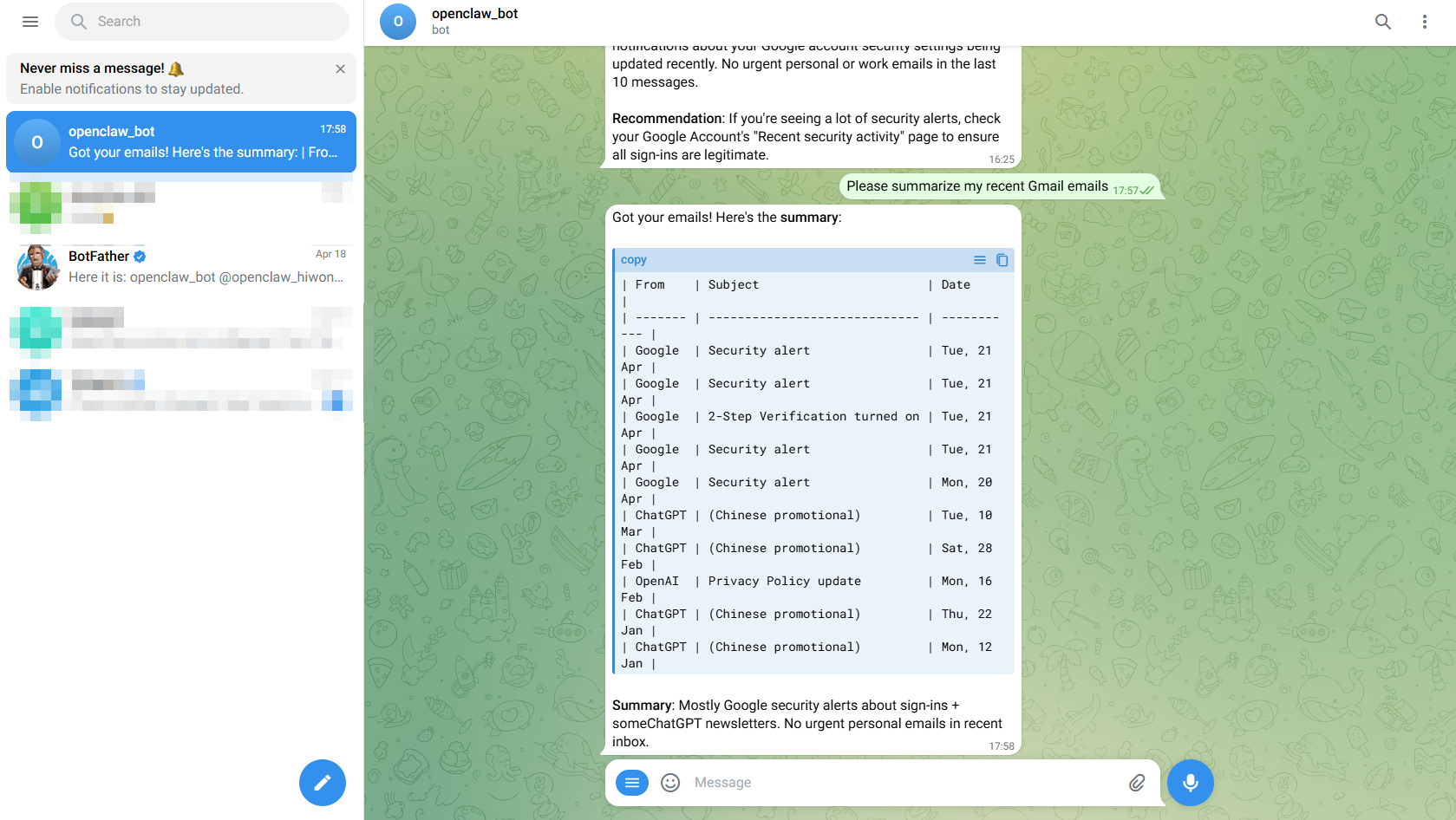

    • Add the bot to a group or chat with it directly. Use the same receiving scope as configured on the open platform.
    • Send a simple message to @the bot, such as Hello, testing the connection, or @bot hello.
  3. Check the response
    • Normal: the bot replies with text within a few seconds. The content may be a greeting or an explanation, depending on the model and Skill.
    • Abnormal: if there is no reply for a long time, first follow the troubleshooting section in 7.9 OpenClaw Deployment, Integration Testing, and Troubleshooting to check whether the app has been published and installed, whether event subscription or long connection is working, and whether the local Gateway is running.
    • If the email Skill has already been connected, send another message such as Check today's unread emails and confirm whether the reply includes an email summary or a clear message. This depends on whether the script and model have retrieved emails.
Email retrieval depends on config/email-accounts.json and the network. If Telegram replies normally but email-related errors appear, the issue is on the email or script side. Continue troubleshooting with the authentication and Skill items in 7.9 OpenClaw Deployment, Integration Testing, and Troubleshooting.
Demo result:

  2. Authentication side for Gmail: whether imap.auth.pass and smtp.auth.pass in config/email-accounts.json use the app password instead of the Gmail password, whether user is the full email address, whether MAIL_PASSWORD and MAIL_USERNAME are correct when environment variables are used, whether IMAP/SMTP is enabled on the web, and whether outbound network and TLS from Ubuntu are blocked by a firewall or proxy.
