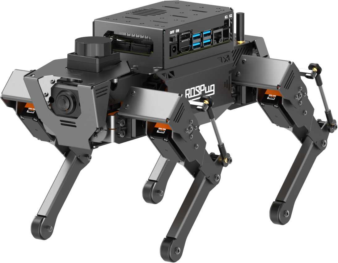

1.1 Introduction to ROSPug
The black ROSPug and the gun-gray ROSPug are only different in appearance; their internal functions and features are exactly the same.
ROSPug is a quadruped robot dog specifically designed for ROS education, integrating the Ubuntu 18.04 system and ROS Melodic robot system.
It is equipped with advanced hardware components, including the NVIDIA Jetson Nano, high-voltage bus servos, Lidar, and an HD camera. With this high-performance hardware configuration, ROSPug excels in various applications such as robot motion control, mapping, navigation, tracking and obstacle avoidance, autonomous patrolling, human body recognition, and somatosensory interaction.
Moreover, ROSPug utilizes inverse kinematics, allowing for highly adjustable posture, height, and speed. This feature enhances the user’s control experience, providing excellent maneuverability and customization options.

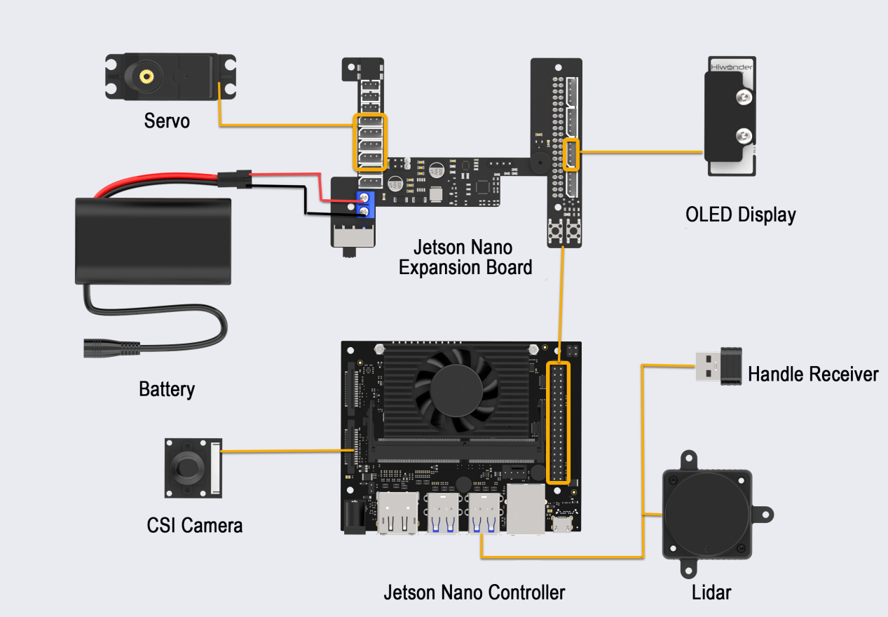

1.1.1 Hardware Connection Diagram
The diagram below shows the connections between the ROSPug robot dog’s mainboard, expansion board, and various hardware modules.

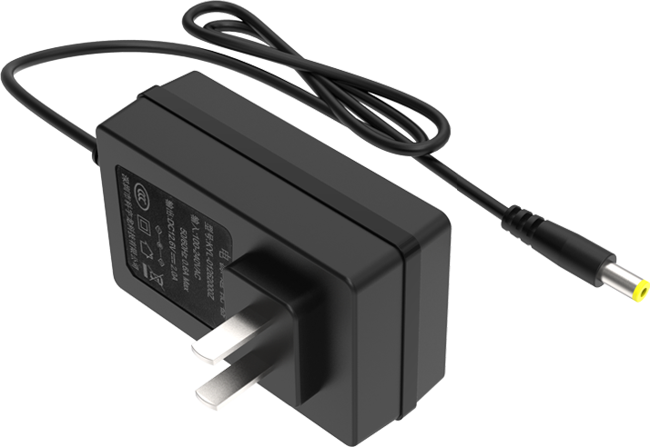

| 3 | 12.6V 2A charger(DC 4.0*1.7m) | 1 | ![]() |

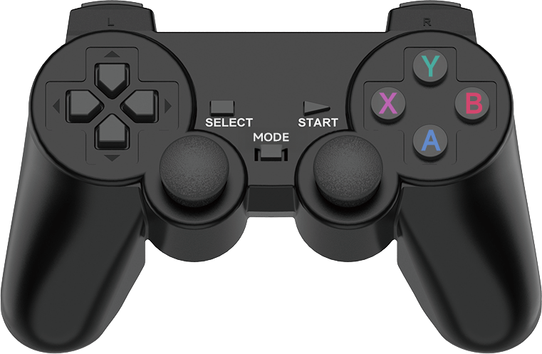

| 5 | Wireless handle | 1 | ![]() |

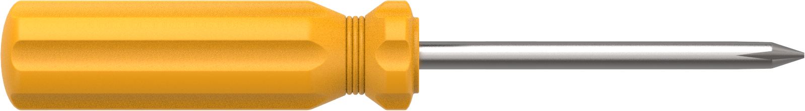

| 7 | Screwdiwer | 1 | ![]() |

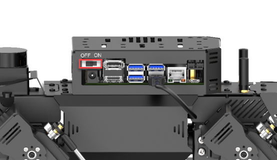

(1) Turn OFF the switch on the expansion board.

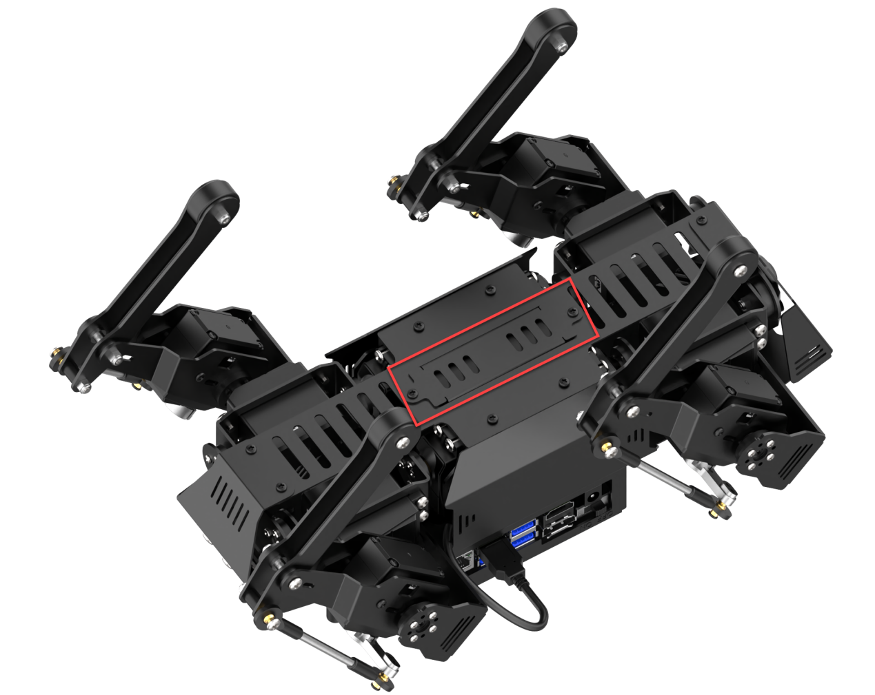

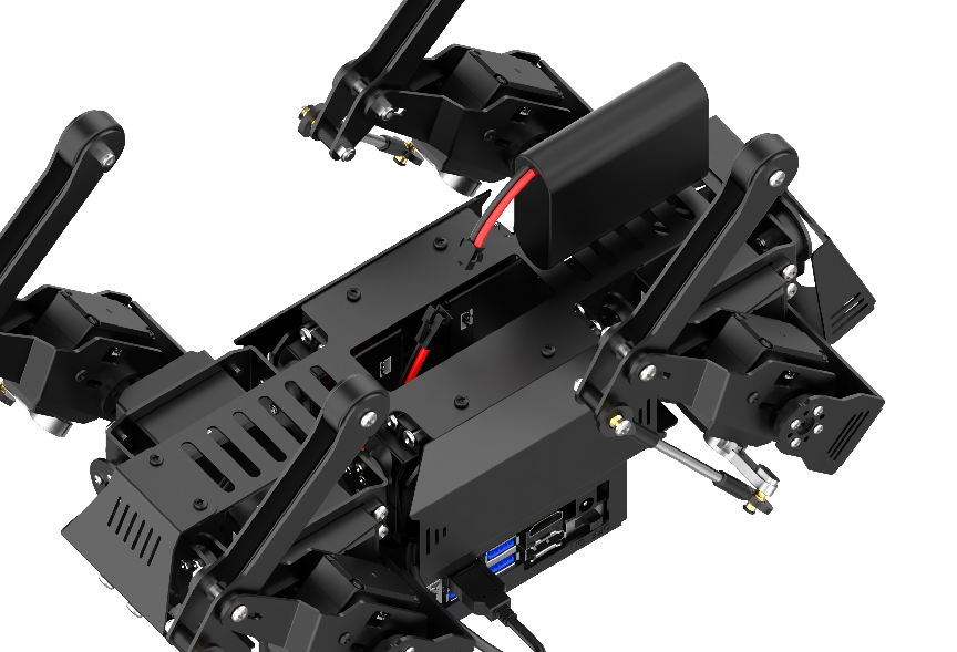

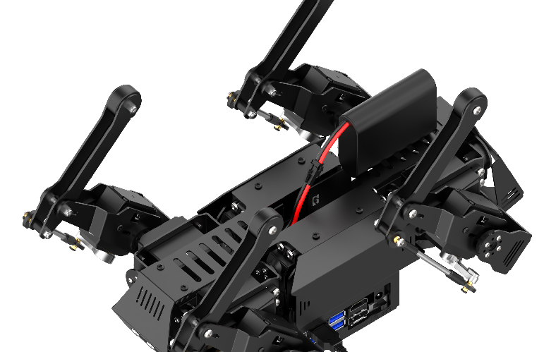

(2) Take out the battery wires from the bottom hole.
(3) Connect the battery by matching the wires: red to red and black to black.
(4) Secure the battery cover.
(5) Connect the provided charger to the DC power port on the Jetson expansion board to charge the robot.

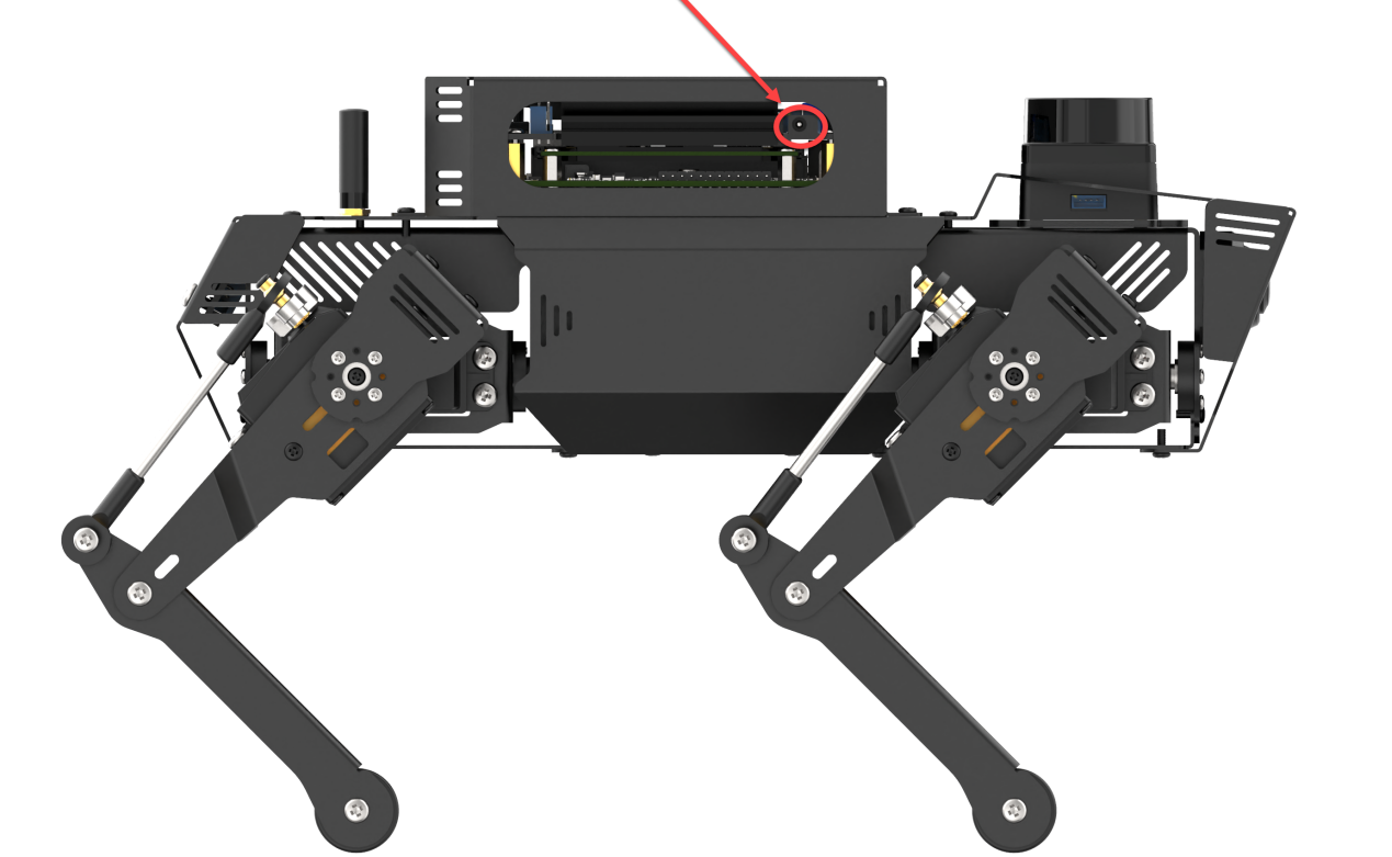

1.4.2 Startup Notice
(1) Before powering on, ensure all connections on the main controller are securely plugged in. Pay particular attention to the servo wires, OLED module, HD camera, controller, and radar connections.

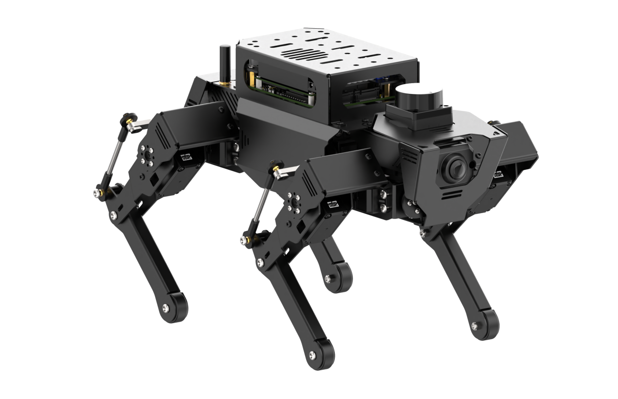

(2) To prevent damage to the robot caused by sudden force upon startup, place the robot as shown in the picture.

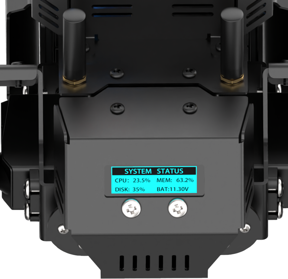

(3) Switch ON the expansion board. LED1 will emit a faint blue light, and after 20 to 30 seconds, it will begin flashing. Soon after, LED1 will stay solid, and the OLED module at the rear will display the current voltage. At this point, the robot dog will shift to its initial posture, signaling that the ROS configuration is complete and the device is fully powered up.
