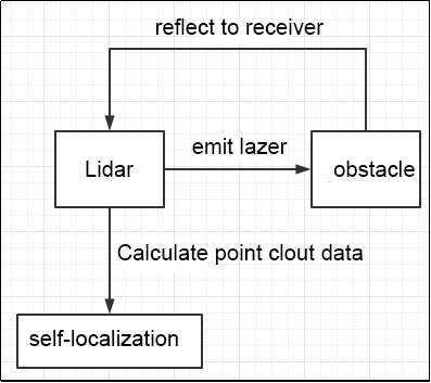

With Lidar as a signal source, pulse laser emitted by the Lidar’s emitter hits the surrounding obstacles, causing scattering. A portion of the light waves reflects back to the Lidar’s receiver, and by utilizing the principle of laser ranging, the distance from the Lidar to the target point can be calculated. By continuously scanning the target object with pulse lasers, data of all target points on the object can be obtained. After performing imaging processing on this data, an accurate three-dimensional image can be generated.

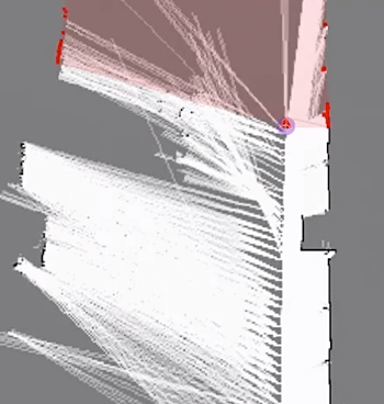

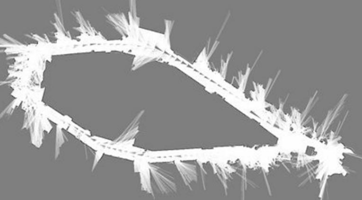

9.1.3 Mapping Knacks
(1) When initializing the mapping process, it’s advisable for the robot to face a straight wall or use a closed cardboard box instead. This allows the Lidar to scan as many points as possible.
(2) Strive to move in straight lines to minimize the robot’s rotational movements. Otherwise, the density of feature points in the map may be reduced. When environmental features are weak, position the robot close to the most prominent side of the environment to facilitate mapping.
(3) In certain large-environment scenarios, it’s beneficial to allow the robot to complete a closed-loop mapping first, then proceed to scan smaller details in the environment meticulously. For instance, in settings like shopping malls with numerous transparent surfaces and less distinctive features, it’s advantageous to pause the robot at conspicuous environmental features such as pillars, corridors, or inclined walls. Rotate the robot towards these features, allowing the radar to capture them thoroughly. After understanding the characteristic environment, rotate the robot back and resume forward movement. However, avoid stepping backward while rotating whenever possible.

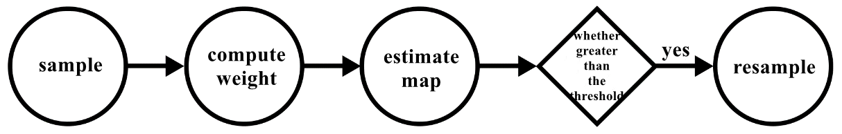

Gmapping algorithm will estimate the Lidar pose firstly based on the previous map and motion model. Then it will compute the weight according to the sensor observation to resample and update the map of particle. It will execute these steps in cycle to complete mapping.
But RBPF particle filter algorithm has defects. It requires ample particles, and resamples frequently. Large amount of particles will result in great computation and storage occupation. And Gmapping has proposed two solutions for these two problems, including improving proposal distribution and selective resampling.

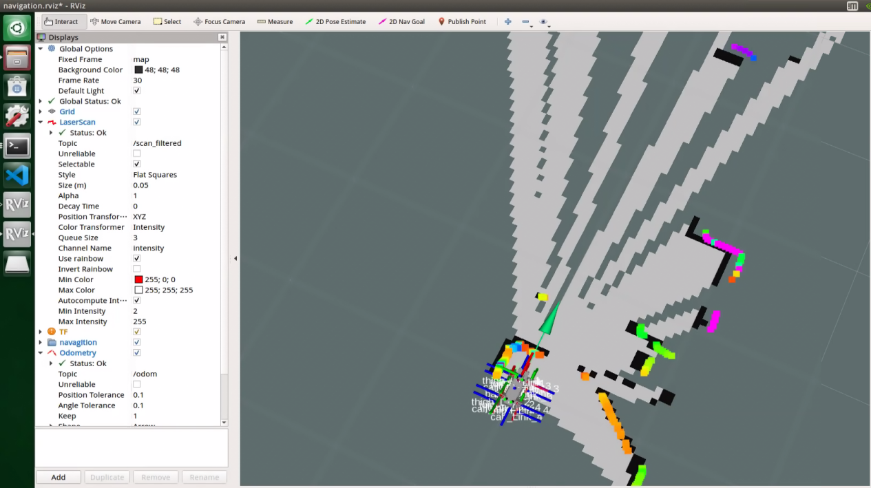

(5) Open a new command-line terminal, then run the command below to start the RVIZ to view the mapping simulation.
roslaunch pug_slam rviz_slam.launch

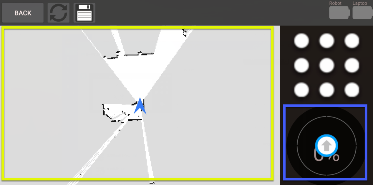

Control the robot to move around to map using the wireless handle.
| Button | Function |
| START | Reset robot's pose |
| L1 | Look up |
| L2 | Look down |
| R1 | Tilt forward |
| R2 | Tilt backward |
| ↑/ Move left slider forward | Go forward |
| ↓/ Move left slider downward | Go backward |
| ← / Move left slider to left | Turn left |
| → / Move left slider to right | Turn right |
| △ / Move right slider upward | Elevate the robot |
| × / Move right slider downward | Lower the robot |
| ◻ / Move right slider to left | Speed down (used with the button "↑","↓") |
| ○ / Move right slider to right | Speed up (used with the button "↑","↓") |

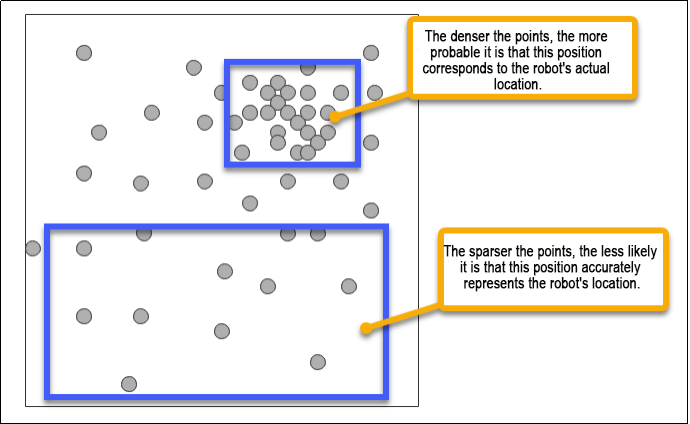

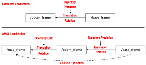

The AMCL operates on the principle of utilizing the particle filtering method to approximate the posterior distribution (confidence) of the robot within a known map. This is achieved by employing a set of randomly sampled states (particles), each representing a potential robot pose (position and orientation). These particles are assigned weights based on how effectively the sensor data (e.g., laser scans) aligns with the map.
Through the resampling process, particles are extracted from the original set with replacement, proportionate to their weights. This eliminates low-weighted particles while bolstering high-weighted ones.
With multiple iterations, the particle set gradually converges towards the actual robot posture, a phenomenon known as particle convergence. Adaptation occurs through dynamically adjusting the number of particles using the KLD sampling method to match the state space complexity.
When particle distribution is widely dispersed, increasing particle count enhances exploration capabilities. Conversely, when distribution is concentrated, reducing particle count conserves computing resources. This adaptive approach effectively addresses challenges like robot kidnapping and fixed particle number constraints.

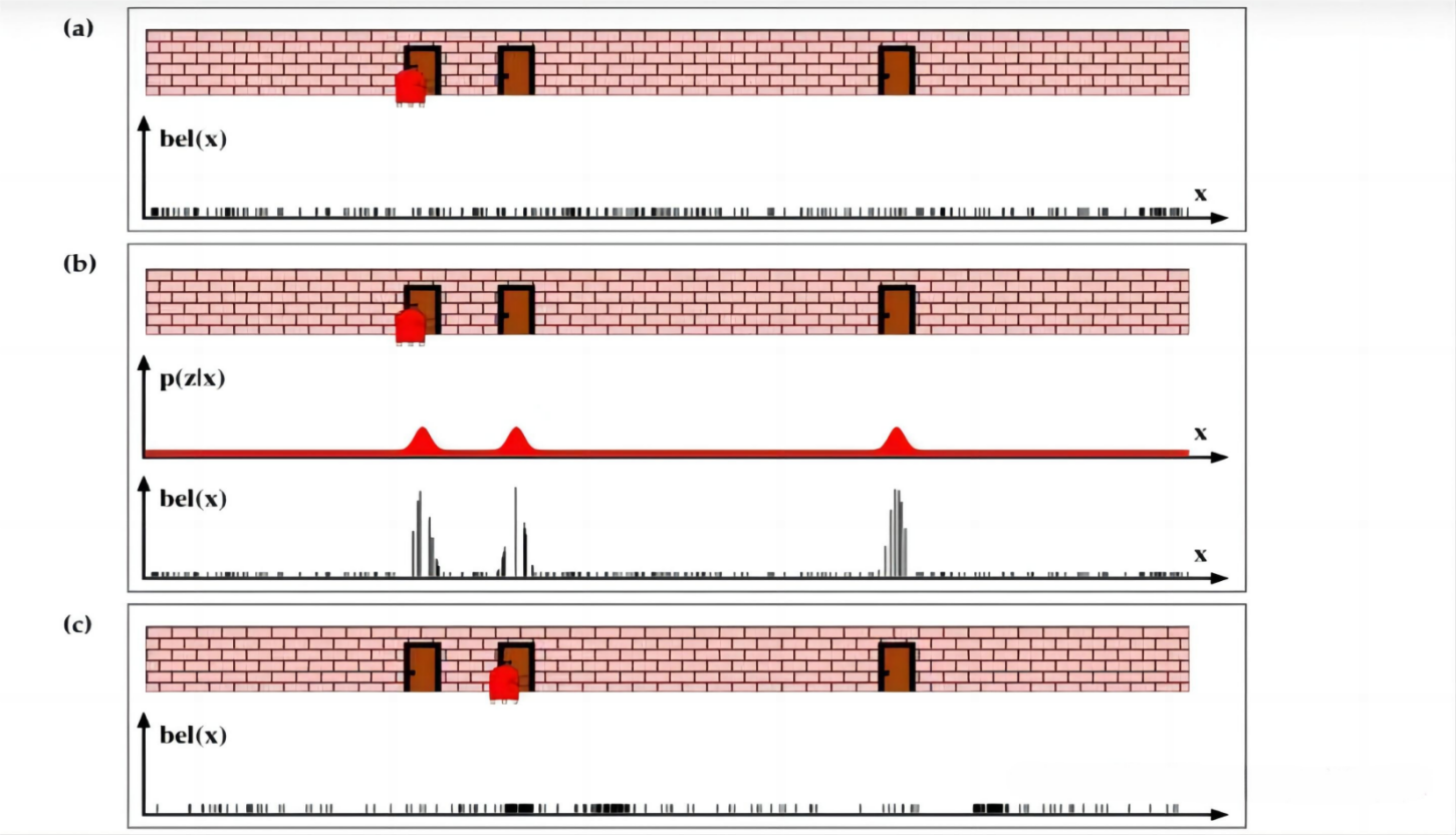

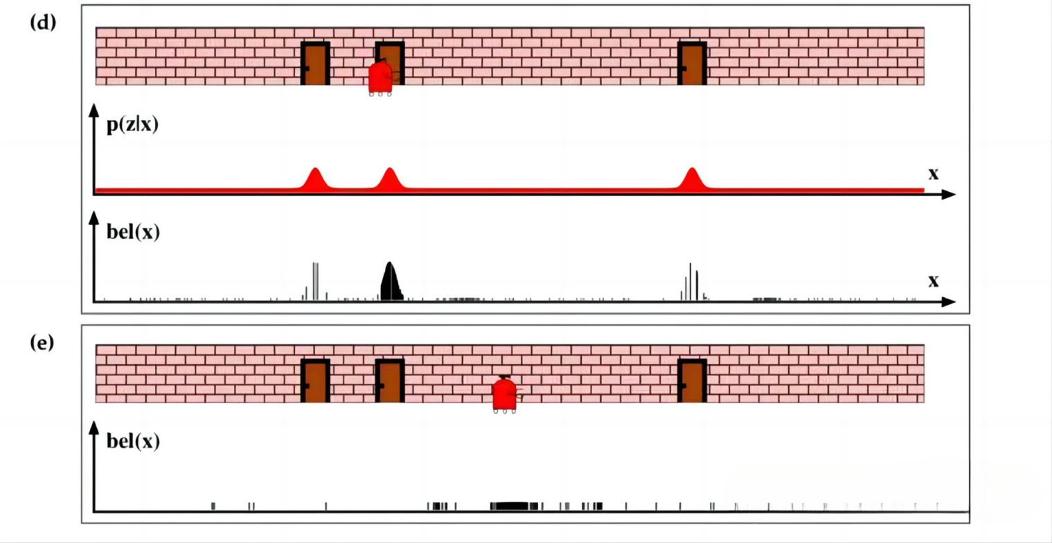

9.3.4 Description of a Simple MCL (Monte Carlo Localization) Example:
(1) Picture a: Initially, the robot is positioned near a door, but its precise location is unknown. We initialize all particles with equal weights.
(2) Picture b: As the robot senses the presence of a door ahead, particles closer to the door exhibit increased weights.
(3) Picture c: After resampling and the robot’s movement, particles converge around the original points near the door, depicted as densely black areas in the image.
(4) Picture d: With renewed perception, the robot confirms the presence of the door ahead, further amplifying the weights of particles near the door. Notably, main sampling points shift towards the second door, leading the robot to ascertain its position relative to it.
(5) Picture e: Following another round of resampling and robot movement, it becomes evident that the robot’s current position lies centrally. Reviewing the example picture provides a tangible sense of particle filtering’s role in localization.

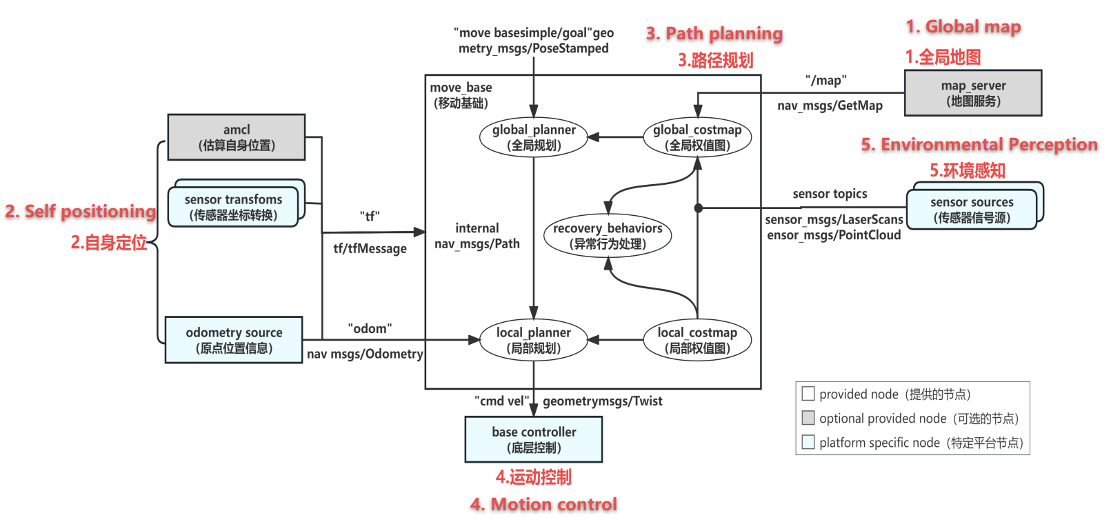

9.4.2 Key Technologies for Navigation Implementation
The autonomous navigation principle of ROS robots involves utilizing a suite of function packages and algorithms within ROS to achieve robot positioning, map construction, path planning, and motion control in both known and unknown environments. The ROS navigation module primarily comprises the following components:
(1) Global map: Provides an overarching view of the robot’s environment. It can utilize SLAM algorithms (e.g., gmapping) to generate a two-dimensional raster map based on odometry and lidar data. Additionally, it can be saved and retrieved using the map_server function package. For insights into SLAM principles, refer to 9.1 SLAM Mapping Working Principle in the same folder.
(2) Self-positioning: Determines the robot’s position on the map through algorithms. Typically, two algorithms are employed for this purpose: one calculates the current position relative to the origin using odometry, while the other utilizes radar sensors to compare surrounding environment data with map feature points to ascertain the robot’s position.
(3) Path planning: Facilitates both overall and local path planning based on predefined target points and the global map. Global path planning (e.g., global_planner) employs Dijkstra or A* algorithms to compute the optimal route. Local path planning (e.g., local_planner) utilizes dynamic window techniques to navigate around obstacles and select the most favorable path while adhering to the global plan.
(4) Motion control: Governs the robot’s speed and direction to adhere to the planned path. The navigation function package can publish messages of type geometry_msgs/Twist via the “cmd_vel” topic. These messages, based on the robot’s base coordinate system, transmit motion commands. Therefore, a node subscribing to the “cmd_vel” topic is required to convert speed commands into motor commands and transmit them accordingly.
(5) Environment perception: Enables the perception of surrounding environmental data using sensors such as lidar, cameras, encoders, etc. This data is utilized for map building, localization, cost_map updates, etc. The cost_map, a raster map, contains information on static and dynamic obstacles, delineating passable and impassable areas.

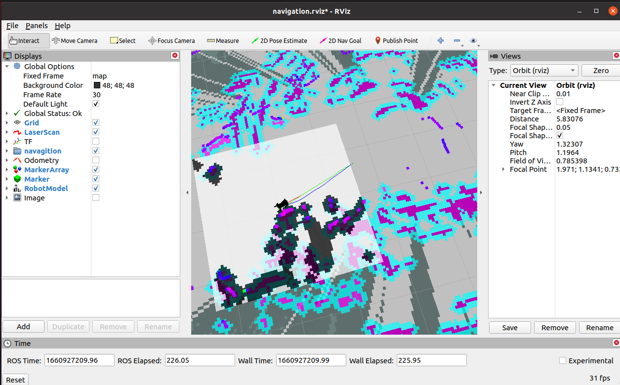

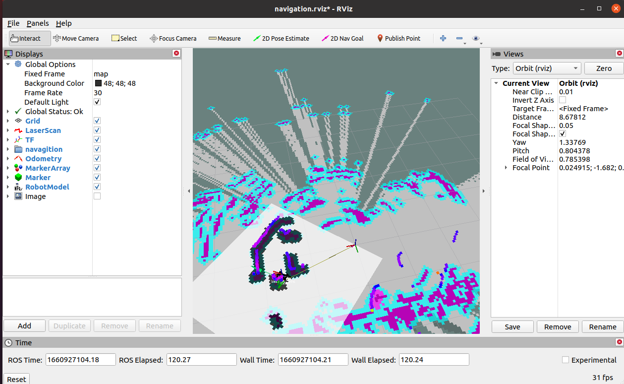

(4) Open a new command-line terminal, and run the command below to enable the navigation service. If there is no error reported, it means that the navigation service is enabled successfully.
roslaunch pug_navigation navigation.launch map:=map_01

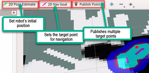

(5) Open a new command-line terminal and enter the command below to launch the RViz model for viewing the navigation simulation.
roslaunch pug_navigation rviz_navigation.launch
9.6.2 Start Navigation
The functions of the tools are as follows:
(1) 2D pose estimation: Sets the initial position of the robot dog.
(2) 2D Nav Goal: Sets the target point for navigation.
(3) Publish point: Publishes multiple target points. The robot dog will automatically plan a path to reach each target point while avoiding obstacles.
If you need to terminate the navigation, click on ‘2D Nav Goal’. If the robot dog’s position is changed due to external force, you need to reset the robot dog’s position.
After setting the target points, two paths will be generated. The red line represents the direct distance between the robot dog and the target, while the green line depicts the path planned by the robot dog.

9.7.2 Mapping
App Mapping
(1) Start the robot dog, and access the robot system desktop using NoMachine.
(2) Start SLAM mapping. To access the detailed instructions, please refer to the file saved in 9.2 Gmapping Mapping.
(3) Run the following command to initiate the app mapping service.
roslaunch pug_slam gmapping.launch

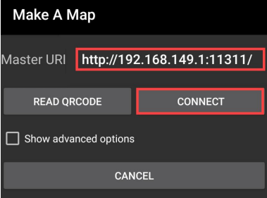

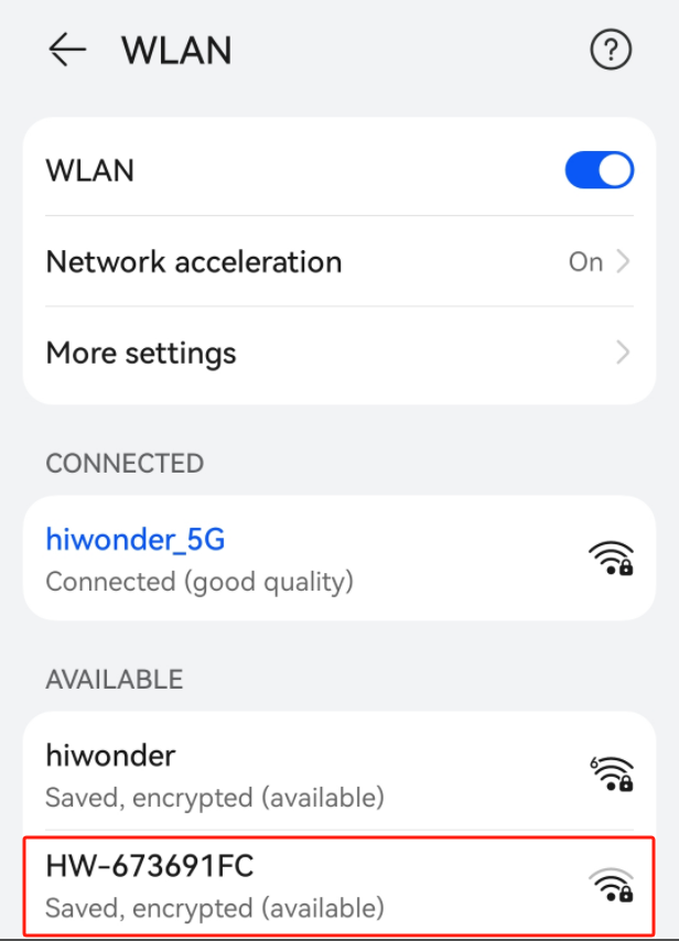

(4) Connect to the WiFi generated by the robot dog starting with HW.

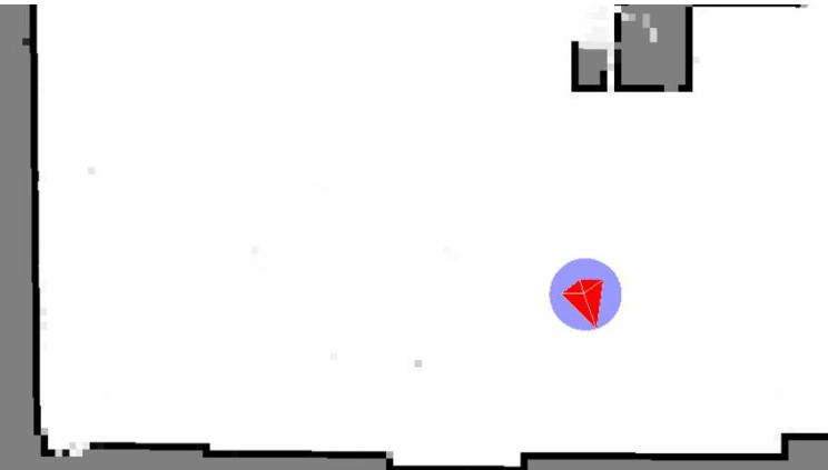

(5) Open the “Make A Map” app, and change the “Master URI” field to http://192.168.149.1:11311, then click on “CONNECT” button.
The app interface is divided into two zones. The map is displayed on the yellow frame, and the blue frame section is for controlling the robot.
Save the Map
(1) Open a new command line terminal window, enter the following command, and press Enter to navigate to the folder where maps are stored:
roscd pug_slam/maps
(2) Run the command below to save the map.
rosrun map_server map_saver -f map_01
map_01 in the command is the map name, which can be renamed according to your needs. If the following message appears, the map has been saved successfully.

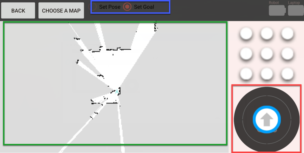

9.7.3 Navigation
APP Navigation
(2) Enter the following command to initiate the navigation service. If there is no error reported, it means that the navigation service is enabled successfully.

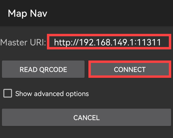

(3) Connect your phone to the WiFi starting with HW. The initial password is hiwonder.
(4) Open “Map Nav” app, and input http://192.168.149.1:11311 in “Master URI” bar, then click “CONNECT”.
The icon ‘CHOOSE A MAP’ serves no practical purpose. Map will be loaded automatically.
The “Map Nav” interface is divided into three sections. The green box displays the map; the red box controls the robot dog’s movement; and the options ‘Set Pose’ and ‘Set Goal’ in the blue box, used together with the green box, are for setting the robot dog’s initial position and navigation target.
(1) Select “Set Pose”, then press one point on the map to set it as the initial position of robot.
(2) Drag arrow in red section to control ROSPug to move so as to calibrate the position.
(3) Select “Set Goal”, then press one point on the map to set it as the destination.
(4) After initial position and destination are set, the path between these two points is generated automatically. Then robot will move from the initial position to the set destination.
