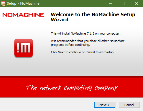

(1) Open the software pack nomachine_7.1.3_1.exe in the same folder.
(2) Click “Next” button.

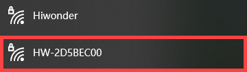

(1) ROSPug is default to AP direct connection mode. After it boots up successfully, it will create a WiFi starting with ‘HW’. Connect your computer to this WiFi.Password: hiwonder

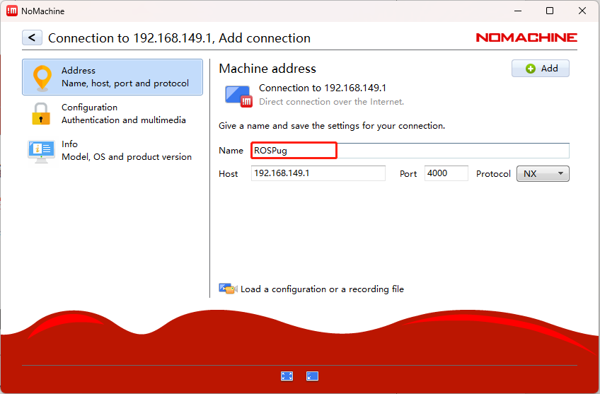

(2) Open NoMachine. Input “192.168.149.1” in the search bar, then click-on “Configure connection to new host 192.168.149.1”.
(3) Rename it to ‘ROSPug’ and leave the remaining settings unchanged. Then, click ‘Connect’.

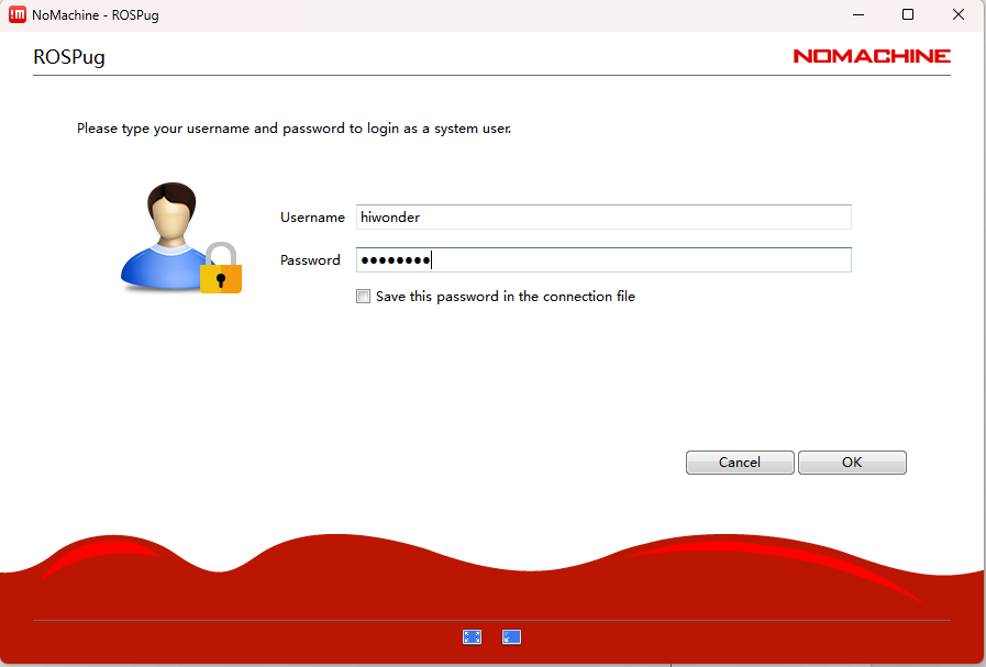

(4) Use the username “hiwonder” and password “hiwonder” to log in. Remember to select “Save this password in the connection file” before clicking the “Login” button to access the Jetson Nano desktop.

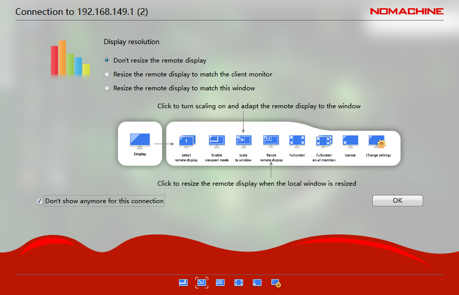

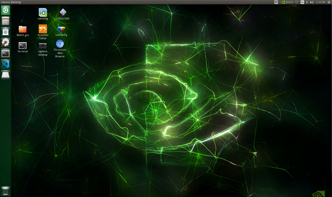

3.3 Method To Fix Abnormal Resolution
When using the remote tool NoMachine to connect to the ROSPug, if you experience abnormal screen resolution (as shown in the figure below), you can address this issue by following the methods outlined in 3.3.1 or 3.3.2 (beginners are advised to use the approach detailed in 3.3.1).

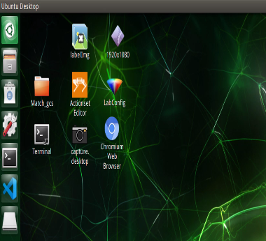

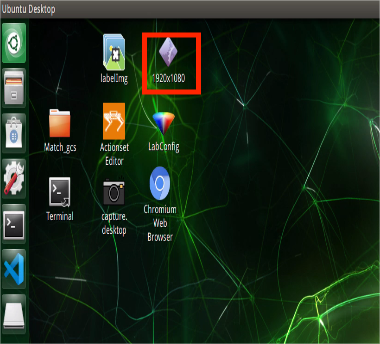

3.3.1 Change Resolution On The Desktop
(1) Double-click “1920*1080” icon to change the resolution.
(2) After revision, you can directly close the window.
(3) Lastly, restart NoMachine.
