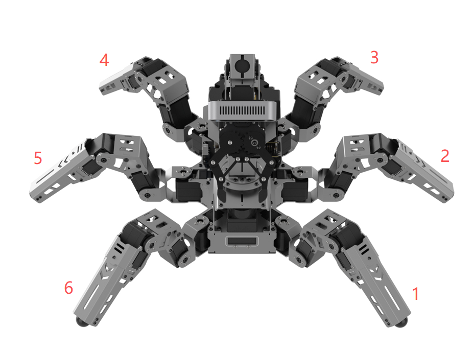

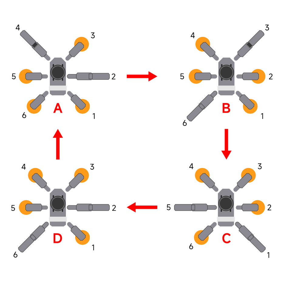

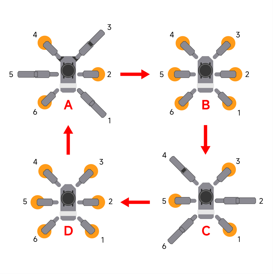

The following uses the diagrams below to analyze and explain the tripod gait:
As shown in Figure A, legs 1, 3, and 5 of the hexapod robot are lifted and swing forward, while legs 2, 4, and 6 are used to support the body, ensuring the center of gravity is located at the intersection of the diagonals. At this time, legs 1, 3, and 5 are in the swing phase, and legs 2, 4, and 6 are in the stance phase.
As shown in Figure B, all six legs touch the ground simultaneously. The positions of legs 2, 4, and 6 remain unchanged, legs 1, 3, and 5 move forward, and all legs are in the stance phase.
As shown in Figure C, legs 2, 4, and 6 are lifted and swing forward, while legs 1, 3, and 5 are used to support the body, ensuring the center of gravity is located at the intersection of the diagonals. At this time, legs 2, 4, and 6 are in the swing phase, and legs 1, 3, and 5 are in the stance phase.
As shown in Figure D, all six legs touch the ground simultaneously. The positions of legs 1, 3, and 5 remain unchanged, legs 2, 4, and 6 move forward, and all legs are in the stance phase.
When these four sets of actions in Figure A, B, C, and D are completed, the hexapod robot completes one full cycle of motion.

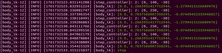

2.1.3 Program Outcome
After the operation is initiated, the hexapod robot will advance for 5 seconds under the tripod gait, with the three pairs of legs divided into two groups alternating forward, and then come to a stop.

When the hexapod robot is in the ripple gait, each pair of opposing legs operates alternately. The following uses the diagrams above to analyze and explain the ripple gait:
As shown in Figure A, legs 2 and 4 of the hexapod robot are lifted and swing forward, while legs 1, 3, 5, and 6 are used to support the body, ensuring the center of gravity is located at the intersection of the diagonals. At this time, legs 2 and 4 are in the swing phase, and legs 1, 3, 5, and 6 are in the stance phase.
As shown in Figure B, legs 3 and 6 of the hexapod robot are lifted and swing forward, while legs 1, 2, 4, and 5 are used to support the body, ensuring the center of gravity is located at the intersection of the diagonals. At this time, legs 3 and 6 are in the swing phase, and legs 1, 2, 4, and 5 are in the stance phase.
As shown in Figure C, legs 1 and 5 of the hexapod robot are lifted and swing forward, while legs 2, 3, 4, and 6 are used to support the body, ensuring the center of gravity is located at the intersection of the diagonals. At this time, legs 1 and 5 are in the swing phase, and legs 2, 3, 4, and 6 are in the stance phase.
As shown in Figure D, legs 2 and 6 of the hexapod robot are lifted and swing forward, while legs 1, 3, 4, and 5 are used to support the body, ensuring the center of gravity is located at the intersection of the diagonals. At this time, legs 2 and 6 are in the swing phase, and legs 1, 3, 4, and 5 are in the stance phase.

    node.move(gait=1, direction=math.radians(node.direction))
    node.get_logger().info('\033[1;32m%s\033[0m' % f'Movement angle {node.direction} degrees')
    time.sleep(5)  # Wait for 5 seconds
    node.move(gait=0) # Stop
    node.get_logger().info('\033[1;32m%s\033[0m' % 'stop')

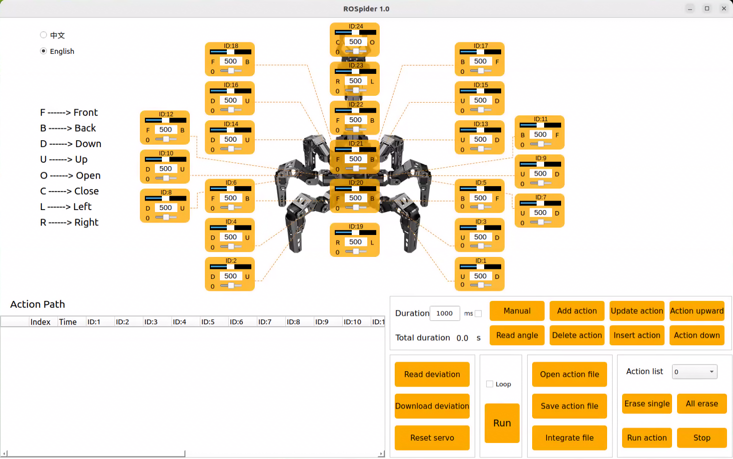

2.11.2 PC Software Interface Layout

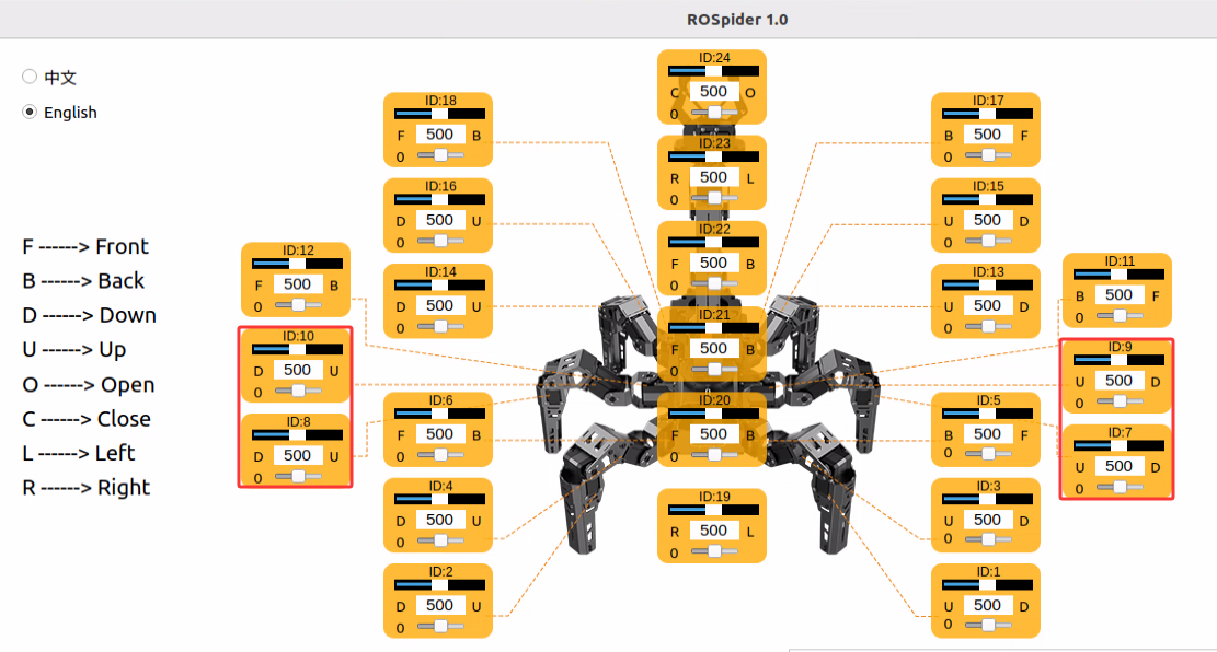

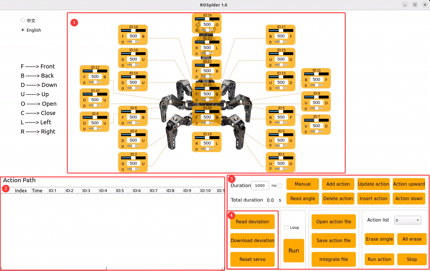

The interface of the PC software is shown in the figure below, consisting of four areas: ① Servo control area, ② Action details list, ③ Action group setting area, and ④ Deviation setting area:
The functions of each area are introduced below.

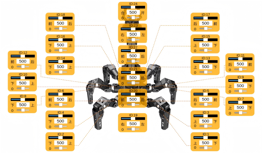

2.11.3 Servo Control Area
The servo control area displays the selected servo icon. By adjusting the corresponding slider value, the rotation position of the servo can be adjusted, thereby adjusting the posture of ROSpider.
Icon Function Description
Servo ID number.
Used to adjust the angle position of the servo, with a value range from 0 to 1000.
Used to adjust the servo deviation, with a value range from -125 to 125. To prevent accidental operation, the deviation adjustment slider can only be dragged after clicking the "Read Deviation" button.

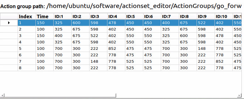

2.11.4 Action Details List
The action details list displays the current action number, execution time, and the position information of each servo within it.
Action number.
The time required to execute the action, in ms.
The rotation position of the corresponding ID servo, which can be modified by double-clicking the value below .
Run the currently selected action.

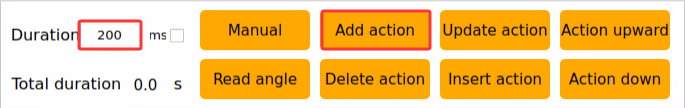

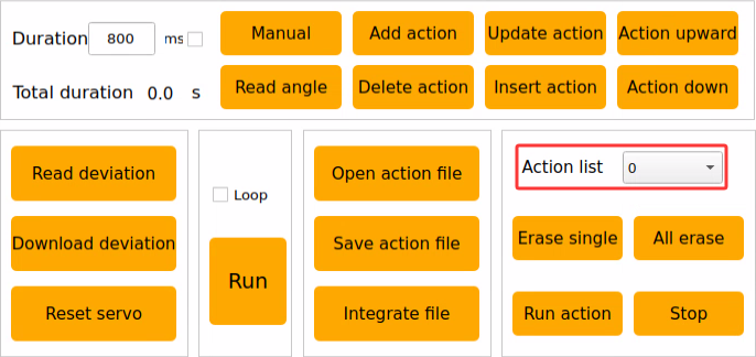

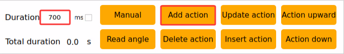

2.11.5 Action Group Setting Area
The action group setting area allows operations such as adding, deleting, updating, inserting, running, opening, and connecting actions.
The time required to run a single action, which can be modified by clicking . Checking the small box after "ms" can lock the time value.
The total time required to run the complete action group.
Clicking this powers off the robot's servos, making the joints loose. At this time, the robot can be manually adjusted to design actions. If it cannot be adjusted, do not force it, just click again.
Read the position information of the manually adjusted servos. Needs to be used in conjunction with the "Manual Programming" button.
Integrate the current servo values in the servo control area into one action and add it to the last row of the action details list.
Delete the selected action in the action details list.
Replace the selected values in the action details list. Servo values are replaced with the current servo values in the servo control area, and the action running time is replaced with the time set in "Duration".
Insert a row of action above the selected action. The time of the action is the time in "Duration (ms)", and the angle value is the servo value in the servo control area.
Move the selected action up one row.
Move the selected action down one row.

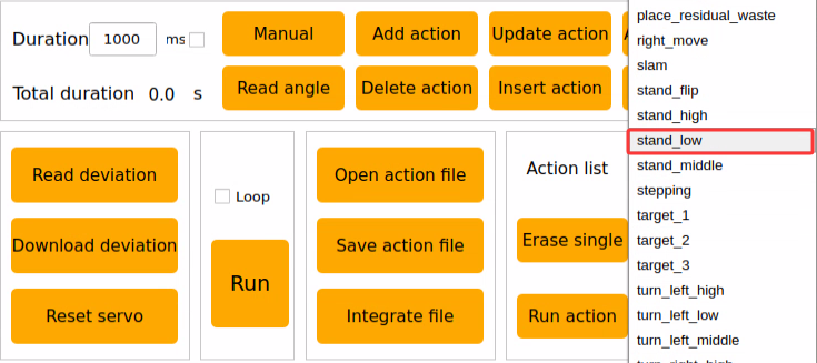

Clicking this button will run the actions in the action details list once. If "Loop" is checked, the robot will repeatedly run the actions.
Click to select the action group to be opened to load the action group data into the action details list.
Save the actions currently in the action details list to a specified location.
After opening an action group, click the connect action file button to continue opening another action group file, which can connect the two action group files into a new action group.
Saved action groups can be displayed in the PC software.
Delete the action group file in the current action group selection bar.
Caution: This action cannot be undone. Delete all action groups in the action group selection bar.
Execute the action group in the action group option box once.
Stop the currently running action group.
Action group files are uniformly saved to the path /home/ubuntu/software/actionset_editor/ActionGroups.

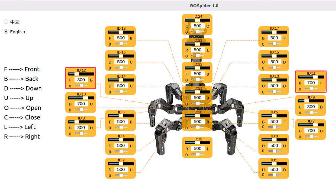

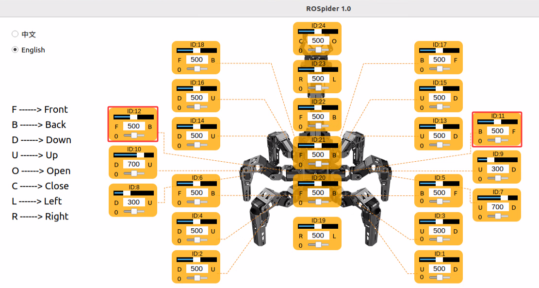

## 2.12 Action Editing Instruction
This lesson will edit an action group to make ROSpider **clap**. This action group contains 15 independent actions.
### 2.12.1 Action Editing
1. Power on the robot and connect it to the remote control software VNC. Refer to the contents in the **[1. ROSpider User Manual\1.4 Development Environment Setup](https://wiki.hiwonder.com/projects/ROSpider/en/raspberry-pi-version/docs/1_ROSpider_User_Manual.html#development-environment-setup)** directory for remote connection.
2. Double-click the icon <img src="../_static/media/chapter_2/section_1/image18.png" style="width:80px;"/> on the system desktop to open the PC software.

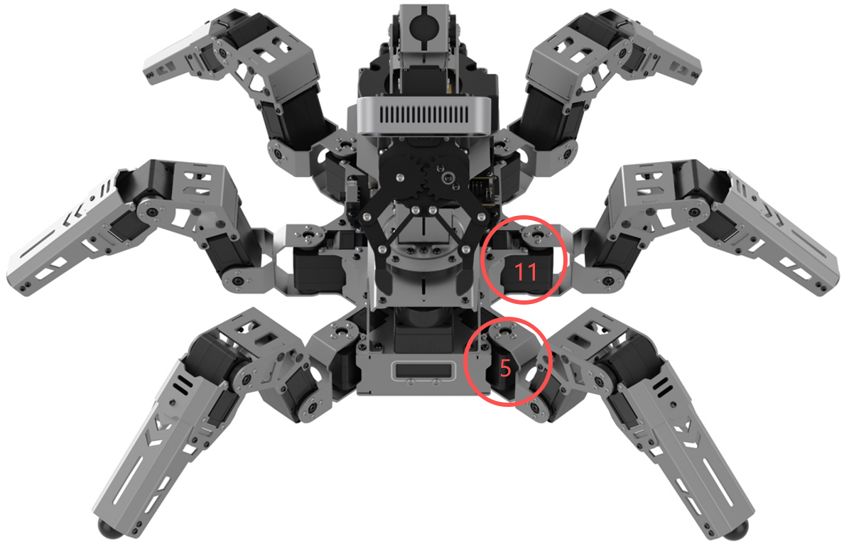

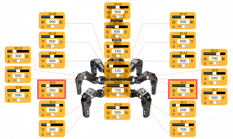

3. To facilitate subsequent explanations, the legs of ROSpider are sorted as shown in the figure below:
<img src="../_static/media/chapter_2/section_1/image54.png" class="common_img" style="width:600px;"/>

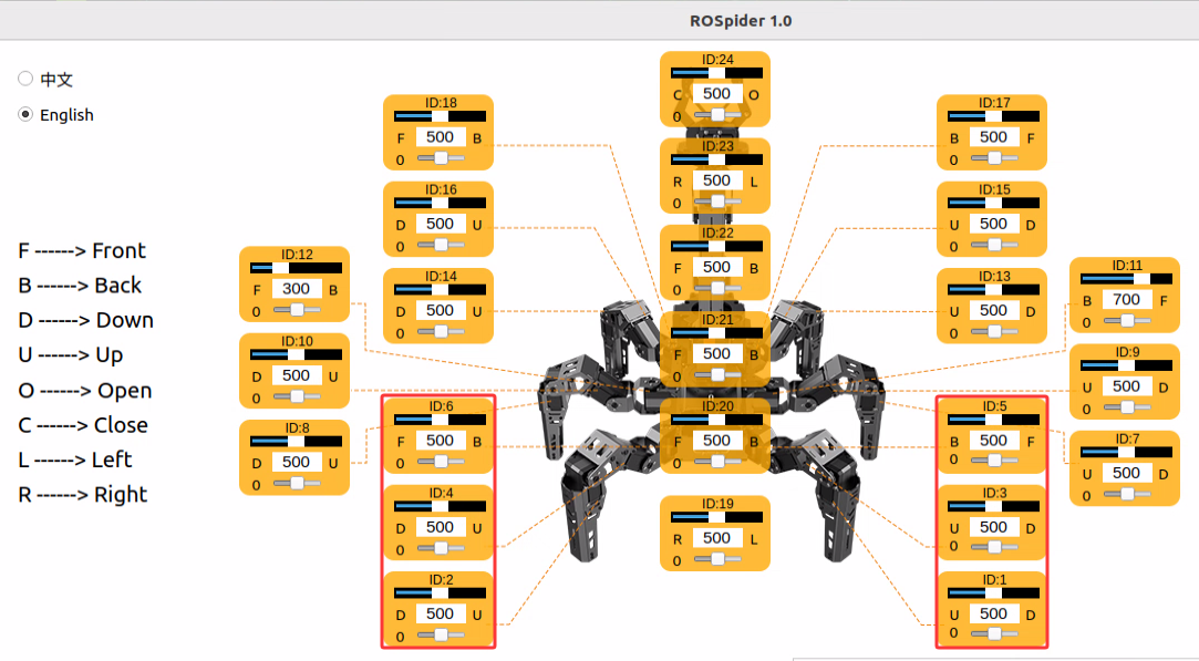

4. Action 1: Click the **Reset servo** button in the deviation adjustment area to restore the robot to its initial posture.
<img src="../_static/media/chapter_2/section_1/image55.png" class="common_img" style="width:500px;"/>

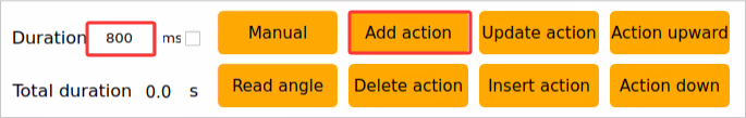

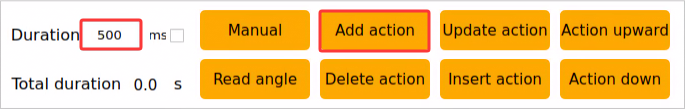

5. Change the action time to 500ms and click the **Add action** button in the action editing area to add the initial action to the action list.
<img src="../_static/media/chapter_2/section_1/image56.png" class="common_img" style="width:500px;"/>
The specific parameters of the action can be viewed in the action list area.
<img src="../_static/media/chapter_2/section_1/image57.png" class="common_img" style="width:600px;"/>
```{note}
**Every subsequent edited action needs to be added to the action list.**

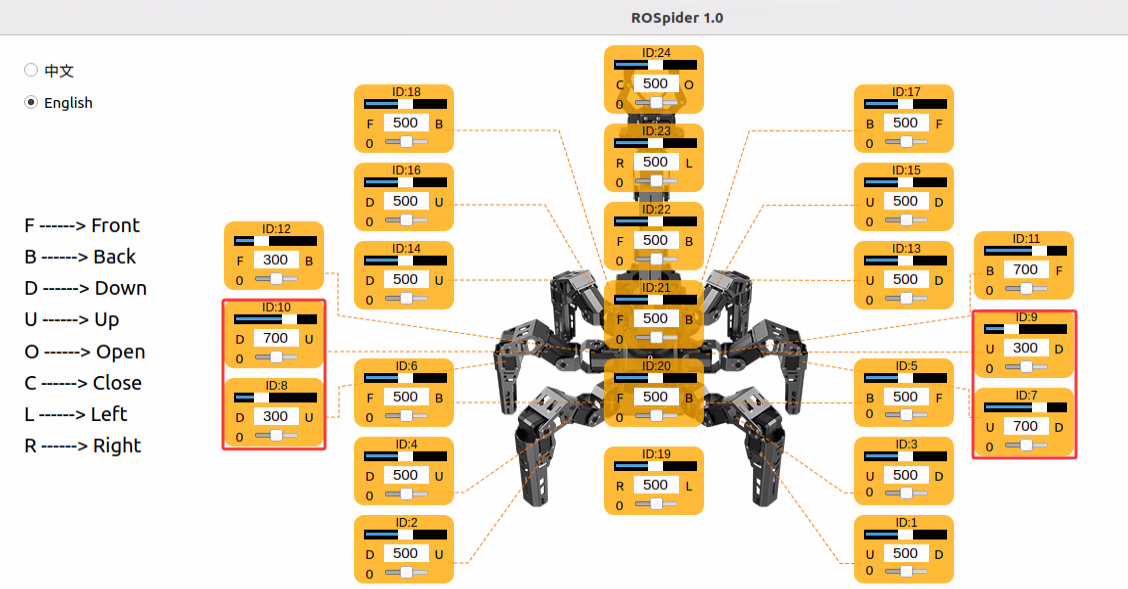

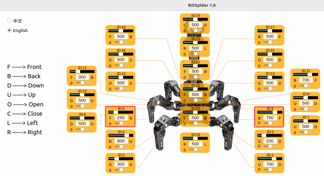

  1. Drag the slider to adjust the parameter of servo No. 8 to 300.
  1. Action 2: Refer to the figure below to modify other servo parameters to make ROSpider lift legs No. 2 and No. 5, and add the action to the action list.

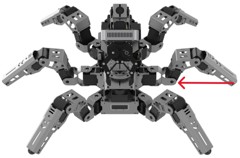

  1. Action 3: Make legs No. 2 and No. 5 of ROSpider swing forward.
  1. Action 4: Make legs No. 2 and No. 5 of ROSpider touch the ground.
  1. Action 5: Repeat Action 4 to make the action transition smoother and more fluent. Change the time to 200ms, and click the Add action button to add this action to the action list.
  1. Action 6: Make legs No. 1 and No. 6 of ROSpider lift to the chest. Change the time to 700ms, and click the Add action button to add this action to the action list.
  1. Action 7: Make legs No. 1 and No. 6 of ROSpider close slightly to clap. Change the time to 400ms, and click the Add action button to add this action to the action list.
  1. Action 8: Separate legs No. 1 and No. 6 of ROSpider.
  1. Action 9: Make legs No. 1 and No. 6 of ROSpider close slightly again to clap.
  1. Action 10: Separate legs No. 1 and No. 6 of ROSpider.
  1. Action 11: Repeat Action 10 to make the action transition smoother and more fluent. Change the time to 200ms, and click the Add action button to add this action to the action list.
  1. Action 12: Reset legs No. 1 and No. 6 of ROSpider, meaning the respective servos on legs No. 1 and No. 6 return to the center. Change the time to 500ms, and click the Add action button to add this action to the action list.
  1. Action 13: Lift legs No. 2 and No. 5 of ROSpider. Change the time to 600ms, and click the Add action button to add this action to the action list.
  1. Action 14: Make legs No. 2 and No. 5 of ROSpider swing backward. Change the time to 500ms, and click the Add action button to add this action to the action list.
  1. Action 15: Click the Reset servo button to restore the hexapod robot to its initial posture, and click the Add action button to add this action to the action list.

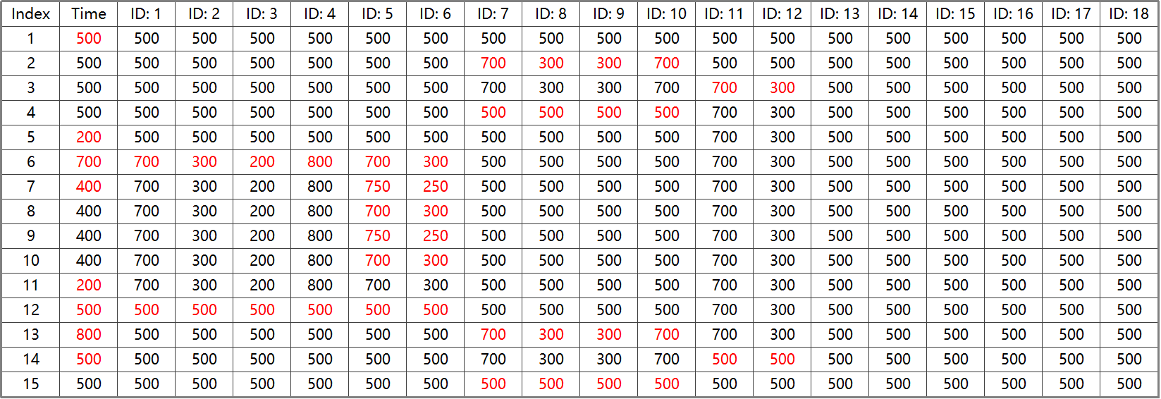

All numerical parameters of this action group are shown in the table below:
The red values are the time parameters or servo parameters that need to be adjusted in each step.

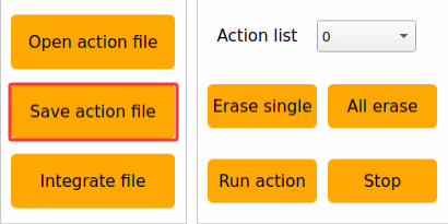

2.12.2 Action Saving

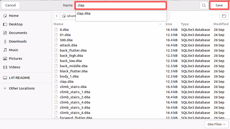

  1. To facilitate later debugging and management, click the Save Action File button to save the action group.
  1. Select the save path as /home/ubuntu/software/actionset_editor/ActionGroups, name the action group clap here, and then click Save to save.
2.12.3 Action Group Invocation
  1. Open the PC software and click Action list.
  1. Select the name of the action group to be invoked.
  1. After selection, click Run action.

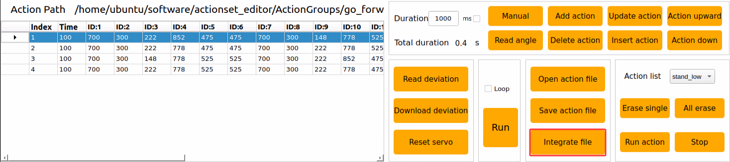

2.12.4 Integrating Action Groups

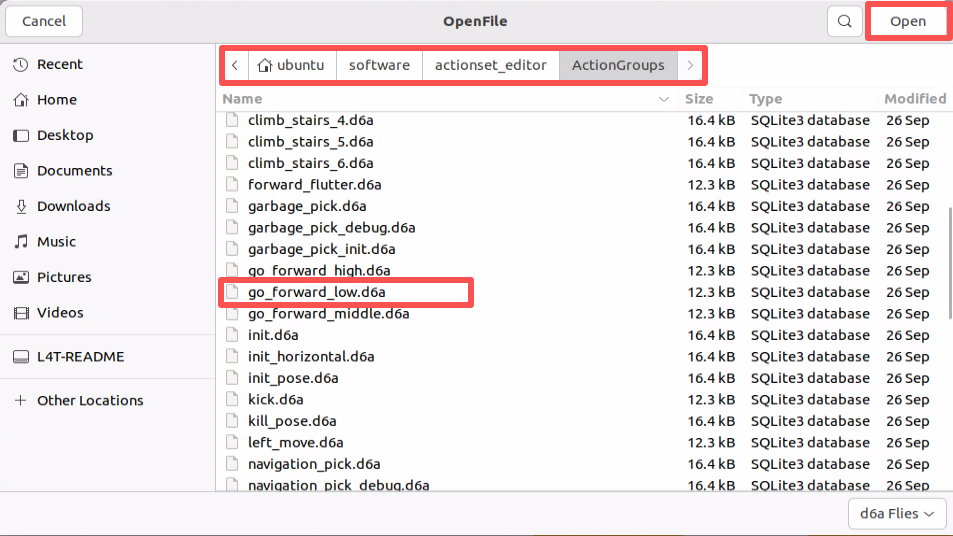

  1. After remotely connecting to the system, start the PC software.

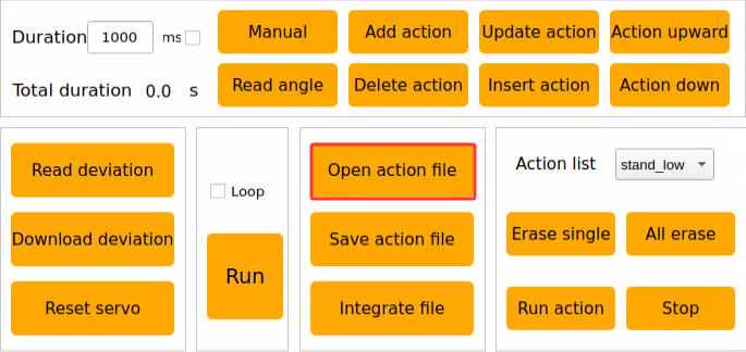

  1. Click the Open action file button in the action group setting area, navigate to the directory /home/ubuntu/software/actionset_editor/ActionGroups, select go_forward_high, and double-click to open.
  1. Click the Integrate file button in the action group setting area, navigate to the directory /home/ubuntu/software/actionset_editor/ActionGroups, select go_forward_low, and double-click to open.
  1. At this point, it can be seen that the integrated action group has been imported. Move the cursor to number 1, and then click Run action to run the new connected action group online once.
  1. Click the Save action file button to save the newly connected action group for later debugging.

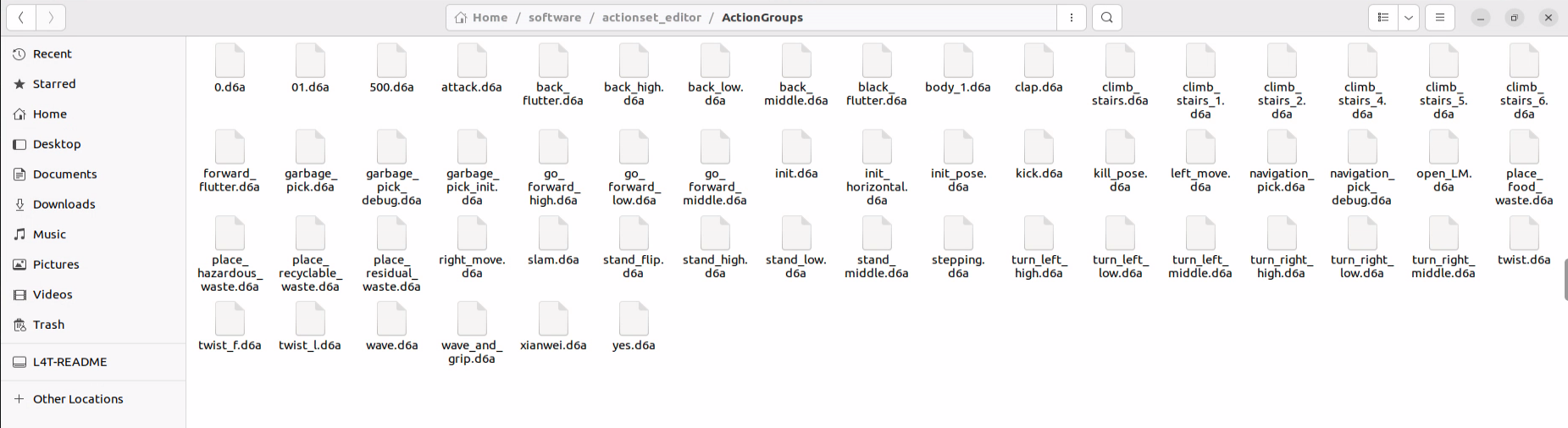

2.13.1 View Built-in Action Groups
  1. Power on the robot and connect it to the remote control software VNC. Refer to the contents in the 1. ROSpider User Manual\1.4 Development Environment Setup directory for remote connection.
  2. Click the icon in the system status bar to open the file manager.
  3. Navigate to the directory /home/ubuntu/software/actionset_editor/ActionGroups to view the names of all current action groups.

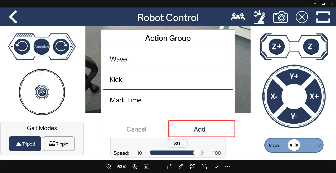

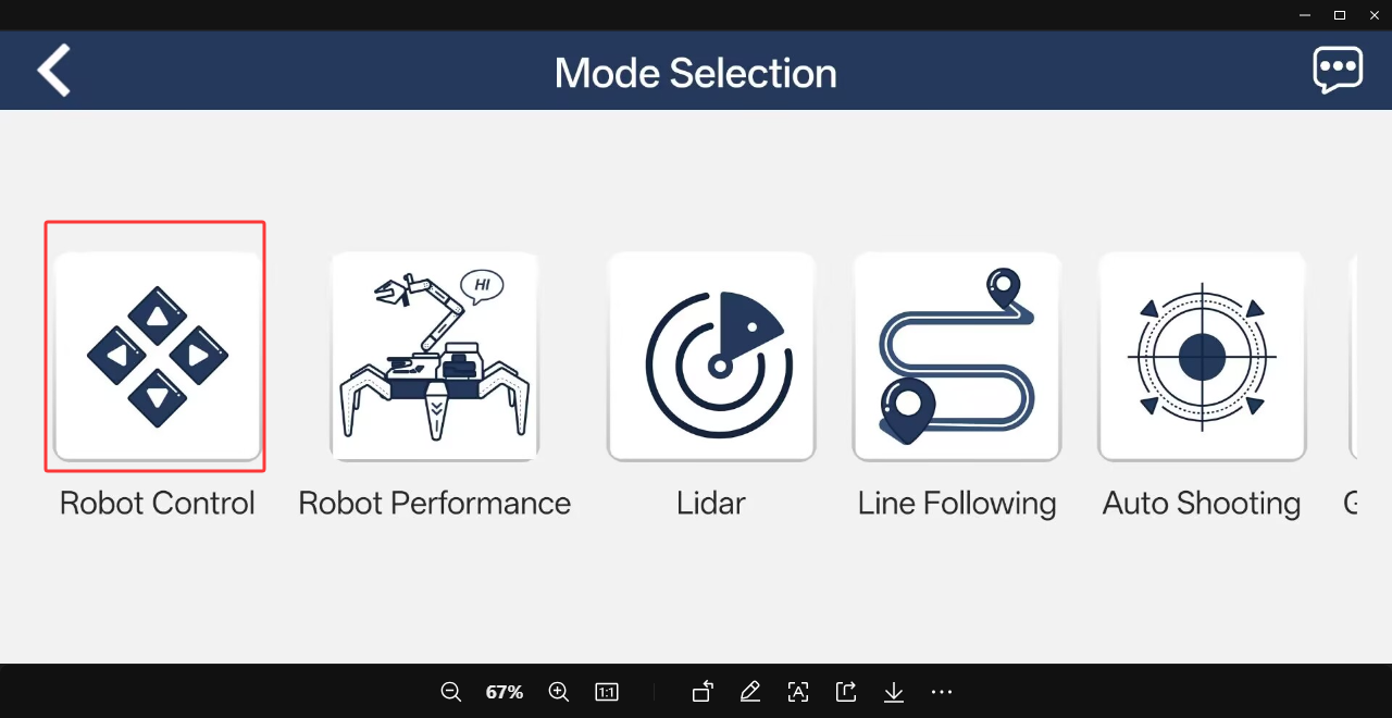

  1. Open the app WonderNex and connect to the ROSpider.
  2. Click Robot Control on the mode selection interface to enter the operation interface for this mode.

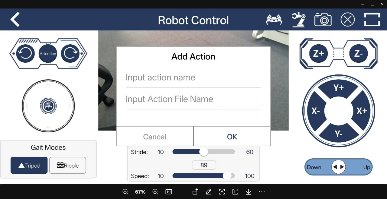

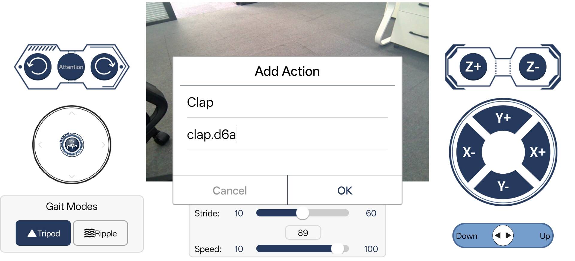

  1. Click the icon in the manual bar.
  1. Click the Add button to add a custom action.

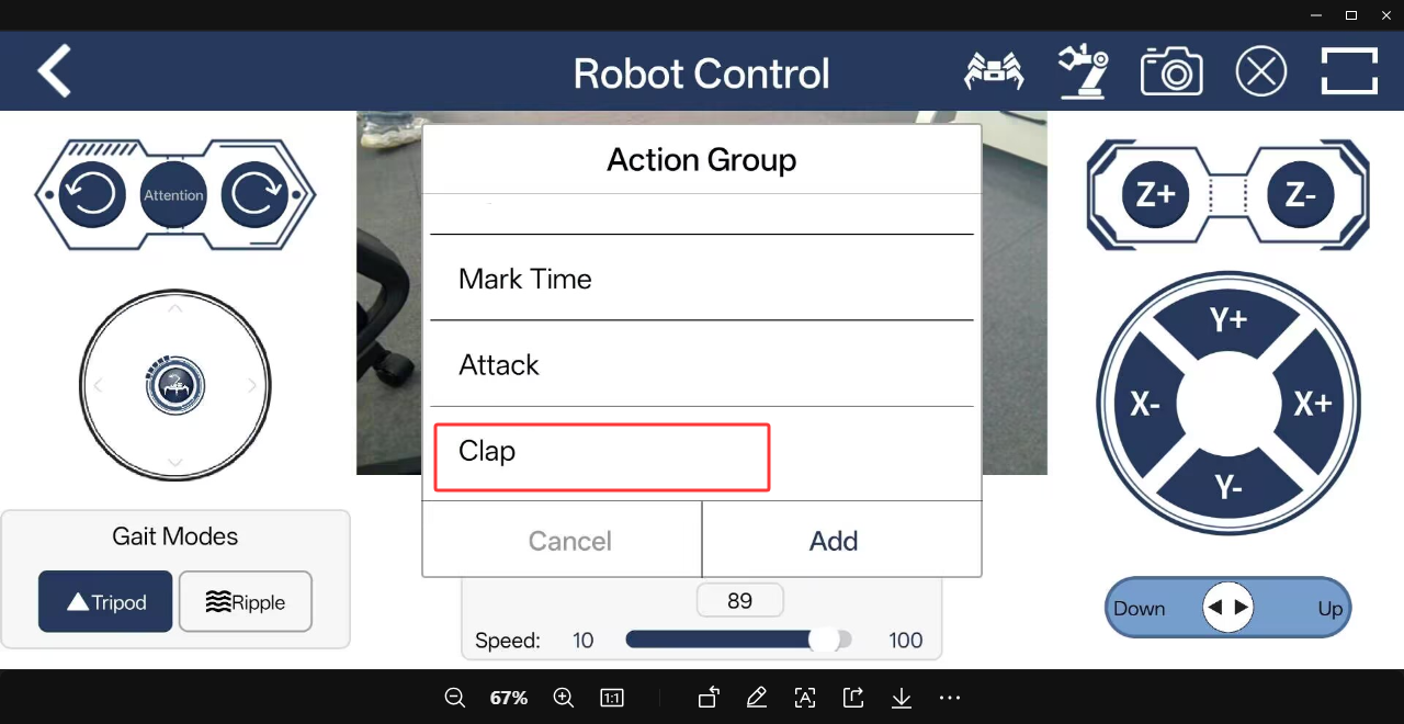

  1. Fill in the required action information. Fill in Clap in the Input action name field, and clap.d6a in the Input Action File Name field. After filling in, click the OK button to complete the addition of the custom action.
The “Input action name” field can be filled in freely, while the “Input Action File Name” field needs to be filled with the name of the robot’s built-in action group. To view the specific action group names, refer to 2.13.1 View Built-in Action Groups for instructions.
  1. Click the icon in the manual bar and select the Clap action. The robot will execute the corresponding action.

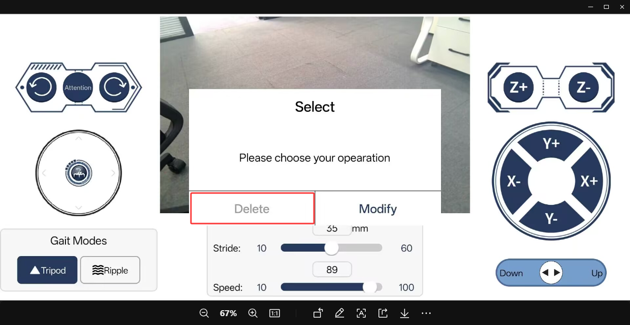

  1. To modify the action, long-press the Clap text and follow the pop-up prompt. Click the Edit button to modify the settings of the custom action. Click the Delete button to delete the selected custom action.

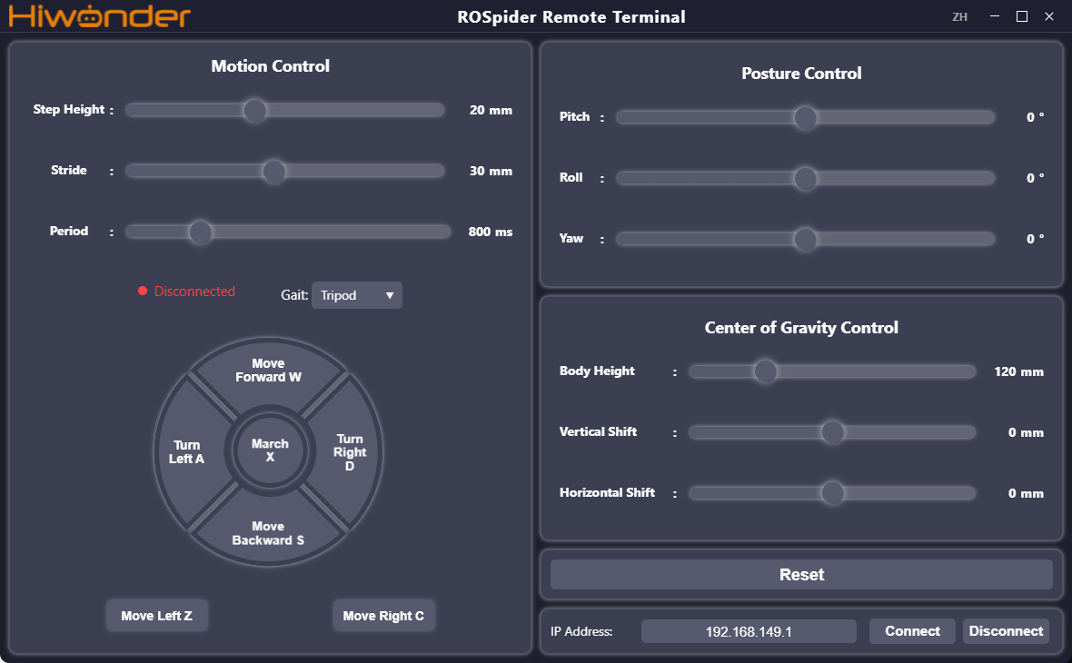

The installation package of the computer-side control software is located in the 2. Softwares directory. Double-click the installation package ROSpider Terminal Setup 1.0.0.exe to install it.
2.14.2 Host Computer Software Connection
  1. Power on the ROSpider.
  2. Open the computer network settings. Desktop computers need to prepare their own wireless network card. If the ROSpider is in direct connection mode, the computer needs to be connected to the robot’s hotspot. If it is in LAN mode, the computer needs to be connected to the same local area network.
  3. Double-click the desktop icon on the computer to open the PC software.

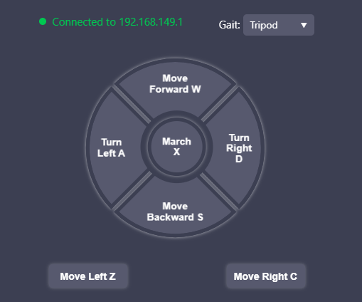

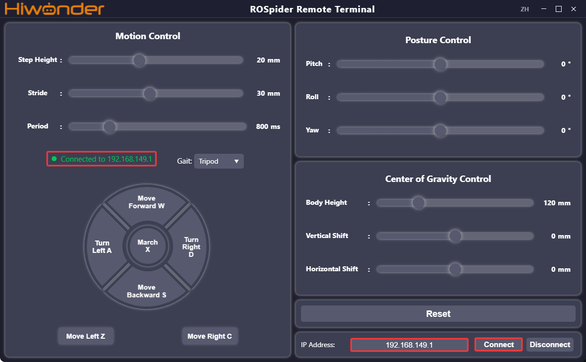

  1. After filling in the corresponding IP address, which is 192.168.149.1 in the direct connection mode, click the Connect button at the bottom right of the software interface. Wait a moment for the PC software to complete the connection.

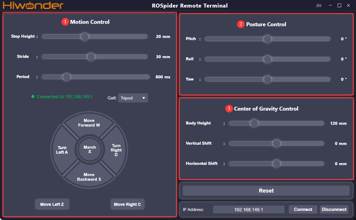

2.14.3 Interface Description
  • Movement Control Area
Set the moving step height of the ROSpider, which is the maximum distance the foot tip can be lifted, in mm.

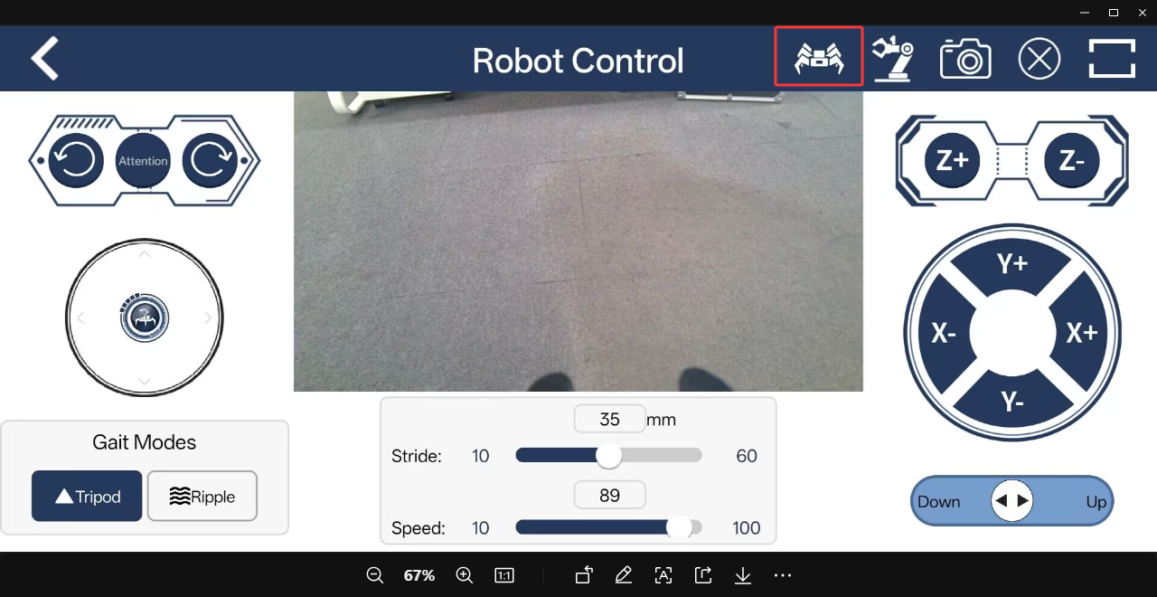

Set the moving stride length of the ROSpider, in mm.
Set the gait cycle of the ROSpider, which is the time required to complete a full gait, in ms.
Set the gait of the ROSpider, which can be selected as ripple gait or tripod gait. Clicking the movement button controls the robot to execute the corresponding action once, and long-pressing the button controls the robot to execute the corresponding action continuously.
  • Posture Control Area
Set the pitch angle of the ROSpider from the robot's first-person perspective, which is the angle of looking down or up. When the value is positive, the robot looks up, and when negative, the robot looks down. The larger the absolute value, the larger the angle of looking up or down.
Set the roll angle of the ROSpider from the robot's first-person perspective, which is the tilt angle of the body to the left or right. When the value is negative, the robot tilts to the right, and when positive, the robot tilts to the left. The larger the absolute value, the larger the tilt angle.
Set the yaw angle of the ROSpider from the robot's first-person perspective, which is the twisting amplitude of the body. When set to a positive value, left twisting is positive, and when set to a negative value, right twisting is positive. The larger the value, the larger the twisting amplitude.
  • Center of Gravity Adjustment Area
Set the body height of the ROSpider, in mm.
Set the longitudinal center of gravity offset of the body. When the value is positive, the center of gravity shifts forward, and when negative, the center of gravity shifts backward.
Set the lateral center of gravity offset of the body. When the value is positive, the center of gravity shifts to the left, and when negative, the center of gravity shifts to the right.

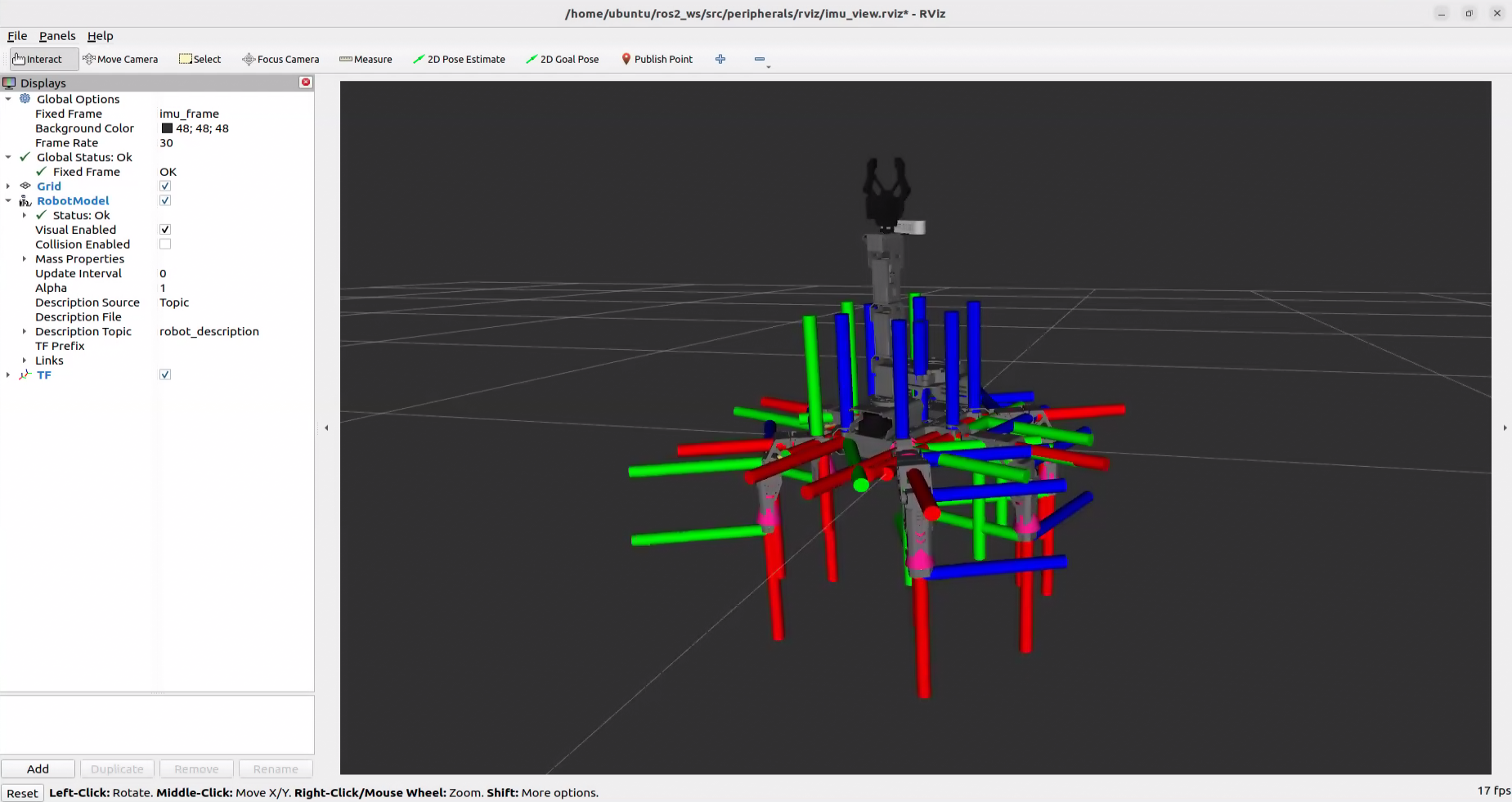

2.15 IMU Calibration
Calibration is only to reduce deviation. Actual hardware deviation will definitely exist, so during calibration, it only needs to be adjusted to be relatively accurate to meet specific requirements.

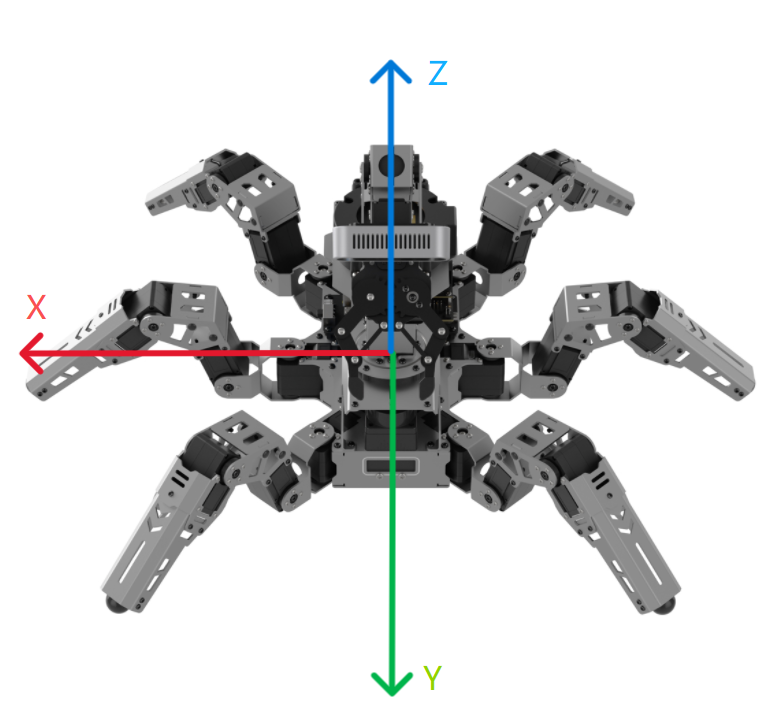

The IMU (Inertial Measurement Unit) is a device that measures the three-axis attitude angle or angular rate and acceleration of an object. Gyroscopes and accelerometers are the main components of the IMU, providing a total of 6 degrees of freedom to measure the angular velocity and acceleration of an object in three-dimensional space.
The figure above shows the positive directions of the three axes x, y, and z of the IMU. In the subsequent calibration process, calibration can be performed referring to the coordinate relationship in the figure above. After the node receives the first IMU message, a prompt will appear to hold the IMU in a specific direction, and then press Enter to record the measurement value. After completing all 6 directions, the node will calculate the calibration parameters and write them into the specified YAML file. The specific steps are as follows:
  2. Click the icon on the system desktop to open the command line terminal.
  3. Enter the command and press Enter to close the auto-start program.
  1. Enter the command and press Enter.
  1. Open a new command line terminal, then enter the command, and press Enter to start IMU calibration:
ros2 run imu_calib do_calib --ros-args -r imu:=/ros_robot_controller/imu_raw --param output_file:=/home/ubuntu/ros2_ws/src/peripherals/config/imu_calib.yaml
  1. The following prompt will appear in the command line terminal, indicating that calibration of the angular velocity deviation in the positive direction of the IMU’s x-axis can begin. Similarly, place the robot sideways from the perspective shown in the figure below, ensure the direction and angle of the sideways roll match the figure below, and press Enter to execute.
After each direction is successfully calibrated, the following prompt will appear:
  1. Then, the following prompt will appear in the command line terminal, indicating that calibration of the angular velocity deviation in the negative direction of the IMU’s x-axis can begin. Similarly, place the robot sideways from the perspective shown in the figure below, ensure the direction and angle of the sideways roll match the figure below, and press Enter to execute.
  1. Next, the following prompt will appear in the command line terminal, indicating that calibration of the angular velocity deviation in the positive direction of the IMU’s y-axis can begin. Similarly, place the robot facing upwards from the perspective shown in the figure below, ensure the direction and angle match the figure below, and press Enter to execute.
  1. Then, the following prompt will appear in the command line terminal, indicating that calibration of the angular velocity deviation in the negative direction of the IMU’s y-axis can begin. Similarly, place the robot facing downwards from the perspective shown in the figure below, ensure the direction and angle of the robot match the figure below, and press Enter to execute.
  1. Then, the following prompt will appear in the command line terminal, indicating that calibration of the angular velocity deviation in the positive direction of the IMU’s z-axis can begin. Pick up the robot, place it upright facing upwards, fix the robot properly, and press Enter. Similarly, place the robot from the perspective shown in the figure below, ensure the direction and angle of the robot match the figure below, and press Enter to execute.
  1. Then, the following prompt will appear in the command line terminal, indicating that calibration of the angular velocity deviation in the negative direction of the IMU’s z-axis can begin. Similarly, place the robot from the perspective shown in the figure below, ensure the direction and angle of the robot match the figure below, and press Enter to execute.
  1. The following prompt indicates that the calibration is complete.
  1. After calibration is complete, commands can be entered to view the calibrated effect:

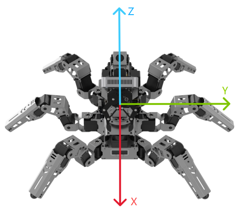

2.16 Establishment of Hexapod Robot Coordinate System
2.16.1 Coordinate System Introduction
To control the motion of ROSpider, inputting the coordinates for the footholds of the 6 legs allows the system to use inverse kinematics to output the required rotation angles for all servos, thereby enabling walking control.
First, establish the coordinate system for ROSpider. When establishing the coordinate system, the center point of the ROSpider body is taken as the origin coordinates (0, 0, 0). From a first-person perspective of the robot, the forward direction is the positive X-axis, the left side is the positive Y-axis, and the upward direction is the positive Z-axis, as shown in the following figure:
When setting coordinates, it is only necessary to configure the X, Y, and Z-axis values for the footholds of the 6 legs.
2.16.2 Coordinate Description
For a clearer understanding, the initial posture coordinates of ROSpider are utilized as an example. The program source code is located at: /home/ubuntu/ros2_ws/src/driver/controller/controller/bulid_in_pose.py
Three initial coordinate points and heights are defined in the program.
X1 = 93.60
Y1 = 50.805
X2 = 0.0
Y2 = 73.535
INITIAL_X = 70.0
INITIAL_Y = 110.0
INITIAL_HEIGHT = 70.0
INITIAL_HEIGHT_M = 95
SLAM_HEIGHT = 100.0
The positions of Servo 11 and Servo 5 are shown in the following figure:
  1. (X1, Y1) represents the innermost coordinate value of the left front leg with ID 5, indicating the offset from the servo rotation axis to the robot center.
  2. (X2, Y2) represents the innermost coordinate value of the left middle leg with ID 11, indicating the offset from the servo rotation axis to the robot center.
  3. (INITIAL_X, INITIAL_Y) represents the offset from the foot tip of each leg to the innermost servo rotation axis.
  4. INITIAL_HEIGHT represents the vertical height offset from the foot tip of each leg to the robot center.
  5. INITIAL_HEIGHT_M represents the vertical height offset from the foot tip of each leg to the robot center during mapping.
  6. SLAM_HEIGHT represents the vertical height of the robot center during mapping.

Once the feature is launched, the robot’s leg number 2 will retract and extend according to the set coordinates, and the servo rotation angles will be printed in the terminal.
  • Program Analysis
The source code for this program is located at: /home/ubuntu/ros2_ws/src/example/example/body_control/include/body_ik.py
for i in range(3):
	joints = node.controller.set_leg_position(2, (0, 140, -50), 2)
	node.get_logger().info('\033[1;32m%s\033[0m' % str(joints))
	time.sleep(2.5)
	joints = node.controller.set_leg_position(2, (0, 250, -50), 2)
The leg servo rotation is primarily controlled through the set_leg_position function.
Taking the code joints = node.controller.set_leg_position(2, (0, 140, -50), 2) as an example, the specific parameters are as follows:
The return parameter joints represents the returned servo rotation angles.
The input parameter 2 represents the robot’s leg number, which is the middle leg on the left side.
The input parameter (0, 140, -50) represents the moving coordinate point, in the order of XYZ.
The input parameter 2 represents the time required for rotation, in seconds.
  • Coordinate Analysis
From a first-person perspective of the robot, the robot center is the origin, the forward direction is the positive X-axis, the left side is the positive Y-axis, and the upward direction is the positive Z-axis, as shown in the following figure:
Analyzing the code “joints = node.controller.set_leg_position(2, (0, 140, -50), 2), (0, 140, -50) is the coordinate position of leg 2 relative to the body center, in millimeters. Using these coordinates, the set_leg_position function calculates the required rotation angles for the three servos on leg 2 with IDs 11, 9, and 7. The calculation results are shown below:
Since there is no change in the X-axis coordinate, servo 11 does not rotate.
In the initial posture, the Y-axis coordinate of the foot tip of leg 2 is around 193, so the Y-axis needs to decrease in the opposite direction to the 140 position.
In the initial posture, the Z-axis coordinate of the foot tip of leg 2 is around -60, so the Z-axis needs to increase in the positive direction to the -50 position.

	q = imu.orientation
	r = R.from_quat((q.x, q.y, q.z, q.w))
	x, y, z = r.as_euler('xyz')
except queue.Empty:
	if not self.running:
		continue
  1. The posture is primarily adjusted by setting parameters within the transform_euler function. This function mainly uses translation transformation plus Euler angles to perform posture transformations, returning new foot tip coordinates.
	self.pid_pitch.update(y)
	self.pid_roll.update(x)
	new_pose = kinematics_calculate.transform_euler(build_in_pose.DEFAULT_POSE, (0, 0, 0), 'xyz',(self.pid_pitch.output*10,self.pid_roll.output*10, 0), degrees=False)
	self.step_controller.set_pose_base(new_pose, 0.02)
except Exception as e:
	self.pitch = 0
	self.roll = 0
  1. transform_euler function: (1) The first parameter pose is the posture to be transformed. (2) The second parameter translate is the translation transformation of the body center offset, in millimeters. The range depends on the actual posture situation of the robot. X, Y value range: -50 to 50, in mm. Z value range: -30 to 90, in mm. (3) The third parameter axis is the order of the three axes for Euler angles. (4) The fourth parameter euler is the tuple of Euler angles, corresponding to the rotation angle of each axis. The setting order and length must match the former. Positive values indicate counterclockwise rotation, negative values indicate clockwise rotation. Value range is -20 to 20, in degrees. (5) The fifth parameter degrees is used to set whether the unit for Euler angles is degrees. True for degrees, False for radians.
