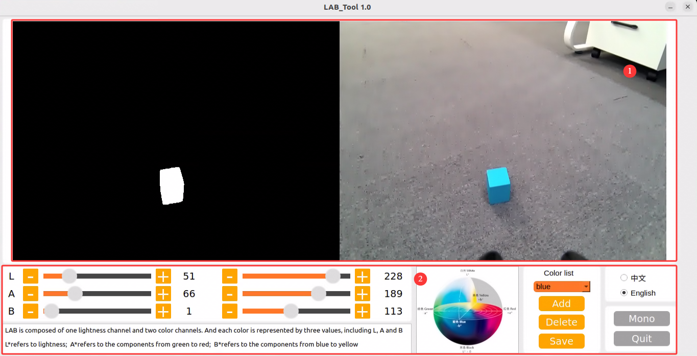

The LAB_TOOL software interface is divided into a video feed display area and a recognition adjustment area.
  1. Video Feed Display Area: The left side shows the processed camera feed, and the right side shows the original feed.
If the video feed does not display, the camera connection has failed. Check the cable connection at the corresponding port, or try replugging it to resolve the issue.
  1. Recognition Adjustment Area: Used to adjust color thresholds. The functions of each button are described in the table below:
Icon Function Description
The L, A, and B sliders are used to adjust the numerical values of the L, A, and B components of the video feed.
The left slider represents the "min" value of each component, and the right slider represents the "max" value of each component.
Select the color for threshold adjustment.
Add a recognizable color.
Save the color threshold adjustment results.
Click this button to switch between the depth camera and the monocular camera.
Close the LAB_TOOL.

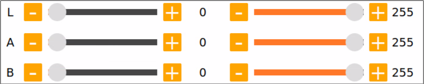

  2. Set both the min and max values of the L, A, and B components to 0 and 255 respectively.

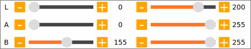

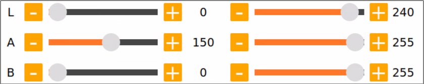

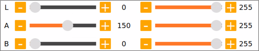

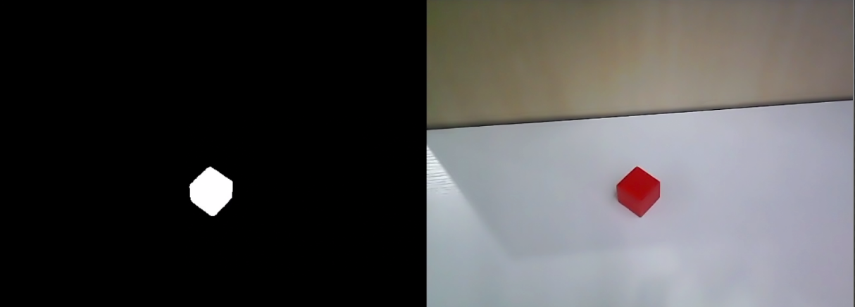

  1. Place a colored object within the camera’s field of view. Refer to the LAB color space distribution chart, and adjust the L, A, and B components toward the target recognition color range.
Red is closer to “+a”, so the A component needs to be increased. Keep the max value of the A component unchanged and increase its min value until the colored object area in the left display screen turns white, while other areas turn black.
  1. Adjust the remaining L and B components based on the environment. If the red color appears too light, increase the min value of the L component. If it appears too dark, decrease the max value of the L component. If the red color is too warm, increase the min value of the B component. If it is too cool, decrease the max value of the B component.

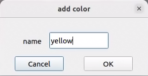

  1. Open the LAB_TOOL and click the Add button.
  1. Enter the color name in the Name field and click OK.

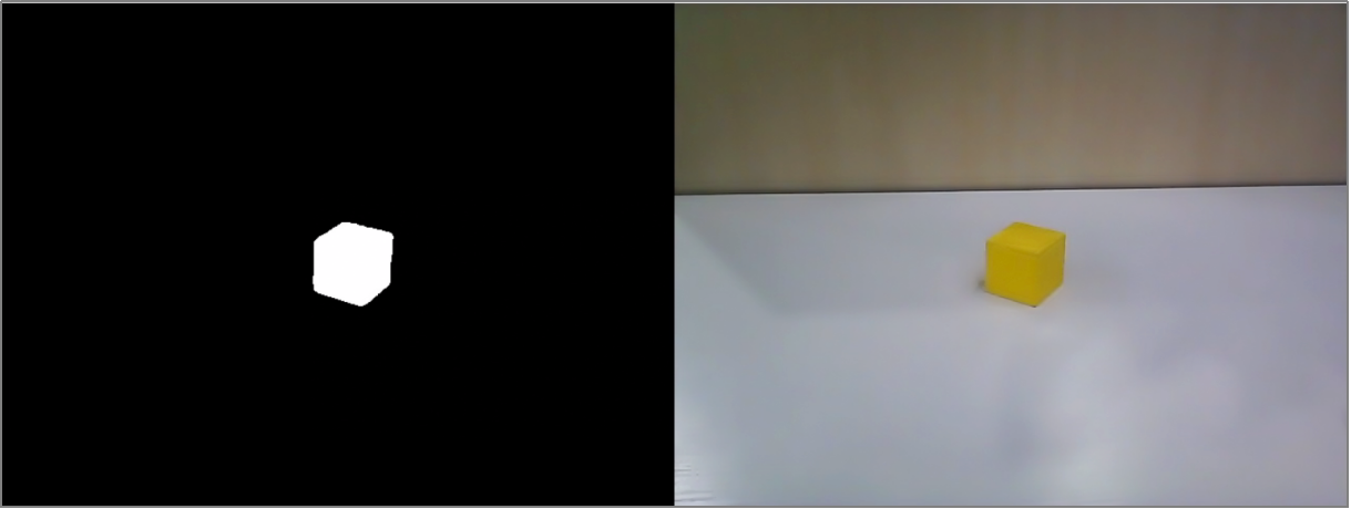

  1. Place the colored object within the camera’s field of view. Drag the sliders for the L, A, and B components to adjust the threshold until the colored object area in the left display screen turns white, while other areas turn black.

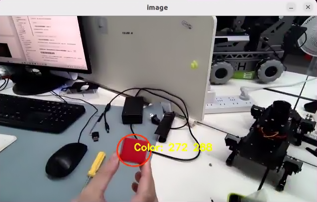

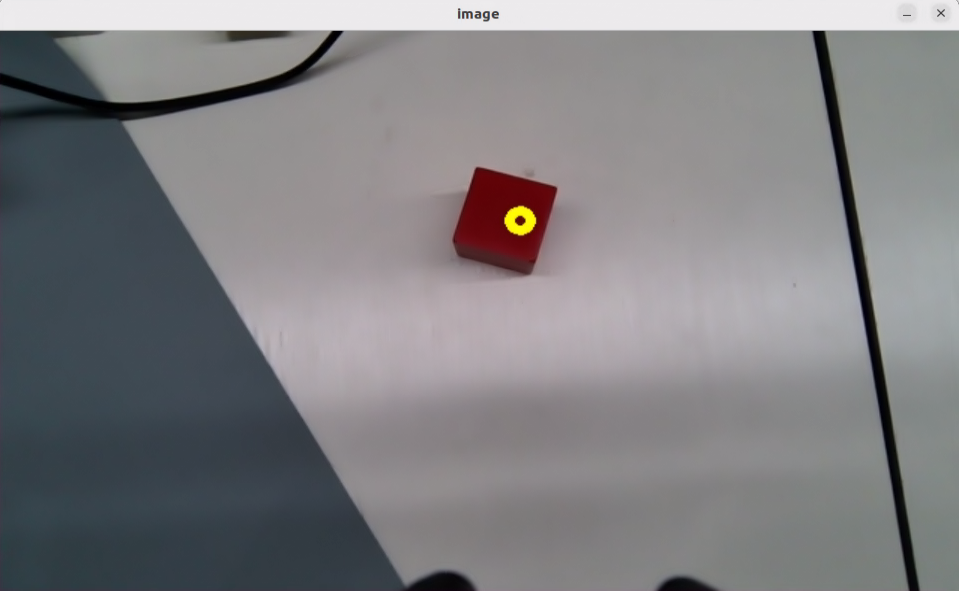

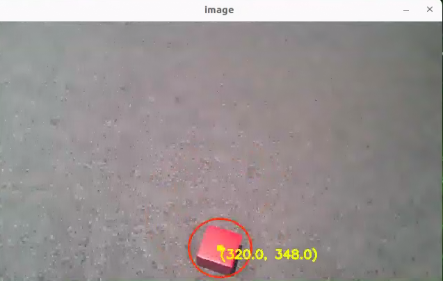

6.2.3 Program Outcome
After starting the feature, ensure that no other objects containing the target colors exist within the camera’s field of view to avoid affecting the performance.
After starting the feature, place the target object within the camera’s field of view. When the target object is recognized, the buzzer will emit a short beep, the video feed will mark the target object with a circle of the corresponding color, and the color name will be printed in the terminal. Upon recognizing red, servo No. 22 will rotate once, upon recognizing blue, servo No. 23 will rotate once, and upon recognizing green, servo No. 19 will rotate once. The program can recognize objects that are red, blue, and green.

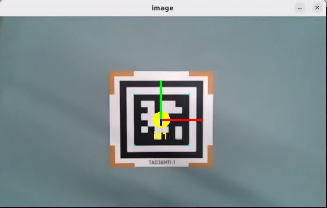

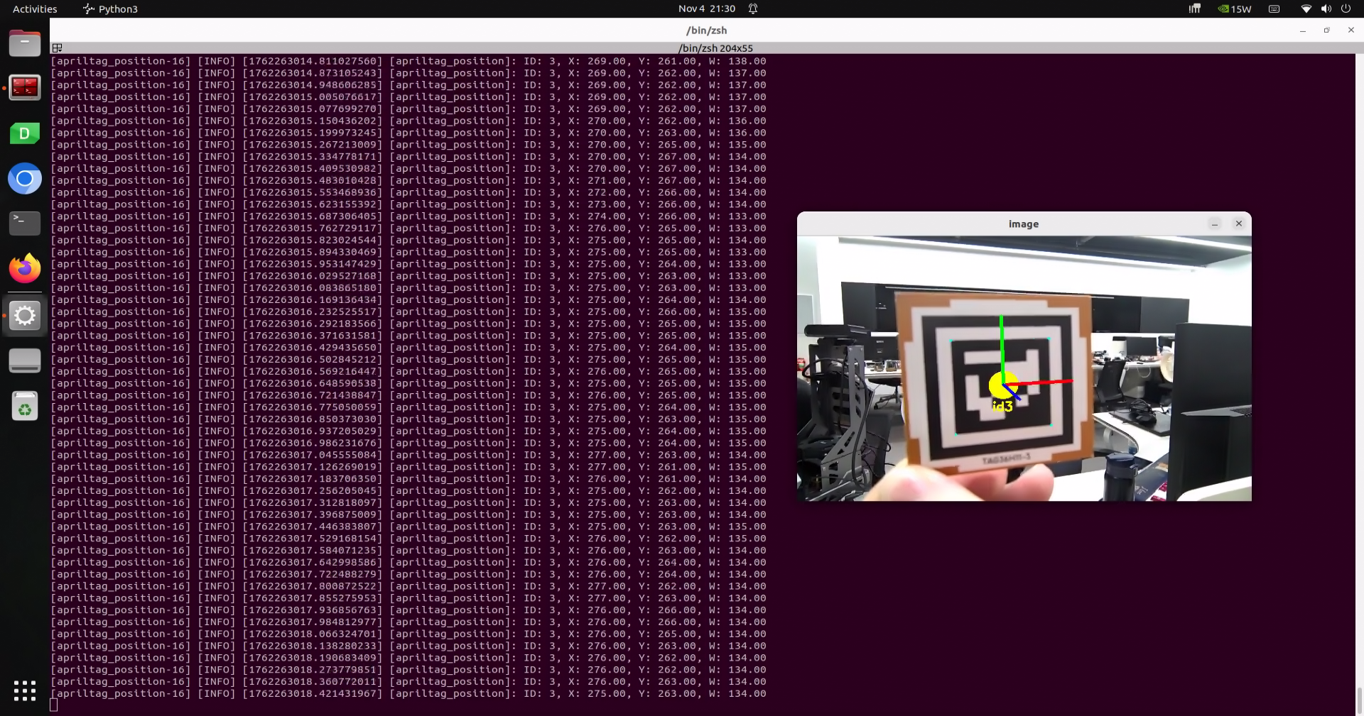

6.3.3 Program Outcome
After starting the feature, place the tag card within the camera’s field of view. When the tag is recognized, a coordinate axis will be drawn at the tag on the video feed, the four corners of the tag will be marked with small blue dots, and the tag’s ID will be displayed.

6.3.4.2 Python Source Code Analysis
/home/ubuntu/ros2_ws/src/example/example/opencv_example/include/apriltag_recognition.py
  • The parameter OBJP refers to the world coordinates of the feature points. The parameter AXIS refers to the 3D coordinates of three-dimensional points in the world coordinate system. The parameter CIRCLE is an array representing a circular set of points.
OBJP = np.array([[-1, -1,  0],
                 [ 1, -1,  0],
                 [-1,  1,  0],
                 [ 1,  1,  0],
                 [ 0,  0,  0]], dtype=np.float32)
AXIS = np.float32([[0, 0, 0],
                   [1.5, 0, 0],
                   [0, 1.5, 0],
                   [0, 0, 1.5]])
CIRCLE = np.float32([[0.3 * math.cos(math.radians(i)), 0.3 * math.sin(math.radians(i)), 0] for i in range(360)])
AXIS = np.append(AXIS, CIRCLE, axis=0)
  • The draw function is used to draw the four points and three coordinate axes.
def draw(img, corners, imgpts):
    imgpts = np.int32(imgpts).reshape(-1,2)
    cv2.drawContours(img, [imgpts[4:]], -1, (255, 255, 0), -1)
    cv2.line(img, tuple(imgpts[0]), tuple(imgpts[1]), (255, 0, 0), 3)
    cv2.line(img, tuple(imgpts[0]), tuple(imgpts[2]), (0, 255, 0), 3)
    cv2.line(img, tuple(imgpts[0]), tuple(imgpts[3]), (0, 0, 255), 3)
    return img
  • Sets the camera intrinsic matrix and distortion coefficients, subscribes to images and camera information, and publishes tag information and image processing results.
        self.camera_intrinsic = np.array([[619.063979, 0, 302.560920],
                                          [0, 613.745352, 237.714934],
                                          [0, 0, 1]], dtype=np.float32)
        self.dist_coeffs = np.array([0.103085, -0.175586, -0.001190, -0.007046, 0.000000])
        self.tag_detector = apriltag("tag36h11")
        self.image_sub = self.create_subscription(Image, '/depth_cam/rgb/image_raw' , self.image_callback, 1)  # Camera image subscription
        self.camera_info_sub = self.create_subscription(CameraInfo, '/depth_cam/rgb/camera_info' , self.camera_info_callback, 1)  # Camera info subscription
        self.apriltag_info_pub = self.create_publisher(ApriltagsInfo, '~/apriltag_info', 1) # Tag info publishing
        self.result_publisher = self.create_publisher(Image, '~/image_result', 1)  # Image processing result publishing
        # self.declare_parameter('enable_display', False)
        self.display = self.get_parameter('enable_display').value
  • camera_info_callback: A callback function used to handle subscriptions to camera info messages, updating the camera intrinsic matrix and distortion coefficients.
    def camera_info_callback(self, msg):
        with self.lock:
            self.camera_intrinsic = np.array(msg.k).reshape(3, 3)
            self.dist_coeffs = np.array(msg.d)
  • image_callback: A callback function used to handle image messages from the image subscriber, including image conversion, processing, visual display, and publishing the processed image to a designated topic.
    def image_callback(self, msg):
        rgb_image = self.bridge.imgmsg_to_cv2(msg, 'rgb8')
            with self.lock:
                result_image = self.image_proc(rgb_image, result_image)
        except Exception as e:
        if self.display:
            cv2.imshow('image', cv2.cvtColor(result_image, cv2.COLOR_RGB2BGR))
            cv2.waitKey(1)
        self.result_publisher.publish(self.bridge.cv2_to_imgmsg(result_image, "rgb8"))
  • Draws tag corners and center points, and performs pose estimation. The parameter corners refers to the pixel coordinates of feature points in the image. The parameter rvecs refers to the rotation vector transforming the world coordinate system to the camera coordinate system. The parameter tvecs refers to the translation vector transforming the world coordinate system to the camera coordinate system.
    tag_center = common.point_remapped(tag_center, (int(w/2), int(h/2)), (w, h))
    corners = np.array([lb, rb, lt, rt, tag_center], dtype=np.float32).reshape(5, -1)
    ret, rvecs, tvecs = cv2.solvePnP(OBJP, corners, self.camera_intrinsic, self.dist_coeffs)
    imgpts, _ = cv2.projectPoints(AXIS, rvecs, tvecs, self.camera_intrinsic, self.dist_coeffs)

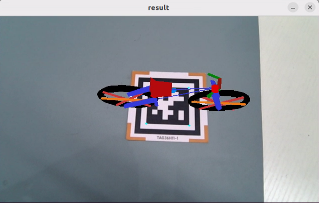

6.4 AR Vision
6.4.1 Experiment Overview
First, the RGB image is obtained by subscribing to the topic message published by the camera node, and it undergoes grayscale conversion and scaling processing.
Next, tags are detected to acquire tag information, such as the tag ID, tag center point, and corner coordinates.
Finally, through operations like model projection and polygon filling, a 3D image is rendered at a specified location on the video feed.
6.4.2 Operation Steps
  1. Power on the robot and connect it to the remote control software, VNC. For instructions on connecting to the remote desktop, refer to 1. ROSpider User Manual \ 1.4 Development Environment Setup.
  2. Click the desktop icon to open the terminal.
  3. Enter the command to stop the auto-start service.
  1. Enter the command to start the AR vision feature.
ros2 launch example ar.launch.py
  1. To close the feature, press Ctrl + C in the terminal interface. If the feature does not close immediately, try pressing Ctrl + C a few more times.
6.4.3 Program Outcome
6.4.4 Program Analysis

6.4.4.2 Python Source Code Analysis
/home/ubuntu/ros2_ws/src/example/example/opencv_example/include/ar.py
  • Obtains the default storage path for the model.
MODEL_PATH = os.path.join(os.path.abspath(os.path.join(os.path.split(os.path.realpath(__file__))[0])), '3d_model')
  • The draw_rectangle function is used to draw a cube. The parameter img is the image on which to draw the cube. The parameter imgpts refers to the corner points of the cube. Finally, it returns the image with the drawn cube.
def draw_rectangle(img, imgpts):
    imgpts = np.int32(imgpts).reshape(-1, 2)
    cv2.drawContours(img, [imgpts[:4]], -1, (0, 255, 0), -3)  # Draw contour points, filled
    for i, j in zip(range(4), range(4, 8)):
        cv2.line(img, tuple(imgpts[i]), tuple(imgpts[j]), (255), 3)  # Draw points connected by lines
    cv2.drawContours(img, [imgpts[4:]], -1, (0, 0, 255), 3)  # Draw contour points, unfilled
    return img
  • Obtains related information about the 3D image, such as vertex position information and color information.
	if self.target_model != 'rectangle':  # If the cube is not being drawn
		# Load the model
		obj = obj_load(os.path.join(MODEL_PATH, self.target_model + '.obj'), swapyz=True)
		obj.faces = obj.faces[::-1]
		new_faces = []
		# Analyze the model and get the point coordinates
		for face in obj.faces:
			face_vertices = face[0]
			points = []
			colors = []
			for vertex in face_vertices:
				data = obj.vertices[vertex - 1]
				points.append(data[:3])
				if self.target_model != 'cow' and self.target_model != 'wolf':
					colors.append(data[3:])
			scale_matrix = np.array([[1, 0, 0], [0, 1, 0], [0, 0, 1]]) * MODELS_SCALE[self.target_model]  # Scale
			points = np.dot(np.array(points), scale_matrix)
  • Conversion from Euler angles to rotation matrix: Converts Euler angles to a rotation matrix to subsequently adjust the viewing angle of the 3D image. The parameter 'xyz' is the axis of rotation. The parameter (0, 0, 180) represents the rotation angle, namely the Euler angles. The parameter degrees=True dictates the unit of the rotation angle. If set to True, the unit is degrees.
if self.target_model == 'bicycle':
	points = np.array([[p[0] - 670, p[1] - 350, p[2]] for p in points])
	points = R.from_euler('xyz', (0, 0, 180), degrees=True).apply(points)
elif self.target_model == 'fox':
	points = np.array([[p[0], p[1], p[2]] for p in points])
	points = R.from_euler('xyz', (0, 0, -90), degrees=True).apply(points)
elif self.target_model == 'chair':

6.5 Color Block Coordinate Positioning
6.5.1 Experiment Overview
First, the RGB image is obtained by subscribing to the topic message published by the camera node. The image undergoes scaling and Gaussian blur processing, and its color space is converted from RGB to LAB.
Subsequently, the image is subjected to binarization, erosion, and dilation to acquire the maximum contour of the target color within the image.
Finally, the recognition results are fed back through the video feed and the terminal interface.
6.5.2 Operation Steps
  • Commands are strictly case-sensitive, and the Tab key can be used to auto-complete keywords.
  • The recognizable colors for this feature are red, green, and blue.
  1. Enter the command to start the color block coordinate positioning feature. To locate other colored blocks, change red to the desired color.
ros2 launch example color_position.launch.py color:=red
6.5.3 Program Outcome
After starting the feature, ensure that no other objects containing the recognized color exist within the camera’s field of view to avoid affecting the performance.
After starting the feature, place the target object within the camera’s field of view. When the target object is recognized, the buzzer will emit a short beep, the video feed will mark the target object with a circle of the corresponding color, and the color name will be printed in the terminal. Upon recognizing red, servo No. 22 will rotate once, upon recognizing blue, servo No. 23 will rotate once, and upon recognizing green, servo No. 19 will rotate once. The program can recognize red, blue, and green objects.
6.5.4 Program Analysis

/home/ubuntu/ros2_ws/src/example/example/opencv_example/include/color_position.py
  • Creates subscriptions to the '/color_detect/color_info' and '/color_detect/image_result' topics, creates the '~/start' service, and creates a client to request the /controller_manager/init_finish service. Creates publishers buzzer_pub and joints_pub, sets up the color detection and ROI clients, and finally creates a timer.
    self.create_subscription(ColorsInfo, '/color_detect/color_info', self.get_color_callback, 1)
    self.create_subscription(Image, '/color_detect/image_result', self.image_callback, 1)
    self.create_service(Trigger, '~/start', self.start_srv_callback, callback_group=timer_cb_group) # Enter the feature
    self.controller = step_controller.StepController()
    self.buzzer_pub = self.create_publisher(BuzzerState, 'ros_robot_controller/set_buzzer', 1)
    self.set_color_client = self.create_client(SetColorDetectParam, '/color_detect/set_param', callback_group=timer_cb_group)
    self.set_roi_client = self.create_client(SetCircleROI, '/color_detect/set_circle_roi', callback_group=timer_cb_group)
    self.set_color_client.wait_for_service()
    self.set_roi_client.wait_for_service()
  • This initialization function initializes robot posture and robotic arm servo positions, calls the start_srv_callback service callback function, and starts a thread to execute the target function.
    def init_process(self):
        self.timer.cancel()
        self.controller.set_build_in_pose('DEFAULT_POSE', 1)
        joint_angle = [500, 670, 40, 210, 500, 600]
        set_servo_position(self.joints_pub, 1, ((19, joint_angle[0]), (20, joint_angle[1]), (21, joint_angle[2]), (22, joint_angle[3]), (23, joint_angle[4]), (24, joint_angle[5])))
  • Service callback function used to start the color recognition function and return a response.
        self.get_logger().info('\033[1;32m%s\033[0m' % "start color position")
        color_msg = ColorDetect()
        color_msg.color_name = self.target_color
        color_msg.detect_type = 'circle'
        msg.data = [color_msg]
        if res.success:
            self.get_logger().info('\033[1;32m%s\033[0m' % 'set color success')
            self.get_logger().info('\033[1;32m%s\033[0m' % 'set color fail')
        response.success = True
        response.message = "start"
        return response
  • Acquires the image, recognizes the colored object, marks the center point, and finally displays the image.
    def main(self):
        while self.running:
            except queue.Empty:
                if not self.running:
                    continue
            if self.color in ['red', 'green', 'blue'] :
                self.count += 1
                if self.count > 30:
                    self.count = 0
                    self.target_color = self.color
                self.count = 0
            if image is not None:
                if self.center is not None:
                    cv2.circle(image, (int(self.center[0]), int(self.center[1])), 5, (0, 255, 255), -1)
                    string = "({:0.1f}, {:0.1f})".format(self.center[0], self.center[1])
                    cv2.putText(image, string, (int(self.center[0]), int(self.center[1] + 16)), cv2.FONT_HERSHEY_SIMPLEX, 0.6, (0, 255, 255), 2)
                cv2.imshow('image', image)
                key = cv2.waitKey(1)
                if key == ord('q') or key == 27:  # Press Q or Esc to exit
                    self.running = False
        rclpy.shutdown()
  • Image reception and processing callback function.
        if self.id :
            self.get_logger().info(f"ID: {str(self.id)}, X: {self.center[0]:.2f}, Y: {self.center[1]:.2f}, W: {self.width:.2f}")
        cv2.waitKey(1)

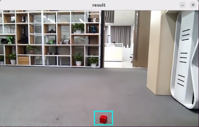

6.6.3 Program Outcome
After starting the feature, place the target object within the camera’s field of view. When the target object is recognized, ROSpider will track the object.

6.7.3 Program Outcome
Once the program runs, it will recognize the tag in the frame, draw the 3D coordinate axis and corners at the tag’s center, and print the recognized tag ID and coordinate position information to the terminal.
6.7.4 Program Analysis

  • The set_target_tag_srv_callback function is used to set the target tag. It receives request data from the client, updates the tag, and returns a success response.
    def set_target_tag_srv_callback(self, request, response):
        with self.lock:
            self.target_tag = request
            self.get_logger().info('\033[1;32mset_target_color %s\033[0m' % self.target_tag)
        return response
  • In the main function, a loop is set up to process image data from the image queue, adjust the robot’s movement based on information such as target tag, distance, and coordinates, while utilizing PID control for fine adjustment.
    def main(self):
            except queue.Empty:
                continue
            twist = Twist()
            if self.tag_id == self.target_tag and self.distance !=0 and self.x !=0:
                if abs(self.distance - self.d_stop) > 1:
                    self.pid_dist.update(self.distance - self.d_stop)
                    twist.linear.x = common.set_range(self.pid_dist.output, -0.01, 0.01) * -3
                    twist.linear.x = 0.0
                    self.pid_dist.clear()
                if abs(self.x - self.x_stop) > 20:
                    self.pid_yaw.update(self.x - self.x_stop)
                    twist.angular.z = common.set_range(self.pid_yaw.output, -1, 1) * 0.2
                    twist.angular.z = 0.0
                    self.pid_yaw.clear()
                self.cmd_vel_pub.publish(twist)
                self.cmd_vel_pub.publish(Twist())
            cv2.imshow("image", result)
            k = cv2.waitKey(1)
            if k != -1:
        rclpy.shutdown()

6.10 KCF Object Recognition
6.10.1 KCF Introduction
KCF, Kernel Correlation Filter, is an algorithm proposed by Joao F. Henriques, Rui Caseiro, Pedro Martins, and Jorge Batista in 2014.
KCF is a discriminative tracking method. Its principle primarily involves using the circulant matrix of the area around the target to collect positive and negative samples, training a target detector, and using the target detector to check whether the predicted position in the next frame is the target. The training set is then updated based on the new detection results, subsequently updating the target detector.
6.10.2 Experiment Overview
The implementation workflow for this experiment is as follows:
First, instantiate the KCF tracker, and obtain the real-time camera image by subscribing to the topic message published by the camera node.
Subsequently, perform processing such as conversion, scaling, and copying on the acquired camera feed.
Next, use the selectROI function to let a target area be bounded via a bounding box, obtaining the rectangle data of the target area. Combine this with the image frame to initialize the KCF tracker and start tracking.
Finally, utilize the constructed detection model to detect data points in the image, update the rectangle data of the target area, draw the rectangular area using the rectangle function, and reflect this on the video feed.
6.10.3 Operation Steps
  1. Enter the command to start the KCF object recognition feature.
ros2 launch example kcf.launch.py
6.10.4 Program Outcome
After starting the feature, press the S key, and left-click the mouse to draw a box around the tracking target in the current frozen frame. To redraw the box, press the C key, and press the S key again.
After selection is complete, press the Space key or Enter key to start tracking. A blue box will mark the tracking target in the video feed, and the robot will rotate left and right based on the target’s position to track it.
6.10.5 Program Analysis

6.10.5.2 Python Source Code Analysis
/home/ubuntu/ros2_ws/src/example/example/opencv_example/include/kcf.py
  • The initialization process for the ROS2 node, including the creation of clients, publishers, subscribers, and timers.
        self.joints_pub = self.create_publisher(ServosPosition, '/servo_controller', 1) # Servo control
        self.cmd_vel_pub = self.create_publisher(Twist, '/controller/cmd_vel', 1)  # Chassis control
        self.image_sub = self.create_subscription(Image, '/depth_cam/rgb/image_raw', self.image_callback, 1)  # Subscribe to the camera
  • The initialization function, initializing robot movement and robotic arm servo positions, starts a thread to execute the target function.
        self.timer.cancel()
        self.controller.traveling(gait=-2, time=1, steps=0)
        joint_angle = [500, 750, 200, 150, 500, 600]
        self.get_logger().info('\033[1;32m%s\033[0m' % 'Press “S" in the picture window to start tracking the target, then press the "space" to start tracking')
  • Image reception and processing callback function, including image data format conversion and image display.
        # Convert the screen to opencv format
        if self.image_queue.full():
            self.image_queue.get()
  • The main function processes the image data in the video stream and uses OpenCV’s KCF tracker to perform object tracking.
    def main(self):
        while self.running:
            rgb_image = self.image_queue.get()
            factor = 1
            rgb_image = cv2.resize(rgb_image, (int(result_image.shape[1]/ factor), int(result_image.shape[0]/ factor)))
            if self.tracker is None:
                if self.enable_select:
                    roi = cv2.selectROI("result", result_image, False)
                    roi =  tuple(int(i / factor)for i in roi)
                    if roi[2] > 0 and roi[3] > 0:
                        param = cv2.TrackerKCF.Params()
                        param.detect_thresh = 0.2
                        self.tracker = cv2.TrackerKCF_create(param)
                        self.tracker.init(rgb_image, roi)
                twist = Twist()
                status, box = self.tracker.update(rgb_image)
                if status:
                    p1 = int(box[0] * factor), int(box[1] * factor)
                    p2 = p1[0] + int(box[2] * factor), p1[1] + int(box[3] * factor)
                    cv2.rectangle(result_image, p1, p2, (255, 255, 0), 2)
                    center_x, center_y = (p1[0] + p2[0]) / 2, (p1[1] + p2[1]) / 2
                    self.pid_x.SetPoint = result_image.shape[1]/2
                    self.pid_x.update(center_x)
                    if self.pid_x.output :
                        twist.angular.z = (common.set_range(self.pid_x.output, -10, 10)/ 10.0) * 0.3
            cv2.imshow("result", result_image)
            if key == ord('s'): # Press 's' to start selecting the tracking target
                self.tracker = None
                self.enable_select = True
        rclpy.shutdown()
