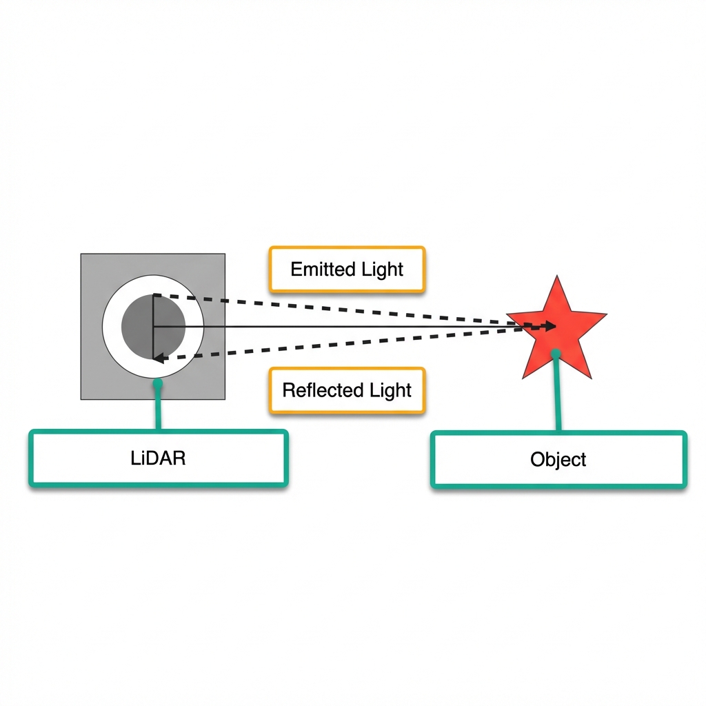

There are two common methods for LiDAR to determine the distance to a target: Triangulation and Time-of-Flight (ToF) ranging.

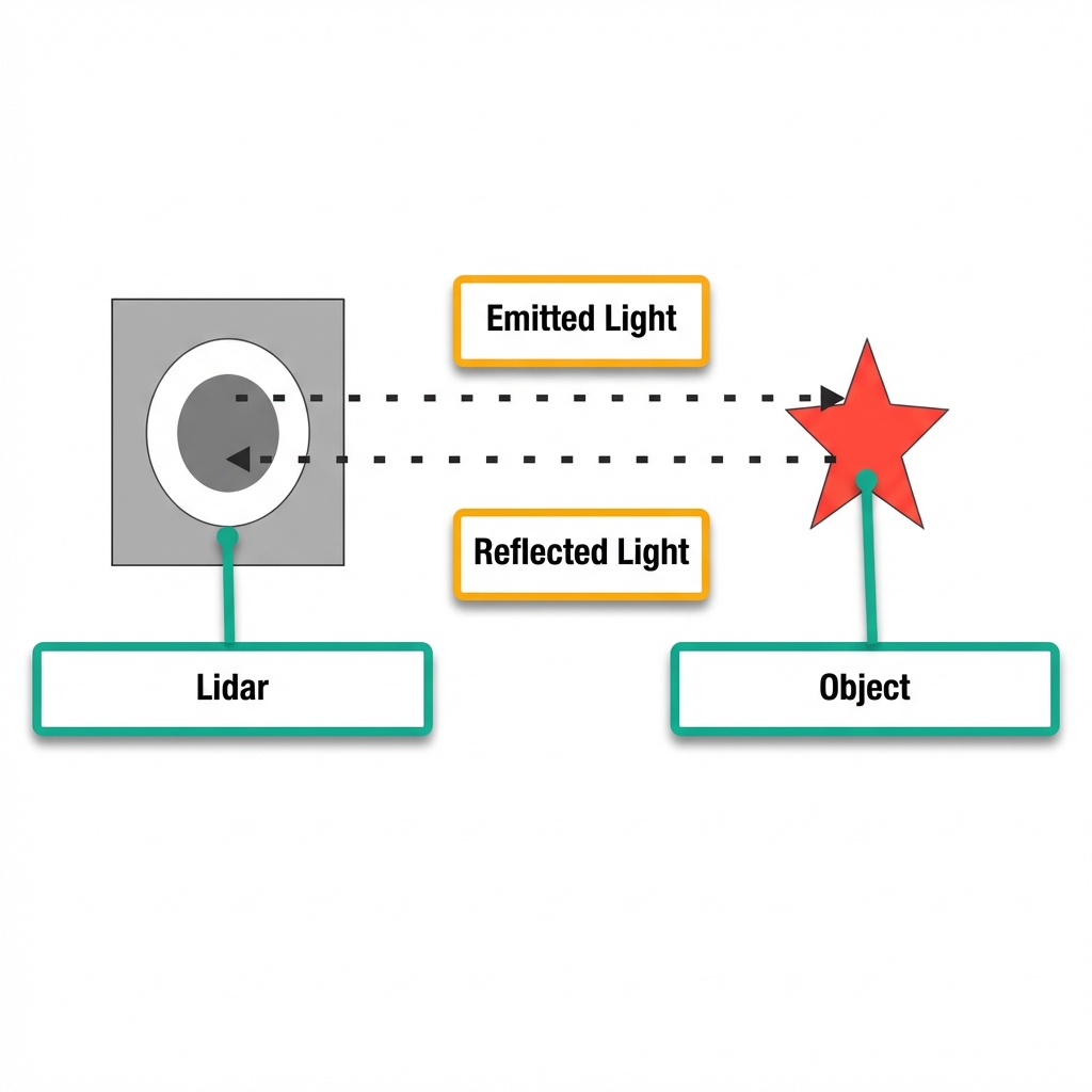

ToF ranging can be understood by referring to the diagram below. The LiDAR first shines light onto the object, which then reflects the light directly back to the LiDAR. The LiDAR calculates the time it takes for the light to return, multiplies this time by the speed of light, and divides the result by two to determine the distance between the object and the LiDAR.

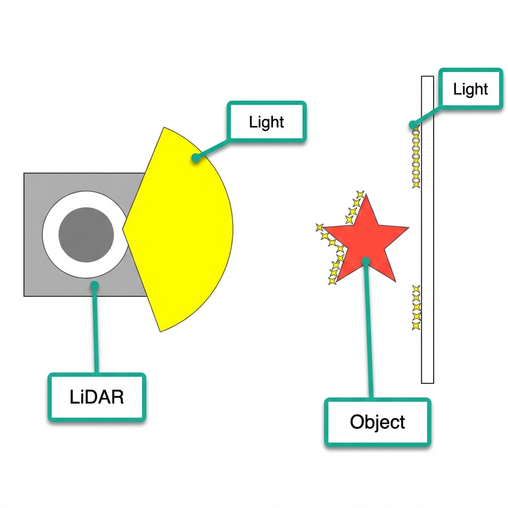

Refer to the diagram below to understand the effect of LiDAR. The LiDAR emits light that illuminates the surface of an object. When the LiDAR receives the light reflected from the object, the outline of the object is marked at the illuminated position.

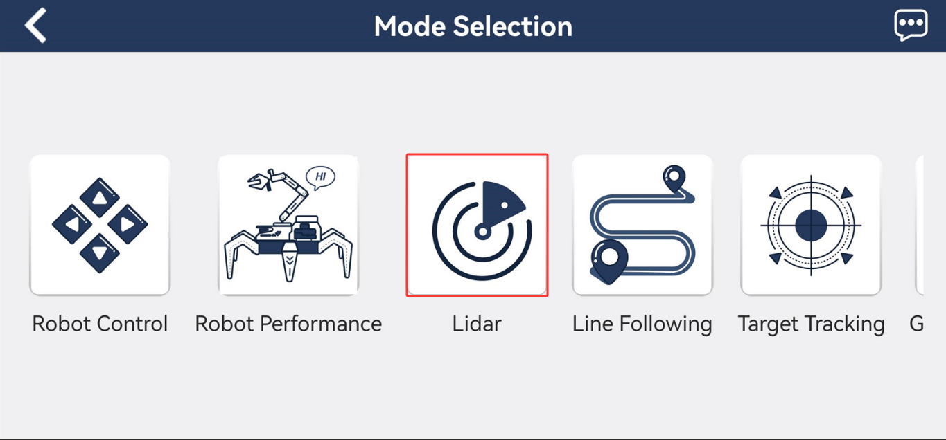

  1. Open the app WonderNex and connect to ROSpider.
  2. In the mode selection interface, tap Lidar to enter the operation interface for this feature.

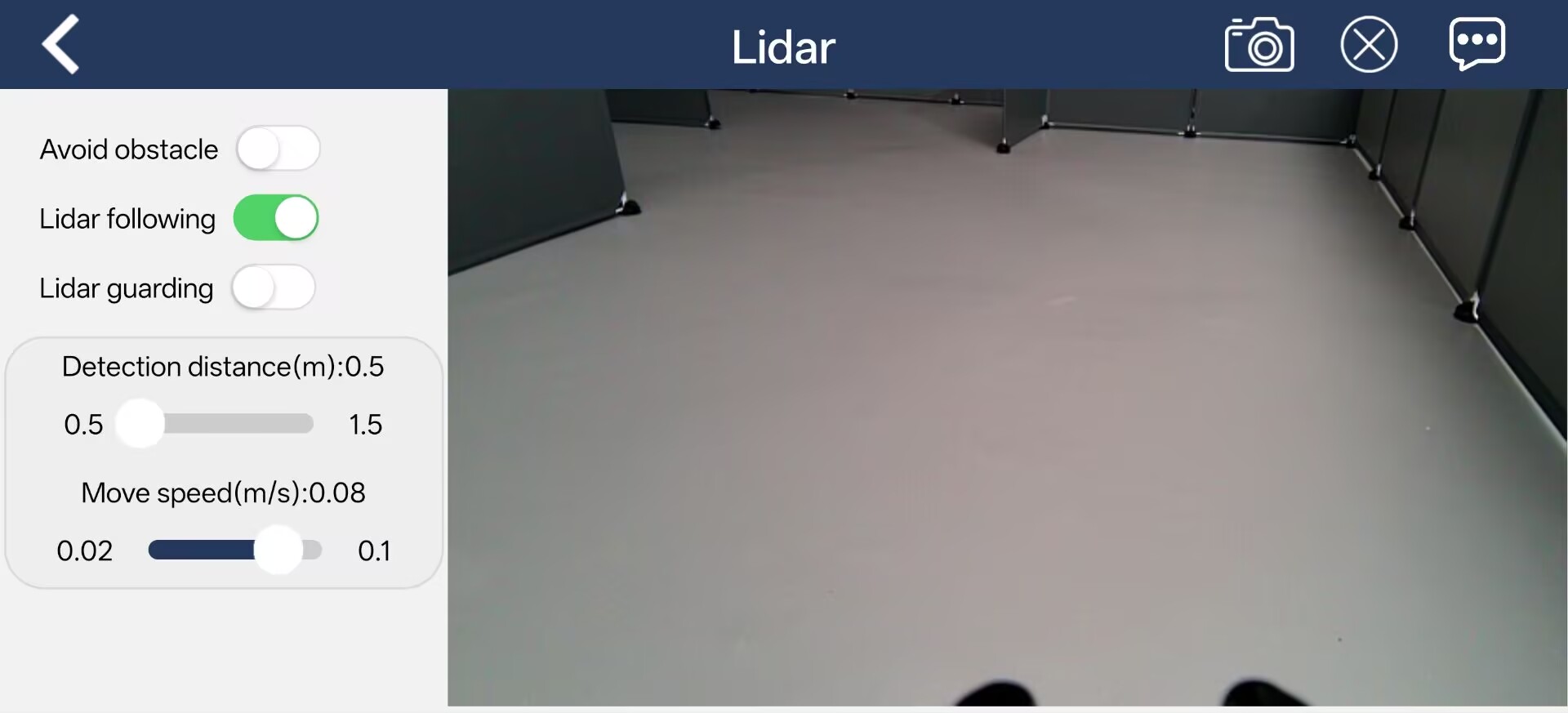

3.4 LiDAR Following
To understand the connection method for the app, please refer to 1. ROSpider User Manual\1.3.3 App Installation and Connection for the relevant course.
3.4.1 Activation via APP
  1. Tap the switch button on the right side of Lidar following to activate this feature.

  1. Then, in the current command line terminal, enter the command and press Enter to activate the LiDAR following feature:
ros2 service call /lidar_app/set_running interfaces/srv/SetInt64 "{data: 2}"
  1. To stop the current function, enter the command in the current command line terminal and press Enter to execute.
  1. To exit the feature, press Ctrl + C directly in the terminal interface from step 4.
3.4.2 Program Outcome
During the use of the LiDAR following feature, the object to be detected must be higher than the horizontal scanning height of the LiDAR. This ensures that the LiDAR mounted on the robot can effectively scan its position information. The robot will then adjust its own position so that the distance between the body and the obstacle is constantly maintained at a certain range.

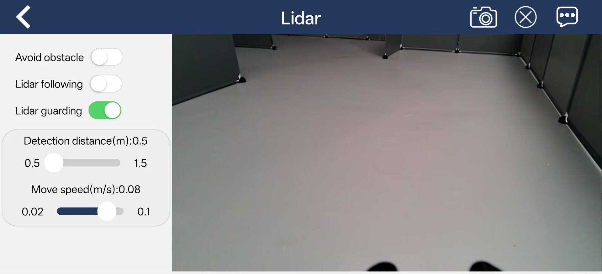

3.5 LiDAR Guarding
3.5.1 Activation via APP
  1. Tap the switch button on the right side of Lidar guarding to activate this feature.

  1. Then, in the current command line terminal, enter the command and press Enter to activate the LiDAR guarding feature:
ros2 service call /lidar_app/set_running interfaces/srv/SetInt64 "{data: 3}"
3.5.2 Program Outcome
During the use of the LiDAR guarding feature, the object to be detected must be higher than the horizontal scanning height of the LiDAR. This ensures that the LiDAR mounted on the robot can effectively scan its position information. The robot will then adjust the orientation of its body to face the obstacle, aligning the camera directly toward the obstacle.
