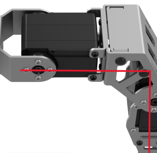

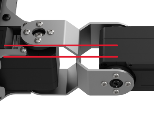

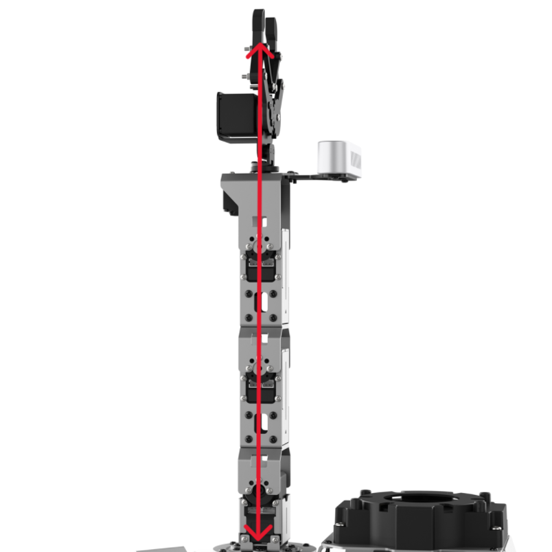

During servo deviation calibration, refer to the standard calibration diagram. The robot’s calibration is considered acceptable only when all four of the following criteria are strictly met:
  1. The robotic arm points straight up and is perpendicular to the chassis. As seen from the image, several servos align on the center servo horn, meaning a conceptual connection line through the center screws of the servo horns can pass vertically through these servos.

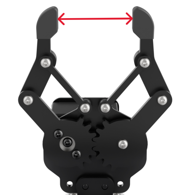

  2. The opening distance of the robotic arm’s gripper should be maintained at 2-3 cm. This distance serves as the neutral point standard for the gripper servo. The measurement can be quickly verified using the combined width of an index and middle finger. A perfect fit indicates the standard is met.
  3. The leg forms a 90° right angle in the reset state.
  4. The edge of the large U-shaped cross bracket on the chassis is parallel to the edge of the inner servo.

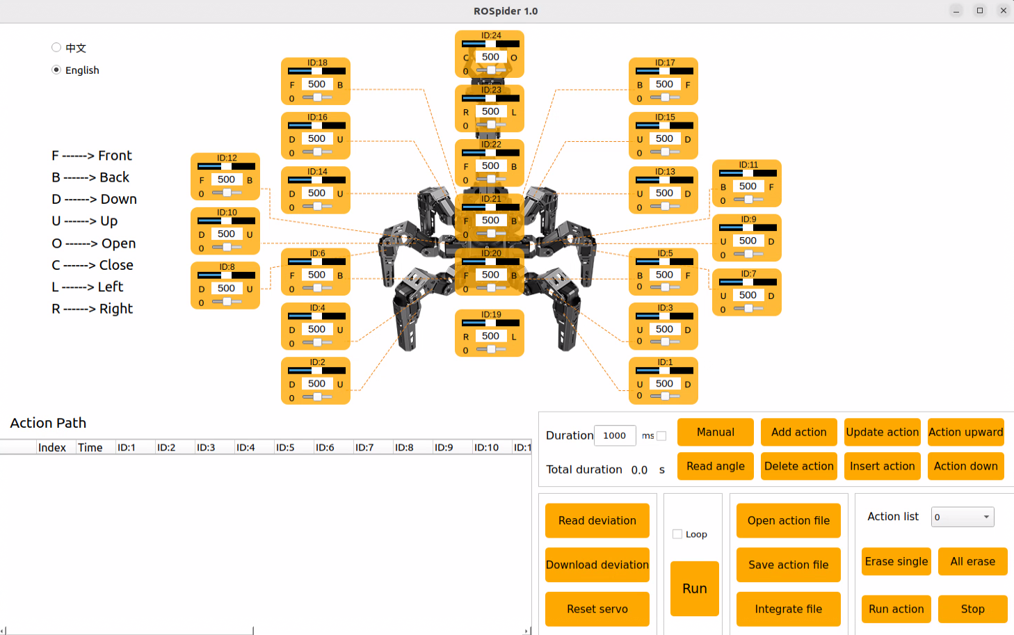

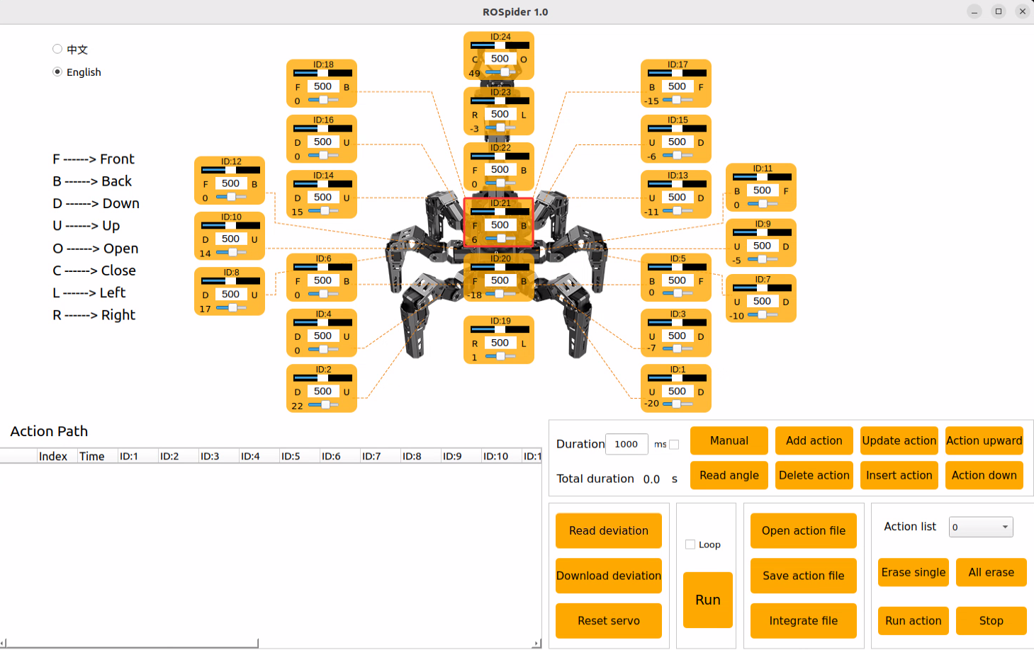

  1. Connect the robot, then click the ROSpider PC software icon on the desktop.
  2. Click the Reset servo button. For example, a deviation has occurred on servo ID 21 in the robotic arm.
  1. Click the Read deviation button to obtain the corresponding deviation value of the servo currently mounted on the robotic arm.
  1. Wait for the success! pop-up window to appear, then click the OK button.
  1. Check the deviation value of servo ID: 21, as shown in the figure below. In the figure, each servo has its corresponding ID number. The upper slider represents the current position, the middle value displays its numerical position, and the bottom slider represents the set deviation value of the servo.
  1. The current deviation value of servo 21 is -12. When such a deviation occurs on servo 21, it needs to be adjusted in the opposite direction until it is calibrated to the first state outlined in 8.1.1 Calibration Standards.
  1. The deviation value of servo 21 is now adjusted to “6”, completing the deviation calibration for servo 21. The current value must be saved to the robot’s system according to subsequent steps. After the robot restarts, it will read the currently saved deviation for servo control. The calibration method for servos with other ID numbers is identical.
  1. Click Download deviation.
  1. Wait for the success! prompt window to appear, click OK to exit the window, thus completing the deviation calibration for servo 21.
  1. When it is necessary to return the robotic arm to the initialized state, select init in the action group, and then click Run action.
  1. If any other bus servos on the robot exhibit unacceptable deviations, repeat the steps above by adjusting the corresponding servo ID slider in the PC software to correct the alignment.

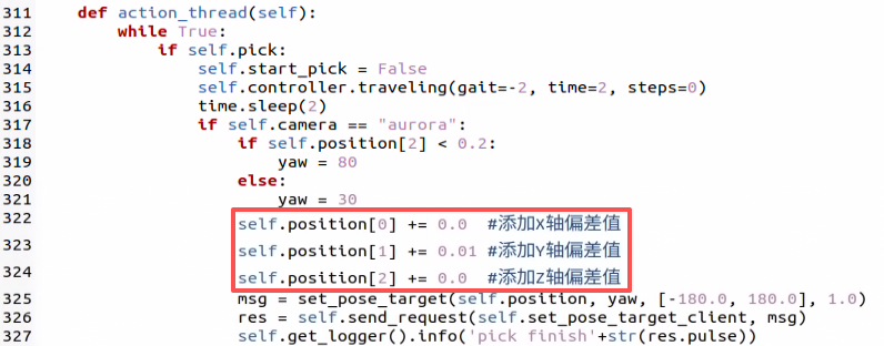

8.4.5 Deviation Adjustment
If the gripper fails to align properly during picking operations, parameters within the source code can be adjusted to calibrate the deviation. The source file is located at: /home/ubuntu/ros2_ws/src/example/example/navigation_transport/automatic_pick.py.
  1. If the robot is equipped with a depth camera, the X, Y, and Z axis offsets can be tuned directly at this location.
  1. If the robot is equipped with a monocular camera, depth data cannot be acquired. Therefore, the corresponding action group must be modified in these lines to calibrate. It is highly recommended to first load the target action group into the PC software and execute it to verify the adjustments visually.

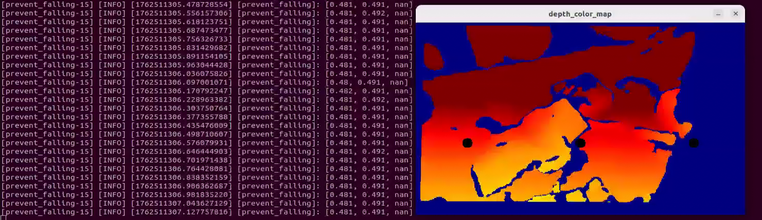

8.5.3 Program Outcome
Following the feature launch, the terminal will display the depth camera feed. The robot will move forward autonomously. Upon encountering high or low terrain immediately ahead, the robot will automatically turn in place and assess the flatness of the new forward position. It proceeds forward if flat, or continues to turn in place until flat ground is detected ahead.
Upon initial setup or whenever the robot is relocated, the command ros2 launch example prevent_falling.launch.py debug:=true must be executed to calibrate the current surface and establish a safe baseline. For subsequent operations in the same location, running the file ros2 launch example prevent_falling.launch.py will maintain this calibrated safety state.
