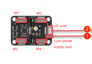

13.1.1 Wiring Instruction

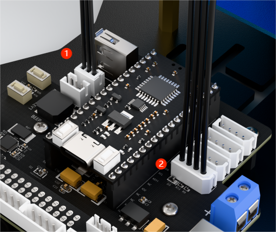

Connect the four motors of the mecanum wheel chassis in the following order: M1: Front left wheel.
M2: Rear left wheel.
M3: Front right wheel.
M4: Rear right wheel.
Use a 4-pin cable to connect the 4-channel motor encoder driver module to the IIC port (port 2) on the expansion board. Use a 3-pin cable to connect the 4-channel motor encoder driver module to the 3-pin port (port 1) on the STM32 expansion board.

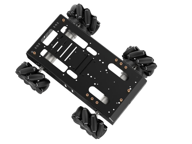

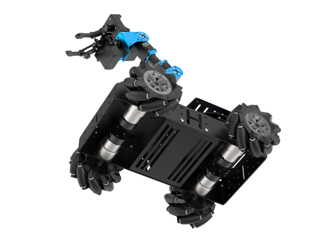

13.1.2 Chassis Installation

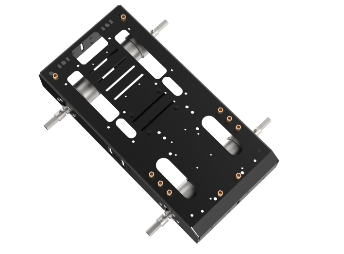

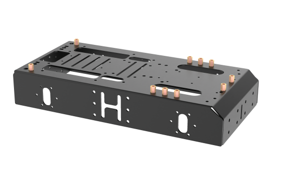

  1. Secure the 10 M4×6 round-head screws to fix the 10 M4×8 double-pass copper pillars.

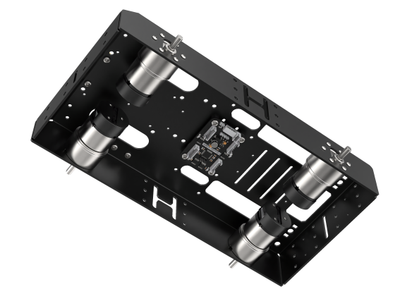

  1. Attach four M4×5+6 nylon standoffs to the Mecanum chassis, then mount the 4-channel encoder motor driver module onto the standoffs using four M4×6 round-head screws. Make sure the end with the I2C port is facing the right side of the chassis.
  1. Use M3×6 round-head mechanical screws to attach the four motors to the Mecanum chassis.

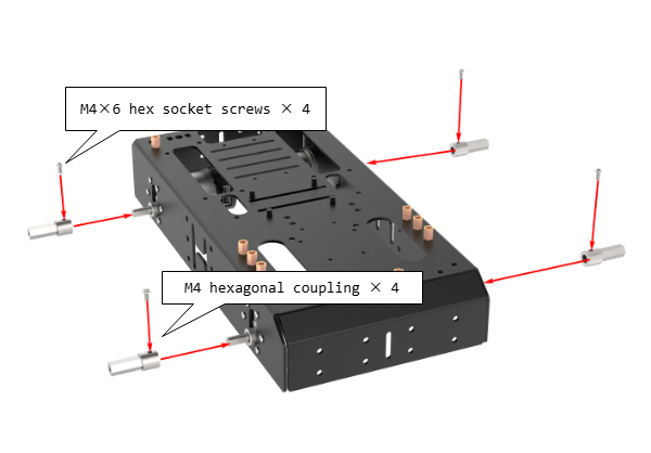

  1. Fix the four M4 hexagonal coupling to the motor using M4×6 hex socket screws.

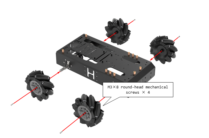

  1. Secure the four Mecanum wheels to the coupling with M3×8 round-head mechanical screws.
  1. Connect the motors to the 4-channel encoder motor driver module using the 6-pin module cable.

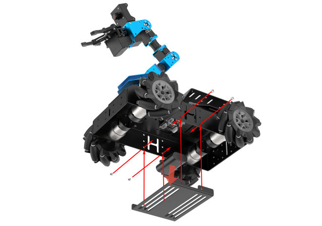

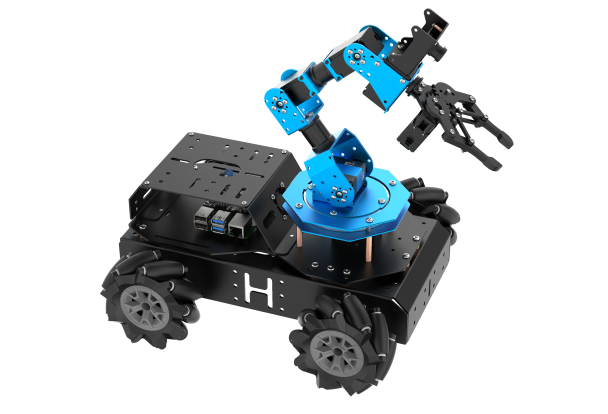

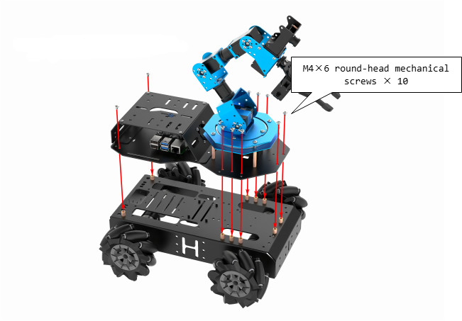

  1. Attach the robotic arm to the Mecanum chassis using 10 M4×6 round-head screws.
  1. Loosen the screws on the ports shown below and replace the wires with the battery cable. Ensure correct polarity: red to positive and black to negative. Tighten the screws securely, then connect the cable to the battery. The battery shown in the image is for reference only.
  1. Use Velcro to attach the battery to the battery mounting plate, and secure the battery plate to the chassis with 4 M4×6 round-head mechanical screws.

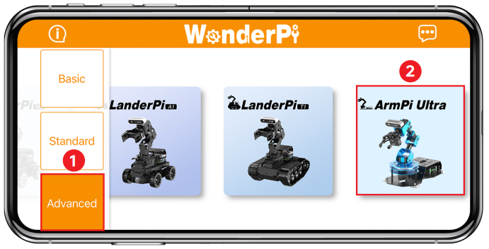

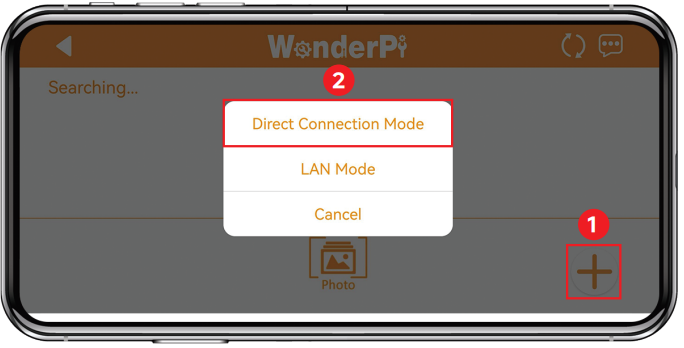

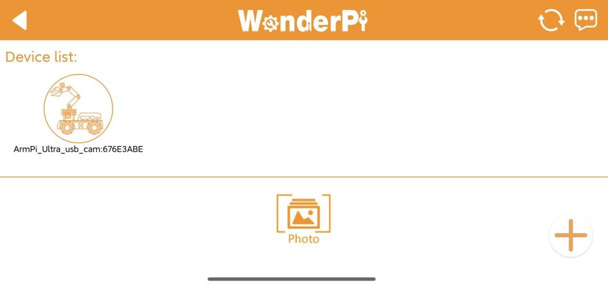

Open the WonderPi app and select “Advanced” > “ArmPi Ultra”.

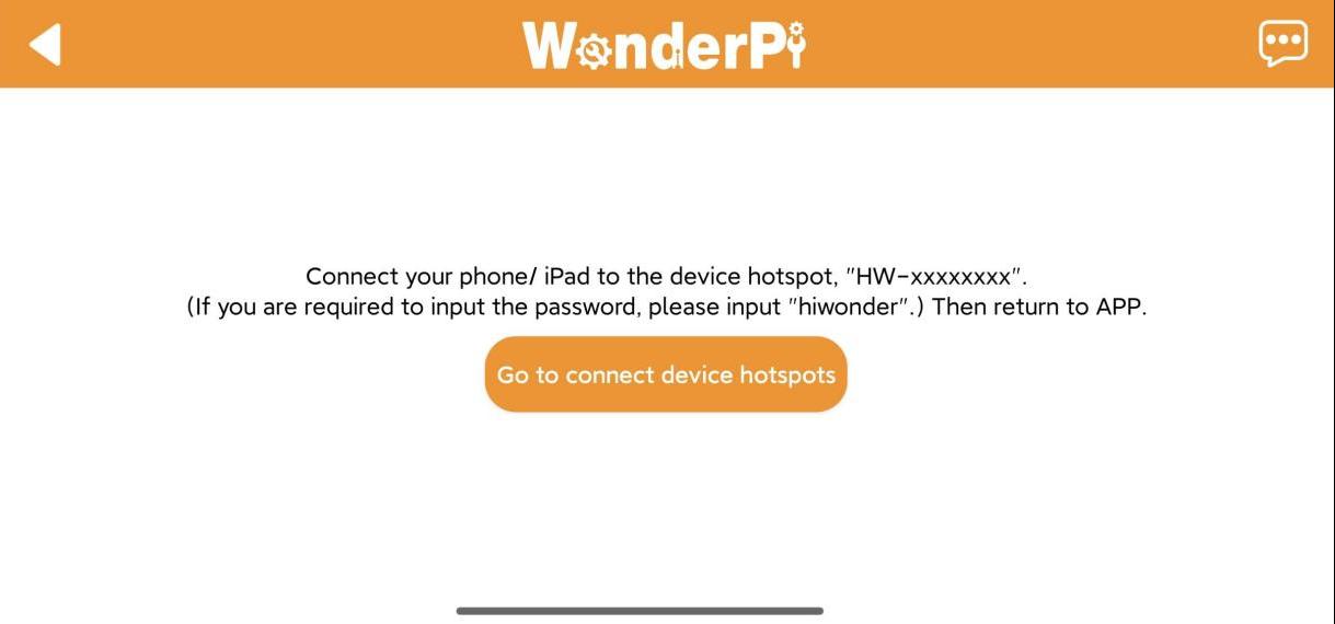

Tap the “+” button in the bottom-right corner and choose “Direct Connection Mode”.

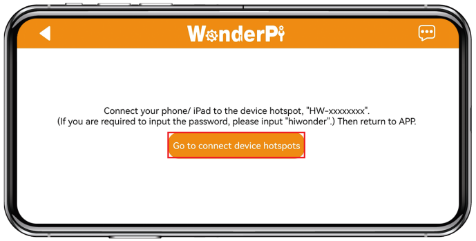

Tap “Go to connect device hotspots”, which will take you to the Wi-Fi settings page to connect the hotspot generated by the robot.
The hotspot starts with “HW” and connect to it by entering the password: hiwonder.
For iOS users: Make sure the Wi-Fi icon appears in the status bar before switching back to the app, or the device might not be detected. If the app doesn’t detect the device right away, tap the refresh icon in the upper-right corner.
Go back to the WonderPi app, tap the corresponding robot icon, and enter the mode selection screen.
If a message pops up saying “Network is unavailable, continue?”, tap “Keep Connection” to proceed.
If a message appears saying Whether to switch and enter the searched product interface?, it means the wrong product was selected in Step 1. Tap “Confirm” to automatically switch to the correct version’s mode selection screen.
After tapping the robot icon, the mode selection screen will appear as shown below:

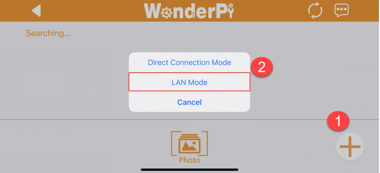

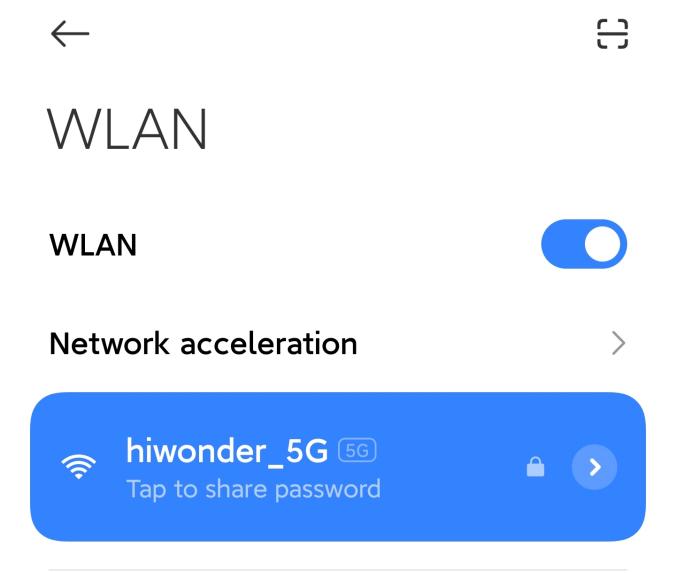

  • LAN Mode Connection (Optional)
  1. First, connect your phone to a 5G Wi-Fi network. For example, connect to “Hiwonder_5G.” If you are using a dual-band router with separate SSIDs, the 2.4G and 5G networks will have different names, for example, “Hiwonder” for 2.4G and “Hiwonder_5G” for 5G.
  1. Open the WonderPi app and select “Advanced” > “ArmPi Ultra”.
  1. Tap the “+” button in the bottom-right corner and choose “LAN Mode”.

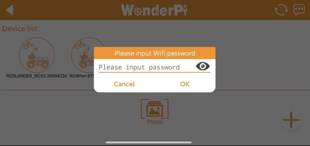

  1. The app will prompt you to enter the Wi-Fi password for the network you’re connected to. Make sure you enter the correct password, a wrong password will prevent the connection. After entering the password, tap OK.
  1. Tap “Go to connect device hotspots” to switch to the Wi-Fi settings.
  1. In the Wi-Fi list, find the hotspot starting with “HW”, and connect to it using the password: hiwonder. After connecting, tap the “Back” button to return to the app.

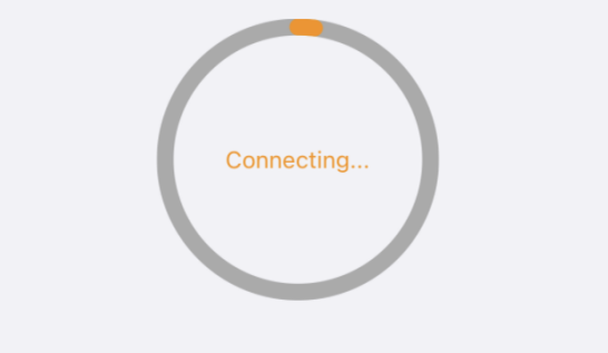

  1. You will see that the app has started connecting to the robot.

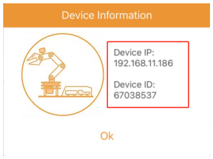

  1. After a few seconds, the robot’s icon and name will appear on the main screen. The LED1 indicator on the expansion board will stay on.
  1. Long-press the corresponding icon of your robot in the app to view its assigned IP address and Device ID.
  1. You can use this IP address in a remote desktop tool to establish a connection with the robot.

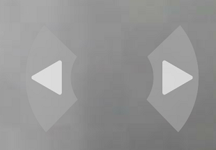

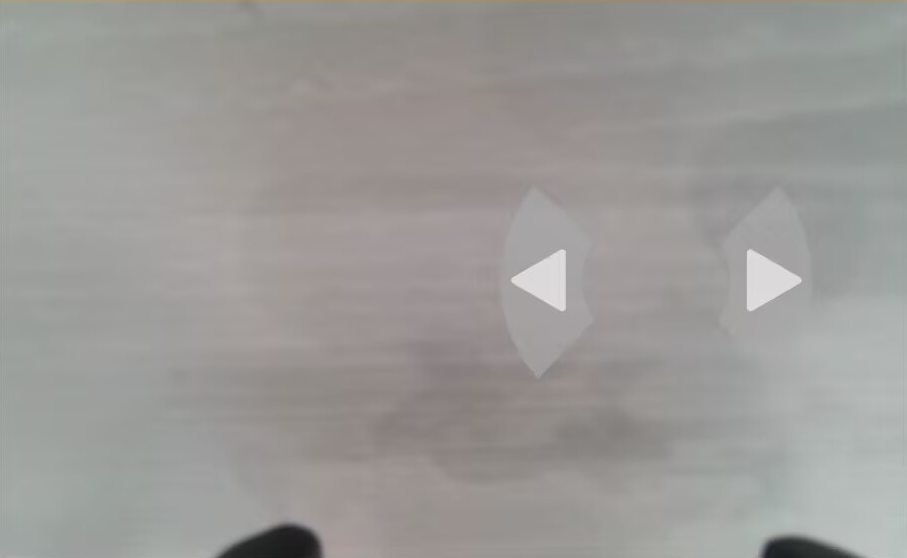

Live Video Feed The pan-tilt rotates left or right, and the gripper rotates clockwise or counterclockwise accordingly.

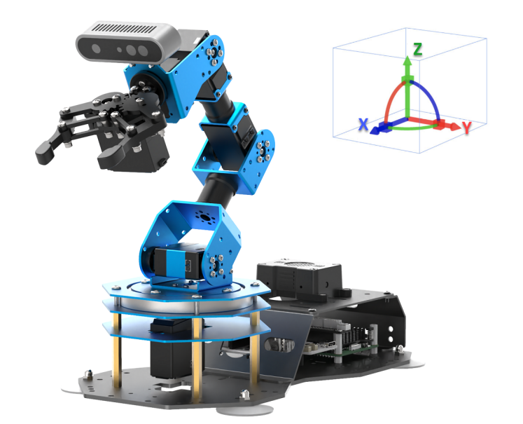

  • Coordinate Mode: In Coordinate Mode, the robotic arm moves as a whole along the X, Y, and Z axes and can also adjust its tilt angle based on button inputs.
Button Functions in Coordinate Mode:
Button Function (from the robotic arm's first-person perspective)
START Reset the robotic arm
SELECT+START Switch control mode (Single Servo / Coordinate)
UP / ↑ Move arm in the positive X direction (forward)
DOWN / ↓ Move arm in the negative X direction (backward)
LEFT / ← Move arm in the positive Y direction (left)
RIGHT / → Move arm in the negative Y direction (right)
Y Close the gripper (Servo 10)
A Open the gripper (Servo 10)
B Rotate Servo 5 to the right (Gripper turns right)
X Rotate Servo 5 to the left (Gripper turns left)
L1 Move arm upward along Z axis
L2 Move arm downward along Z axis
R1 Increase gripper pitch angle
R2 Decrease gripper pitch angle

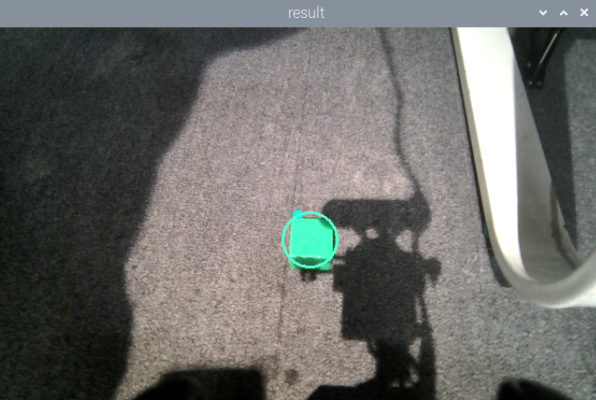

  1. Click on the object you want to track in the camera feed window. The system will automatically detect the color threshold of the selected object and set it as the tracking target.

After launching the feature, place a red block within the field of view of the robotic arm’s camera. The live video feed will highlight the detected target color, and the robotic arm with its chassis will continuously follow the movement of the red block.

Scale the image to the preset size and convert it to the LAB color space, then apply Gaussian blur to reduce noise. Generate a threshold range based on the target color’s LAB values, and create a mask using cv2.inRange. Then, apply erosion and dilation operations to remove interference. Target contour extraction: Extract contours from the mask, filter out small contours to exclude noise, and select the largest contour or the one closest to the previous frame as the target. Calculate the target’s minimum enclosing circle, obtaining the center coordinates (x, y) and radius (r), and map them back to the original image size. If the x deviation from the target center exceeds 20 pixels, compute the rotation speed twist_msg.angular.z using pid_yaw to control the chassis rotation. If the y deviation exceeds 20 pixels, compute the forward/backward speed twist_msg.linear.x using pid_dist to control the chassis to move closer to or farther from the target. Target loss handling: If the target is not detected for 10 consecutive frames, reset the tracking state last_color_circle=None.

When the left mouse button is clicked on the image, normalize the click coordinates to a 0–1 range and create a Color_Picker instance to extract the color information at that location.

Receives the target coordinates through the SetPoint service, sets the tracking color, and returns a success status.

Converts the incoming ROS image message to an OpenCV RGB image and stores a copy for result display. If no color has been selected, use ColorPicker to extract the target color. If a color is already selected, run the ObjectTracker and publish the chassis velocity depending on the is_running state. If tracking is disabled, with is_running set to False, publish a zero-velocity command and reset the PID controllers.

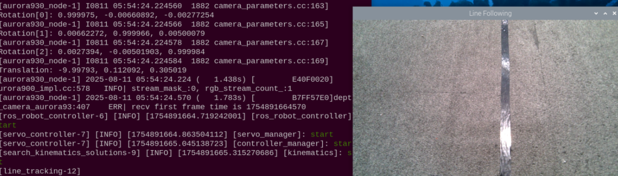

  1. Once the program is launched successfully, you will see the following log messages printed in the terminal. A camera feed window will pop up automatically.
  1. Click on the line you want to track in the camera feed window. The system will automatically detect the color threshold of the selected line and set it as the tracking target.

7. mouse_callback Function
        if event == cv2.EVENT_LBUTTONDOWN and self.image_width and self.image_height:
            with self.lock:
                norm_x = x / self.image_width
                norm_y = y / self.image_height
                self.color_picker = ColorPicker(Point(x=norm_x, y=norm_y), 20)
                self.follower = None
                self.get_logger().info(f"Picked color point norm coords: ({norm_x:.3f}, {norm_y:.3f})")
When the left mouse button is clicked on the image, normalize the click coordinates to a 0–1 range, create a ColorPicker instance, and extract the color at the clicked position as the tracking target.

def main(args=None):
    rclpy.init(args=args)
    node = LineFollowingNode("line_following")
        rclpy.spin(node)
    except KeyboardInterrupt:
        pass
    finally:
        node.mecanum_pub.publish(Twist())
        node.destroy_node()
        rclpy.shutdown()
Serves as the program entry point, initializing the ROS2 environment, creating and running the node, and cleaning up resources upon exit.
