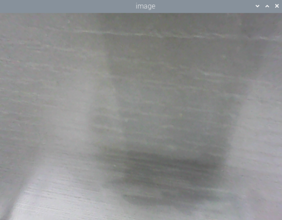

  • Project Outcome
The live camera feed will pop up.

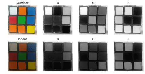

(1) RGB Color Space
RGB color space includes the following characteristics:
① It is a color space where colors are obtained through the linear combination of the Red (R), Green (G), and Blue (B) components.
② Object illumination affects the values of each channel in this color space, and the three color channels are correlated. Let’s split the image into its R, G, and B components and observe them to gain a deeper understanding of the color space.
From the image below, if you look at the blue channel, you can see that the blue and white parts of the Rubik’s Cube in the second image appear similar under indoor lighting conditions, but there is a noticeable difference in the first image. This non-uniformity makes color-based segmentation in this color space very challenging. Additionally, there is an overall difference in values between the two images. Therefore, the RGB color space exhibits issues with uneven color value distribution and the blending of chromaticity and brightness.

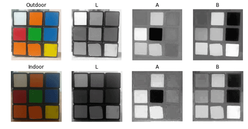

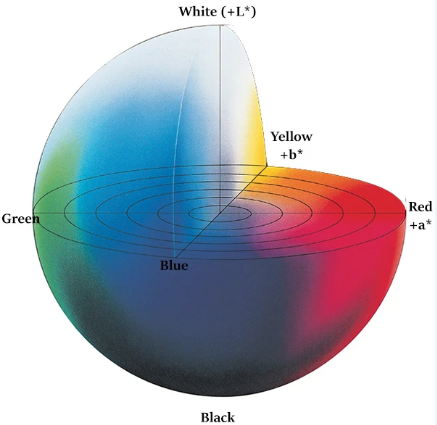

Lab Color Space
Similar to RGB space, Lab also has three channels.
L: Lightness channel.
a: color channel a, representing the colors ranging from green to magenta.
b: color channel b, representing the colors ranging from blue to yellow.
The Lab color space is entirely different from the RGB color space. In the RGB color space, color information is divided into three channels, but these same three channels also include brightness information. On the other hand, in the Lab color space, the L channel is independent and contains only brightness information, while the other two channels encode color.
L Component: Represents the brightness of pixels. A higher L value corresponds to higher brightness.
a Component: Represents the range from red to green.
b Component: Represents the range from yellow to blue.
In OpenCV, the numerical range of R, G, B values in the RGB color space is [0-255]. In the Lab color space, the L value range is [0-100], where 0 represents black, and 100 represents white. The a and b values range from [-128, 127], and both a and b values of 0 represent gray.

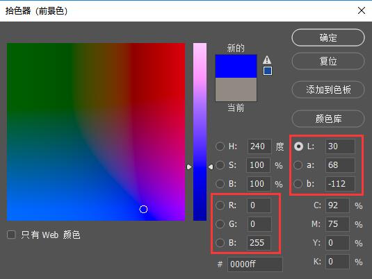

To further aid in understanding the comparison between RGB and Lab, here is an example using Photoshop software:
① Use the Eyedropper Tool to select a color.
② Click on the Color Picker in the lower left corner to view the corresponding Lab and RGB values, as shown below.

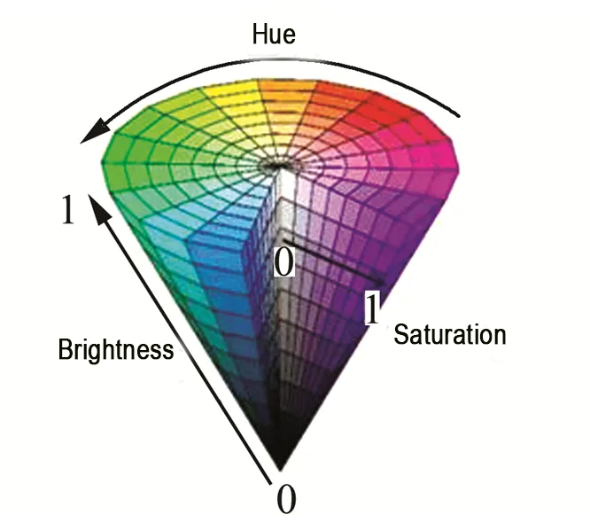

The HSV color space is a perceptually-based color model with three components:
H (Hue), S (Saturation), and V (Value).
Hue is associated with the dominant wavelengths in the blended spectrum, such as red, orange, yellow, green, cyan, blue, and violet, representing different hues. If considered from the perspective of wavelength, light of different wavelengths actually reflects differences in hue.
Saturation refers to the relative purity or the amount of white light mixed with a color. Pure spectral colors are fully saturated, while colors like deep red (red plus white) and light purple (purple plus white) are desaturated. Saturation is inversely proportional to the amount of white light added.
Value reflects the brightness of light perceived by the human eye, and this metric is related to the reflectivity of an object. Concerning color, the more white is added, the higher the brightness; the more black is added, the lower the brightness.
One notable feature of HSV is its use of only one channel to describe color (H), making it very intuitive for specifying colors. However, HSV color is device-dependent.

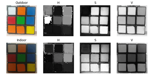

As shown in the figure below:
The H component is remarkably similar in both images, indicating that even with changes in lighting, color information remains consistent.
The S component in both images is also highly alike, while the V component represents brightness and thus varies with changes in illumination.
There is a significant disparity in the values of red between outdoor and indoor images. This is because the H value represents the starting angle of the color in degrees. Therefore, it may take values between [300, 360] and [0, 60].

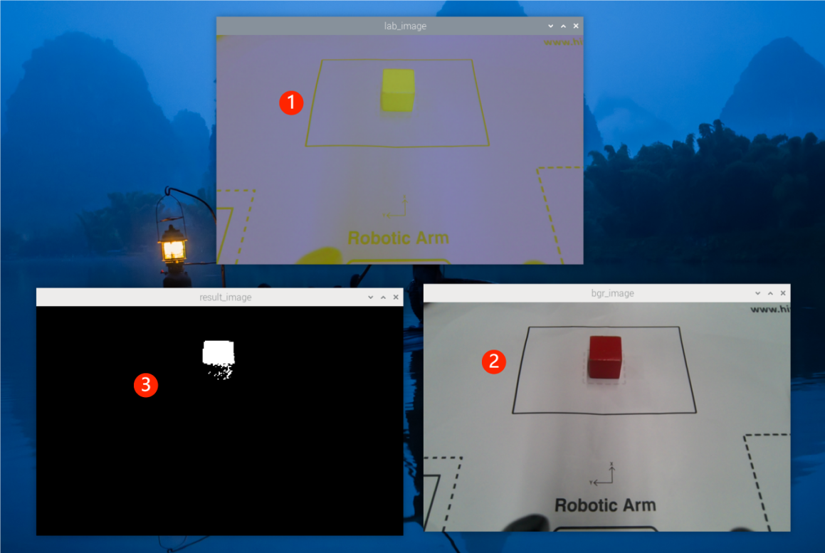

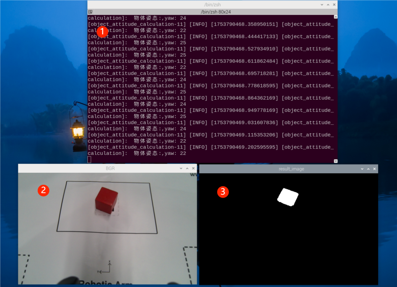

  • Project Outcome

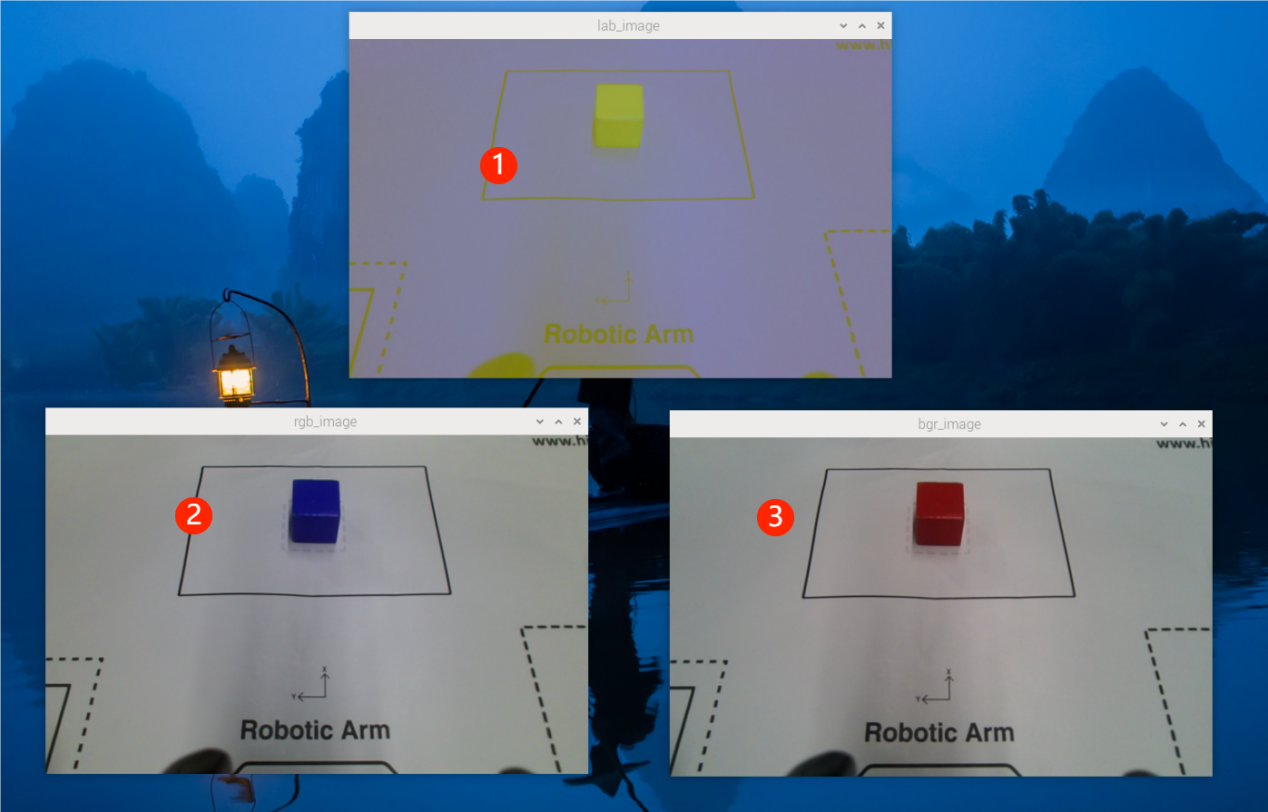

In the display:
The window labeled ① is lab_image – the LAB image converted from RGB.
The window labeled ② is bgr_image – the image in the BGR color space.
The window labeled ③ is result_image – the binary image obtained after color threshold filtering.

5.1.4 Color Space Conversion
  • Program Introduction
By subscribing to the camera images, we convert the captured images to different color spaces and view them in the displayed output.
  • Operation Steps
When entering commands, be sure to use correct case and spacing. You can use the Tab key to auto-complete keywords.
(1) Start the robotic arm, and access the robot system desktop using VNC. To get detailed instructions on remote control software connection, please refer to the tutorials saved in 1. ArmPi Ultra User Manual->1.6 Development Environment Setup and Configuration.
(2) Click the terminal icon in the system desktop to open a command-line window. Enter the following command and press Enter to stop the auto-start service:
(3) Enter the following command and press Enter to start the feature.
ros2 launch example color_space.launch.py
(4) To stop the program, press Ctrl + C in the terminal window. If the program does not stop immediately, repeat this step until it terminates.
(5) After completing the feature, you need to initiate the app service. Otherwise, future app features may not function properly. In the terminal, enter the following command and press Enter to start the app service. Wait a few seconds for it to initialize.
ros2 launch bringup bringup.launch.py
  • Project Outcome
In the display:
The window labeled ① is lab_image – the image converted from RGB to the LAB color space.
The window labeled ② is rgb_image – the original image from the camera.
The window labeled ③ is bgr_image – the image converted from RGB to BGR.

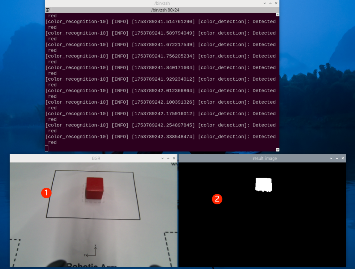

5.1.5 Color Recognition
By subscribing to camera image data, the captured images are converted to the LAB color space. Following this conversion, color recognition can be performed using specific color thresholds. After matching the transformed image with the color thresholds, the program identifies the desired colors and prints the recognized color in the terminal. Additionally, it outputs the BGR image and the binary image.
  • Operation Steps
(1) Start the robotic arm, and access the robot system desktop using VNC. To get detailed instructions on remote control software connection, please refer to the tutorials saved in 1.ArmPi Ultra User Manual->1.6 Development Environment Setup and Configuration.
ros2 launch example color_recognition.launch.py
  • Project Outcome
In the display:
The window labeled is BGR – the image in BGR color space.
The window labeled is result_image – the binary image obtained from color detection results.

  • Project Outcome

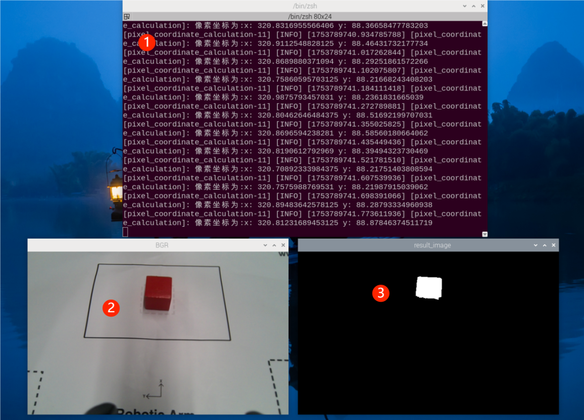

The terminal in area ① prints the pixel coordinates. x represents the horizontal coordinate, while y represents the vertical coordinate.
The window named “RGB” in area ② shows the depth camera’s feed, which is the BGR image converted from RGB.
The window named “result_image” in area ③ displays the binary black-and-white image generated by the color_detection function.

  • Project Outcome
The terminal output in area shows the object’s yaw pose, which corresponds to the gripping angle of the robotic claw.
The window named “BGR” in area displays the feedback image from the depth camera, converted from RGB to BGR format.
The window named “result_image” in area displays the binary black-and-white image generated by the color_detection function.

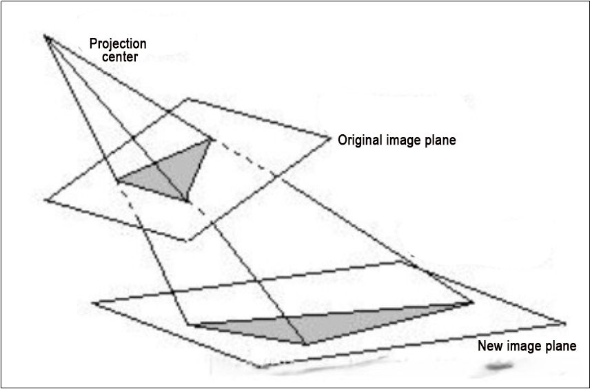

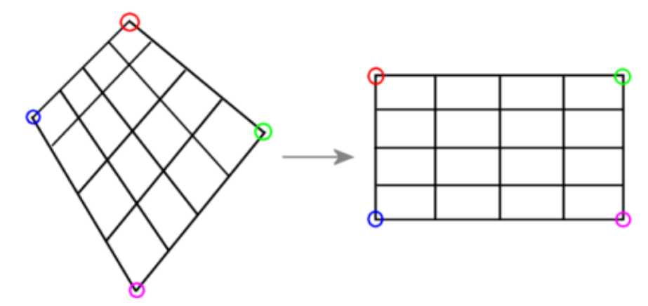

5.1.8 Perspective Transformation
  • Perspective Transformation Description
Perspective transformation refers to the process of projecting an image onto a new viewing plane using the conditions of collinearity among the perspective center, image points, and target points. The goal of perspective transformation is to convert objects that appear as lines in reality but may be skewed in an image into straight lines through the transformation process.
  • Perspective Transformation Function
Perspective transformation is commonly employed in research areas such as vision navigation for mobile robots. In scenarios where the camera is inclined relative to the ground rather than directly facing downward, resulting in an oblique angle, there is a need to rectify the image into a form with a straight, orthogonal projection. This correction is achieved through the application of perspective transformation.
  • Perspective Transformation Principle
The process of converting a three-dimensional object or entity from a spatial coordinate system into a two-dimensional image representation is known as projection transformation. Perspective transformation is an operation that modifies the size and shape of objects, resulting in a three-dimensional effect when applied to a planar figure. For instance, in the case of a rectangle, shear transformation only displaces two vertices on the same edge, both moving in the same direction, while keeping the other two vertices stationary. Conversely, perspective transformation may require moving all vertices of the rectangle, with the two vertices on the same edge moving in opposite directions. Simply put, perspective transformation involves transitioning from a two-dimensional image to a three-dimensional representation and then back to a two-dimensional image.
Based on the schematic principles of perspective transformation, we can formulate the following equations:
The coordinates (X, Y, Z) represent a point in the original image plane, and the corresponding transformed image plane coordinates are (x, y). Since we are dealing with a two-dimensional image, we can set Z=1. Dividing the transformed image coordinates by Z is a way to reduce the image from three dimensions to two dimensions. Thus, we can obtain the following equations:
Usually, we set a33=1 to simplify obtaining X’, Y’, ensuring that the denominator on the left side of equation 3 is 1. Expanding the above formula, we obtain the situation for a single point:
Equation 3 involves a total of 8 unknowns. To solve for these unknowns, it is necessary to formulate eight sets of equations. This entails manually selecting four points on both the source image and the target image. On the source image, four coordinates are selected: A (x0, y0), (x1, y1), (x2, y2), (x3, y3). Simultaneously, four coordinates are chosen on the target image: B (X’0, Y’0), (X’1, Y’1), (X’2, Y’2), (X’3, Y’3).
By substituting into Equation 3, we can obtain Equation 4 as follows:

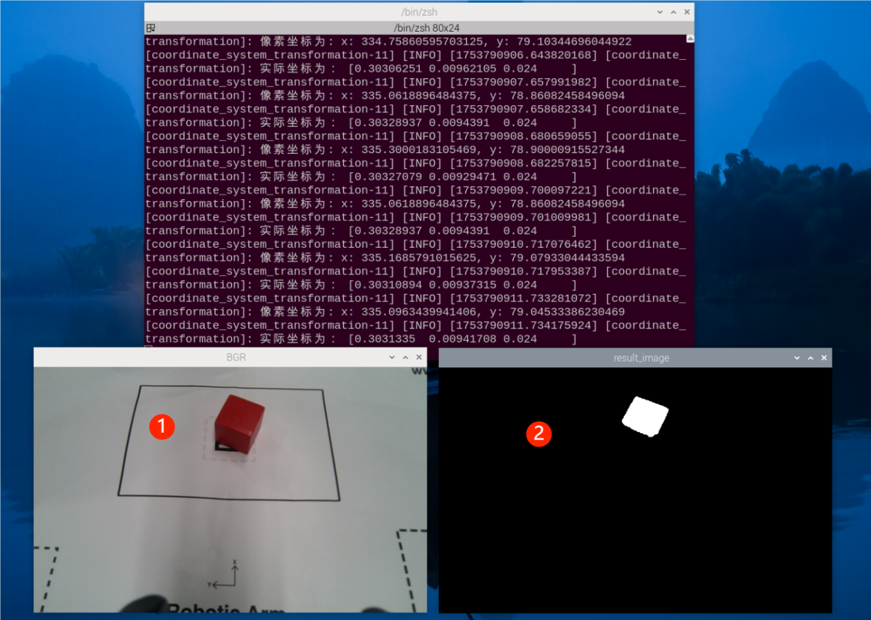

  • Project Outcome
In the display, the image on the left labeled ① is the BGR image converted from RGB, and the image on the right labeled ② is color_detection, which is the result after color recognition processing. The terminal prints the pixel coordinates of the color block’s center point as well as the actual coordinates after conversion.

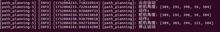

(3) Enter the command to start the Demo of trajectory planning.
ros2 launch example path_planning.launch.py
(4) To stop the program, press Ctrl + C in the terminal window. If the program does not stop immediately, repeat this step until it terminates. If you want to experience the mobile app features again later, enter the command and press Enter to start the app service. Wait for the robotic arm to return to its initial position — a beep from the buzzer will indicate it’s ready.
  • Project Outcome
The pan-tilt at the base of the robotic arm first rotates to face the target position. Then, the arm moves above the target position, descends to the target, and finally returns to its initial pose.
  • Change Robot Arm’s Gripping Position
To change the gripping position of the robotic arm, you can modify the parameters within self.movement_0 and self.movement_1 functions. The parameters in the parentheses, from left to right, represent the x, y, and z coordinates of the target position in meters, as well as the angle of the gripper when grasping the object, ranging from -90° to 90°.
Once the gripping position for the robotic arm set, it will calculate whether it can reach that position. If reachable, it will move to the target location, but otherwise the robotic arm will remain stationary.
86
87
88
89
90
91
92
93
94
95
96
97
            # Run the path planning program (运行路径规划程序)
            self.get_logger().info("云台运动")
            self.move_0(0.2, -0.1, 0.05, 90)
            time.sleep(2)
            self.get_logger().info("动作1")
            self.move_1(0.2,  -0.05, 0.07, 90)
            time.sleep(2)
            self.get_logger().info("动作2")
            self.move_1(0.2,  -0.05, 0.005, 90)
            time.sleep(3)
            self.start = False  # Stop the loop (停止循环)
            self.get_logger().info("停止运动")

                            # Print pixel coordinates and real-world coordinates. (打印像素坐标和实际坐标)
                            self.get_logger().info(f"像素坐标为: x: {x}, y: {y}")
                            self.get_logger().info(f"实际坐标为: {position}")
                            self.start_sortting(position,yaw)

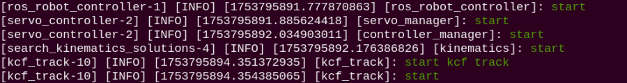

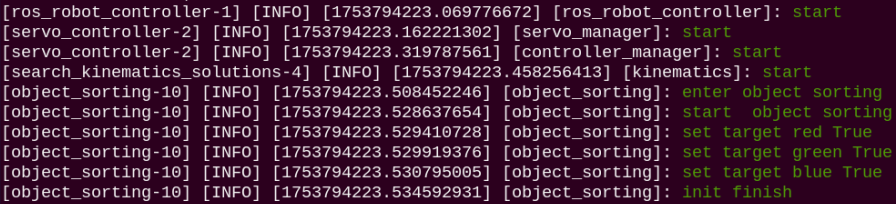

ros2 launch example color_sorting_node.launch.py
(6) Once the program is launched successfully, you will see the following log messages printed in the terminal. A camera feed window will pop up automatically.

        if not self.get_parameter('broadcast').value:
            target_list = ["red", "green", "blue"]
            req = SetStringBool.Request()
            req.data_bool = True
            for i in target_list:
                req.data_str = i
                res = SetBool.Response()
                self.set_target_srv_callback(req, res)
        self.get_logger().info('\033[1;32m%s\033[0m' % 'init finish')

    def get_object_pixel_position(self, bgr_image, roi):
        target_info = []
        draw_image = bgr_image.copy()
        roi_img = bgr_image[roi[0]:roi[1], roi[2]:roi[3]]
        roi_img = self.image_process.get_top_surface(roi_img)
        # cv2.imshow('roi_img', roi_img)
        image_lab = cv2.cvtColor(roi_img, cv2.COLOR_BGR2LAB)  # Convert to LAB space (转换到 LAB 空间)
            index = 0
            mask = cv2.inRange(image_lab, tuple(self.lab_data['color_range_list'][i]['min']), tuple(self.lab_data['color_range_list'][i]['max']))  # Binarization (二值化)
            # Smooth edges, remove small blocks, and merge adjacent blocks (平滑边缘,去除小块,合并靠近的块)
            eroded = cv2.erode(mask, cv2.getStructuringElement(cv2.MORPH_RECT, (3, 3)))
            contours = cv2.findContours(dilated, cv2.RETR_EXTERNAL, cv2.CHAIN_APPROX_NONE)[-2]  # Find all contours (找出所有轮廓)
            contours_area = map(lambda c: (math.fabs(cv2.contourArea(c)), c), contours)  # Calculate contour area (计算轮廓面积)
            contours = map(lambda a_c: a_c[1], filter(lambda a: self.min_area <= a[0] <= self.max_area, contours_area))
            for c in contours:
                rect = cv2.minAreaRect(c)  # Obtain the minimum bounding rectangle (获取最小外接矩形)
                (center_x, center_y), _ = cv2.minEnclosingCircle(c)
                center_x, center_y = roi[2] + center_x, roi[0] + center_y
                # cv2.circle(draw_image, (int(center_x), int(center_y)), 8, (0, 0, 0), -1)
                corners = list(map(lambda p: (roi[2] + p[0], roi[0] + p[1]), cv2.boxPoints(rect)))  # Obtain the four corner points of the minimum rectangle and convert to the coordinates of the original image (获取最小外接矩形的四个角点, 转换回原始图的坐标)
                cv2.drawContours(draw_image, [np.intp(corners)], -1, (0, 255, 255), 2, cv2.LINE_AA)  # Draw rectangle contour (绘制矩形轮廓)
                # cv2.line(draw_image, (int(center_x), 0), (int(center_x), 480), (255, 255, 0), 2, cv2.LINE_AA)
                index += 1  # Incremental numbering (序号递增)
                angle = int(round(rect[2]))  # Rectangle angle (矩形角度)
                target_info.append([i, index, (int(center_x), int(center_y)), (int(rect[1][0]), int(rect[1][1])), angle])
        return draw_image, target_info
Processes images within the ROI, converts to LAB color space, performs threshold segmentation and contour extraction for red, green, and blue colors. Filters contours by area, calculates the center point, bounding rectangle, and angle, and returns an image with drawn contours and a list of target information.

    def get_object_world_position(self, position, intrinsic, extristric, white_area_center, height=0.03):
        projection_matrix = np.row_stack((np.column_stack((extristric[1], extristric[0])), np.array([[0, 0, 0, 1]])))
        world_pose = common.pixels_to_world([position], intrinsic, projection_matrix)[0]
        world_pose[0] = -world_pose[0]
        world_pose[1] = -world_pose[1]
        position = white_area_center[:3, 3] + world_pose
        position[2] = height
        config_data = common.get_yaml_data(os.path.join(self.config_path, self.calibration_file))
        offset = tuple(config_data['pixel']['offset'])
        scale = tuple(config_data['pixel']['scale'])
        for i in range(3):
            position[i] = position[i] * scale[i]
            position[i] = position[i] + offset[i]
        return position, projection_matrix
Converts pixel coordinates to world coordinates using camera intrinsics and external parameters. Applies scaling and deviation from the calibration file, adjusts world coordinates, and returns the result.

5.1.13 Modify Default Recognizable Color
This section demonstrates changing the default color used for object detection and picking in the positioning clamp. The same method applies for other features.
To change the robotic arm’s recognition color, modify the parameters inside the red box to “blue” or “green”.
61
            # Start color detection (开始颜色检测)
            self.color_detection("red",self.bgr_image)

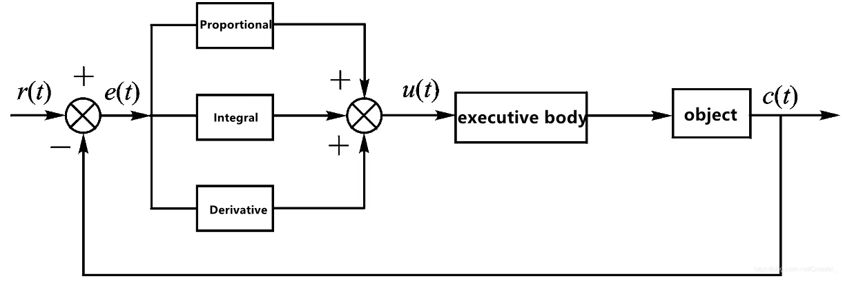

  • PID Algorithm Description
The PID (Proportional–Integral–Derivative) algorithm is one of the most widely used automatic control methods. It operates by adjusting control inputs based on the proportional, integral, and derivative of the error. The PID controller is popular due to its simplicity, ease of implementation, broad applicability, and independently adjustable parameters.
Simplify:
And: u(t) —— The output of the PID controller.
Kp —— Proportional gain .
Ti — Integral time constant.
Td — Derivative time constant.
e(t) — The difference between the setpoint r(t) and the measured value (error).

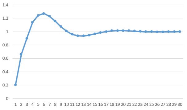

  • PID Algorithm Working Logic
In a closed-loop control system, the output result of the object controlled will be returned to affect the output of the controller so as to generate one or multiple loop. The closed-loop system has positive and negative feedback. If the feedback signal is opposite to the given signal, it is negative feedback. If they are the same, it is positive feedback. The control flow of the PID algorithm can be referred to in the following diagram:

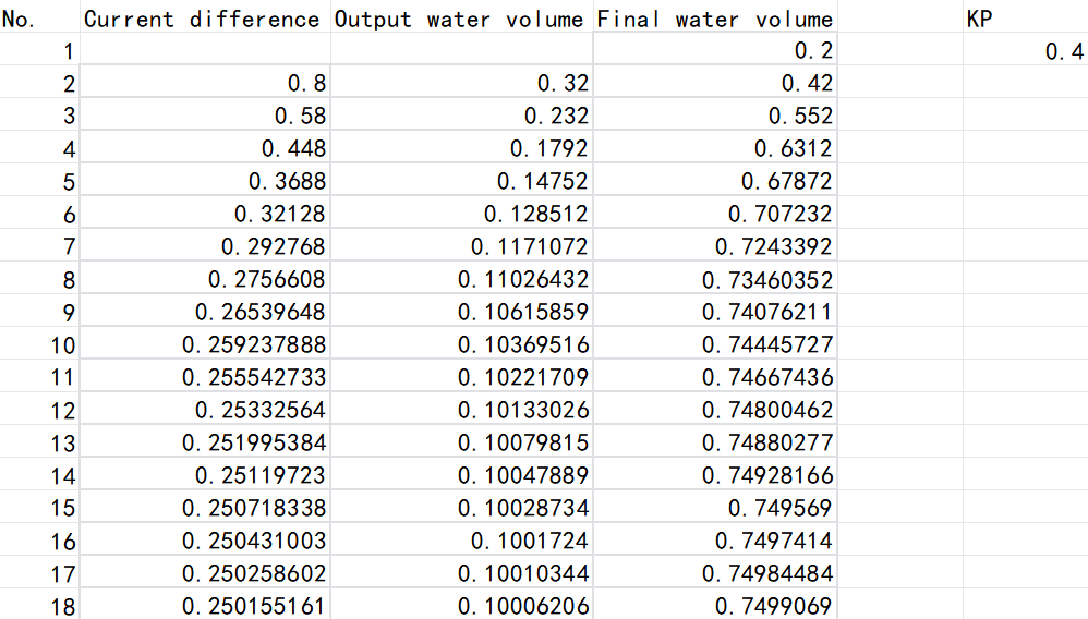

(1) Proportional
Error is the difference between the given value, the set threshold r(t), and the measured output c(t). After the proportional is introduced, the output of the system is proportional to the error, which can reduce the error quickly and stabilize the system. When the system tends to stabilize, steady-state error will still exist and cannot be eliminated. The control effect of proportional depends on the value of Kp. The smaller the proportional coefficient Kp, the weaker the control and the slower the system response. On the contrary, the larger the proportional coefficient Kp, the stronger the control, and the faster the system response. However, too large Kp will cause the system to generate large overshoot and oscillation. The advantage of proportional control lies in its fast response, but the disadvantage is that there is a steady-state error.
Take a bucket for example. There is a hole at the bottom of the bucket, but you need to maintain the water in the bucket at 1m. And the current water level is 0.2m, and the water will leak 0.1m whenever you add the water. Here, proportional control can be adopted to control the water volume. The current water volume is 0.2m and the target is 1m. Set Kp = 0.4. Then u = 0.4 * e, and e = last water volume - current water volume.
The first error: e(1) = 1 - 0.2 = 0.8m. Therefore, the volume of the added water is 0.32m (Kp * 0.8 = 0.4 * 0.8 = 0.32m), and the current water volume in the bucket is 0.42m (0.2 + 0.32 - 0.1 = 0.42m).
The second error: e(2) = 1 - (0.2 + 0.32) = 0.48m. Therefore, the volume of the added water is 0.192m (Kp * 0.48 = 0.192m), and the current water volume in the bucket is 0.552m (0.52 + 0.192 = 0.552).
Lastly, the water level stabilizes at 0.75m, and the error is 0.25m. When you add 0.1m water, the volume of the water added is equivalent to the volume of the water leaking. And this kind of error is called steady-state error.
Steady-state error is defined as the difference between the output under the system tends to stabilize and the target output.

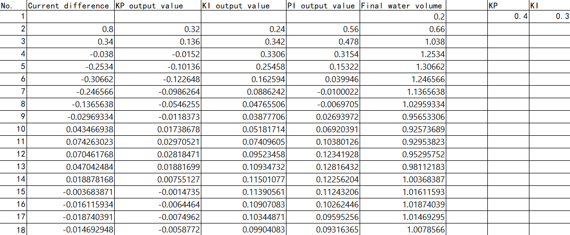

(2) Integral
Integral aims at eliminating the steady-state error. The integral of the error over time is continuously accumulated to keep the output changing so as to reduce the error. If the integral time is sufficient, the steady-state error can be completely eliminated. The smaller Ti is, the stronger the function of integral is. But too strong integral function will make the system overshoot and even oscillate. The advantage of the integral is that the steady-state error can be completely eliminated, but the disadvantage is that the response speed is reduced and the overshoot will be too large.
In the example given above, the steady-state error still exists after proportional control is adopted. To eliminate it completely, you can add integral control. Set the integral constant Ki as 0.3 (Ki = 0.3).
The first error: e(1) = 1 - 0.2 = 0.8m. Therefore, the volume of the added water is: Kp * 0.8 = 0.4 * 0.8 = 0.32m, KI * e(1) = 0.3 * 0.8 = 0.24, and and the final added water is: 0.32 + 0.24 = 0.56. And the current water volume in the bucket is: 0.2 + 0.56 - 0.1 = 0.66m.
The second error: e(2) = 1 - 0.66 = 0.34m. Therefore, the volume of the added water is: Kp * 0.34 = 0.4 * 0.34 = 0.136m, KI * (e(2) + e(1)) = 0.3 * (0.8 + 0.34) = 0.342, and the final added water is: 0.136 + 0.342 = 0.478m. And the current water volume in the bucket is: 0.66 + 0.478 - 0.1 = 1.038m.
After the Integral control is adopted, the steady-state error is completely eliminated, but overshoot occurs.

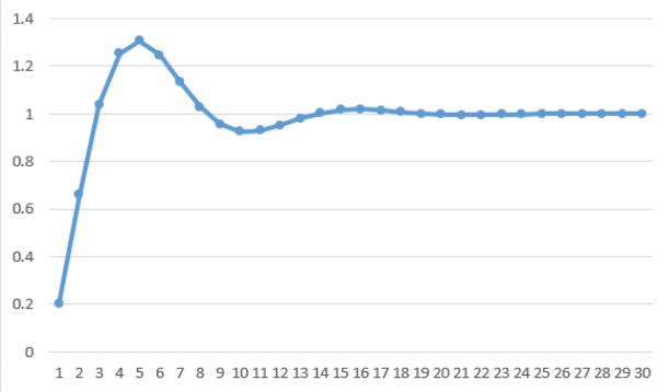

(3) Derivative
The slope error can be obtained by differentiating the error, and the slope reflects the change (rate of change) of the error signal, so the error can be adjusted in advance in derivative part. And it takes effect at the moment when the error appears or changes, so as to avoid excessive overshoot and reduce the dynamic error and response time. The larger the derivative coefficient Td, the stronger the ability to suppress the error variation. The advantage of derivative is that it suppress overshoot and speed up the response. The disadvantage is that the anti-interference ability is poor. When the interference signal is strong, it is not recommended to add derivative.

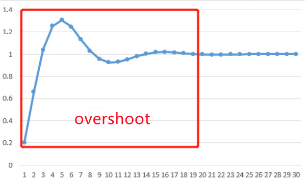

In the above example, the integral effectively eliminates the steady-state error, but overshoot occurs. In order to reduce the overshoot, a derivative control is added. Set Kd as 0.3 (Kd = 0.3).
The first error: e(1) = 1 - 0.2 = 0.8m. Therefore, the volume of the added water is: Kp * 0.8 = 0.4 * 0.8 = 0.32m, KI * e(1) = 0.3 * 0.8 = 0.24. And KD = 0, because the current water difference is 0.8. The final added water is: 0.32 + 0.24 = 0.56m. And the current water volume in the bucket is: 0.2 + 0.56 - 0.1 = 0.66m.
The second error: e(2) = 1 - 0.66 = 0.34m. Therefore, the volume of the added water is: Kp * 0.34 = 0.4 * 0.34 = 0.136m, KI * (e(2) + e(1)) = 0.3 * (0.8 + 0.34) = 0.342. And KD *(e(2) - e(1))= 0.3 * (0.34 - 0.8) = -0.138. The final added water is: 0.136 + 0.342 - 0.138 = 0.34m. And the current water volume in the bucket is: 0.66 + 0.478 - 0.1 = 0.9m.
Compared with proportional control, the overshoot is weakened.

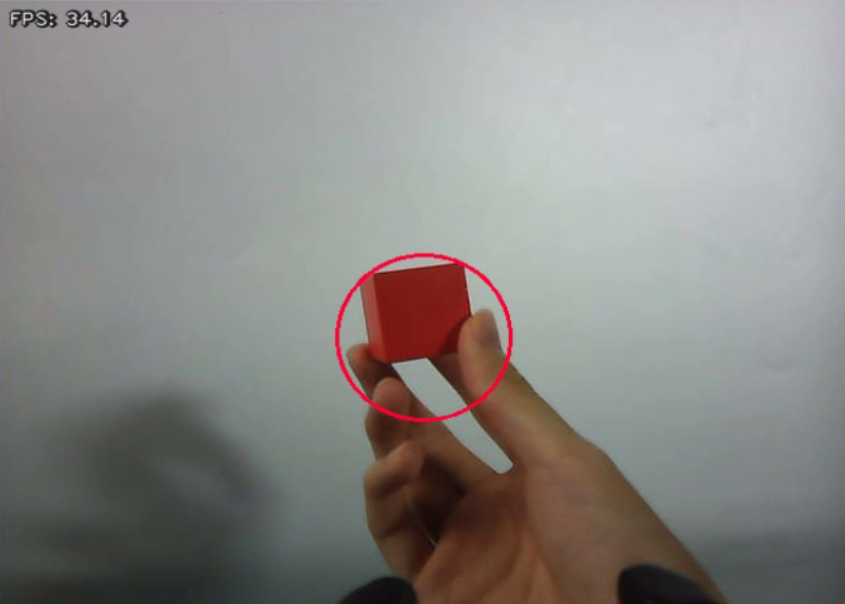

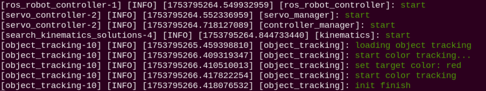

When the camera identifies the target color block, red by default, the robotic arm moves in sync with the color block’s movement.
  • Project Process
First, subscribe to the topic published by the color recognition node to obtain detected color information.
Once the target color is detected, obtain the center position of the target object in the image.
Finally, inverse kinematics is employed to calculate the angles necessary to align the center of the screen with the center of the target image. Then publish the corresponding topic message, control servo rotation, and ensure the robotic arm follows the movement of the target.
  • Enabling the Feature
(1) Start the robotic arm, and access the robot system desktop using VNC. To get detailed instructions on remote control software connection, please refer to the tutorials saved in 1.ArmPi Ultra User Manual ->1.6 Development Environment Setup and Configuration.
(3) Enter the following command and press Enter to stop the auto-start service:
(4) Entering the following command to start the feature.
(5) Once the program is launched successfully, you will see the following log messages printed in the terminal. A camera feed window will pop up automatically.
(6) To exit the feature, press Ctrl+C in the terminal. If the program does not close successfully, try pressing Ctrl+C again.
(7) If you want to experience the mobile app features again later, enter the command and press Enter to start the app service. Wait for the robotic arm to return to its initial position — a beep from the buzzer will indicate it’s ready.
  • Project Outcome
After launching the feature, place a red block within the field of view of the robotic arm’s camera. The live video feed will highlight the detected target color, and the robotic arm will continuously follow the movement of the red block.

            threading.Thread(target=self.enter_srv_callback,args=(Trigger.Request(), Trigger.Response()), daemon=True).start()
            time.sleep(1.0)
            req = SetBool.Request()
            req.data = True
            self.enable_color_srv_callback(req, res)
            req = SetFloat64.Request()
            req.data = 1.0 # Tracked color: 0.0 for no tracking, 1.0 for red, 2.0 for green, 3.0 for blue (追踪的颜色 0.0为不追踪, 1.0为红色, 2.0为绿色,3.0为蓝色)
            res = SetFloat64.Response()
            self.set_target_color_srv_callback(req, res)

5.2.3 Tag Tracking
When the camera detects the target tag, set to ID1 by default, the robotic arm will follow the movement of the tag.
  • Project Process
Firstly, subscribe to the topic messages published by the tag tracking node to obtain information about the recognized tag.
Then, upon identifying the target tag, retrieve the central position of the tag image.
ros2 launch example tag_track_node.launch.py

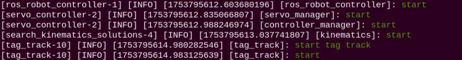

  • Project Outcome
After starting the feature, place the tag with ID1 in front of the robotic arm’s camera. The screen will display the recognized tag ID, and the robotic arm will continuously follow the movement of the tag with ID1.

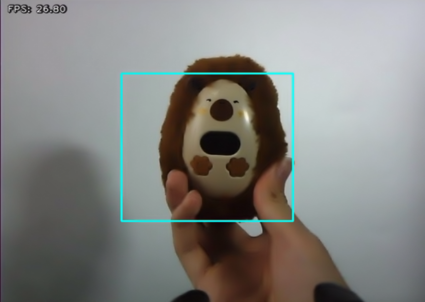

  • Project Outcome
After initiating the feature, place the object you want to track in front of the camera. In the live camera feed window, press the ‘S’ key on the keyboard, then use the left mouse button to draw a bounding box around the object. Finally, press Enter. At this point, the robotic arm will continuously follow the selected object’s movement.
It’s advisable to keep the object’s movement speed moderate. If the object is lost, press ‘S’ again to re-select and frame the object.
